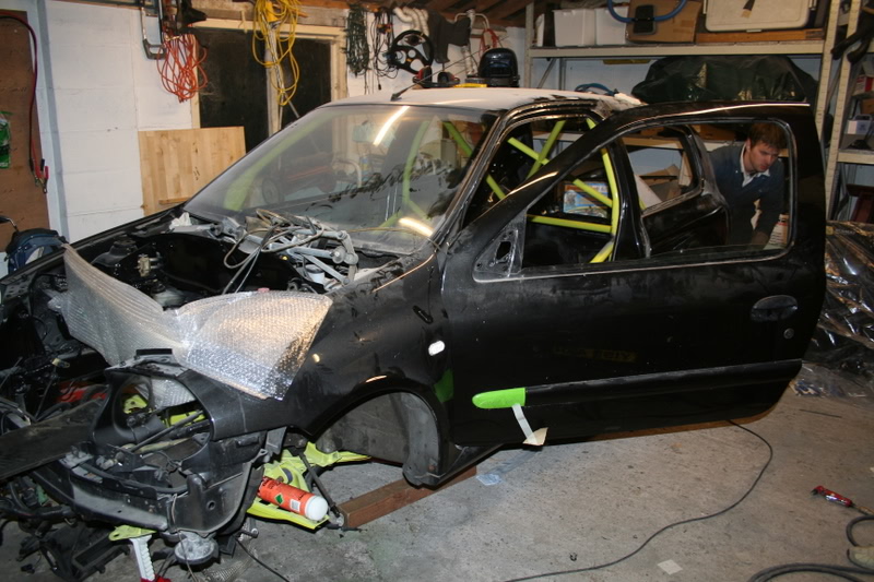

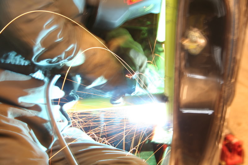

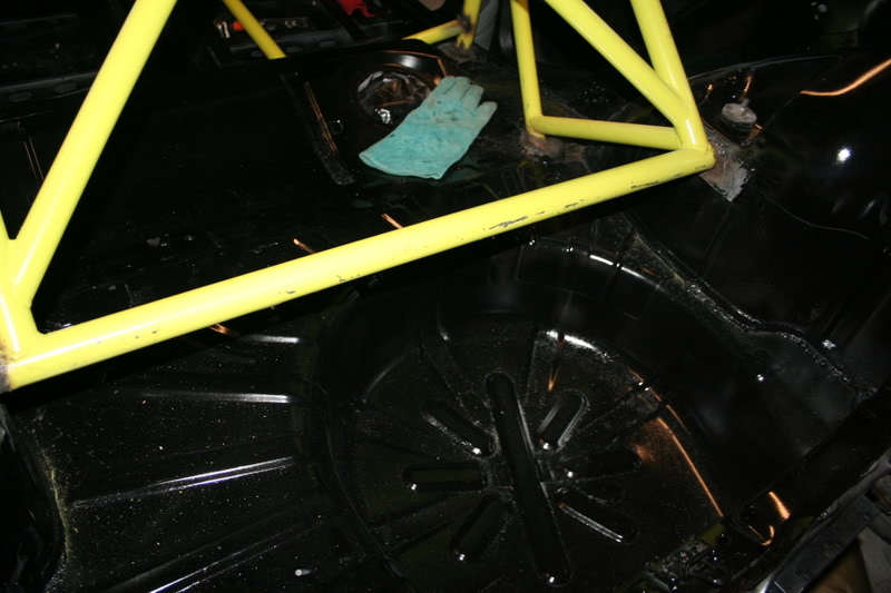

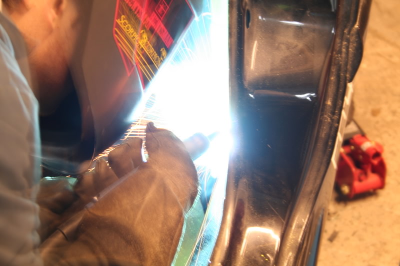

So at 11am rich (Gib172) had driven down from Cumbria to weld the roll cage in for me! Before we could start welding we had to hook the air sander up to take the black paint off the roll cage mounting plates. Then we the help of three people we lifted the rear part of the cage into place, then the front hoop! We spent the best part of 40 minutes lining the cage up and making sure that all the joints where a snug fit. Then whilst taping the front mount with a hammer the fooking front hoop dropped onto my head, ouch... now have a melon sized lump on the back of my head)
Once it was all lined up and we had cleaned the pint of blood from my head up we could start welding the cage.

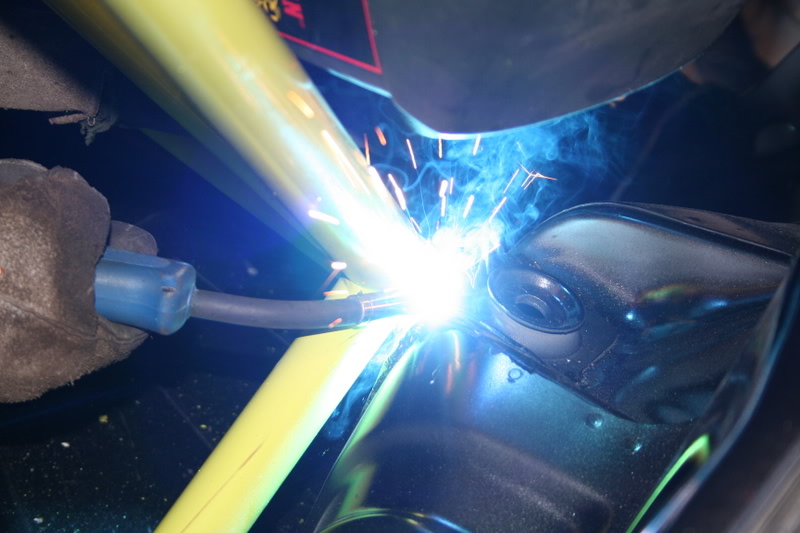

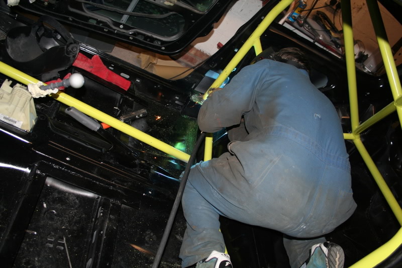

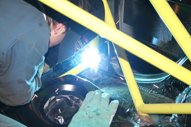

We started with the two mounts between the rear arches.
then the next two mounts above the rear axel
centre of the cage mounts
other side

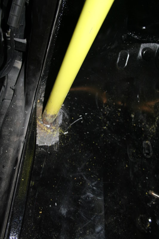

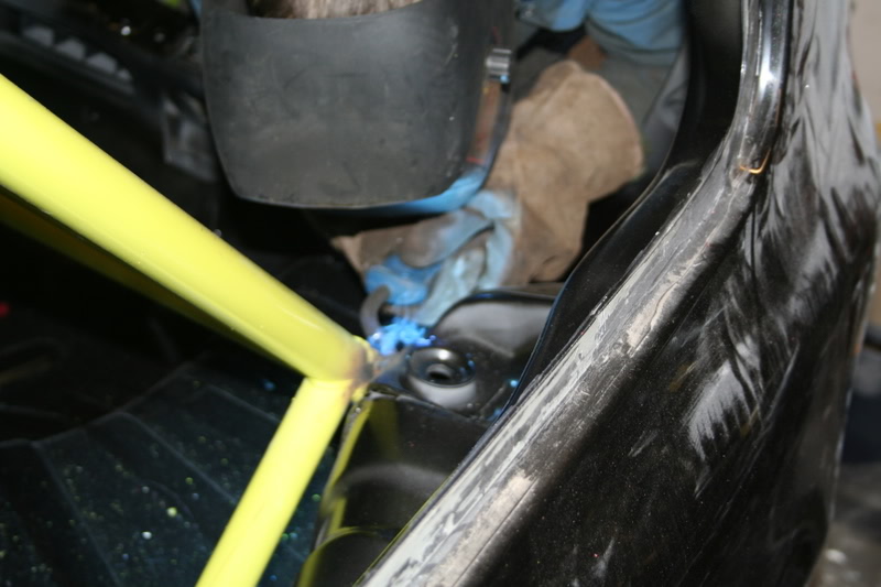

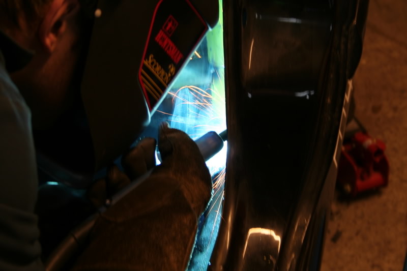

one of the front left lower mount being welded in

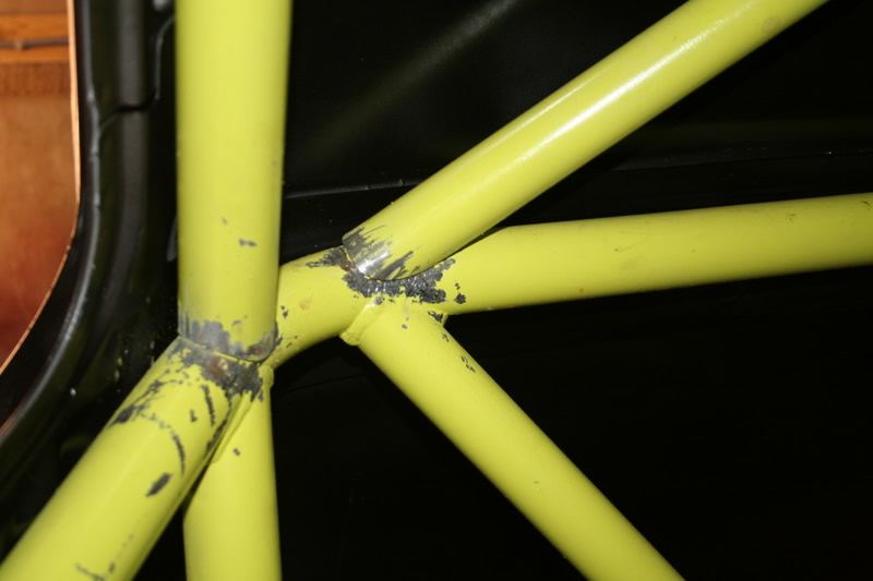

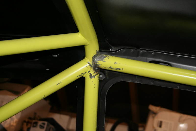

roof mounts half way through..

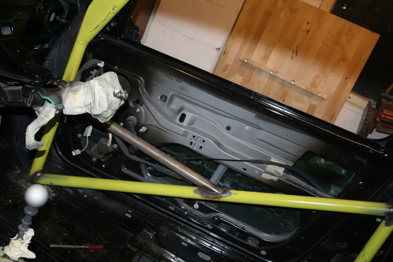

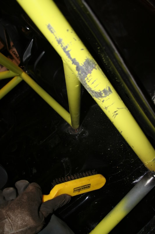

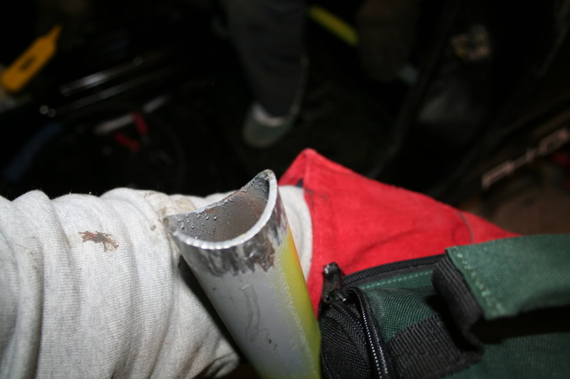

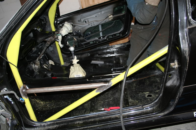

sanding the paint off for the first door bar.. and the tips of the bar

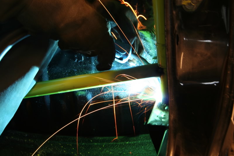

one door bar welded in..

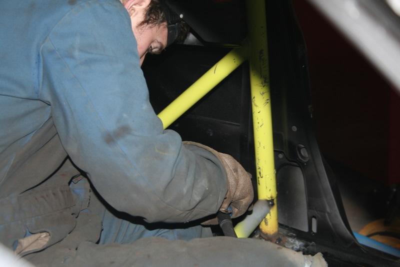

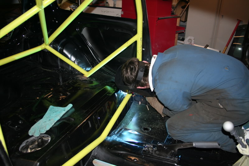

one side of the lower cross bar being welded in

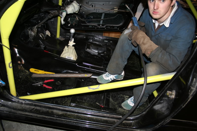

my now melon head doing some filing prep for a weld

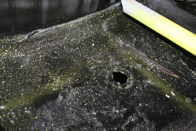

and some green dust all over the floor i had made LOL

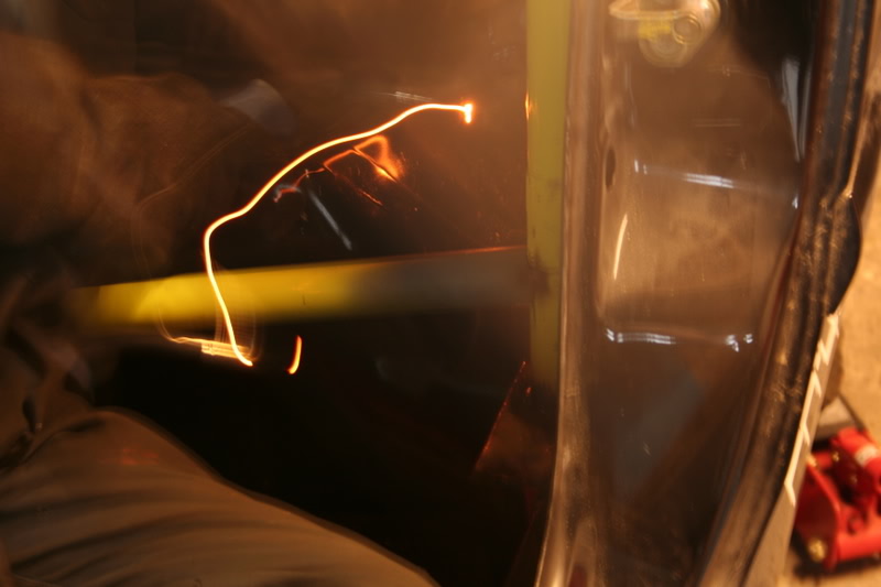

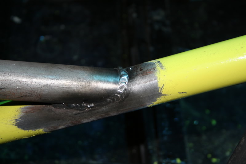

second part of the door bar being welded in

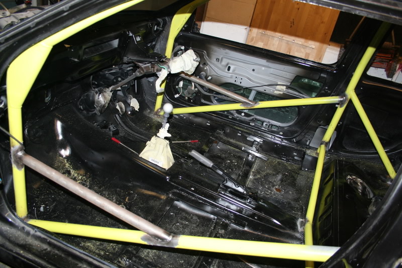

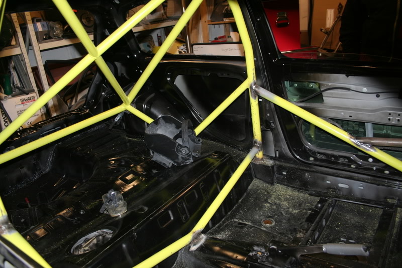

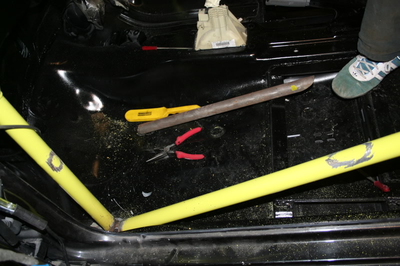

other sides door bars in

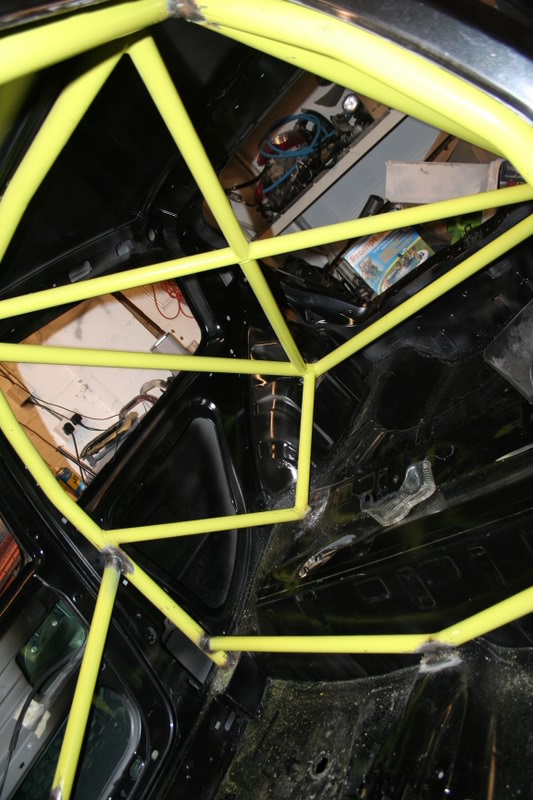

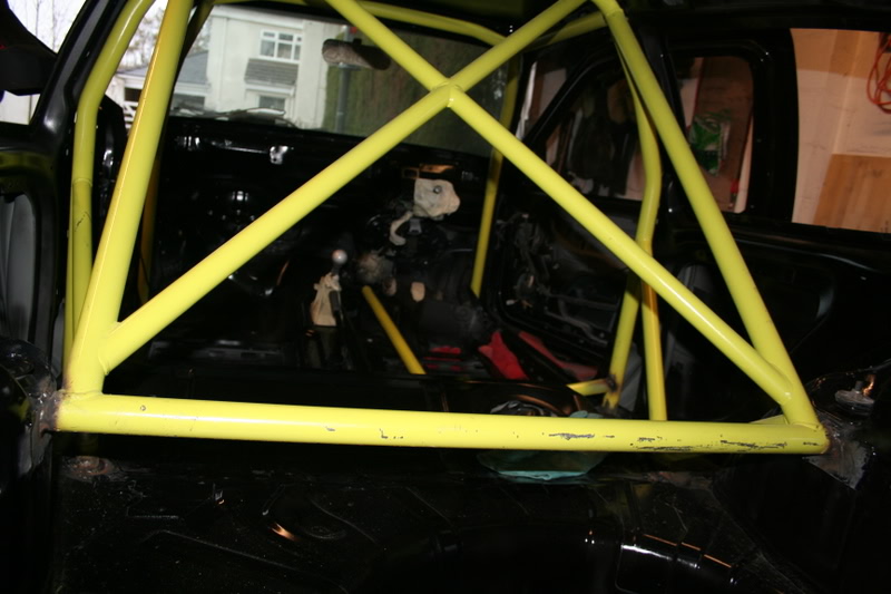

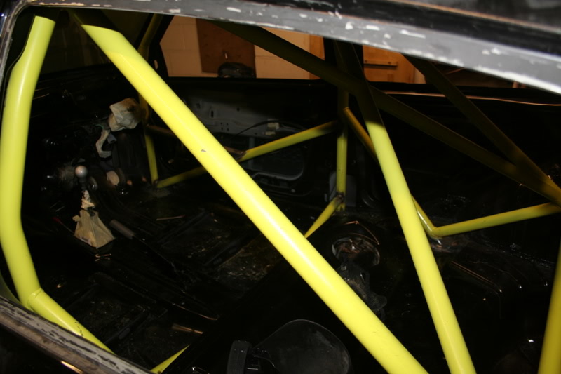

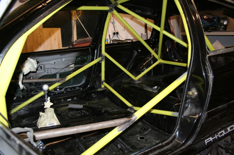

random shots of the cage in
:D

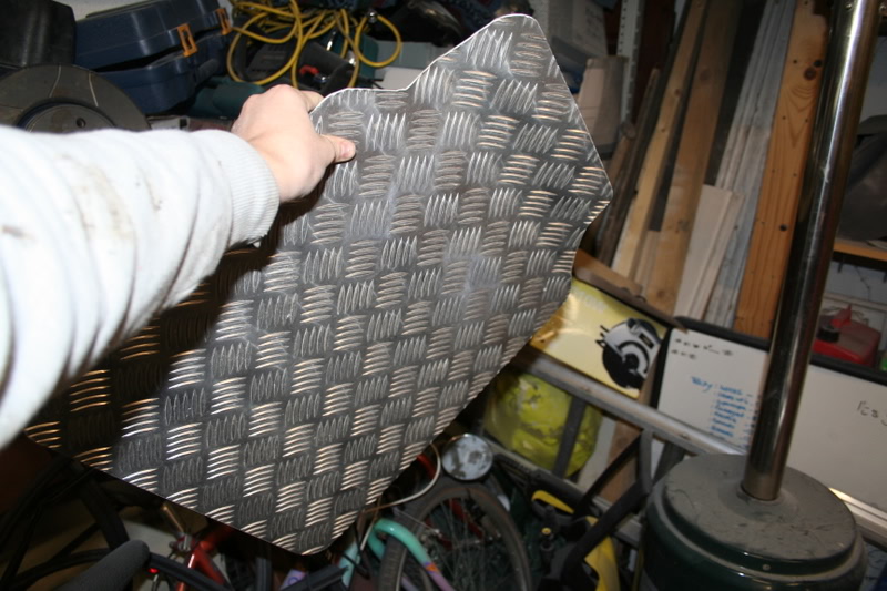

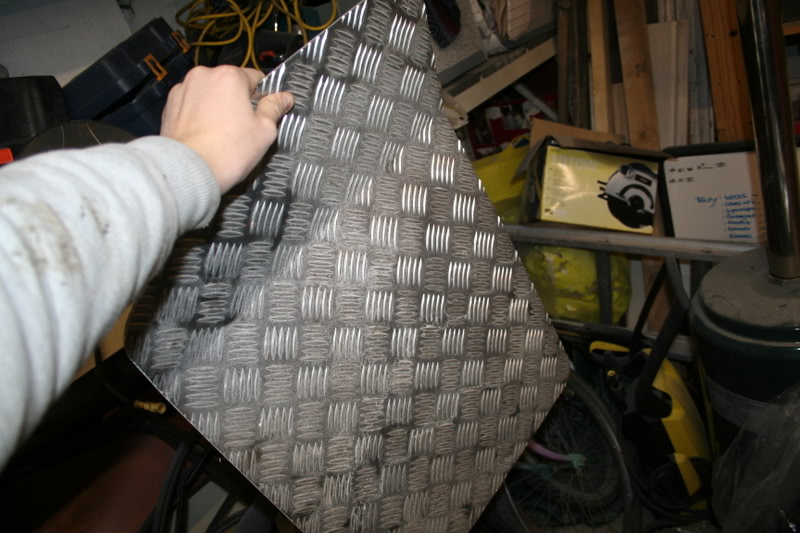

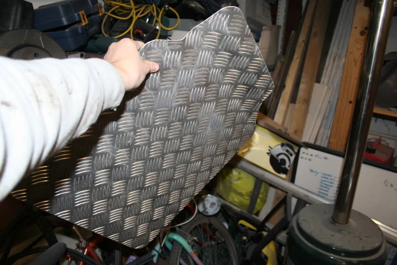

superlight weight ally checker plate floor plates to be rivited in

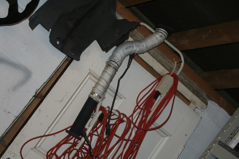

my heatwraped and heat coated miltec 2 1/2 inch de-cat

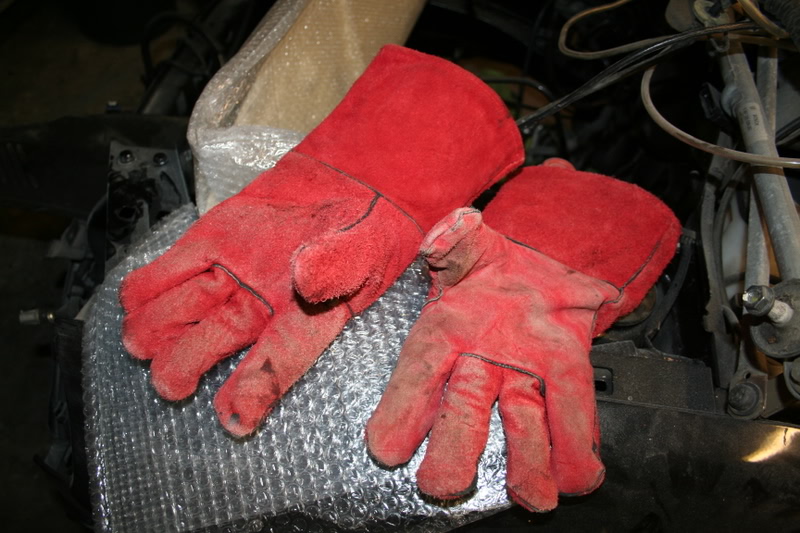

new welding gloves...

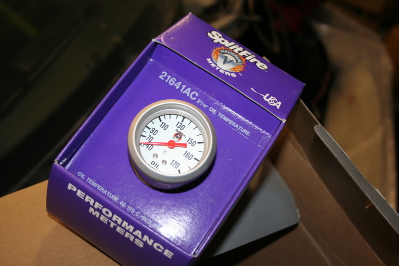

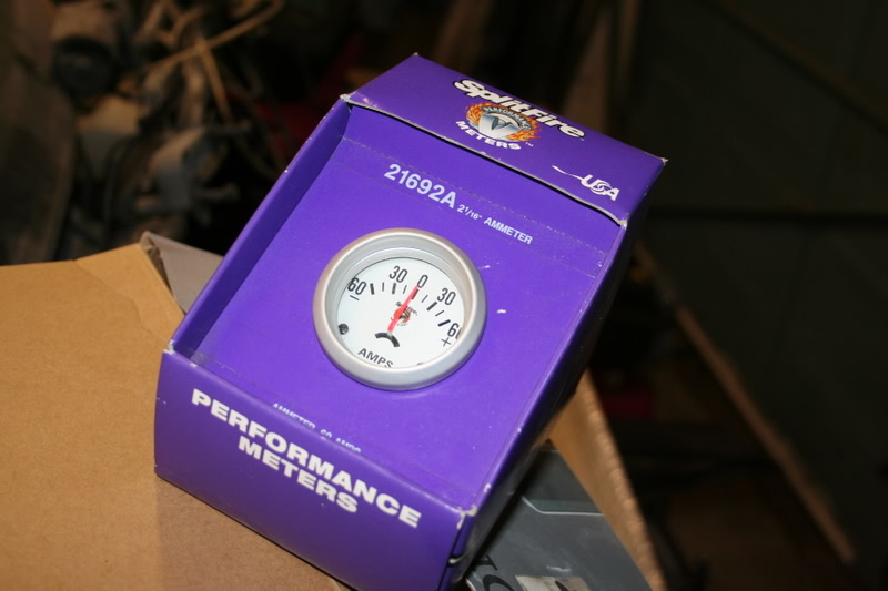

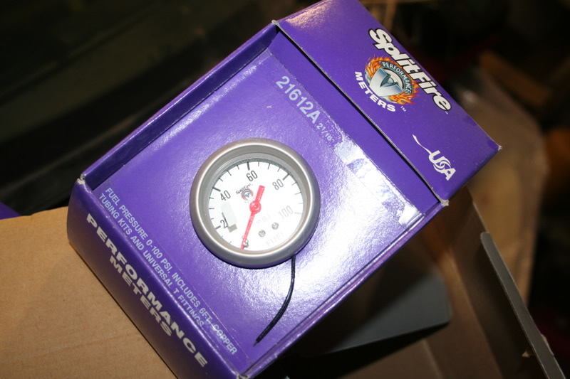

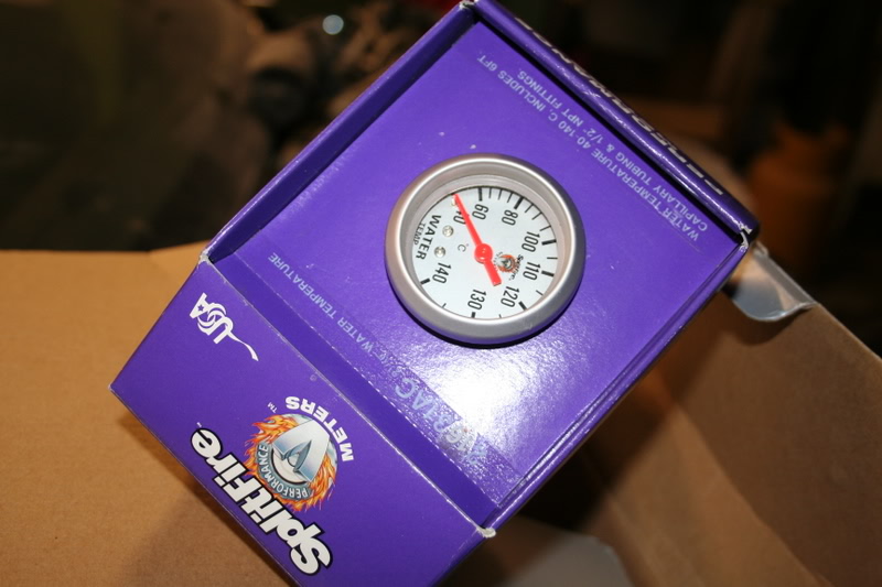

few spitfire guages for the custom dash (theres still a few on order.. boost etc)

How come you have heatwrapped the exhaust manifold and decat? Just to keep heat out the engine bay im guessing but how much does that actually help?

well as i have removed the fire/heat insulation from the bay and cockpit... with 400hp through the manifold.... things could get a little red LOL
plus it keeps bay temp down and can improve performance. i heatwrapped the top part of the de-cat as it joins the manifold in the engine bay (just)

with the cage, in the description on ebay, it says it comes with harness attachment bars.
I didnt get these with mine, unless it means you fix them to the long cross bar at the back?
any ideas???
  C63 AMG, F430 & 172
another excellent update!
any ideas???
i know, i saw this too. i've got quite a few bars left over (which i bought seperatly)
i think i will attach mine on the bar between the rear arch's :)
