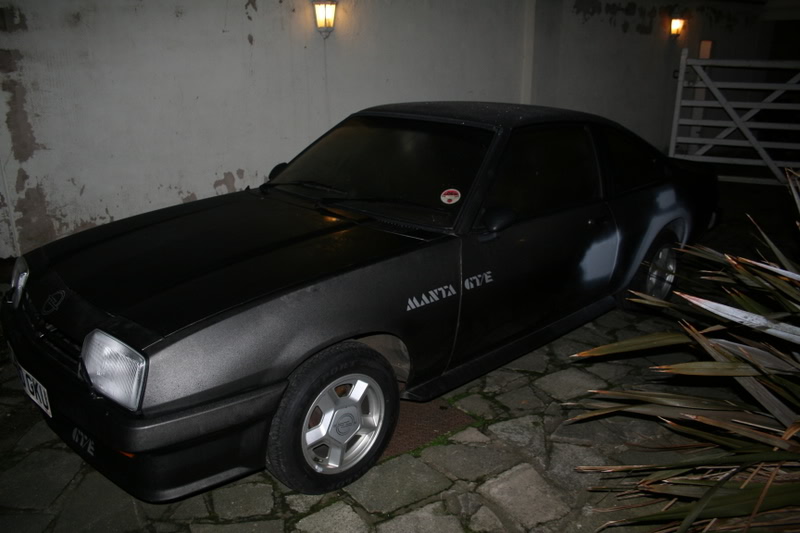

Then just when I had finished my cousin popped round as his project opal manta has blown the water pump taking out various other parts with it....
So about 30 hours later.... that was fixed..

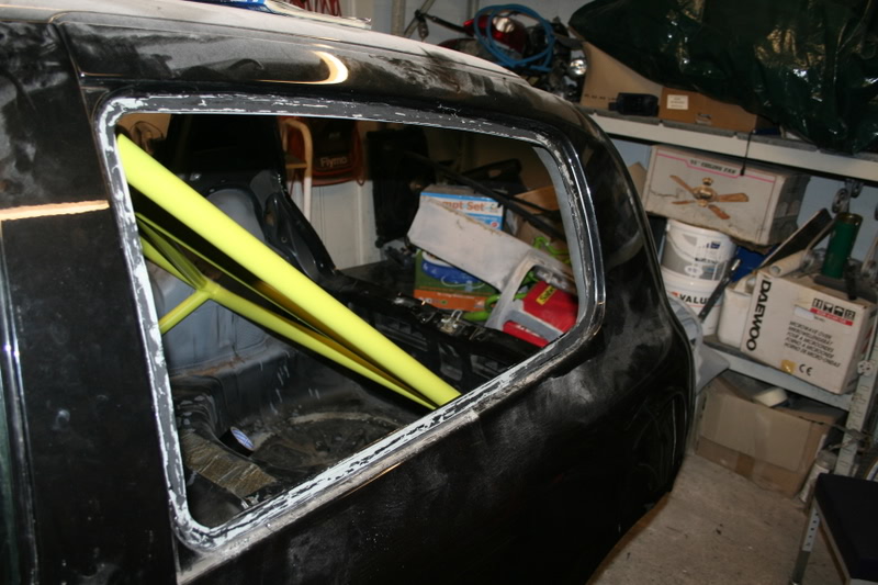

The windows had to come out to enable us to fit the polly carbs... so tried with cheese wire.. no luck, bought a tool which was for removing them which just scratched the paint so Bob had a brain storm...
Awaiting VID.. come on Bob
Then took a Stanley blade to the rest of the bonding agent .... then hovered up the glass LOL

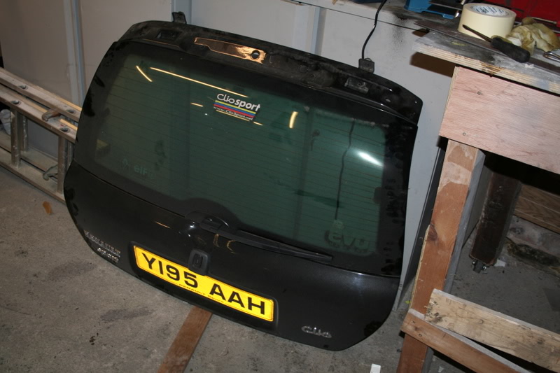

Next off was the boot lid and glass, this is easy.... just remove the gas struts (two clips per side) and then there is two 16mm bolts holding the hinges onto the roof panel.. quick knock with the hammer and off it came! I then removed the hinged from the steel boot ready to fit to the fibreglass boot lid.

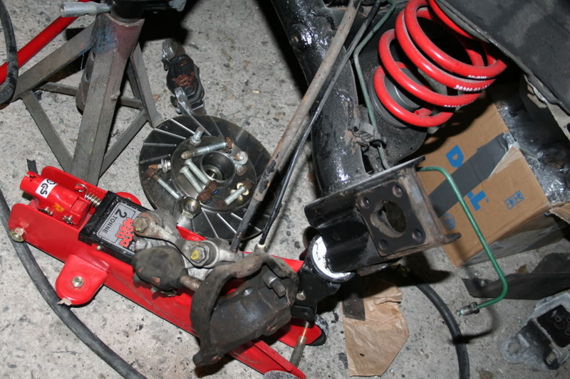

Next job was I am having 1.25 degree camber shims made up so I had to remove the rear brake and sub axel assembly... to do this ...remove the rear shock and support the axel on a jack, remove the two 17mm calliper bolts, remove the 30mm castle nut holding on the disk, remove the 11 nut retaining the brake line screw, remove the two 18mm main calliper bolts and then you are left with the 4 bolts holding the stub axel on .. remove these.. and your left with..

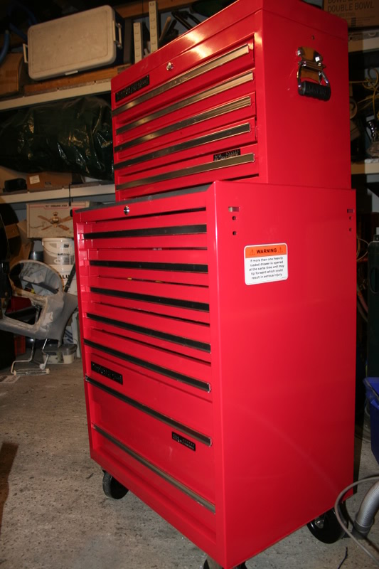

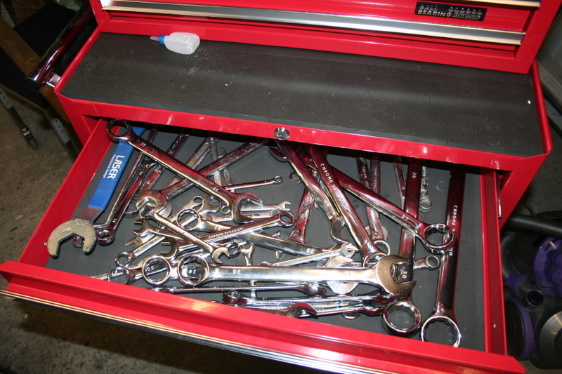

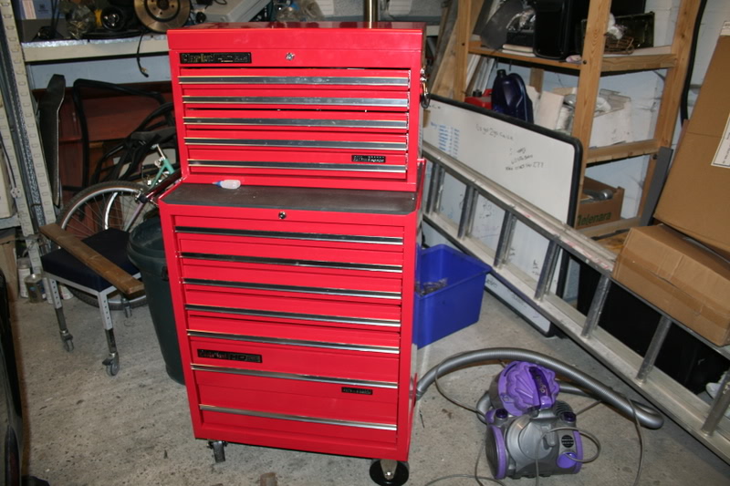

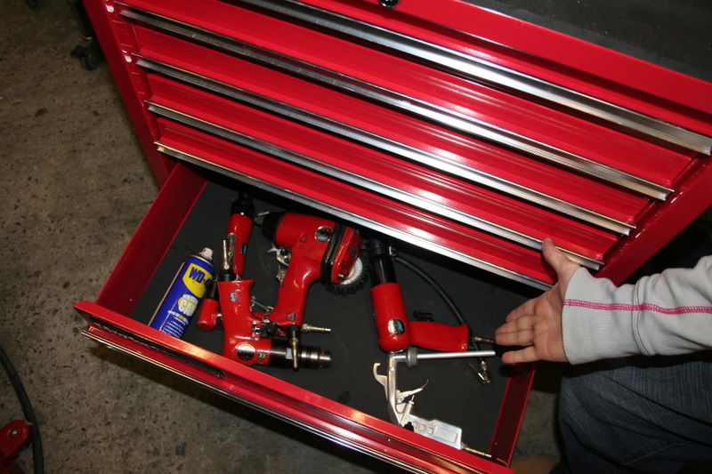

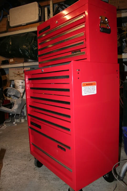

Clarke Roller ball bearing plus range heavy duty two part tool chest ....chin ching!
Mahussive spanner set

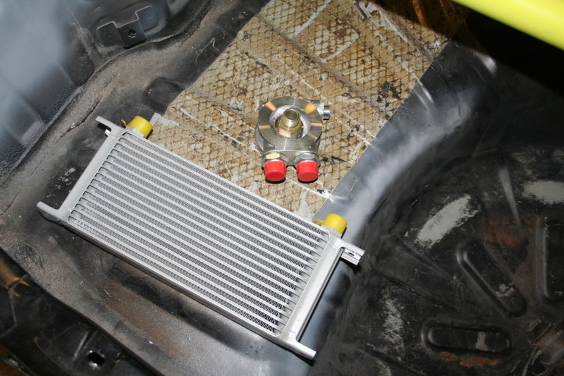

Mocal thermostatic oil cooler sandwich plate
19 row oil cooler (1/4 inch BSP)

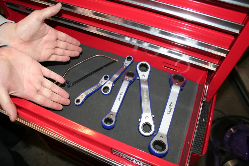

Clarke Ratchet spanners
1 LTR of Renault 647 pearl black for the interior

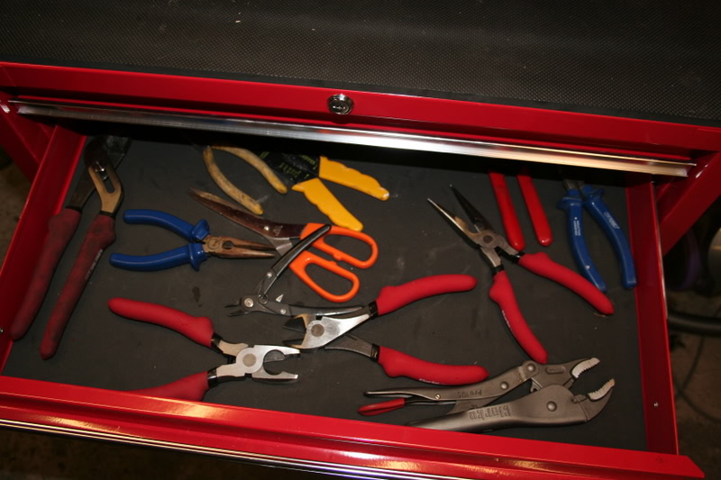

Clarke heavy duty pliers, mole grips etc

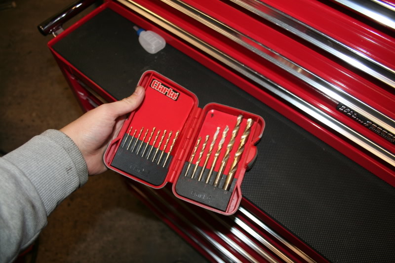

Clarke tin top steel drill bits

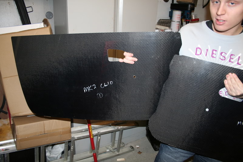

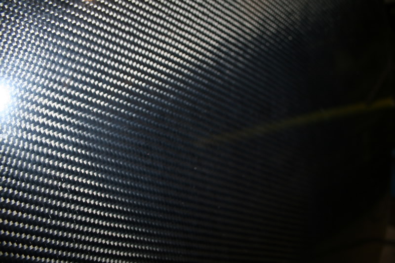

Custom made carbon fibre door cards
Few more air tools LOL

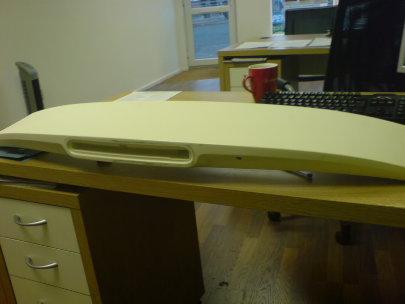

Brand new 172 cup spoiler

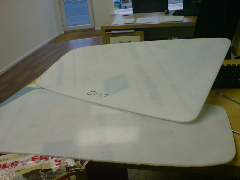

the two rear side polly carb windows turned up with other the others :rolleyes:

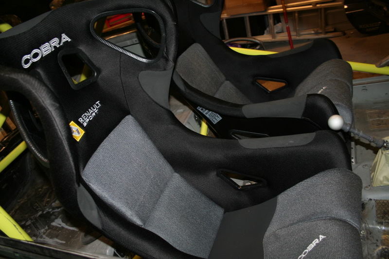

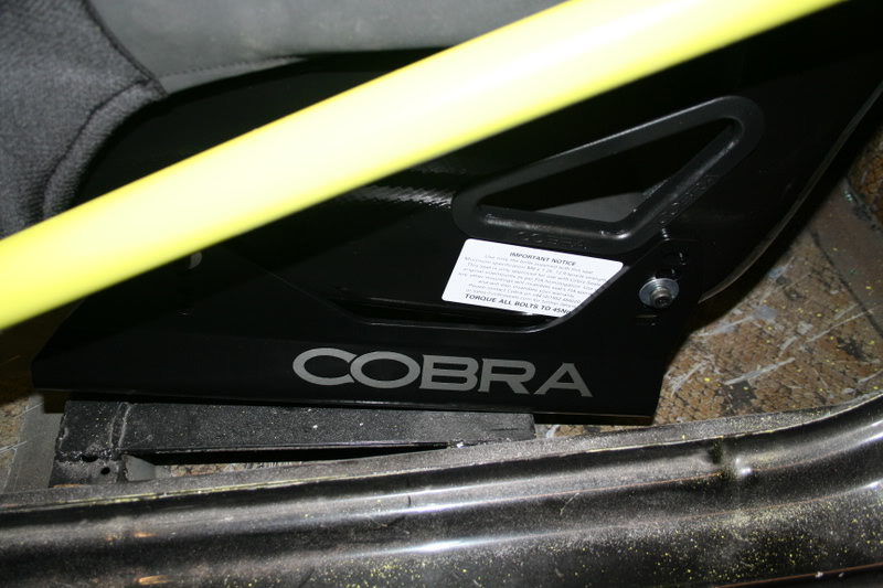

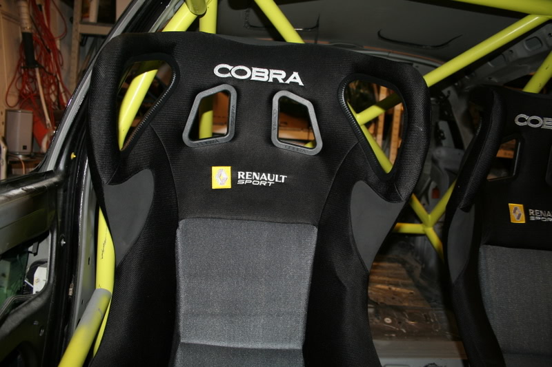

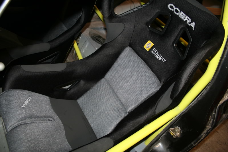

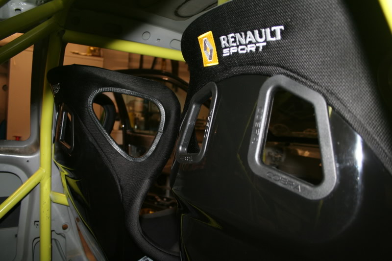

So yesterday I got a delivery finally from cobra for my;
2 x Cobra Evolutions S (one in GT width)
Renault sport embroidery on the front of the head rest and on the rear of the headrest
2 x aluminium 5 mm side mounts

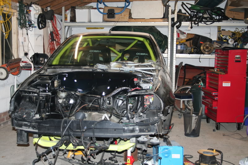

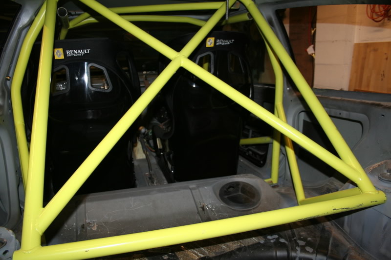

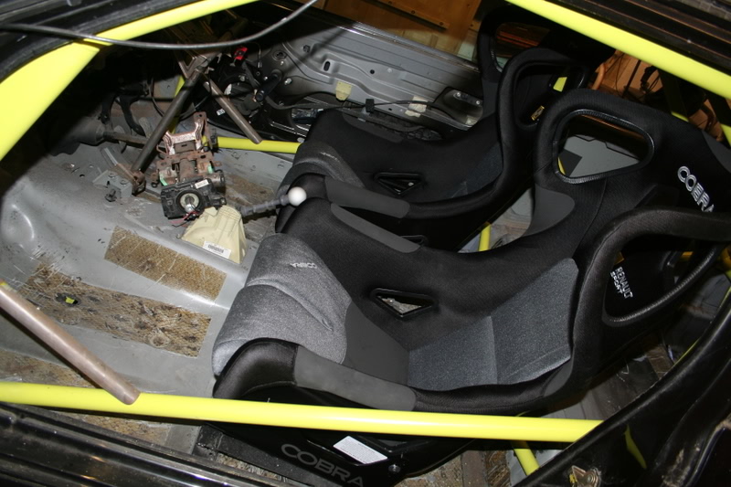

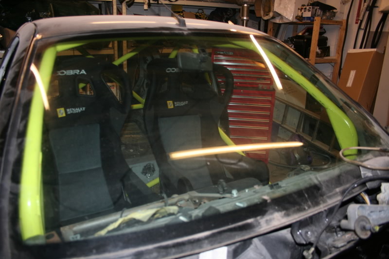

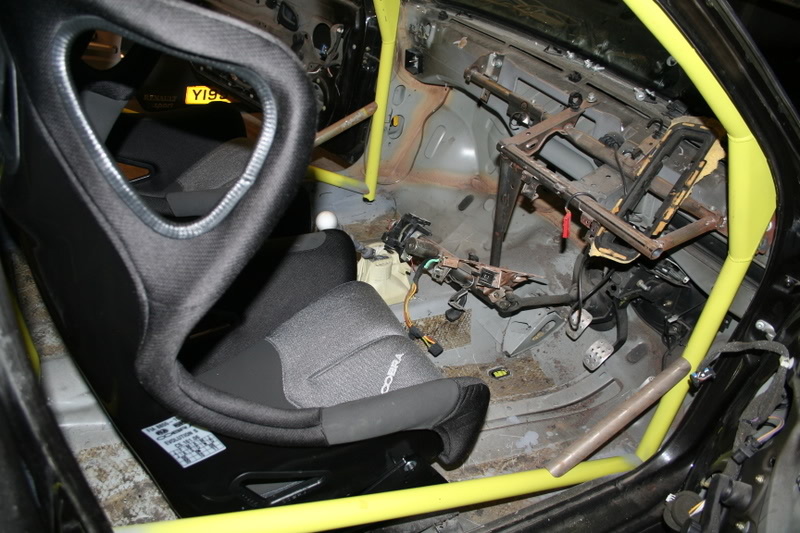

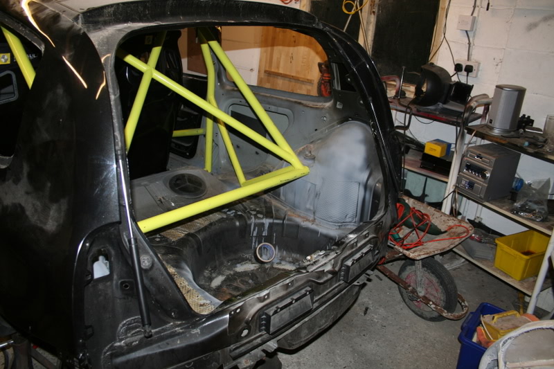

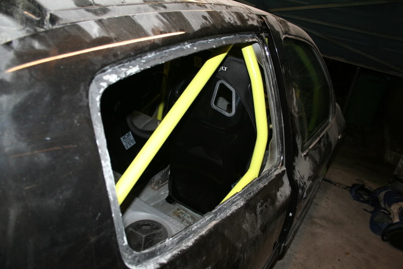

Got home and fitted the side mounts to the seats and placed them in the car! They look out of this world but I had one concern... I didn’t think that they would fit in with the overkill roll cage I have.. L So I decided to re fit the roll cage (this is a b**ch as it gets scratched to f**k fitting it and is one of the most awkward things I have ever had to do in my life!)
But after a hour or so the cage was back in and ...... phew they fit but only just! And they look s**t hot with the green cage etc! Barrp barrpppp!
fitted some cheaky green badges too :p

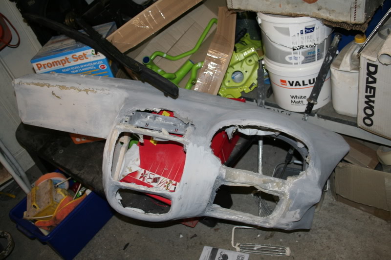

and one of the grim dash..... Lord help me!
