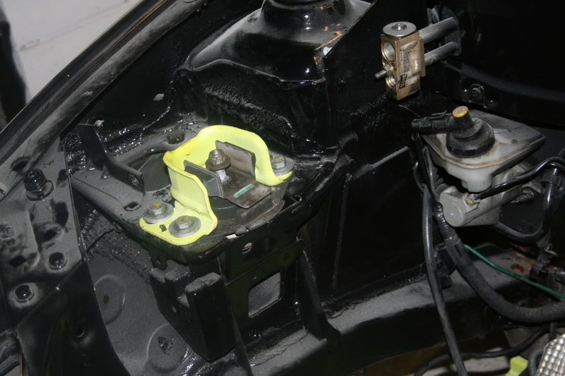

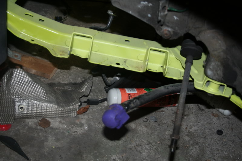

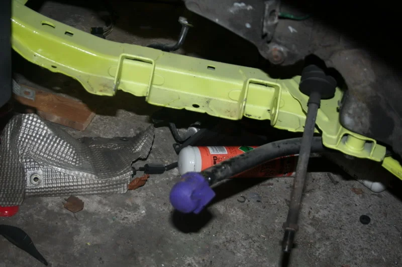

next up i torqued up the front and rear bolts for the subframe! 105 rear 67 front!
and then the subframe support brackets to 60
one of the f*****s snapped in the chasis! so had to drill it out and re-tap ! nightmare!

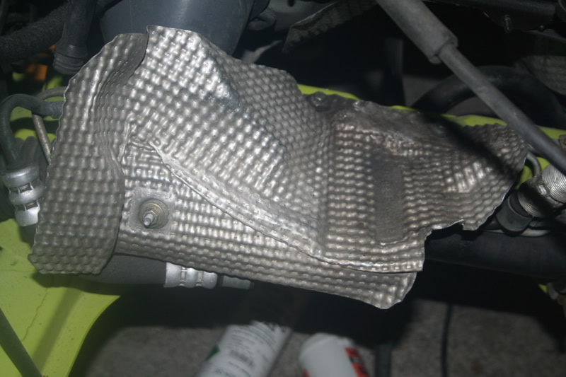

removed the carbon canister on the otherside today to fit the oil cooler for the supercharger
the engine oil cooler needs to be in the fog light on this side! more space = more air

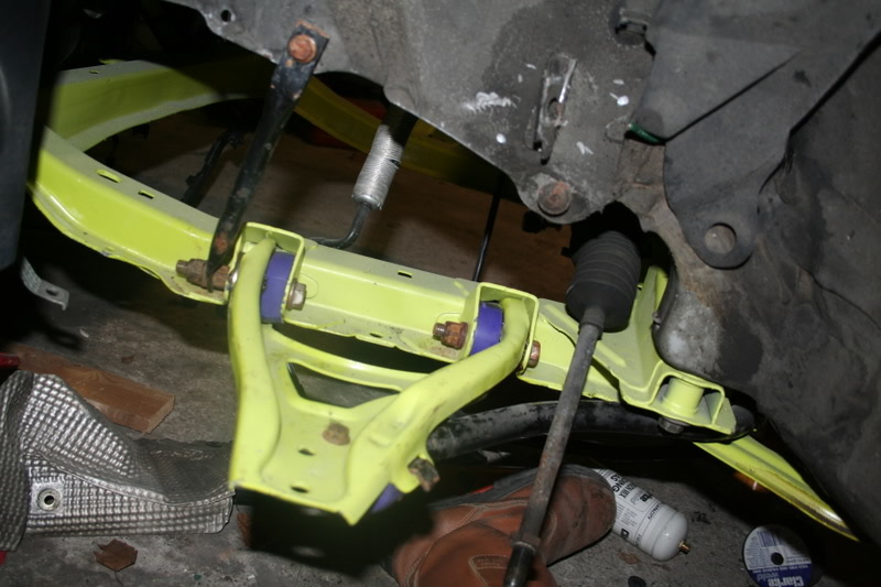

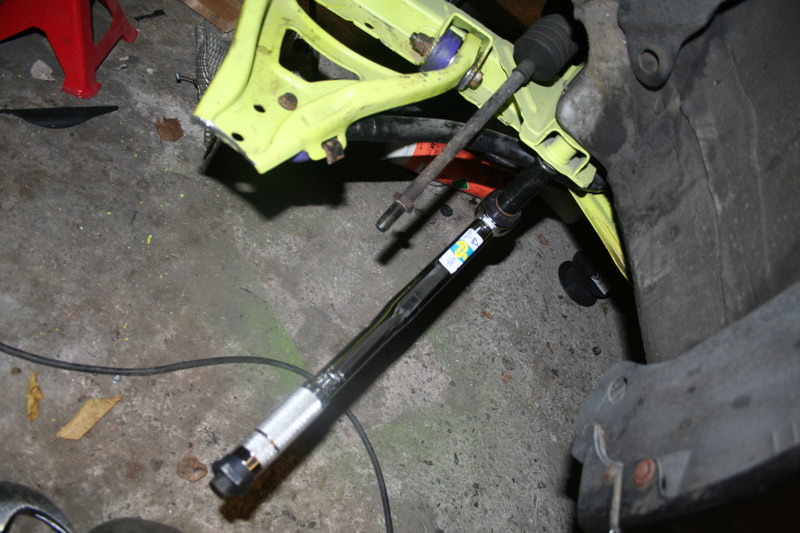

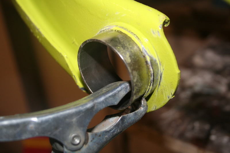

after reading a few posts and speaking to powerflex myself i have decided that i need to weld the metal shrouds on the wishbone bushes!
which ment taking part the ARB mounts, drop bar, bush bolts etc... t**t LOL
so did that...

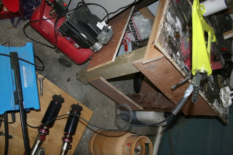

then popped them on the bench in the vice
filed the green paint back for the weld!
welded them, re greased the bushes (plenty) and re assembled the wishbones (bolts to 90NM) ARB bolt to 20 NM
then did the same on the otherside!

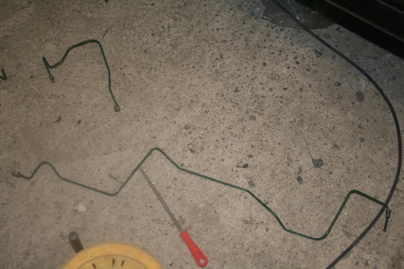

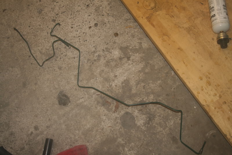

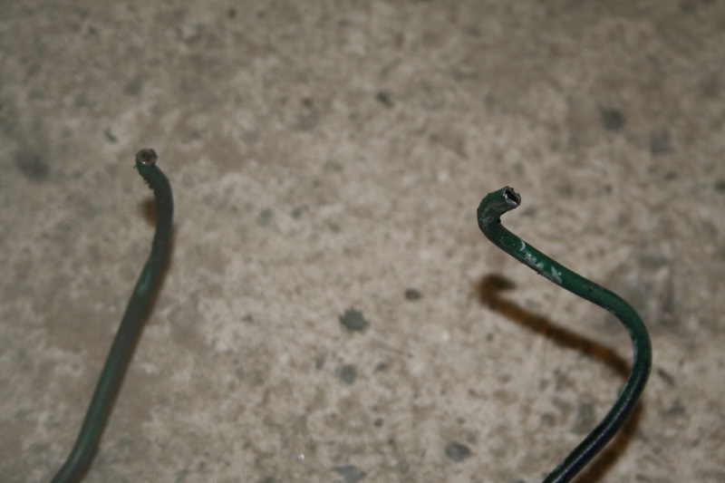

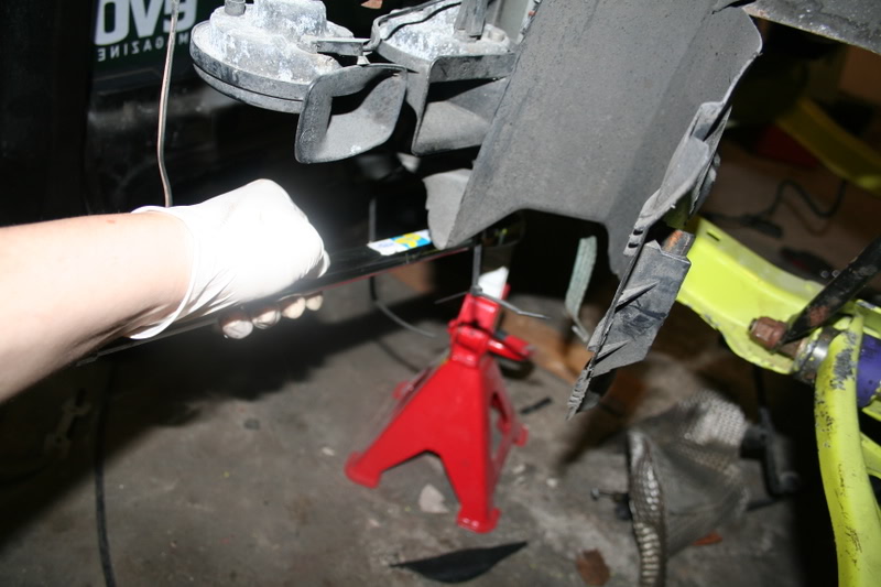

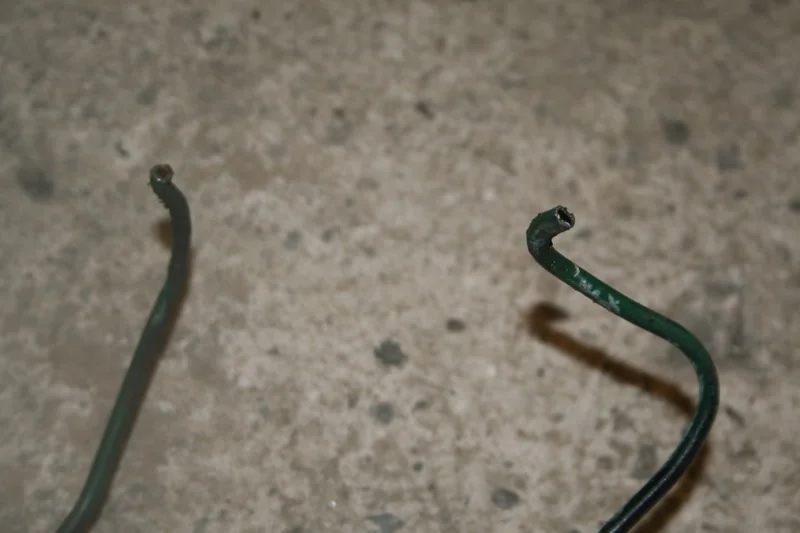

next i had to change the battered brake lines on the front!
was a easy job with all the space.. key to brake unions is a good quality 11mm spanner LOL
before

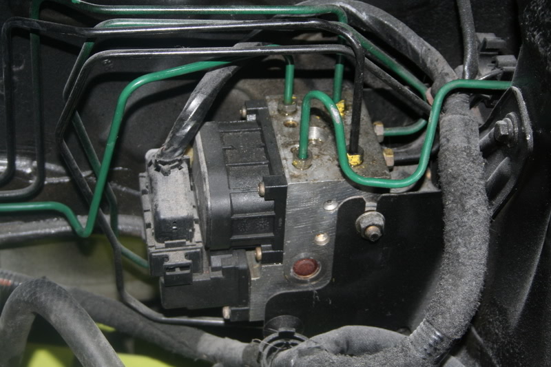

new lines made up
and fitted into the ABS block

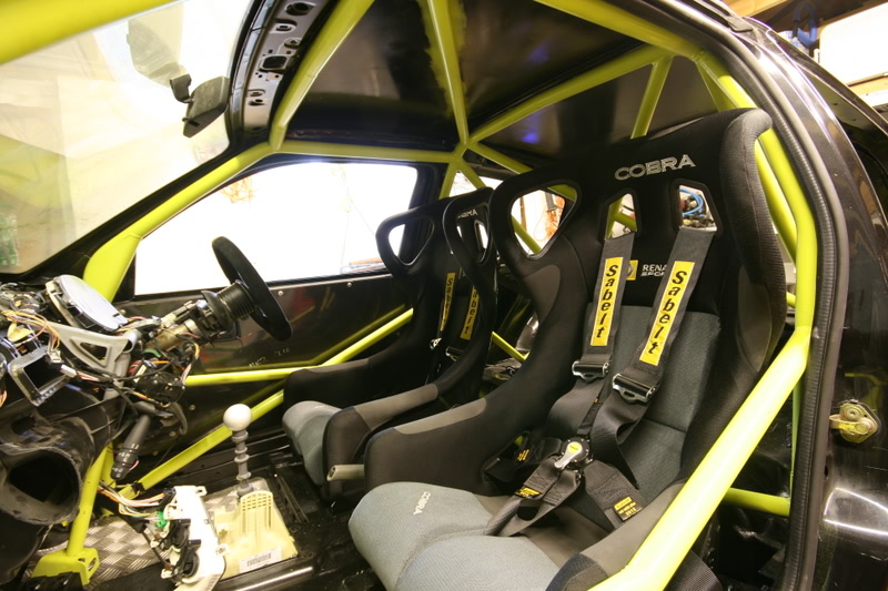

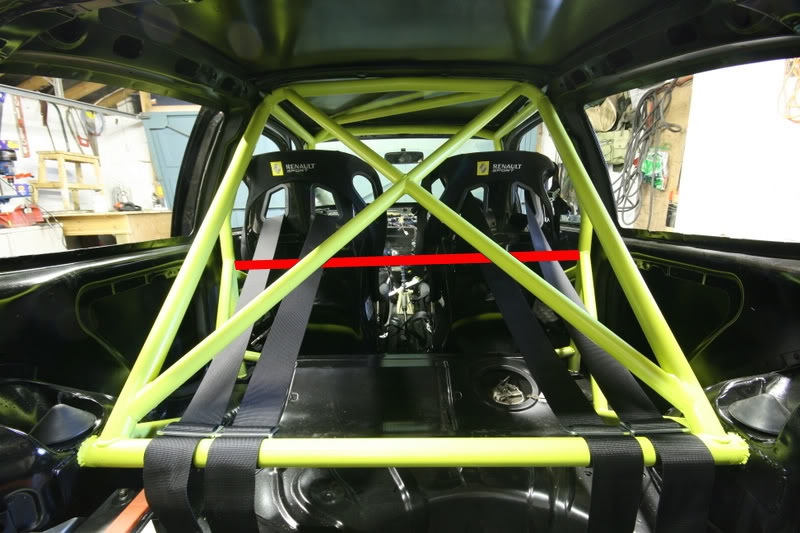

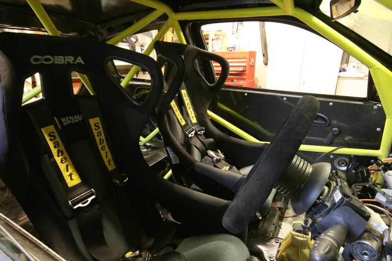

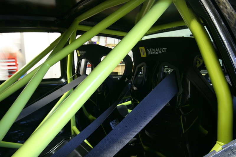

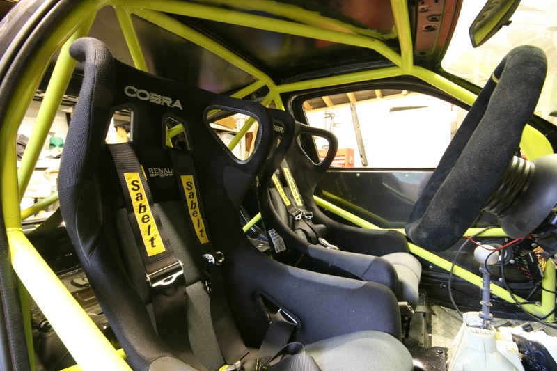

heres a few pics of seats, cage etc using the 400D with the signa lense
(cheers sambo)
That lot MADE MY DAY!! :D
as you know ben i got the same cage and seats going in mine, and yours looks badass! cant wait to get mine back!
  172, Tiguan

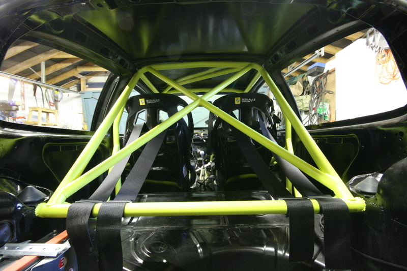

Ben coming along nicely!
You should have a bar here (mentioned before). Quite critical as obviously provides B Pillar side impact protection.
  clio 200 F4Rt
surely if a bar was needed there designers would of added one?
dont ever see bars there on any cages.
i am guess the strength of the main hoop, coupled with being welded in palce etc provides enough.
unless you put a 'X' section in like WRC cars etc run.
Tom
  i3
No, jon's right.
A bar is needed there.
Ad
  MK2 FRS
FIA testing must of missed it then!
Ive just been looking on the manufacturer pics and there aint one there...
however, the new OMP design is quite different but does have strengthing in that area.
