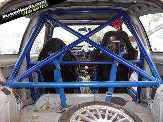

i have the same cage. it doesnt require one.
and racking my memeory, i cant remember the last cage that i saw with a bar there.
but i am guessing these guys know something the rest of us dont?
  C63 AMG, F430 & 172
hmmm i didnt get a bar for there. there is a lower one and the main hoop.
too late now anyway lol
unless i buy a some cage bar... cut it to shape, weld some door bar brackets, paint it green and bolt it round the hoop?

^ no your not doing that... lol
cba taking all the seats out etc... maybe a future mod! Might not live to regret the decision if you stack it passenger side on the 'ring! haha

You can see the cage in the pic below and that bar mentioned on the previous page. Just because its not there doesn't mean anything FIA wise, the basic sparco cages are much most minimal that what you or I have and they are FIA approved.
If the worst should happen you are well protected.

surely if a bar was needed there designers would of added one?
dont ever see bars there on any cages.
i am guess the strength of the main hoop, coupled with being welded in palce etc provides enough.
unless you put a 'X' section in like WRC cars etc run.
No, jon's right.
A bar is needed there.
As said your right it does need a high up bar one thing to remember is there a certain seat type which are approved for the lower design mount but I don't think anyone on here has one.
FIA testing must of missed it then!
Just becuase its approved doens't mean its perfect.

In an ideal world thats fine, but if your cage doesnt have harness bars at the correct level you have to make do with what you have available
I agree but if I by a car where the seat belt mounts are all completly rusted I don't drive the car round unil I get caught.
Whole point of a cage is for safety.
edde, rusted seatbelt mounts is a very different proposition and you know that...

I have my harnesses attached to the rear seat belt fixing point. This is WRONG. Someone said there previously they are supposed to be mounted more horizontal back, that is right, the idea is that if in an accident the belt holds you, but when its low the belt will pull down on you and compress your spine.

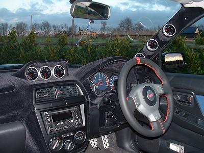

What does having the dash flocked mean?
One thing I was think was get rid of everything and just have something like these
http://www.p1instruments.com/
its a coloured firbe thats applied to the dash with an electrostatic charge, the reason for it is to remove glare/light bounce off the dash ... in reality it just looks good
