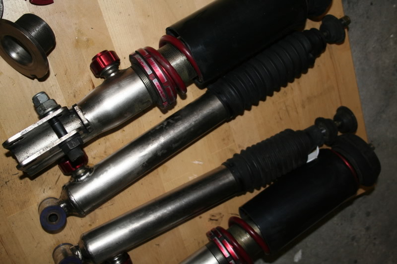

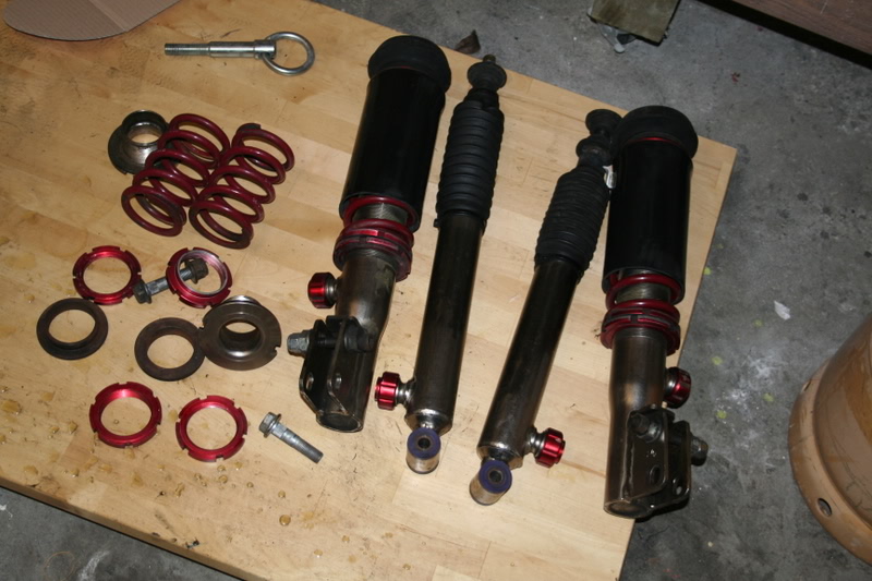

so the H&R's went.........
i needed something a bit more track focused! i have somthing else up my sleve which ben is sorting.. but thats a while off!

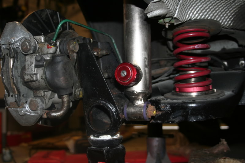

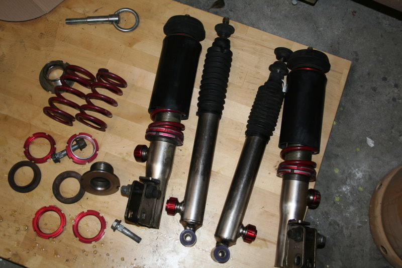

so for now i guess i will have to "make do" with LEDA's and eibach (sp) springs, camber bolts and shims :D :D

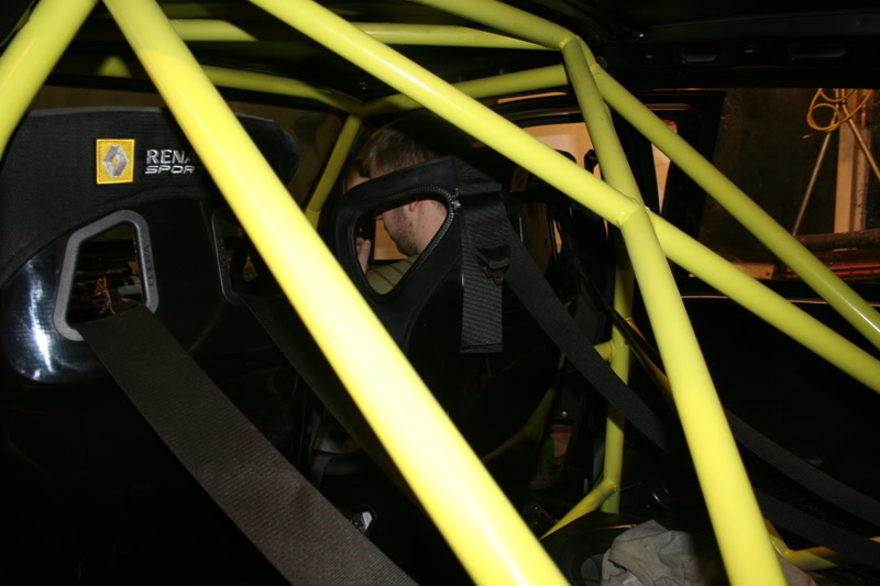

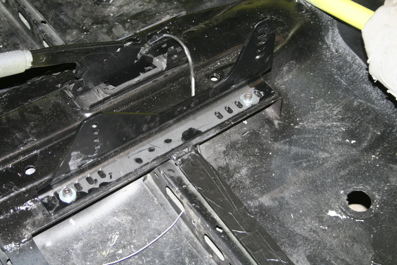

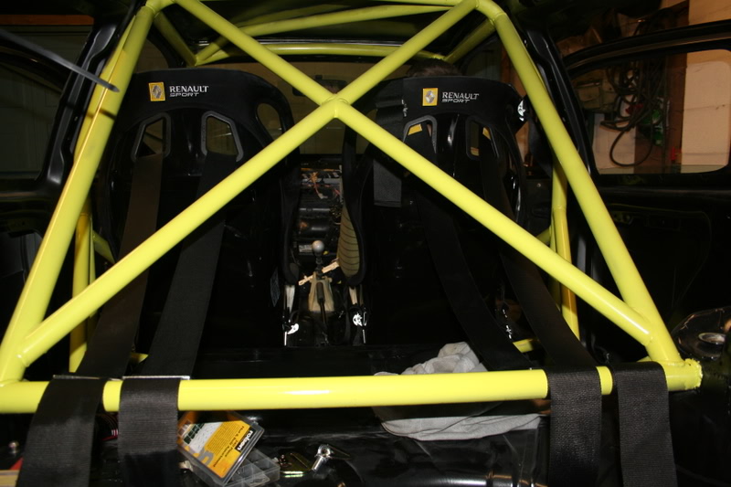

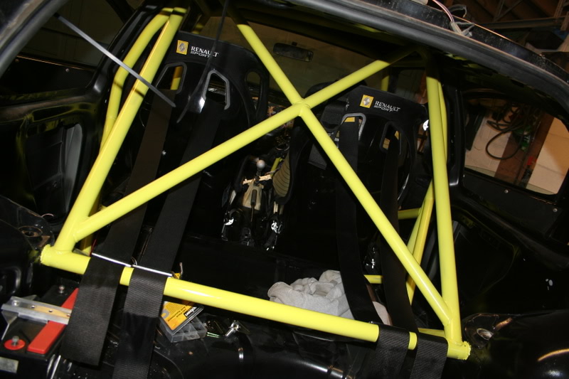

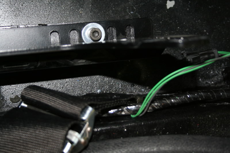

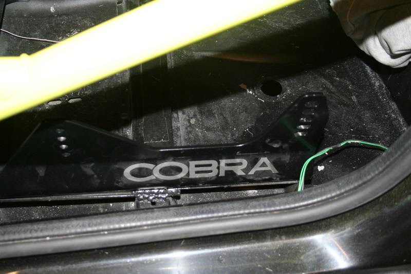

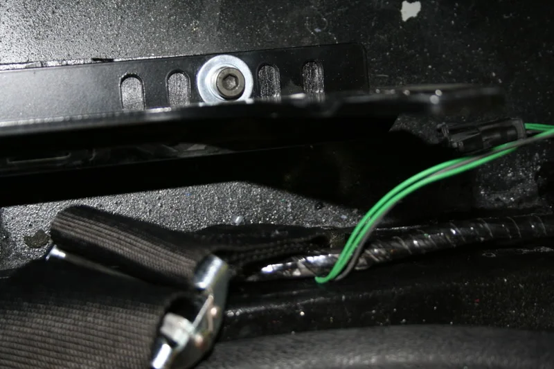

as the dash is on hold untill i can think of some way of sorting it out..i have decided to get the seat and harnesses fitted. afer much '*****ing' about, wev finally decided on the seating positions and height for both, we marked all 8 holes for the side mounts+after attempting to drill two of the holes using tintop HSS drillbits, each time the drill bit would melt as the steel is so thick so back to machine mart! Bought some stupidly expensive metal cutting bits, we then piloted each hole with a 6mm,and followed through with the 8.
We then replaced the side mounts onto the frames +secured with 12.9 m8 cap bolts, 8.8 m8 nyloc nuts,2x 12mm m8 spacers+then 2x 20mm m8 spacers per fixing.

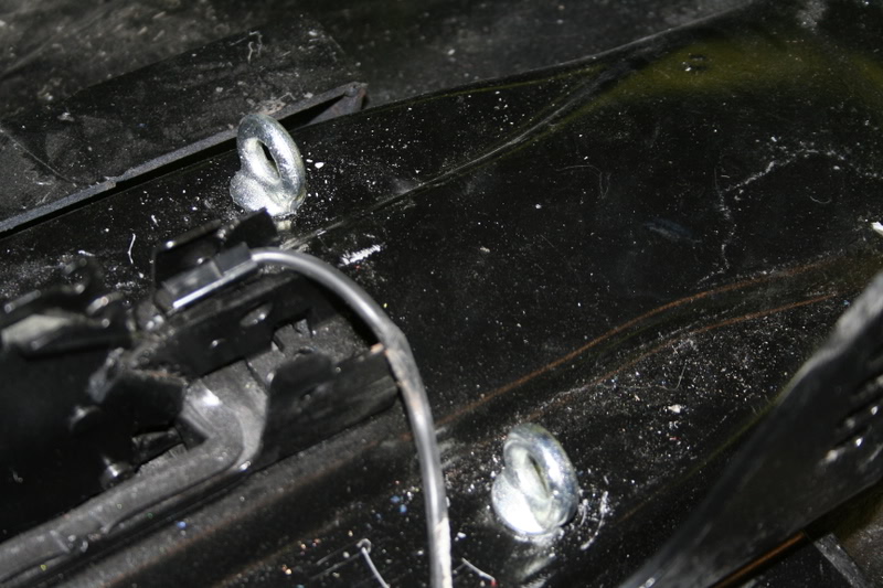

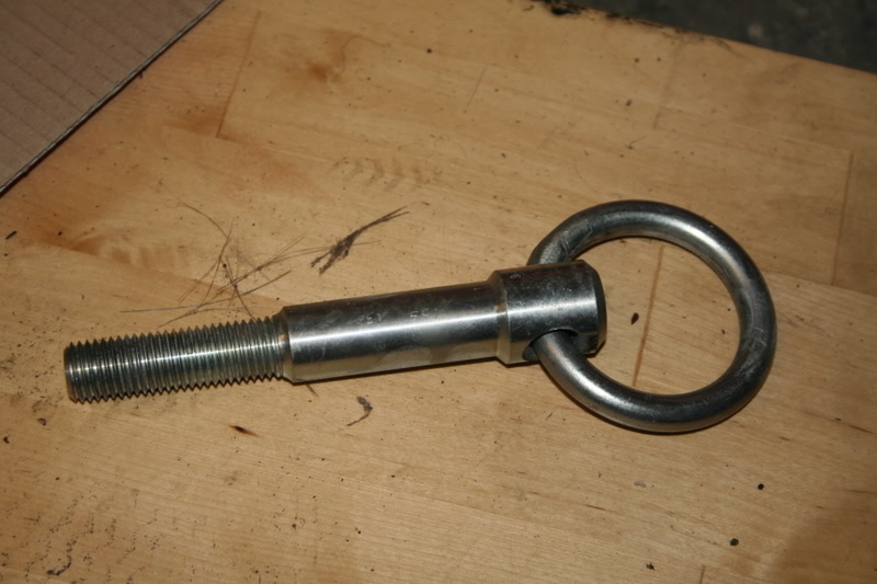

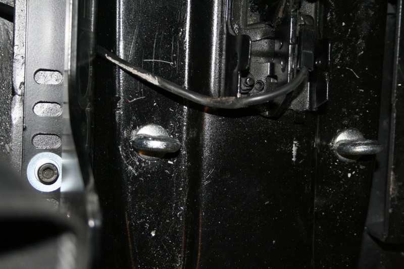

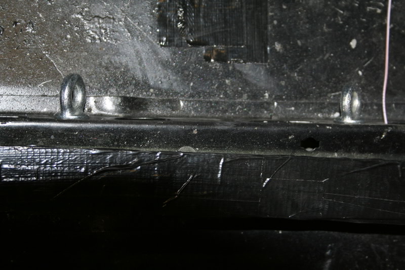

Next up was to fit 2 lower eyelets on the under side of the lower sub frame, to do this we spaced two 10mm holes on the front lip, trimmed down the eyelet backing plates to fit in the frame, put the eyelet through the hole then secured to the backing plate, nipped them up nice+tight facing the right way.
We then fitted the 2 rear central eyelets from under the exhaust tunnel in the original seat frame mounting points.
We then secured the outer harness to the shell on the original seatbelt mounting using the original 10.9 cap bolt.

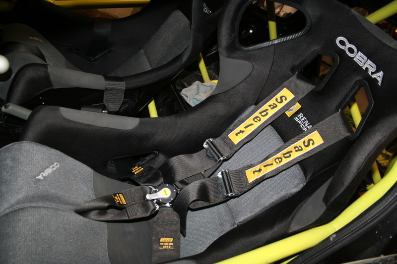

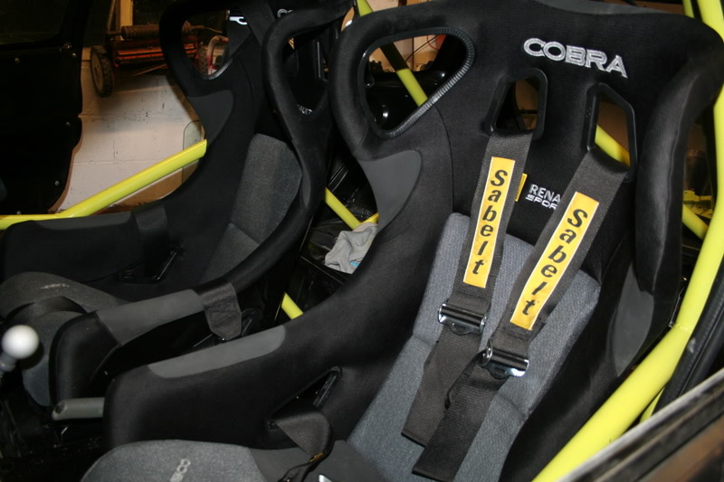

With all these in place, we placed each seat in its respective side mount +secured the seat with a 12.9 cap bolts and 20mm m8 spacers. All torqued up to 45nm ;)

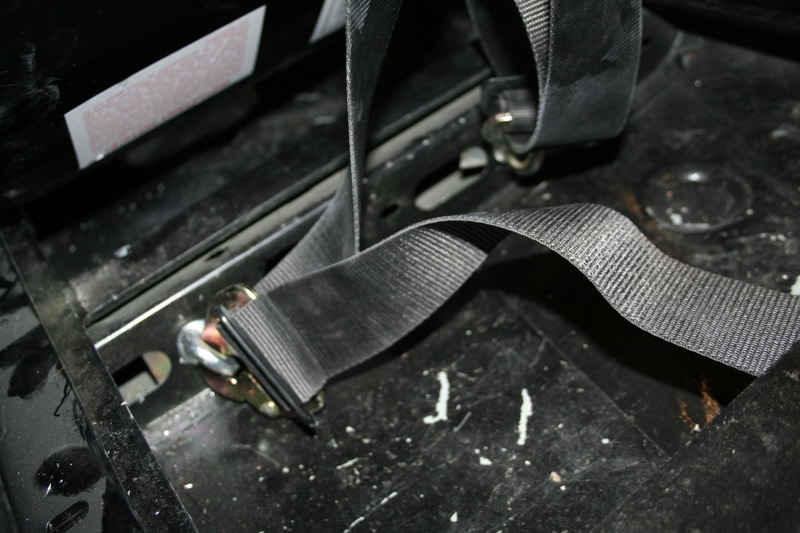

We then removed the rear harness mounting buckle from the strap, wrapped the strap around the rear of the role cage harness bar and relooped into the original buckle.
We then adjusted all the harnesses, ensuring that they were all equal+double checked all the torque settings.
Seating position which we have chosen is perfect imo, cant wait to get on the open road!

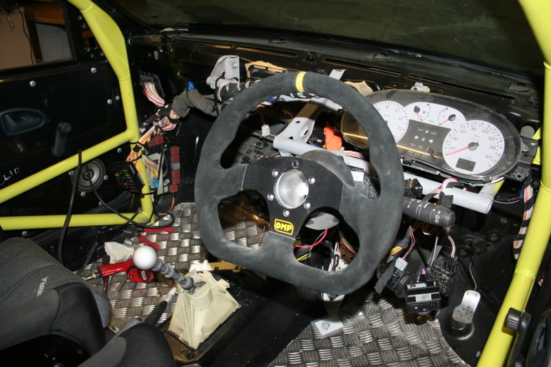

Also trial fitted the new omp wheel and boss.
:D :D :D

aren't the harnesses mounted a little low down? I thought that Race cars had to have the harnesses mounted at shoulder height?
I'm probably completely wrong....
  C63 AMG, F430 & 172
proberly. but omp state that to be the harness bar.
gotta be better than bolting them to the floor

whilst there was loads of messing around with the seat positioning, it was definitely worth getting right.
The feeling of sitting there in the evoultions with the 6points in was a good feeling...

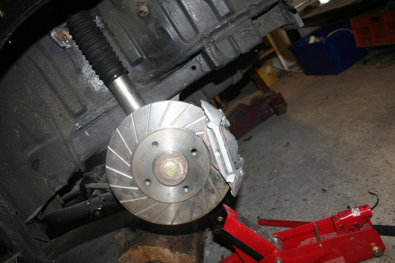

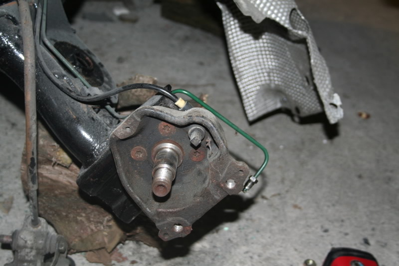

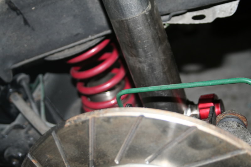

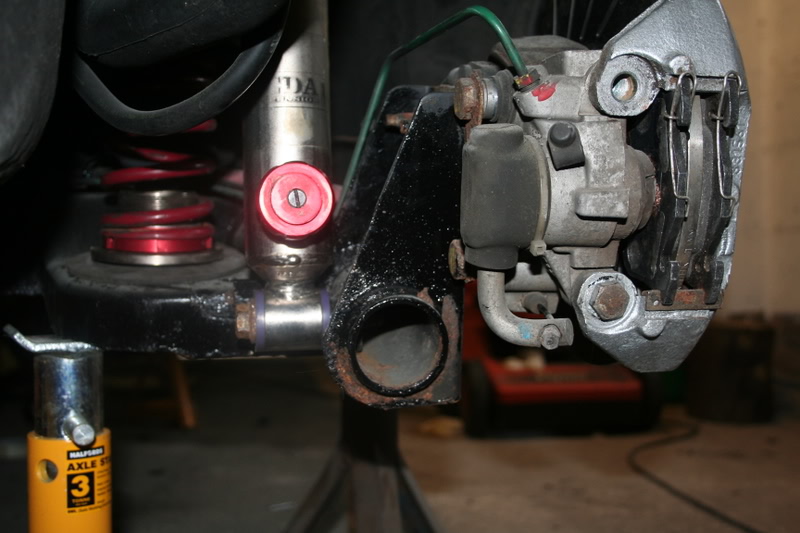

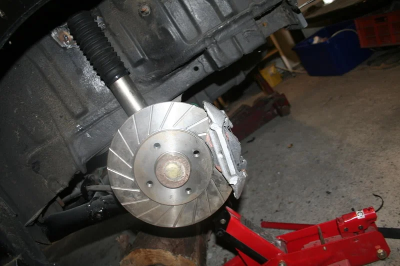

started with fitting the whiteline 1.2 neg camber shims.
I had alredy removed one brake assembly and stub axel off when i was looking to have custom shims made,
after removing the otherside i fitted both shims to the axel and bolted both stub axels back on.... then torqued the 4 nuts to the correct NM.
at the start of the thred it was pointed out that the rear disks were the wrong way round (direction of the grooves) so whilst both brake assembly's were off i swaped the disks round!
i then re-bolted the rest of the calliper, brake line union and re-fitting the mintex pads with good helping of copper grease!
with the rear brakes assembled and whilst working on this part of the car i decided to fit the rear LEDA's
the quality is second to none! 20 mins later the rears were fitted! :D

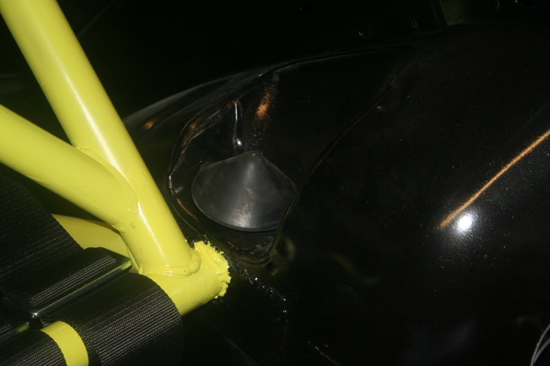

i fitted the cover cones inside the car to keep it looking tidy
