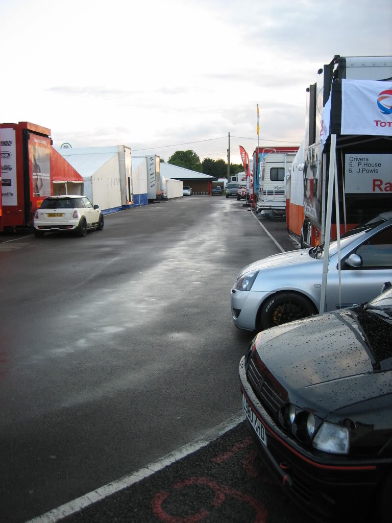

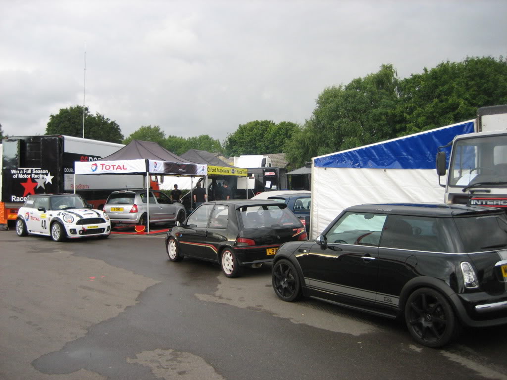

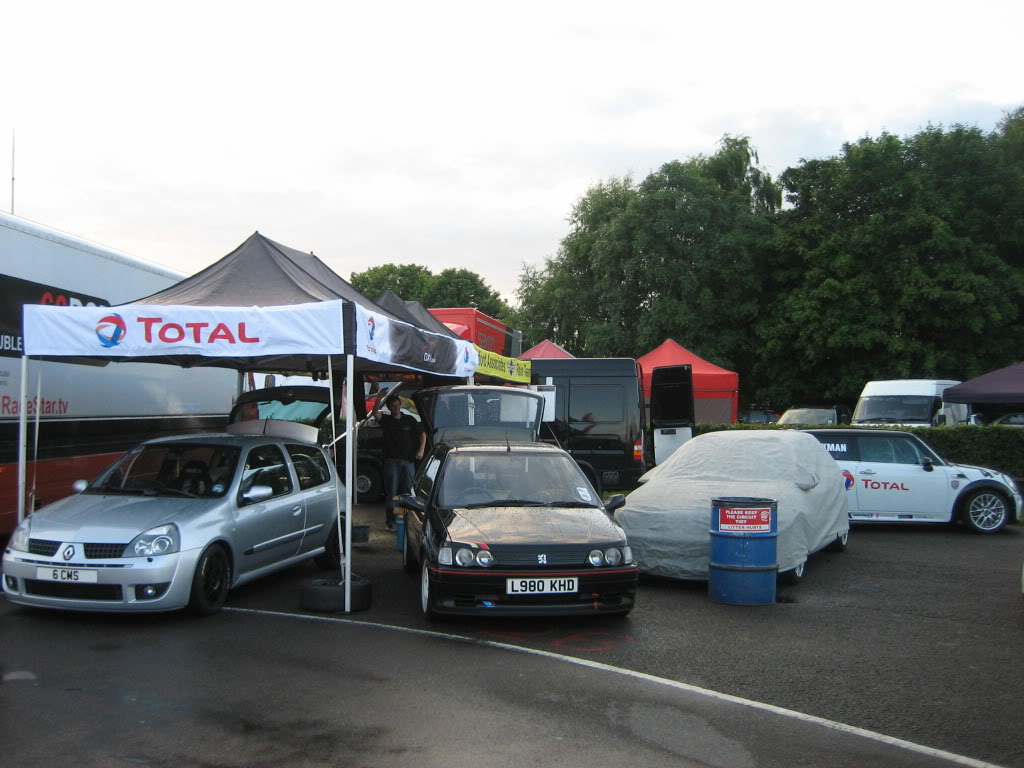

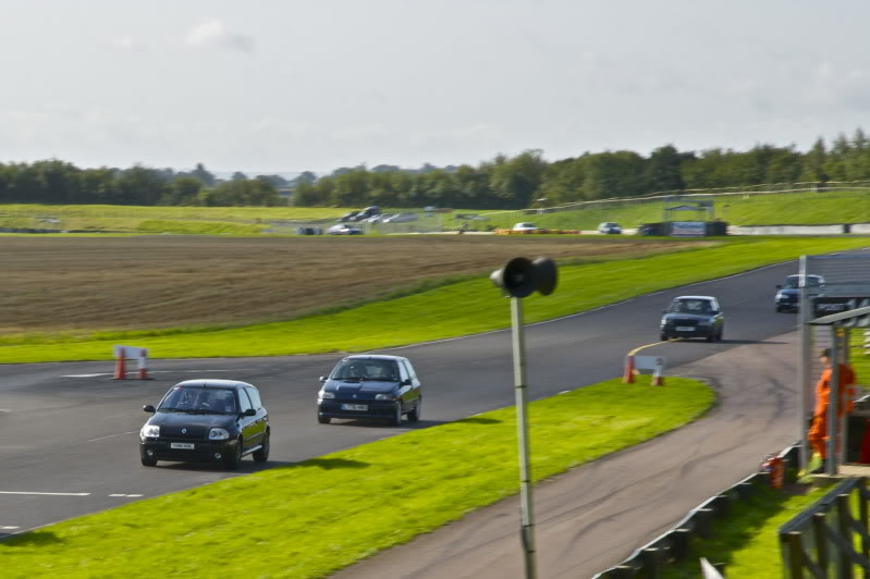

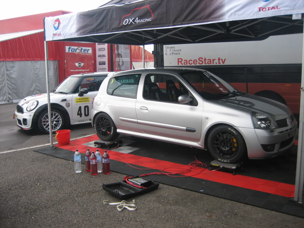

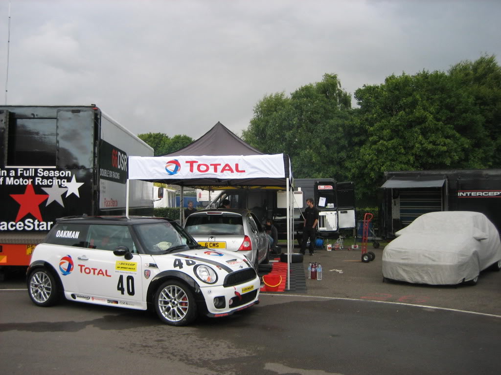

Went to Castle Combe this weekend with my race team OX4 Racing. The weather was, how should i put it...wet! Very wet.
The reason for me driving 100miles in the poring rain on my R888s was so i could use our flat floor and see how much my little S**G weighed at each corner and what sort of camber i was running.

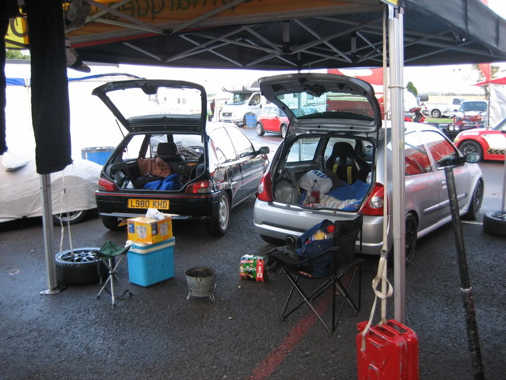

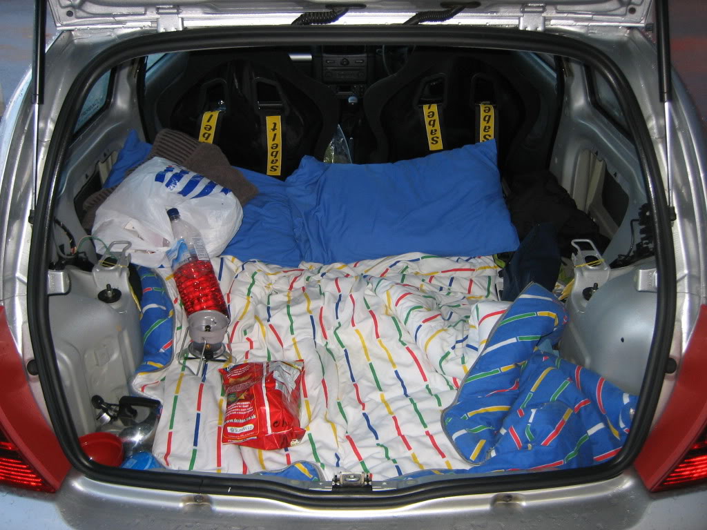

Clio-a-la-bed :)
Ended up turning the bed around and had my legs go inbetween the buckets lol, Slept like a baby :)

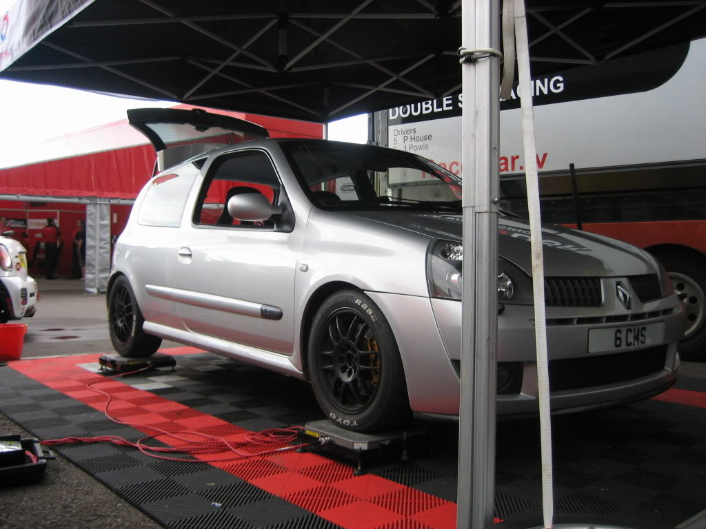

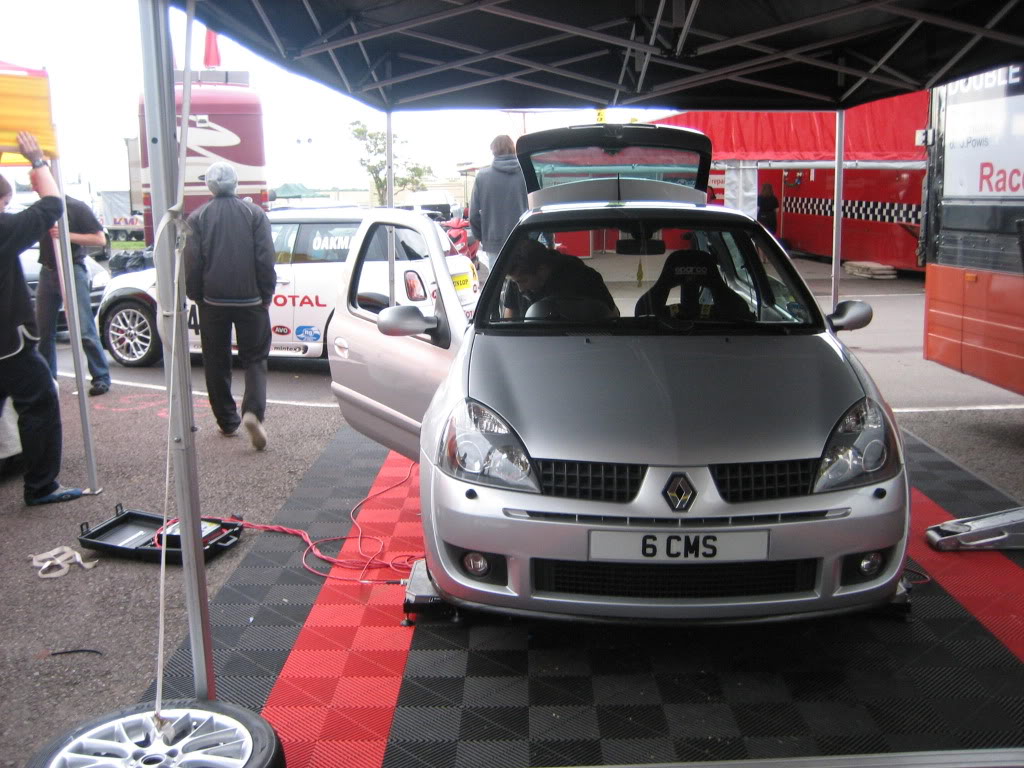

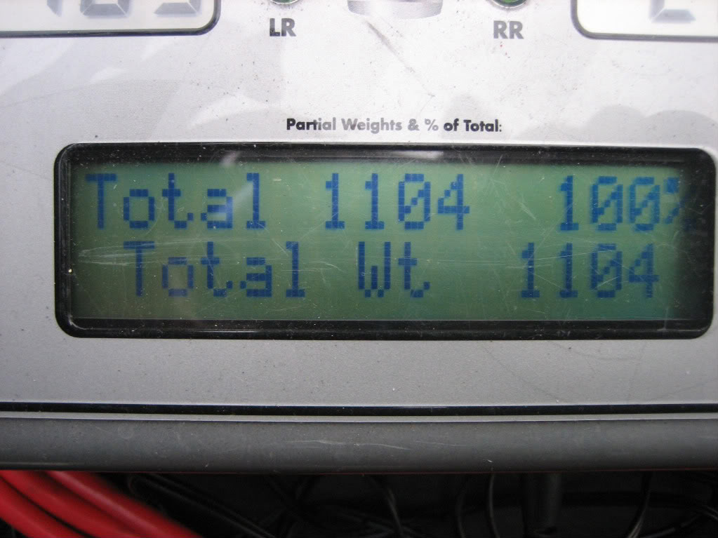

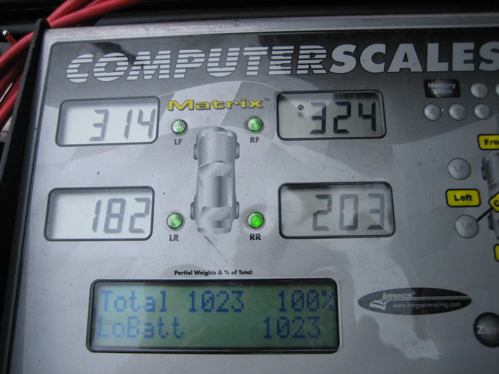

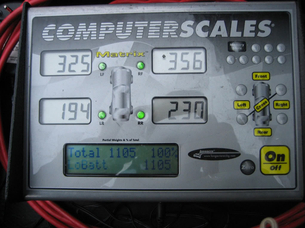

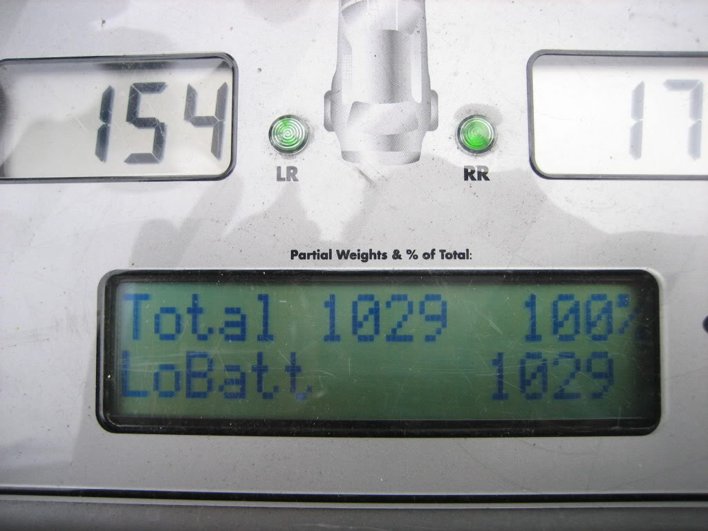

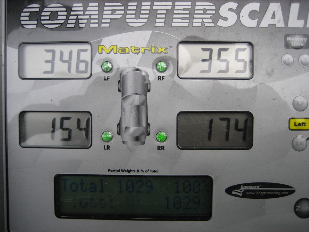

Now we set up the flat floor zeroed the computer thingy and bashed the clio on top.
The car was full of my bed and food so i pulled it all out.
I'm sure there is lighter stuff out there but i was quite pleased as she still had just under 3/4 of a tank of fuel.
Now with me in the car. Fatty fatty!

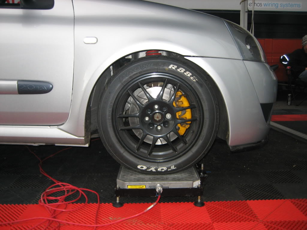

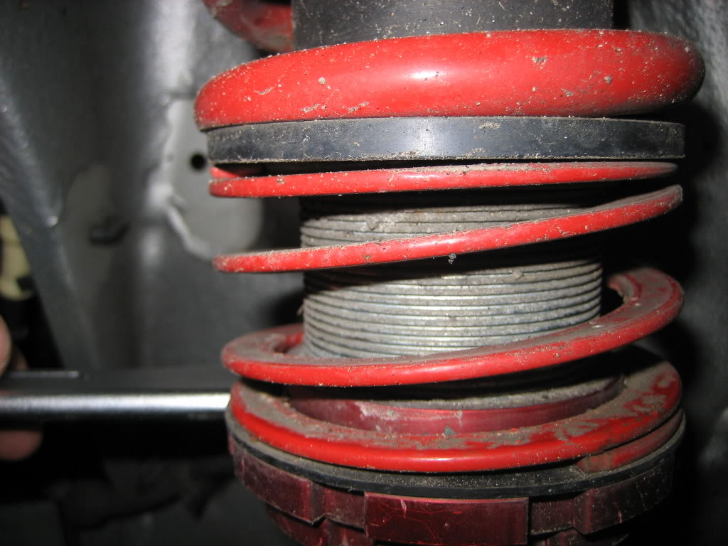

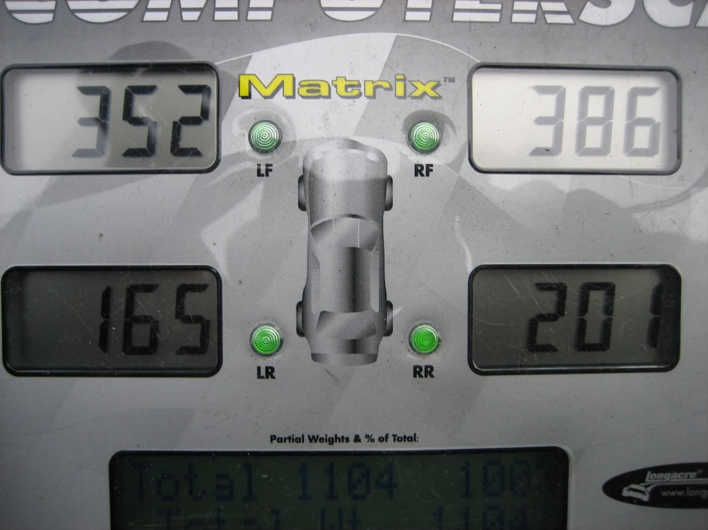

It's a bit too heavy front right so i gave the coilover on the right a few turnes up.

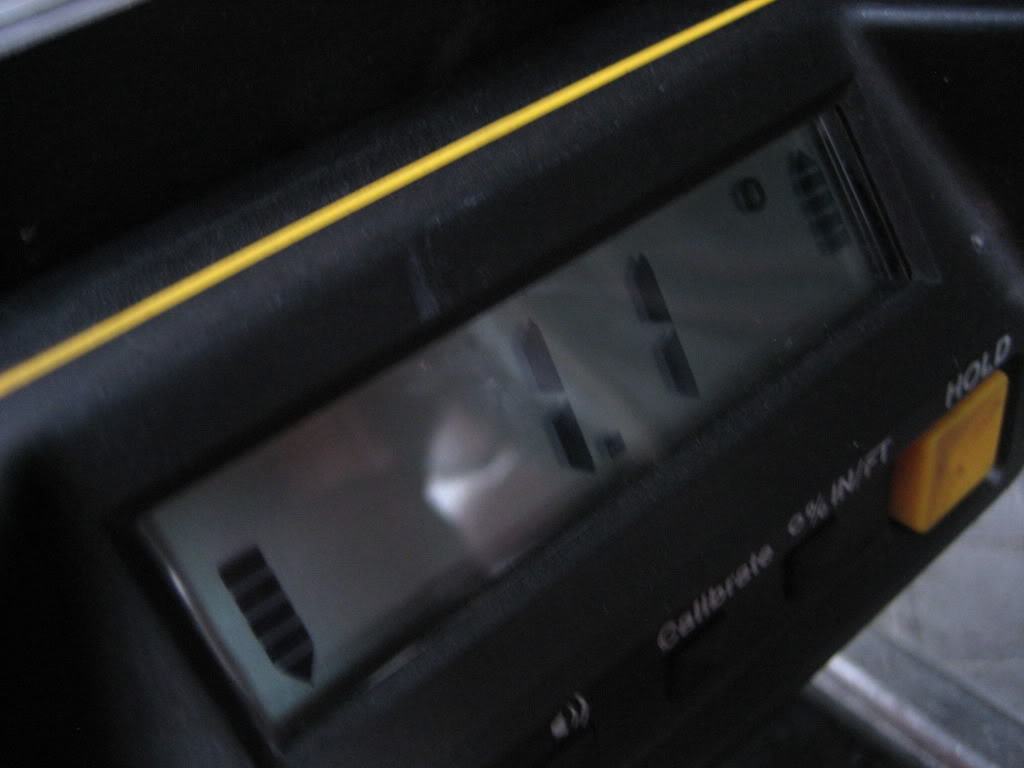

One little annoying thing. The computer was running out of battery so i turned it off forgetting to reset it when putting the car back down so the readings were a tiny bit out.
Anyway car was back down and the numbers looked much better.
Now with me back in there less weight on the front right.

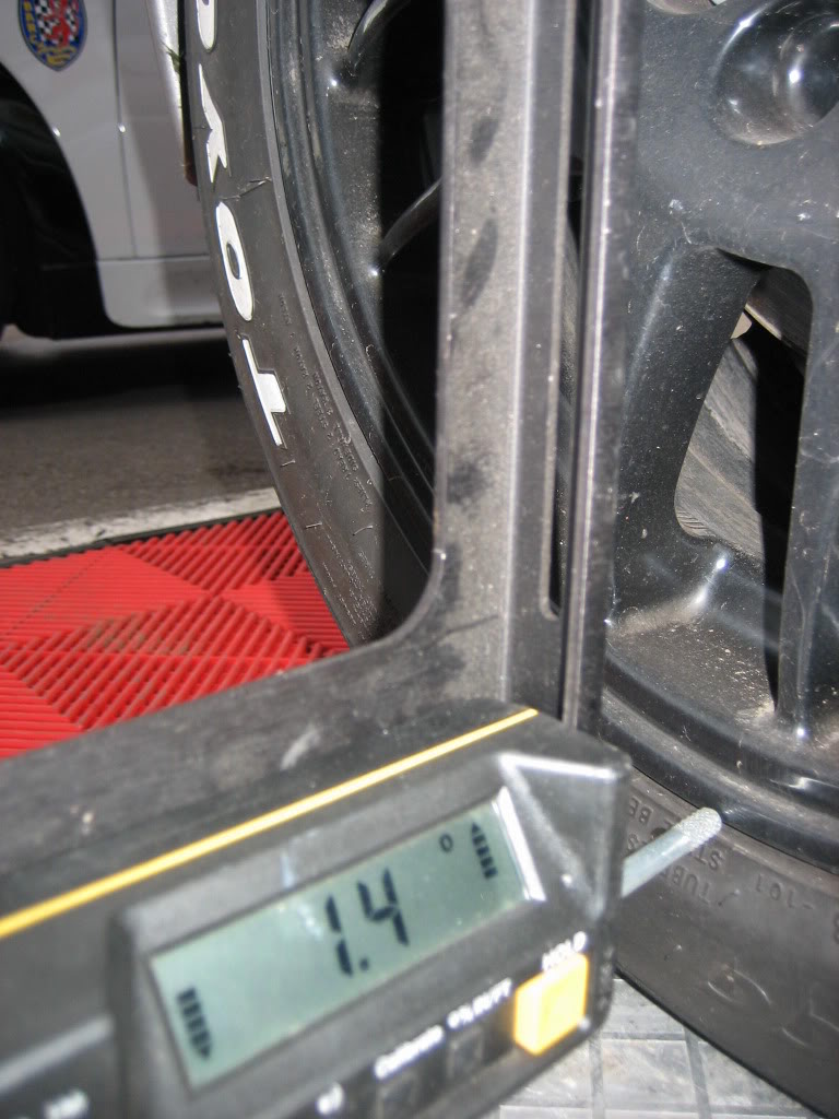

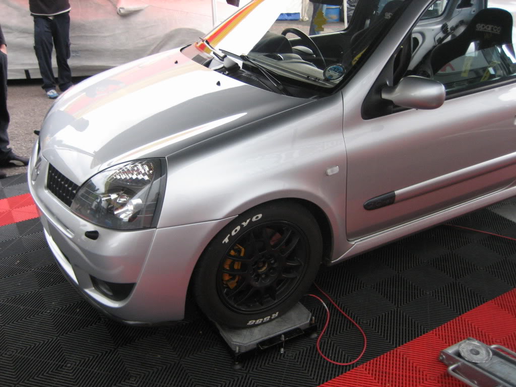

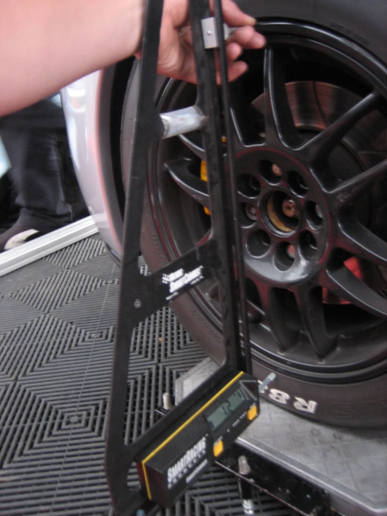

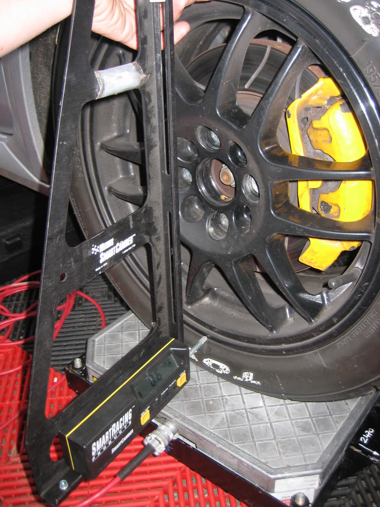

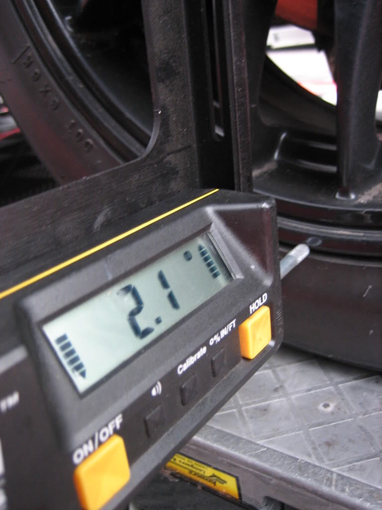

Camber Time:
Front Left
Front Right
Rear Left
Rear Right
So the Camber is kinda all over the place so when i use the flat floor at Croft i will sort that out then. (we ran out of time)

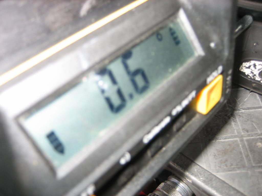

Toe:
I was running 0 minutes toe on the front :( but that is an easy fix when i sort out the camber
And i was running 15 minutes toe out at the back.

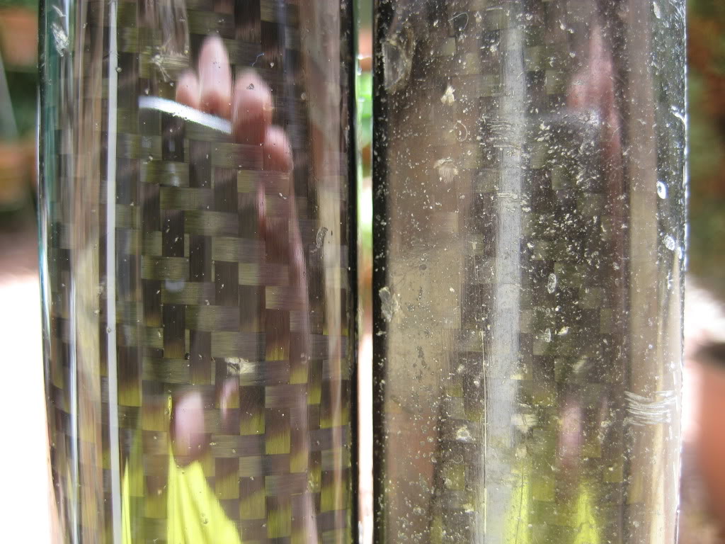

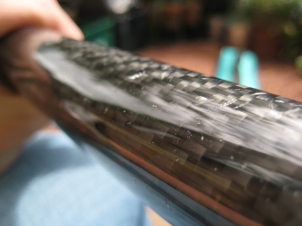

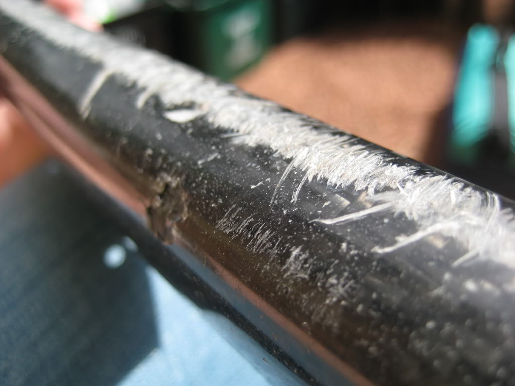

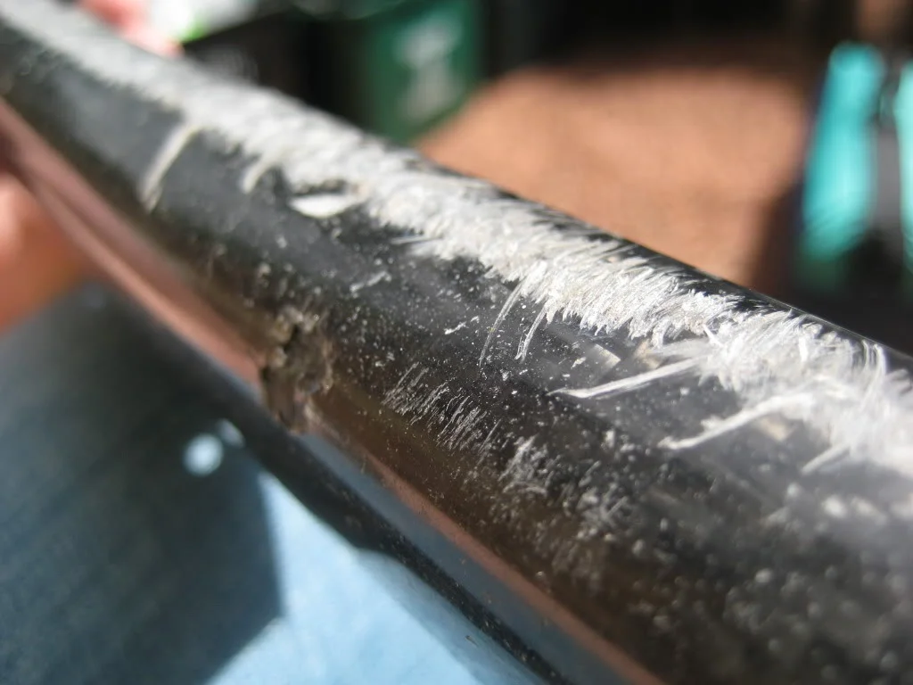

A very small update, wet sanded & polished my CF splitter yesterday.
Before
After
Looks much better.

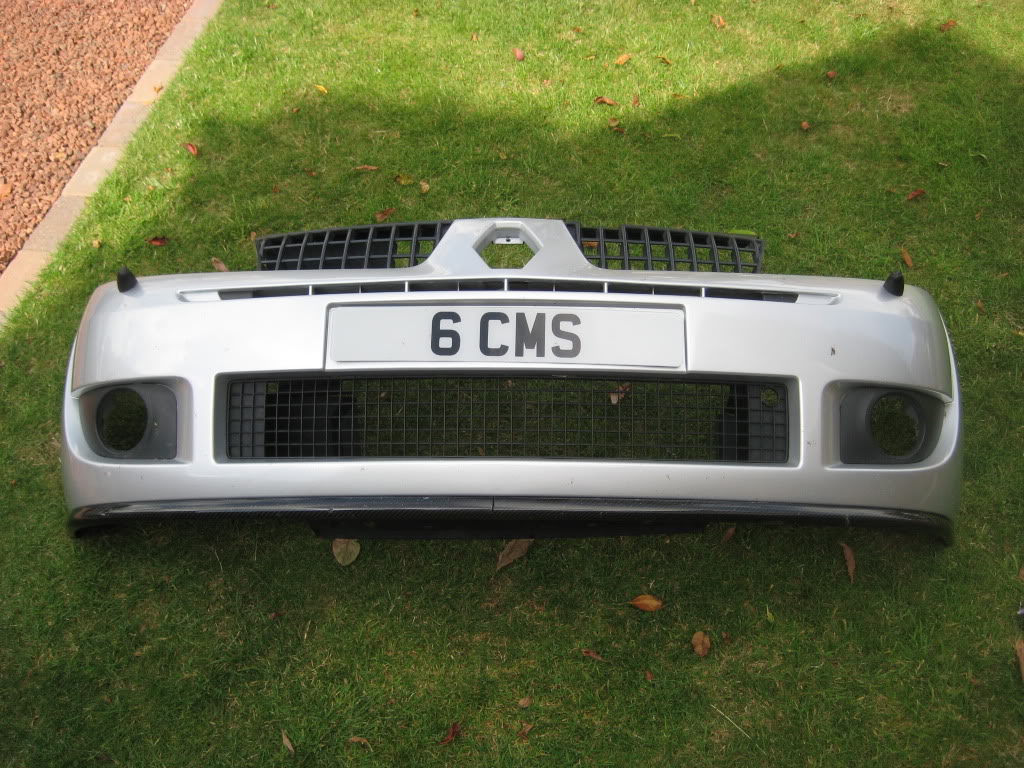

As the front bumper was off i decided to start making my CAF's for the brakes and take the lights out and wet sand them to get rid of all the stone chip marks.
I'm going to be buying some tubing for the brakes asap, fog light removal is the first thing.

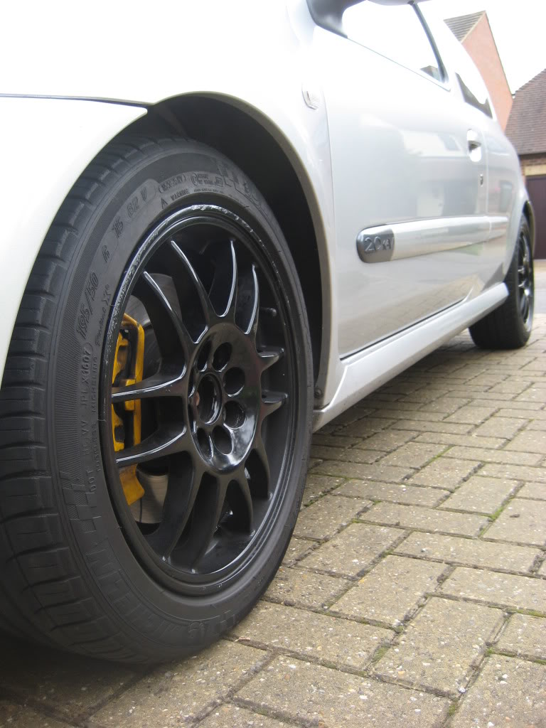

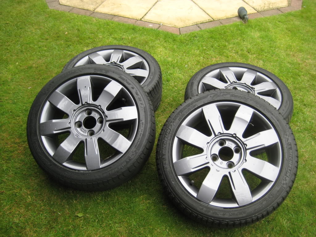

I now have my 3r set of wheels.
My standard 182 wheels
My OZ F1's with R888's
And now another set of OZ F1's with PE2's

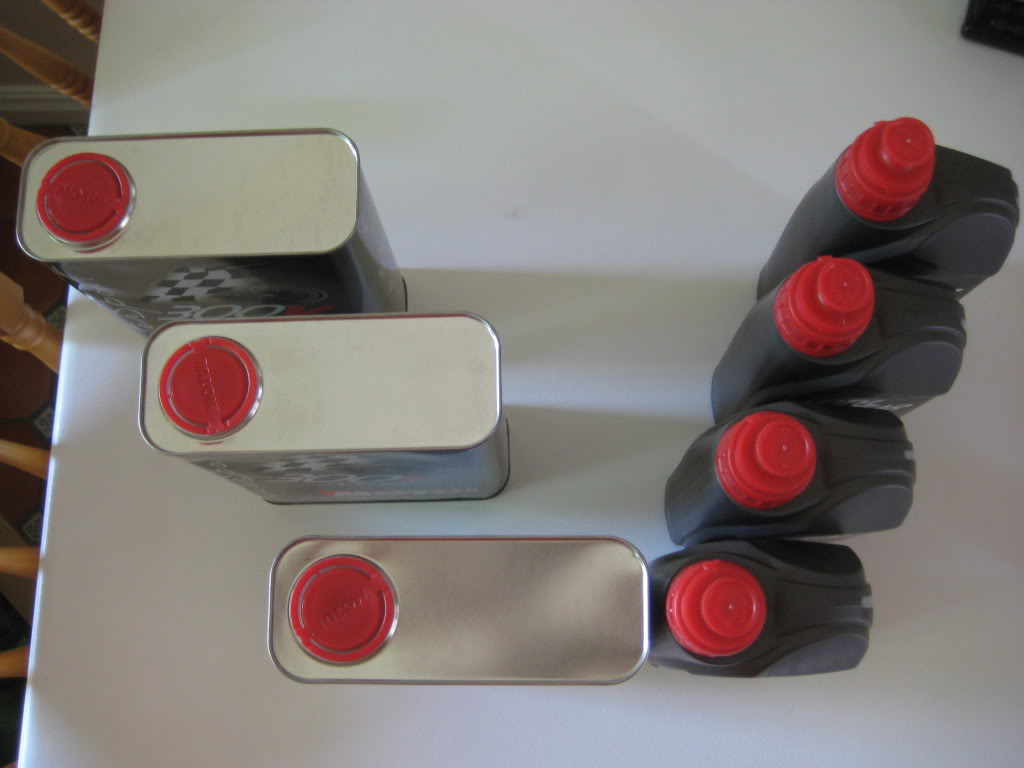

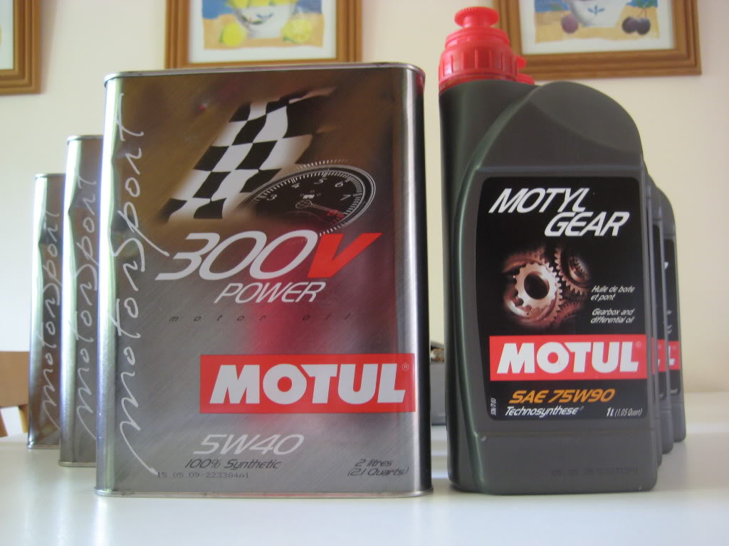

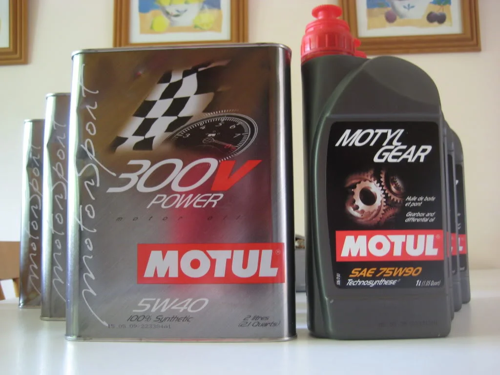

Just ordered some Motul 300v for the engine and some Motul for the Gear box. So tha will be the next thing added to the car :)

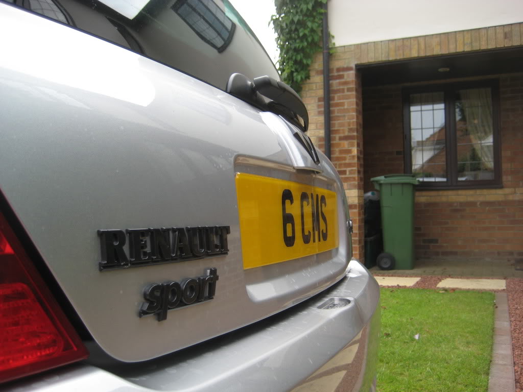

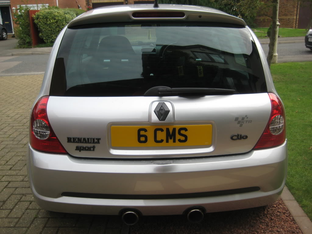

Tiny Update, Renault sport badge is now on
These arived today :)
So now i'm gona go outside and put the new oils in :)

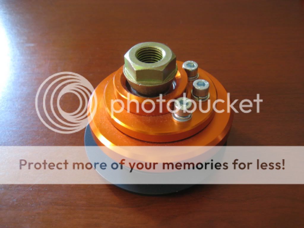

I bought AST solid top mounts, which are amazing. Made such a big difference to how sharp the steering is.
Before
After

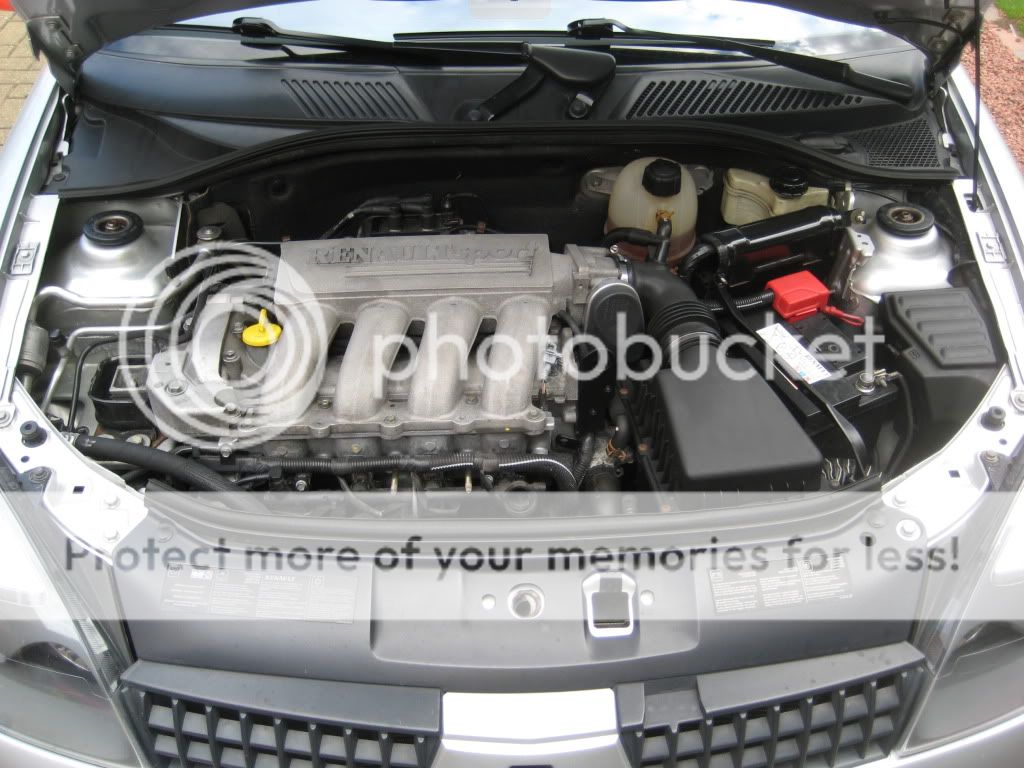

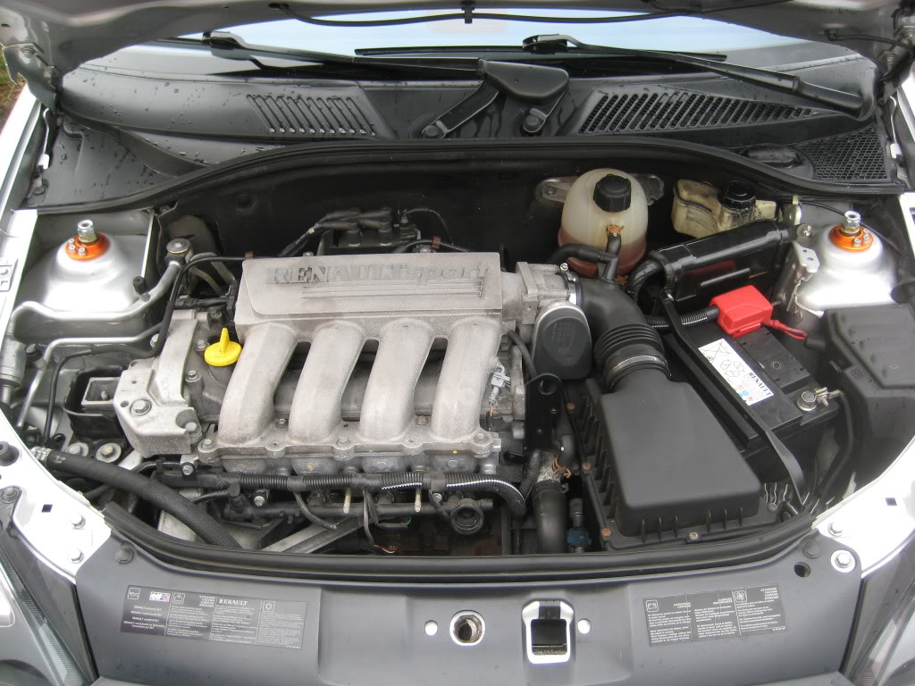

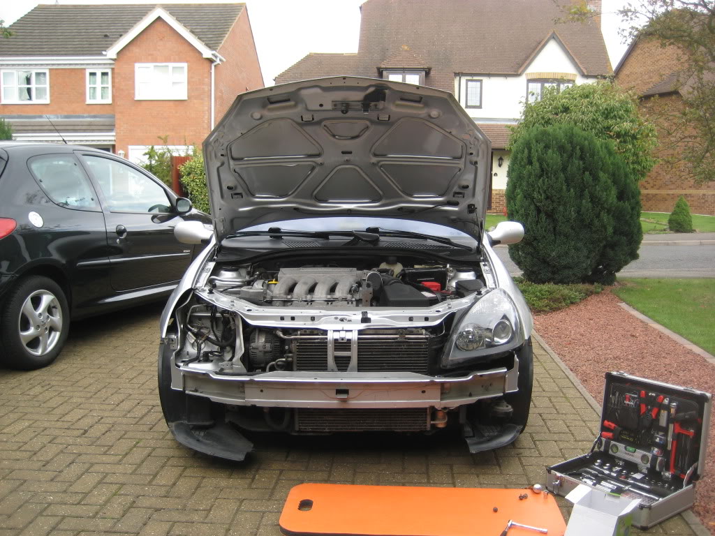

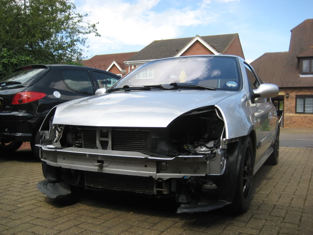

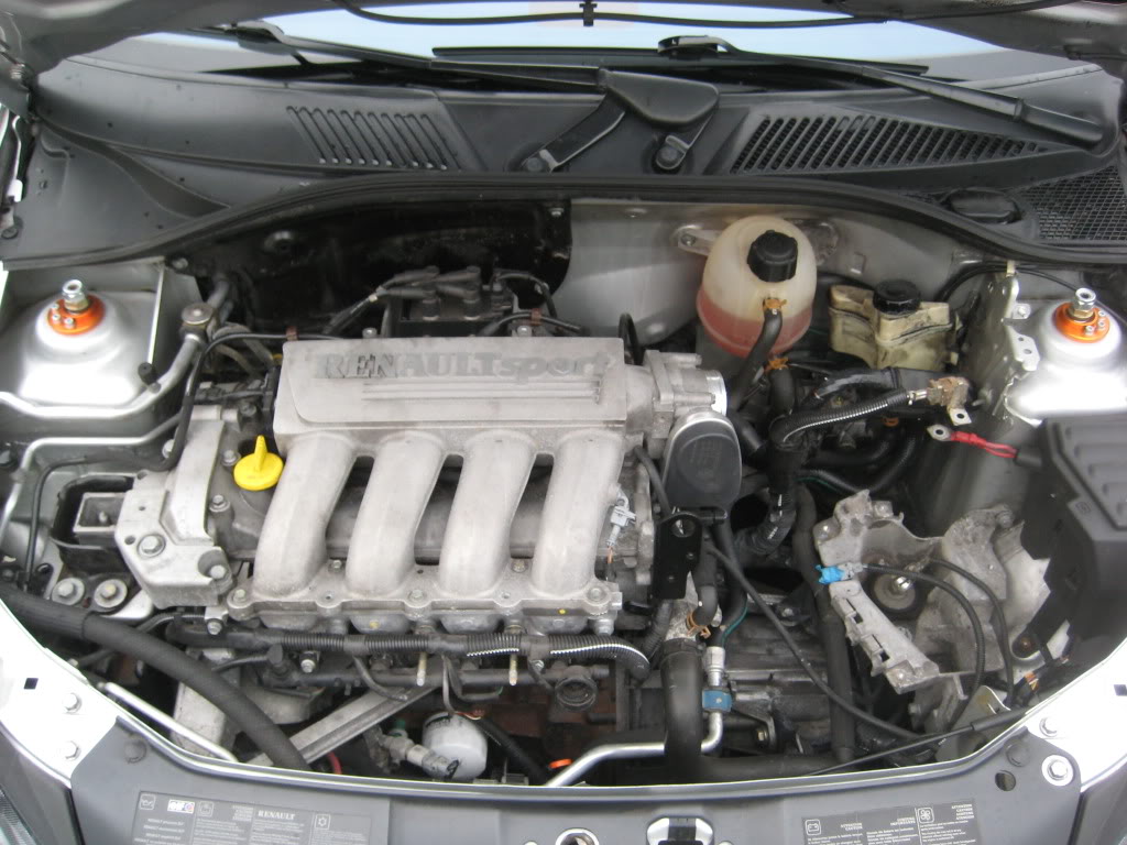

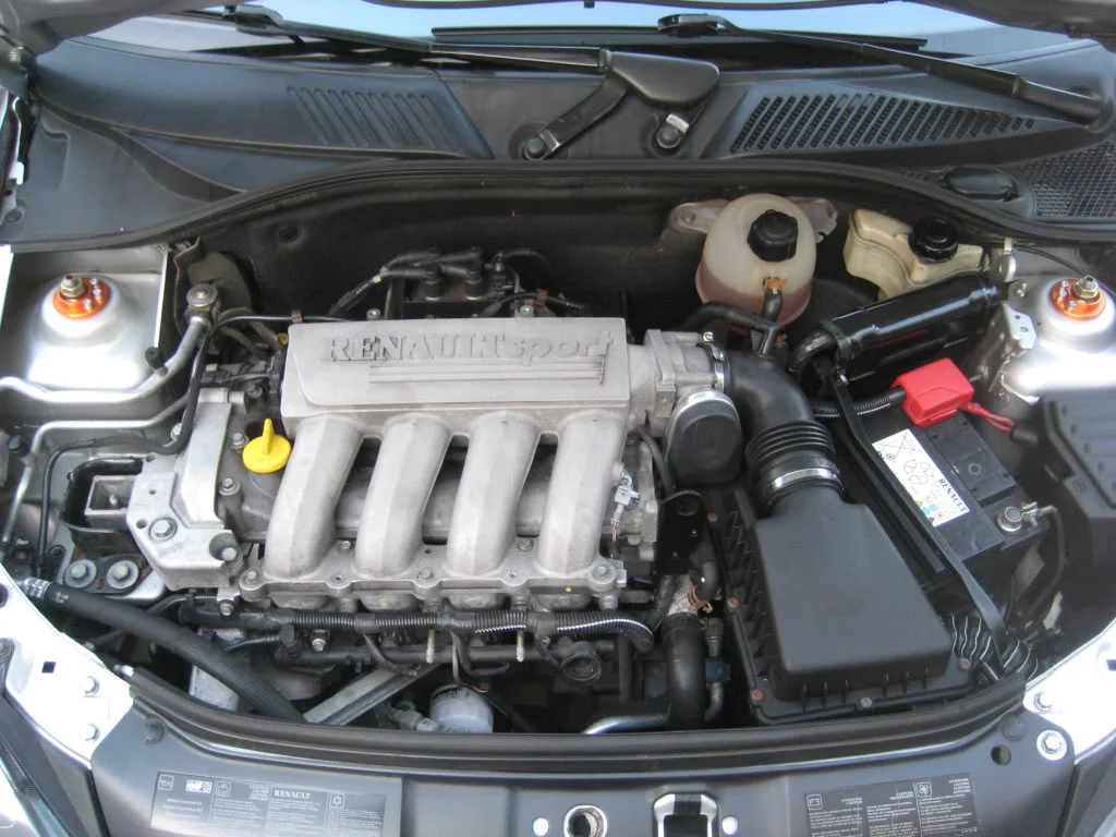

Also been doing quite a bit of stripping in my engine bay
Removed:-
ECU bracket
Old air box + Pipe
heat shild
Lots of metal brackets

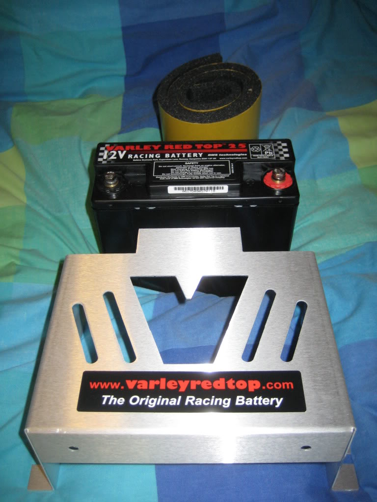

Battery
Bought a V6 airbox, ITG filter, small bit of hose so airbox is directly next to the TB. Redtop 25 to go under passenger seat. (Pics to come)
I've got the car down to 957kg and i need to weigh the Tar. I've got half the dash out atm and i'l be taking the other half out so i can take the brown sound proofing out from behind it. So i should get a little more weight out.
Not really the best update, The car will be going on the Dyno on the 7th of November so i'm hoping for some more ponies with the new air box set up. Also gona track get a cheeky cheep trackday in somewhere before the winter gets too harsh.

Looks awesome! Where did you relocate your ECU to? Ended up bolting mine on top of the gearbox mount, couldn't think of anywhere else to put it!
  TrackCar & F30 330d
Re: One Year on & £3000 spent
Looks awesome buddy! Everytime I hear a loud 'bwaaarp' past halls I can pretty much narrow it down to someone from your flat! lol
Bit random but do you still have your original numberplate? I want it! :)
Ha ha yeah my flat is right next to the road so we can tell who is coming home as all the exhausts sound different. Apart from the 2 106 rallye's
Photo shoot when i get my car working yeah! :)
Oh i just through the ECU away, i though i didnt need it :S.
Only joking, i have zippy tied it to the gearbox mount too. Just not in the picture. I have put it in a plactic bag so it doesnt get wet but it looks a bit poo. Might put it in a jonny instead lol, might look a little neater, Better to be safe ;)
