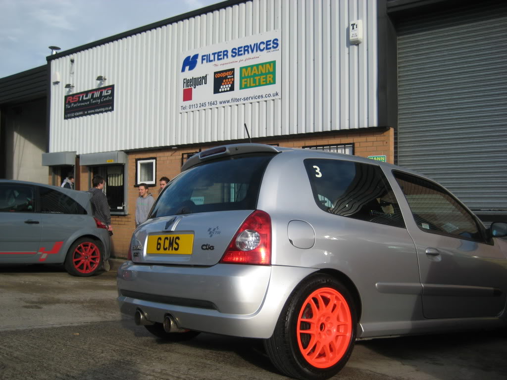

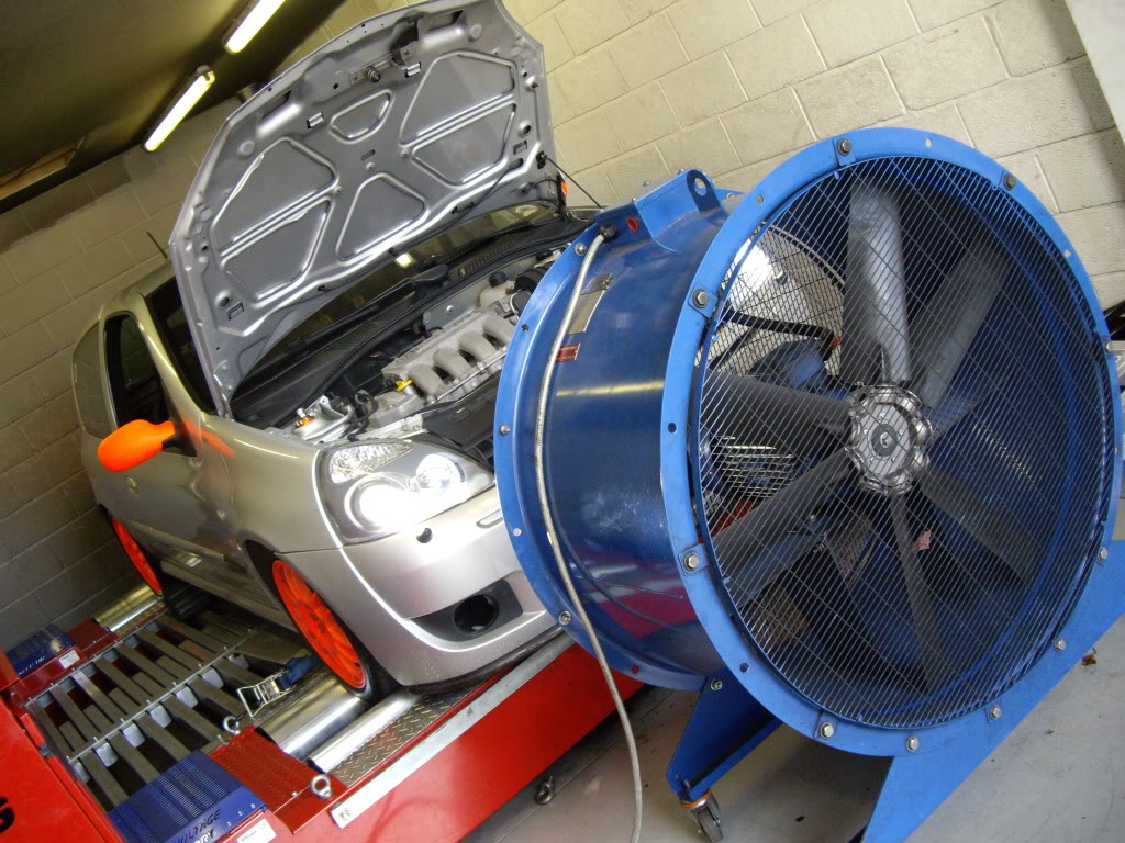

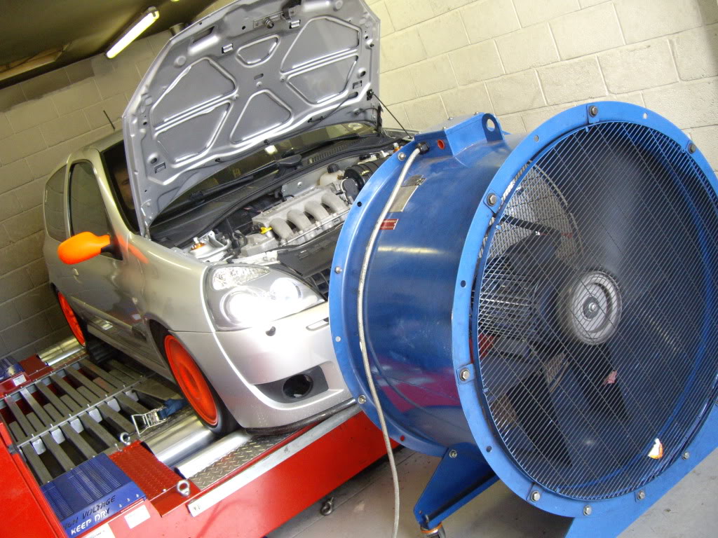

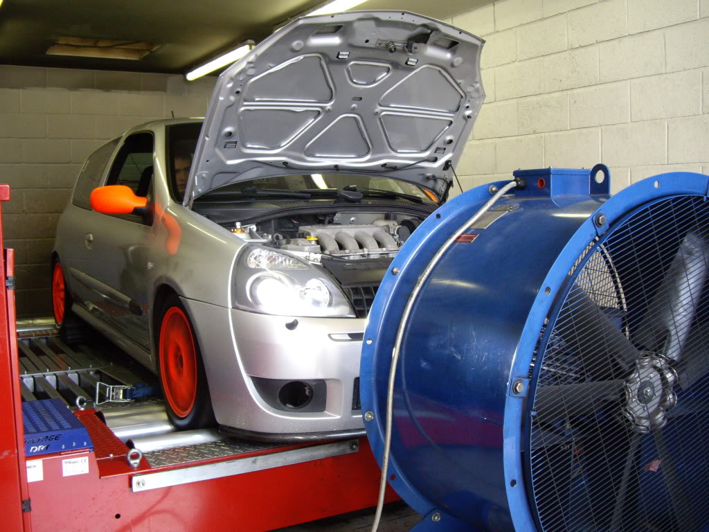

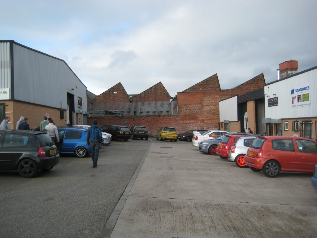

Went to the RS Tuning meet today, I have been thinking that my car wasnt quite pulling at well as it has in the past. Anyway it produced 176.4 bhp and 157 Ft/Lb which is down by 9 bhp from last time i had it on a set of rollers.
It turnes out i have a missfire :eek: which is more annoying than anything as it could be due to a varaity of things.
So i will have to look into coil pack, HT Leads, Sparkies ect.
I plugged my RS Tuner in and found a few faults which i have not had before
DF0236 - Ignition Constant Feed
DF0002 - TPS sensor
DF0189 - Flywheel tooth
DF0135 - Brake information fault
Could any of these be causing my missfire?

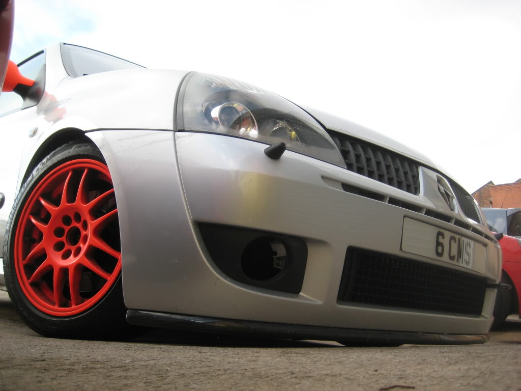

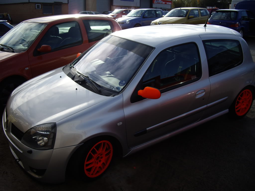

Here are a few pics of my car today :)
  Titanium 182

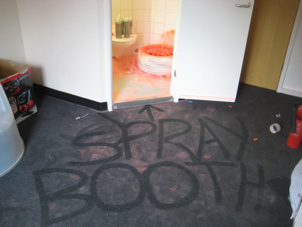

Finally finished my orange wheels, took me about 2 months to finish them because i got bored half way through and then decided just to stay on my track wheels.
Anyway, here's the spare toilet on our flat AKA the spray booth.
Henery the hoover made the sign on the floor so people didnt mistake it for a toilet lol

sweet pics on the rollers, unlucky on the misfire though :(

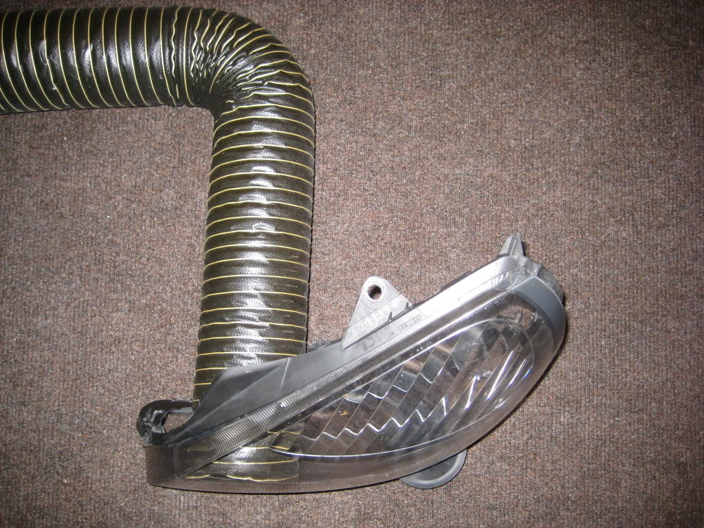

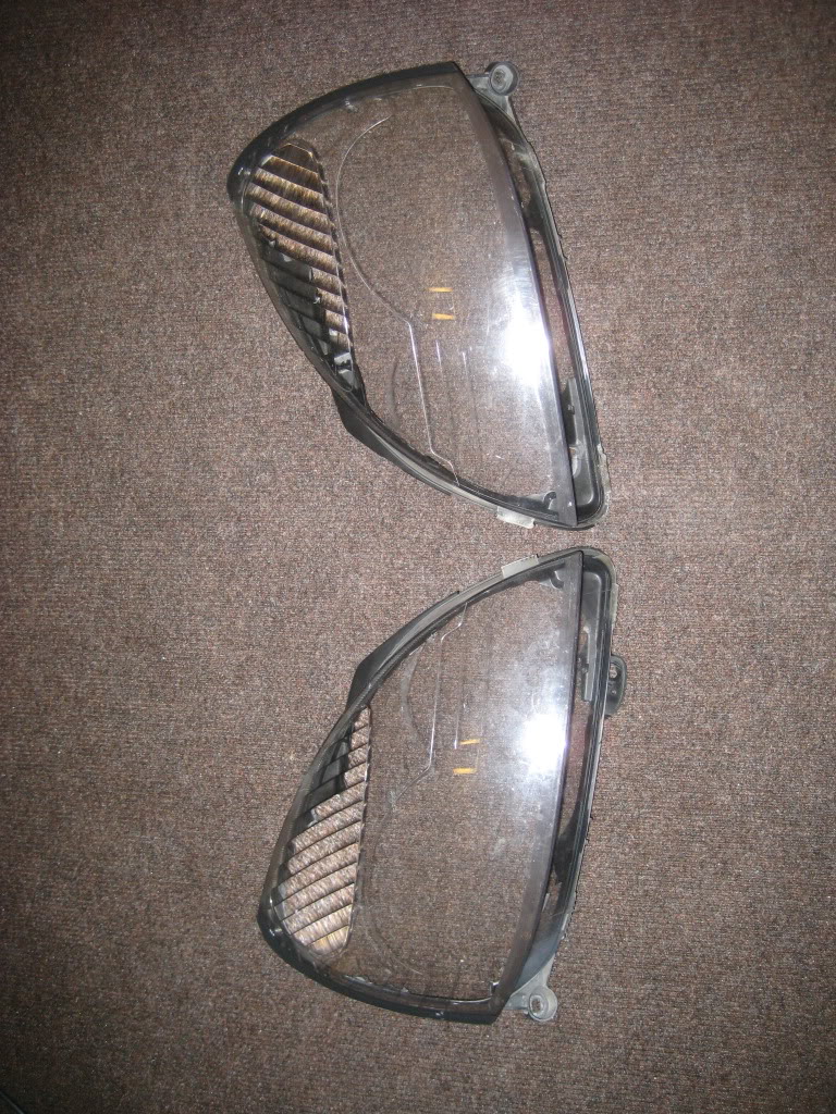

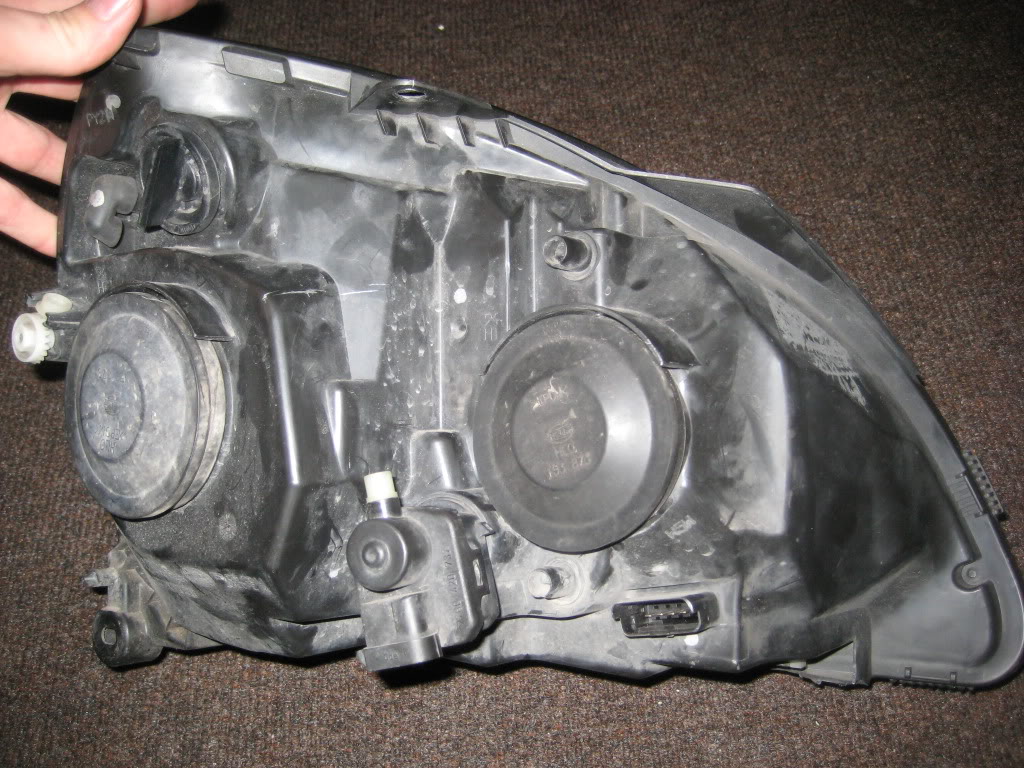

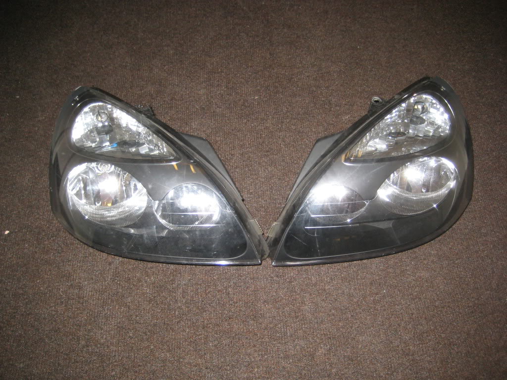

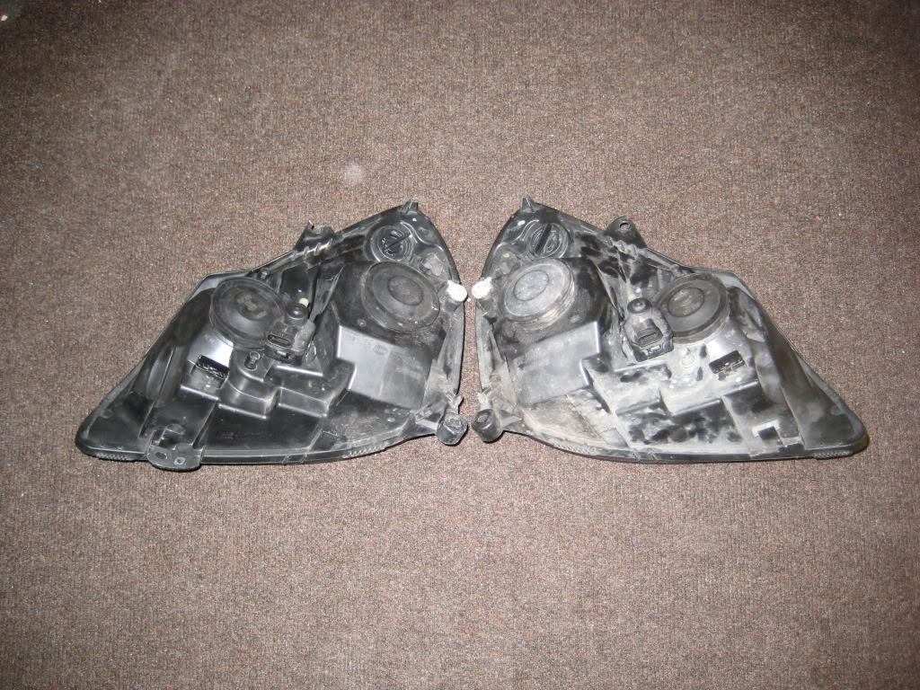

UPDATE.
Right so i'm getting my driveshaft re-furbished by a company in Huddersfield so my car should be working with by the end of the week :)

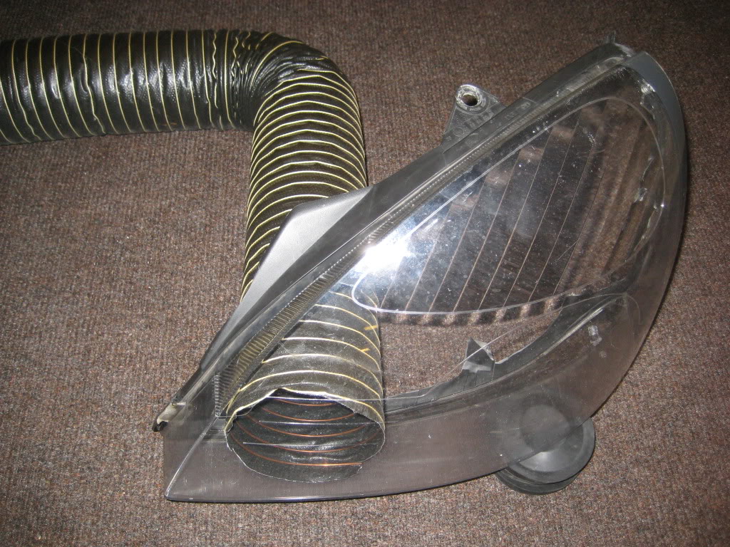

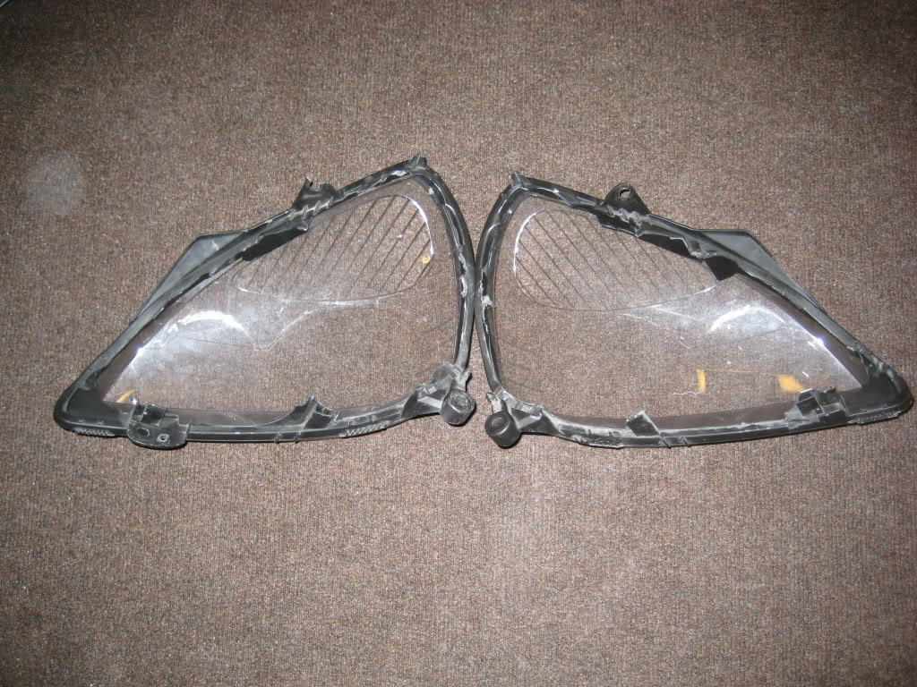

I bought another set of front light from Jesus and they arrived today.
I wanted another set so i could run CAF's to the ITB's when on trackdays
They were in a good condition and for £35posted they were the right price for what i was going to do to them.
I tryed a heat gun on the edges to try get the plastic face off them so i could pull the gubbings out from them, but that didnt work, also tryed soaking them in hot water but that didnt work.
So i got a nice big hammer and wacked the S**T out of the back and after a while it looked like this.
I've kept the mounting points so its now nice and light but it will attach to the same places.
Now i need to cut a dirty big hole in the front of them and attach the piping with some tiger seal or somthing. Then they will be sparyed Black :)
Should get a lot of cold air to the ITB's and save a few KGs over the xzeons.
I know i could have bought the CF ones from Yozza but £200 was quite a lot as i was cutting a hole in them.
Bargin CAF :)

That's gonna look awesome when it's done - how are you cutting into the front lense? Spraying the covers too? :)
Probably fancyplates.com - it's where I got mine from! *touch wood* so far I haven't had any problems with it, either!
Yeah i will be spraying them black i think.
I'm not 100% sure on what i'm going to cut them with, but i want to make it flush, so i may cut the hole a tiny bit smaller so the pipe just sits behind it. :)

My new "cup racer" lights only weigh 0.7 kg and the normal xzeons weight about 3kgs?! So i suppose i'm gona be saving a few kgs.
The main reason for doing it is for the cold air feeds to the ITB's
