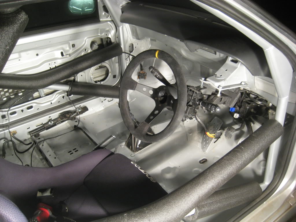

Little update from the bits i did tonight

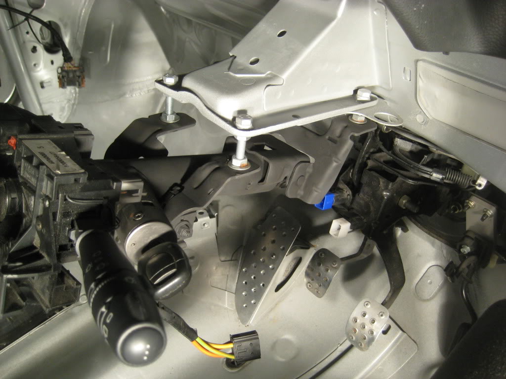

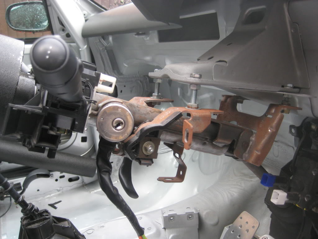

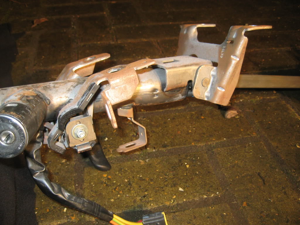

So my steering coloum had some little bits of excess metal which i didnt really want, and it looks poo because of the rusty colour
So i removed it from the car
And then set about cutting the bits off i didnt want.

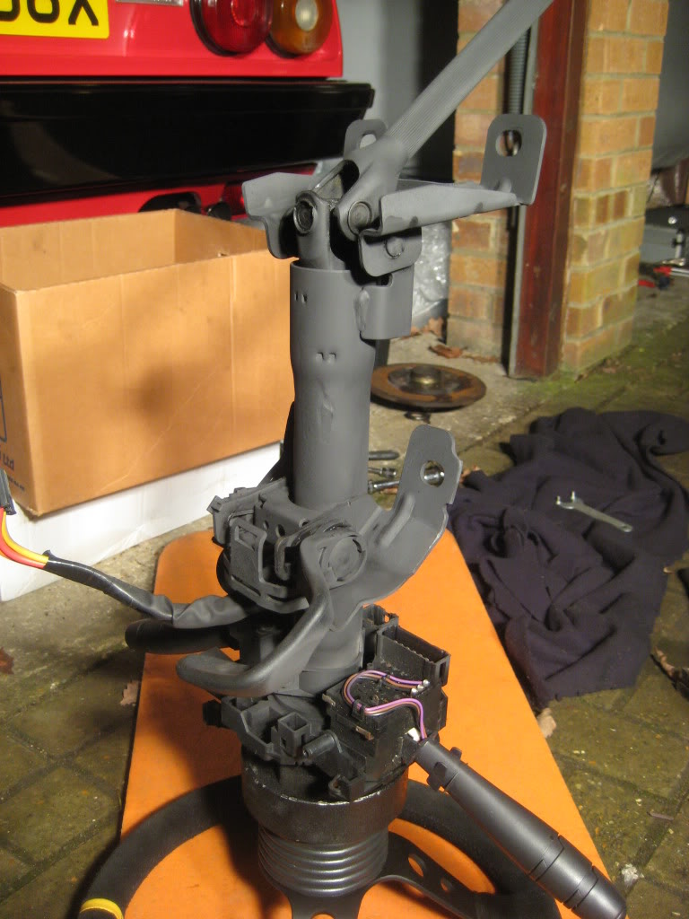

So before
And after i had cut the bits and sprayed it black
Then re attached to the car :)
Much better :)
  DCi 100
The longer bolts on the collumn are where you've spaced it out to have a lower position on the steering wheel right? Can't remember it being like that last time I saw one.
  TrackCar & F30 330d

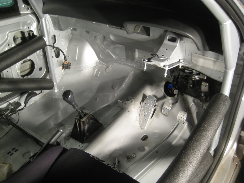

The Interiour should pretty much look the same when all the wires are back in too as 90% of the wiring will be hidden under the little dash.
With the steering coloum been lower its now a perfect driving position the only bad bit is the gear stick is still far forward, shame that cant be relocated further back as easy as lowering the coloum
Chris, I'm 6'4" and have been thinking the same but Fred @BTM gave Tom@JMS the best advice which I'm trying. Rather than relocate the lever further back. Use all the adjustment in the linkage to bring 4th back toward the hand brake and 3rd will be nearer the original neutral position. May need to dremel the plastic for getting into reverse. It's in Tom's thread somewhere...

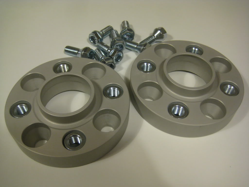

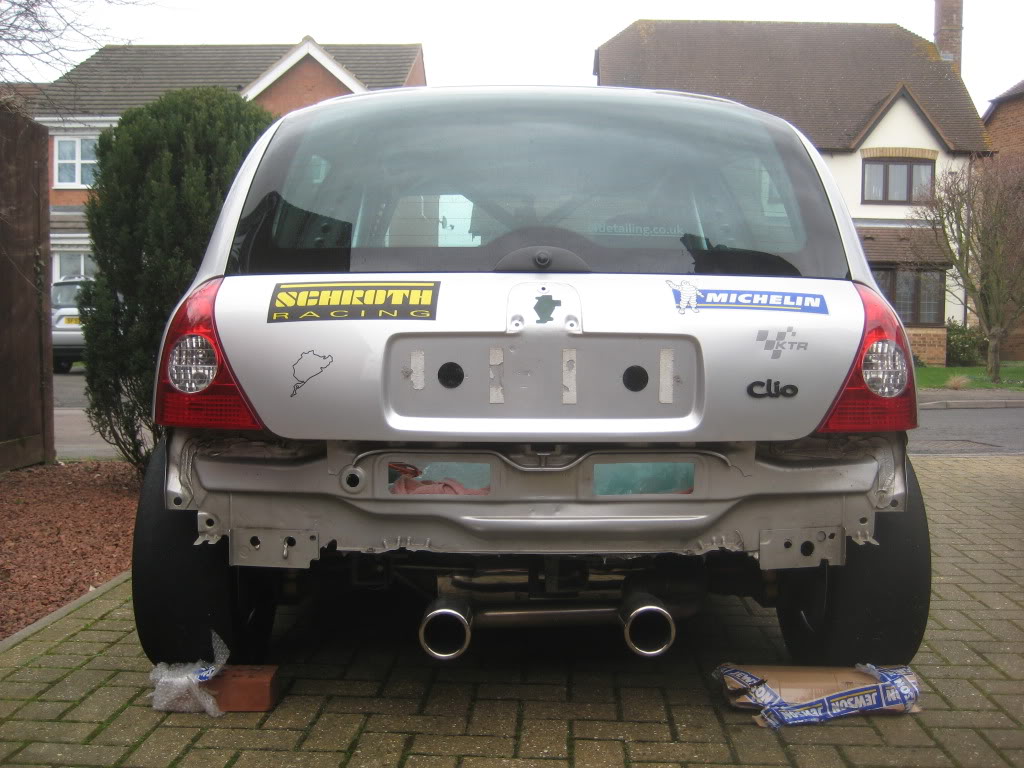

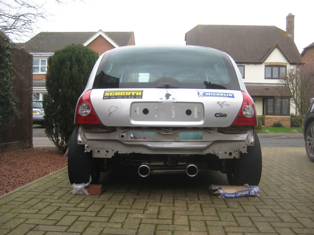

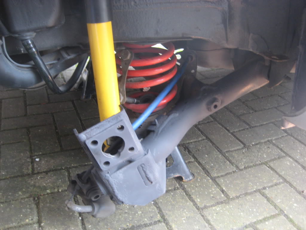

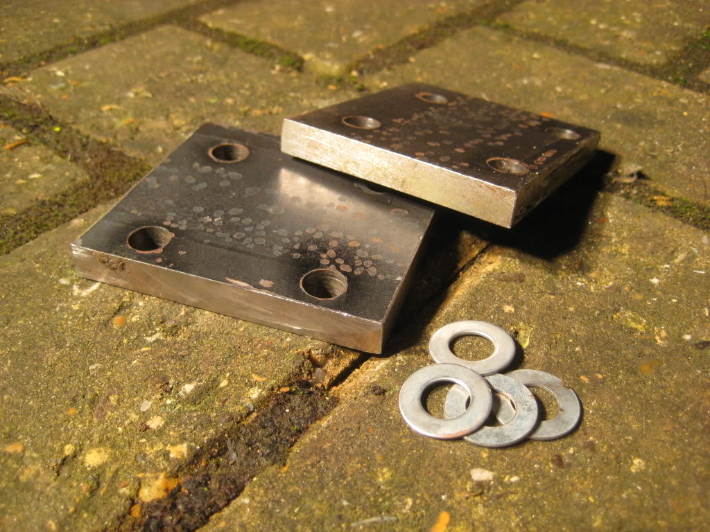

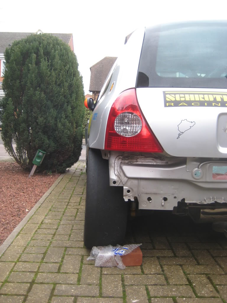

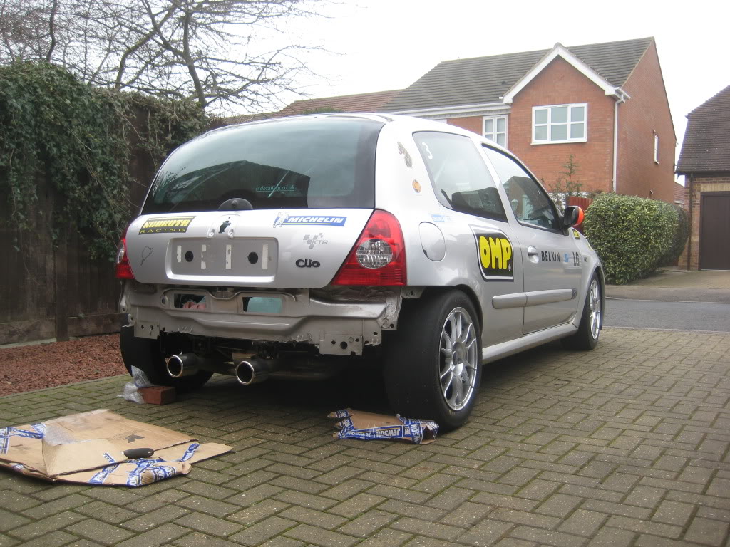

Today i rebuilt up the rear hubs with my spacers Bomber gave to me (thanks mate) & my expensive camber washers lol.
Heres the gear
10mm spacers for each side
The rear beam was pretty rust so i brushed the rust off with the drill and gave it a quick spray

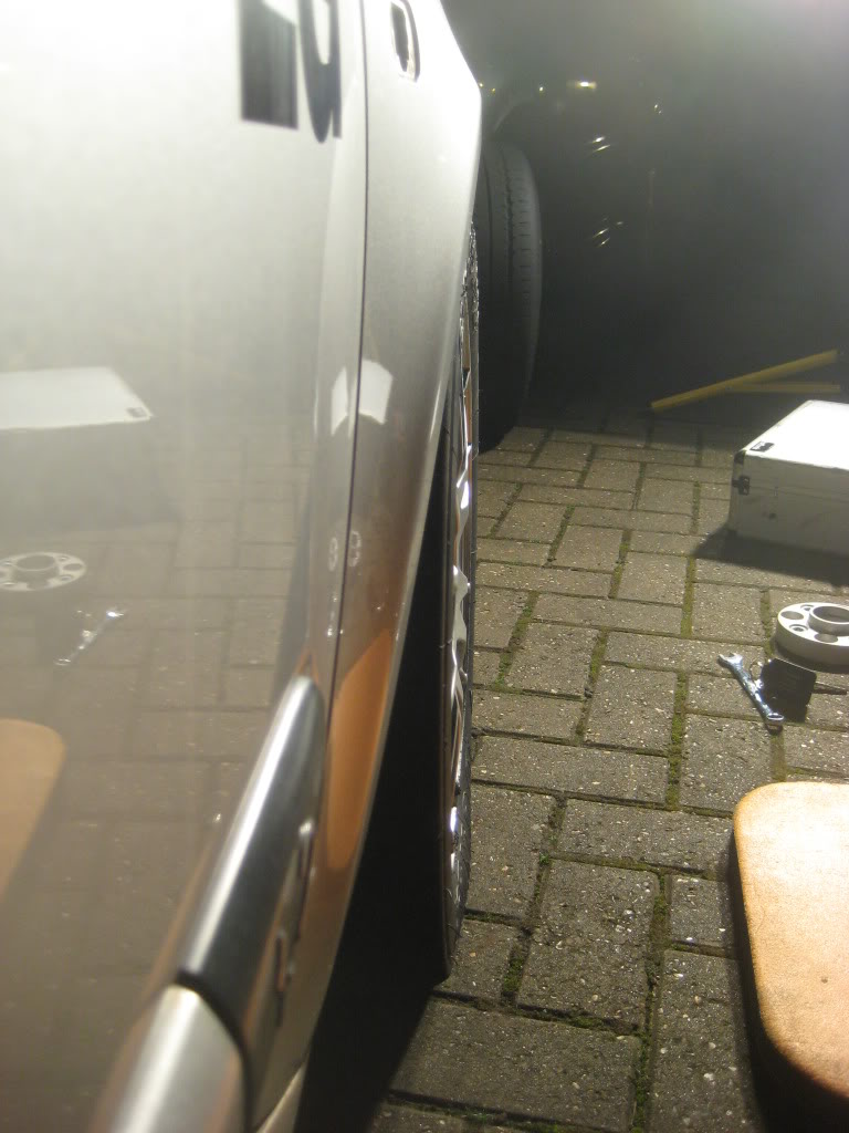

so built it all up and put some wheels on her so we could get the cars out of the garage for a drive
Rear wheels sit much better in the arches :)
Nearly 1 month to go when it has to be finished :S

Driving on slicks? lol
Looking good tho :approve:
Thats how I roll (do you get it....i have to push the car because it doesnt drive yet so it rolls!)
Hmmm Carlsberg Export!!
Awesome, you seen my thread? I already have the steering column marked up for trimming.
Yeah i just had a look at your thread again, your coloum is wierd, it has that huge bit of metal underneath which is strange as mine never came with it!
Looks good mate, how much camber should that give you?
I cant remember the size washers i put in but i belive it will give me around 3 degrees negative camber so we'll see how that feels like.
I'm gona be ordering the front spacers next week hopefully so it should have a good stance.

Weird and alot easier that you didn't have that plate. Was the column easy to remove? Think it will be easier to cut and grind like that.
Well as i dont have any PAS pipes getting in the way anymore its easy to get to the bolt which attaches the colom to the rack but i remember it been a right ball ache getting it off.
So for you it might be best just dropping the 4 bolts which attach it to the car and using the angle grinder in the car. Or just do it when its on.

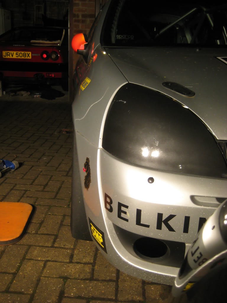

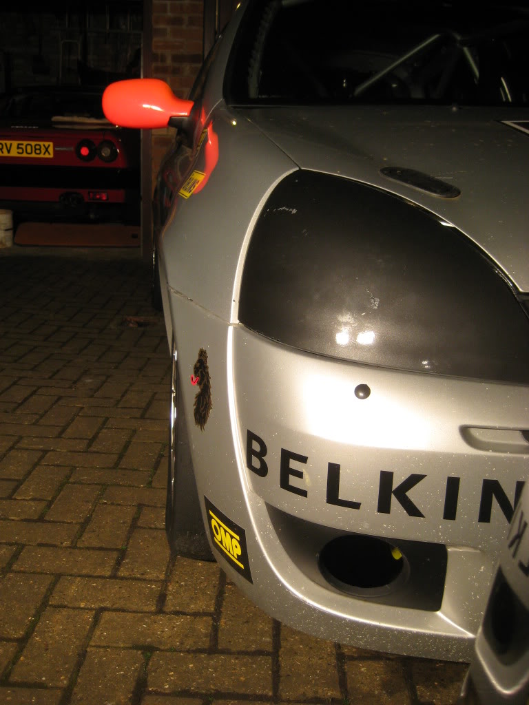

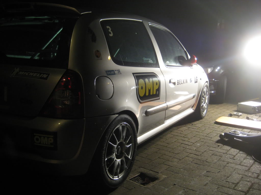

Update,

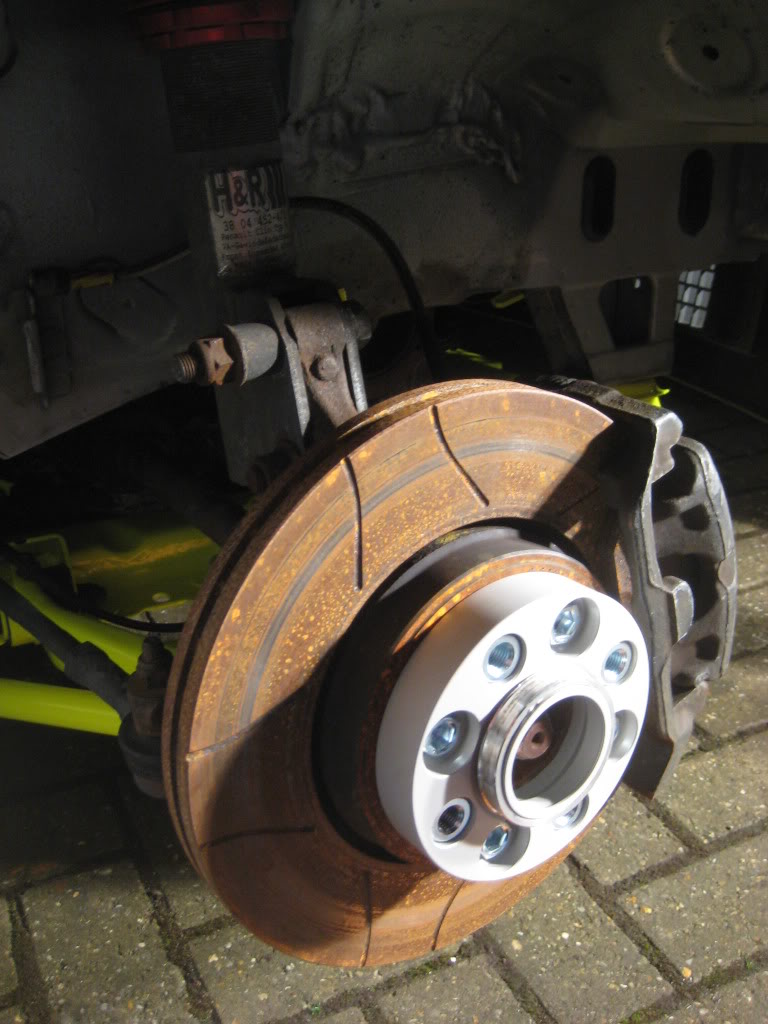

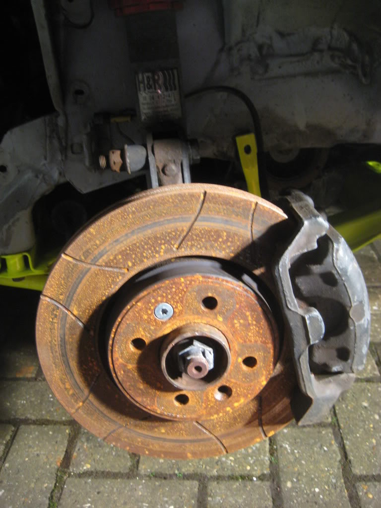

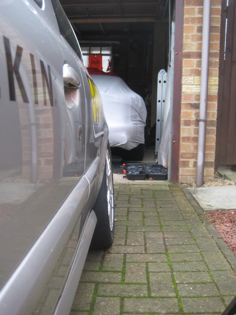

As i had spaced the rear out i needed to space the front track outwards too. So i bought some 25mm Eibach spacers for the front. So its now 50mm wider at the front.
As they arrived today i fitted them tonight :)
So here's the disk bare with no spacer, ignor the rust.
With the 25mm spacer
So before
After

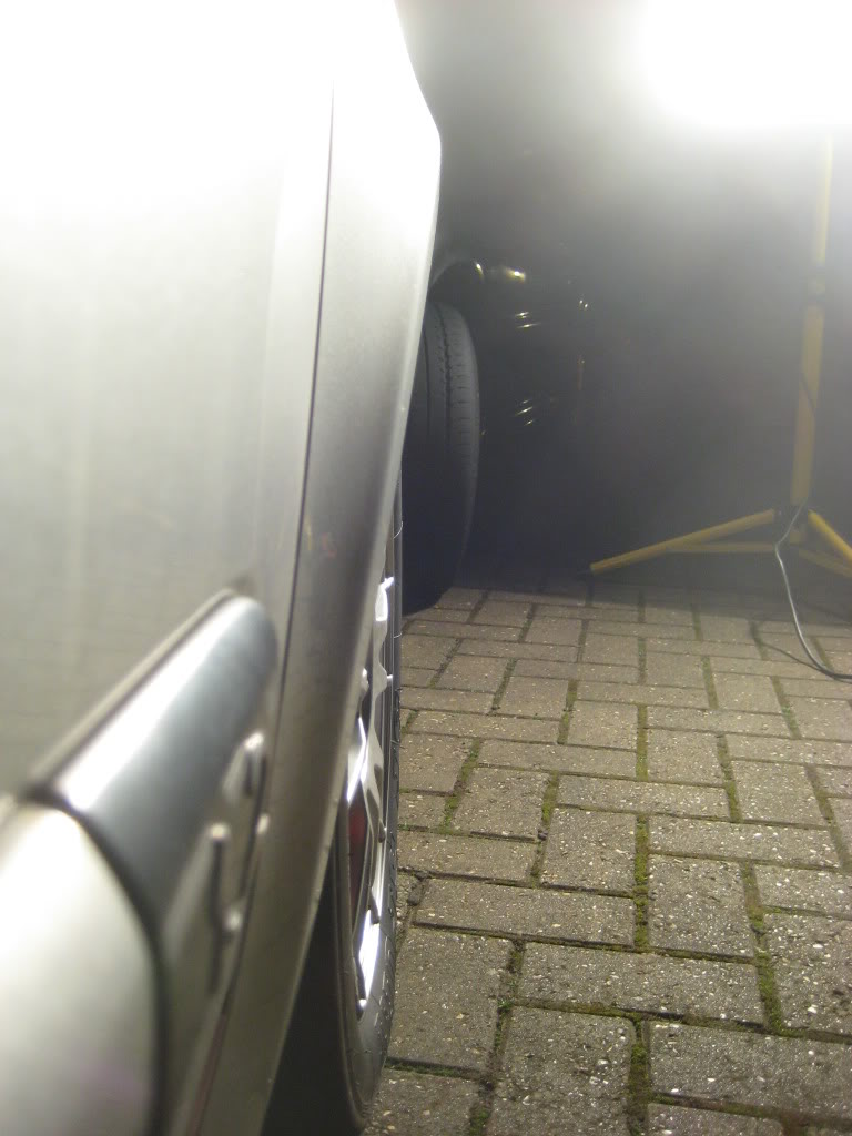

Befor
After
So all spaced out now :)
Need to do a bit of trimming of the bumper and arches but thats not difficult as i'm now a dab hand with the angle grinder :evil:

Very nice, same spacing as mine front and rear IIRC.
