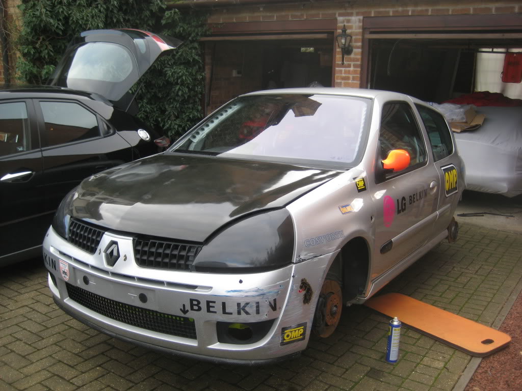

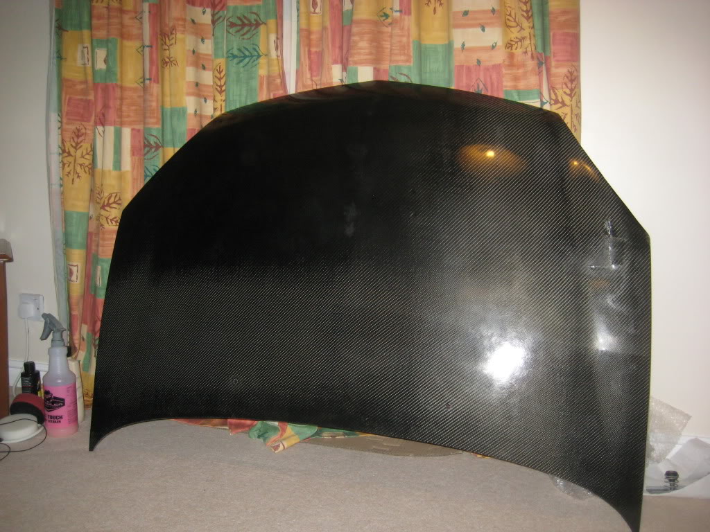

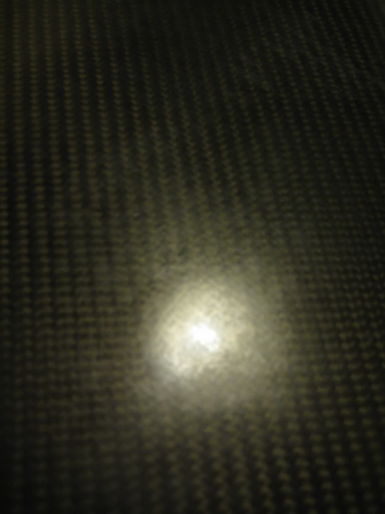

Cutting a long story short, I bought a Carbon Firbre bonnet which had some laqure peel. and the courier damaged it in transit by putting a large cut in it :( The package didnt have insurance or anything so i'm stuck with a bonnet with damage.
Anyway today i took the DA to it to try getting it looking a bit better.

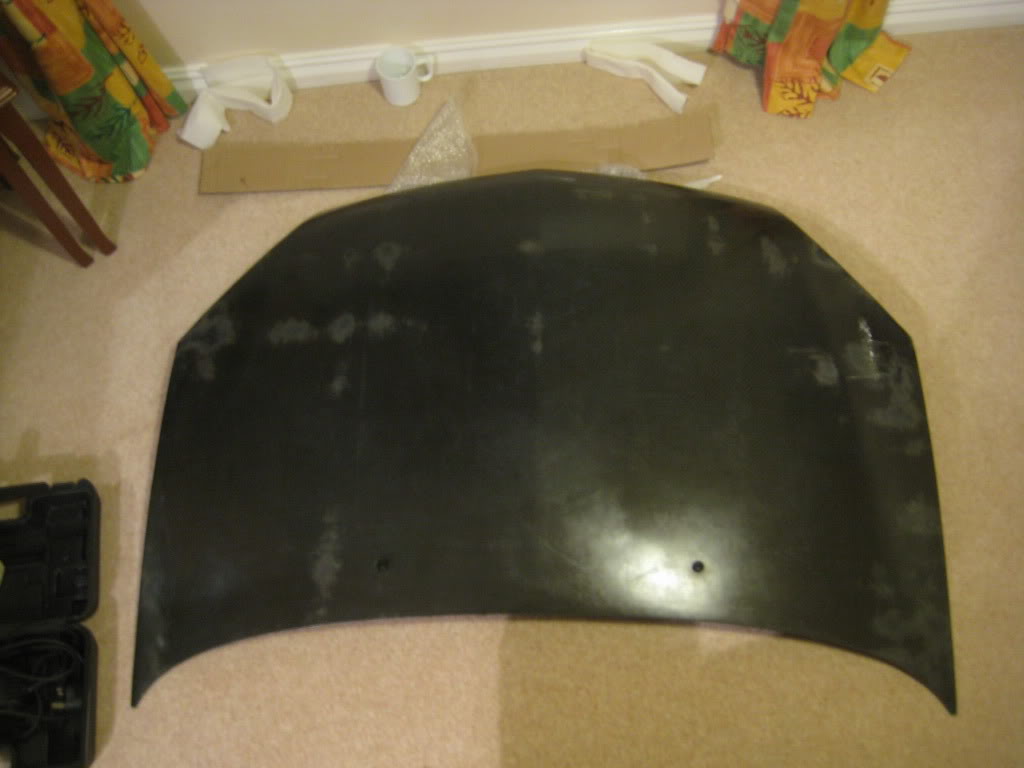

This is what it looked like when i got it

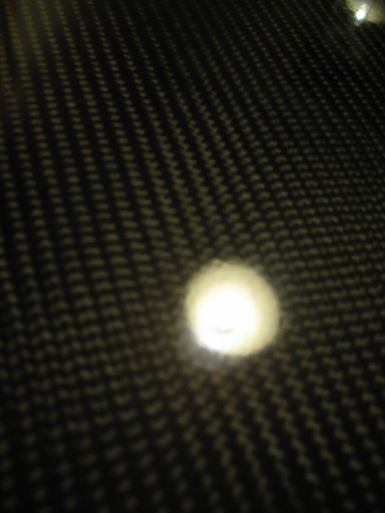

Here's a close up of the 'good' part of the bonnet, the most swirled and hazy laqure i've ever seen.
And after a few runs over it with some cutting fluid
Looks better but still needs a bit more work

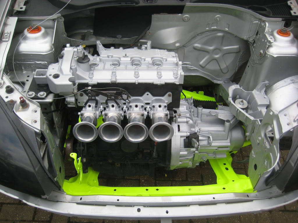

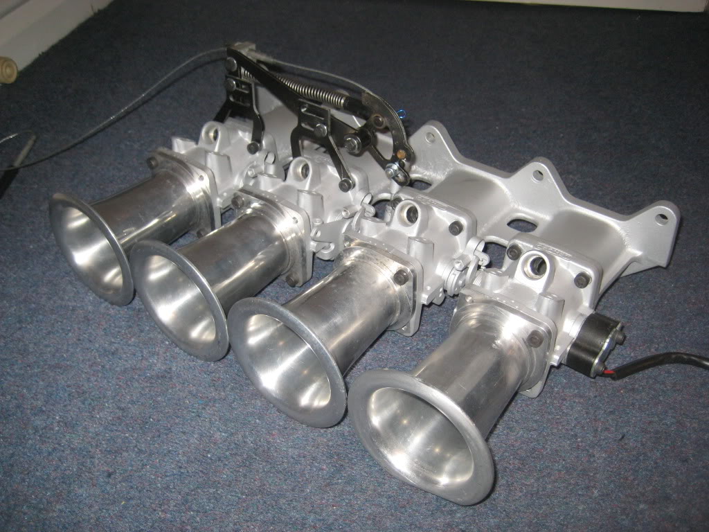

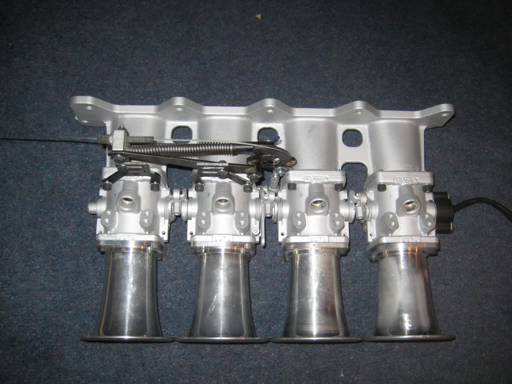

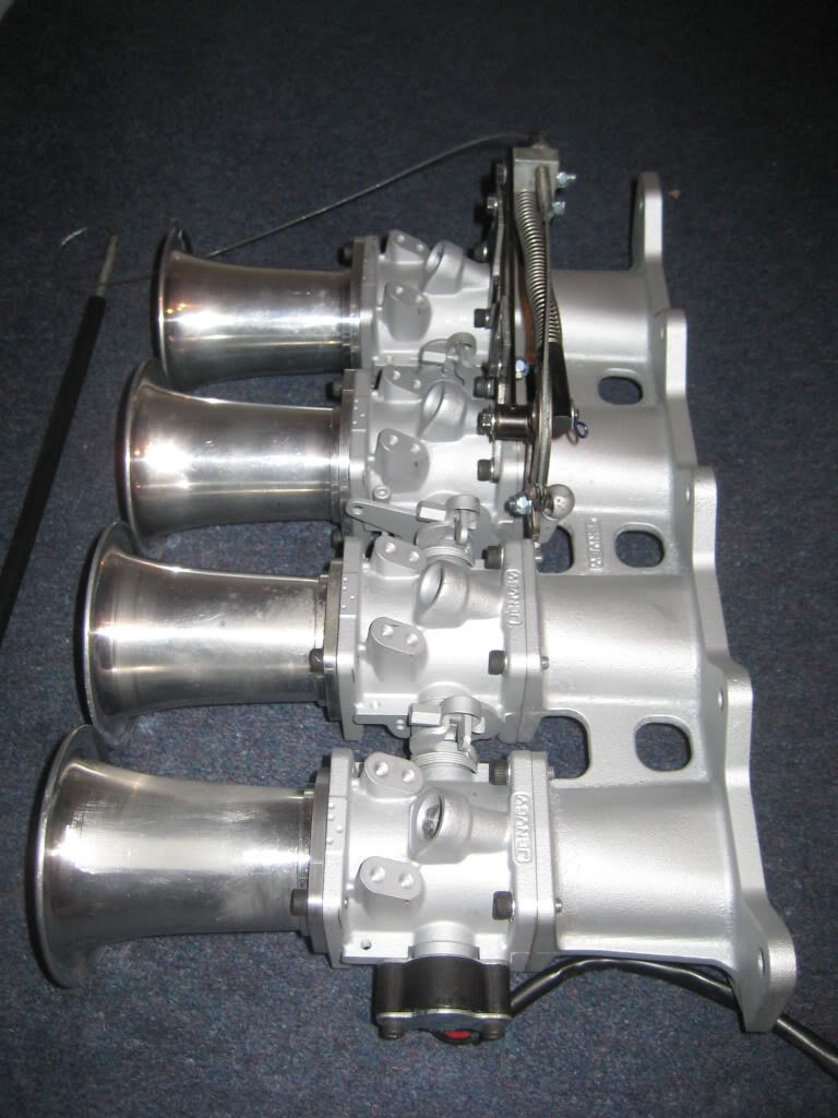

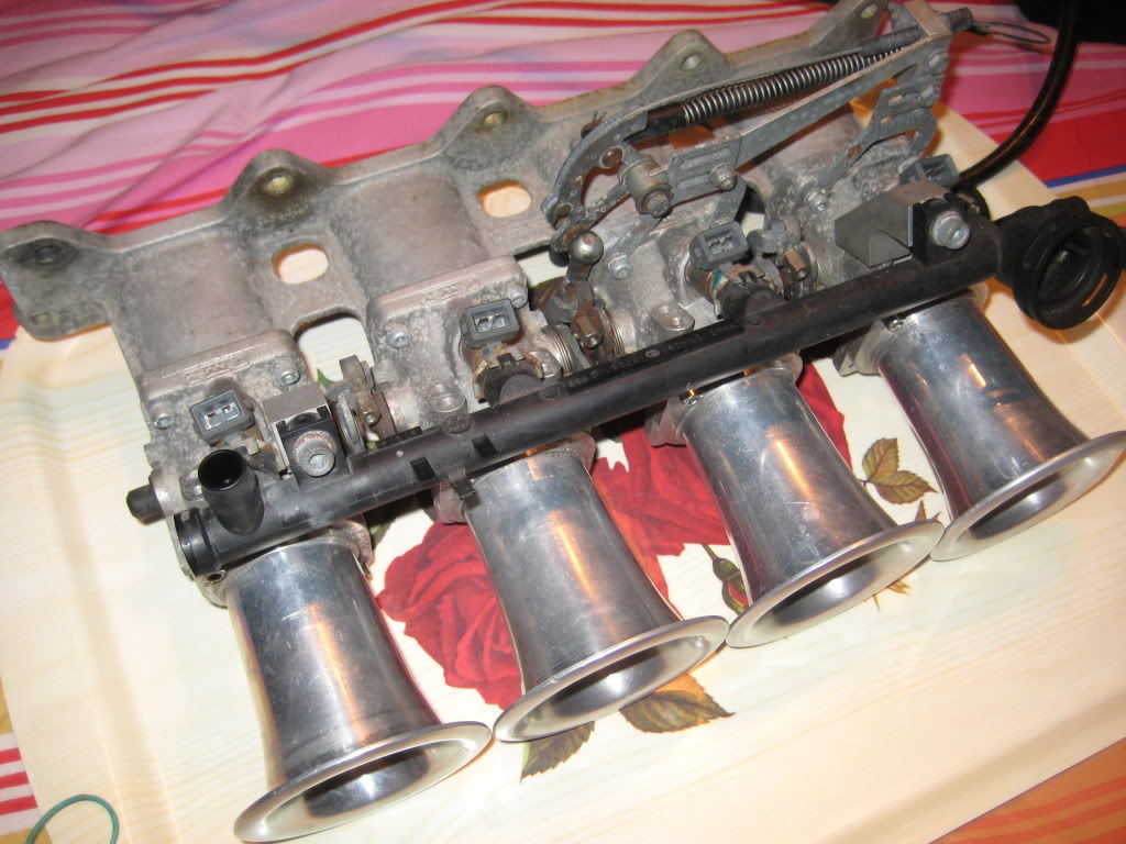

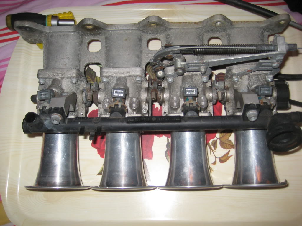

Also rebuilt the ITB's
Before
After
As you can see i've rebuilt them with the mech on the left so its pointing left and to the peddles instead of it going right and having to curve round.
Still need to polish up the trumpets, but might get some cheeky Carbon trumpets instead.

I had a fibreglass bonnet for my 172... 1.4kg iirc, but was mega flimsy!
Only had it on a few weeks an sold it.
You got a carbon bonnet also eh? Same here! ;) How heavy is yours? Mine seems lighter than the standard bonnet but not a light as I thought though, someone told me that its a GRP bonnet with a carbon skin on top...
Yeah mine is a GRP with CF top layer. Mine weight 7kg. which is a lot ligheter than standard so i'm happy :)
7kg's sounds about similar to mine, ill get mine on the scales and see! Getting the inner boot skin taken out of mine soon, wont be long before i'm as light as yours ;) Though I still have no cage :(
Well my heavy thing in my roll cage and yours is your 2118's lol, probably weight the same lol
I doubt that bonnet will polish back up, mine is exactly the same. The trouble with those K-tec bonnets is that they are cheaply made with polyester resin instead of epoxy resin, polyester resin is quite soft and doesnt polish up very well so the bonnets are lacquered from new. This is all fine if the lacquer used is good quality but the stuff on these bonnets seems utter crap and goes all patchy, so the only way round it is to sand all the old lacquer off and re-lacquer it or just paint it body colour like im going to do.
Polyester also turns blue tinted and spider webs fairly easily iirc?
Shame about the bonnet dude! Trumpets all cleaned up are lovely.
Thats probably gel coat your thinking of, the top layer of most fibre glass products. These bonnets arent gel coated though.
I've polished it up and it looked pretty much brand new, obviously apart from the big gash in it. The bonnet just needs a little bit more work in a few areas where the laqure was very bad.

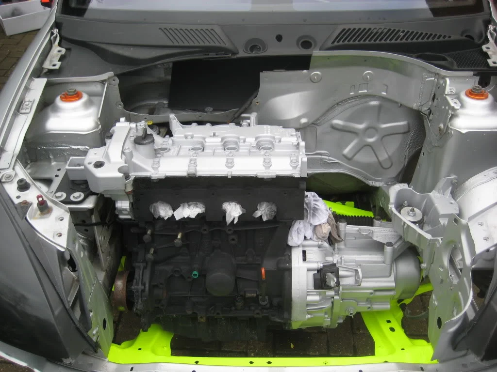

These some pictures of what i got upto the other day :)

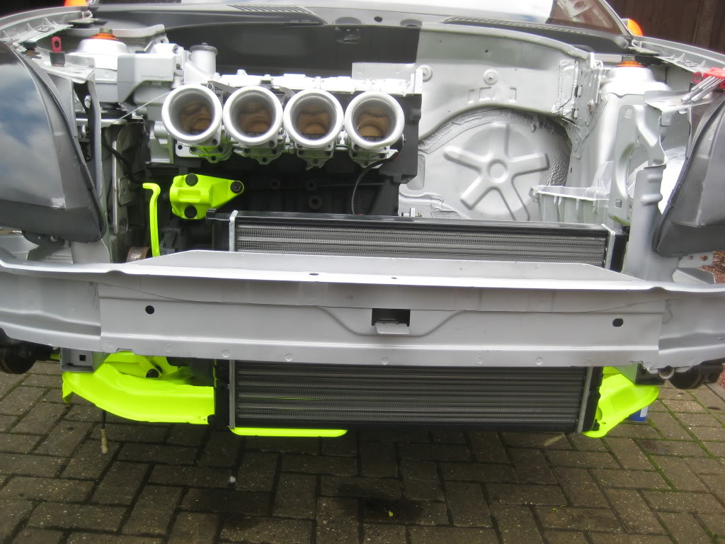

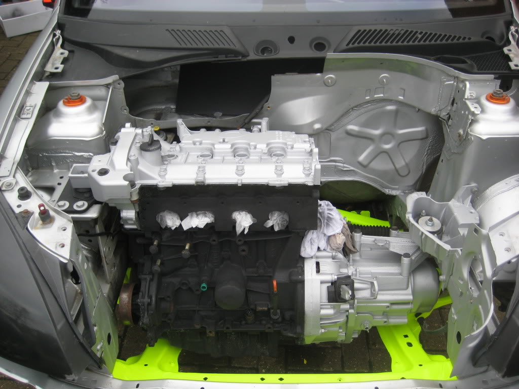

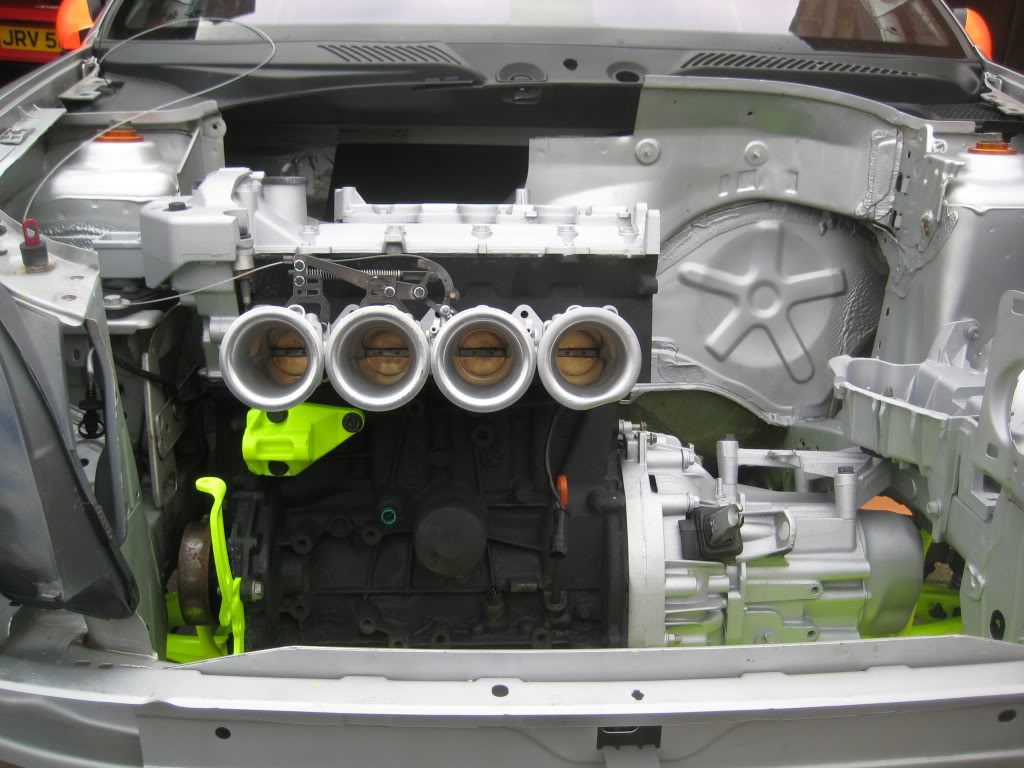

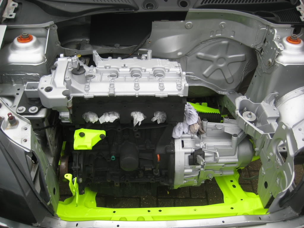

So i finished off attaching the wishbones and subframe to the car and suspension so it was all ready for teh slightly more fun stuff

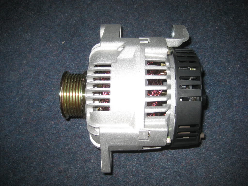

Alternator Bracket and tentioner bolted on :)

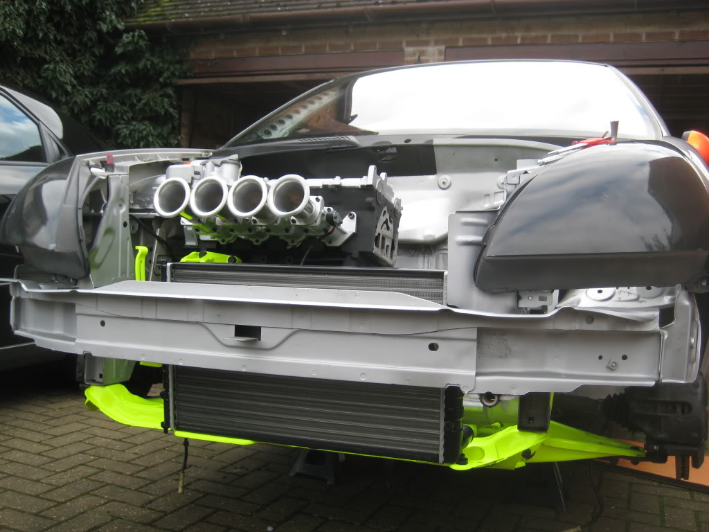

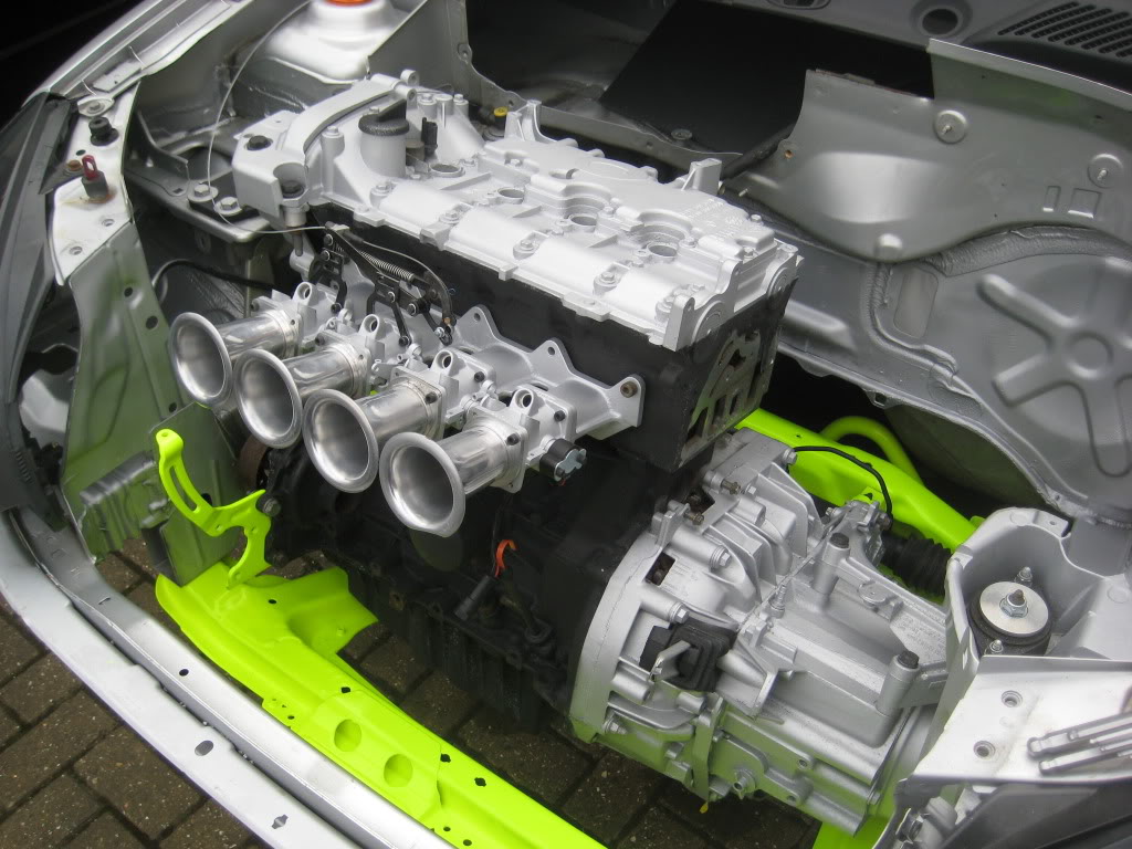

Then the ITB's went on to see what it all looked like.
And as i have had my new rad for months i brought it out and had a trial fitting
Fits pretty well tbh, just needs a few little bracket and it'l be nice and sturdy :)
A;sp trial fiting the bonnet :)
So thats it for now. Just need to find a bolt to go through the top of the alternator which turned up today :)
Its getting there :)
