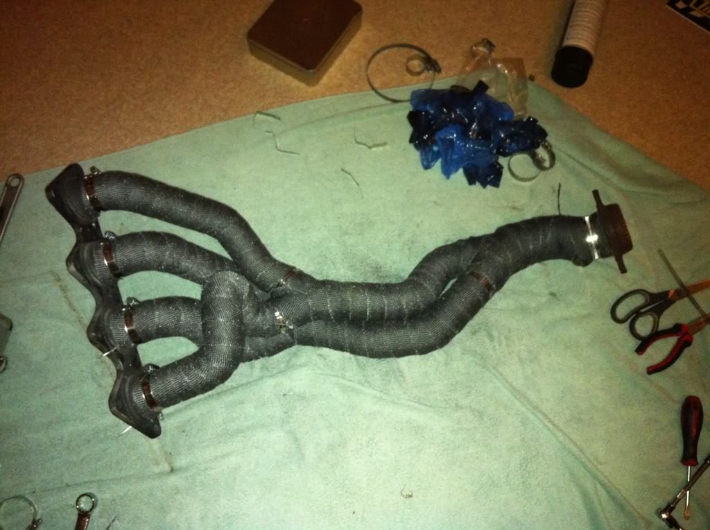

Also I heat wrapped my manifold the other day so here's a iPhone picture.
Just need spraying to make it not soak up fluids that might drip on it, i bought it from Nimbus Motorsport and it was the bargin of the century. I <3 Nimbus Motorsport :)

I bought a thermo tech heat wrap kit which comes with enough wrap to wrap a 4-2-1 mani, 6 metal tip ties ( which isn't enough) and 500ml of special spray which you spray over the manifold after it's wrapped and it seals the wrap.
  182cup & 172 racecar
The only thing with wrapping a manifold is that any oil leak etc gets on it,then,FIRE!
Best ti get them coated,but thats expensive.
  TrackCar & F30 330d
Zirotec coat a 182 size mani for about £350.00 last time I checked, worth it for the lack of risk alone.
Its very expensive, maybe on my next track/race car i will send my manifold off to them but for now i'll stick with this.
I did hear about the old oil on the wrap, but i thought that was the whole point of the spray, it seals the wrap so it cant soak up fluids as much. If theres enough oil on the wrap to set on fire then the engines probably gone pop. and in that case i'll build a new one.
Also £350 is a full set of plastic windows so i'll do thats at some point.
