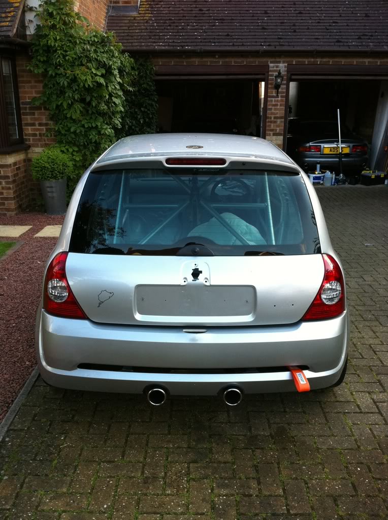

Fitted the rear tow strap :)

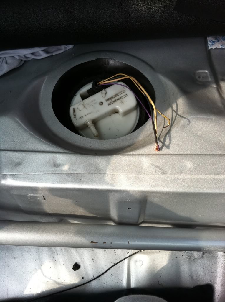

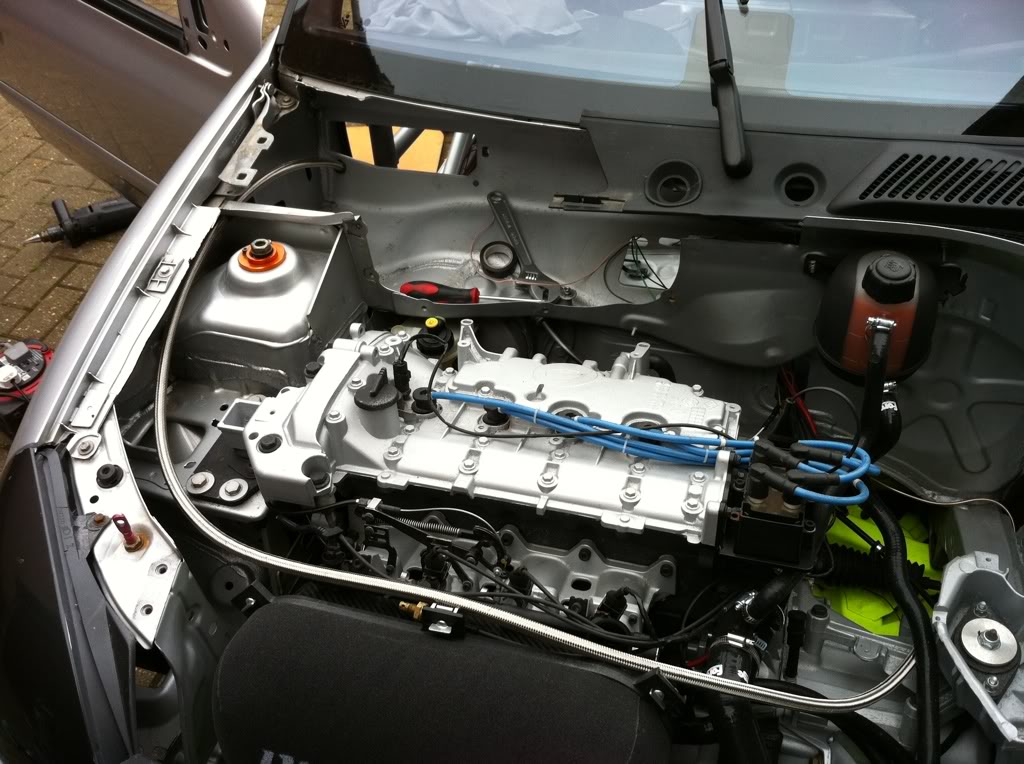

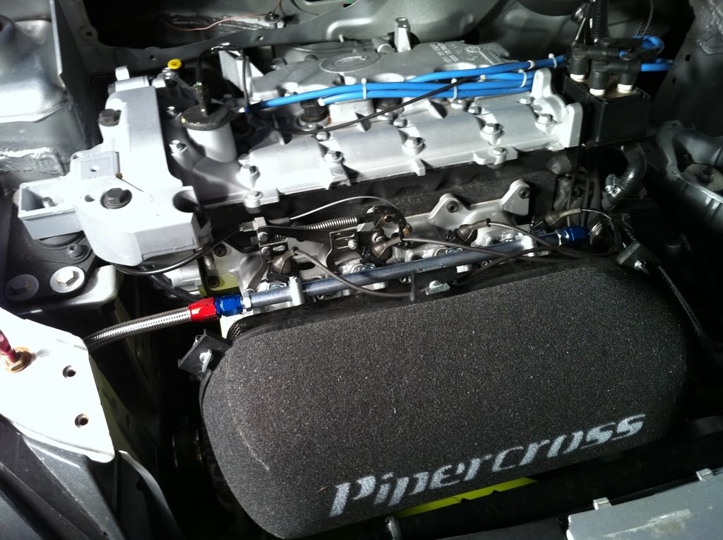

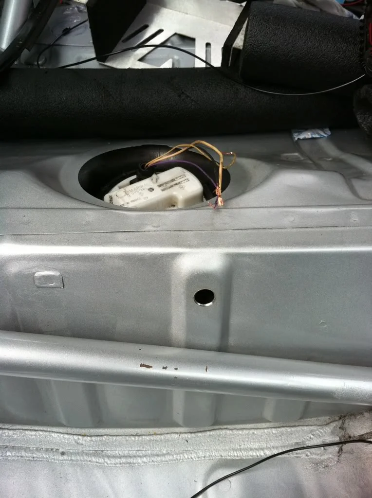

As the standard fuel line was allways really tight i decided to buy some new bits to change to a full braided line and metal fuel rail.
Parts were:
4 meters of braided hose
1 goodridge hose to fuel rail fixing
1 alloy blanking cap from Think Automotive
1 alloy push hose adaptor
1 Jenvey metal fuel rail
2 bracket kits for the fuel rail suited for the standard injectors

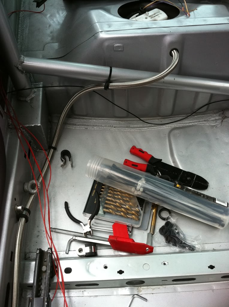

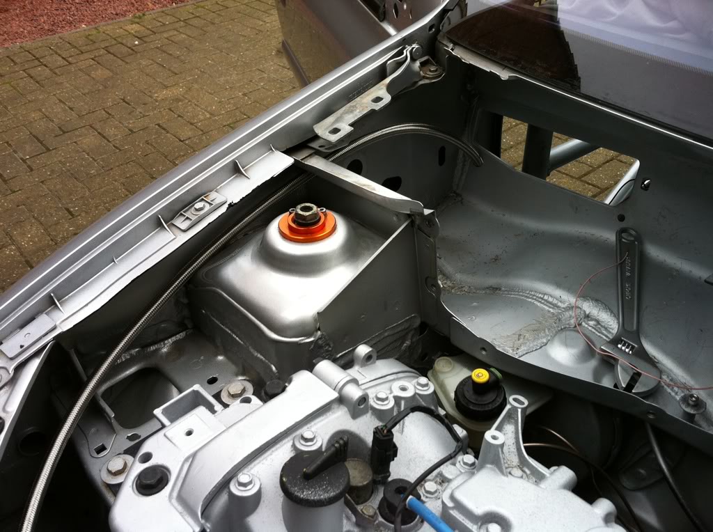

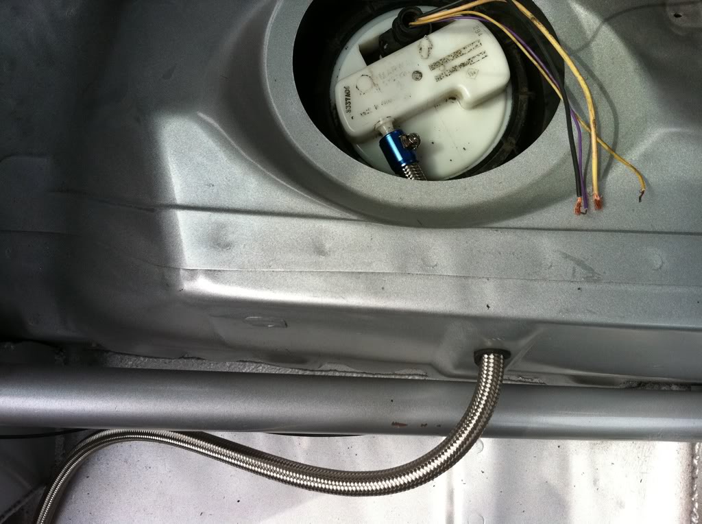

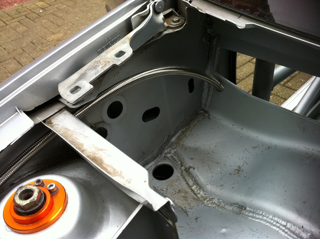

So first i drilled a hole where i wanted the fuel line to go through the car.
All was fine so i enlarged the hole to the size of the grommet and line

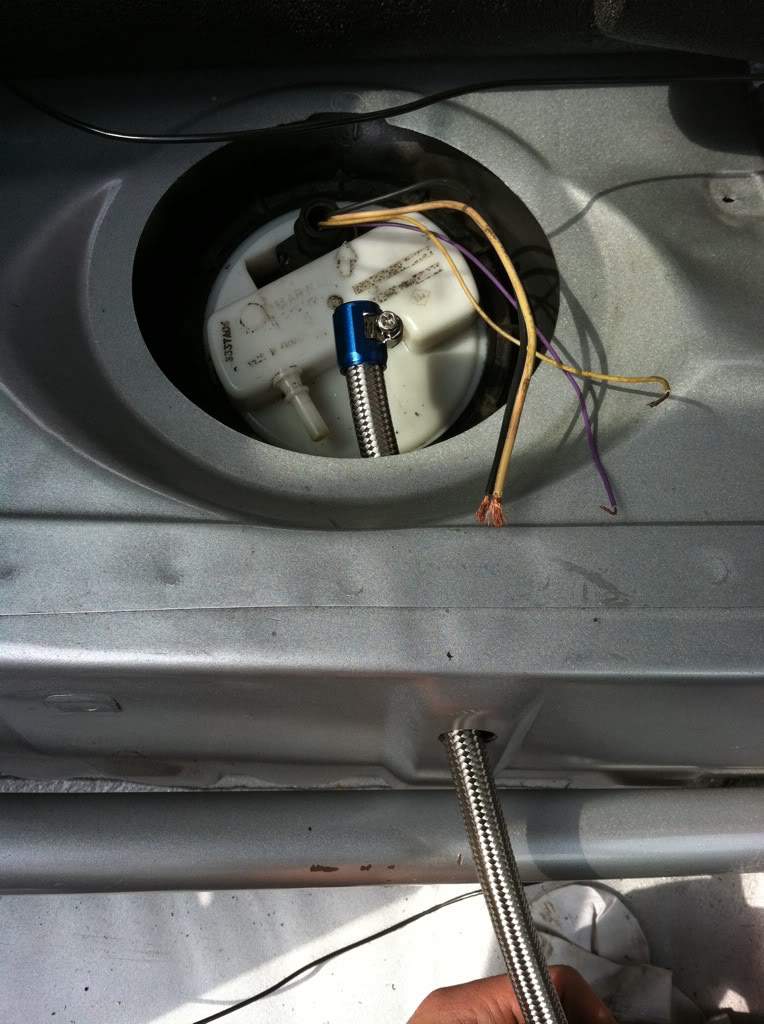

Poked the fuel hose through the hole and attached the push on fuel fixing
Pushed the hose on
I then ran the line down the side of the car
Through the fire wall

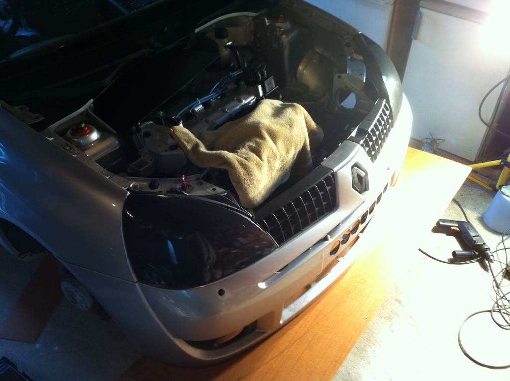

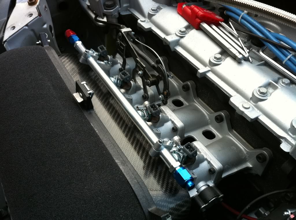

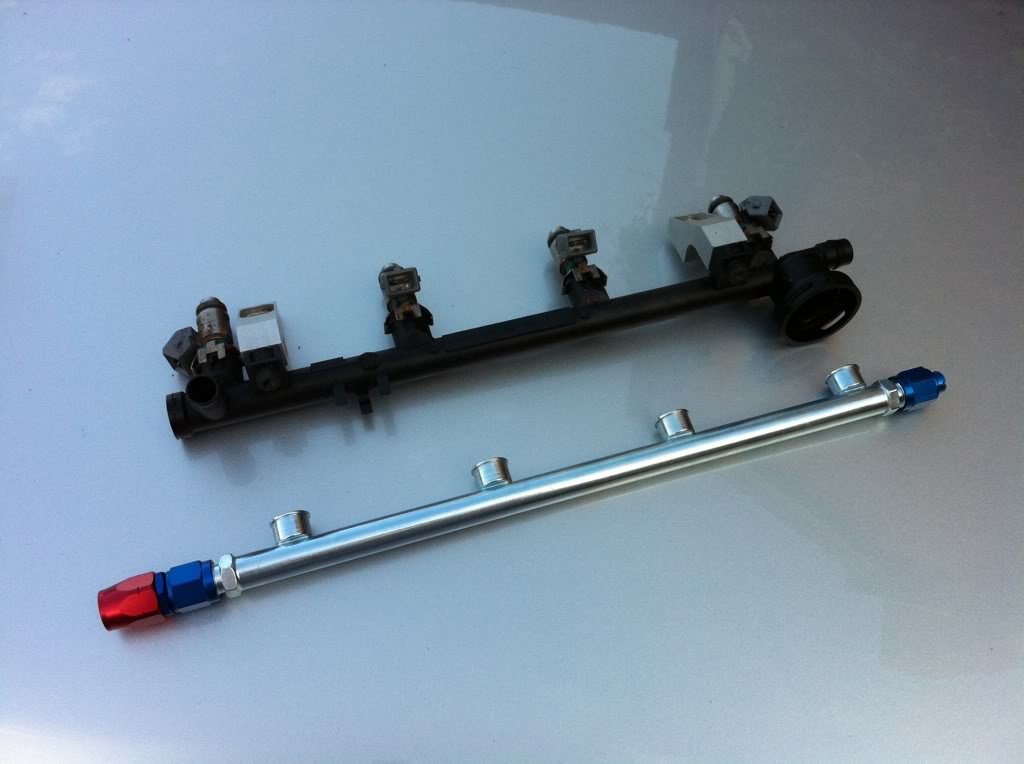

I then started to remove the old fuel rail
New fuel fail next to the old one
New rail fitted
The other thing i have done is completly rewired the car, so the car had NO wiring from RENAULT and just amazing wiring by me.

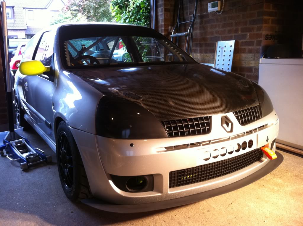

It starts up striaght away now i have set the throttle cable.
Sound very rough tho and it seems to be kicking out black smoke which doesnt sound/look good. I'm gona bleed the cooant and try plug the laptop into the ecu now i know the ECU actually works.

How did you fit the rear tow strap?
I've got my front one fitted easy enough but then looked at fitting the rear and couldn't really work out a good way to do it
I was contemplating drilling the welds out for the standard one - then drilling a big hole through the spare wheel well and using a harness eye load spreading plate on the other side - but wasn't sure it would be strong enough :(

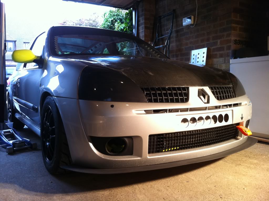

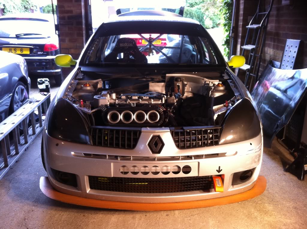

UPDATE:

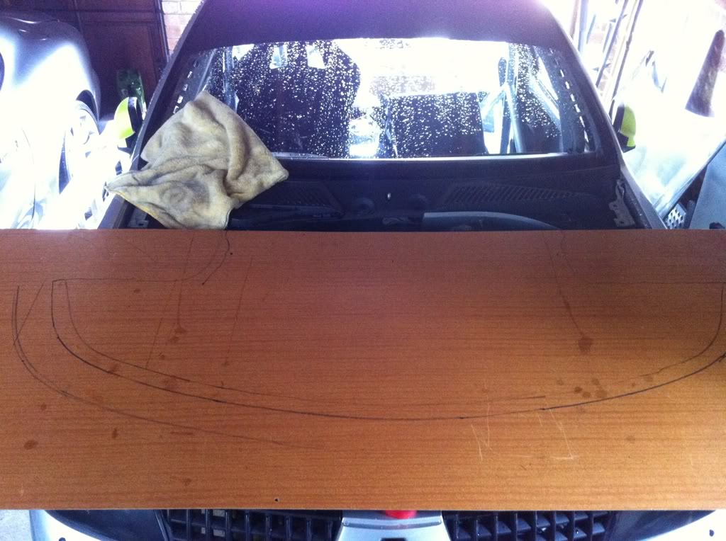

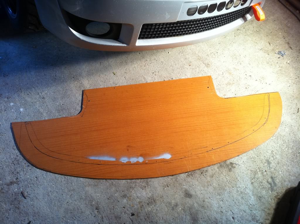

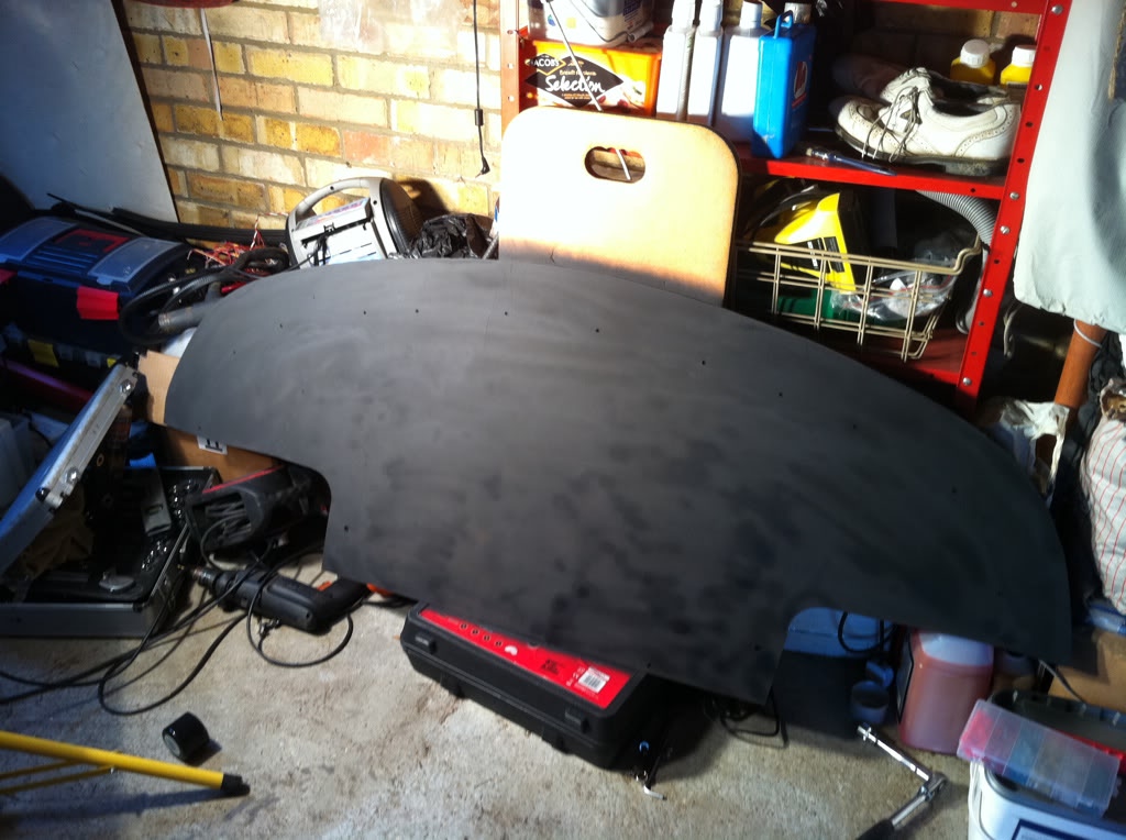

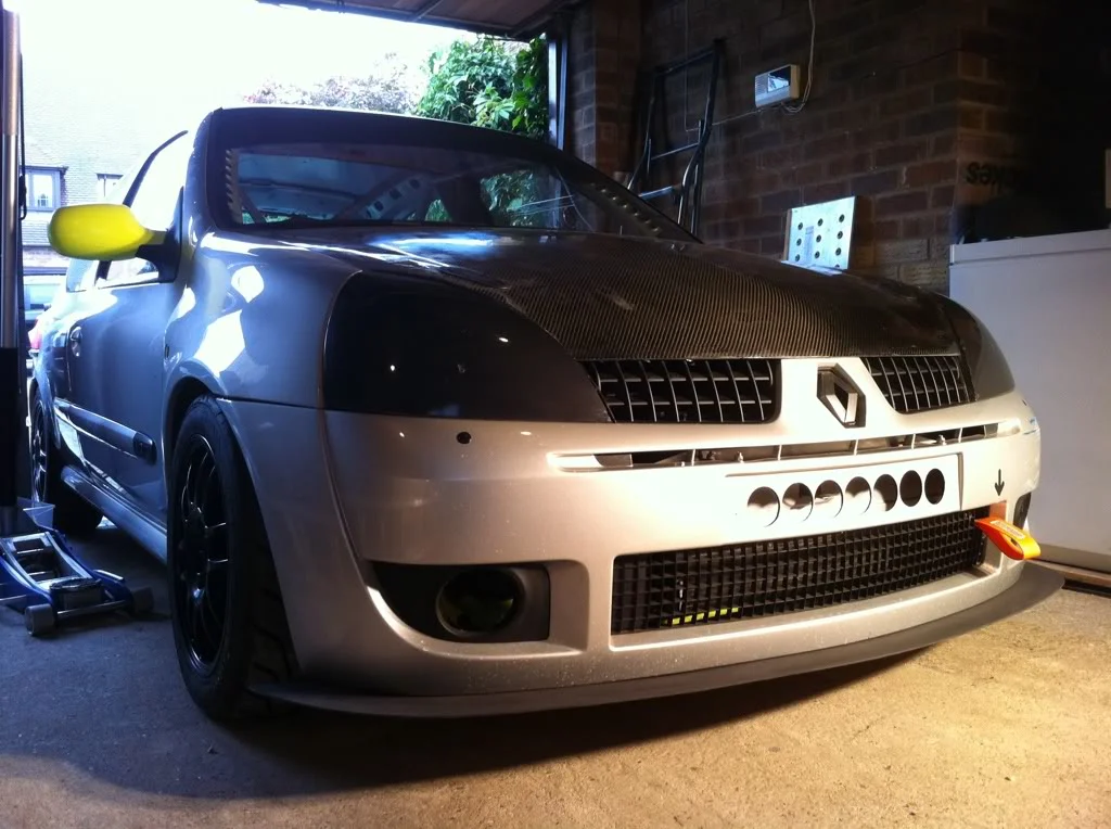

I've been meaning to make a new front splitter for quite a while now and today I thought i'd give it a bash.

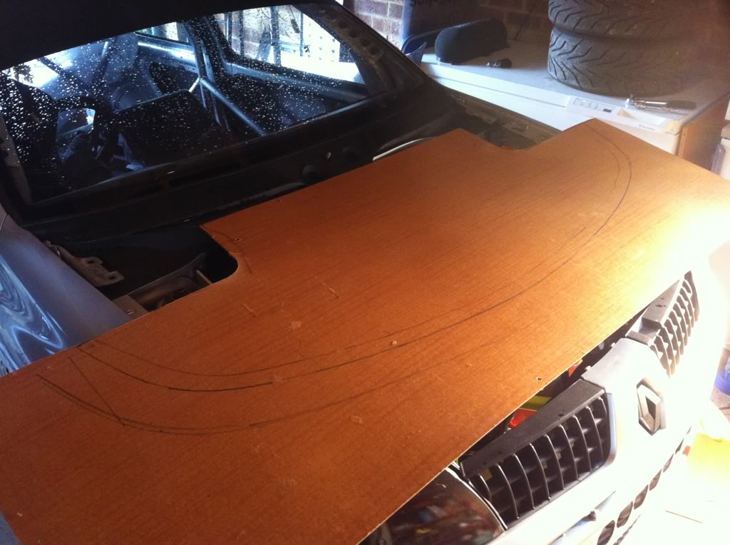

I started with a huge piece of chip board of something and slid it under the car which is on axle stands
I then drew on the wood to mark out what I needed to cut off

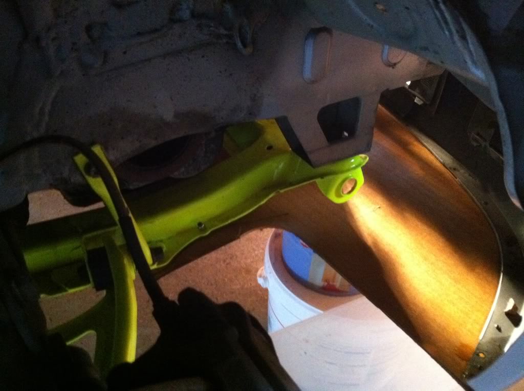

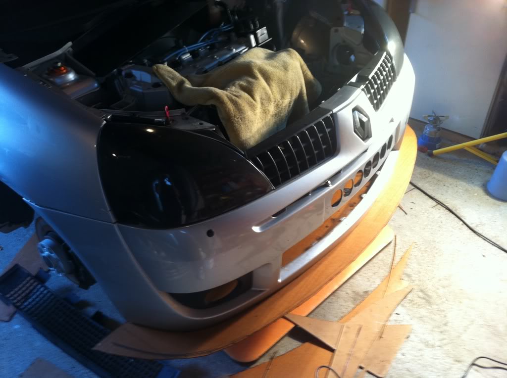

So then I trimmed the bits so the wheels didn't catch on it.

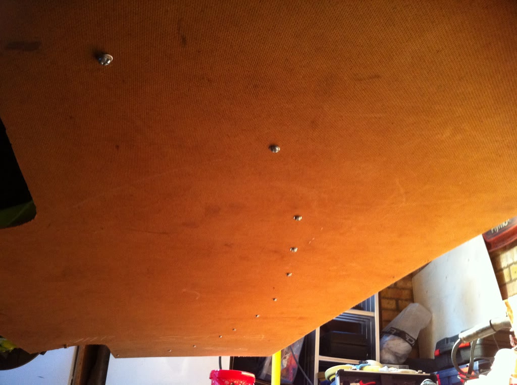

Then I attached it to the subframe
And then attached it to the bumper
So not it was secure it was ready to trim the curve
Trimmed a bit
I then removed it ready for painting

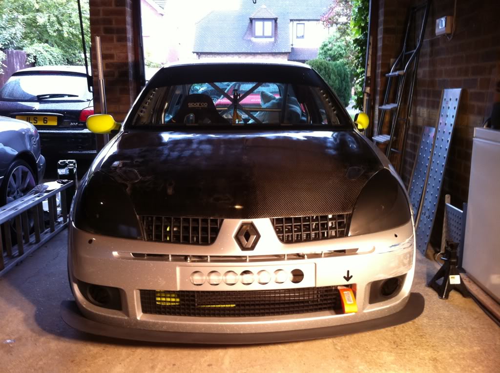

Bit of spray paint
And then refitted I'm not 100% sure about the size of the lip or about the ends of the splitter as I think they should be cut flat but it will do for now until I decide.
  172/1.2/E30
I think it would look better if the outer edges were flush with the bumper. Isn´t there a splitter by Mark Fish that looks similar?
  TrackCar & F30 330d
Question is will it catch fire like the top gear one :rasp:
It doesn't touch the sump but I still might put a little bit of heat shield on the floor it so it doesn't catch fire lol
Yes that exactly what I was thinking but I didn't want to rush into it and cut it off and it look rubbish! Might do it tomorrow :)
Mr Fish did make one out of metal but the lip was only about an inch and someone else on here had a huge carbon one which had a lip which was about a foot!

No good for Tin Tops Mark,standard profile only.
Haha, Mark is like the kid in the sweet shop and your the dad saying he's not allowed anything!
I suppose you could still have it as a flat floor but with no lip. Would still aid the airflow.
It cost me nothing which is why I did it :)
