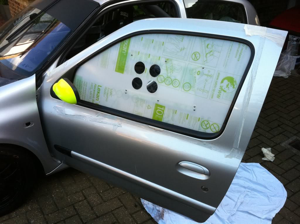

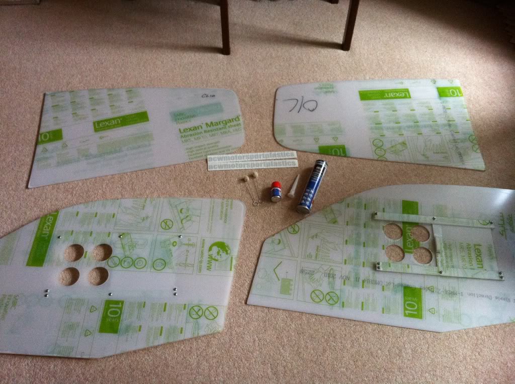

My new Lexan Margard windows from ACW Motorsport Plastics arrived today, i'm very impressed with the quality of the windows and for £254 its an amazing price :)
A few facts for you that you might like to know.
Standard front windows weigh just under 5kg each and my new Lexan front windows with sliders weigh 2.4 kg.
Not had chance to weigh the standard rear windows but the Lexan rears weigh 1.5 kg each.
I'll fit them as soon as i get a free moment :)

myself and tony were talking about attaching the rears to get them flat....
i was think put on a load of bond on the car, let this go off, then apply another lot and apply the window, the earlier coating that has gone off will then act as the spacer...

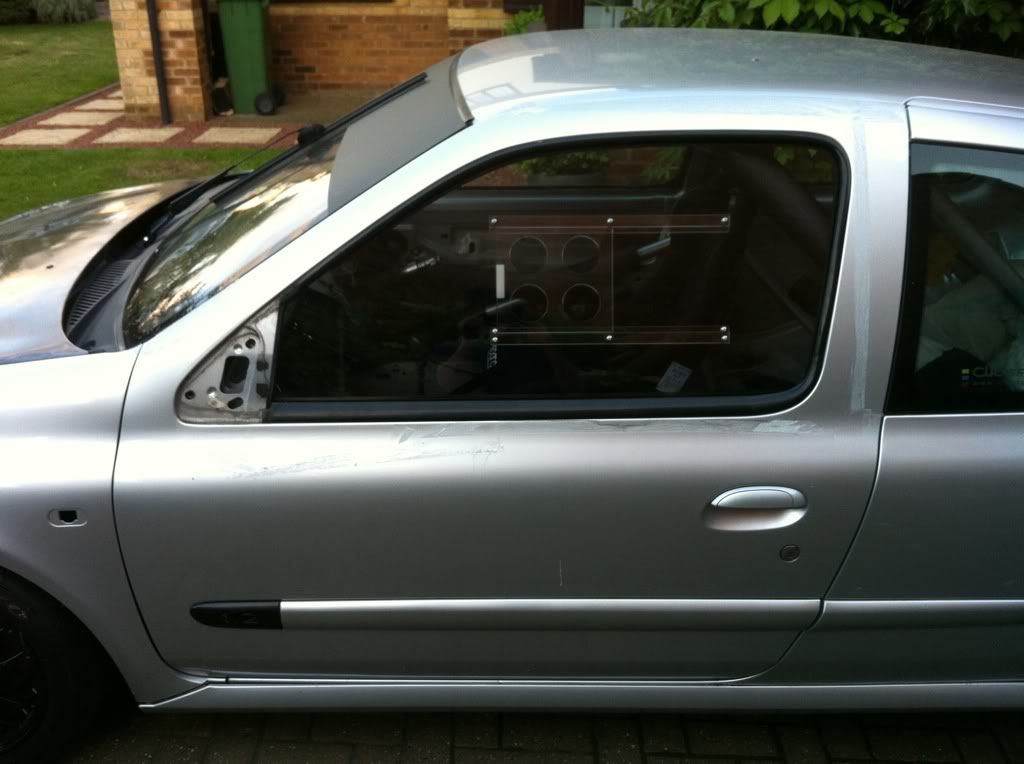

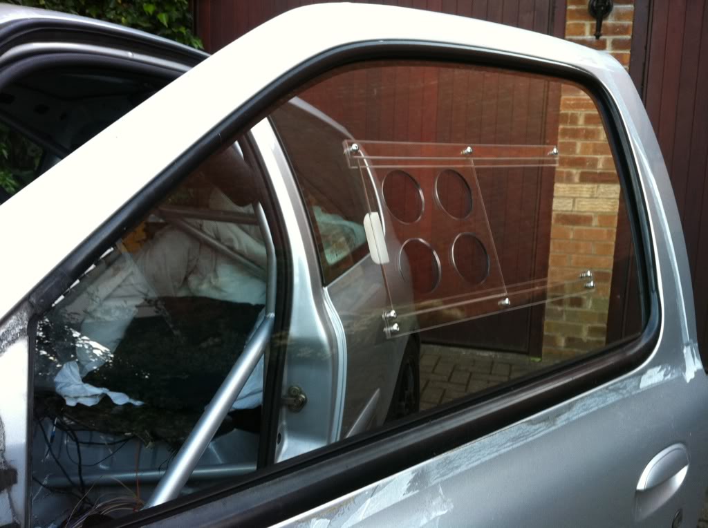

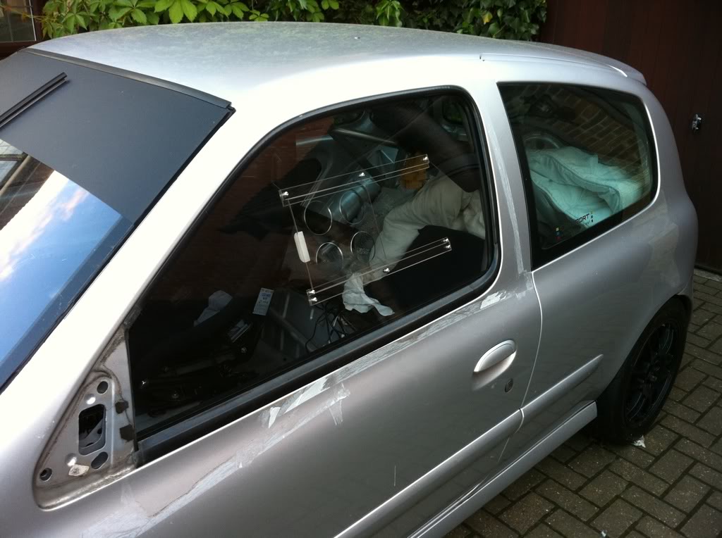

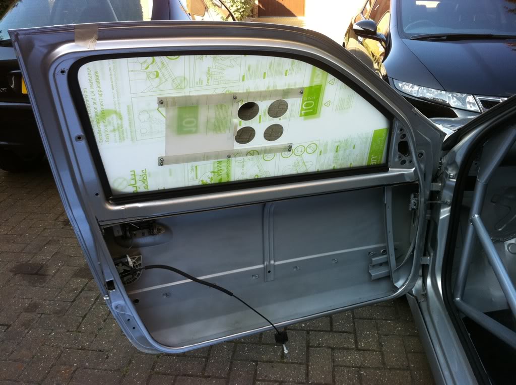

Have been really busy recently so i havnt been able to really do much on the car, but this evening i fitted my passenger side window. I really struggled to decide where to screw the self tappers into.
I first slotted the window in through the top of the door for a trial fit.
Allthough these windows are not thermoformed they fit very well and dont have big gaps like i thought they might have.
After making sure the window was nice and snug i removed it and took it inside to dismantal and wax up.
So here's some pics of that window in :)
Very pleased with how it looks and fits, 1 down 4 to go lol

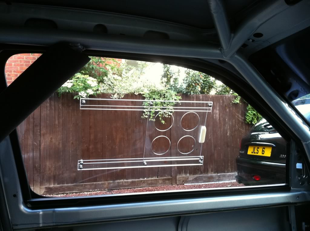

I've saved 10kg from each door by removing the window motors inner door skins and bracing and changing from glass to plastic! I was very pleased with that weight saving!

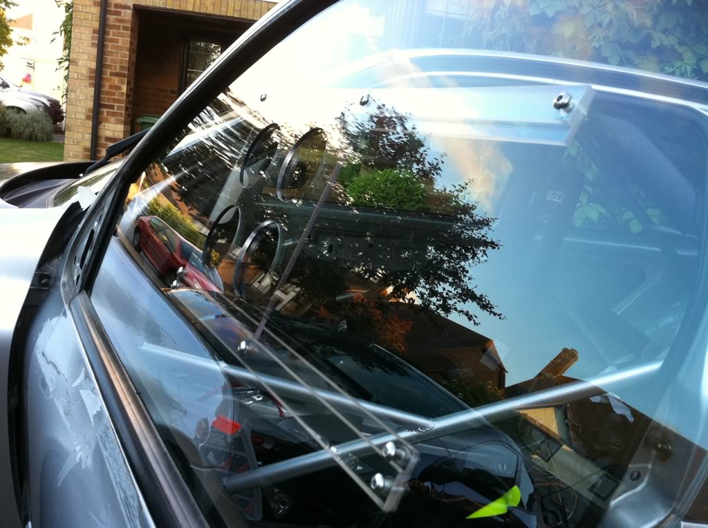

Cutting a long post short I fitted the drivers side window yesterday and re fitted my single wiper ready to be re wired to my new switch board
good work again chris, windows look good in there.
i can't help but think i have left too much in my doors when i look at yours, i left mine in there so the interior door handles have something to mount too.... how are yours going in?
