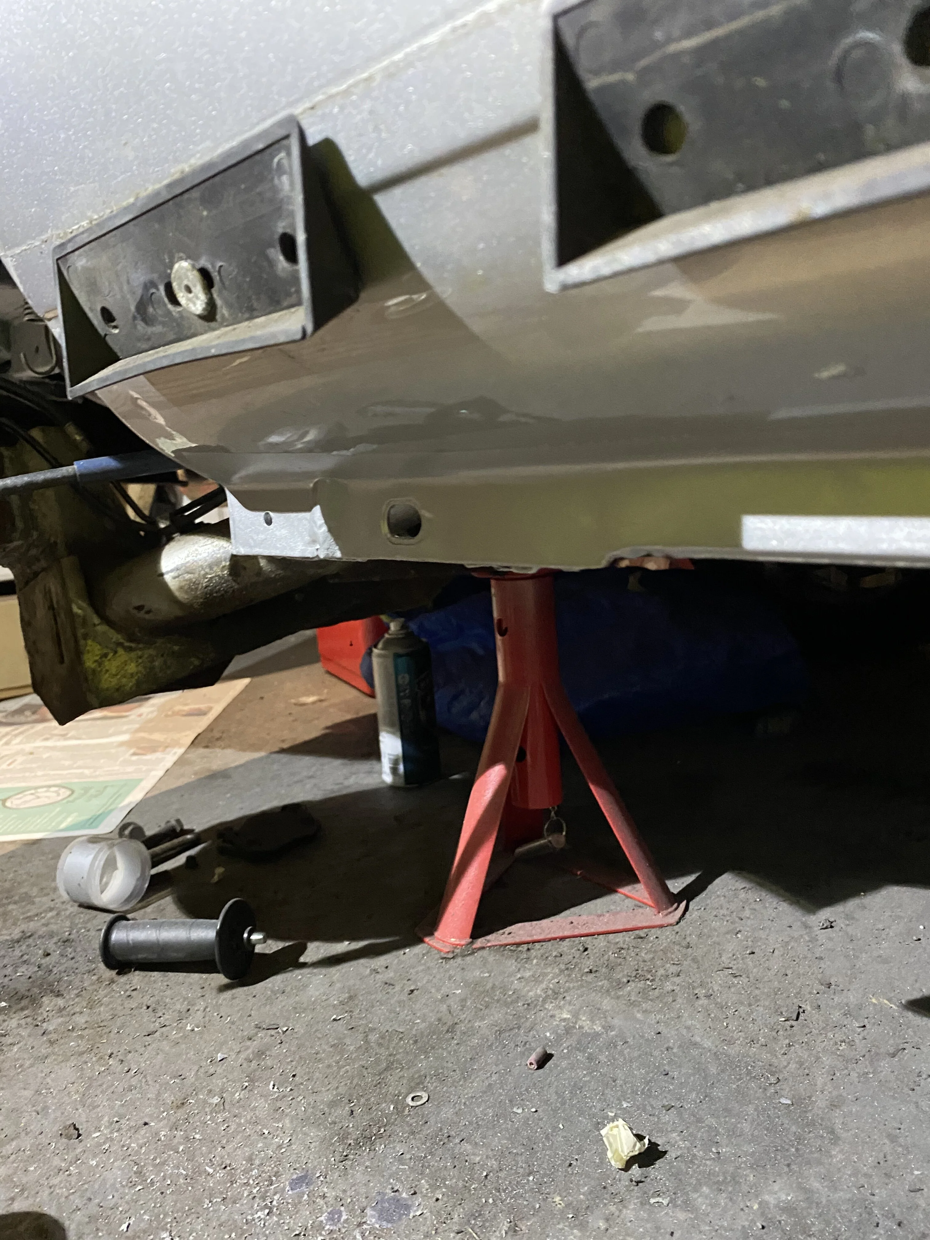

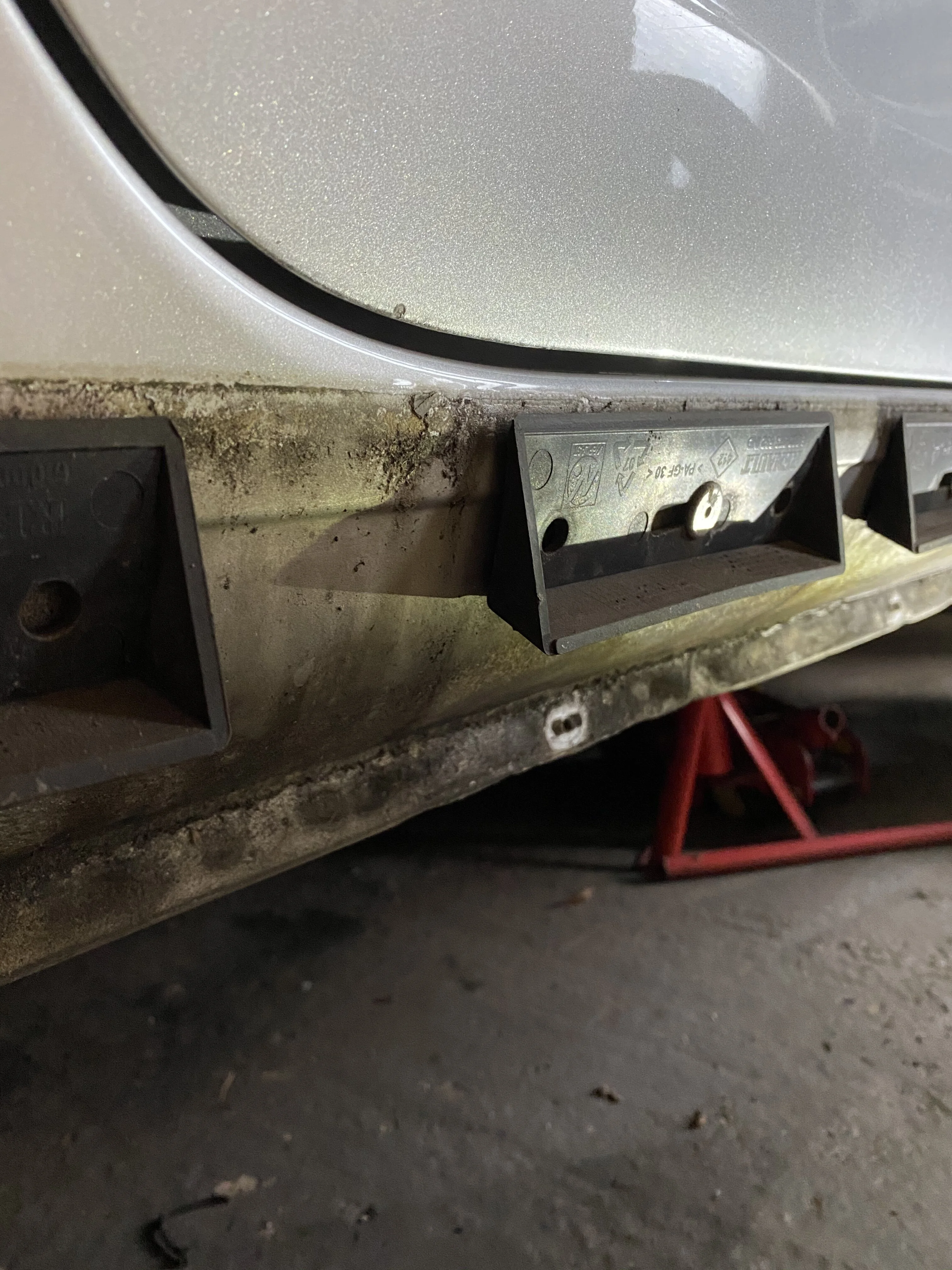

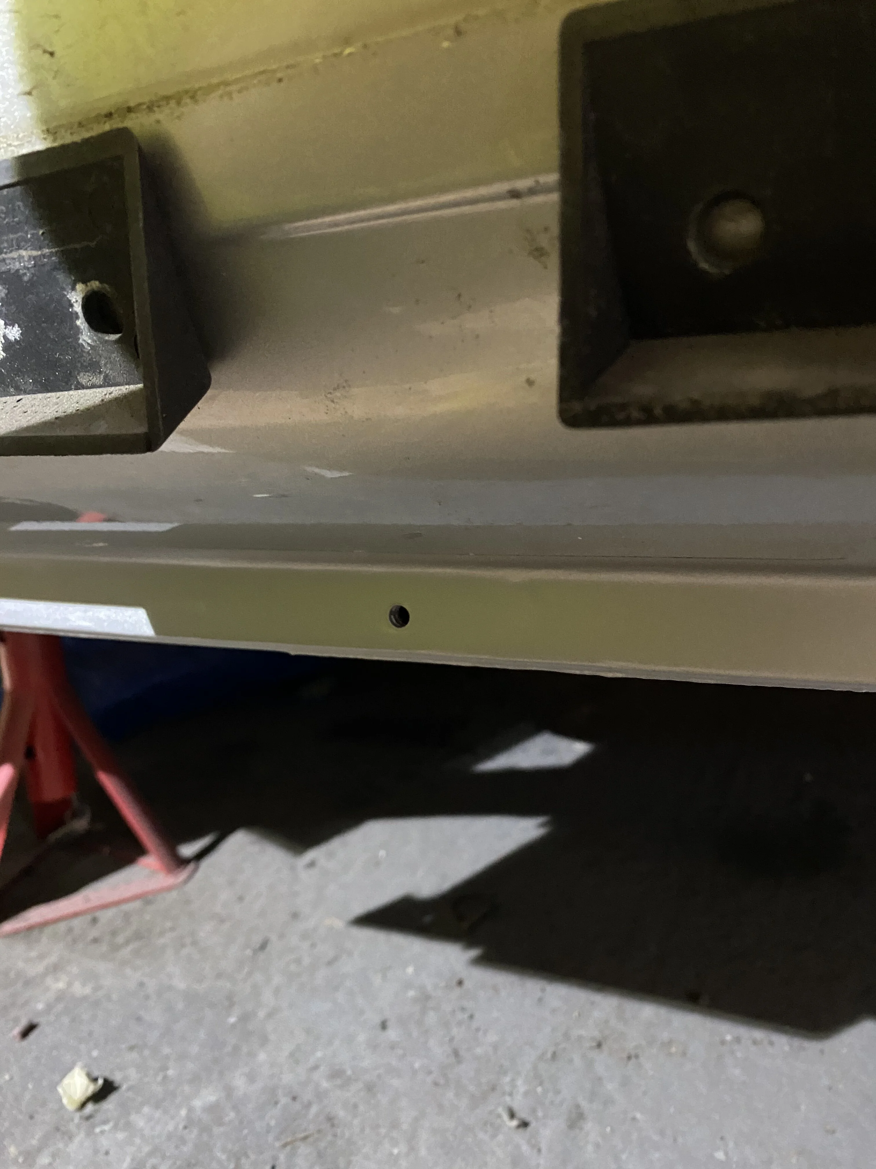

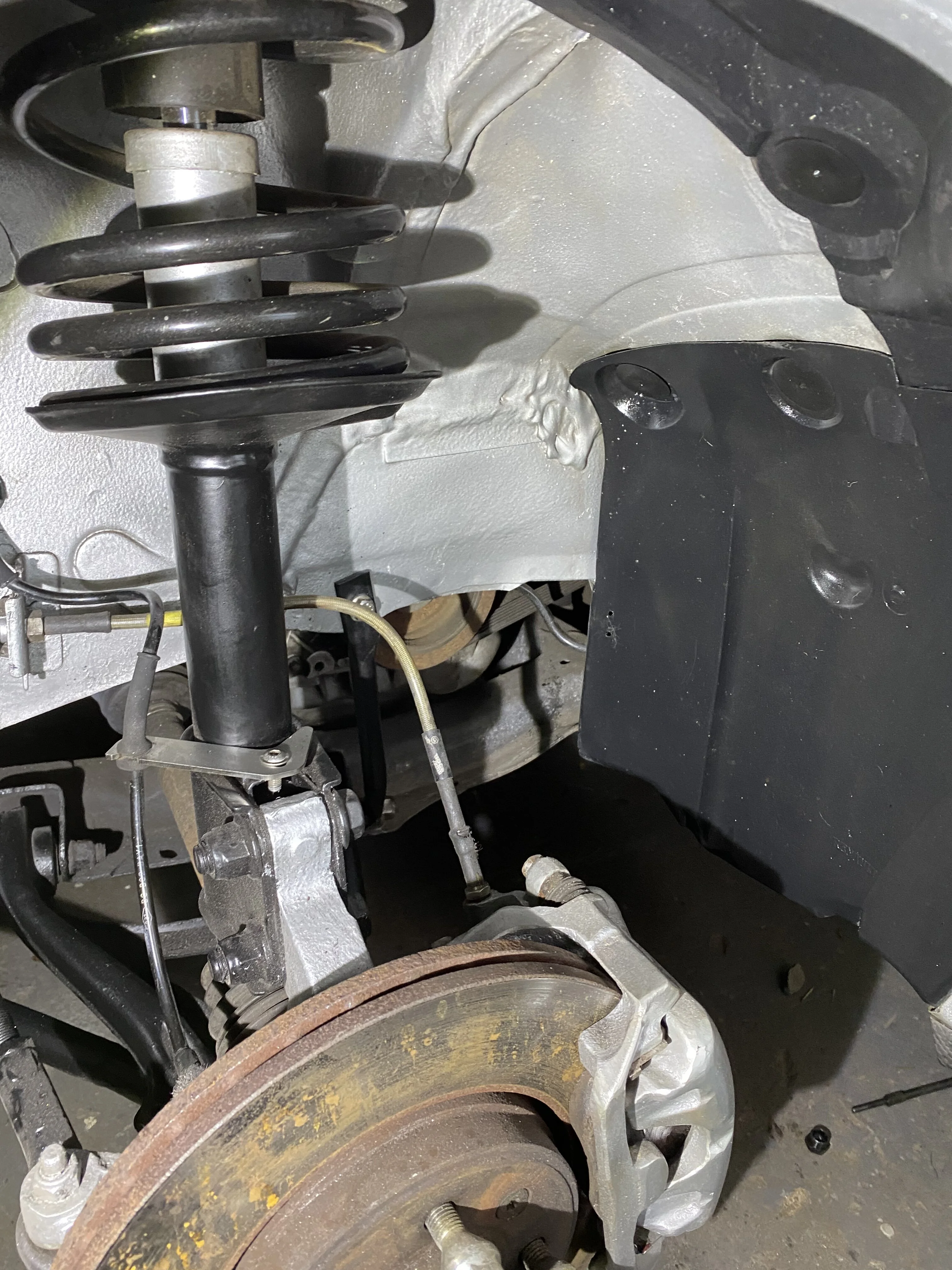

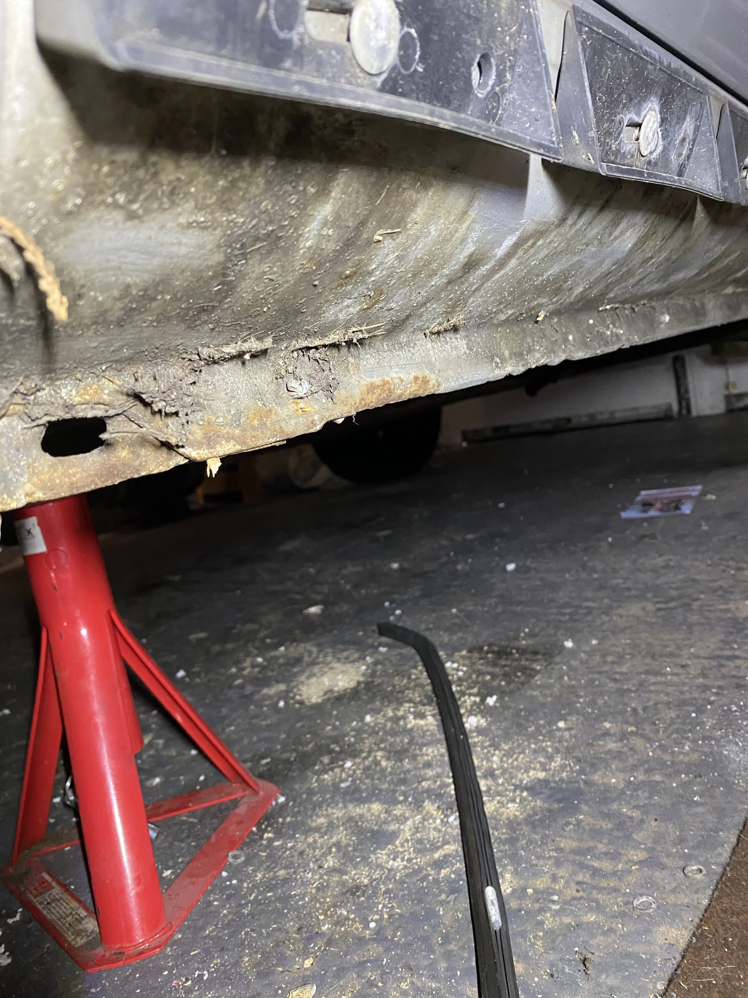

So sill next, having already completed the passenger side, time to tackle the drivers side. I’m pretty luck with the jacking points on this car. They are not perfect but much better than the last car.

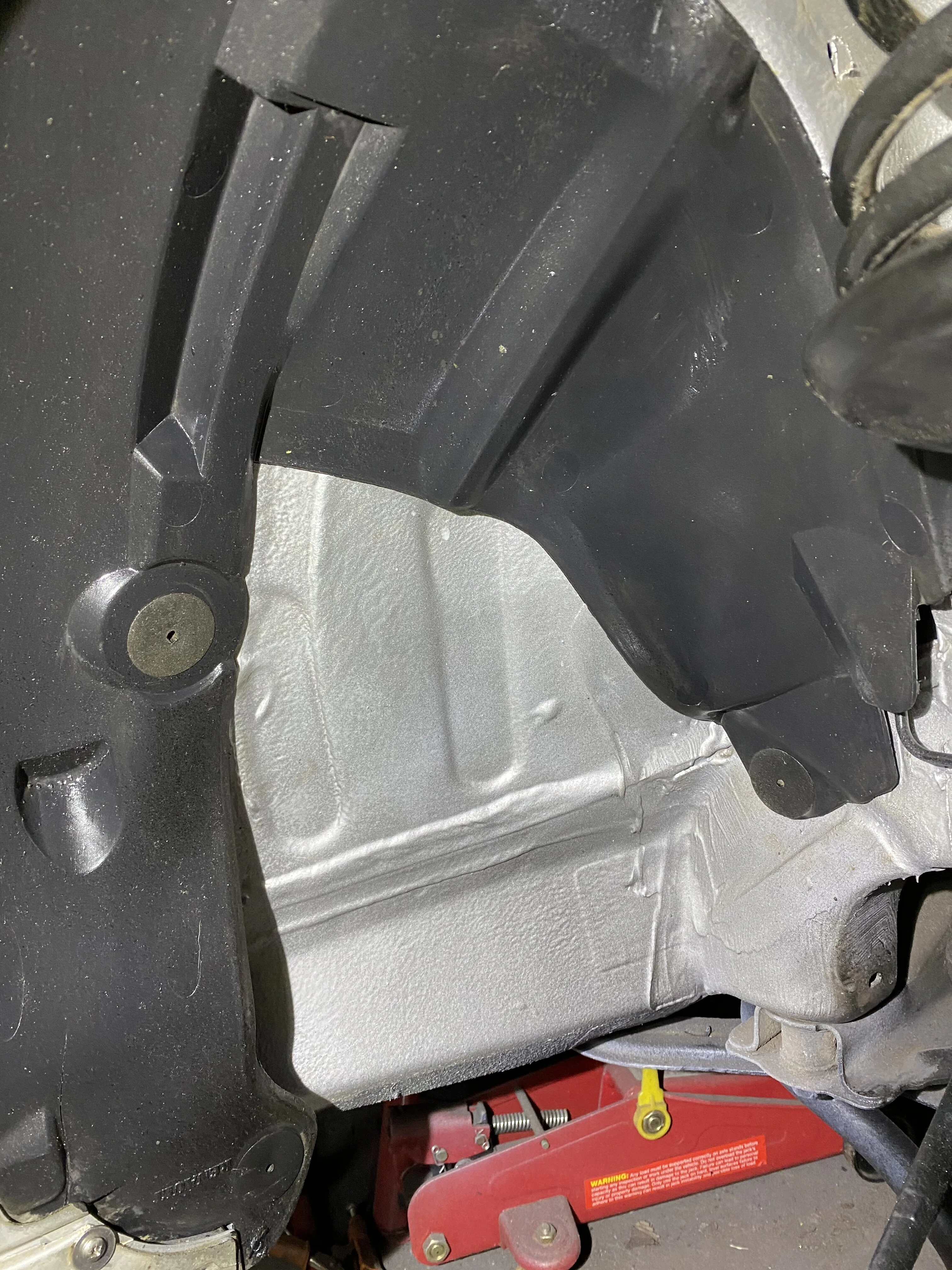

As you will see from earlier posts the front wheel arch and sill had plenty of surface corrosion. Again all sorted with my best mate the angle grinder with the flap disc.
Once treated and painted I laid a layer of clear waxoil to prevent any future corrosion issues. Pretty happy with how it all came out to be honest.

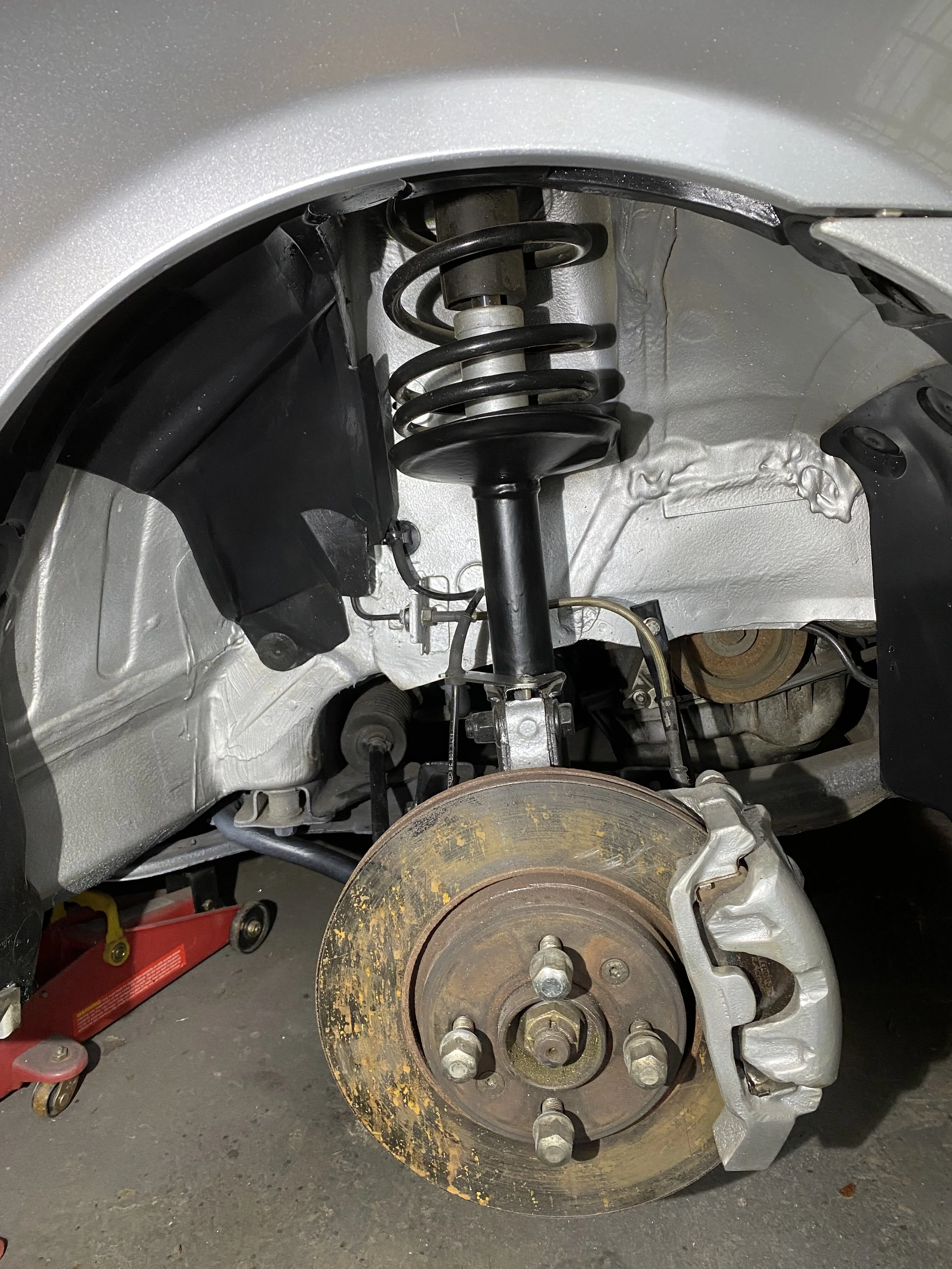

Also finished up the driver side wheel arch. It’s now free from the localised corrosion, which was particularly focused around the arch liner attachment ‘holes’ and the brake line point. Whilst I was there, I tidied up the ARB, fitted the other new stainless ABS sensor bracket. I’m annoyed that the previous owner spent the time sorting polybushes on the inner and outter Arb but didn’t take the time to run down and treat the bar itself. So I did my best tidying up the ends. However I will find another arb at some point and get it blasted before replacing. I may get a new subframe sorted at the same time. More items to add to the ever increasing list!

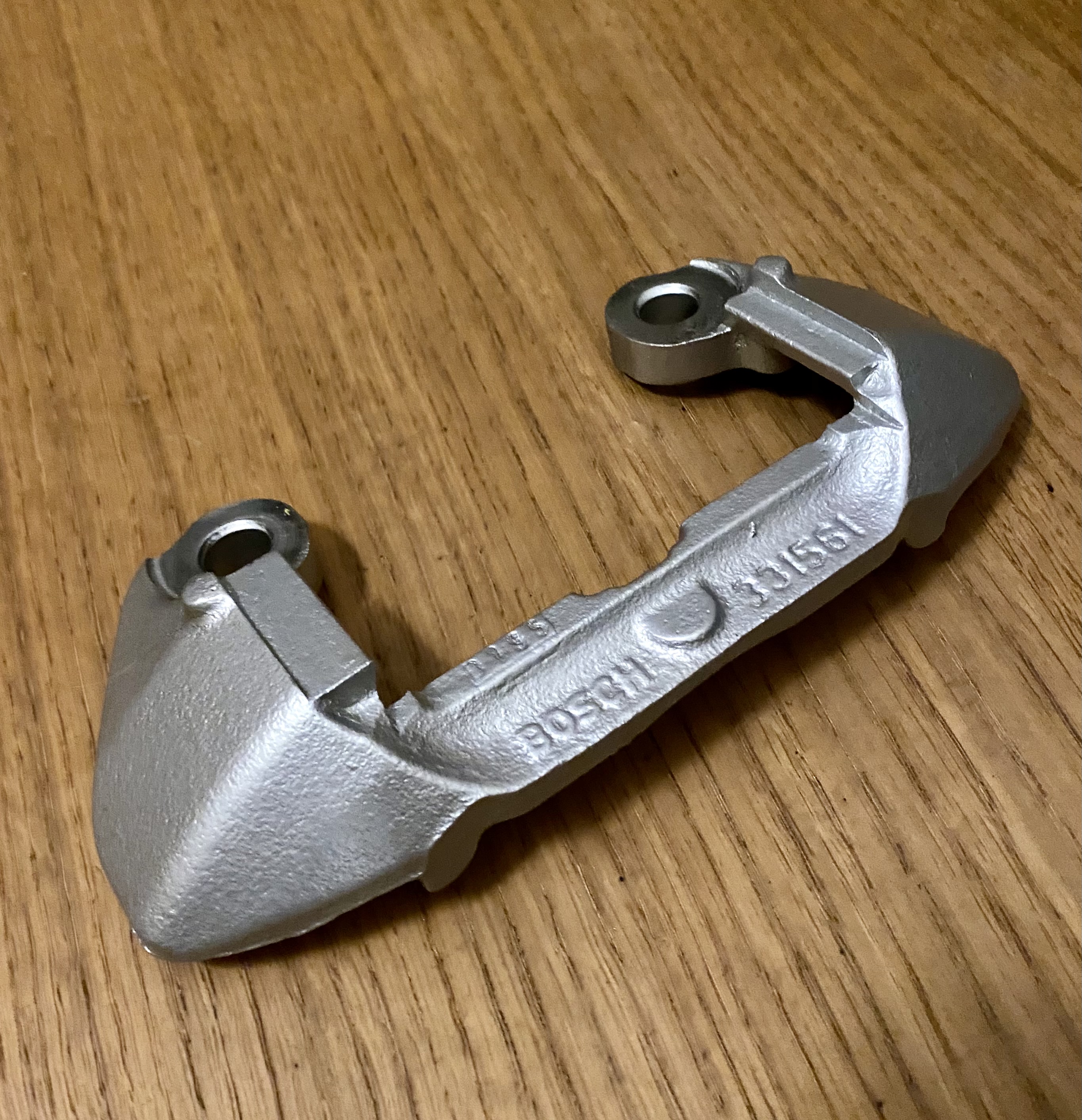

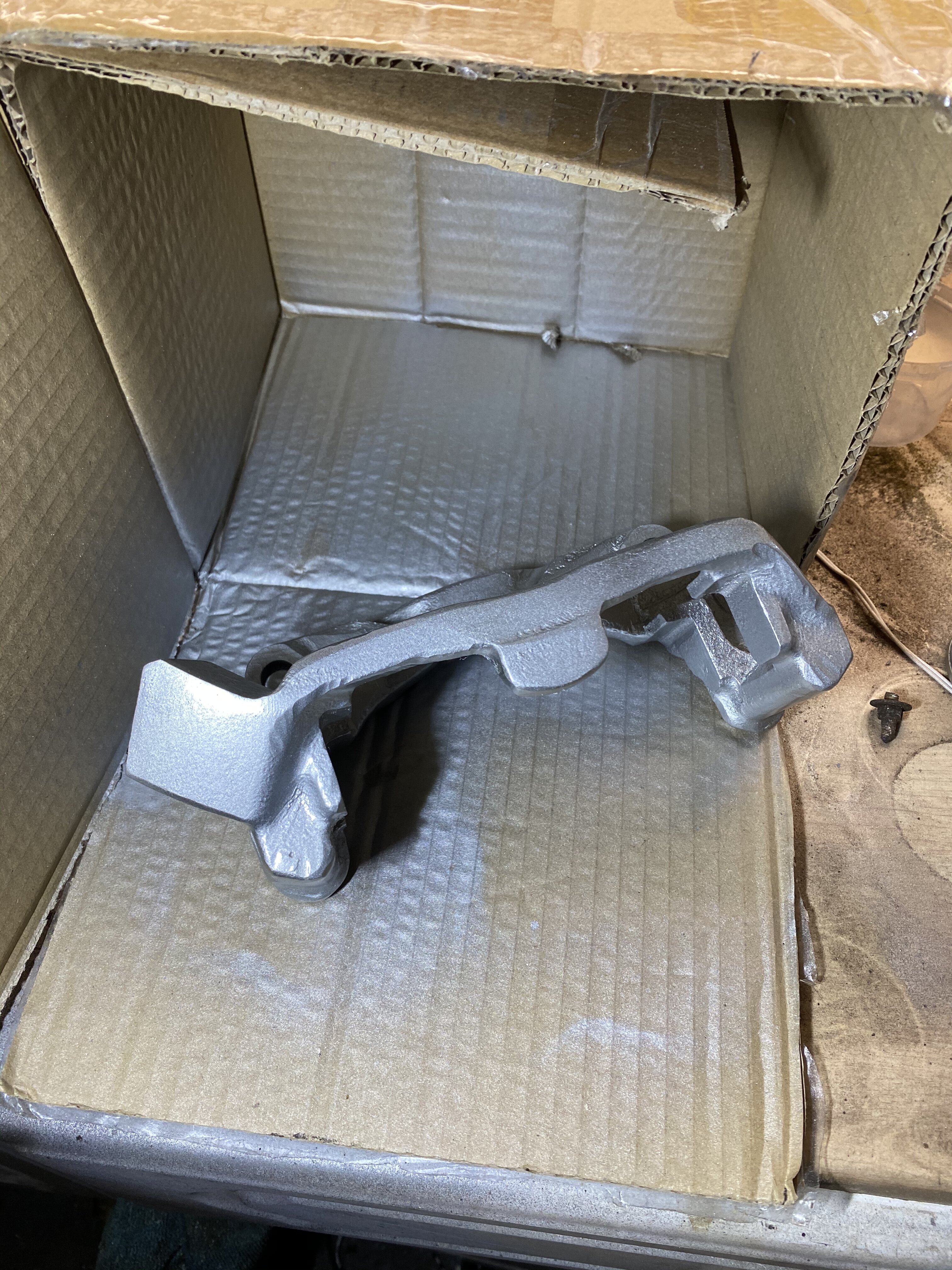

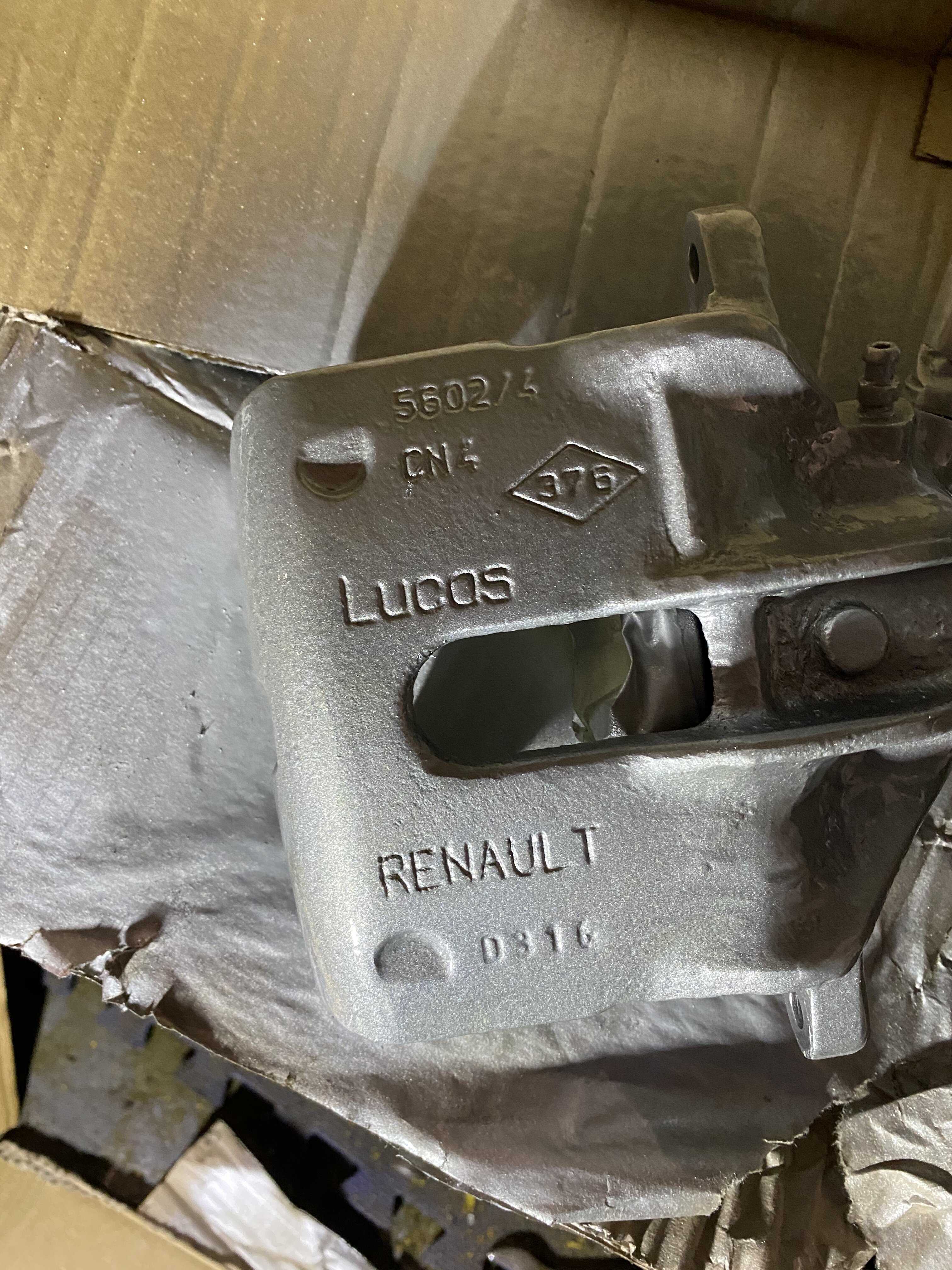

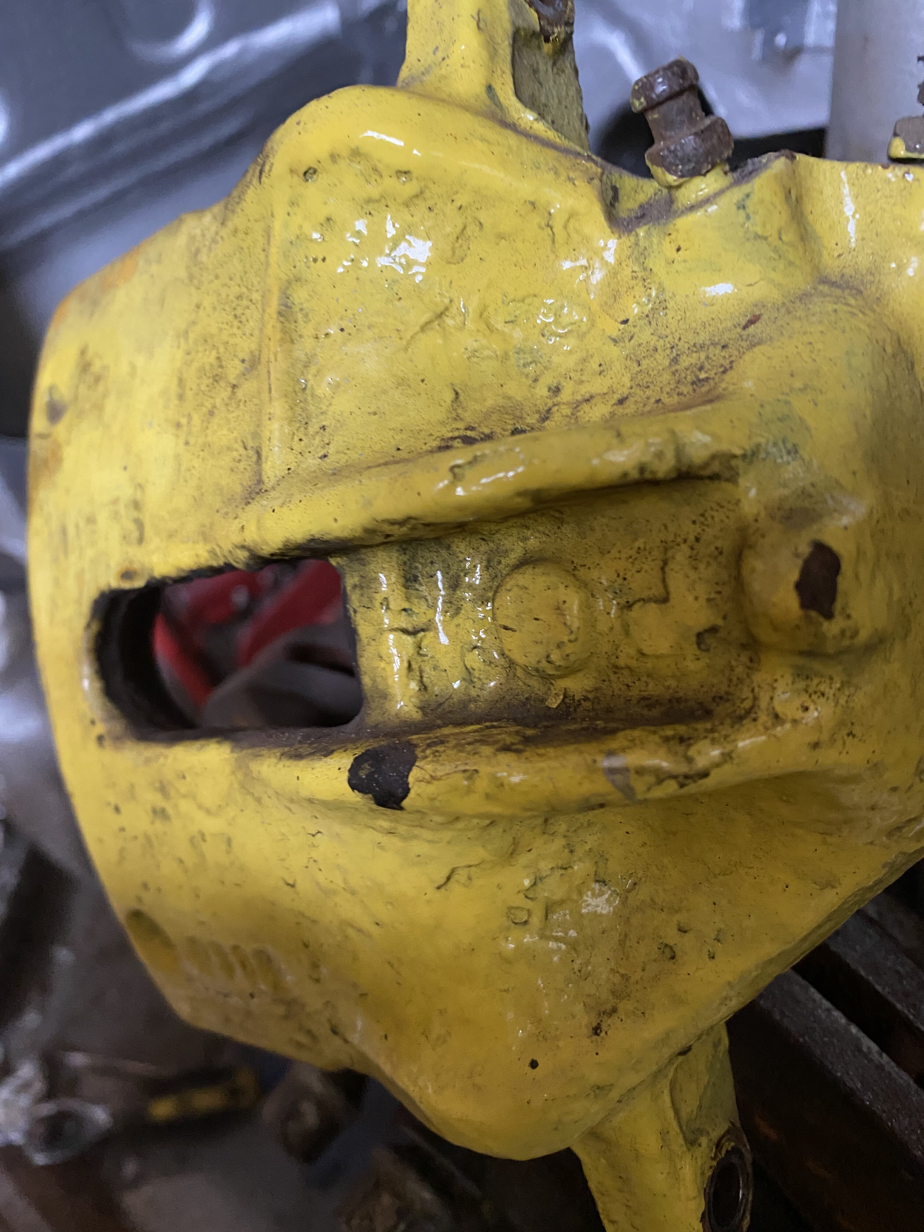

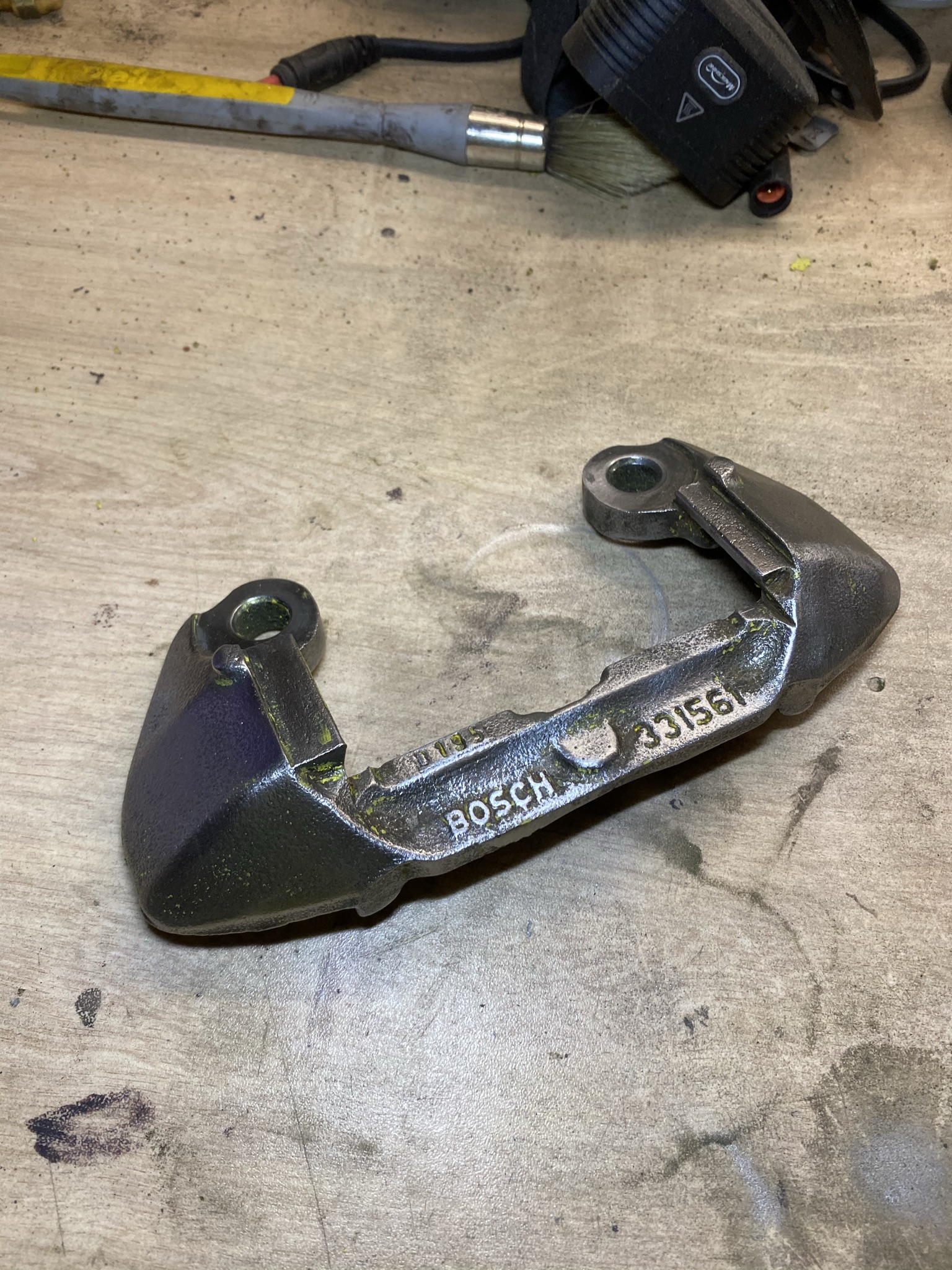

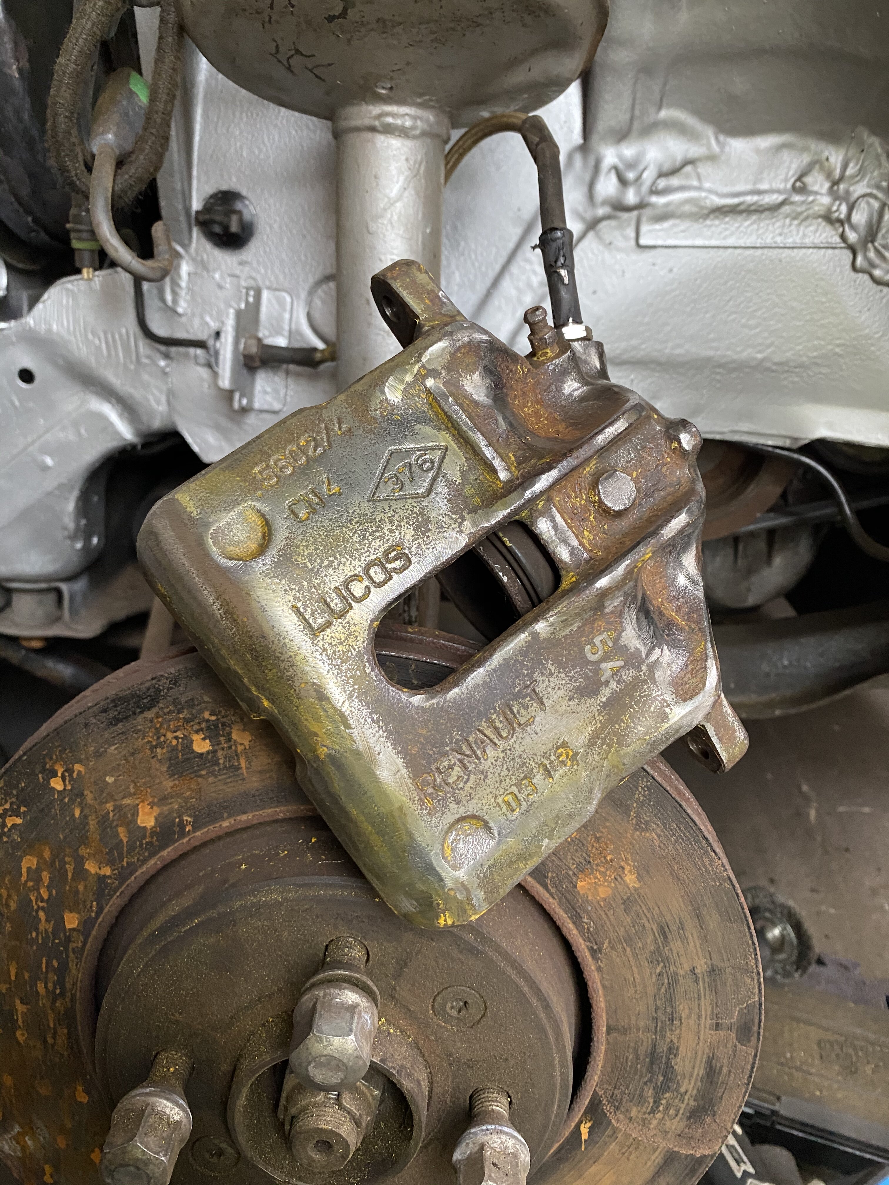

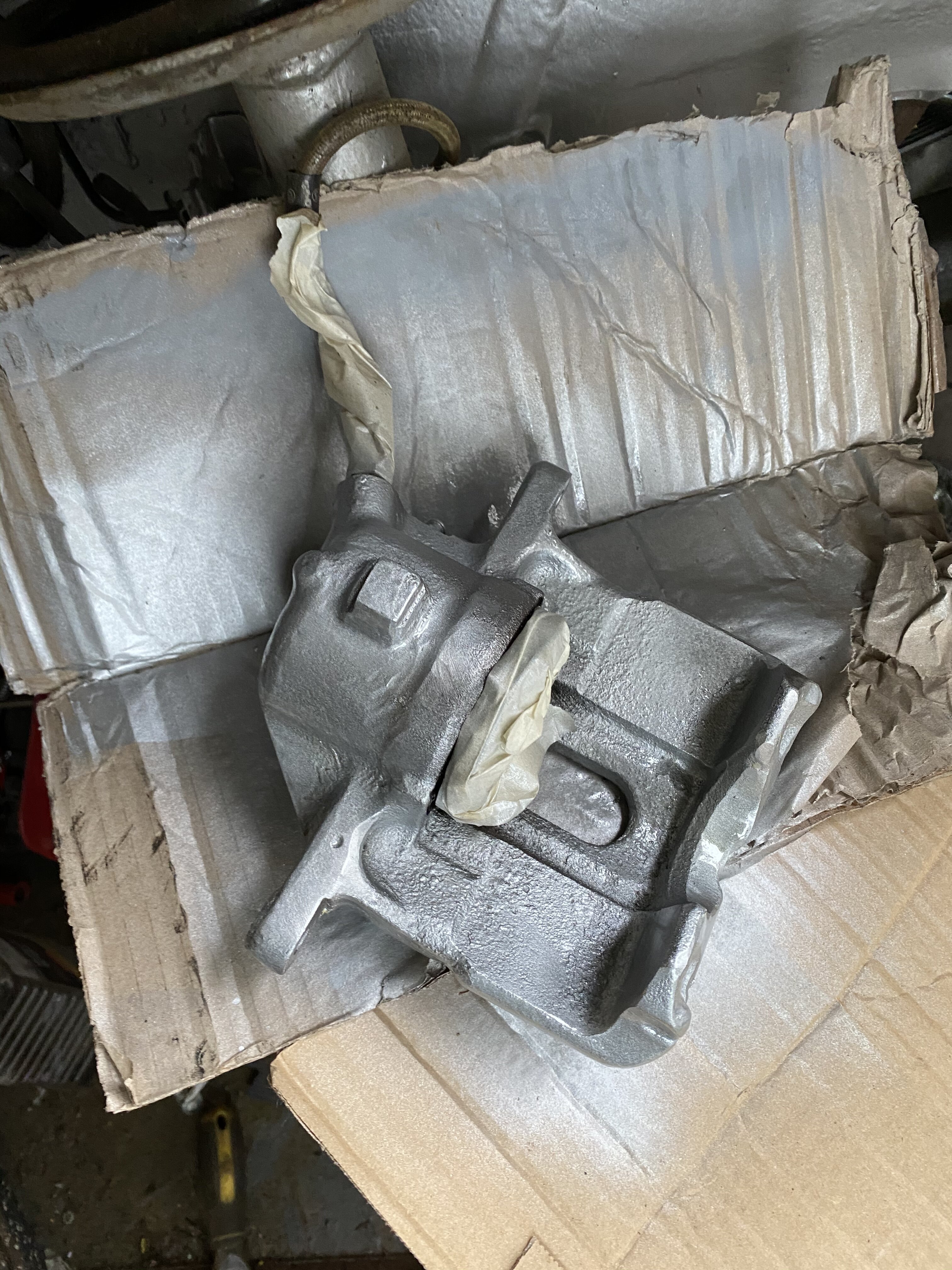

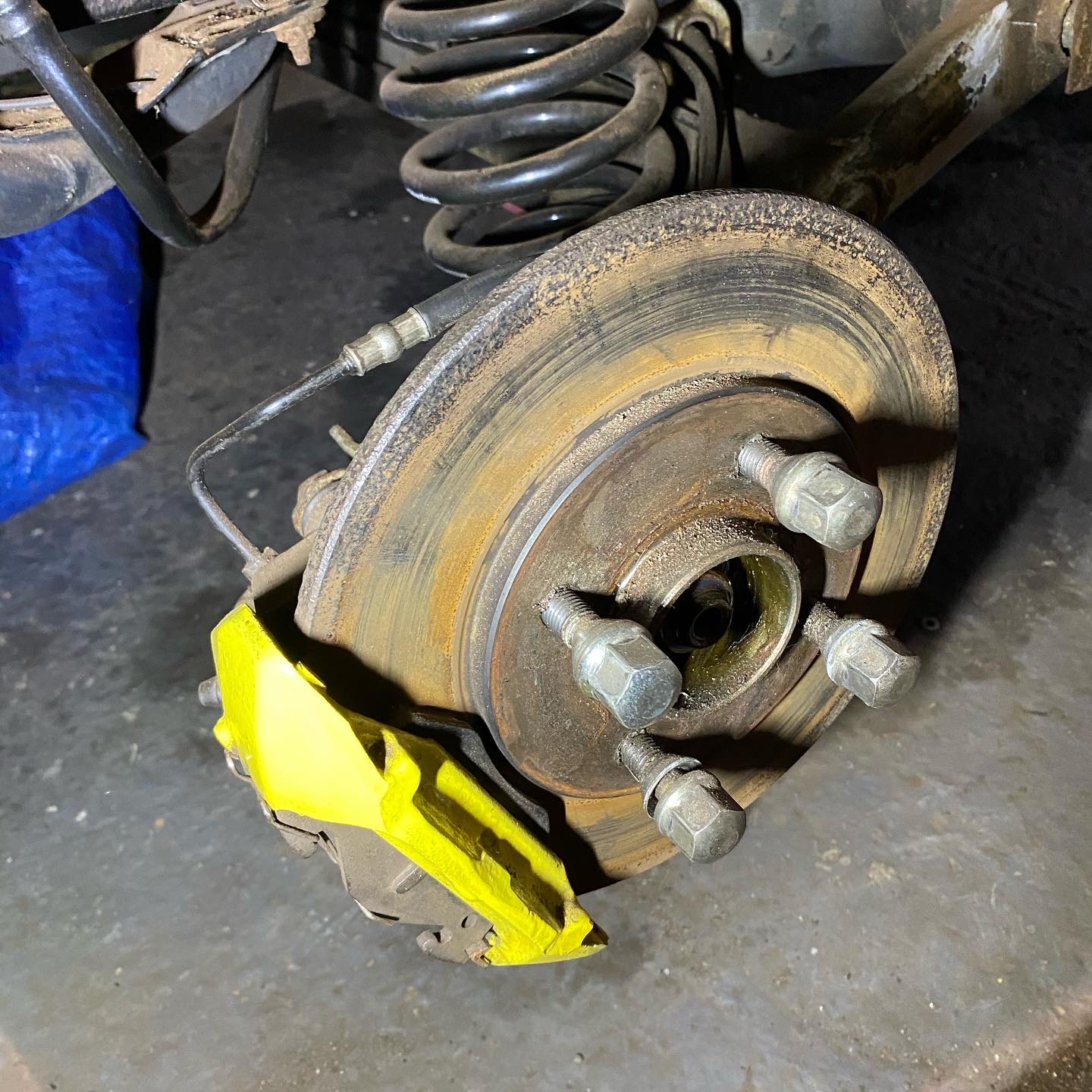

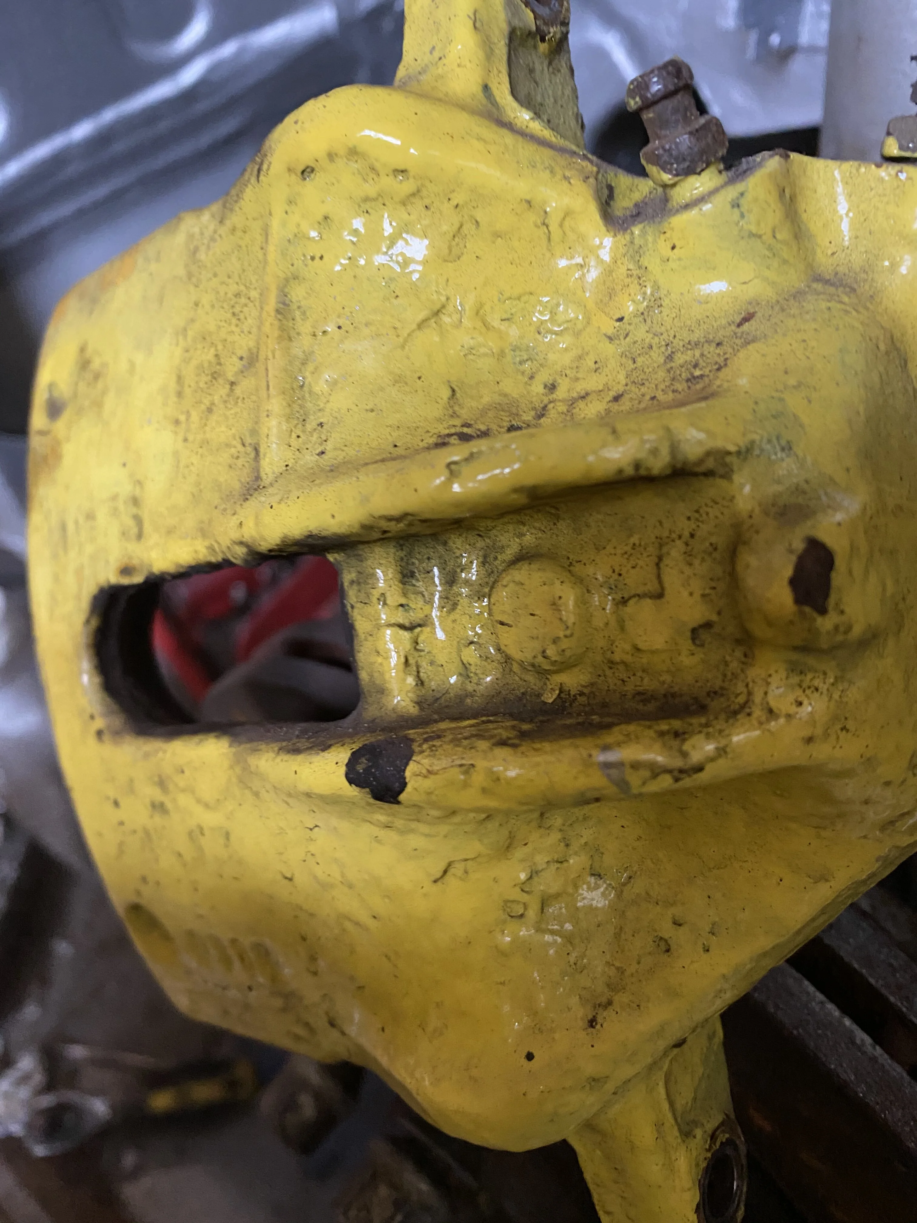

Probably can see from the earlier photos. That I have just about sorted the horrible yellow brake callipers now! (One more to go)
ideally they needed blasting, but I don’t have a blast cabinet so me old mate the angle grinder and his flappy friend was deployed. With a little help from his little brother the dremel! Ground all the shitty yellow crap off
and then painted with 3 coats of silver calliper paint. I’ll be sorting some new pads and discs in the coming weeks. But will be dropping and refurbing the rear bear soon so it can wait until I have to flush the fluid at the same time

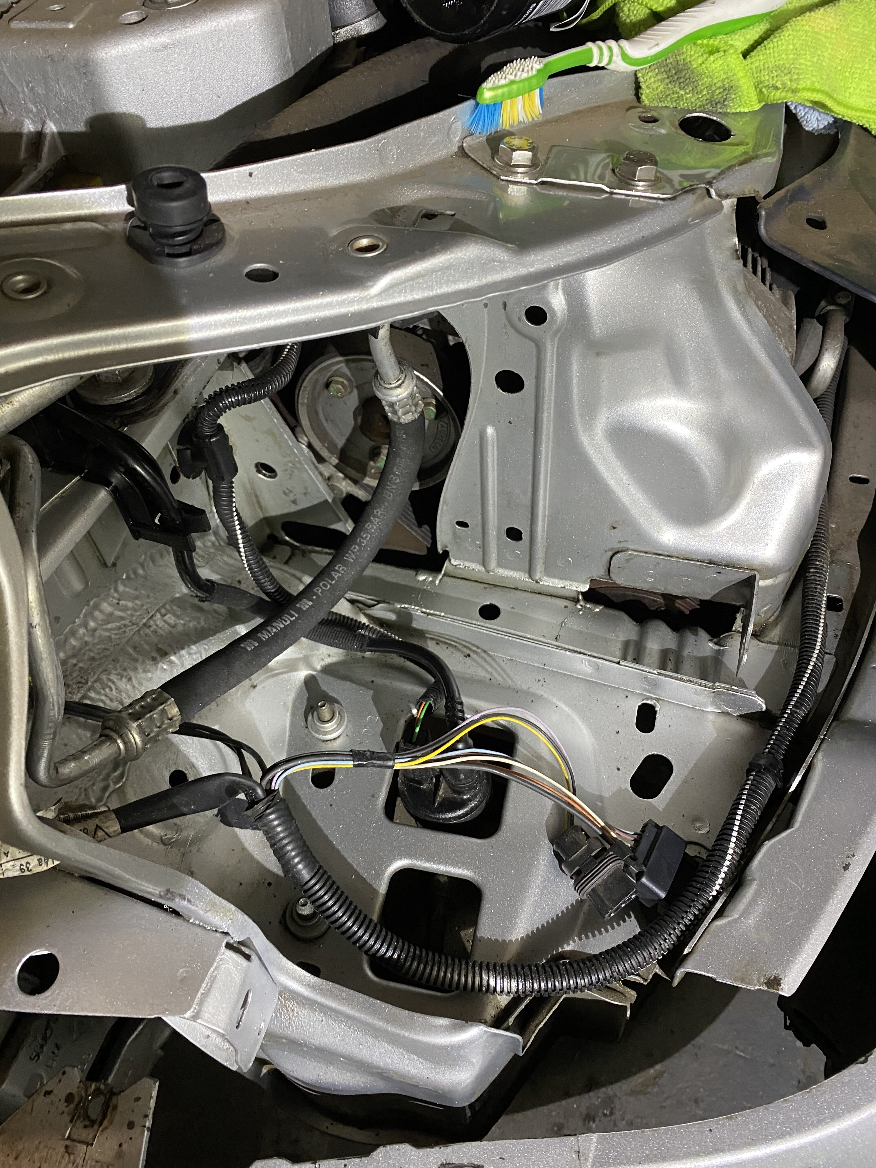

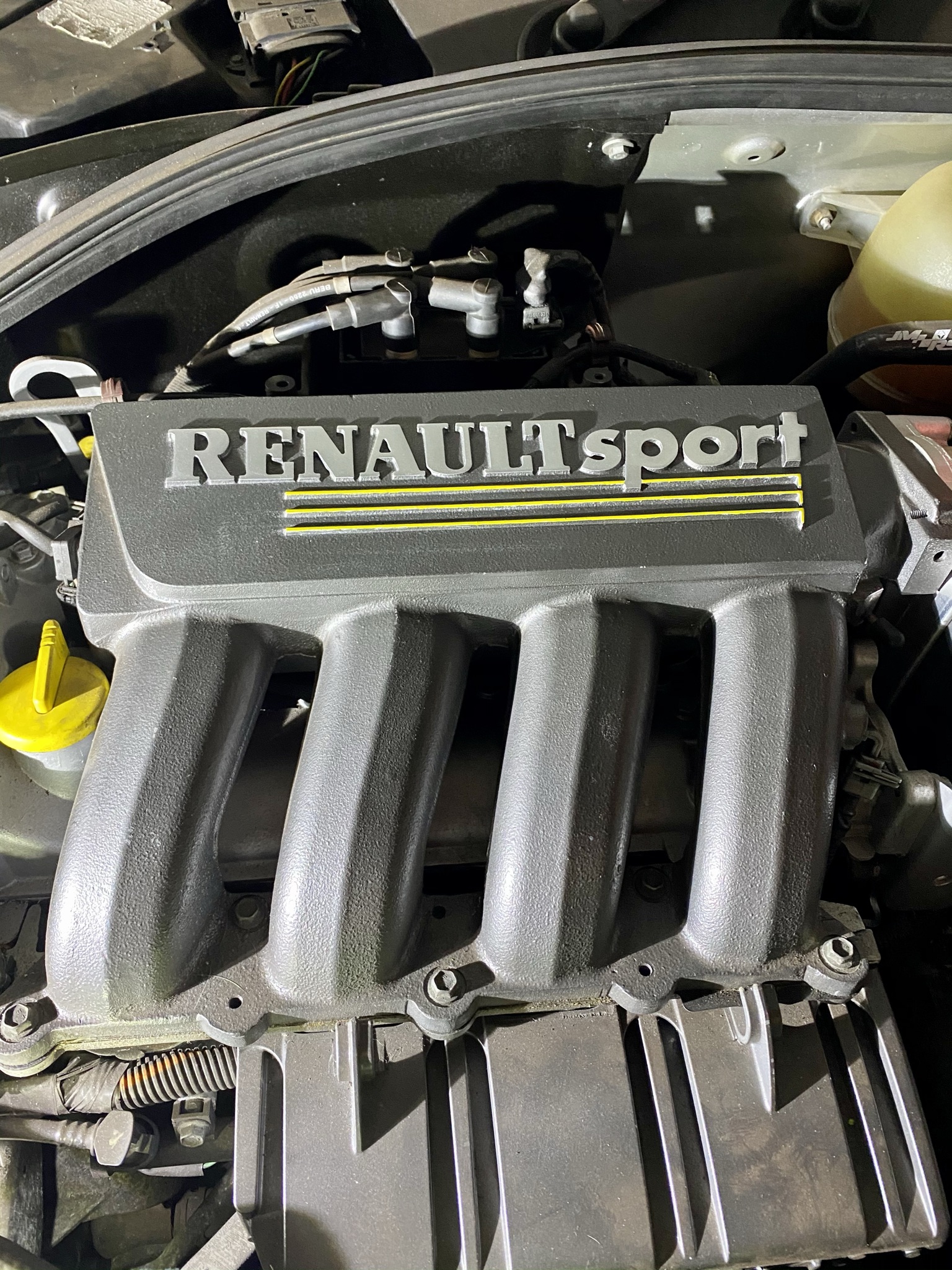

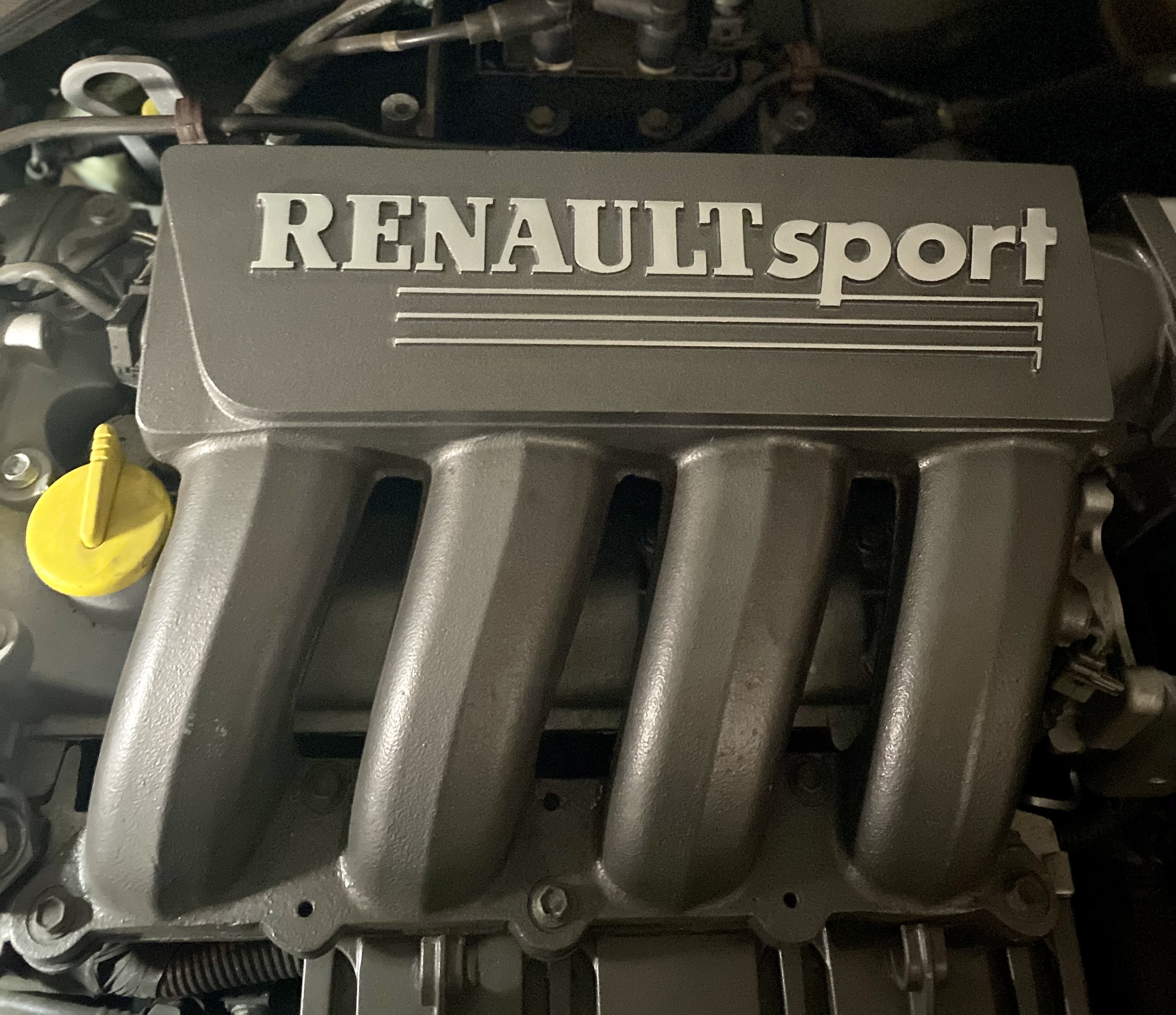

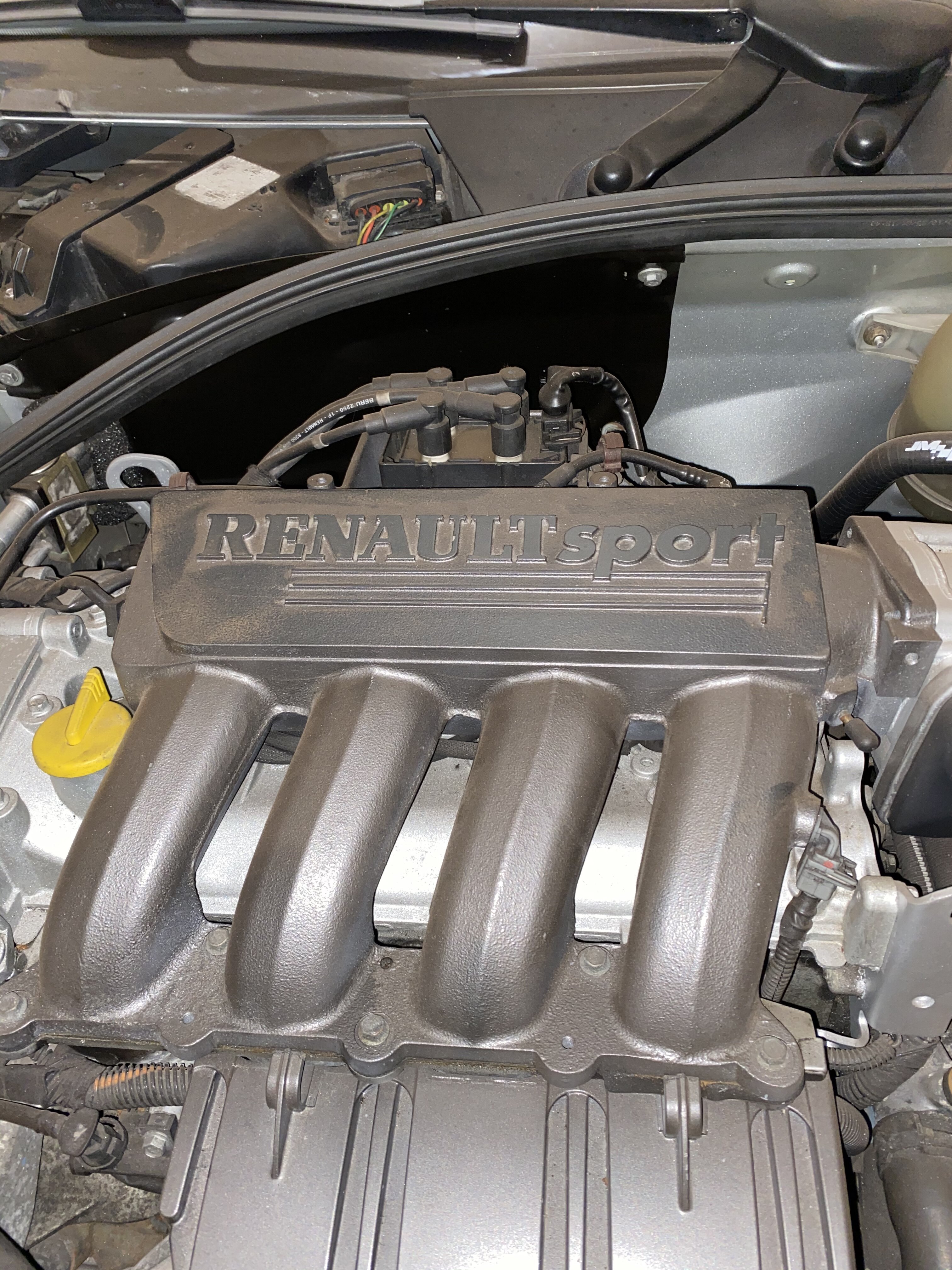

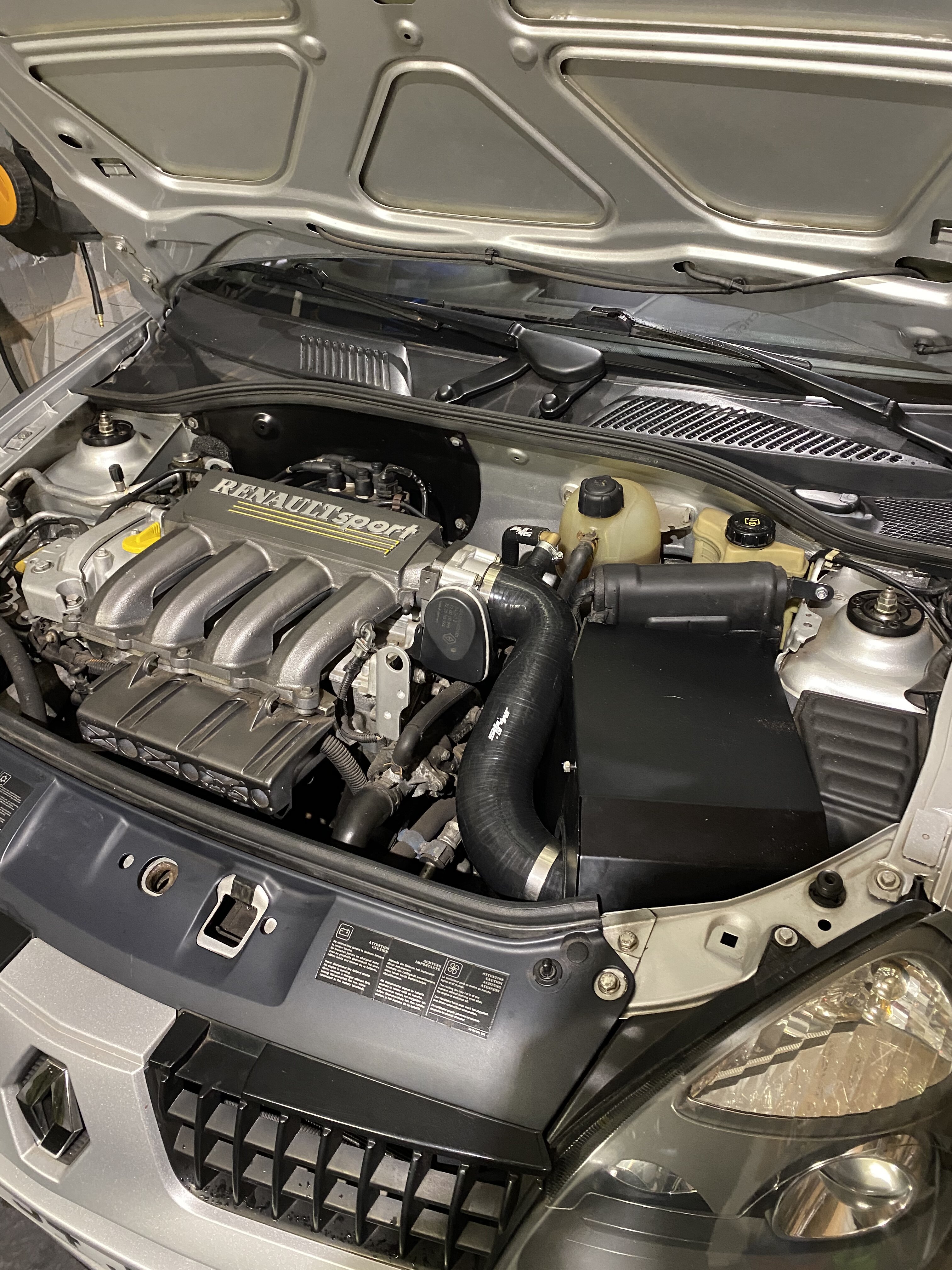

Think the final update for today... I had previously spent some time tidying up under the bonnet. With the front light off the car I cleaned the recess. The car has been extensively covered with some form of protective spunk. A good thing really as it shows someone has cared about it at least once before me. Over the years this has attacked and stuck all sorts of crap. So an hour with white spirits and an old tooth brush had it looking presentable.
I then turned my attention to the plenum. It was finished in Anthracite and was a reasonable job. However boring, I will likely buy a set of ported and refurbished units from MS, but again the list is long so in the meantime I polished up the ‘Renault Sport’ lettering and detailed the lines with yellow enamels. Pretty happy with the look. The engine is absolutely caked in dust currently (as is the inside of the car) as being a complete knob head I left the bonnet and windows open when grinding away brake paint and rust!

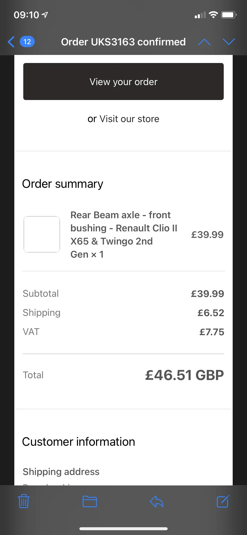

If you’re looking for whiteline rear axle bushes I’ve just purchased a set from driftworks of all places, much cheaper than going to whiteline direct atm:-
Is thats £16 for both? I seem to remover paying around £50 for my last set!!
clio_ross
  Clio 172
Yup. I was sceptical when I order them, but they arrived yesterday and it was the kit containing both bushes. Like you said, bargain compared to the powerflex bushes or even ordering direct from whiteline.
Slowpoke Rodriguez
Bon Jovi Officianado
Ordered £18.11 delivered what an absolute bargain! Thank you. Albeit you have now made me commit to sorting out my rear beam next!
Slowpoke Rodriguez

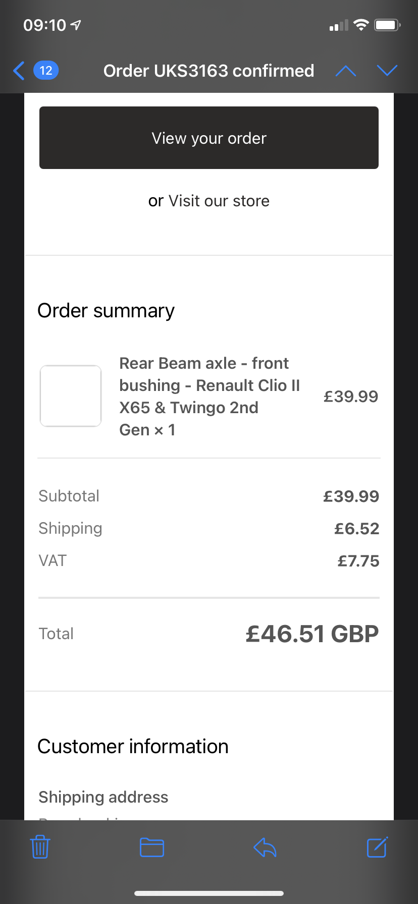

That's surely a mistake, I paid about £50 for mine from KAM
i ordered mine from KAM who them couldn’t get them so went to whiteline U.K. direct and got them a touch cheaper than KAM just found the invoice:
so this is too good an offer to pass up! I initially thought it was for the one side but @clio_ross has received his! So it’s confirmed my next job....time to drop the beam, sort he boot floor rust I can see, snap old bolts. Pick s**t out of my eyeballs and ear holes as I lie underneath a car for weeks in end sorting rust.

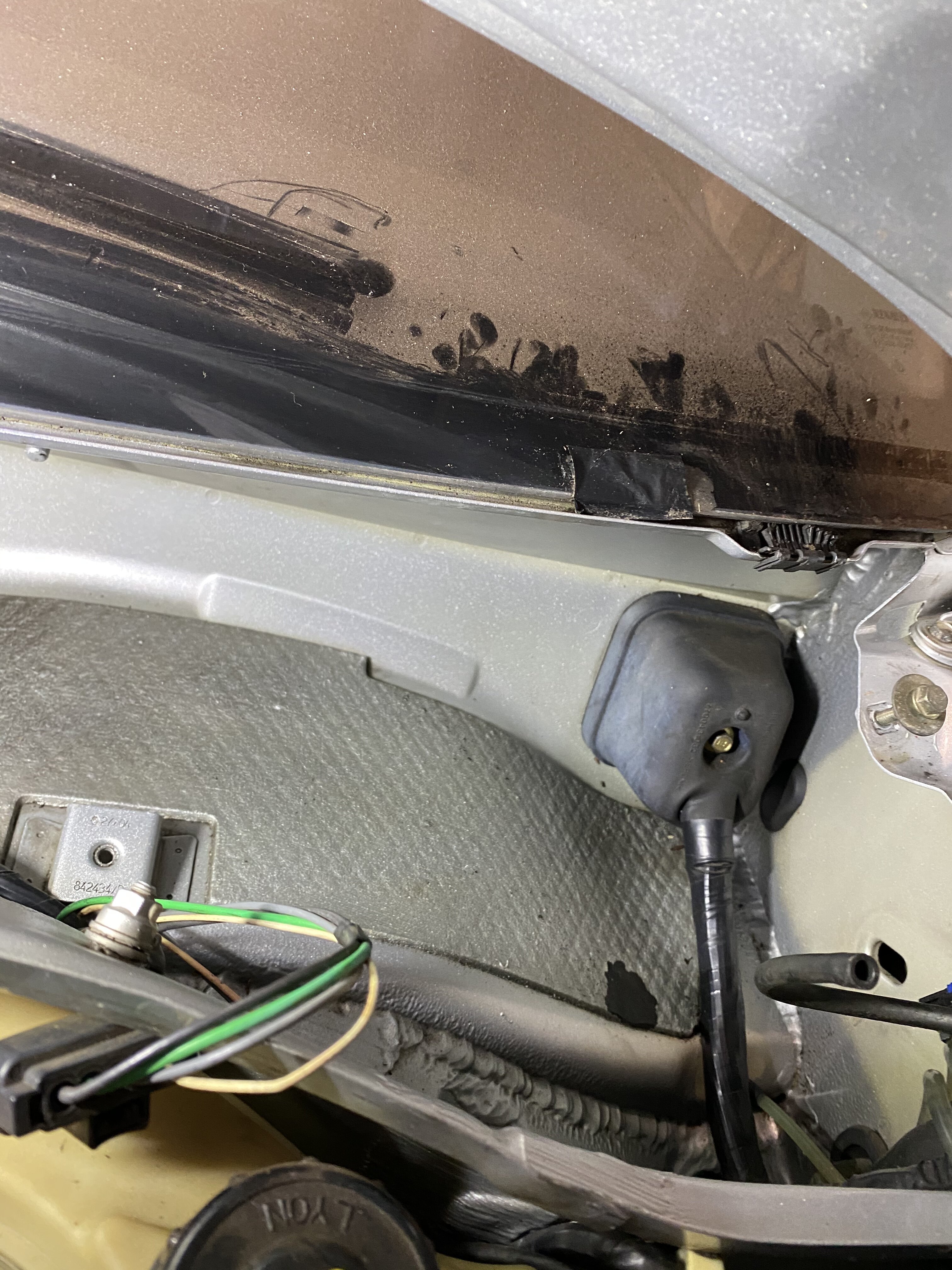

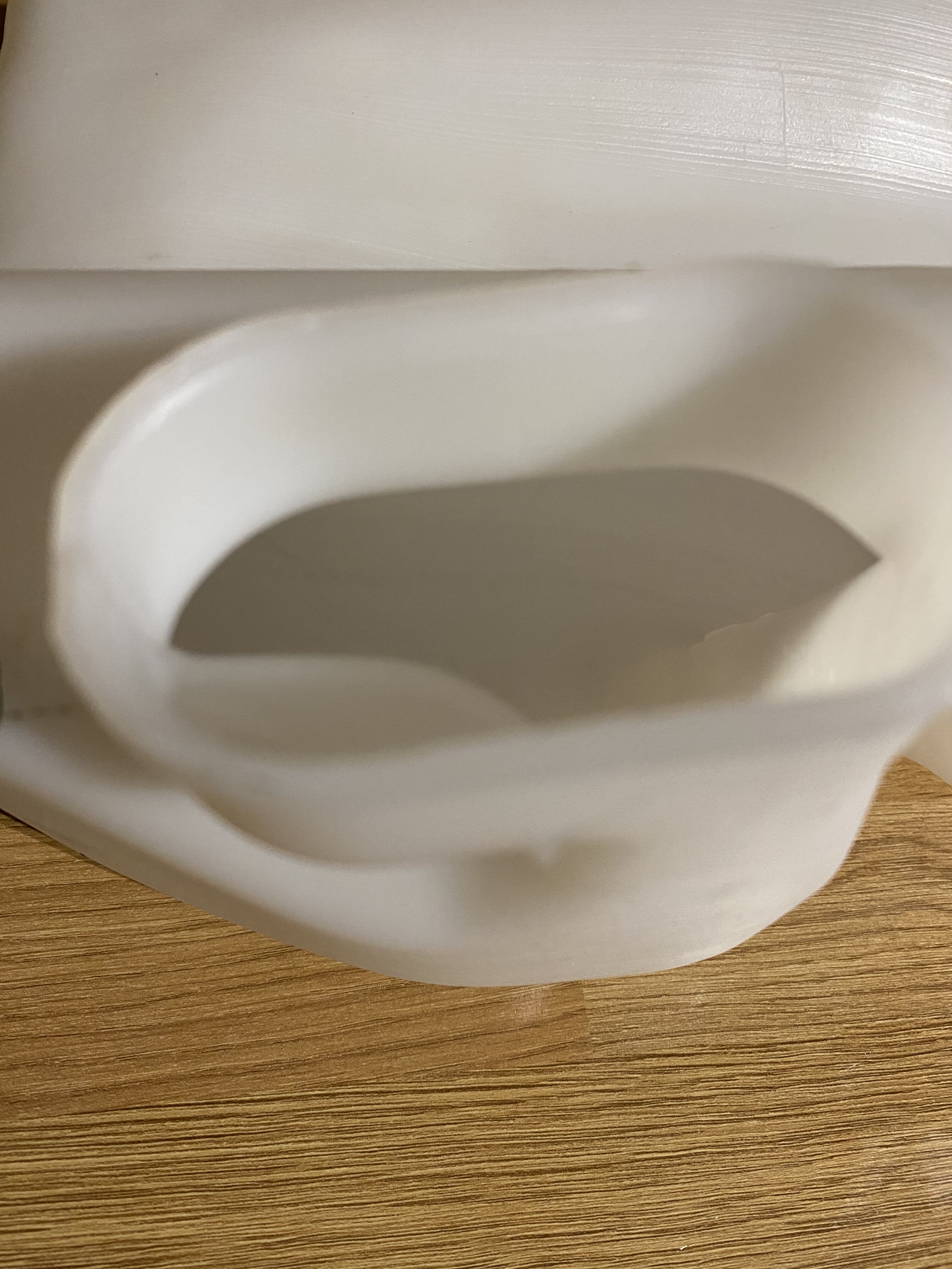

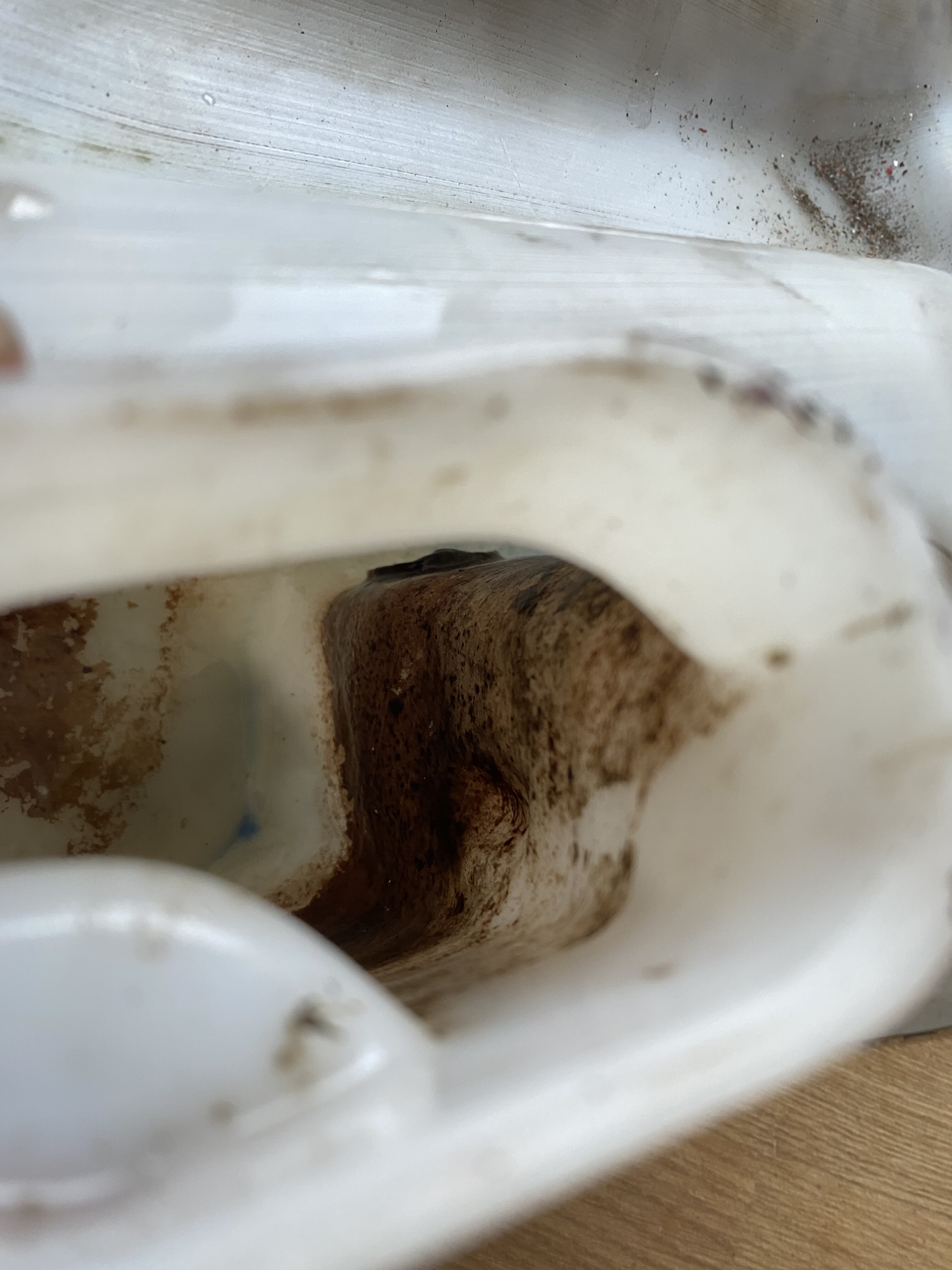

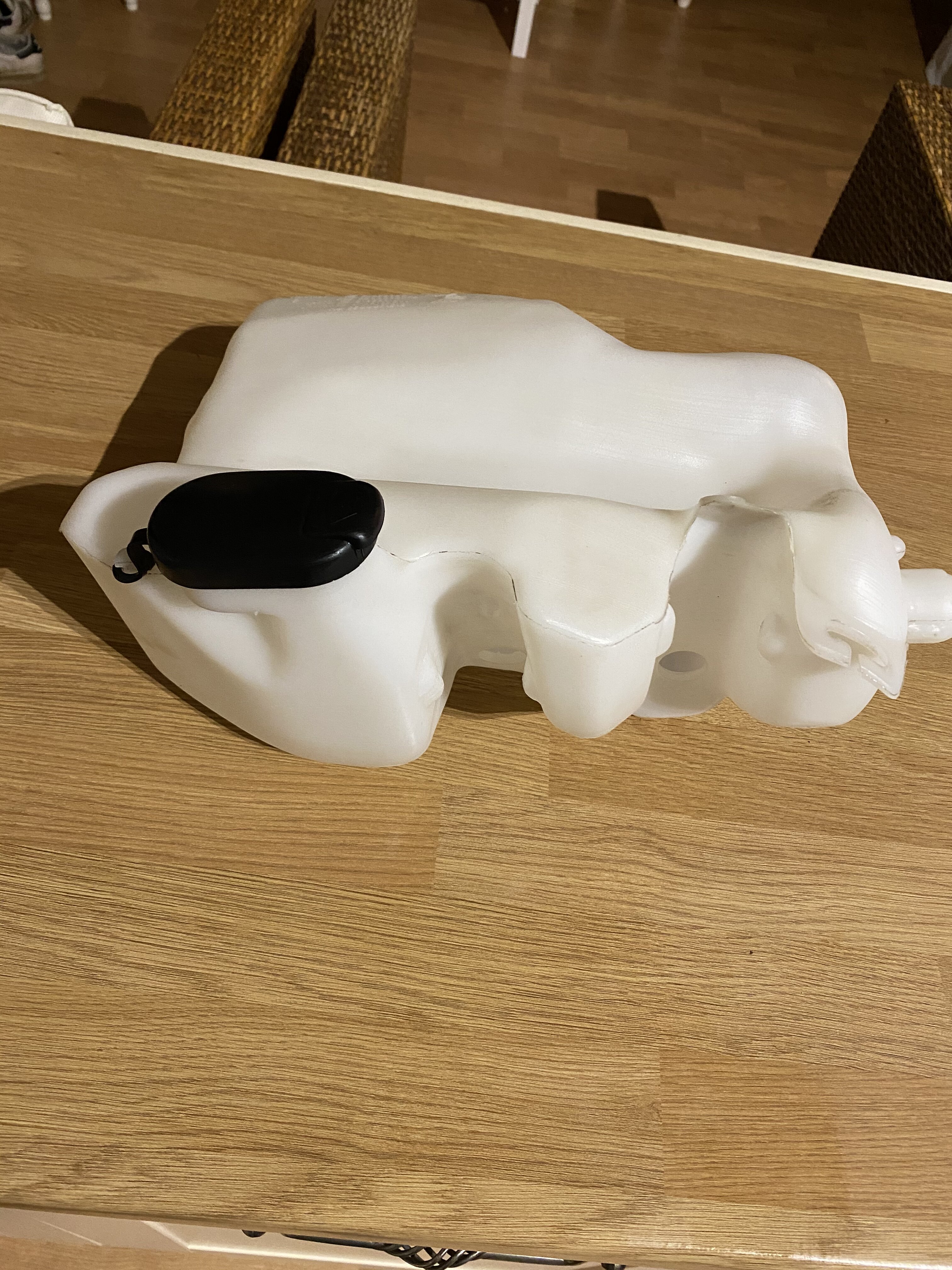

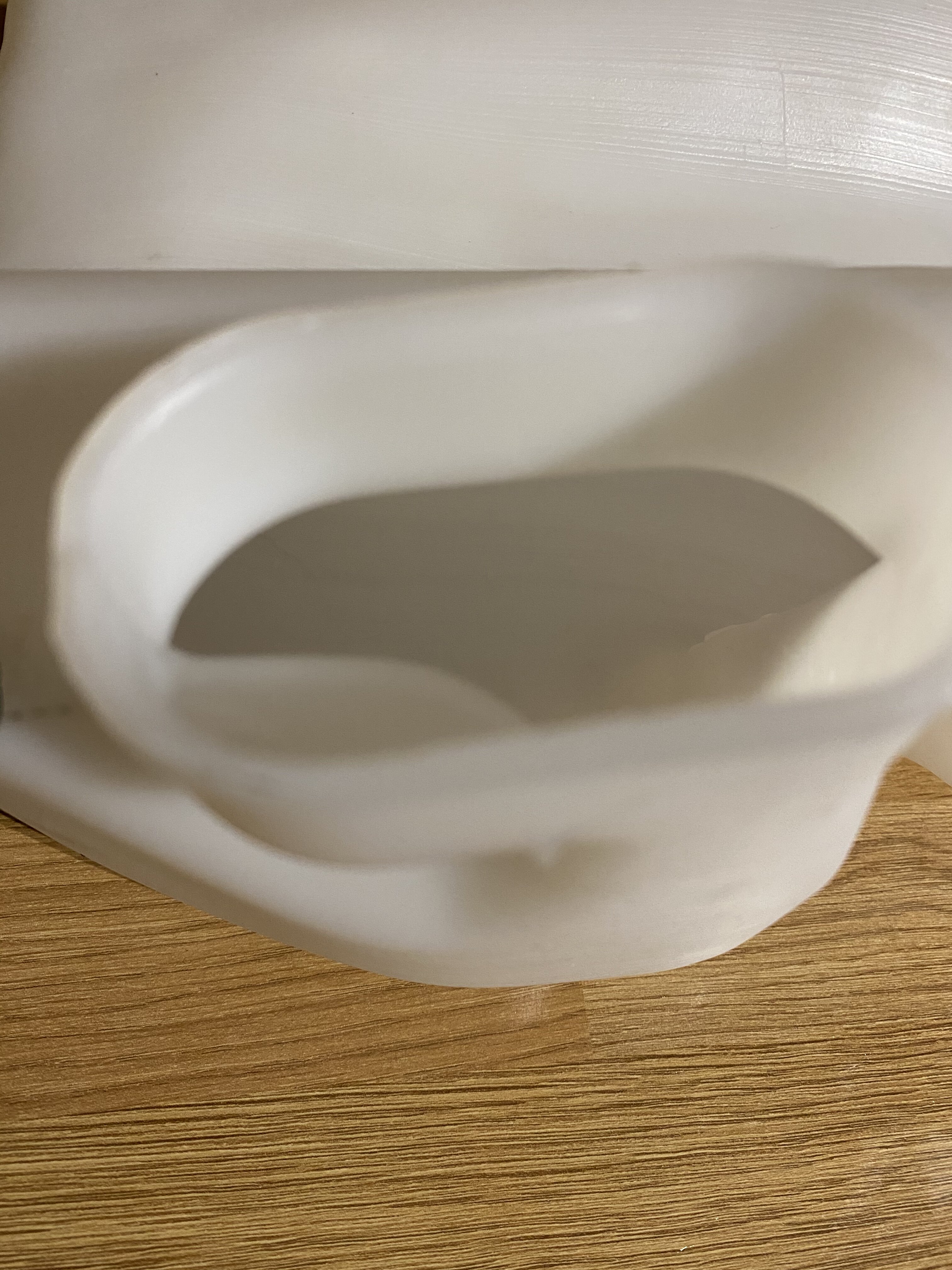

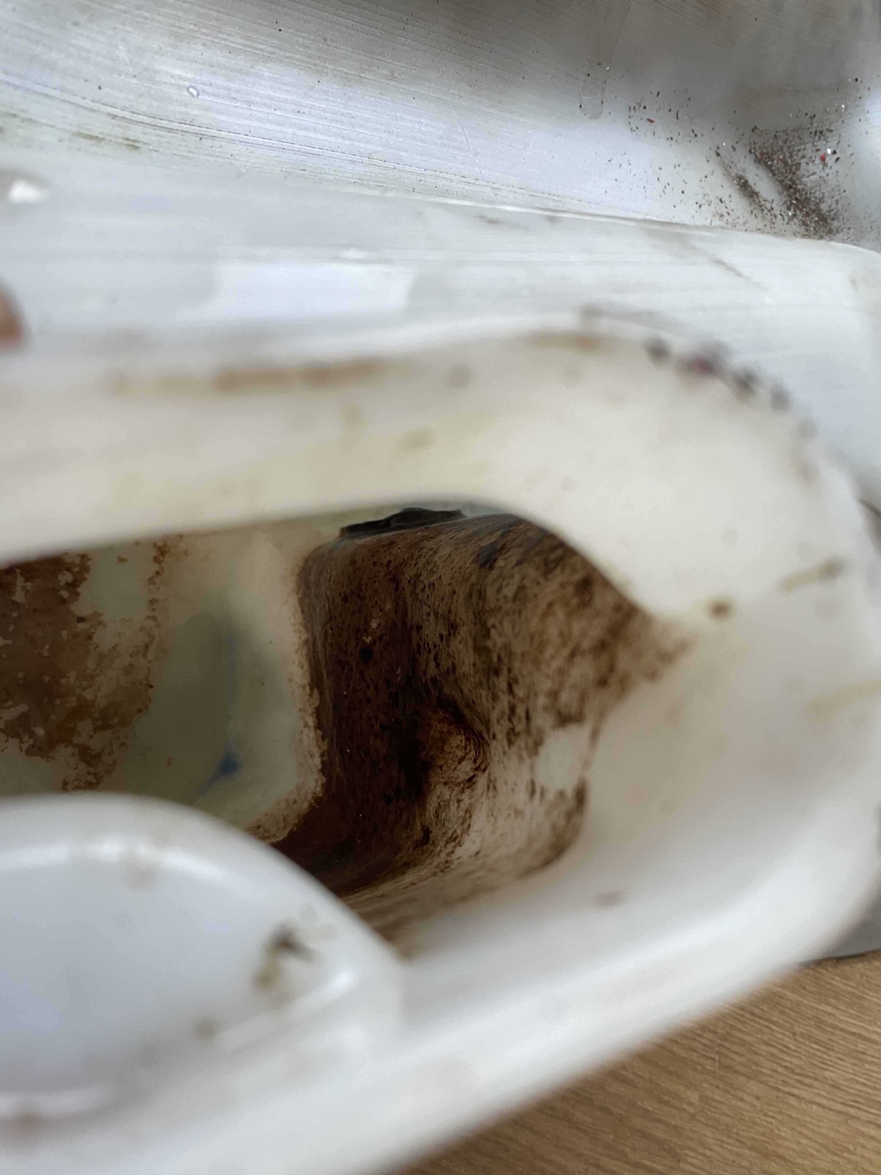

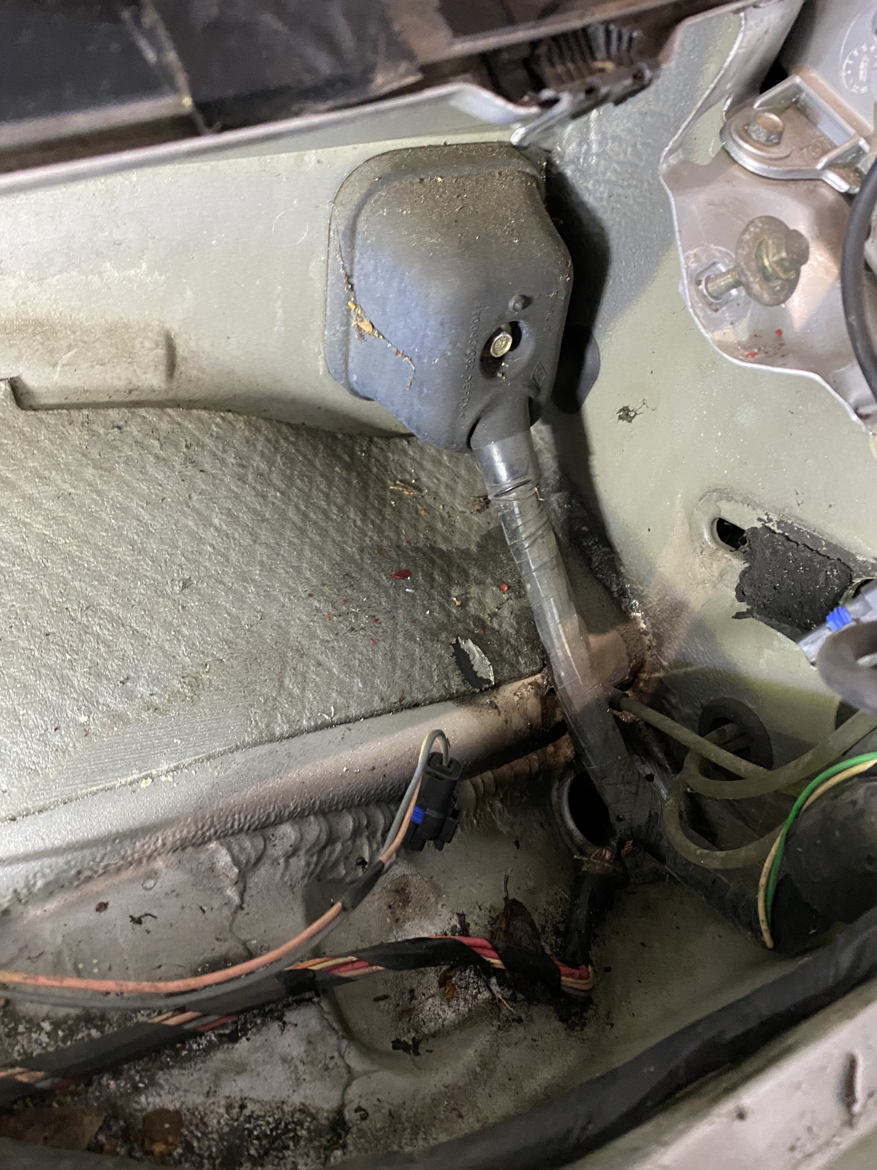

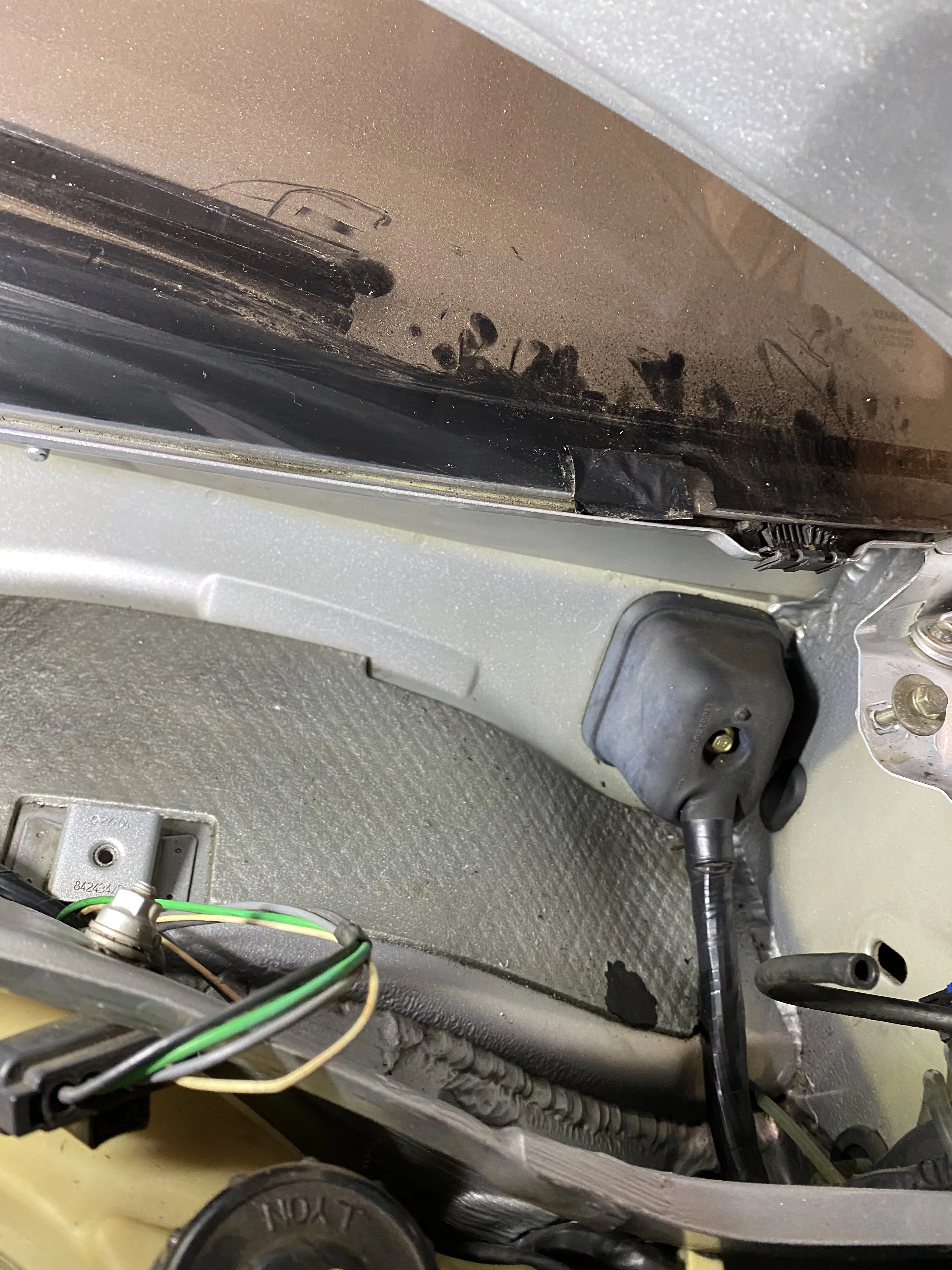

I had a couple of hours spare this morning, so decided to tackle a job which was the result of one of my own balls up. Whilst fiddling about under the scuttle previously I managed to dislodge one of the washer pumps. I didn’t realise until I had put everything back together and heard the disheartening tinkle of fluid hitting the floor. Given how much of a ball ache it is to access the washer bottle I ignored it and put it ‘on the list’. Well today was the day! I was met with this stinking lump of absolute grot.
A litre of bleach, dishwasher tablet and vanish oxyaction leaving it for about 6 hours has sorted! I also cleaned the scuttle out. It was all pretty clean really. Not managed to get it back together yet as I needed to crack on with some work!
View attachment 1517604View attachment 1517605
A litre of bleach, dishwasher tablet and vanish oxyaction leaving it for about 6 hours has sorted! I also cleaned the scuttle out. It was all pretty clean really. Not managed to get it back together yet as I needed to crack on with some work!View attachment 1517608View attachment 1517609View attachment 1517606View attachment 1517607
I am yet to go there, bought a new pollen filter so will have to take the panel off soon anyhow! Managed to put it off so far.

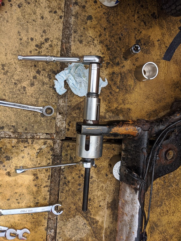

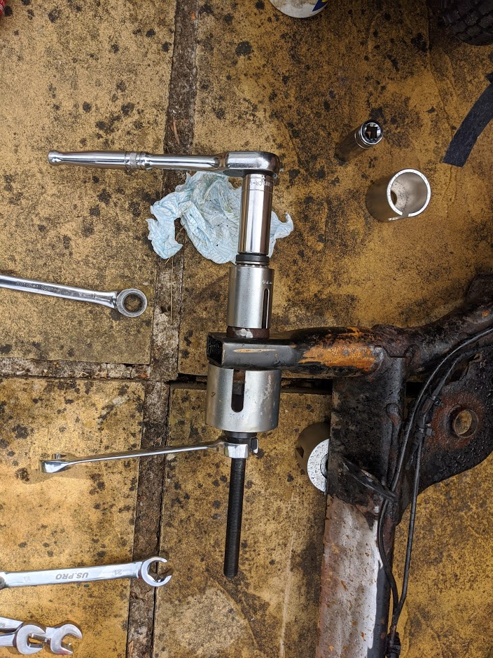

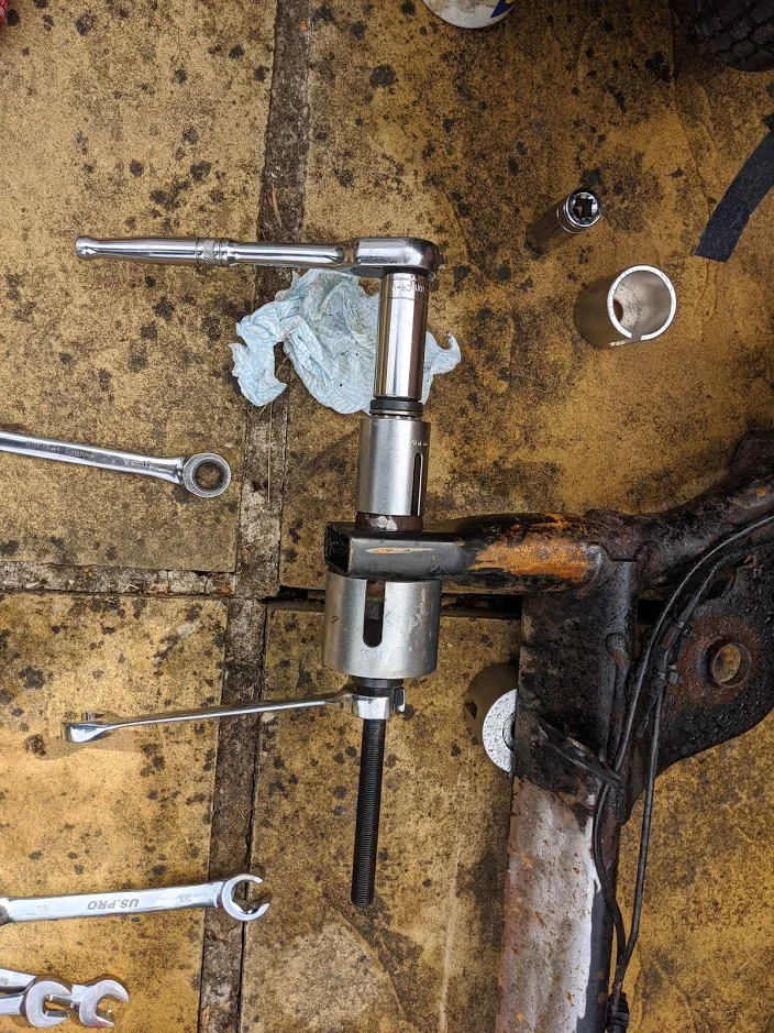

Have you got a bush inserter kit? One of the cheap eBay jobs? Made removing and installing the rear beam bushes loads easier!, didn't have to cut them out etc.
No mate, have you got a link? On my last car I used a hole saw to drill out the old bush then a hacksaw to remove the old collars. Think I cobbled together a press using a threaded bar and the old bush cups. I got there in the end but if there is a tool to make it effortless and it isn’t hundreds of pounds I’m all ears
Flob
Dead easy to do, could likely do as you did and use a threaded bar with some sockets etc, You crank the rod up then give the beam (above the bush) a gentle hammer tap and the bush jumps out. Its sheet metal so as you torque up the puller the sheet metal pinches the bush so you have to tap it to release it rather than crank the nuts up more which could damage the feeble beam.
This is the set I have, its been very handy over the years, I'm sure there are cheaper kits about. If you weren't a bizillion miles away from me you could have just borrowed my set!
Thanks Rob, I’ll probably buy the correct tool this time then. I seem to remember on my last beam making use of what I had ‘cup’ wise I got there in the end. Through persistent perseverance. Plus new tools! Probably a month or so away from that point just yet. I have the indignity of removing the old beam and brackets first. I’m going to drop the whole lot this time. The beam brackets on mine look horribly corroded and god knows what it’s like underneath them. I must say I’m not looking forward to the removal of the caged nuts

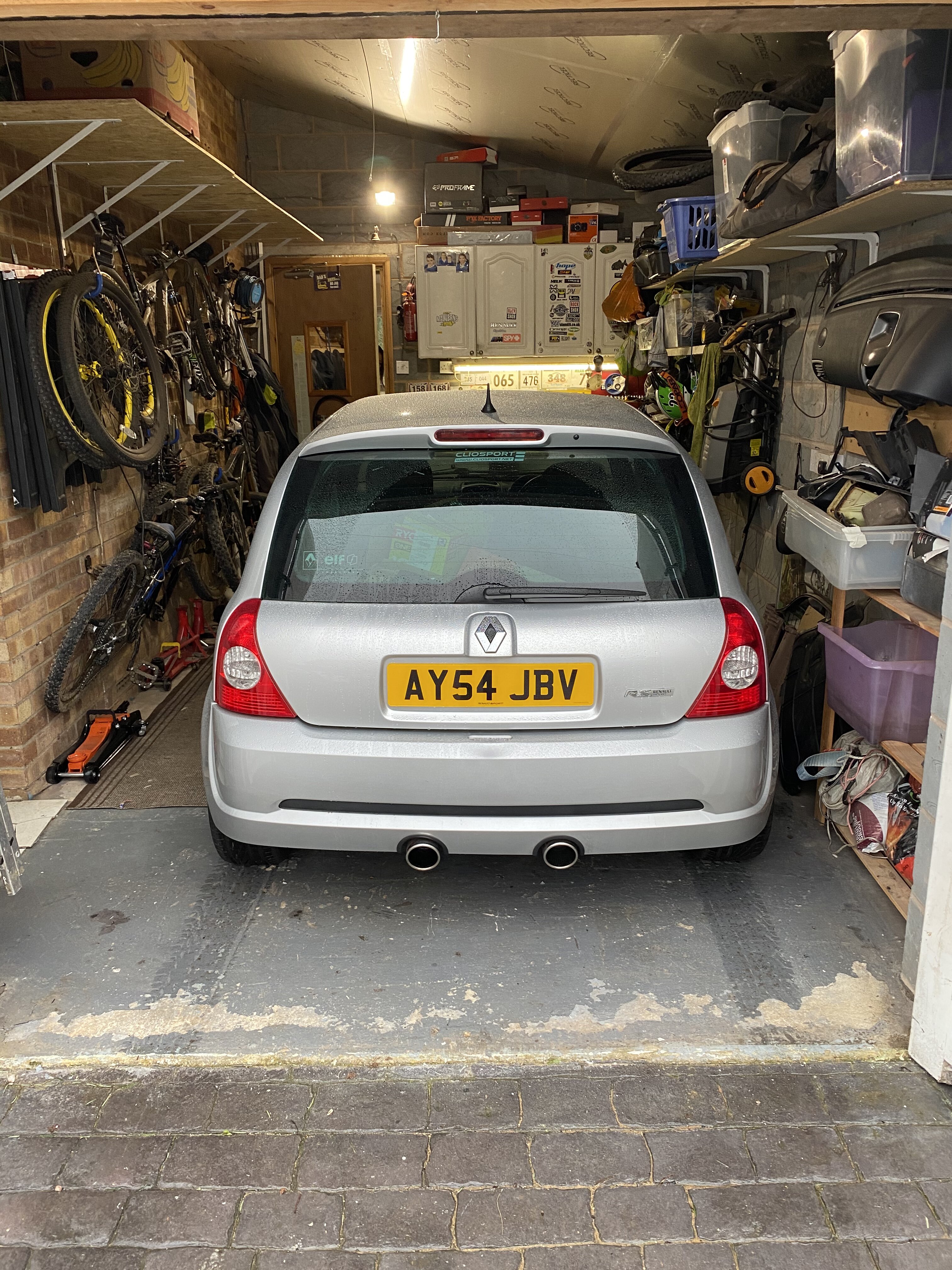

Rolled the old girl out of the garage this weekend. Took her for a quick rip around the block. Such a fantastic car! Need to get the tracking sorted once the spring comes.

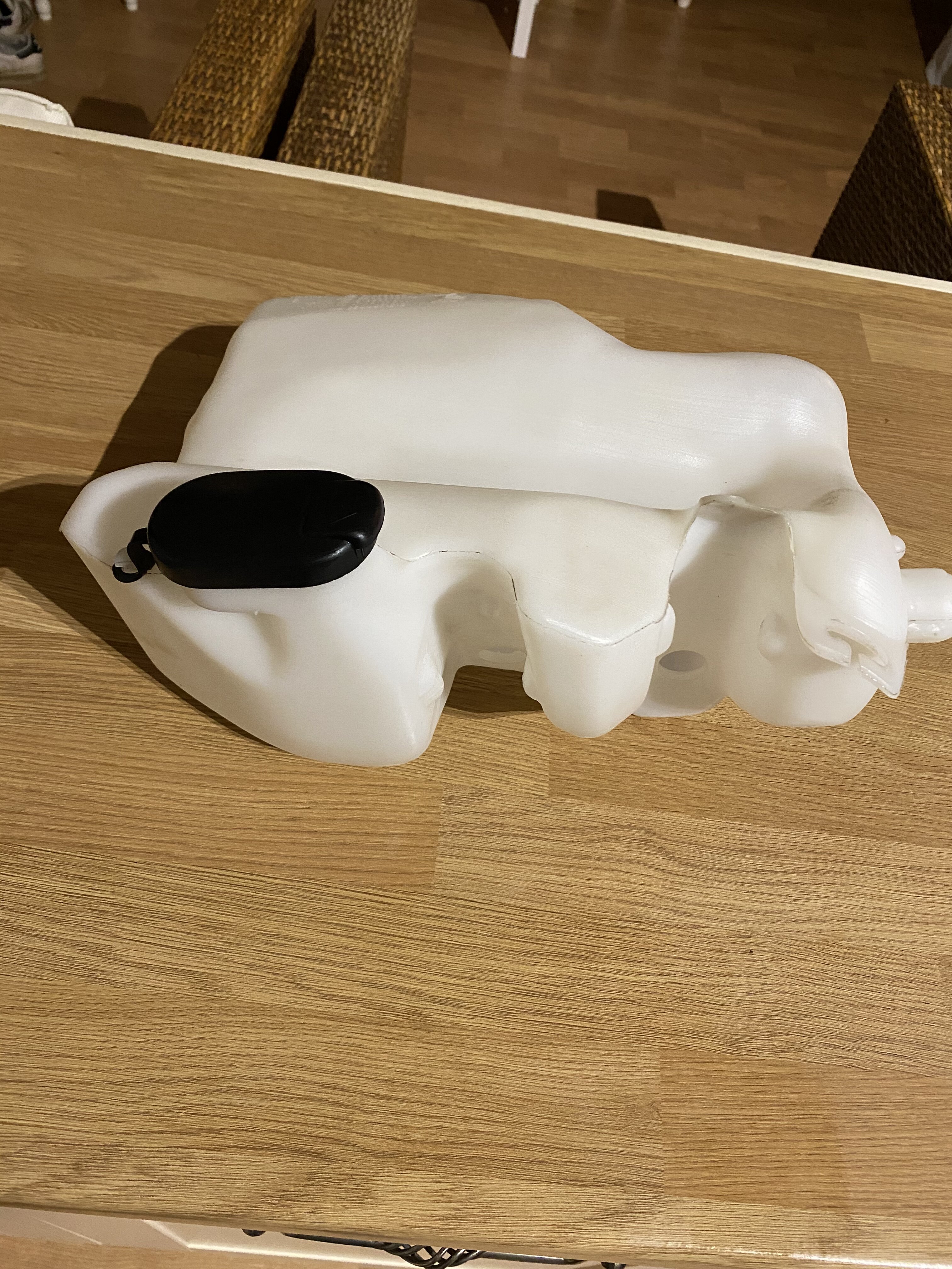

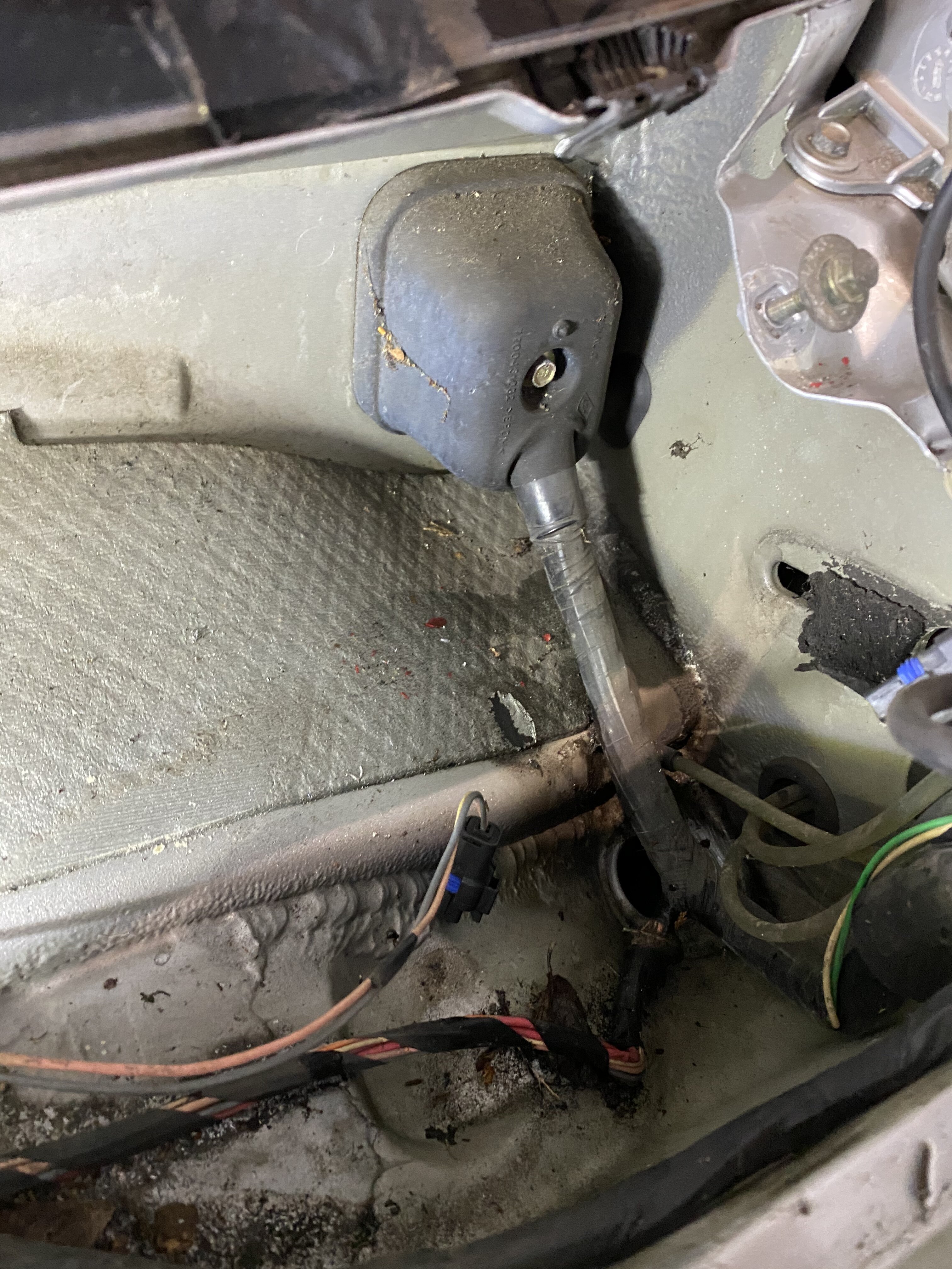

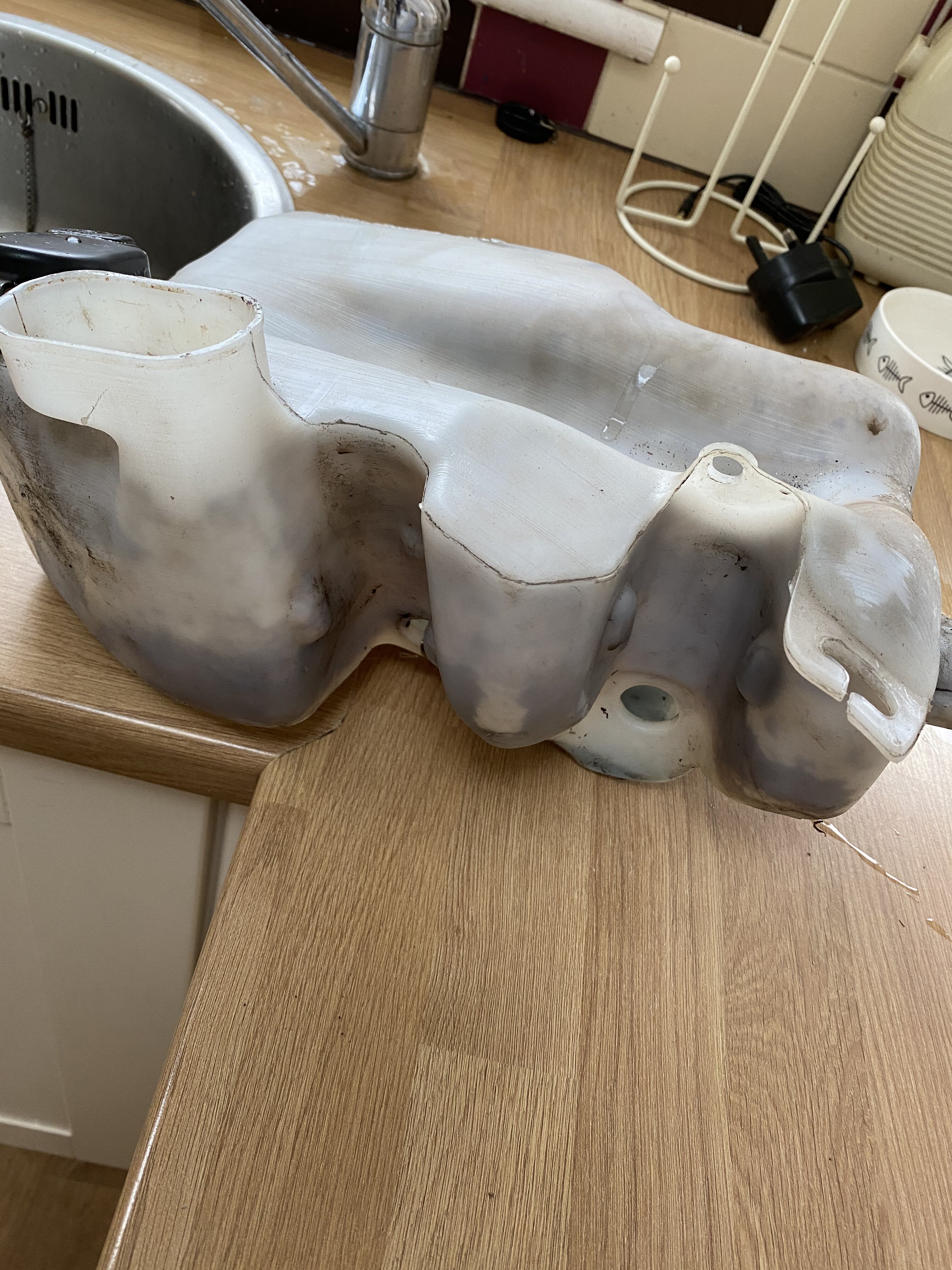

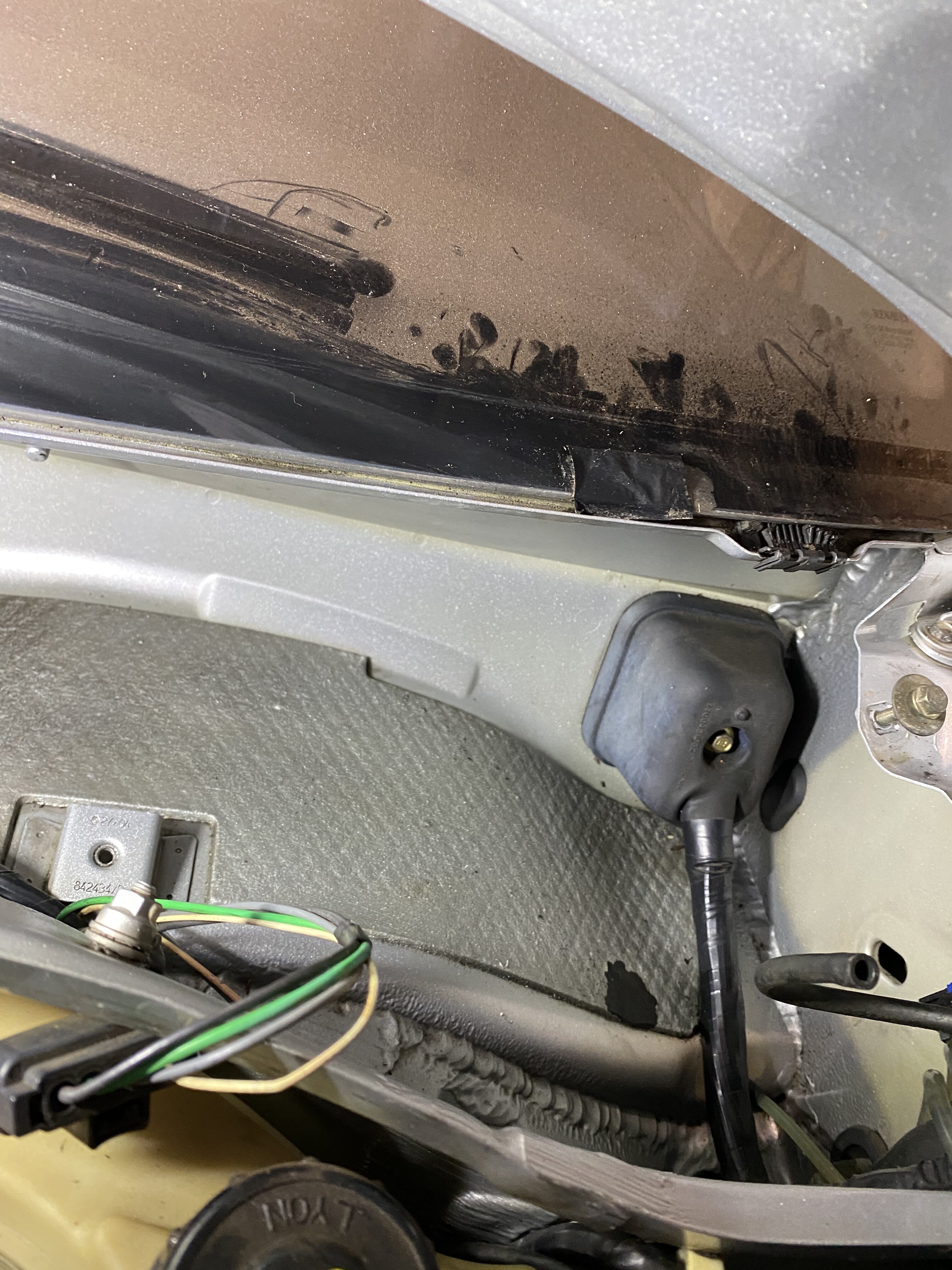

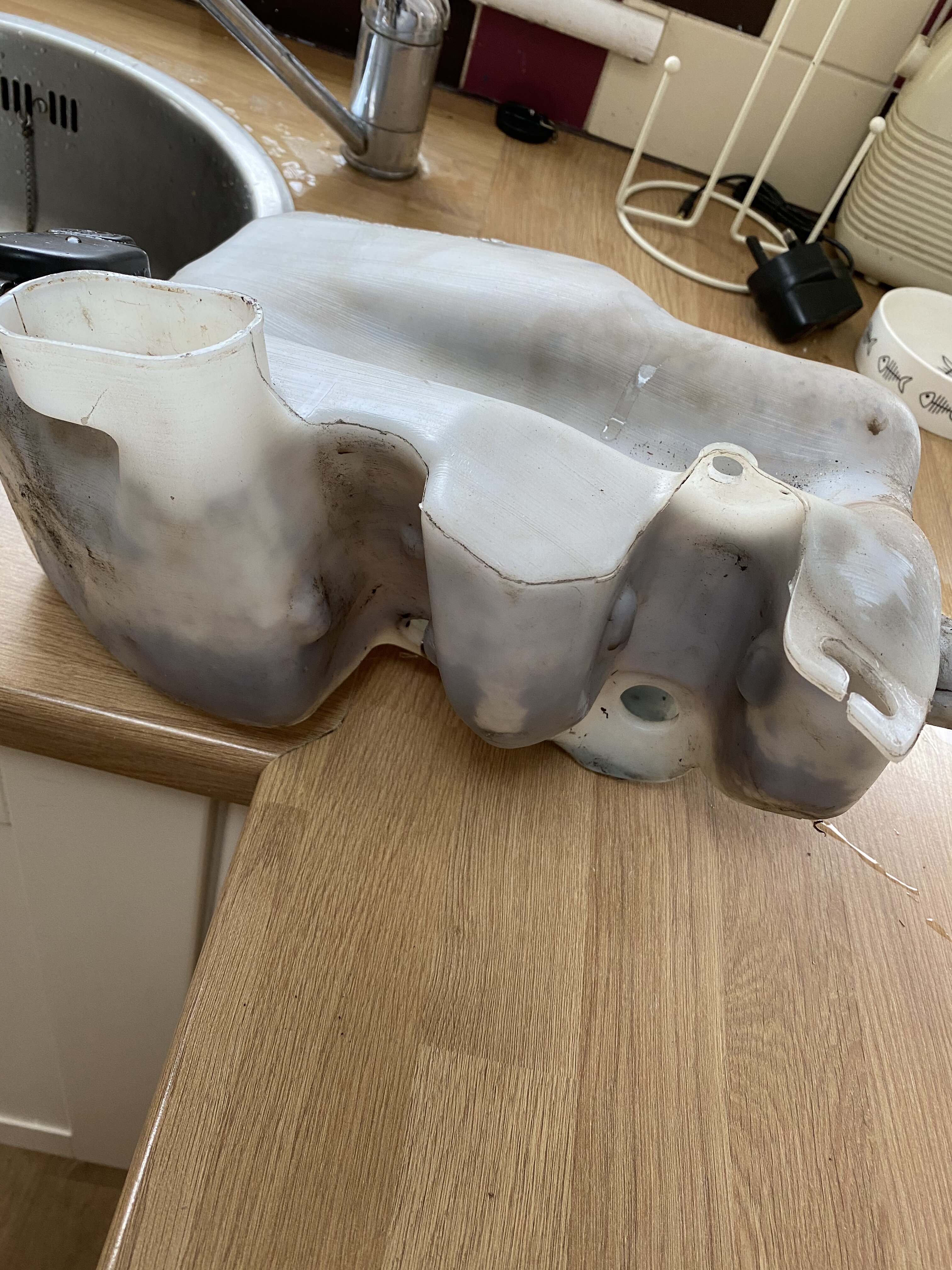

So I cocked up again a couple of times! Refitted the washer bottle tested it and it all was working! But what I didn’t notice was when I wash the windscreen the car now also washes the rear screen! So obviously I have done something daft! Secondly on the drive I noticed the speedo isn’t working! Again I changed the clock dials so must have done something stupid! Dash out again! 😔

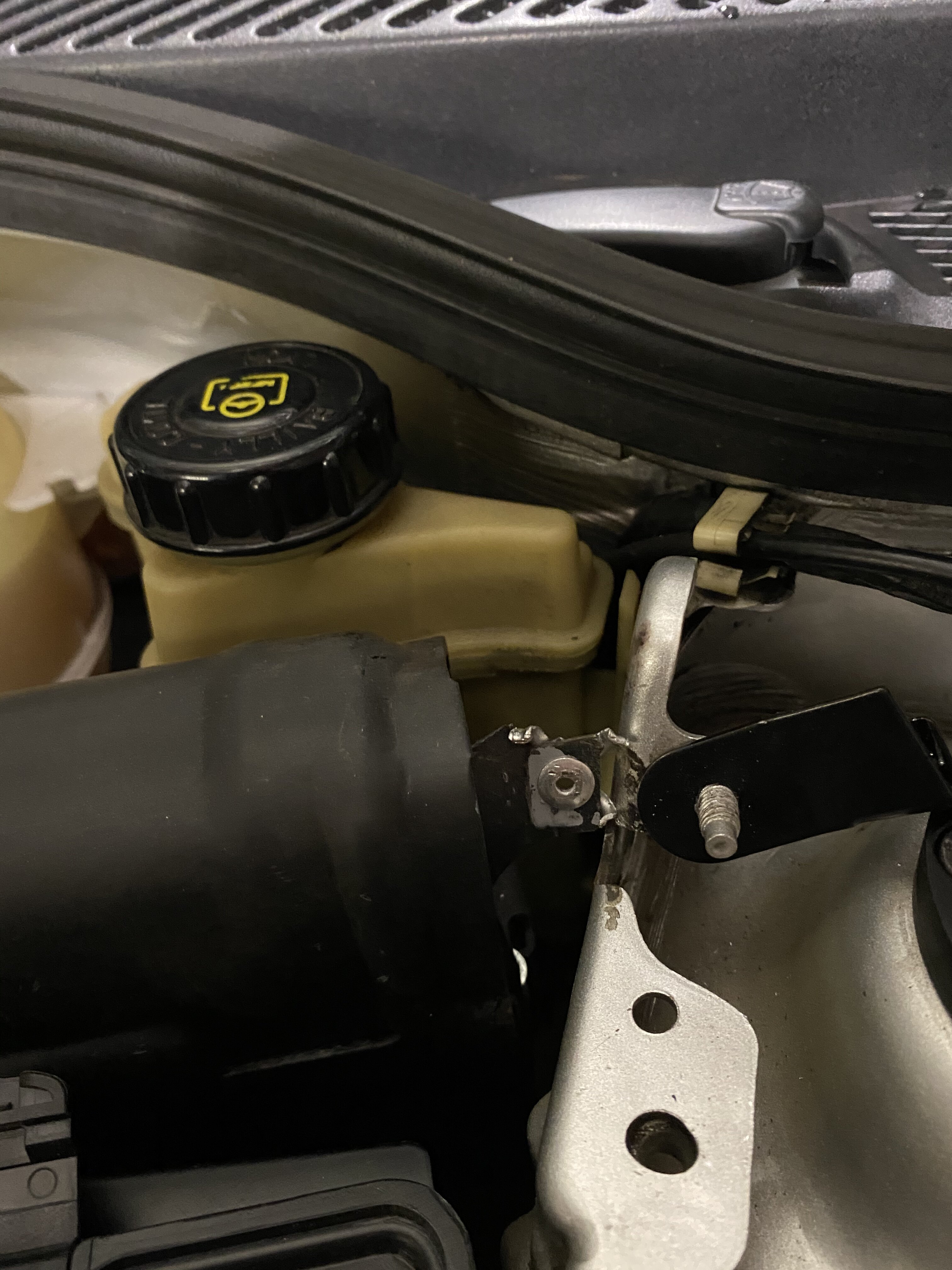

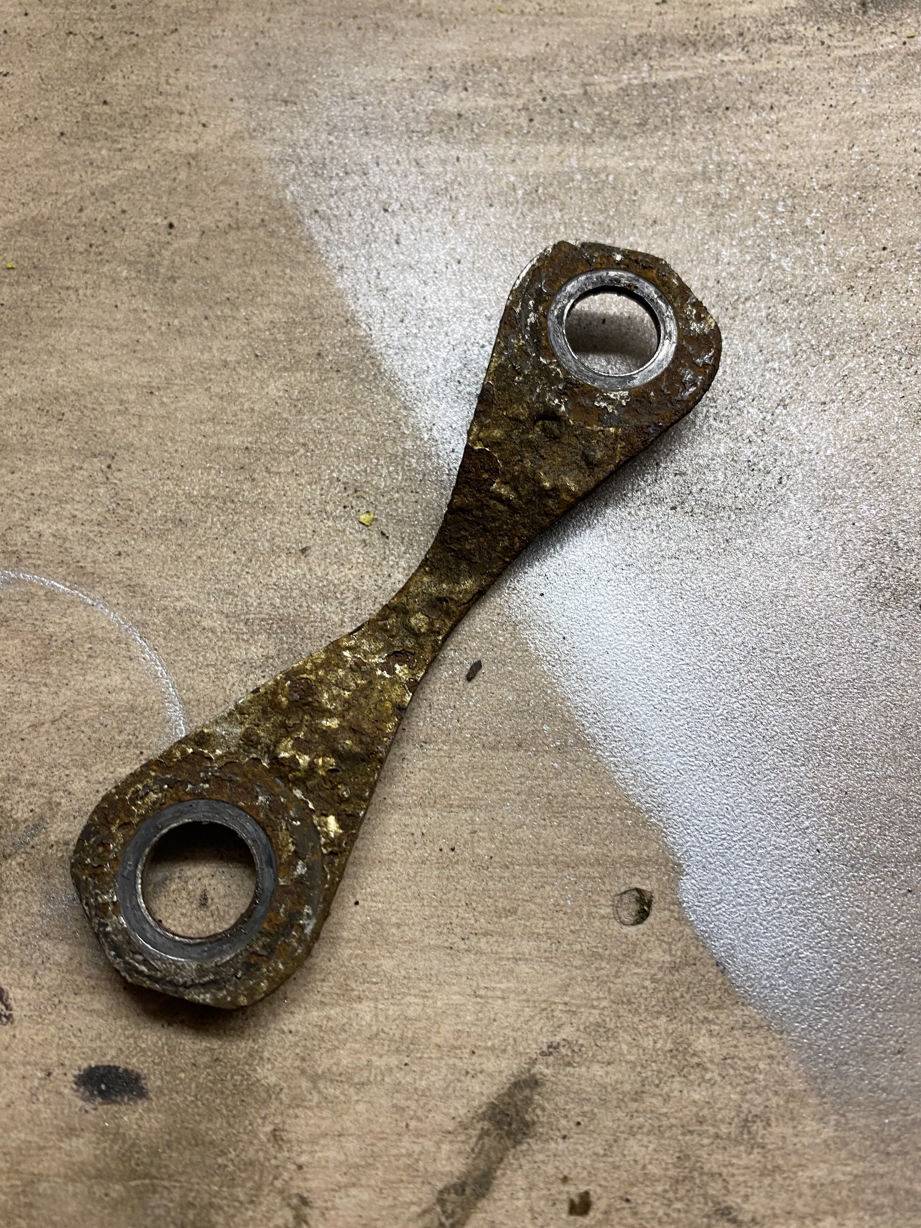

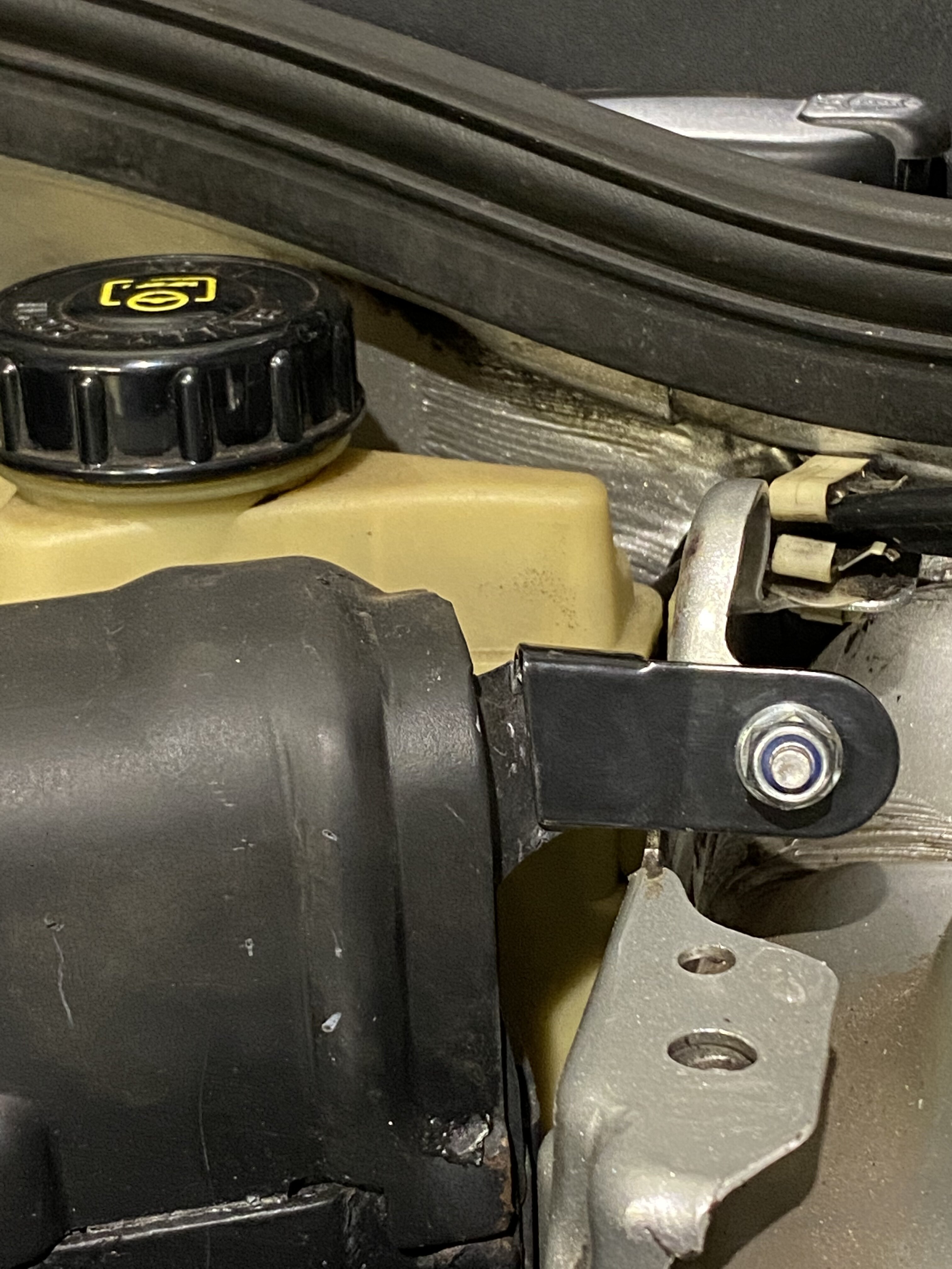

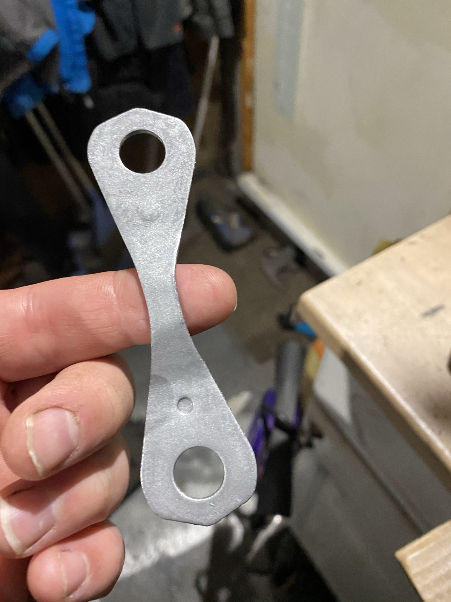

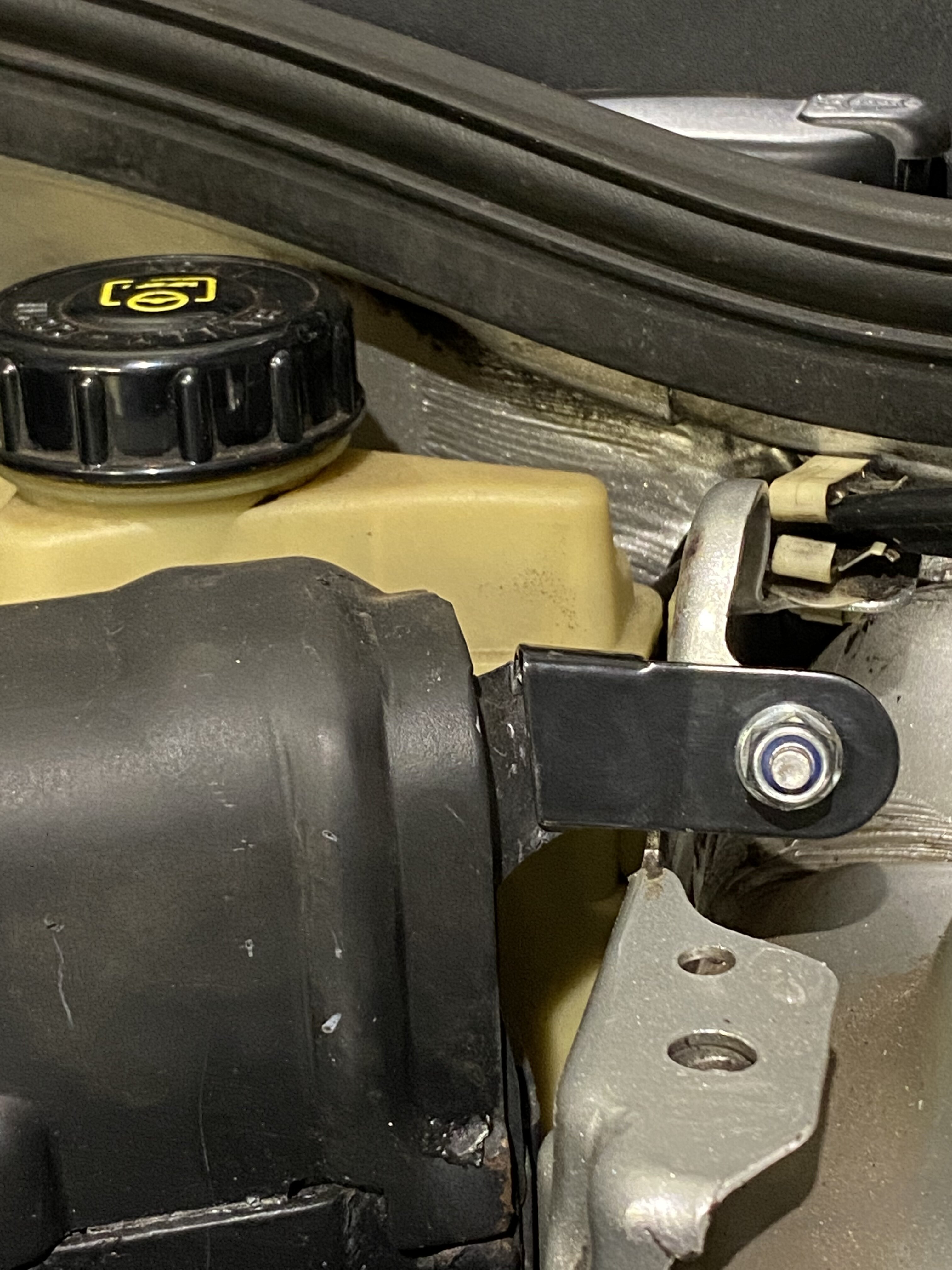

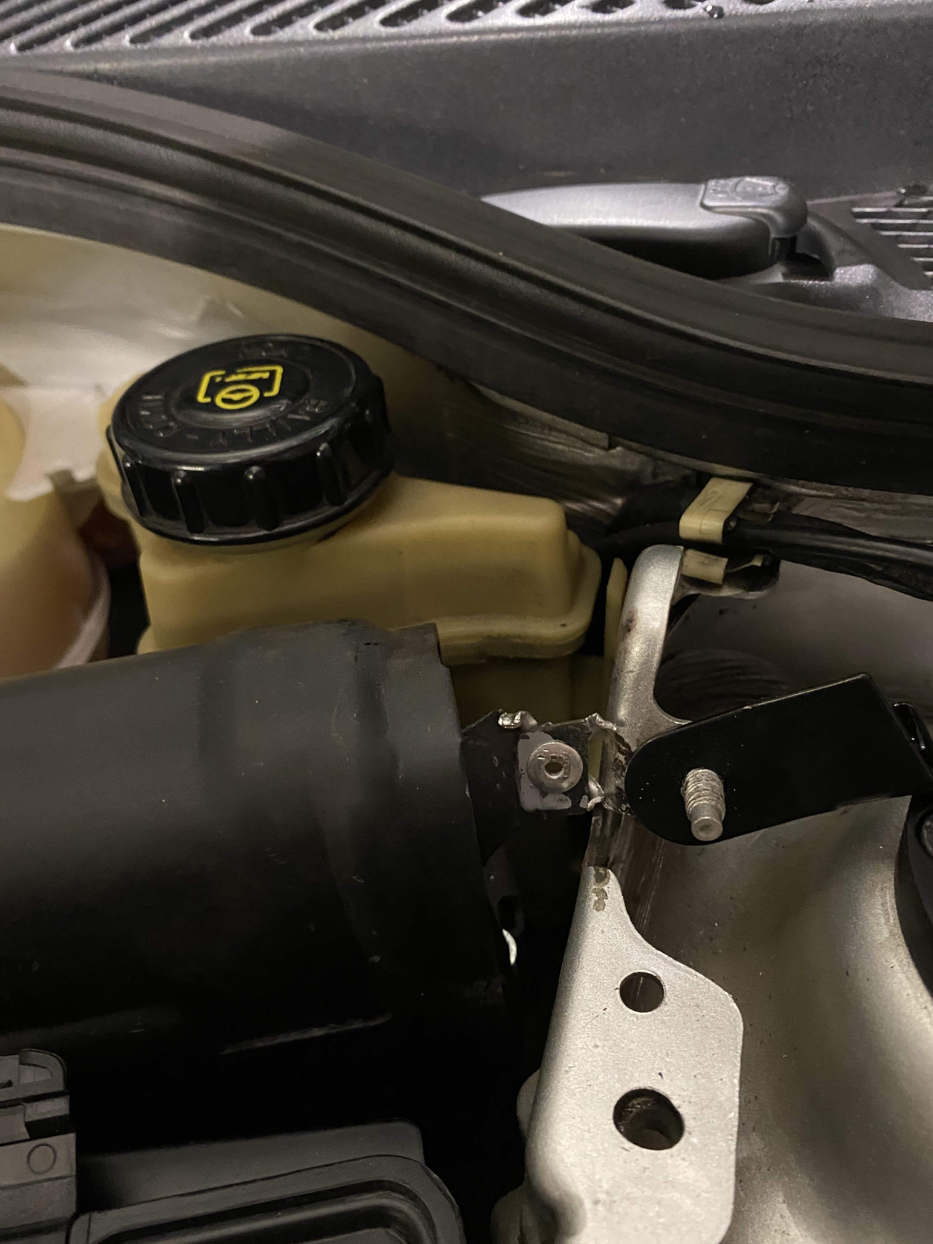

I fitted my CFAB ecu repair bracket. Decided to drop a river into the old broken arm which meant the repair bracket had more ‘girth’ to bite into. Seems to have done the trick.

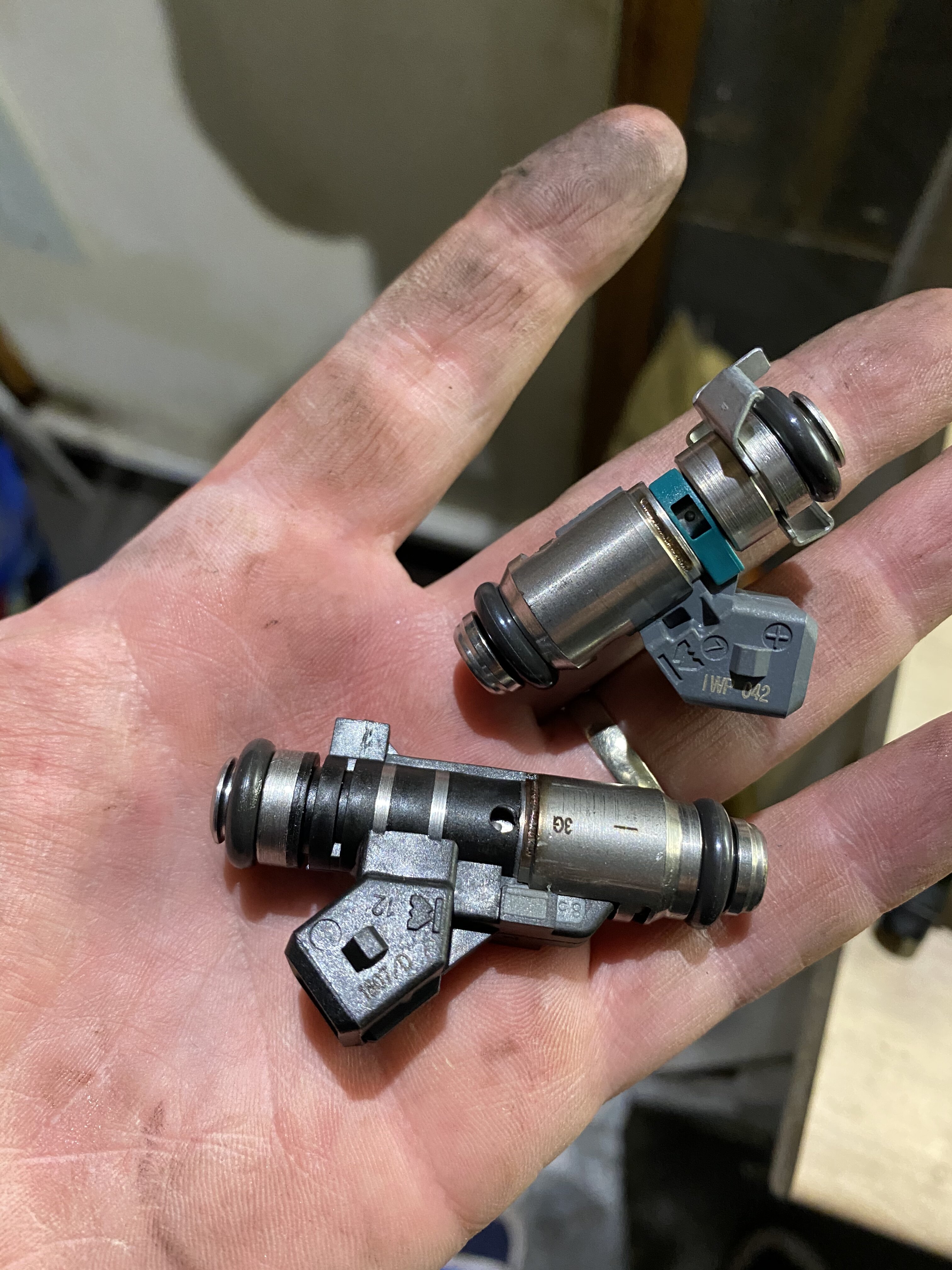

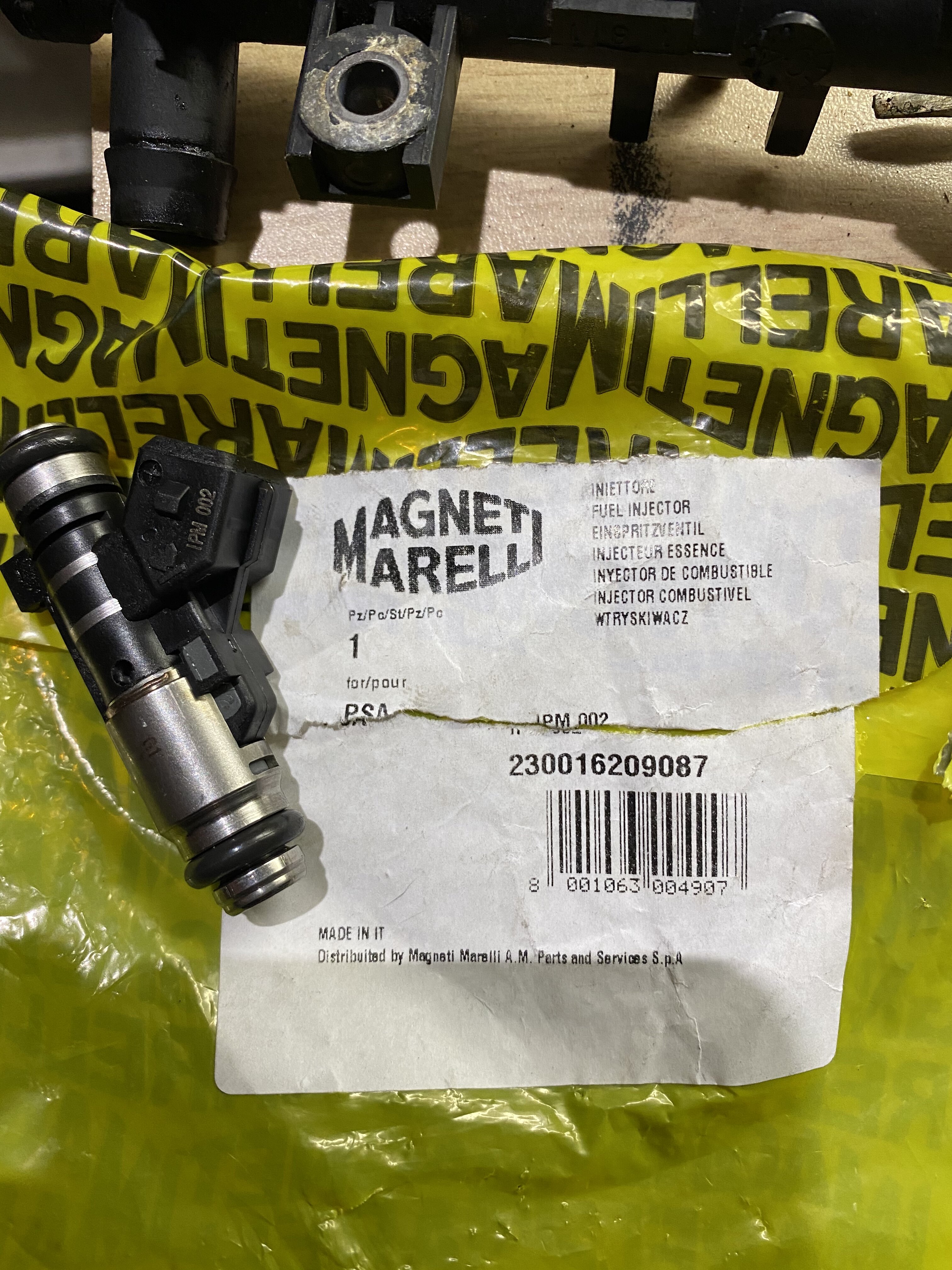

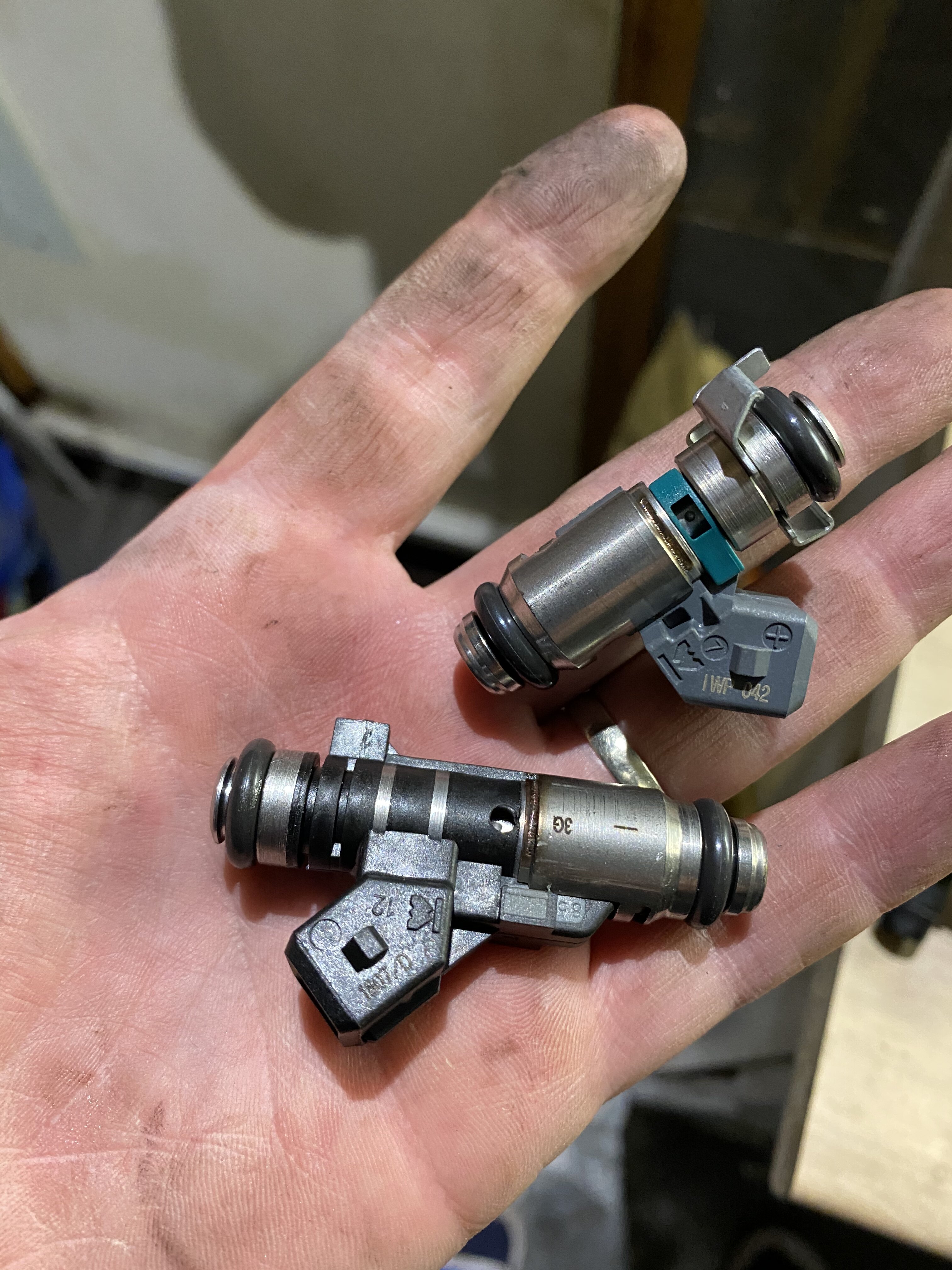

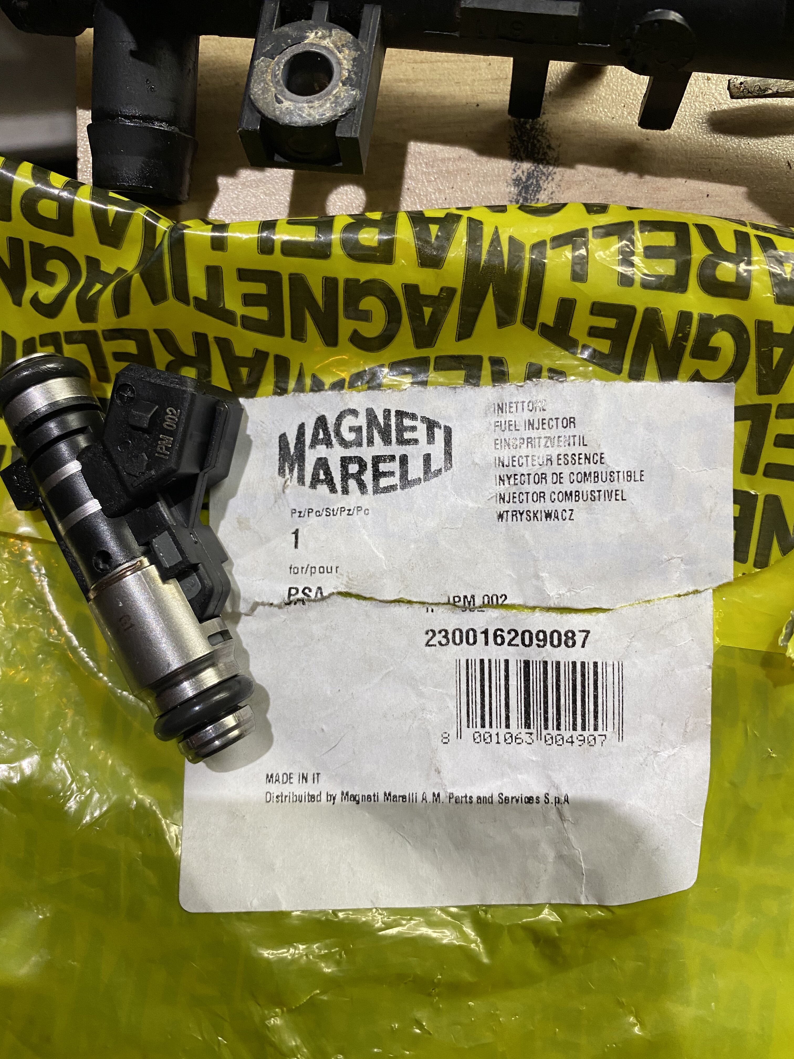

Then went to change my injectors, the old ones are still prettt good, but I ordered a new set with the recent Renparts 20% off offer. Started fitting them and then found they had sent me 3 clio injectors and one Peugeot one! Great! I have dropped them a message to try and sort but I hate s**t like that it’s always a

Finally parked the old girl back in her home
