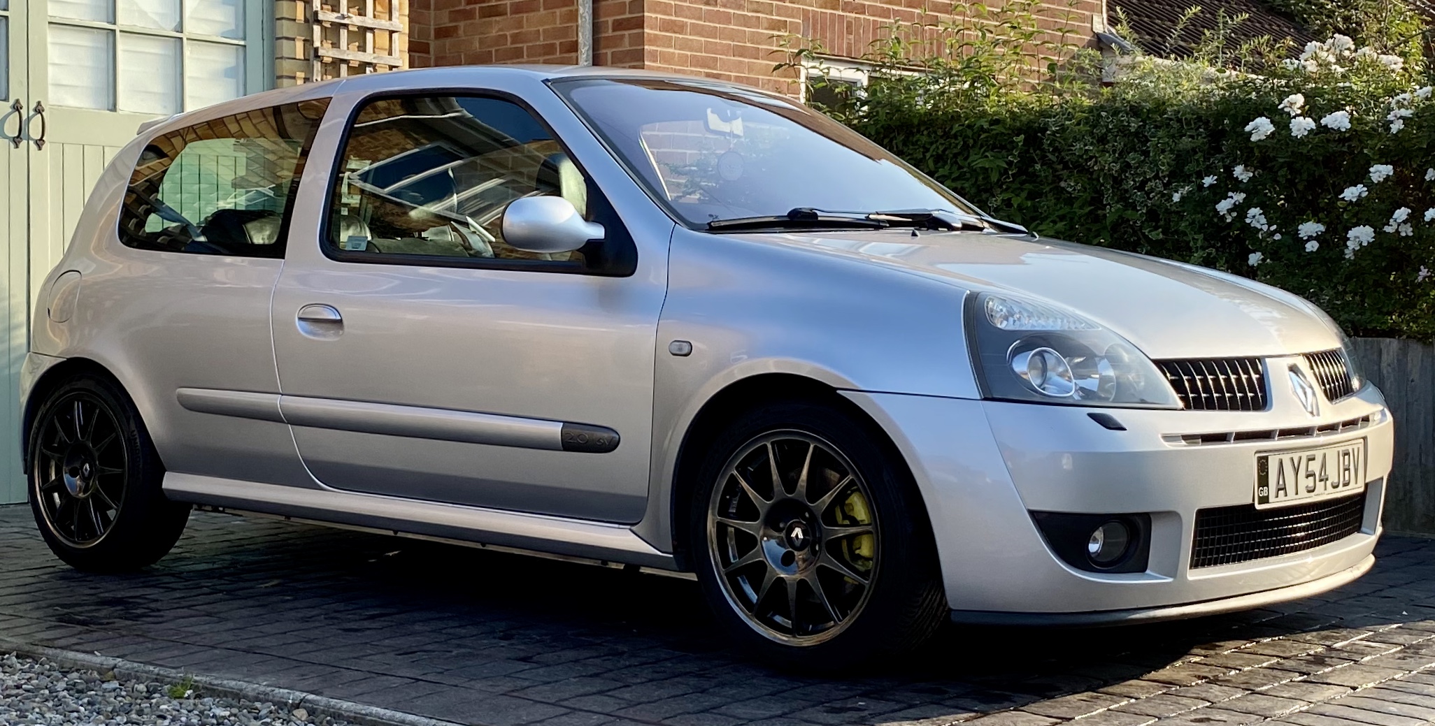

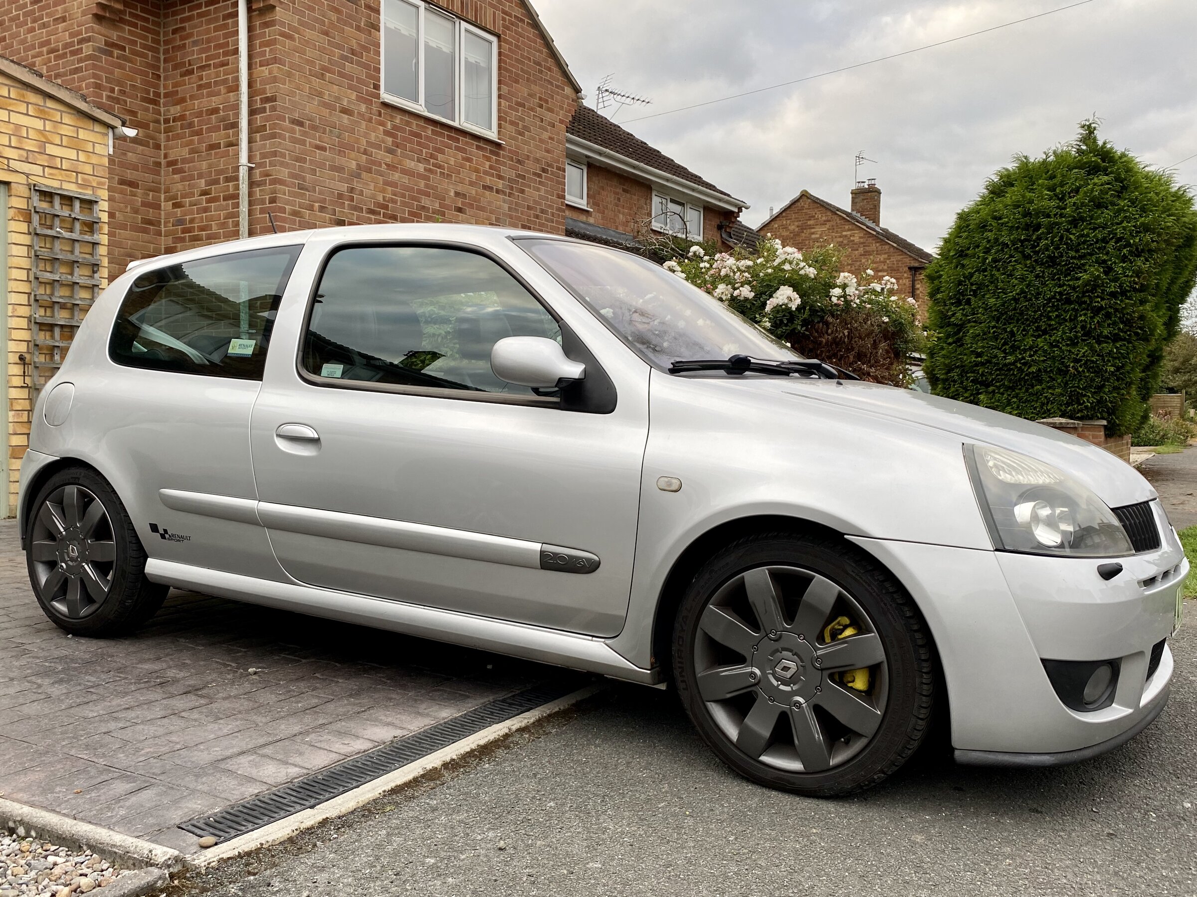

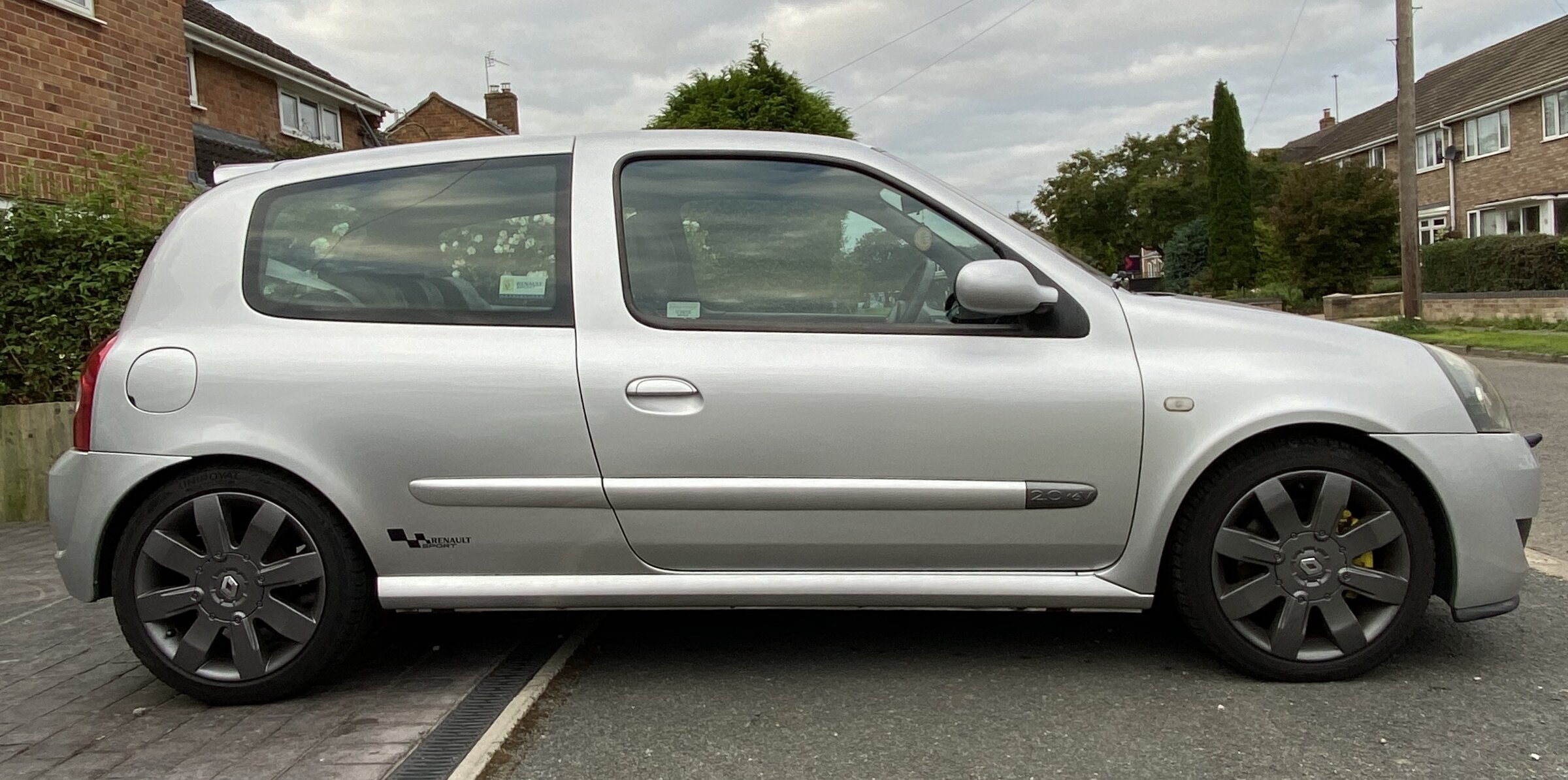

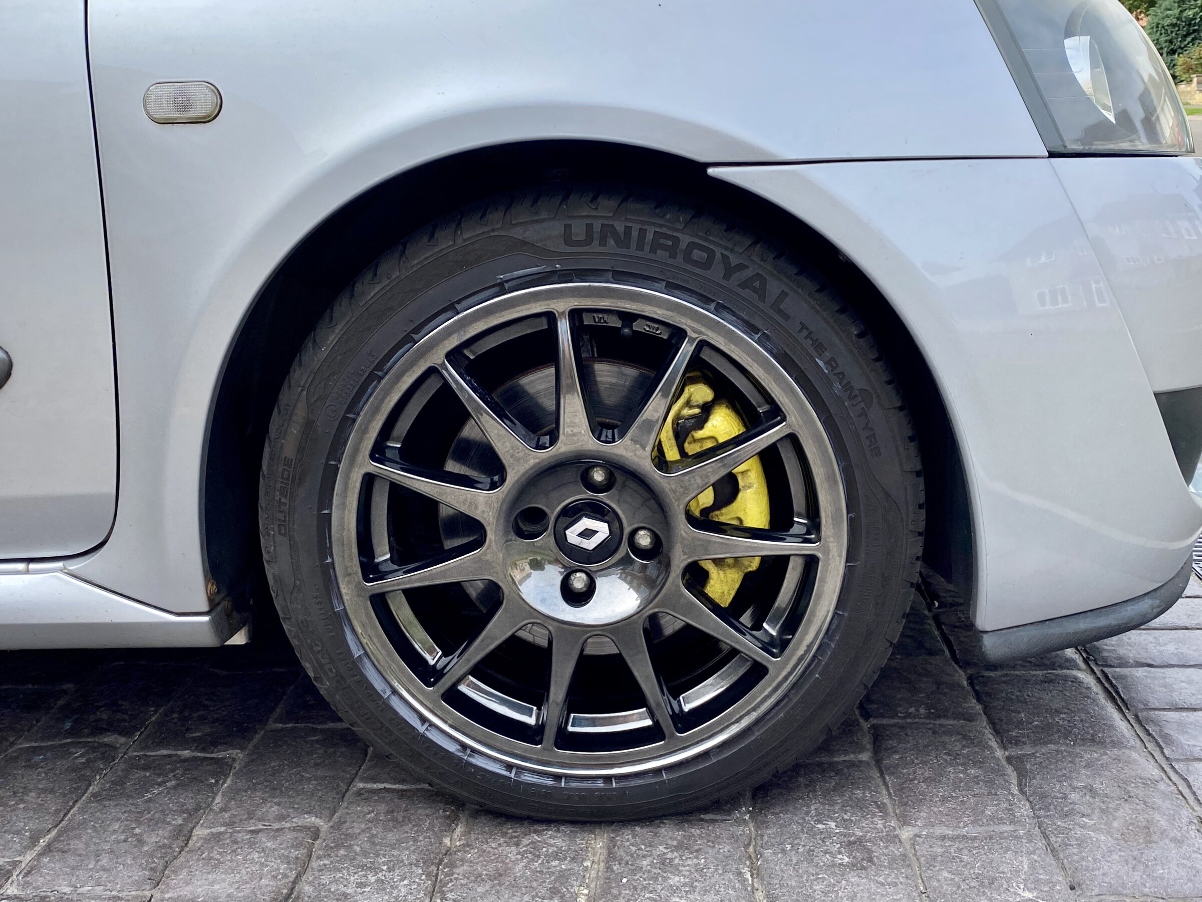

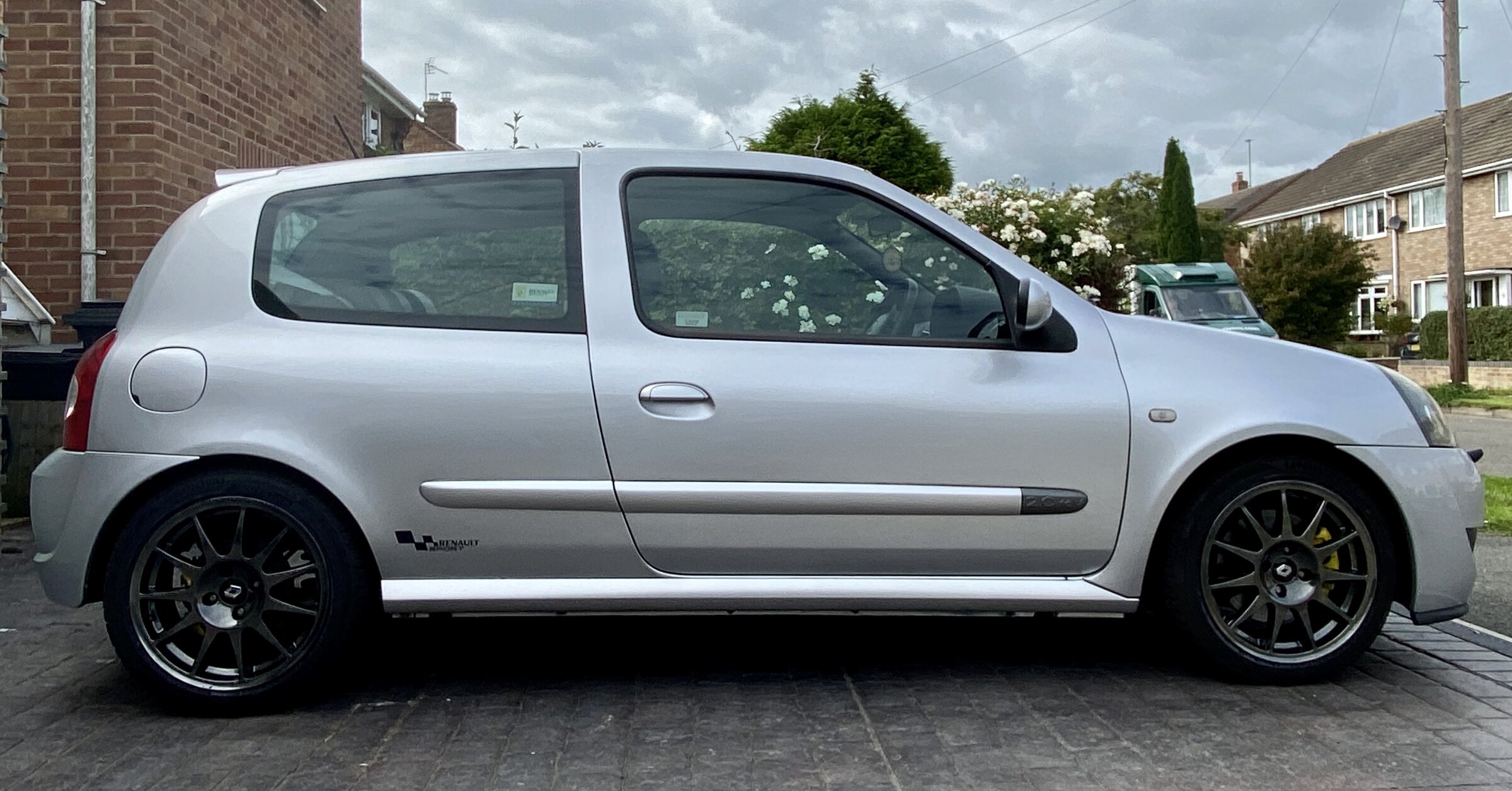

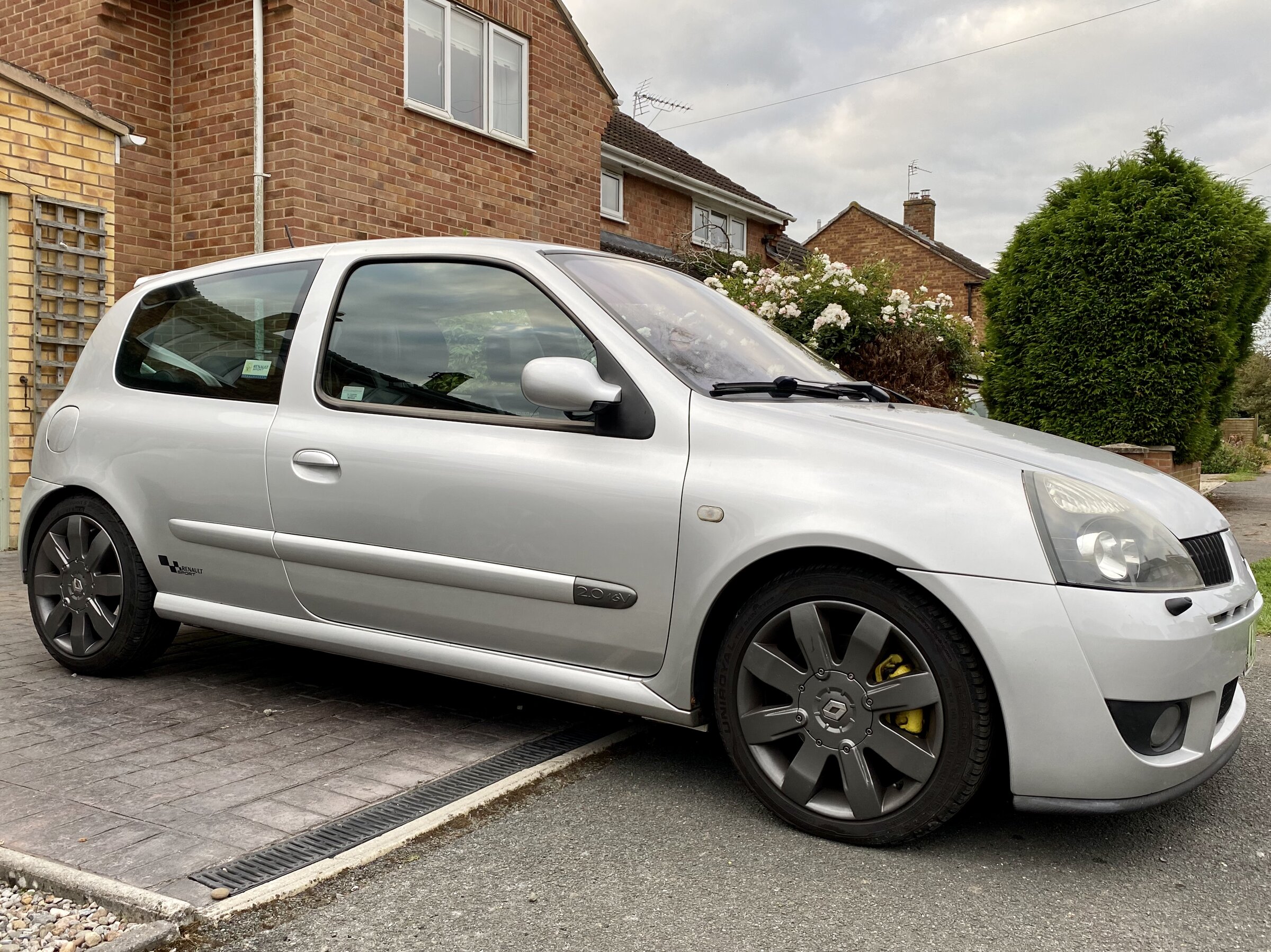

After:

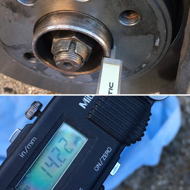

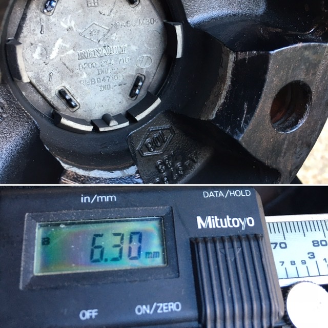

Those eagle eyed will notice only 3 wheel bolts...typical Renault locking wheel key looked a bit of a mess. So I told the chap not to refit. Pretty damn chuffed. However couple of things now apparent. The car has Eibach ‘black’ springs fitted. However I think it needs a touch more ‘drop’ secondly needs some spacers.... 🤔
frayz
That looks really smart. Do yourself a favour and dont go any more than 5mm spacers on the turinis. Due to the chamfer in the rear of these wheels, you cant run a laregr slip on spacer or you have nothig to locate the centre of the wheel on.
The experts of the internet will tell you its okay to centre the wheels on the suds alone but this is both crap and unsafe. The wheels atud are not designed to take lateral loading, theyre only there to stop the wheel falling off. So the central hub location is important.
The next jump after 5mm is a 15mm hubcentric, yes they look smart but they drive crap.
Fitted mine and took them off.
Your call, just my opinion.

That’s great advice thanks @frayz I was going to go pure hubcentric to be honest, should have been clearer! with a pure stub axle kit on the rear. But I’ll take on board your comments and leave as is for now. I don’t want to ruin what is a superb handling car. Will see how I feel about how it looks over the coming days as I start to put my touch on it. I have plenty to be getting on with! I’d like to do a stud conversion at some point as well. But until that point I need some new wheel it’s now I have sling the crappy Renault lockers. Any recommendations on go to brands that won’t rust whilst sat in the garage?
frayz
Unless you go Ti then all the studs are motorsport items and just high grade steel. All of them will corrode I’m afraid. Giving them a liberal wipe of ACF50 will certainly starve off any corrosion for a good while.
If you stay with bolts then the Polarised items from TPI seem to stay nice for a long time.
Up to you on the spacers dude. I just know if i certainly wouldn’t go any more than 10mm up front but as said with the large 6mm chamfer the Turinis have, a 5mm slip on is all you can fit and keep contact on the hub nose.

I’ve got 10mm slip ons with the 2118s (ET43) as they have a tiny 2mm chamfer so still locate. My new wheels are ET38 and will probably run with a 5mm spacer. This is combined with the roll centre kit will bring the front out 10mm without messing up the scrub radius and will align with the 10mm rear axle spacers. If I could get a 5mm rear axle spacer I’d drop them in slightly but I haven’t found any just yet.
DomP182
  ph1 172, Arctic182
Agree with Frayz my flamer is on 89k...not such a pretty sight, yet.
As for spacers I've got 15mm hubcentric fronts with camber bolts and 10mm PMS stub axle rears, drives lovely to be honest.

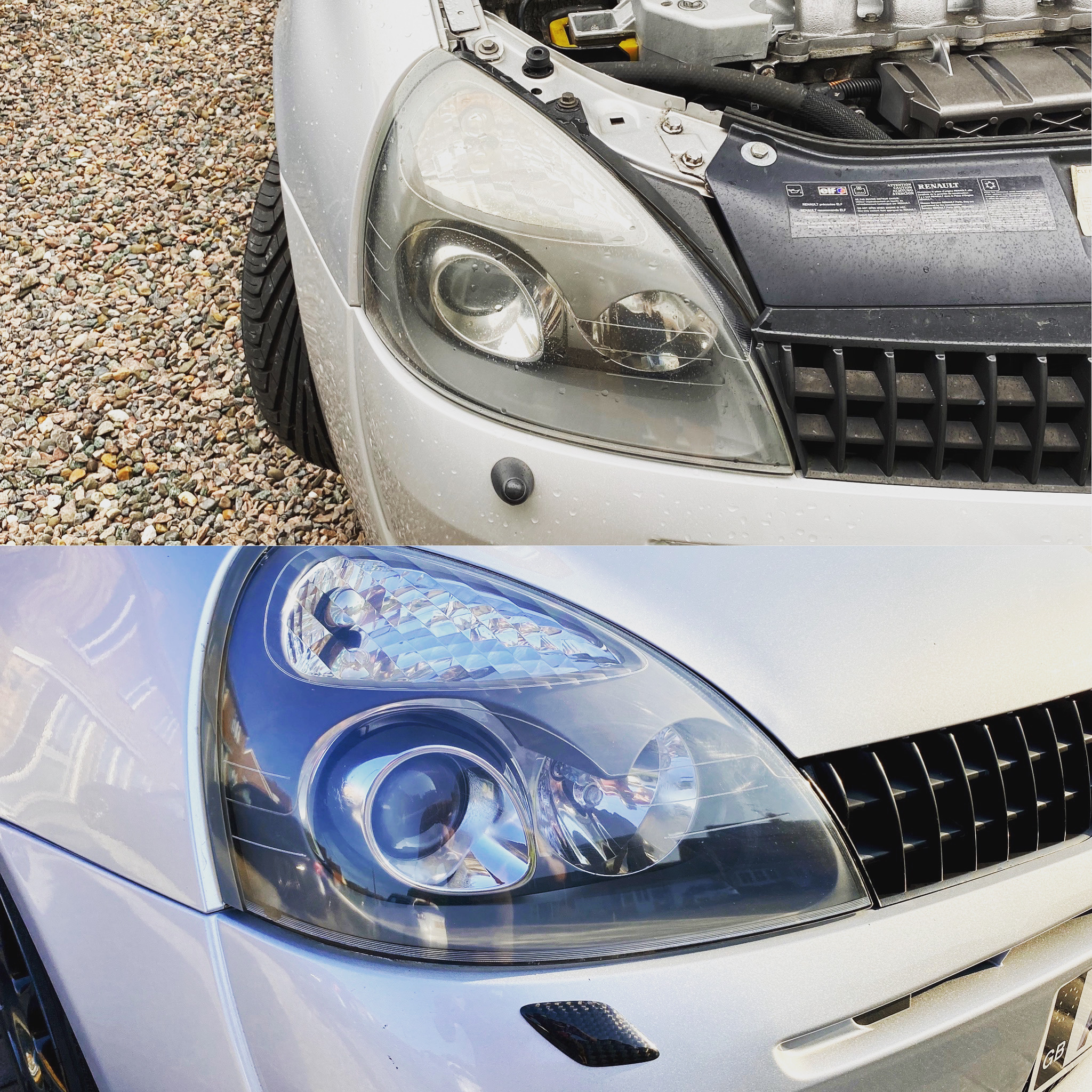

Couple of small updates. I’m looking forward to getting cracking on some bigger jobs! Sadly I have started a new project at work which is eating all of my spare time, plus Dad duties have come into full force! It appears my 15 year old has more of a social life than I.
had some parts left over from my first aborted attempt at freshening up a clio.

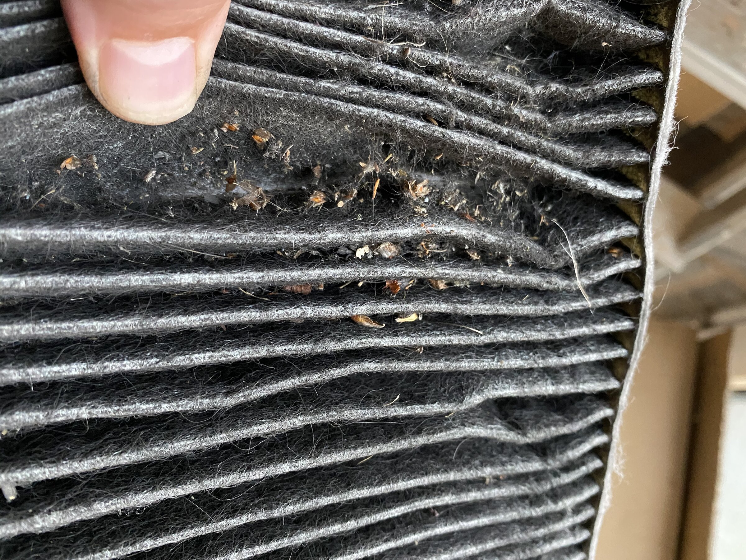

First up I replaced the cabin pollen filter! Glad I did it was full of detritus! Whilst I was there I cleaned under the scuttle and treated the parts with some autofinesse revive, I will be sorting the other side out hopefully over the coming week, making sure the drain is clear and removing the head lamp washer pump connections to support the fitment of my carbon blanks

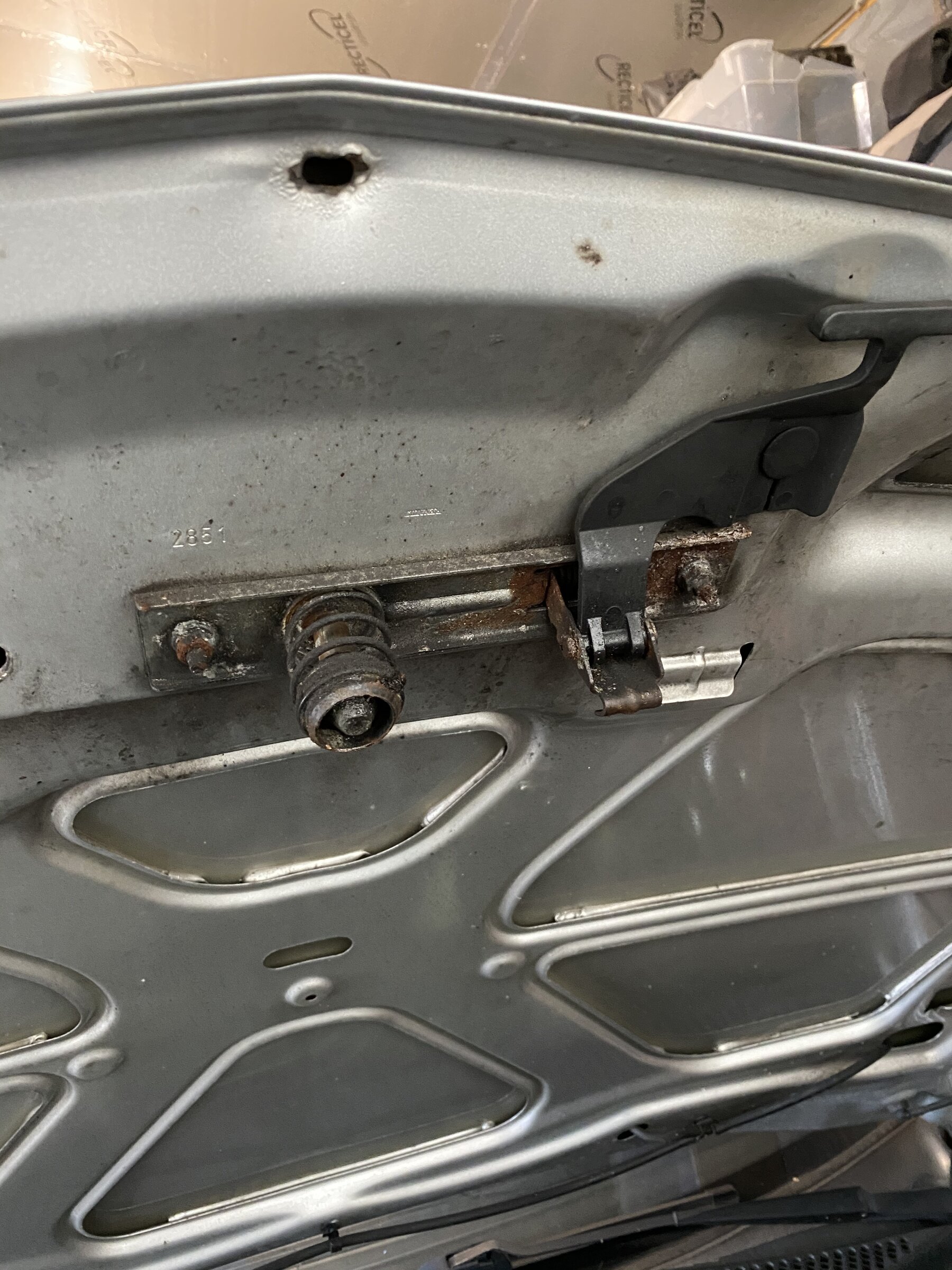

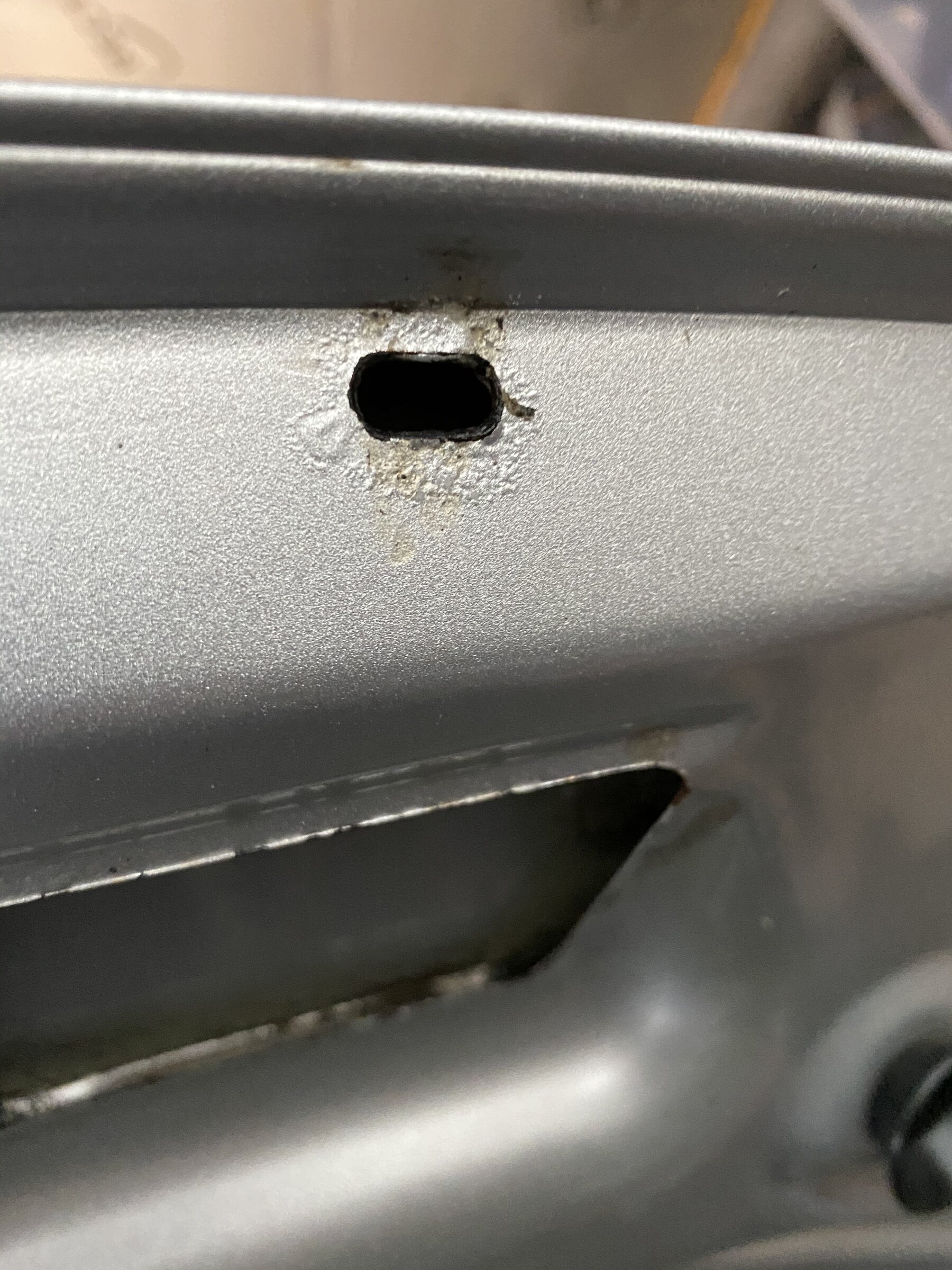

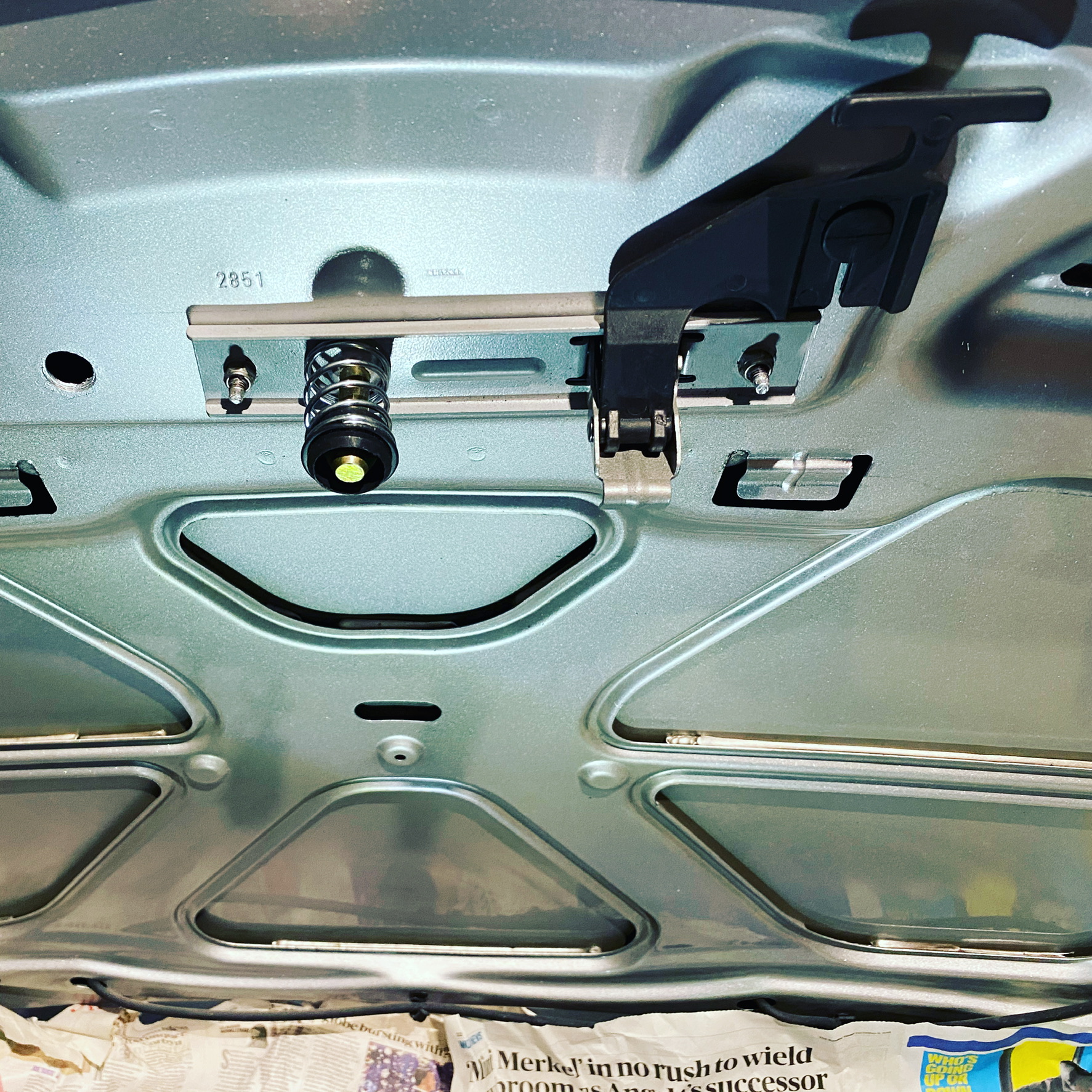

Next up I planned to swap the bonnet catch which was minging, however notice some small area of rust on the underside structure of the bonnet. Most of the cavity’s seem to have been waxoiled so I have no rusting on the actual bonnet skin. I’m tidying the localised rust spots now which has stopped me replacing the catch, whilst I’m at it I’m cleaning the bonnet up. Which will be the likely first stage of an under bonnet tidy.

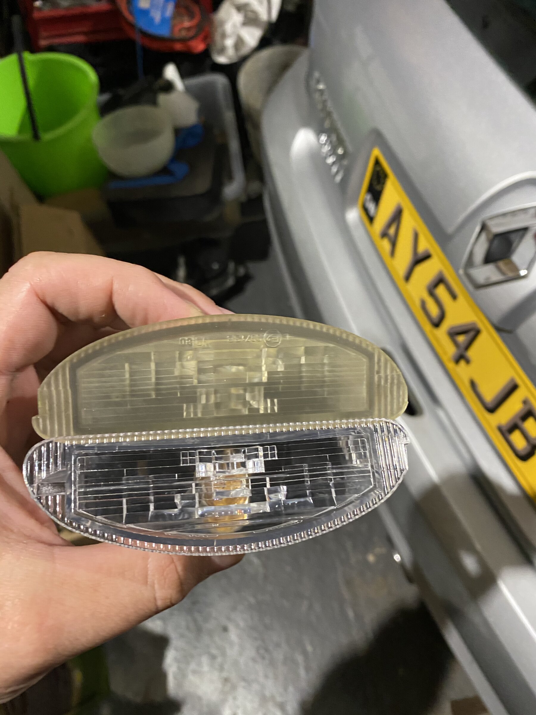

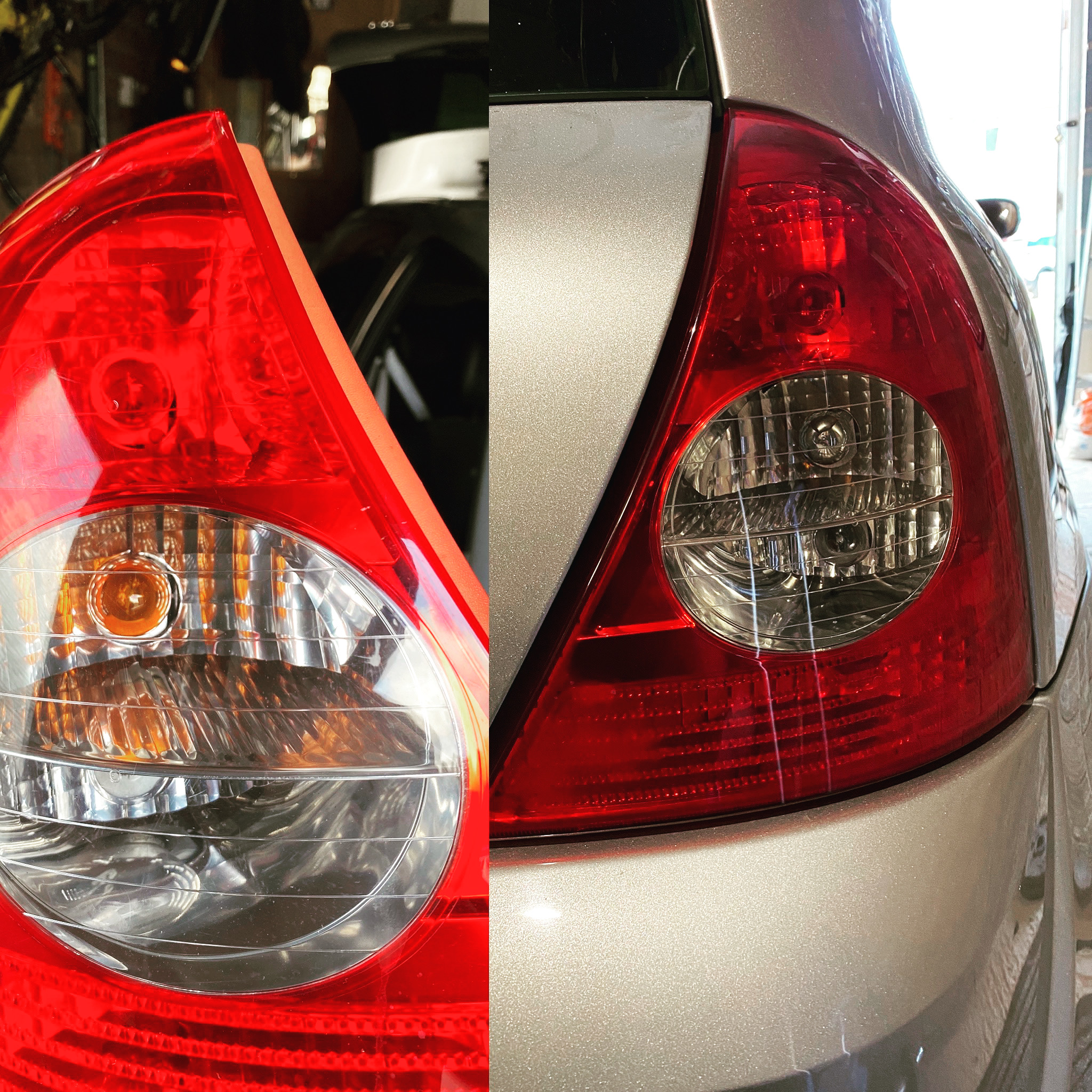

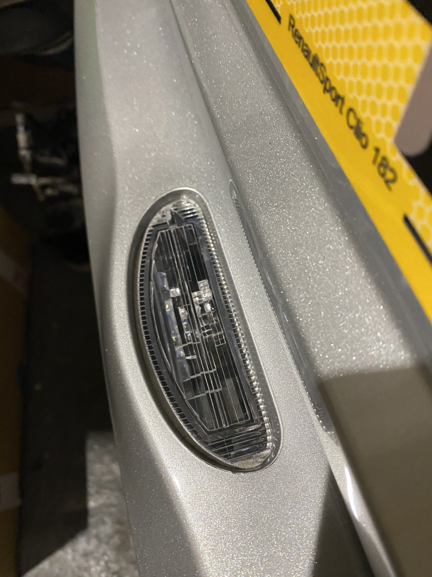

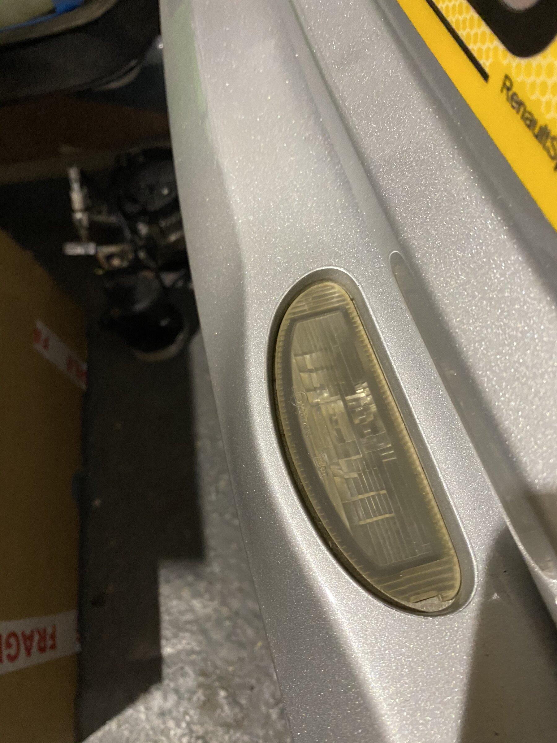

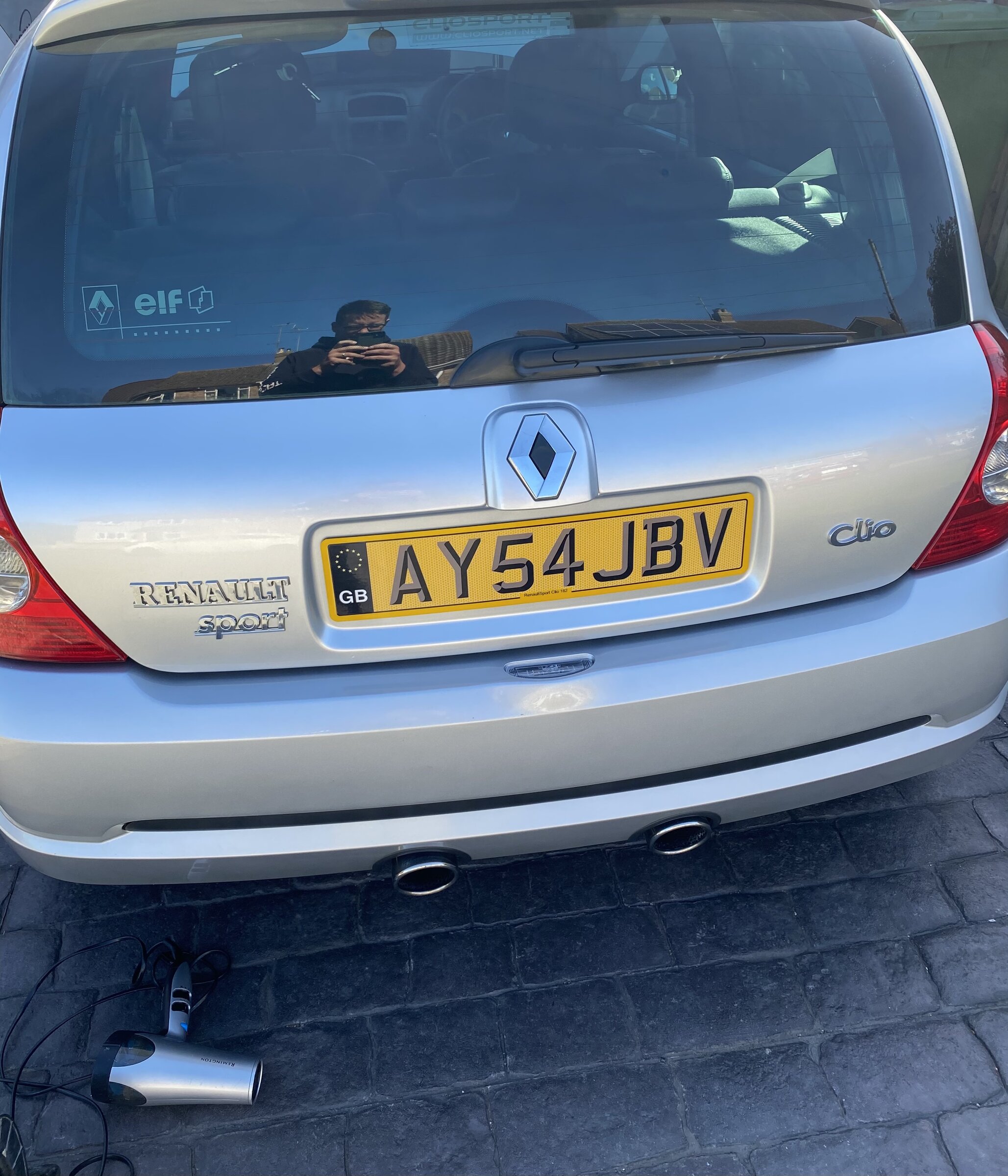

finally, the obligatory number plate light lens replacement. Always cleans a clio back end up nicely

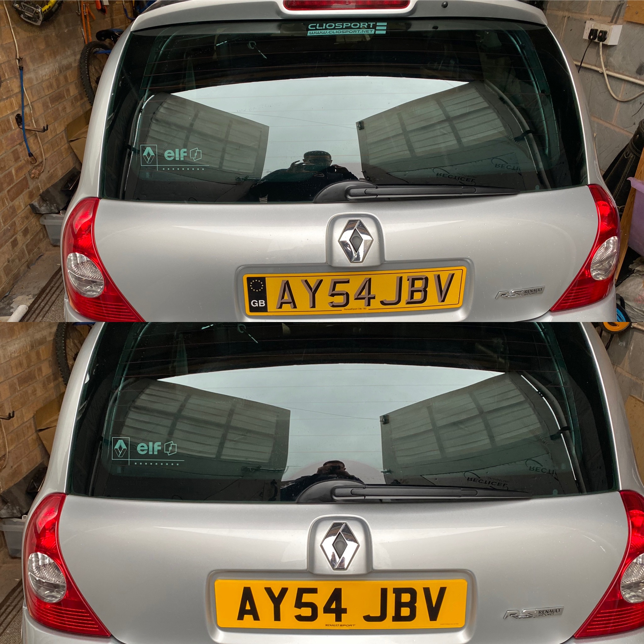

first up I had to get rid of this horrible fried egg bulbs in the rear clusters. Nicely I had been given a voucher by eBay so this little upgrade was free! Tidied up the back end massively. Also fitted a smaller aerial, I had been struggling to find a smaller aerial that fits the OE base properly.

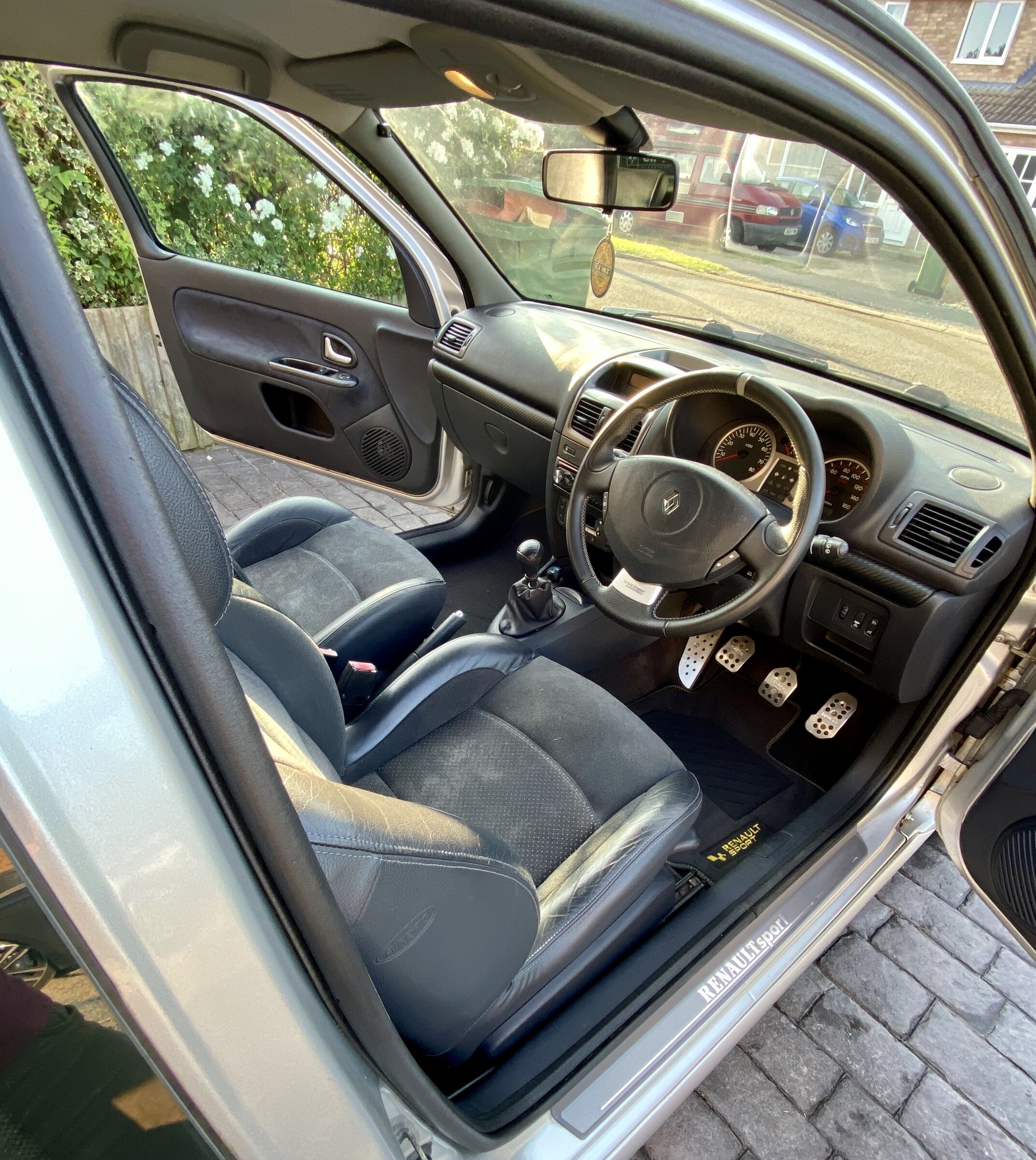

Moved inside the car next, fitted my new floor mats, my in-laws had bought me for my birthday, an alloy foot rest (long old story) and found my passenger side door speaker wasn’t working, so re-wired that (badly)
Finally removed all the bloody stickers, and cleaned the car for the first time. It came up really well. Gave it a coat of Maguiras ceramic wax and finished plastics with Autofineese plastic whatever it’s called.

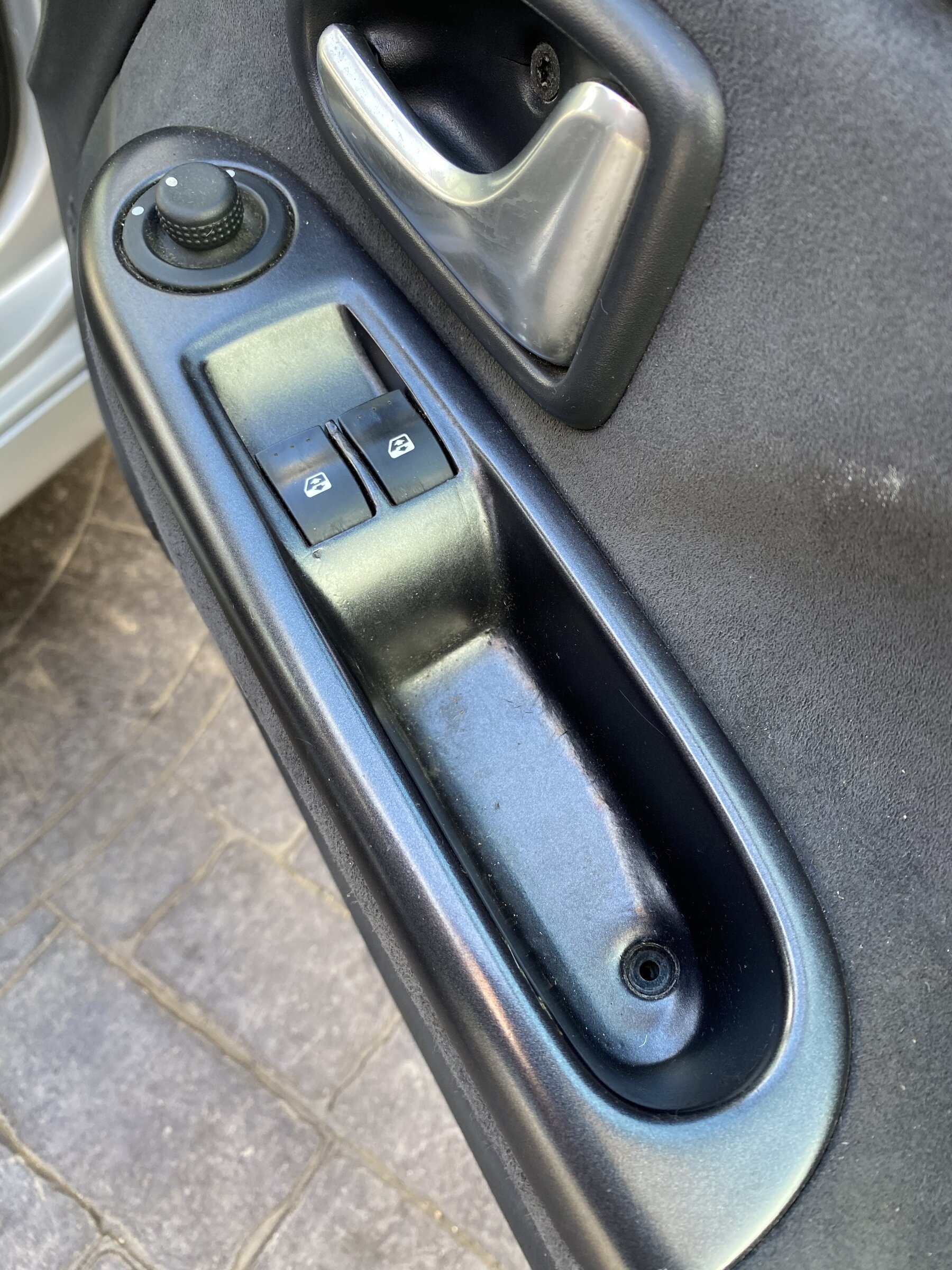

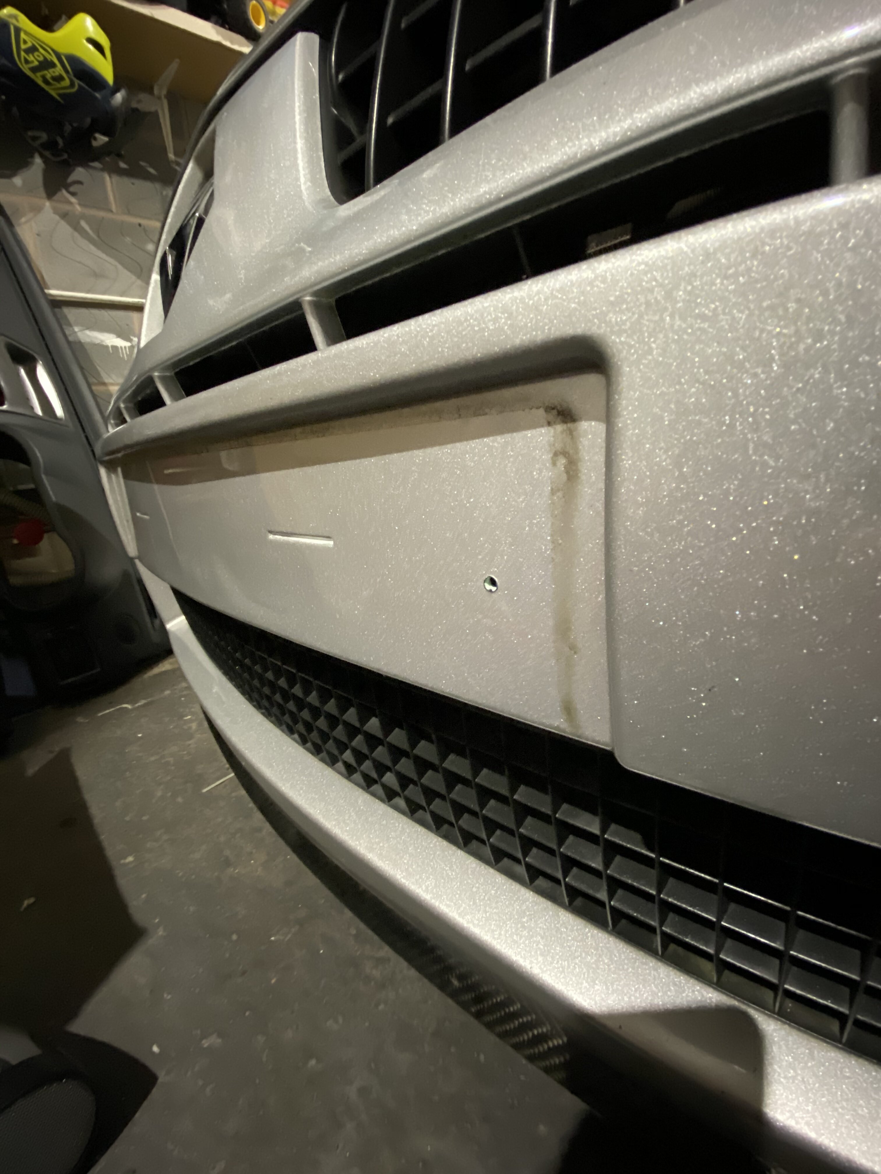

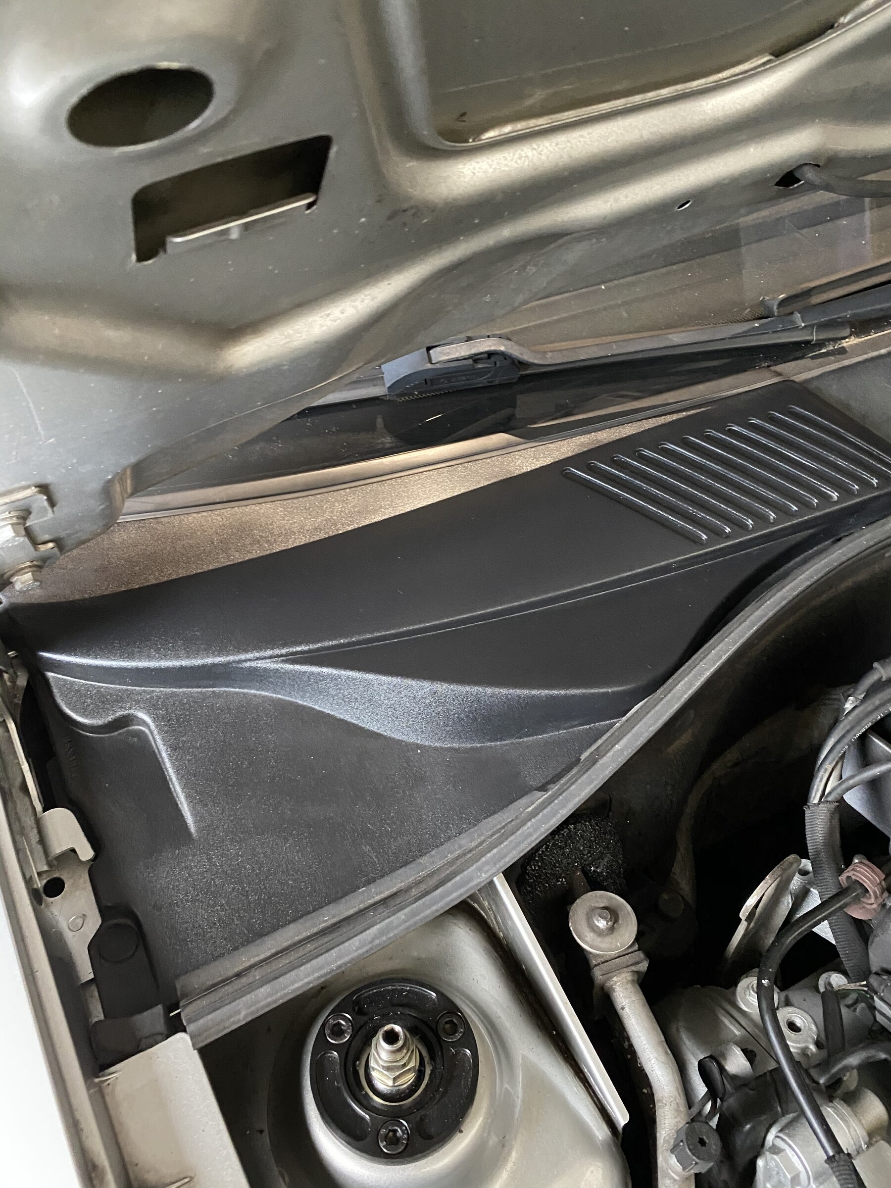

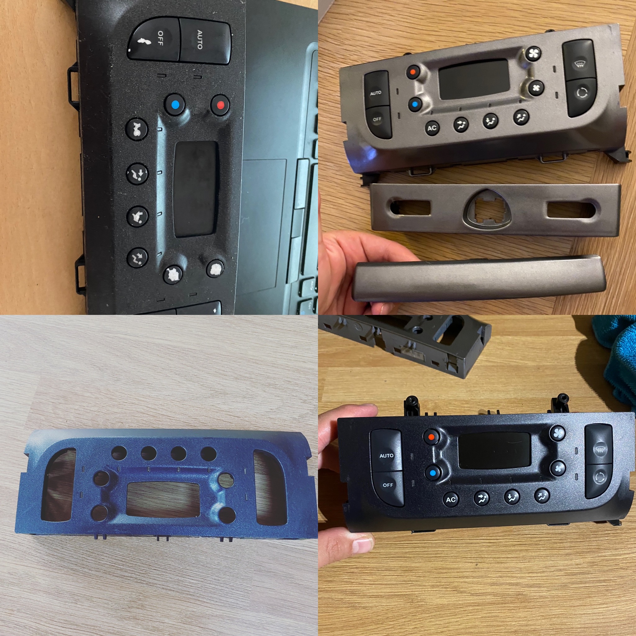

First up I have started the journey of reverting back to factory plastics. The previous owner had painted everything Anthracite. It actually looked ok in places, but the finish on the dash was not great. I managed to find a used top Dash, locally for free which once destickied was great, also picked up an interior plastics here for free and swapped out the door handles once they had again been treated to ‘elbow grease’ thanks to @Cads for supplying me a messy Climate panel, it meant I could actually make one good OE looking one for very little money indeed. I’m still missing the bit of trim that sits below the radio and a hazard panel, which I’ll hopefully sort of the coming weeks.

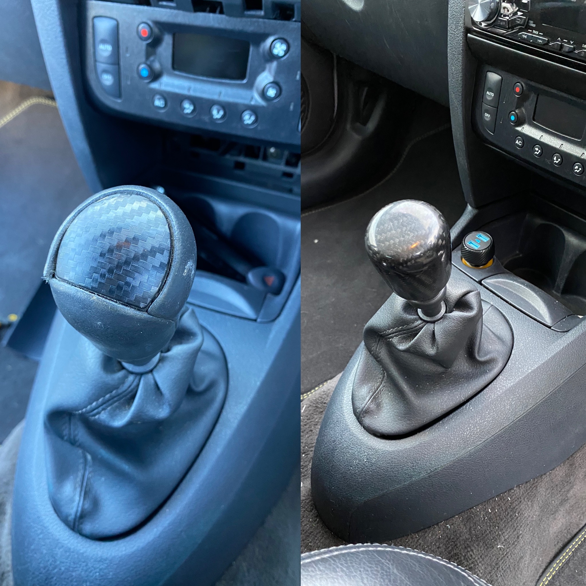

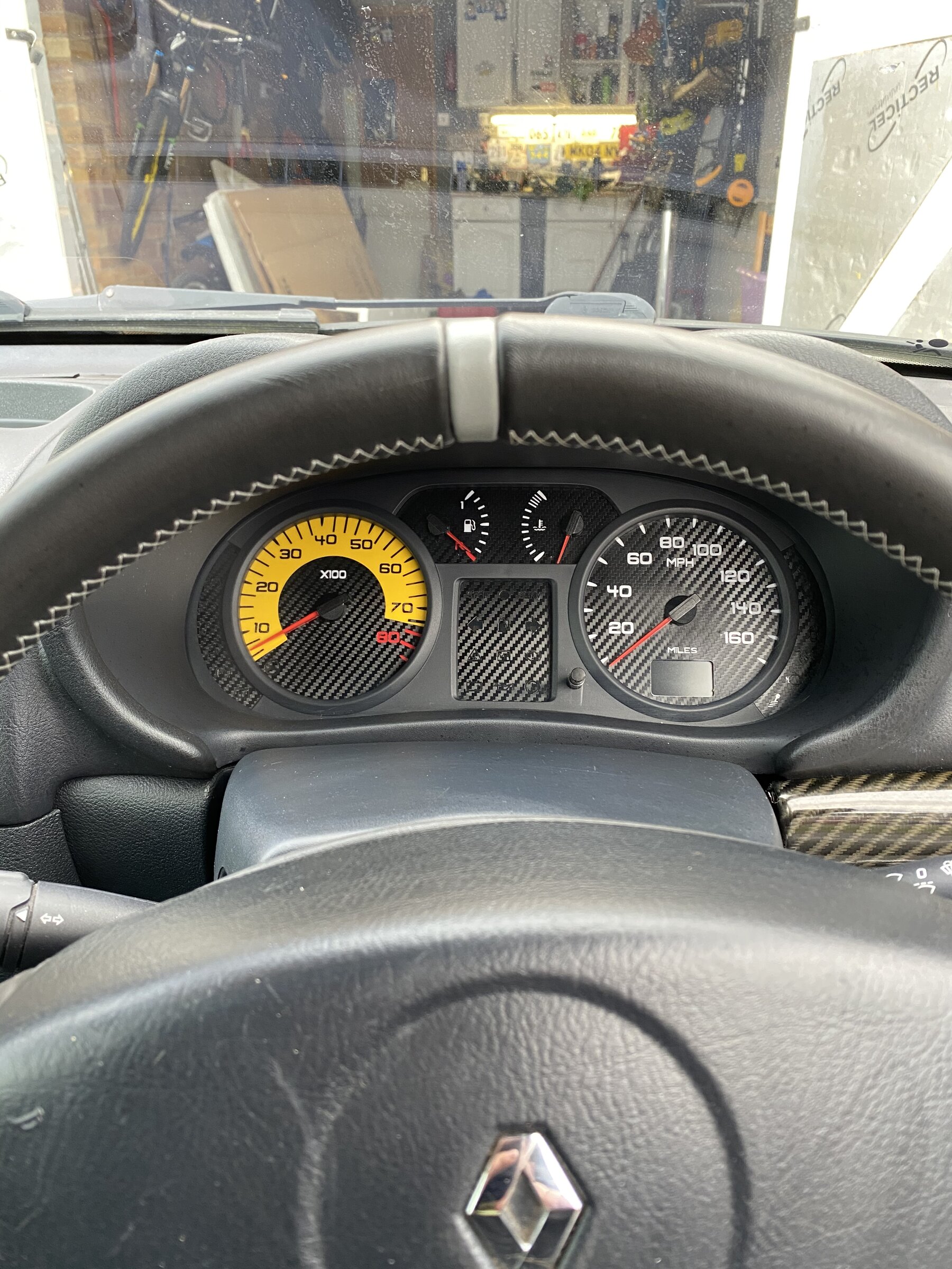

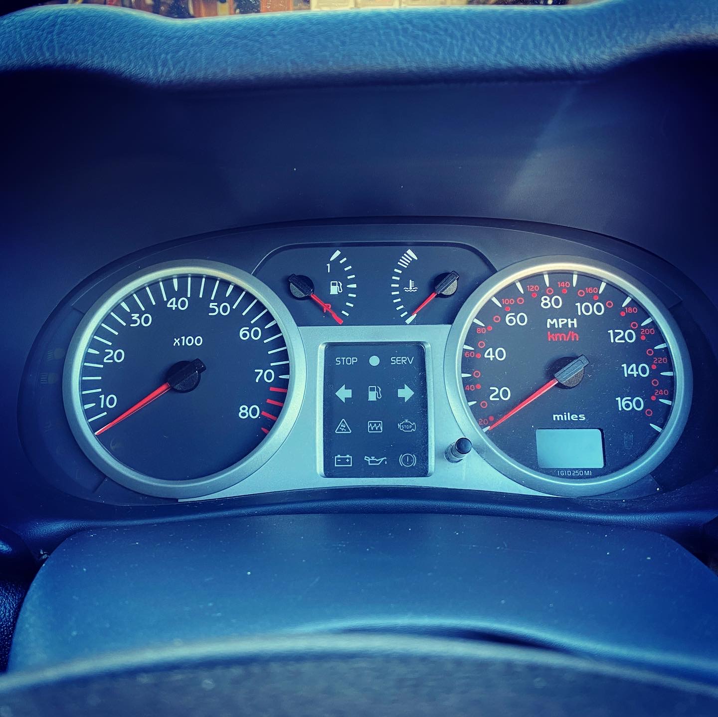

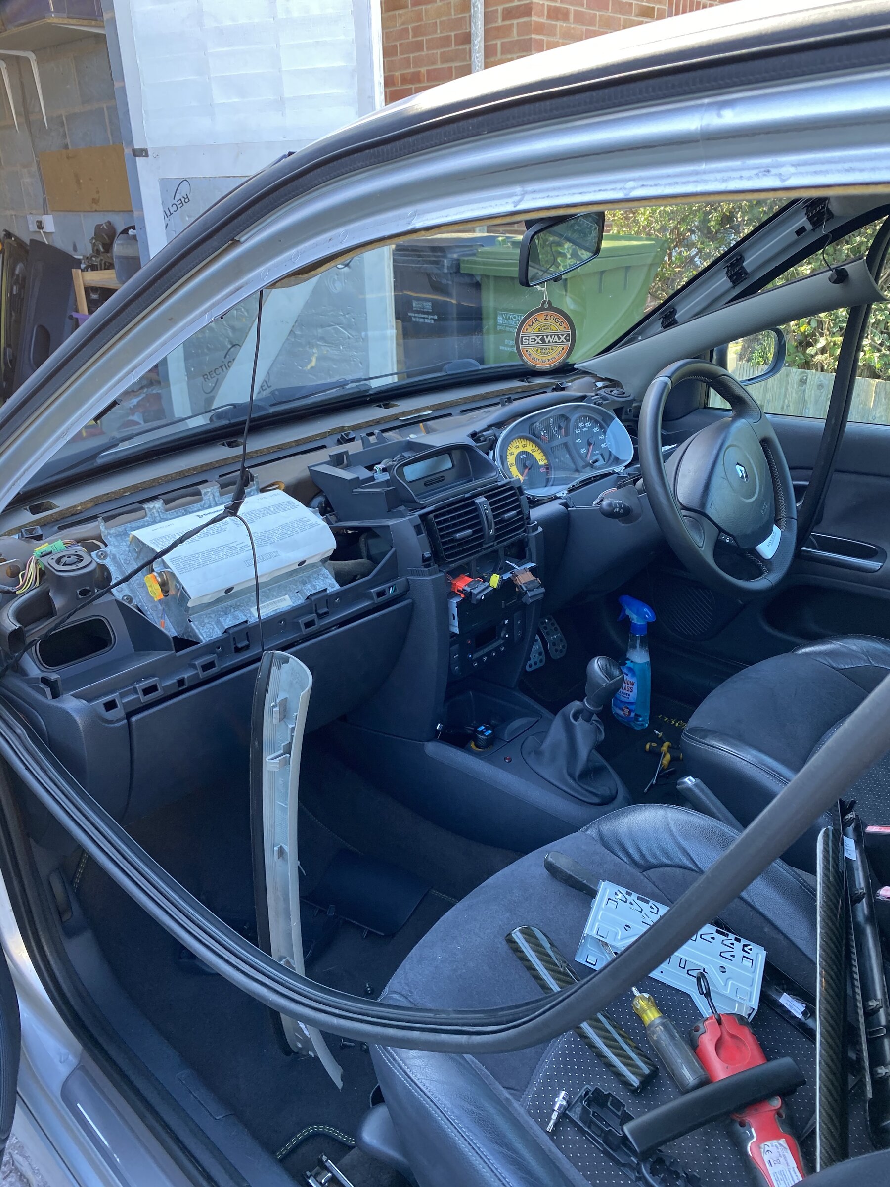

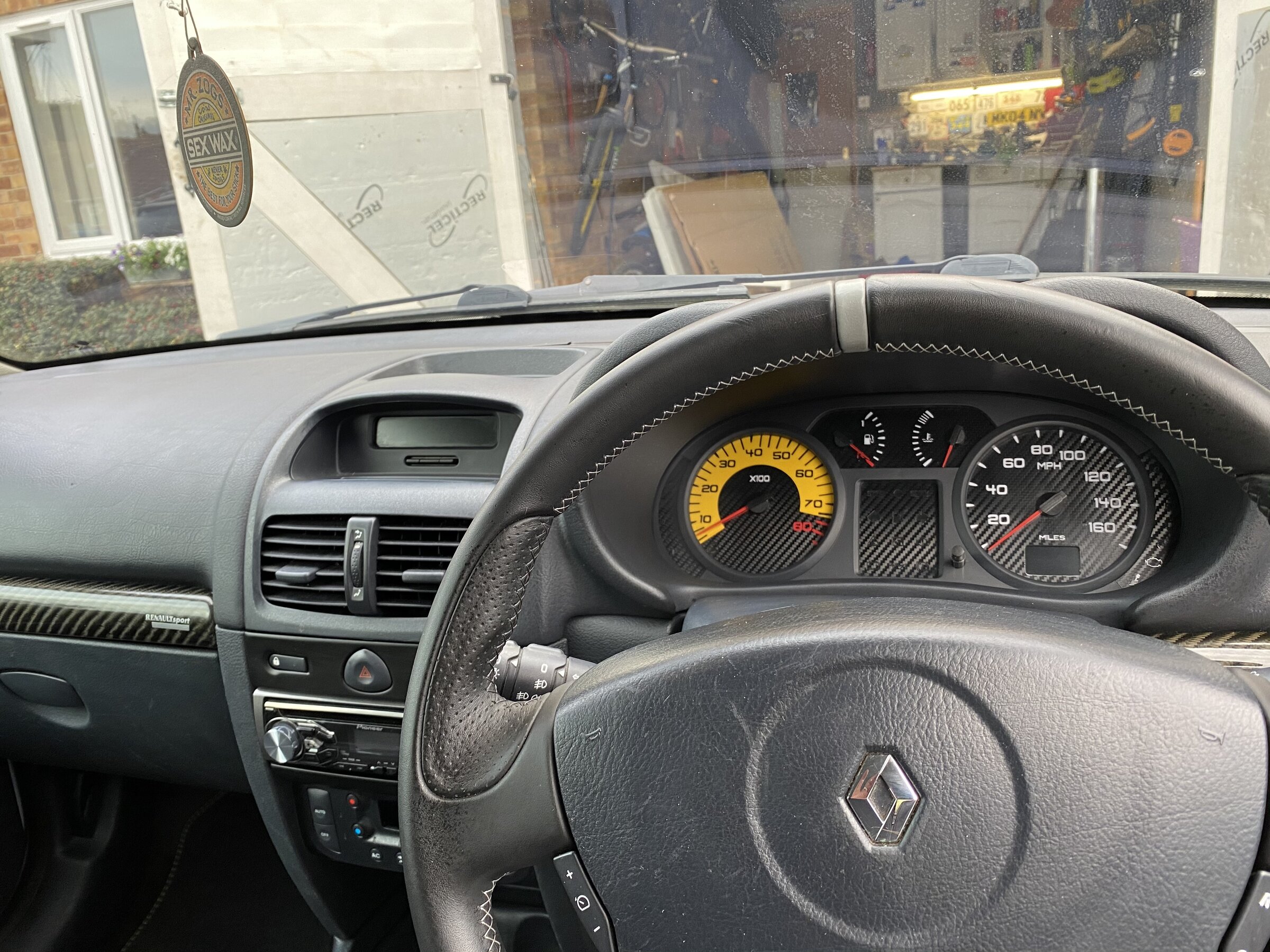

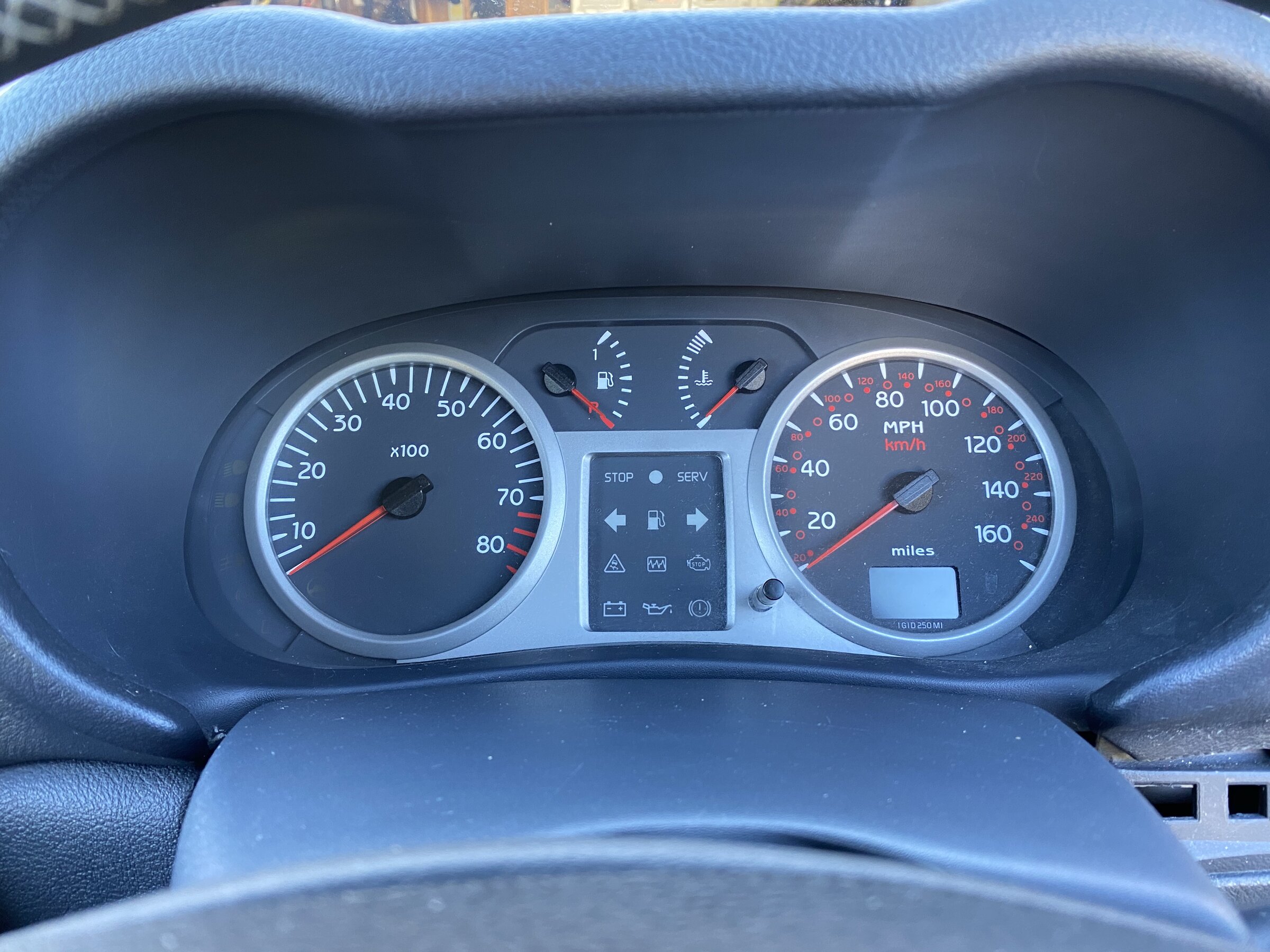

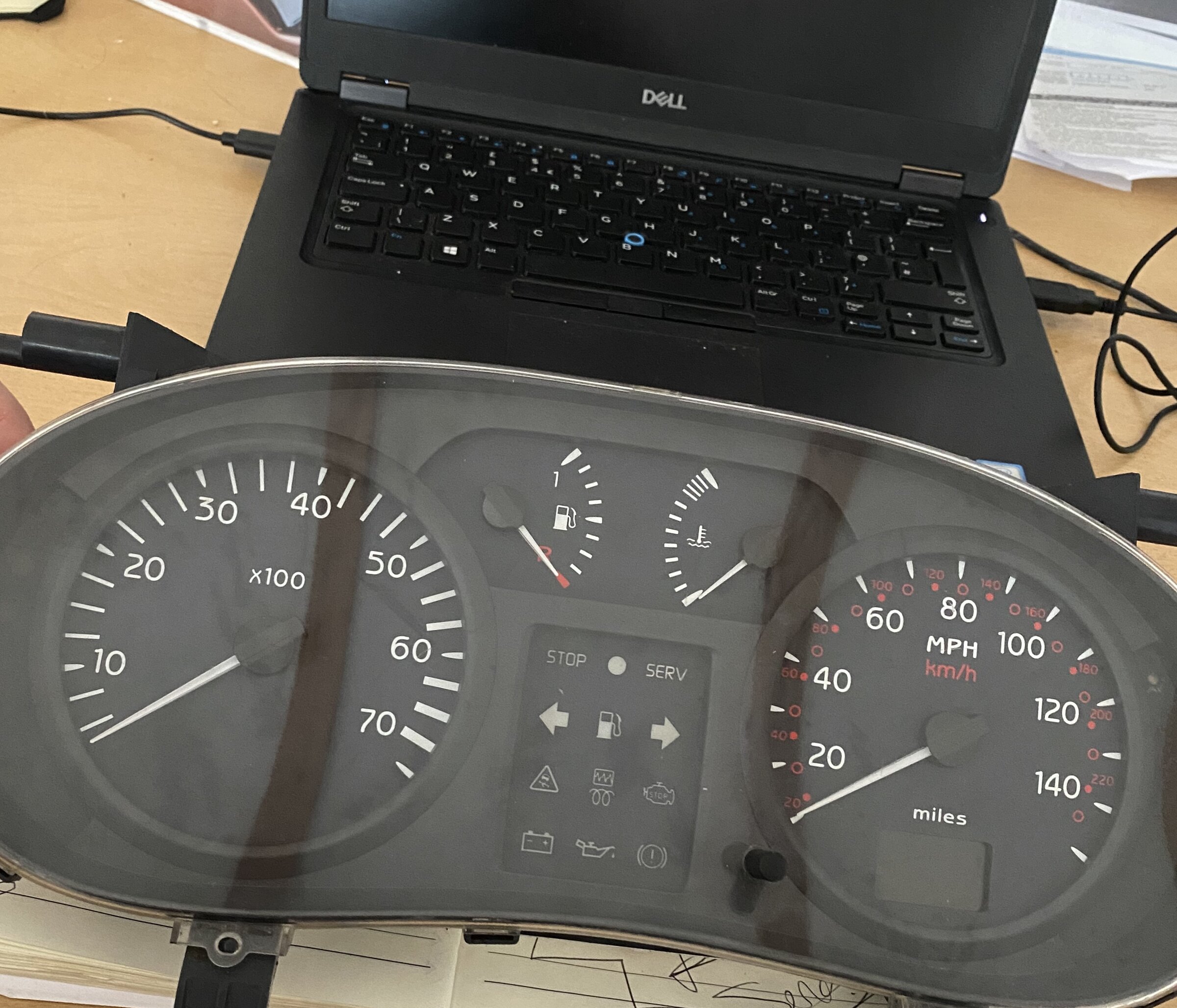

Whilst I had my top dash put I went about fitting my new dial kit I purchased off @Mbeau It came already fitted to a clock set, however I wanted to do things properly. So went about stripping the dials down. I had previously purchased a dial set from a base model clio as I prefer the matte black surround, so with 3 clock sets in pieces I managed to cobble together a pretty nice looking setup. I have to say I wasn’t initially sold on the look when the dials arrived in the post, but fitted with the matte black surround they look really, really good.
Finally on the interior front I fitted my real carbon dash inserts and my carbon gear knob my mate made for me. (Excuse the mess from fitting)

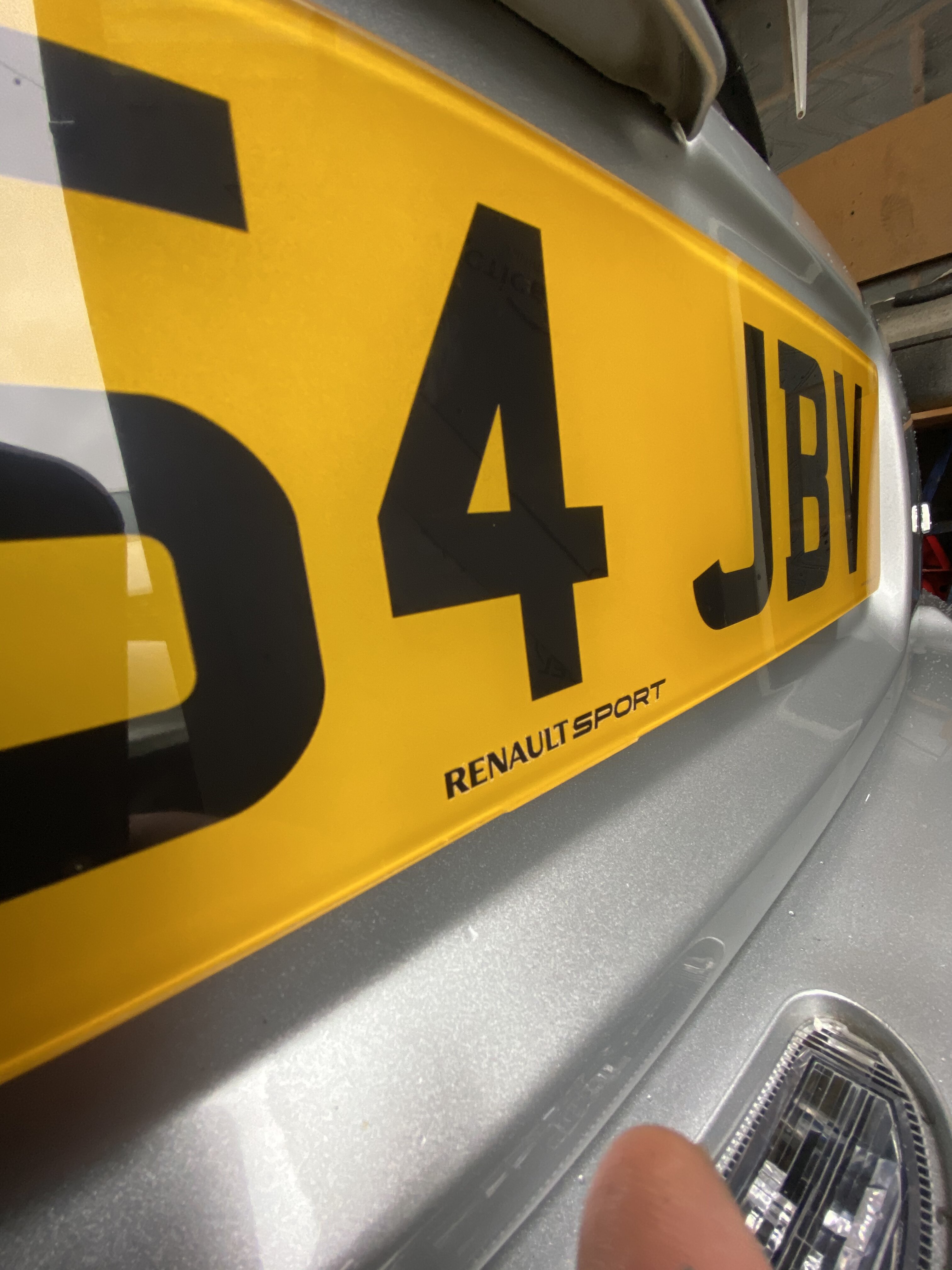

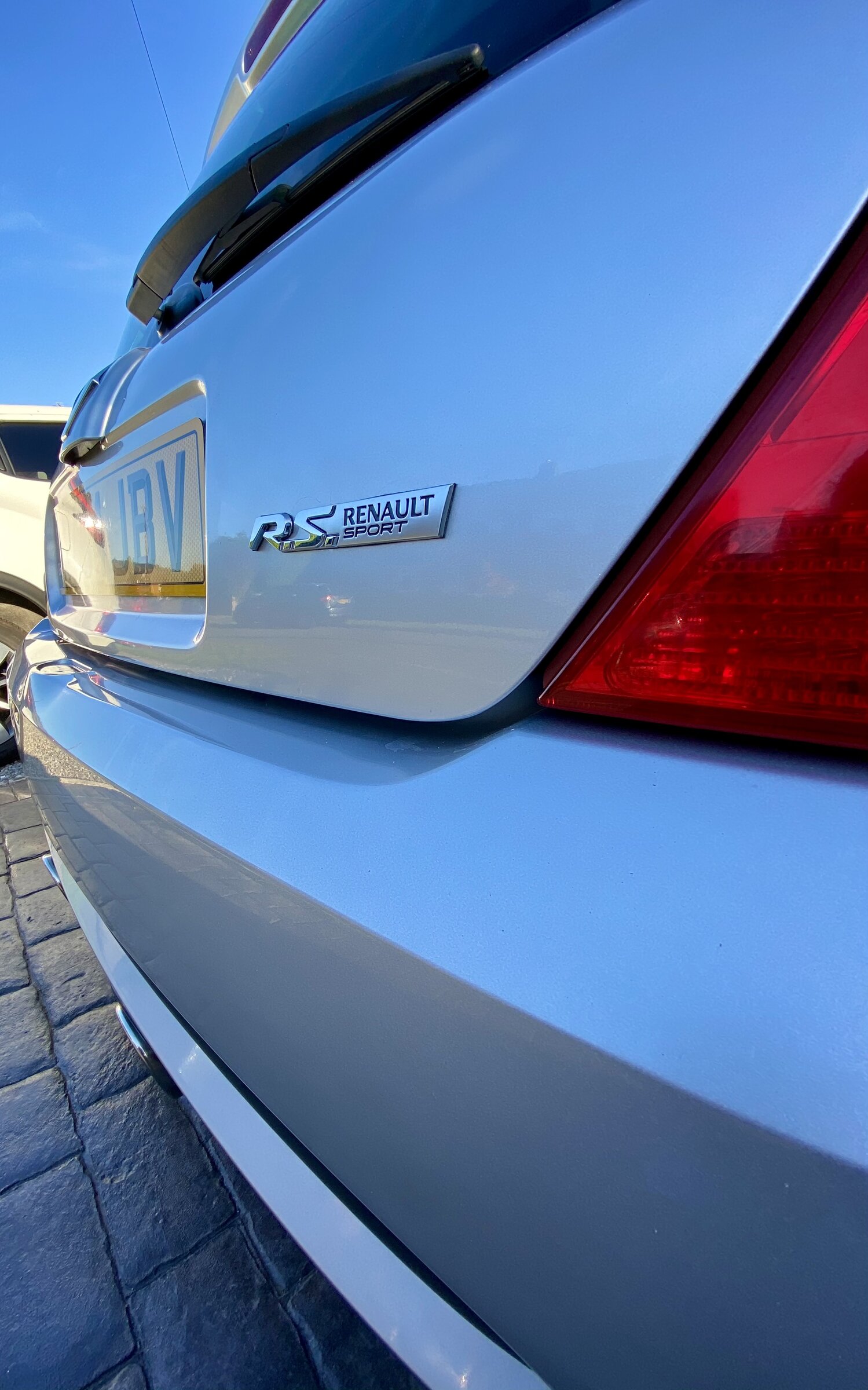

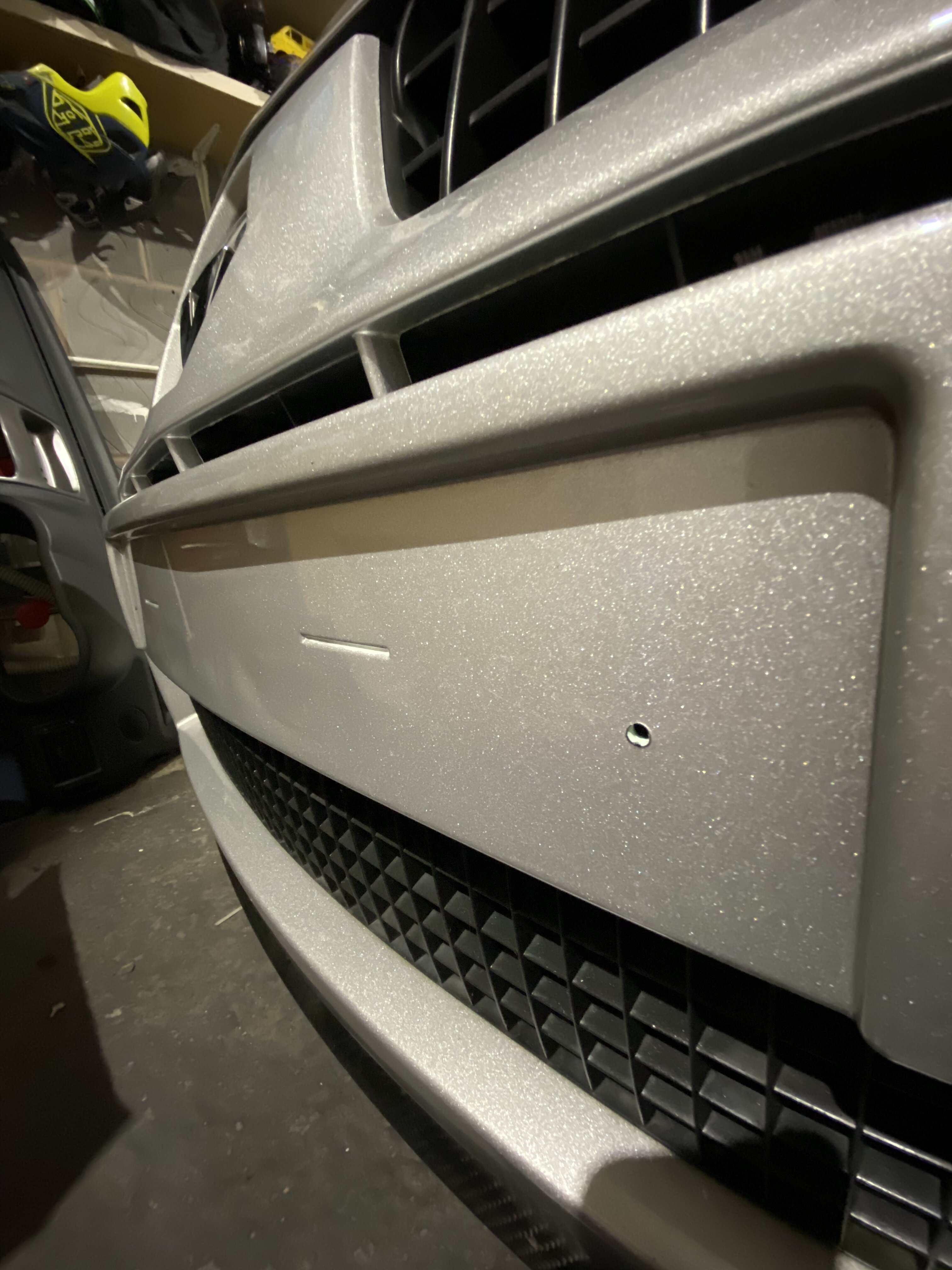

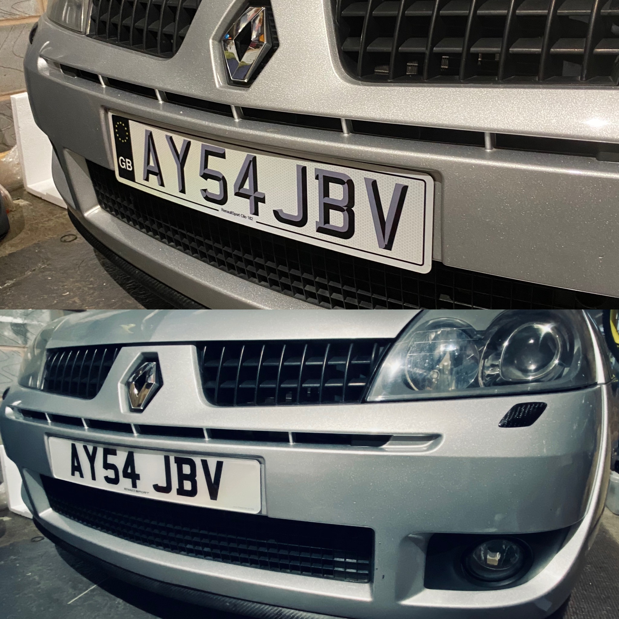

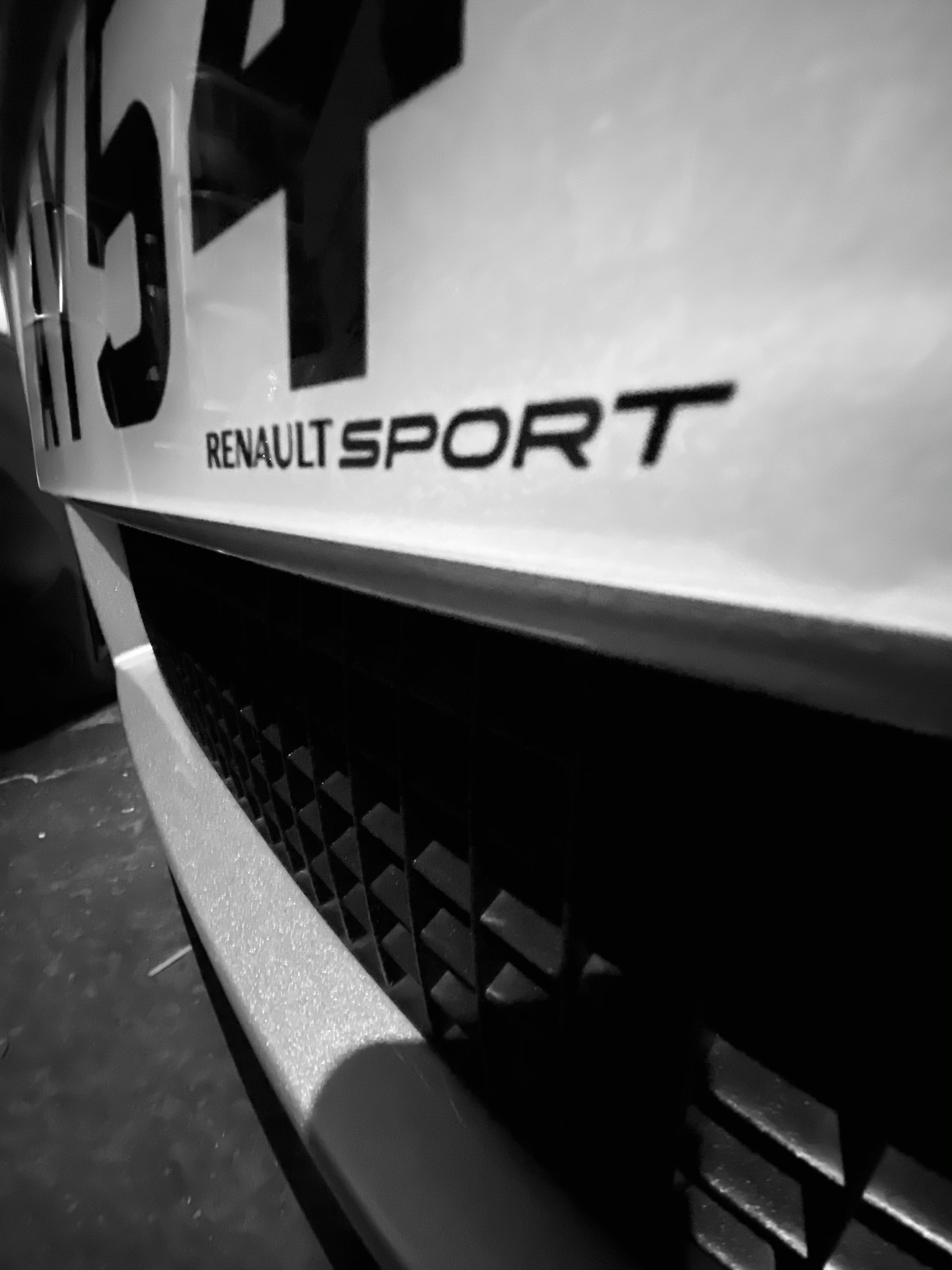

final job for the week was removal of the OE badges and fitment of a newer style Renaultsport badge. I prefer the cleaner look with less badges and stickers everywhere so pretty happy with that.

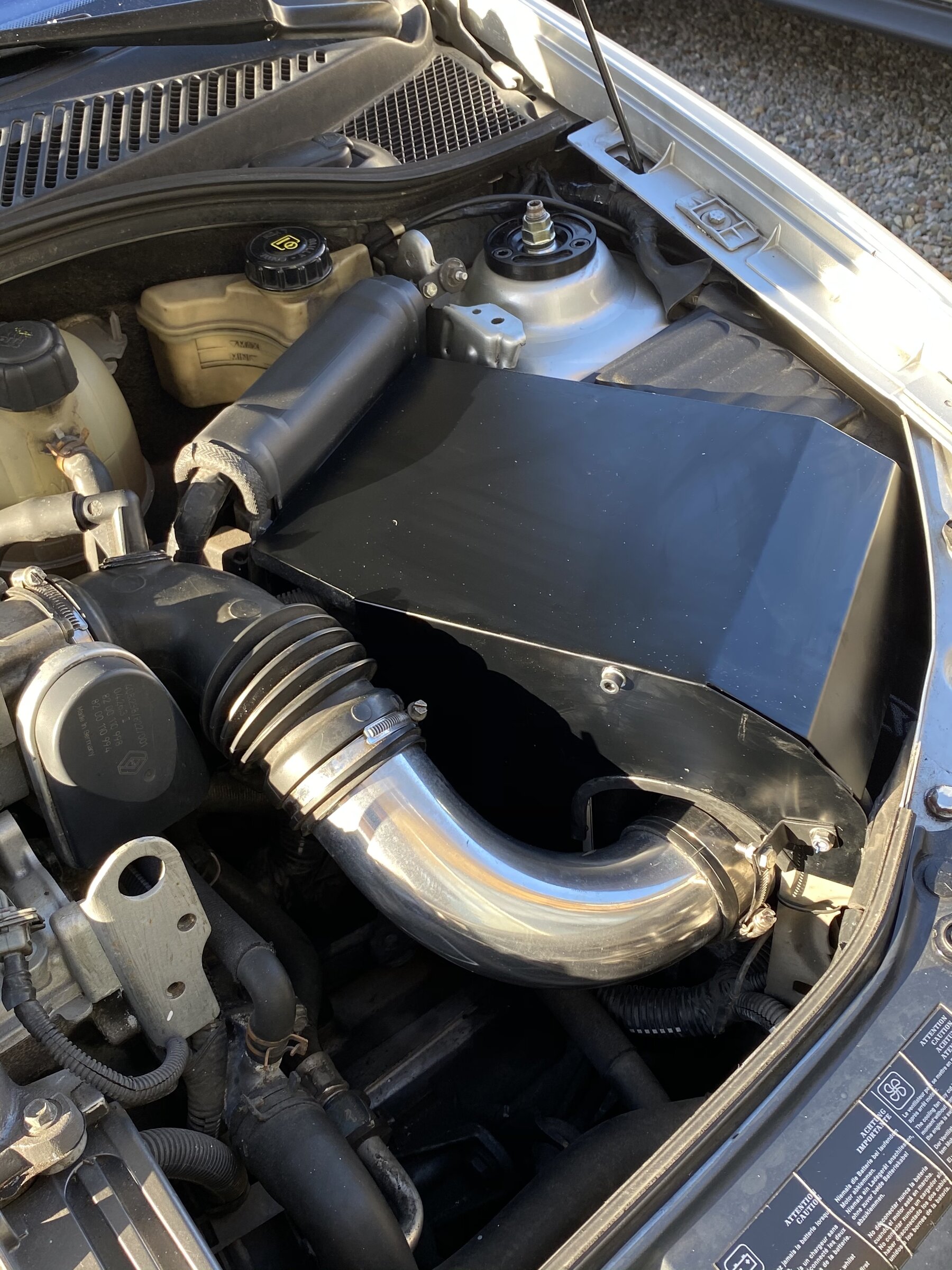

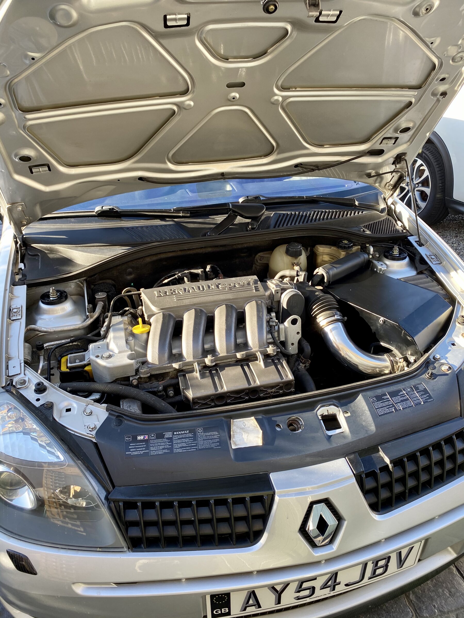

almost forgot...earlier in the week I had repaired all the spots of corrosion under the bonnet and fitted a new bonnet catch.
I will continue to tidy up under the bonnet over the coming weeks. Next upgrade will be some Proam exhaust brackets as mine look well past it and the exhaust is more misaligned than my teeth (I’m from Gloucestershire, so it’s a genetic thing) oh and new number plates are ordered!! I can’t cope with how busy the current ones are on the car!!

Just realised looking at my pics I have put the bloody needles in the incorrect position 😂😂 that will be the dash out again then! What a complete plank!
also noticedI didn’t embed all
My photos properly and missed the edit cut off! Annoying!

Coming along nicely mate. Cluster surround’s on my list - easy enough job?
Really easy mate. I paid £10 delivered for a set of 1.2 clocks. It’s a 5 minute job once you have the dash top out! Which of you have never done before is worth doing as it’s normally filthy behind there!

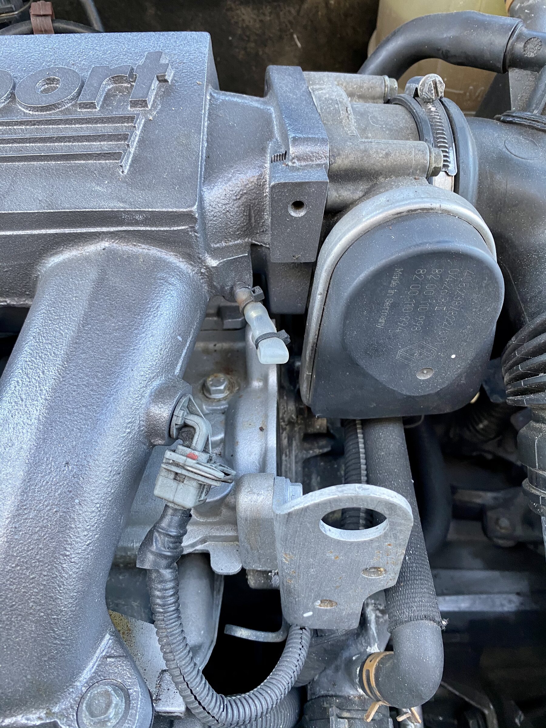

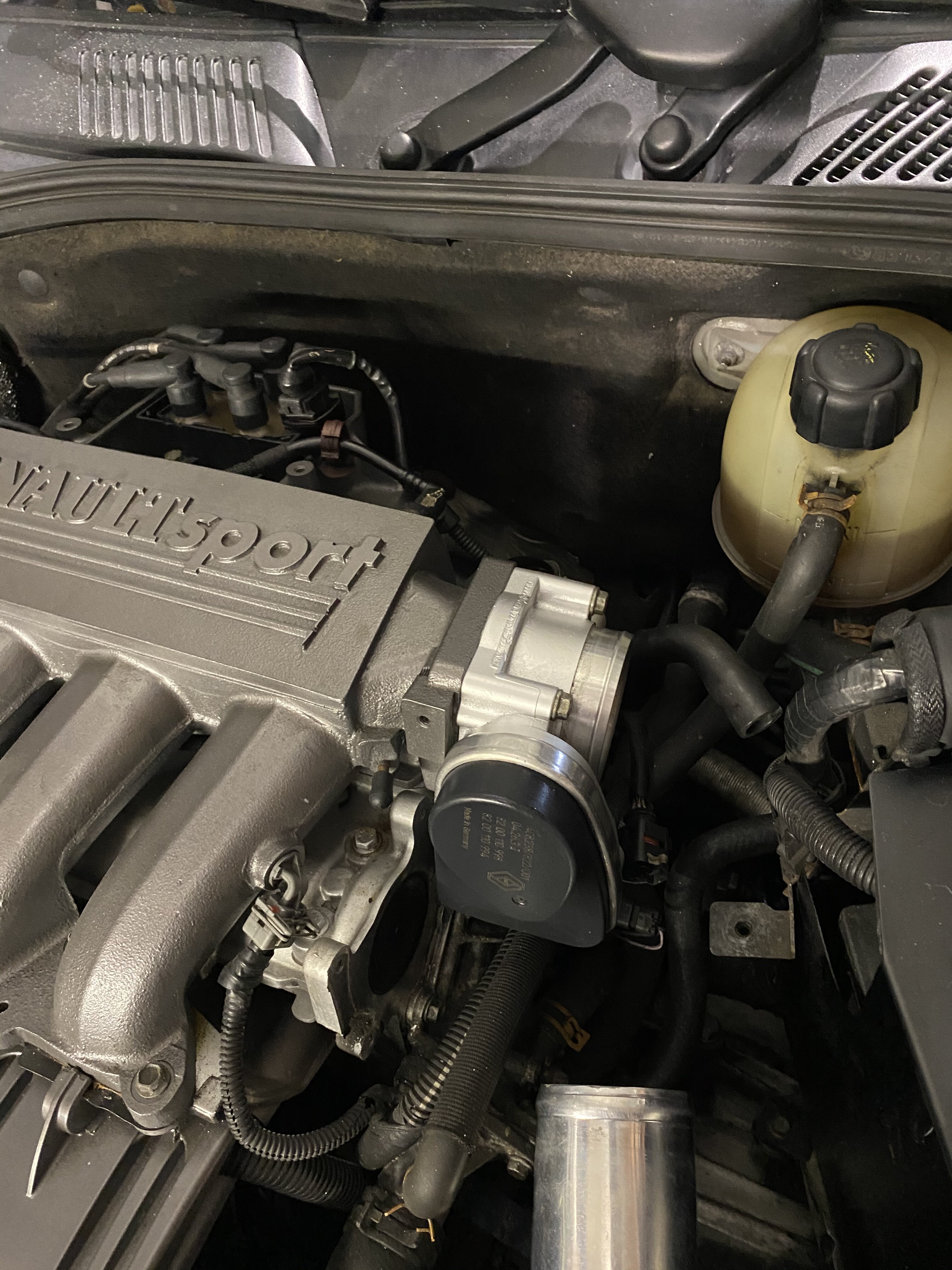

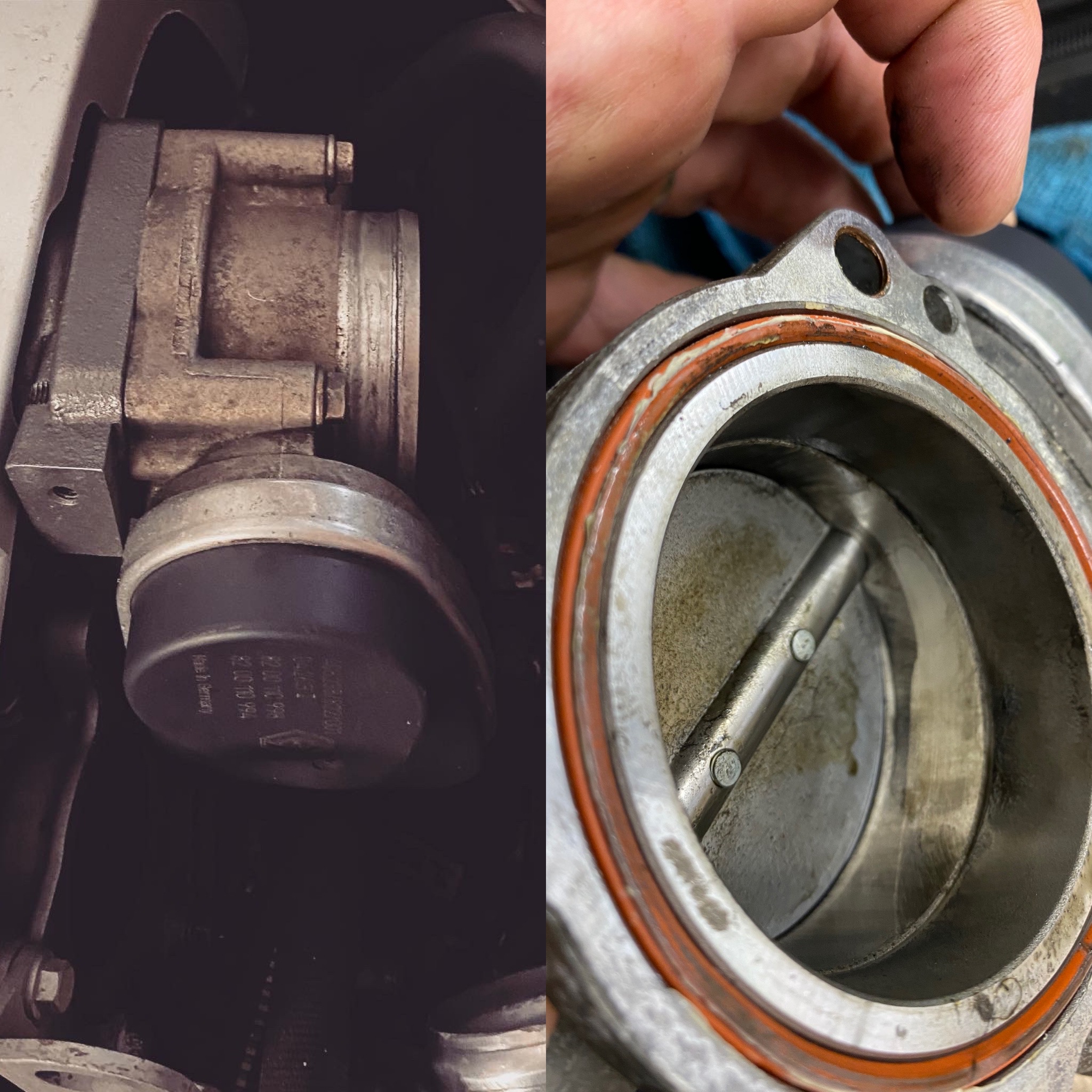

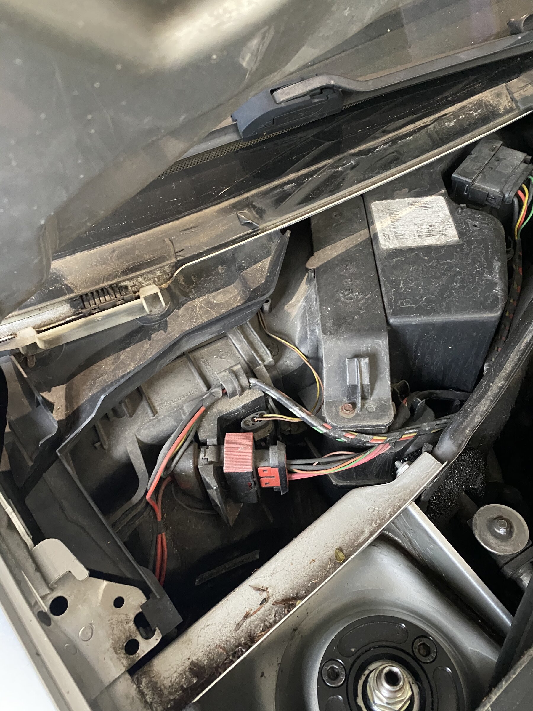

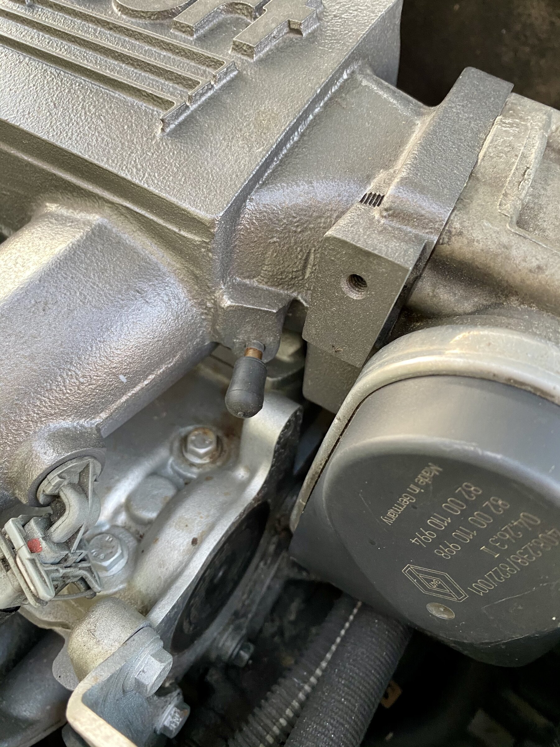

Not a huge amount to report this week, work on tidying the engine bay continues. Throttle body was next on the agenda, aged of the delivery of my new induction kit from JMRS. I was happy to see the TB internals relatively clean (my last car it was like a smokers lungs) a quick wipe around with carb cleaner to care of the muck present. Then masked up and gave it a lick if VHT silver paint, followed by Autosol polish of the ring (sounds wrong) came up really well. Whilst I was there I remove the engine lift eye and gave that a proper rub down and repaint as the previous finish wasn’t great.
(yes you have a new header bottle and yes it will be fitted soon)

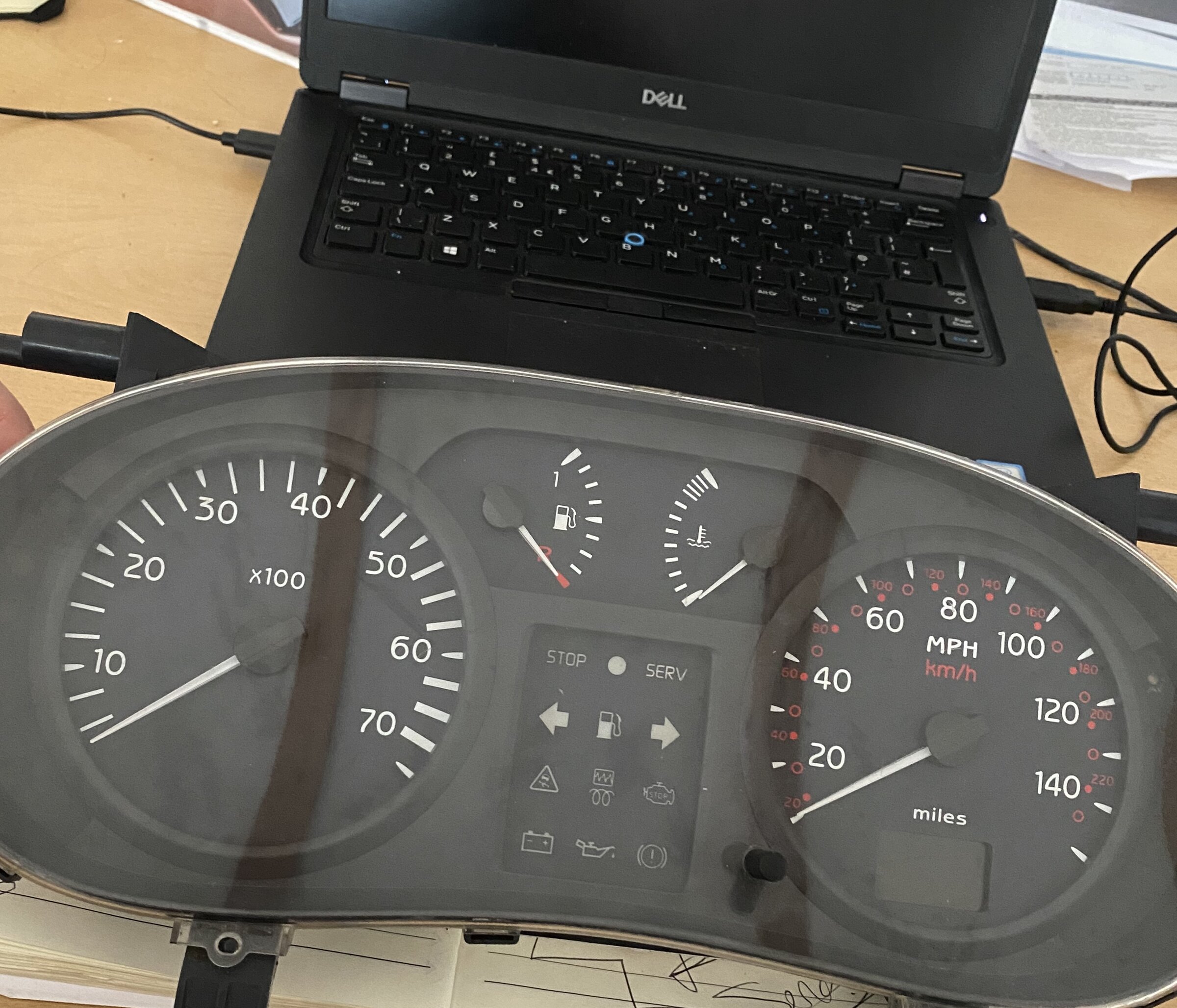

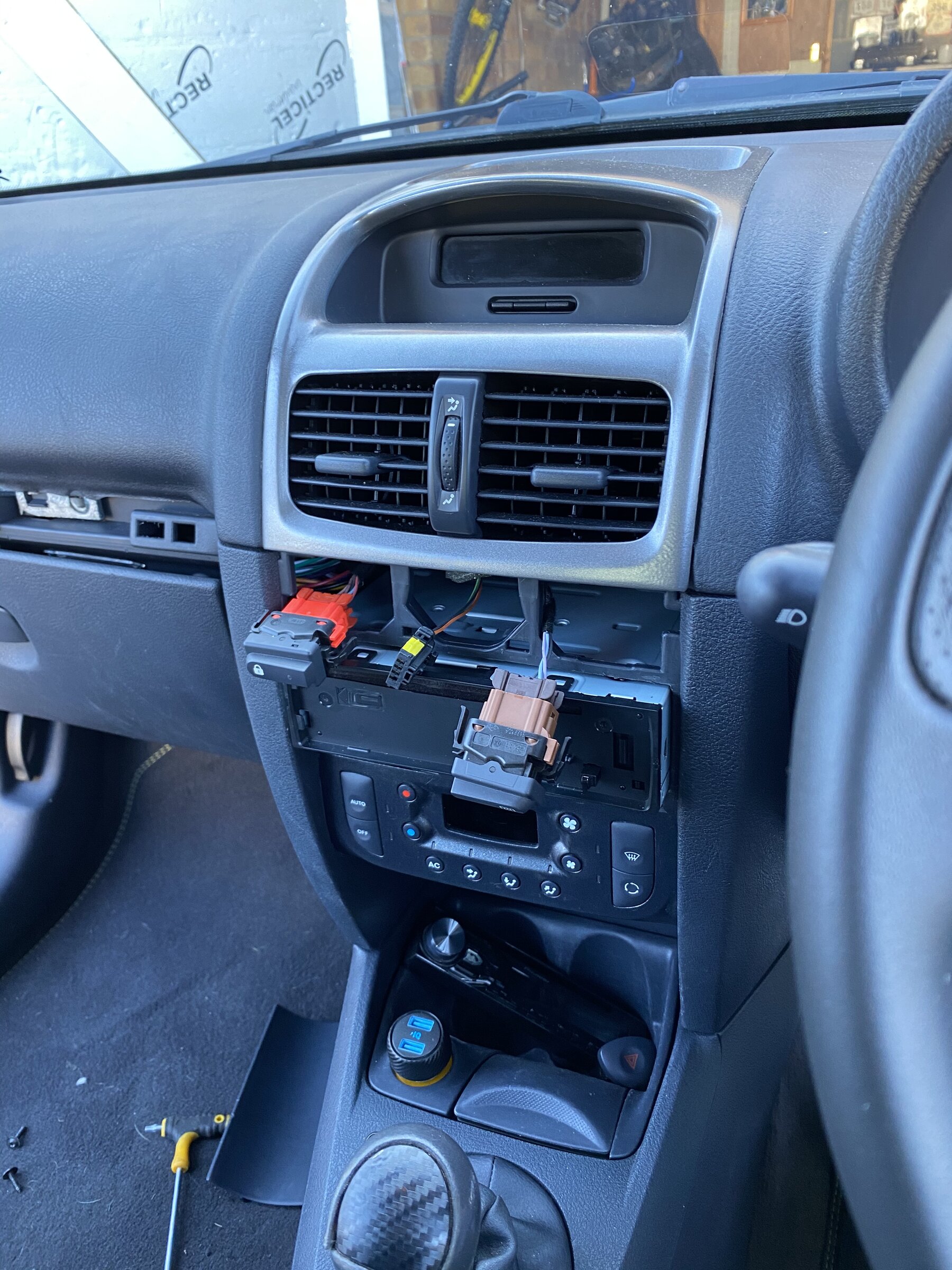

Oh and I had the Dash out of the car again fixing the clocks, I’m a complete nugget and in my excitement to get my new dial kit in I managed to reinstall the fuel cage needle about a cm below the minimum line, the temp gauge at about the temperature of a McDonalds apple pie and let’s just say 0-60
Would’ve taken a while. All now sorted!
