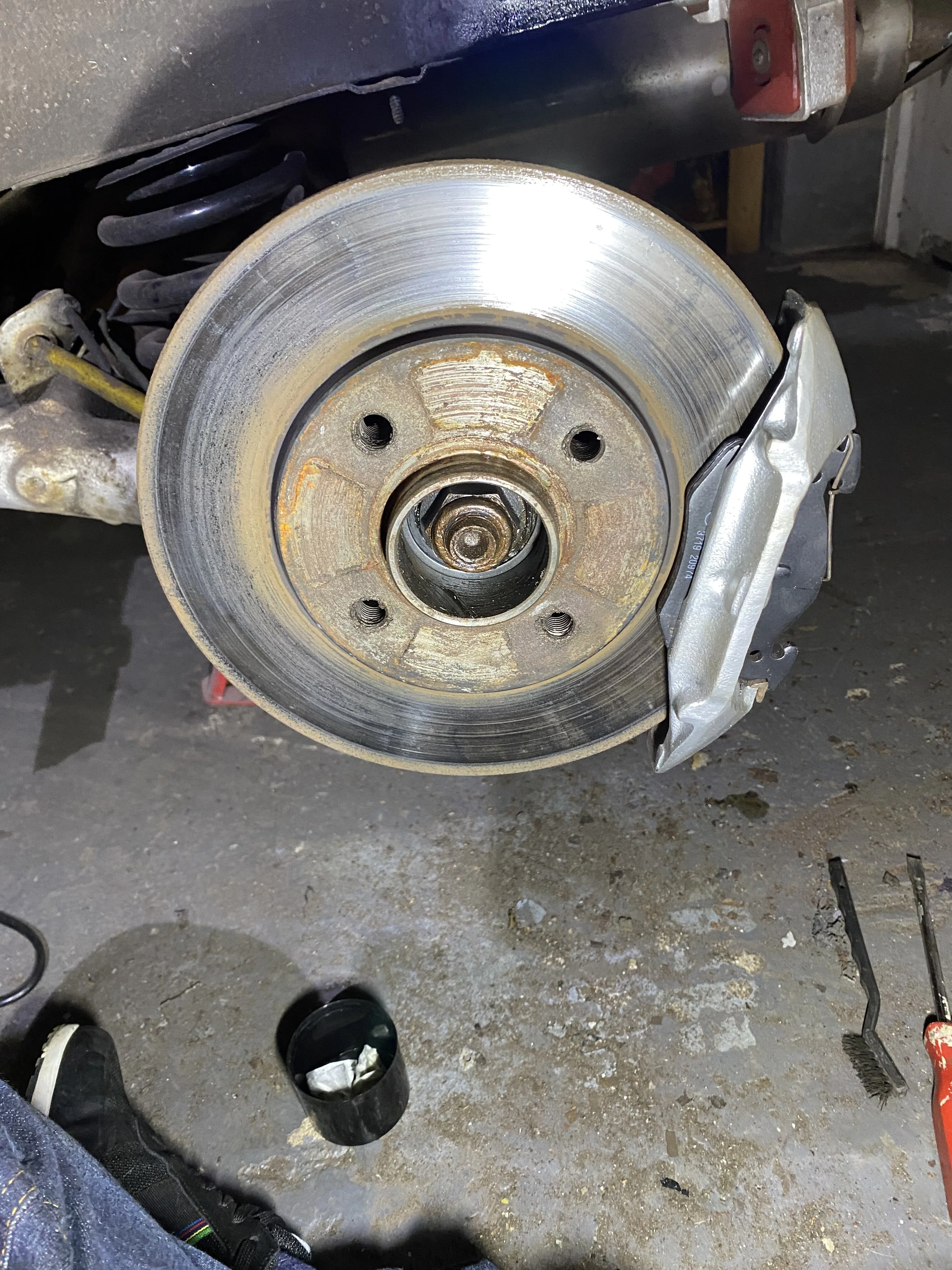

Well couple of weeks since last update. Car is now back together properly and on its wheels.

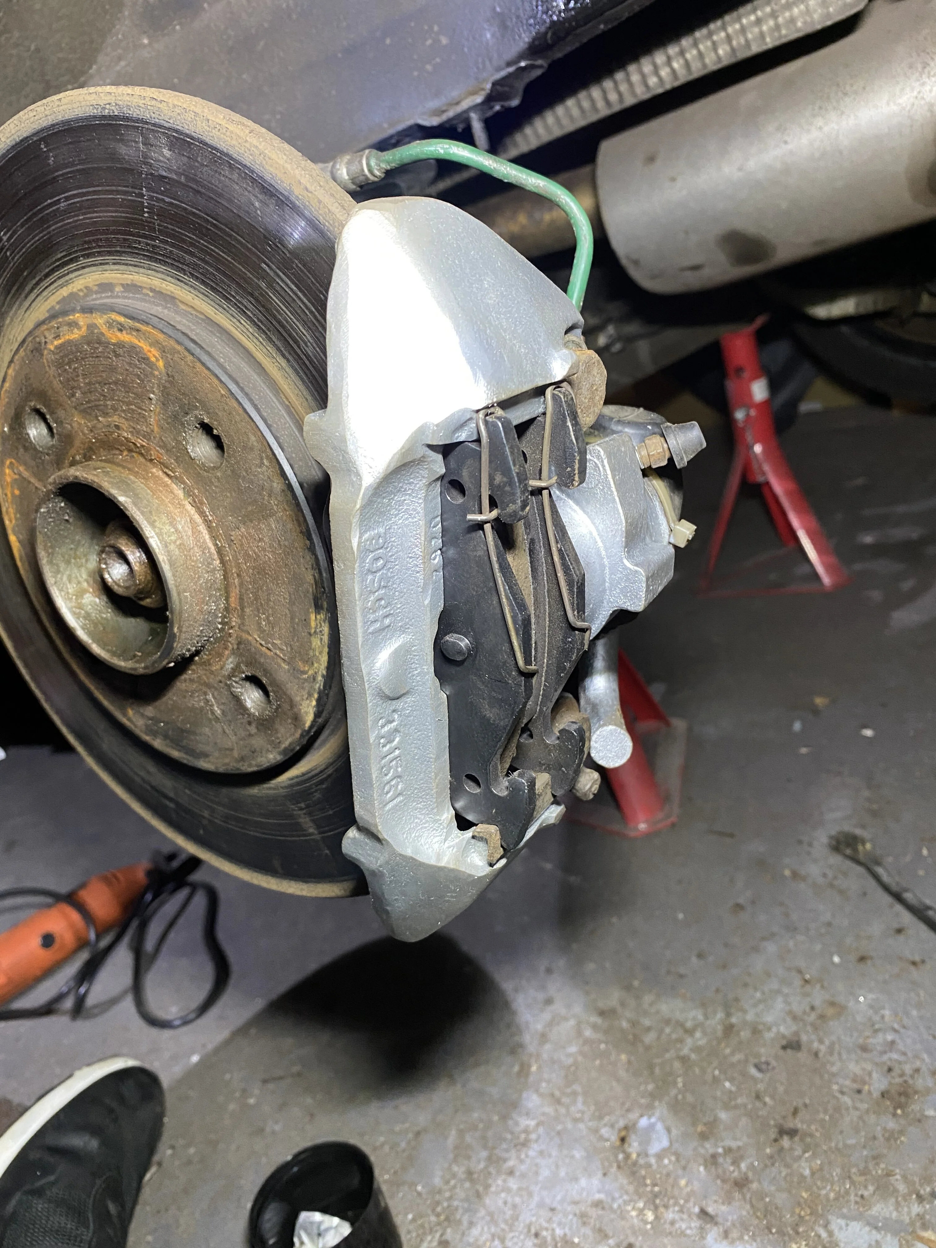

I replaced the rear brake pads with a new pair of Brembo’s as the set on the car were pretty grotty.

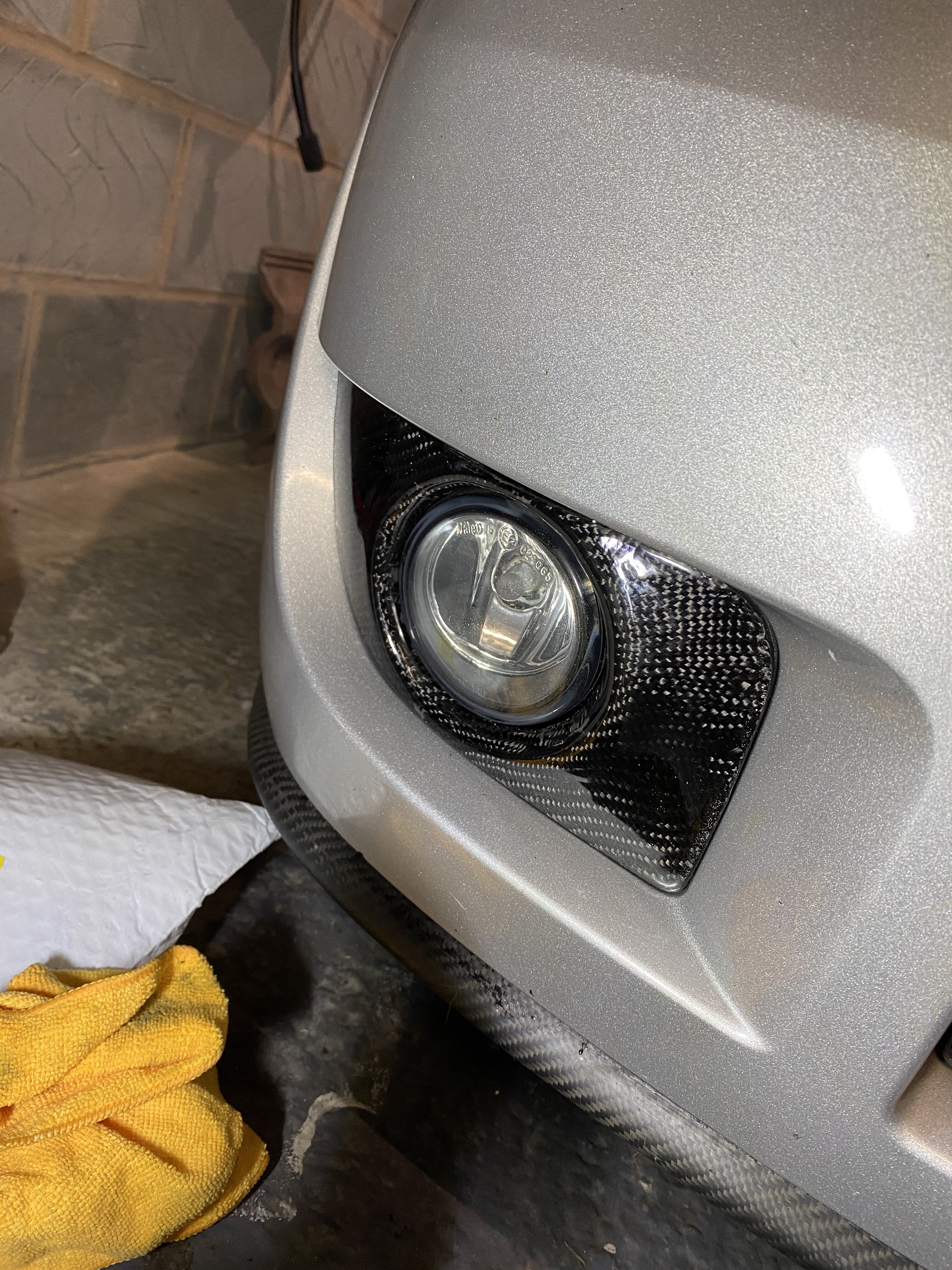

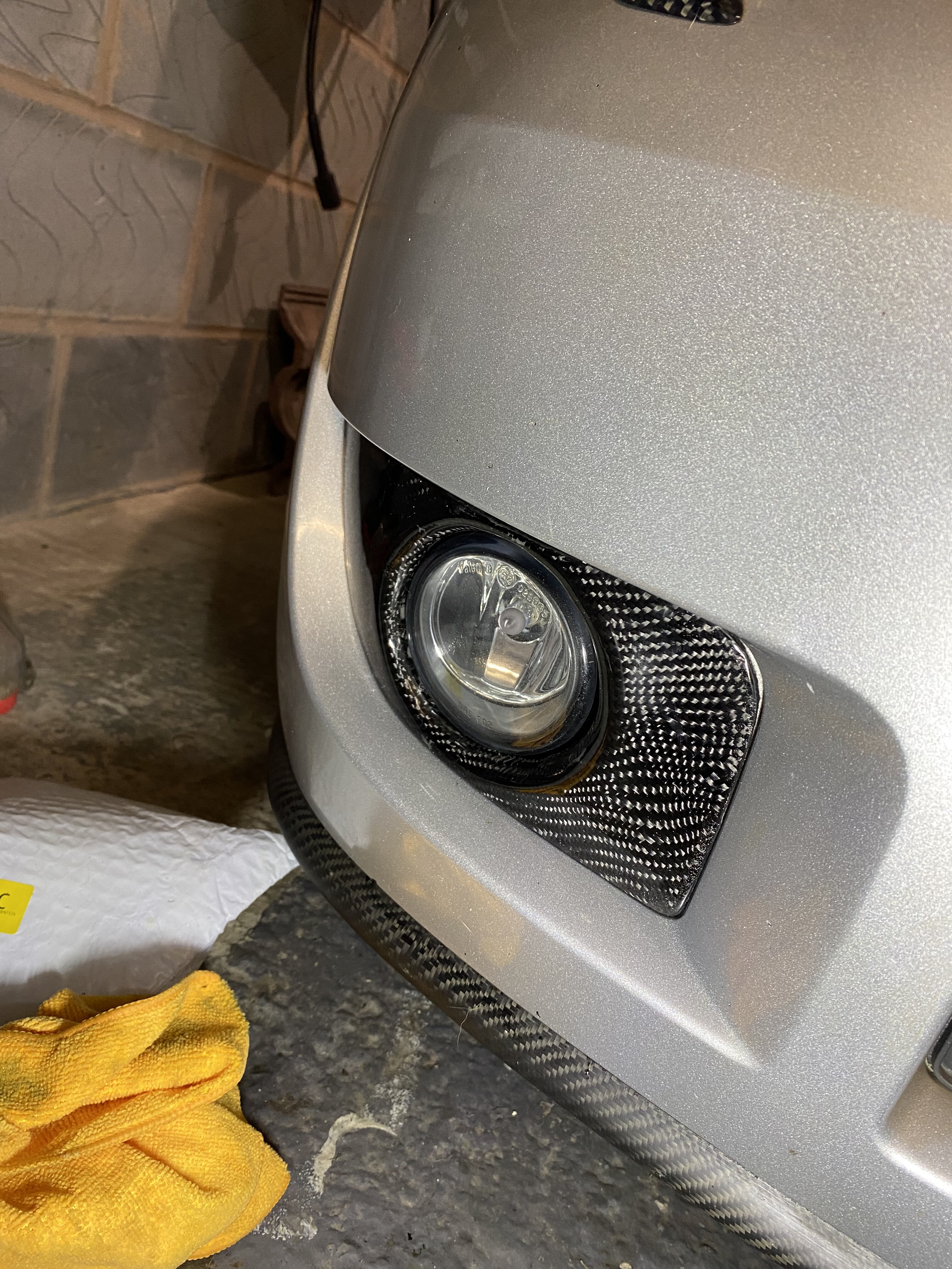

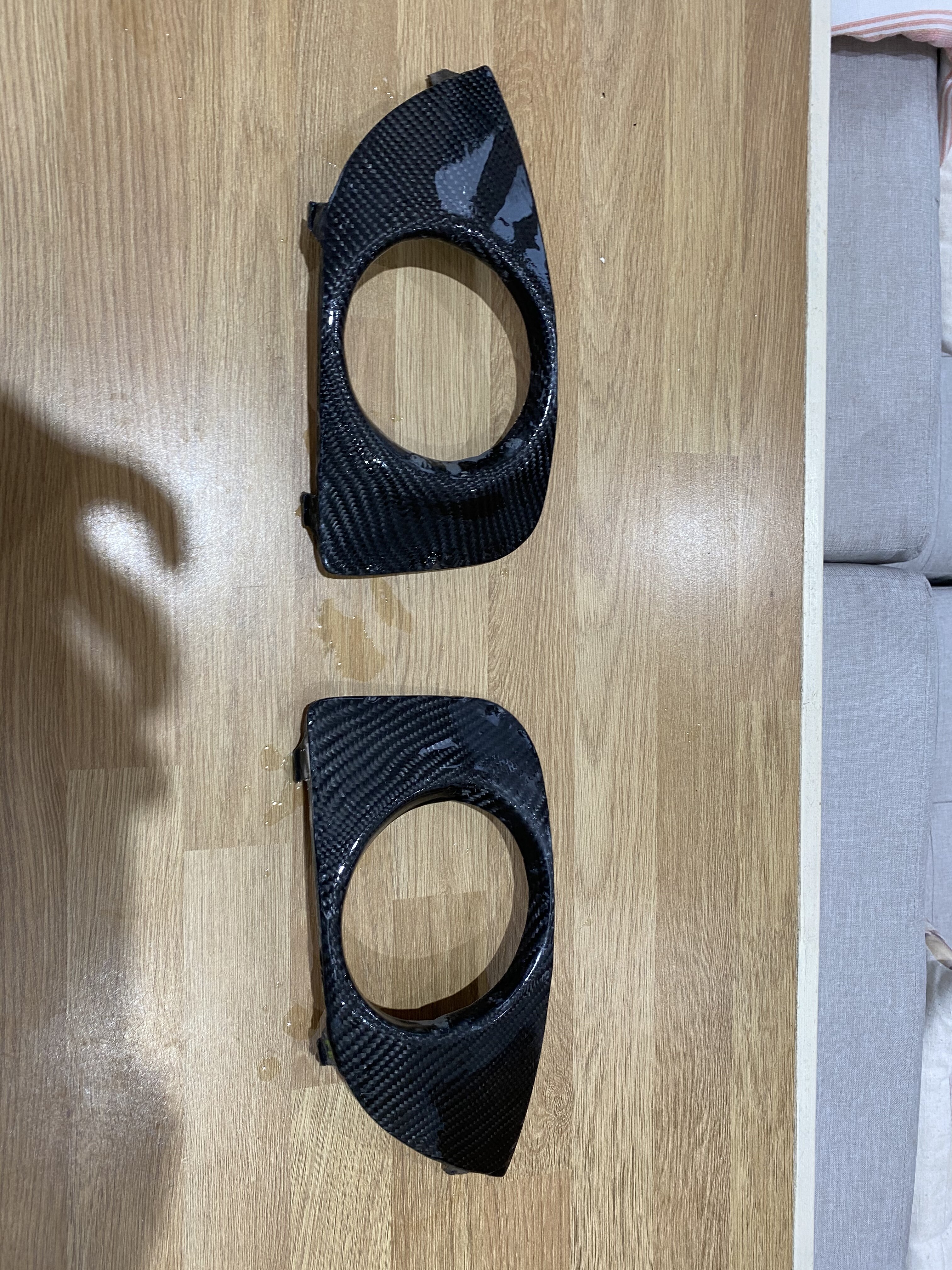

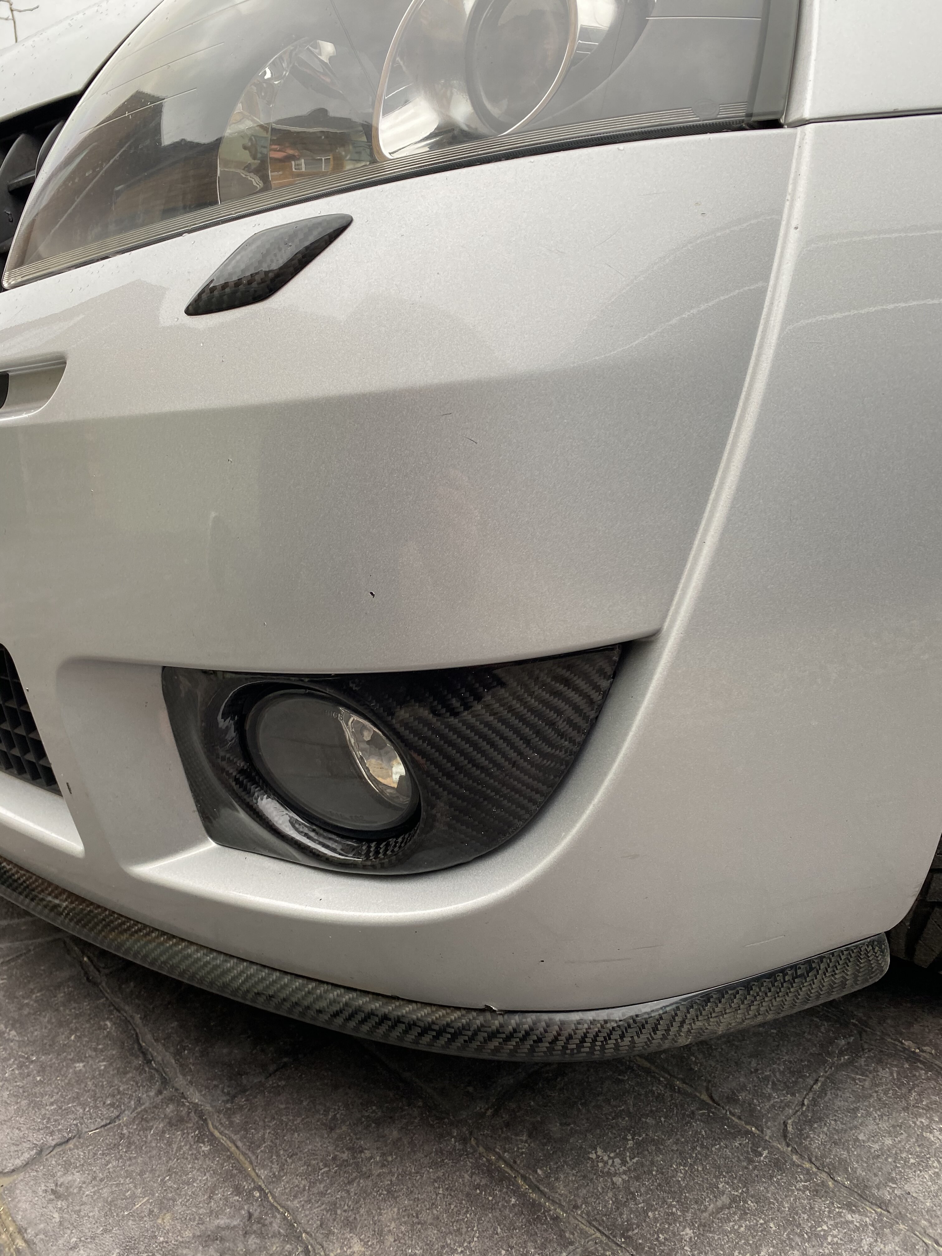

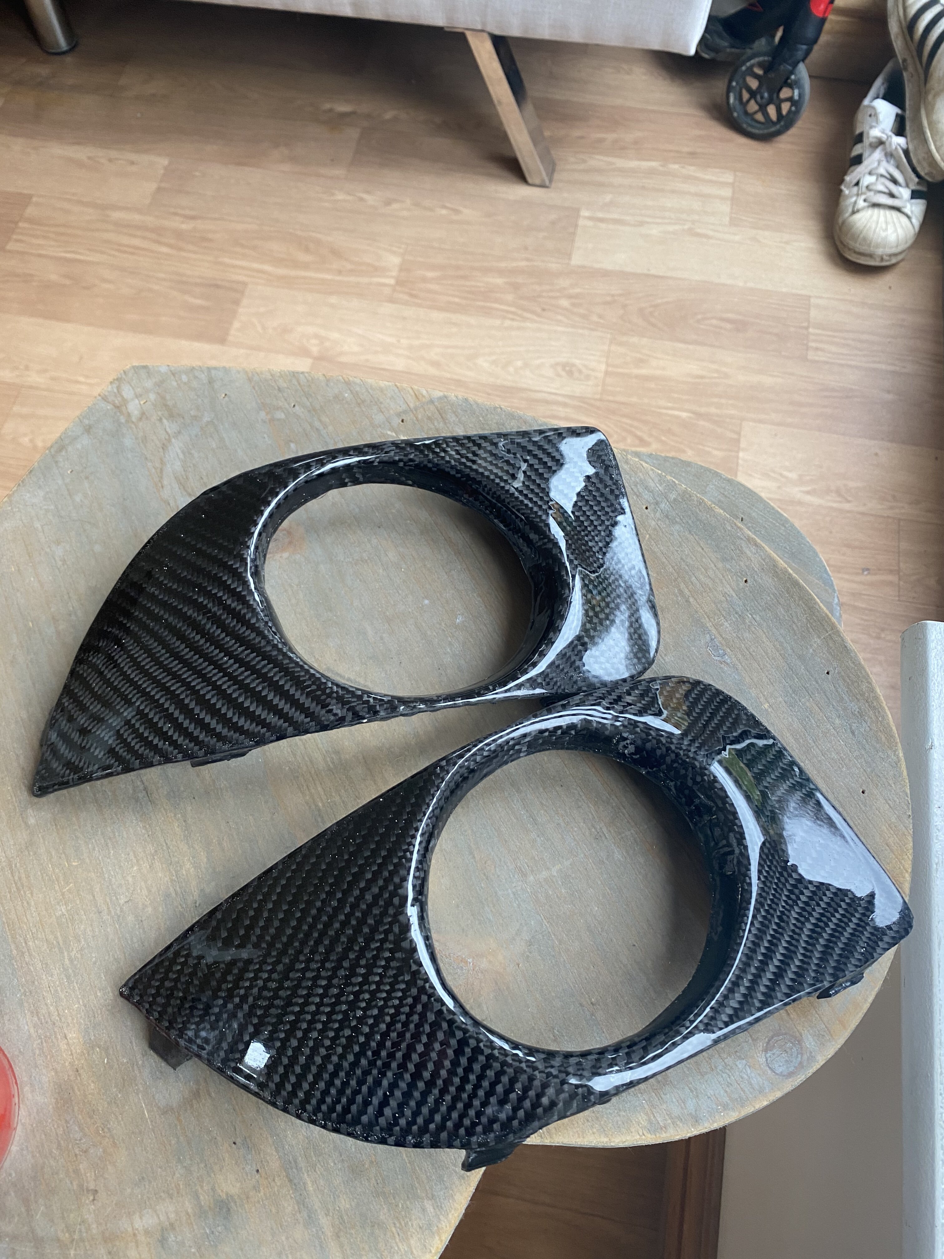

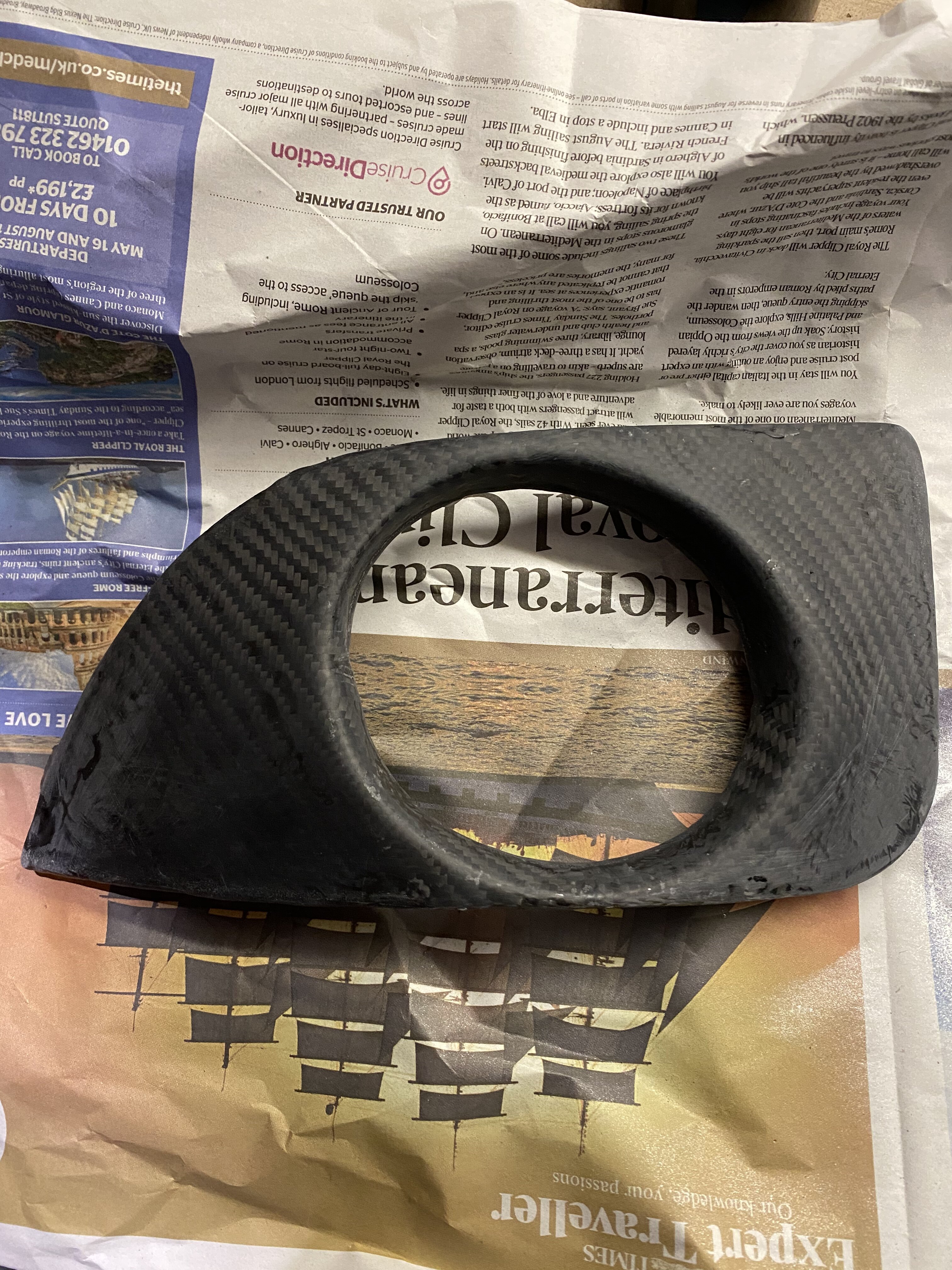

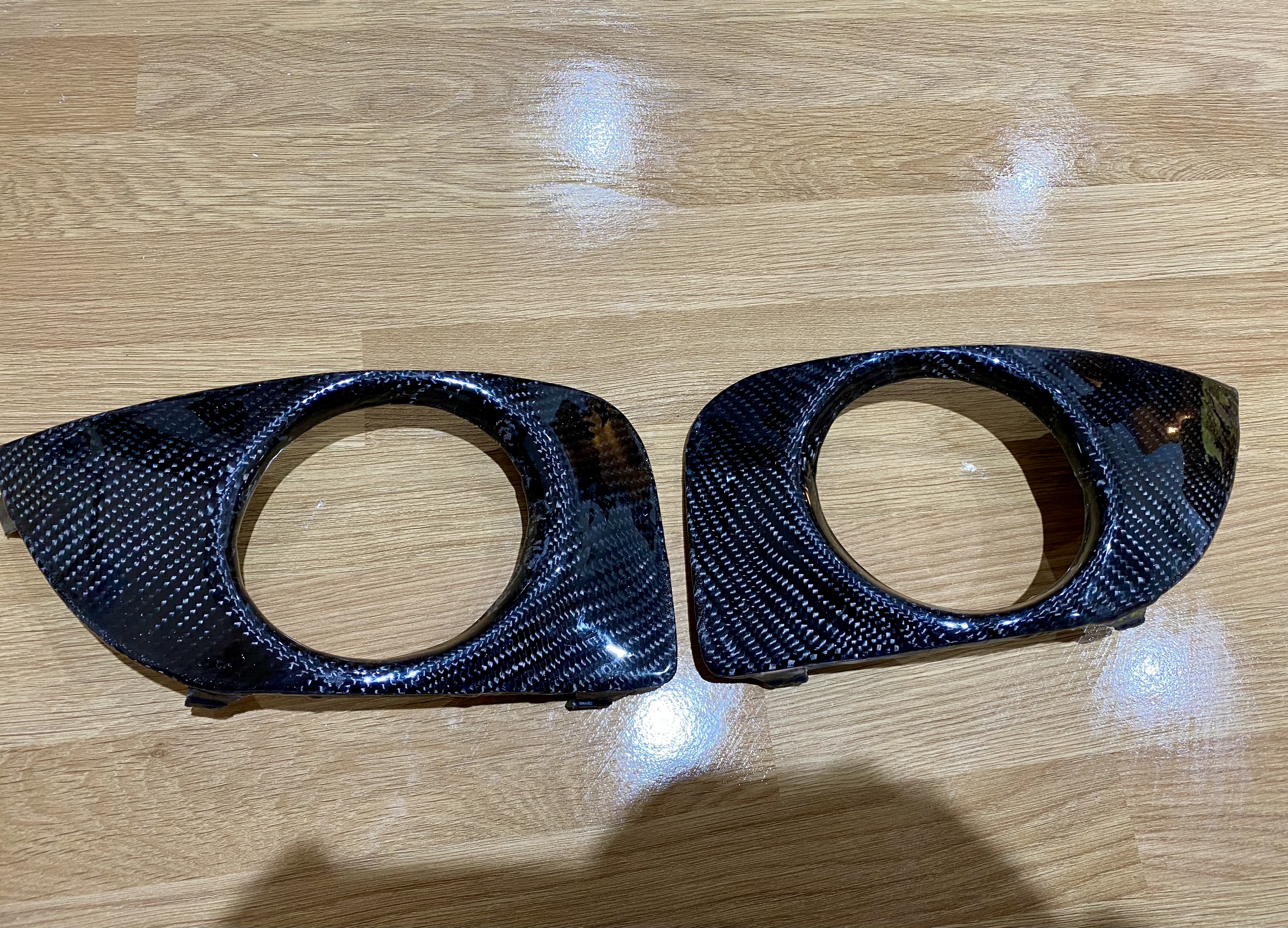

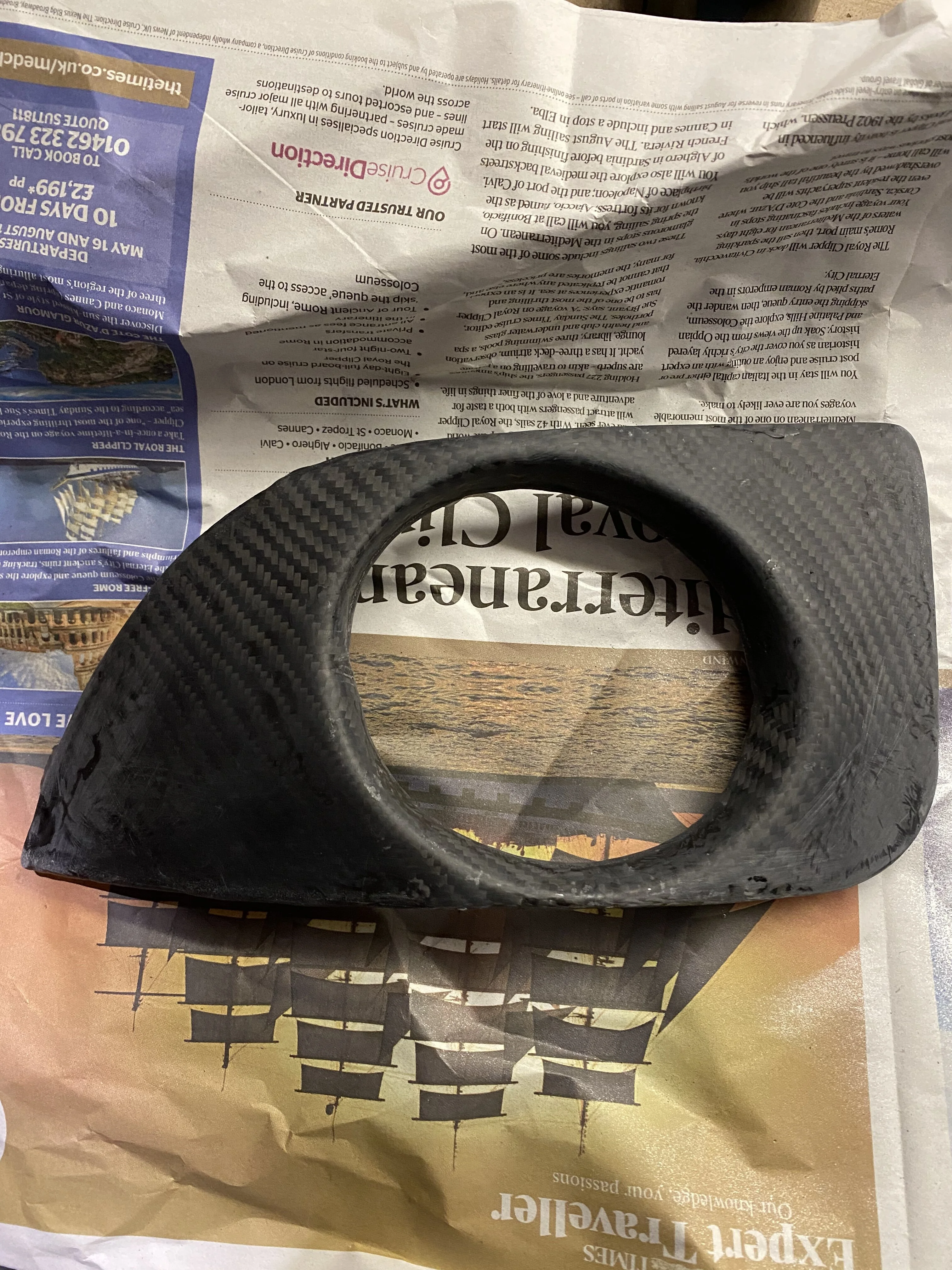

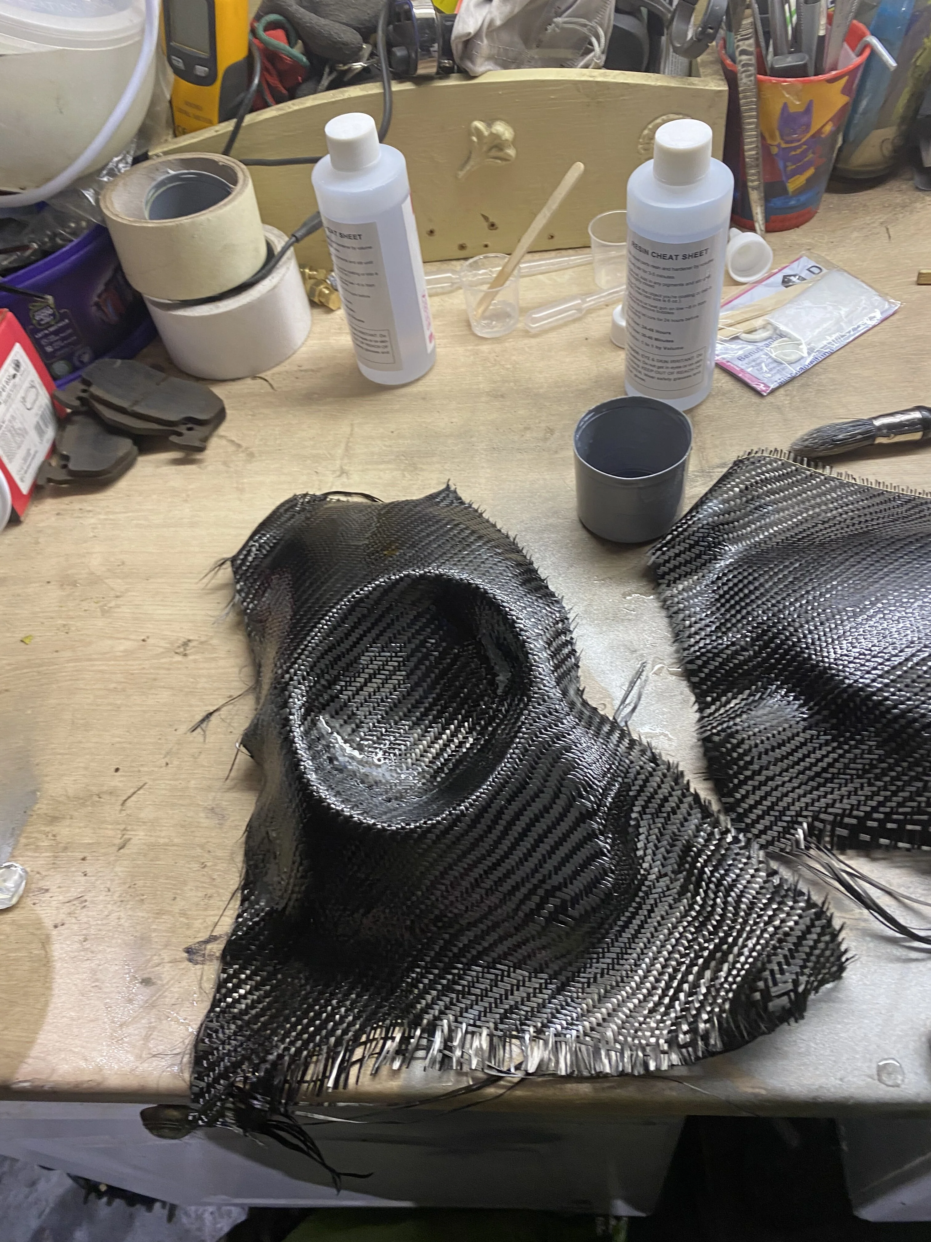

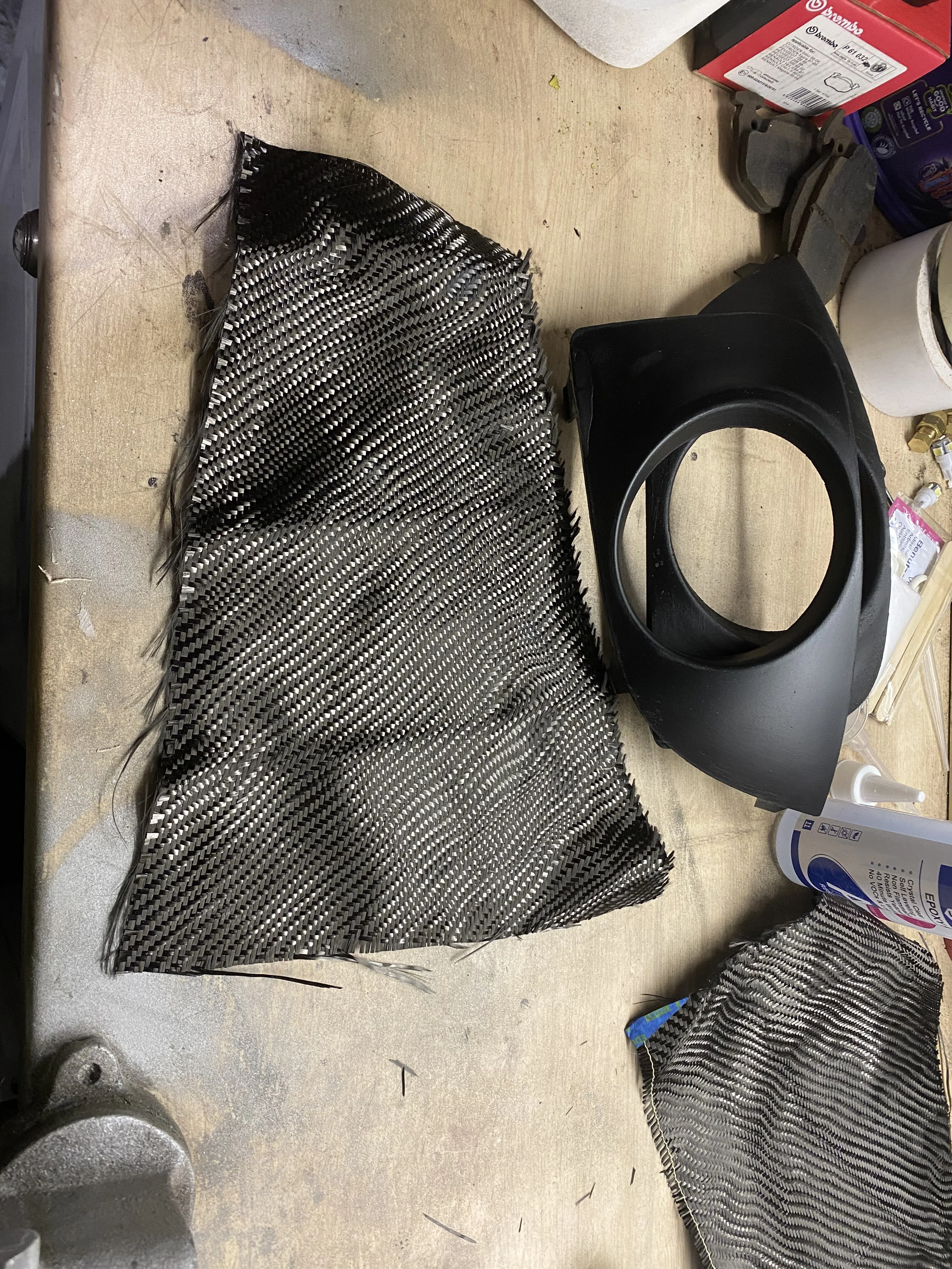

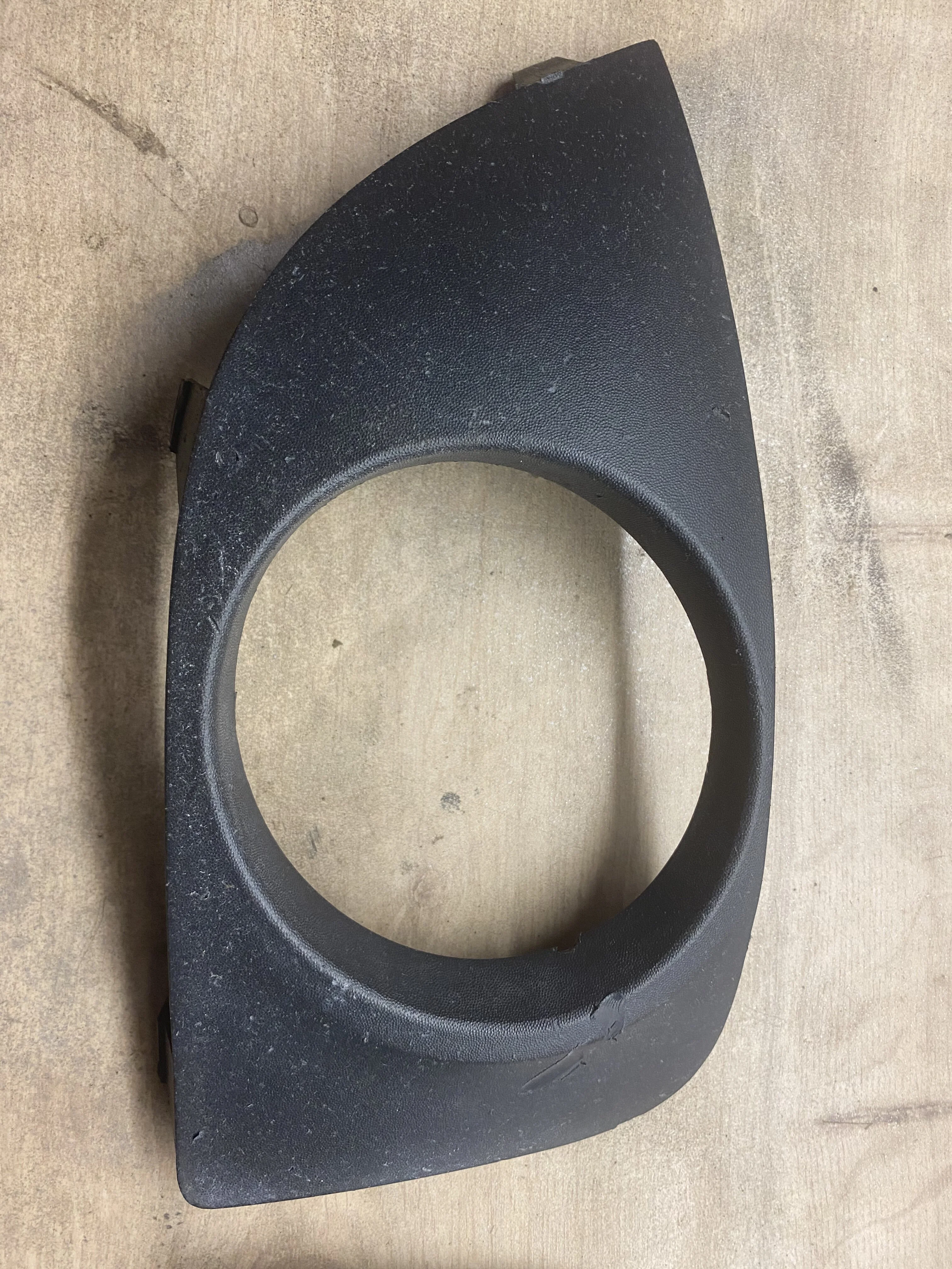

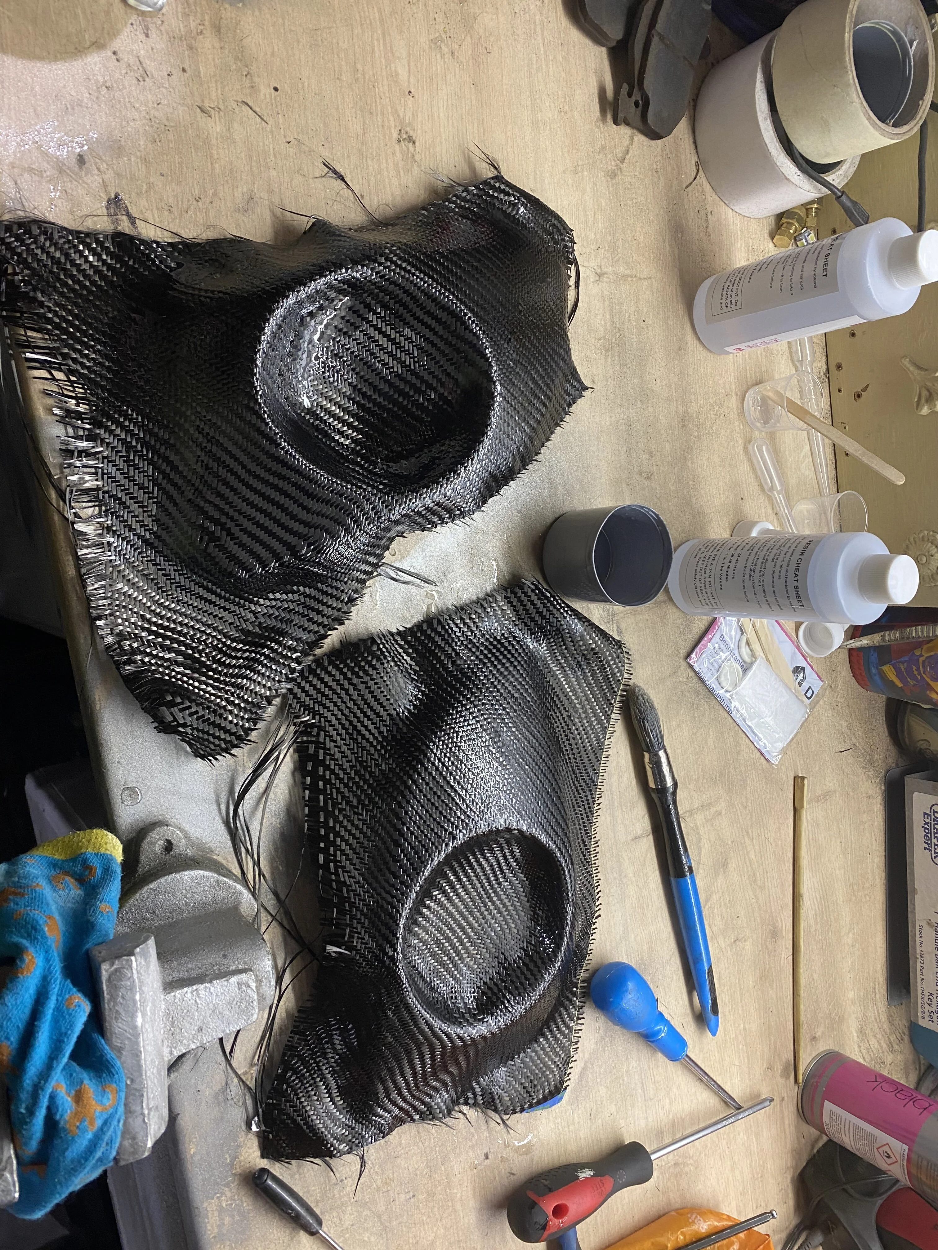

Over the last week I decided to make use of some off cuts of carbon fibre I nabbed off a mate. I have done a bit of carbon layup over the years, so decided to have a go at making my own carbon skinned fog light surrounds. I didn’t want to ruin the frankly minty set that were on the car so set about finding some spares. My usual parts buying frenzy meant I have 3 bloody sets of the things now! So if anyone needs a mint set of surrounds let me know!! Moron!
Started up by using alcohol to remove all the years of silicone and bumper black. Then rubbing the plastic down with a heavy grade sand paper to provide a key. I then filled some of the indents and gouges with plastic padding before rubbing the surrounds down again. A quick blast with black bumper paint (so the filler or faded plastic wouldn’t flash through the carbon weave) we were then ready to skin them.
laid down an epoxy base coat and then the carbon fibre before setting out with more epoxy. I had some Peel ply to hand but actually didn’t bother. Left then for 24hrs to set. Once set I laid another epoxy coat to fill the voids made from the epoxy soaking into the cloth.
Annoying photo limit mean another post sorry
RustyMojo
Bon Jovi Officianado

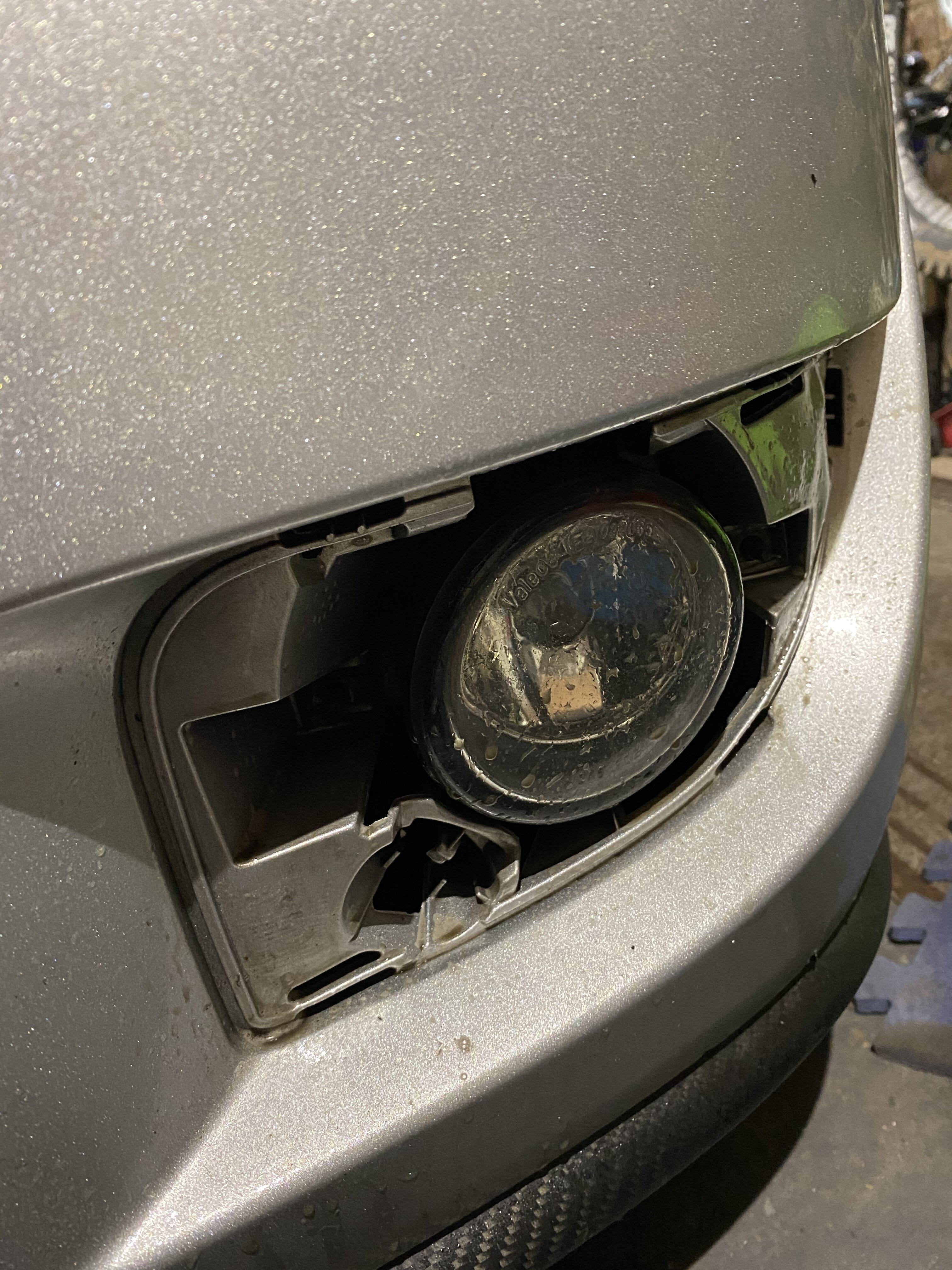

Another 24 hours last and now the real works starts. I cleaned up the unwanted cloth with a dremel and then flatted the whole surface back so it was smooth. At this point a final coat of epoxy is applied....another 24hrs past and it was time to finish them off.View attachment 1522629
So flatted back the epoxy clear coat again and then shot the surrounds with clear lacquer. The reason I do this is epoxy isn’t great at handling UV, regardless of the UV stabilising claims. 2 coats of lacquer and I could flat back through the various grades of wet and dry before polishing up.

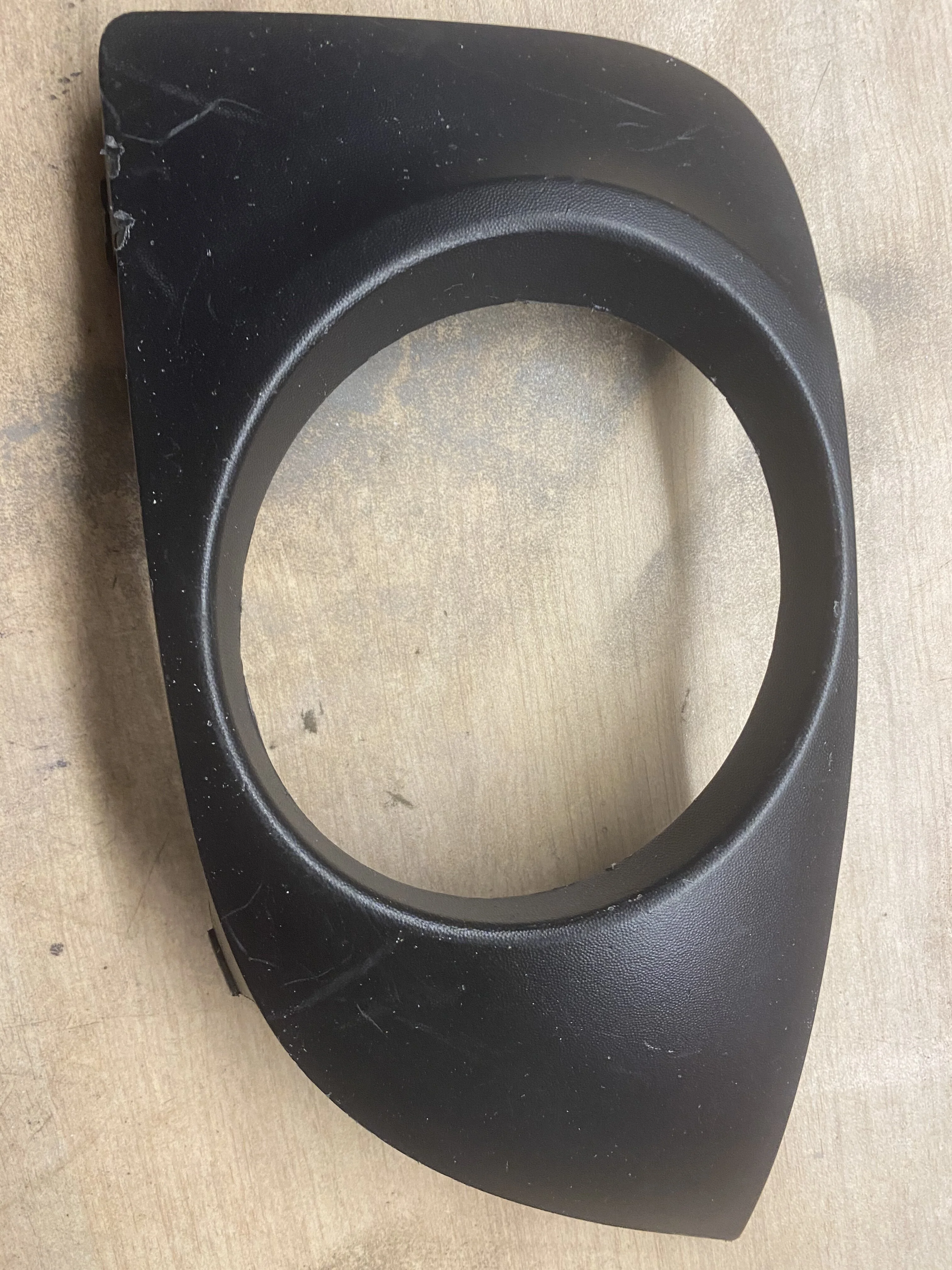

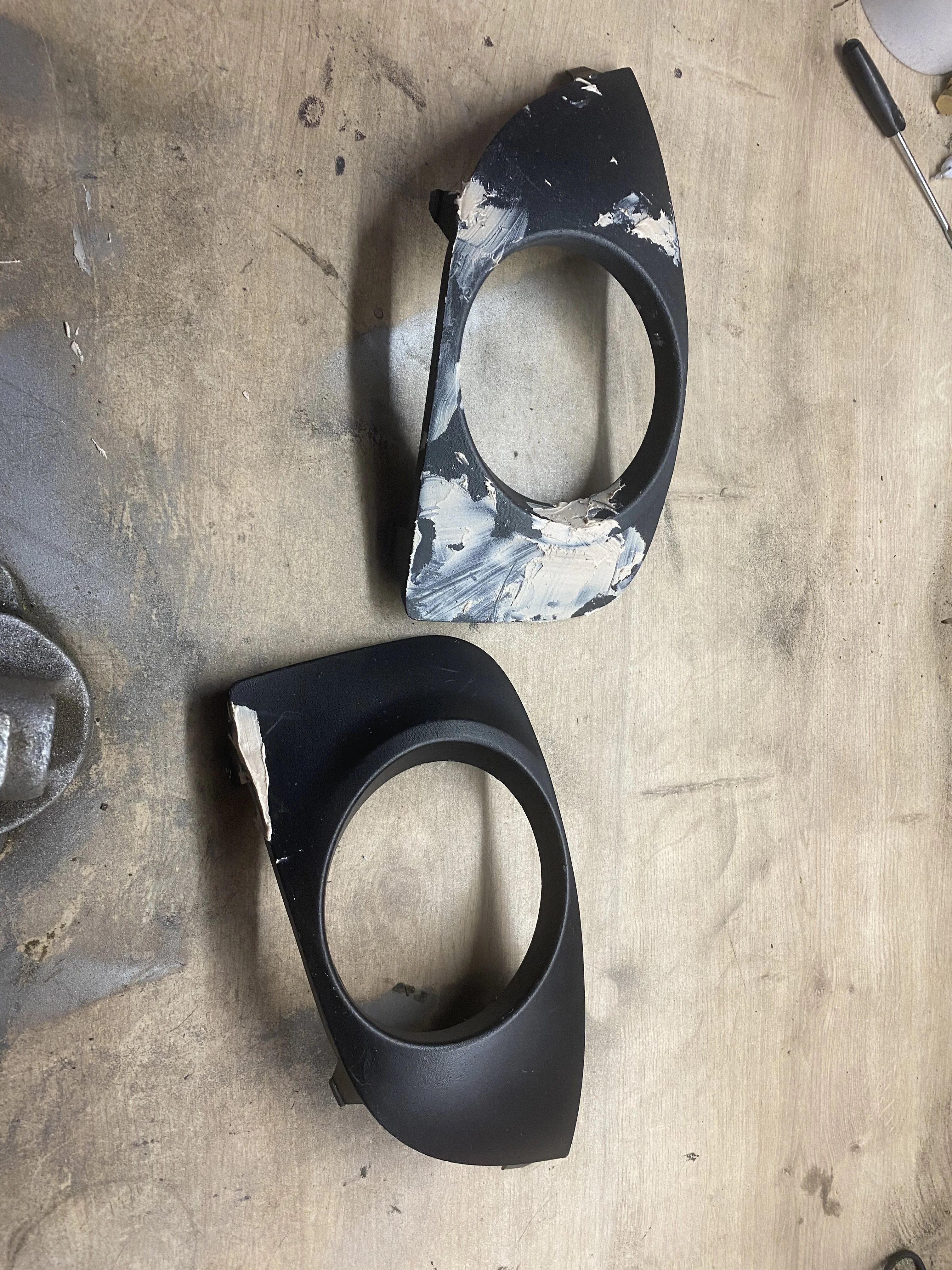

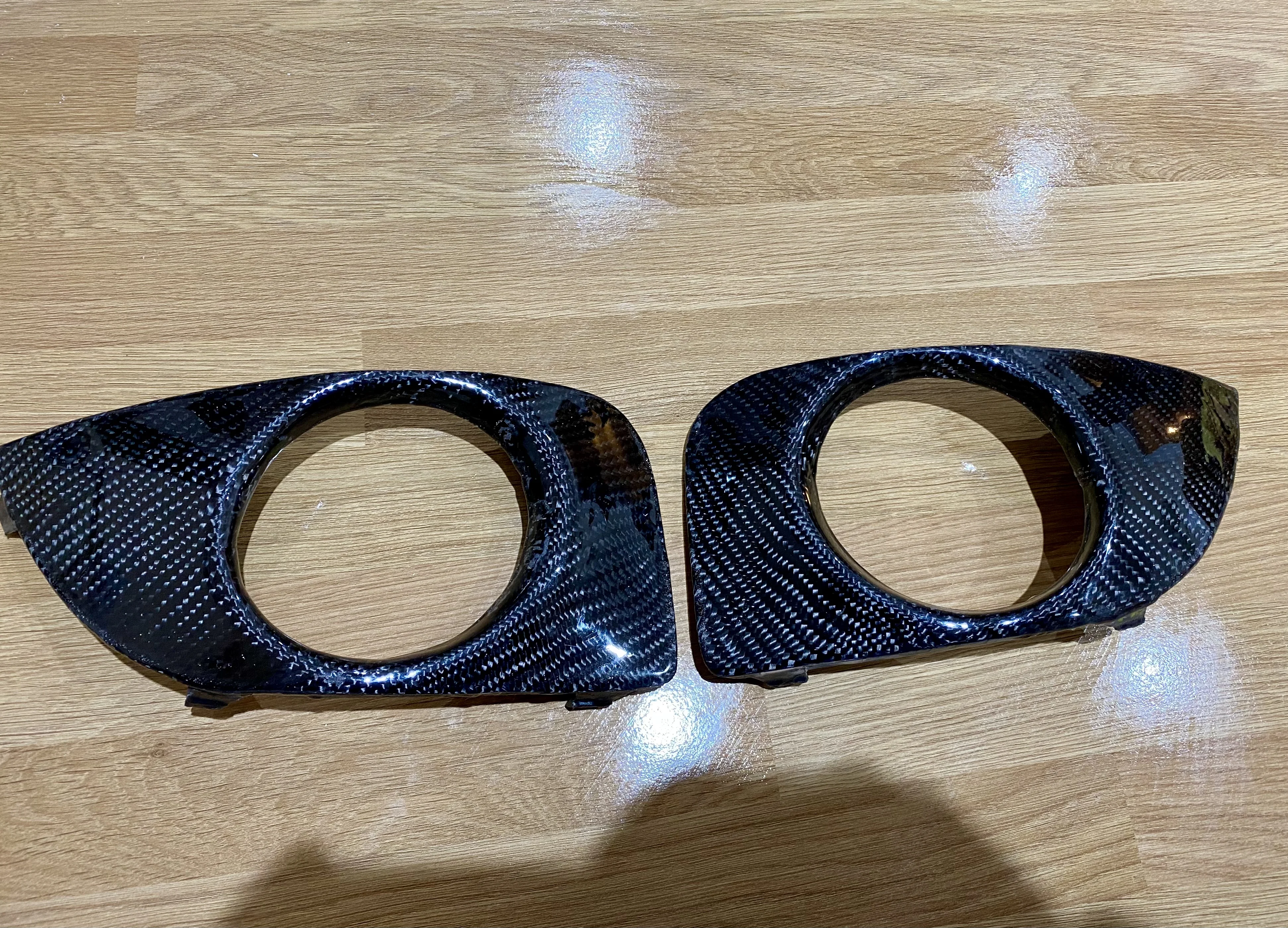

Popped the old surrounds out earlier today, gave the area a good clean up as it was minging back there

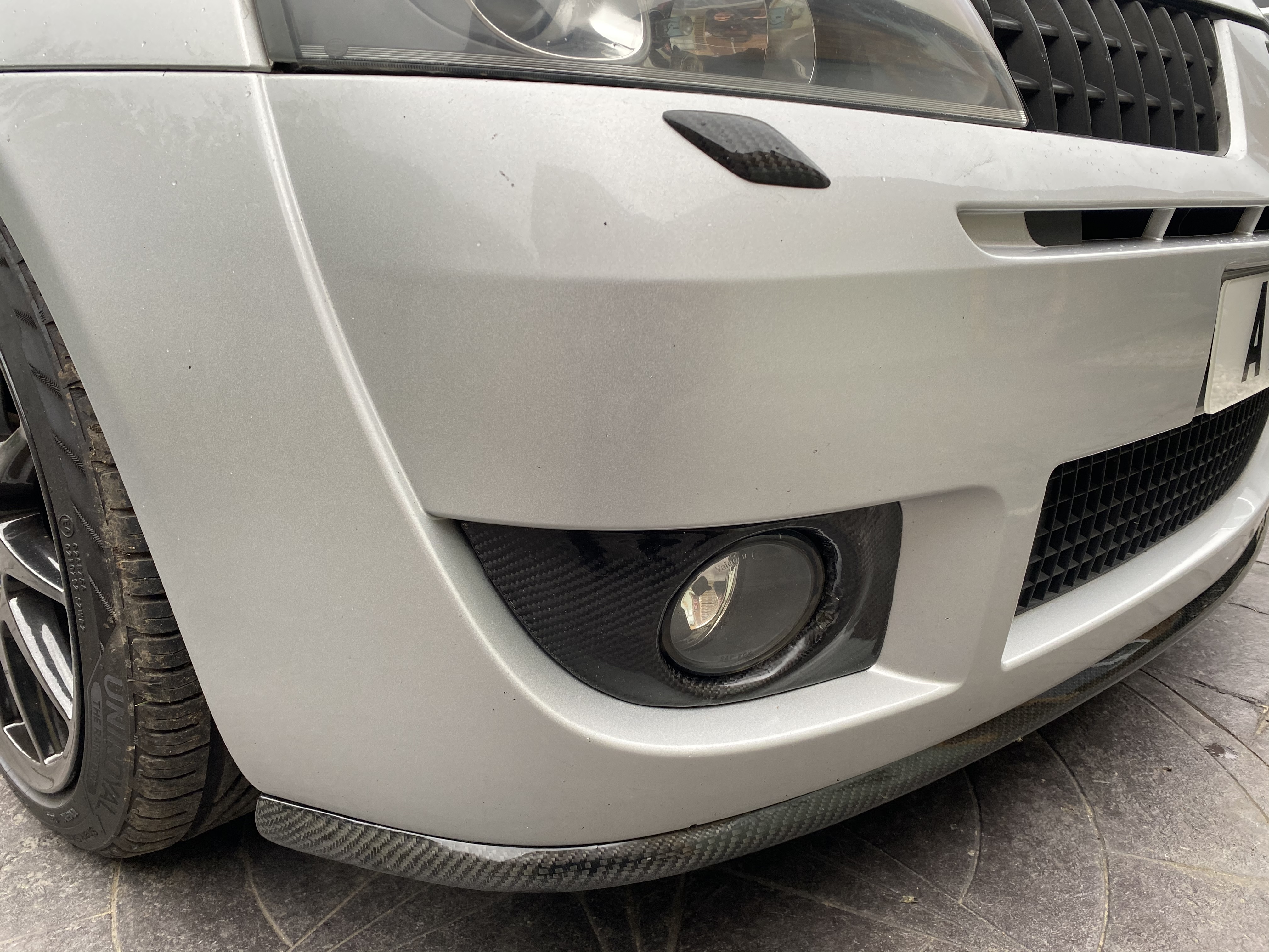

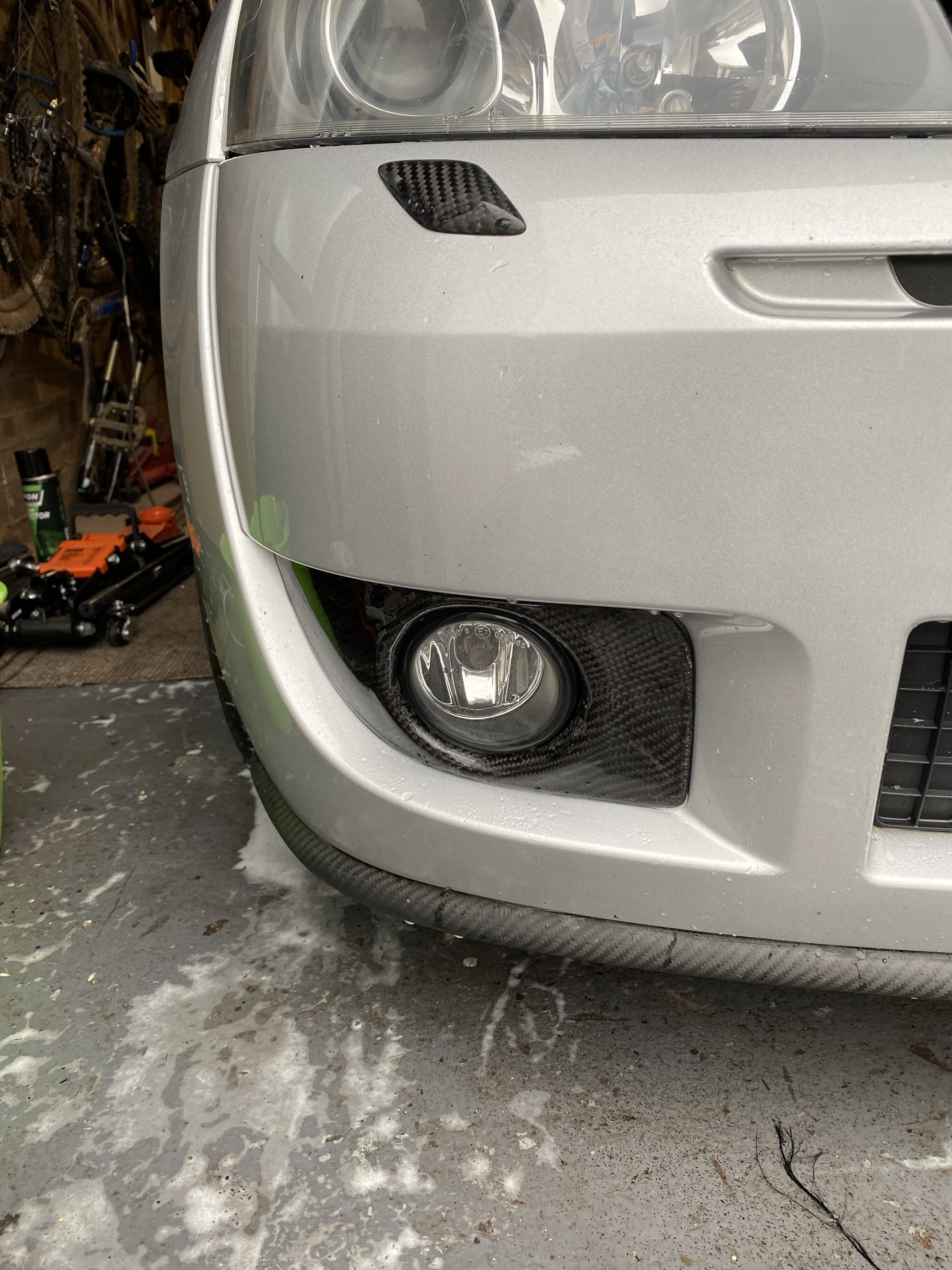

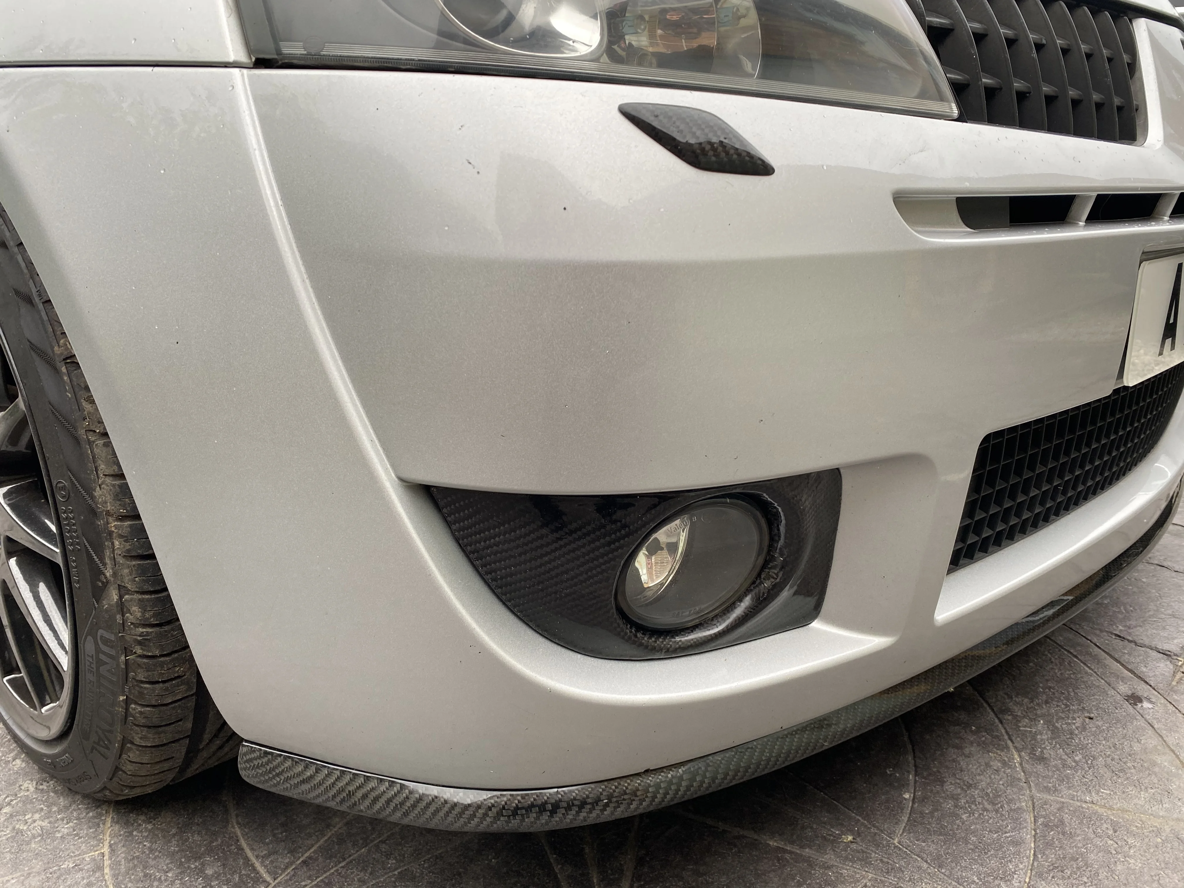

Fitted them today and I have to say I’m happy with the results, not perfect but pretty good and works well with my washer blanks and splitter (which needs clear coating again)
Finished the day off by giving the old girl a bath with my new snow foam Lance.

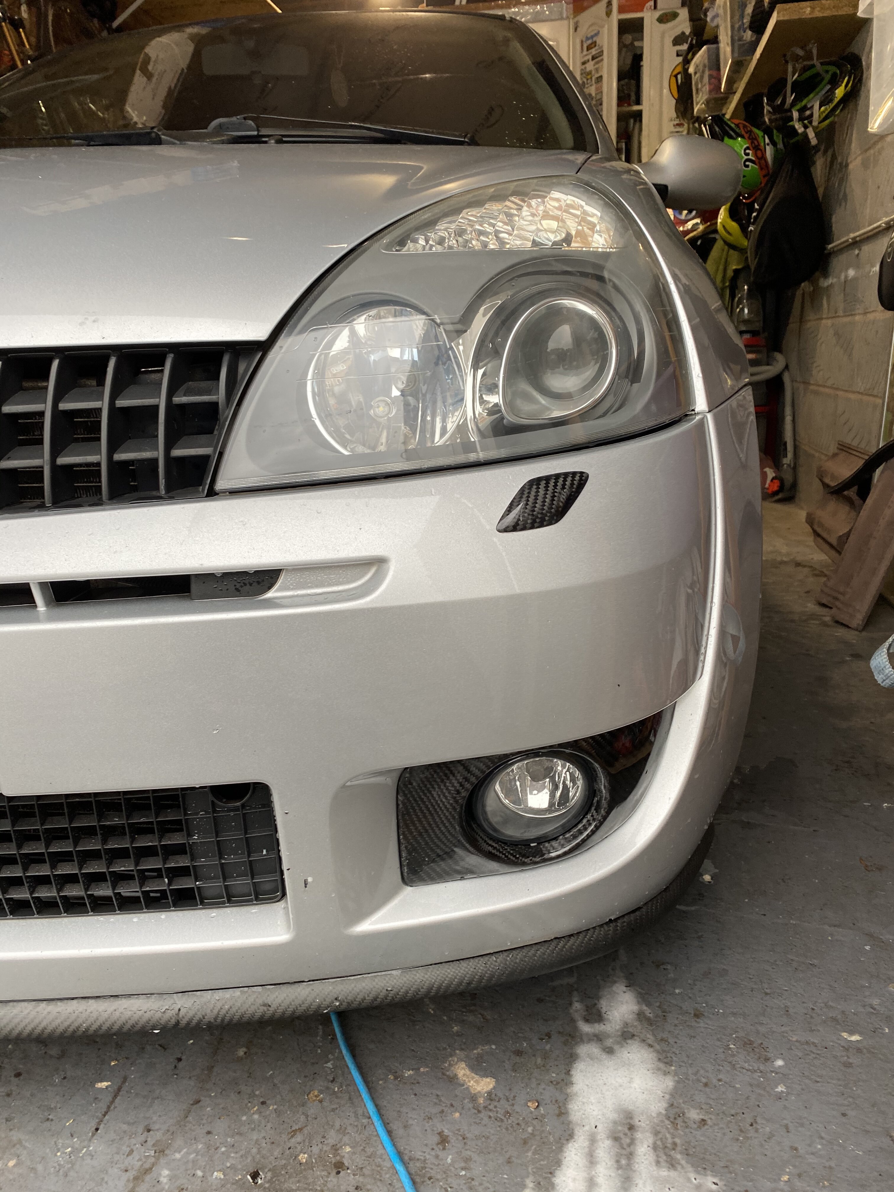

Looks like you are doing a great job mate, especially given the tight area to work on the car.
Thanks mate, the photo is deceptive. I can get all around the car with plenty of space when I need to. It gets parked over to one side to stop my moronic children dragging bikes past it or the wife’s arse as she heads out through the garage.

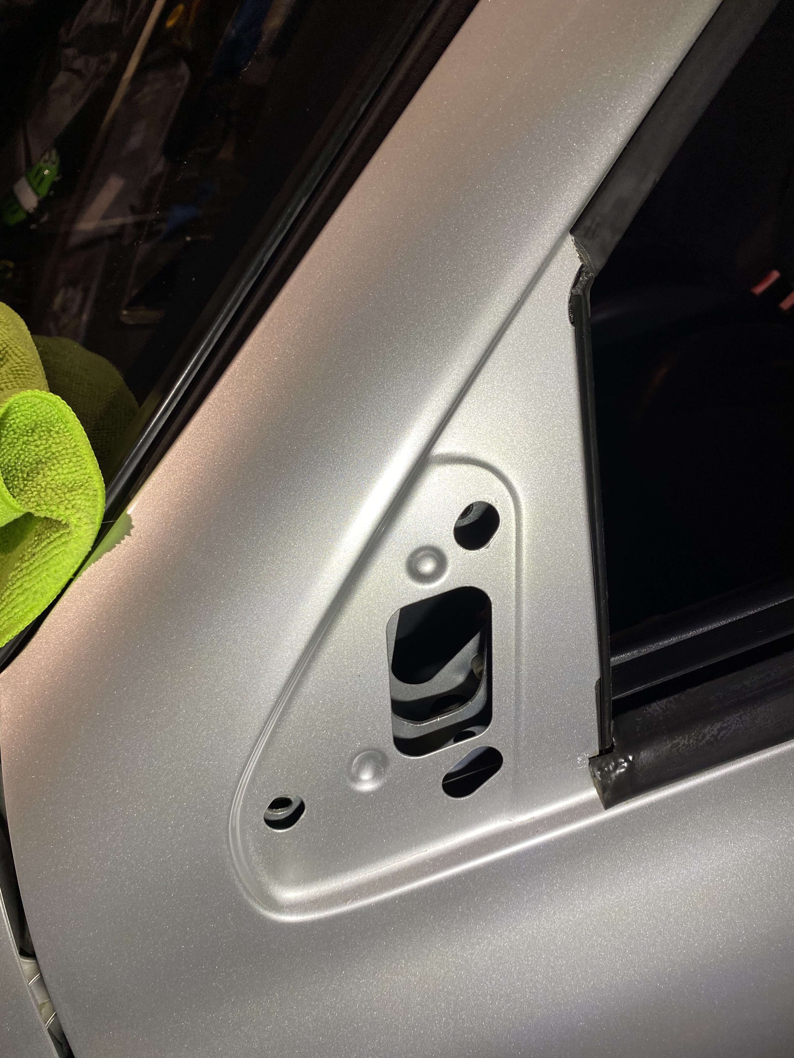

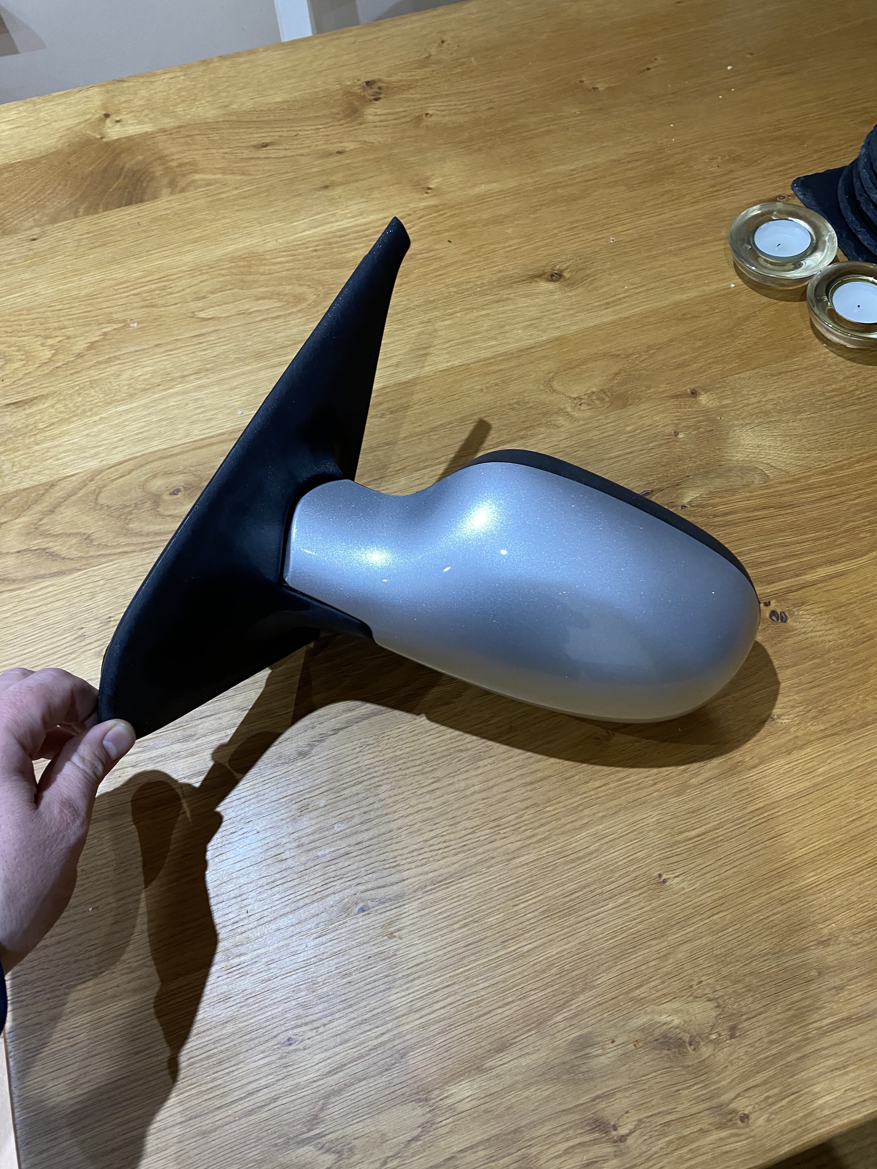

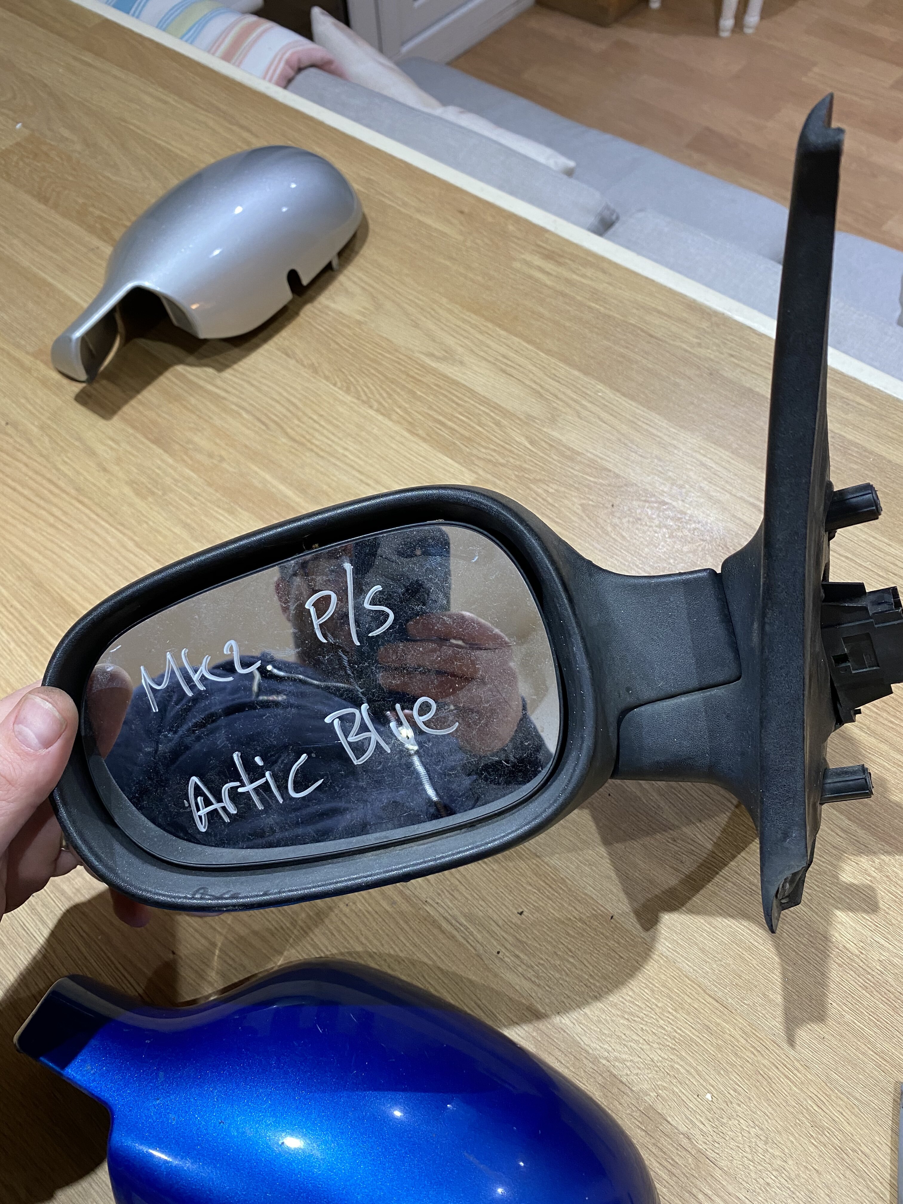

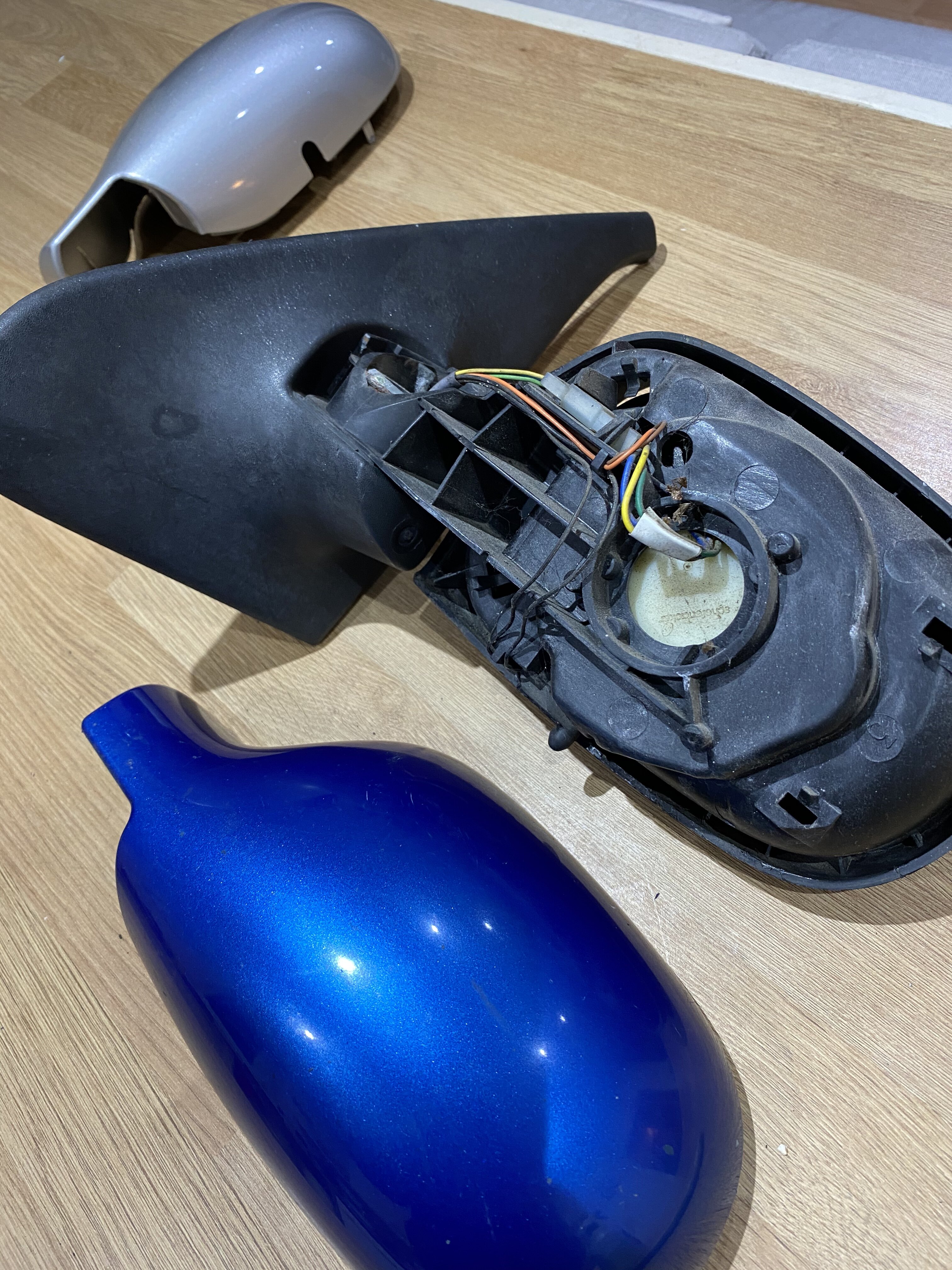

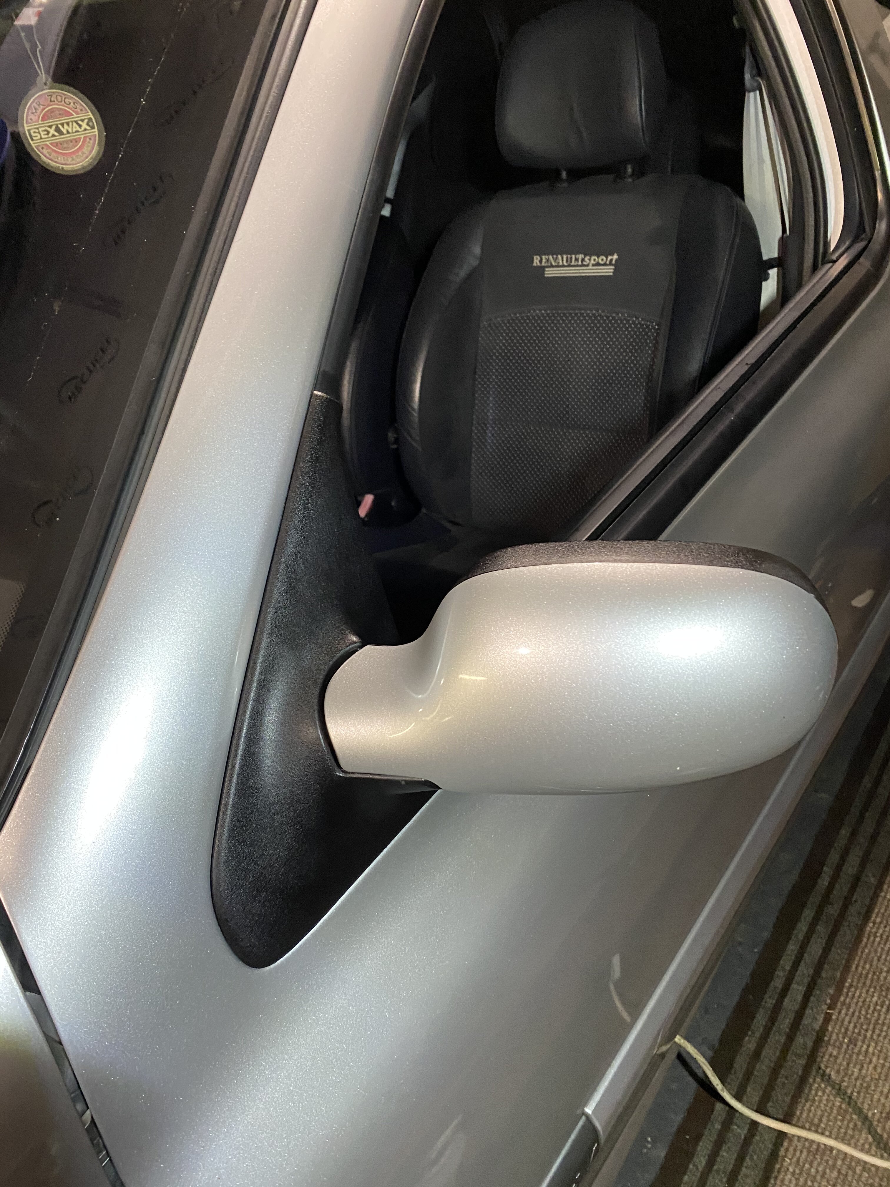

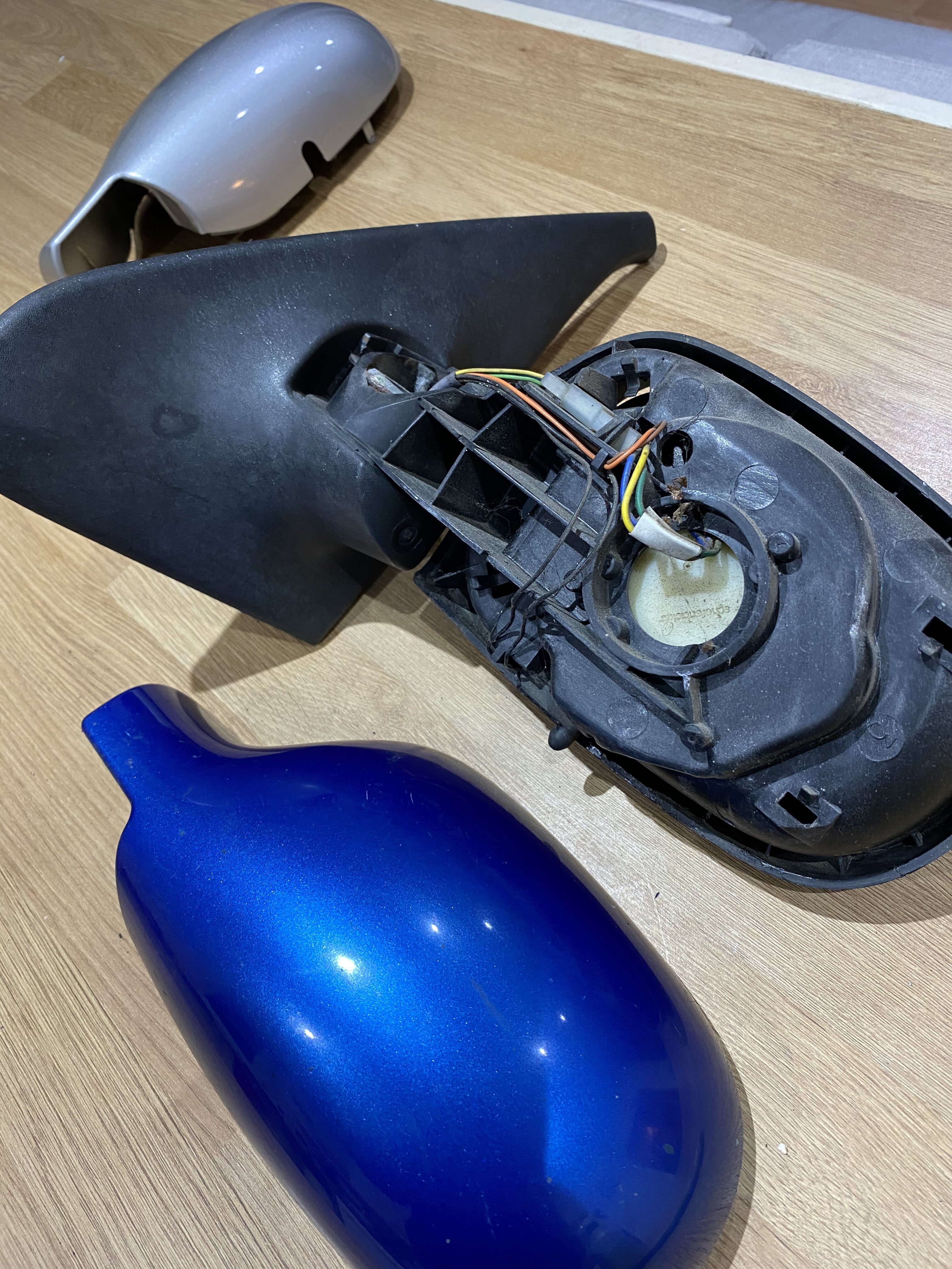

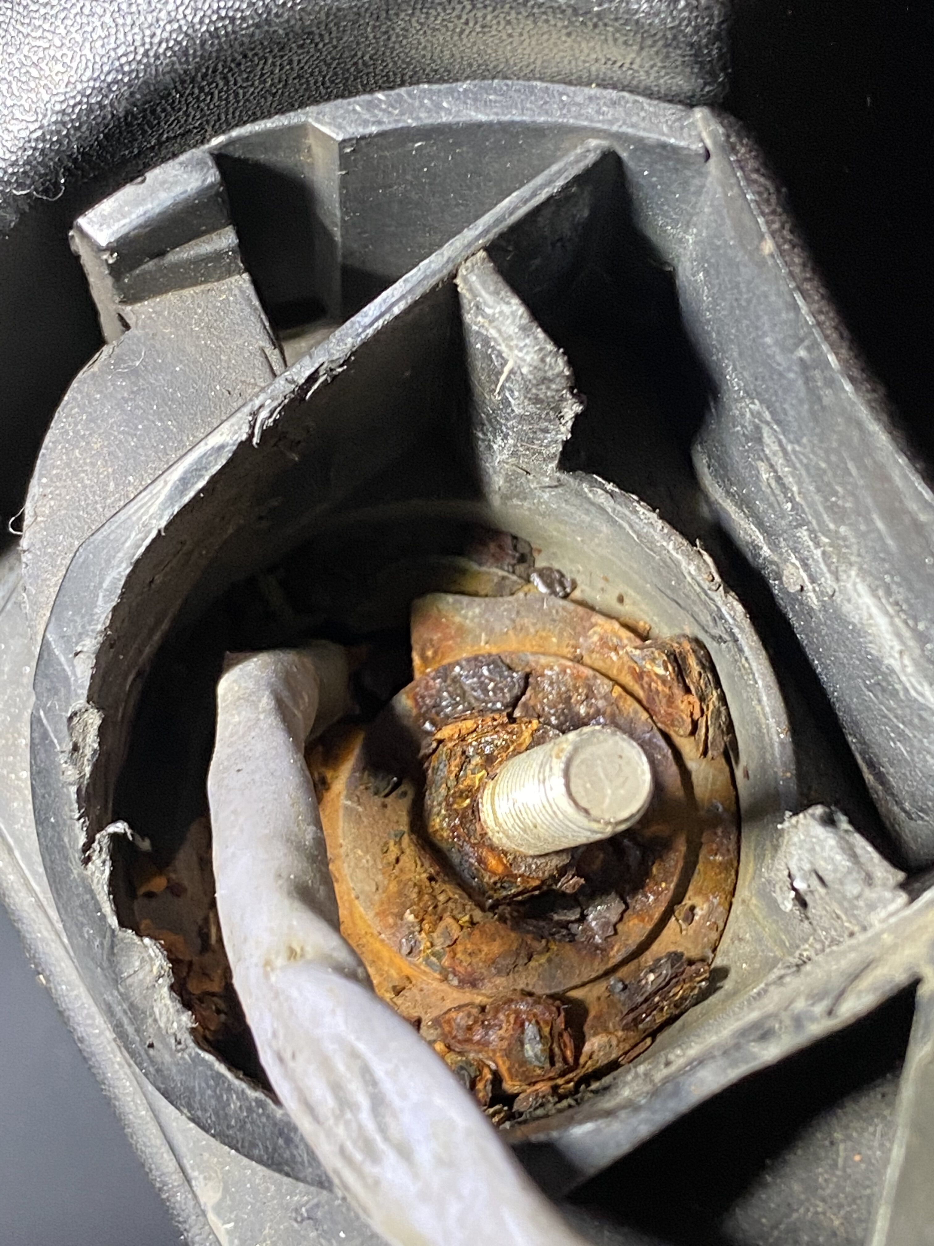

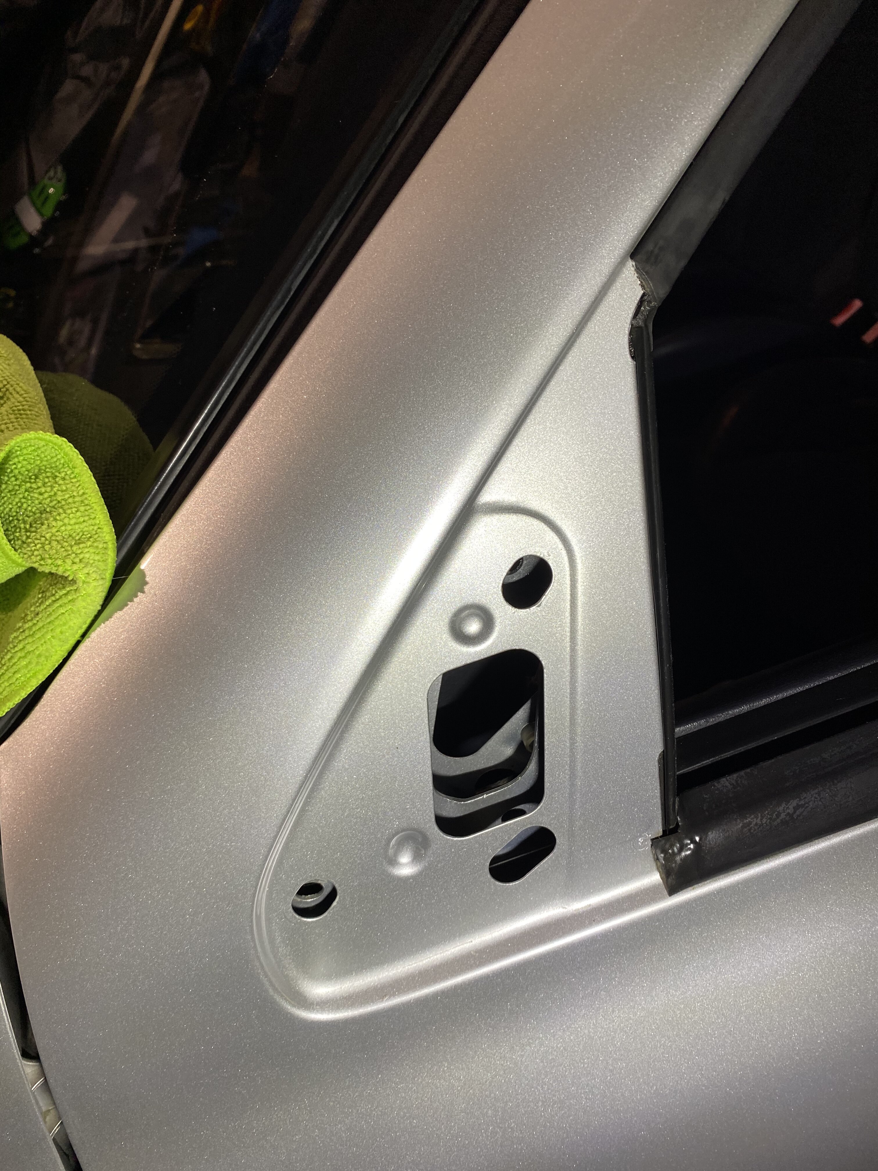

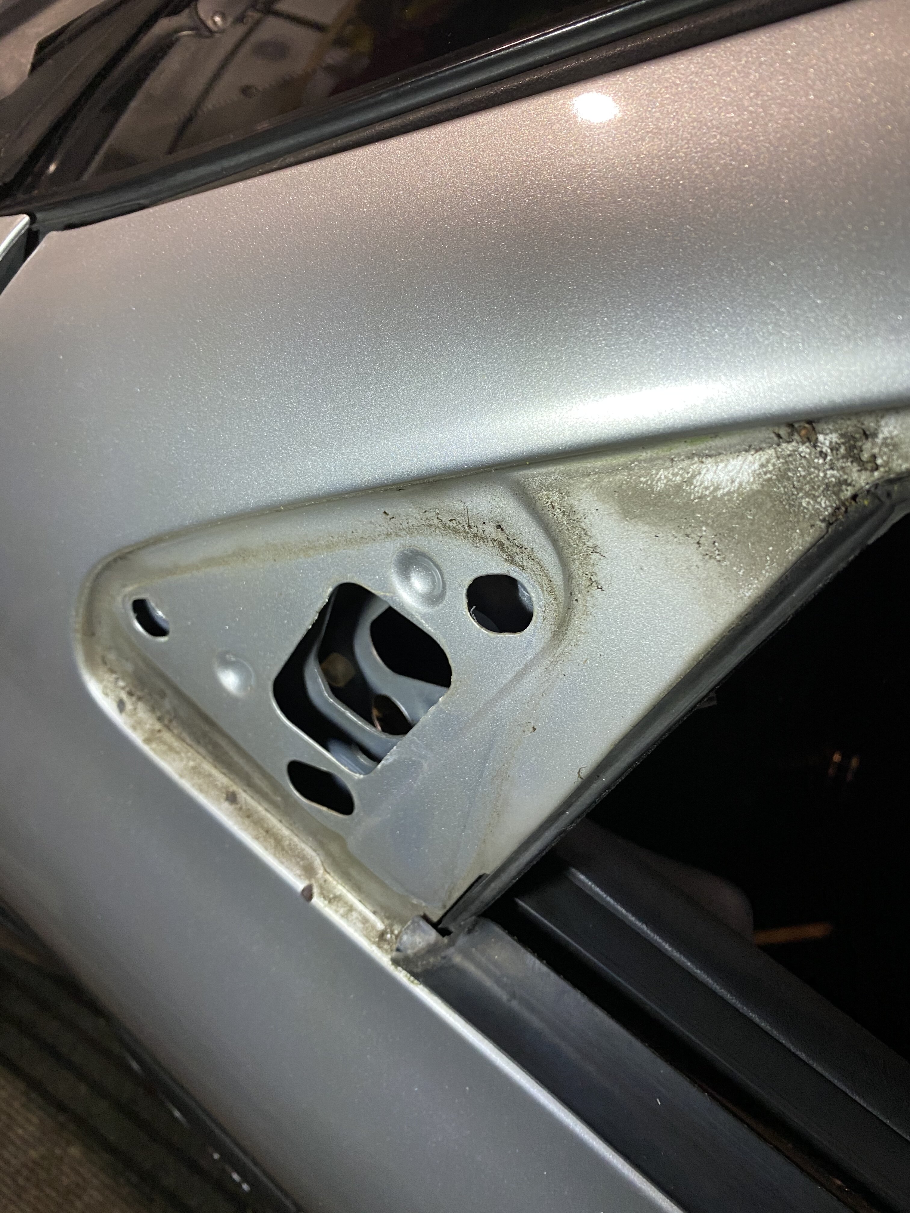

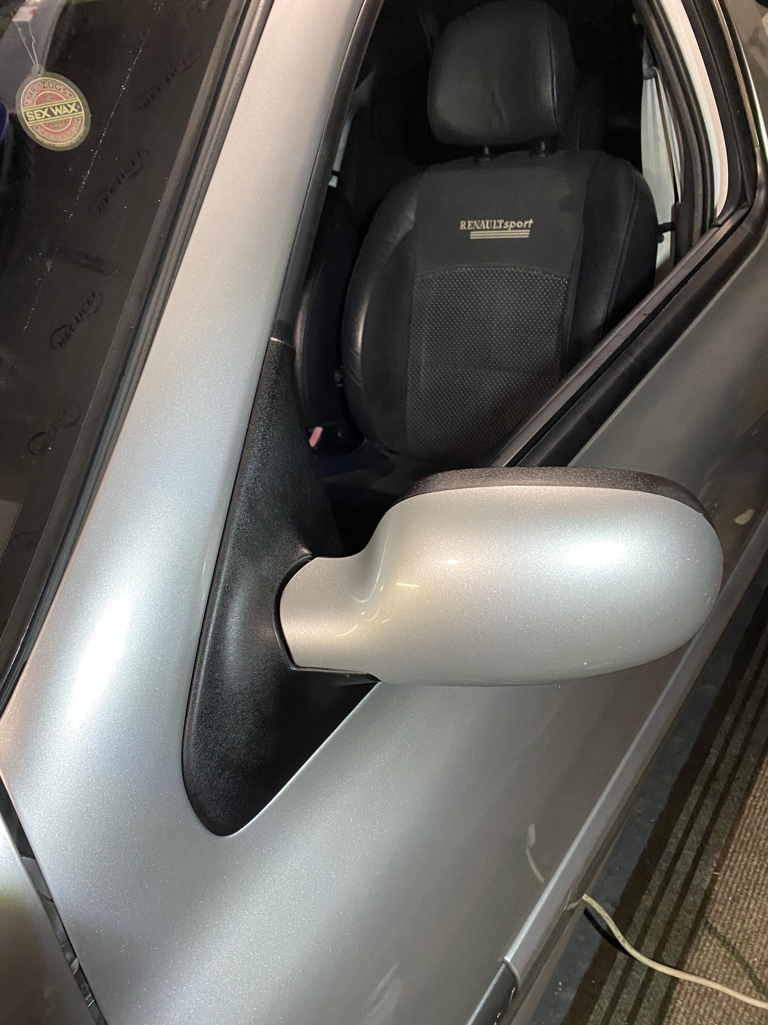

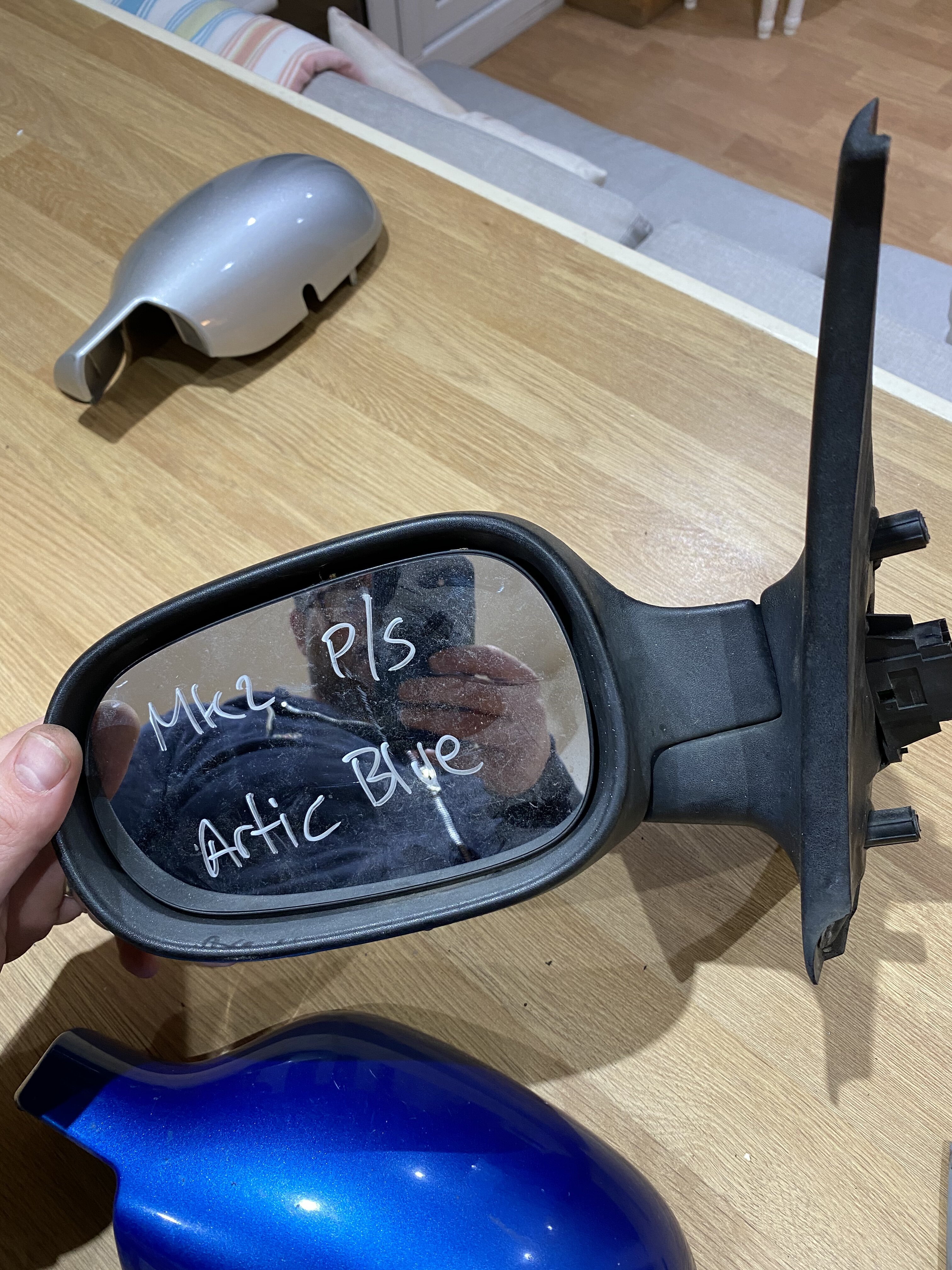

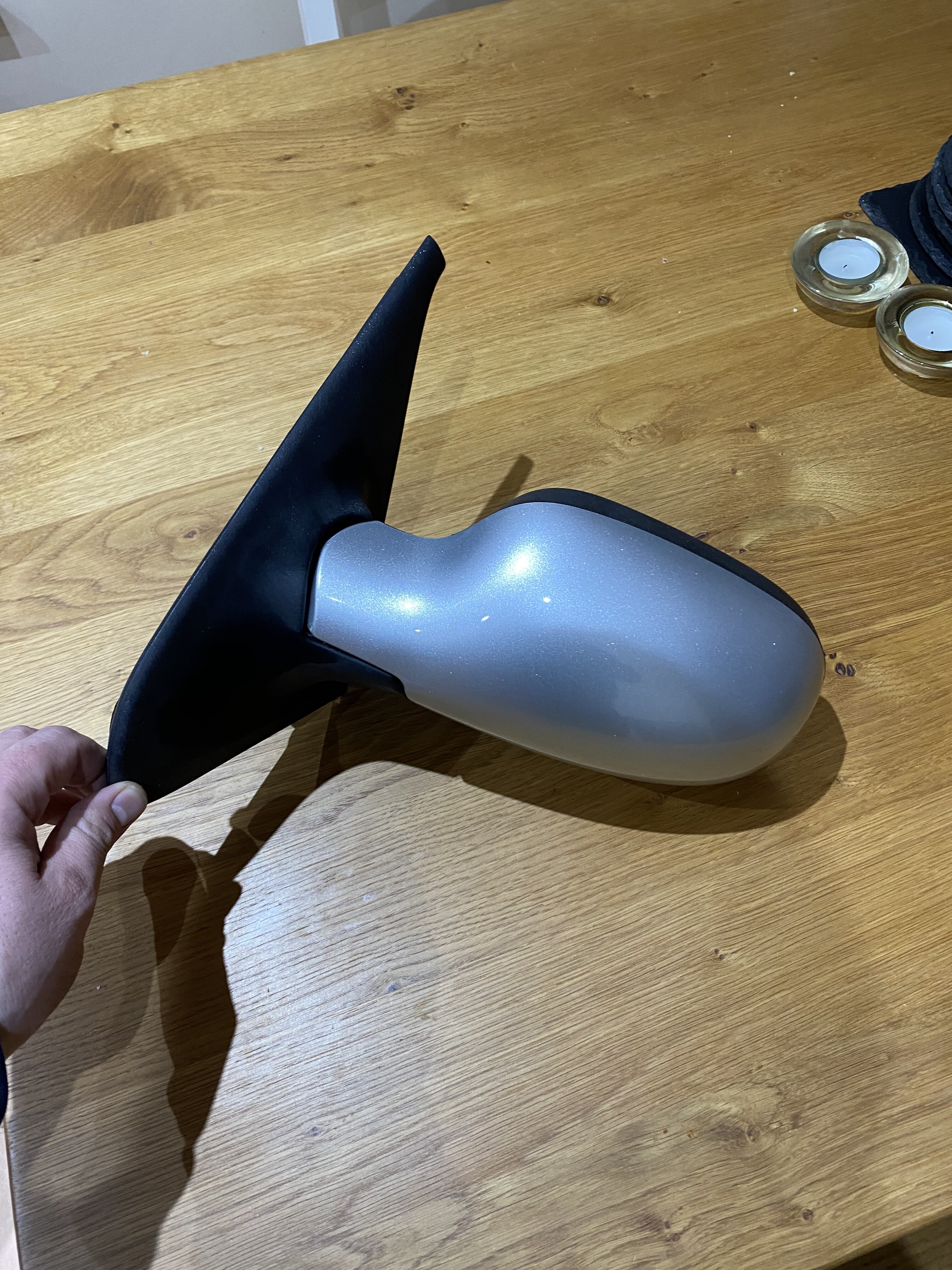

Nice little job tonight. Not sure how I hadn’t noticed this before, but the NS wing mirror was loose. Bit of a wobble and the cap fell off..bugger! On inspection it’s clear someone had been there before with a bolt and cheap crappy washer which had rusted through. Mainly because these mirrors are water traps!
Ordered a replacement mirror from BTT via eBay £15 delivered. Artic blue mirror car was removed, Titanium cover fitted.
I did a bit of testing before fitting as I know the temperature sensor is housed in the NS wing mirror. Glad I checked as would’ve been annoyed if I noticed later in the summer! Luckily all good as gold, defo recommend BTT who seem the fairest and easiest breaker to deal with at present. Cleaned all of the crap that had been hidden behind the mirror for some years.
All fitted and looking distinctly like it should do...silver and shitty
View attachment 1523442View attachment 1523444View attachment 1523445
View attachment 1523446View attachment 1523447

You're a brave man tackling that fuel filler area. Seems stupidly flimsy!
The car looks great though, those carbon brake ducts are rather nice.

Not really mate, if I didn’t tackle it it would’ve needed an inner wing within a couple of years. I’d already done the job on my first 182 so knew what to expect, albeit this one was much worse. I think the worse part is the flimsy metal strip like you point out. Mines ok but rust thins the metal and the fuel filler caps start to stiffen with age so they flex the metal when you open them. Recipe for absolute disaster and a typical Renault half job.
Im a sucker for all things carbon, have been for years. I’m lucky enough to have done my fair share of home boat building and laminating so have some materials and experience. I just got a couple of other areas I want to carbon up and then I’m done! It’s a fine line between nice subtle touches and completely overkill and I’m getting close now!

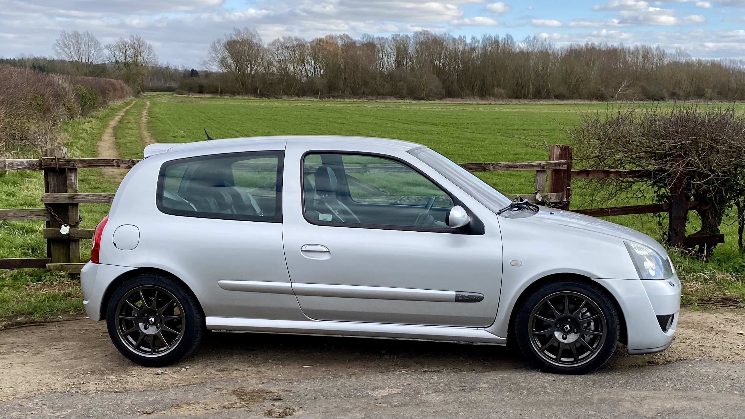

Took the car for a quick spin earlier, it’s now been relegated out of the garage ahead of some building work we are getting done. So short of my planned re-lacquer of my splitter tomorrow and my beam coming back from the powder coaters not going to be getting a load done over the coming months. Took some snaps anyway away from the drive 😂

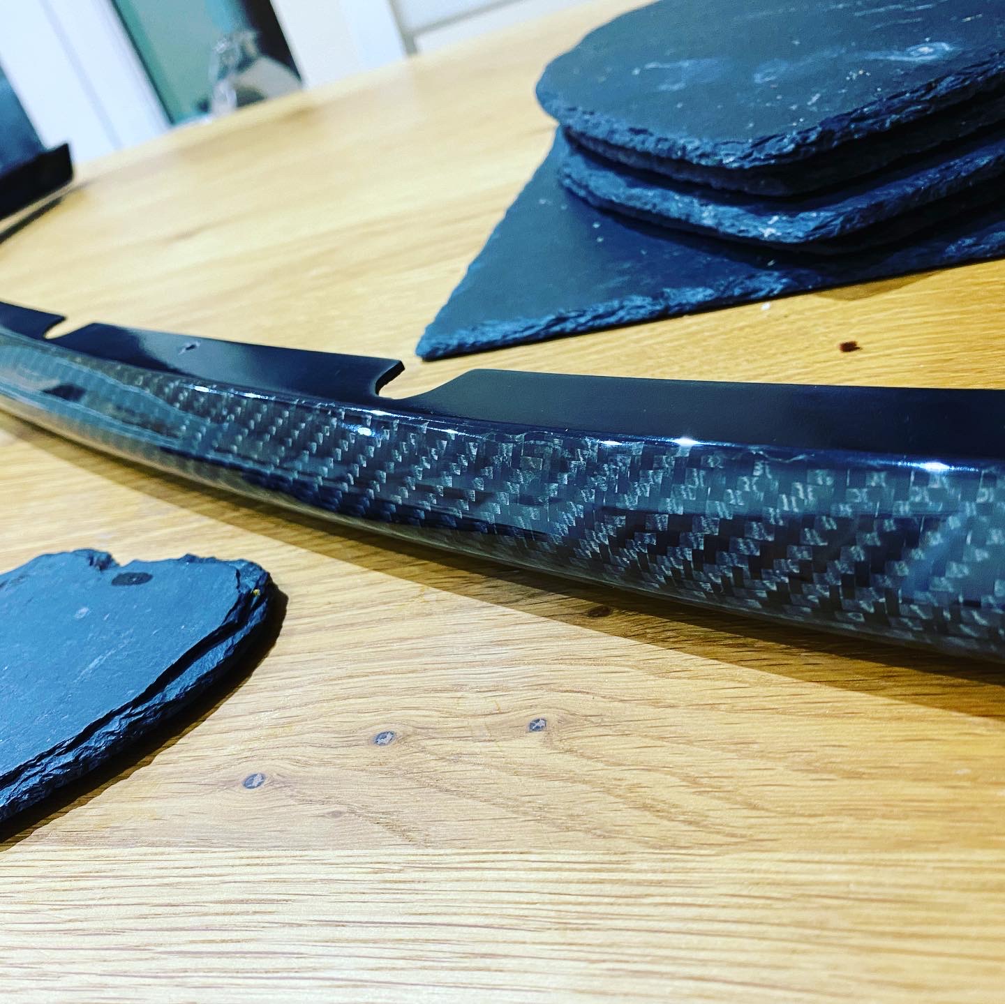

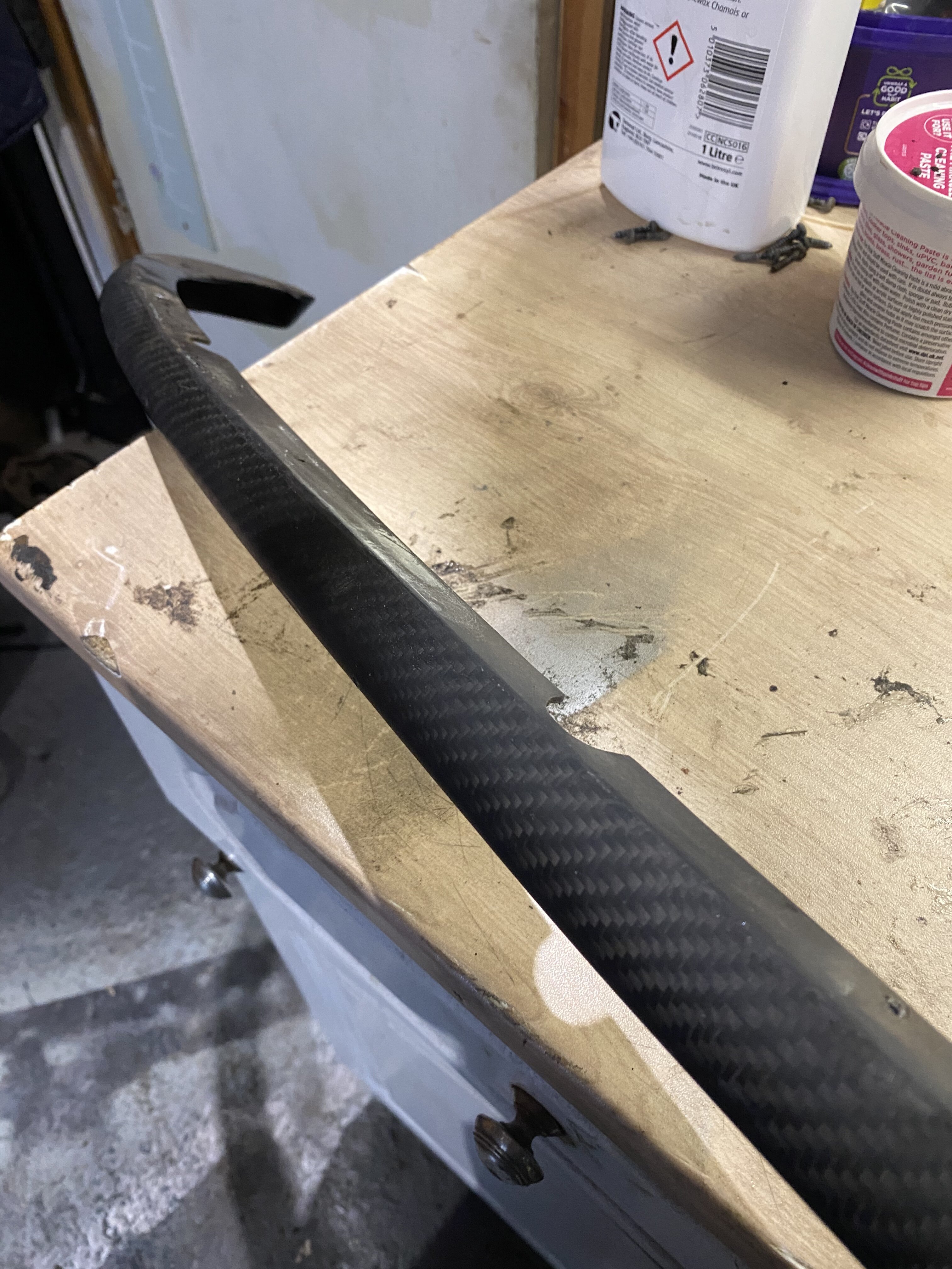

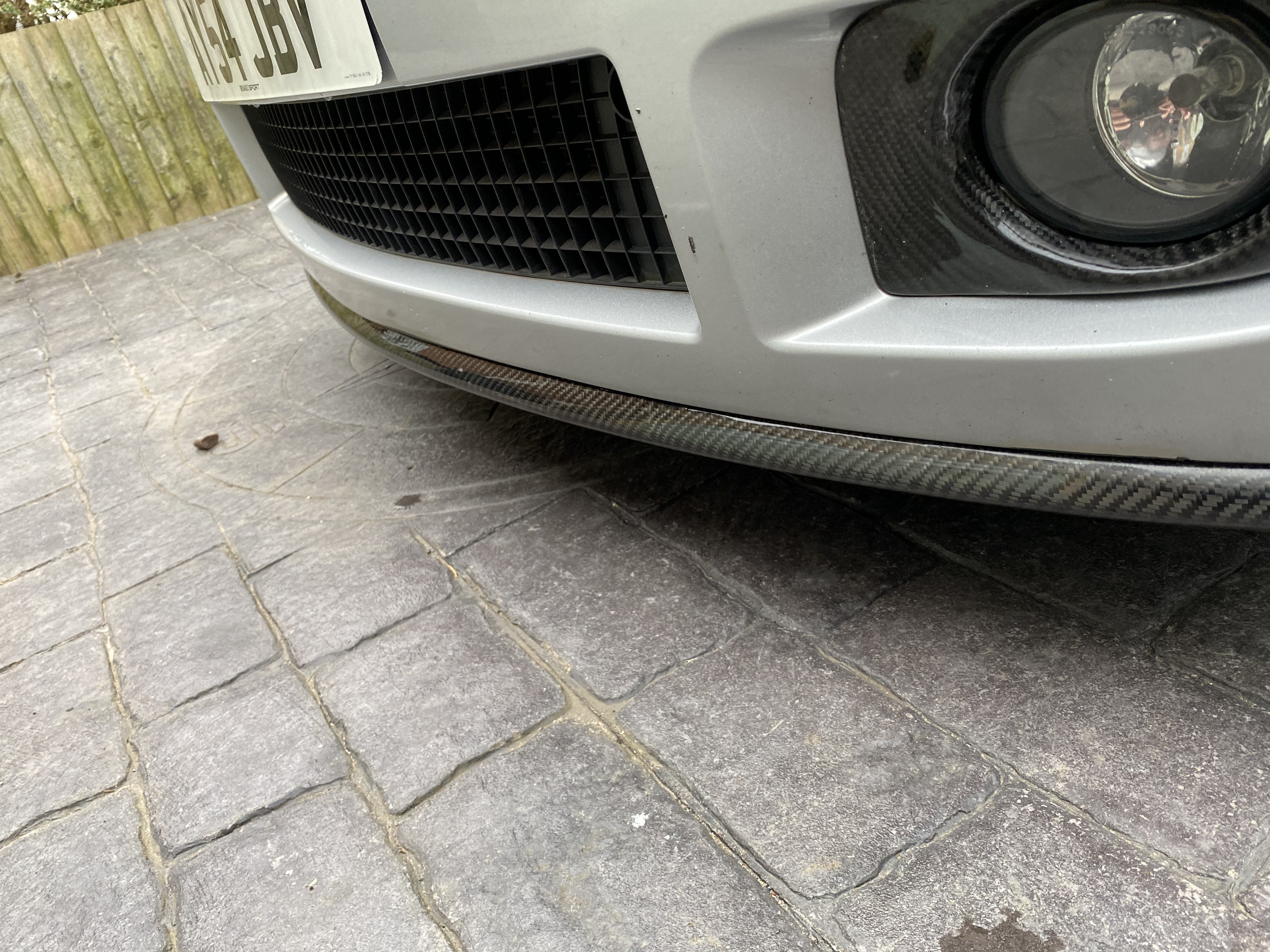

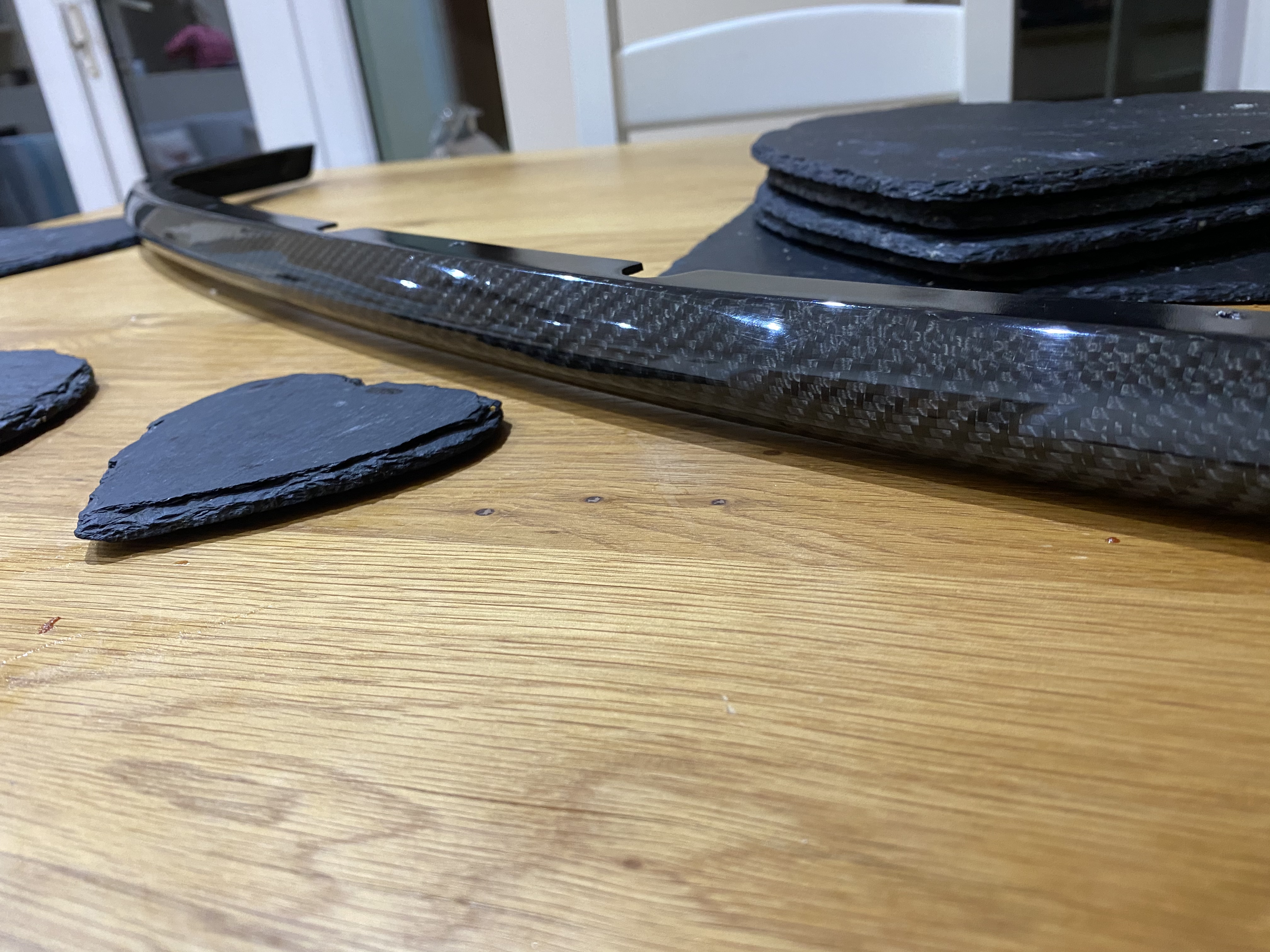

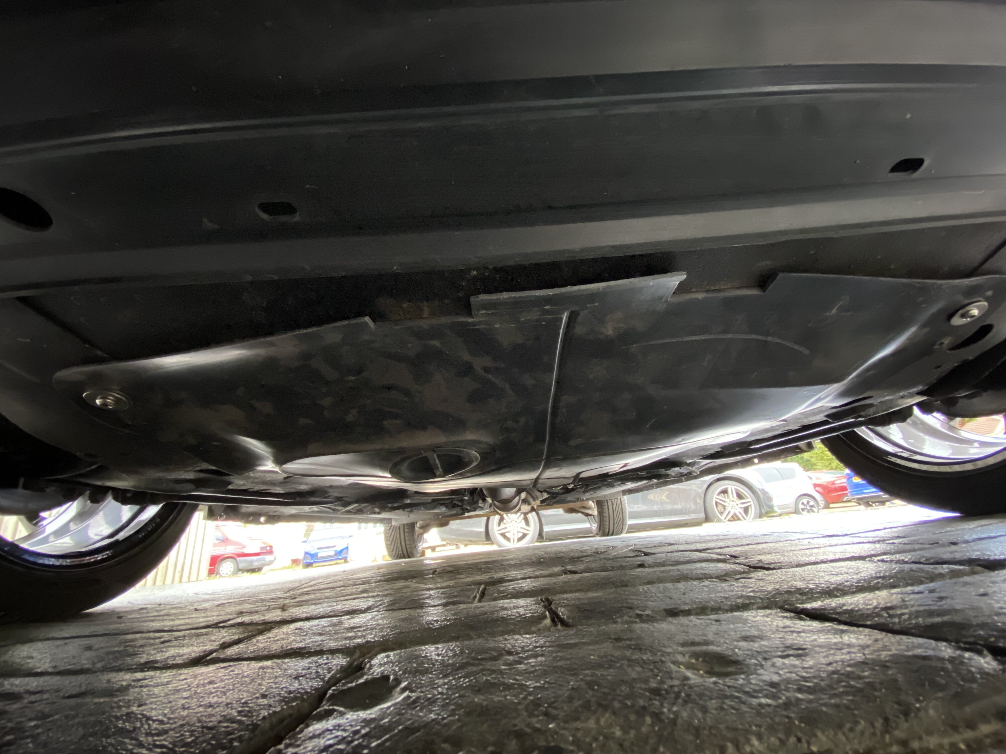

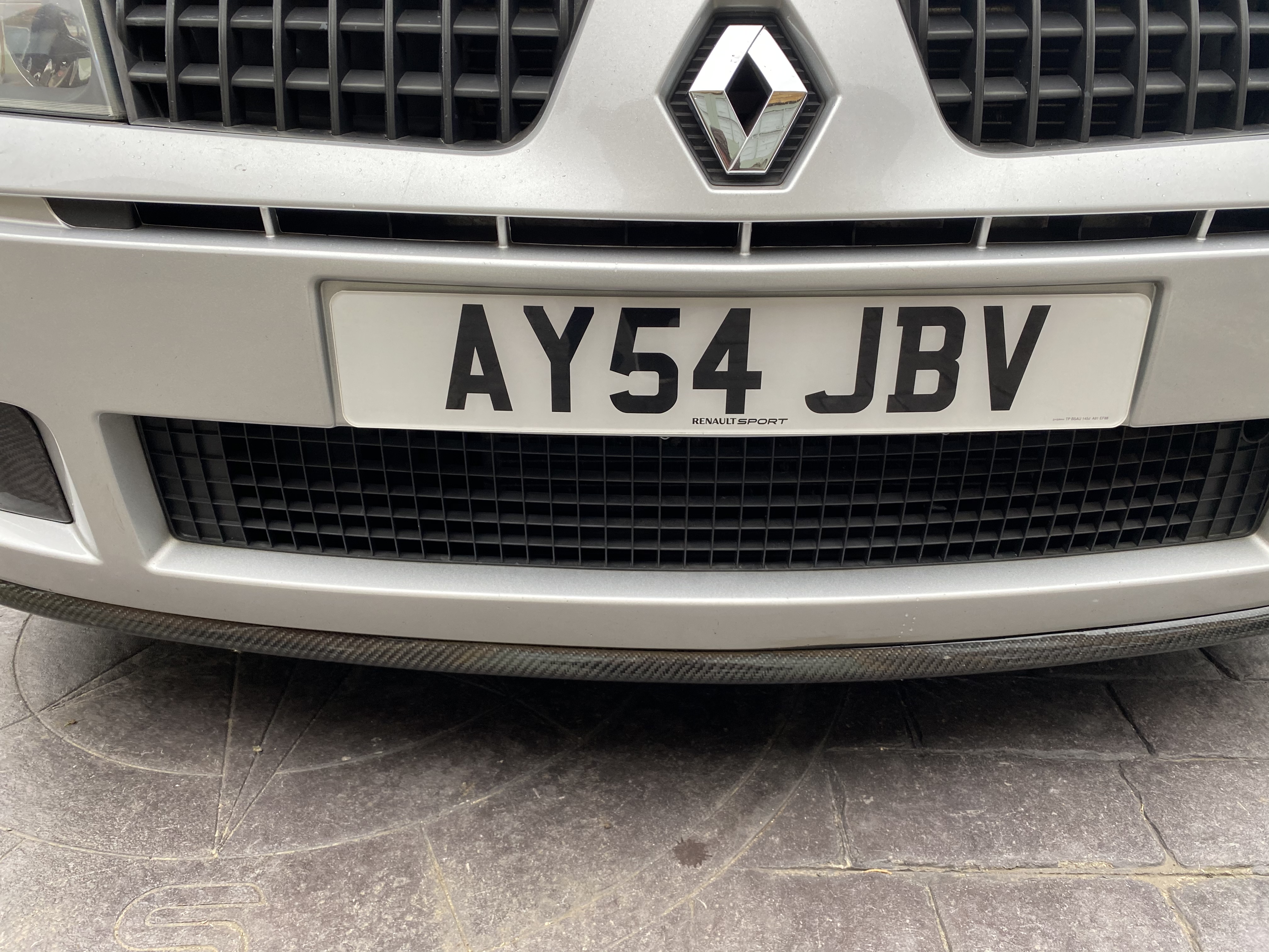

Spent some time this week refinishing my carbon splitter. Obviously these get a bit of a kicking where they sit. I rubbed the clear coat down to remove hazing then refinished in lacquer before refitting with stainless hardware. It ties in the fog light surrounds and washer blanks in nicely as the previous matte finish was almost opaque.
Pretty happy with it, I will likely get the front bumper blown in over the summer. It’s in prettt clean condition, but I’m fussy and there are a few marks which twist my chubby melon somewhat!

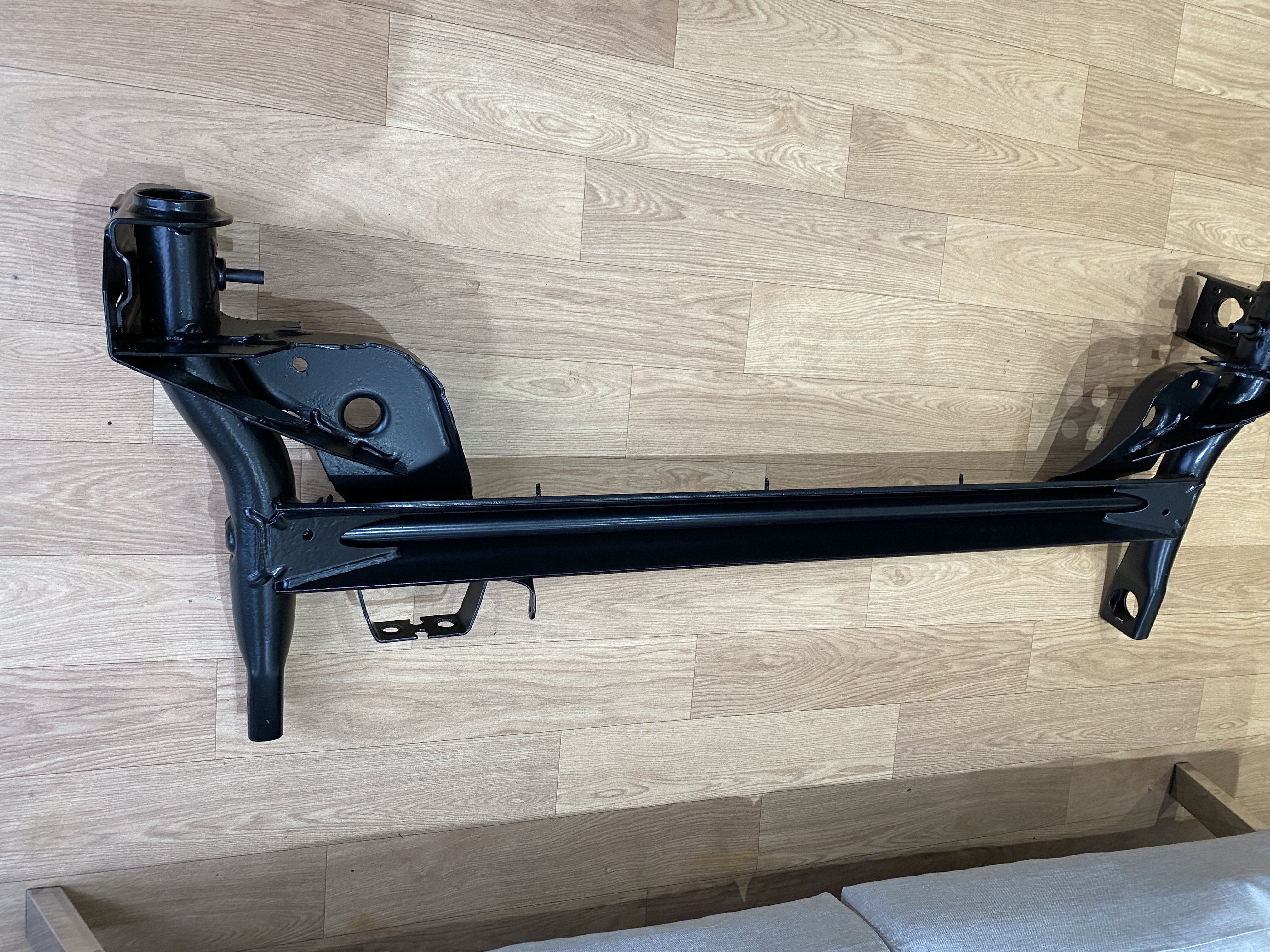

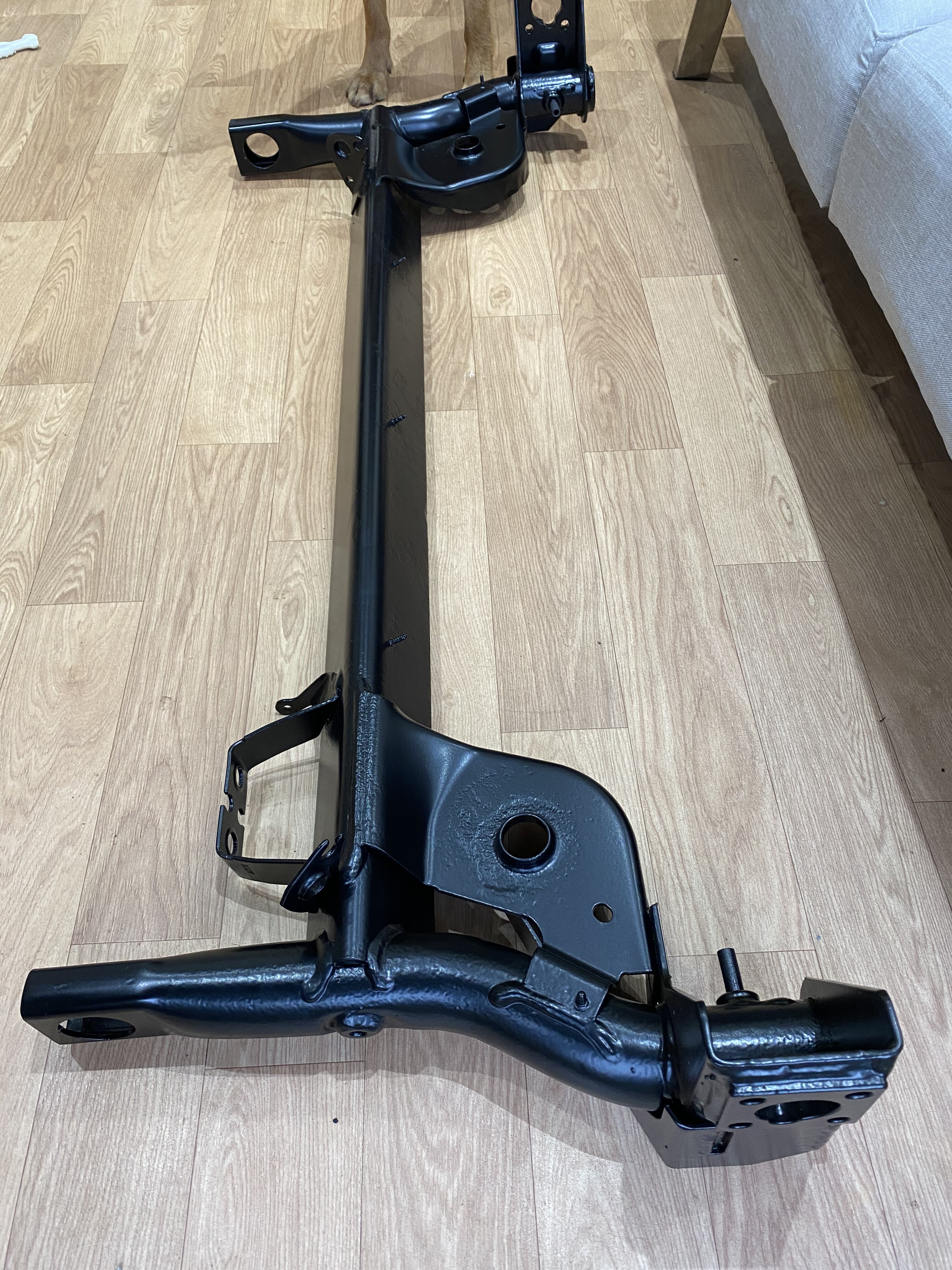

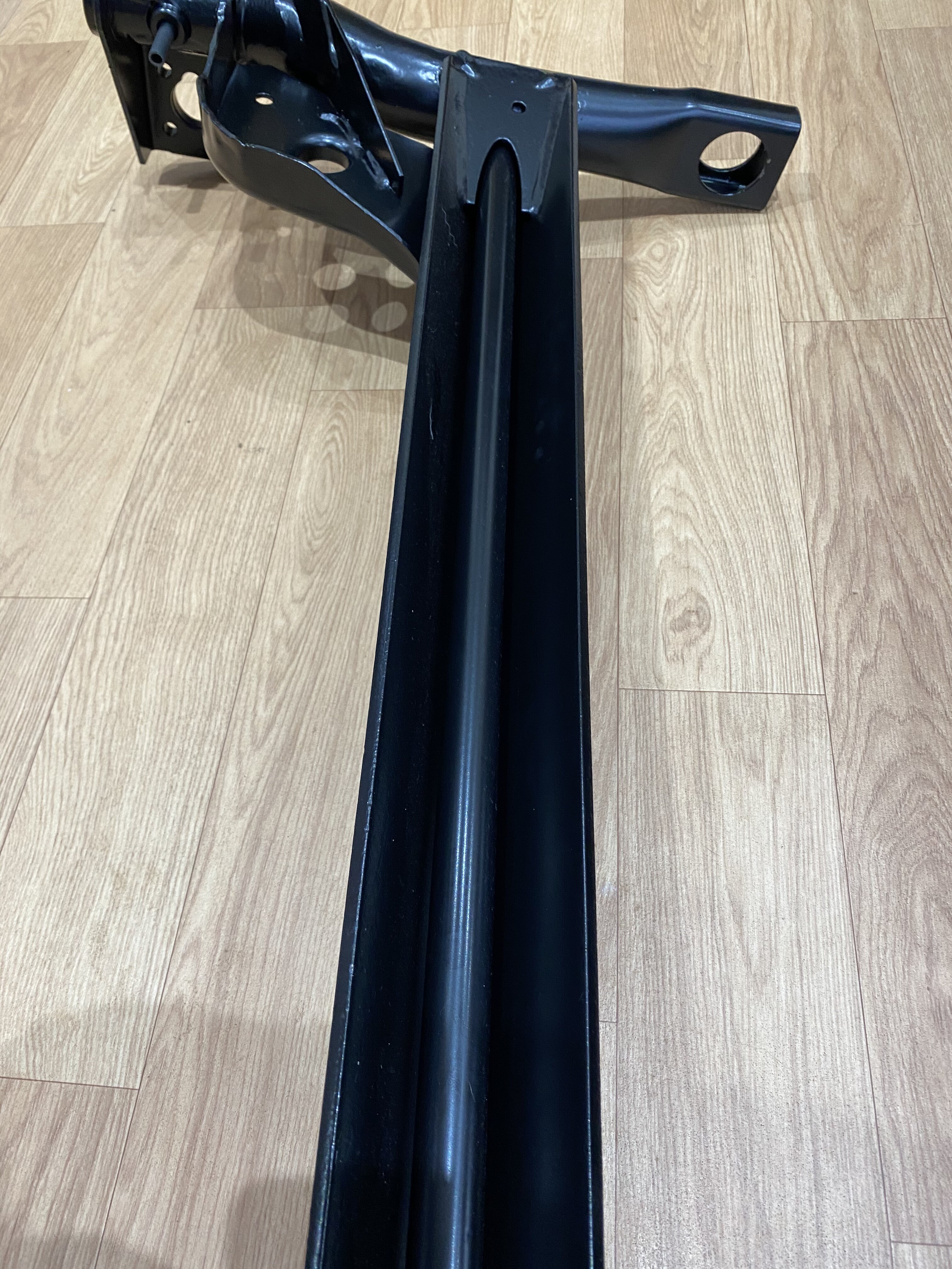

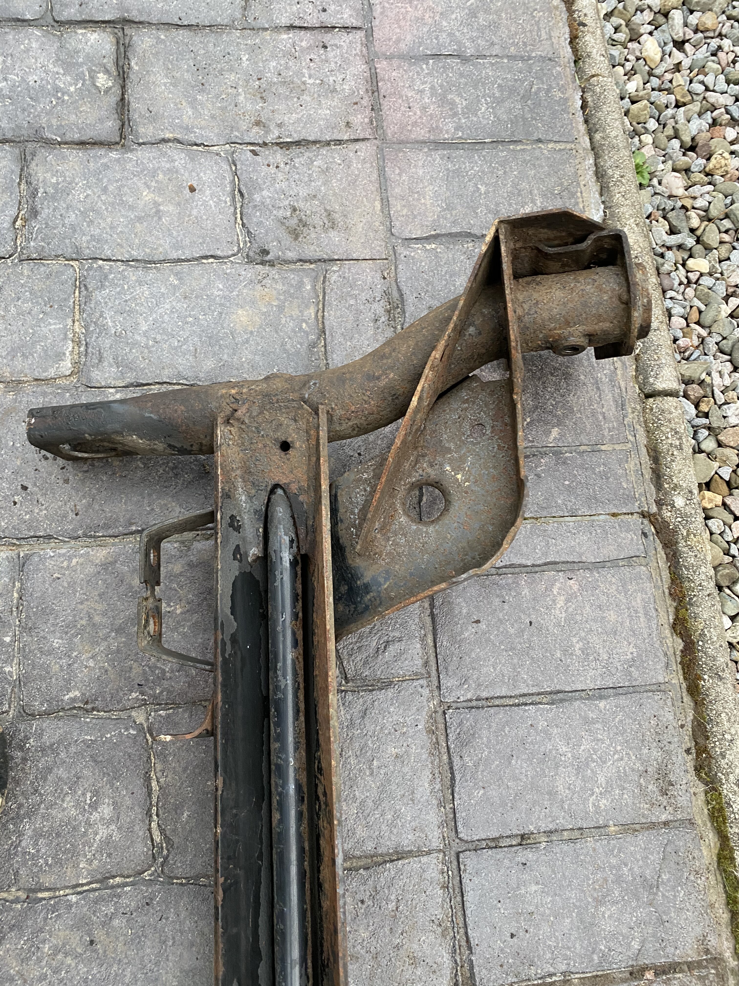

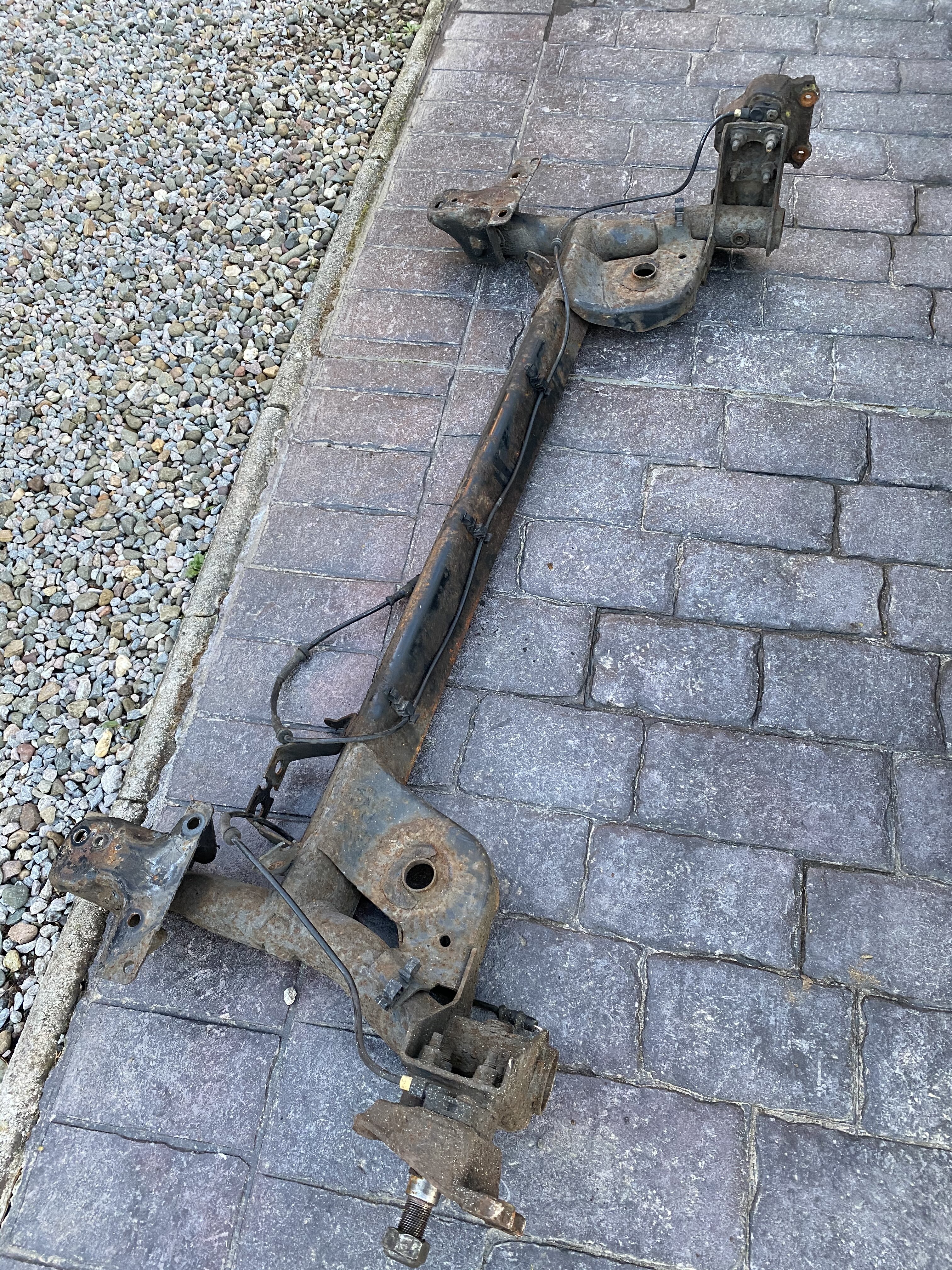

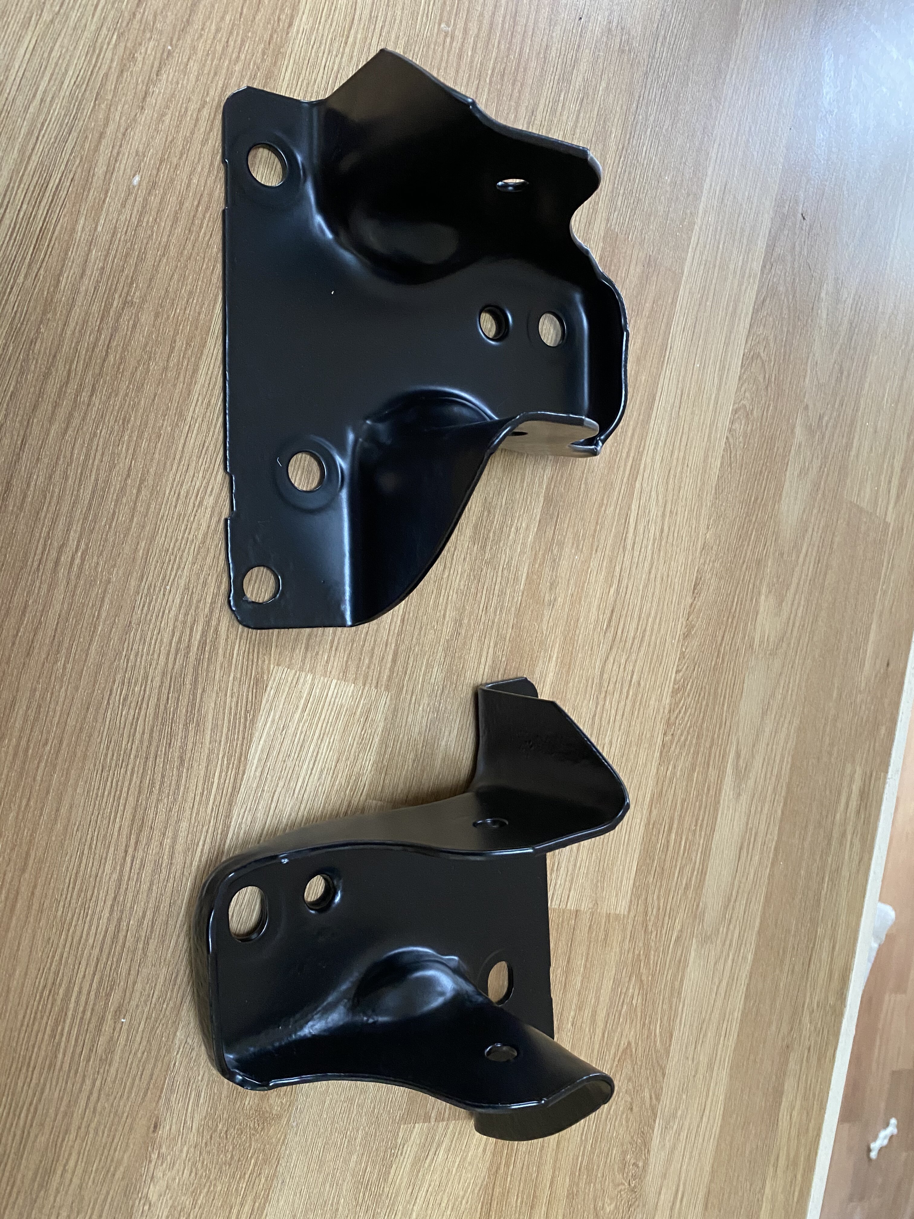

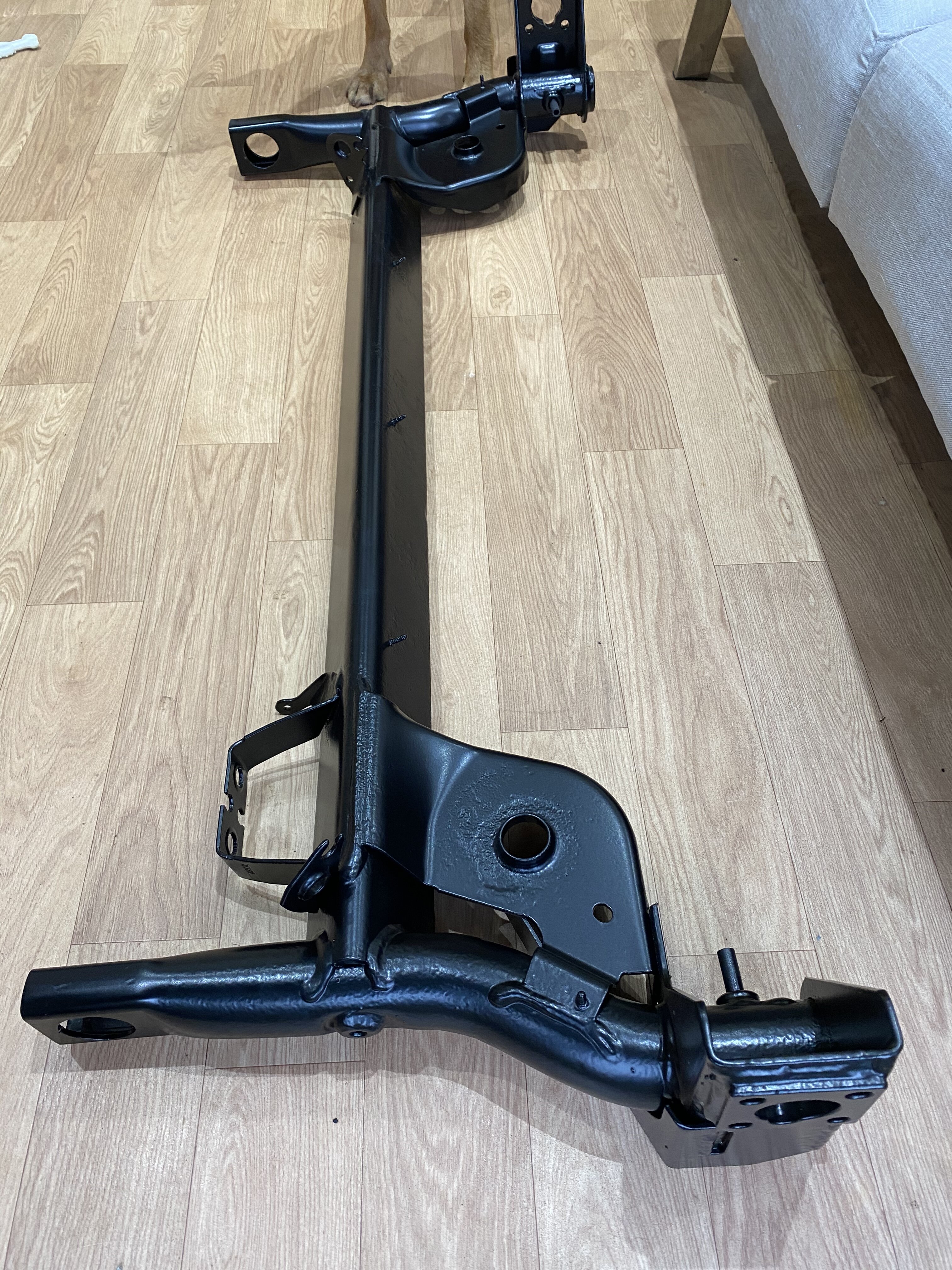

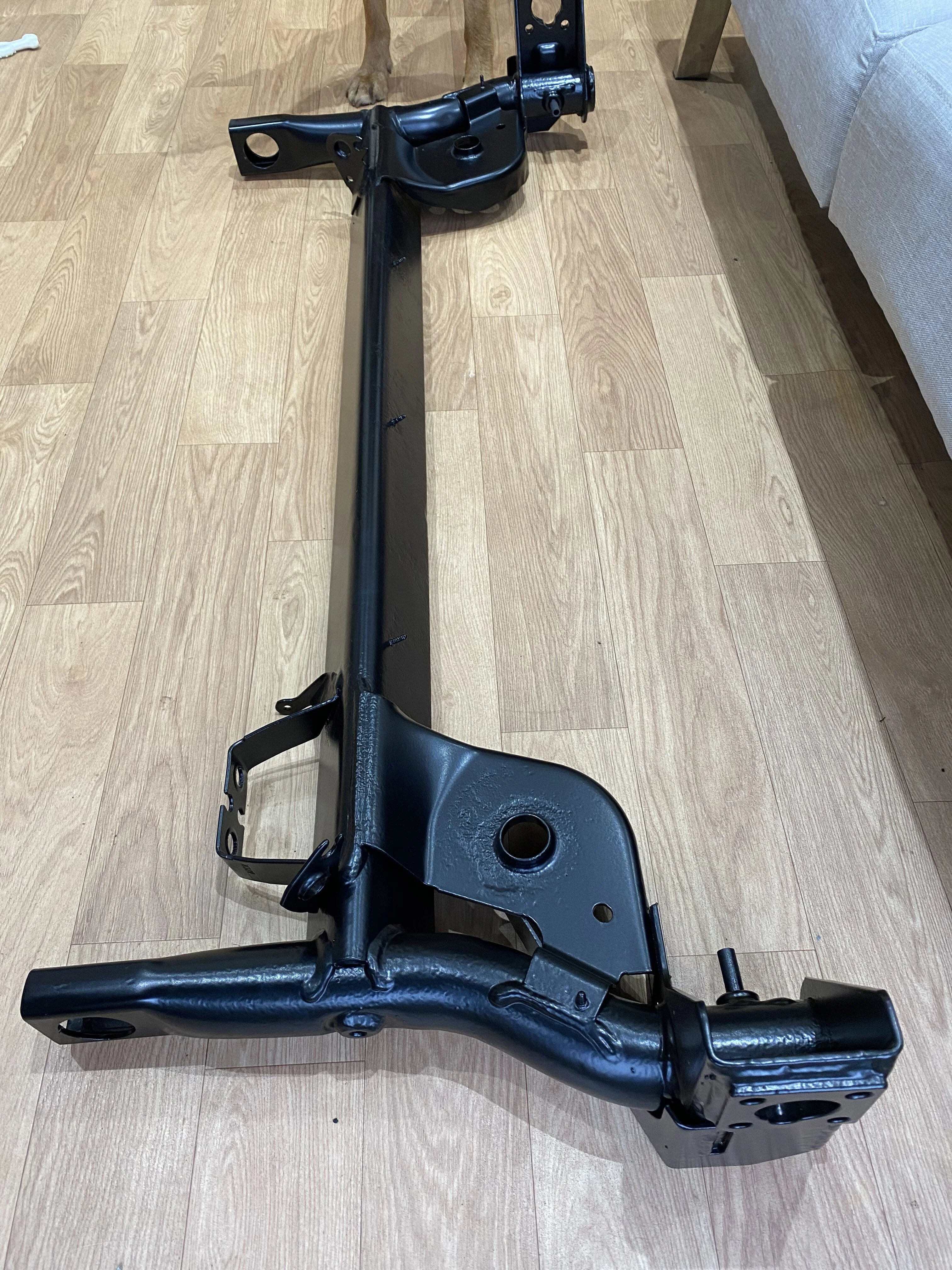

Noticed I forgot to add a post around my rear beam! I managed to pick a 182 beam from James at JMRS (with the extra strengthening plate) .
I dropped the old bushes out and sent it to the powder coaters, along with the brackets. I’m happy with the results given it was typically a block of rust. House build starts tomorrow, so the car won’t be having this fitted until the summer now I don’t think. But I’ll build it up over the coming weeks so it’s ready

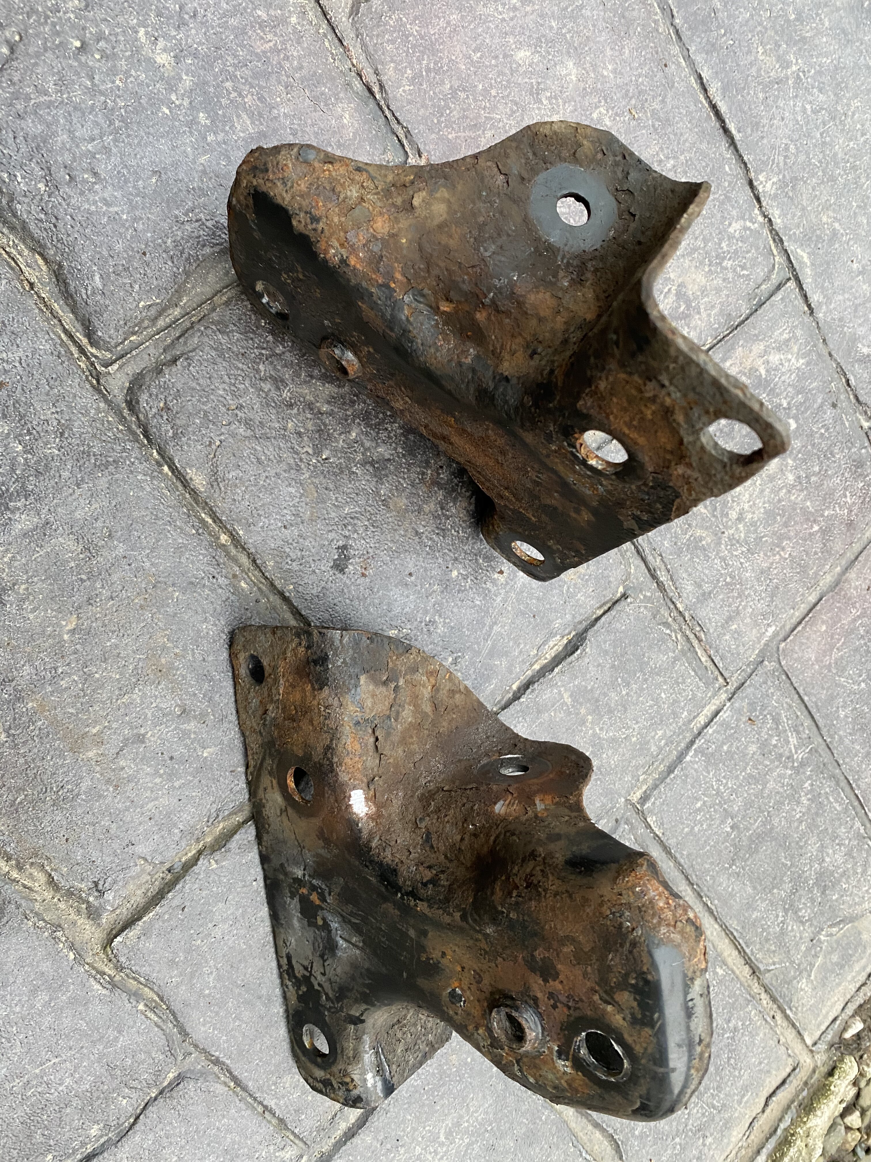

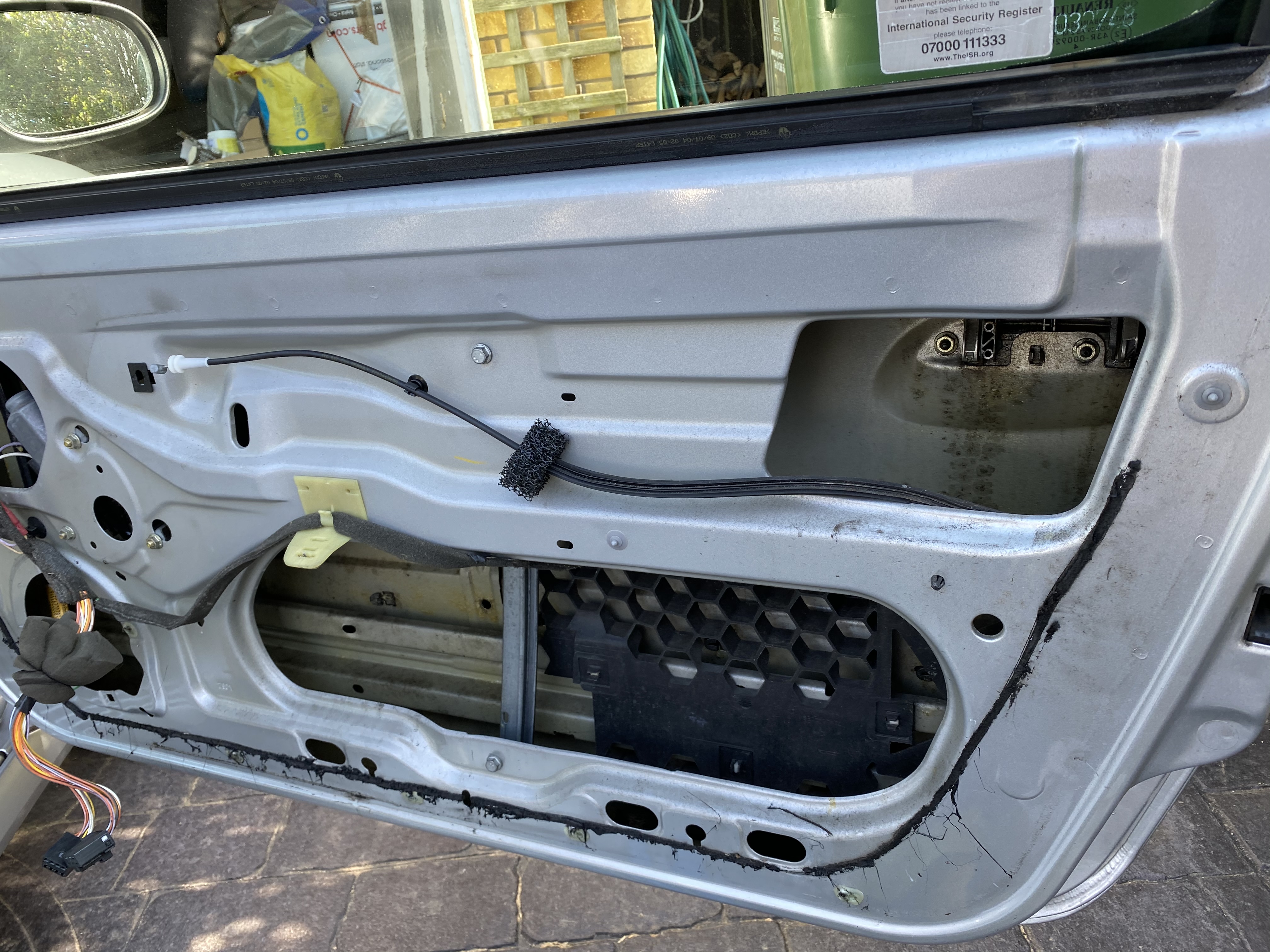

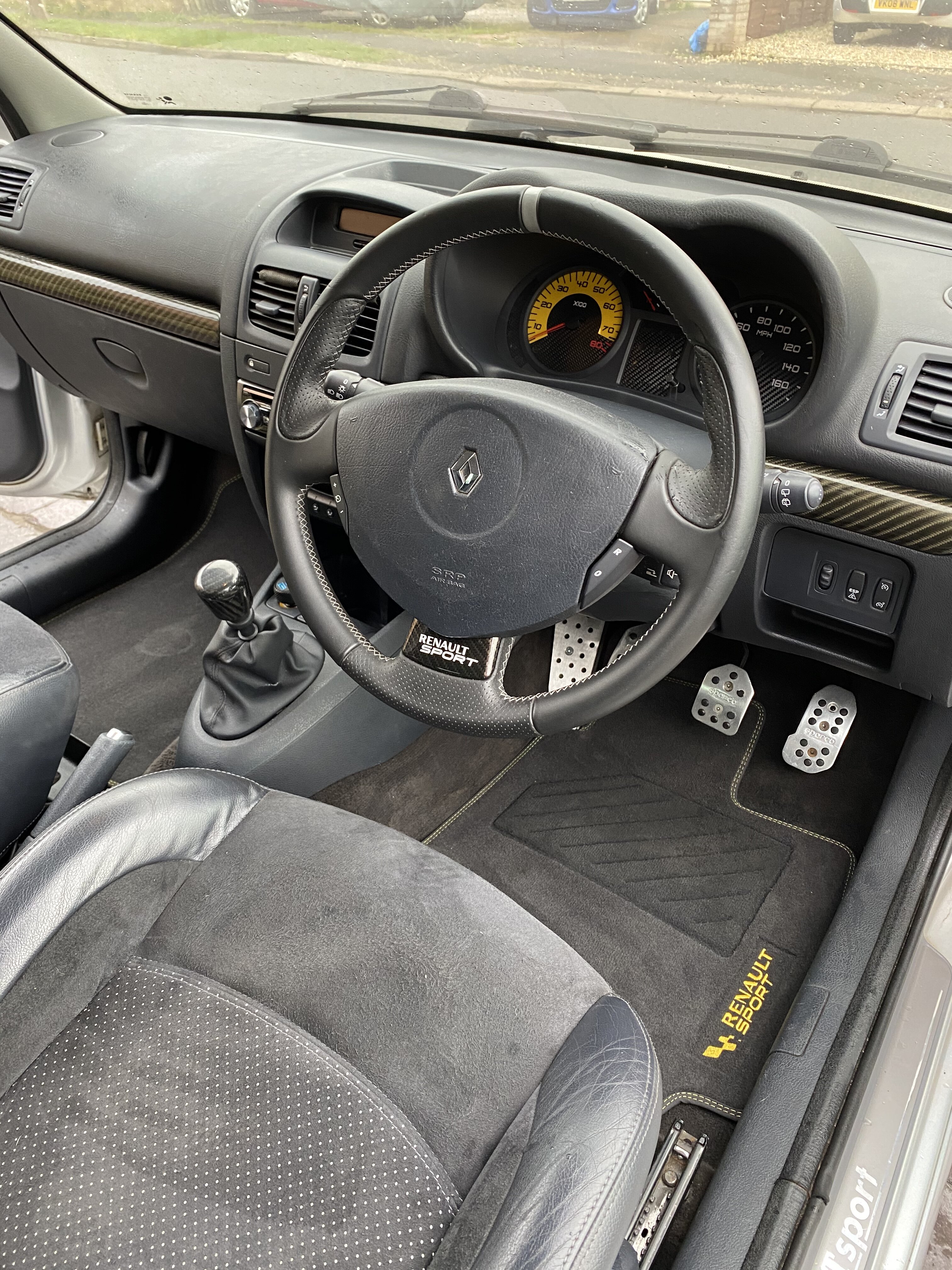

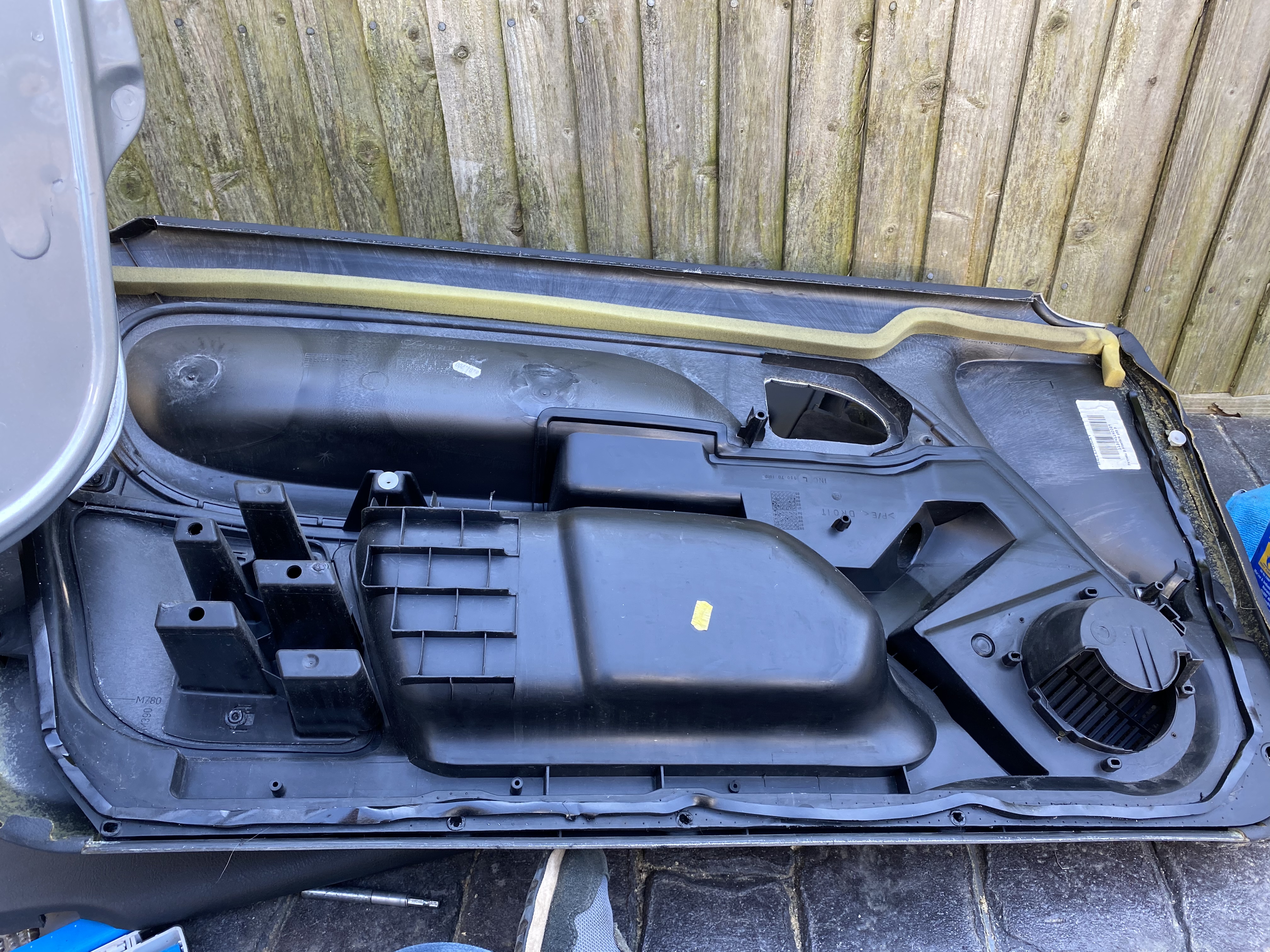

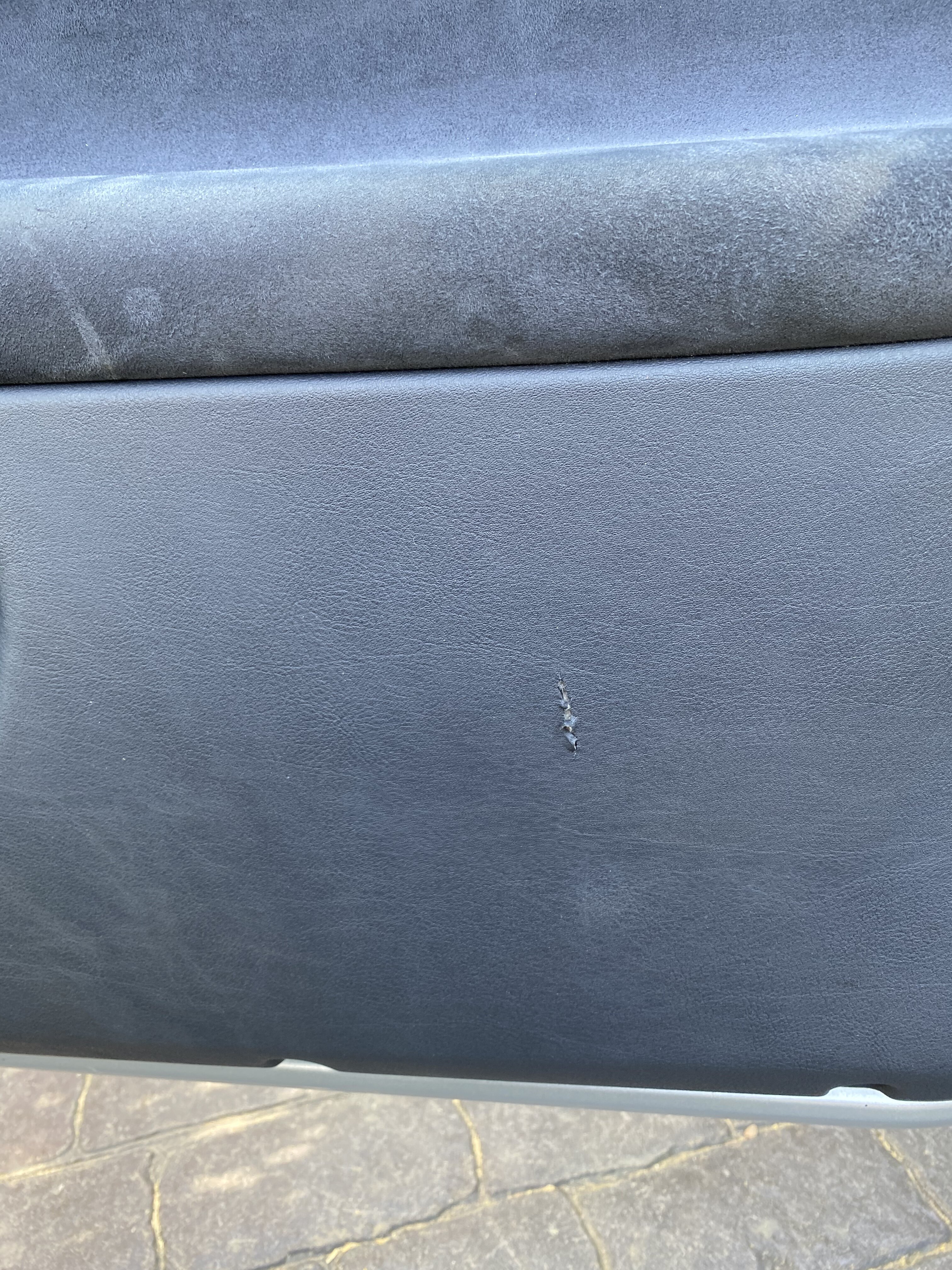

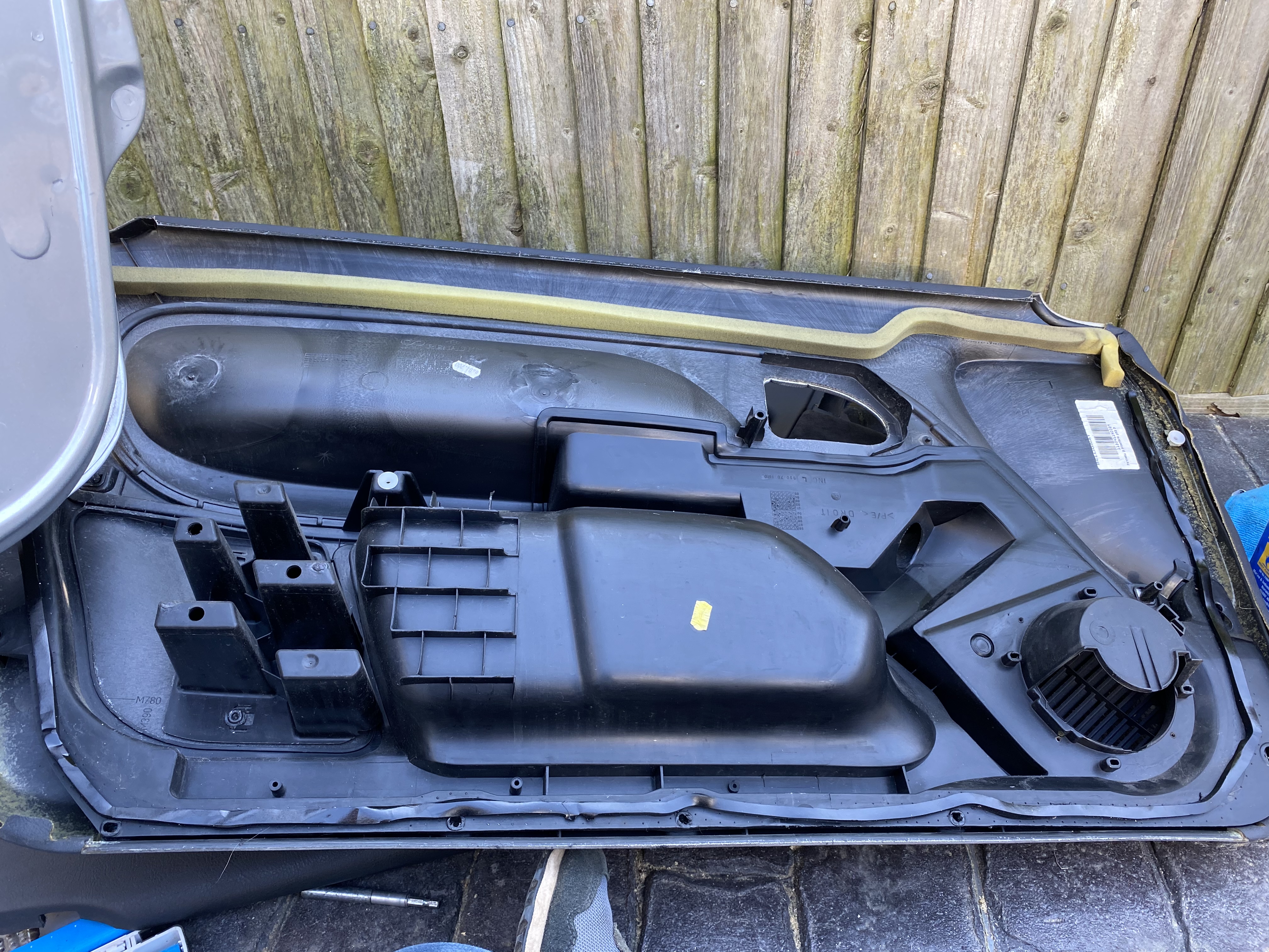

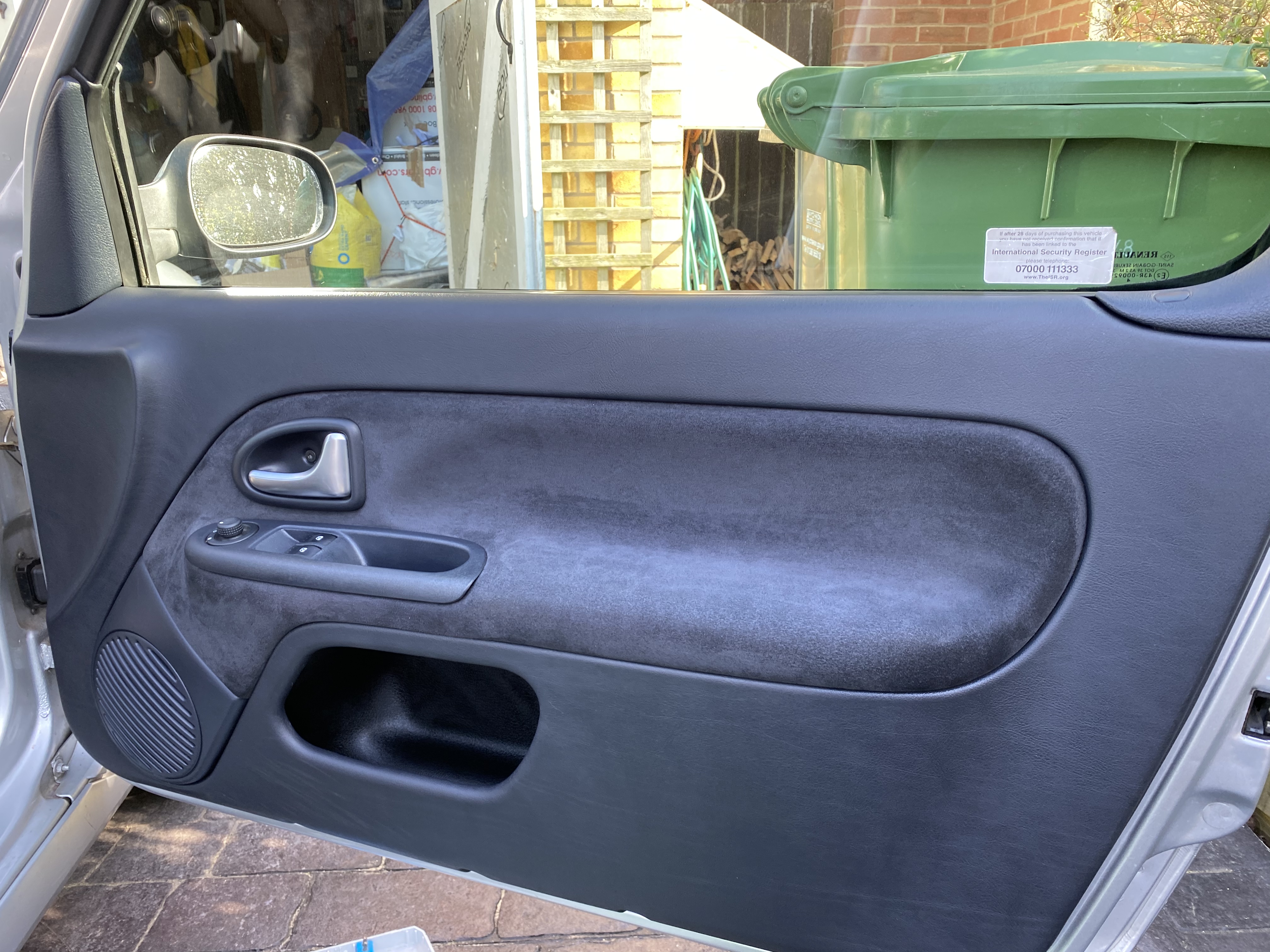

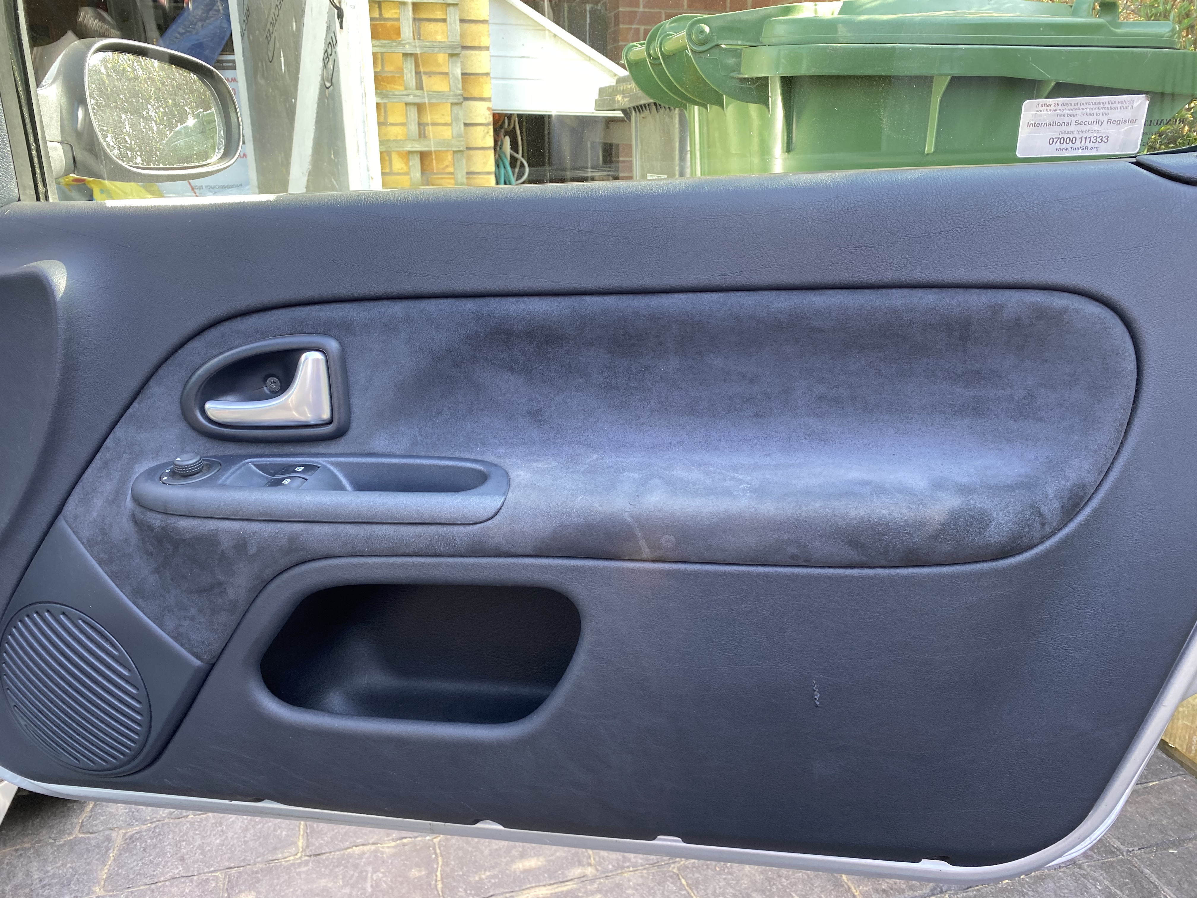

Not a great deal to update really. Other than the car has been taxed finally and I have been thrashing it around all weekend...finally! I need to get the car in for an alignment, so will try and sort over the coming week.

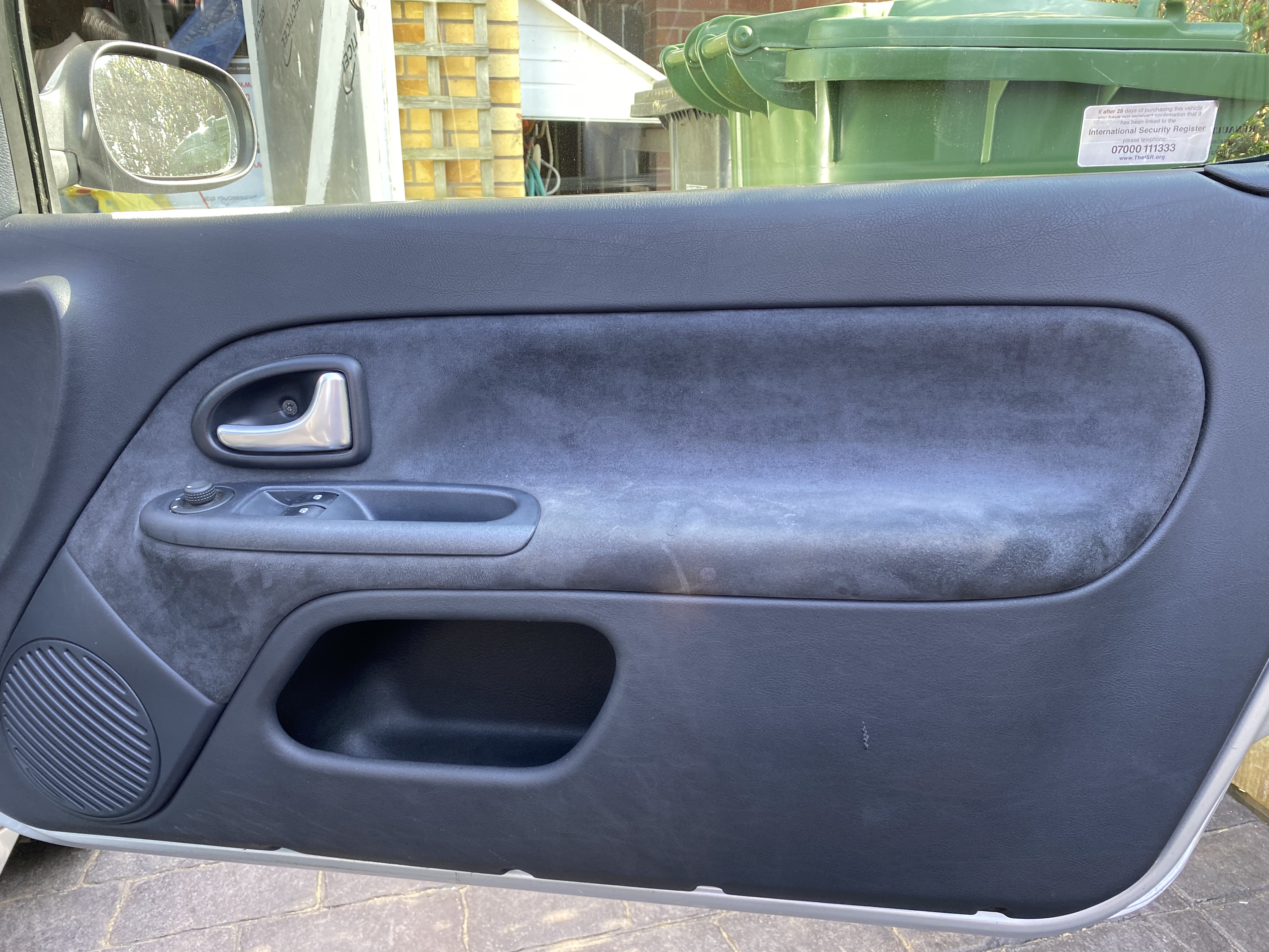

I took a trip over to see @DomP182 to collect some interior trim, he had previously collect off me! The drivers side door card on my car had a nasty scratch/gouge and was generally minging.

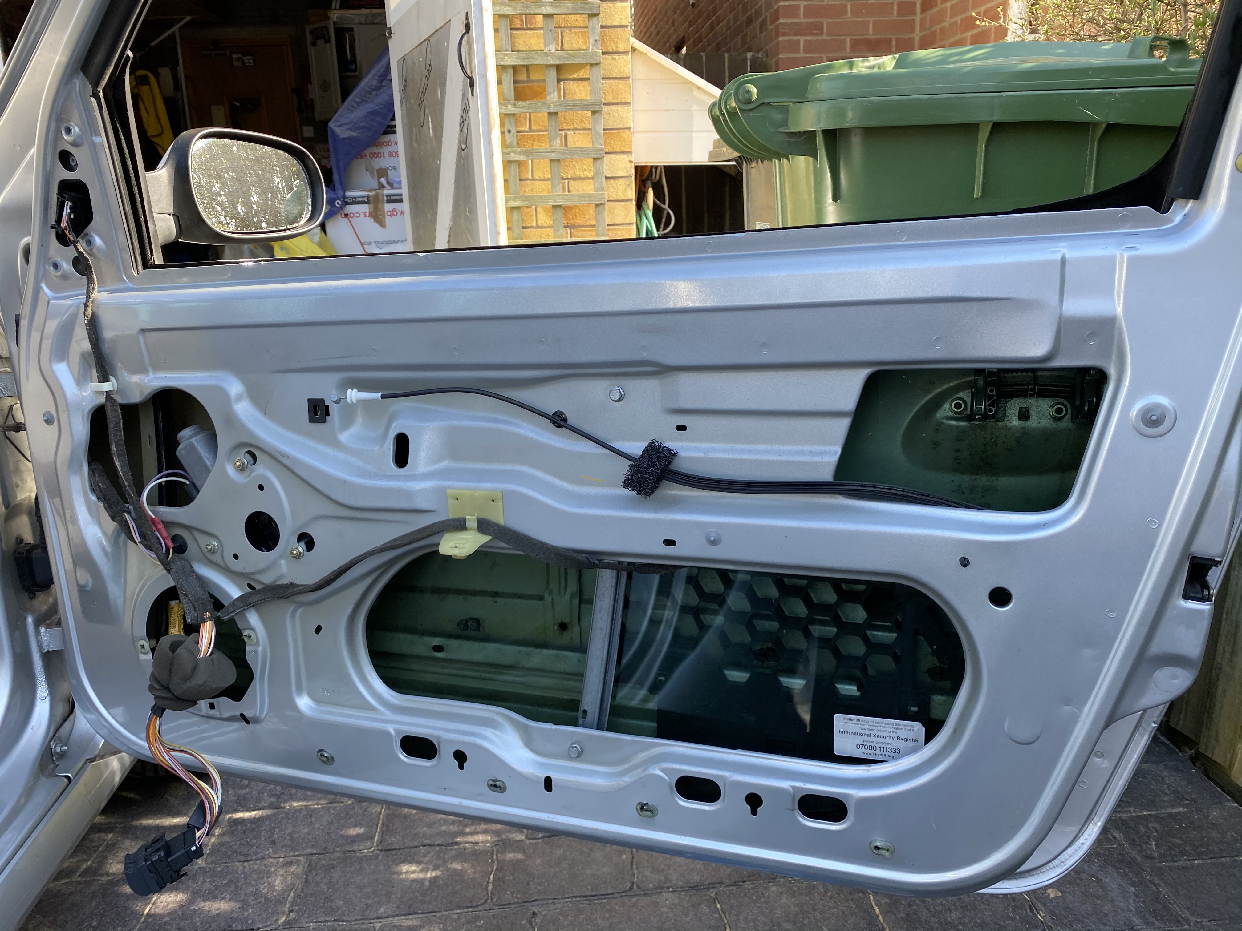

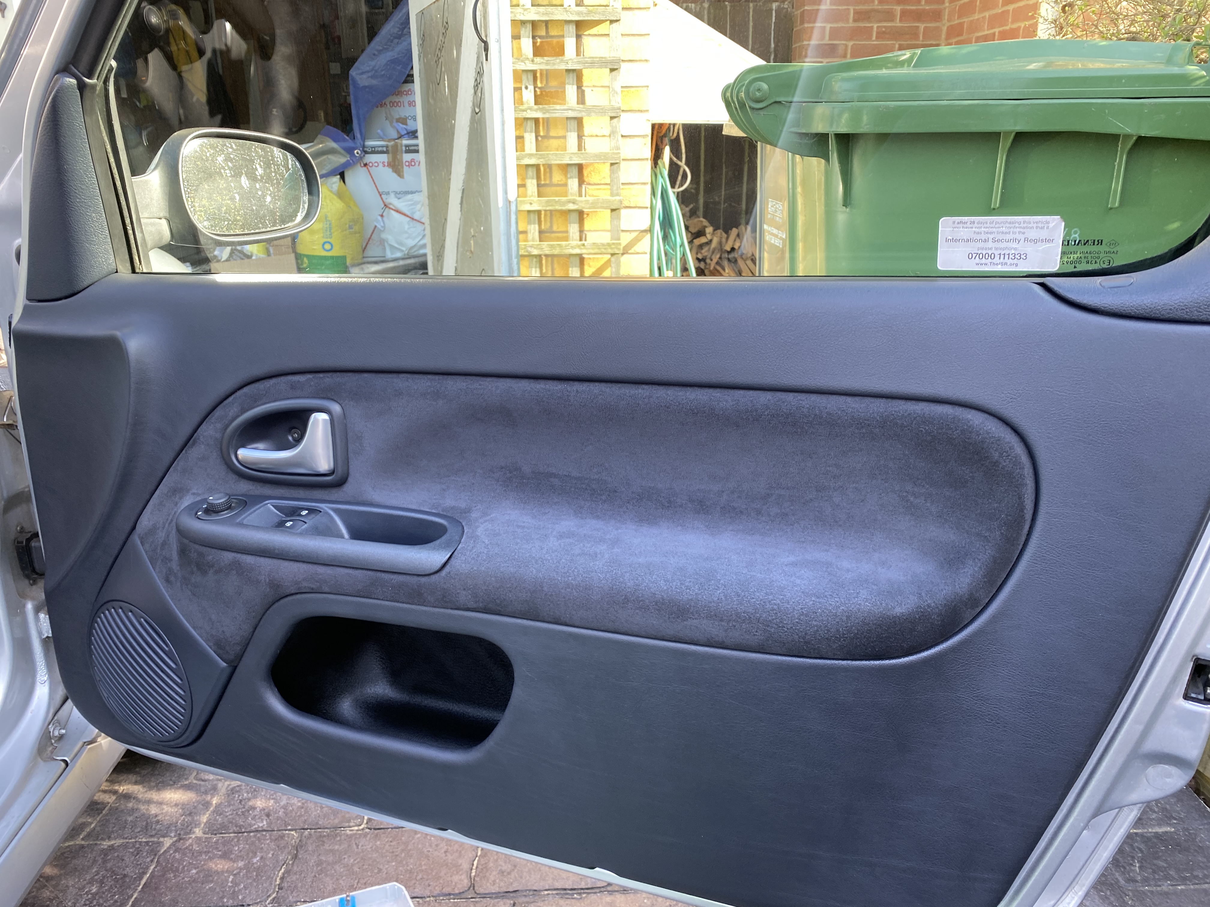

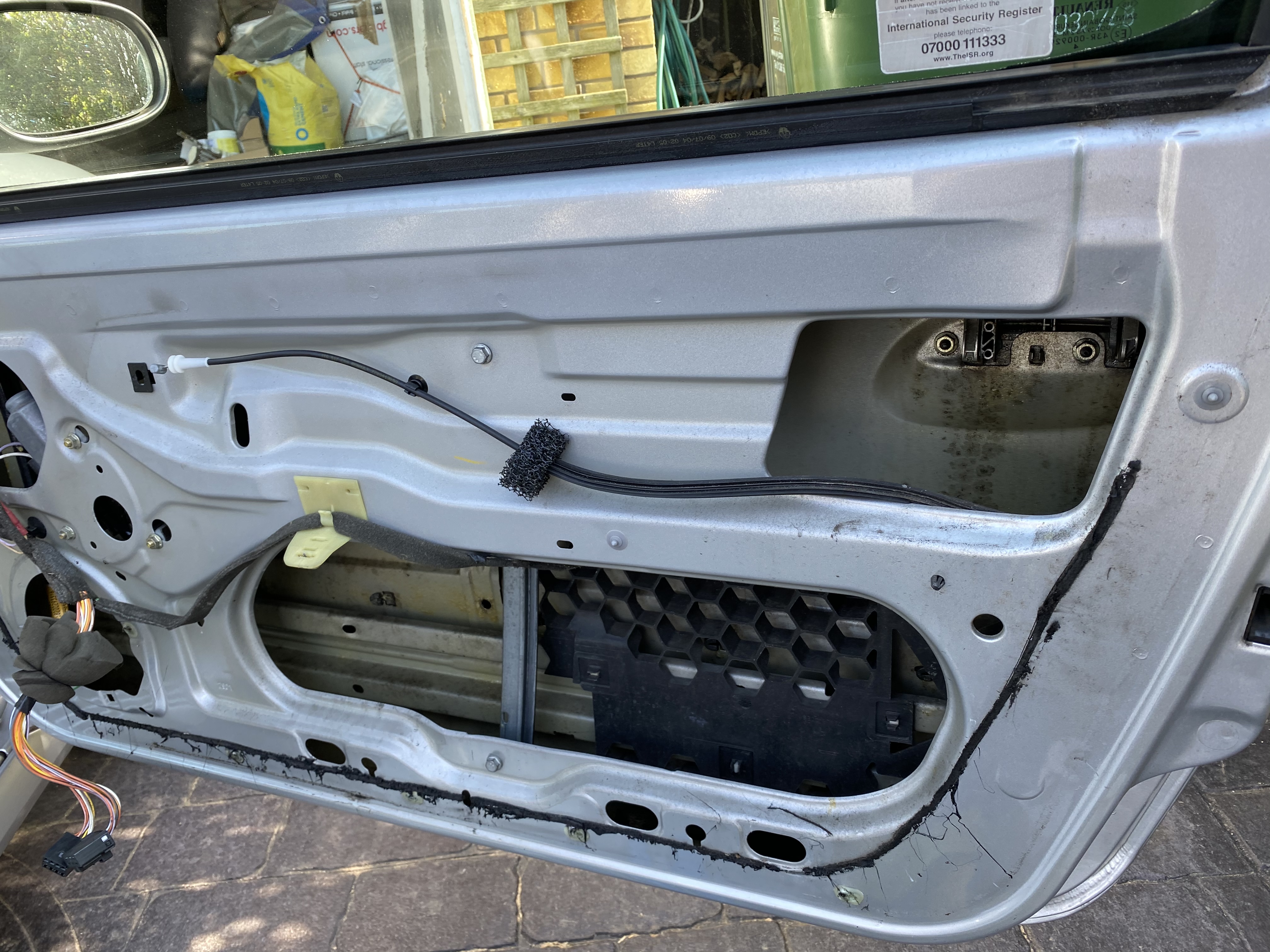

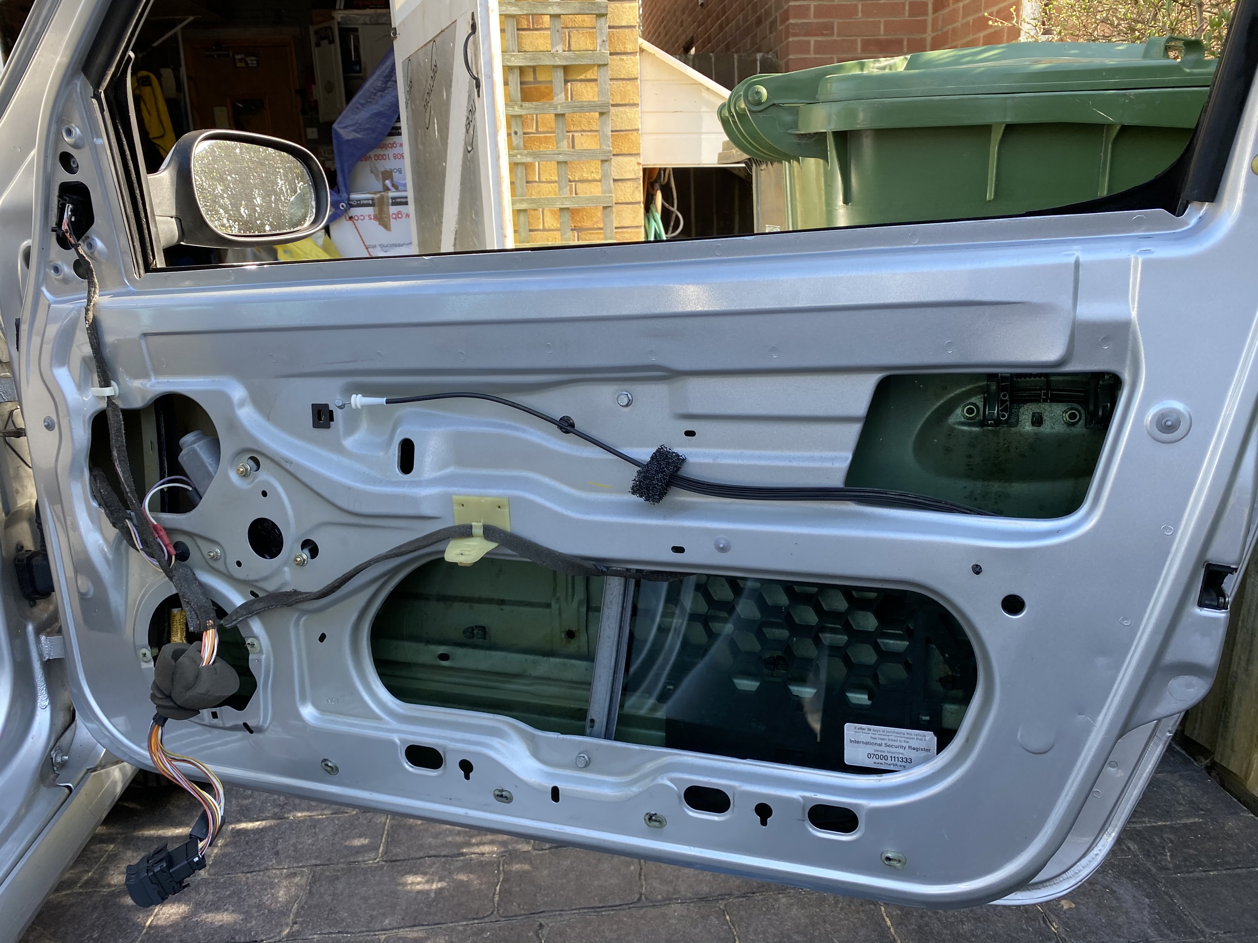

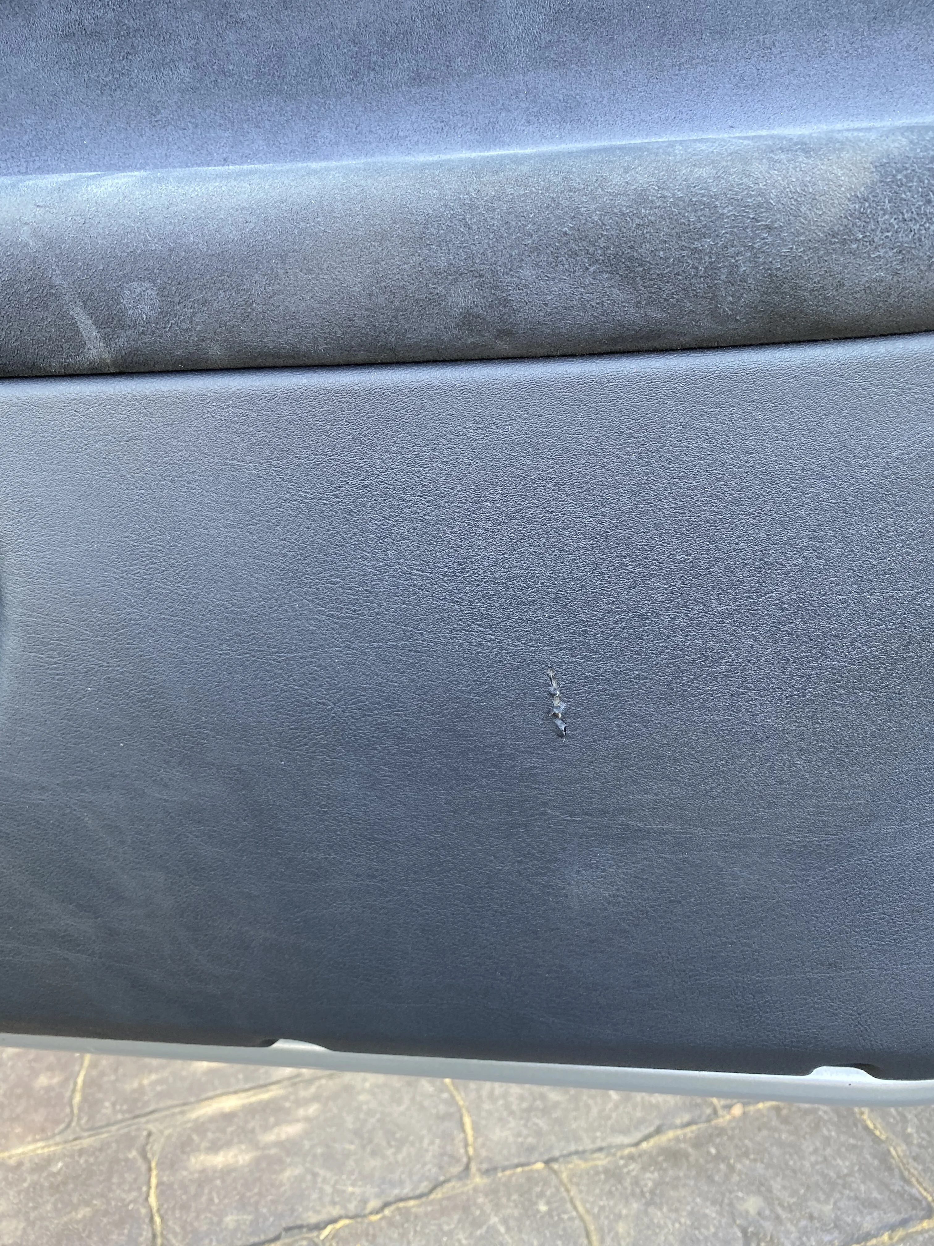

I stripped the old door card off, spent a good hour removing the butyl tape residue, cleaned the inner skin of 17 years worth of detritus, bodily fluids and dead skin. Before adding new Butyl tape and refitting. Easy job really but satisfying none the less.
Managed to ruin my drivers side arch liner thanks to my ham fisted spannering (forgot to attach the leading edge) luckily I managed to cable tie it to my front splitter! Oh and The bloody thing drones like f**k at 2500rpm! Need a centre silence for sure
View attachment 1531062View attachment 1531063
View attachment 1531065View attachment 1531067

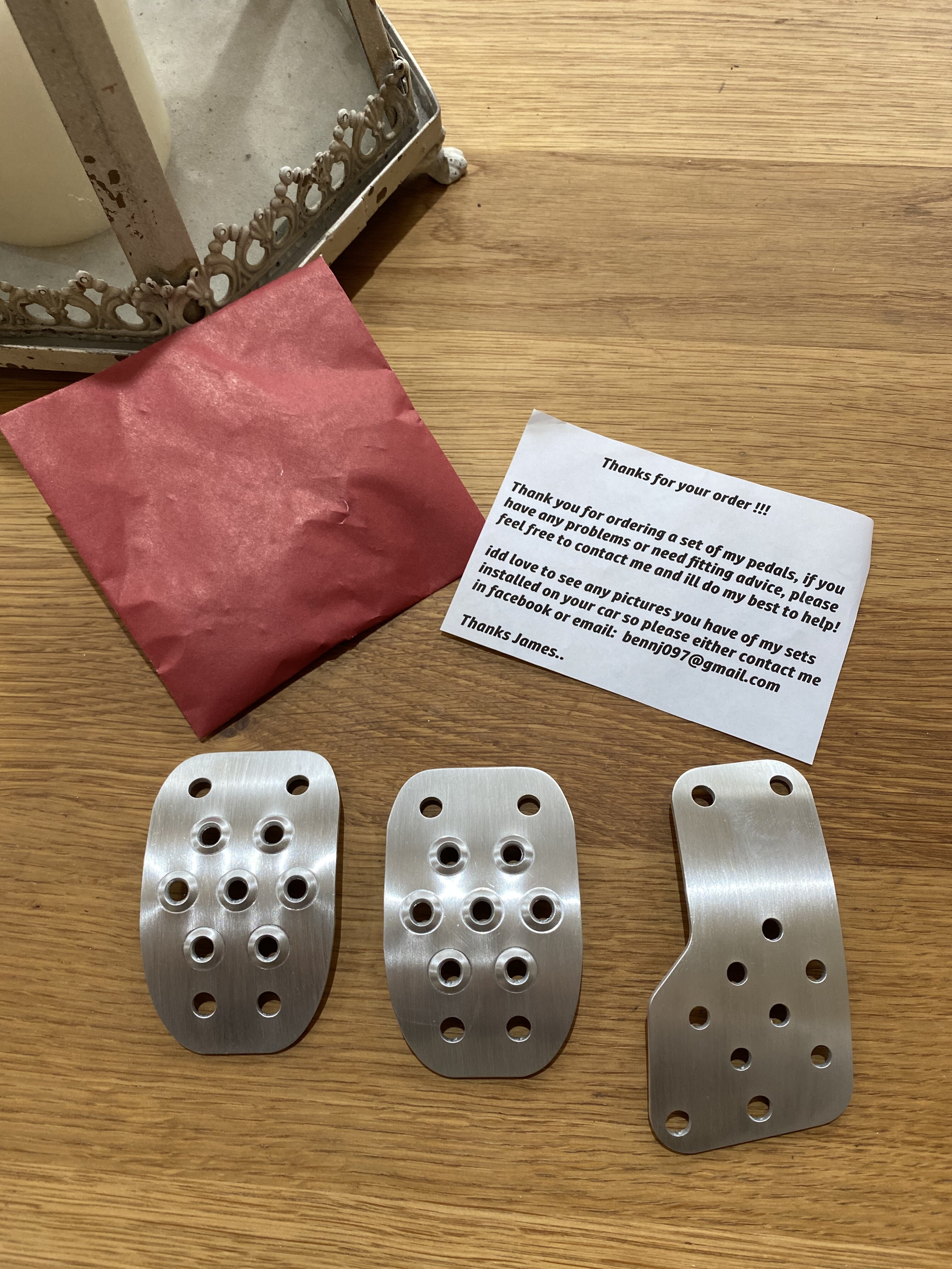

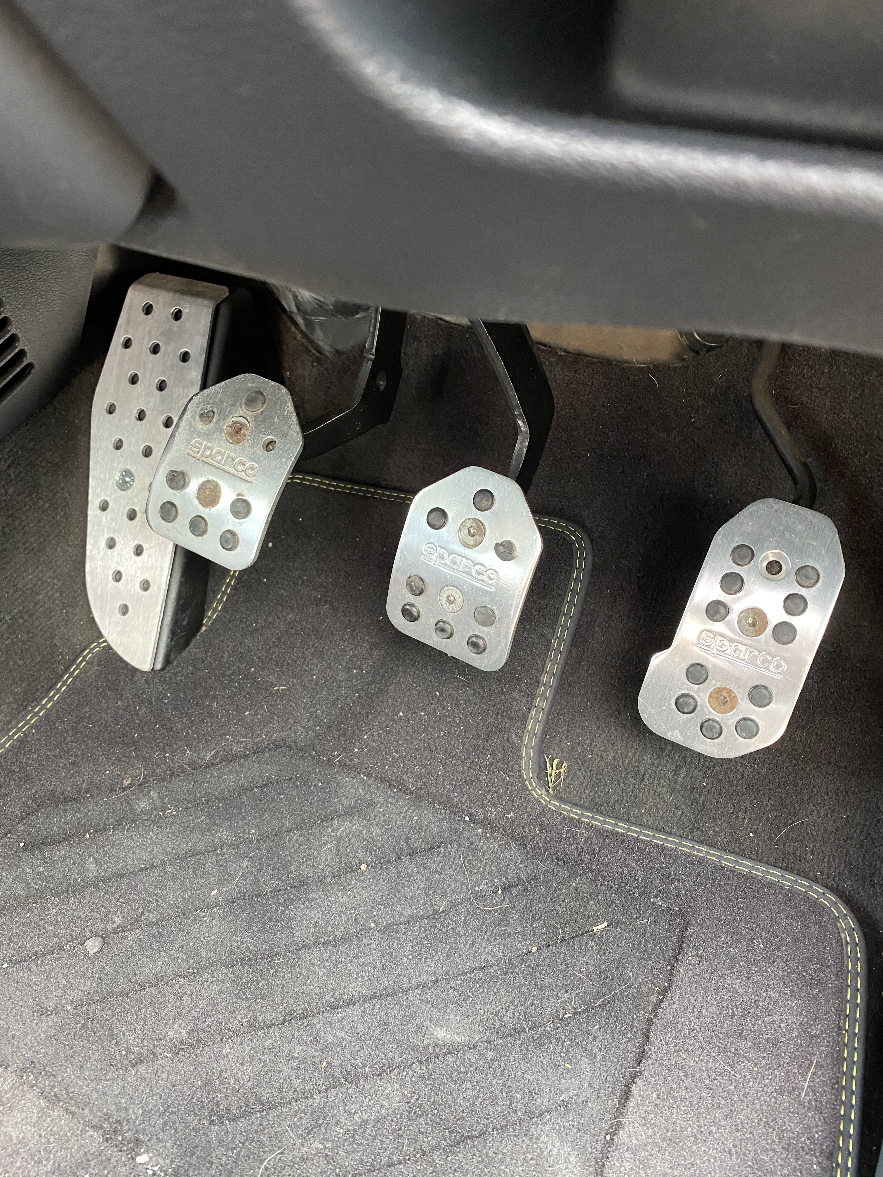

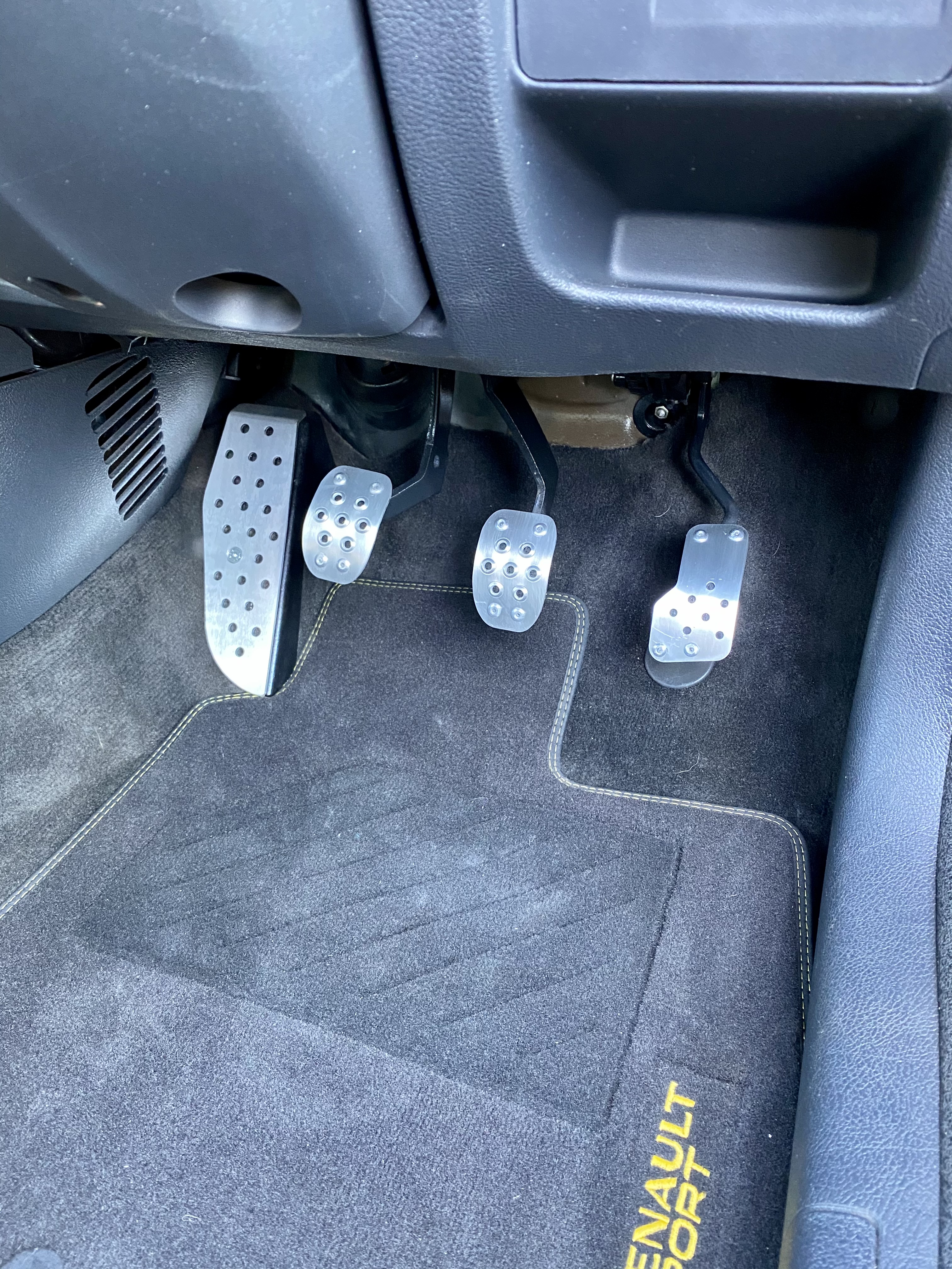

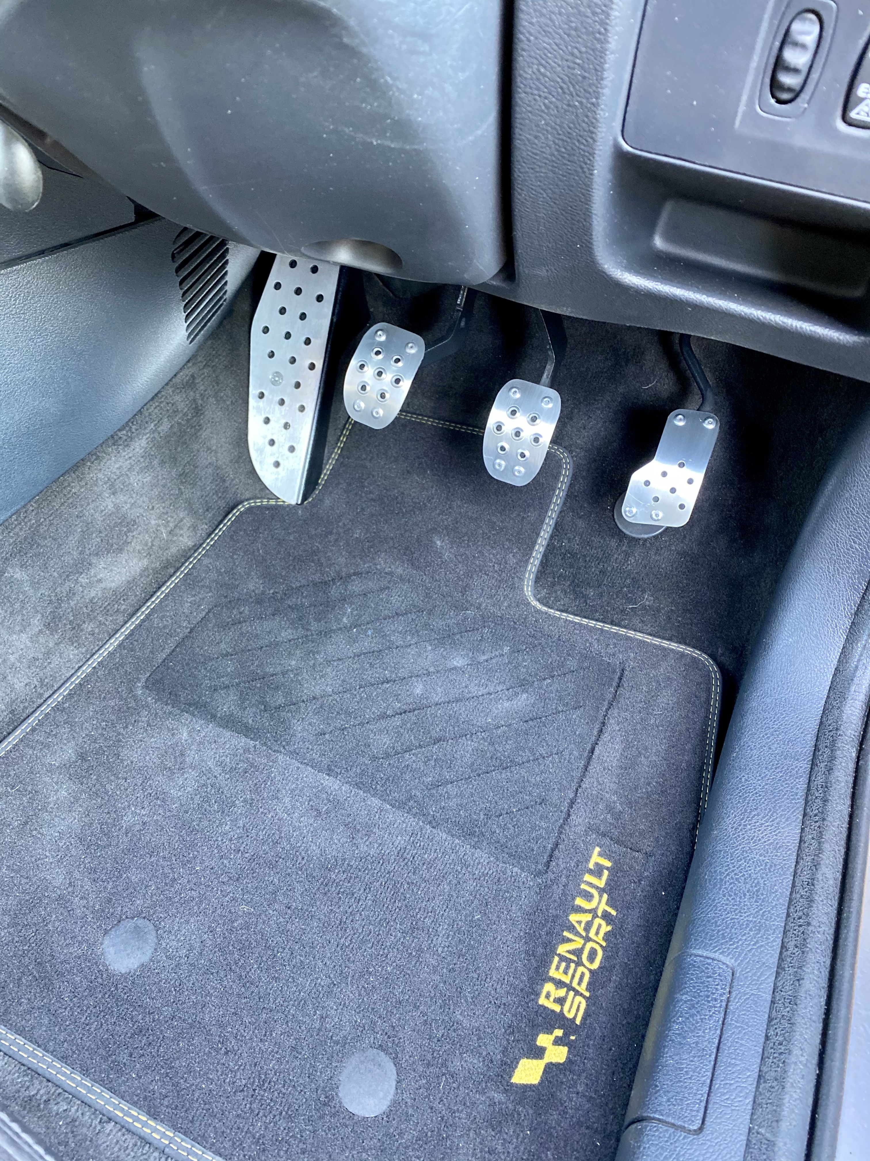

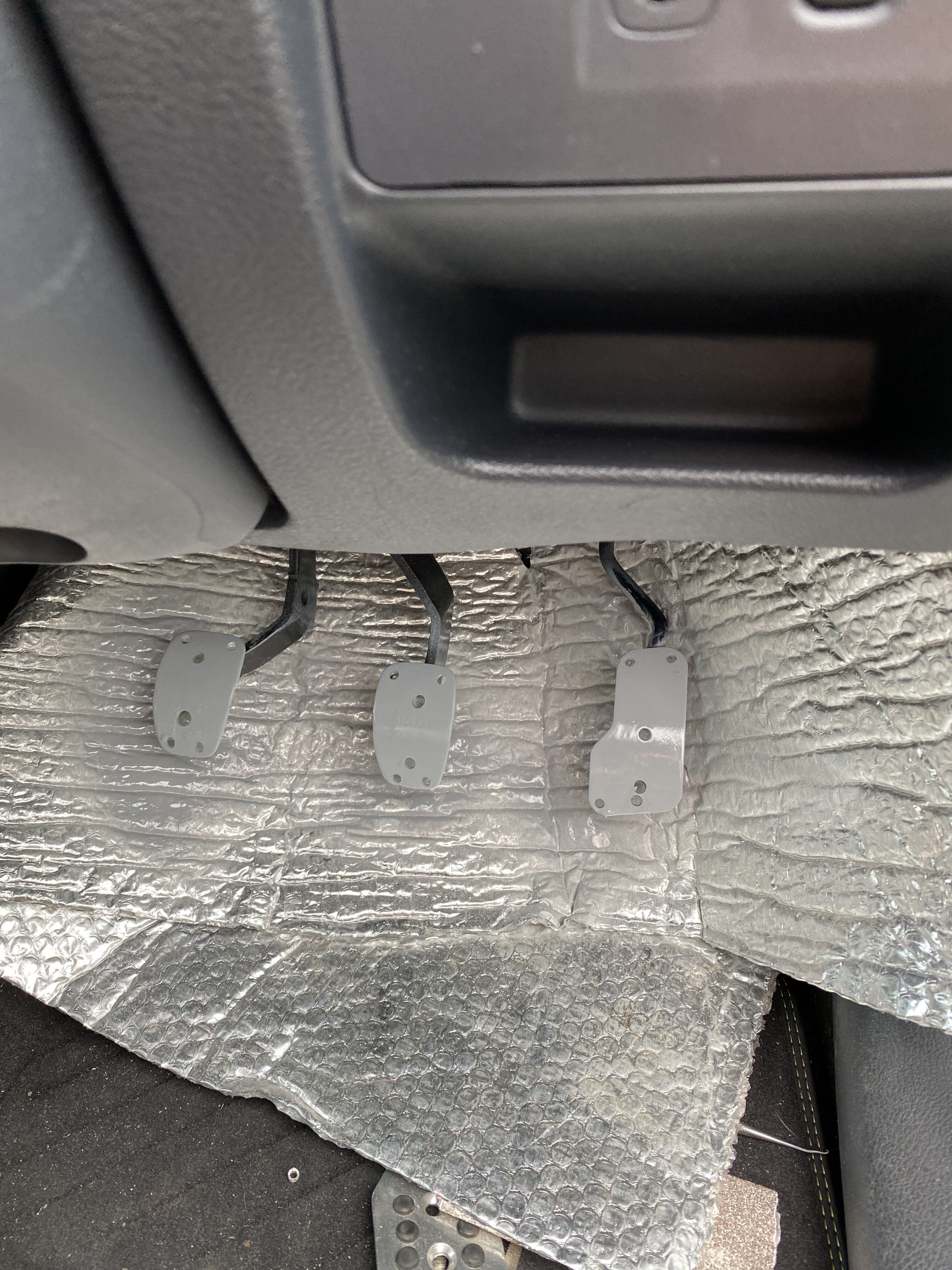

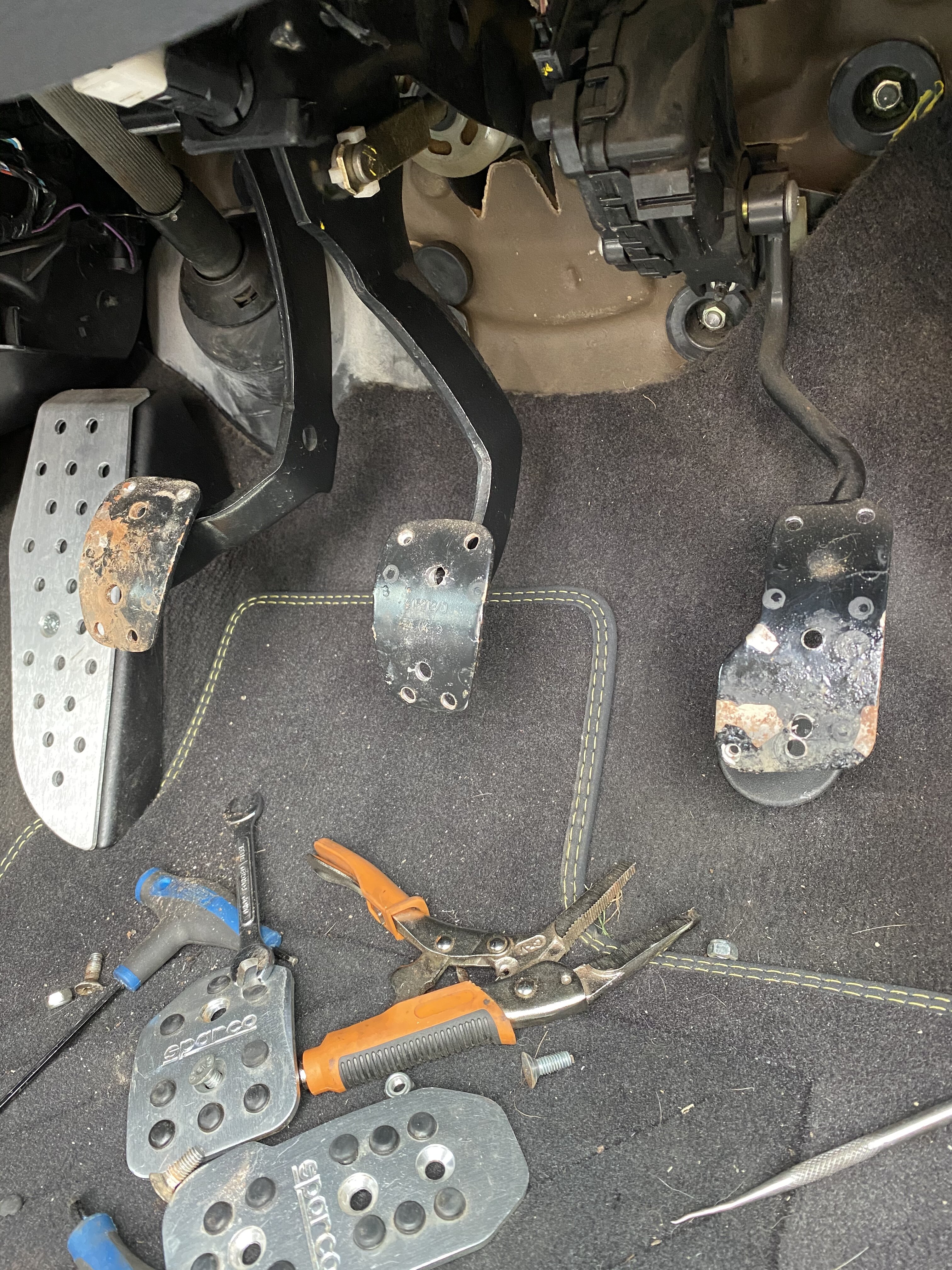

Scraping the barrel with little jobs on the clio at the minute. Annoying as I have a beam ready to fit so I can finish the underside. Anyway, this weekend I replaced the horrible Sparco pedal covers and fitted a set of replica Renault OE pedal covers I purchased the covers off a lad on Facebook, he’s done a lovely job. All apart from the rivers supplied which just seemed to snap.
Anyway, I rubbed the pedals down and coated with zinc primer before black stone chip. Pretty happy with the results.

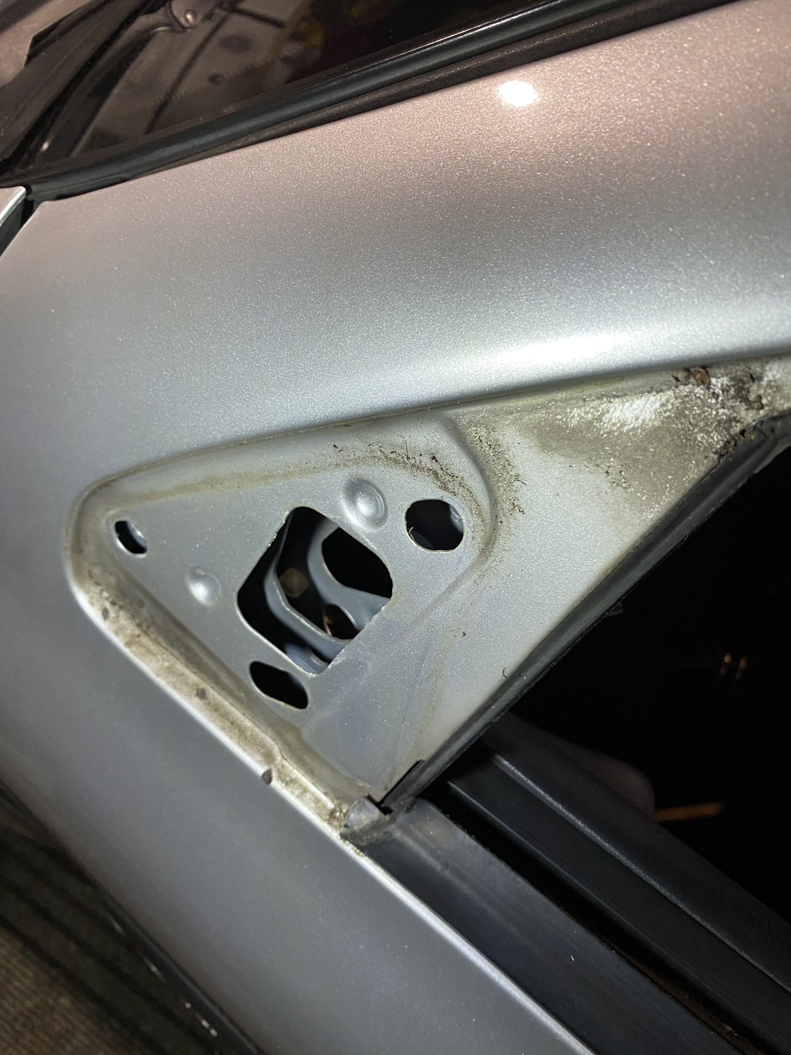

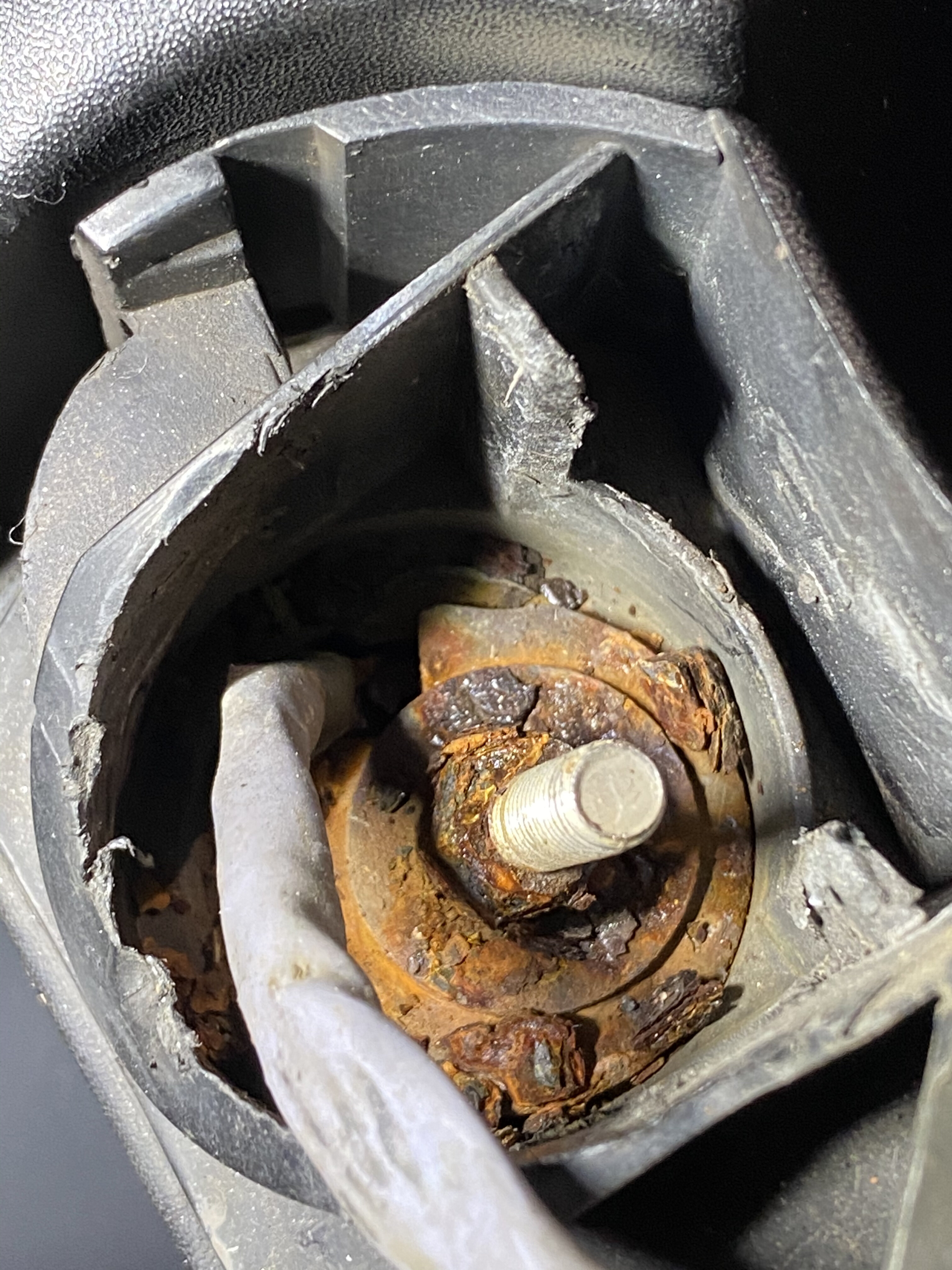

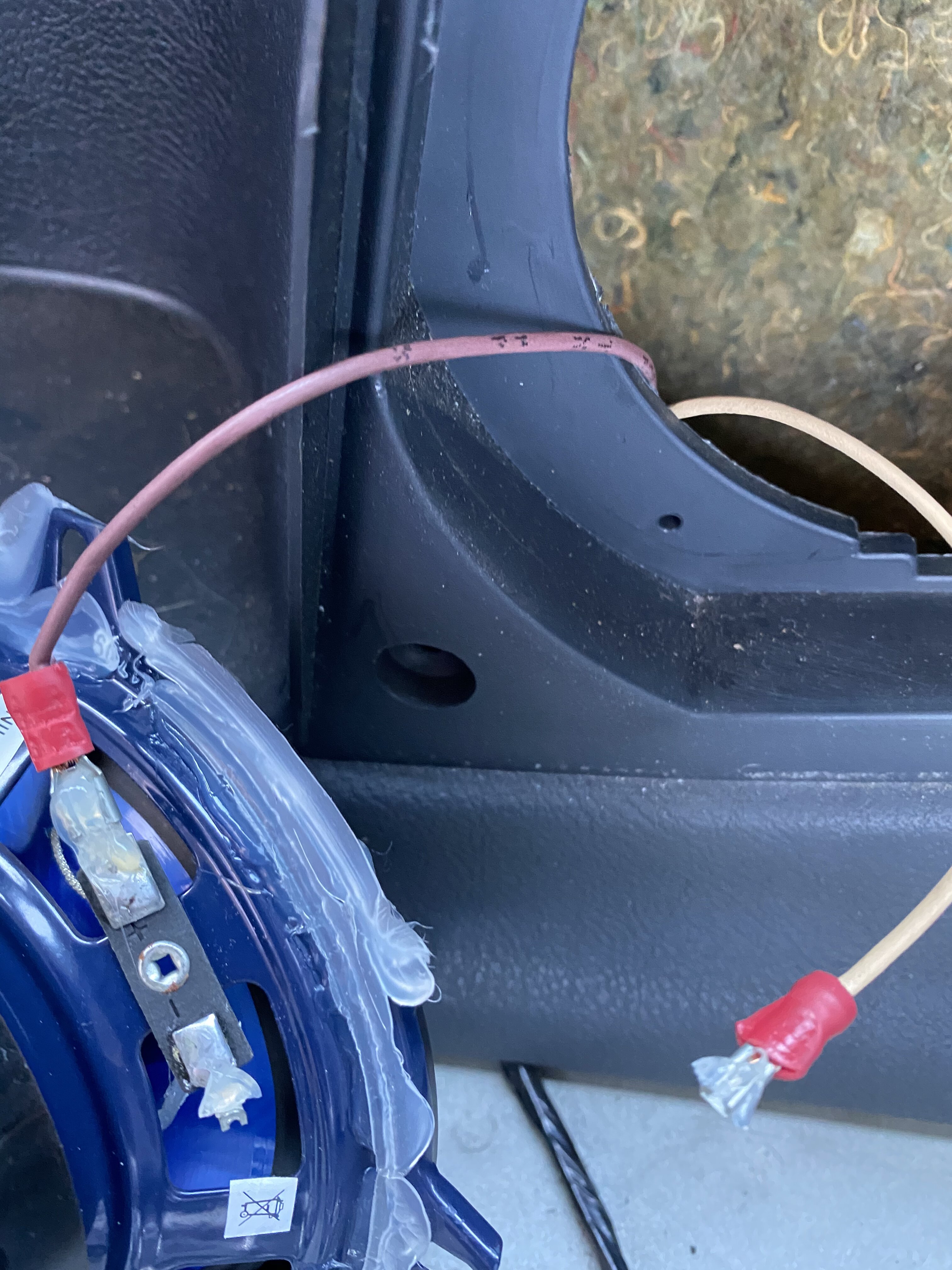

thats right, someone had silicones the speaker in and the cables on! The otherside someone had modified the speaker cables and the join had corroded to a point I had to replace the whole section. Whilst doing this, I thought I had better finally check behind the rear door cards...something I had been putting off!

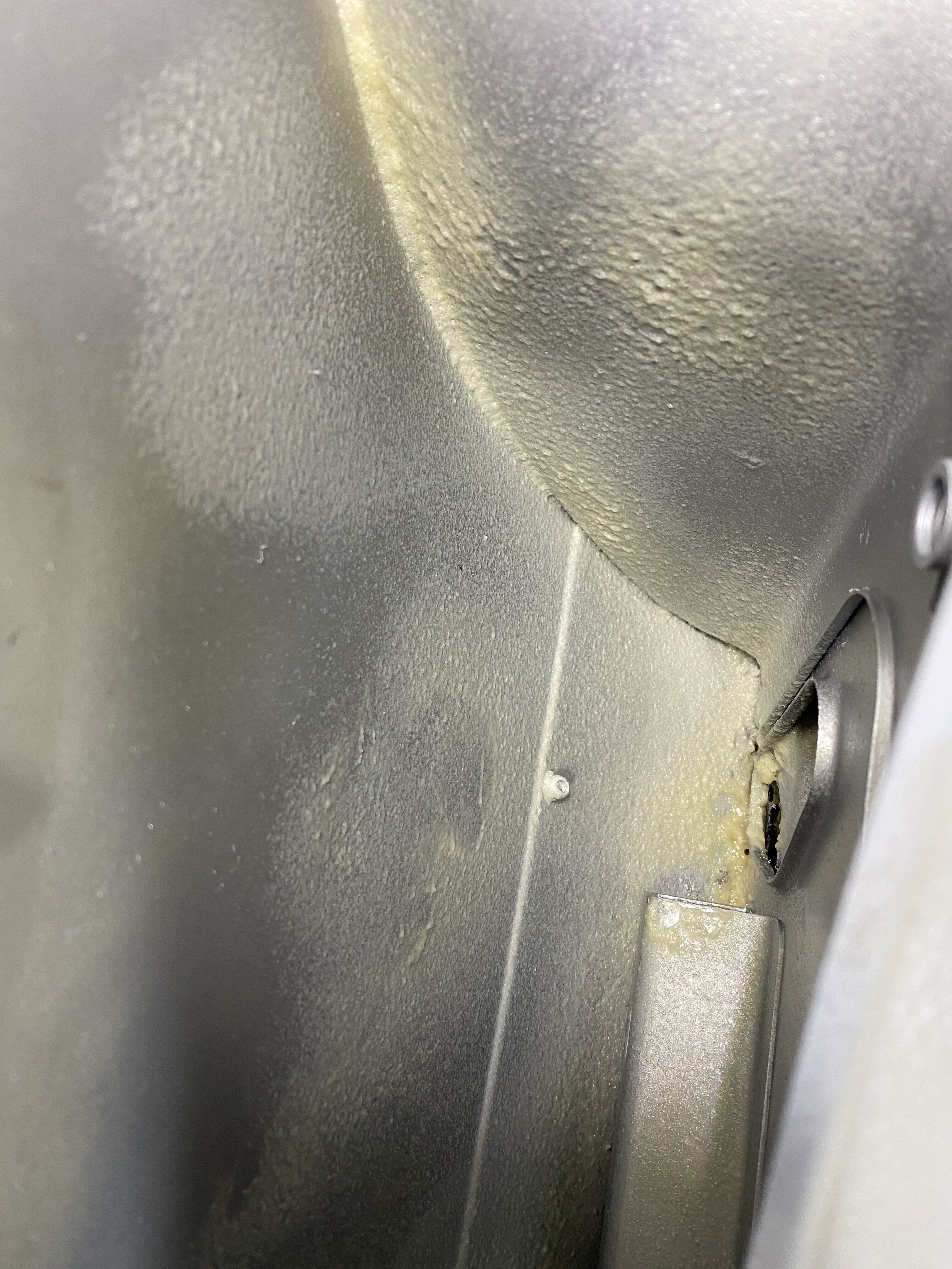

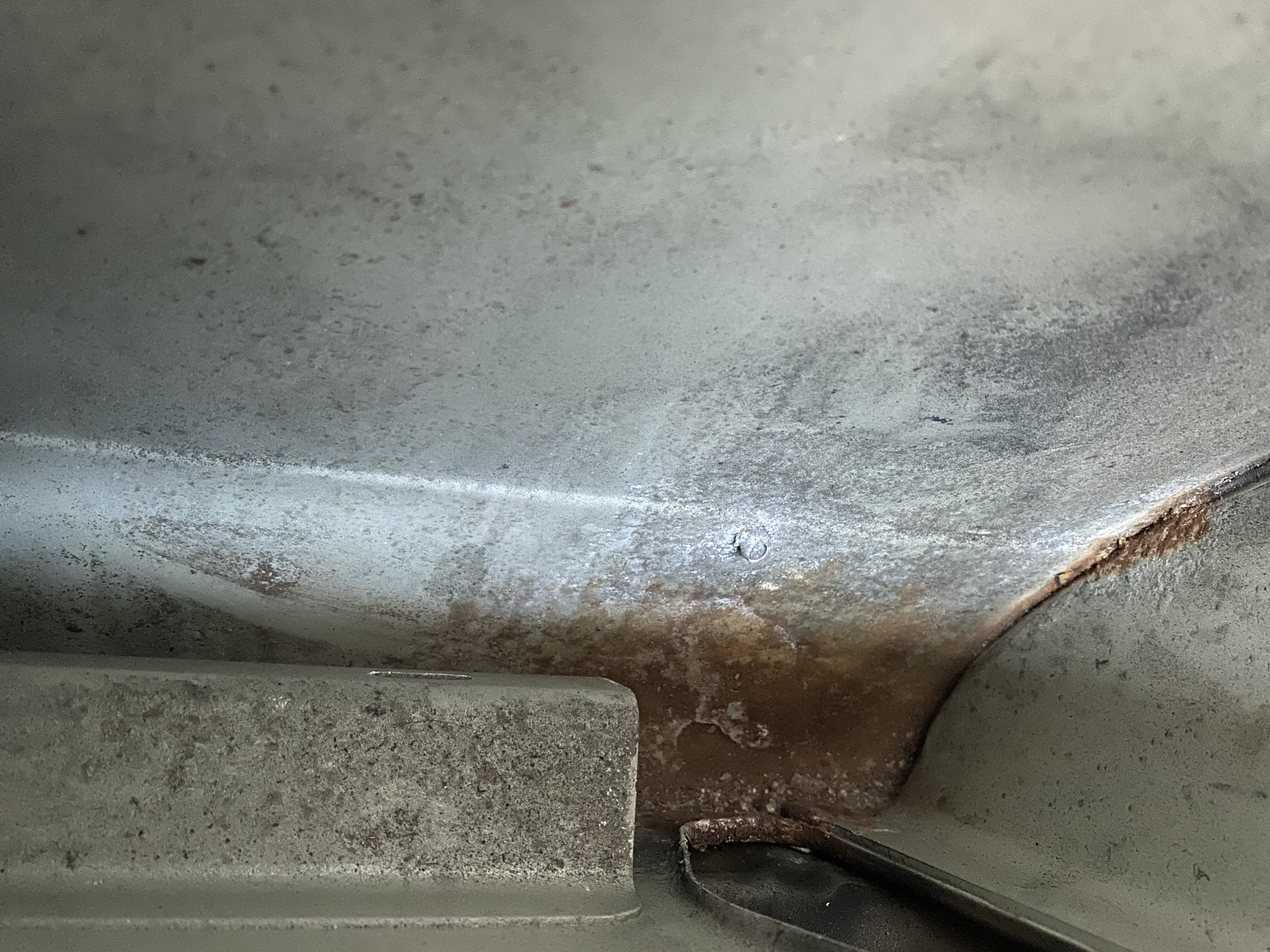

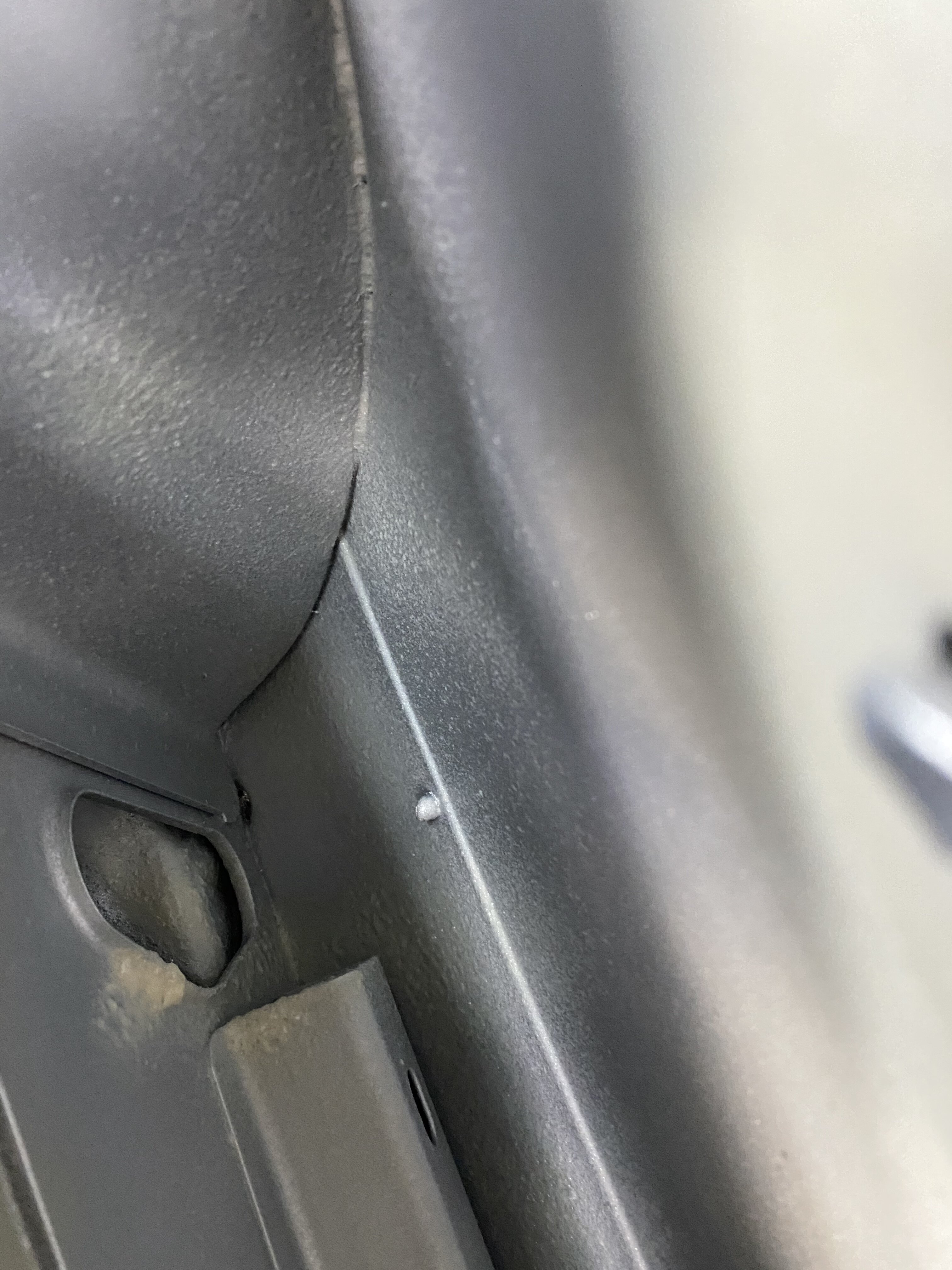

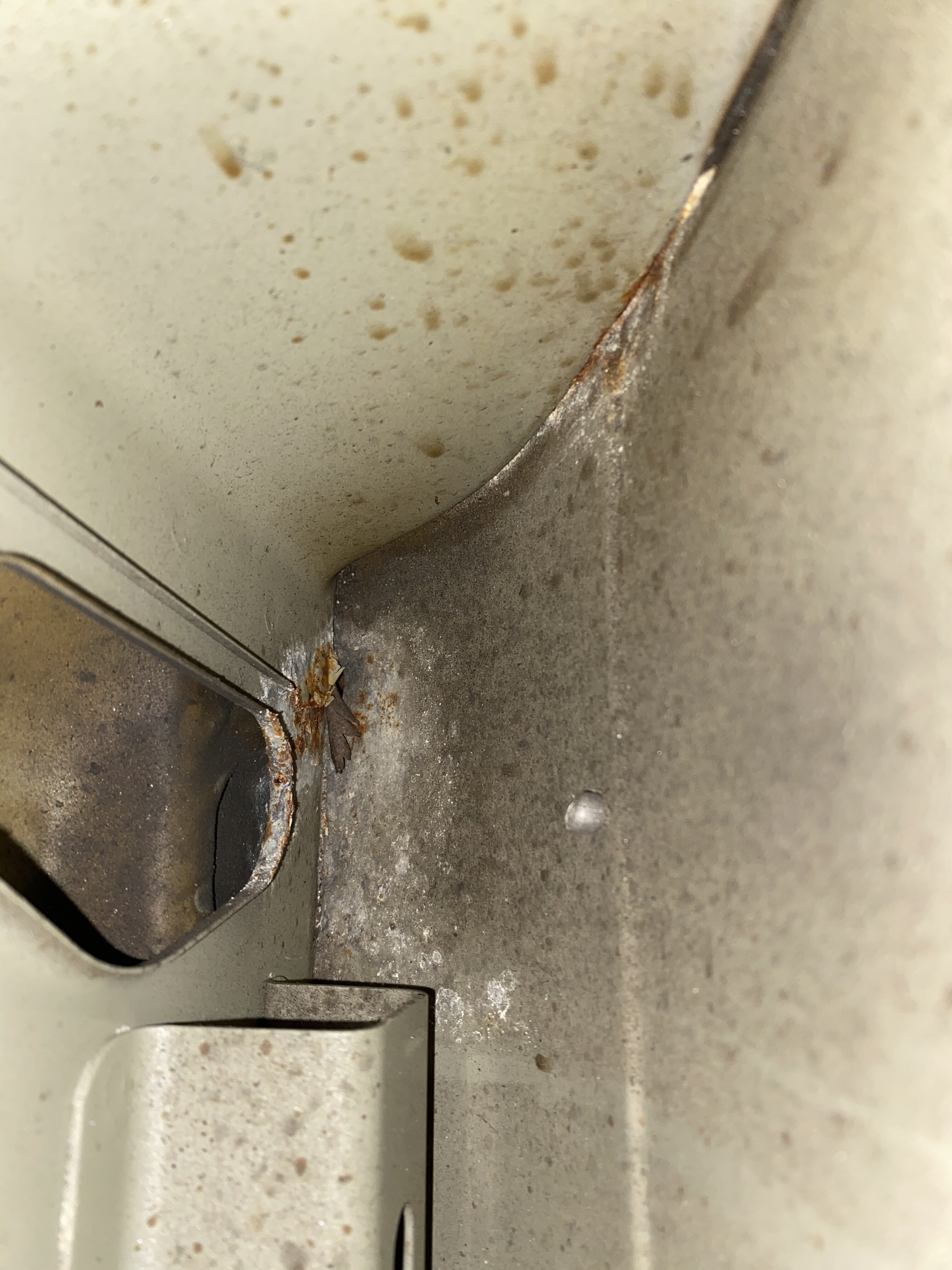

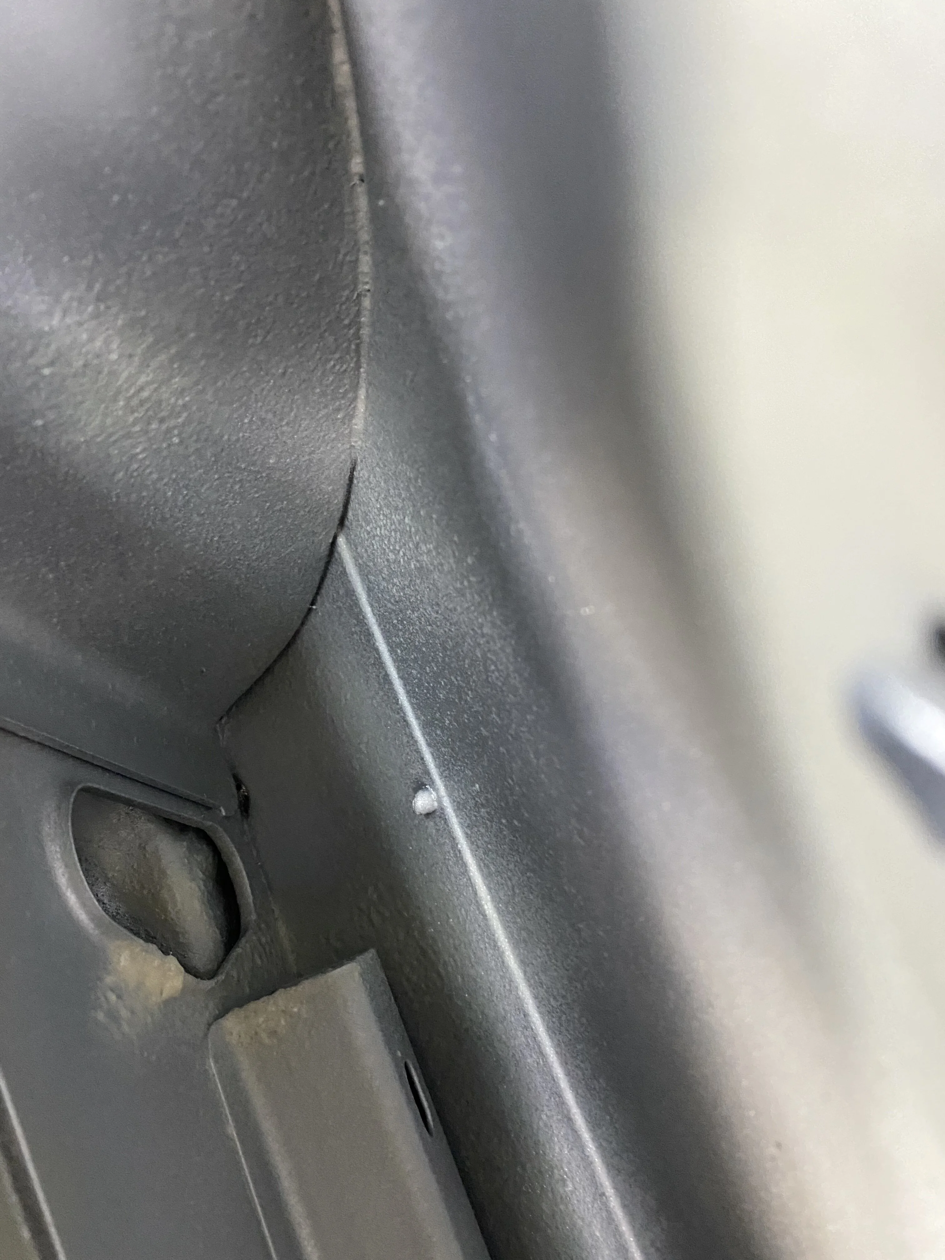

I was pleasantly surprised with what I found. The passenger side was very clean with only mild surface corrosion, the drivers side was much worse but still salvageable. Biggest issue being the drain hole in the sill was blocked.
I set about grinding all of the rust out before treating and over coating and finally protecting with wax oil.

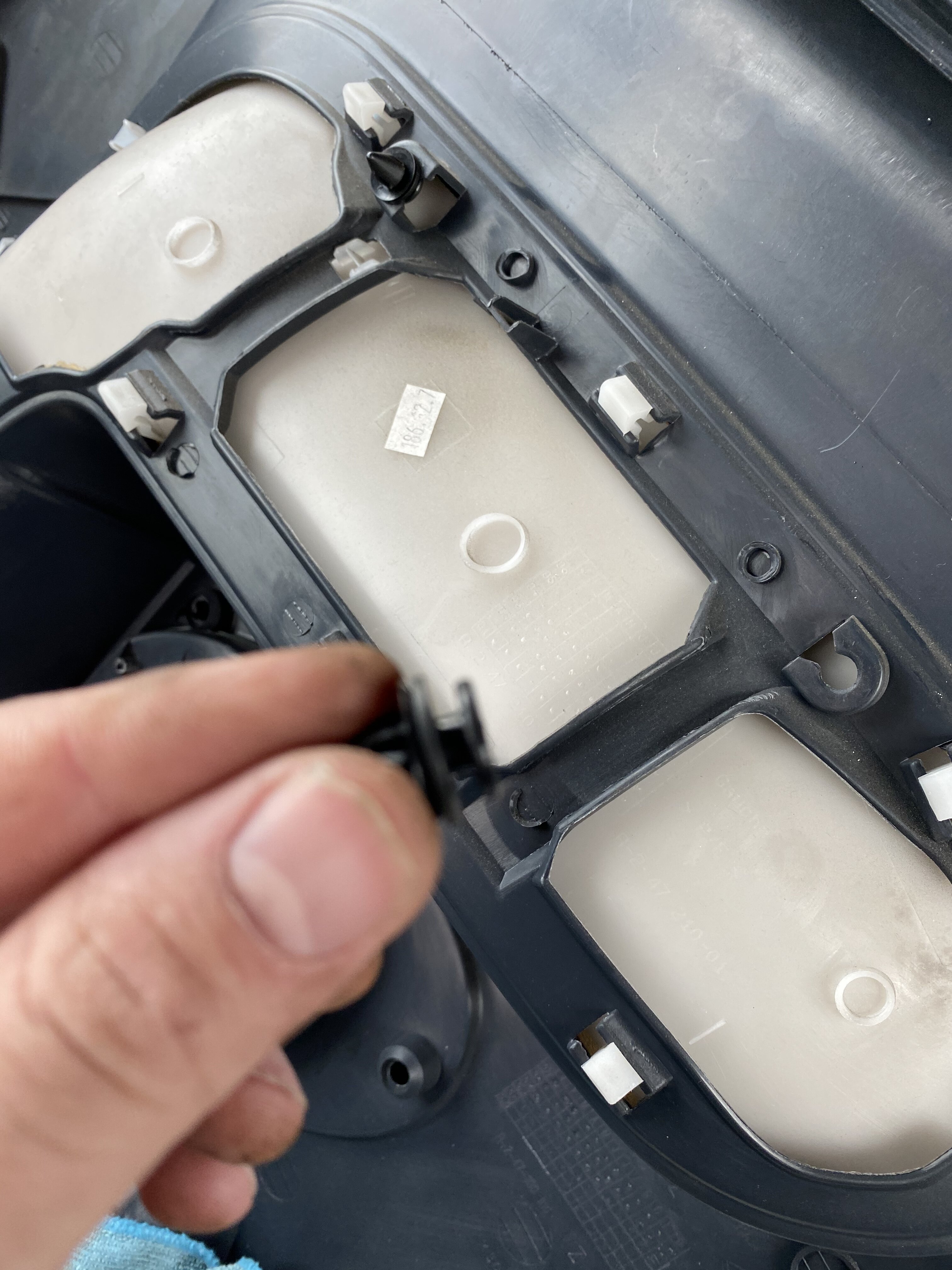

replaced broken trim clips in an ever losing battle to stop the wanker from rattling

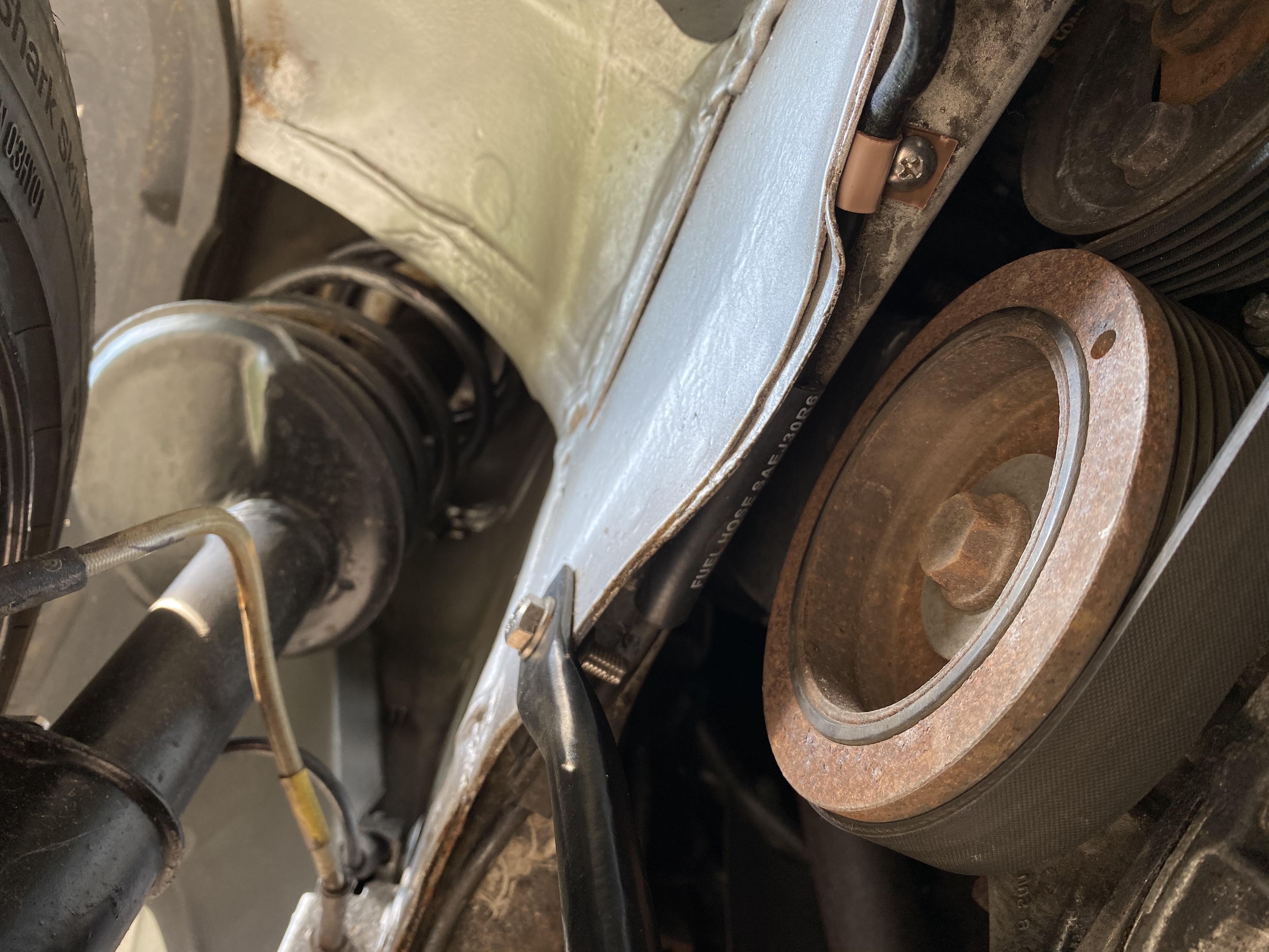

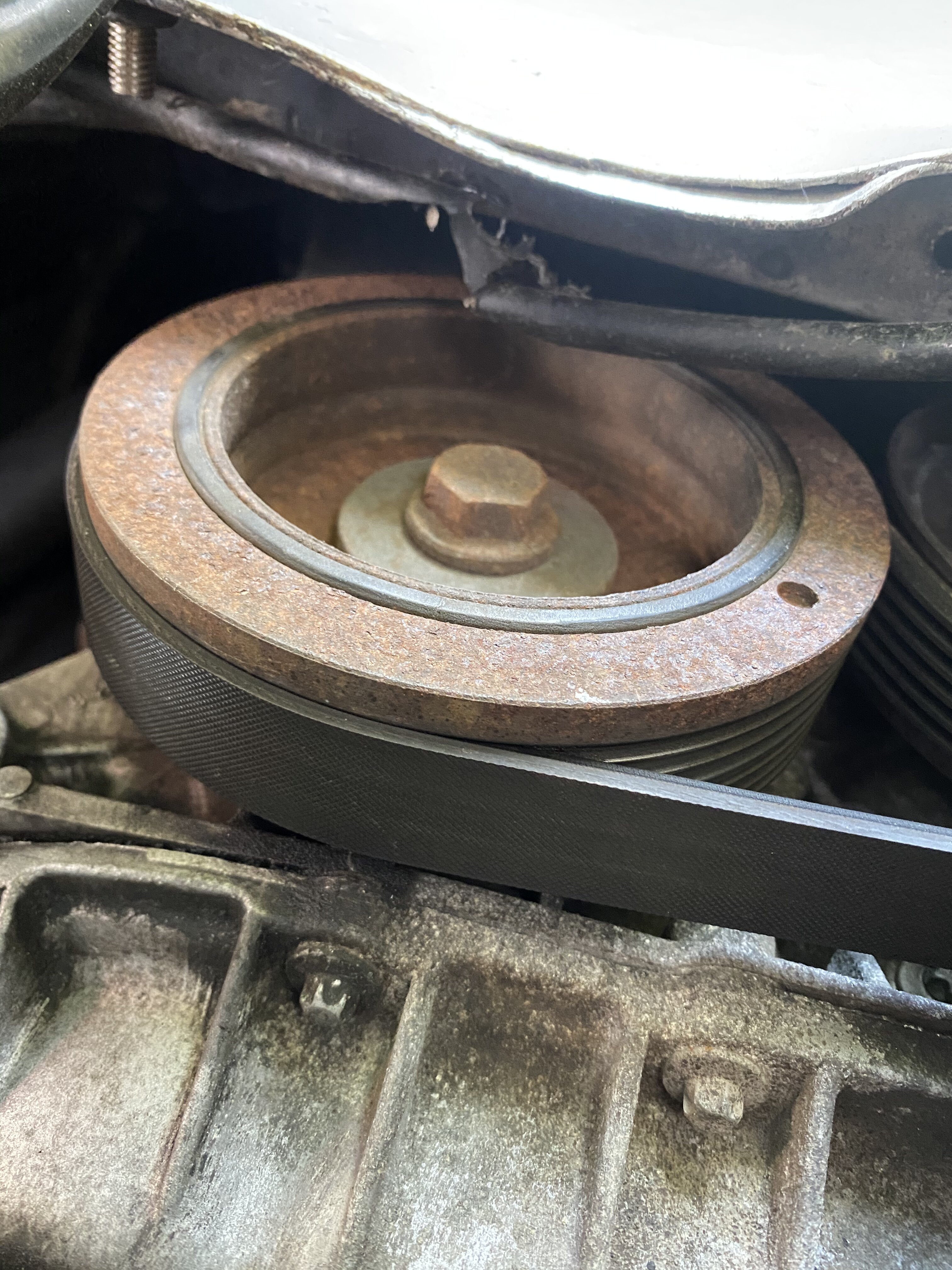

finally, whilst trying to patch back together the remains of my drivers side arch liner (this thing has had more plastic remedial work than Vorderman, I noticed this:

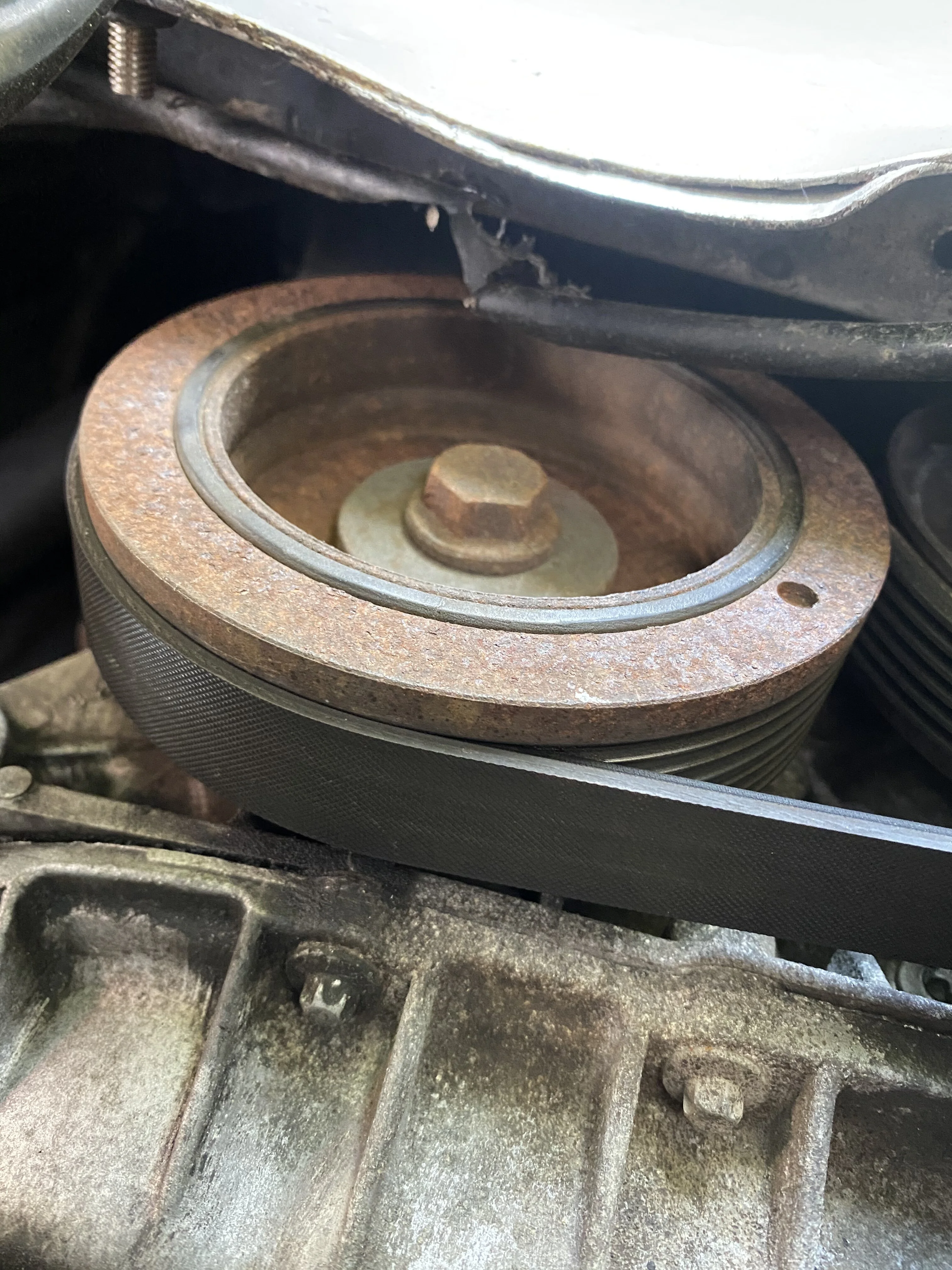

that’s right the carbon canister hose had been running the bottom pulley, which possibly explains the faint smell of fuel, luckily it didn’t catch the belt in an awkward way. I set about looking to remove the carbon canister, albeit I didn’t like that solution. Luckily Alex from AWM suggested sleeving the join! I had completely over complicated the solution, a section of 8mm fuel hose is the perfect size to cover the broken line, I even made a new hose clip to make sure there is no risk of

That silicone'd speaker cable... what the hell were they thinking?!
