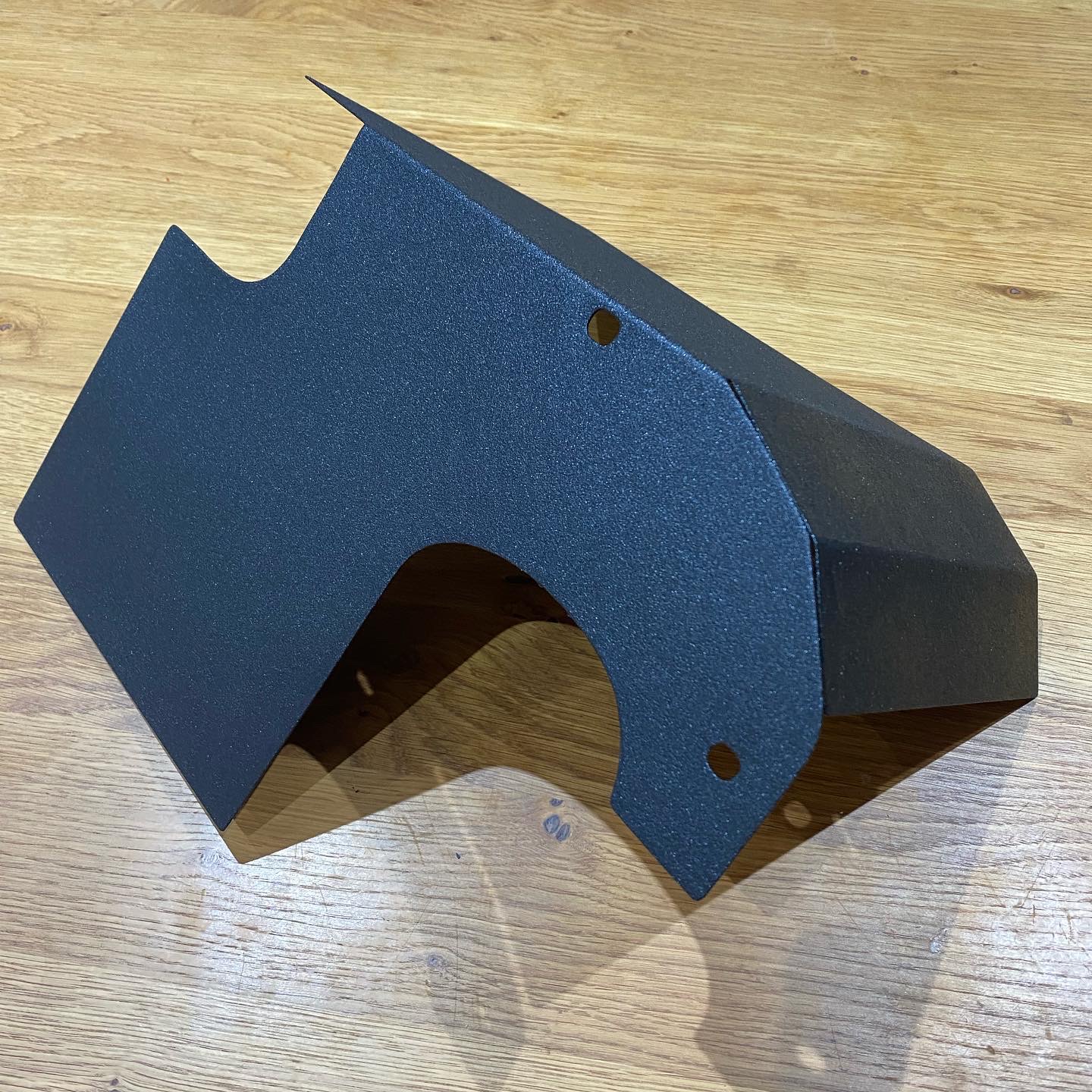

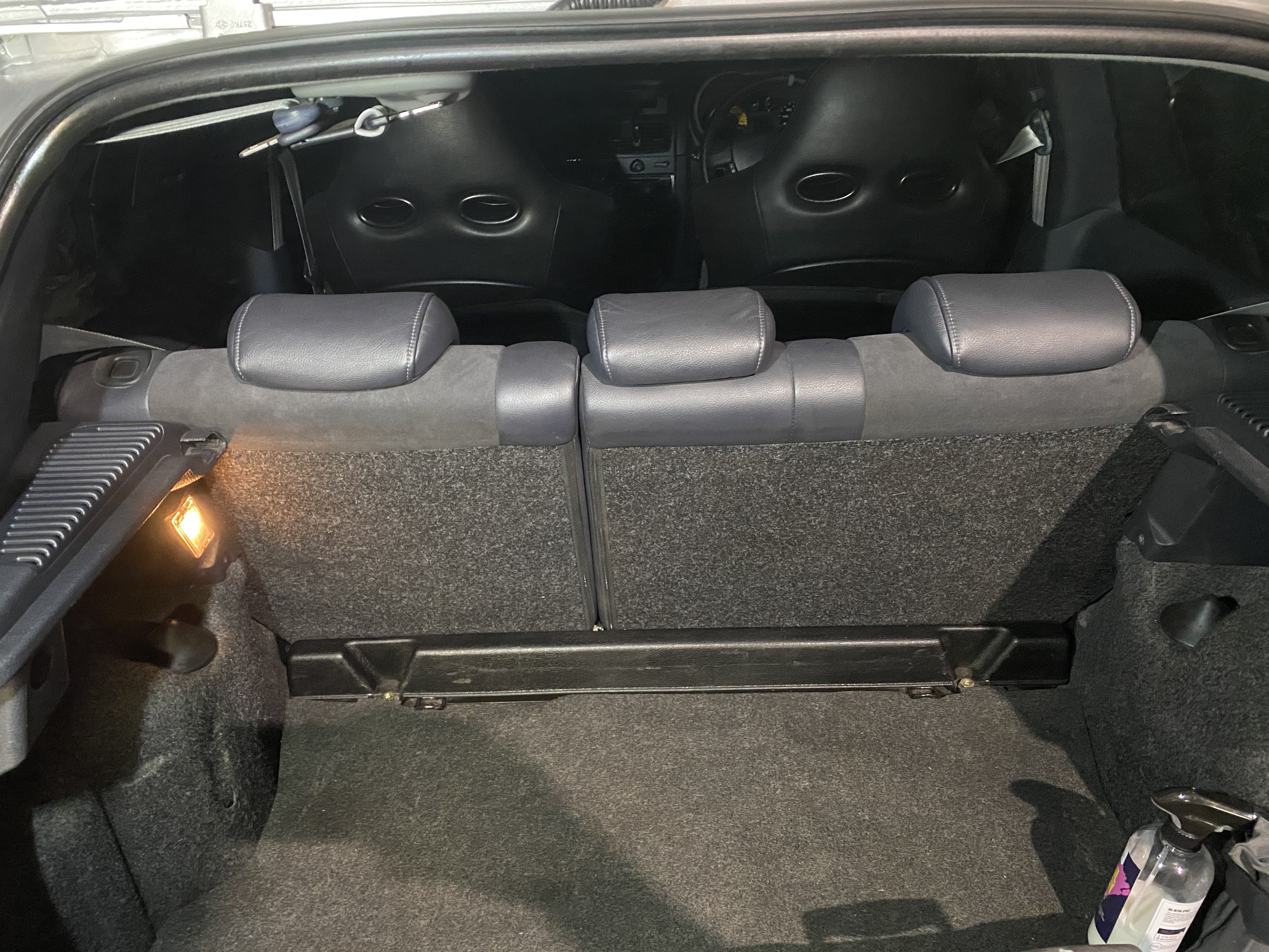

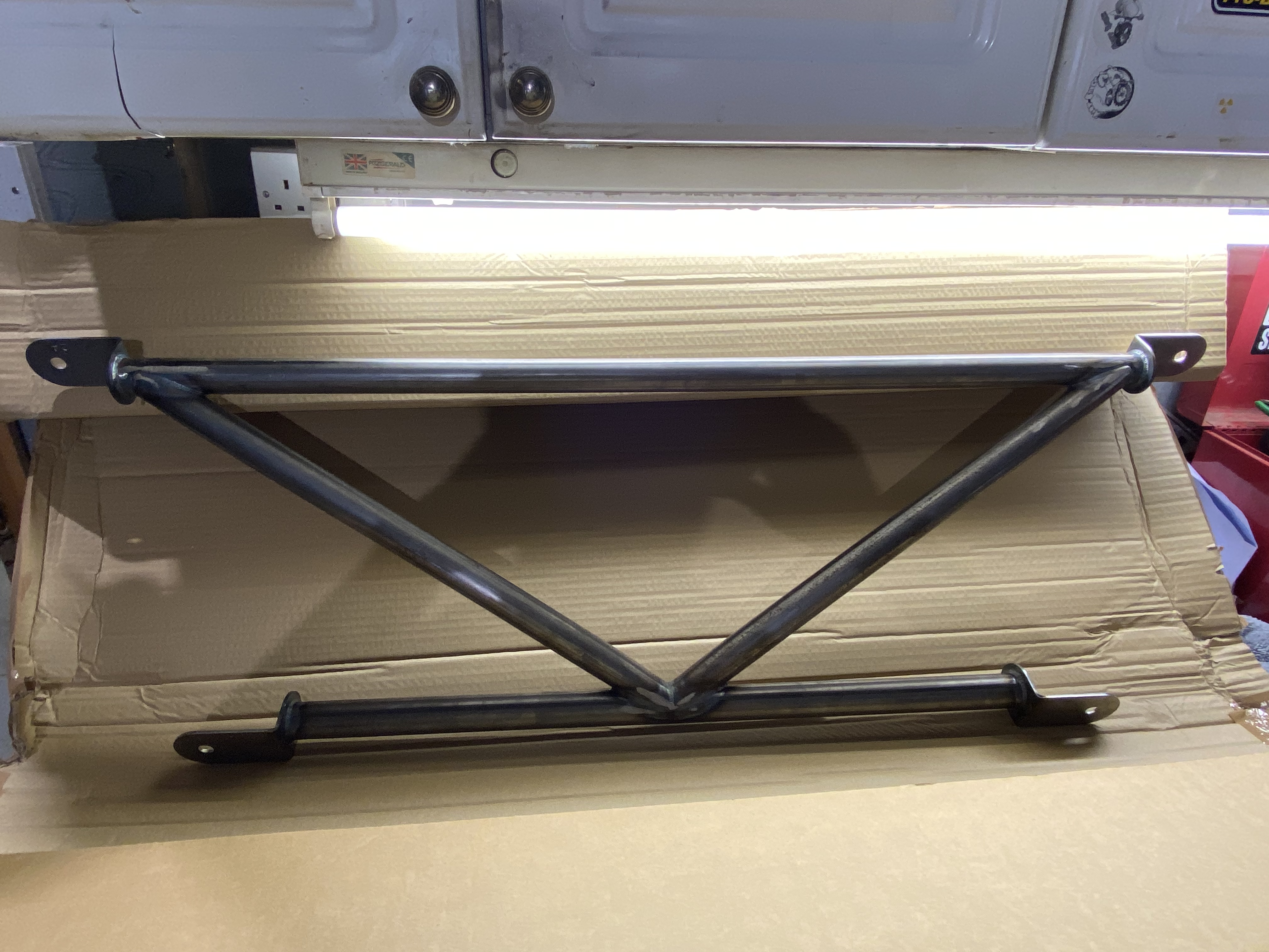

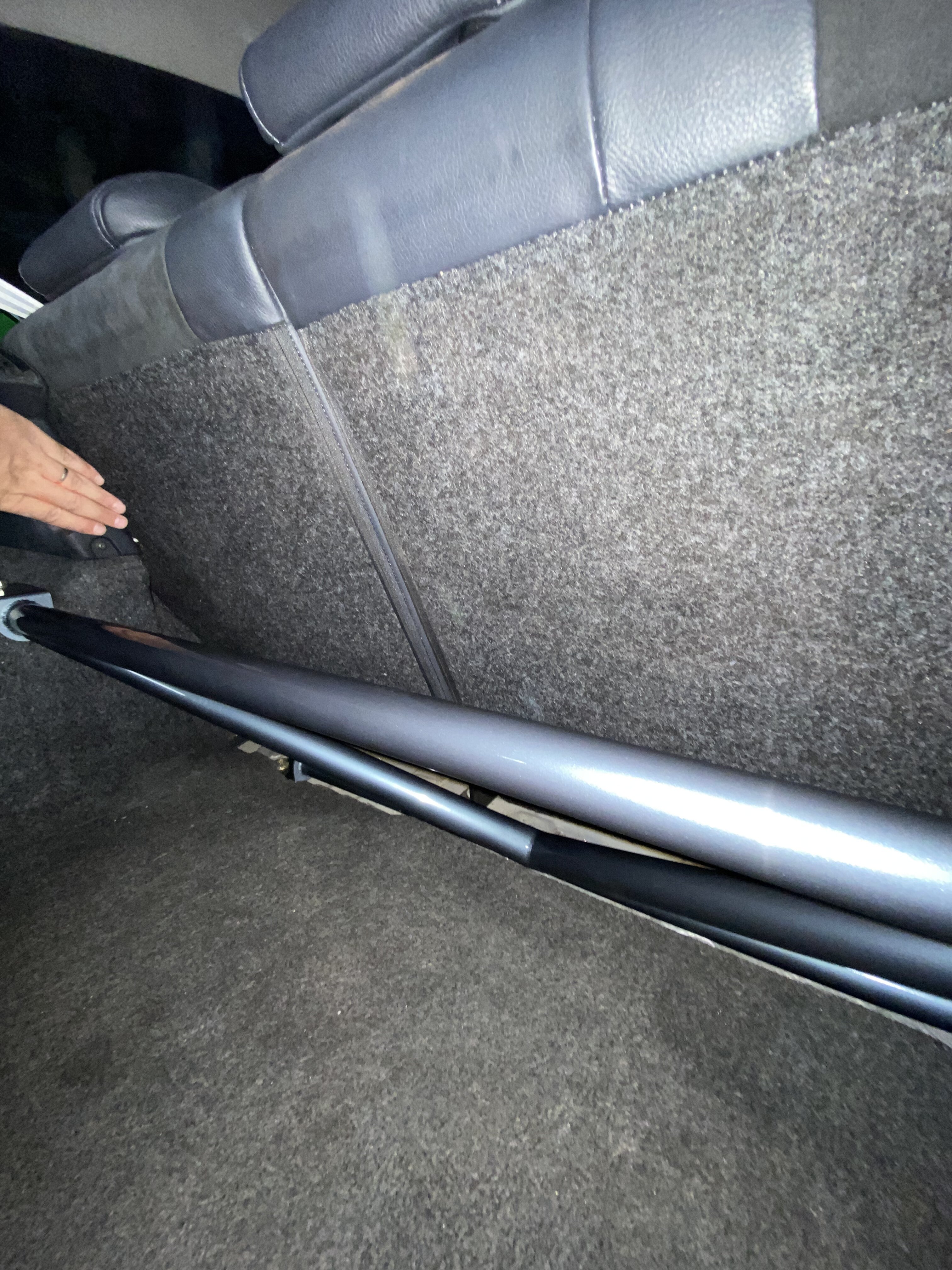

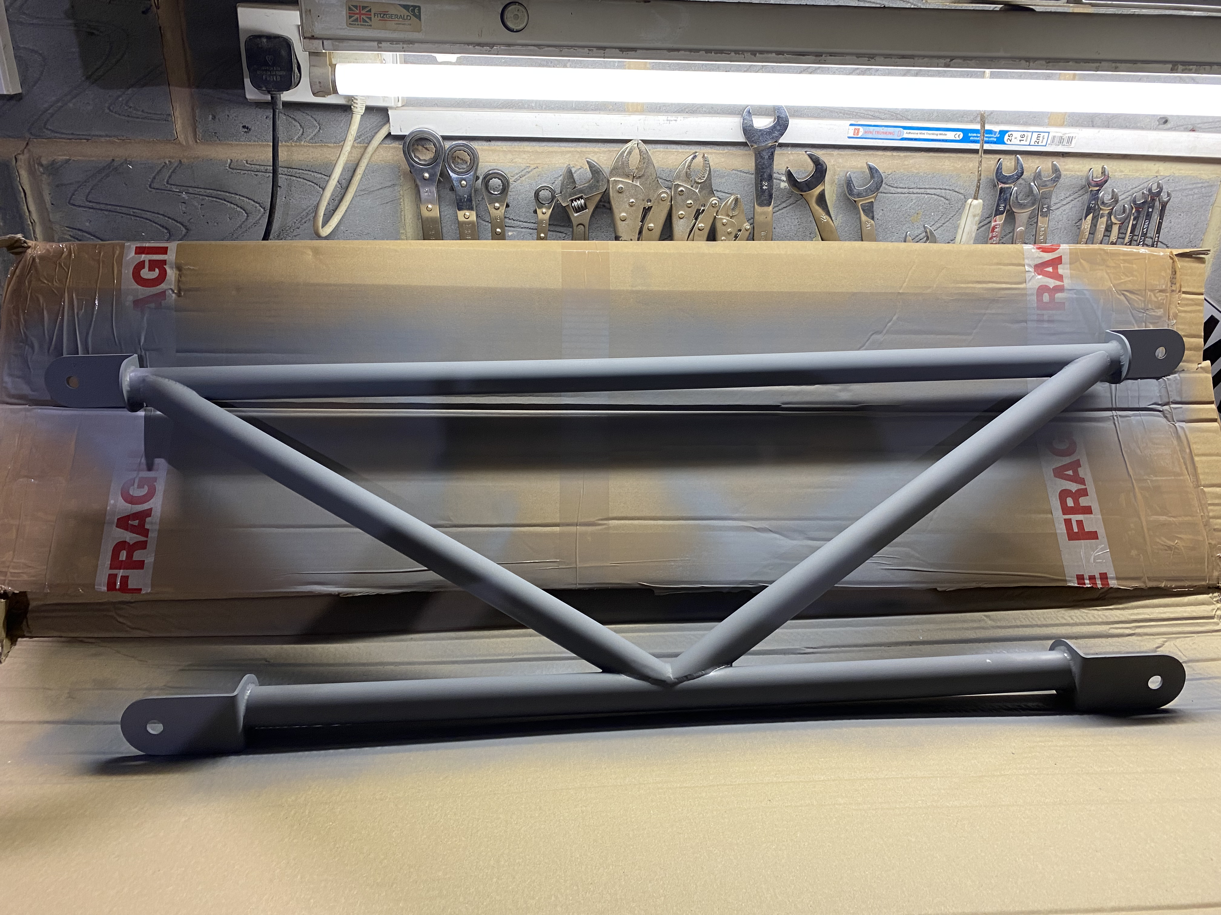

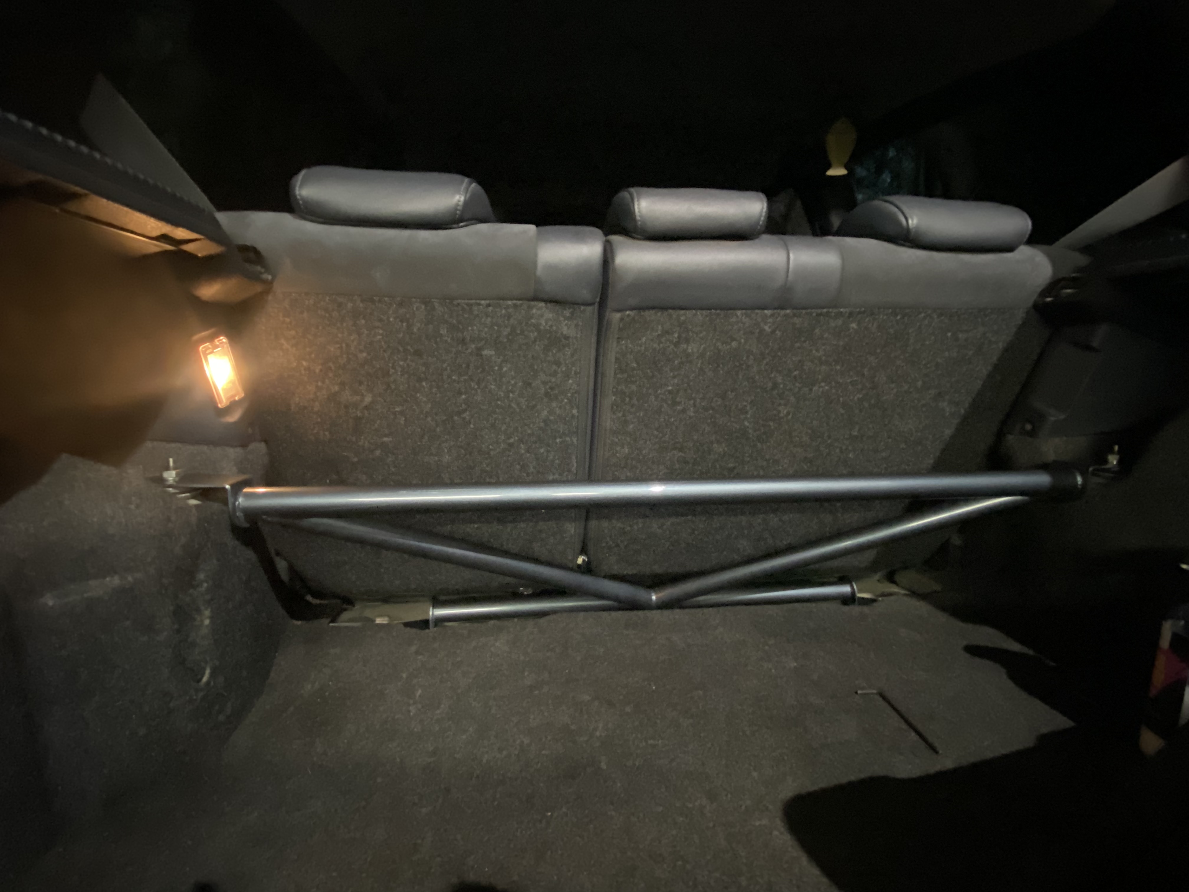

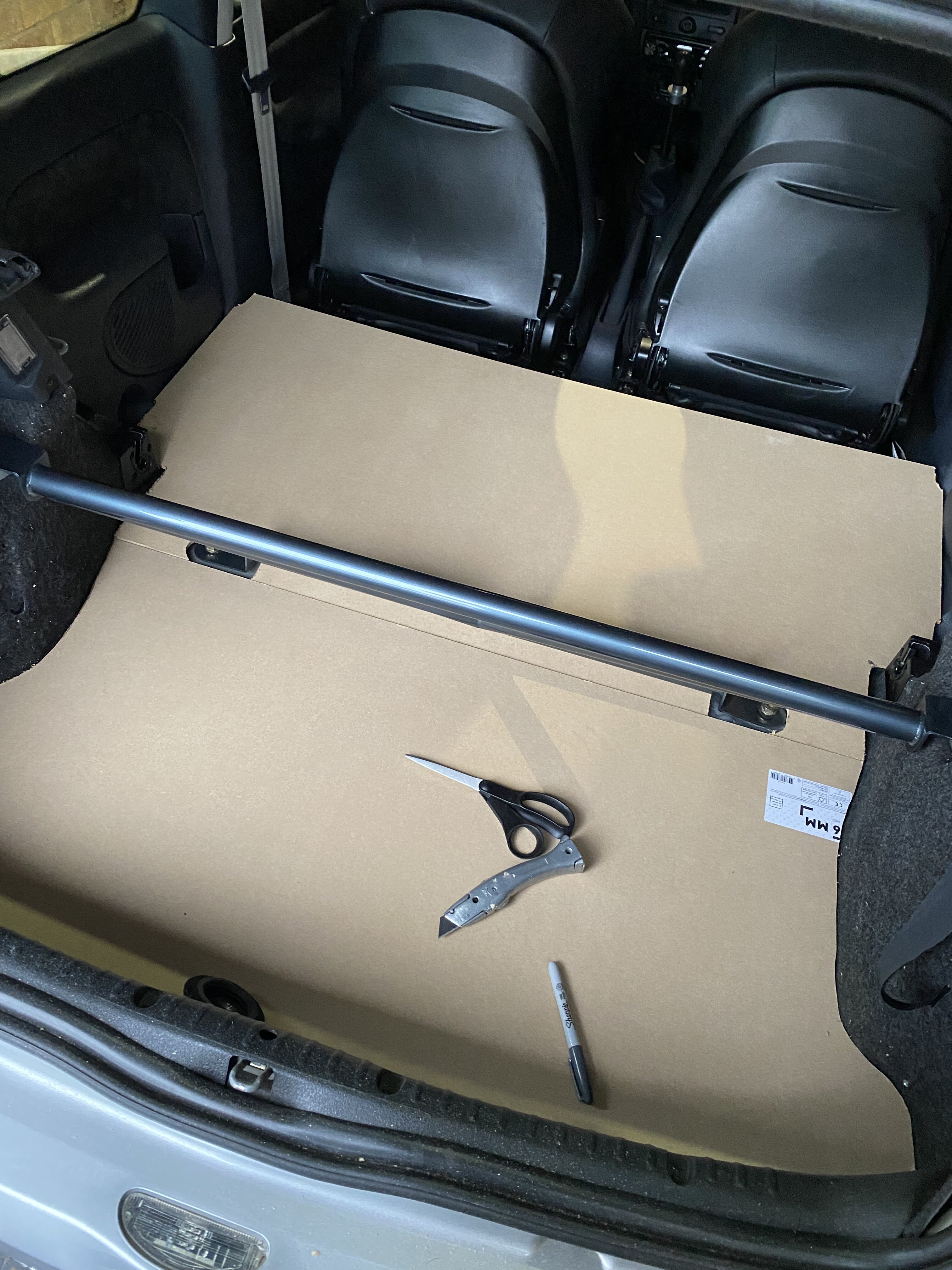

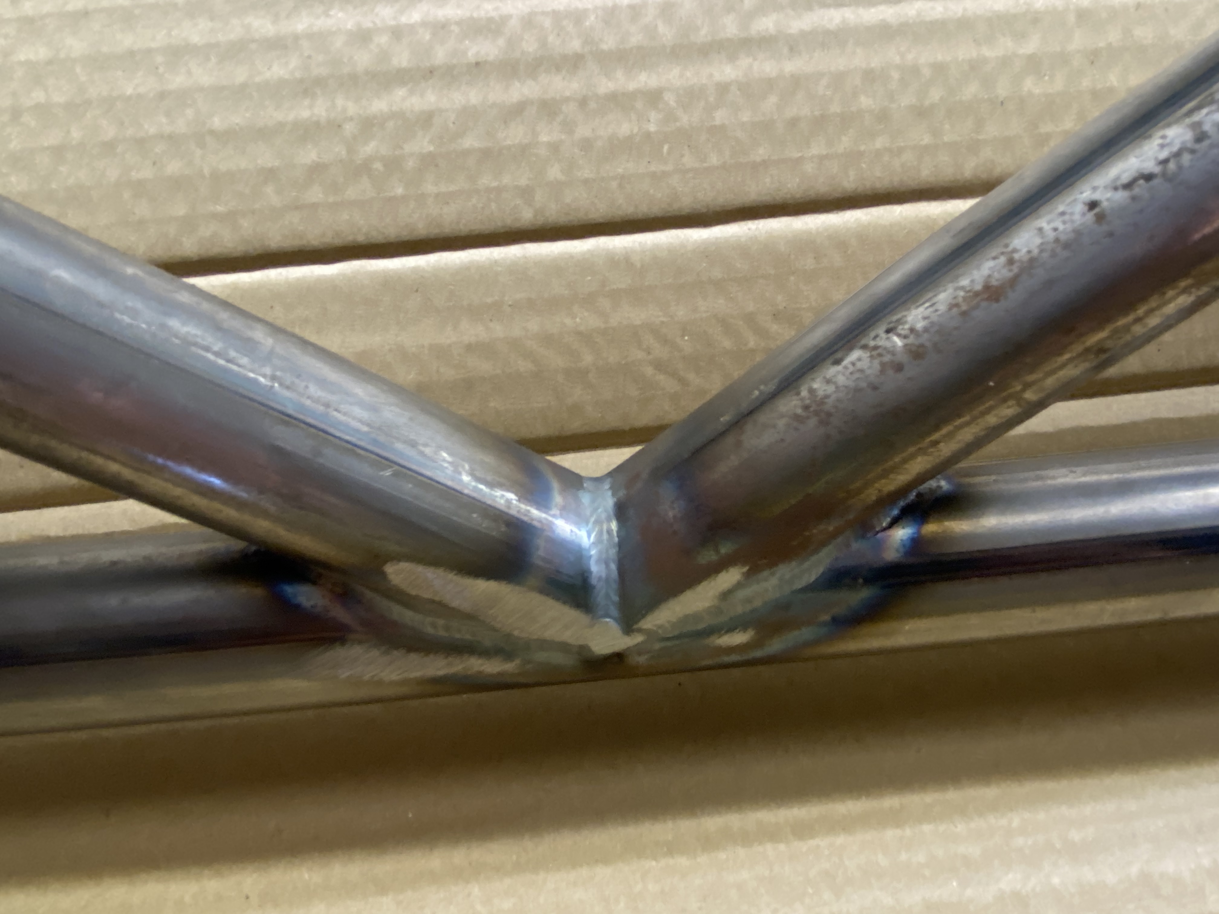

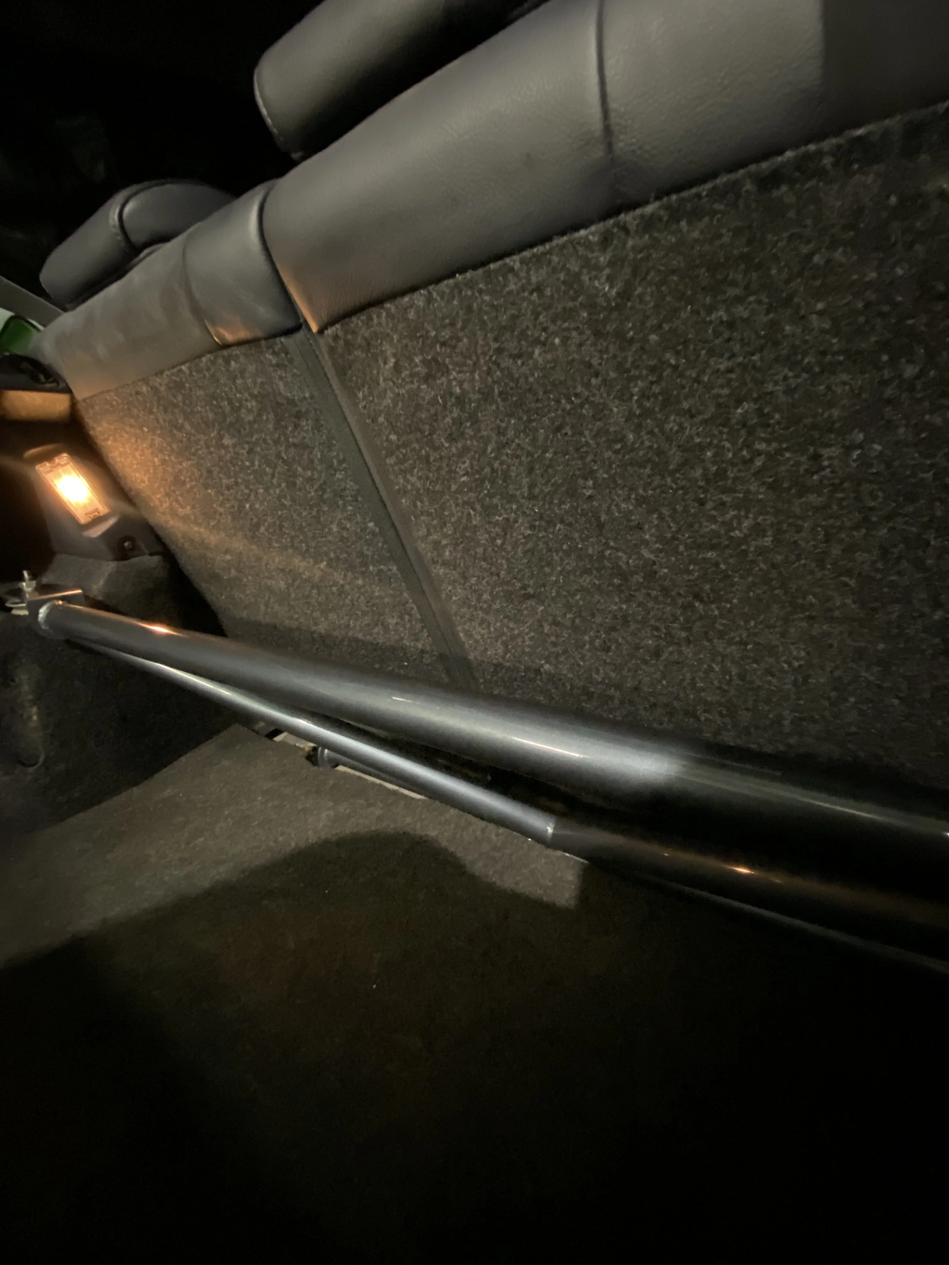

Next up… having decided to head towards the current theme du jour…Clubsport, which actually fits in well with what I now want out of the car (weekend B road blaster and occasional track/Ring toy) I will be removing the rear seats and fitting a false floor, I may go for a half cage at some point. But that’s probably some time off yet. I purchase a Baf K brace, purely cosmetic reasons as we all know they don’t add any rigidity. Plus there was a decent offer on so it’s rude not to!

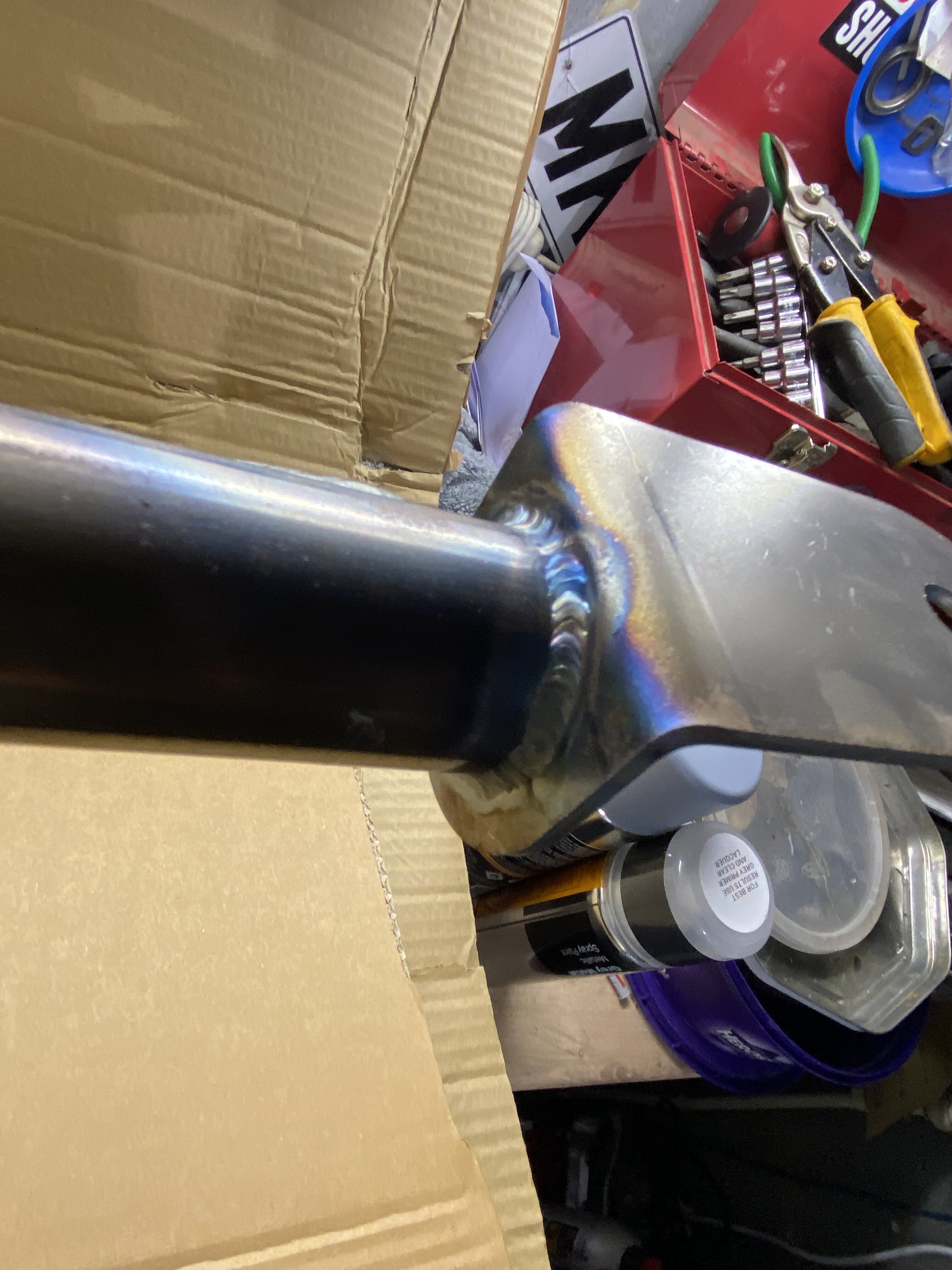

it took a couple of weeks to arrive, I purchased one unpainted as the standard colour choices were rubbish, plus I wanted to make sure it was ‘finished’ prior to painting.
Broadly happy with what turned up! It needed some finishing off on the wields and a couple of other spots.
So I linished what was needed prior to priming and painting ‘Honda polished metal Grey’ really happy with how it’s come out, only temporarily fitted at the moment as over the coming weeks I’ll be working on the false floor

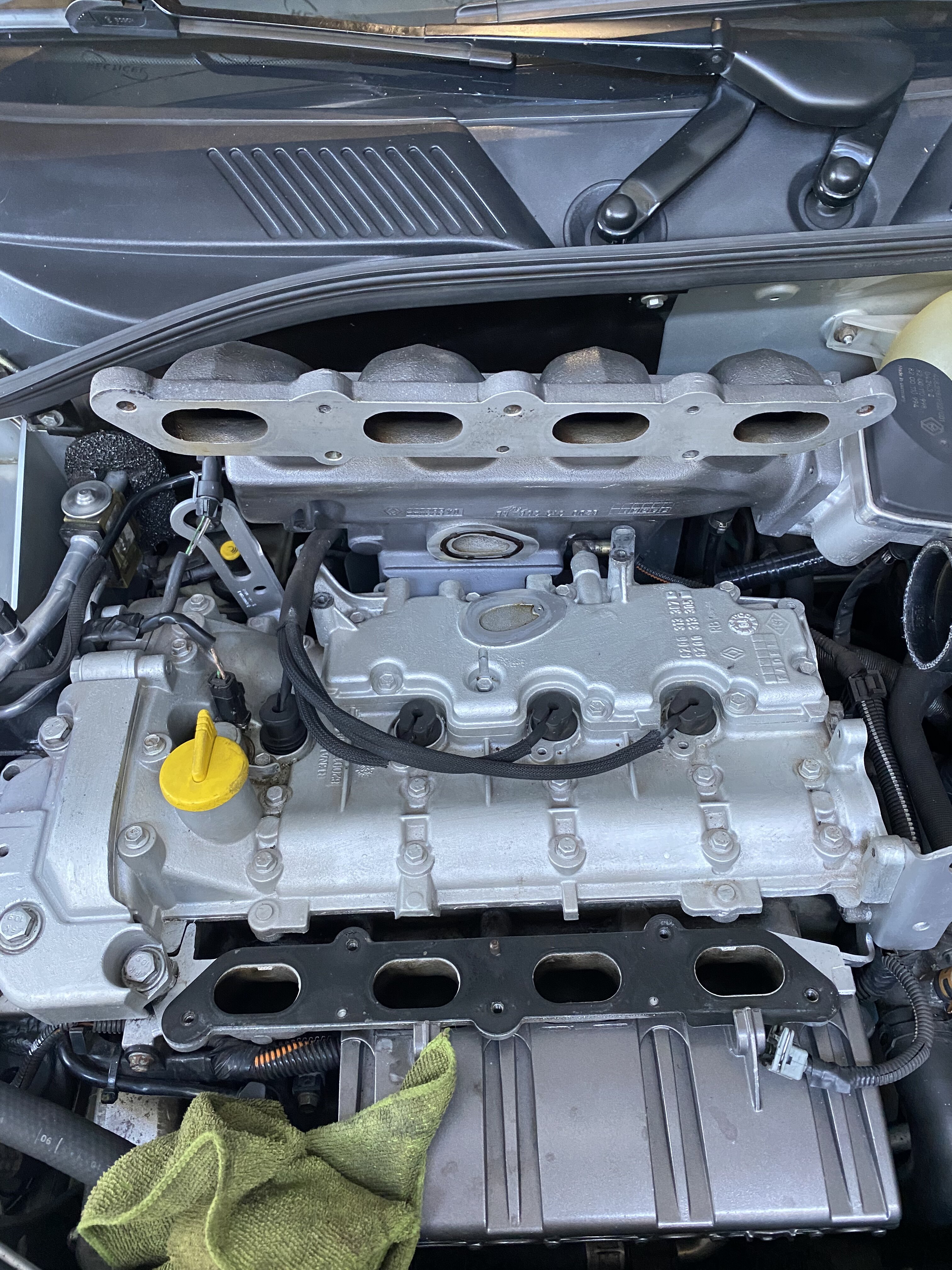

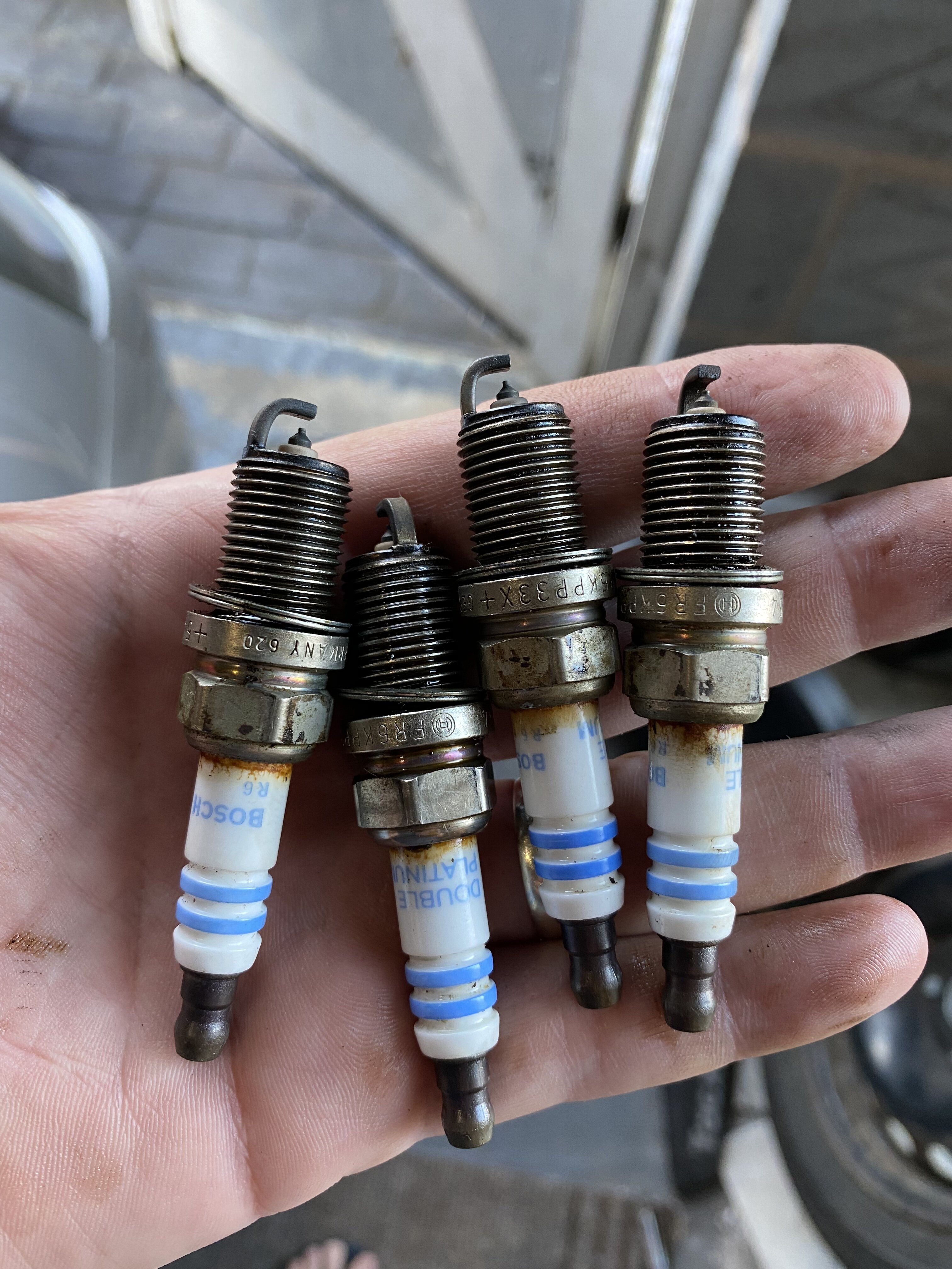

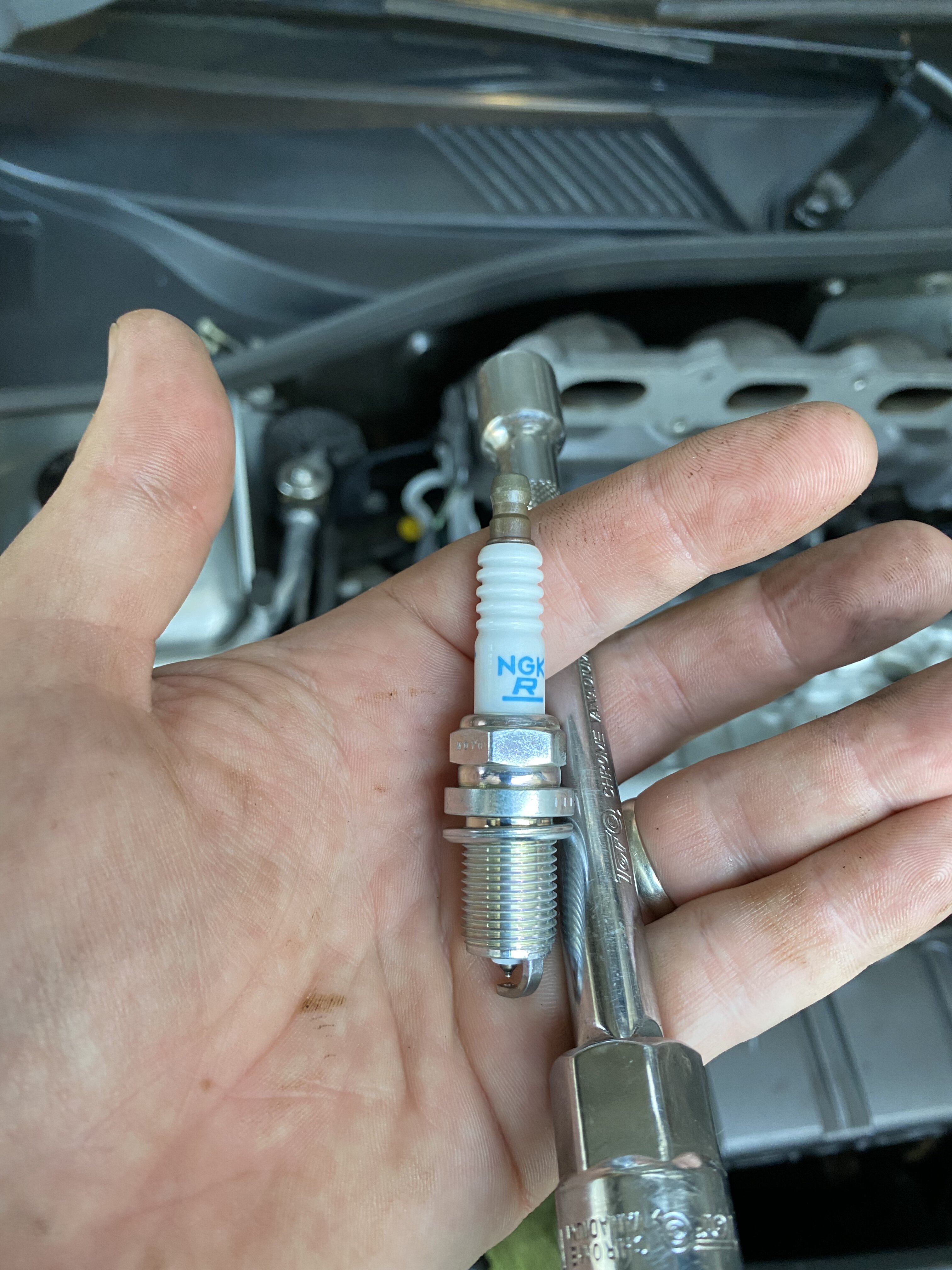

Final update for today. Spark plugs! I don’t have a receipt for when they were last changed. They looked ok but we’re not the favoured NGK’s and were due a change I’m sure
I managed to get a deal on a new set of NGK Platinums. Which these engines seem to worked best with
All fitted and running sweet, @104218 miles for my future reference
Video of an almost silky tick over

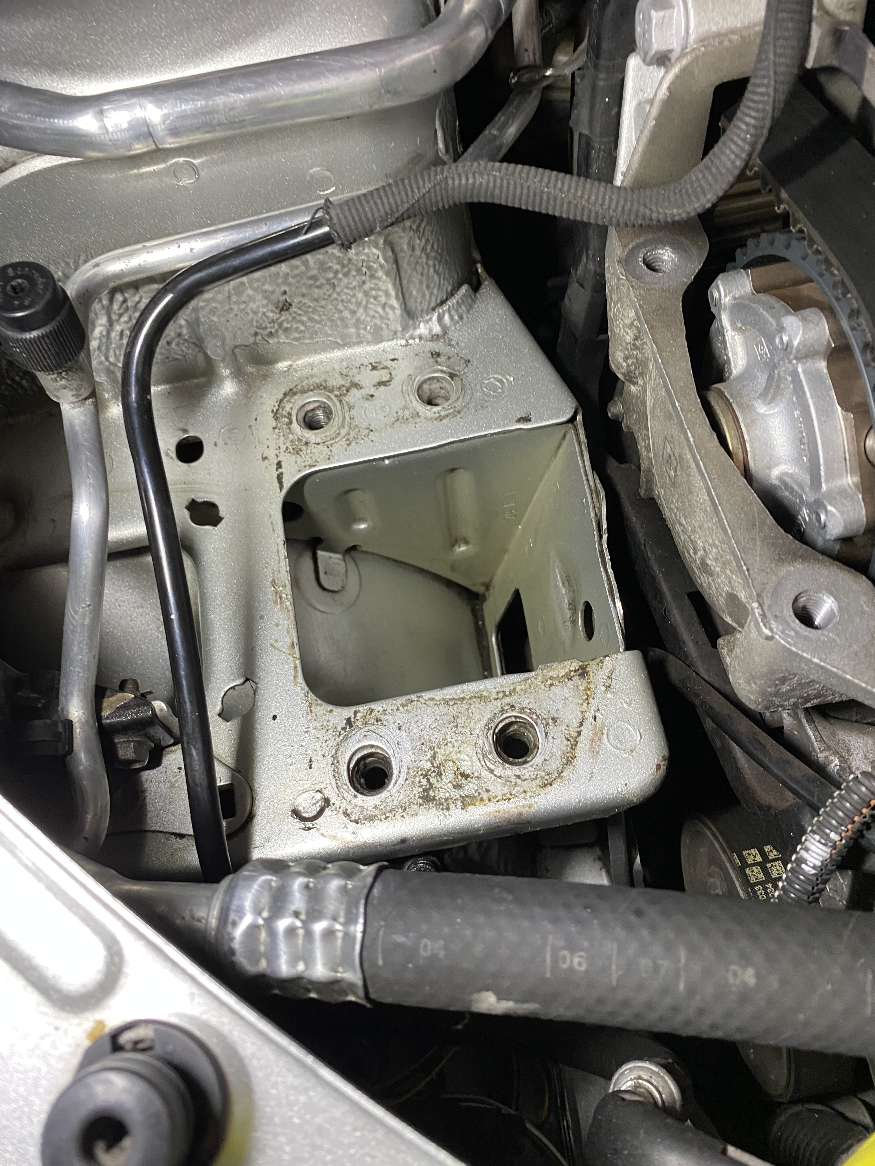

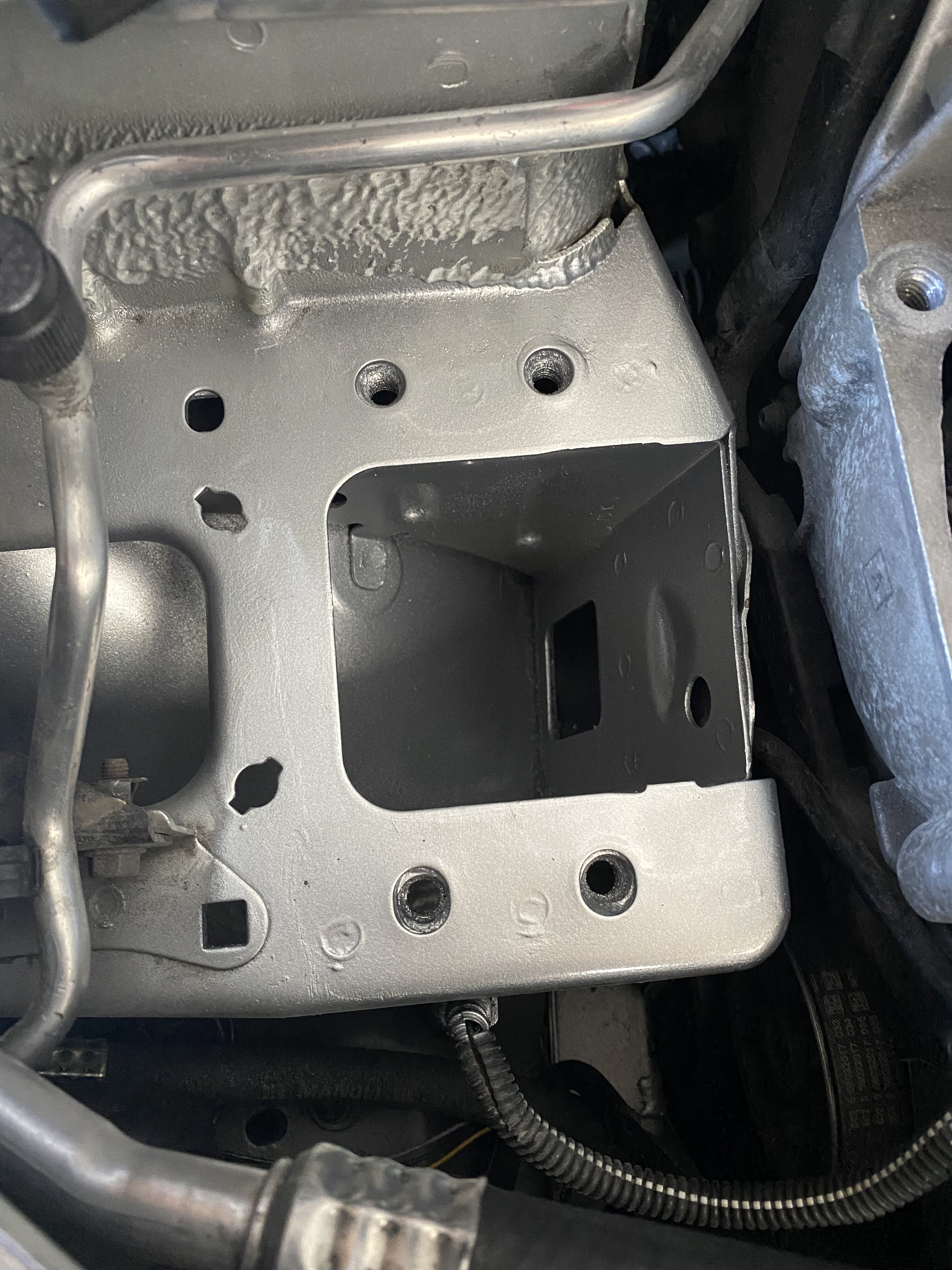

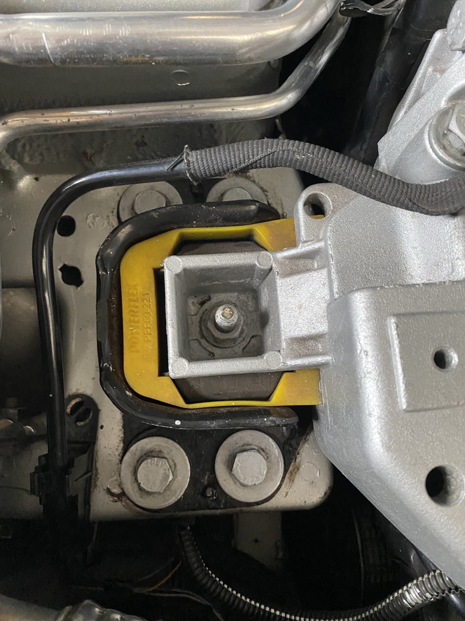

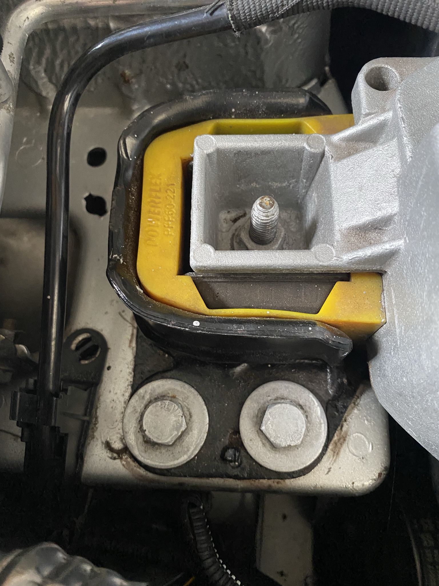

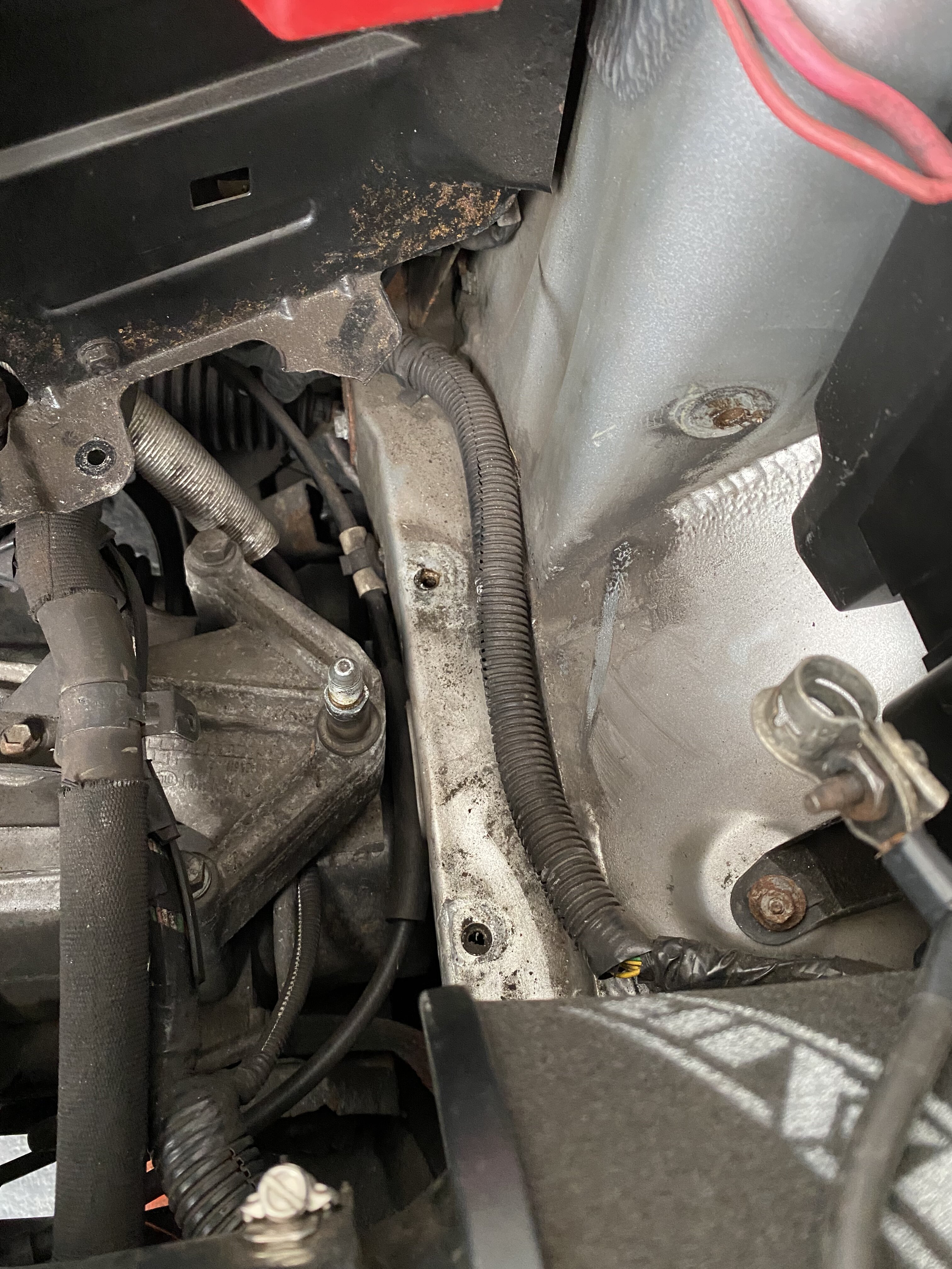

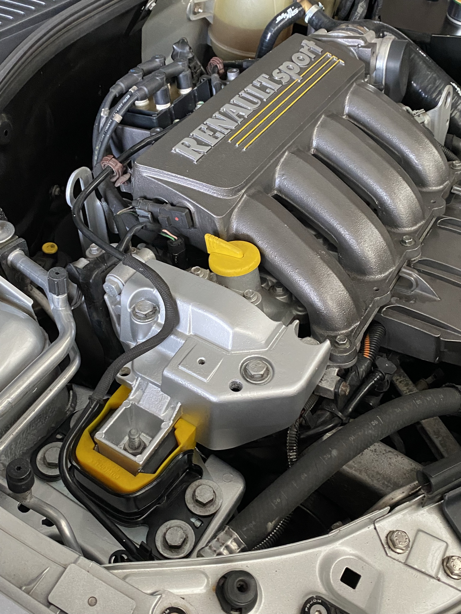

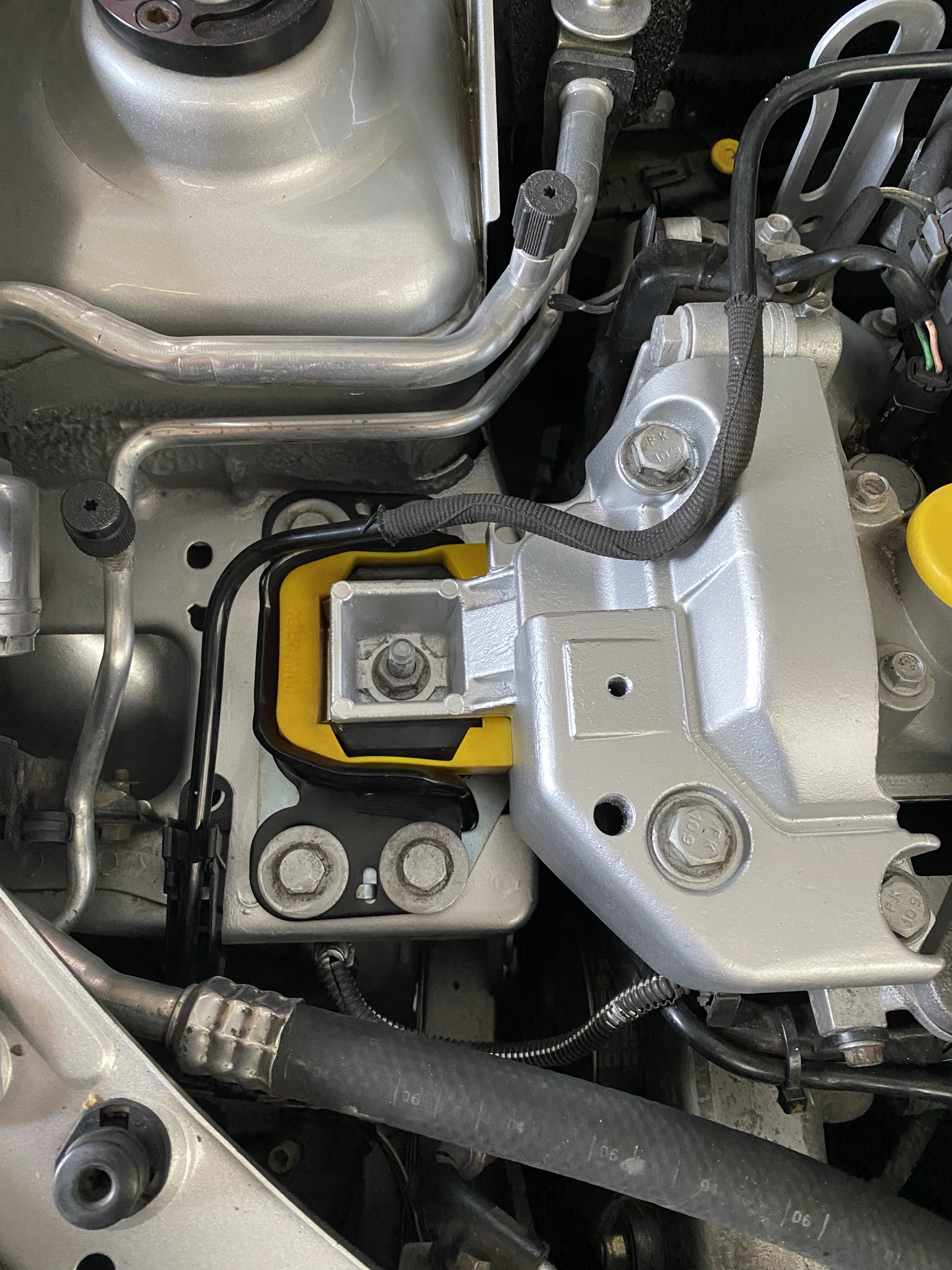

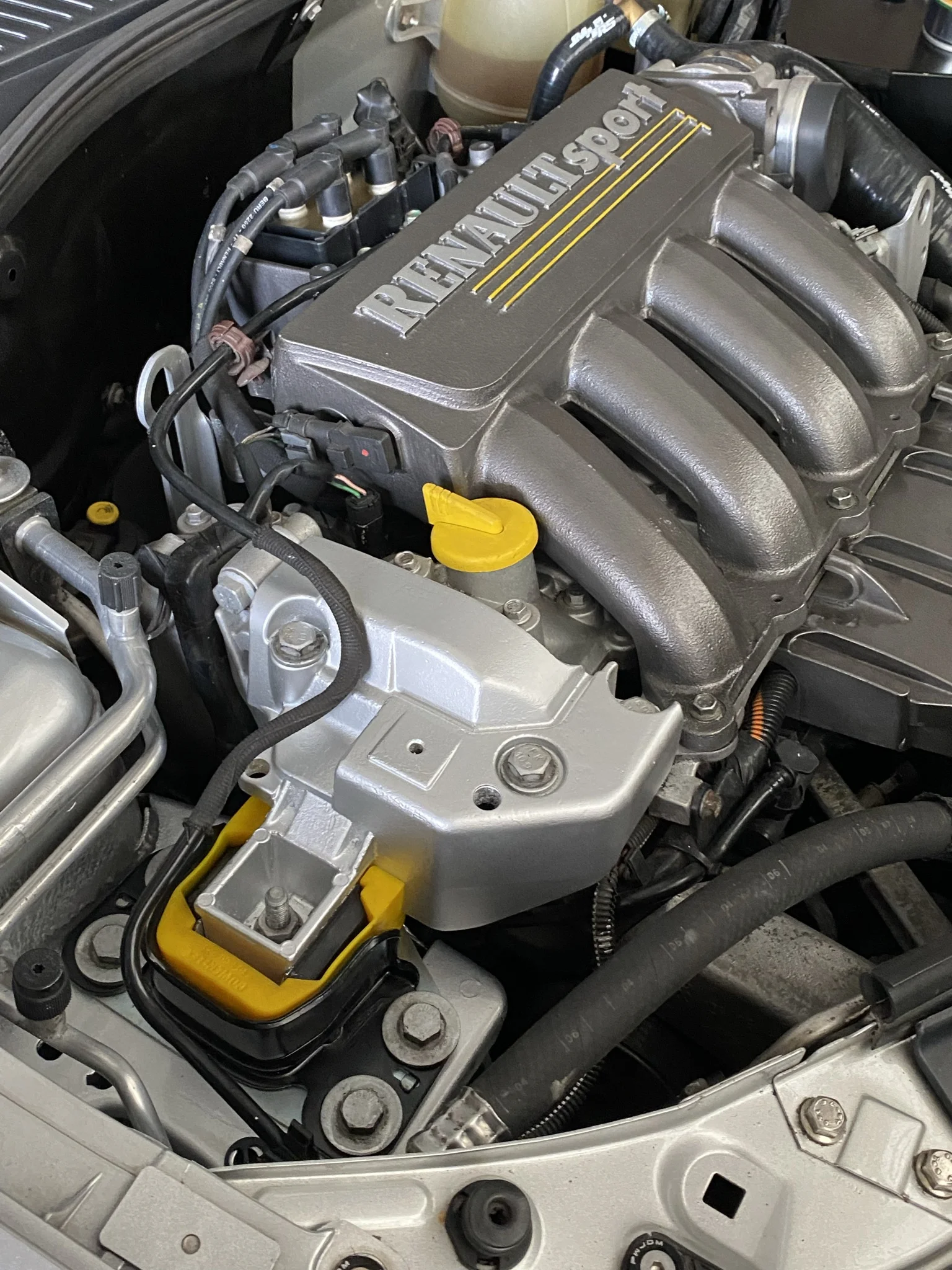

Now, what have I done? Well I’m partial to a clean engine bay, ultimately I want to take the engine out and get everything dicky mint, but I’m yet to determine which direction to go with that as it would be part of a much bigger process. However, one thing that had annoyed me was the engine mounts. They were obviously original and looked a mess.

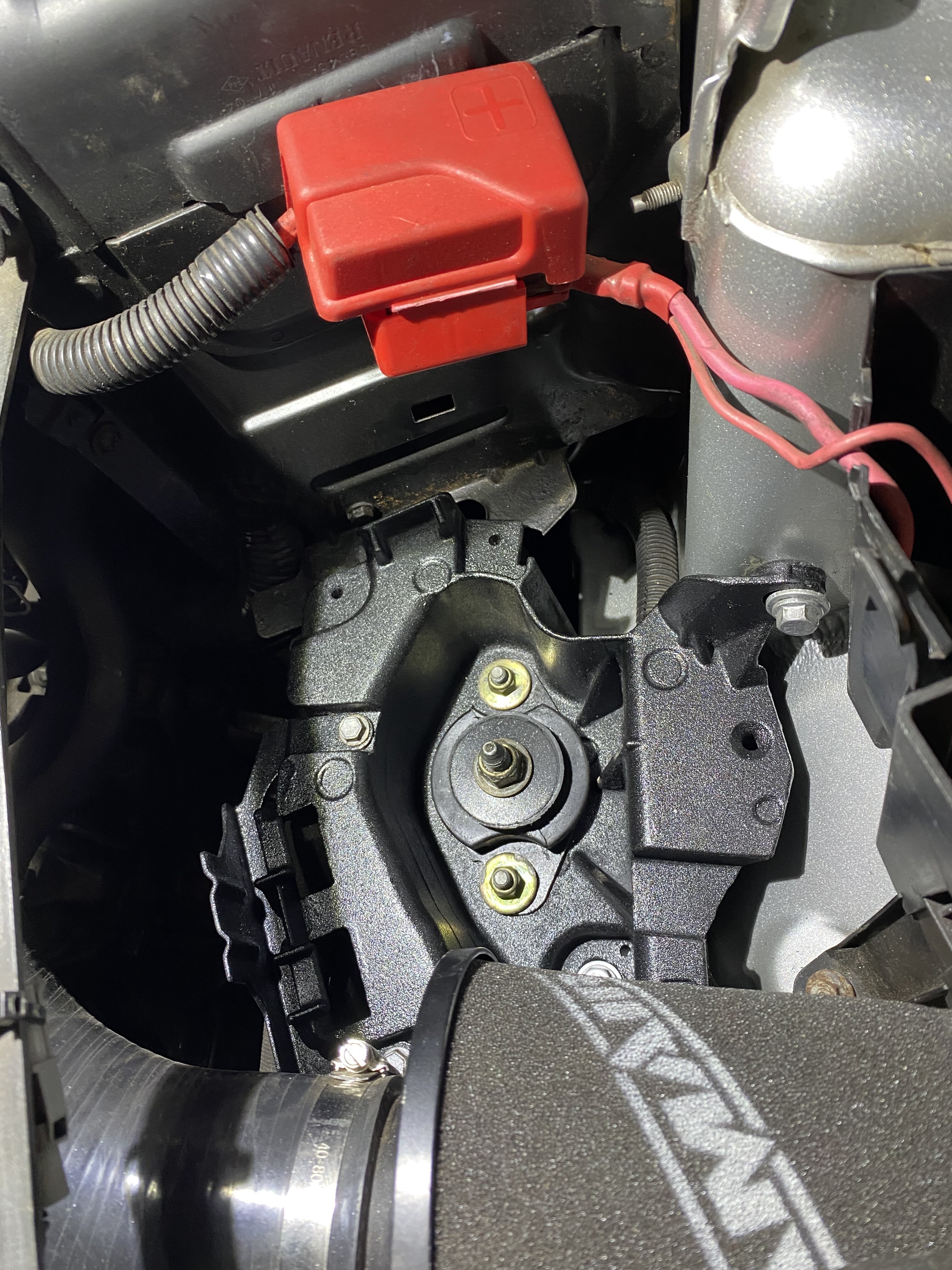

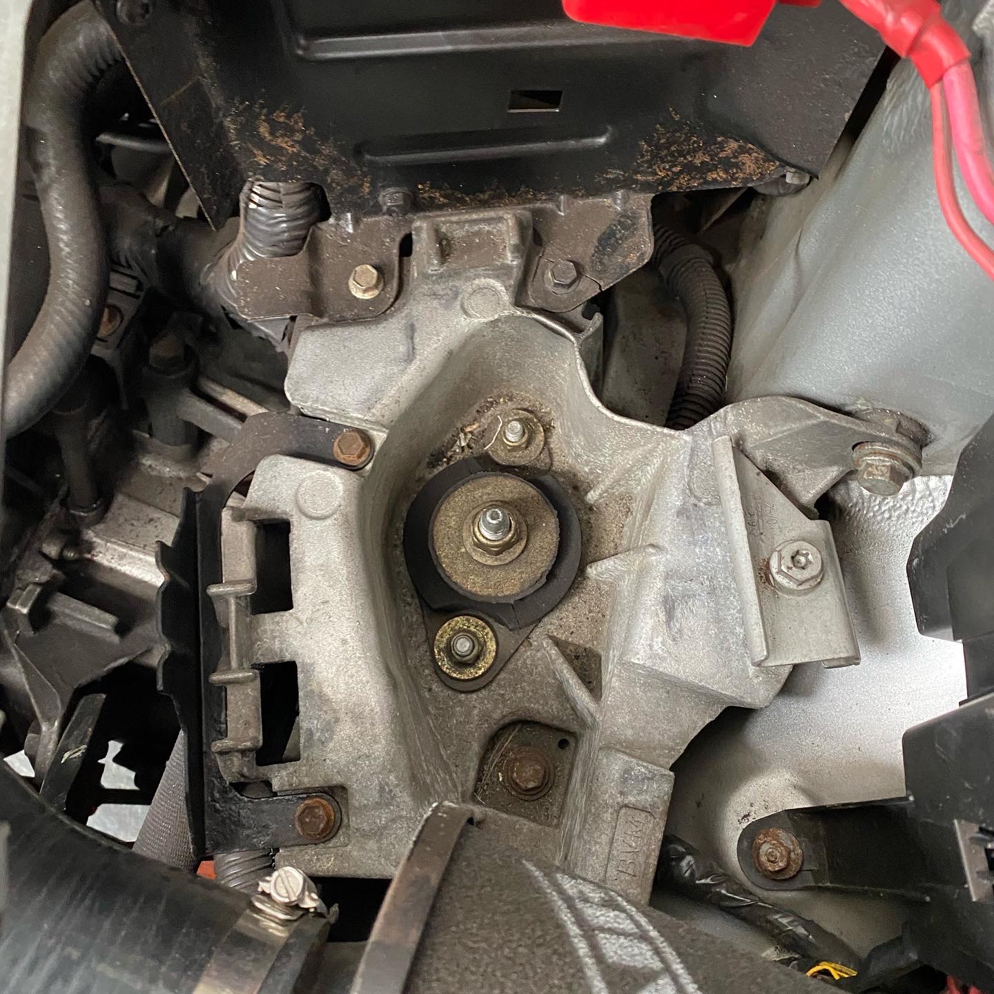

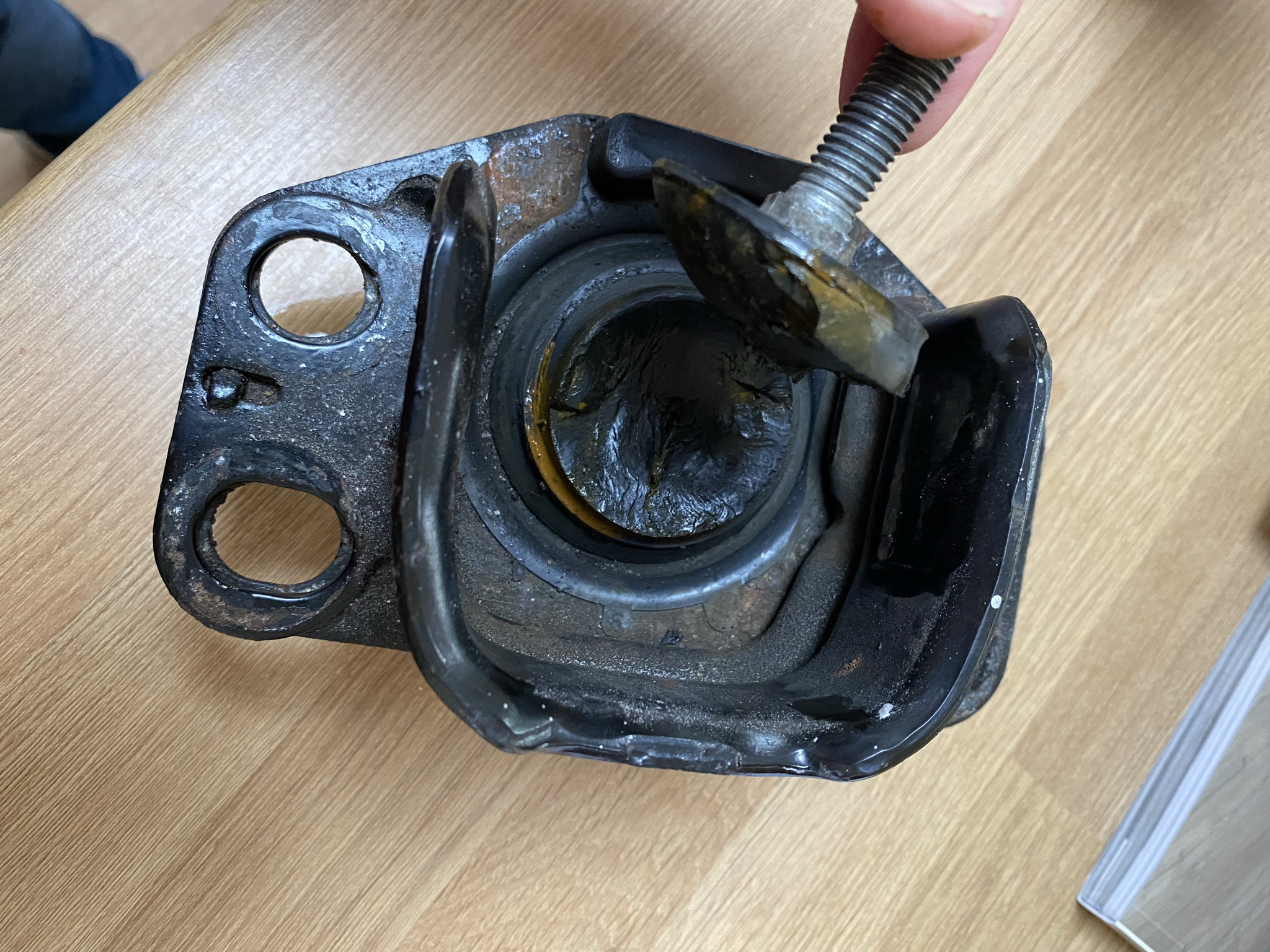

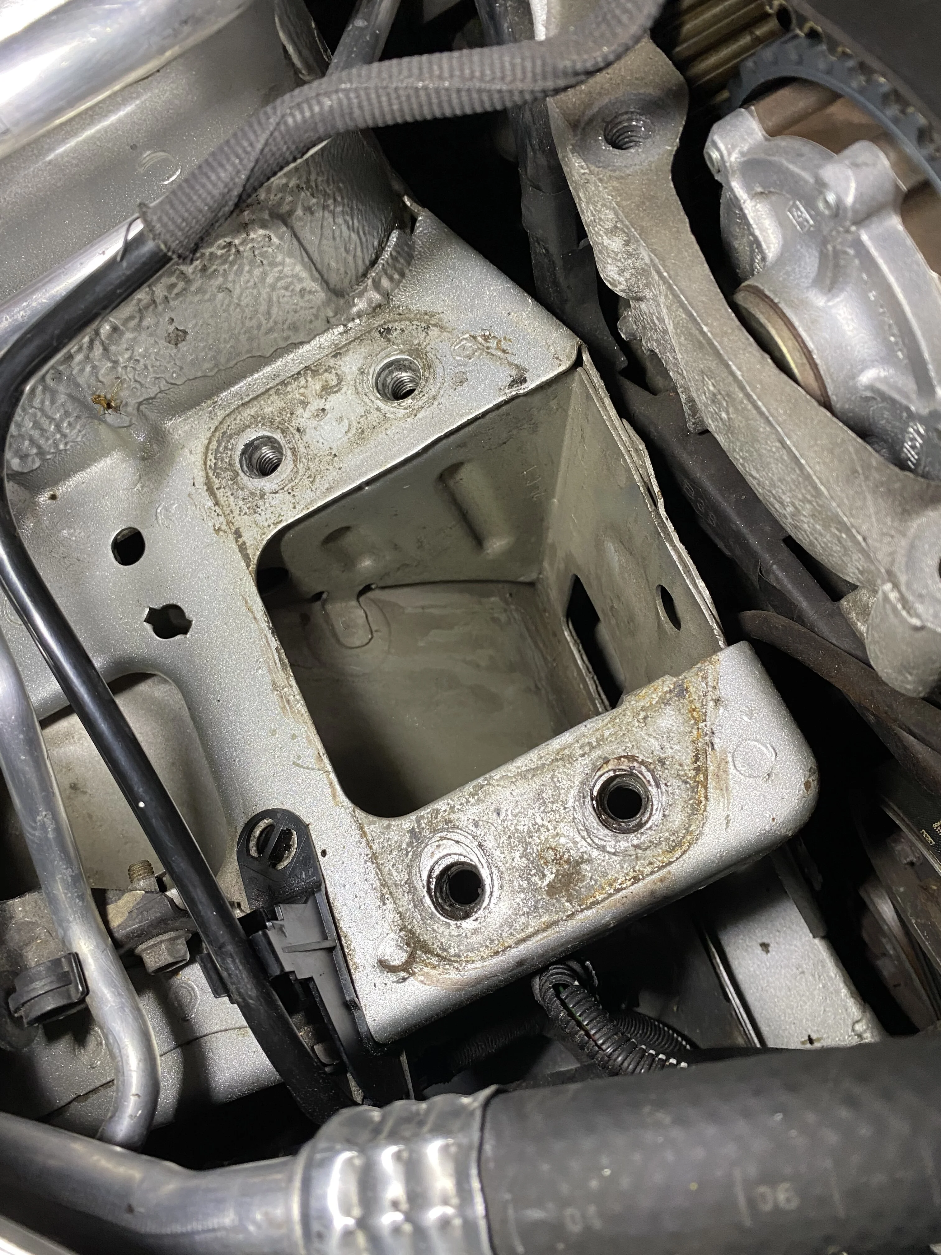

When @Jon Wright listed a new set for sale (both engine and gearbox) I snapped them up. Whilst the mounts were removed it was time to clean things up somewhat. This involved rubbing down some of the scabby areas on the chassis rail, treating and refinishing.
What was interesting was once I removed the mount I found one sheared rubber mount!
and all finished and back together:

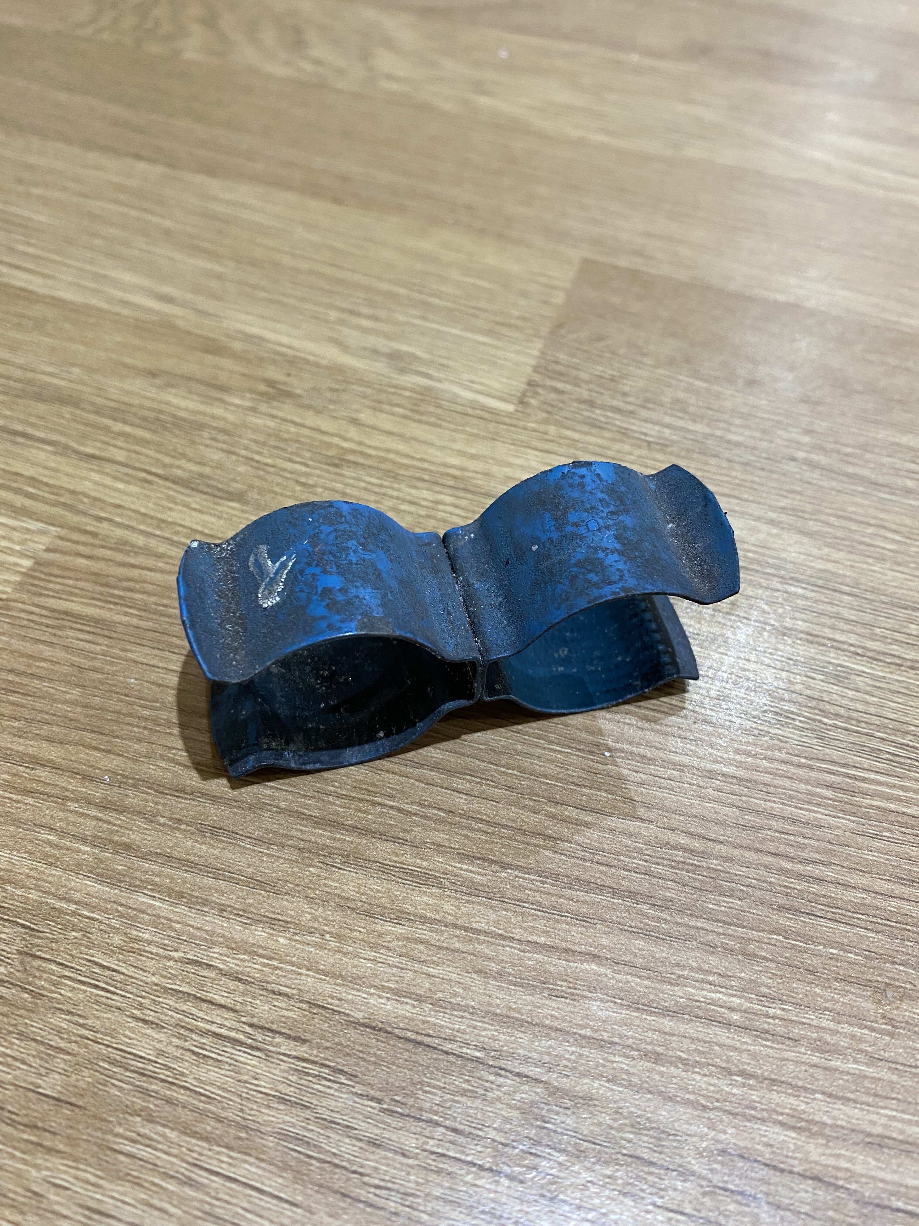

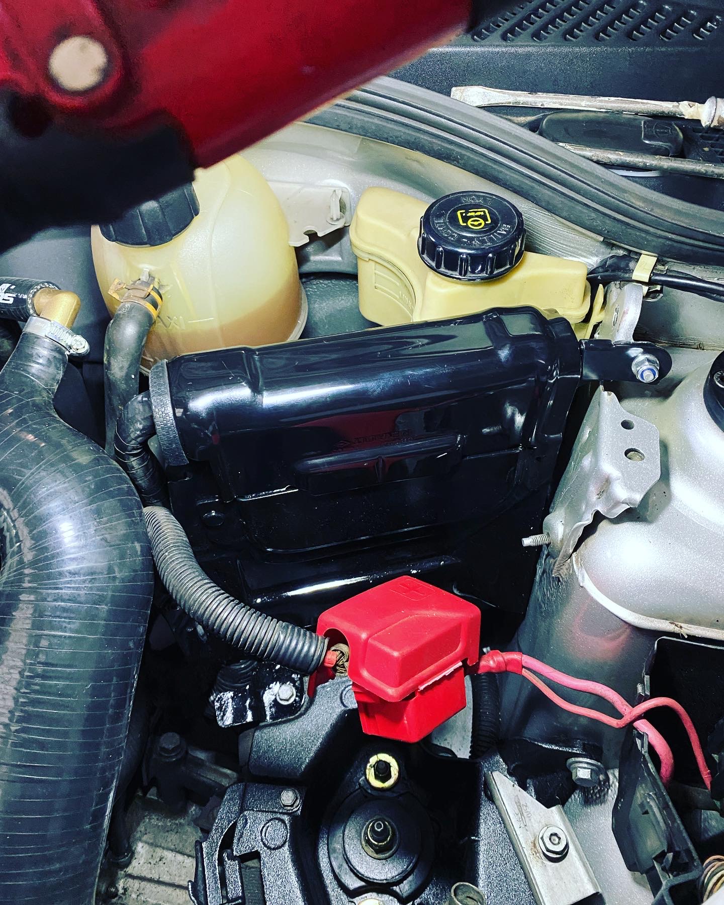

Next up With the engine mount refitted I turned by attention to the gearbox mount. Gave everything a good clean and then painted the mount in my new favourite bed liner paint.
Man I love this stuff, so whilst I was at it. I rubbed down my battery cover and sprayed that as the initial paint was falling off and the weird blue hose coolant hose clip.
Pretty happy with the results.

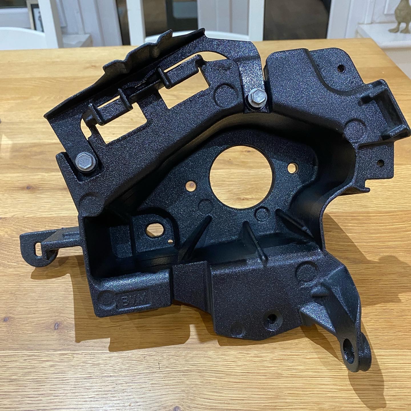

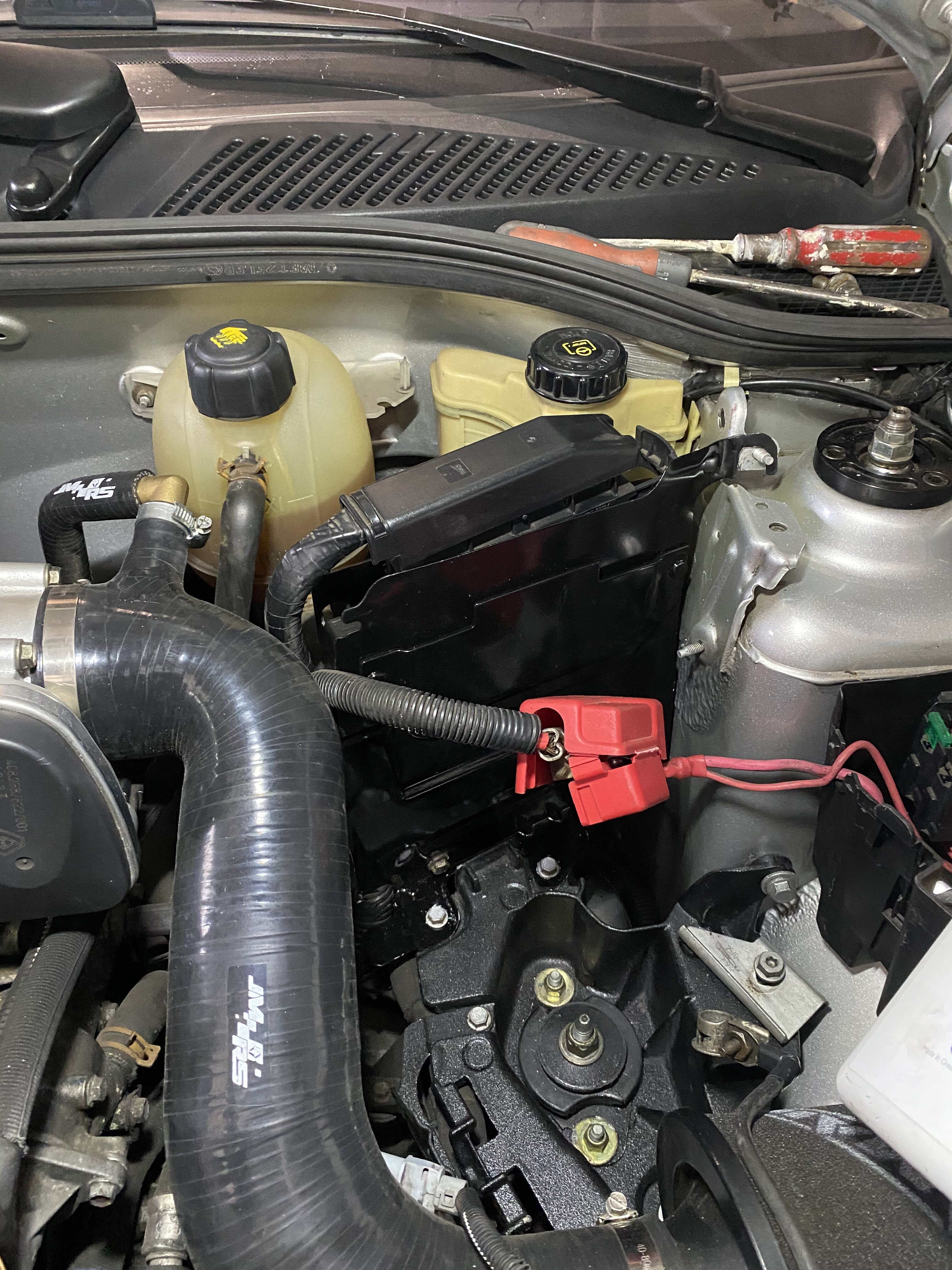

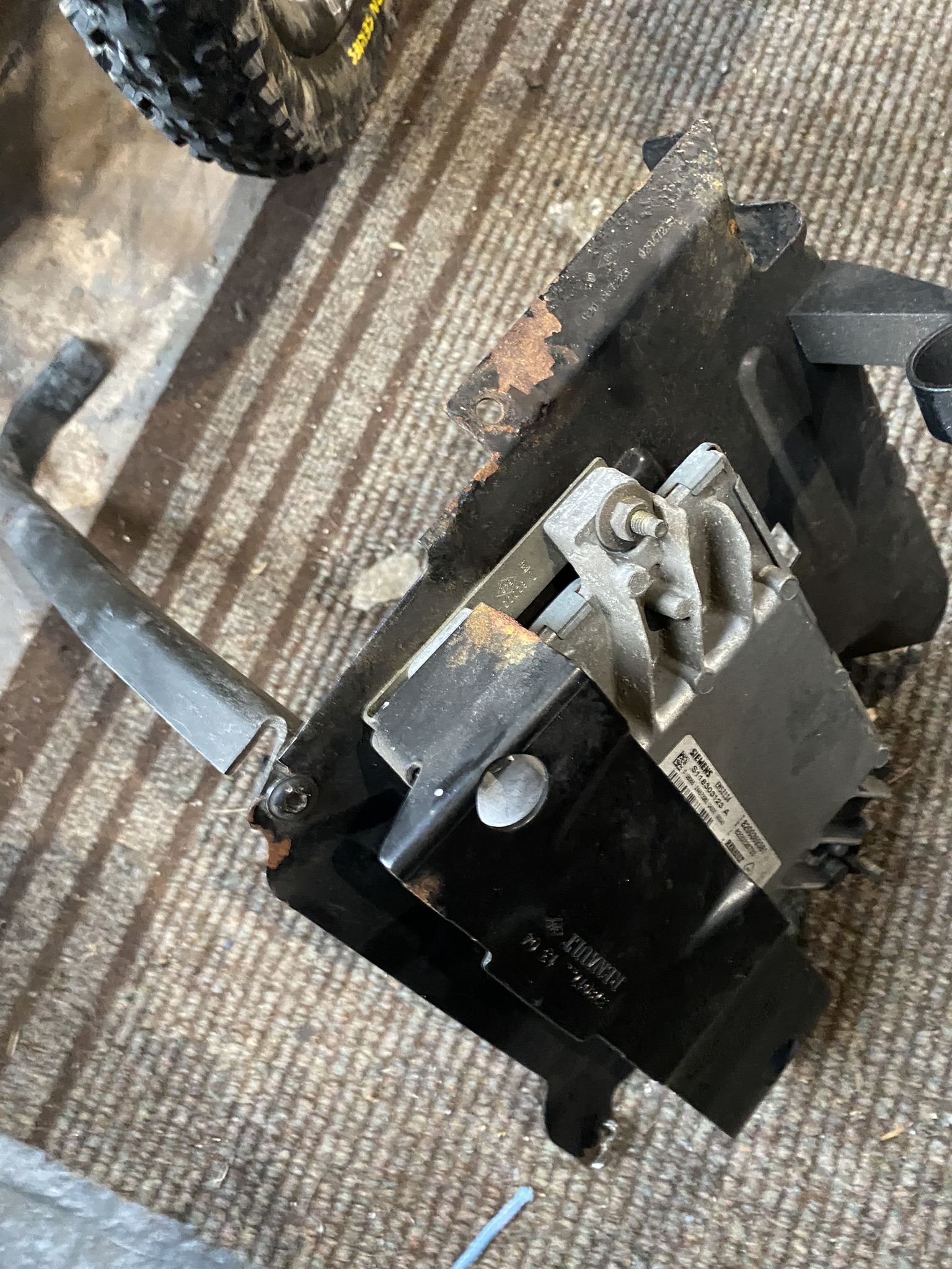

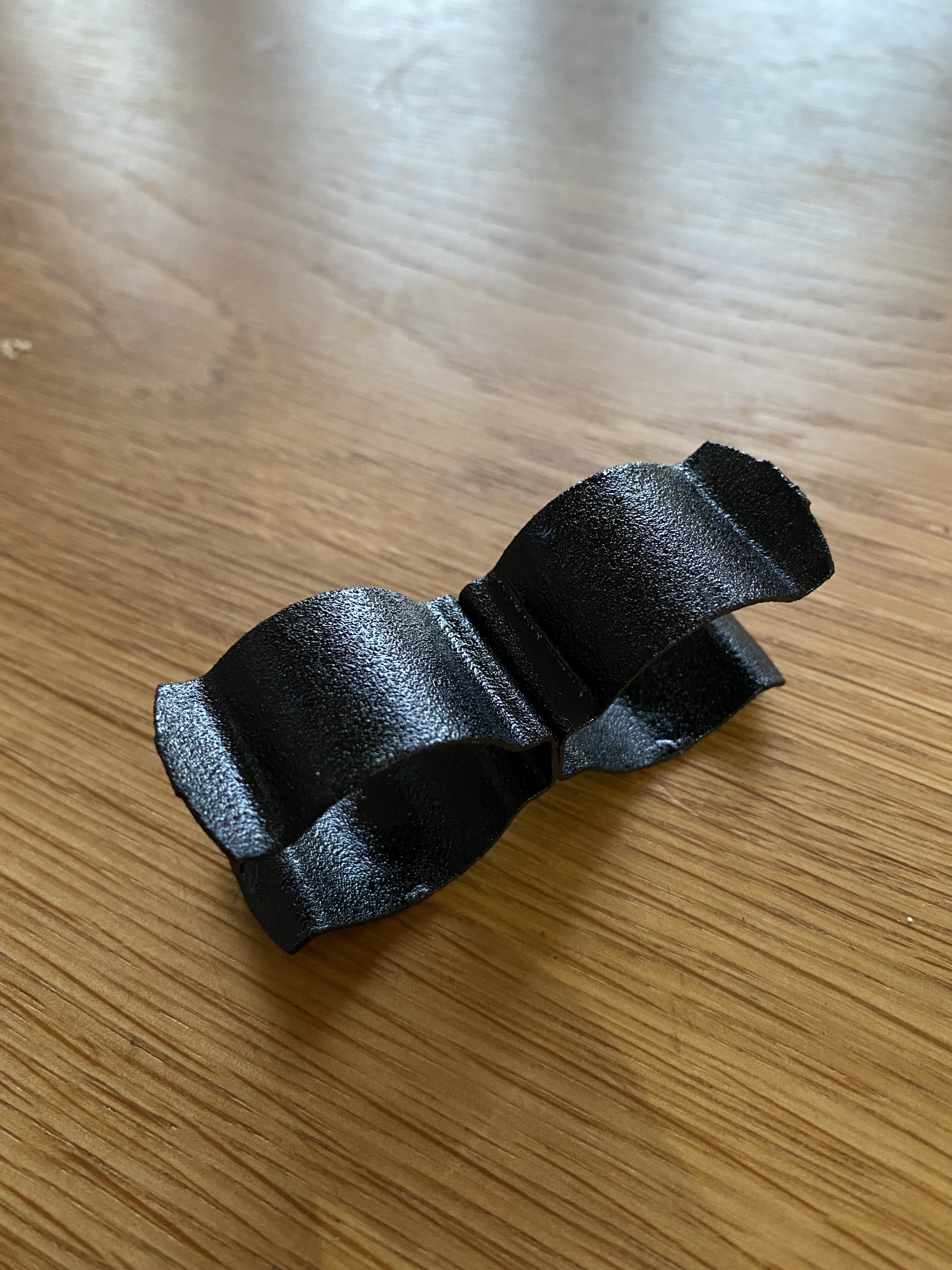

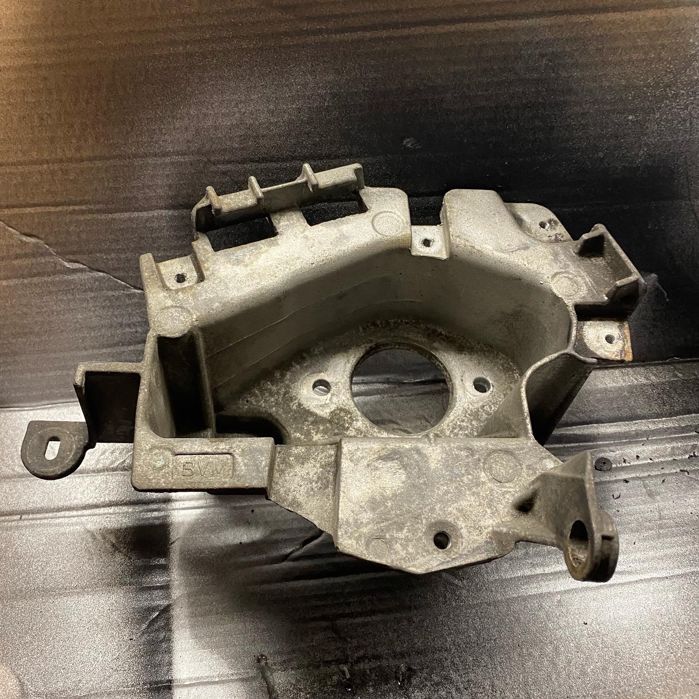

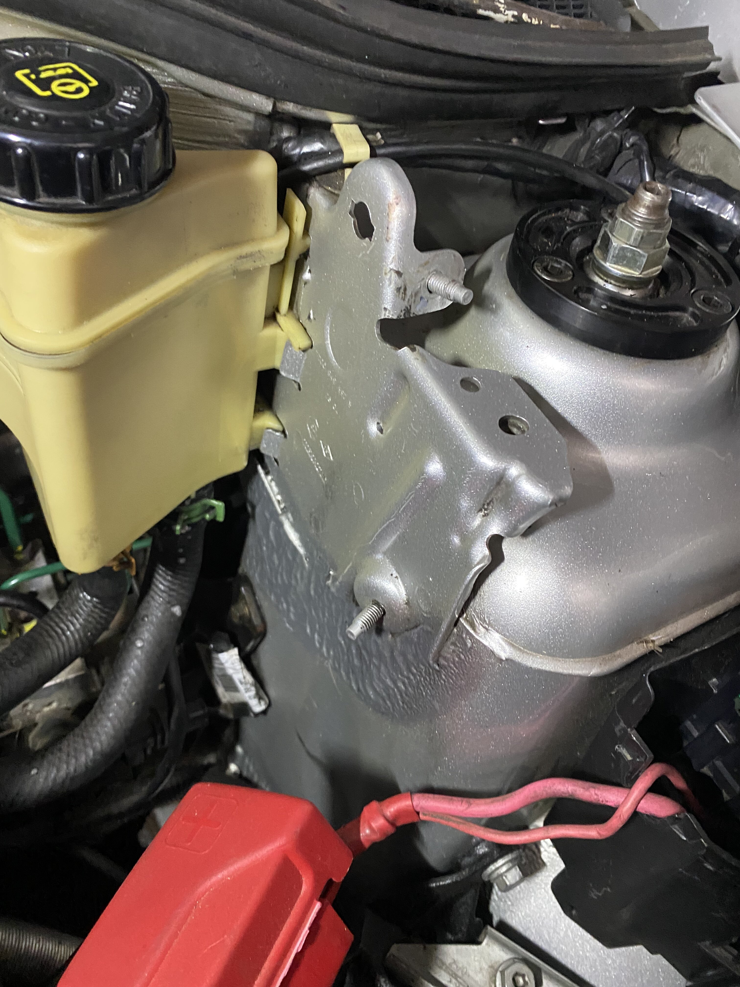

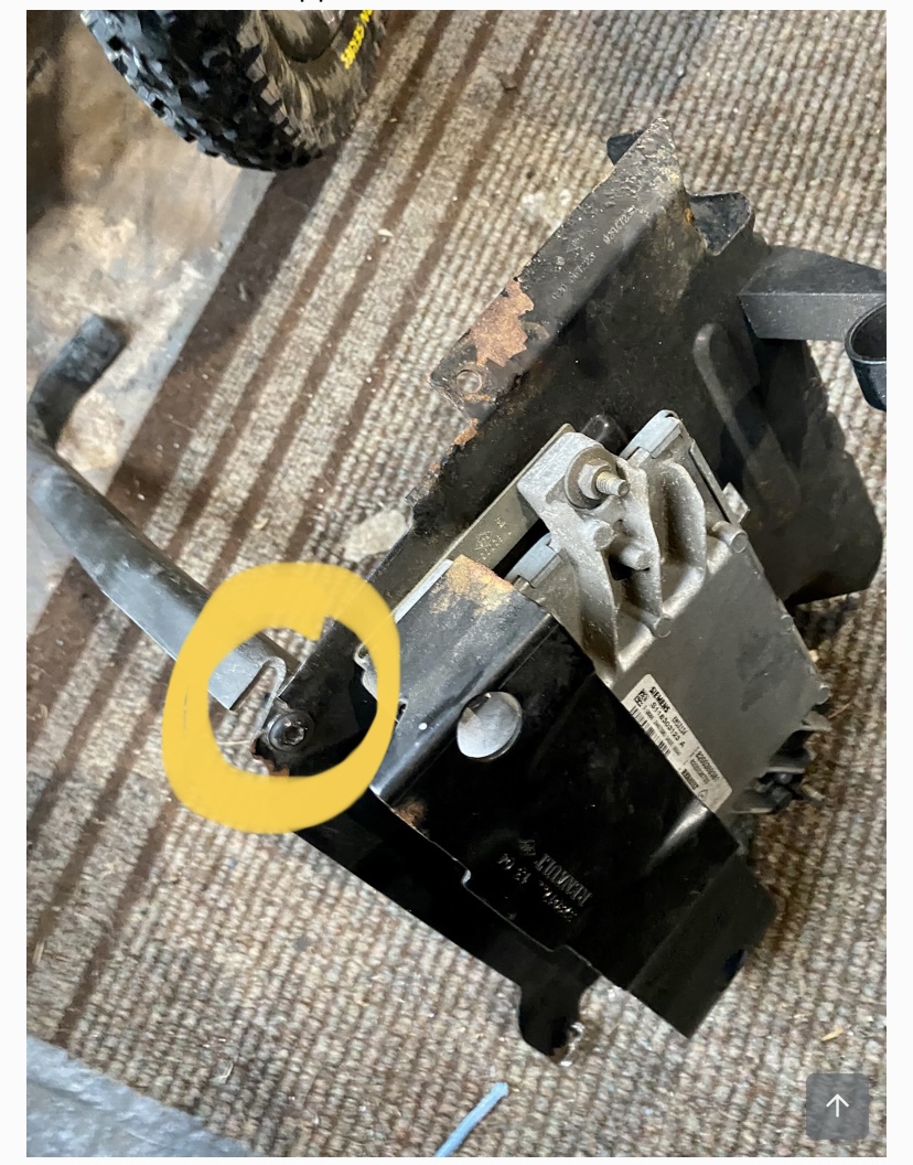

So this left the fuse box cover..now this is where I go back to being more useless at taking photos again…in short mine was cracked and a mess. I had one CFAB bracket repair pieces, which did a great job. But luckily @frayz had replaced his with a much better item and had his cracked but not snapped cover going spare! My brother kindly welded the tab back together and I repainted it. Replacing the loom protective rubber to finish the job off. I’m sure I took photos but I’ll be buggered if I can find them. So just the after photo in this instance. I recited the CFAB tab as a ‘belts and braces’ approach

On this pic, the fixing for the ecu brace looks like a small torx bolt that goes through the rear. Mine has a big (M6?) bolt through the front and it doesn’t sit well. Is this is how they came from the factory? If so then it explains why mine looks like s**t and doesn’t hold very well.
I don’t think this had ever been removed from the car mate, so I’d say it’s as it left the factory yes.

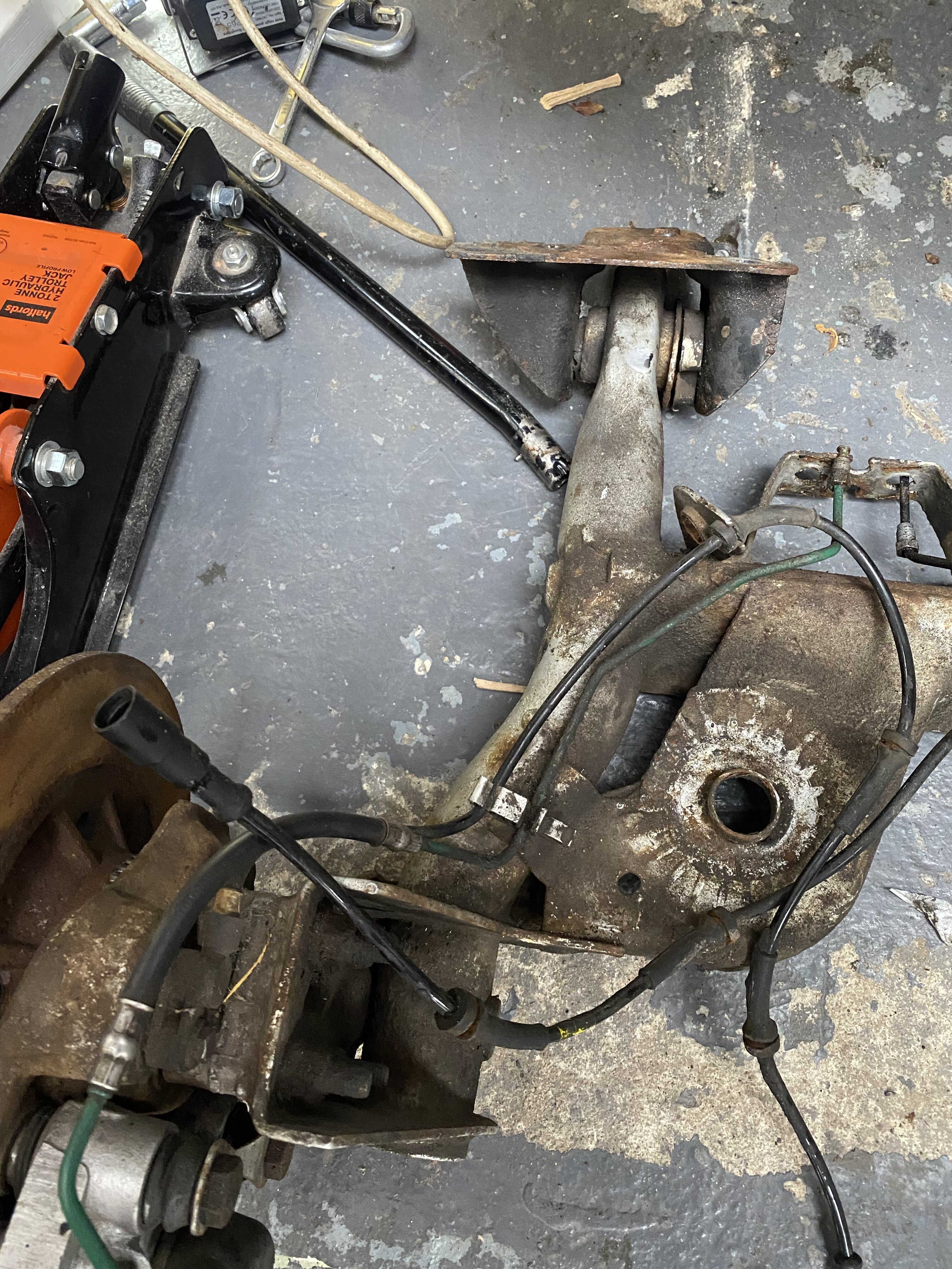

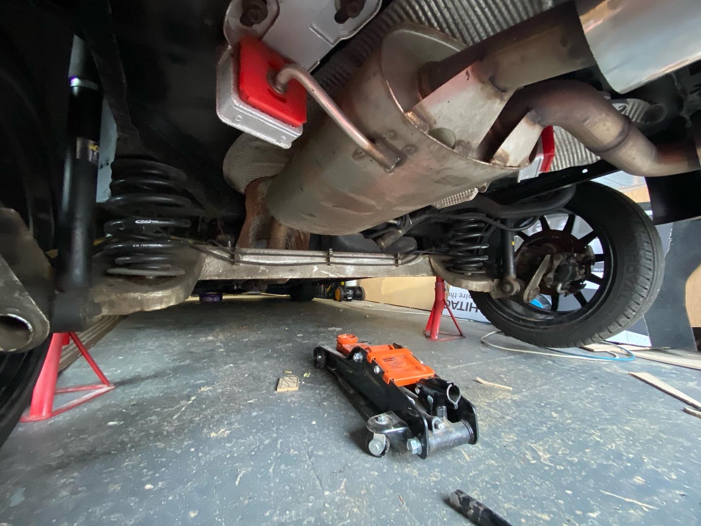

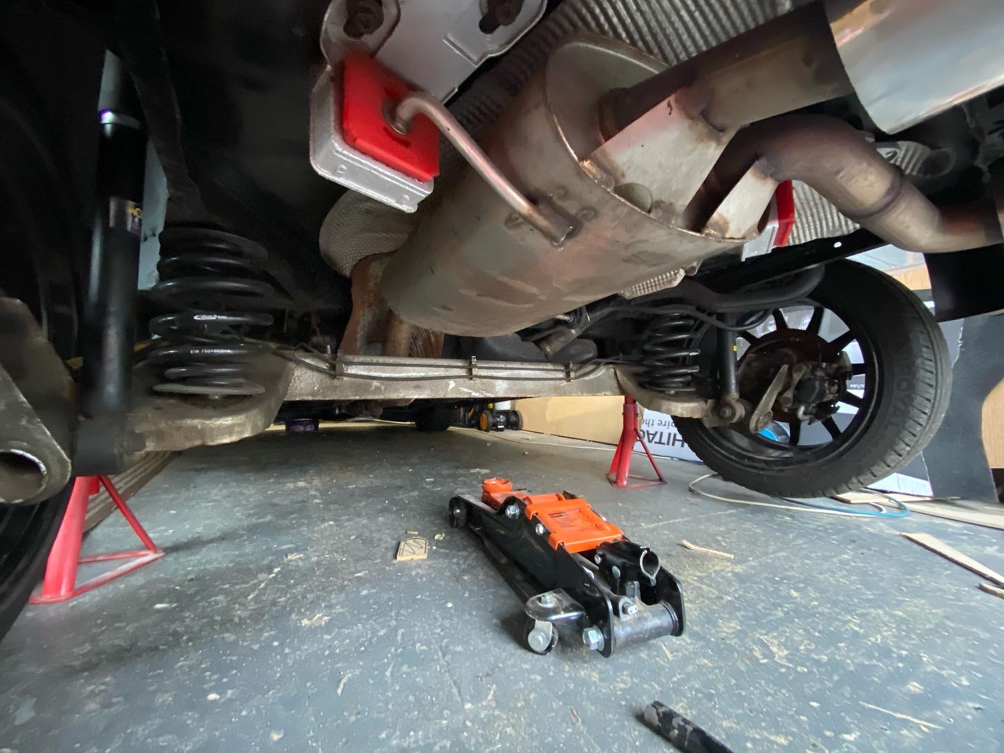

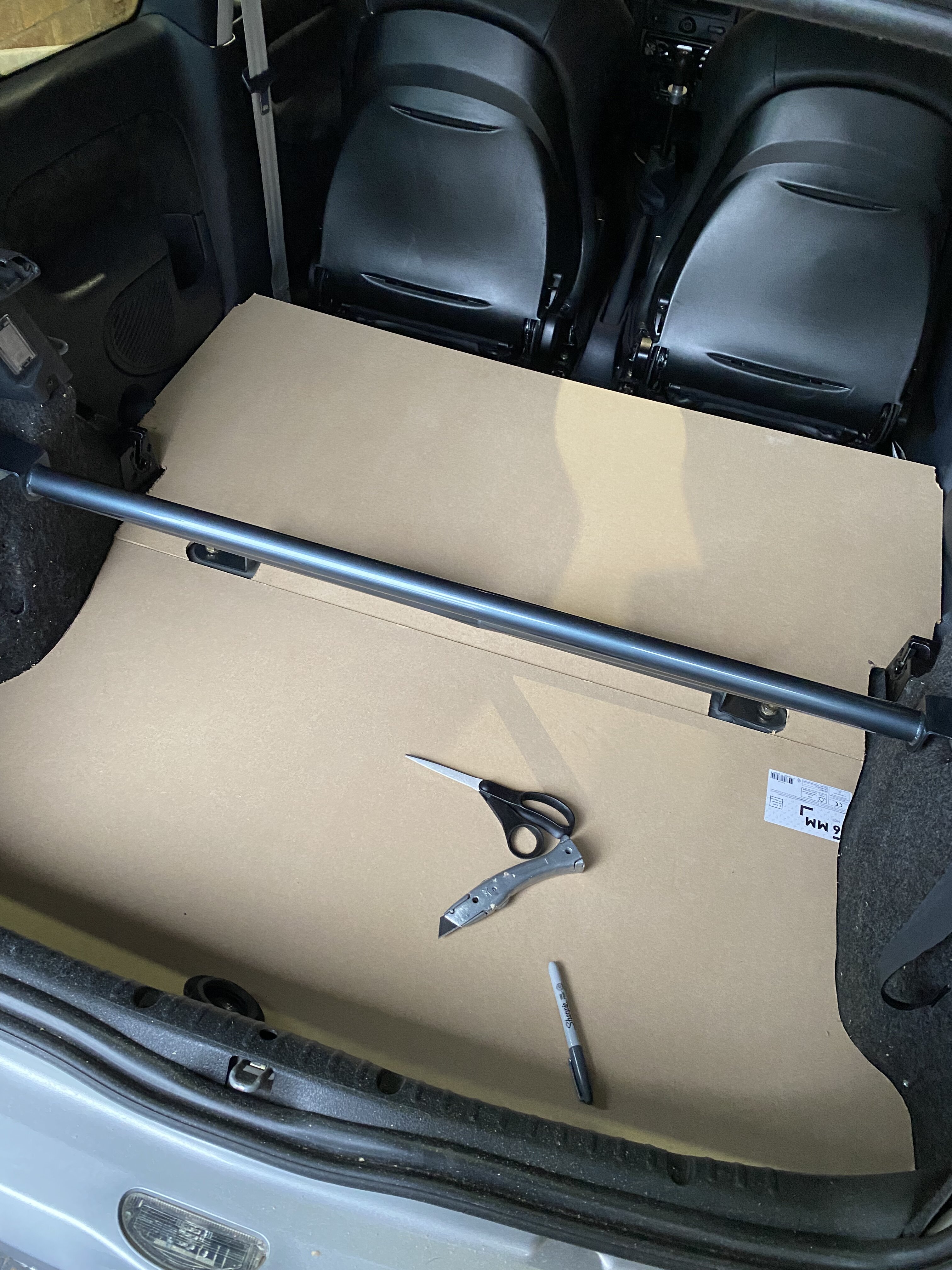

Almost brings me up to date. I have stared making a false floor for the boot area now the rear seats have been removed, needs to be carpet next.

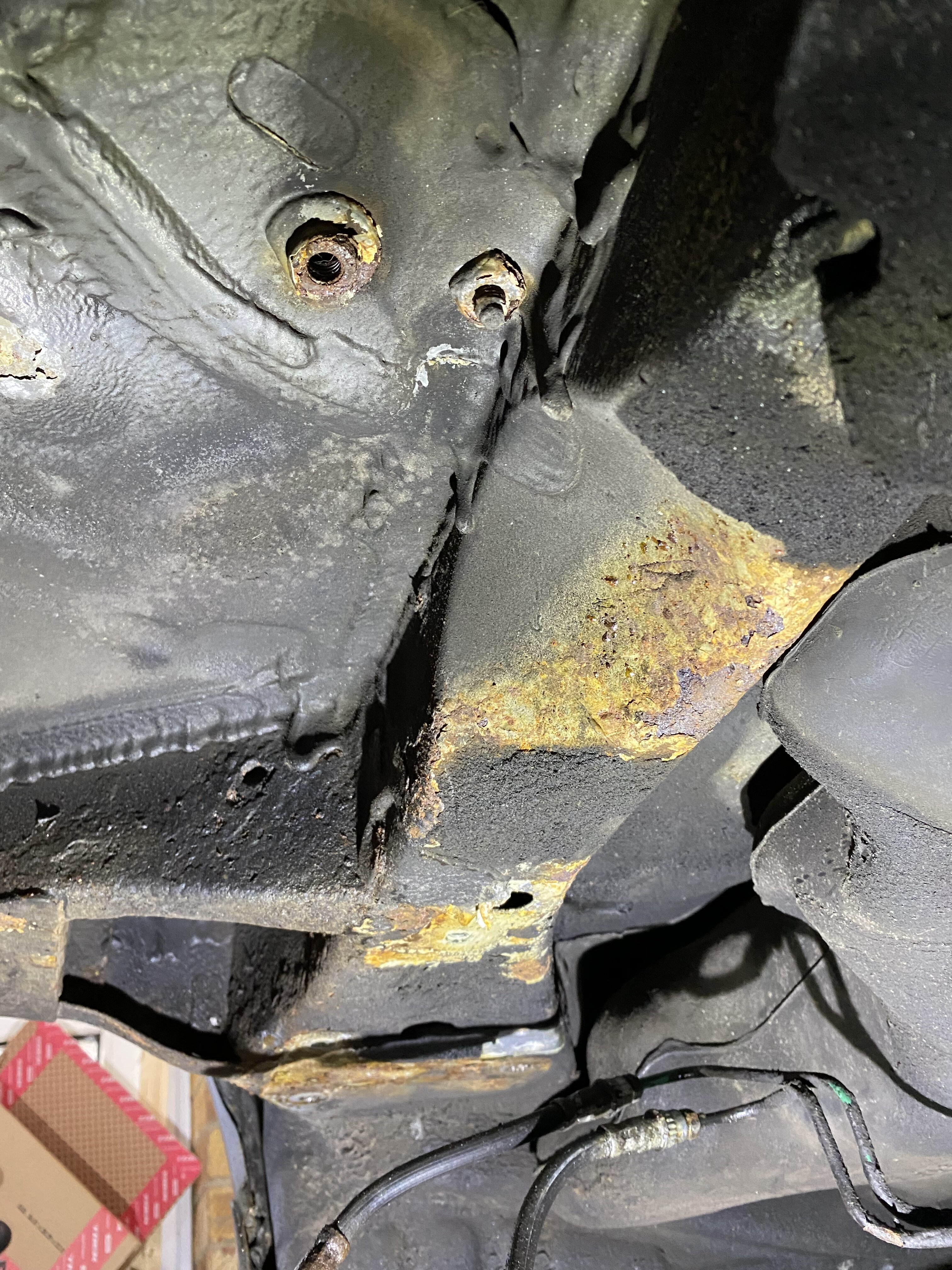

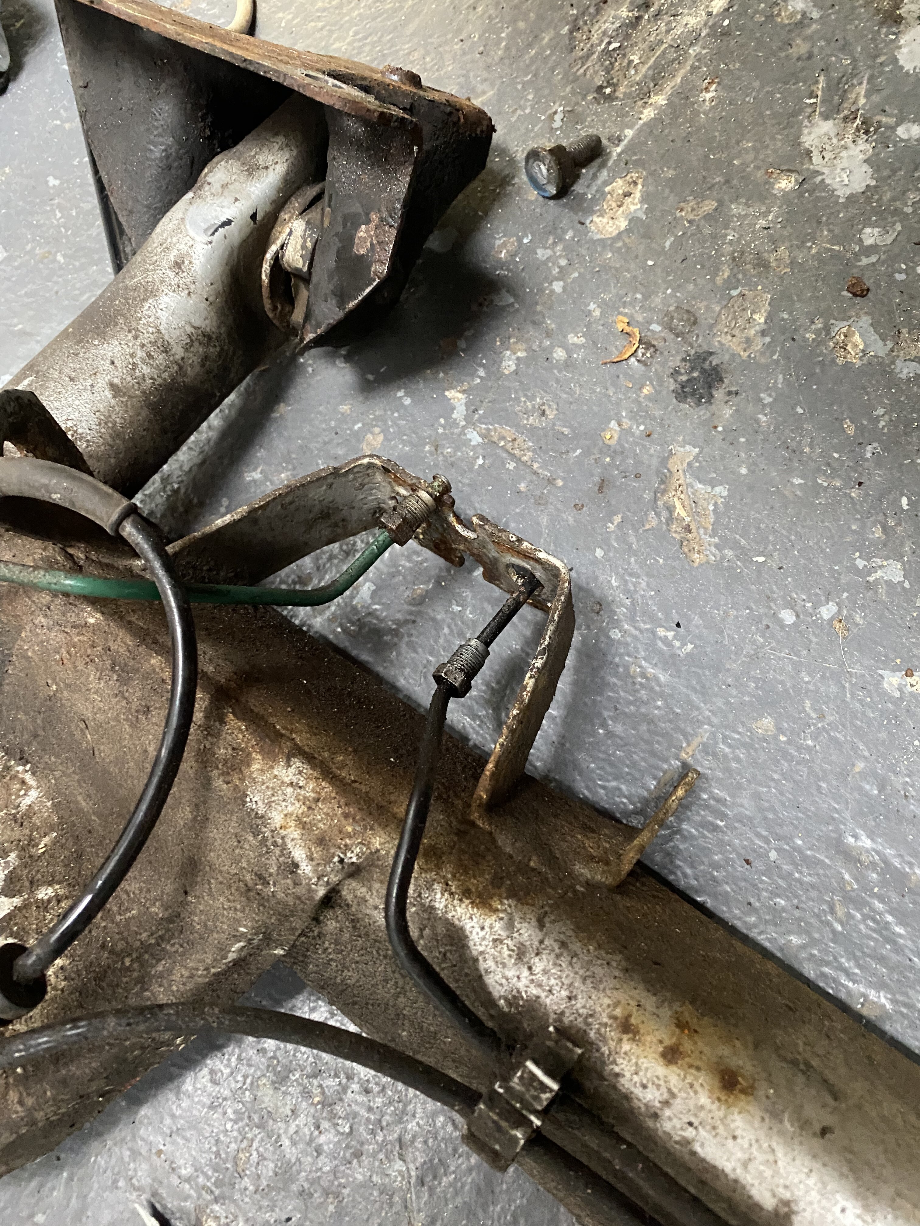

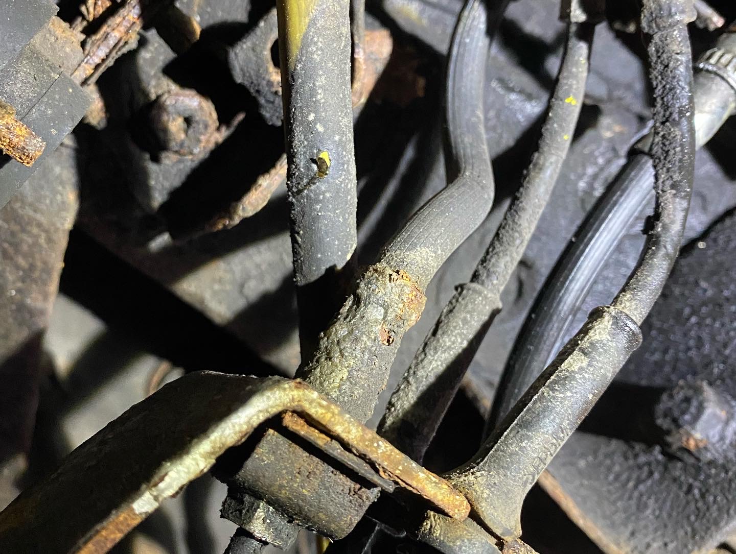

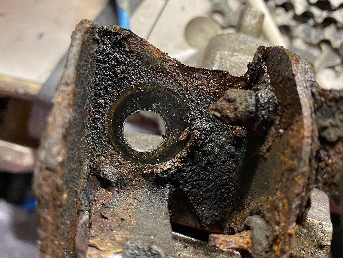

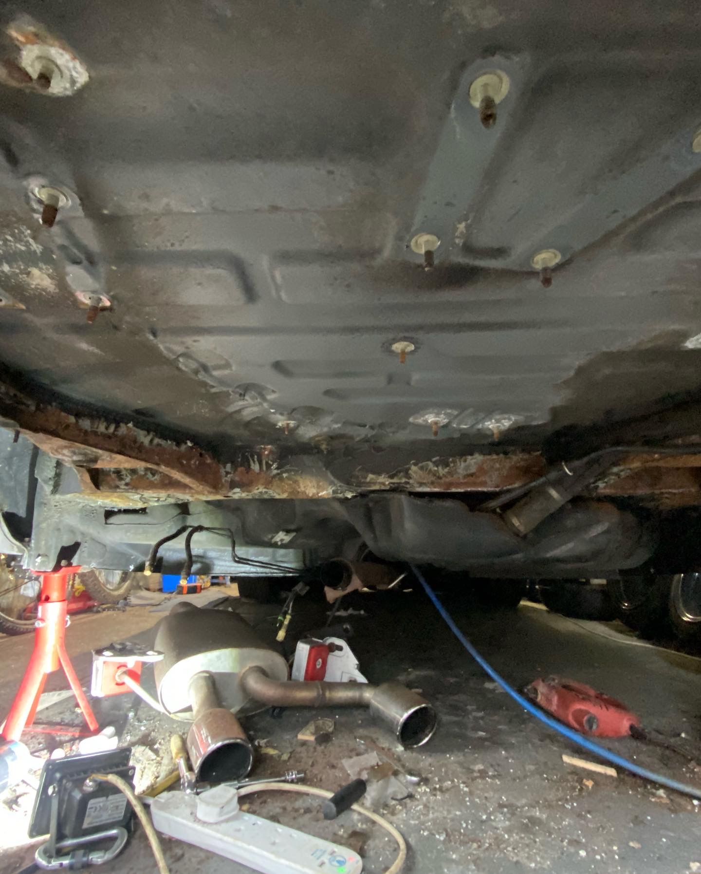

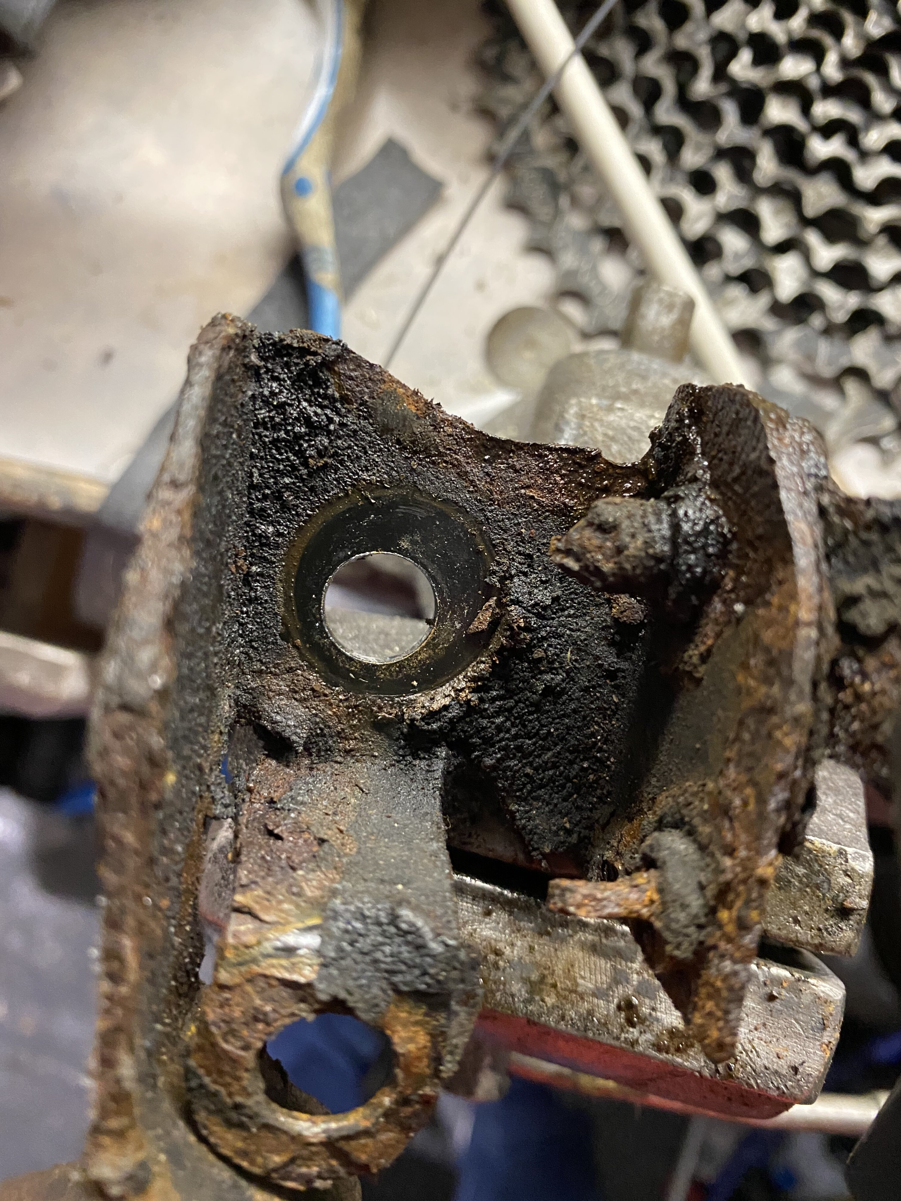

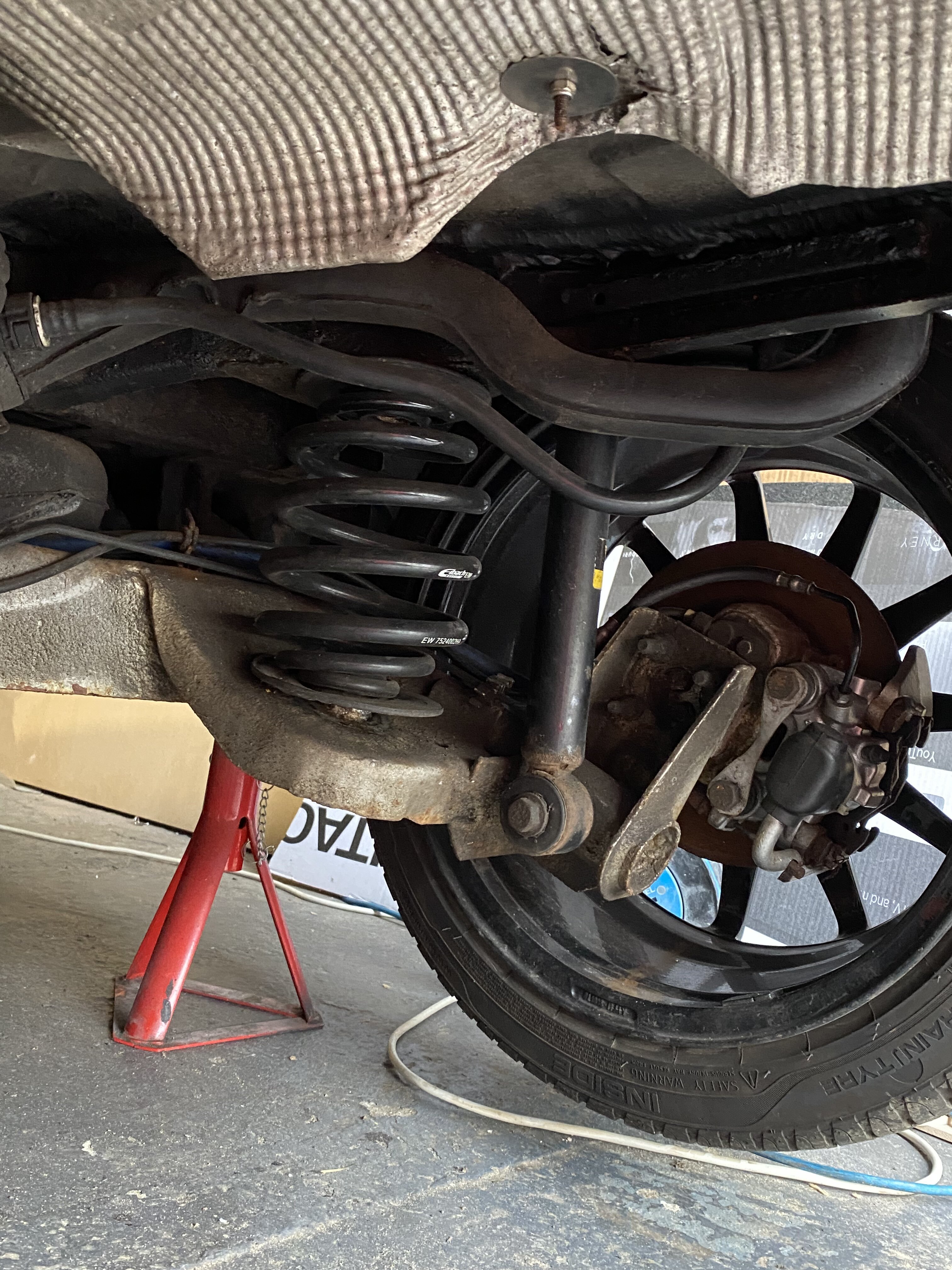

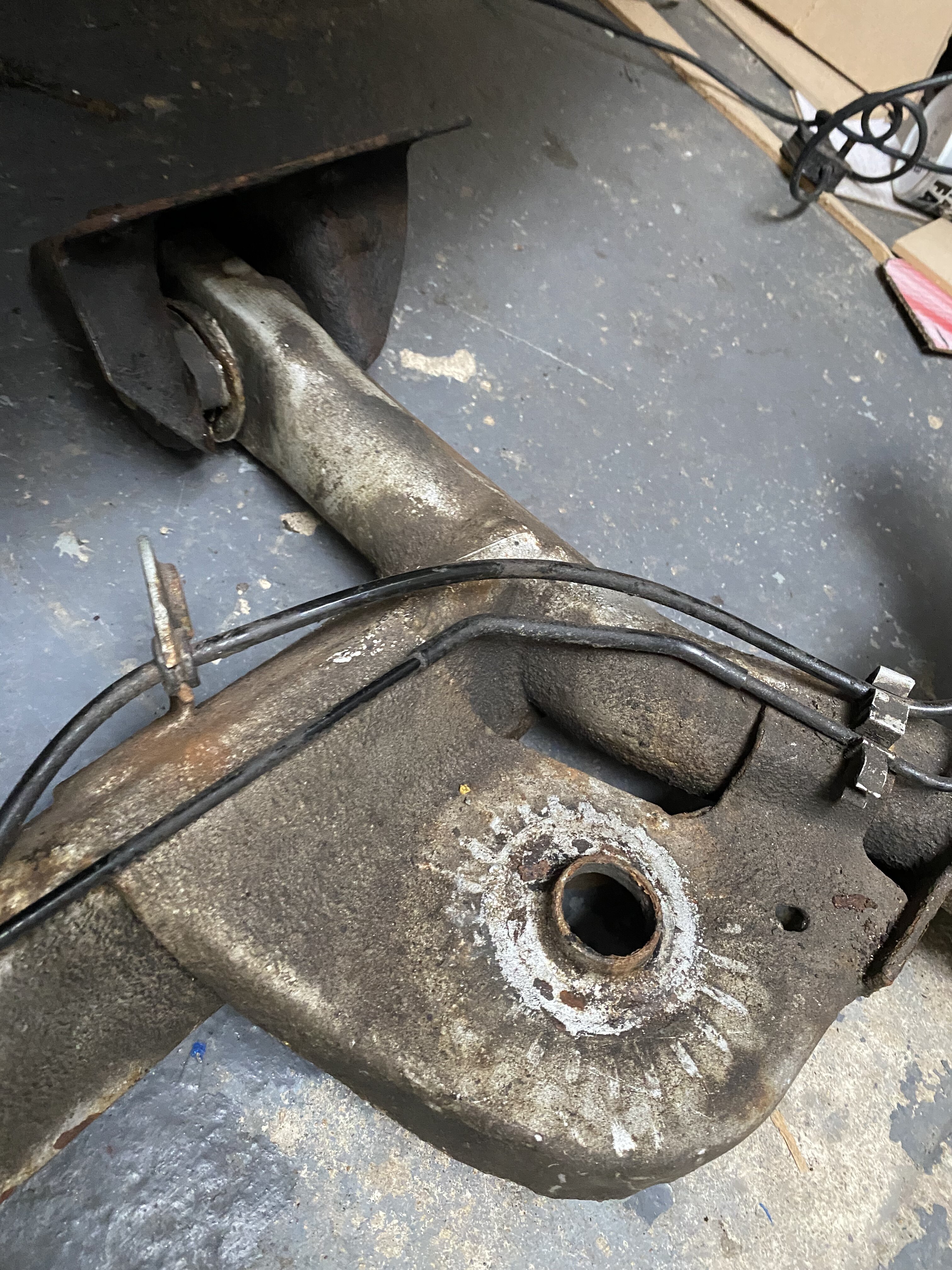

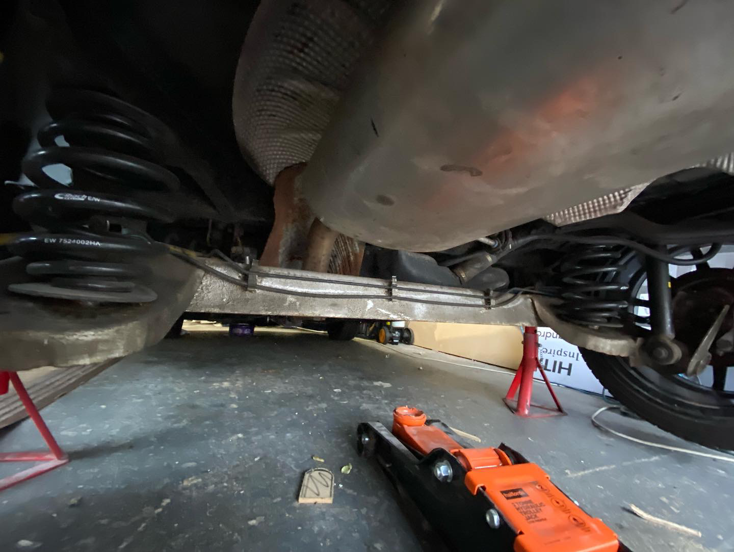

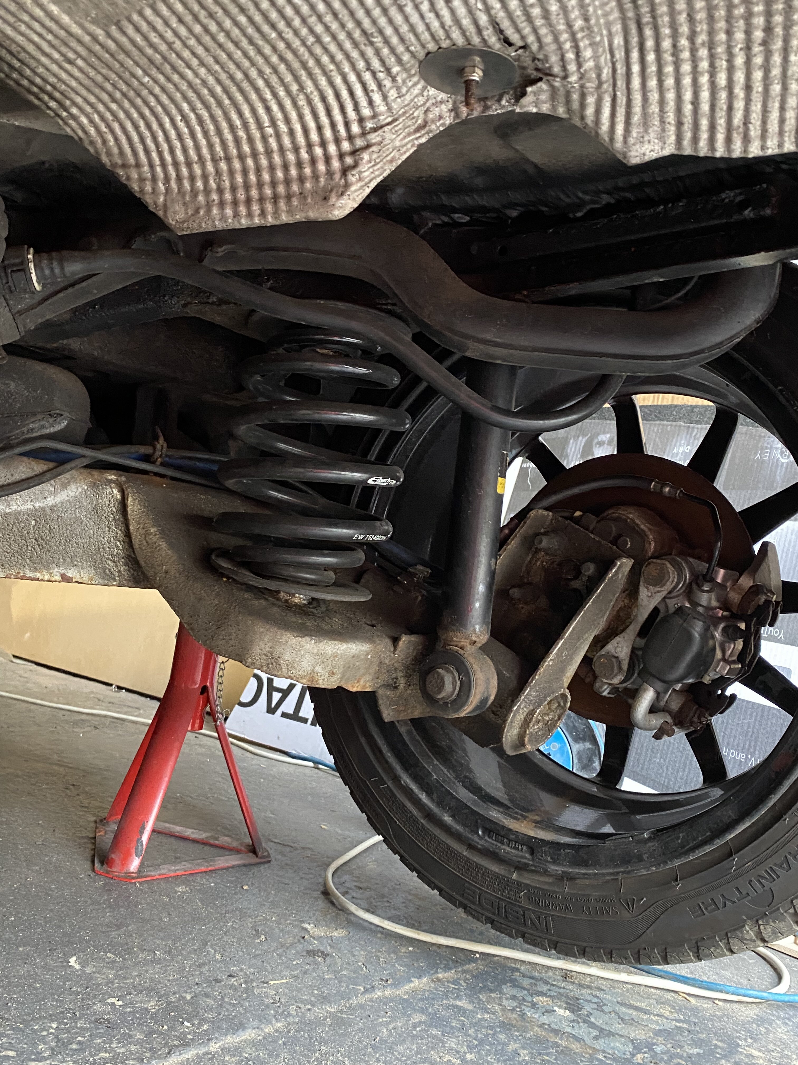

But urgently it’s stripped out, to get the rear beam dropped! Those long term readers will remember I had a rear beam refreshed last year…well I’m finally getting around to sorting the rear end! Check this s**t show out!
Seriously kids, take care of your underside. My car is remarkably straight up top. But it’s also remarkably crusty underneath. More updates will follow as I’m in the swing of things now!
Almost brings me up to date. I have stared making a false floor for the boot area now the rear seats have been removed, needs to be carpet next.View attachment 1578215
But urgently it’s stripped out, to get the rear beam dropped! Those long term readers will remember I had a rear beam refreshed last year…well I’m finally getting around to sorting the rear end! Check this s**t show out! View attachment 1578216View attachment 1578217View attachment 1578218View attachment 1578219View attachment 1578221View attachment 1578222View attachment 1578224

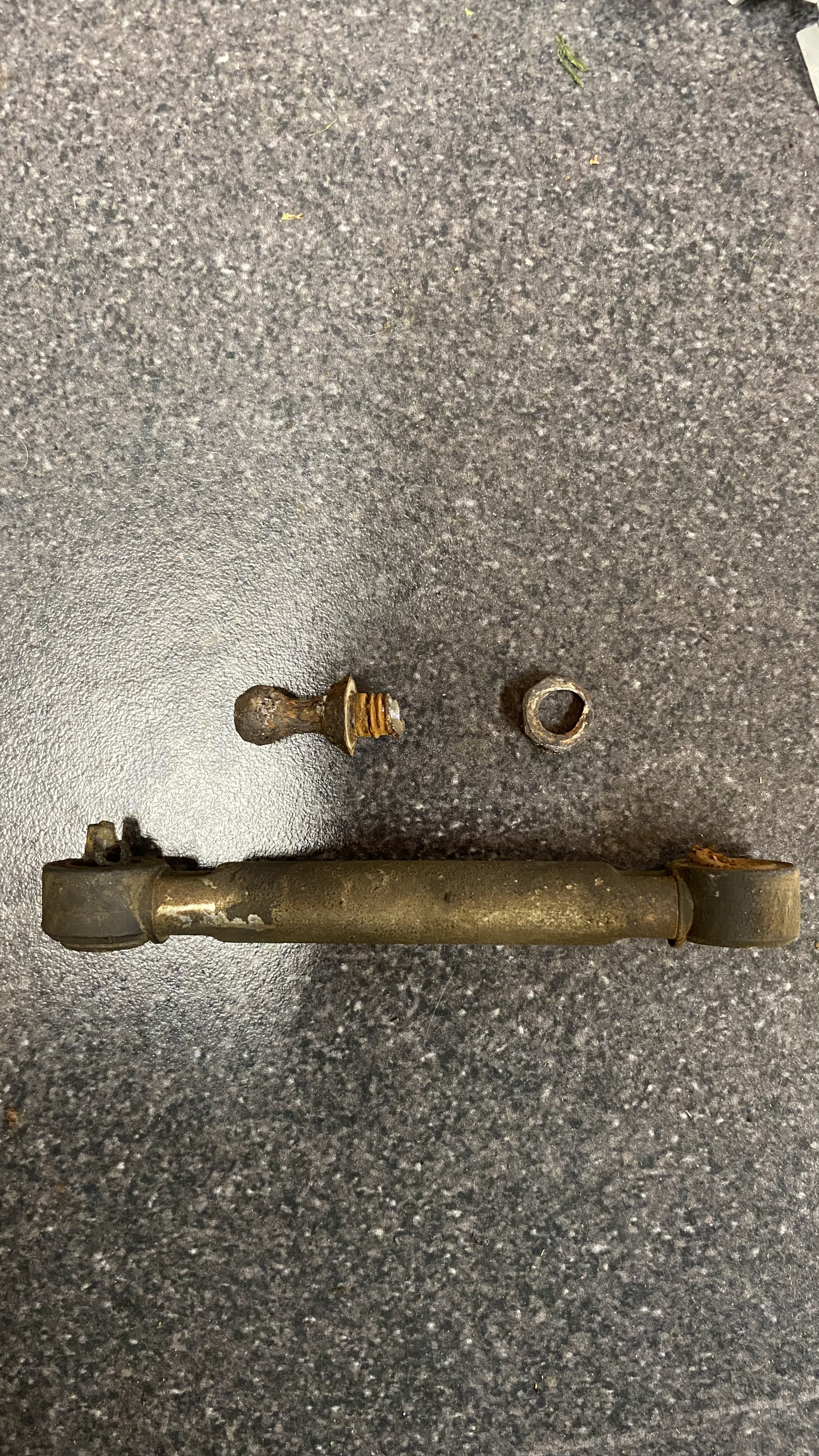

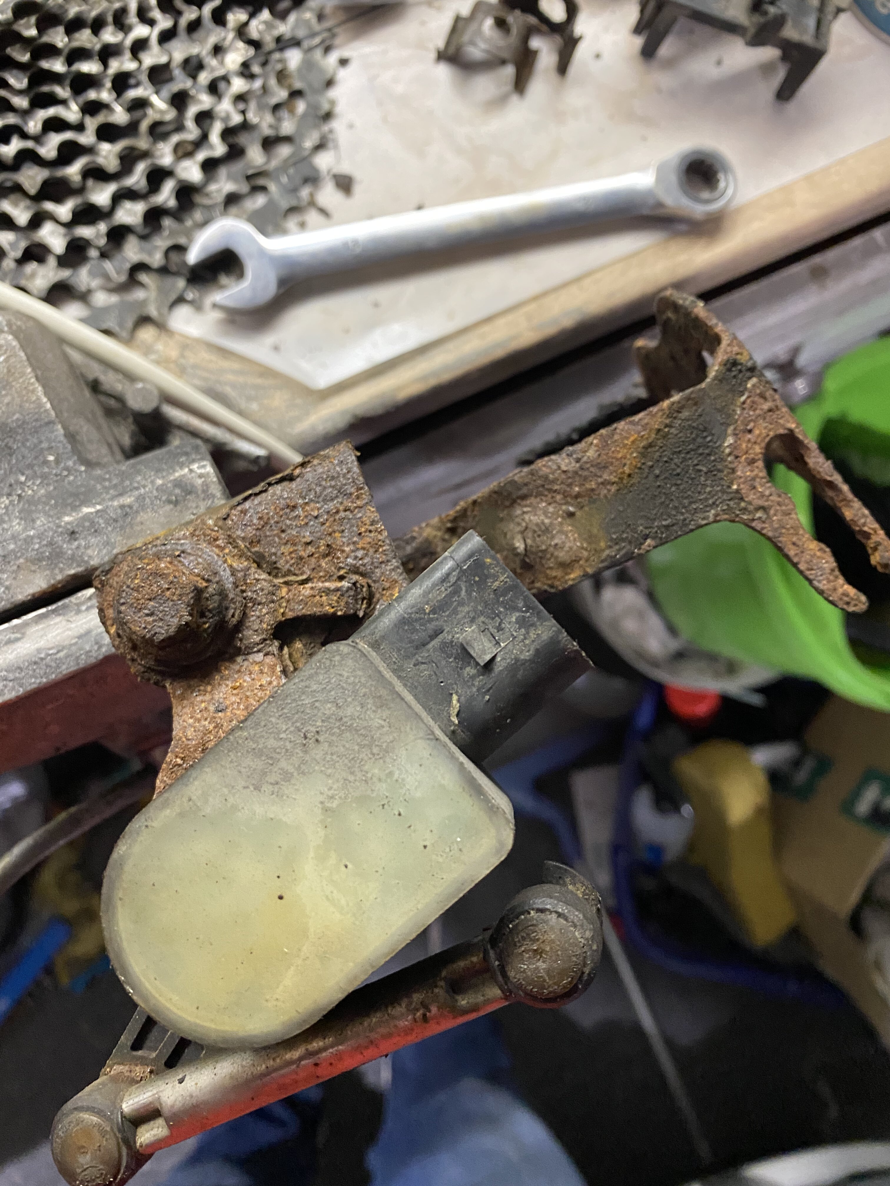

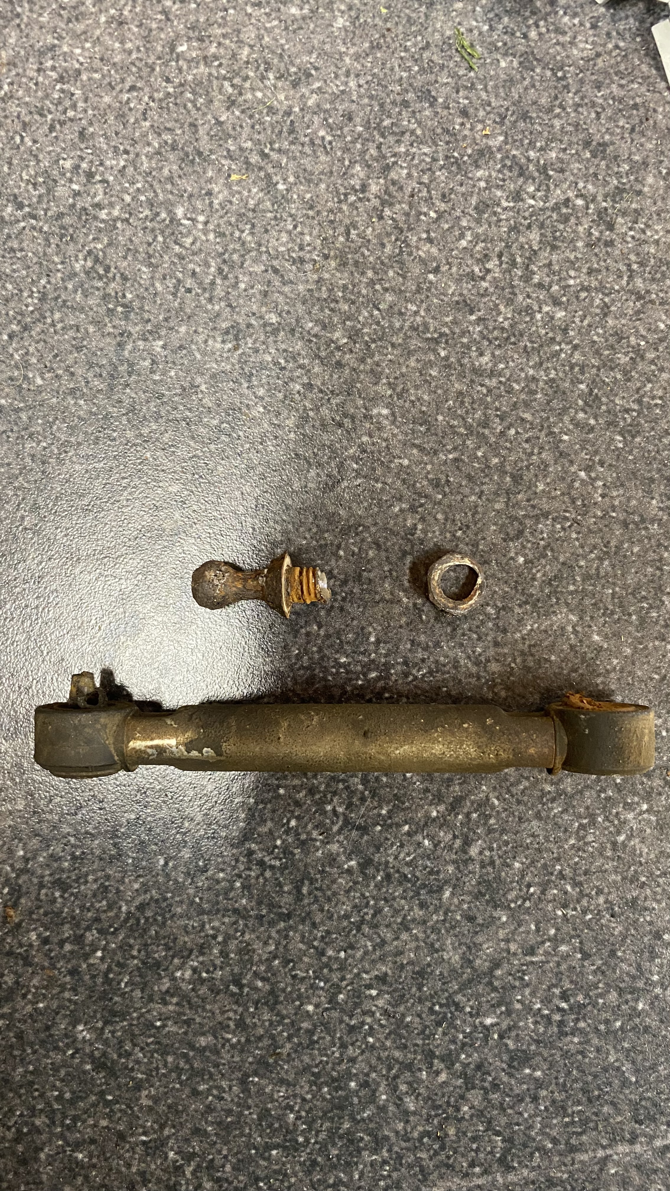

Those rear Xenon headlamp balancer thingy majigs are a precious commodity. Can't even get aftermarket ones now.
Horatio McAllister
Bon Jovi Officianado

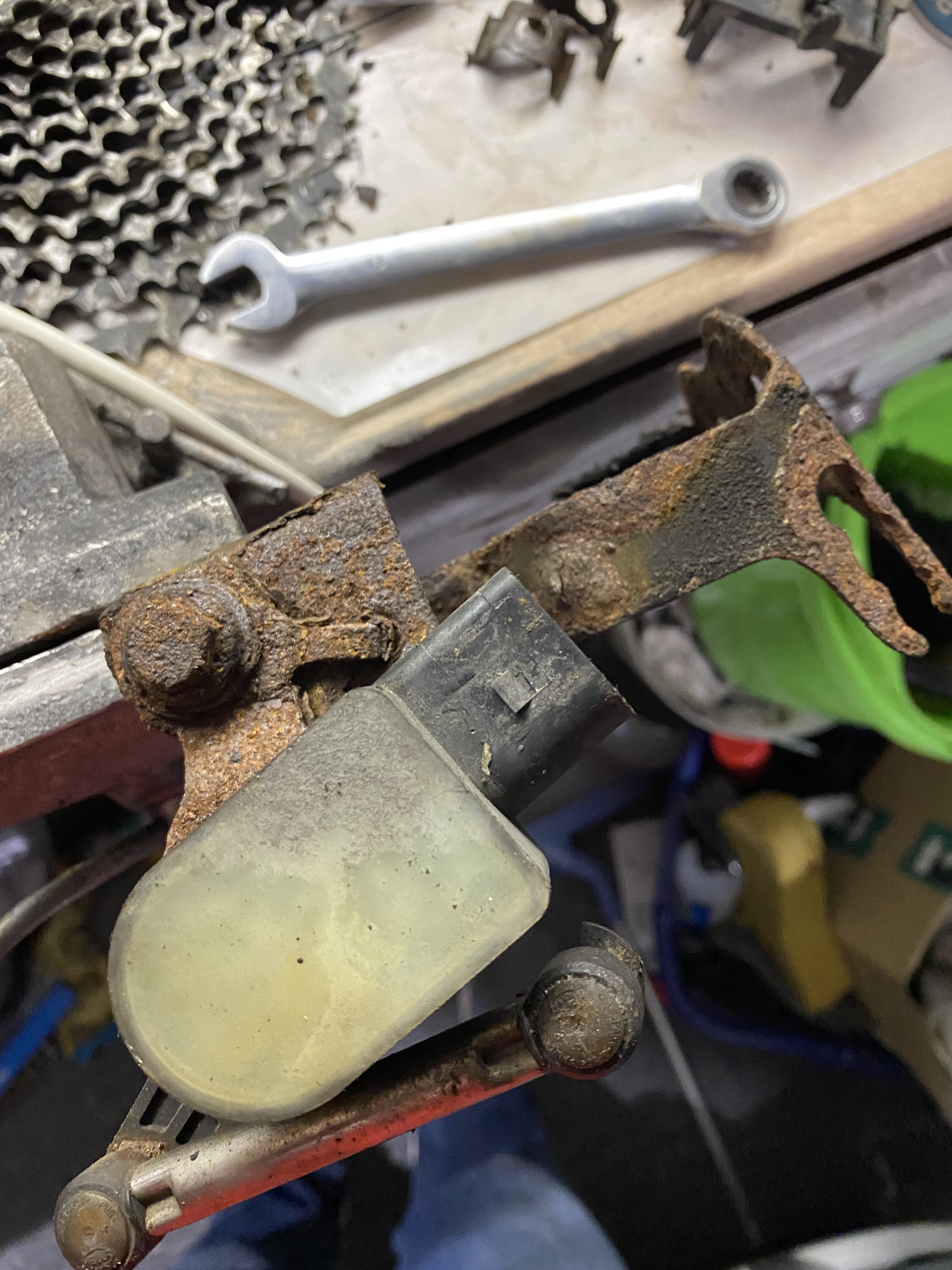

They are indeed, I cleaned mine up. The ball joint/pivot is a mess, so I’ve done what I can. I’m sure I could perhaps replace that part. But I daren’t delve too deep with it for risk of breaking the bloody thing
I know what you mean. Mine looked so fragile i didn't think it would last another year. In the end i took a deep breath, stripped it all down and it might last a few more years now. Beyond that it's life without Xenons.

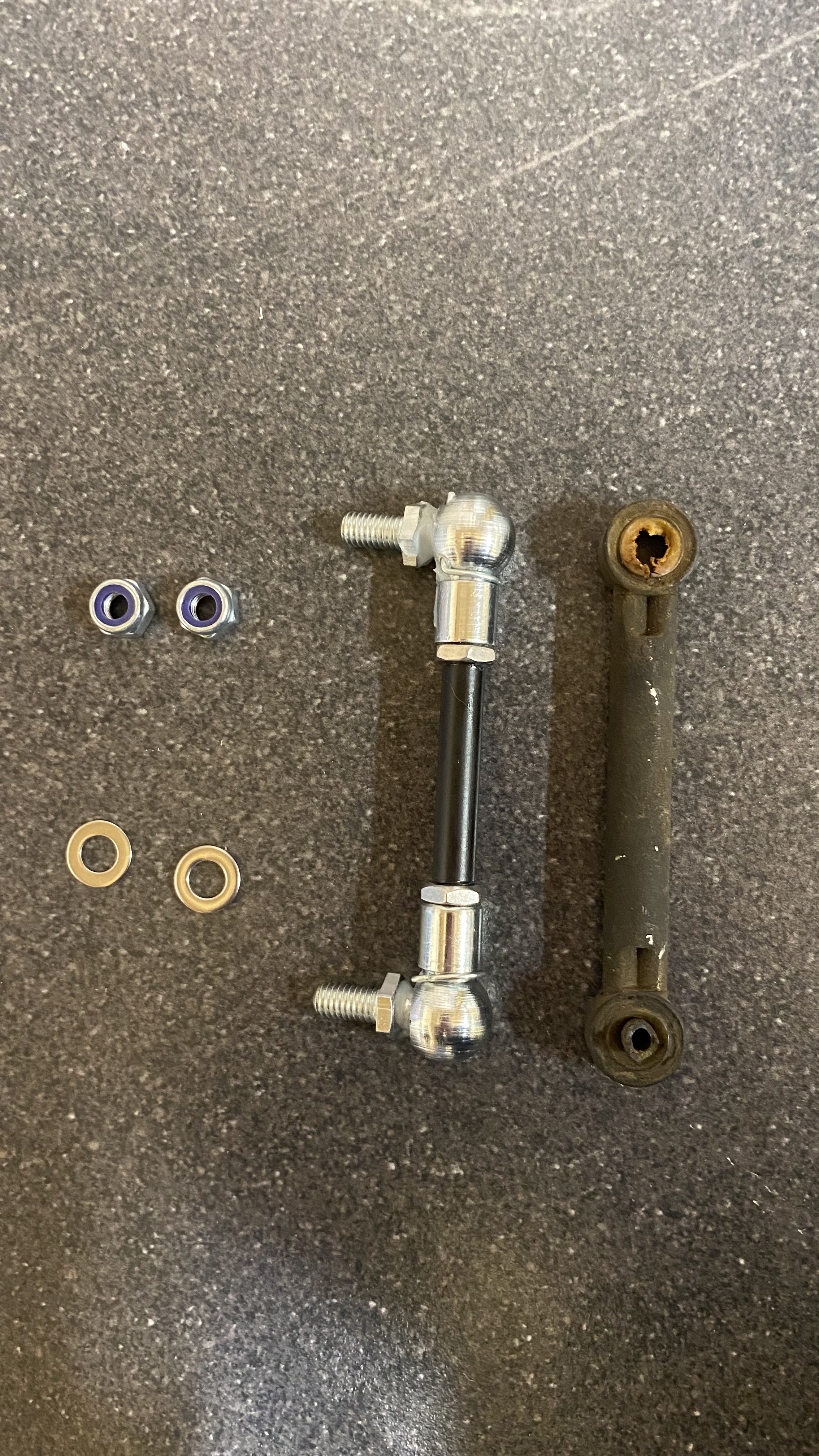

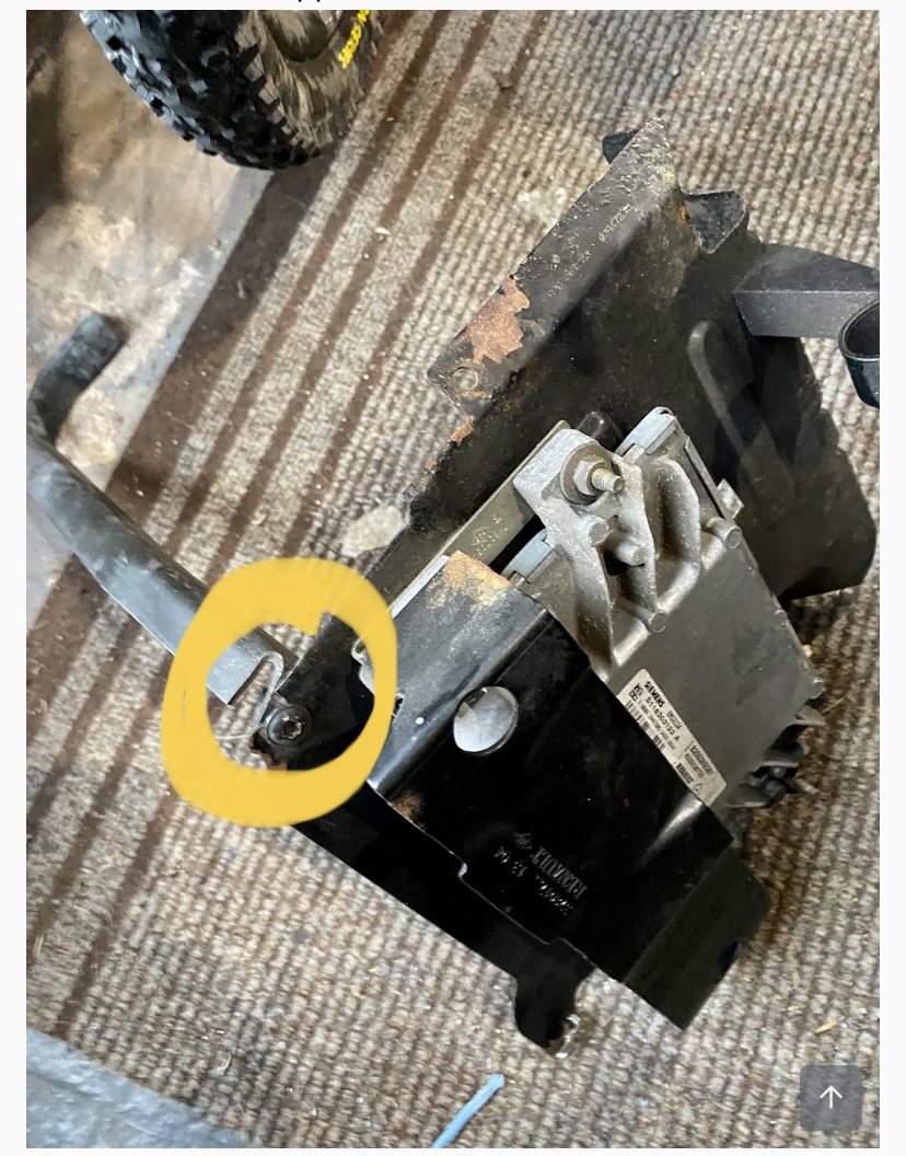

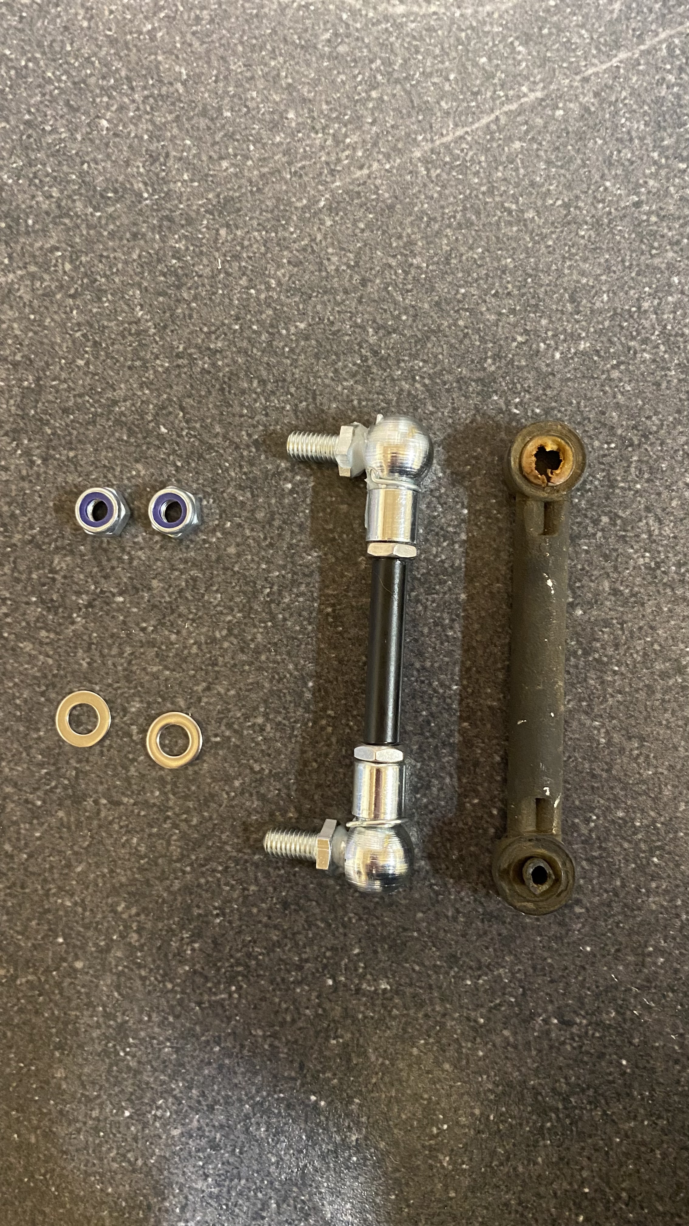

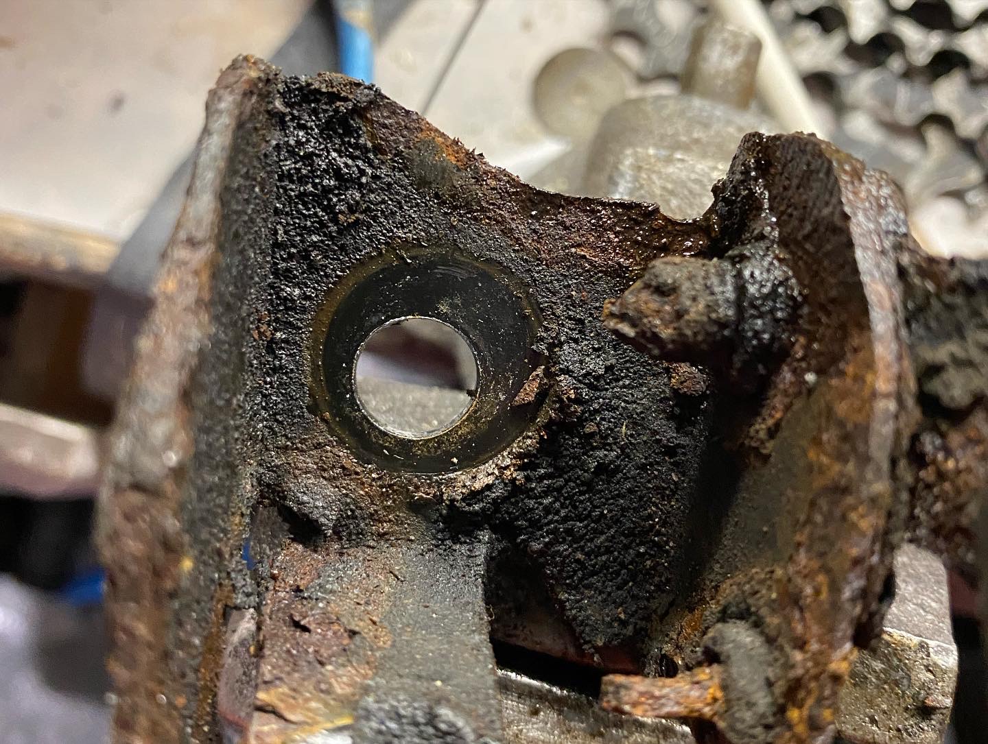

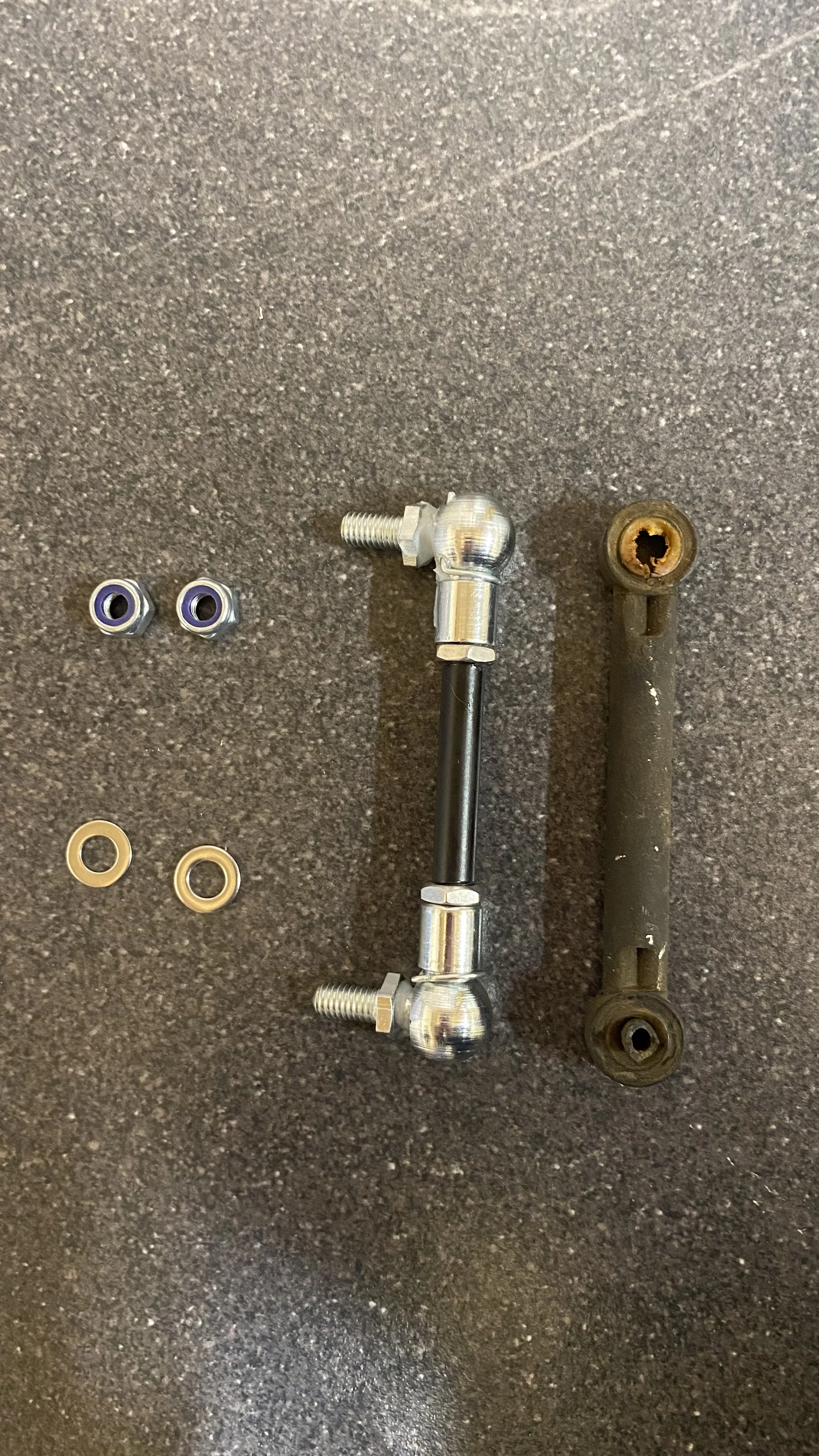

yeah those xenon level sensors are fragile beasts. When I did my axle bushes before Christmas, the ball joint on the axle had already broken off, so this meant having to drill off the ball joint on the level sensor:-
Then had to resort to an aftermarket solution courtesy of eBay; actually turned out to be a really nice bit of kit & a neat solution (I say this having not driven the car since fitting it, but it looks like it will be fine 😂):-
so just something to consider gents if you need an alternative solution at any point.
Thanks mate, to be honest I did think about drilling the existing arm out and making something similar. But to be fair I’ll run with it now until it breaks. But given I hardly drive it that could be years 😂

Sounds like a good plan; especially given I have no idea how long mines was actually broken for and didn’t notice any issues….but then again, I think I’ve average 1k miles per year over the last 4 years and can’t remember the last time I actually drove it at night 😂

Think it’s an MoT failure if the lights don’t adjust so it may have been a recent thing mate. To be honest it’s the least of my problems at the moment 😂😂

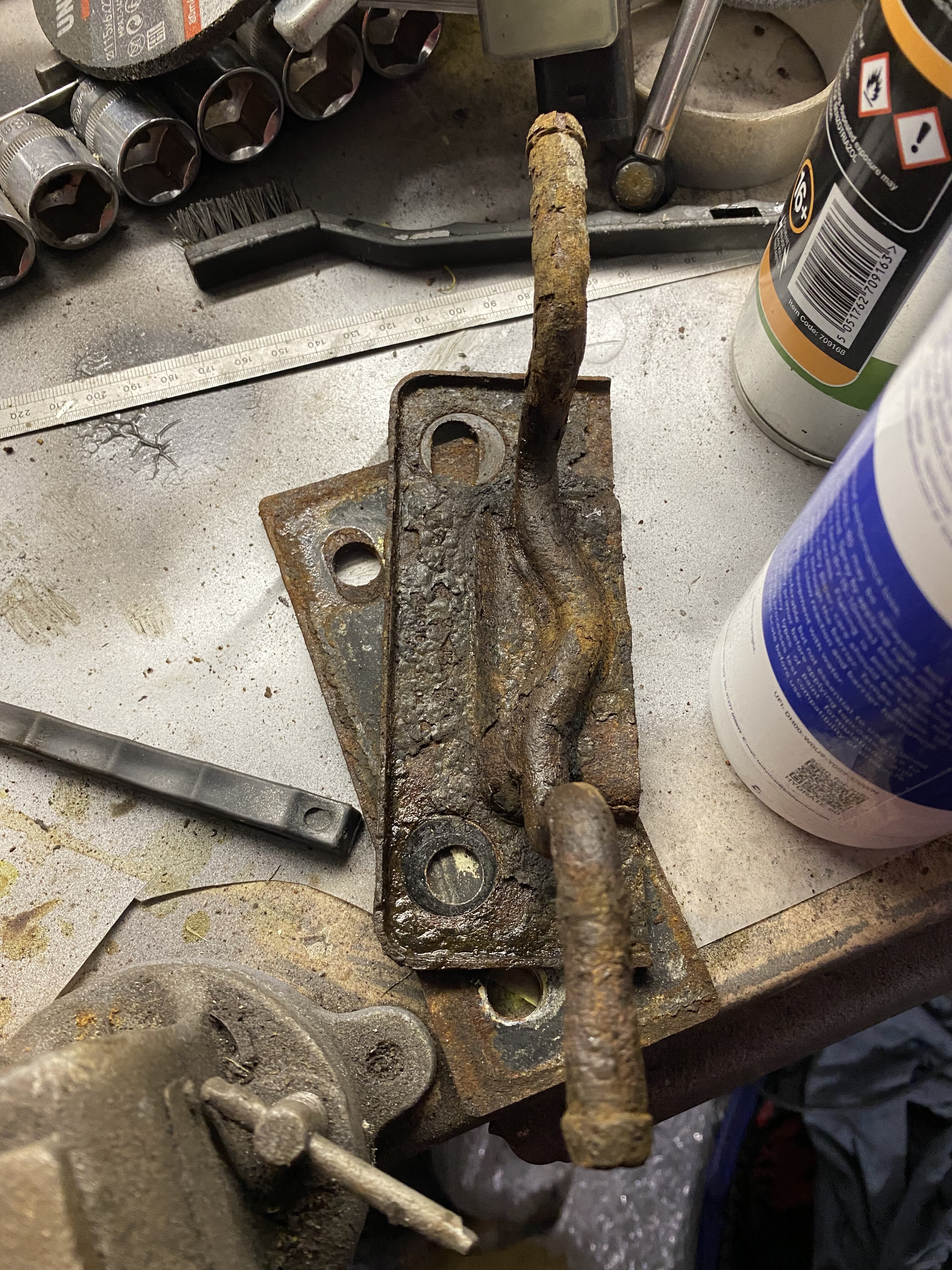

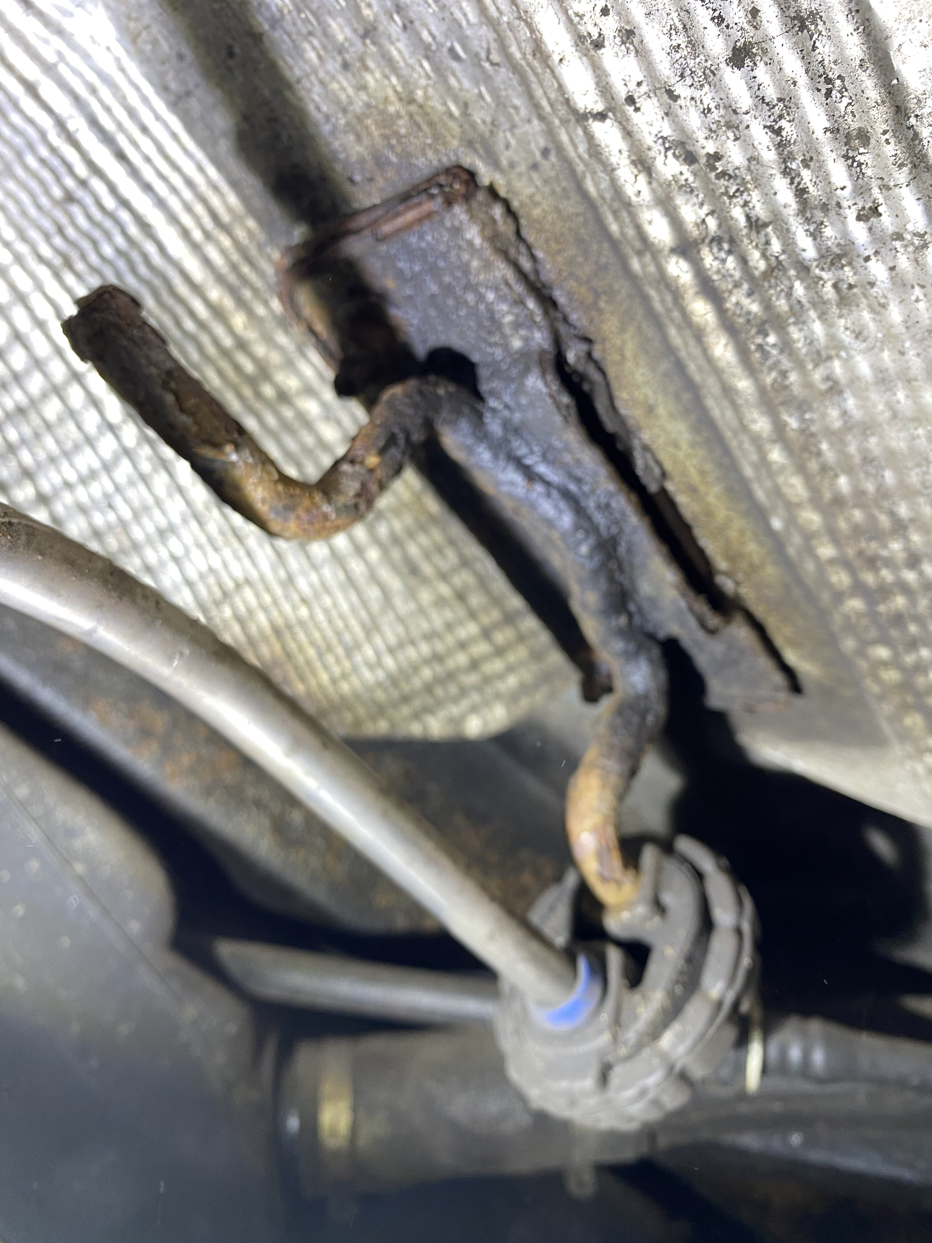

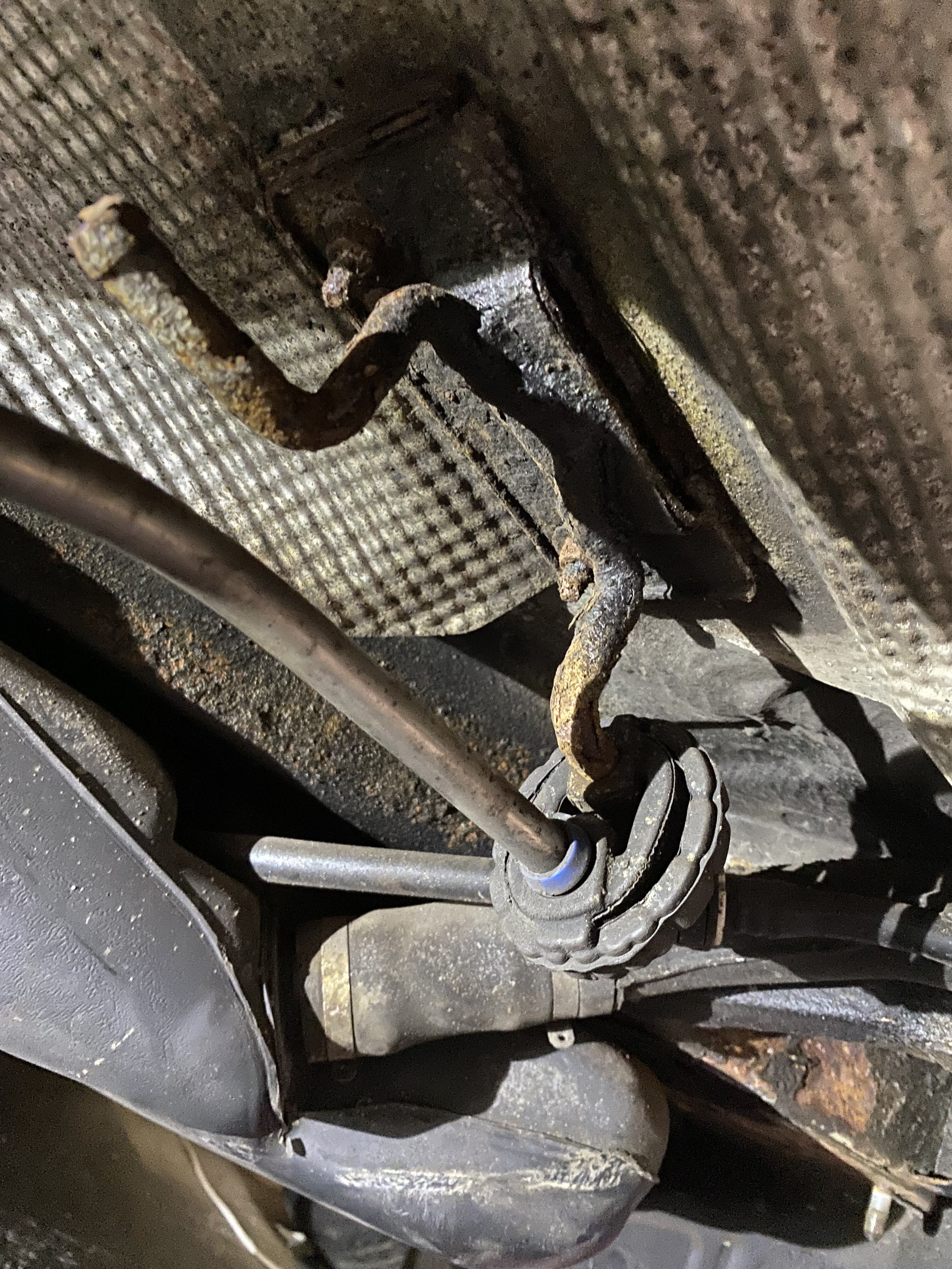

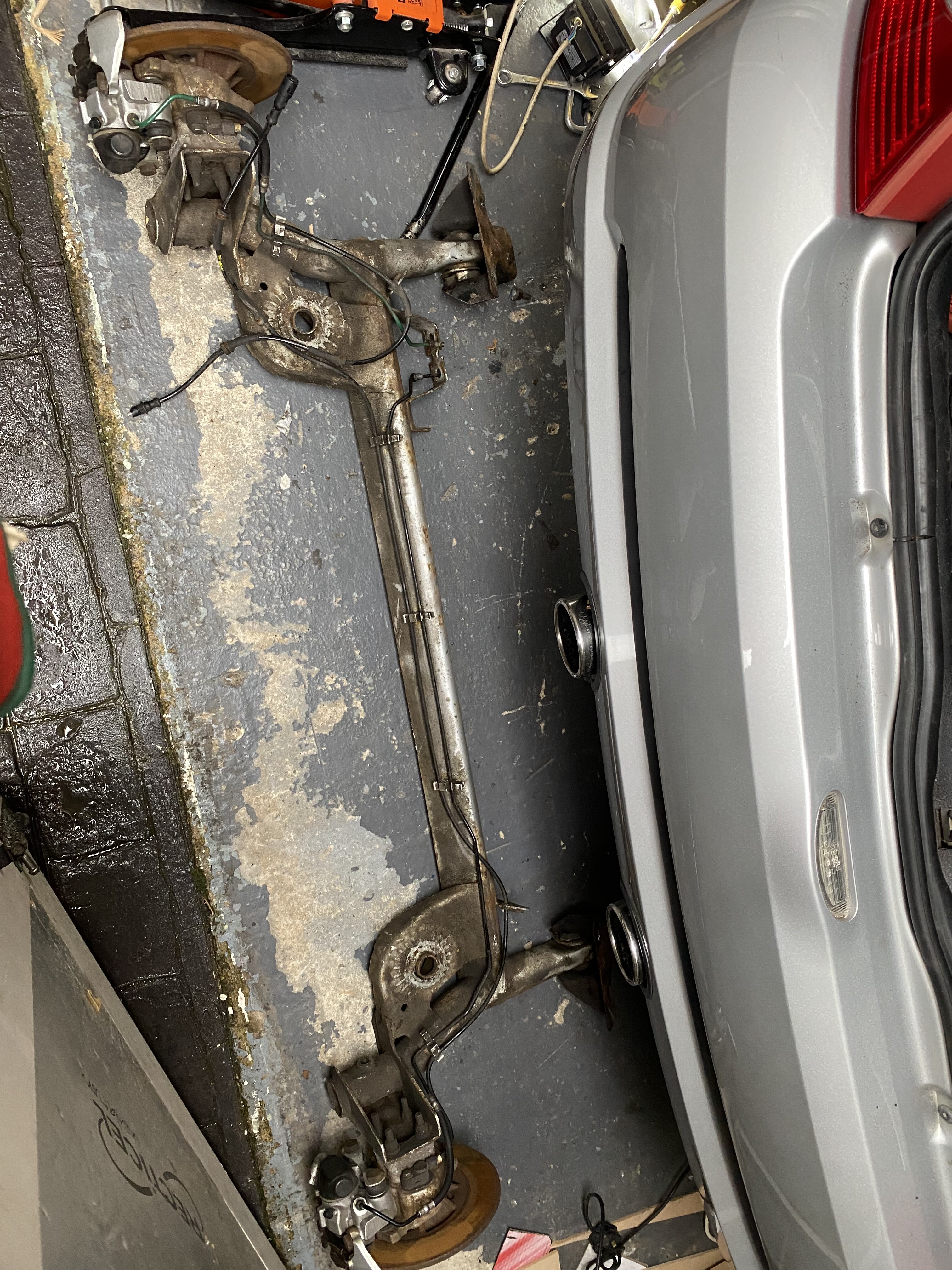

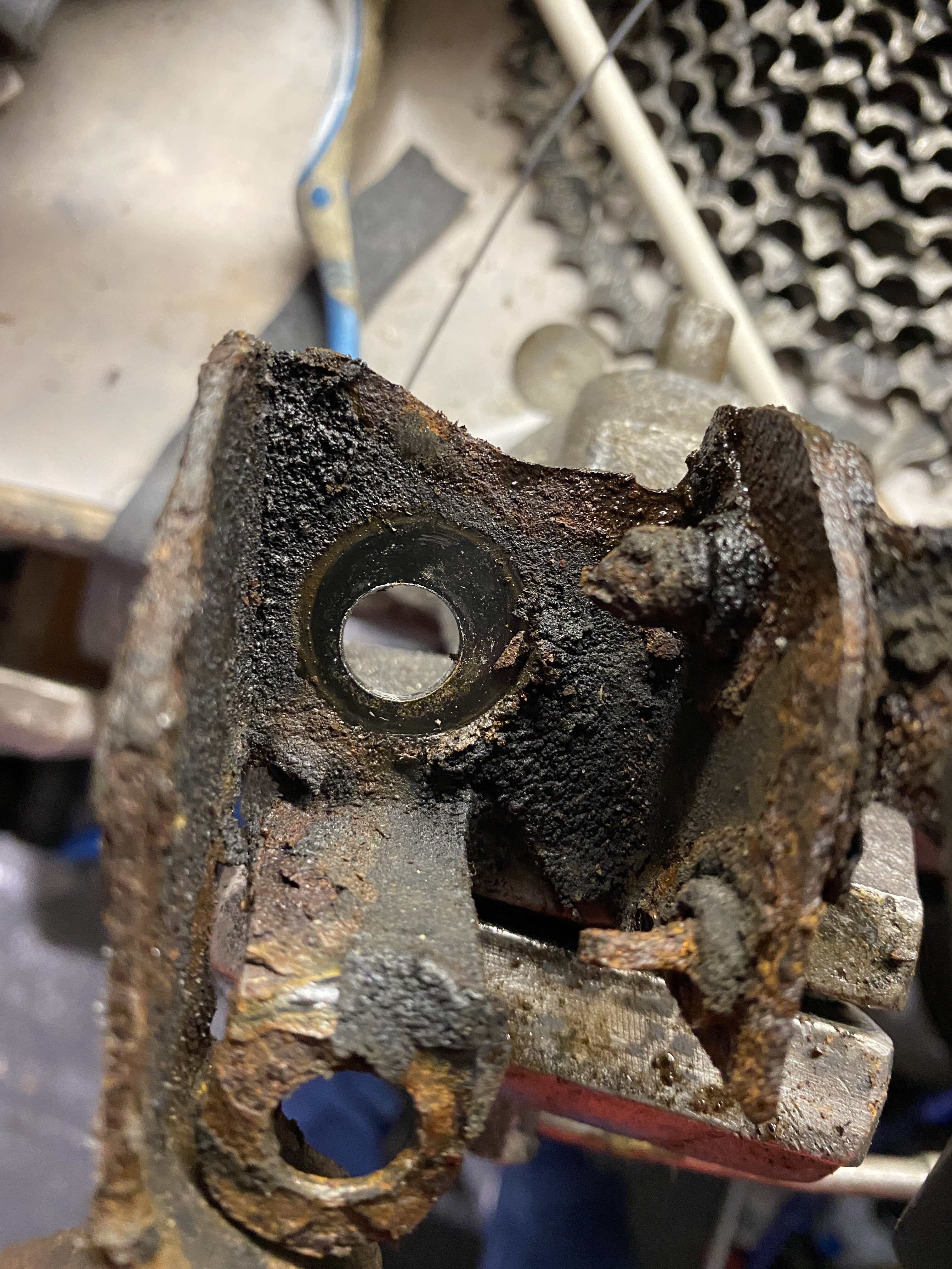

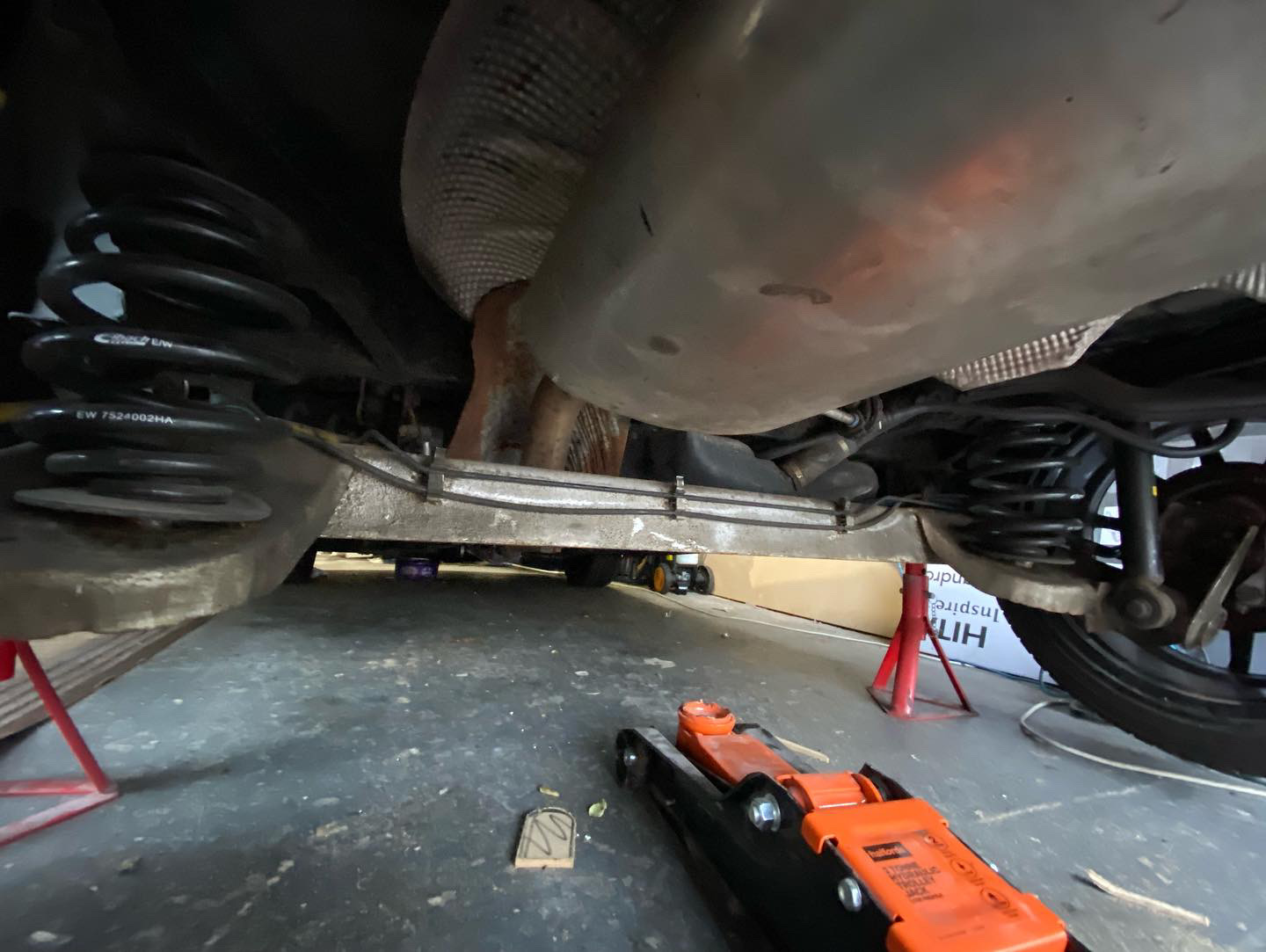

Old beam finally dropped, someone’s obviously rubbed it down and painted it with hammerite before! Also check out that crusty exhaust hanger! It gets worse in the next post
Horatio McAllister

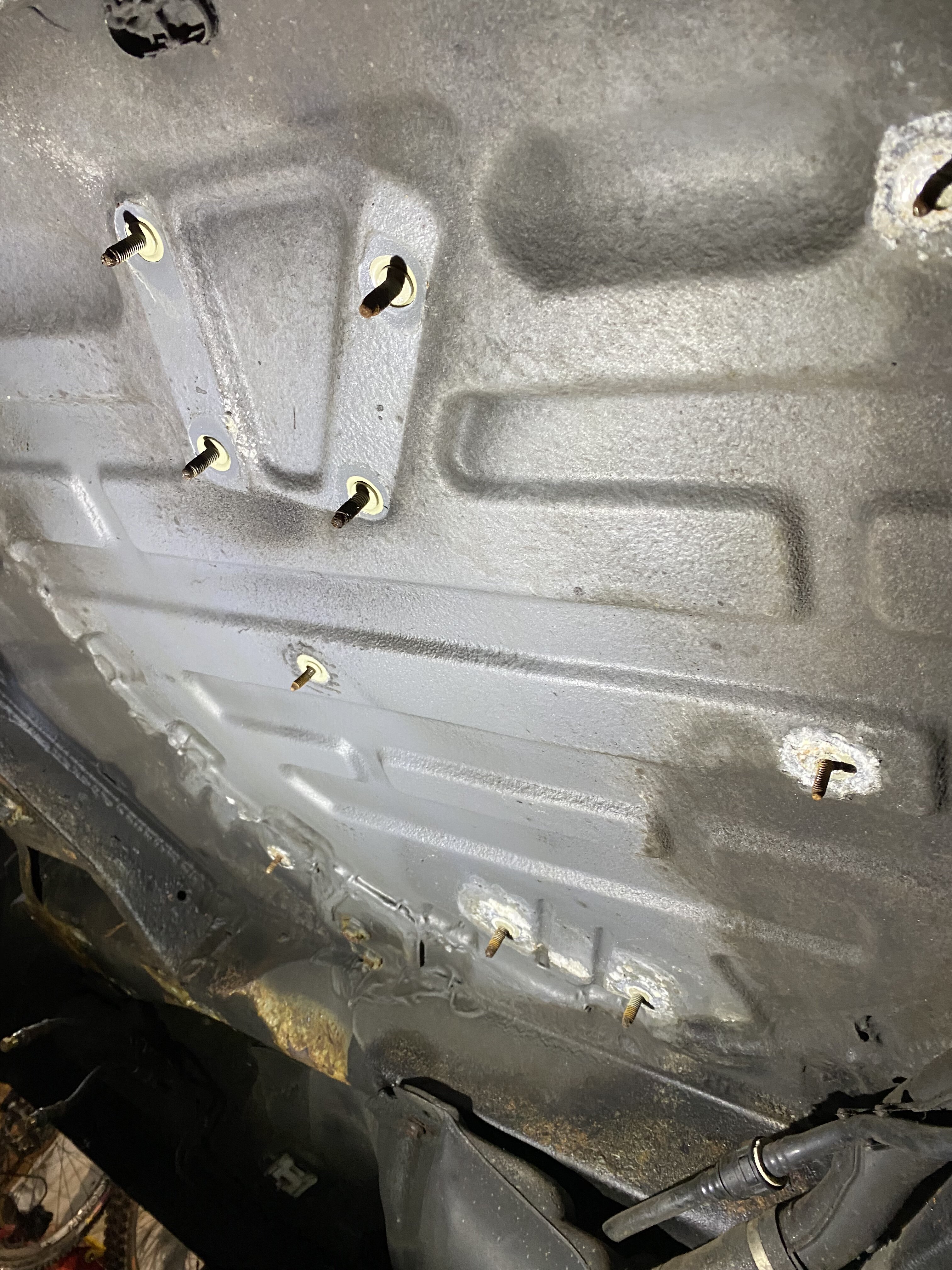

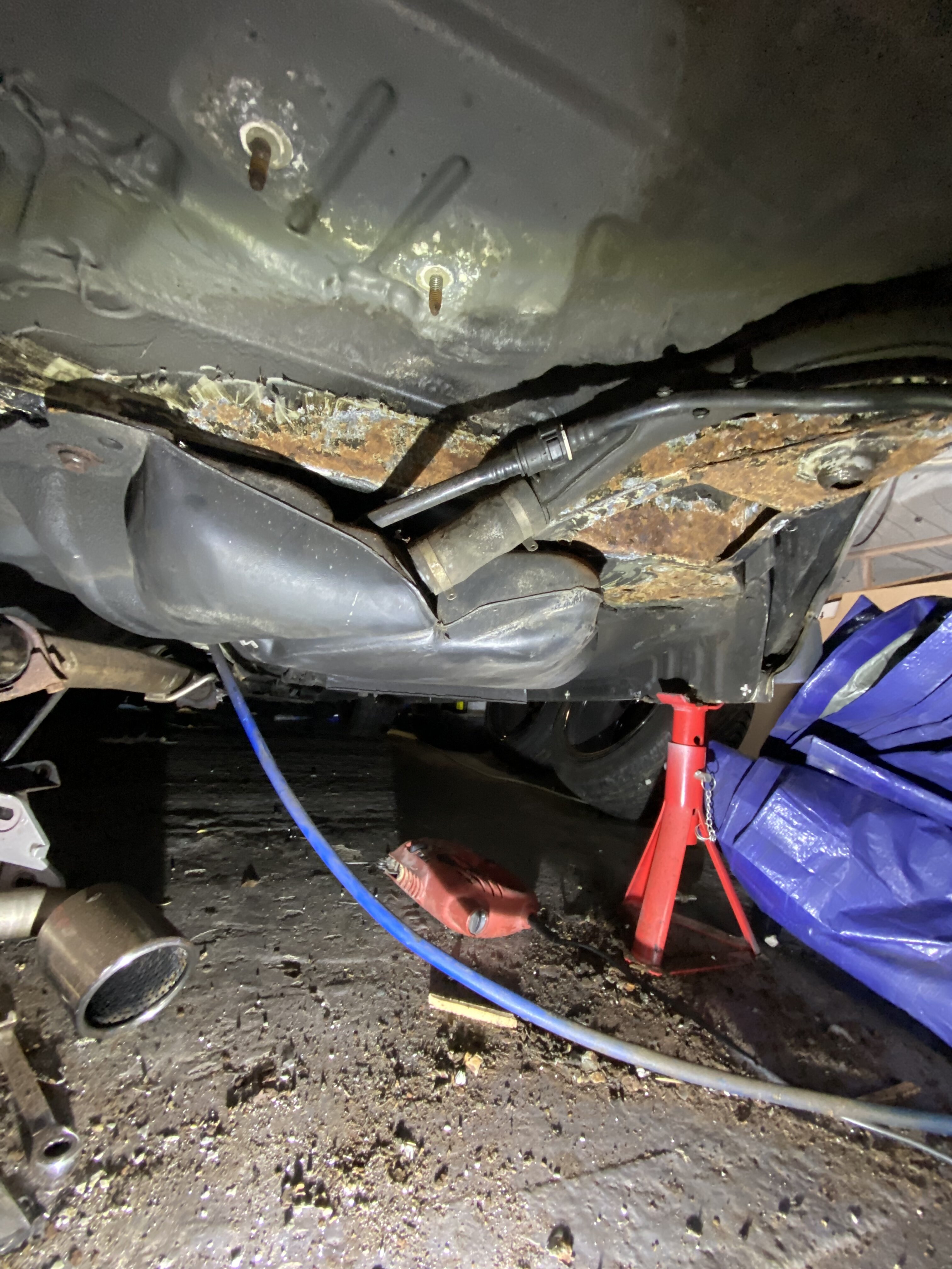

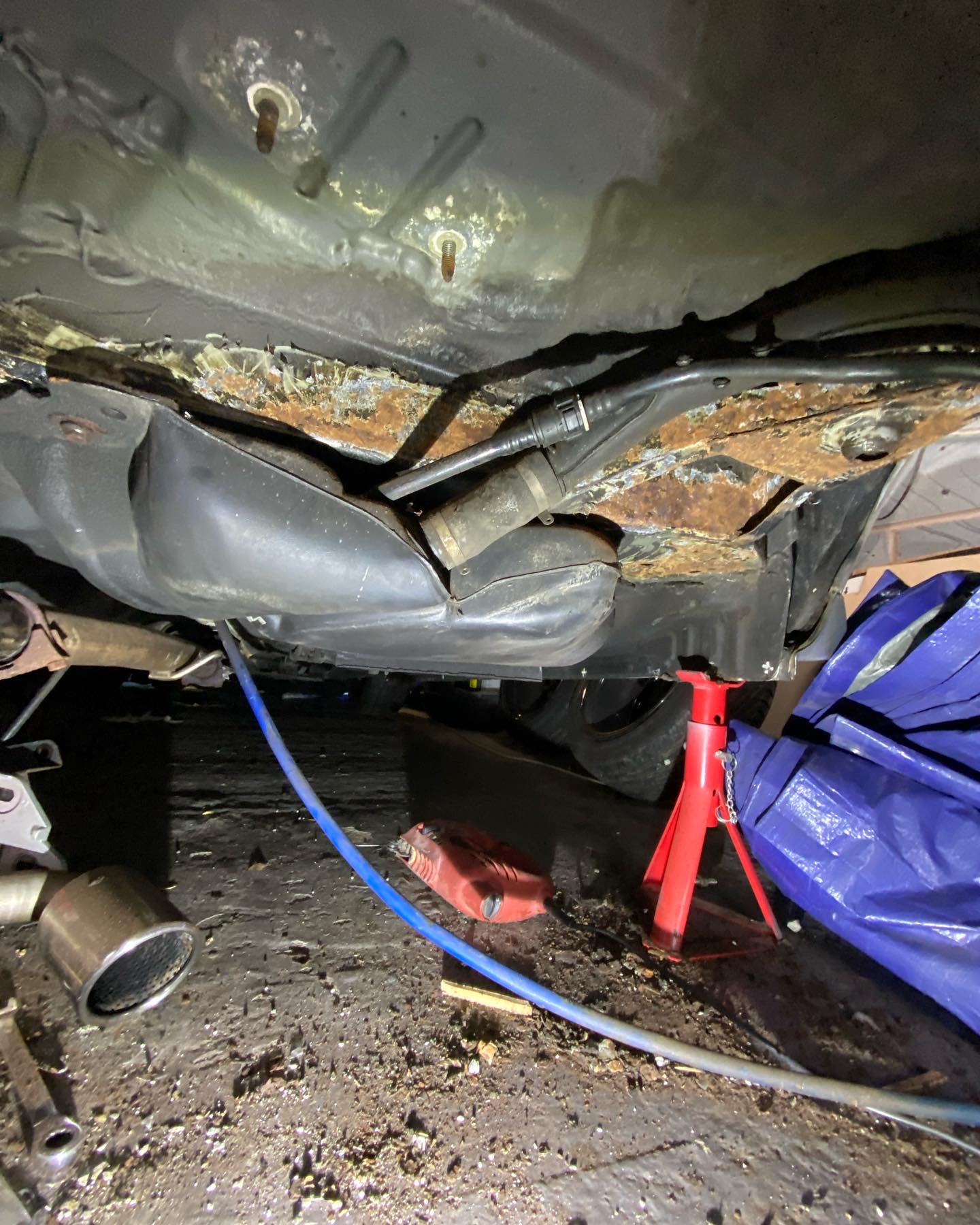

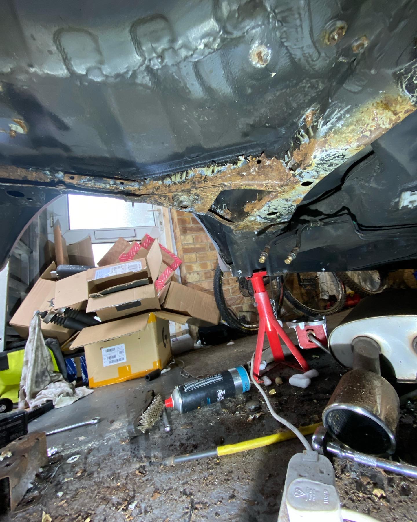

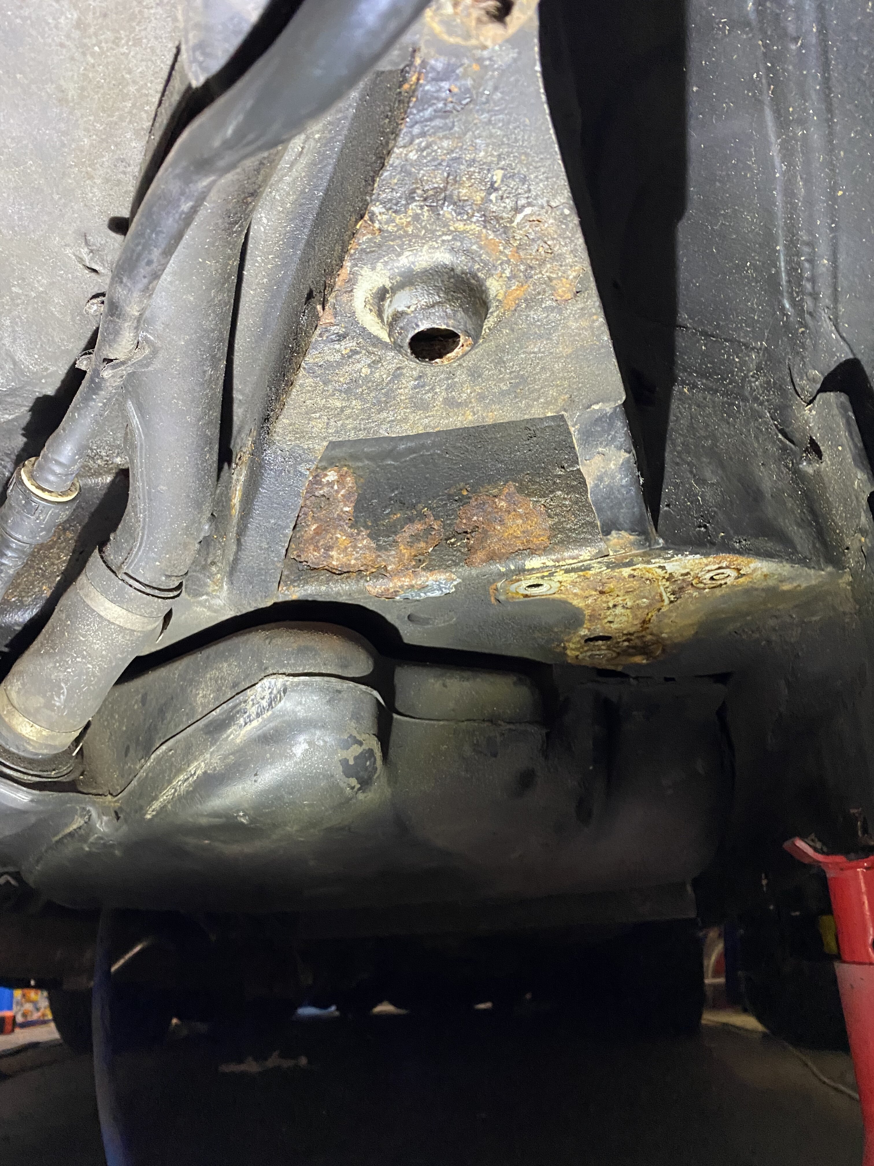

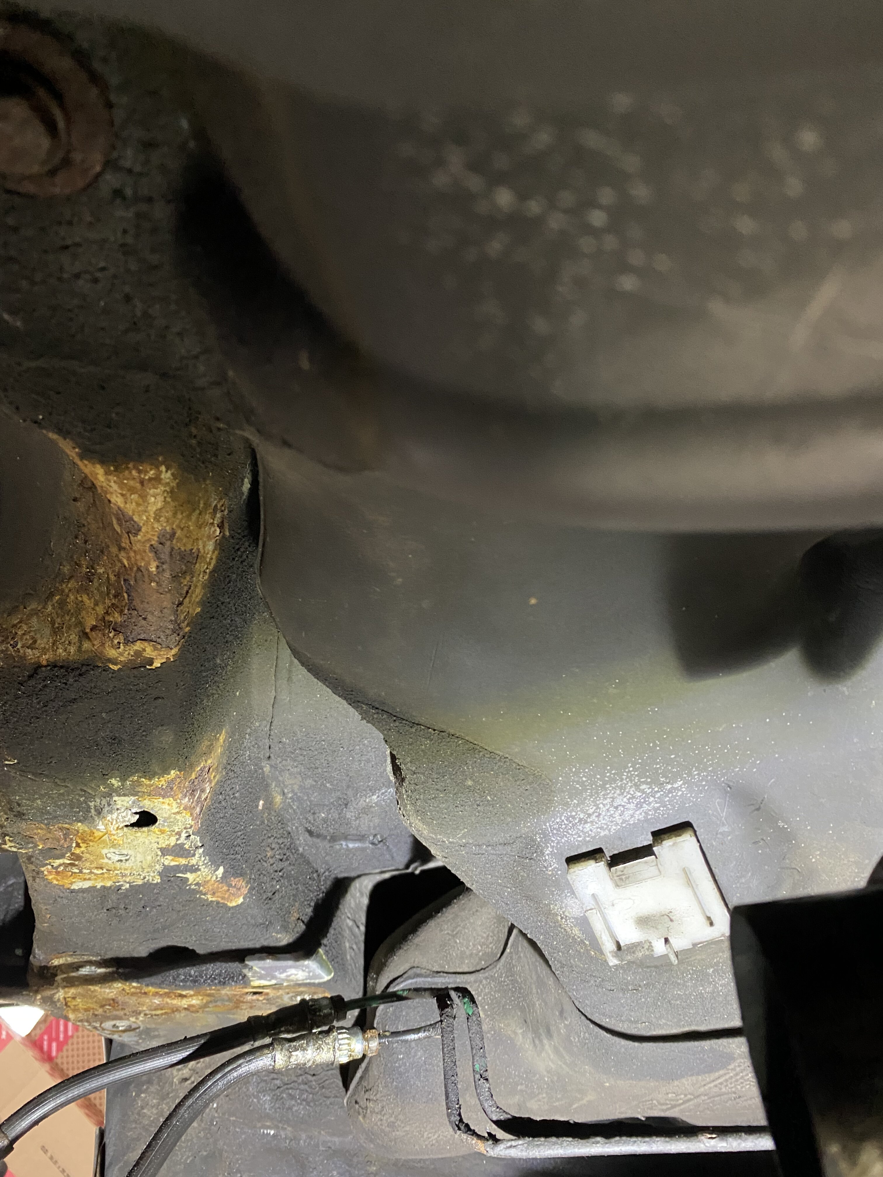

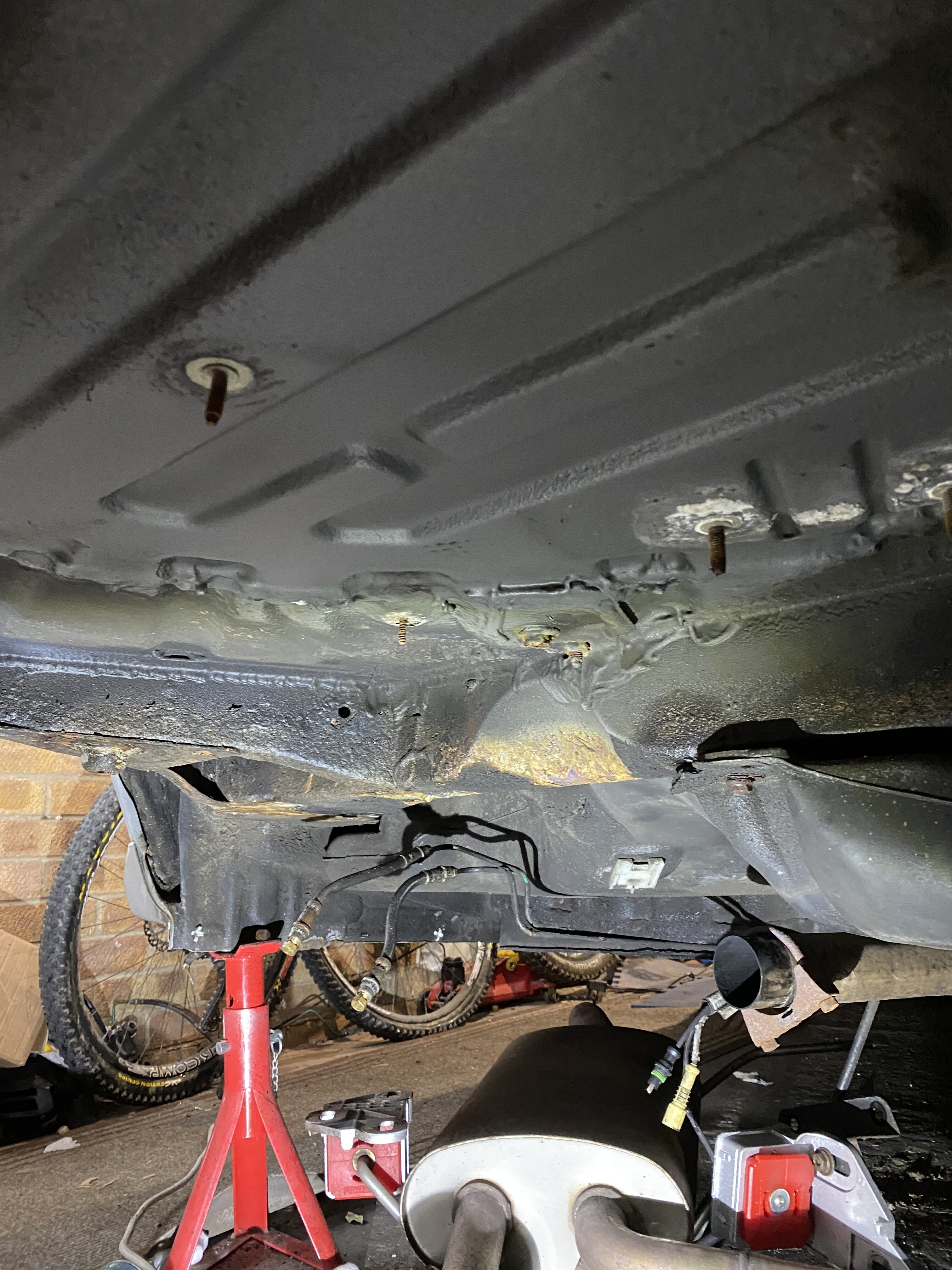

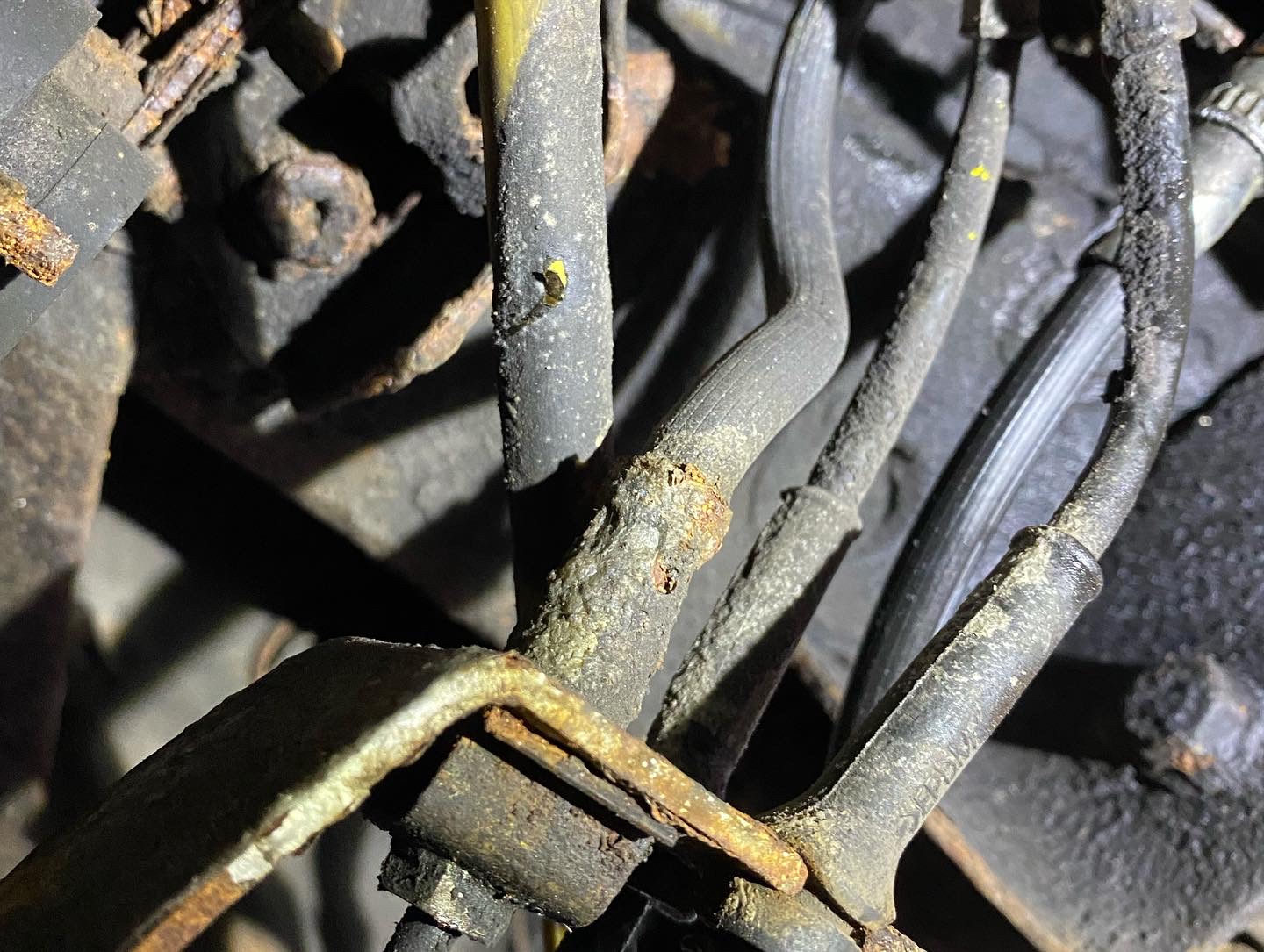

So just about got the underside stripped now. I need to drop the fuel tank really, as I can’t repair all the corrosion with it in the way, plus I need to replace the crusty bolts holding it in! So has anyone dropped the tank without disconnecting fuel lines etc. perhaps then swinging it forward out of the way? I don’t want to be angle grinding under the car with an open tank.
so after a prod around with a chisel scraping off surface rust…it looks worse then it actually is. Nothing structural, so no welding needed thank god. But it needs sorting. Another couple of years and it would be gone. I keep saying it, but please guys have a proper prod around your car. It’s amazing how much is beer the seam sealer and underseal.
View attachment 1580285View attachment 1580286View attachment 1580287View attachment 1580288View attachment 1580289View attachment 1580290View attachment 1580291View attachment 1580292View attachment 1580293
Me, an optimist, ignoring this advice and believing everything is OK
