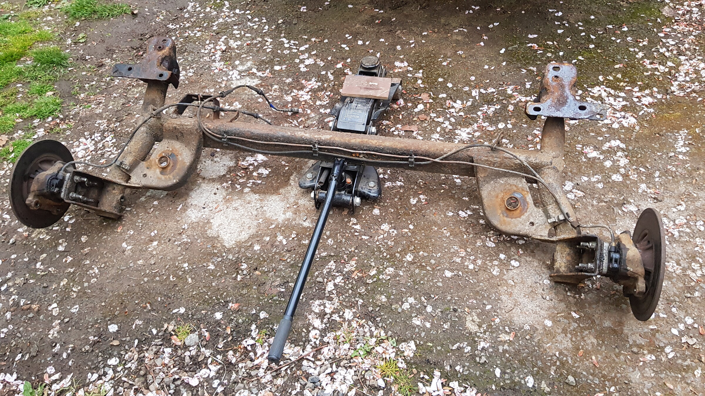

I've stripped off my beam and mounts to powdercoat but I'm wondering if it's too far gone, the threaded studs for the brakeline clips are corroded to thin barely usable spikes.
Is there a good solution to this or would I be best sourcing a better condition beam?
Dom, I was/am in a similar situations. I removed the clips today and mine are pretty much gone. That said when I started to remove the surface corrosion the beam looks to be salvageable I was thinking of drilling and tapping thw beam for brake line clips, possibly replacing the OEM clips with P-clips.
I would be trying to limit the hole size as much as possible. They are only hose guides. If you knew someone who was handy with a welder get them to replace the screws?
Only got a pic from before I stripped it down at the moment, it's quite pitted so I hope it wouldnt look a right mess powdercoated.
@RustyMojo drilling it and tapping might be an idea or I could tigerseal the clips onto what's left once powdercoated.

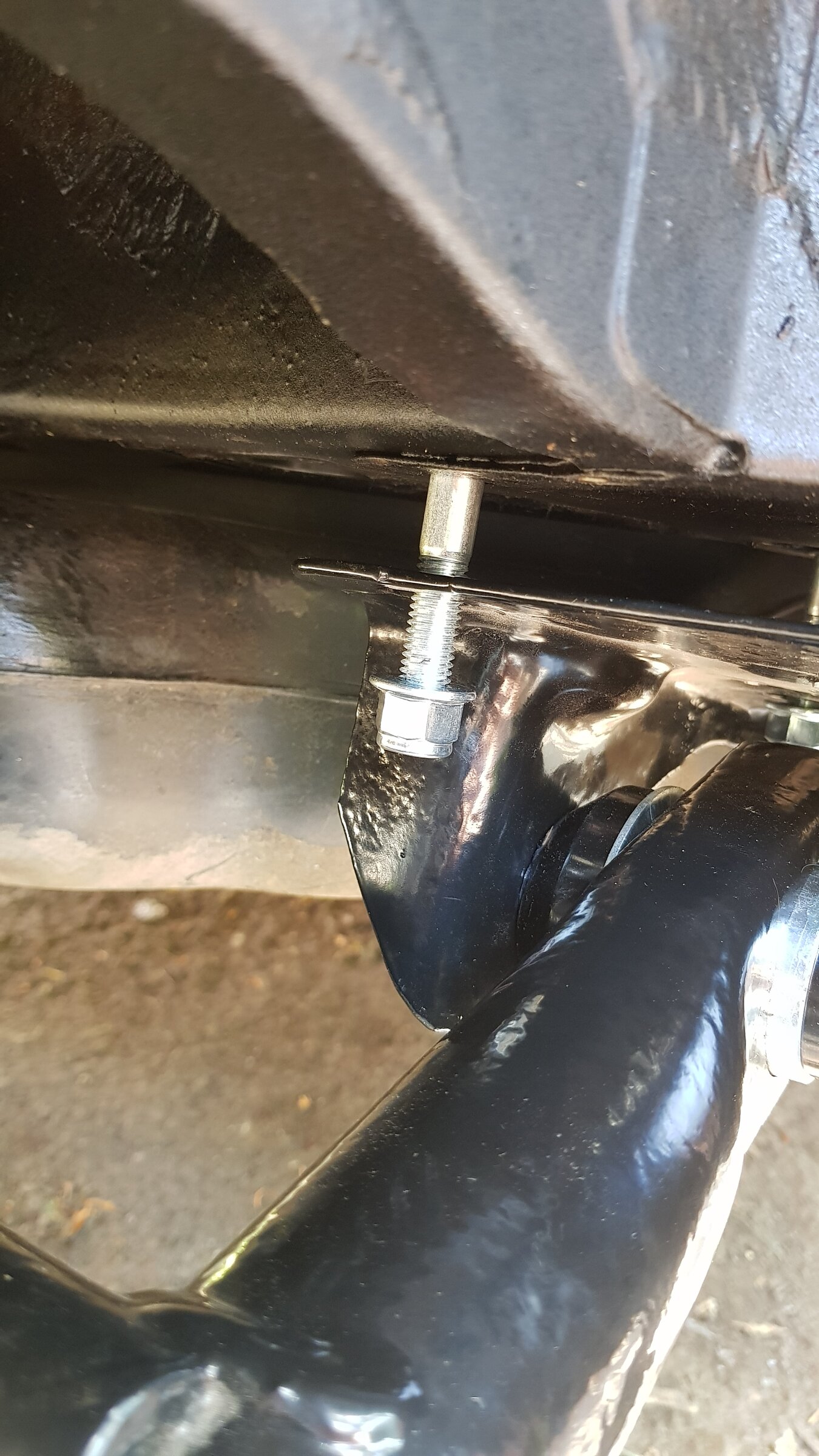

The beam came out well but the powder coat chipped on the inside face where the 4x stub axle nuts meet. Obviously cleaned up the other face where my spacers meet.
Whiteline bushes were a nice snug fit, just tapped home with a block of wood. I still think the Febi were oversized, no way were they going in!
I think I will order some 110mm m10 high tensile cap heads to replace the two longer bolts, that should lose the 15mm of unthreaded section.
