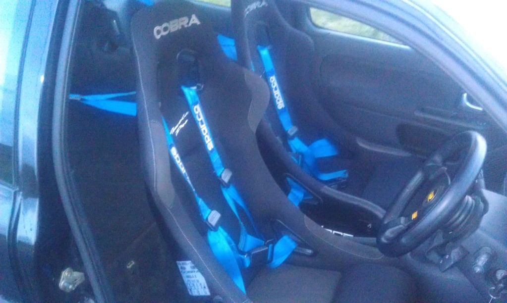

Cobra imola 2 seats, home made subframes
Sparco 3 point harnesses

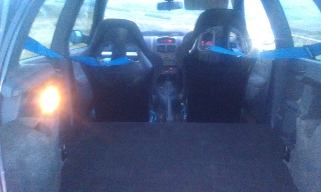

Car looks good. Love the last pic. Not sure about where you've secured the harnesses though :S
Same place I've mounted mine in my track car. The standard inertia belts mount, very strong and a good angle for the harness'.
I mean I have no idea. But seems like they would be at too much of an angle? And would tug a lot harder on one shoulder than the other under pressure?
