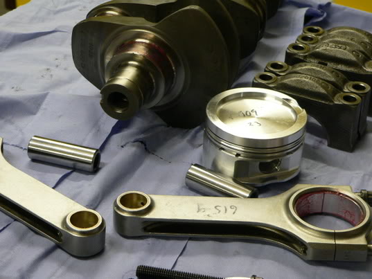

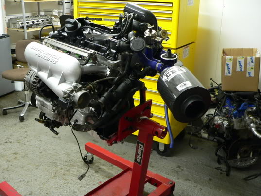

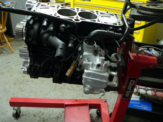

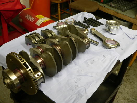

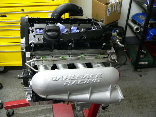

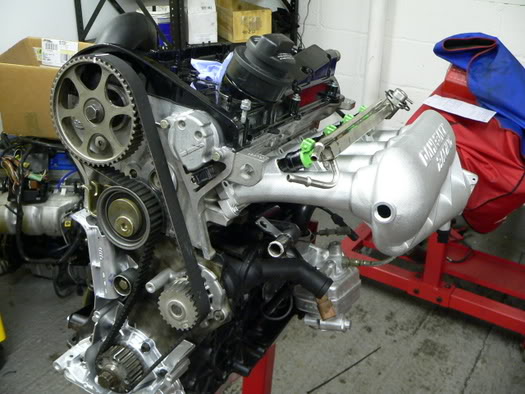

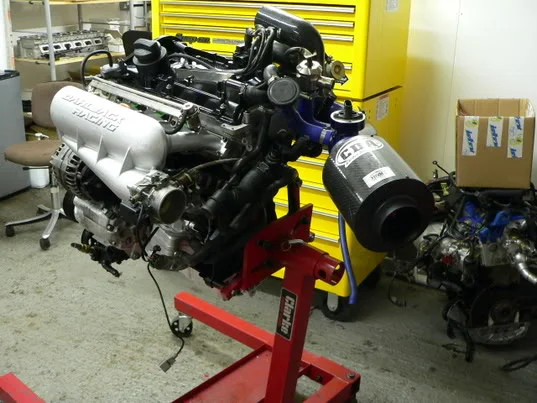

Audi S3 engine
2.0ltr Kinfe edged Forged racing stroker crank
Forged Rods
JE Forged Pistons
Blueprinted
Gasflowed head
Shrick cams
GT2871RS Rollerbearing Turbo
ATP exhuast manifold
Dailback Racing inlet manifold
Omex 600 managment (with antilag if you want to)
Fully balanced
estimated power is 400+ bhp
Zoom !!
When you say blueprinted .. do you mean you followed the manufacturers original engine blueprint ?
blueprinted
all parts and tollerances have specific performance specs... these are followed.
ring gaps
piston to bore clearance
etc
etc

Is there any problems with the tranny or Haldex with the power that will be pushing out?

^^Working in the kitchen again andy? Kitchen table and chairs.
Sounds like a superb spec that.
Just a question though does running the stand alone ECU present any problems with the all wheel drive or anyhting else?
Also how come you've gone down the stand alone route I throught the stock ECU had been so worked upon now that the stock setup could be remapped much cheaper than a stand alone setup would cost.
its going in the dyno cell, so its much easier to work with that way... its not actually costing that much to use the stand alone.....
it wont cause any problems with the haldex.
AJR, yup.... its the kitchen.... well i eat most of my meals there so i guess...
i was up there the other day & saw this beauty!!!! Awesome is the word that comes to mind lol 400+ bhp in an S3!!! i wish it was mine!!! oh & yoz i think if i remember rightly it's going in the blue one, correct me if i'm wrong andy.

can i just ask what the total cost is going to be mate and would that really fit into a clio!! By heck that engine is capable of alot of va va voom
fitting into a clio is a large ish job.... its been done and I was talking to matt about it today..
we are going to offer the conversion as that would sit well with our work...

costwise.... really depends on the build spec.... this one is high spec..

Whats the standard output for this engine then?

early S3's put out 210 ish ... then were upped to 225. The 1.8T was offered by vag in tons of forms 150,167,180,190,210, 225 .....
