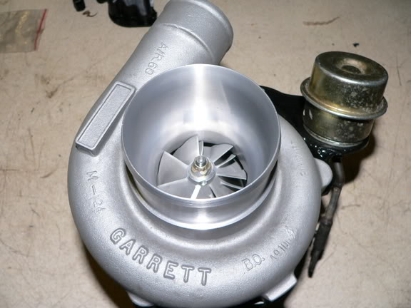

Andy GDI said:turbo was not what the customer thought it was (we did not supply the turbo)
and we found it was not a large as was needed for the right power.. (too small on the turbine side) the trim spec of the exhaust side and housing were too small...
so we are off to get a better matched turbo on monday, we are getting one made to spec to suit the engine.....
the trim levels suggest a limit of 350 bhp, the new turbo should see 420!!!

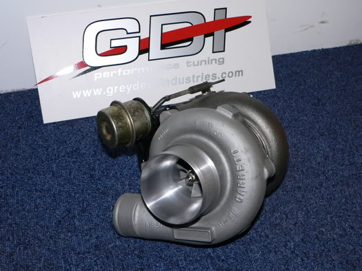

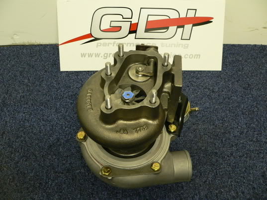

Andy GDI said:new turbo today..... had it specially made to suit this applications..

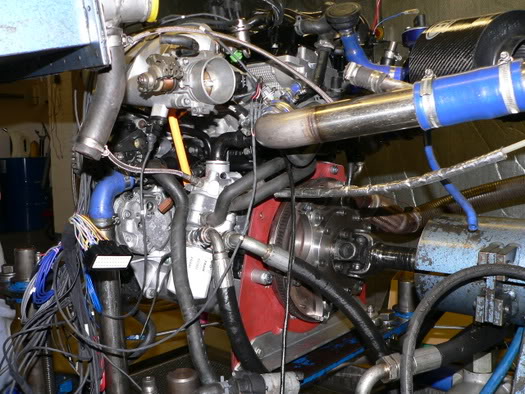

Andy GDI said:power at 1.35 bar is 389bhp.... then we broke the dyno... so more to come
