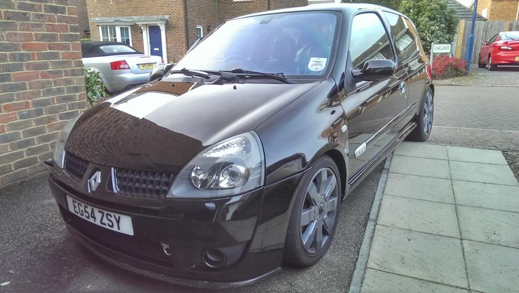

Little update of purchases! Thoroughly cleaned the car over the weekend, it is immaculate apart from a Tiny carpark dent on the rear quarter!
Have bought new inner and outer track rod ends, hopefully to be fitted next weekend.
Bought the 3M headlight restorer kit which will make the front end look 10 times better!
Genuine rear dampers which I hope will stop the oversteer I am currently suffering from haha (should really buy shorter ones)
I will be updating this post with photos once I get the chance to and as I have now driven it more there is a lot more I am going to buy for it!
Since my last post quite a lot has been done! New induction kit, new tow eye, cold air feed, new spark plugs, solid engine/gearbox dogbone mount and new rear dampers.
The headlights are now immaculate after using the restoration kit and the car has had a thorough clean (claybay, polish and wax).

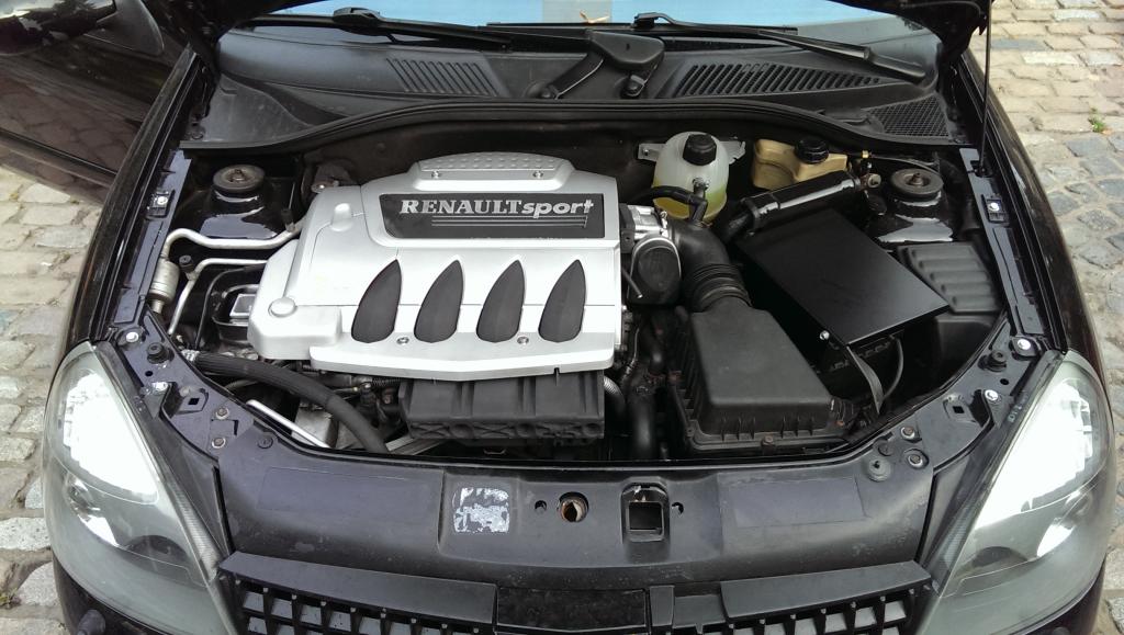

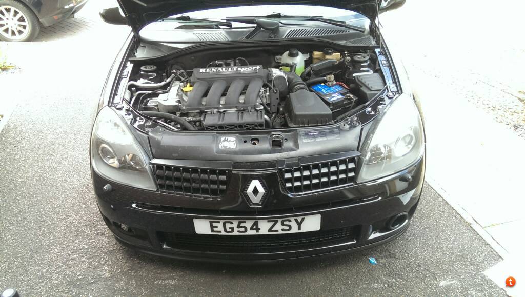

Cleaned the engine bay a little bit. Going to do a coolant change soon and I will be replacing the coolant bottle at the same time.
As you can see I have replaced the foglight with a cold air feed which goes directly to the new Induction kit.
In the background you can see my ongoing project.. But the Clio is kept very clean and there is still so much to buy for it!

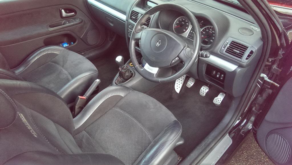

Interior is very clean, Just need to replace the Thumbgrips on the steering wheel as they have fallen apart..

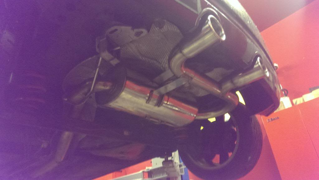

Anyway, time for some noise! So I have now got a Yozza sport exhaust, I fitted it this evening and wasn't "man" enough to fit the decat! But sounds great anyway, although I have a coolant leak which has meant I have not yet given it a blast with it fitted.
Some photos of it!
All fitted!
Sounds fantastic, just to fix the coolant leak and take it for a drive!

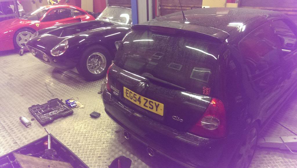

Okay on Sunday I put my car back on a ramp as I suspected I had an exhaust blow. In the end the whistling came from the induction kit! All fixed now :D.

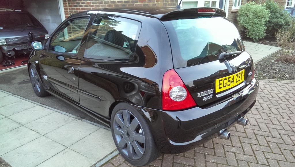

Took a few photos while it was looking a little dirty on Sunday. The front splitter is really in need of a respray now!
Hopefully going to get the wheels refurbed soon, due to paint chipping. I will be buying the proper floor mats and hopefully managing to find an ecu bracket (I never noticed it was missing.)

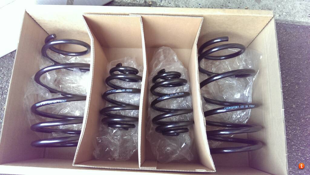

I am finally getting rid of the raceland coilovers that are on it at the moment. Just ordered cooksport springs, awaiting to order all standard cup suspension and some other suspension parts.

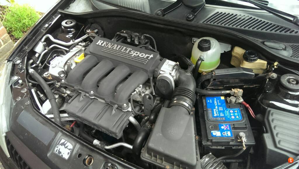

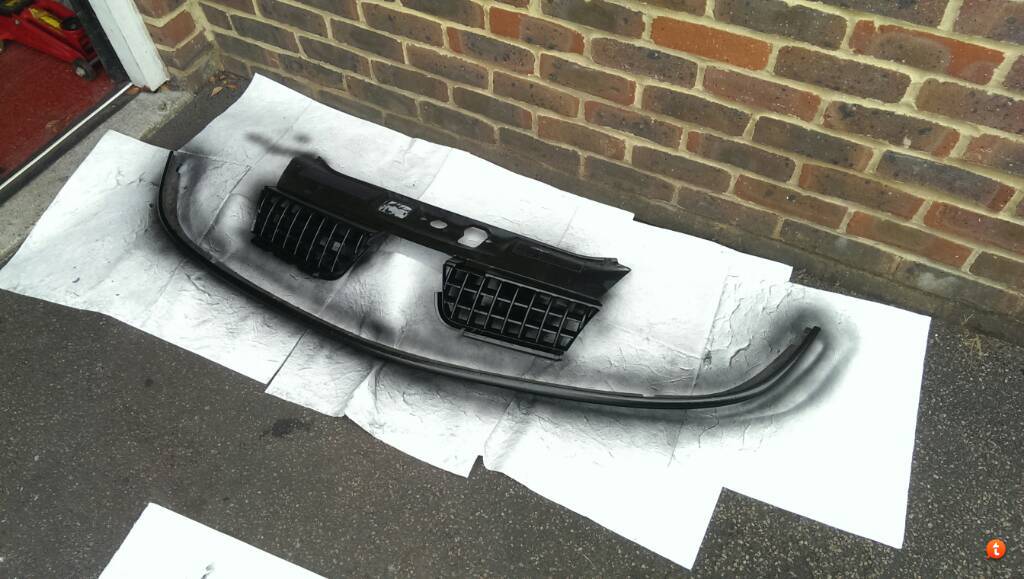

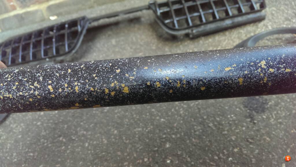

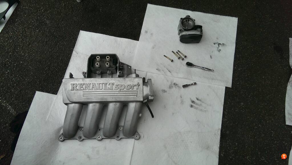

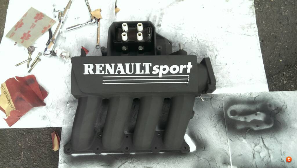

Today I decided to paint the splitter, grill and inlet manifold. The splitter was in terrible condition. Loads of stone chips. The inlet manifold didn't look to great either..
Inlet before paint
After
The splitter was very bad..
During..
All back together

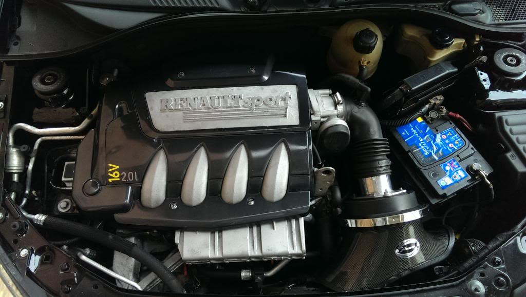

Engine bay is starting to look tidier

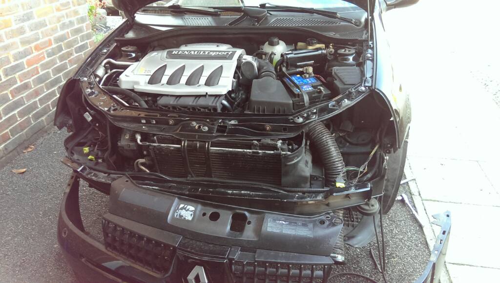

Soo it was MOT time. It failed... Steering rack gaiters split, headlight washers inoperative, drivers side headlight beam too Low.
Right pain to fix certain bits, but as I am currently out of work I started work on it asap!

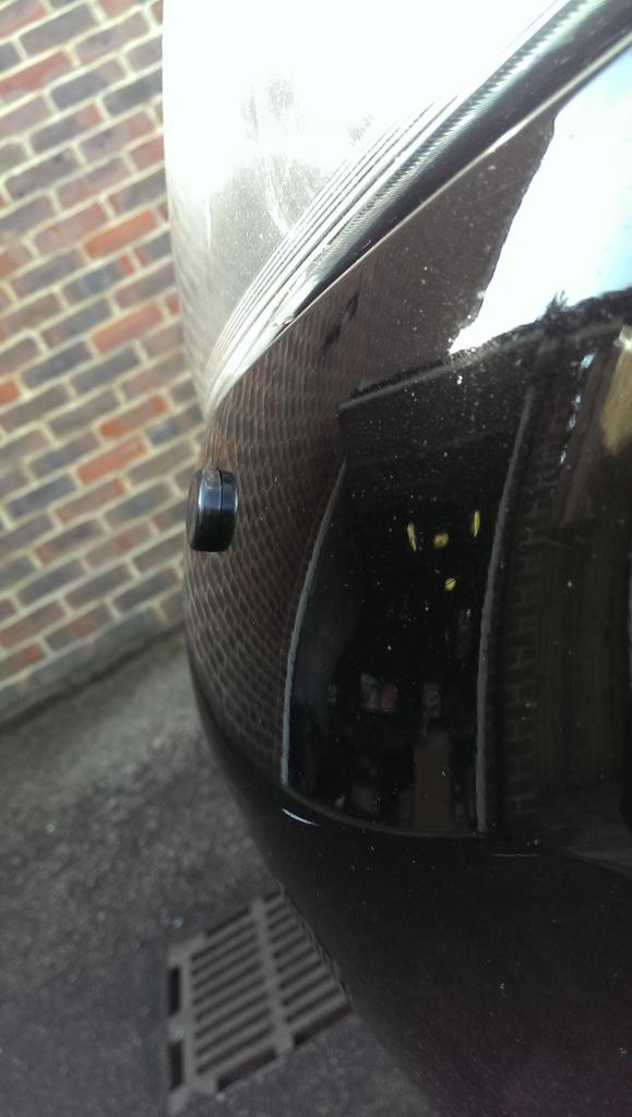

First thing was to sort the headlight beam out, due to the light being bodged before it meant me fixing the headlight properly. Front bumper off headlight out, fixed it but managed to break the xenon bulb. New set of bulbs arrive tomorrow.
Fitted new track rod ends and tie rod ends today as they had seized. Also new steering rack gaiters.
Headlight washers are working but will be removed after mot.
Also decat is going to be fitted after mot.. My poor ears

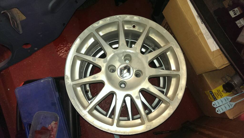

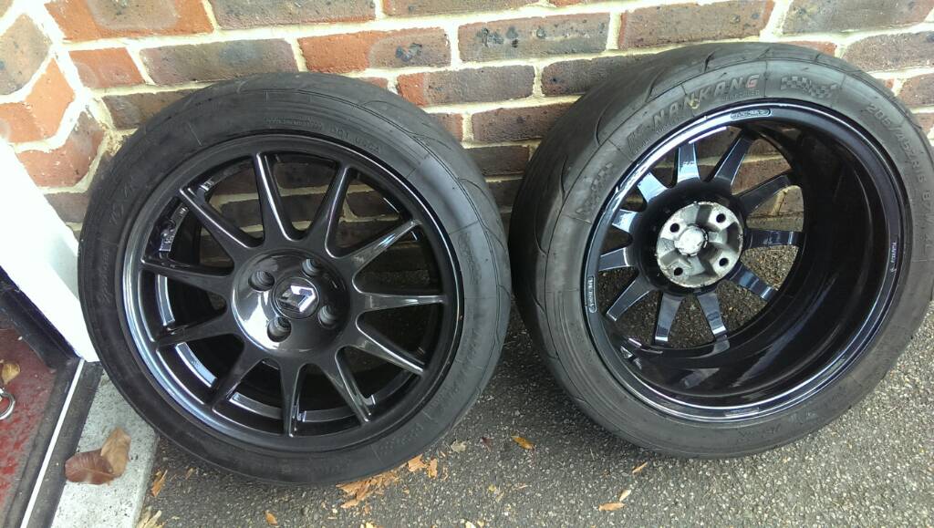

Since the last update I bought some Turinis (before refurbishment and Powdercoating)
After (after waxing them today)

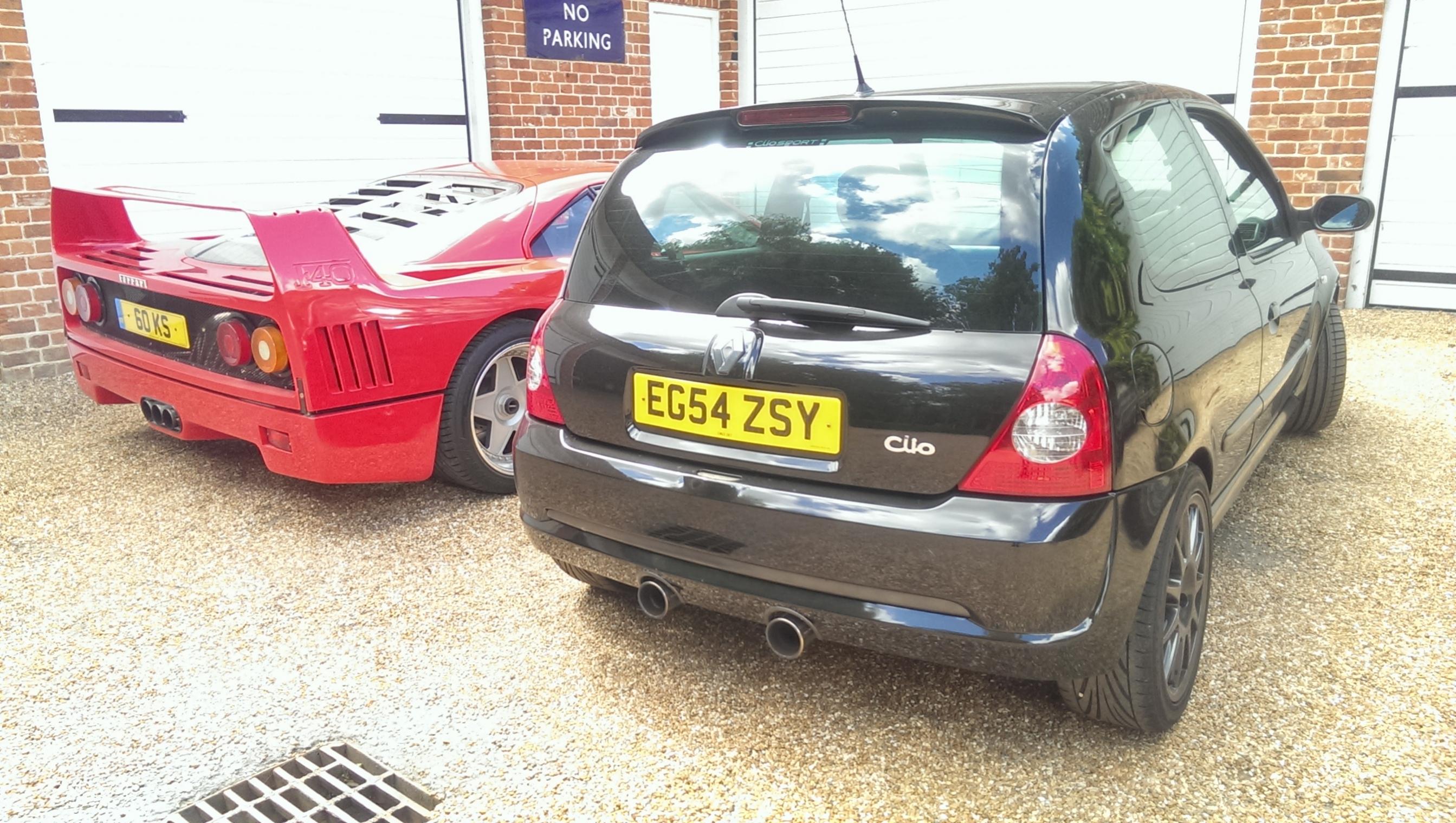

So.. today was a great day. Got to play around with some very nice toys.. my personal dream car and a few other very nice motors. Few videos on my Instagram if anyone is interested : http://instagram.com/sampaulhowell

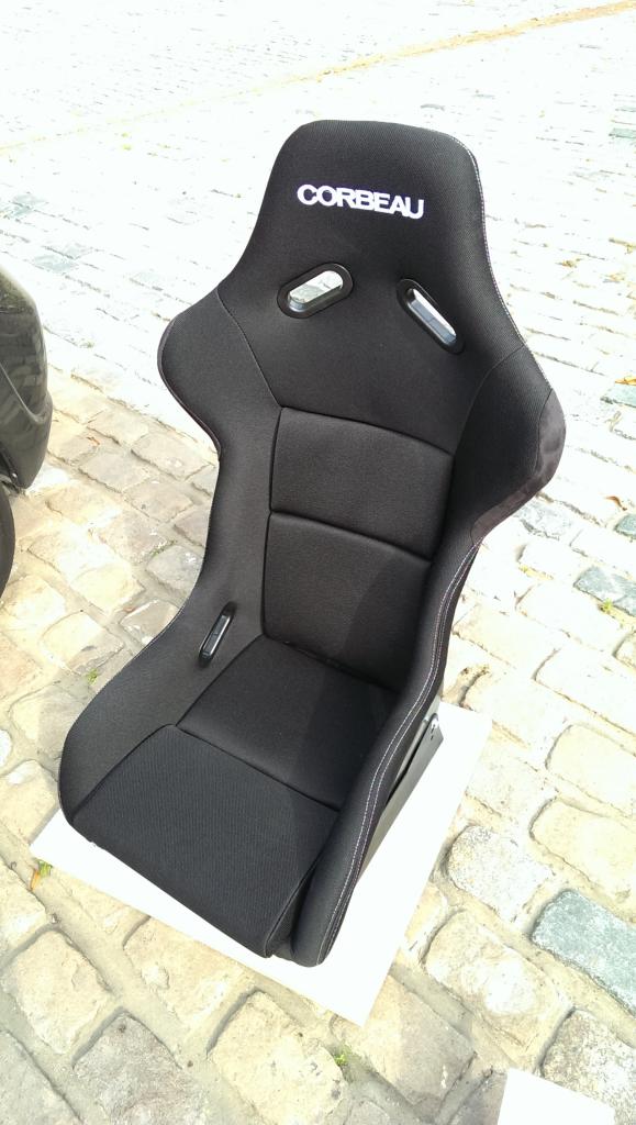

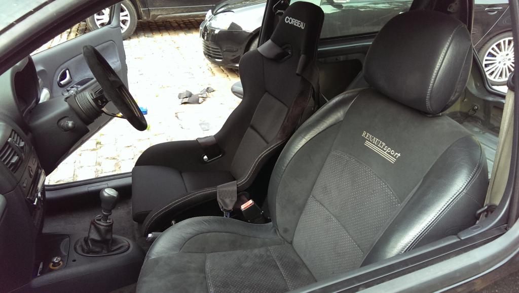

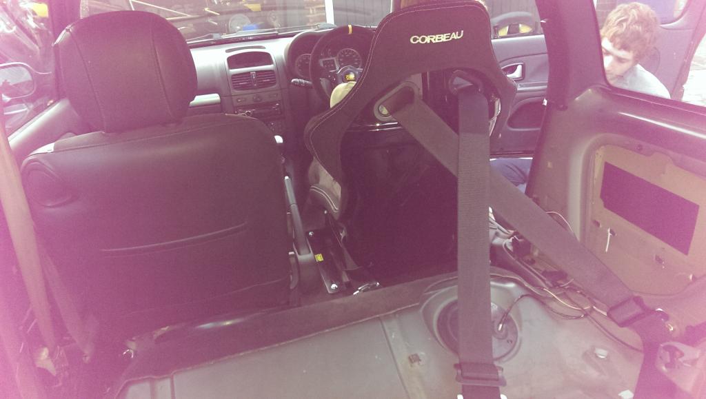

I have bought a few new things in the last week for it. First off was a new seat, I looked around for a decent seat which didn't break the bank and still managed to do the job.
I went for the Corbeau Clubsport! Absolutely amazing change to the car!

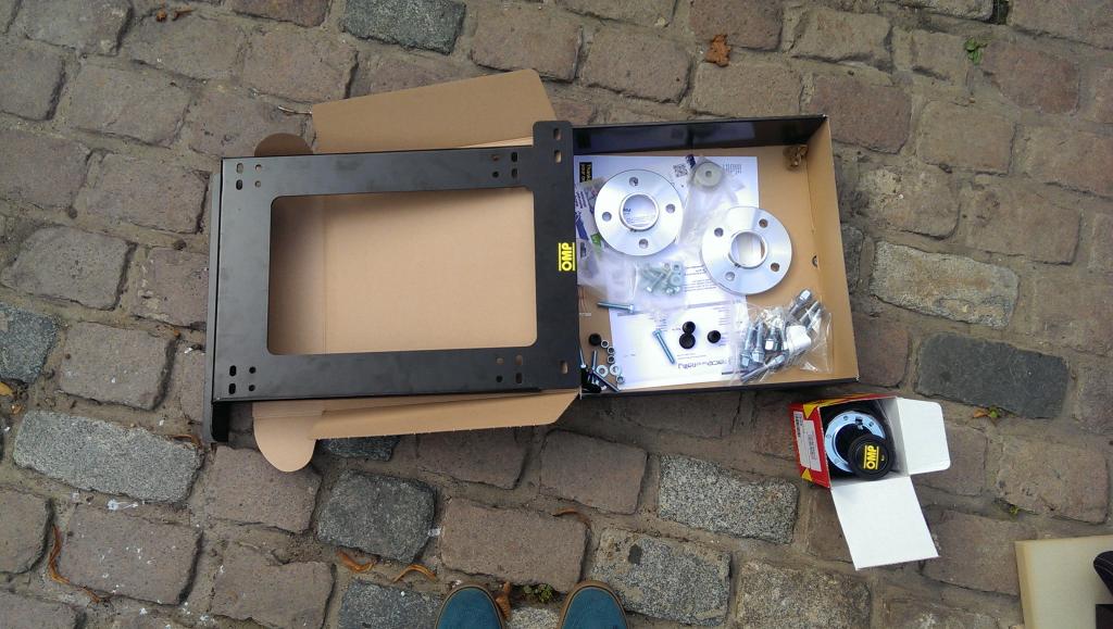

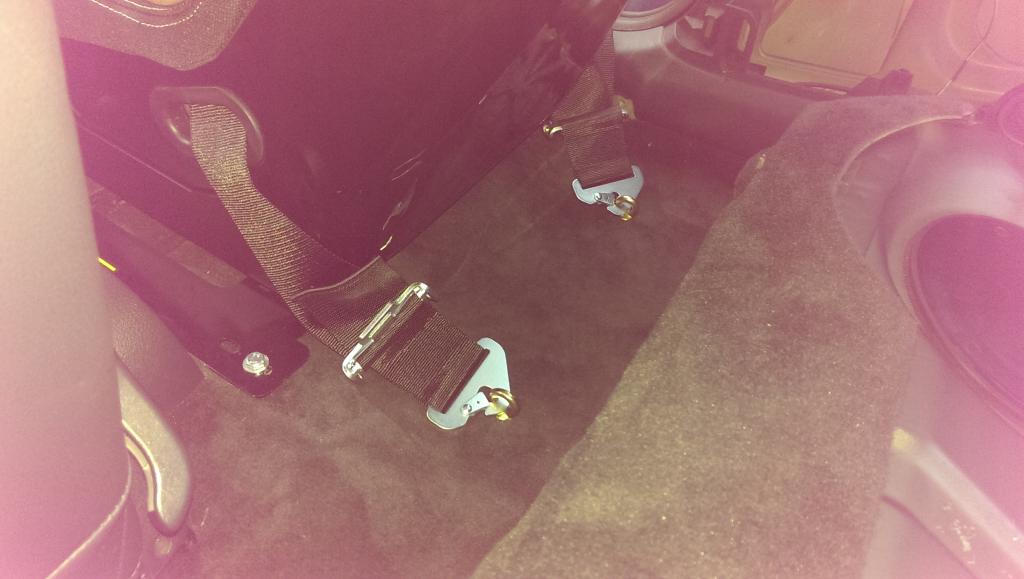

Then I needed to buy a subframe for the seat, so I bought a OMP Subframe and then I needed harnesses. I decided to get 4 point TRS 3" Harnesses. I also drilled through the floor behind the drivers seat and fitted Harness eyelets with spreader plates below, Looks very neat.
After I bought a new steering wheel. OMP Corsica and a Momo boss. The wheel is 330mm in size and is a great improvement over standard. I also bought 16mm spacers to widen the track on the front. (also means that when I fit the 197 Brembos there is clearance.
Photos below of everything fitted!

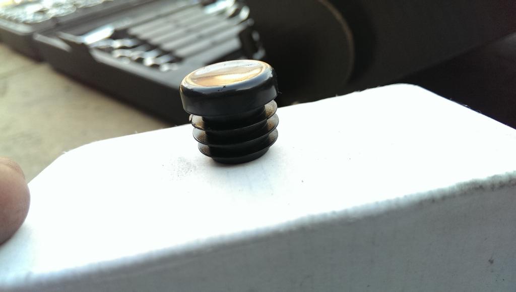

Today I decided to sort out a few little bits on the Clio. Bought the resistors to turn off the airbag and service lights which appeared after changing the wheel and drivers seat.
I have wanted to remove the headlight washers for a little while now.. ever since they caused utter grief on my last mot.. I found a couple of blanking plugs which I used on my old car for a totally different reason and they have fit the holes absolutely perfect and look good too :).

SamHowell Nice one. Where di you get your bolts from if you don't mind me asking? Seems tricky to get hold of the right bolts for mount the subframe to side mounts, and for mounting the subframes to the car...
I got them all on ebay. 4x30mm m8 bolts for subframe to sidemounts. Then 4x80mm m8 bolts for subframe to car. Bought washers and bolts at the same time. They were all high tensile bolts.
What size insert and ducting did you go for pal?
Also what did you use to spray your inlet?
Good progress
I believe it was 73mm all the way through. I used high temperature paint on the inlet and then filed the letters. Thanks :)
