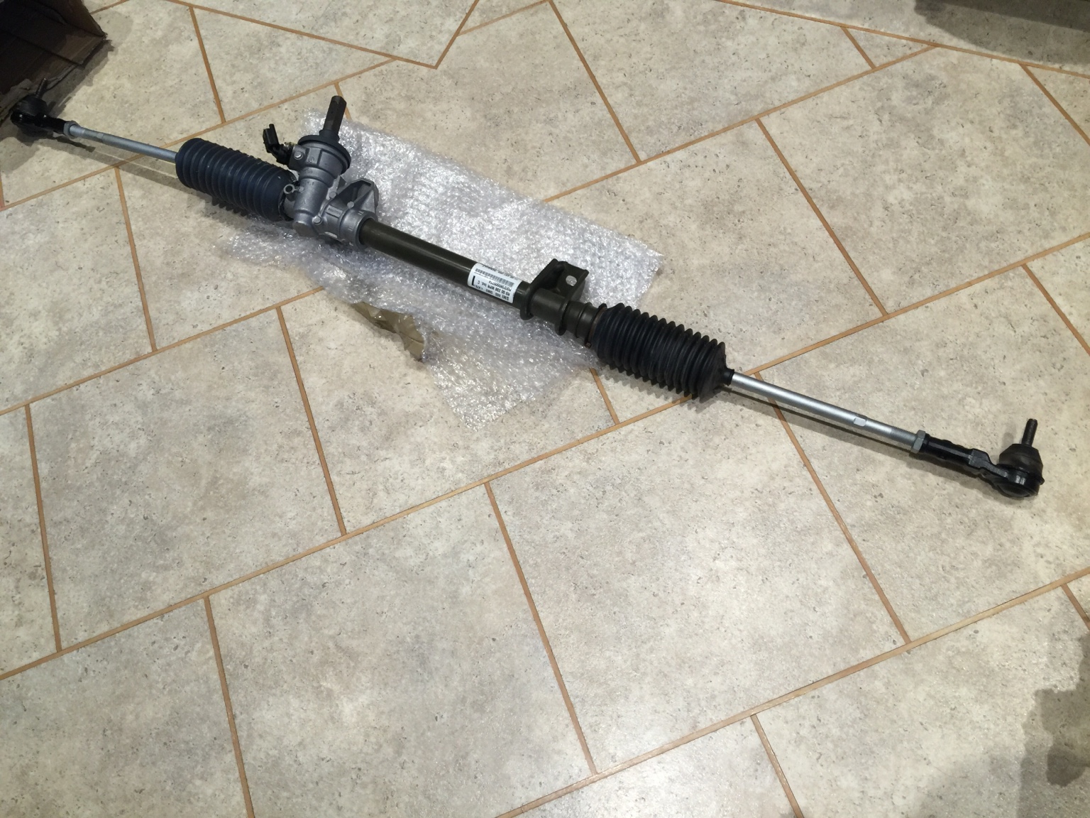

Brand new Renault non power steering rack arrived today! Going to run it without epas initially to see how it drives. If it's not too great I shall just do the conversion.

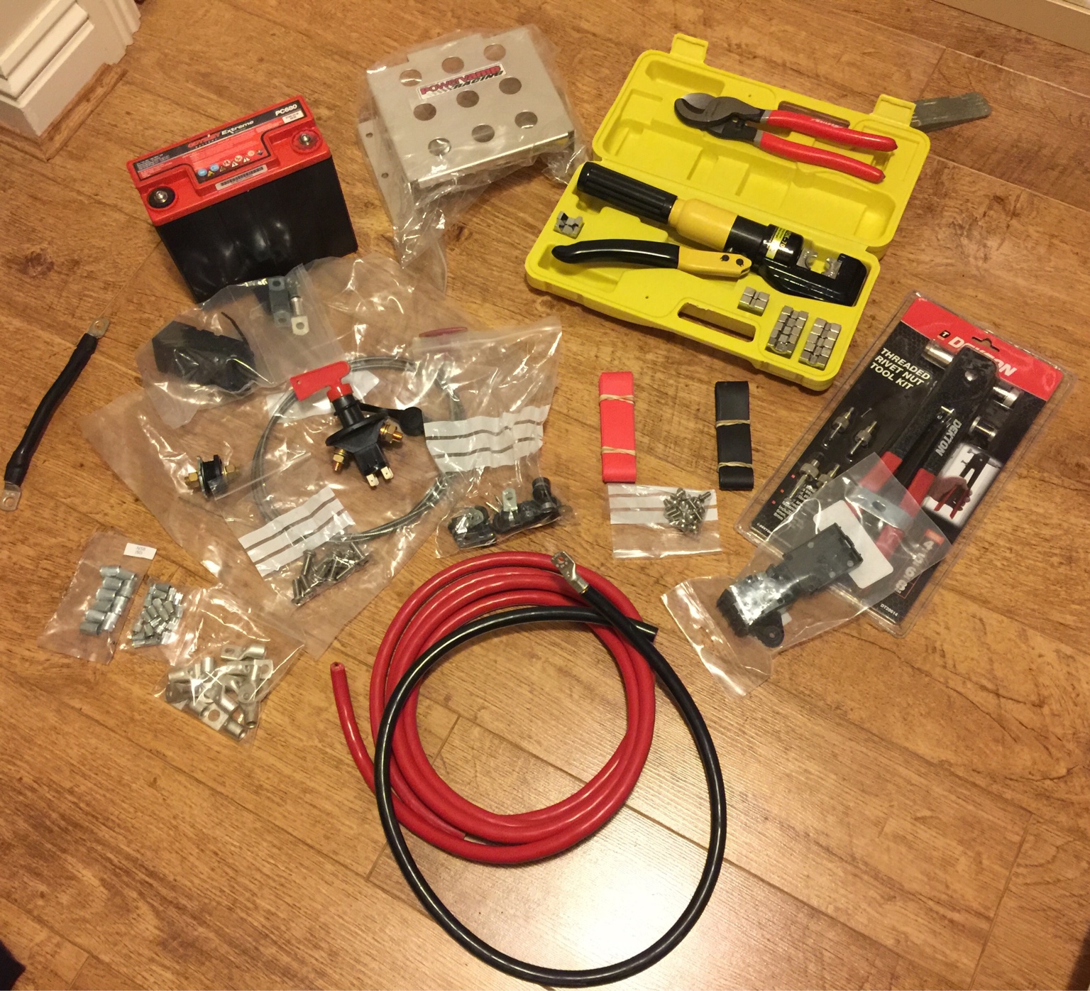

Had a lot more arrive. Battery cable, Cable cutters, hydraulic cable crimper, rib nuts with tool, heat shrink, odyssey pc680 battery, battery holder, battery cutoff with remote pull!
Big nice box full of new parts which is always nice!

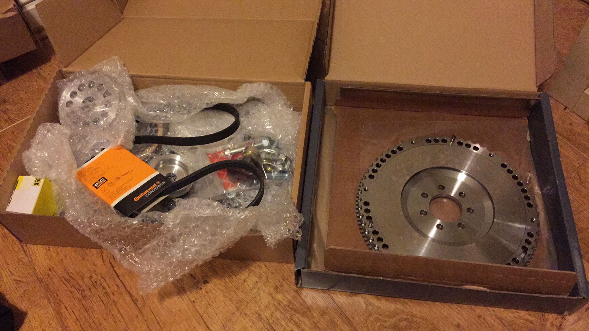

Long time since last update.. But I have done everything apart from the fire extinguisher at the moment!

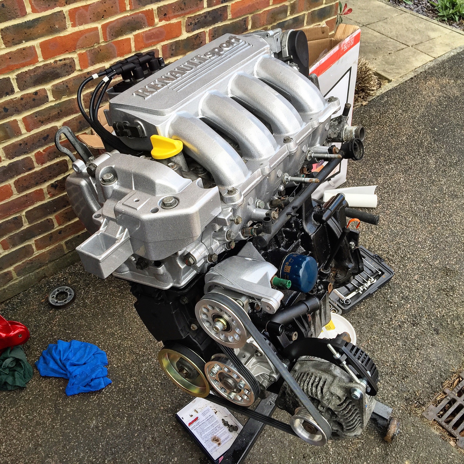

Engine has now got arp Conrod bolts, lightweight power steering kit, lightened flywheel, new clutch. Also have had the gearbox rebuilt.

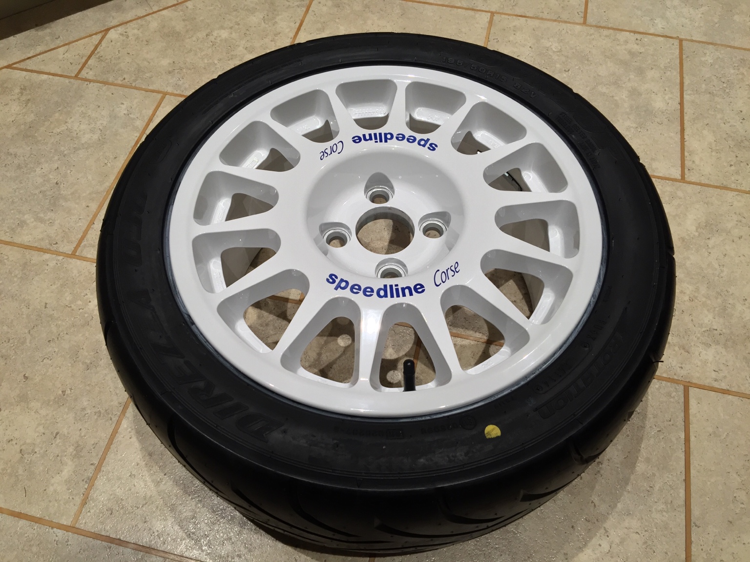

Speedline 2118's have arrived also. With Dunlop Direzza DZ03G's all round.

Looking good mate! I remember having a delivery exactly the same as that before all from eBay - Pclips, battery, battery cable, terminals, crimper, and rivnut tool etc etc.
Done a good job with the engine also, clean!
