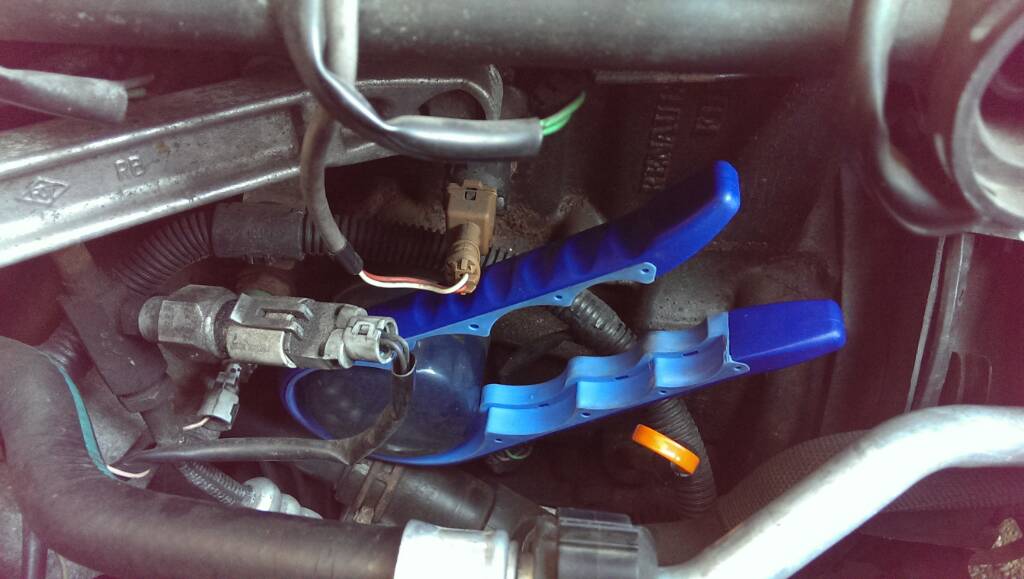

Been meaning to give my car a service before the winter, so ordered all the bits up again and gave it an oil and filter change. Find that changing the oil filter is a right pain.. So I use a jar opener to grip hold of it. Works pretty well!

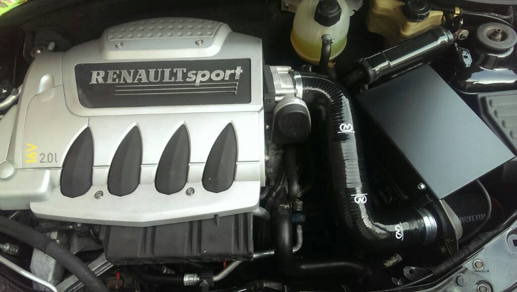

Also I recently built a new induction kit for it, cost me around £75 to make I believe.. But I think it looks great and really has made a difference to the car. Money well spent [emoji106]

Its actually not a one piece bend :smiley:. It is two 90 Degree bends with a 70mm hose joiner connecting the two. Makes a tight fit and a clean looking IK!
I can see that now, looking closer. It looks good.
Do you have a link to the items you bought? I know you can buy pipes and filters on eBay but I like the ones you got, rather than the "ash" ones. I like the slim pipercross filter too.
@Dr Jekyll
Okay here is A list of what I bought. The silicone hoses/pipes do require slight cutting down so they fit perfectly (very easy to do):
I bought two 70mm 90 degree Silicone elbows: Link
Two 70mm Alloy Hose Joiners. They join both Elbows together and the elbow to the filter: Link + unfortunately the first time I bought 1 off demon tweaks, It was £12.. Then did a bit of searching and found this one. Does the same job!
Then I need to sort out the Oil Breather, so I bought a 13mm elbow/connector. I drilled a hole in the silicone elbow and pushed this through. Link
For the actual breather pipe I actually bought A new silicone hose Link I bought 1/2 Metre, 13mm in black.
I suppose you can get any Air filter with A 70mm Neck.. But its trial end error as they wont all fit behind the headlight!.
The filter I bought is: Link ( I don't remember paying that much for just the filter!)
Hope this helps :smile:!

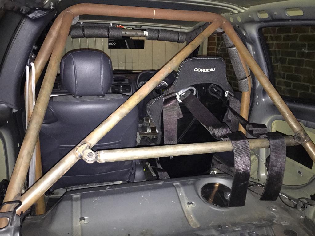

A few pictures of the cage. (Ignore the Bride seat)

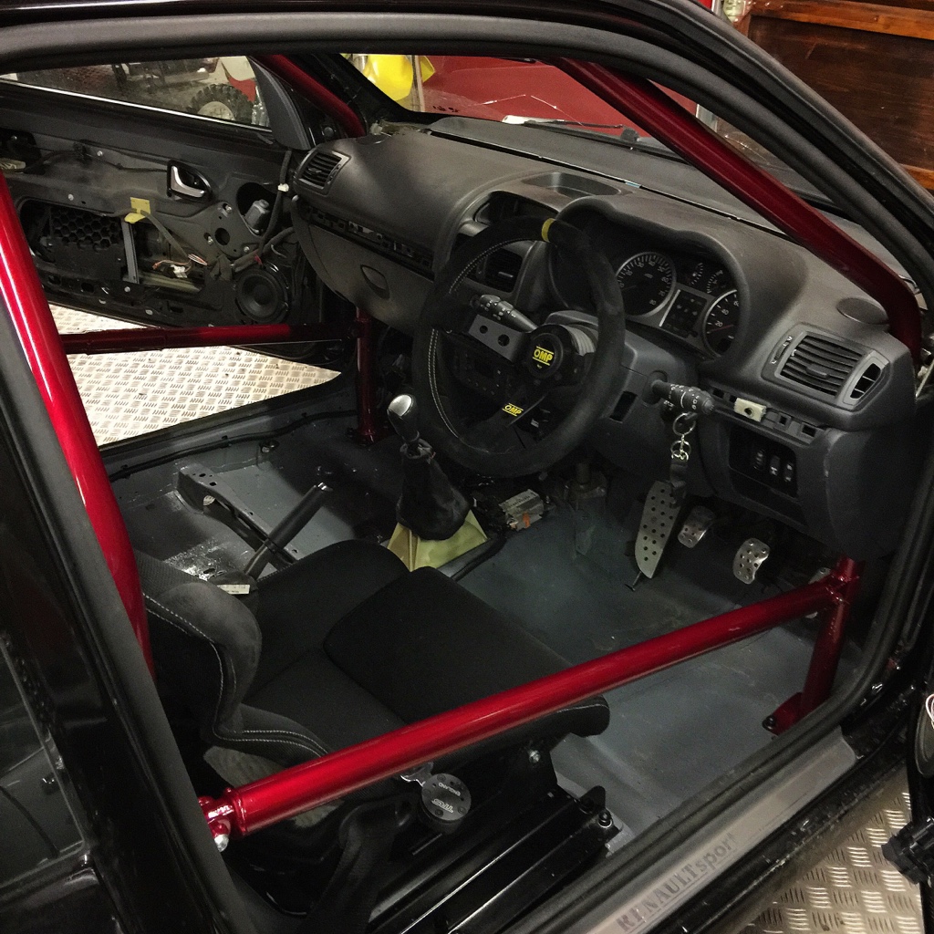

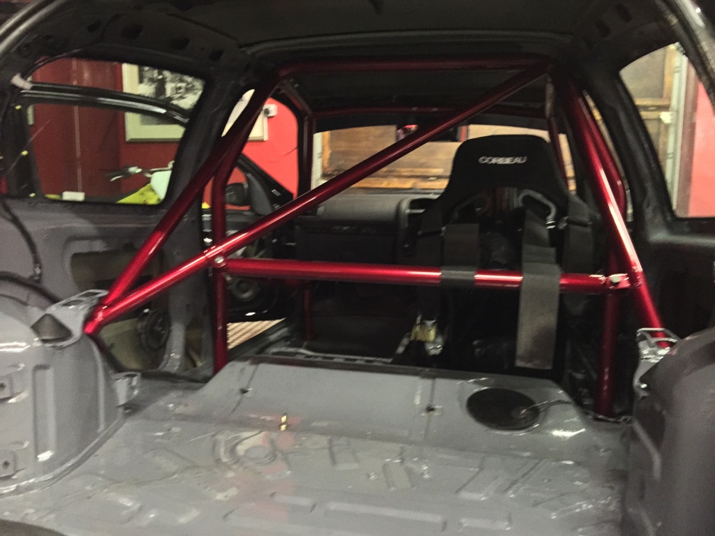

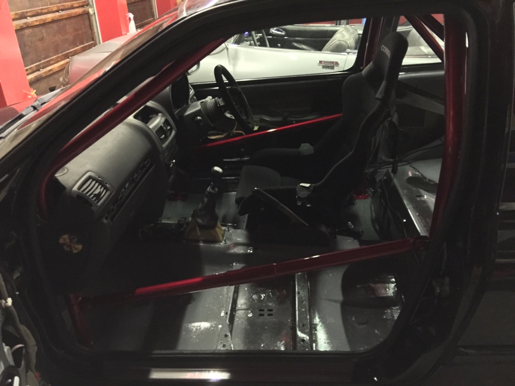

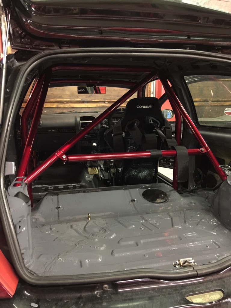

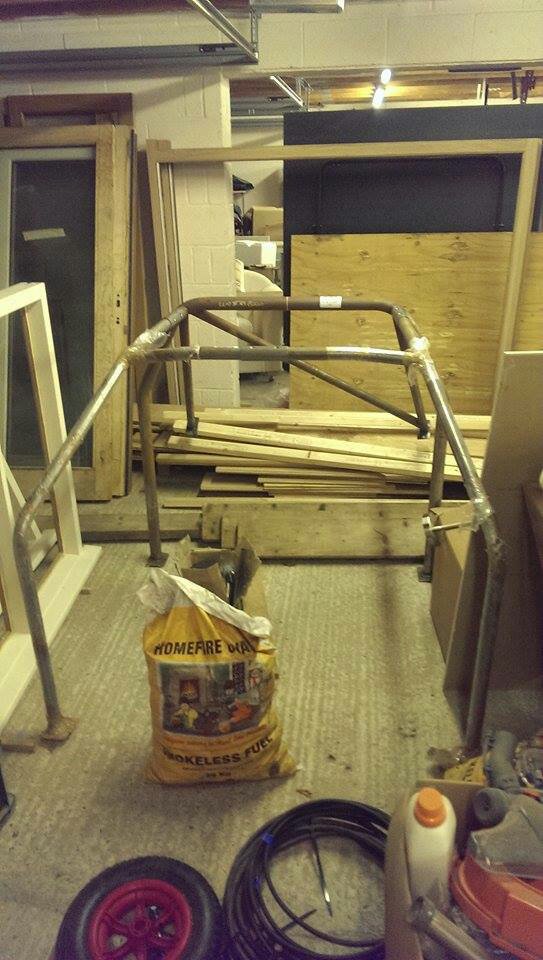

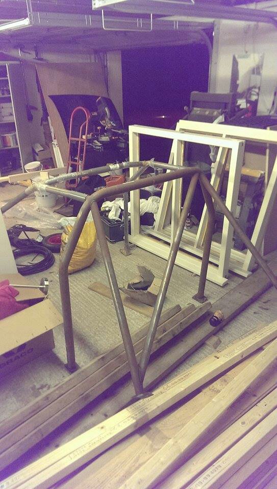

The rollcage is now in the Clio :smile:. Took a while to get right and there is a few bits that need adding but it is in!
I need to get the door bars + Harness bar put in and some padding. Got some photos
[/URL]
[/URL]
[/URL]
Very happy with it! Now I have got to this stage it may be time to retire it as my daily.. and look to get a 197!
Still have a huge list for it, hopefully ready for next summer!

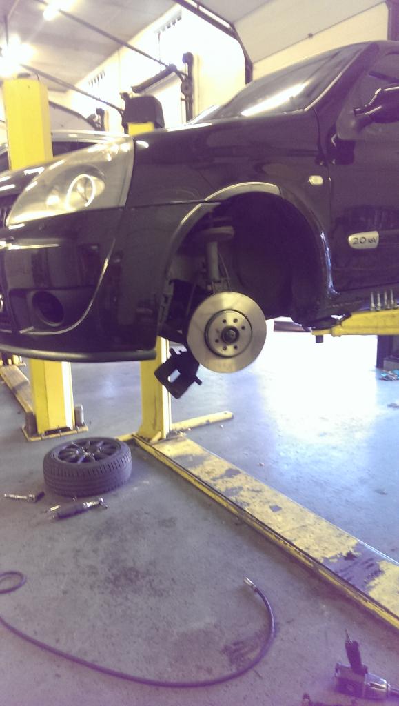

Small update, Got my pads and discs through from @ldubl and got round to getting them fitted straight away. Ferodo DS2500 Pads and Brembo HC Discs, hopefully will notice a huge improvement tomorrow at Brands hatch :smile:. Just a few little photos!
[/URL]
[/URL]
Good stuff Sam! Hope they performed well for you today?
I can't believe how good they are.. Genuinely has changed the way I can drive on track. Soo much more confidence with them. Looks like I need a new exhaust as got black flagged for being too loud [emoji45].

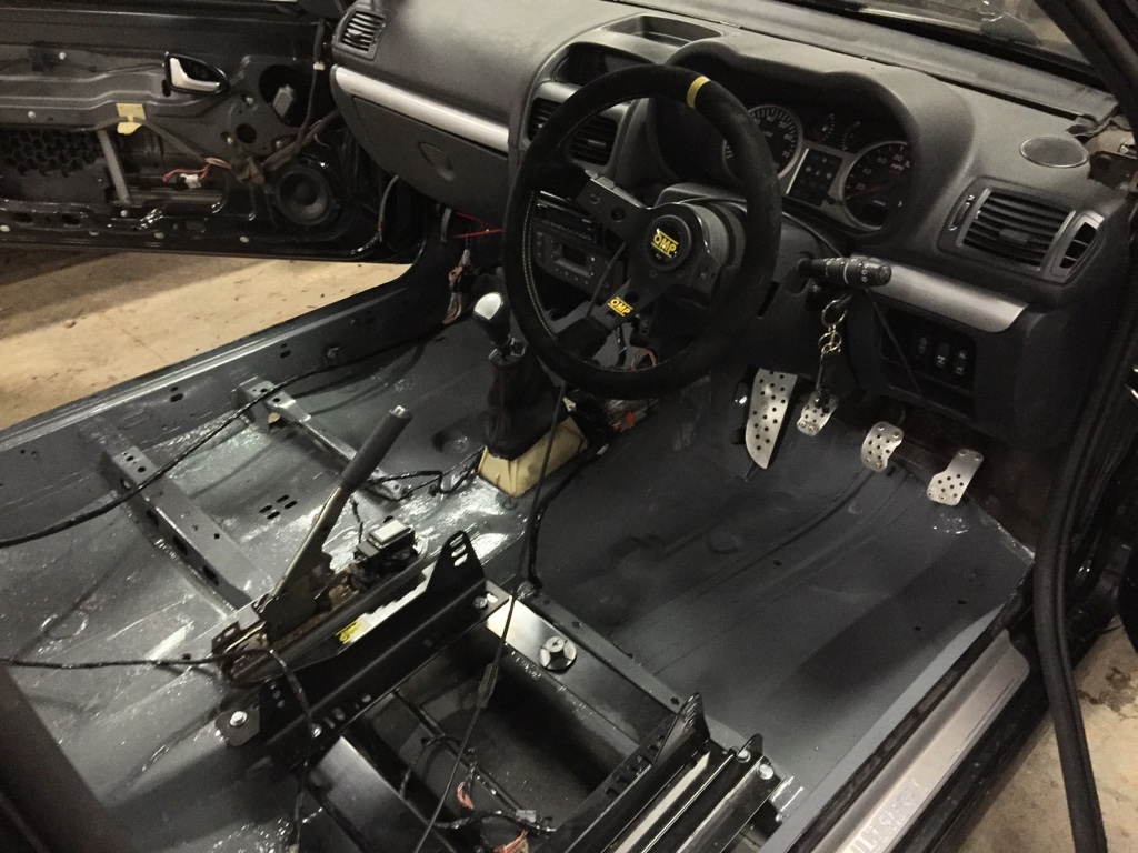

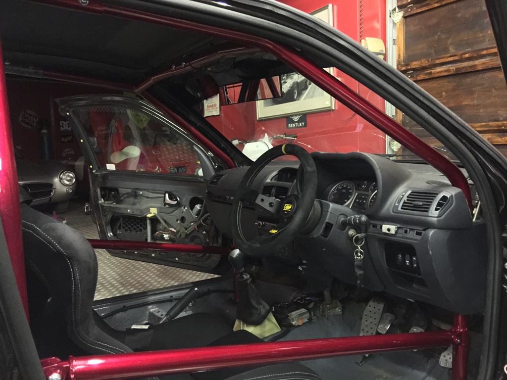

The cage is being painted. But not powder coated
Is it a bolt in?

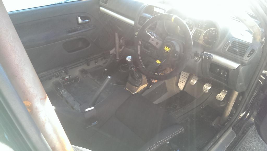

How are you finding the Corbeau? Anything to compare it to? Looks very similar to pole positions.
Plates weld in then the cagebolts to them. I also have a harness bar + door bars and a few strengthening gussets to weld in, this is why its been left unpainted.
Corbeau seat is fantastic. Can't recommend it enough, very comfortable and is a good quality product. I have sat in many different bucket seats before such as tillet racing seats, pole positions, bride buckets and to be honest these are just a comfy as the pole positions. They just lack the extreme quality of the recaro brand... Which is expected

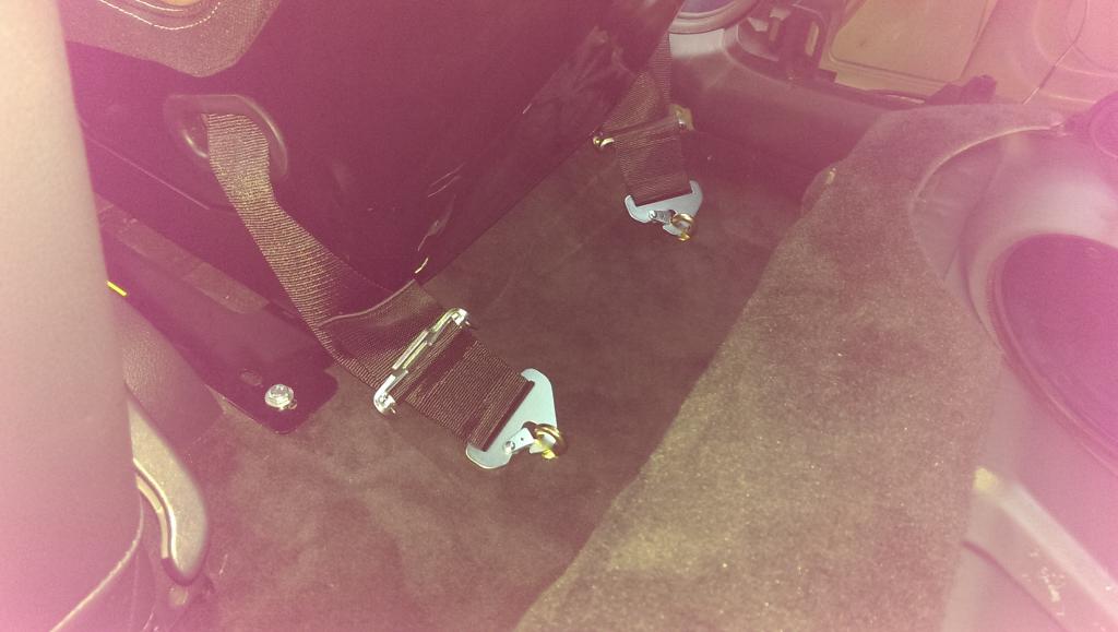

I'll have to find somewhere I can have a sit in both I think, see which one works best for me, could you tell me how you have gone about mounting the eye bolts for the lap belts on your harnesses? I have head you can mount them to the omp frames somehow?
It's nice to see a project thread that has gone the same direction as I want mine to go, I was going to go for the cooksport/ standard dampers as welll so at least I know it seems to work for people!
Good idea, worth getting a seat you will be comfortable in! Heres a photo of how I have mounted them:
Drilled through the floor, spreader plates on other side of eye bolts. Looks very neat! I think you could somehow do it to the omp subframe but I didn't bother.

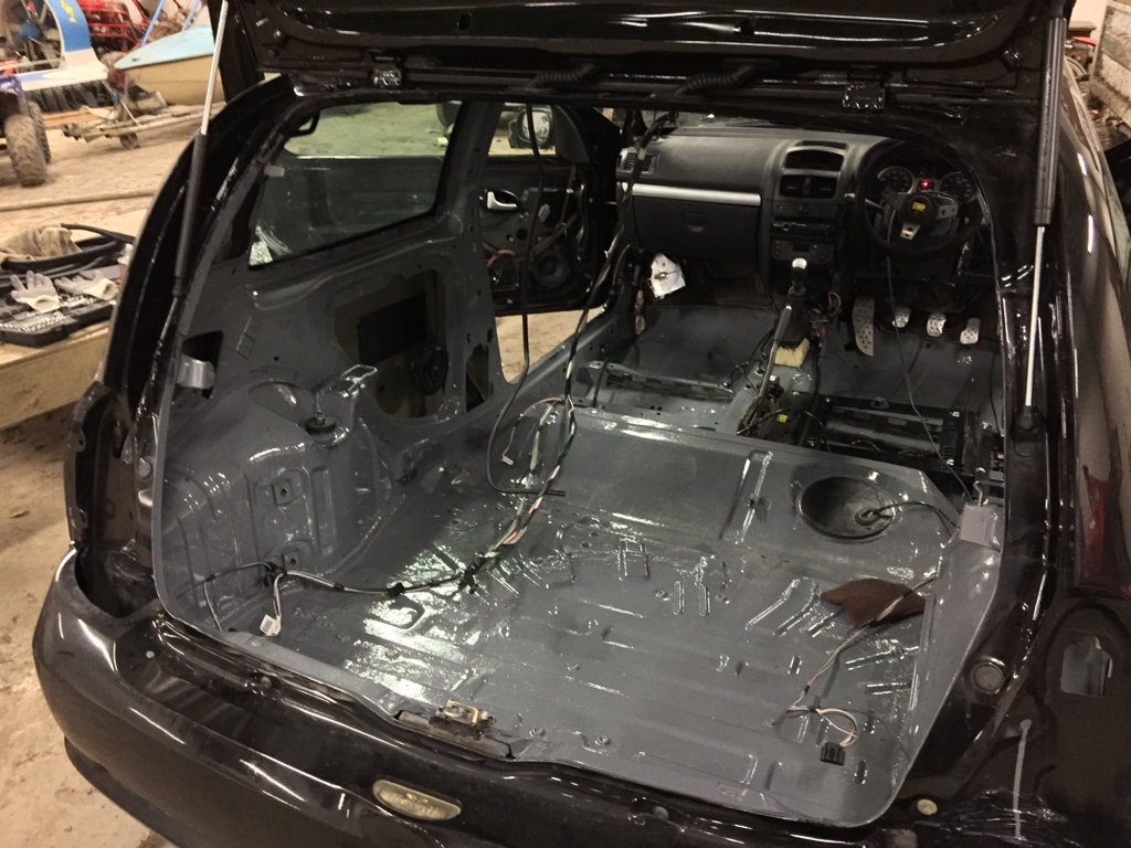

Decided that I will get my cage Powdercoated.. Whilst the cage is out of the car I have painted the interior of the car.
