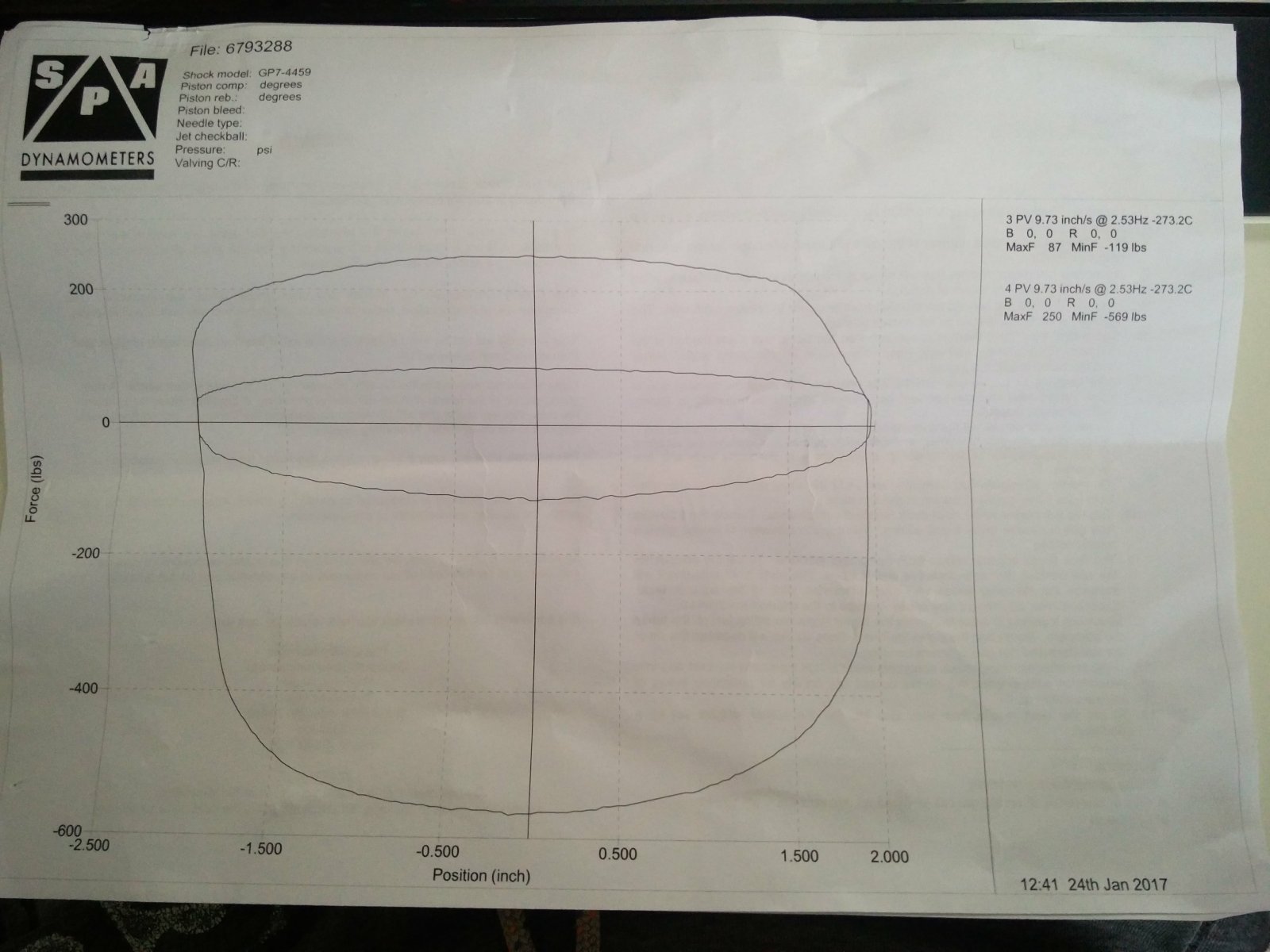

Anyone able to explain shock dyno graphs? Because I don't have a f**king clue what this means 😂
There's 2 sheets, both like that. I can't work out if that's for a front and a rear shock on each graph, or if it's only for one shock per graph showing softest/hardest damping settings. Even then, I still don't know how to read them lol!

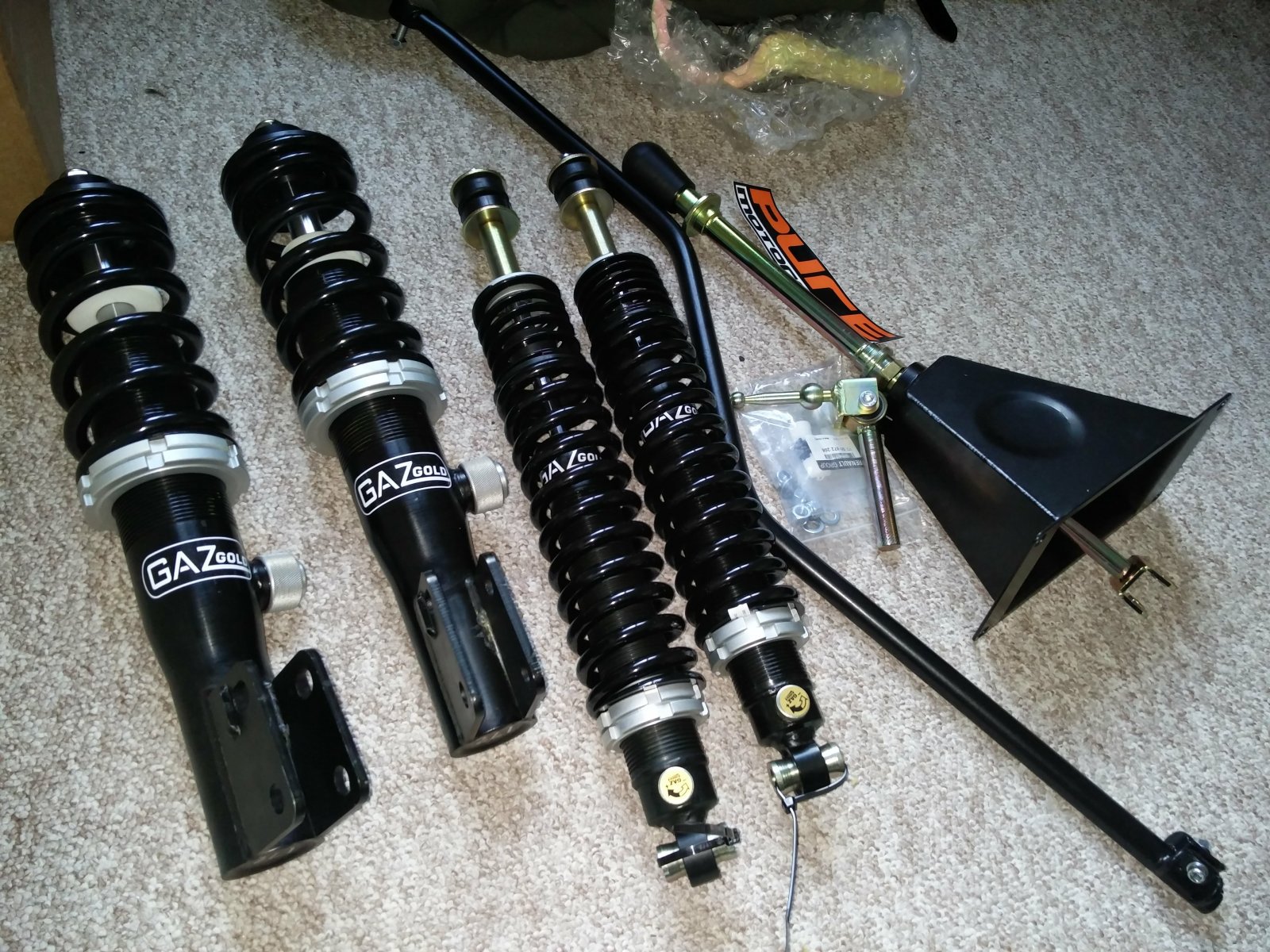

What spring weights did you go for ? I see 569lbs? Is that damper or spring weight ?

The figures on the graph are damper rates. From what I can gather it's the compression and rebound figures for the softest and hardest settings on the dampers.
Spring rate wise I went for 450 front and 350 rear. Standard rates for the golds are 500/300 but I felt that was too soft on the rear for knockhill and 500lbs on the front would be pretty rough on the roads so tried to compromise. Will see how it pans out!

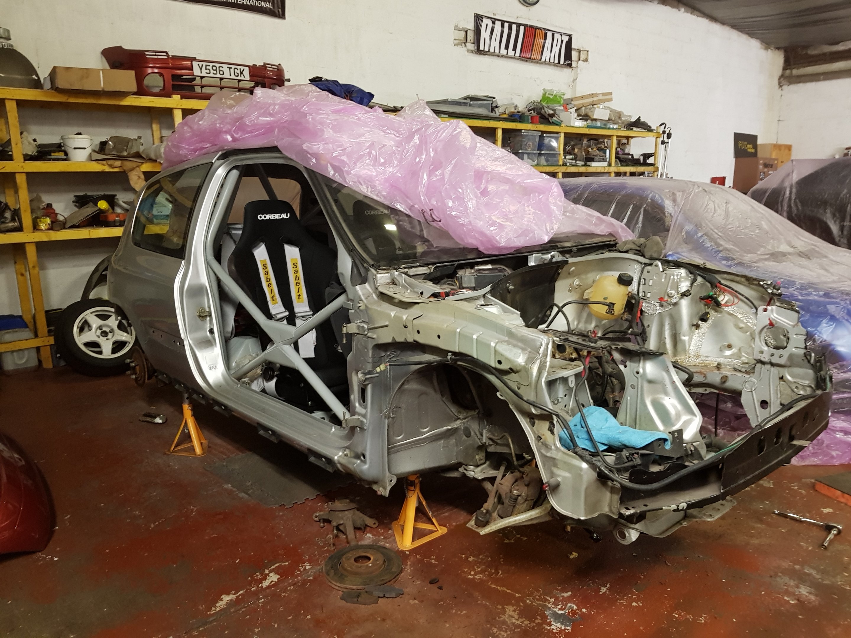

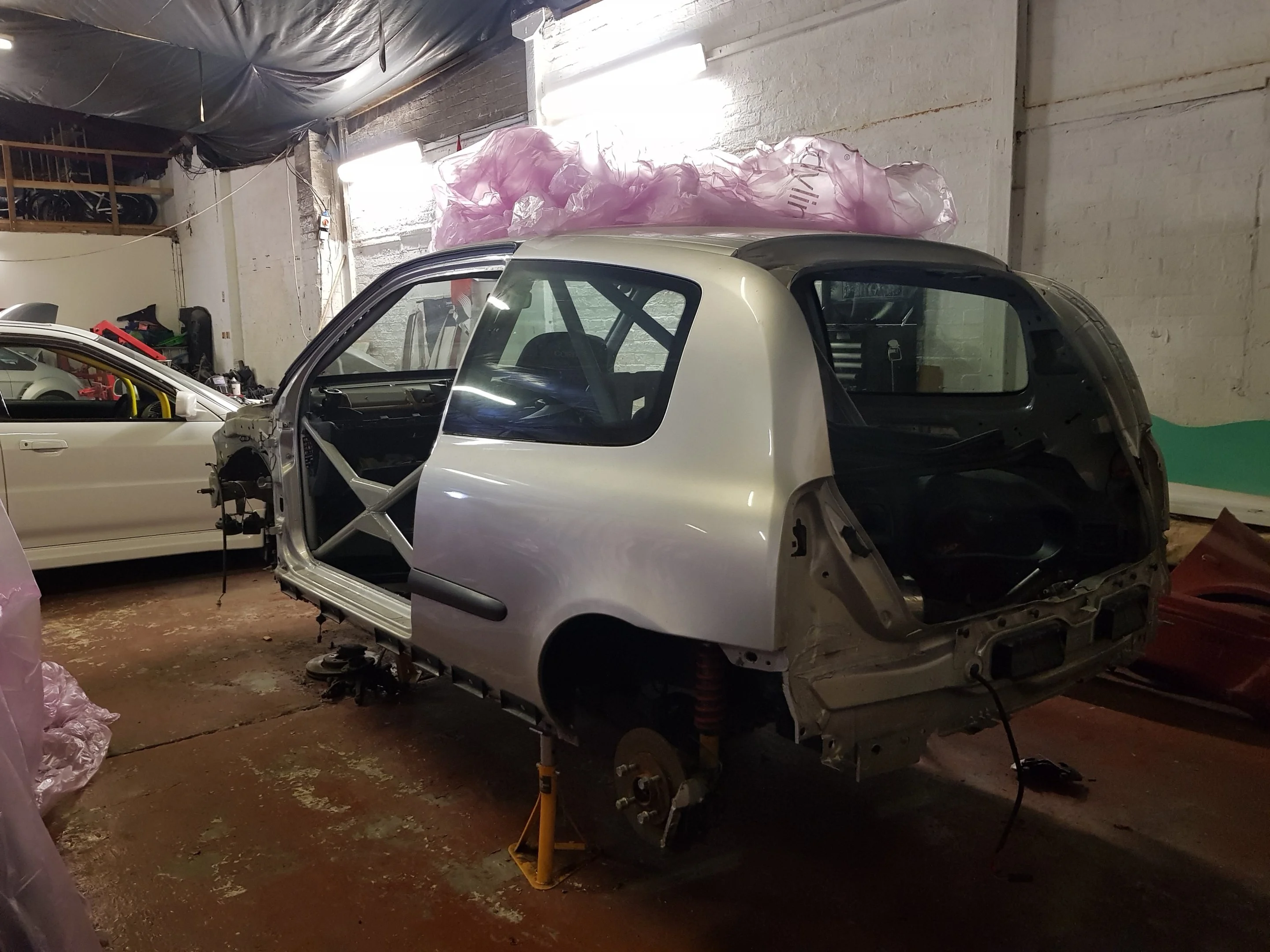

And here we see a typical CS track car in its natural habitat. A garage. On axle stands...
Tucked in way up the back, out the way!
So yeah, that's it in its new resting place in the new unit for now. Much bigger than the last place I was in. Plenty room to get it stripped down and do everything I've wanted to do since reshelling it.
But that aside, I actually worked on it last night!

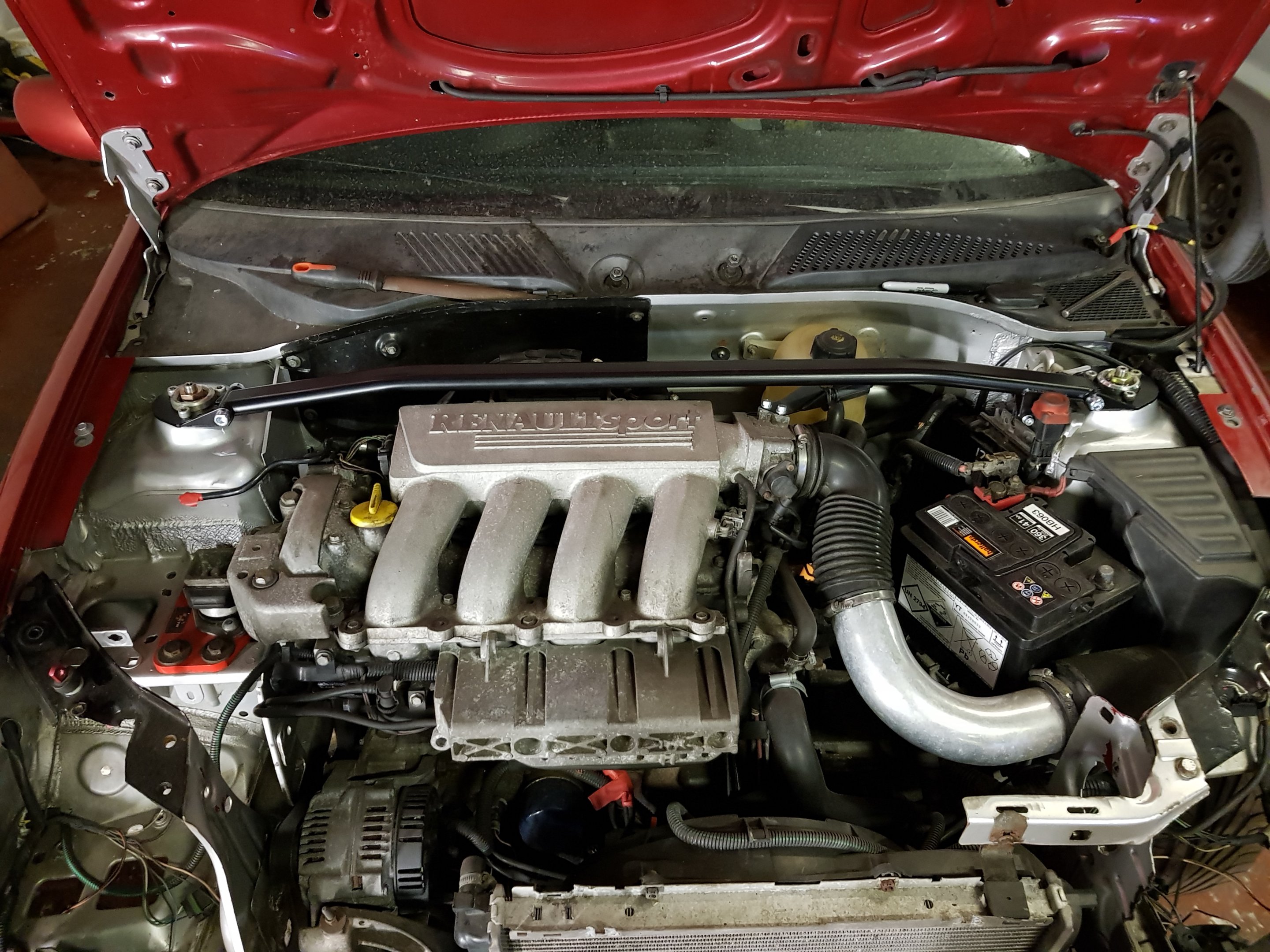

Holes drilled for PMS top mounts and strut brace and test fitted it all. Picked the mounts up for very cheap ages ago and just recently replaced the bearings and wanted to get the brace before fitting.
So now that's done, I've decided it's aaaaalllll coming back out over winter to freshen it all up and give the bay a quick dusting of paint.
I feel a new (fairly long) to do list coming up...

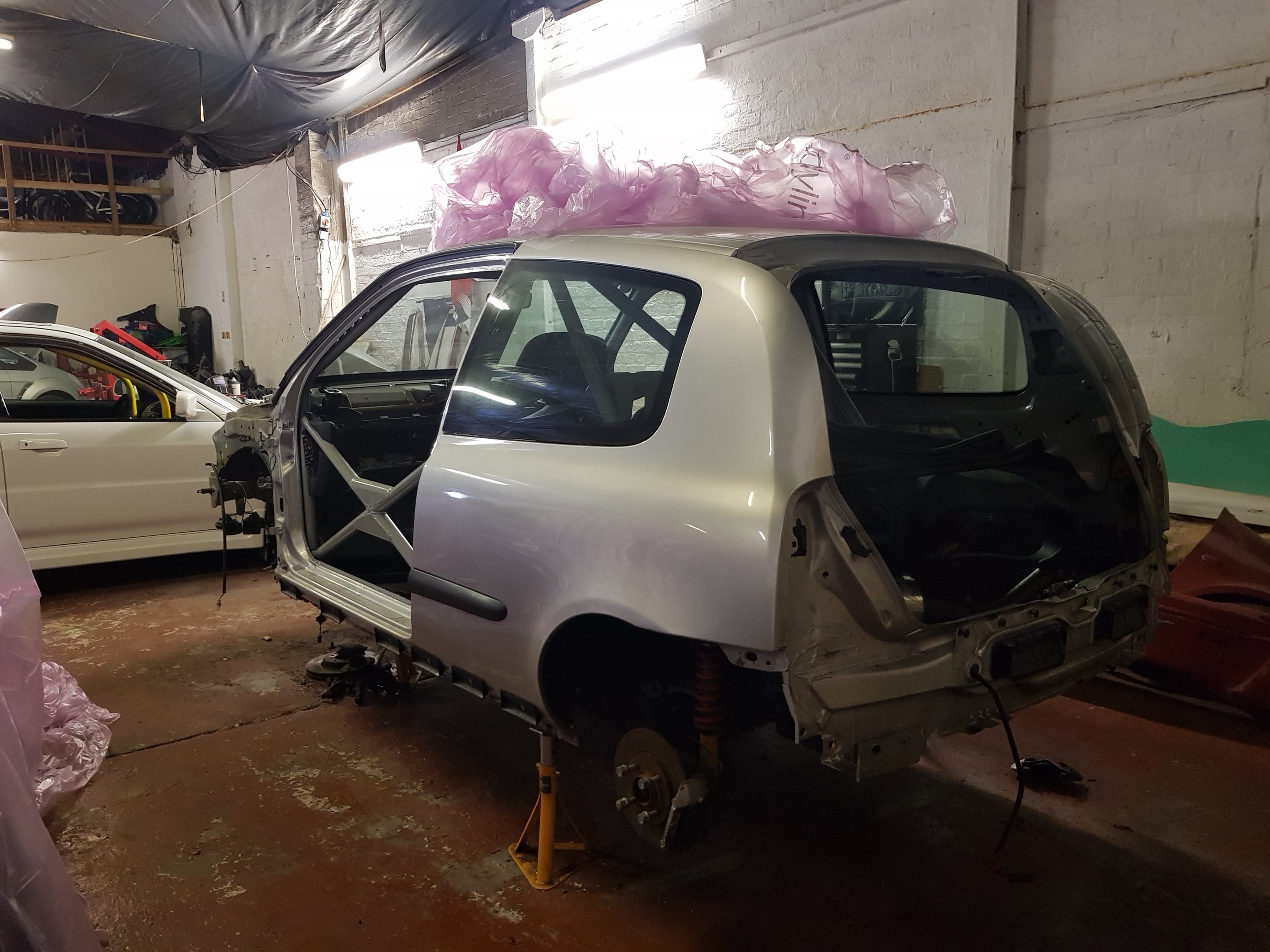

Oh hai. It's been a while. I don't think this is the direction project threads are meant to go...
Think this is literally the furthest I've ever been from having a built car!
Painting soon, and hopefully make the engine look a little bit nicer than it currently does...
