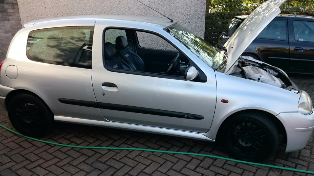

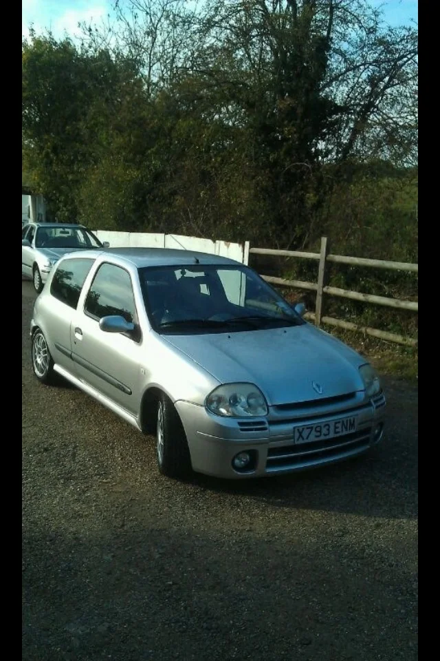

Bored, so I thought I'd start a project thread for my most recent purchase! A ph1 172, 96k (roughly) on the clock, bought off a member on here on Friday, before that it belonged to Chi, and possibly another member on here before that. Unsure on it's full history, but the car seems good to me so I'm happy with that. No history for the belts so they'll be getting done soon by Rentec, but the dephaser is a bit noisy anyway so it was always on the cards.
Original plan was to get it, strip it, fit some bucket seats and harnesses etc and and turn it into a track car over winter, with a view to taking it up Knockhill at the start of next year's season. Unsure how that'll go, but it's a rough goal!

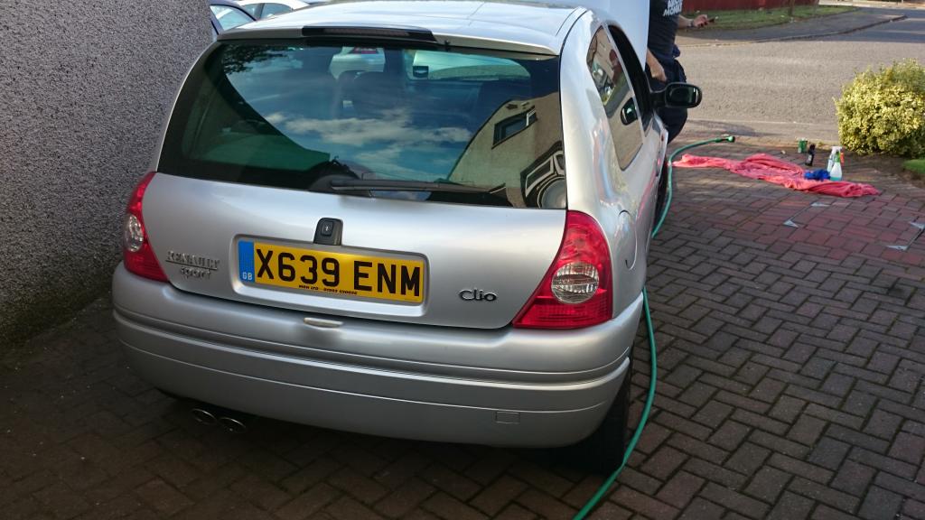

So anyway, since getting it on Friday I've fitted some Ph2 rear lights I had lying around, fitted a new high level brake light as the one on it was cracked, tidied up the front end a little bit (bumper had been resprayed at some point and there was overspray behind it, so done my best to get rid of that), gave the engine bay a quick steam cleaning, polished the headlights a little, and gave the car a half decent clean too. Other small jobs included fitting a new bracket for the UCH as it was hanging down at the passenger footwell, and sorting out the cold air feed for the standard airbox as that wasn't connected up (no induction noise now FTL).
Sadly only got this one photo of the car, but I'm trying to get my brother to send me some over that he took earlier today, so I'll fire those up when I get them.

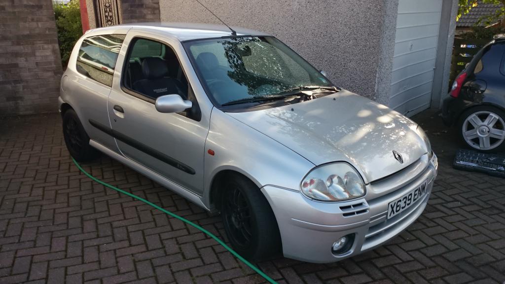

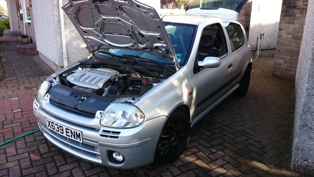

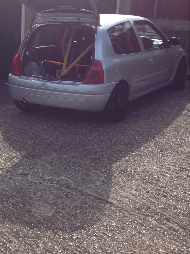

  172 Ph1
Here's my EMN . Shame it's being broken .
But needs must .
I also have a Cammed Ph1 like Chi and I can understand you not wanting to chase big numbers , Cammed and weight loss to are def the way in my opinion , these little rockets just put the biggest smile on my face every time I'm out in mine.
Good luck with yours and I hope it serves you well as mine has. [emoji106]

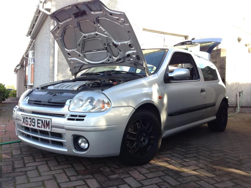

But needs must .
I also have a Cammed Ph1 like @Chi and I can understand you not wanting to chase big numbers , Cammed and weight loss to are def the way in my opinion , these little rockets just put the biggest smile on my face every time I'm out in mine.

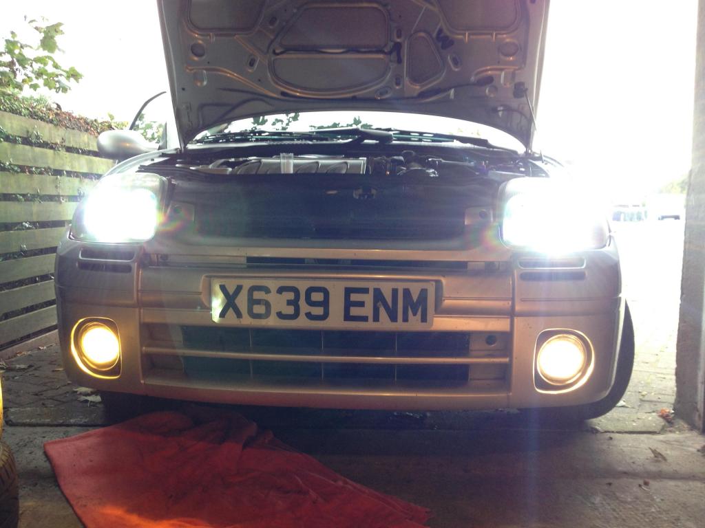

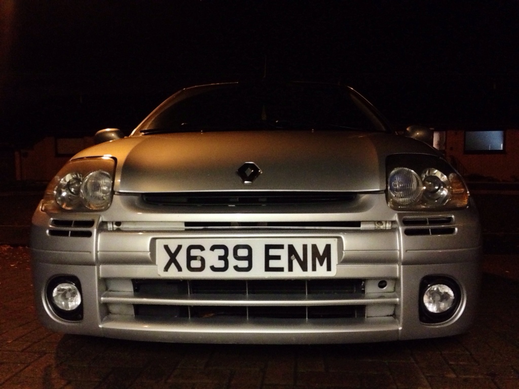

Ordered a load of different bits for the car this week. Got powerflex steering rack bushes and new inner track rods, a set of HID's, some yellow fog light bulbs, new wipers, and mist washer jets.
Decided to leave the steering stuff for another day, since I never had the right tools for the inner track rods, so cracked on with fitting the simpler stuff instead. Started out with the HID kit:

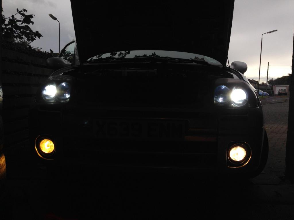

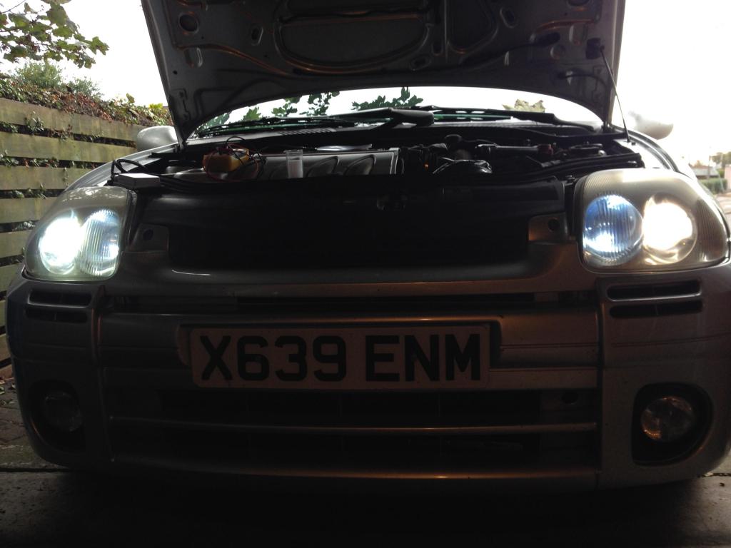

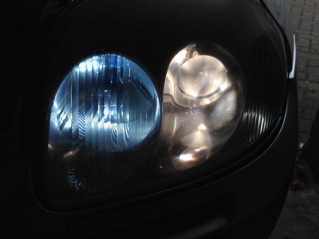

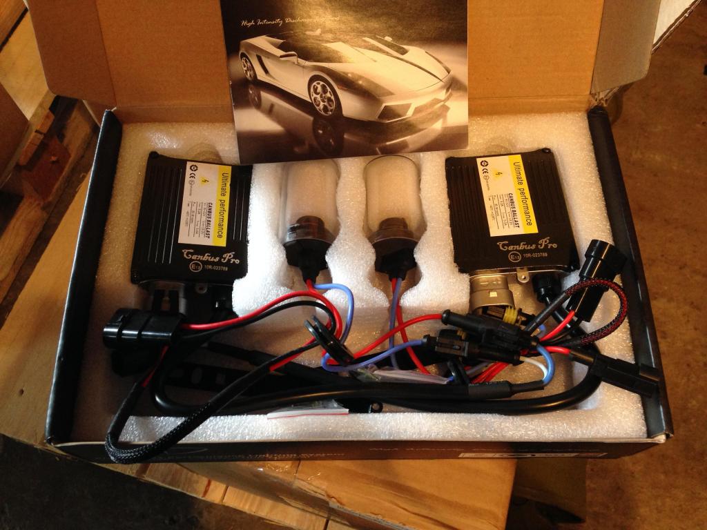

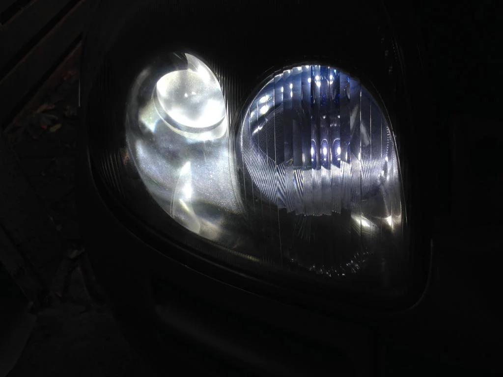

Didn't trust the eBay kits, so got one from HIDs Direct instead. Bit more expensive, but I figured it was worth it for the warranty and lower probability of my car being set on fire 😂
Didn't realise how simple it would be to fit. Literally just a case of swapping the bulbs over and plugging in some wires in different locations to usual!
Figured that by paying a bit more, it would be a quality kit. After fitting, I turned them on only to find one of the bulbs was flickering on startup! Fine once warmed up, but they flicker a lot on start up. Swapped ballasts, and it's definitely the bulb, so I've contacted HID's Direct and hopefully they can send me out another set. At least I know the ballasts aren't at fault, but I'm still a bit pissed that there's an issue with the kit to begin with.
Old halogen bulbs:
New 5000k HID bulb:
Fitted my yellow fog light bulbs after this. I know this wont be to everyone's taste, but the ph1 fog lights are big enough to work well, and I liked the idea of having some yellow light for low visibility without using tint film, so as to keep it more standard looking. Drivers side fog has the yellow bulb in both photos below. Also both HID bulbs are fitted at this point.

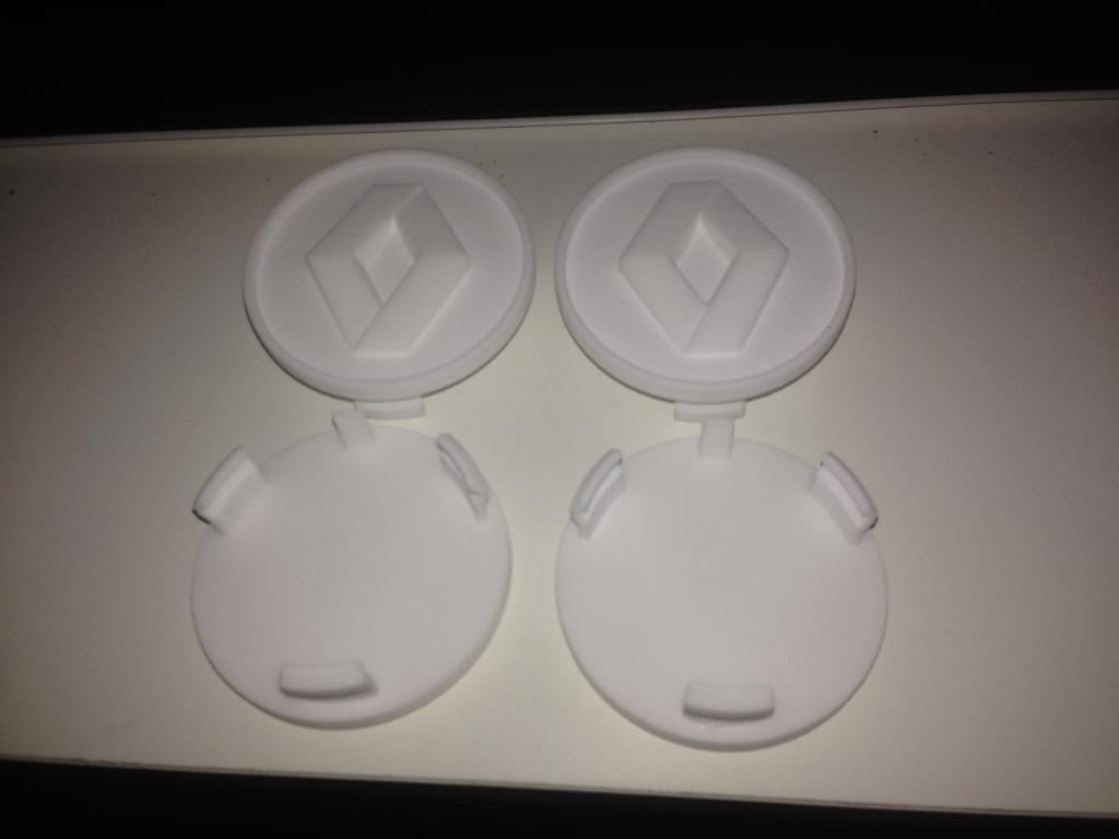

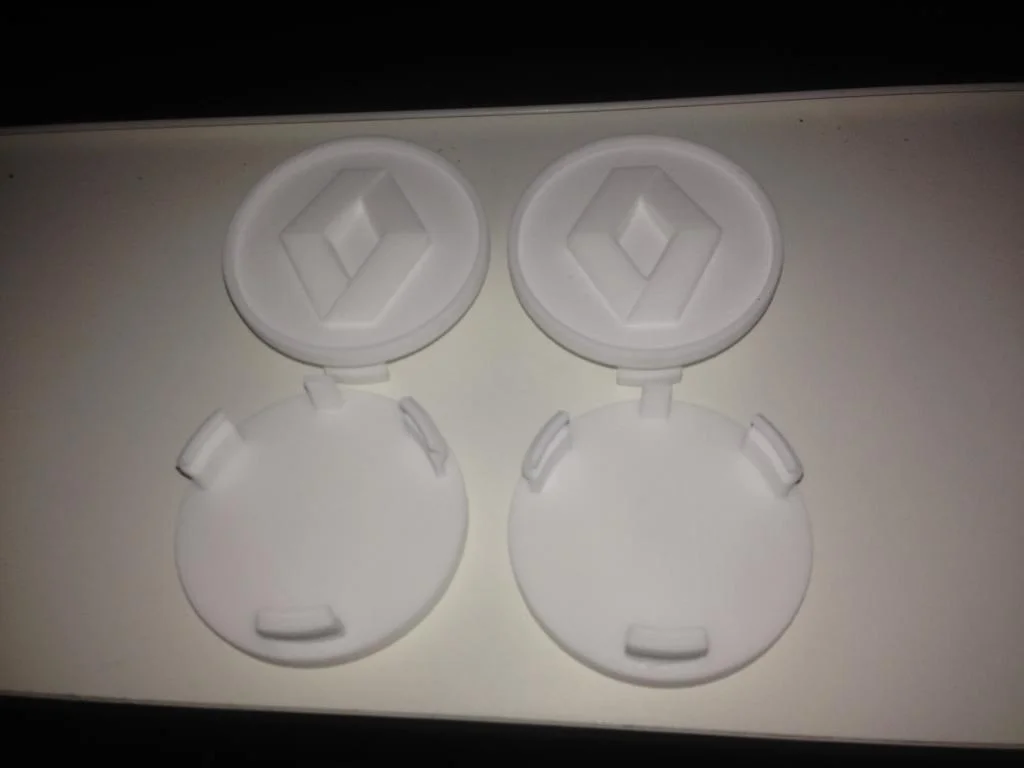

Oh, and saving the coolest for last. My 3D printed centre caps for the F1's arrived! Well impressed with these. Just need to get them painted.

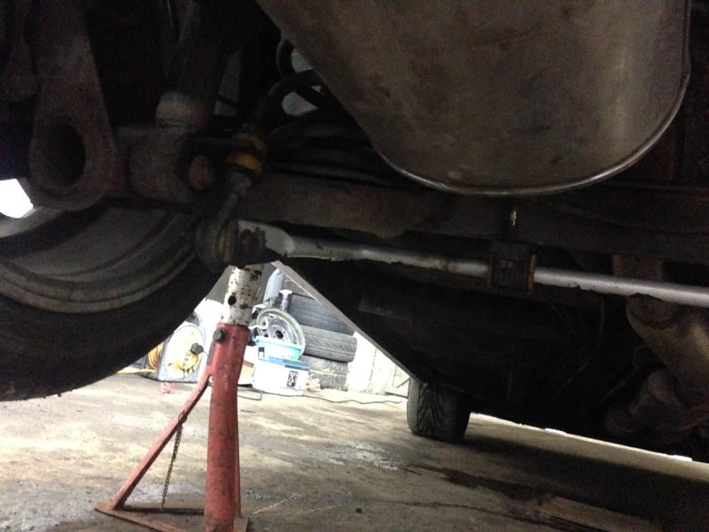

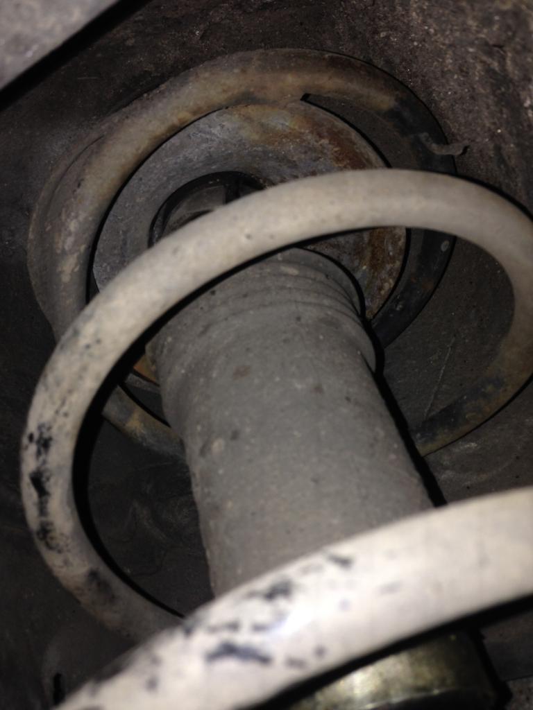

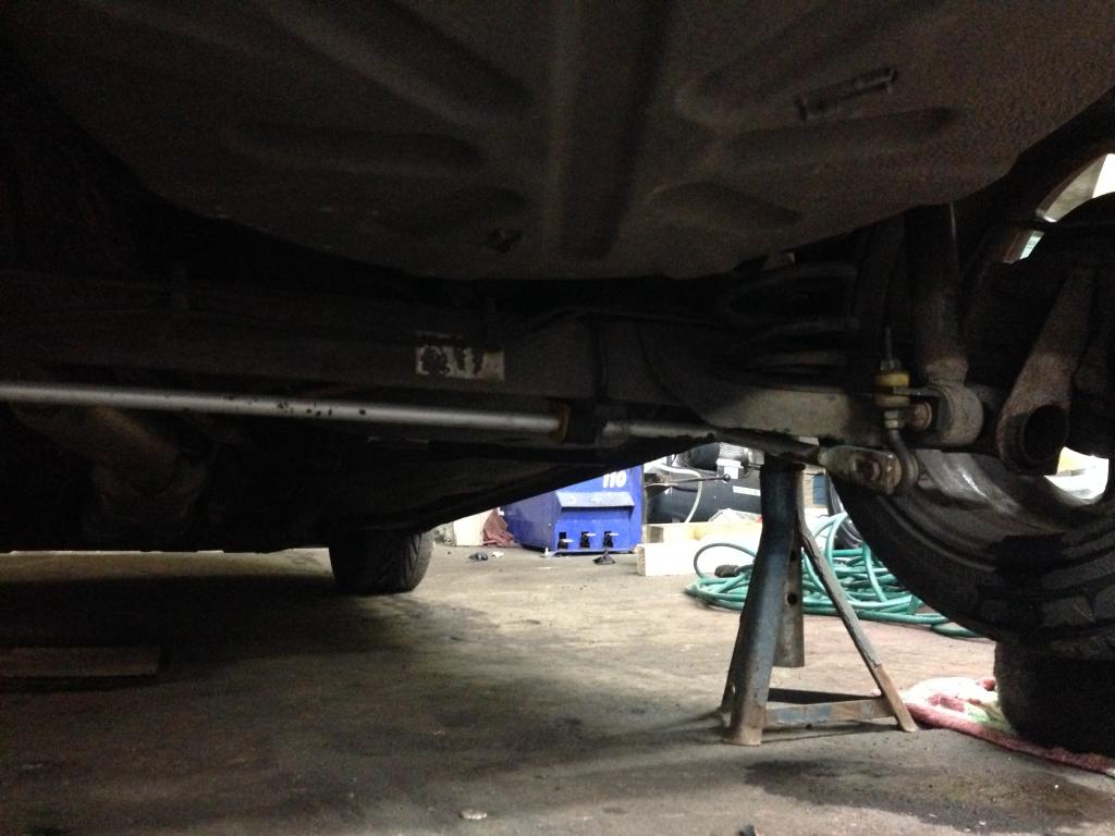

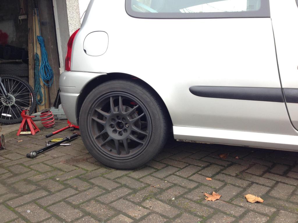

Little bit of progress. Bought a Whiteline rear arb off @Fraser.J. so popped over to his unit and managed to get him to fit it for me today. Quite impressed with the handling now. Can definitely feel a difference and currently got it on the softer of the two settings. Might try changing it at some point.
Couple of pics:

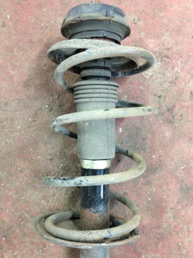

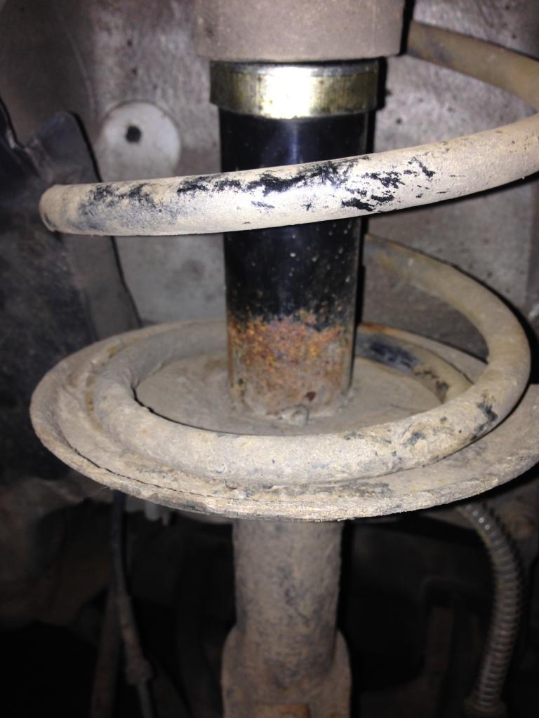

So after that I mentioned I had a clunking noise (mentioned this in OP, and I thought it was the steering rack/rack bushes), but found out it was actually the spring not seated properly. Got the car jacked up to have a look, and was greeted by this:
Looks like the completely wrong spring had been fitted to the car, but no, looked up to the top and saw this:
Yup...spring was fitted upside down! Passed an MOT like that last month as well! So Fraser very kindly agreed to take the shock off and turn the spring round as I didn't really fancy driving home with it like that. The full extent of the problem could be seen once we had the shock off.
So with that sorted, and the Whiteline fitted, the car is now handling better than ever, and there's no clunking from the steering/suspension either!

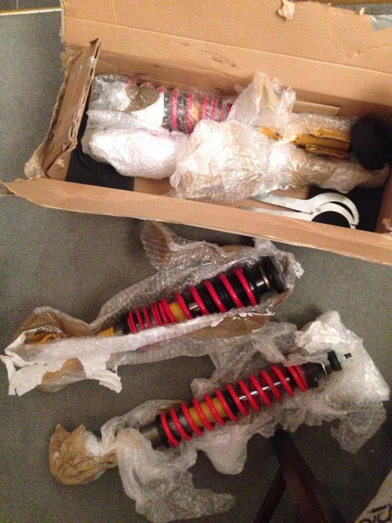

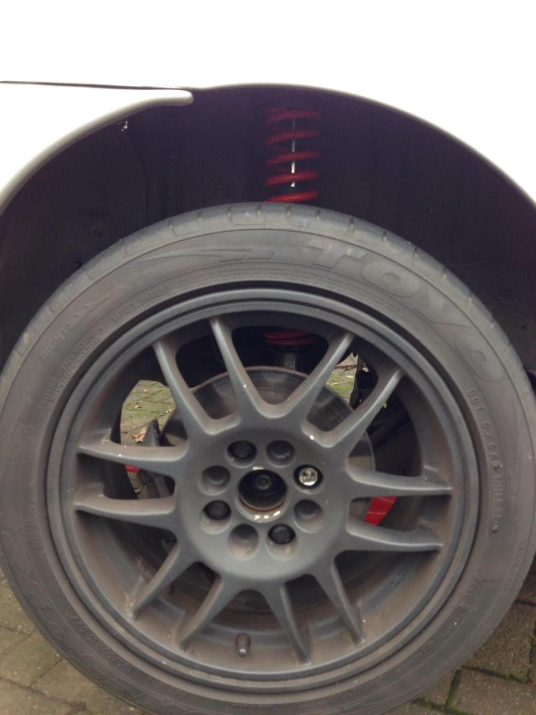

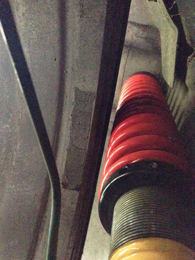

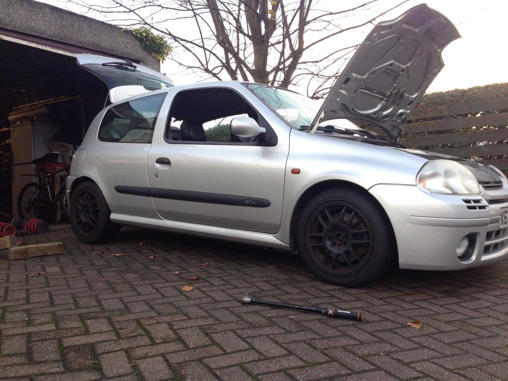

So since I last updated this I've managed to fit a set of sportlines in order to get rid of that dodgy as f**k spring above! They didn't last long though, as I got a bit of a bargain on these!
Spax RSX, full coilover setups all round. Cracked on today and got them fitted. Ended up nice and close to the tyre on the rear ones! Think some spacers are in order.
And fitted
No pics of fitting the fronts but the car is currently sitting like this now
Pretty much the same as when I had the sportlines on it from what I can tell. Will probably wind it down further when I get time, but it's fine for now. Pretty impressive with the ride on them too. 12 clicks from soft and it's still a really comfy ride which is good for the roads round my way.

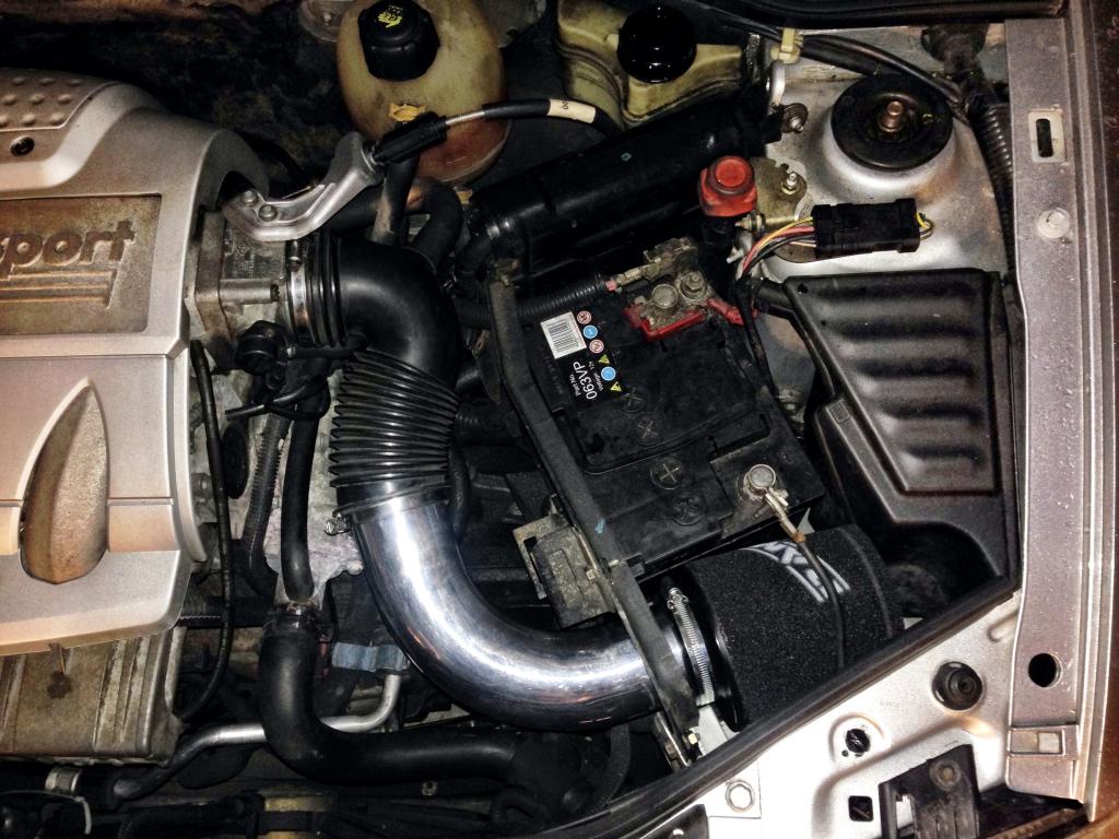

Couple of other jobs I've done now. Firstly, bought and fitted @The Fatty's induction kit setup. It sounds f**king awesome. Almost like throttle bodies!

Induction kit is pretty sweet. I'm unsure on any difference in power but the noise is great! I'm tempted to test it against the standard airbox on a rolling road. Just need to find the time.

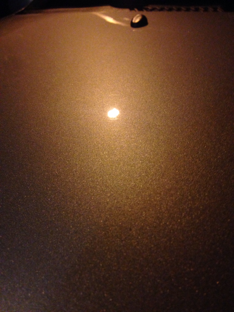

Boring 'not-so-track-car' update, but after buying myself a DA at the end of last week, I attacked the front end to try and bring it up a bit, remove a few marks, and generally get it covered in some form of protection if it's going to be sitting over winter.
Bonnet came up reasonably well (s**t iphone photo in the dark, but the flake is pretty impressive on it now). Polished with menzerna 203s, then tripple by DA and 2 layers of tough coat.
Full car will be getting done at some point to try and rid it of some scratches and basically use it as a practice for polishing since if I f**k anything up I won't be caring!
