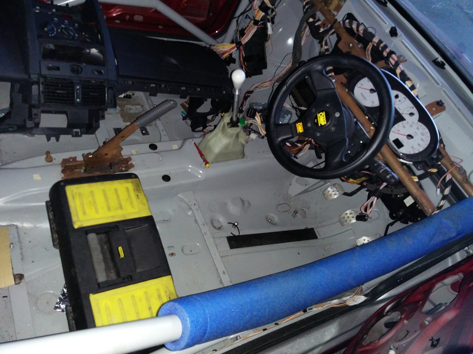

Dash also comes out a piece of piss as its cut in half behind the clocks and under the steering column.

Thank f**k that dash comes out easy then. I'm lazy and impatient, which was half the problem taking the old one out!

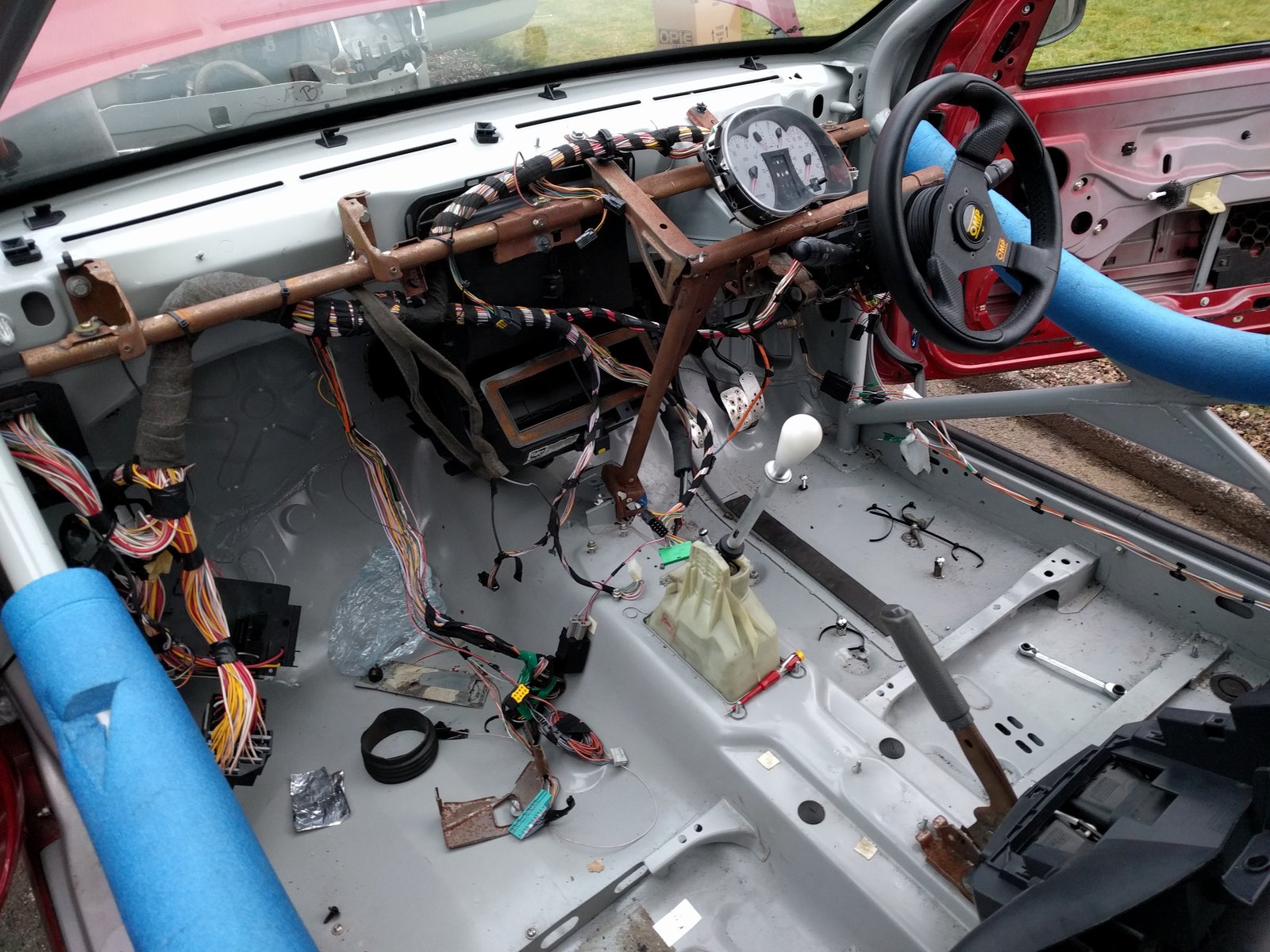

Gives a shout if your needing any wiring diagrams mate.
Cheers mate, I've got the system for them all but it's kind of hit or miss with what diagrams are applicable to what models so will keep that in mind!
PH1s are pretty hit and miss whether the ABS lights pops up when you remove them, my ABS is gone and with no warning light.
Weird! Both I've seen have the ABS lights and the STOP and handbrake lights on. Have you completely done away with the full ABS loom from the fuse box to the multiplug on the pump and abs sensors?
Ohhh yeah! although snipped the wires at the hubs as cba to remove the sensor from the hub! haha
andd yeah I've got the stop and handbrake light on because I've removed the handbrake wires and the airbag light is on causing the stop light to come on.. but no ABS light on.
Gonna start pulling some bulbs I think.
Hmm, I'll hope for the best then lol!
You should be able to bridge a couple of wires behind the dash to get rid of the stop and handbrake light I think btw, going from what I could make out on the wiring diagrams anyway.
A couple you say.. any more specific? ;)
Yeah I've had a play earthing a few wires from the airbag eco with my electrical probe with no luck.
Not got the diagrams to have a look at just now but I THINK you just need to make sure the wire that used to go to the handbrake is earthed. Looks like the handbrake switch is just a simple make/break which breaks the circuit when you lift the handbrake and throws up the light.
That wire should go all the way back to the main bulkhead connector. Not sure how far back you've cut it.
Ohhh right, I doubt I would of cut it far back tbh as I haven't properly sorted the wires on it yet, and don't have the foggiest of what wire it was.
Lol! Well if you can't find the wire, it connects into the clocks so once I find the right pinout, could just cut that wire in the loom and earth it behind the dash (providing it actually works anyway!)
Been a productive day! Got the heater matrix all transferred over and connected up, sorted out some wiring in the car, fitted everything under the scuttle panel like the wiper linkage and blower motor etc and sorted out my heated screen wiring so that just needs a few final connections on it.

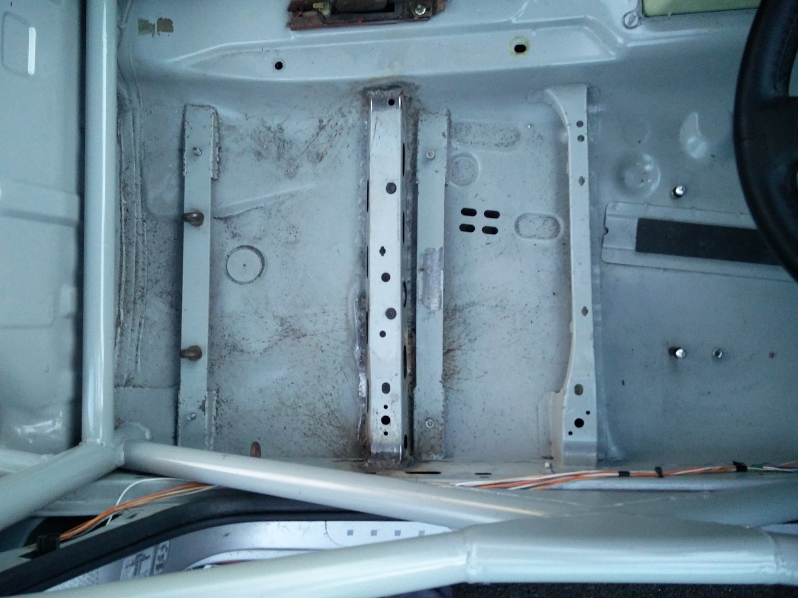

Only big issue just now is the fact the original seat mounting points have been removed and the ones in place are designed for cup racer side mounts. Mine don't fit so I have no way of getting a seat into it just now lol
We have cup racer side mounts....
But can't remember how tall you are! They've been cut down and Dave was too far away by miles. You're welcome to try them and buy if they work and return them if they don't
Somewhere between you and Dave lol. About 5'10".
I'm thinking of trying to make something work with the sliders I have for my seats. If I can get them to fit, even with making up some sort of adaptor plates it'll hopefully bring me in close enough to reach the pedals!
If not though I'll probably grab the side mounts from you and give those a go!

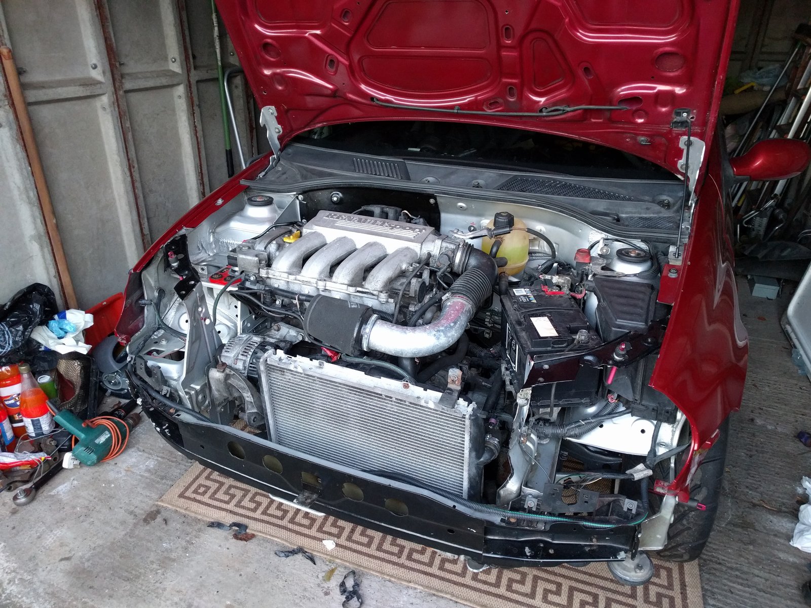

Forgot I done some work last night. Fitted the radiator, got coolant into it and got the other driveshaft on so it actually moves now. Got some photos too!
Heater matrix in place. Need to relocate some wiring to make the dash fit again
Temporary drivers seat...
Radiator etc all in place
Looking like a finished car once again!

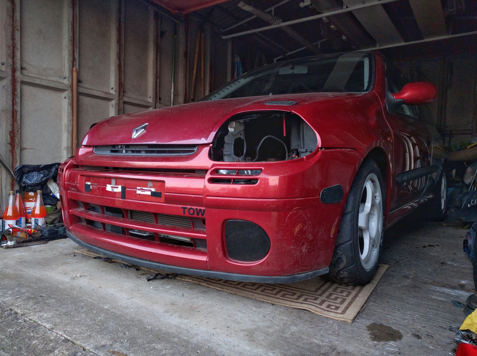

Been a long two days but I've made it! Car is ready to go for it's MOT tomorrow.
Wednesday night was spent getting the original mounting point welded back into the car to fit my subframes onto. Only had a gasless MIG welder available but it's still turned out OK. Didn't run a weld the full way along the rail thing, just enough to be secure and safe. Didn't have much choice really as after a while we managed to set a fairly large amount of underseal on fire under the car that wasn't exactly miles from the fuel lines 😂😂. Called it a day at that!
Today was hectic to say the least. Started off getting my seat in place and mounting the harness properly. Then spent the rest of the morning attempting the inner ARB bushes (powerflex black series ones). f**k. Me. What a horrendous job. Got one side in using a big pry bar to lever it in place. The other side I just admitted defeat and used a long ass bolt to pull it in. I never want to do a set of those again in my life!
Didn't exactly start the day looking like a car ready for an MOT...lol

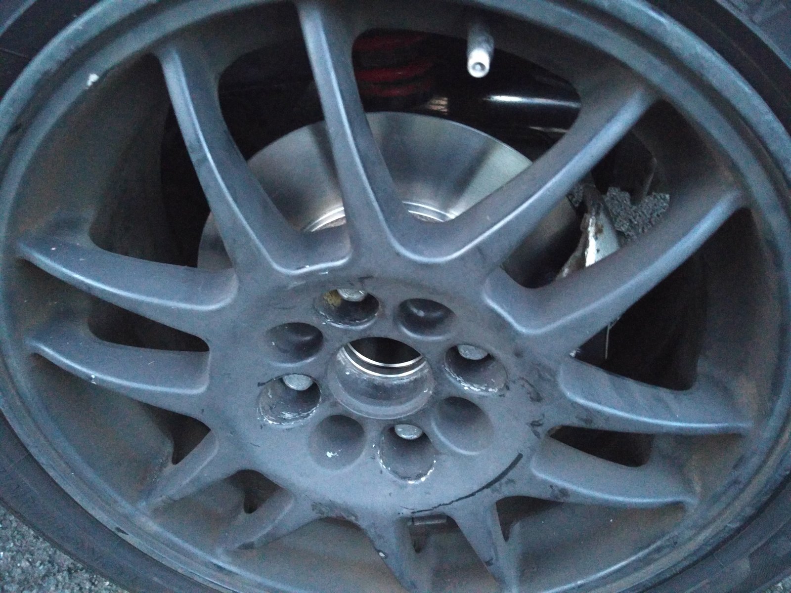

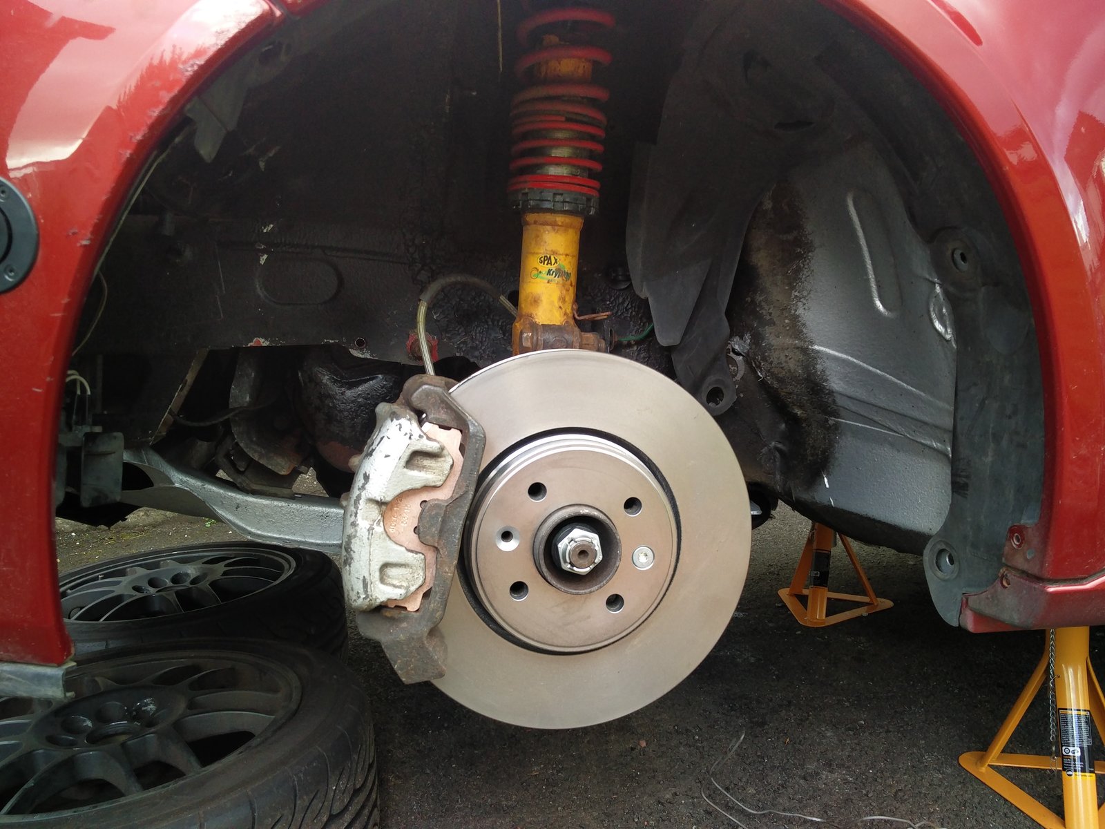

Rear brakes were next up as I still didn't have my front hubs back with new bearings. Rear discs and pads all went on fairly easy. Shiny! P.S. Yes I am in dire need of a wheel refurb!
Went away and collected the front hubs and got some number plates made up, got a text while I was out saying my brake pads had arrived.
Decided to step up from the RC5's I had last year!
Picked those up on my way back and got cracking with the front end. Hubs refitted, discs and pads on surprisingly easy again. Piston pushed back so easily compared with the last time I changed my pads. Fitting them took all of about 30 seconds!
Final things to do after that were all just little annoying things. Had to fit a couple of bulbs, rewire the rear number plate light back up, check all my lights, top up the oil (still due a service), basic spanner check of everything (feel like I've definitely missed things), adjust the gear linkage, fit the wipers and pipe up the washer jets. It's finally done though, back on the road wheels and sitting on all 4 of them for once!
Just need to phone up Greenlight to sort insurance in the morning and tax it and it's ready to go. Ideally it still needs the alignment done but I'll get it running fairly straight by eye for now, until I refit the camber bolts and get my PMS top mounts on, then it can get proper alignment done.
Track night booked for Monday but I'll really just be using it to learn the car again and make sure it's running right and all back in one piece properly, so not fussed about getting it all properly set up etc before then. Although tbh, I just can't wait to get back out in it. Been off the road for too long!
