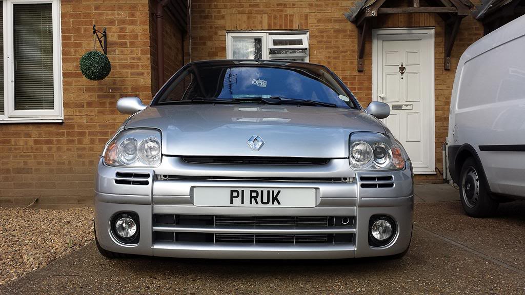

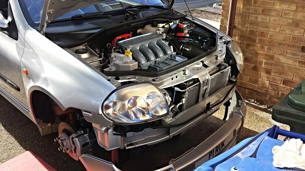

Took the cover off today.
Kind of forgot how it looks, made me fall back in love with the thing.
Looks amazing, Billies look great! Kinda of wish you went with BC and had the gold bits powder coated silver, would've tied in with the theme of the car nicely.

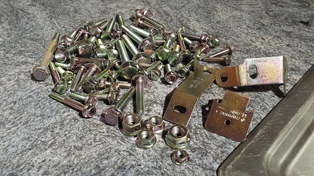

What silver did you get your top engine mount and A/C brackets powder coated. Whilst my engine is out I'm going to get them done quickly.

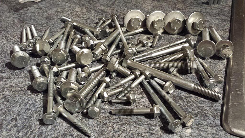

They hang the bolts up and run electricity through it.
The plating is a liquid and then is attracted to it.
There are videos on YouTube mate if you want to see.
And no it won't flake off or causes any problems with the thread's. :cool:

I'll have a look on Youtube now, sounds very interesting. Still can't understand how it doesn't affect threads or flake off though lol :o:o
If you imagine the plating as a colour mate, its not like chrome.
The build it gives is in microns and its not expensive, although I cleaned every nut and bolt on the wire wheel at work before I sent it away to grantee a good finish.
Worth the prep work for any chance of a better finish!!
Looking on the Tube now. Is this Zinc plating?
Yes mate.
And yes I wanted a perfect finish so my time spent on the wire wheel was fine.
Just ended up taking so long.

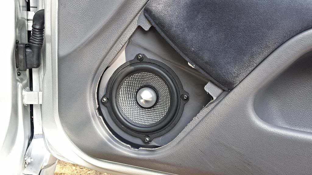

I decided to up grade the audio in the car and being as my HU wouldn't low pass the speakers it meant that i need to run a 5 ch amp which had these controls in it.
This was my choice, no sub yet. Once what i have is fitted then i will be taking the car to the shop and trying a few subs in the boot to see what i like.

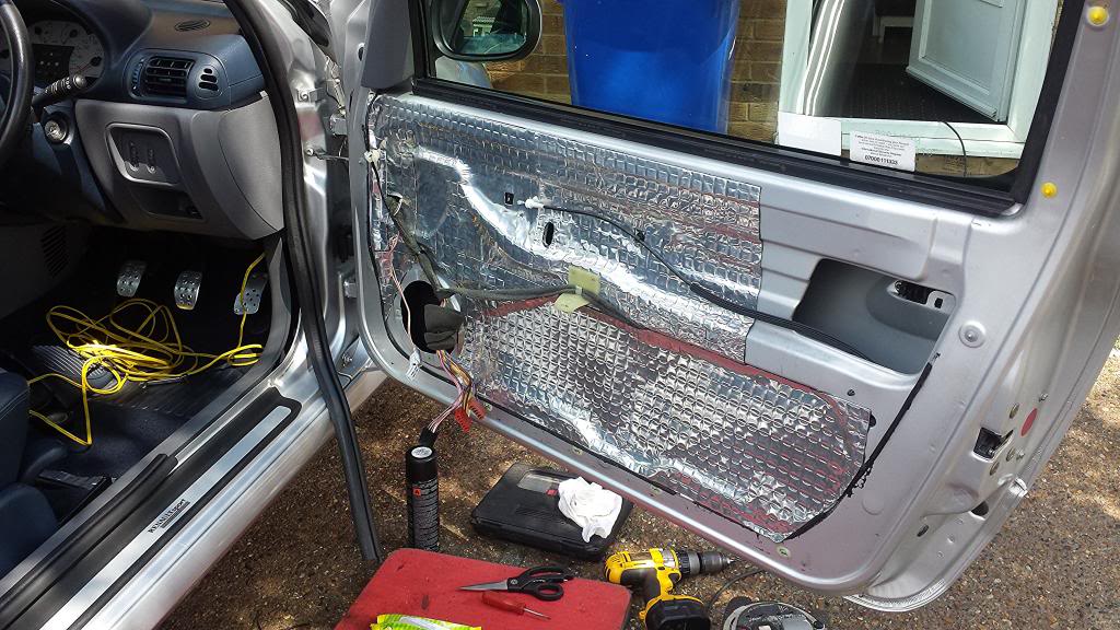

Started to sound deaden the doors.

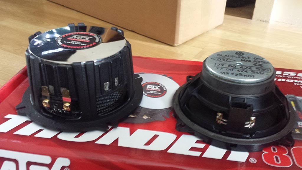

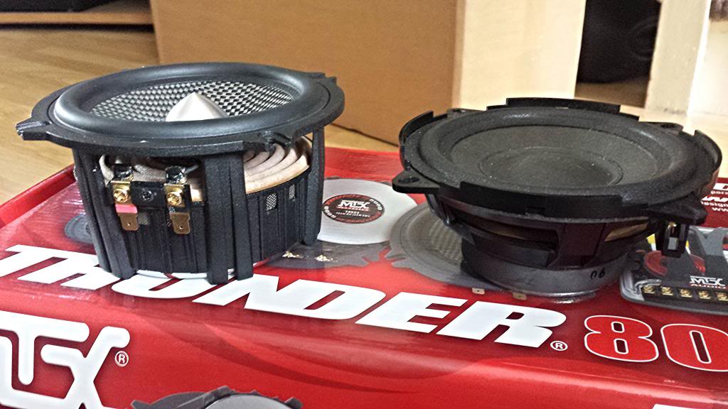

The MTX components are a little bit bigger.
All fitted after a bit of messing about.

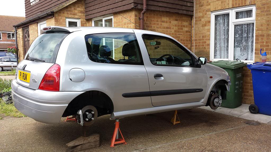

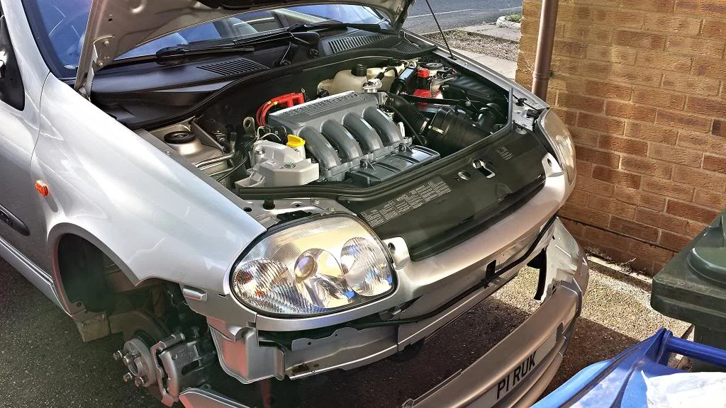

So yesterday i wanted to get it back on its wheels as it is booked in for its MOT 1st thing Monday morning.
Slam panel fitted.

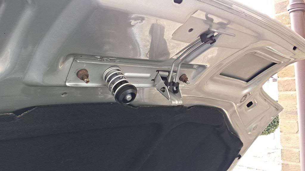

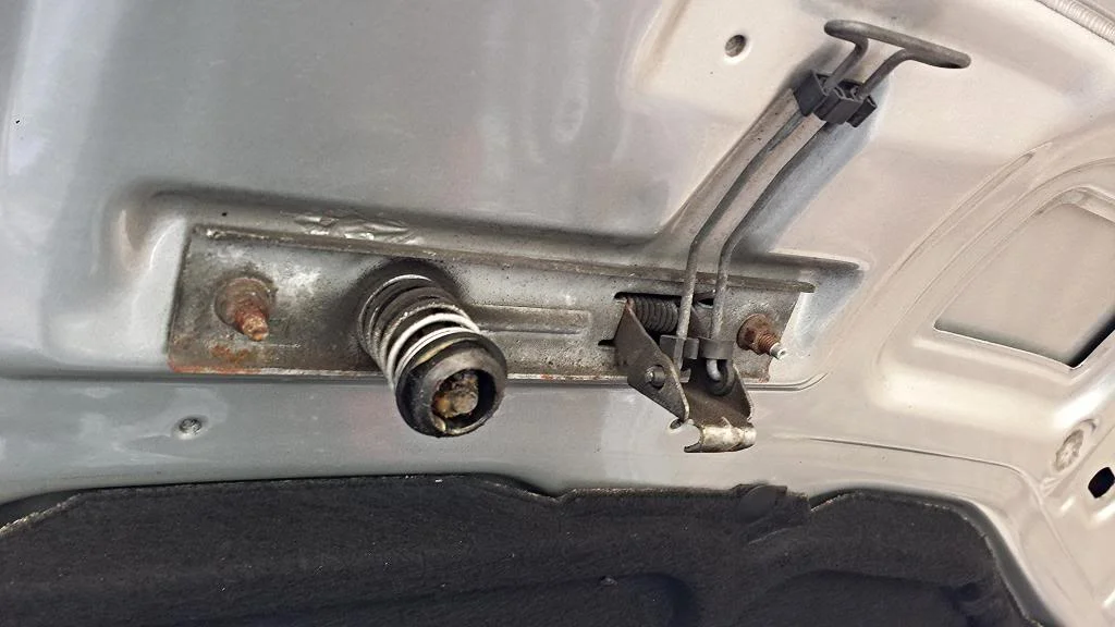

The bonnet catch was looking a bit rusty.
New one fitted (yes the rusty nuts will be getting replaced)

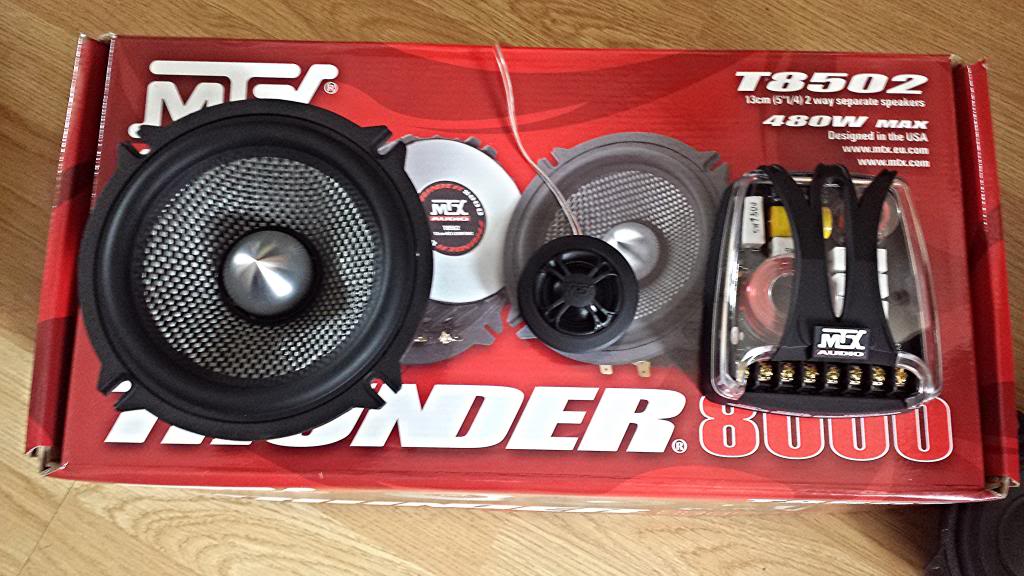

I went to see my mates at Pulse car audio, i'm sure they only had two sets in stock.
Getting MTX stuff in the UK is meant to be hard. (that's what i was told)
