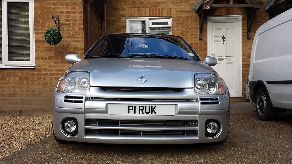

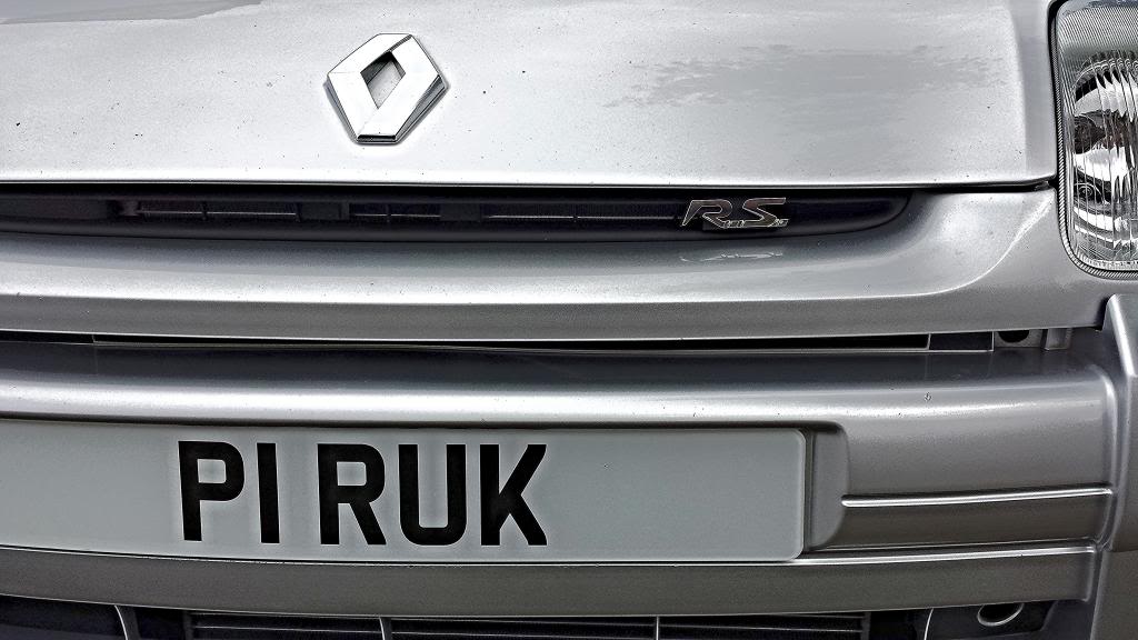

Great number plate!!
Cheers matey.
looks so fat from the front! :)
hope the MOT goes smoothly
I love the front of the PH1.
Thanks mate, it passed with flying colours. :race:
That plate would look perfect on my Impreza P1! ;)
Looks good where it is too tbh. lol
Im so glad i bought the plate tbh, i did have to think long and hard though but i would have been gutted if id of missed it.
After seeing a Luna grey V6 with V6 RUK it just had to be done. :)
Outstanding work!
Thank you mate. :eek:

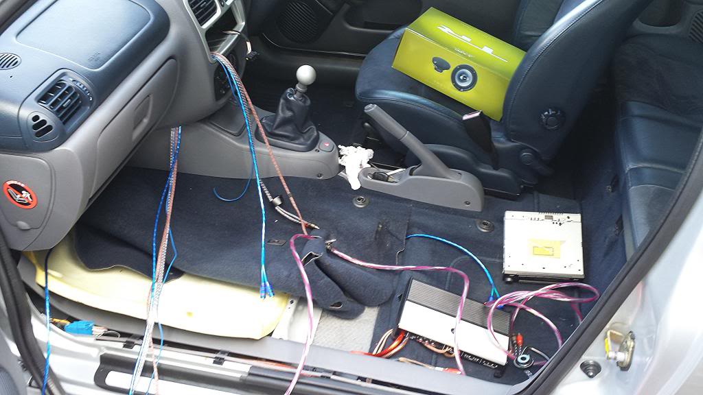

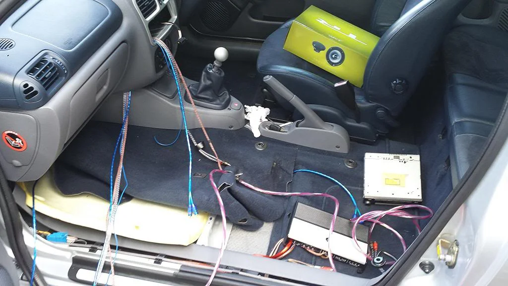

Running all of the cables for the amp, what a pain in the ass to do. Even more so in the baking sunshine but i got there in the end.

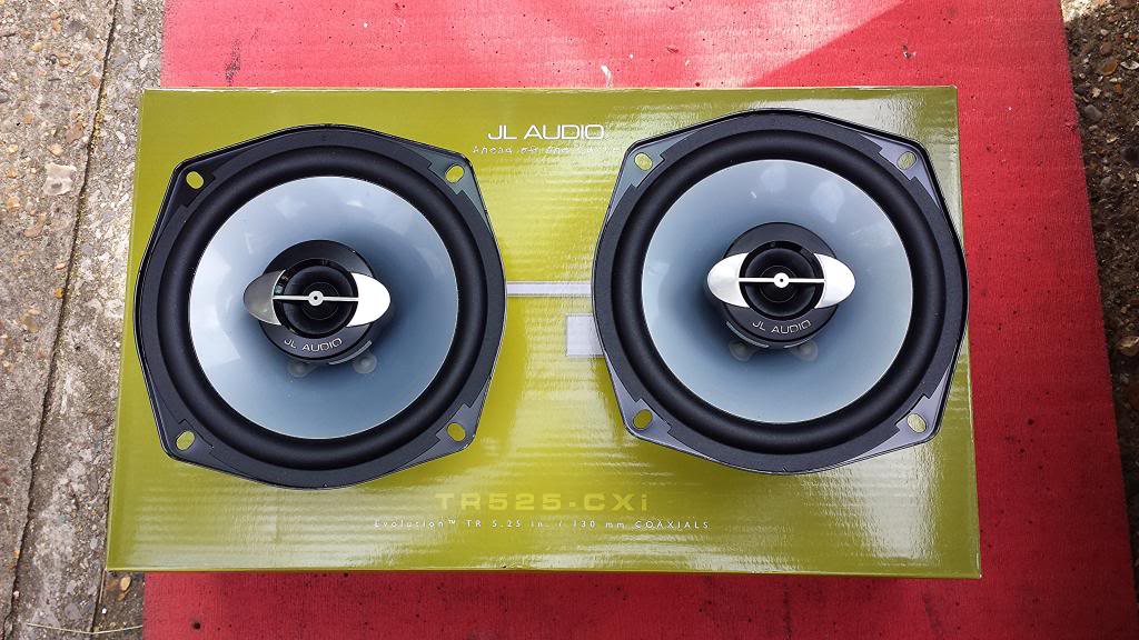

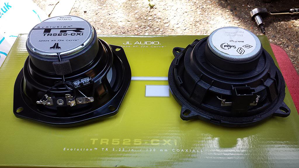

I decided to go with the JL's in the rear. Such a big difference to the standard speakers.

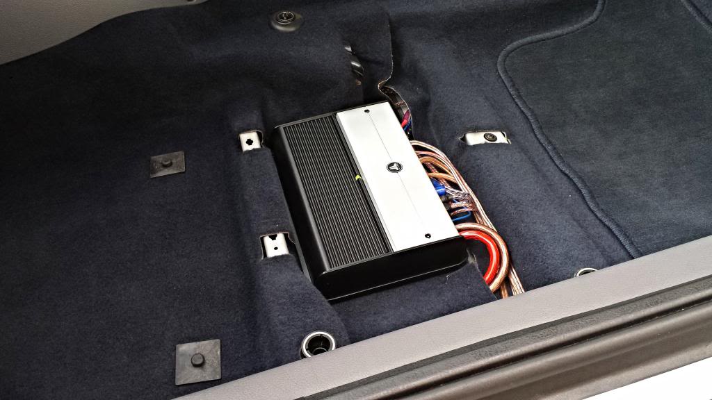

I finished off fitting the amp and had a play trying to set it all up for the best sound.
So far im very happy, the sound is so much better than the Renault stuff.

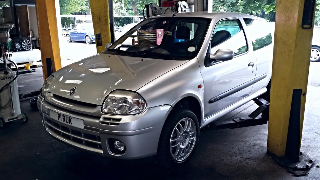

So today was the cars MOT day, the MOT ran out in November last year.
It was booked in for 9am, i shot off to Asda in my van to buy 2 trays of doughnuts (the cost to mot it with a de-cat)
Got back home and started the car only for it to turn over a little slow, thought nothing of it as id been messing with the audio for quite some time the day before.
Anyhow almost got to the mot station when the car cut out because its not been mapped yet (or so i thought) managed to re-start the car as it was rolling down hill, it didn't seem to want to turn over on the key.
Once id got to the mot station i switched it off and tried to start it again, no joy it was dead!!! :dapprove:
We had to run the car on a jump pack to get it through the MOT, the guys did a alternator test and it was dead.

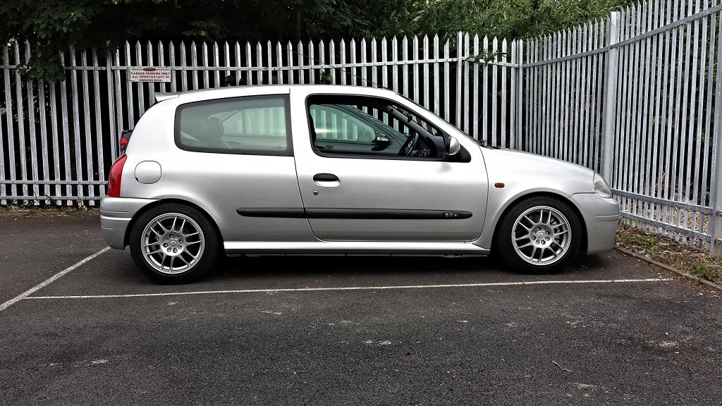

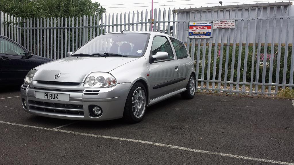

A quick picture from today.
This car is awesome. Just picked myself up a PH1. Booked into RS for the belts doing but my bodywork is so ropey! Two lady owners both on disability. Only 41K on the clock though and inside is immaculate. I'll be using yours as inspiration.

such a big improvement over standard aint it. got all mine sorted
got the tweeters sorted yesterday. just need an amp now
did you get the JL's from pulse in the end
Yes i did dude, bought it all from them apart from the Becker HU. :)

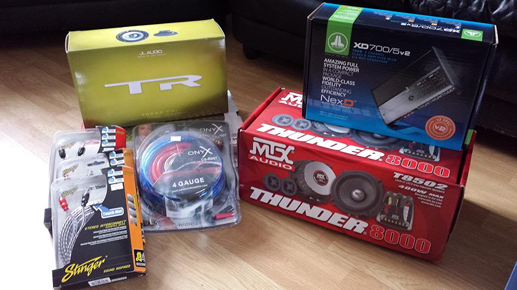

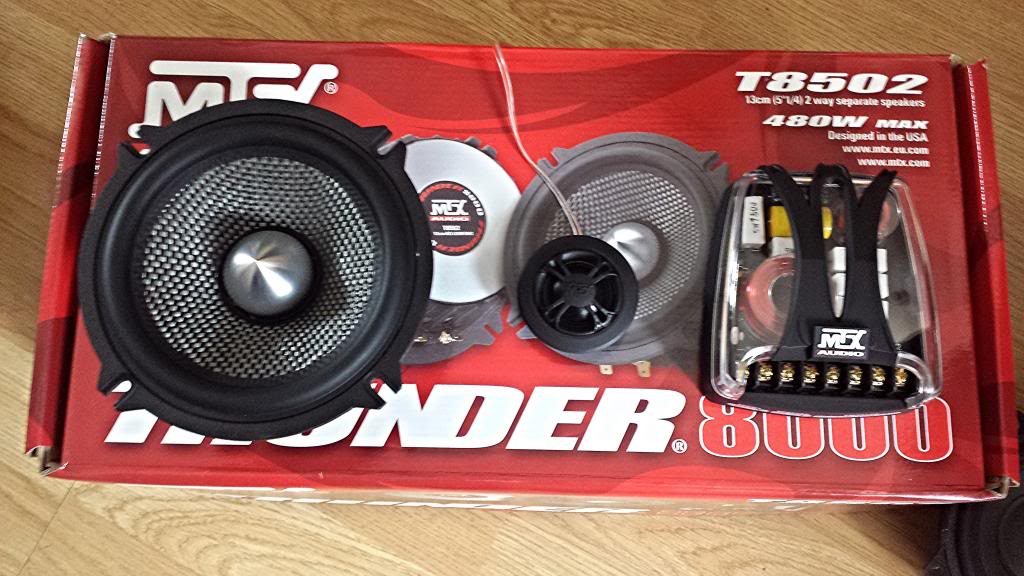

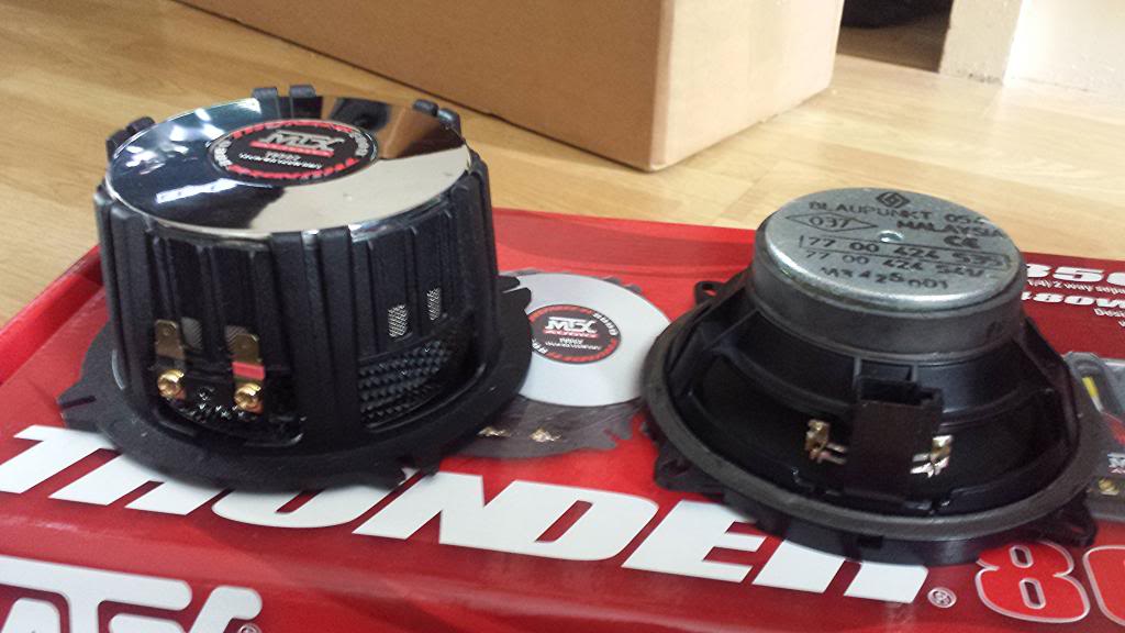

I decided to up grade the audio in the car and being as my HU wouldn't low pass the speakers it meant that i need to run a 5 ch amp which had these controls in it.
This was my choice, no sub yet. Once what i have is fitted then i will be taking the car to the shop and trying a few subs in the boot to see what i like.

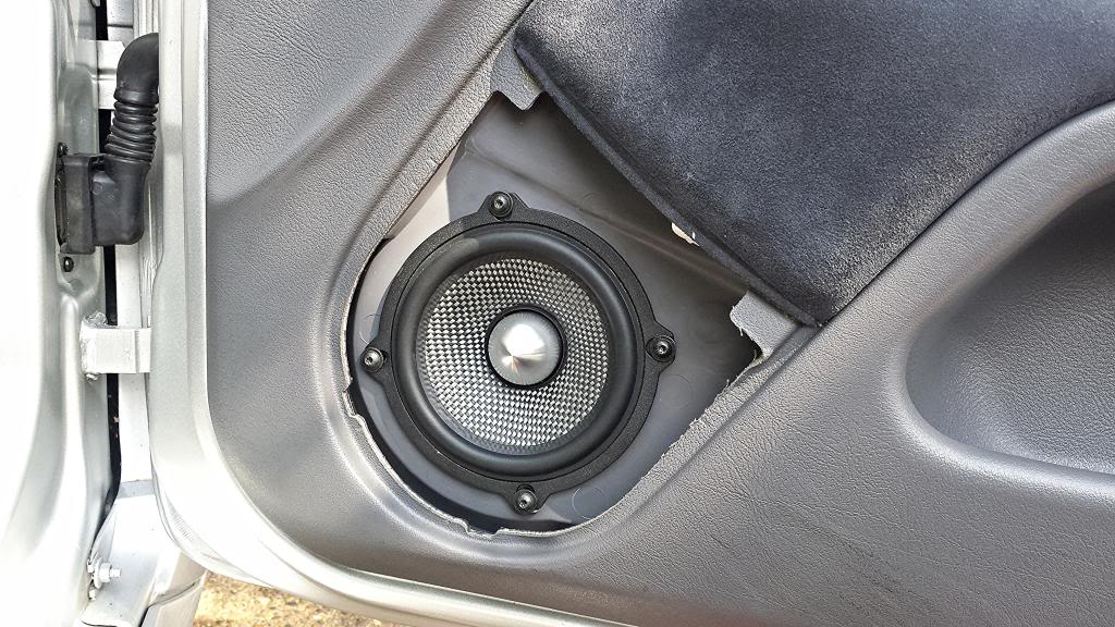

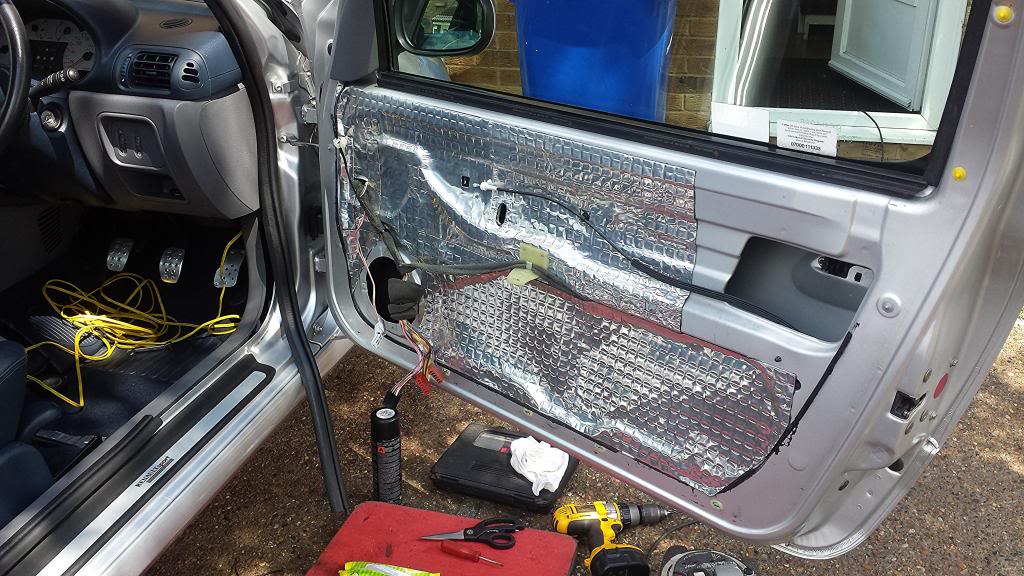

Started to sound deaden the doors.

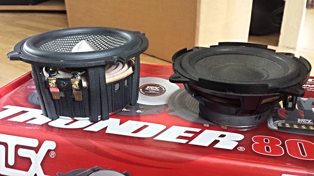

The MTX components are a little bit bigger.
All fitted after a bit of messing about.

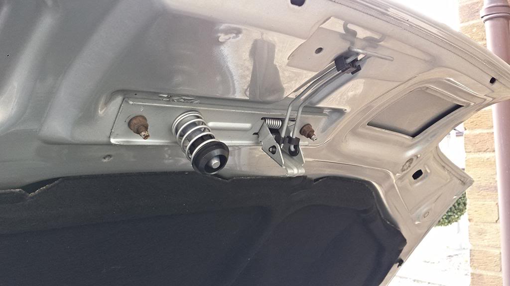

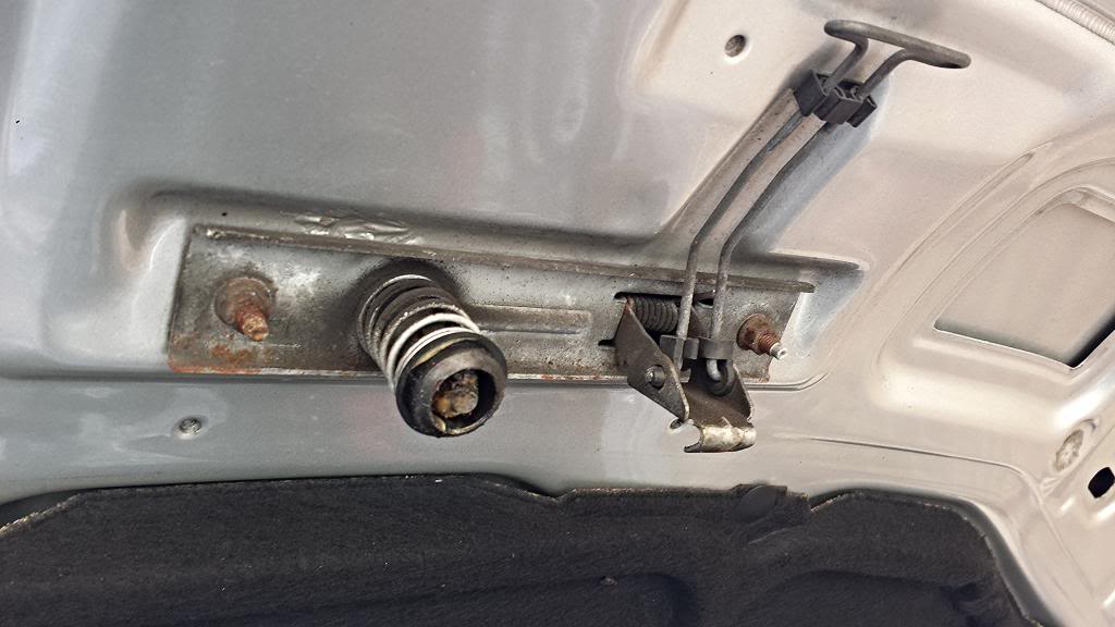

The bonnet catch was looking a bit rusty.
New one fitted (yes the rusty nuts will be getting replaced)

mate them MTX components look the nuts. the size of that magnet :)
:approve:
Yep they are rather large dude and only just fit. :eek:

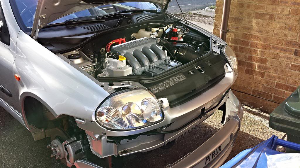

After chatting with my mate at work who knows all about this project and the things that i have been doing to it, he asked me if i had cleaned off the powder coating where it meets the alternator.
So after checking for resistance i found that i had 0.2 ohms from a bolt on the engine to the battery earth lead but i had 6.8 ohms from the alternators bottom bolt to the battery earth lead.
Yeah that will be the problem then, what a dick!!!
So i have cancelled the new alt from Renault and i will pulling the car to bits on Friday after work to clean off the powder coating. :)

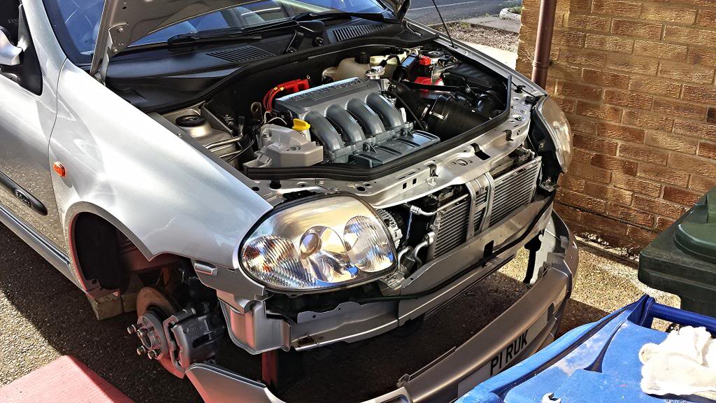

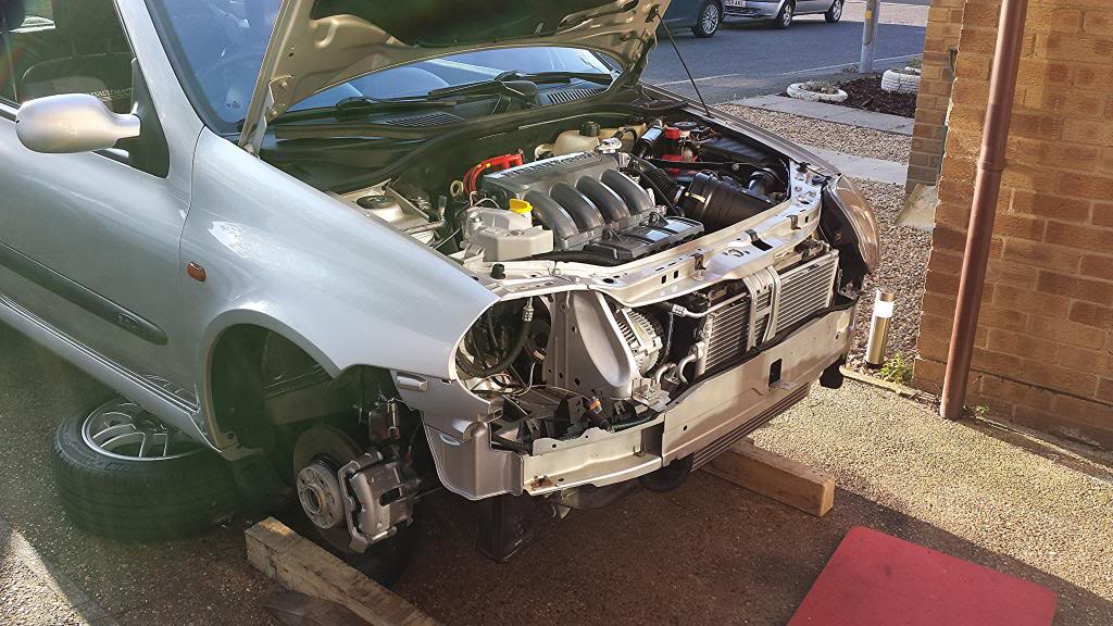

So yesterday after work the car ended up looking like this. :(
I removed the alternator, cleaned the powder coating off and then tested it with the meter.
All good and back down to 0.2 ohms and up to 14 v when running, proper pain in the ass and a problem i could have done without.

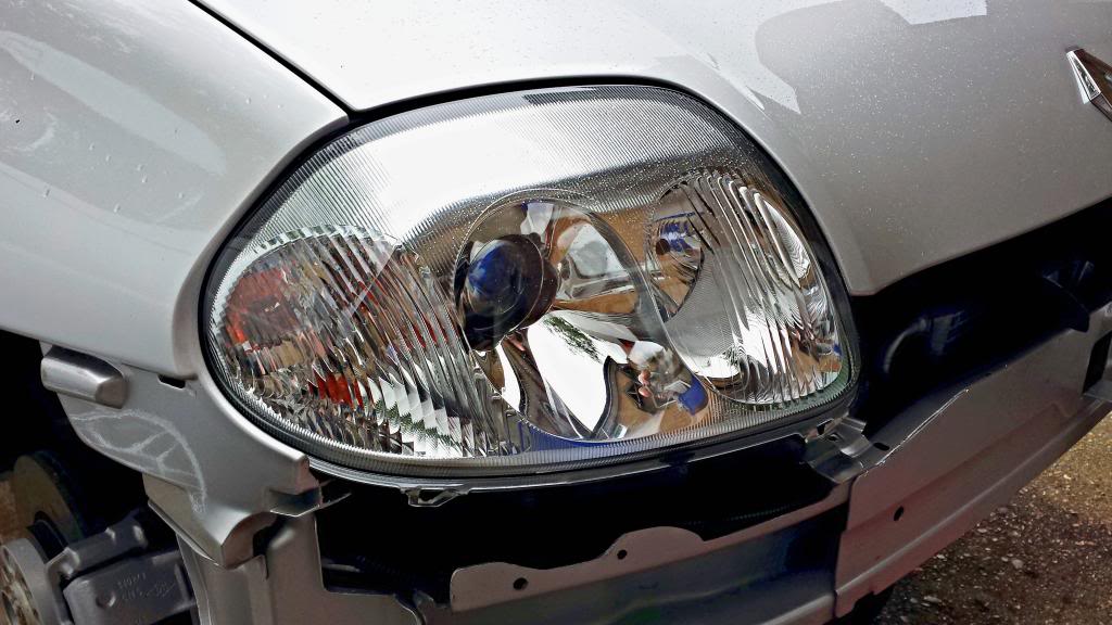

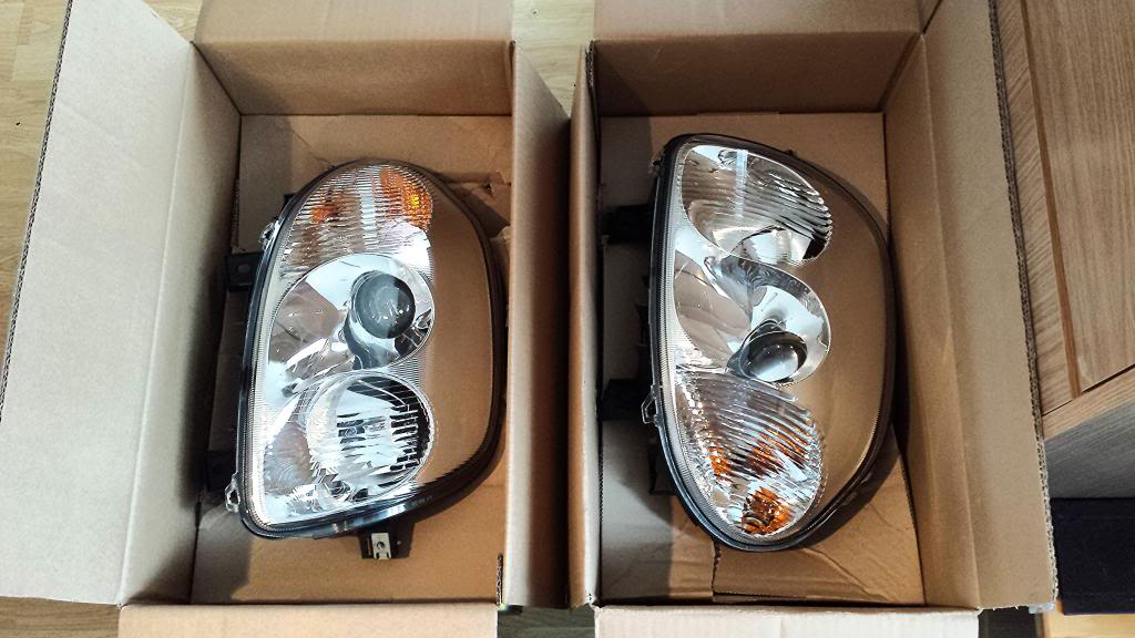

But these arrived at work, i ordered them 2 weeks ago from Renault but the 1st pair arrived smashed.
This pair had to come direct from France.

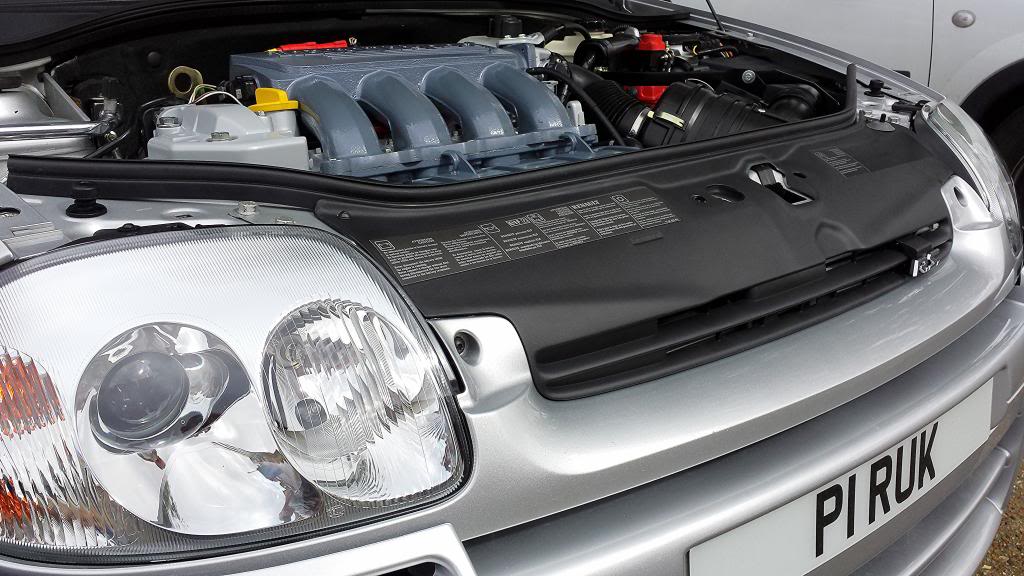

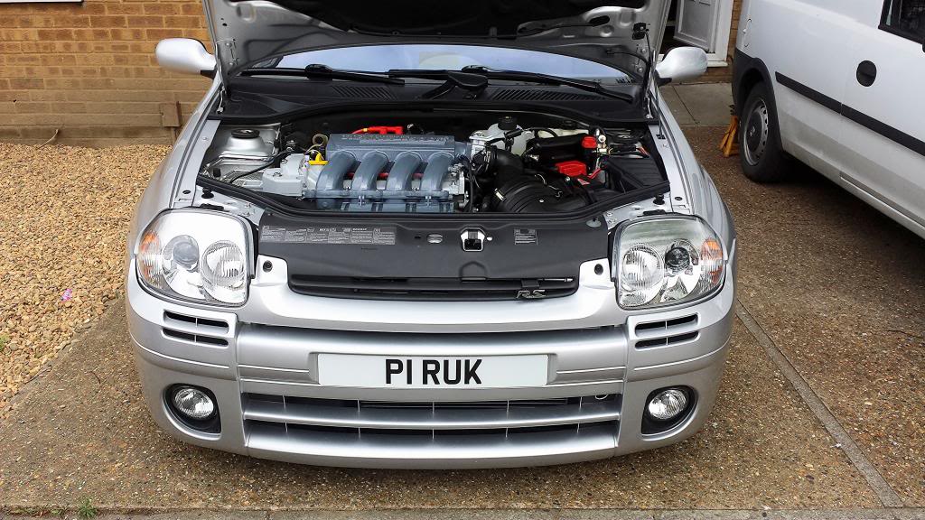

Fitted, looking so much better.
My lights where good but the sliver backing was starting to show signs of age.

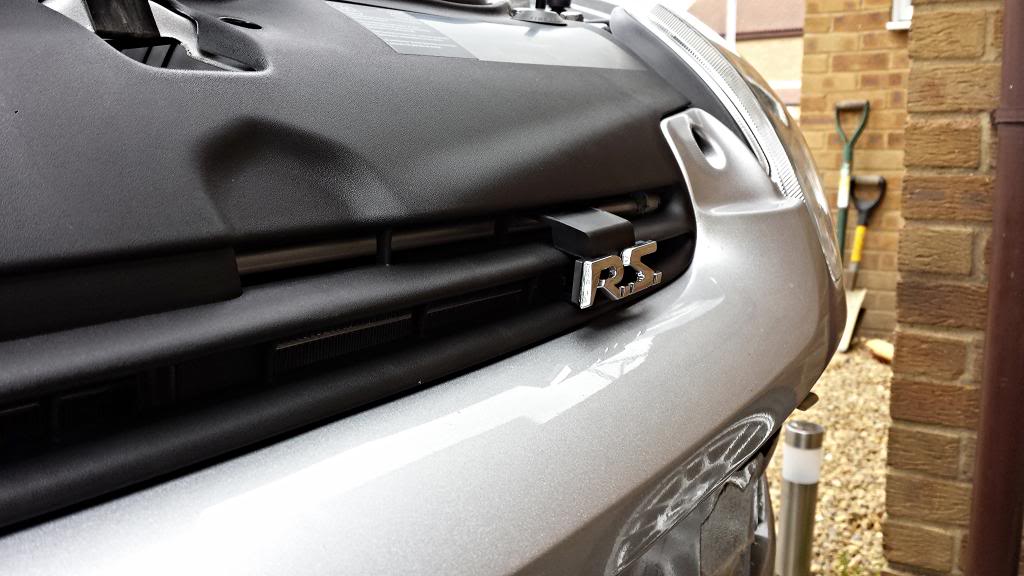

After seeing Craig's sunflower i liked the RS badge that he had fitted to the grill.
I ordered one from Renault and set about making it fit my car.

f**k sakes, theres not enough ways to say Brilliant/awesome/epic/amazing etc.
Comparing those headlights, I can see why you were being picky. Would it be too much to say silvertec bulbs? or do you want to slap me for that?
Also, you know how cars reflect the owner, everytime I see the front of your Clio, I just think of your face.

I must admit I'm surprised at you putting the new style badge on the grill.
Cars looking great though dude.

Do i need to give you my answer on the bulbs?!?!?! :banghead:
Yeah i know, shocking mate.
Next will be a PH2 boot, rear bumper and side strips. Flol :rasp:
Don't worry mate nothing else is going to be fitted to the car, i think its just a nice little touch.

The difference with the new headlights is huge!
The badge is a nice touch, I was going to do it to mine but I no longer have a grille to do it to :p
Thanks Tom, yes mate i thought my head lights where pretty mint until i bought these.
It is a nice touch mate, nice and subtle :)
