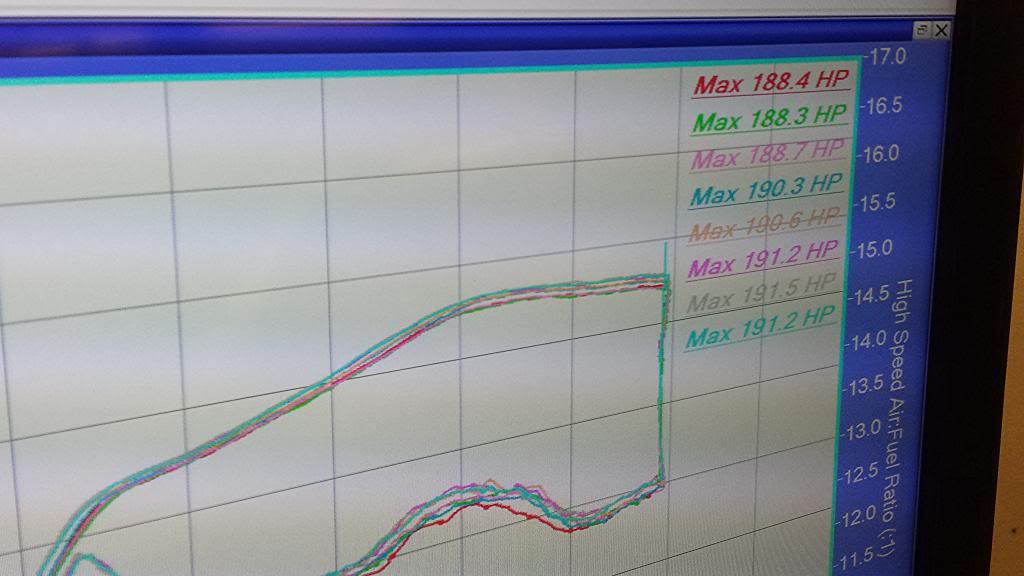

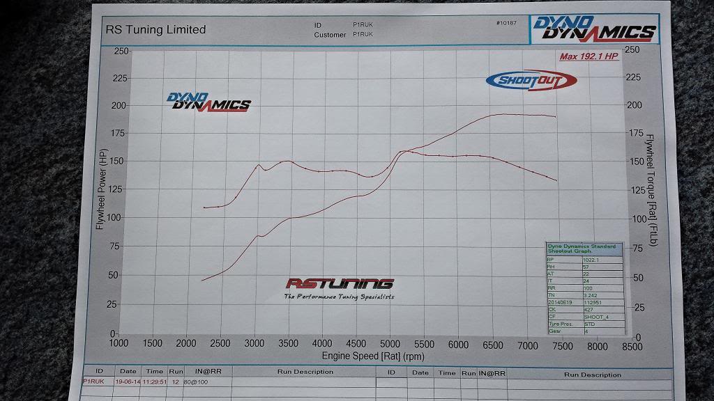

Great results mate. Bet you are well happy with that.
Yes i am, after speaking to Paul the other week when i booked the car in he said 180 bhp so for it to make over 190 was great.
ah i found the other thread now in media. 192bhp, excellent!

Nice results, whap up a final spec with your graph when you get a chance please.

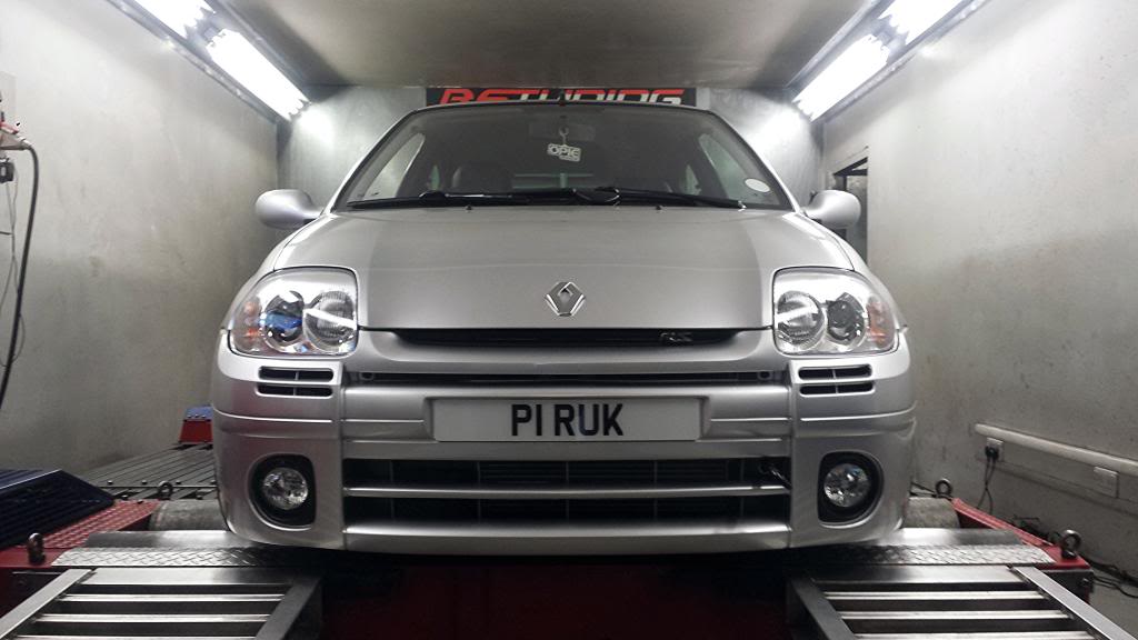

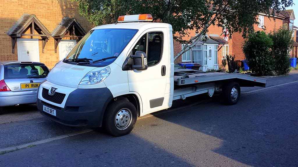

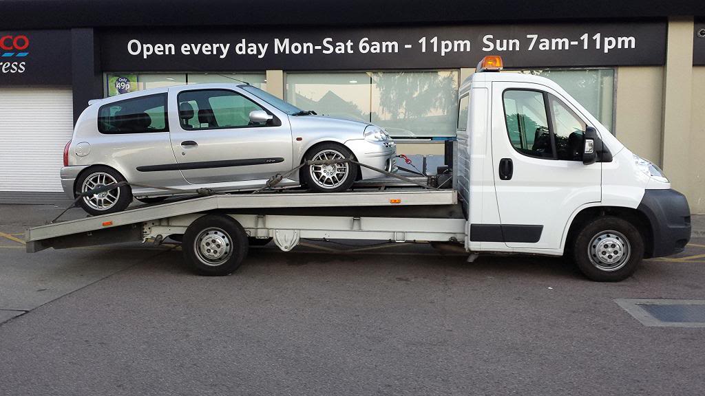

So i managed to get away for work a little bit early on Wednesday as i had to get to Romford before 5.30pm to collect the recovery truck that id hired.
It was 2.2 6 speed so it went very well, even quicker empty. ;)

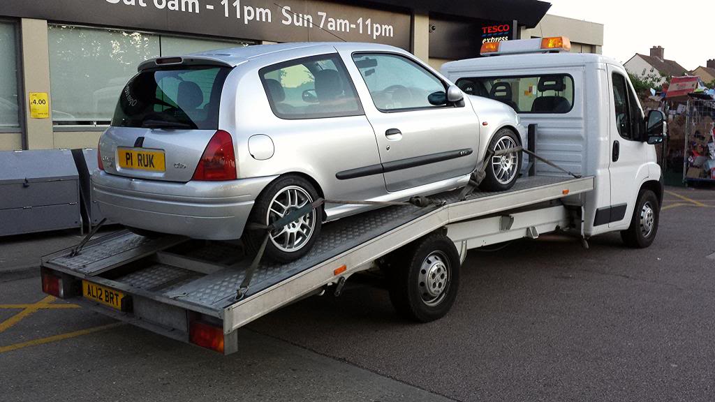

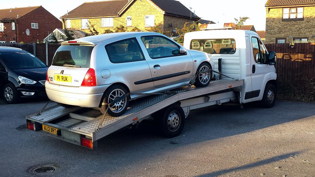

Loaded up the car with the help of the misses and some bits of wood as the front bumper was so low to the ground.
All loaded up and strapped on.
Went to bed at 10pm and had the alarm set for 4am, had to collect Sunglasses_Ron on the way.
4.30am in the petrol station getting some cash out on the way to collect Dave.

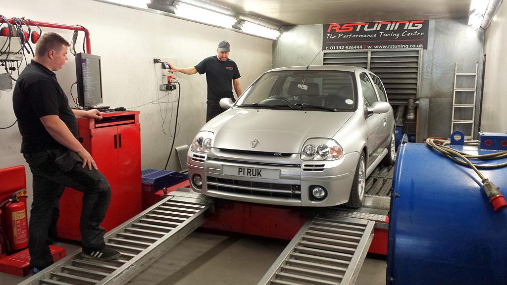

The drive up to RS Tuning went very well, we didn't get stuck in any traffic.
We stopped off for a quick bite to eat and a coffee as we was booked in to Pauls at 9.30.

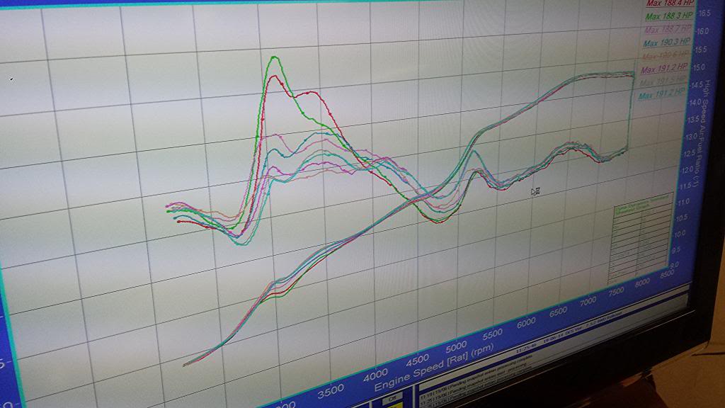

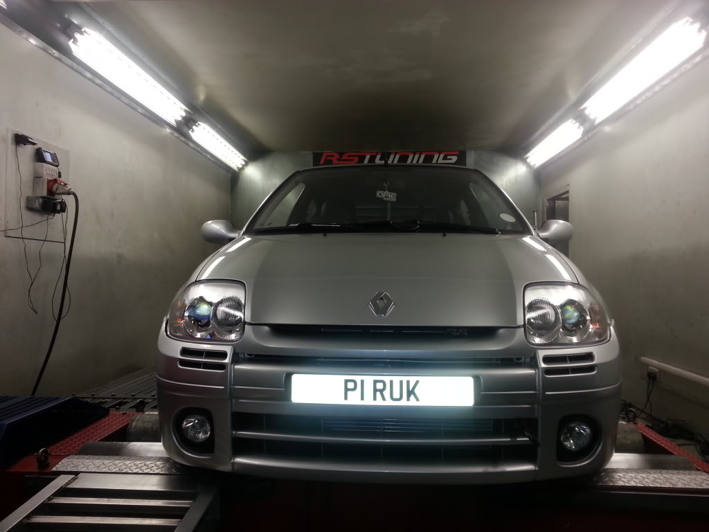

We arrived at RS Tuning at about 9.40am and the lads set about putting the car onto the rolling road, at this point my hands started to sweat as all of my hard work could end up going bang!!

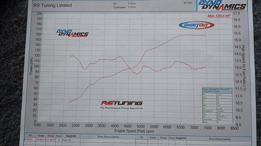

At first the Clio wouldn't idle and was running so rich which was giving Paul a bit of a head ache, but after a few runs and a bit of messing about we started to get some where.
Here is the final print outs. :D
Big thank you to Andrew @ALD for the head work.
And a big thank you to Paul RSTuning for the mapping.
Engine spec is
ALD ported head with new valve guides.
Supertech valves
ALD ported and matched inlets
Catcams 421's
182 exhaust manifold, heat wrapped in Design engineering titanium exhaust wrap.
K-tec de-cat pipe
K-tec single box stealth
Standard PH1 air box with ITG filter
ARP rod bolts

The power/torque starting to drop off around 6400 is the standard inlet being in choke, mine did exactly the same except it dropped off a bit more but that's because of the cams not being quite as lairy as 421s.
I've noticed you didn't get the jump in peak torque around 5000-6000, I think that's down to the filter setup as that's the only difference. I wouldn't bother changing it though, it looks better as it is.

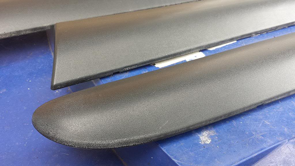

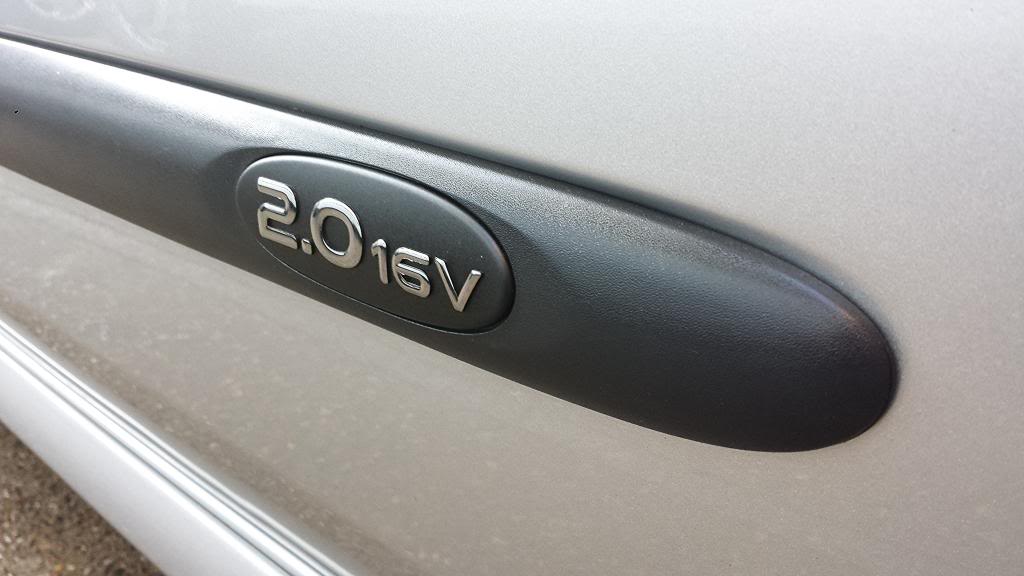

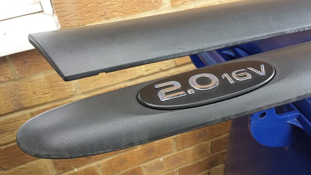

Once i got back home i wanted to remove the plastic side strips and give them a bloody good clean and then give them a coat of Gtechniq C4 and fit my new "2.0 16V" side badges.
Old strips removed.
Treated and new badges fitted. :cool:
