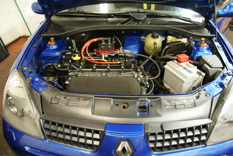

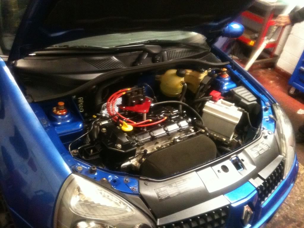

Slightly better picture I took on my lunchbreak when I popped over to Mikes, my mrs attacked all the plastics with some "new look trim gel" stuff and it seems to have done the trick.
Hopefully we'll start some of the mapping in the next day or two so it can be run in properly before we do the under load stuff.

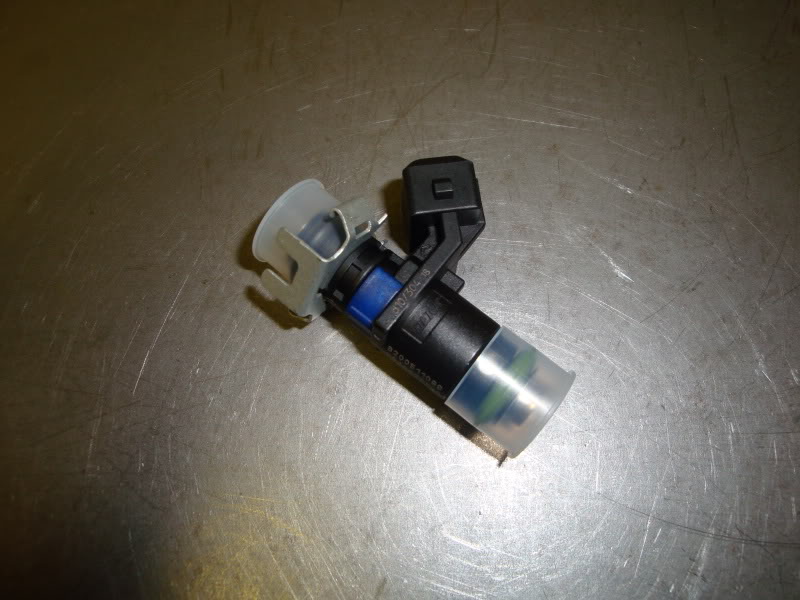

One snag we have hit though is the megane injectors we wanted to be using turned up with 2 correct and 2 with some other injectors in the box and Renault reckon that loads of them have been mis-boxed and it could be 2 weeks till they can get us another set.
Anyone got a set lieing around we could use for a couple of weeks to do the mapping etc until Lee's new ones turn up?

Must say im actually quite jealous of the end result, its come out really well I think, not blingy or tacky, just neat and functional.
If it drives half as well as it looks, mission accomplished :)

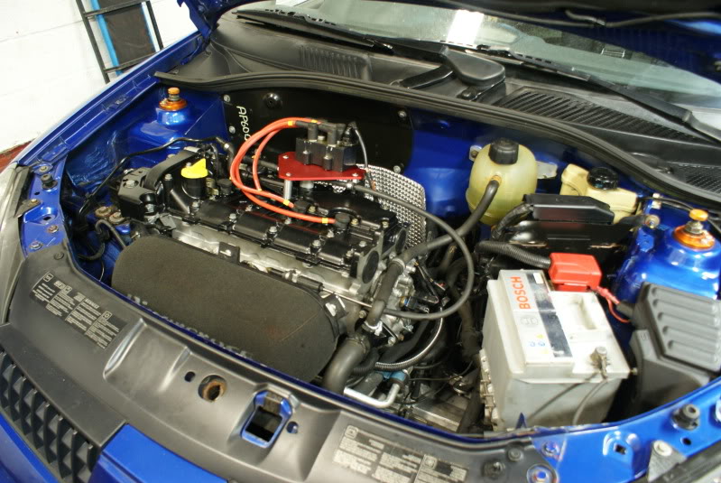

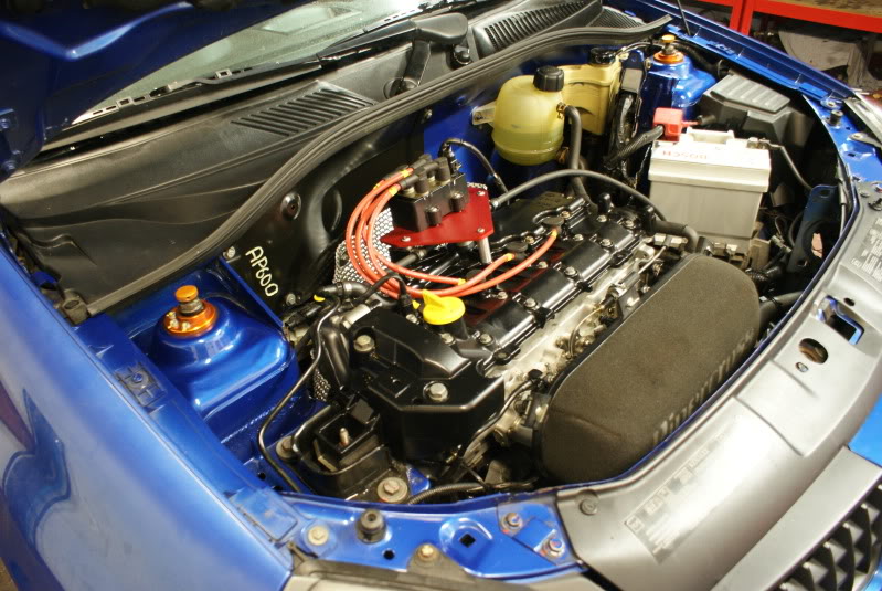

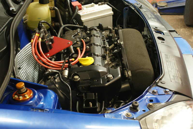

A few pictures Chip asked me to take on the SLR when I popped into see Mike today, Not the best ones my camera's produced -
  e92 + E46 M3 + Cup
Thanks James, bit better than my iPhone effort :)
No worries :)
Its great to see how its turned out, you really should have seen the hours Mike & Chip have put into this with such attention to detail, You guys should be very proud of the finished piece!

Lee, they'll be fine.
Don't like the sound of the problem with the injectors, ours are on order and should be here on Thursday.
They better be right.
  Ph1 172 & Clio DCi
Tony,
The ones we got were wrongly boxed.
They had a pink band round the body of the injector and when Renault put the part number into their computer, they turned out to be 1.4 twingo/ megane/ kangoo injectors.
The correct ones should have a little blue tab on the side.

Just for reference, Megane 225/r26/ F1 etc Blue tag injector -
The old Megane 225 version has a brown tag
Looks great! thanks to all Chip and Mike for all the hard work and super favour's of all he labour and stuff!!!

Chip will tell you exactly. But roughly, slightly high comp pistons, forged rods. Cams, Ported head, one piece valves, ATpower ITB's and mapped by chip on Omex. NOT going for big power at all. Just over engineered for reliability and longevity.
  Golf GTD Mk7
I'll eagerly await the reply. I'd probably expect 220bhp at least from that though. Depends what the limit gets raised to I suppose.
