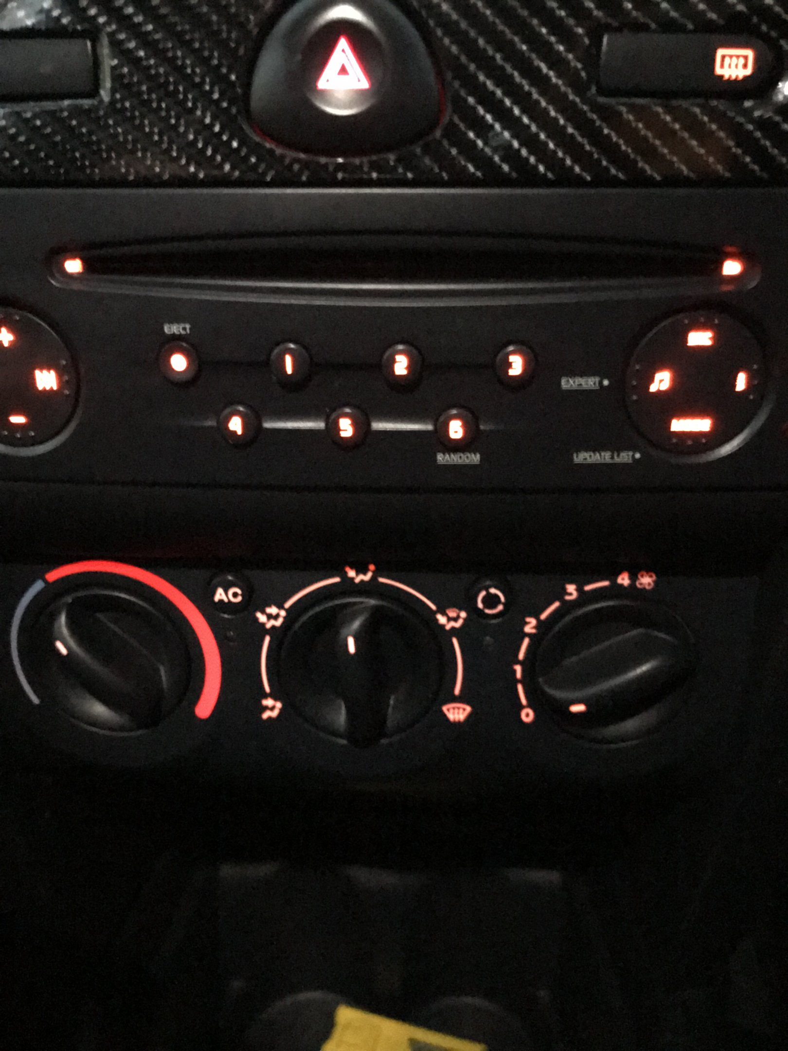

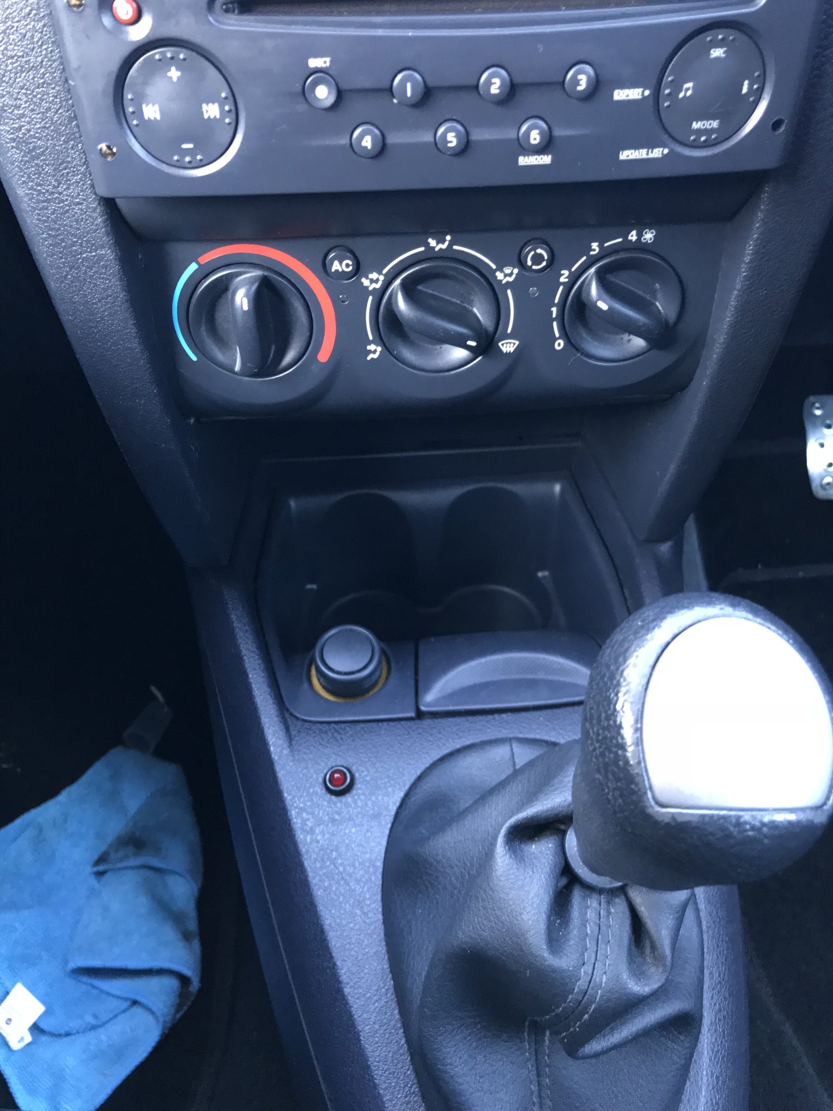

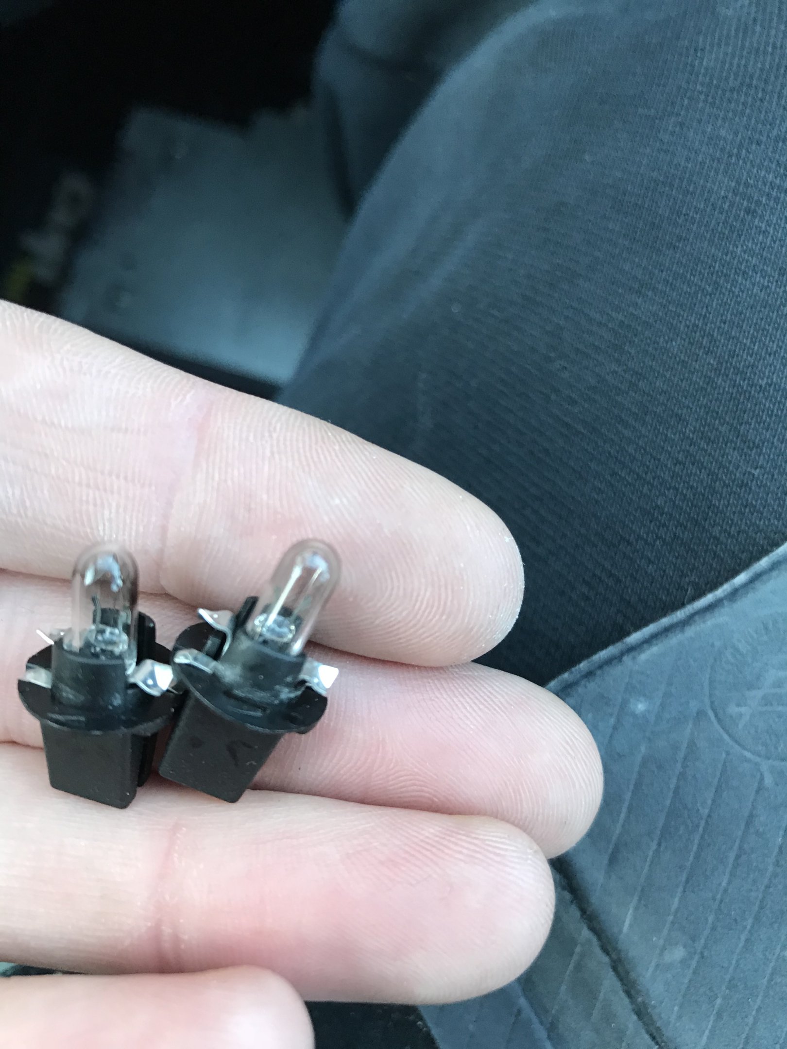

As the sun set on route home the heater control illuminations failed to join the party. So that was first on the agenda for today simple fix 2x bulbs from your local harry Halfords. Job done.

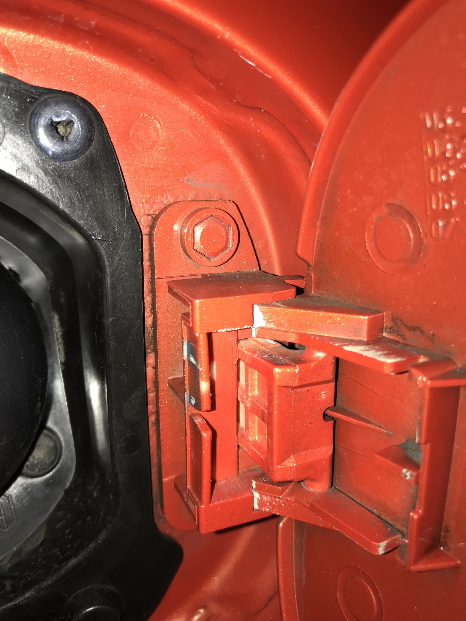

Picture of affected for clarity. Of course the price was negotiated when this was discovered. regardless think I would have Bought it as It was easily the better of the 5 I had viewed.

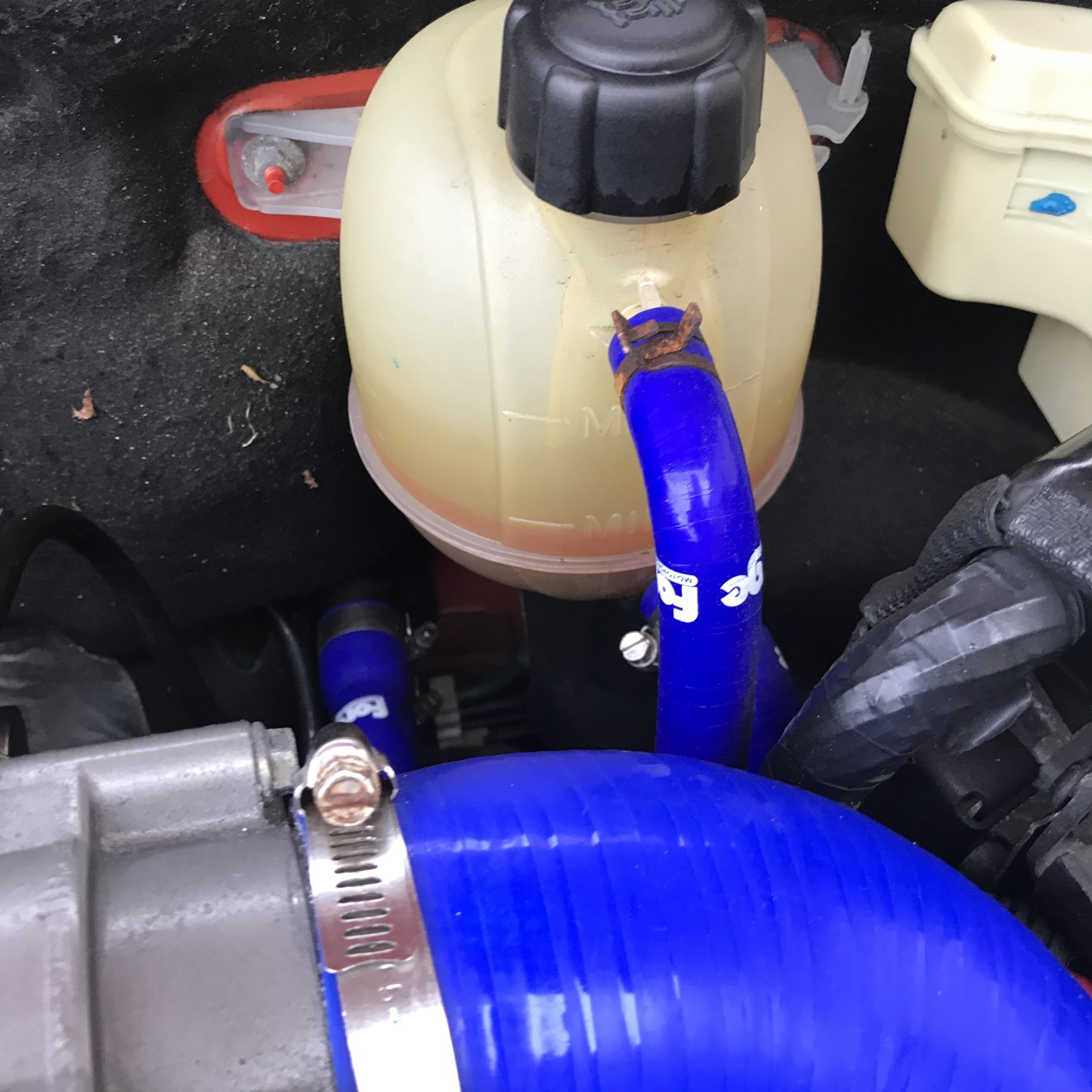

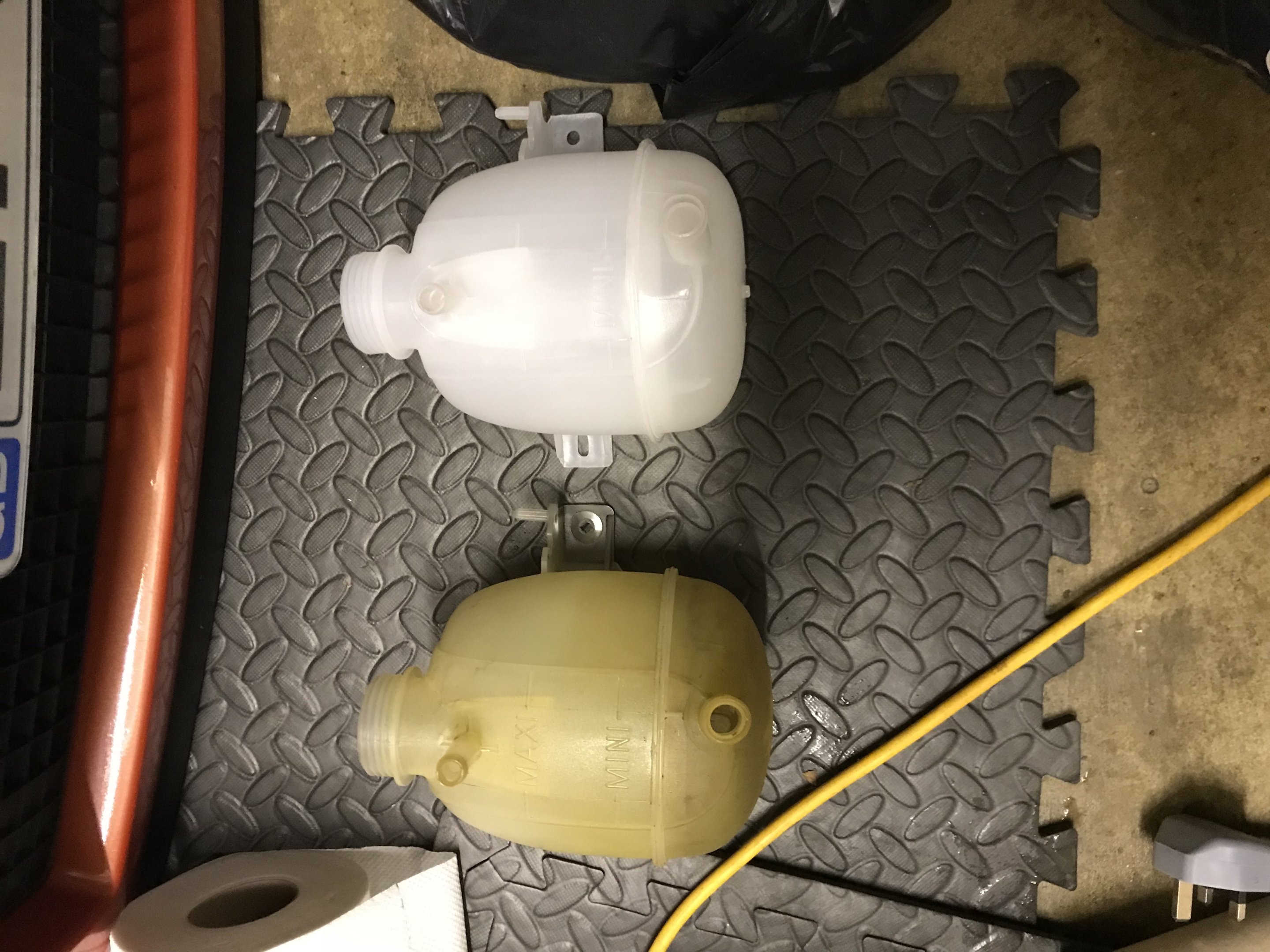

So managed to put a few miles on the 182 this week. I checked all levels to ensure all was ok when to my supprise the coolant appeared to have dropped. Topped up went on a jolly and confirmed that I was loosing coolant with no obvious leaks it was time to stat thinking.
Sniff test passed and with no evidence of contaminated coolant or oil I quickly moved on to tracing the leak. As the outdoor temp took a dive I noticed a slight steaming coming from the bottom hose joint of rad. Simple fix jubilee clip to go on.
Goodridge braided lines to be fitted when the weather warms up.
New expansion tank ordered to be fitted once Iam happy the system is water tight bargain in the euro car parts sale at £11 delivered

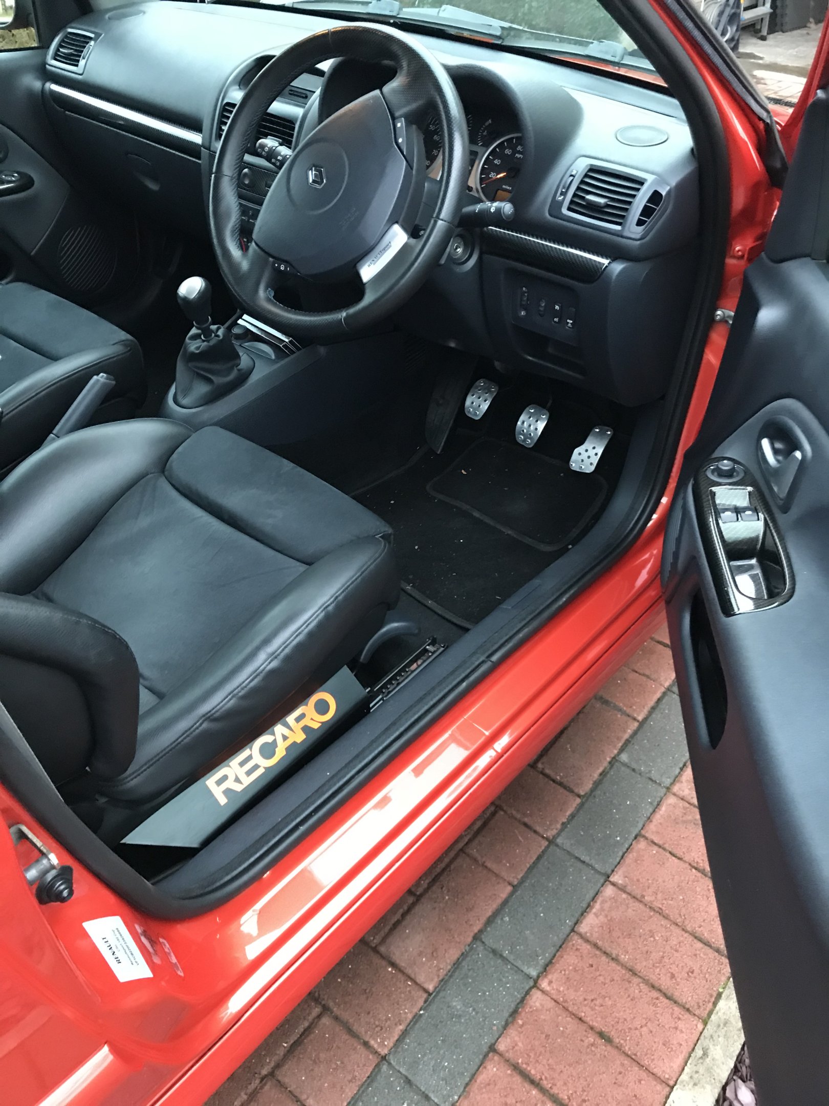

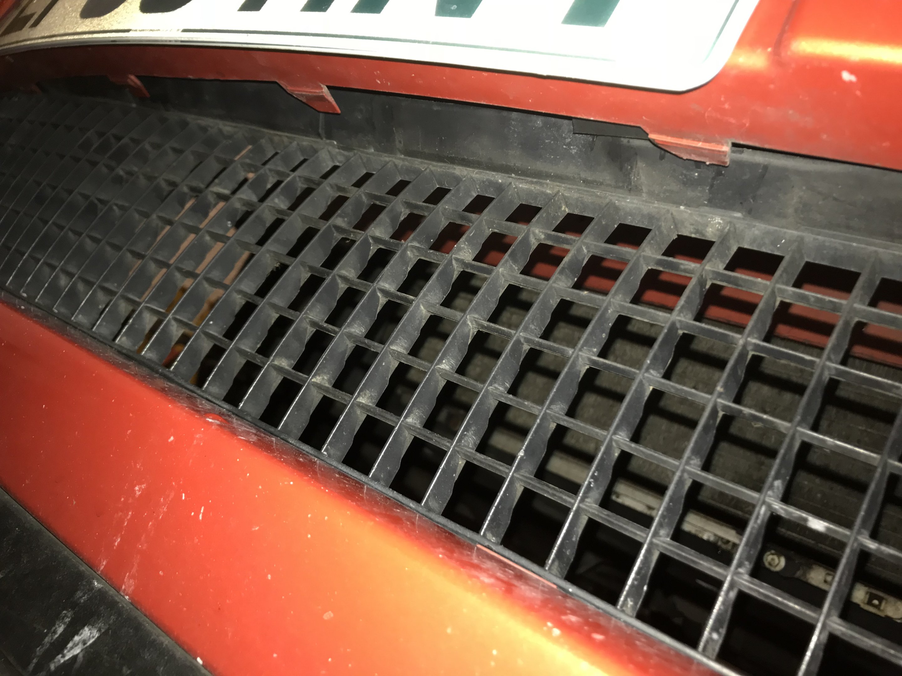

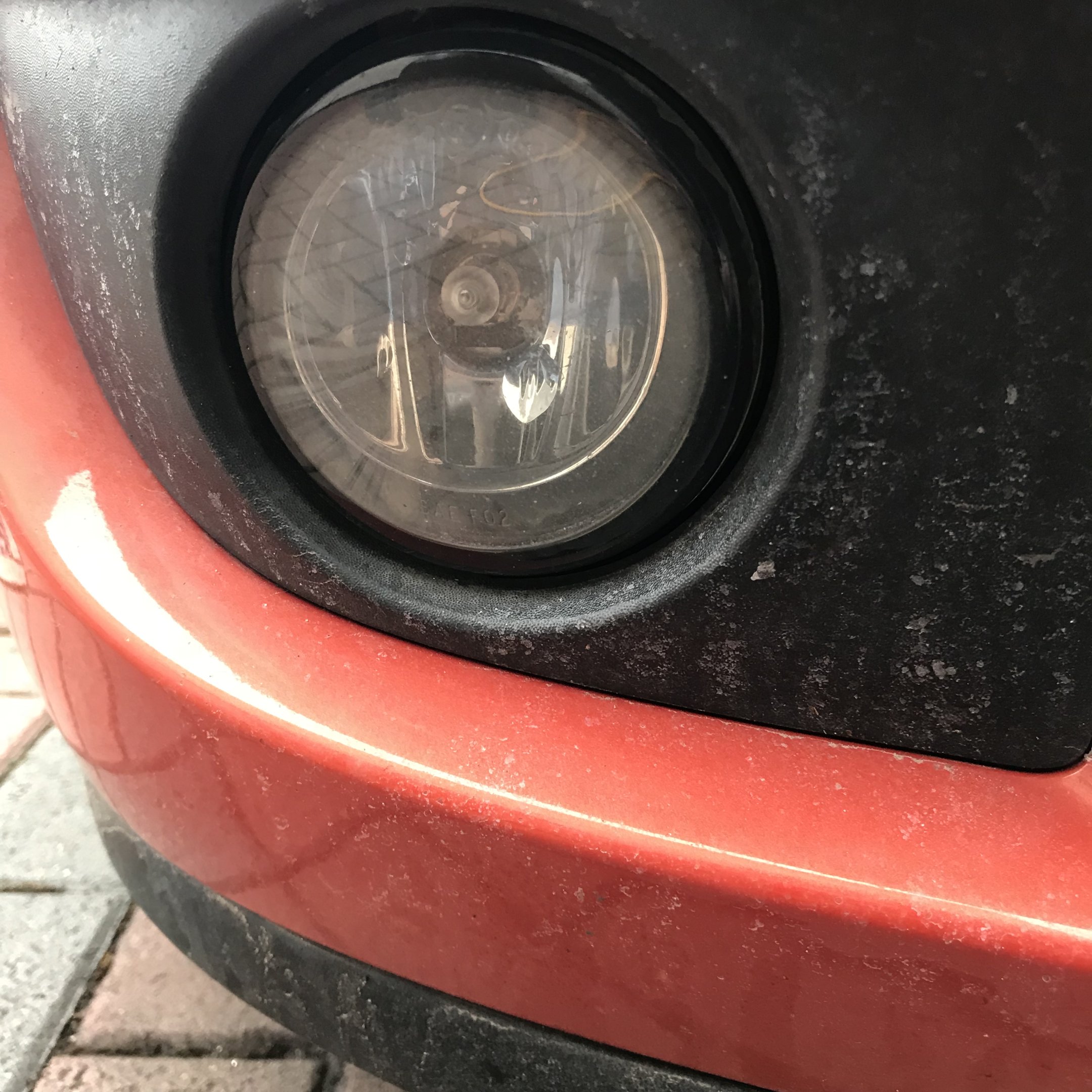

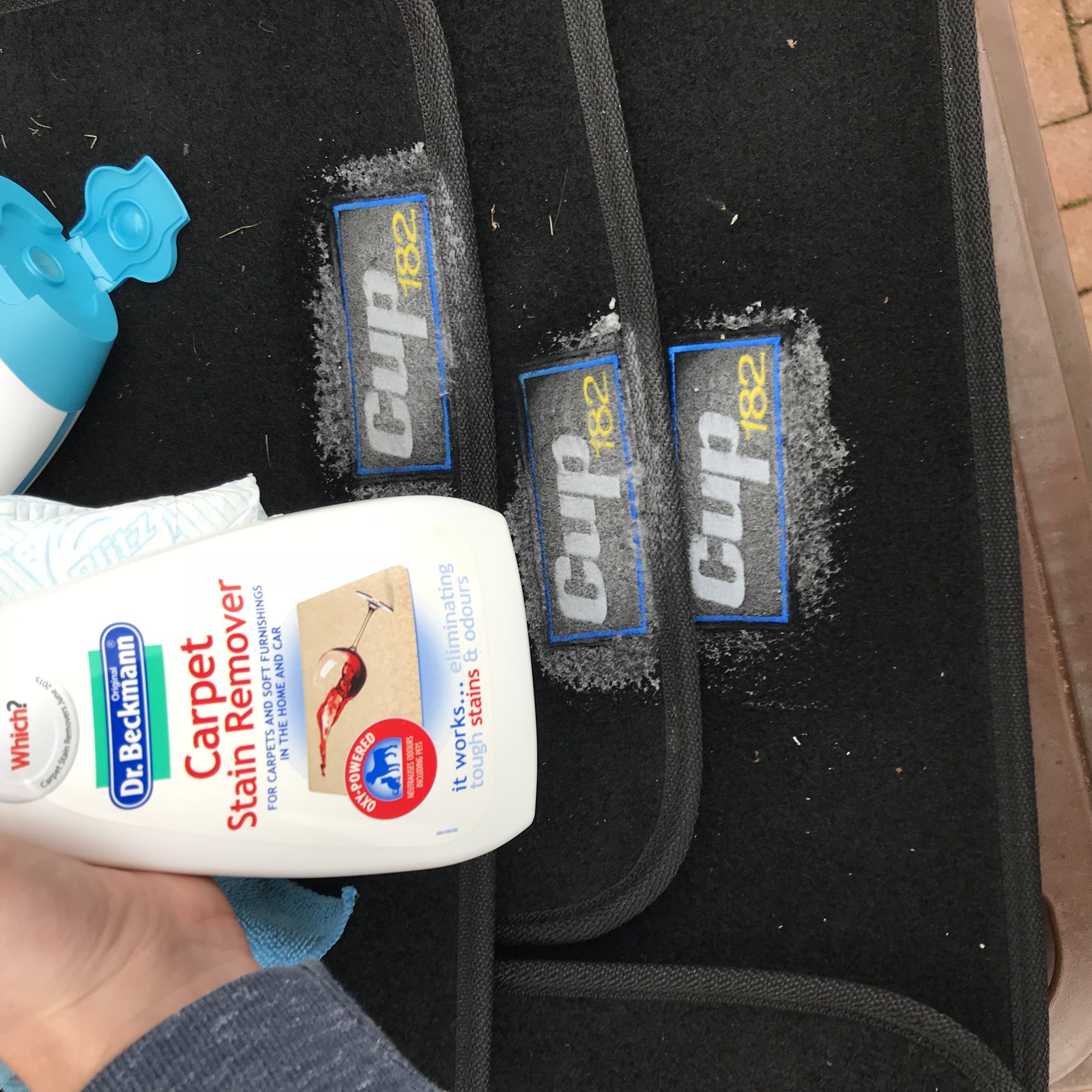

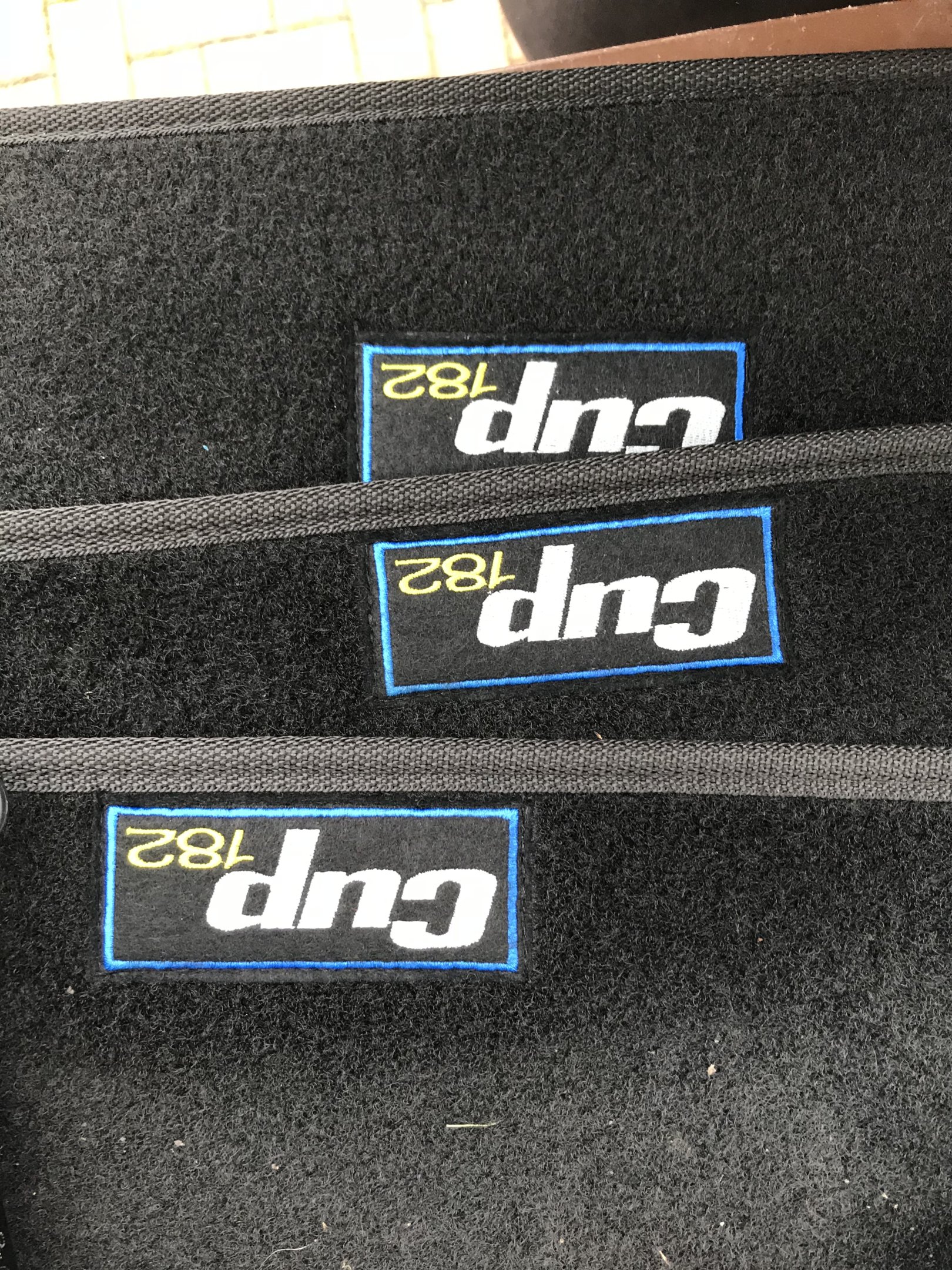

Had intentions of detailing today got waylaid due to my ocd kicking in when tidying the interior. Someone’s spilled a suspected hazelnut latte down the ash tray area so had to start picking the interior apart to square that also the treadlines also needed digging out.

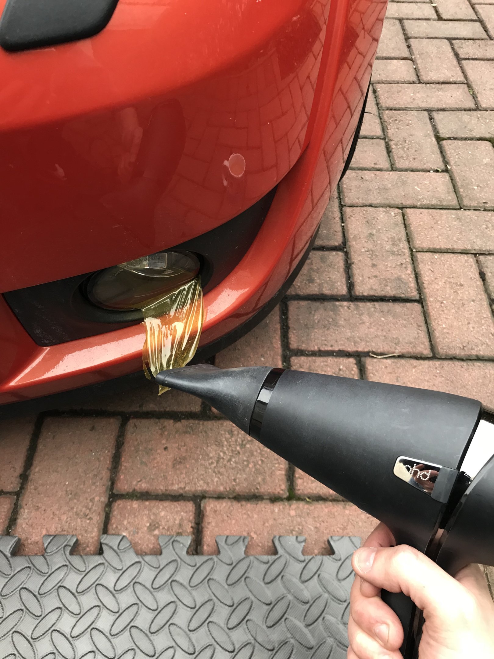

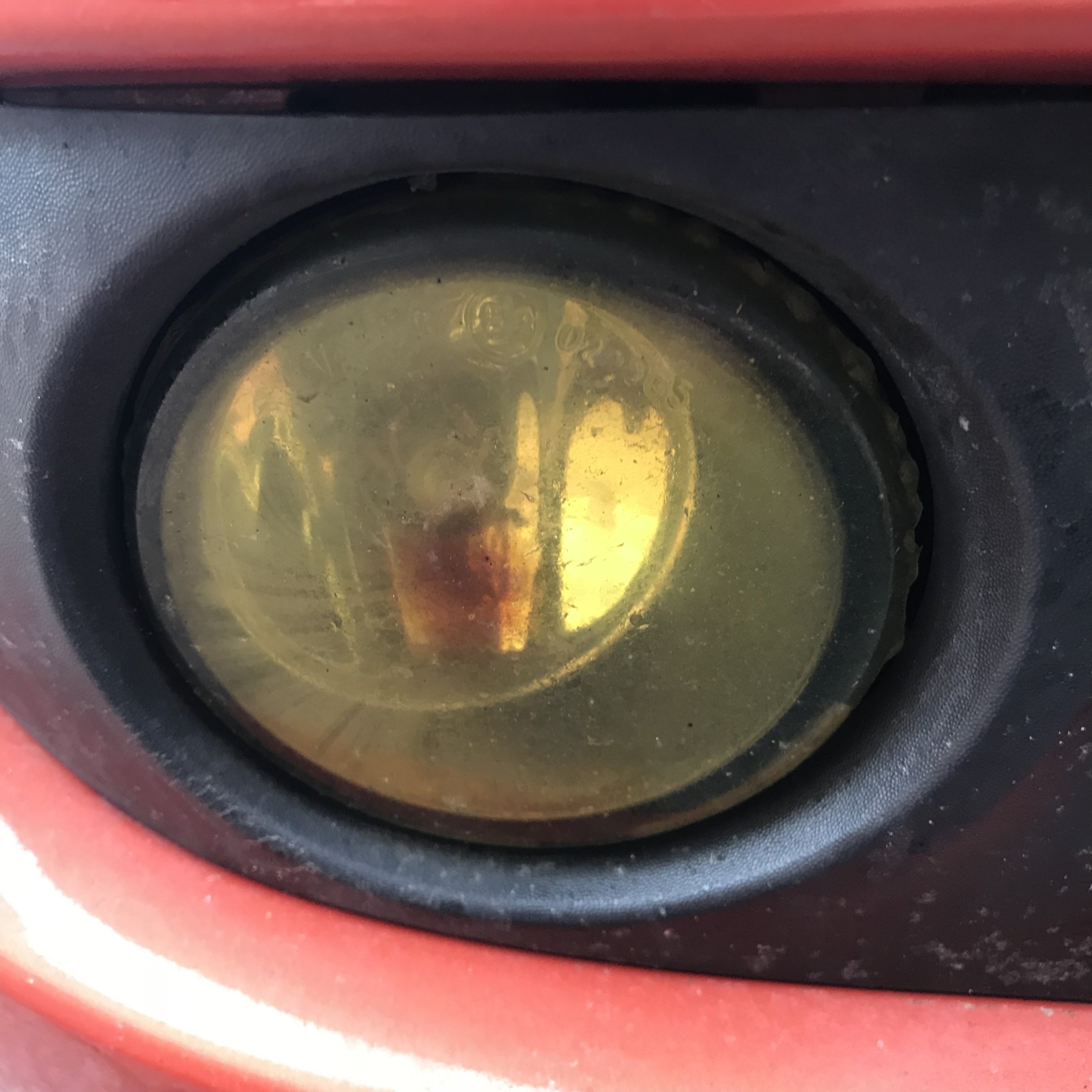

Fog lamps hadbeen tinted with yellow film that was stubborn to get off being from the max power generation stubborn stickers are my speciality. K tec sticker also scrapped.
Night breakers fitted. Slow progress on the 182 but the daily got a good polish.

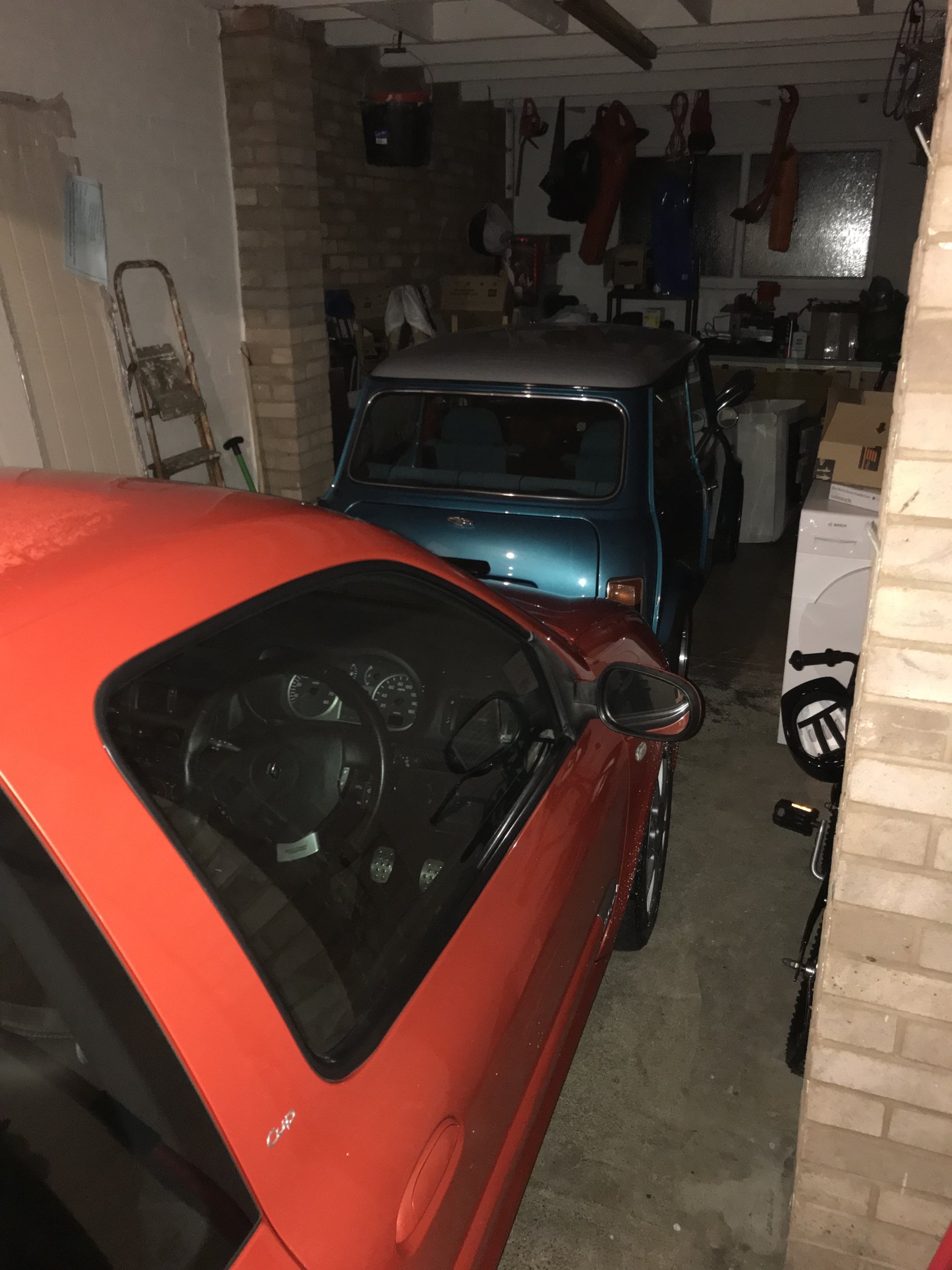

Also decided the mini has to go so I can properly commit to the 182.

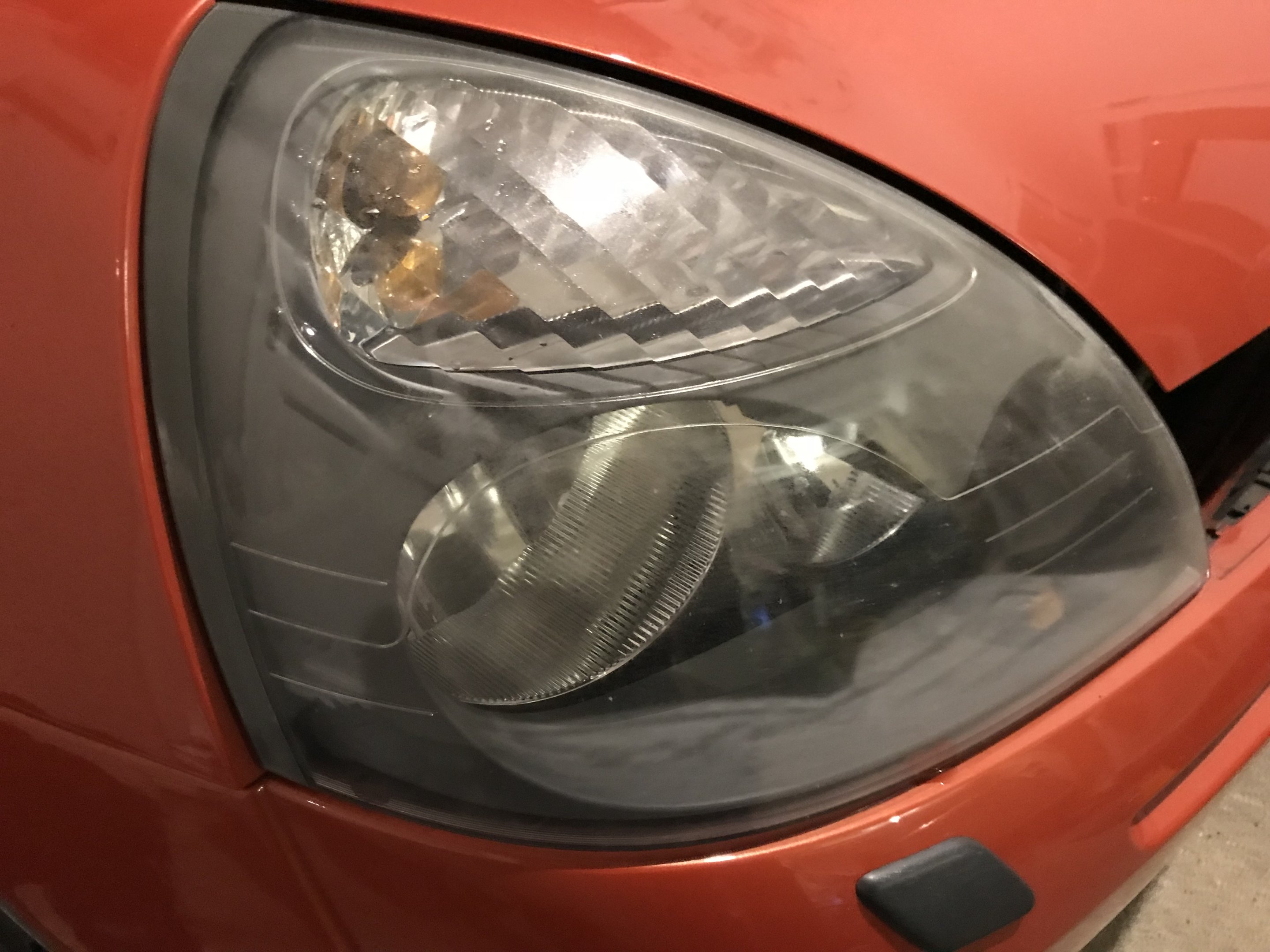

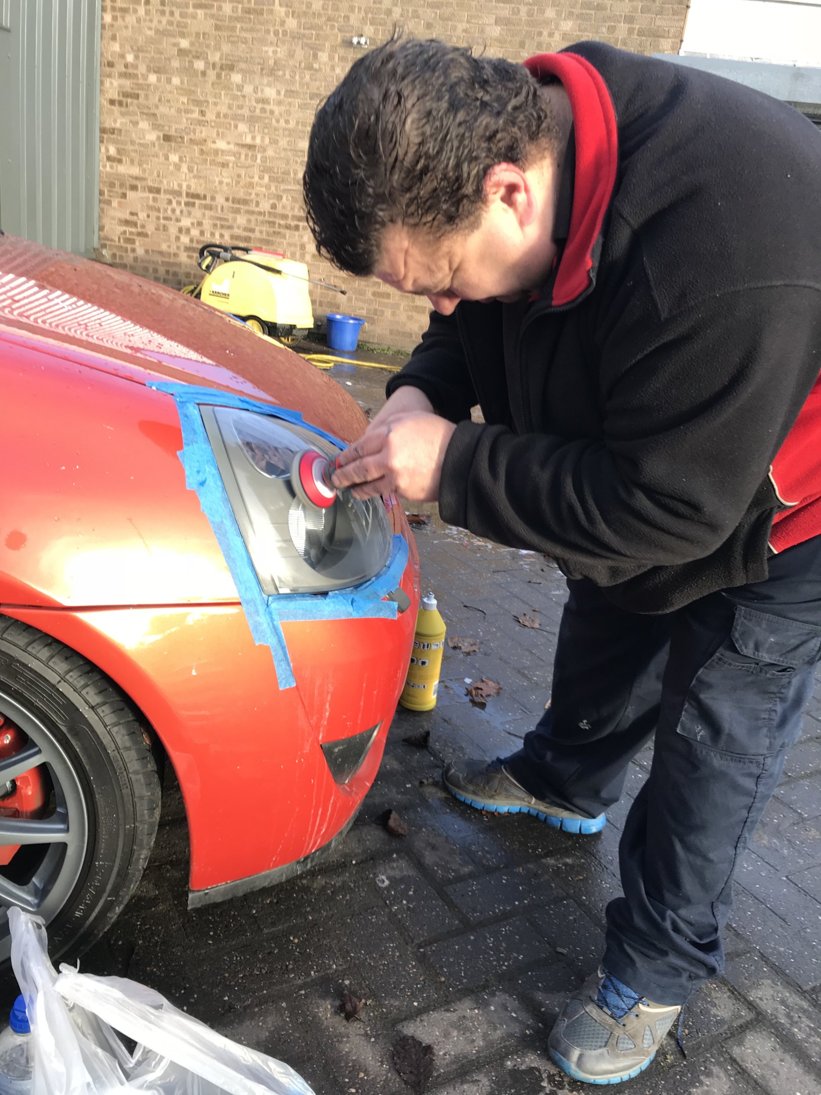

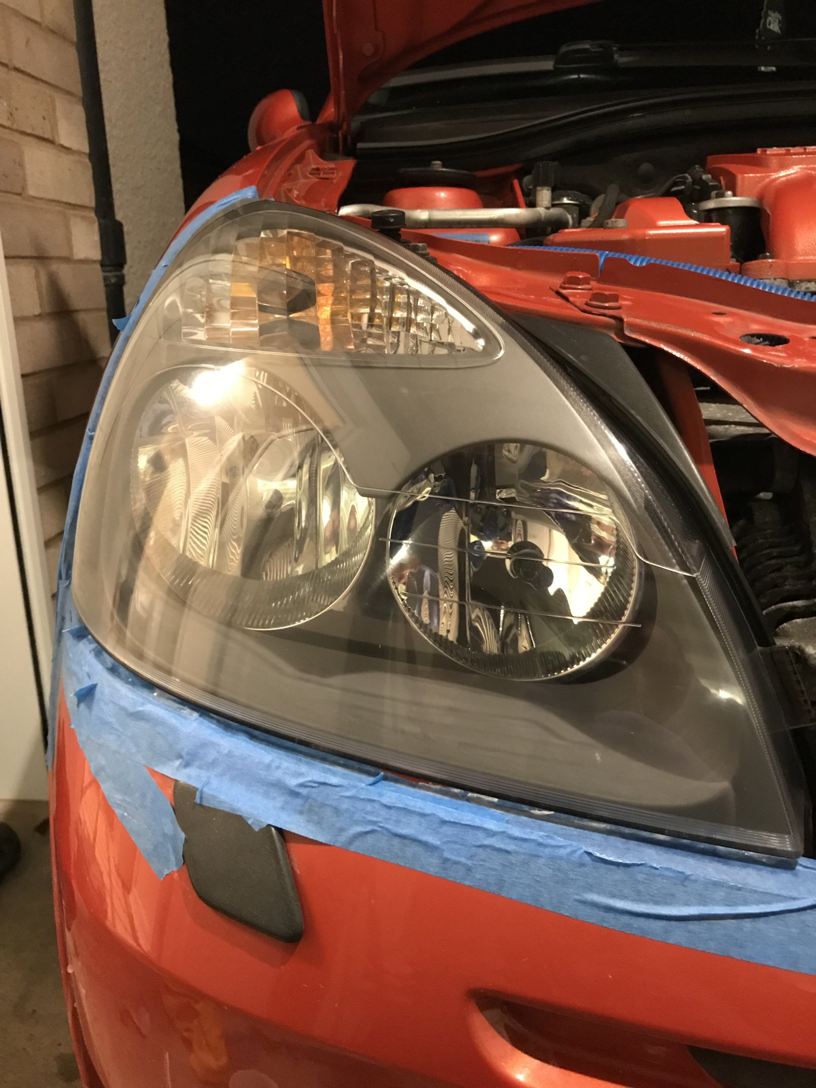

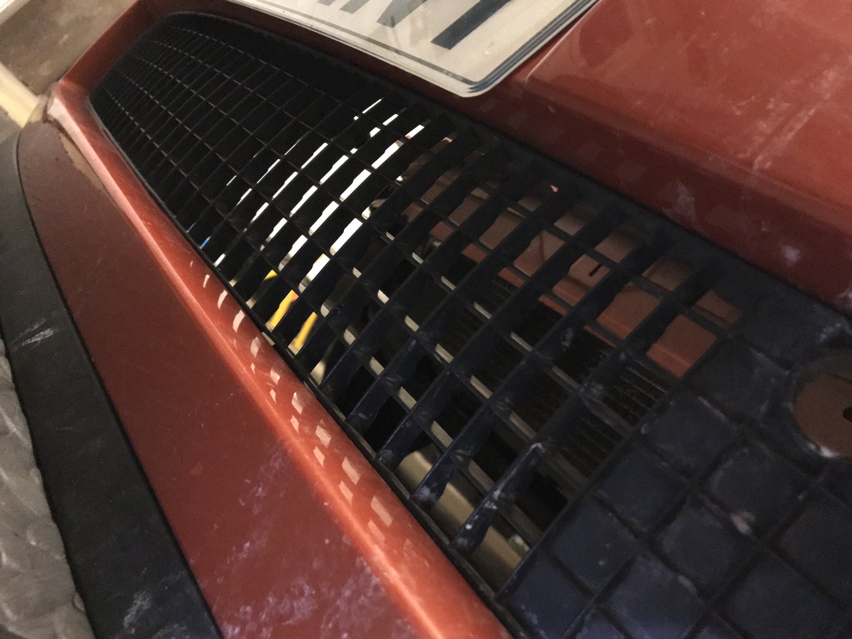

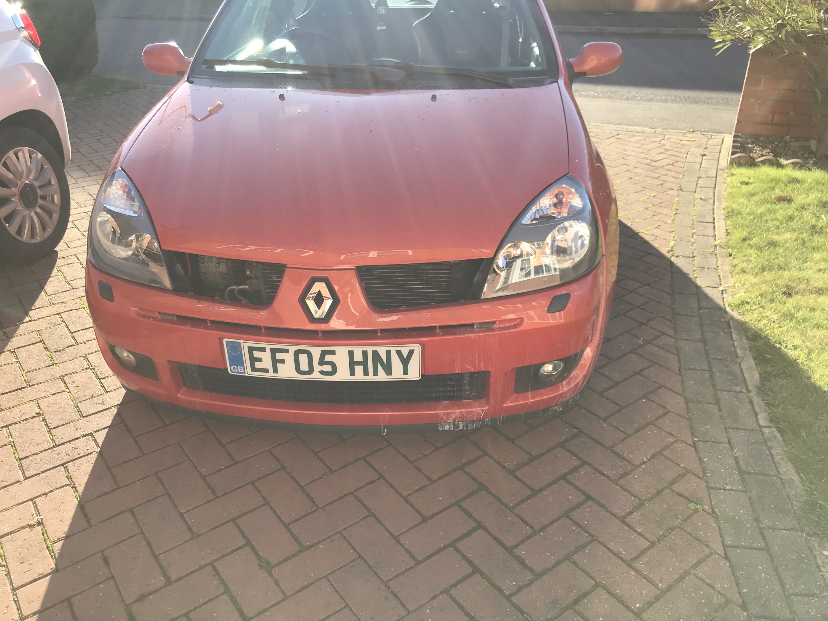

Took some time this evening to make head way on the headlights. They look ten times better than they did. Will pop by my mates shop in the morning to blast them with the mop as a finishing touch.

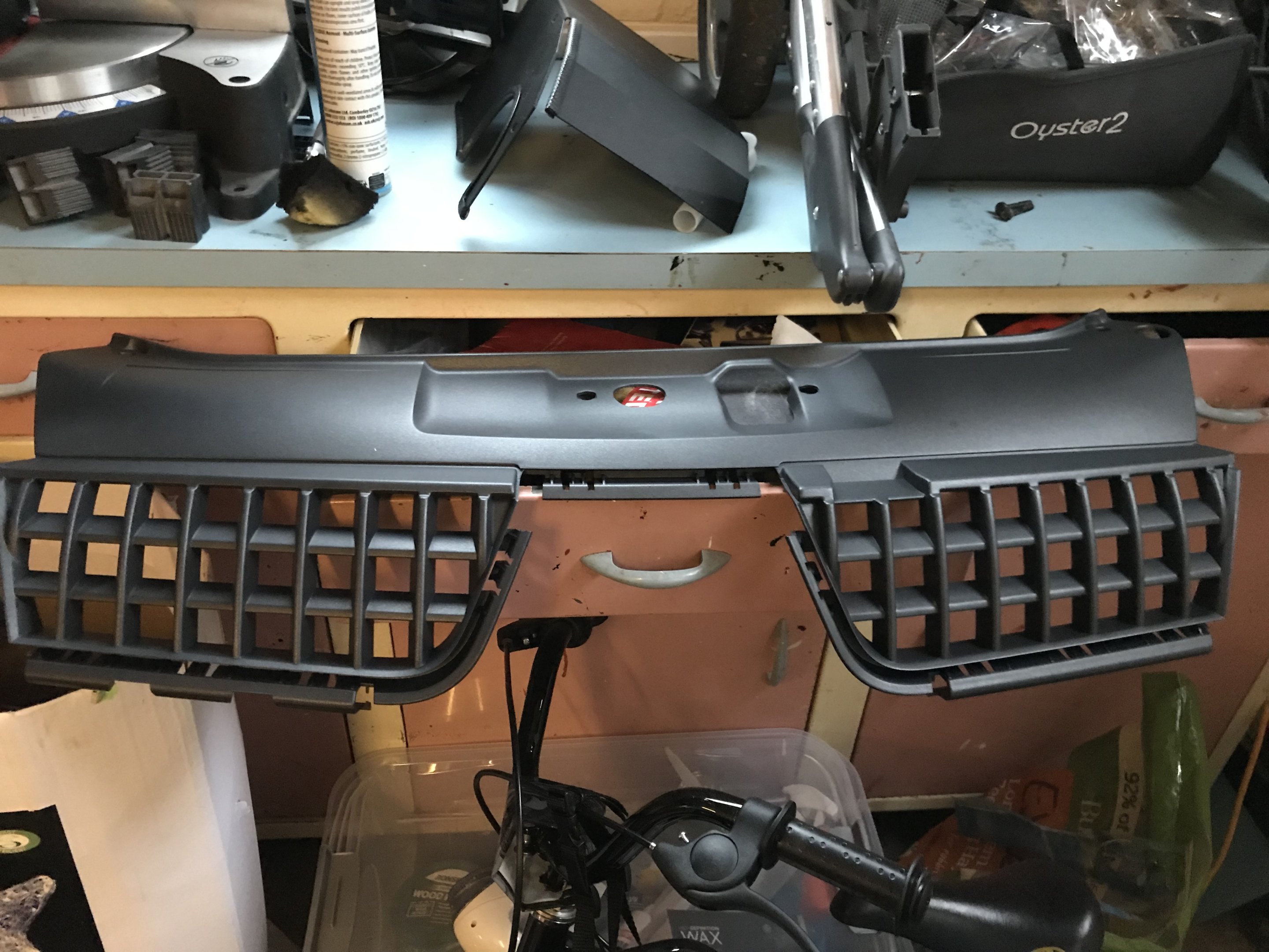

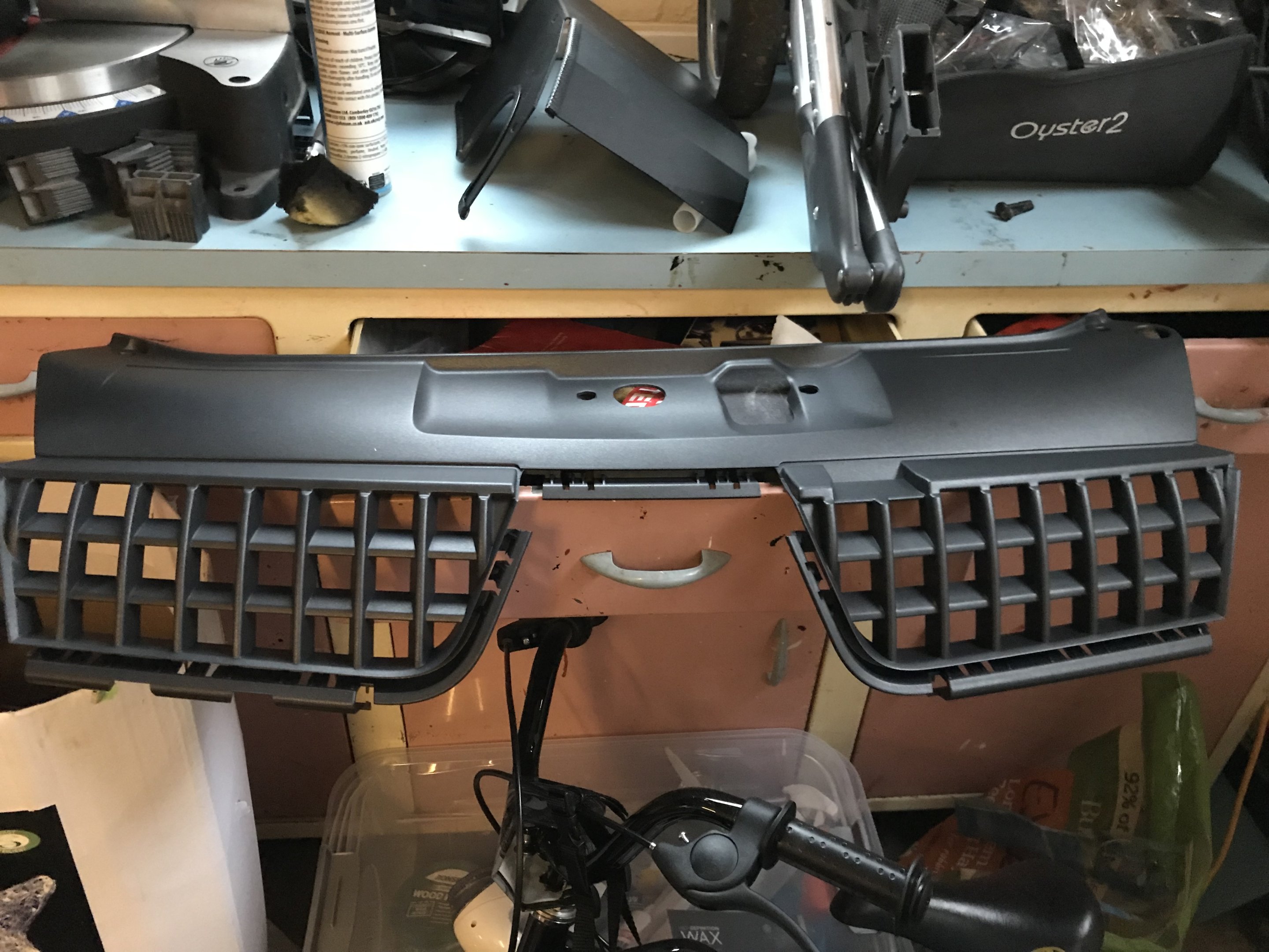

Really trying to source a good upper grille as mine has been painted and is missing the two middle clips and generally now looks shitty. Worst case it will be a new unit from RPD

Good friend and a go to classic mini man Martyn was more than happy to brandish and demonstrate his new polishing weapon of choice. With a healthy helping of g3 glade the lights are looking fresh.

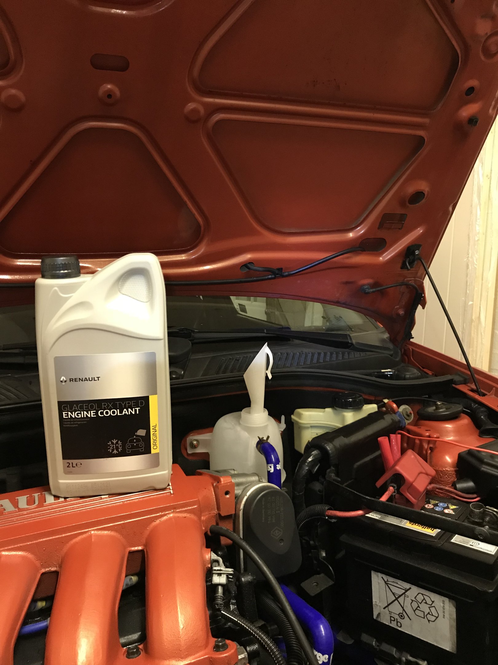

With all my odds and sods turning up on Friday I had to get on with some bits. Coolant changed for the Type D stuff. Swapped out the bottom spring clip for a jubilee, this should see to the leak that was coming from the joint.
Only really dropped 4 of the 7 litres so it’s going to take anouther drain and refill for the coolant to stay nice and green I think as the other stuff was bright pink. Despite flushing with hose pipe.
New expansion bottle on. makes the world of difference imo best tenner you could spend on one of these.

Bumper off to address the wonky lower grille few clips re secured and that’s a good job done.

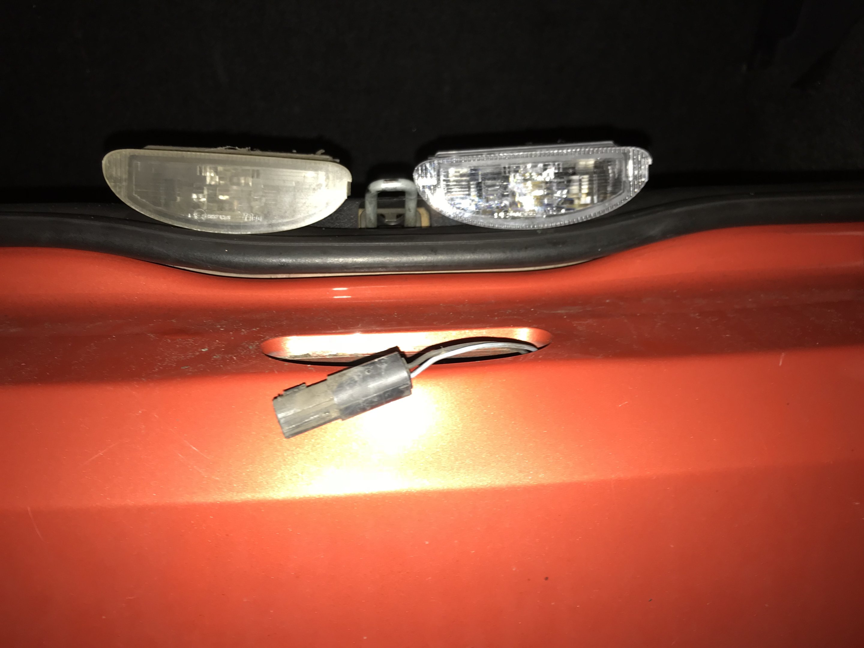

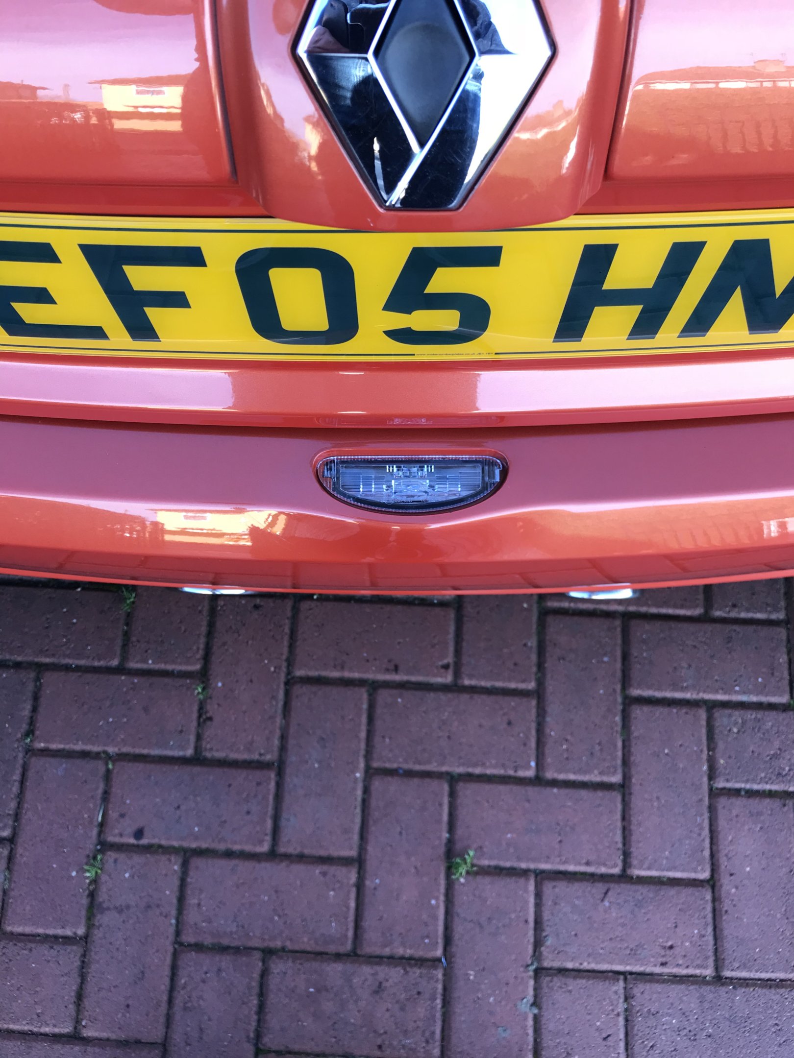

After all that pissing around I needed a morale boost so popped my new rear number plate lamp in.

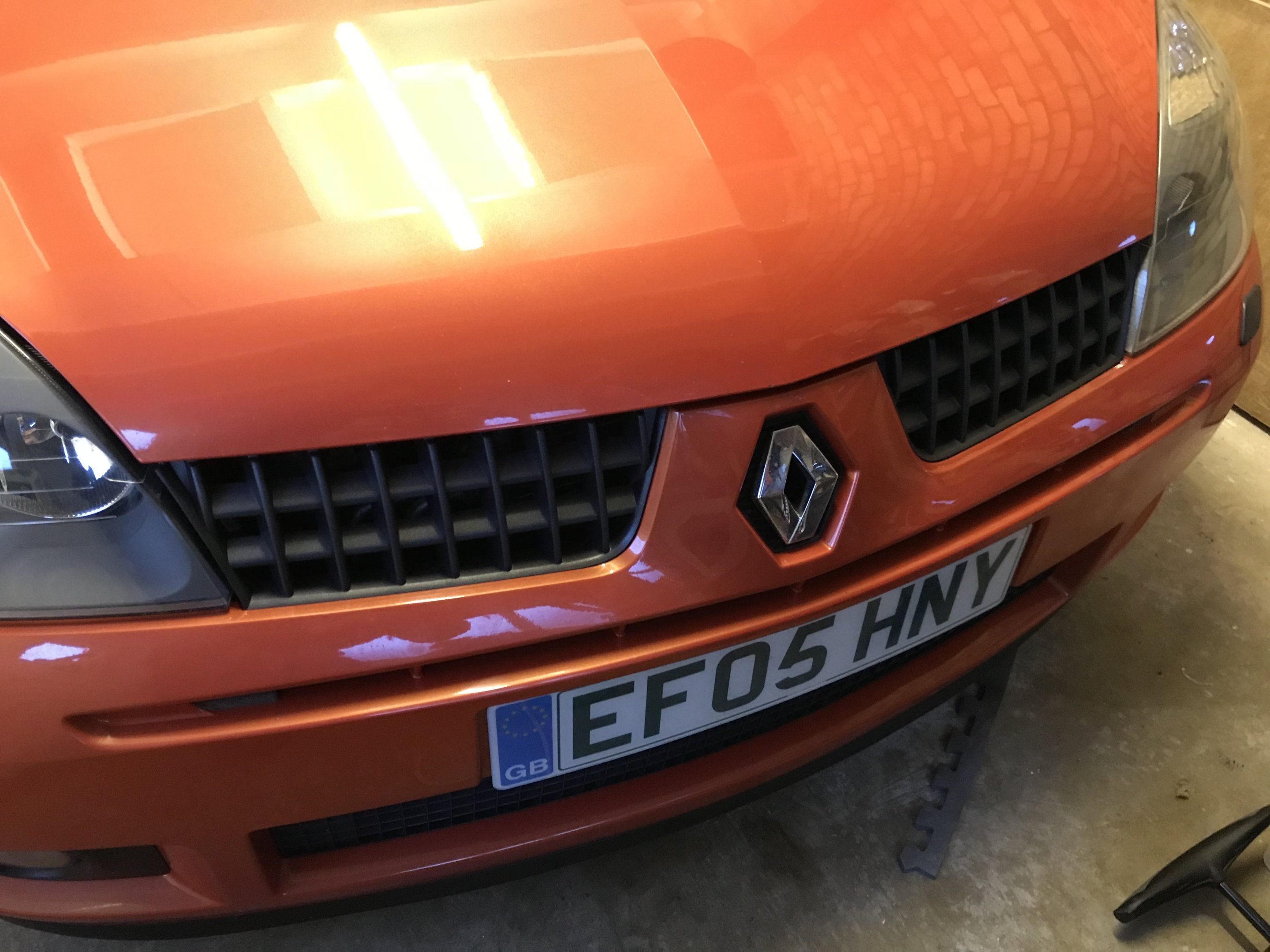

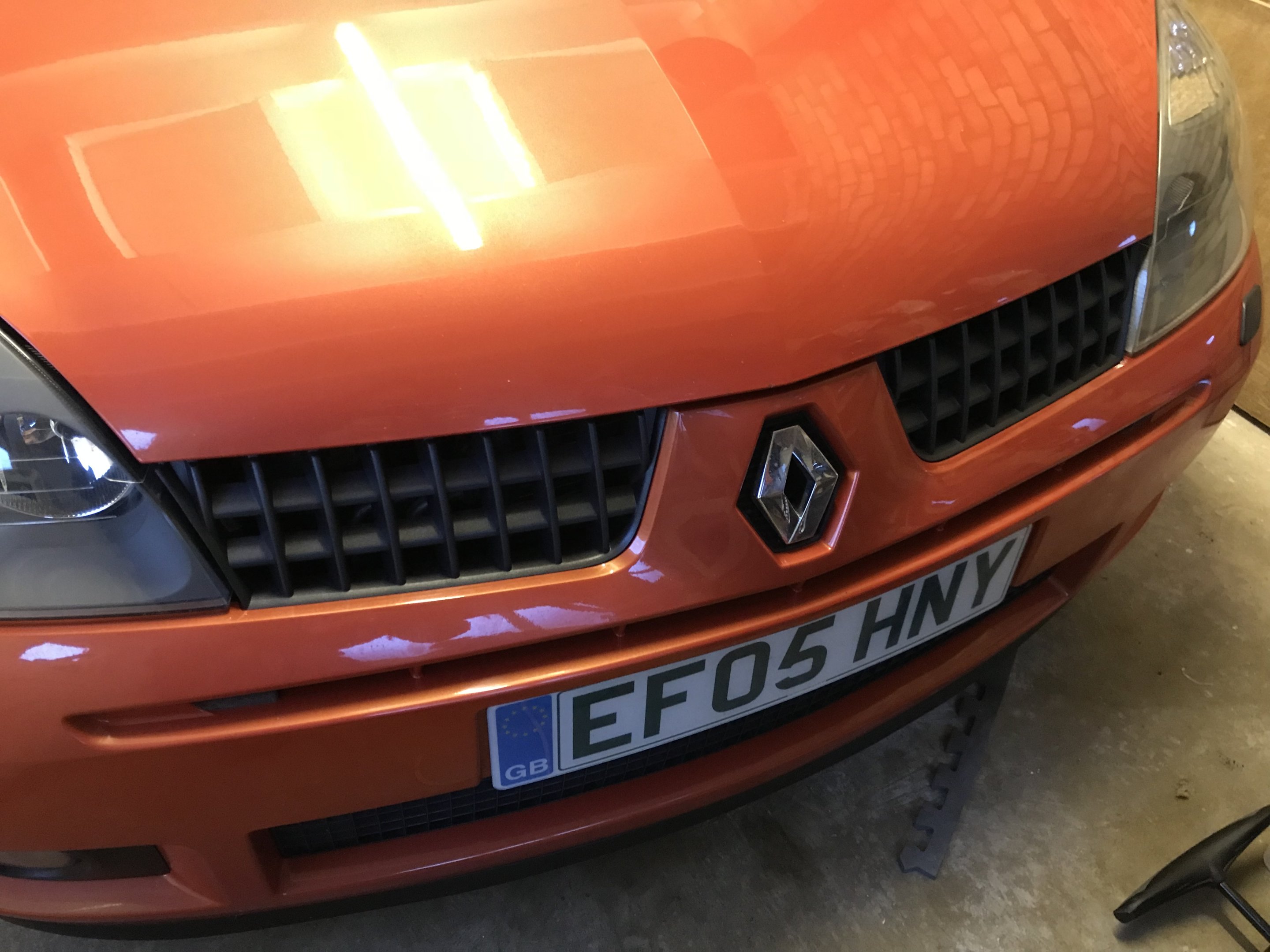

After hunting for a decent used grille unsuccessfully. I purchased a new one fitted and looking fresh. Keeping eyes out now for a slam panel seal. Alternator sheild and new bonnet switch.

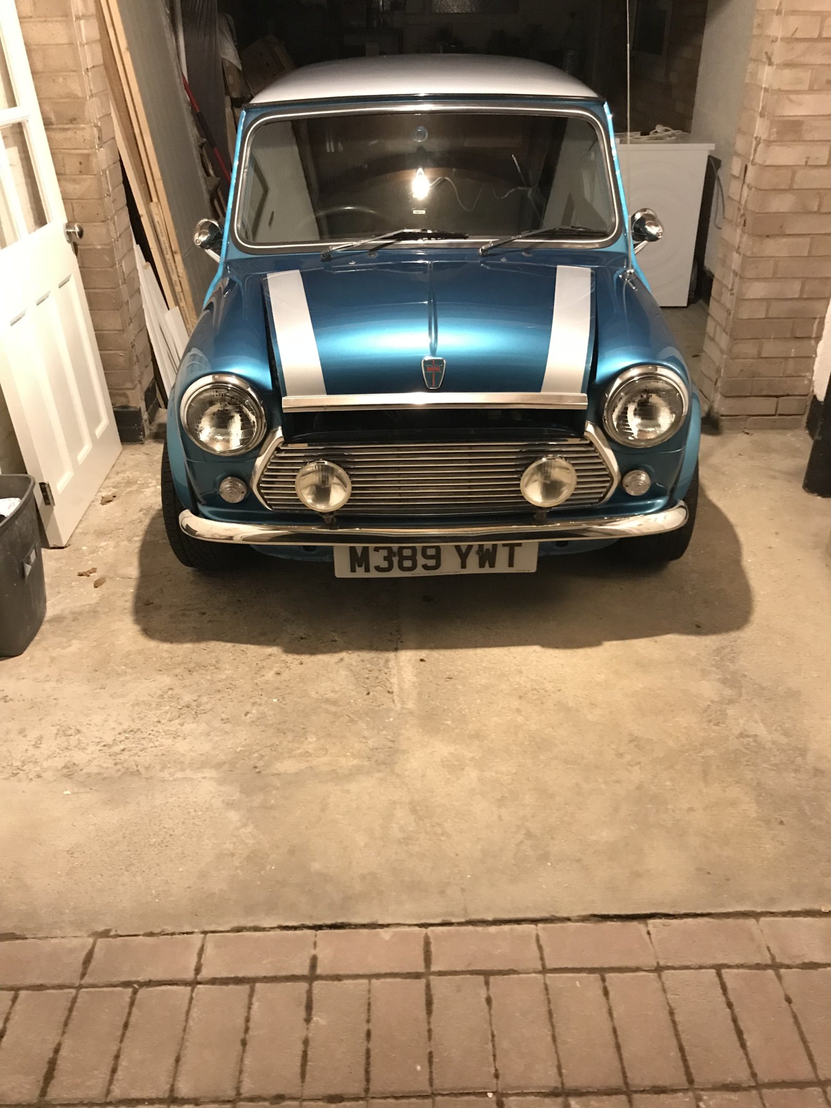

Pic of the old mini for interest

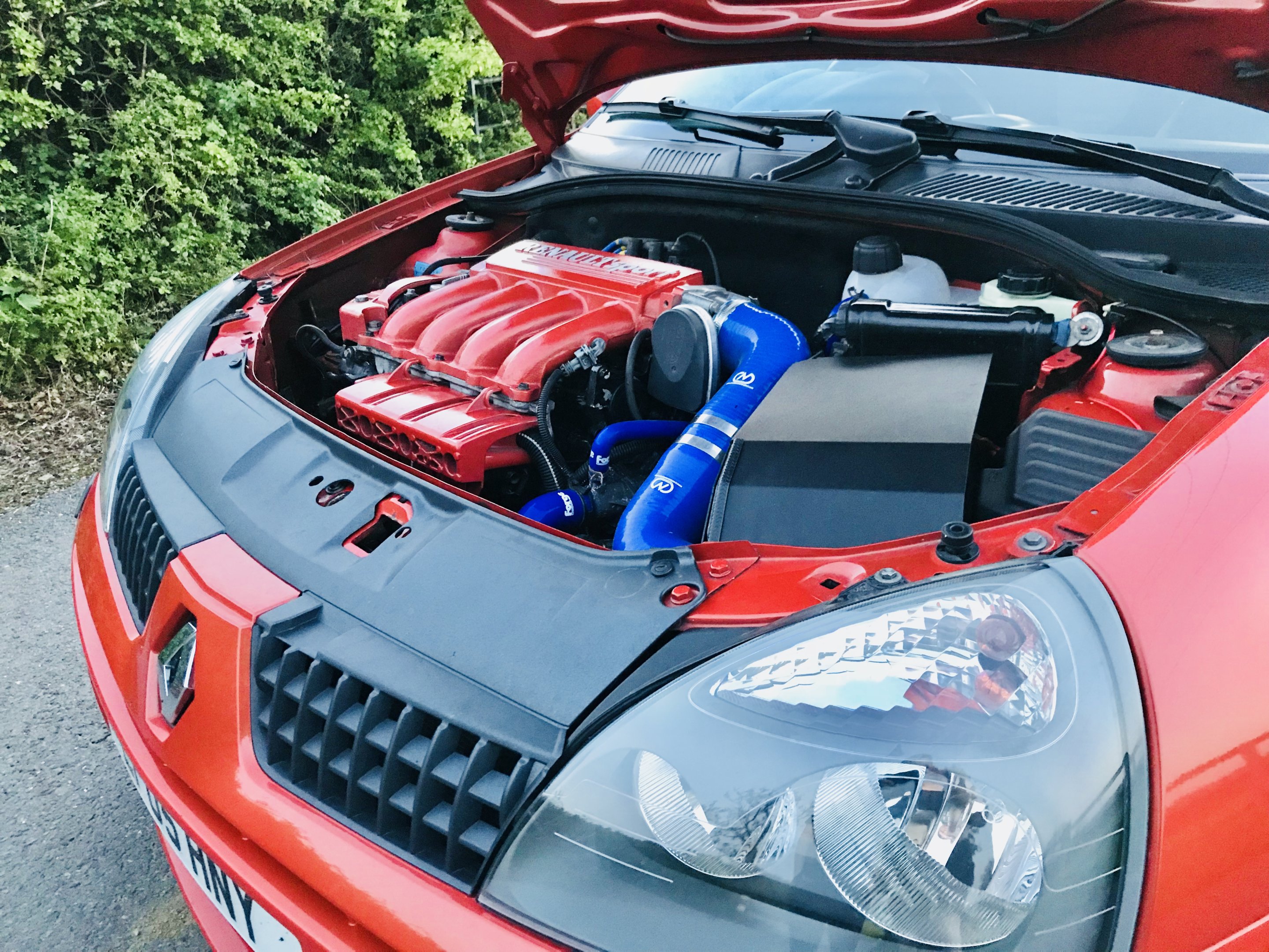

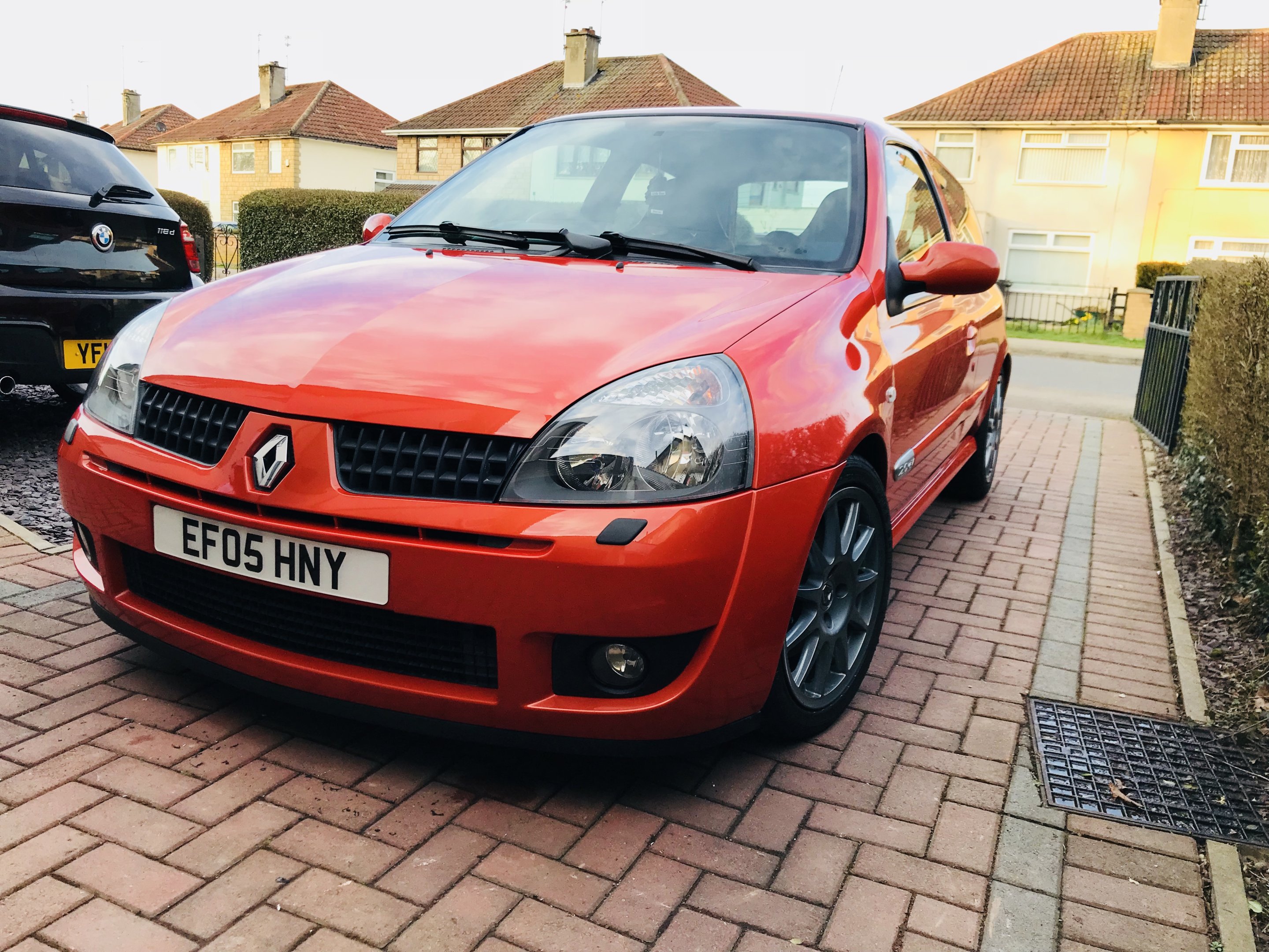

Got round to fitting number plates and giving the car a bit of a detail.
Collecting bits to tart up under the bonnet stand by more to come.

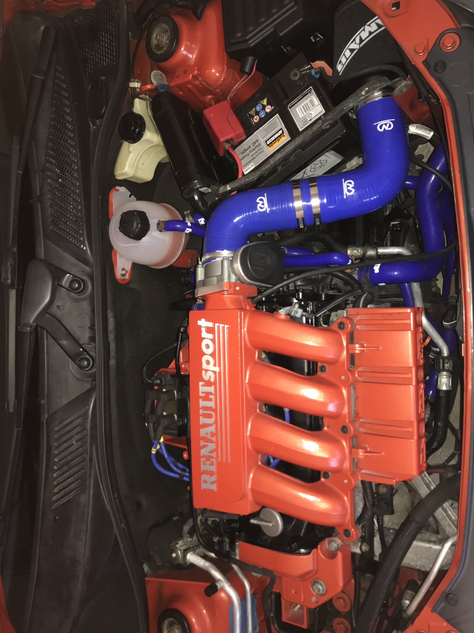

After a horrific winter I’ve managed to find some motivation to push on.

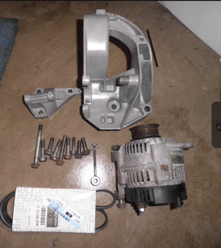

Purchased a 172 cup ac delete

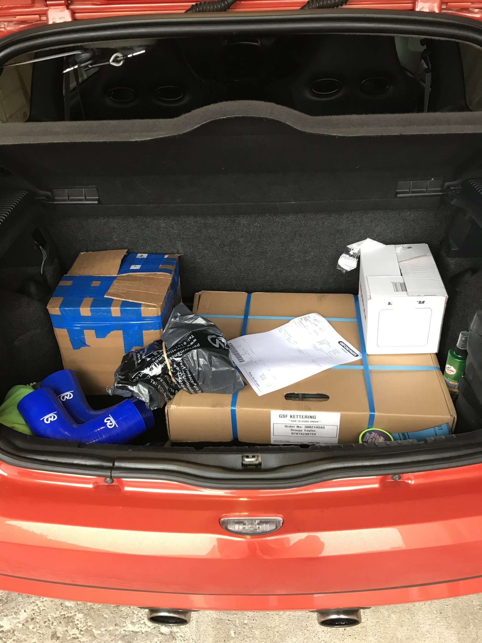

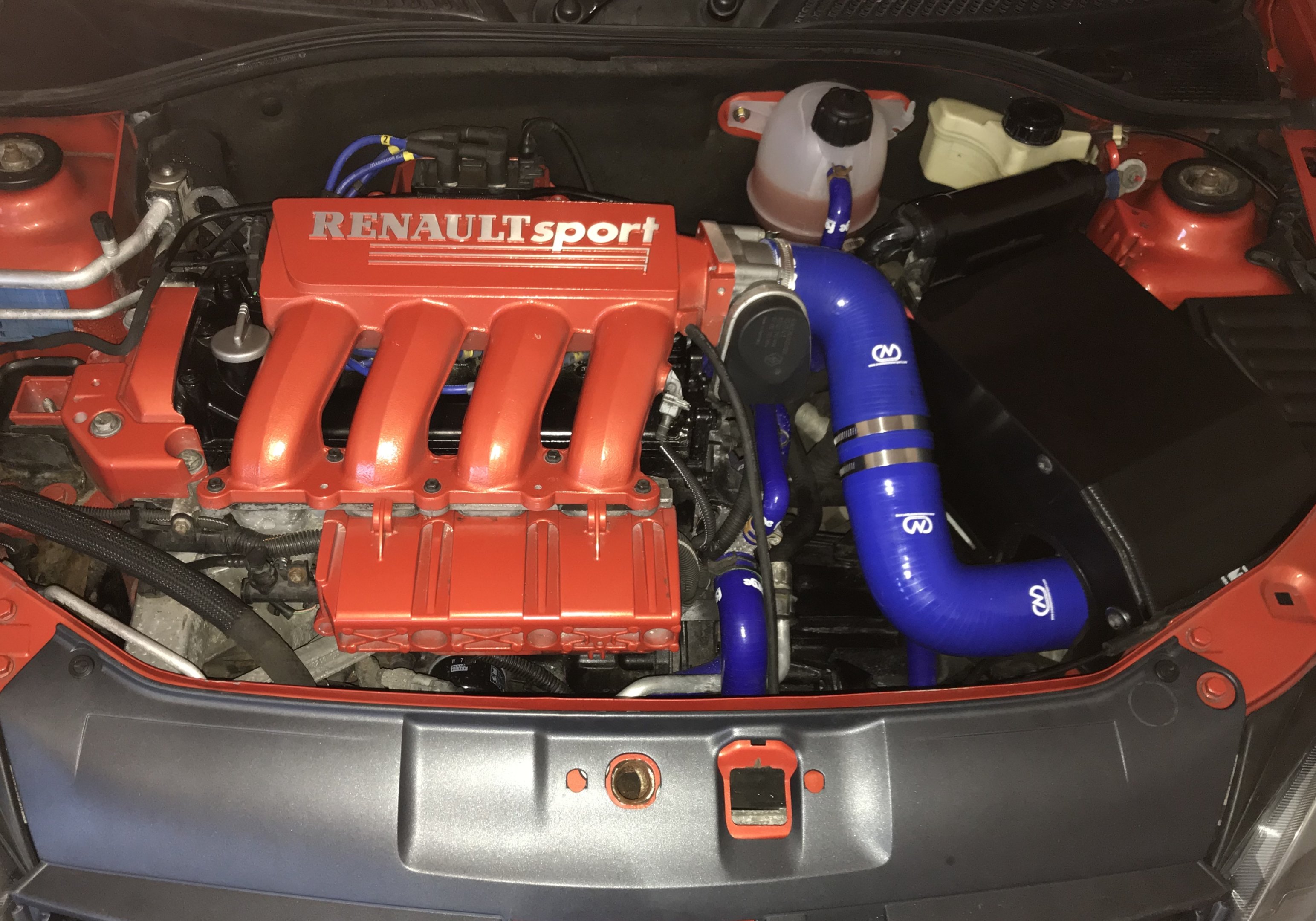

Also have a boot full of bugs that I need to get on the car new rad to finally cure my slow leak that around the bottom hose area after faffing with it for weeks I have come to the conclusion it must be the rad.

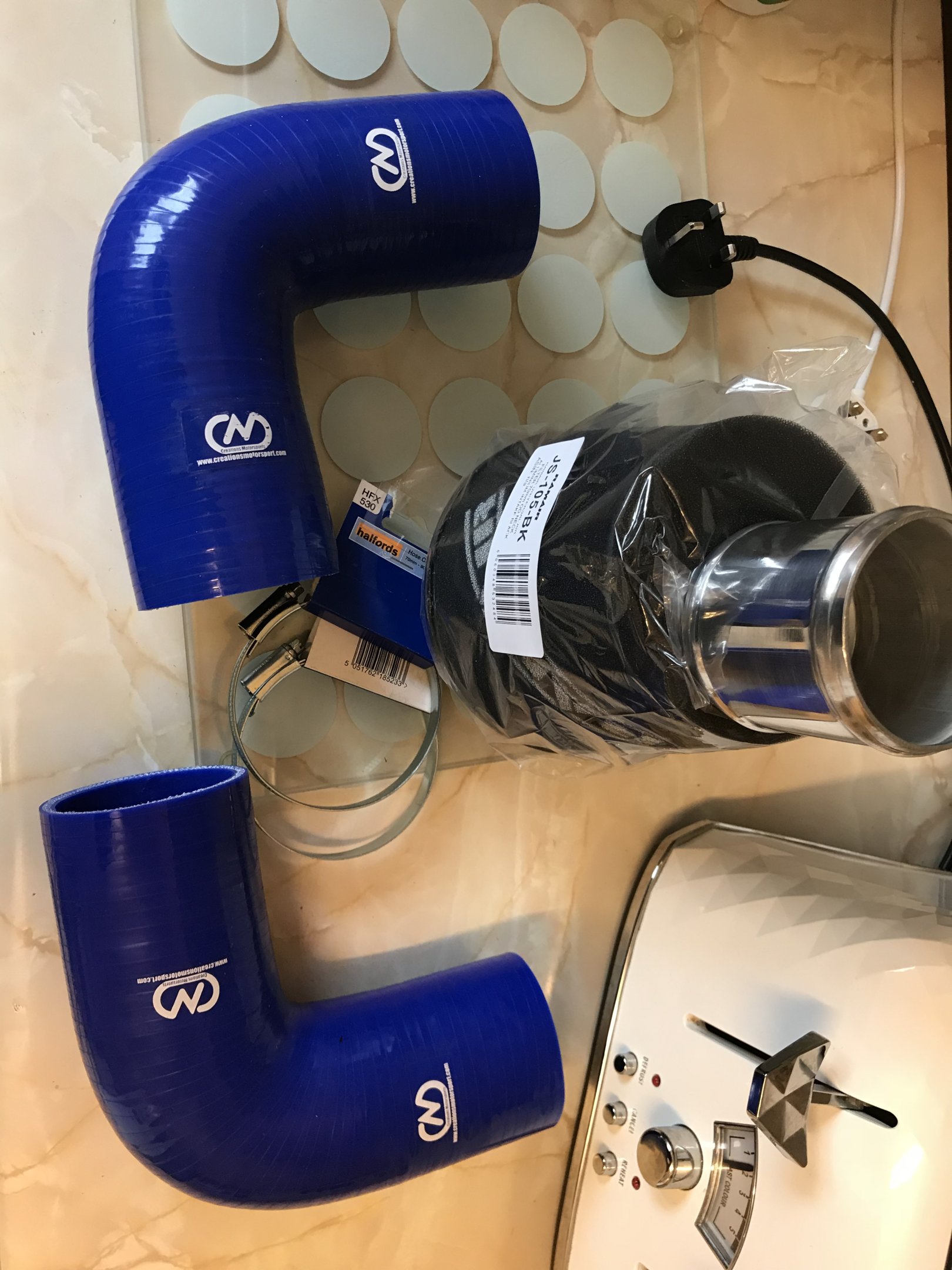

New 90 degree hoses for k tec style induction kit with the ram air filter.

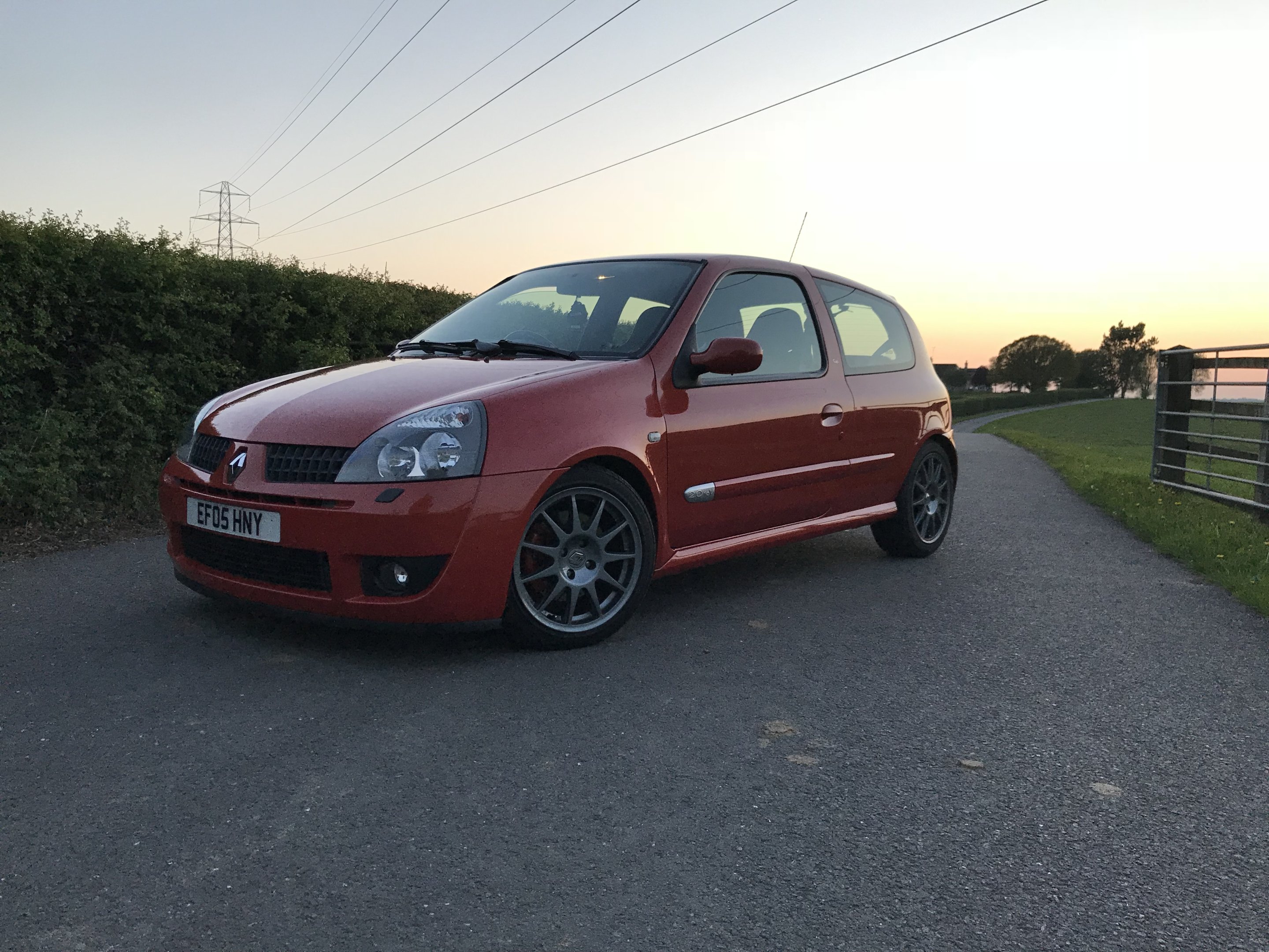

Picture of front end looking fresher with polished lamps new grille and smaller plate

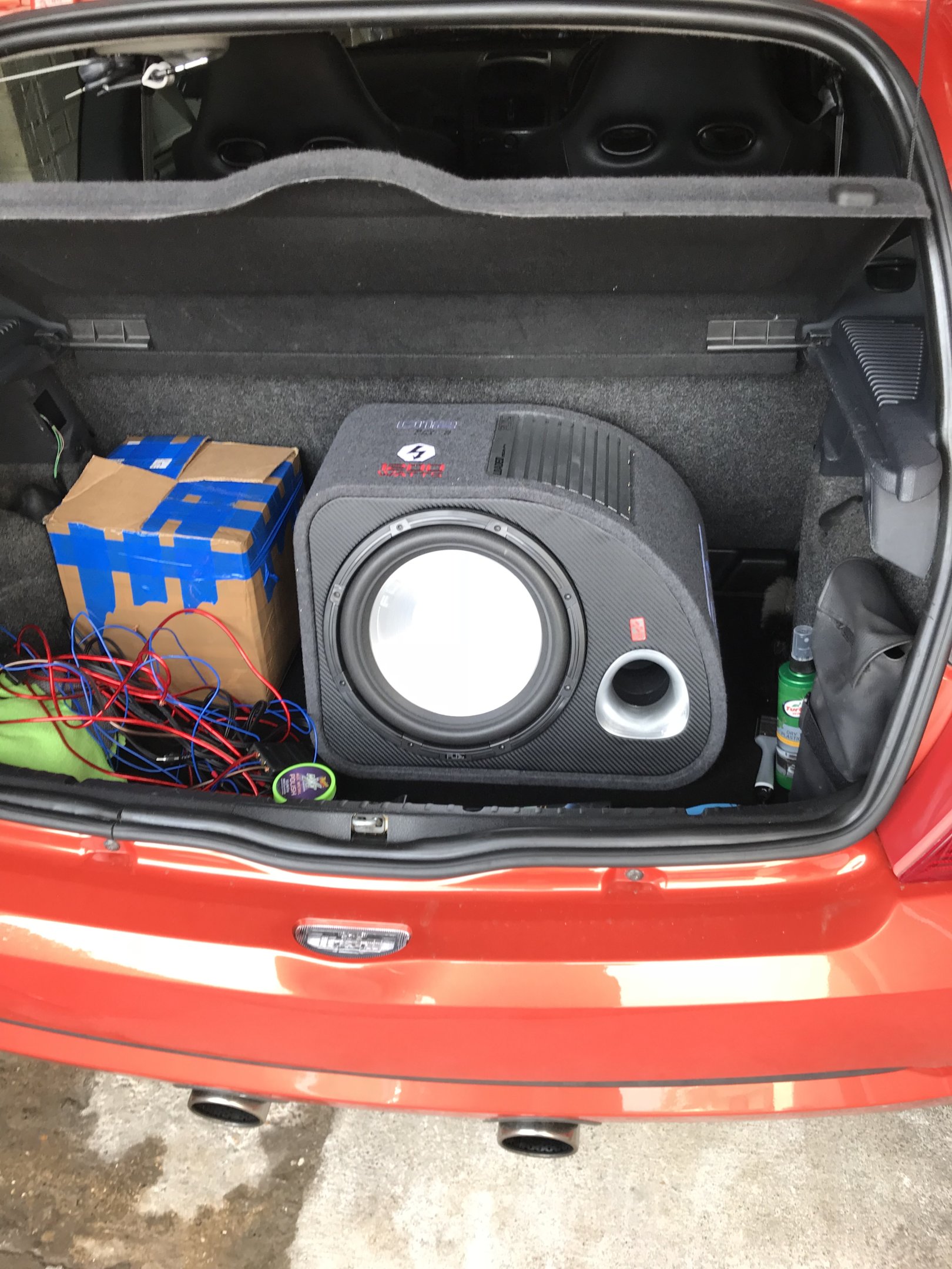

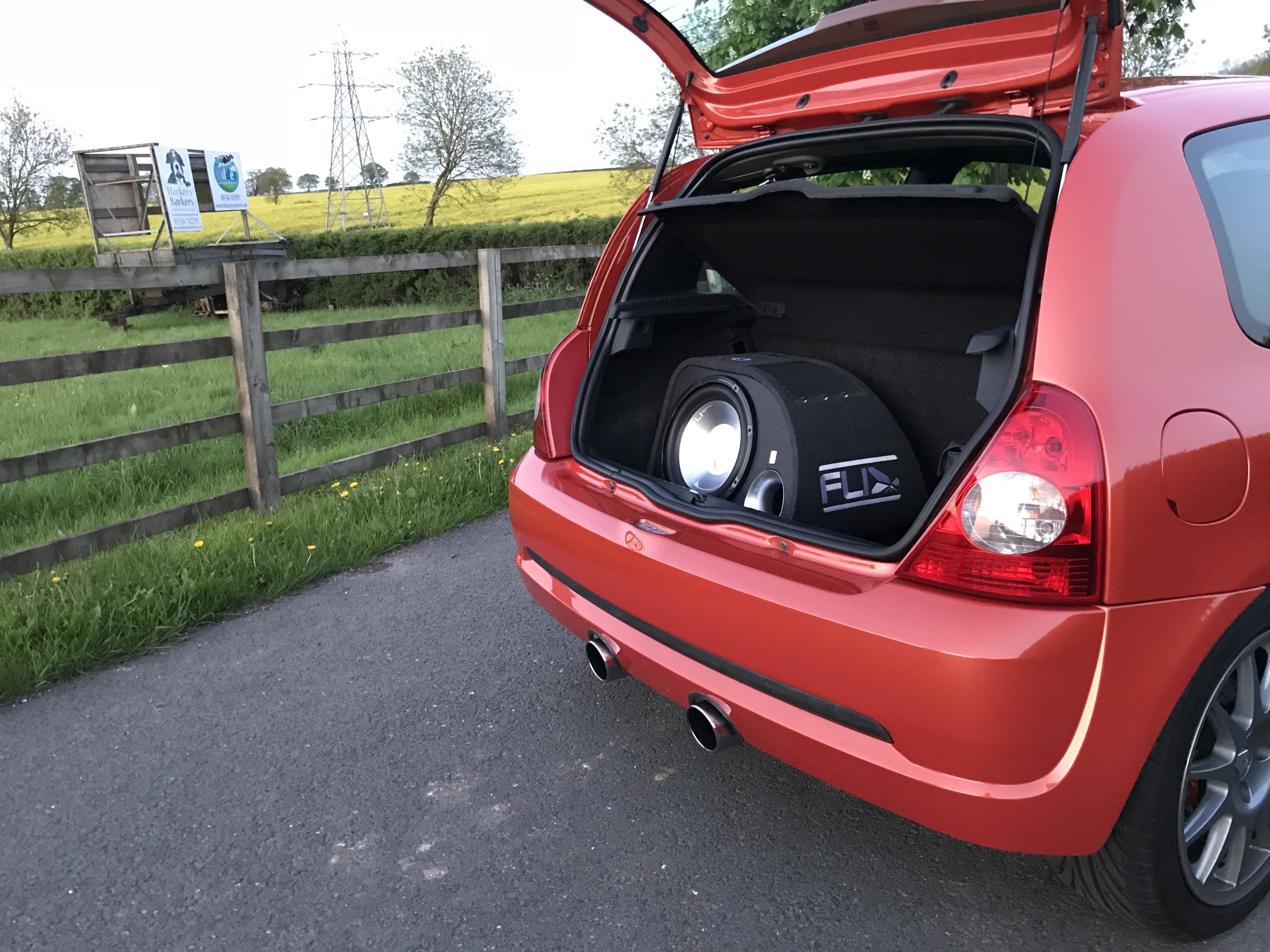

A few drinks friday lead to a some eBay action saturday collectted Early doors. I need to grown up but I love a bit of bass. Will pick up a head unit today and fit.

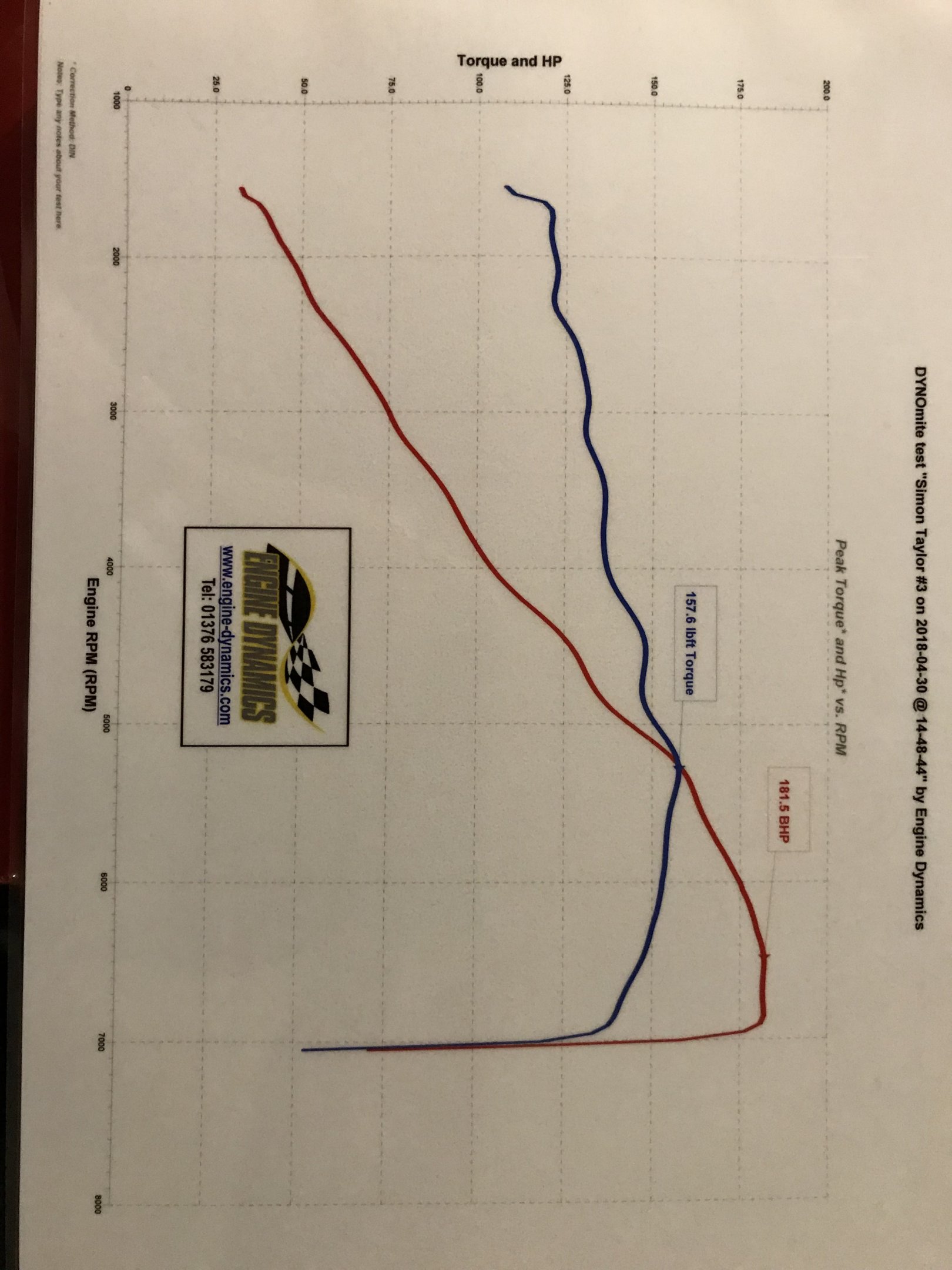

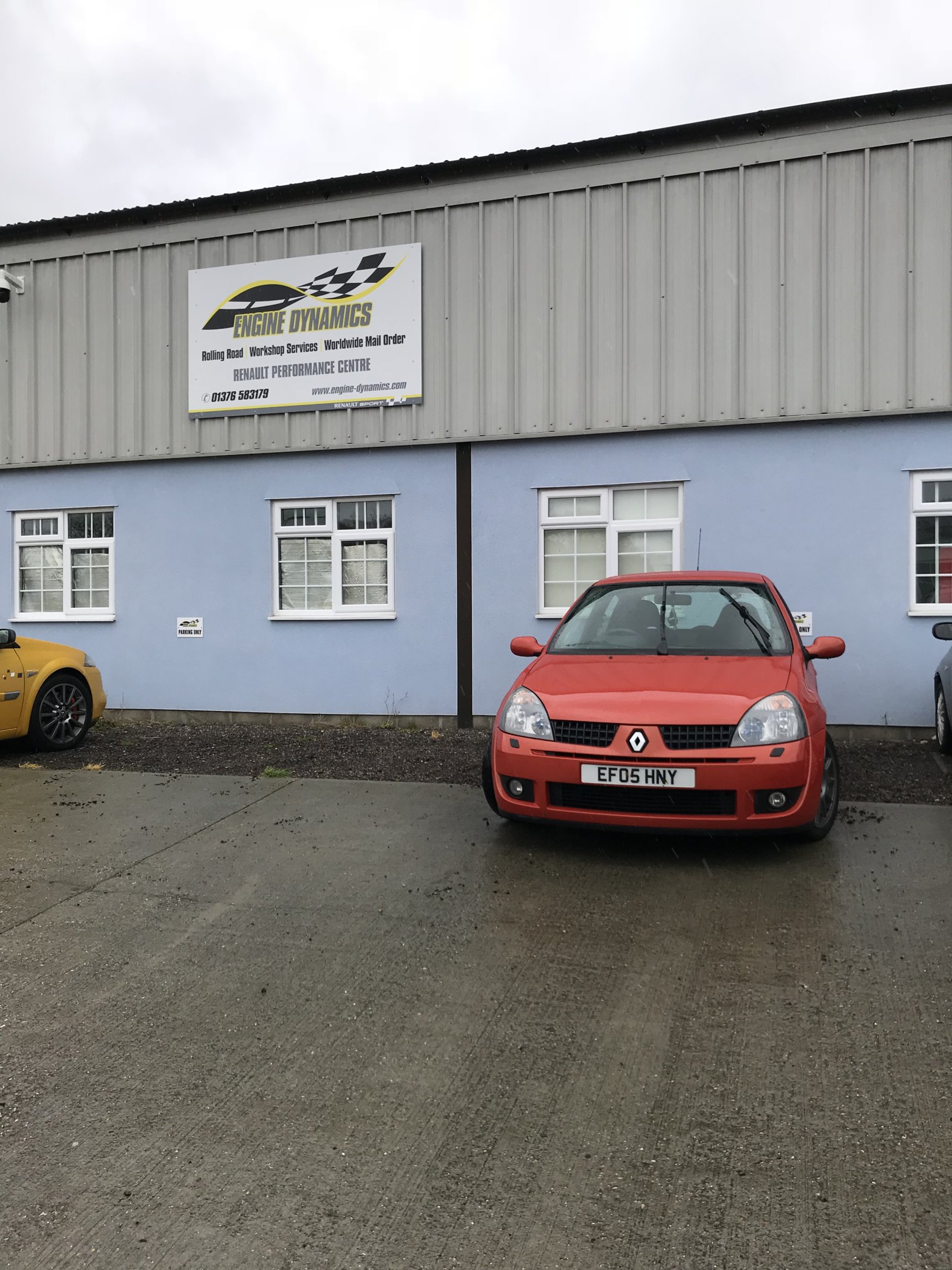

After a month wait for my slot at Engine Dynamics I dropped the car off today for Belts, Cams, water pump, 172 cup alternator set up and new rad. Pick the old girl up next week
  182 cup
After a few days it was time to head south to pick up the car.

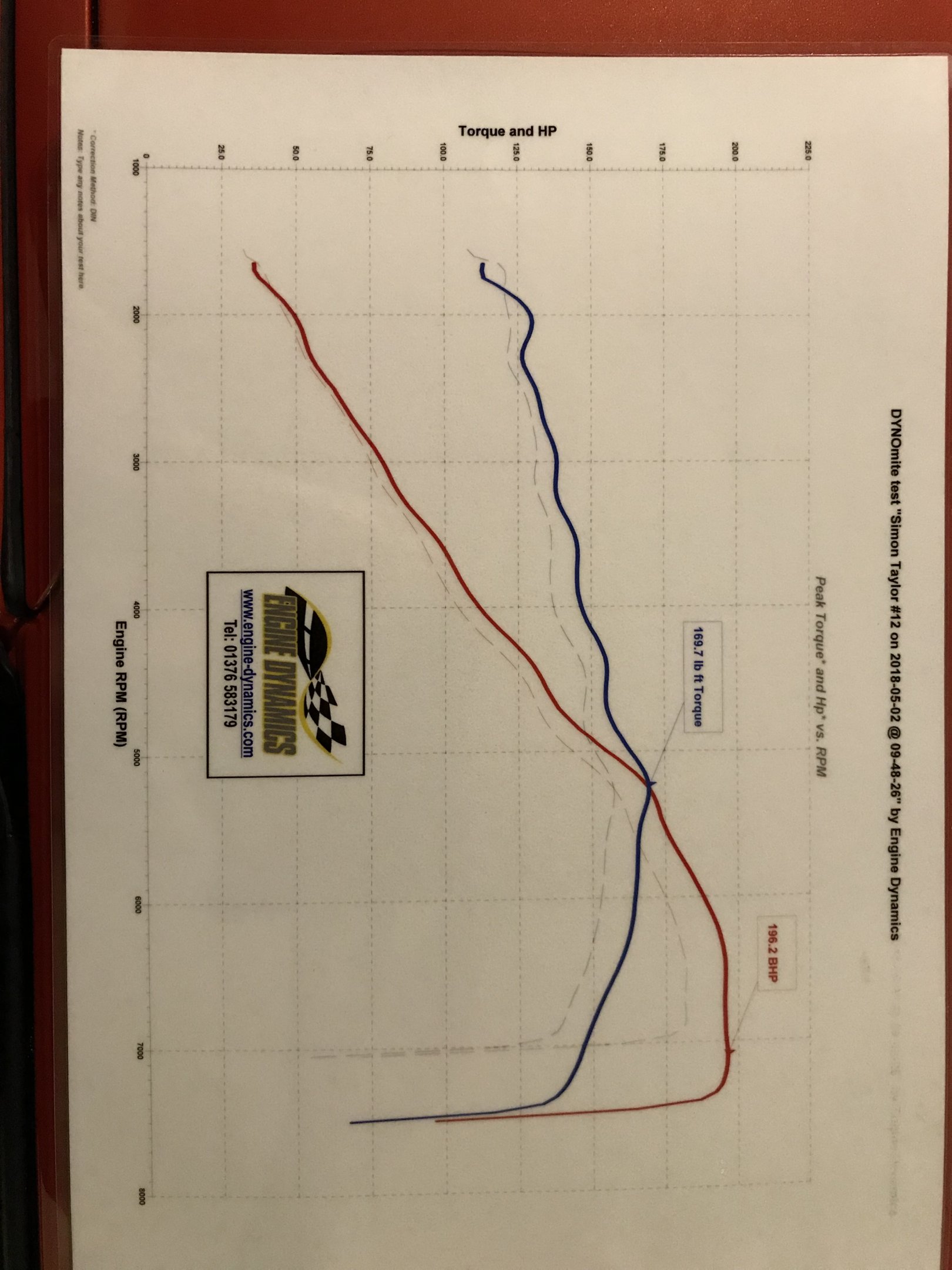

Delighted with the results, she’s come off the dyno at 196 BHP and
  182 cup
After a few days it was time to head south to pick up the car from the guys at ED.
Delighted with the results, she’s come off the dyno at 196 BHP and made good gains in the torque department.
Overall I am delighted with the service from ED and would recommend them highly to anyone. The car feels completely different to drive, more responsive than ever with gains across the board.
Very happy with the car at present and I don’t have further plans to enhance performance at present.

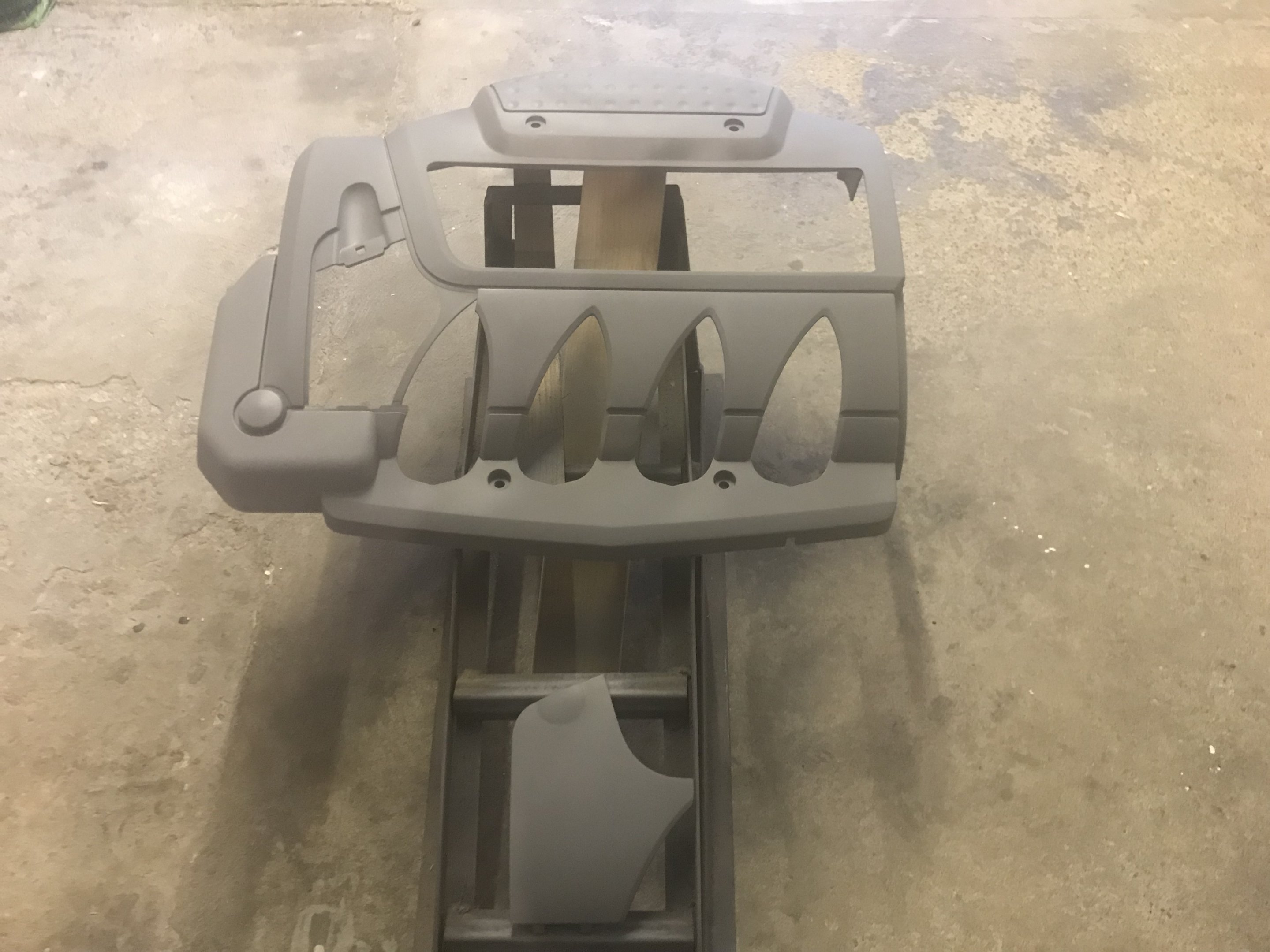

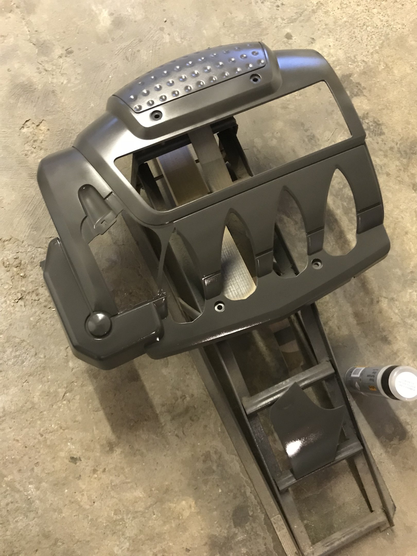

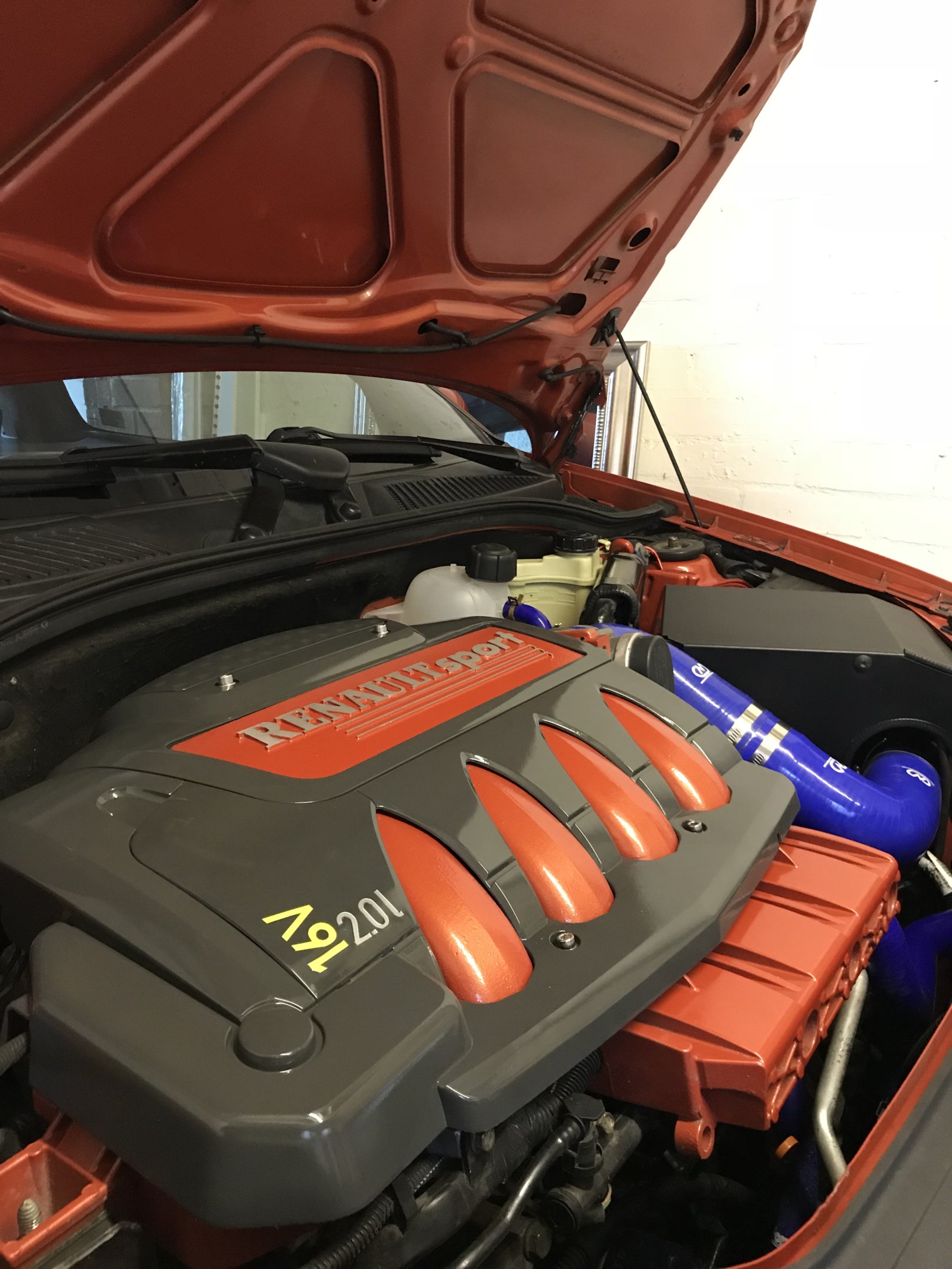

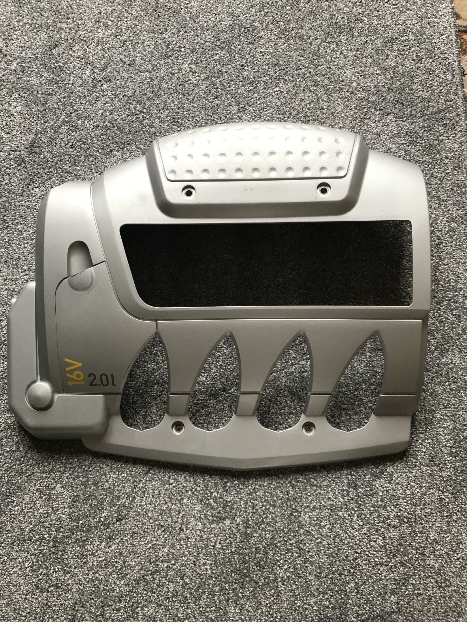

Made a start on painting the engine cover tonight. Not overly experienced at this but so far so good ?
  182 cup
Put some colour to it tonight think ? it’s going ok only time will tell I suppose as I am a total newb to painting.
Hurricane grey (rover)
