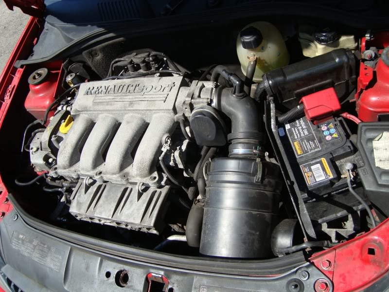

Re: the PMS kit instead of Cup setup - originally i didnt think the alternator was faulty as it was working ok, & the PAS pump was dropping power ocassionally, so though the whirring was related to that, so went for a new PAS pump & PMS kit.
Once it was all built back up, the whir was still there, so they bunged a new alternator on as well - which cured the noise. James offered to take the PAS pump off & not charge me etc, but i decided that it was one less thing to break in the future, so asked them to leave it on.
In addition, the kit is a little bit of s3xyness on a car reknowned for being a dirty shed.

Strangely, its actually cheaper to buy it from JMS than Pure Motorsport:
I agree mate, just saying the cup setup is fairly straight forward once all parts in hand.
The kit on Dave's car looks well put together
I actually got a quote from Wests for the Cup setup (new) at about £350 all in! Ok so the Pure kit was a good £150 more than that, but well, i wasnt that bothered about saving a few pennys here & there tbh.
Whilst i may not clean it that often, it is still my pride & joy, so when things do need doing, it only gets the best parts available :eek:
The purpose of the exercise was to (hopefully) make it reliable for the foreseeable future - after all it has done a fair few miles - so it did need a pretty major overhaul. Re: the price. For everything, it was alot. In fact, i've bought cars for less lol.

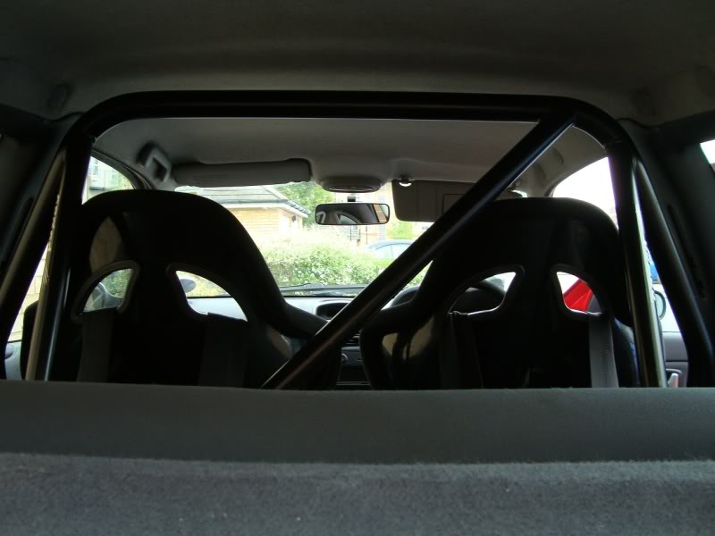

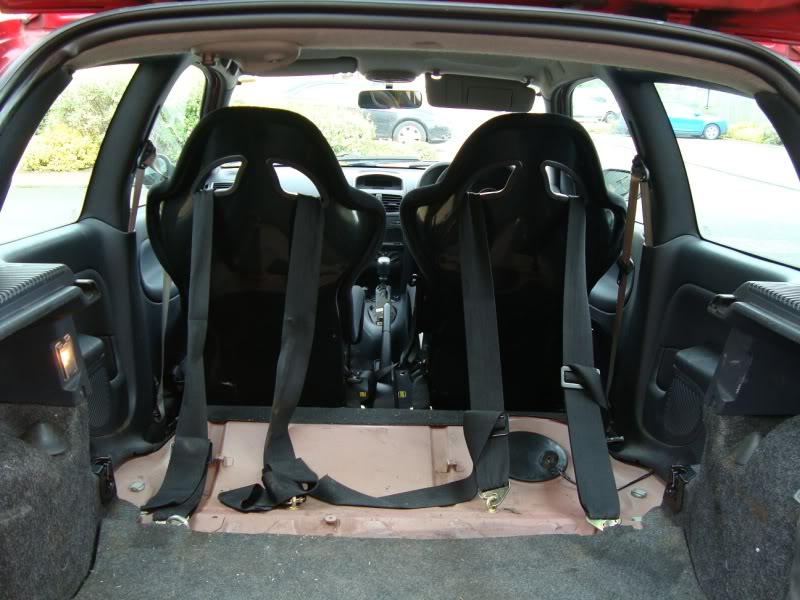

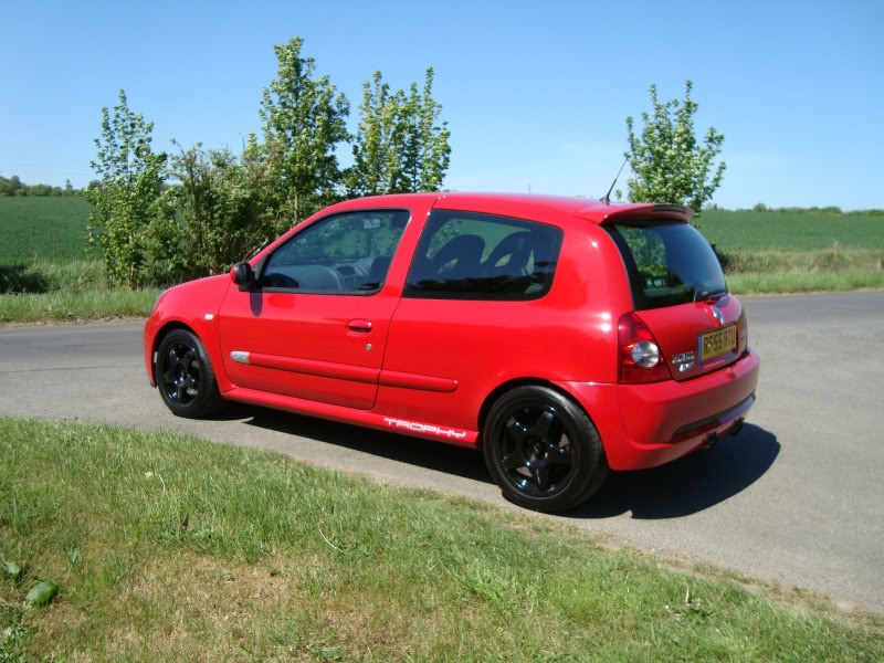

I did another thread the other day (to highlight my new found ability to clean), so thought I had better bung the pics in here before doing my latest update

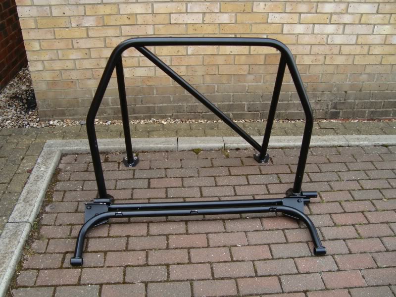

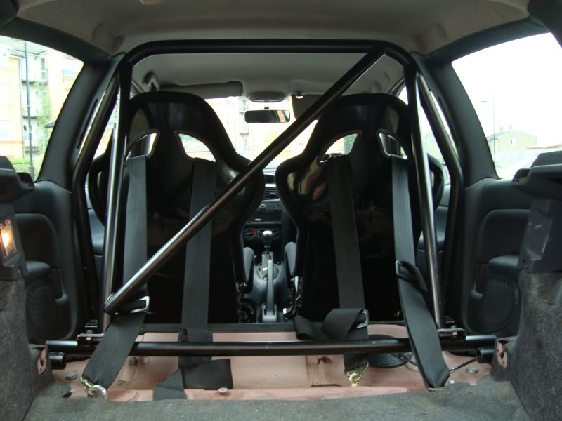

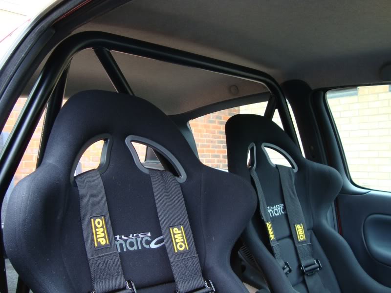

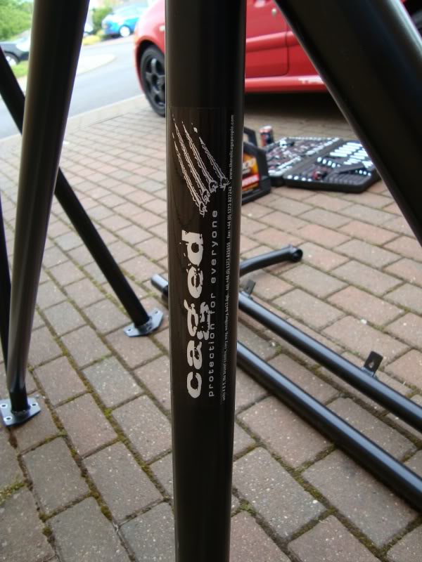

And then, after trying to buy one for years, I finally managed to get my grubby mitts on an MSV cage (from Bubbles), so I trundled off to Oxford services on Saturday morning, & came back with a shiny new toy.
Reason for getting a bolt-in as opposed weld? Well, I wasn’t happy about having buckets, harnesses and no cage at all – be-heading myself in a roll isn’t on my wish list, but I didn’t fancy forking out for a full on cage that couldn’t be taken out if I changed my plans, i.e. put it back to standard/buy something else, etc etc.
Fitting wise, very easy, took about an hour including removing the passenger seat & having a sarnie/crisps/Pepsi break.
Before:
And after:
In addition, as I’m more about useable fun, I also removed part of the rear seat bracket so that I can still put the rear backrest in & out as required – allowing me to still use the boot as well, a boot. Helps to drown out the BTB as well tbh.
Overall, very pleased, fits well, looks nice, & if the worst happens will no doubt add a little bit of exra protection for my bonce.

Thats a good idea with the back of the seats! I never thought of that...
I wanted an excuse to install fixed buckets and a cage but retain full (almost) use of the car...
I'd be tempted to but a used bench and chop it to bits just for the look of a complete rear interior :)

tidy wee cage that. Nice one...possibly the most purposeful Trophy!.. wouldn't say most tinkered! Steve's turbo beast

Good to meet you at the weekend Dave, and nice to see you got it in and fitted. Looks very purposeful in there :)
Thanks, fitted it as soon as i got home :D Was good to meet you both as well!

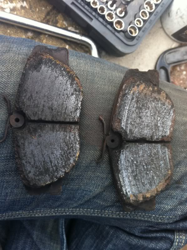

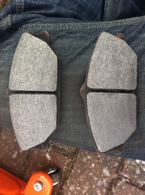

Your prays may well be answered, not necessarily through choice though i might add!! Reason? On Saturday, i fitted some Carbon Lorraine RC5's.
Firstly, this is what a set of DS2500's look like after 40k miles, 3 1*2's, a saxo, 5 trackdays, 11 laps of the 'ring, and three small occasions of fire/serious overheating:
Now, they still worked fine, but as the actual pad material was starting to get a wee bit thin, & the brake pedal travel was to get a little longer, i thought i had better change them.
Although tbh, if i hadnt picked up a set of nearly new RC5's for £50, i probably wouldnt have bothered lol ... they do look less crumbly & more like brake pads though!
Fitting took about 5 minutes, but cleaning the brake dust off the wheels & bodywork might take forever. Essentially, after going for a quick drive (with all my spare parts/cr4p/tools in the boot), its safe to say that the stopping power is pretty ridiculous, matched only by the laughable amounts of grey dust that goes everywhere. It might even pi55 me of, but only as my wheels are currently gloss black :eek: Give it a month & i wont notice amongst all the other dirt though ...
