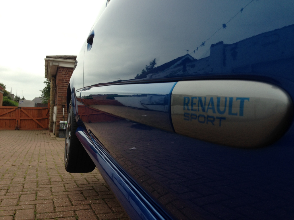

Few bits and pieces I've bought and fitted and/ or awaiting to fit...
Really comes together in the sun,

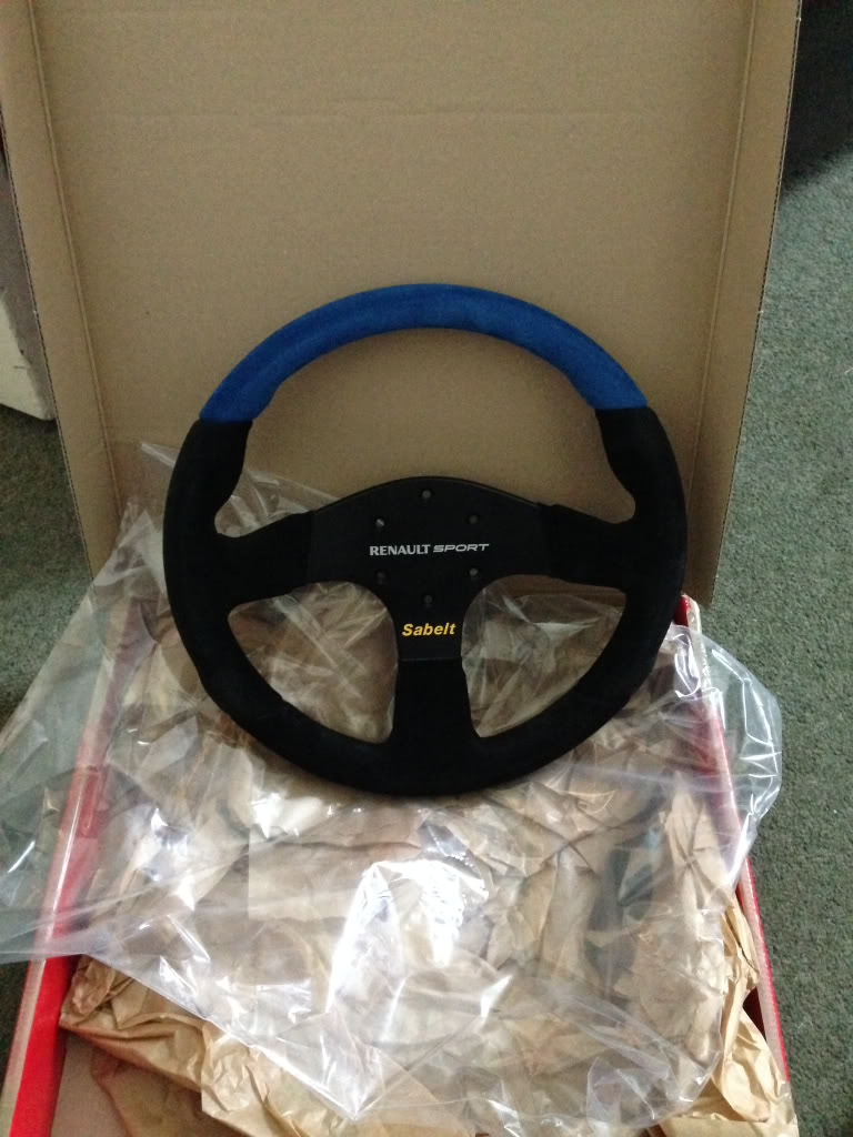

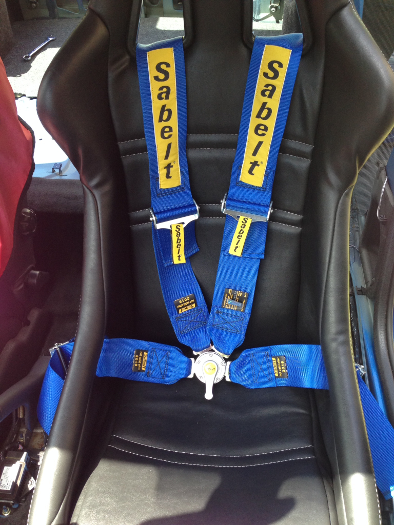

Sabelt wheel!!! Bloody love these! Not currently fitted not got around to it yet. I've sourced a ph1 horn stalk to also accompany this along with an OMP boss

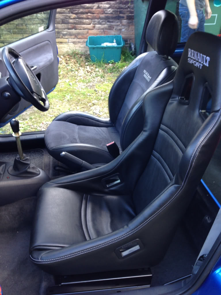

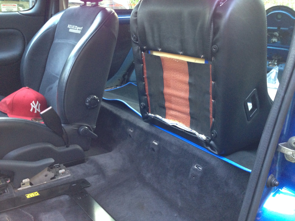

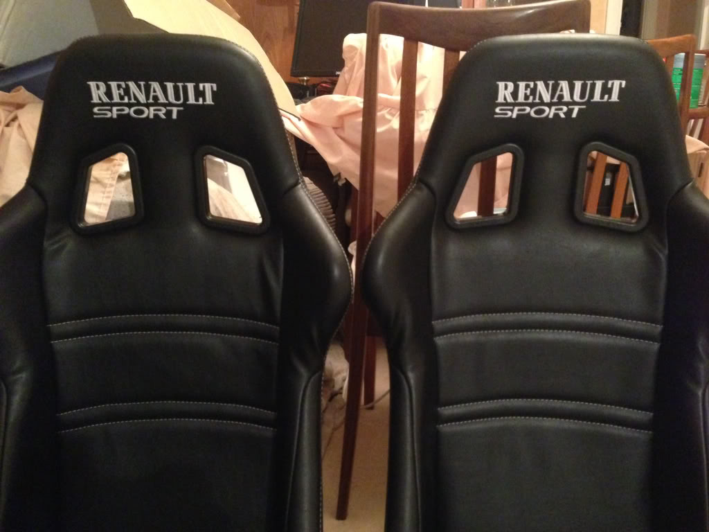

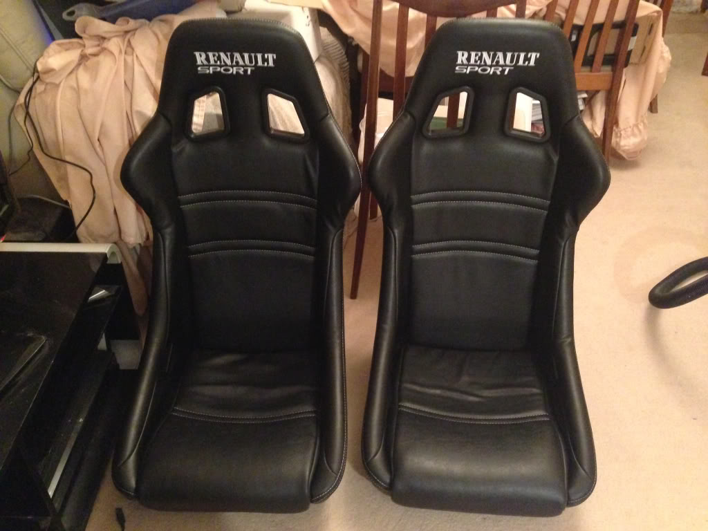

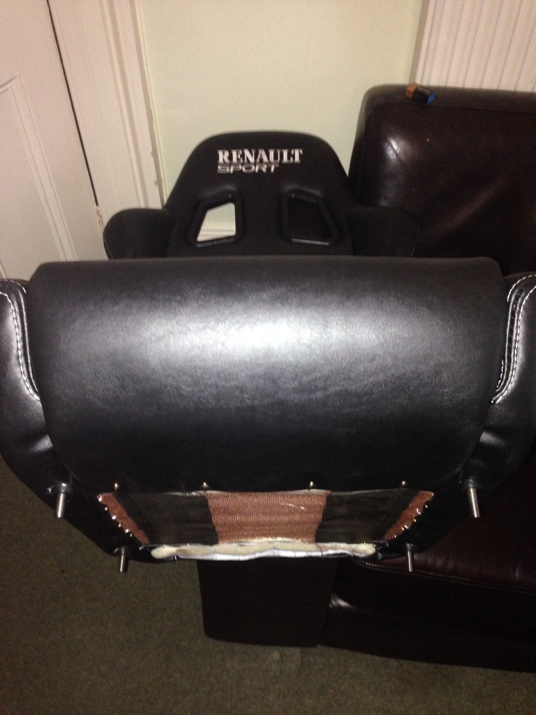

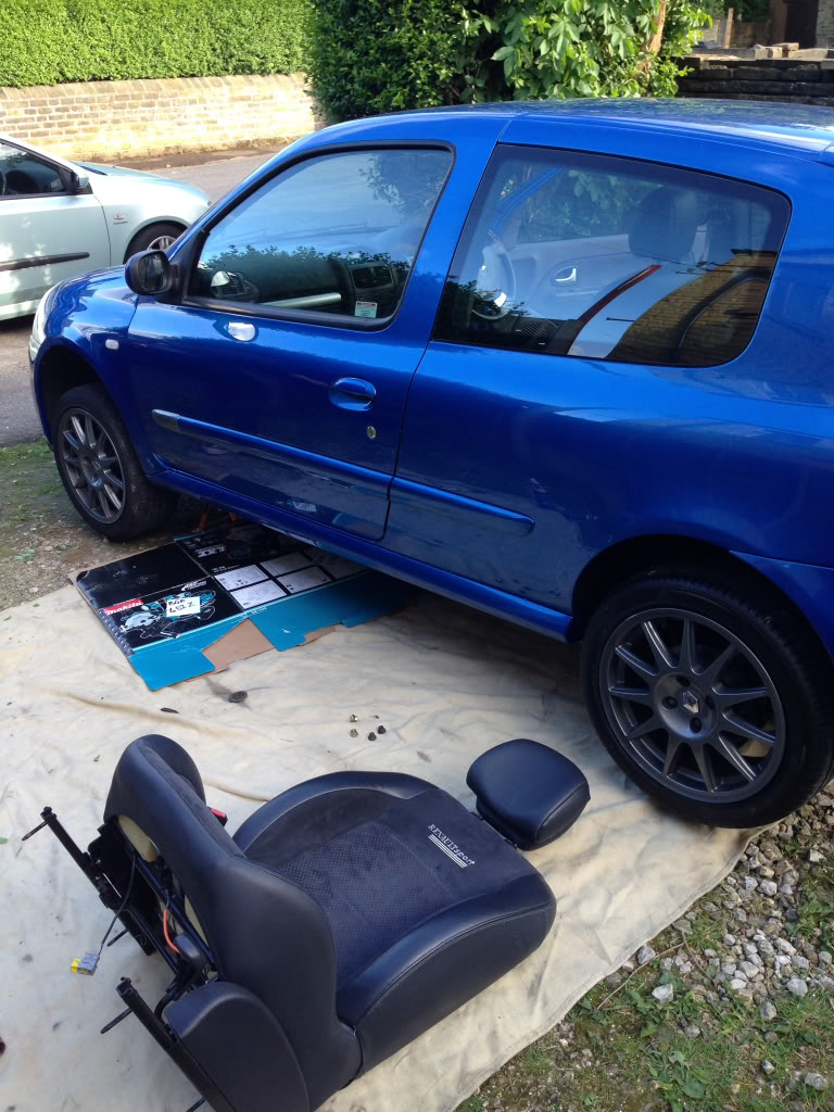

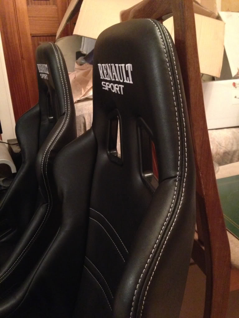

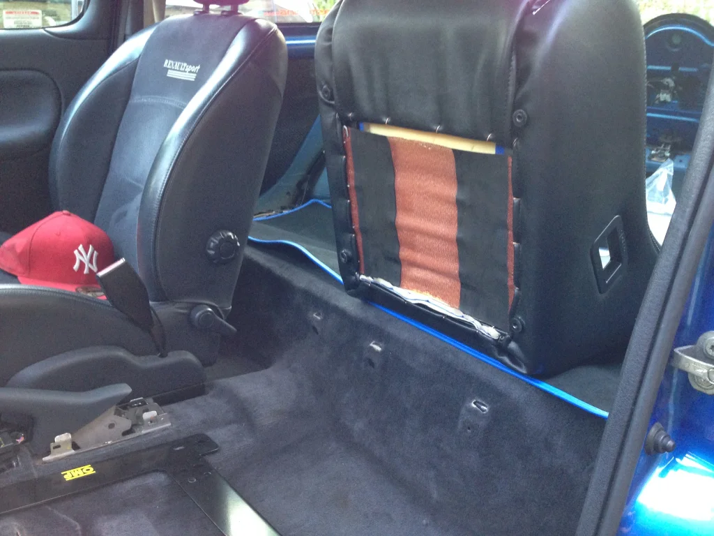

Bought a lovely pair of leather reupholstered Sparco Speed 2's from a good friend of mine @Martin.

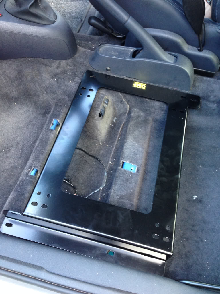

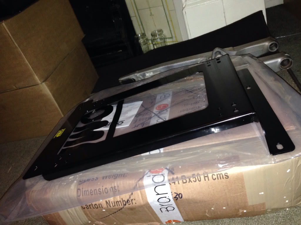

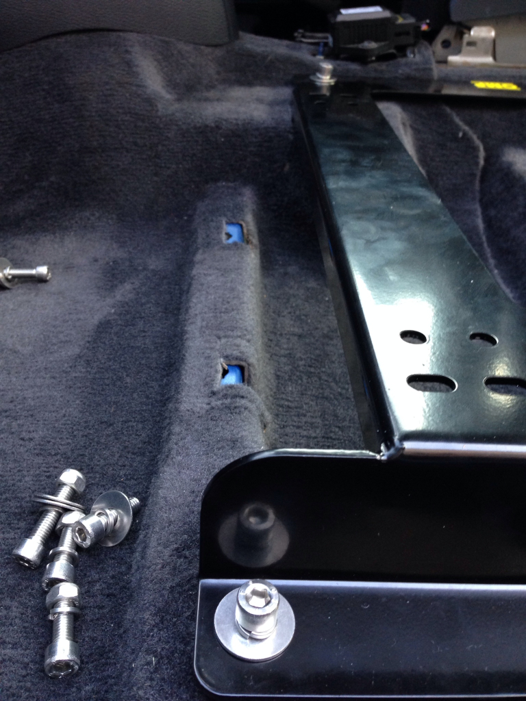

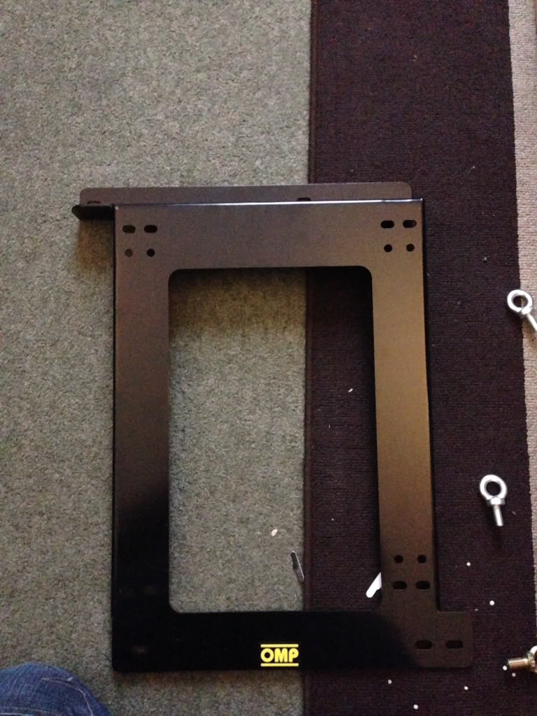

OMP Frames
Loose fitted it all to see how it looked

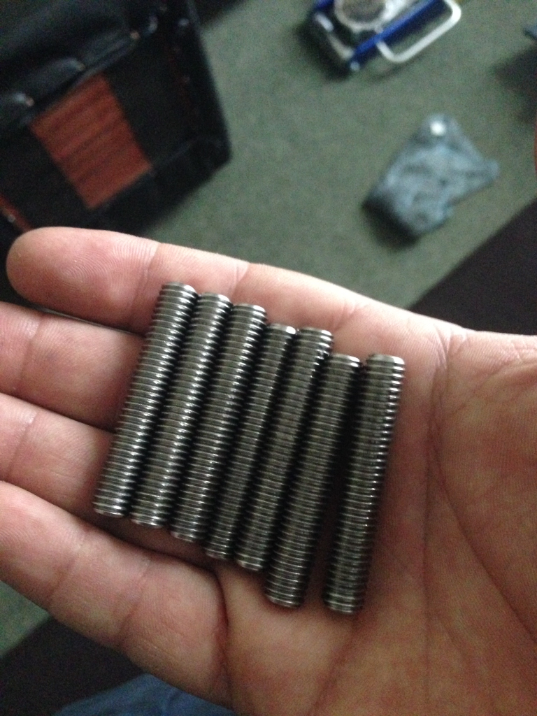

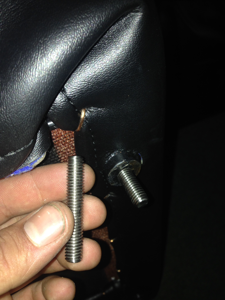

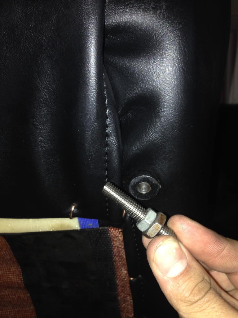

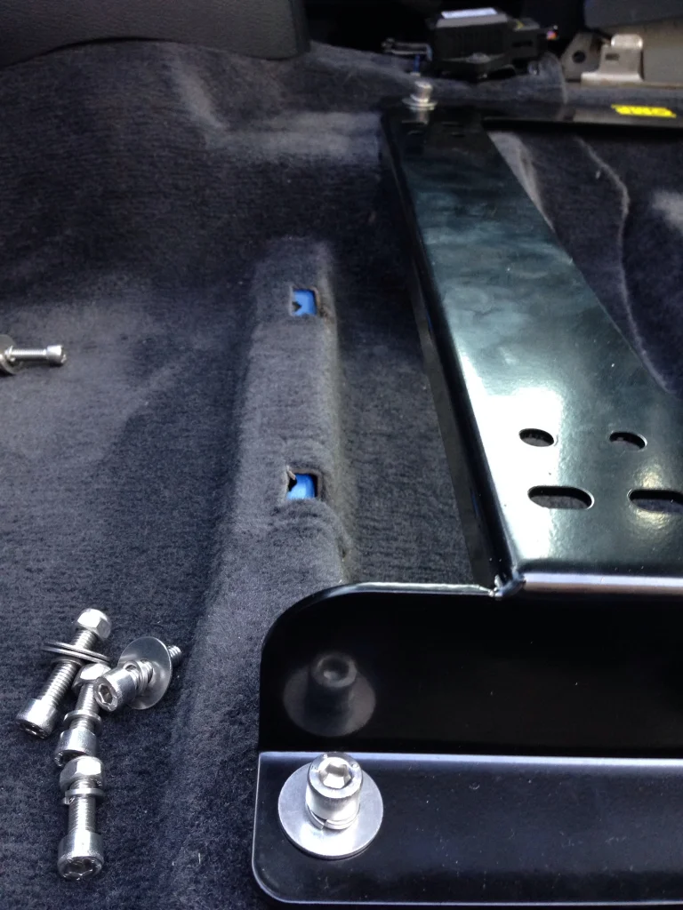

Because of the way the frame is bolted through the underside of the car I wanted to make pulling the seat out as fast as possible without much faffing about if I wanted to pull the passenger one out for track days etc so I decided to convert the base mounted seat to studs so I can quickly from the bottom of the frame remove a nut and lift the self aligning seat on studs off.
M8 high tensile Stainless Steel studs
Two nuts together along with some high strength stud lock and job is a good one
More stainless fixing for the OMP frame a bit overkill with the spring washers and Nylocs but works well and protects against vibration.

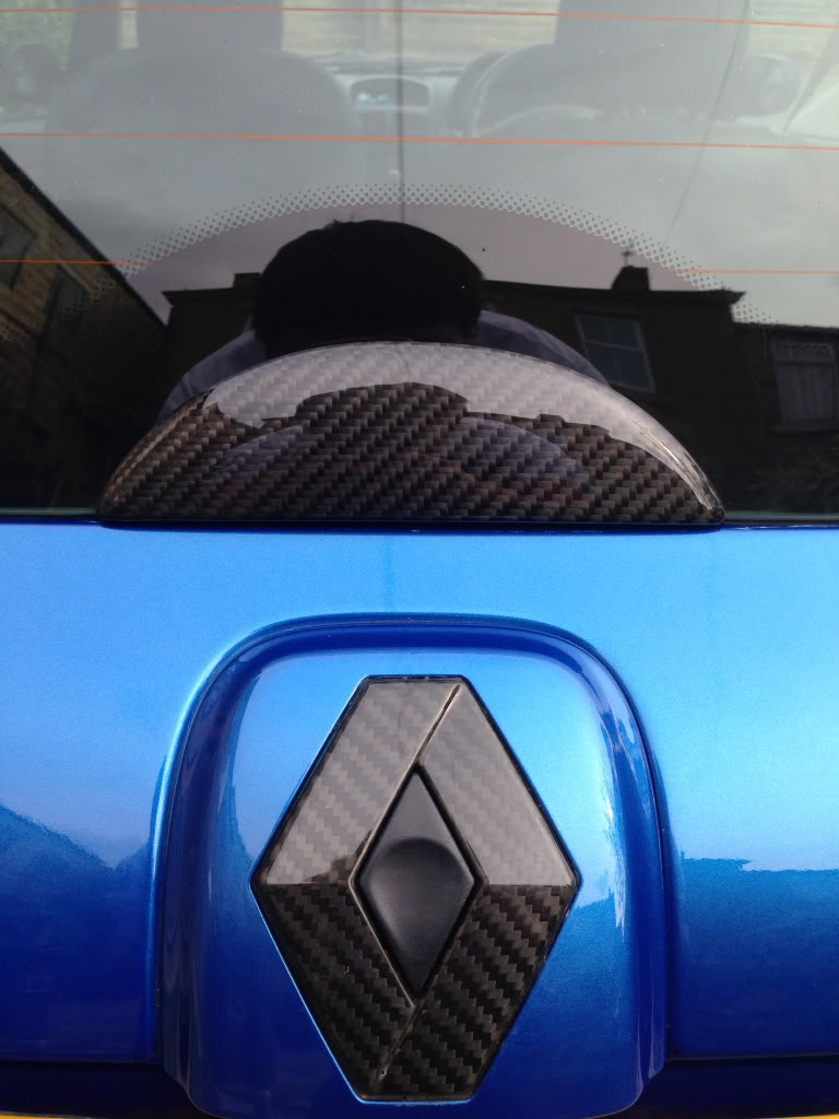

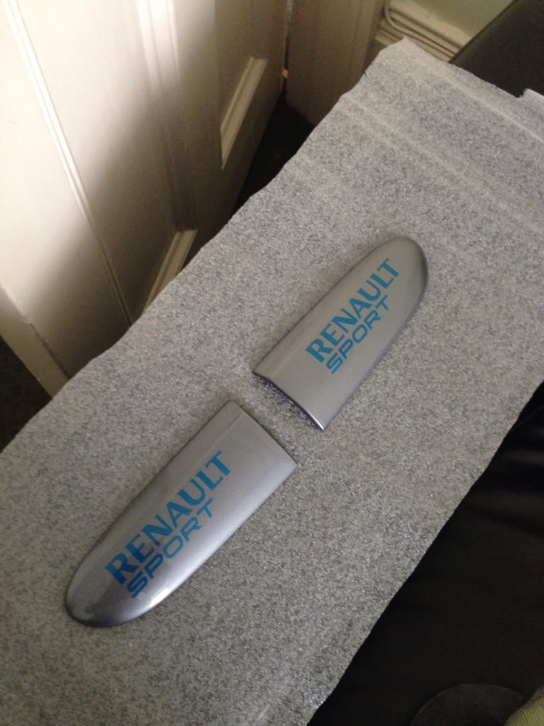

Awesome build! Those bullets look great too. I'm tempted to de-wiper mine now aswell
  CLIO 182
Cheers buddy!
Yeah I love the bullets the colours work really well with the arctic blue and the anthracite!!

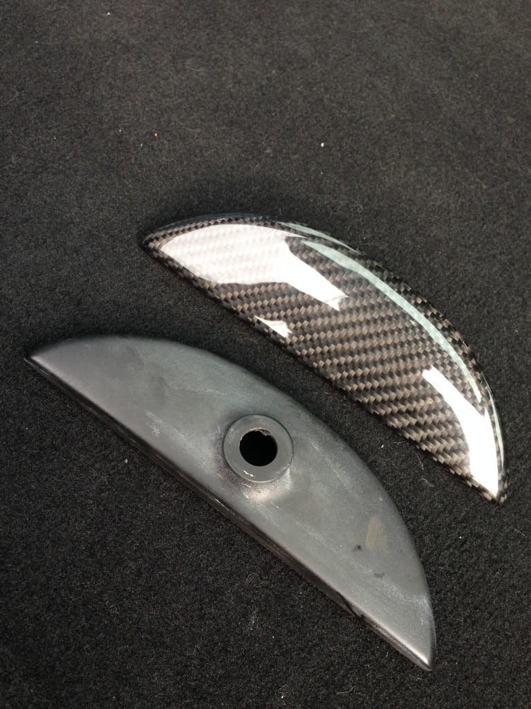

I was never a huge fan of the de wipered look myself until I saw the carbon blanks going around took me a while to source Chris but found him on here eventually nice chap and will I'm sure be glad to make you one.

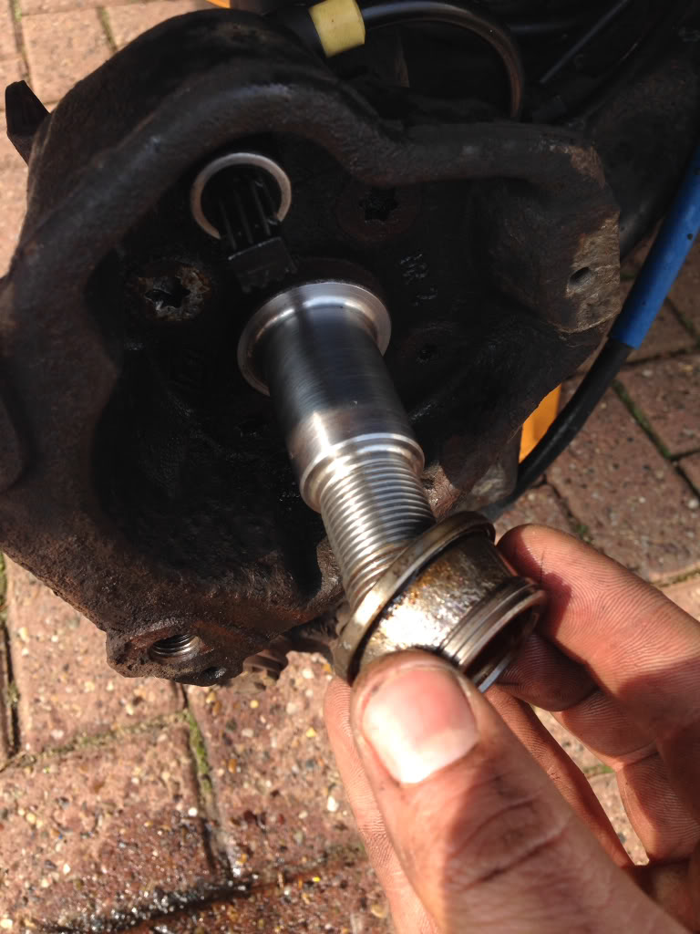

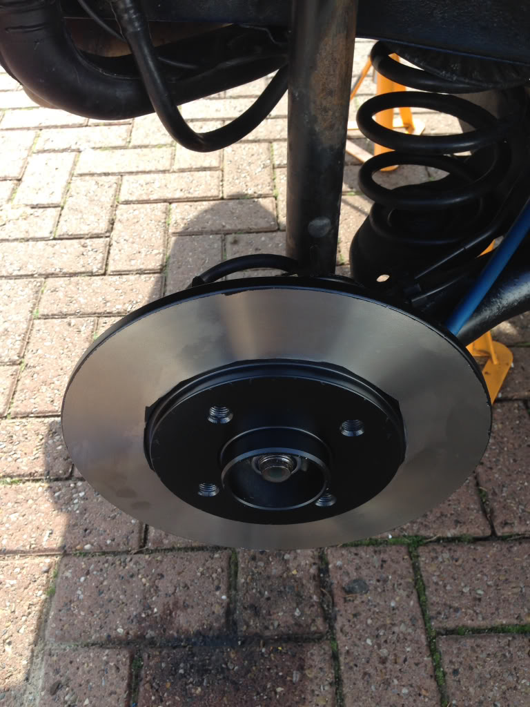

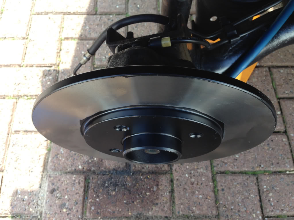

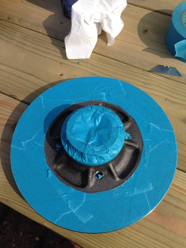

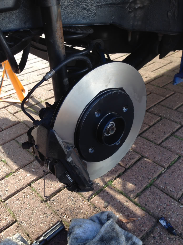

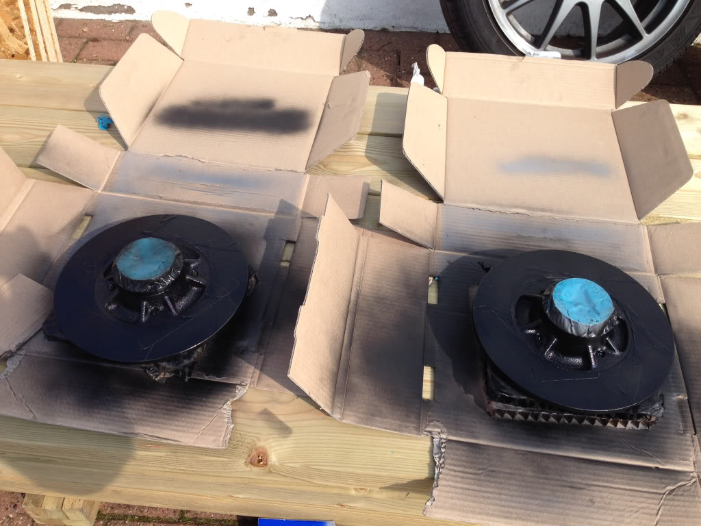

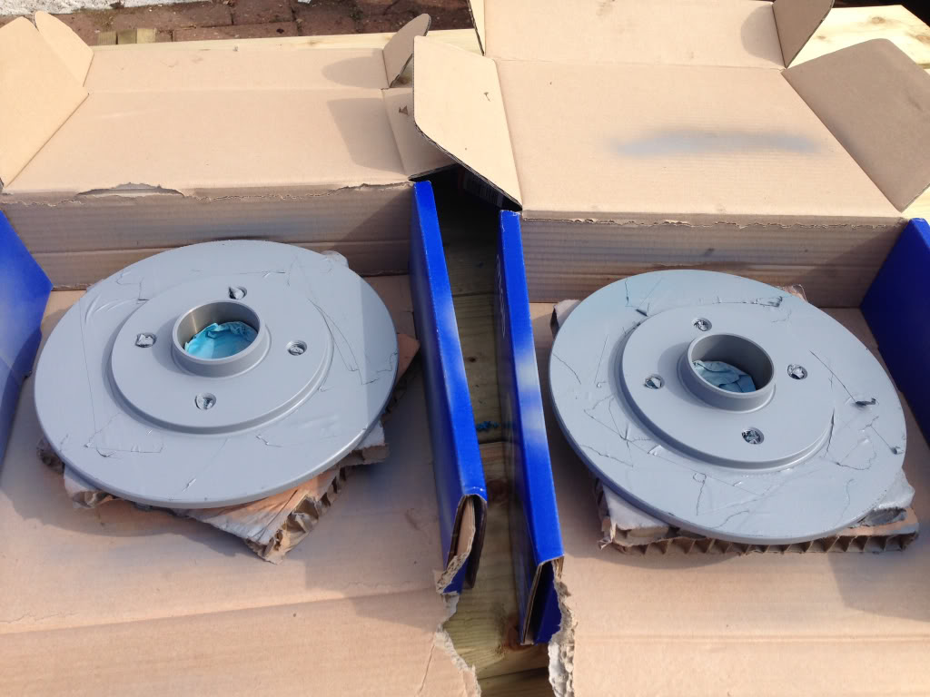

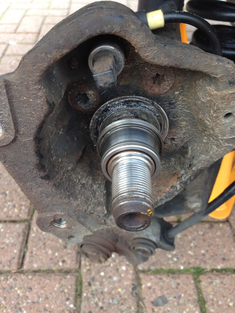

Also fitted new rear discs/bearings and pads and as these tend to last for ages I decided to paint them to stop the edges and centre rusting, hate the look of a rusty disc lurking behind a clean wheel
Used a height temp VHT primer and VHT enamel black
Bearing was seized on and came apart with the old disc leaving the race behind lots of lube and a blow torch later it came of easily enough then cleaned up the stub axle
New washer and nut fitted
The face was painted only lightly and shouldn't affect the wheel mating surface (now been on and off a few times and is still fine)

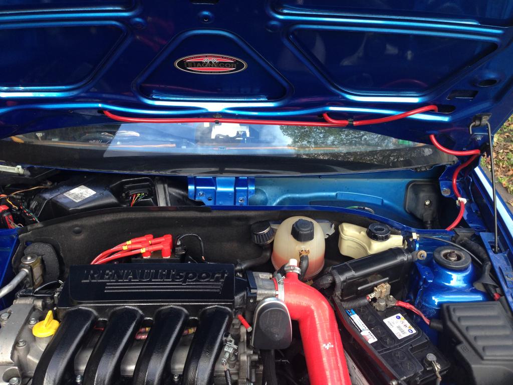

Love the engine bay. What's your views on the magnacor leads?
  CLIO 182
There's always something that gets in the way, but at least that way it makes you enjoy the car more!
Yeah your certainly right about that mate! Ive actually between now and the last update done quite a lot to the car just havent had the time to upload all the photos etc as its quite time consuming and ive never had a evening free where im not doing anything to do it!
Wit regards to the leads, they certainly look fantastic there's no doubt about that haha and being a thicker pure silicon i'm sure they'll have some benefit but then again so would refreshing with OEM more than likely as they were getting on a bit and looked pretty rough.
I certainly didn't really notice an improvement even combined with the matched inlets, new plugs and the IDK. Student loans were in a being a daft student I thought they would look decent with the engine mount and IDK haha :up:

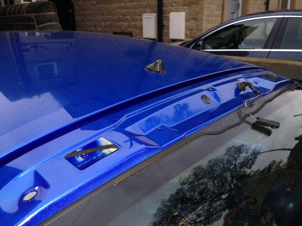

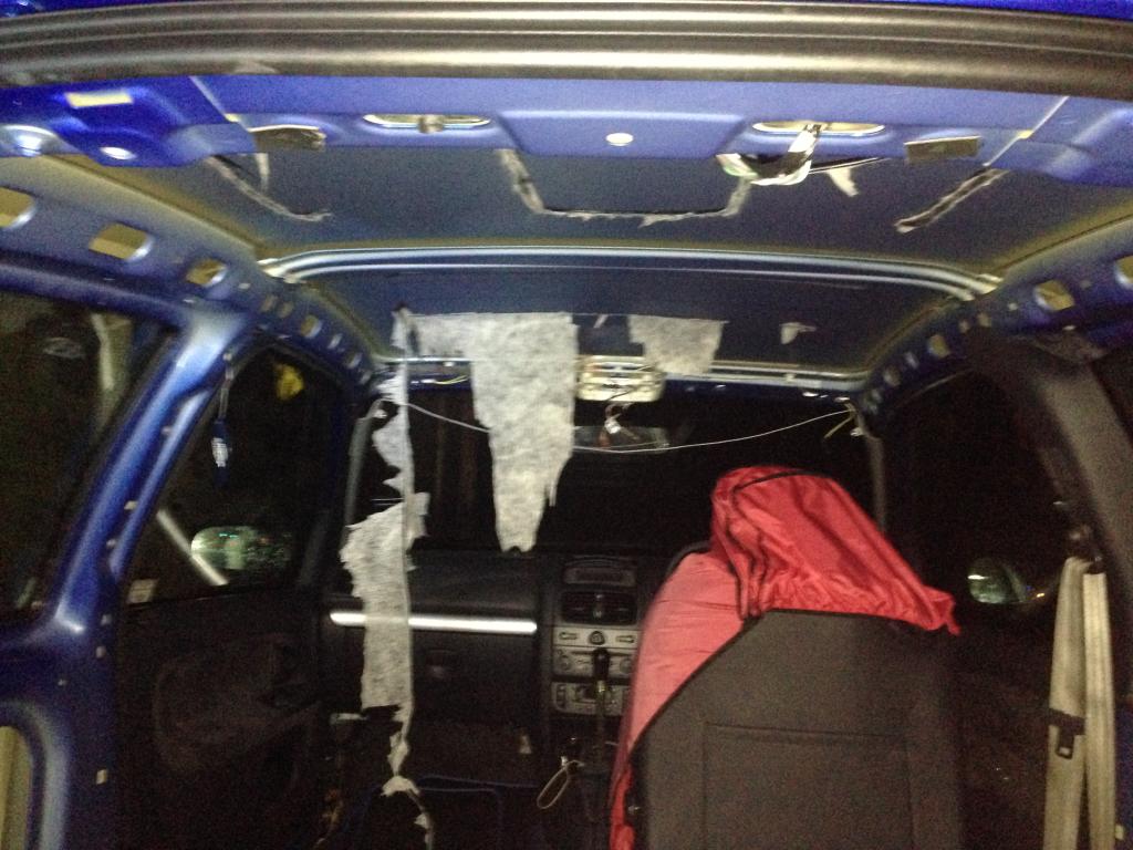

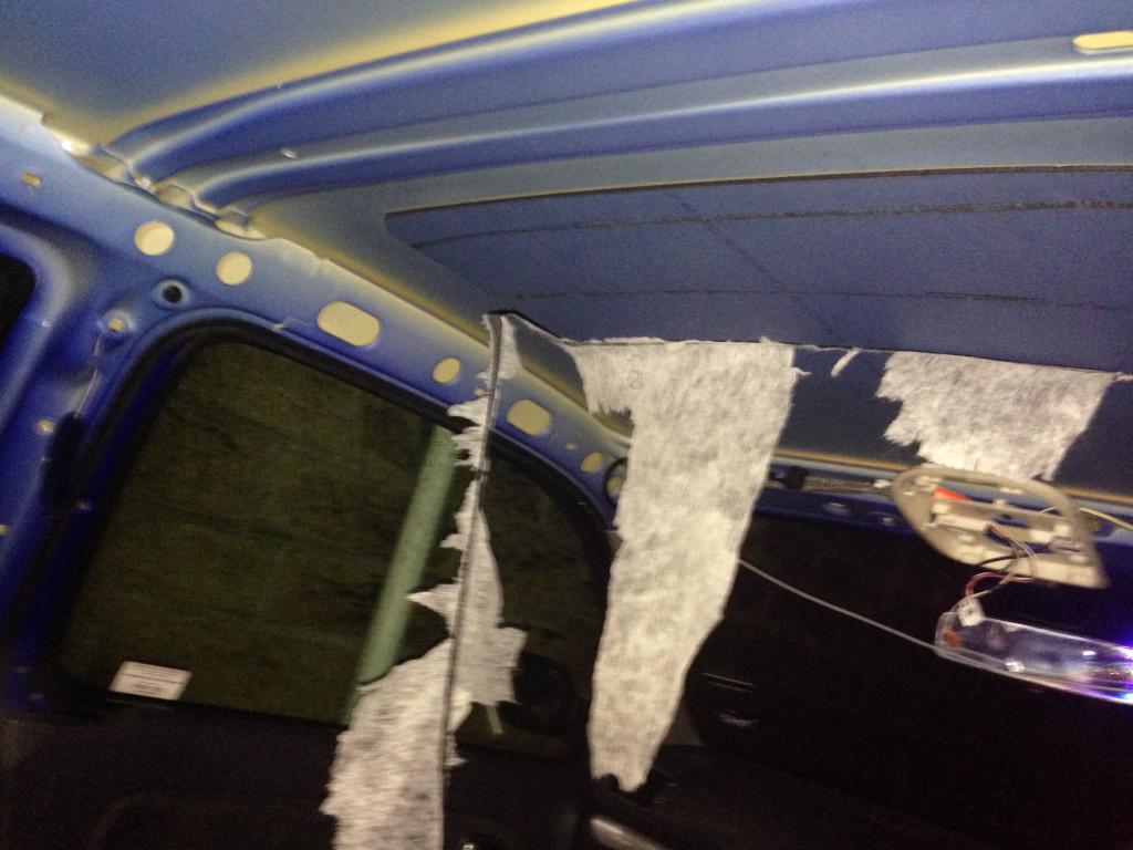

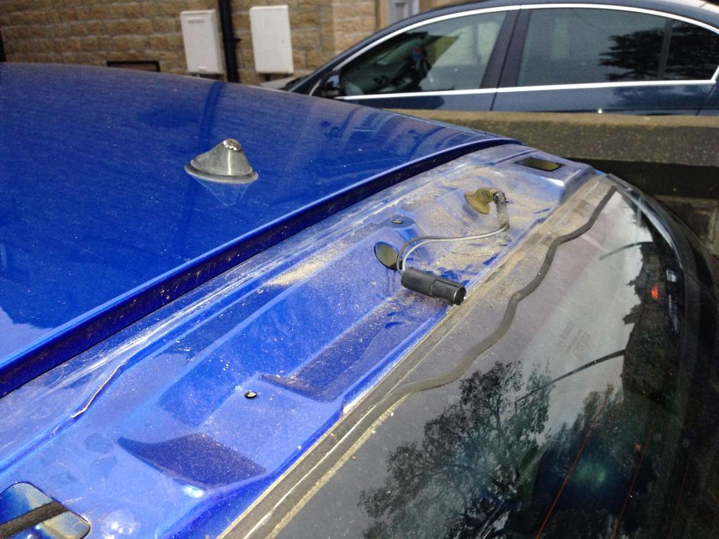

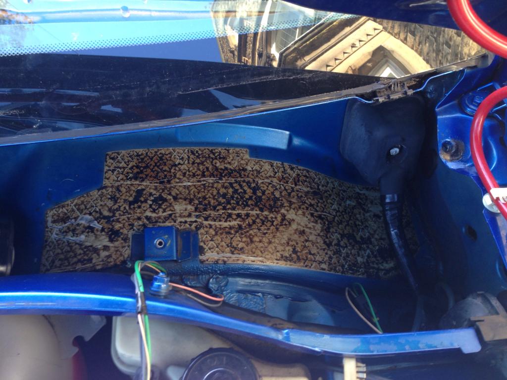

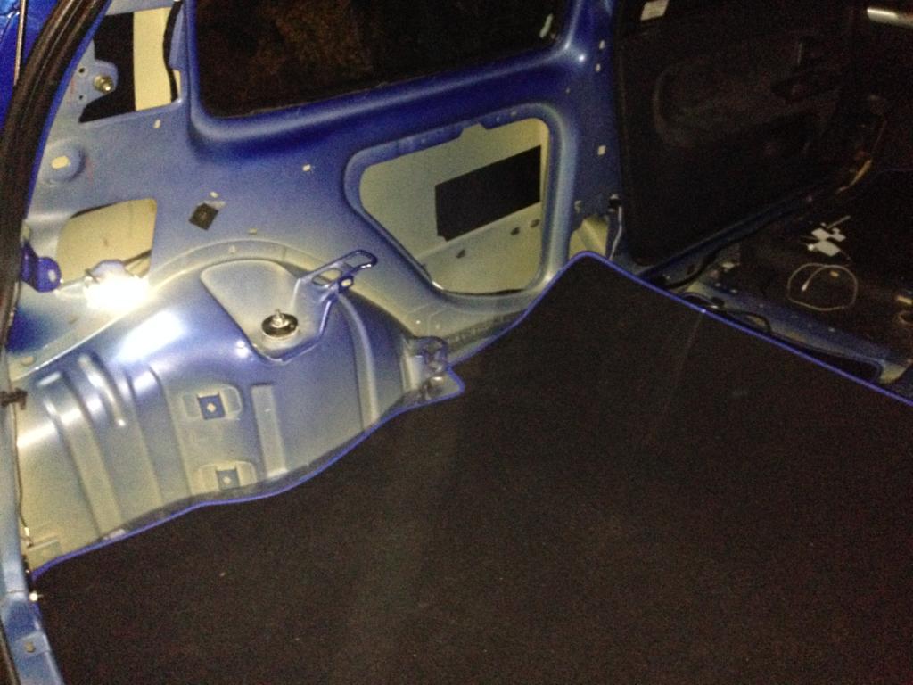

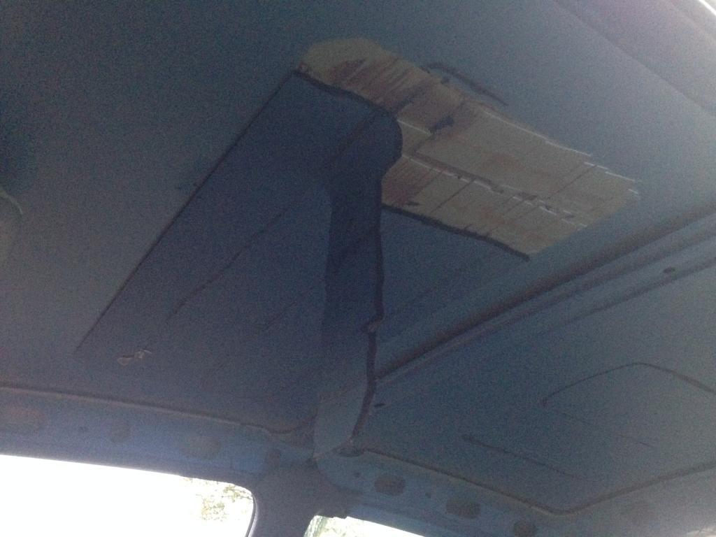

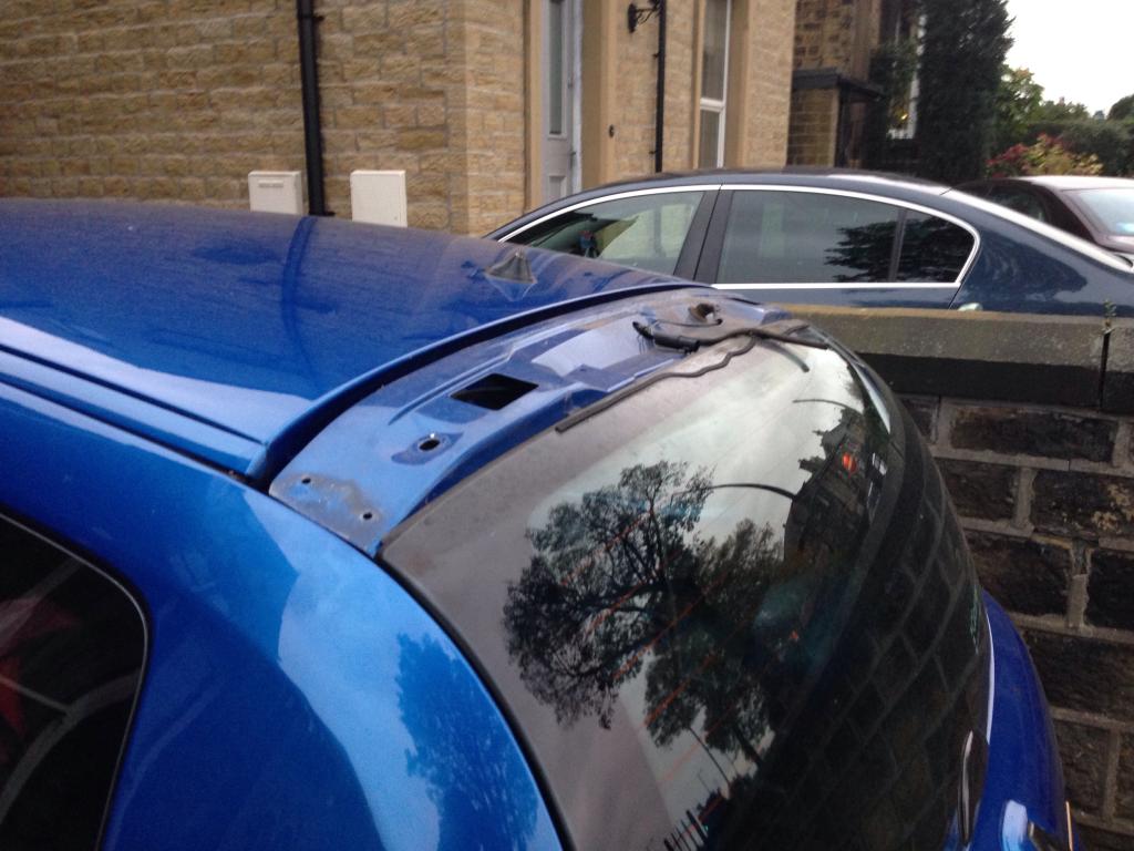

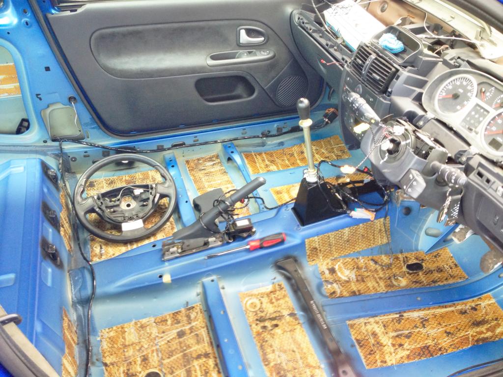

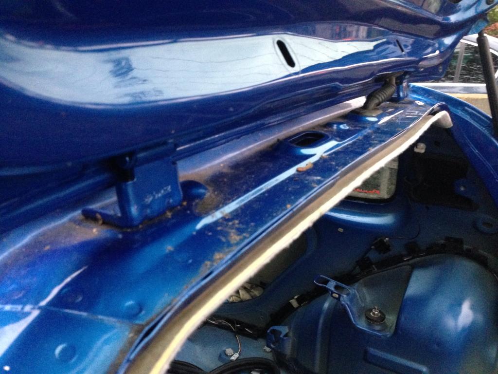

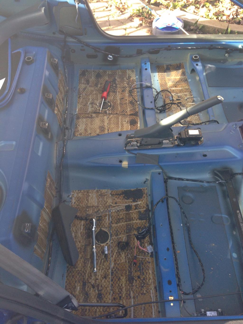

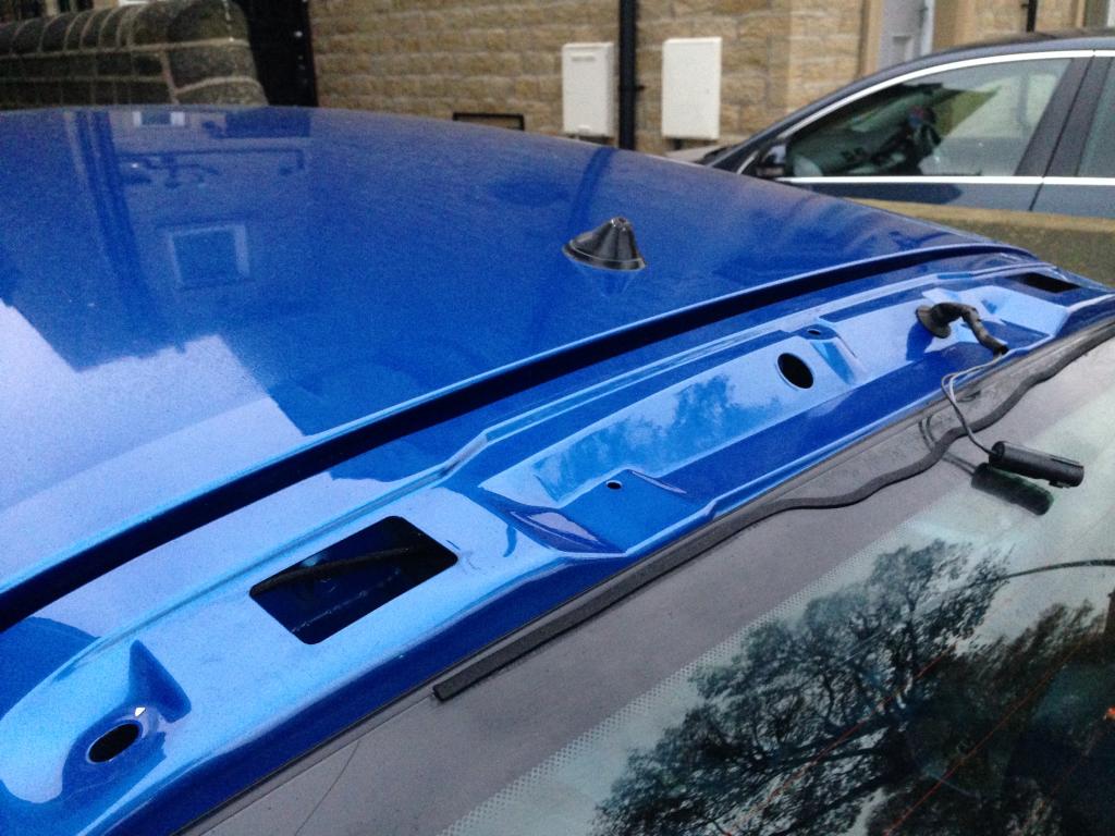

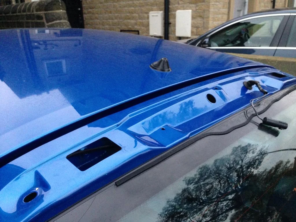

Set about talking my wing off, to remove the washer pipe line, re locate the re wiring loom into the rear quarters and remove my roof lining...and gave everything a right good clean and degrease....
Came out bloody lovely do love this colour...
Started to remove and unplug the loom arial and lights etc
And all the associated crap that holds the roof lining in
Did this around Halloween time so the car had a genuine cobwebby spooky vibe about curtesy of the fluffy roof lining
Despite the hanging fluff the roof lining came out in one piece in great condition...anything you see being pulled off btw all the trime etc is for sale or going to a good home! So shout up if there's anything you need.

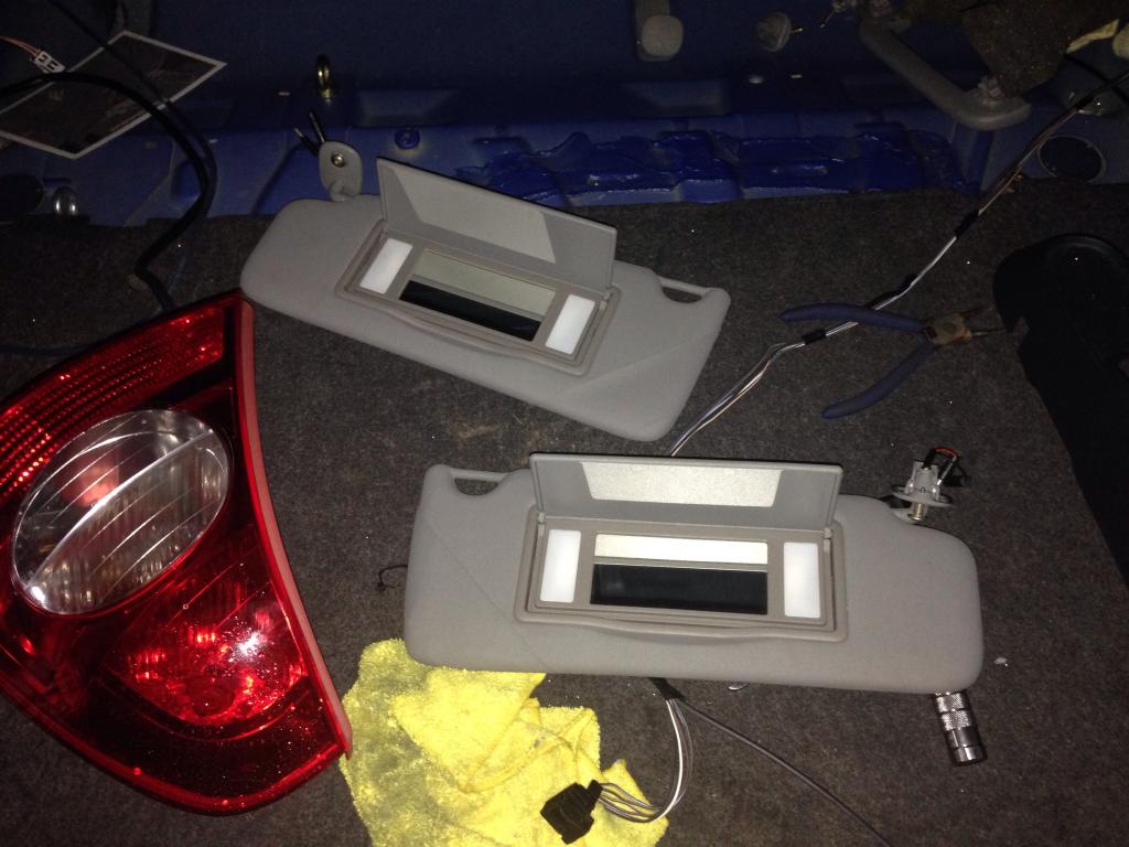

FOR SALE - ILLUMINATED VISORS

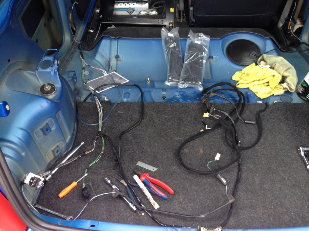

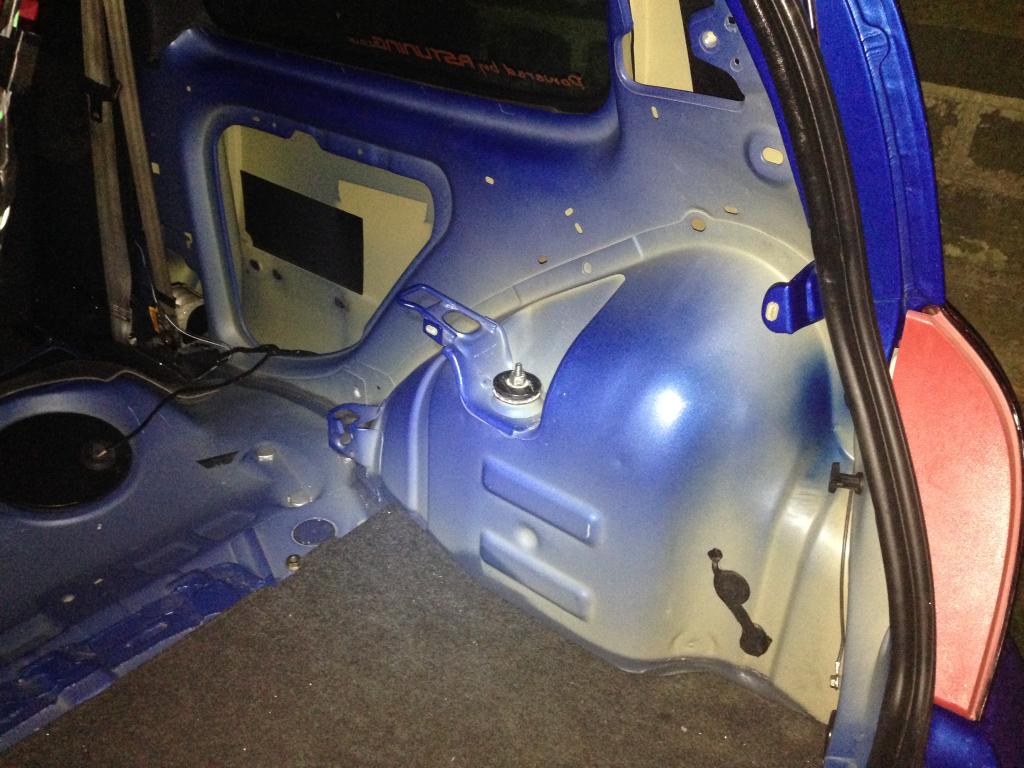

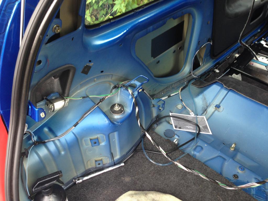

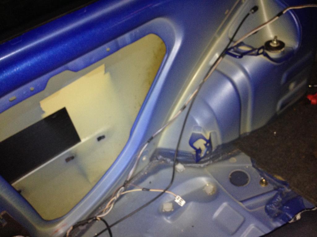

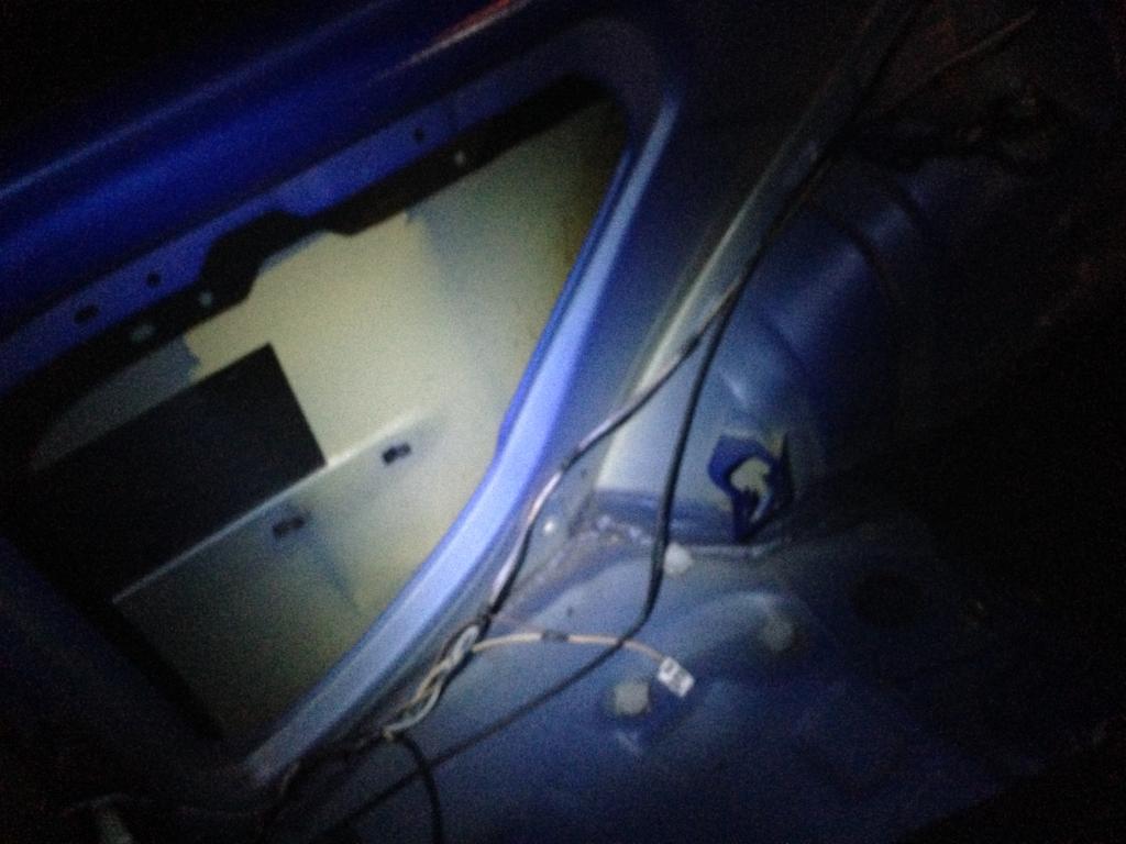

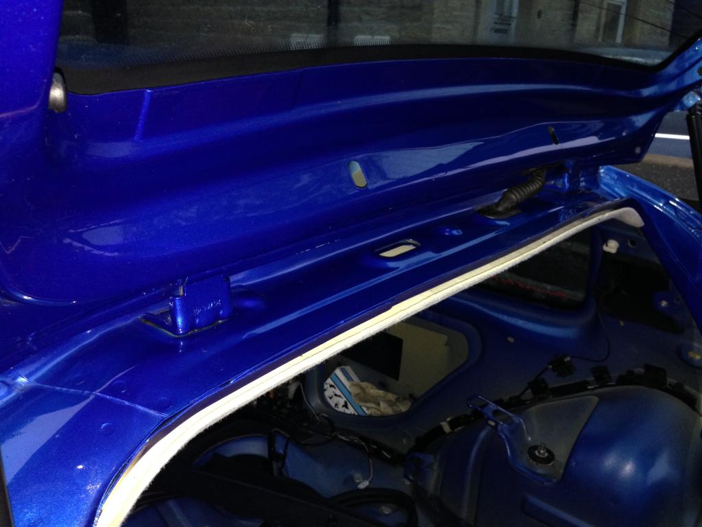

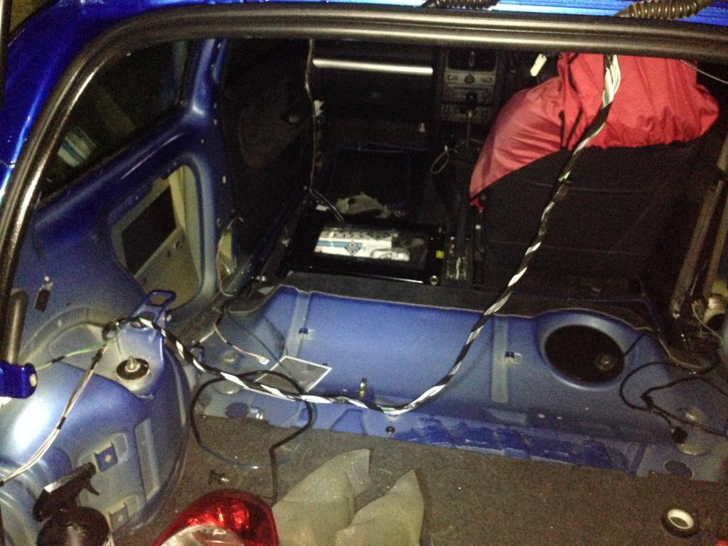

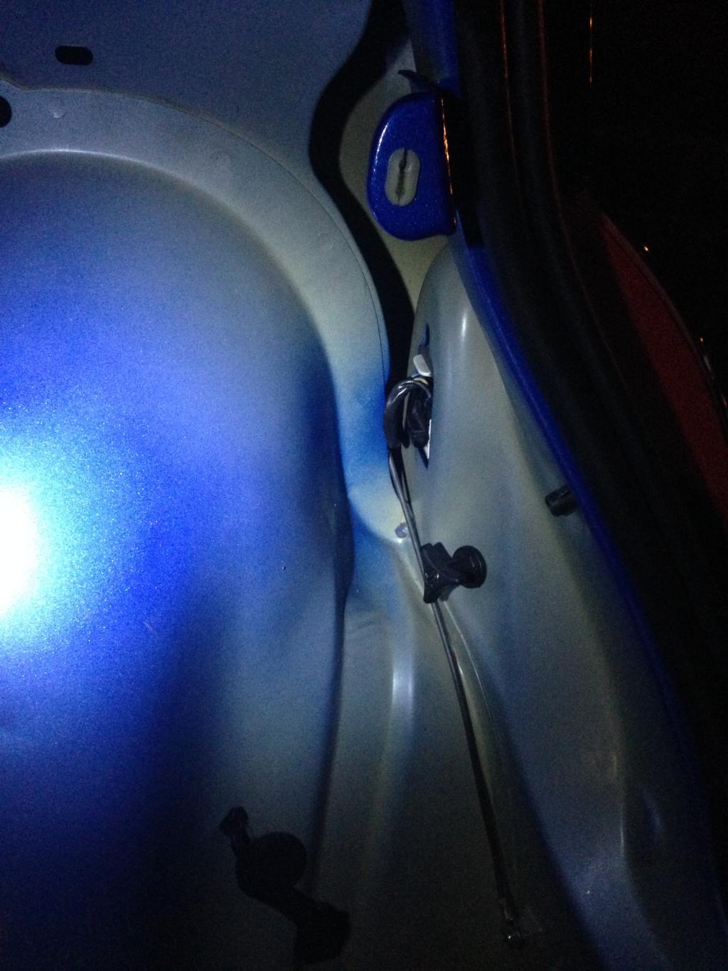

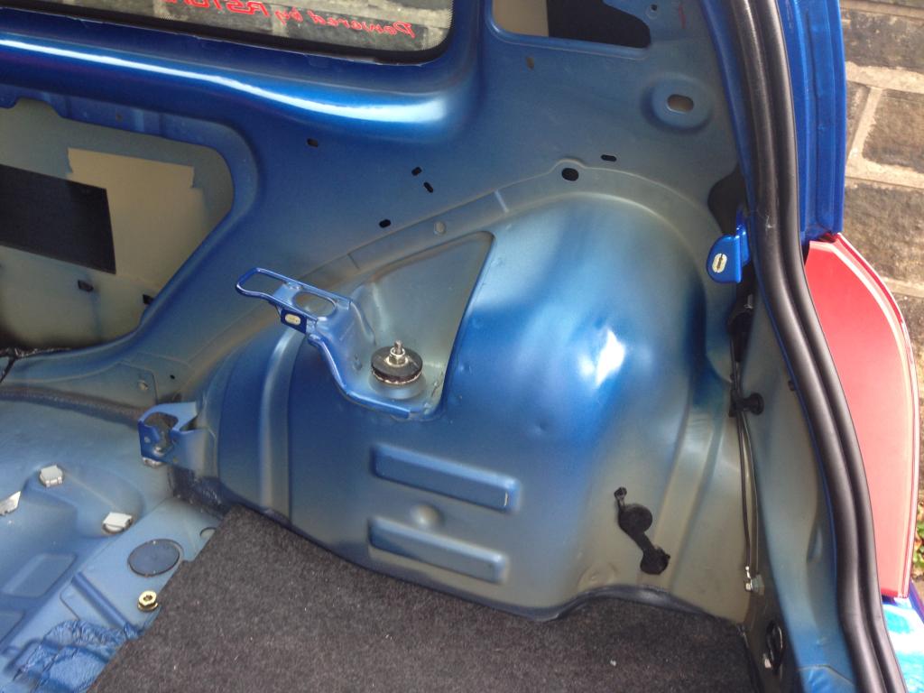

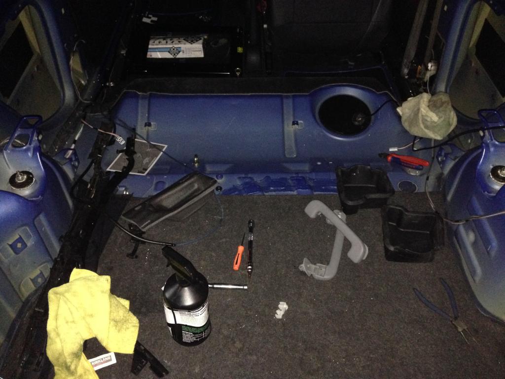

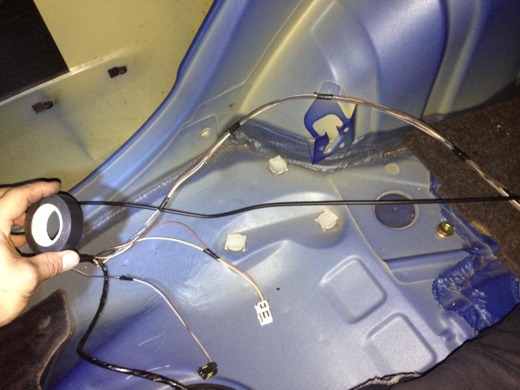

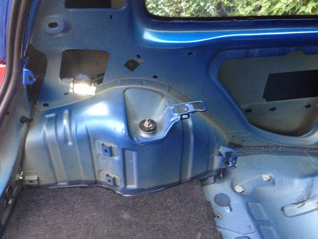

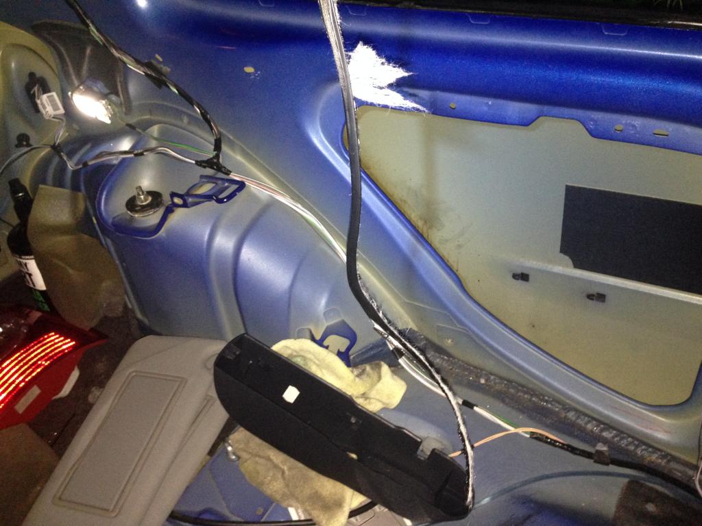

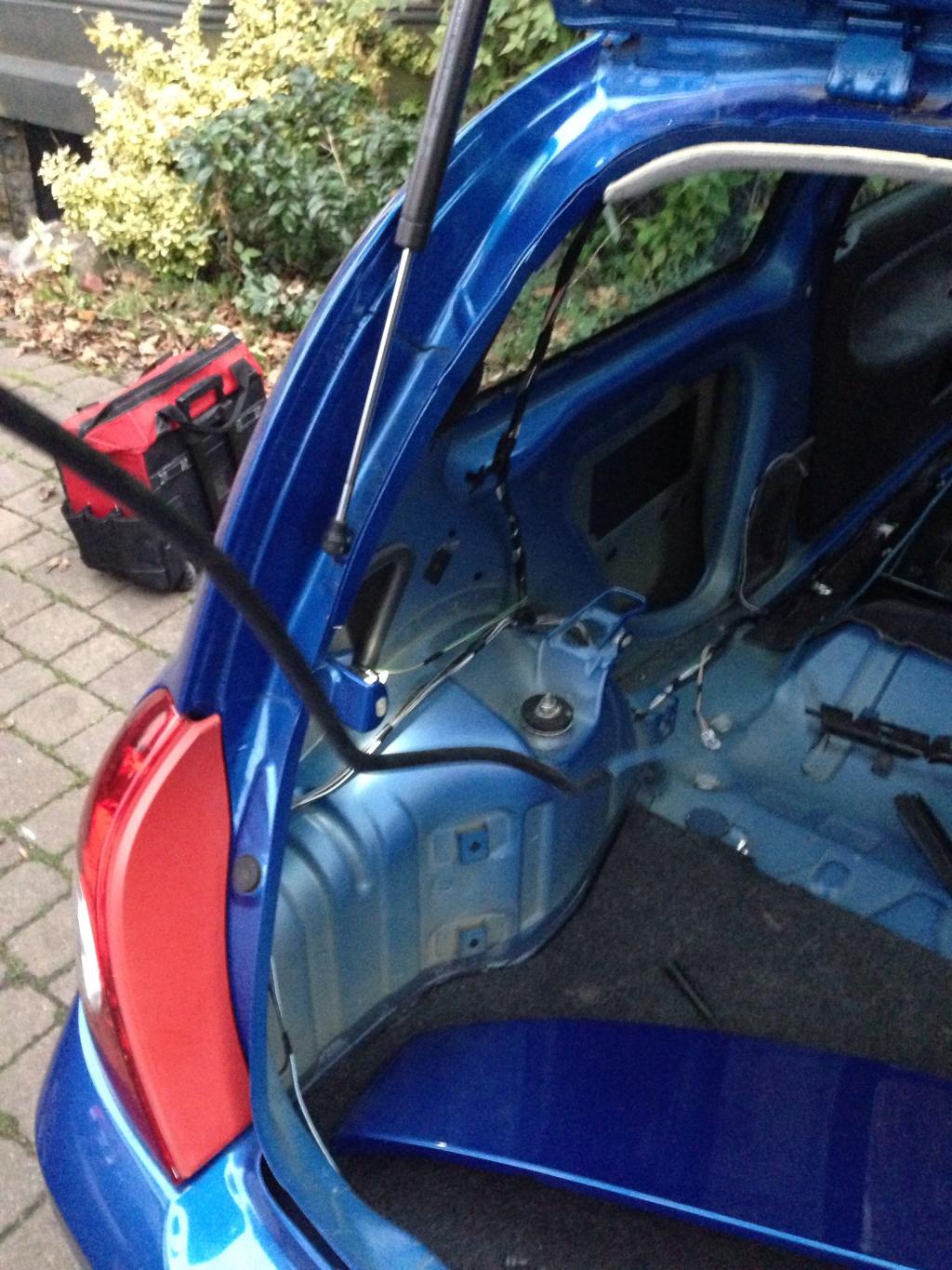

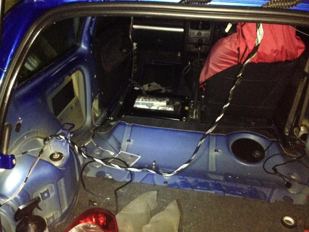

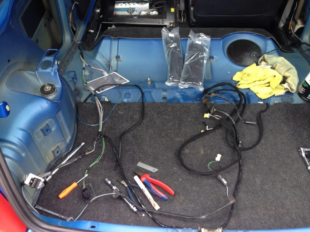

Bloody hate the winter months as its always gets so dark working on the car...I carried on regardless of not being able to see s**t with relocating the loom...
Wrapped up the exposed wires that were going to in the rear quarters probs not necessary but soothed my OCD
Rear light cluster plugged back in
The light failed on me so back at it the next day

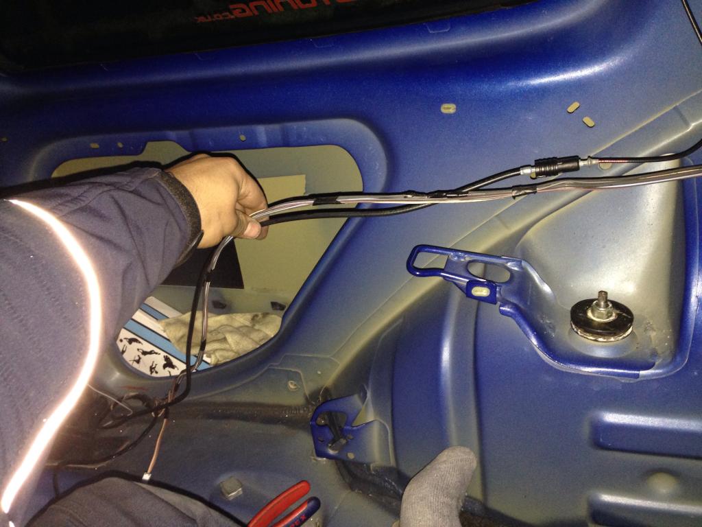

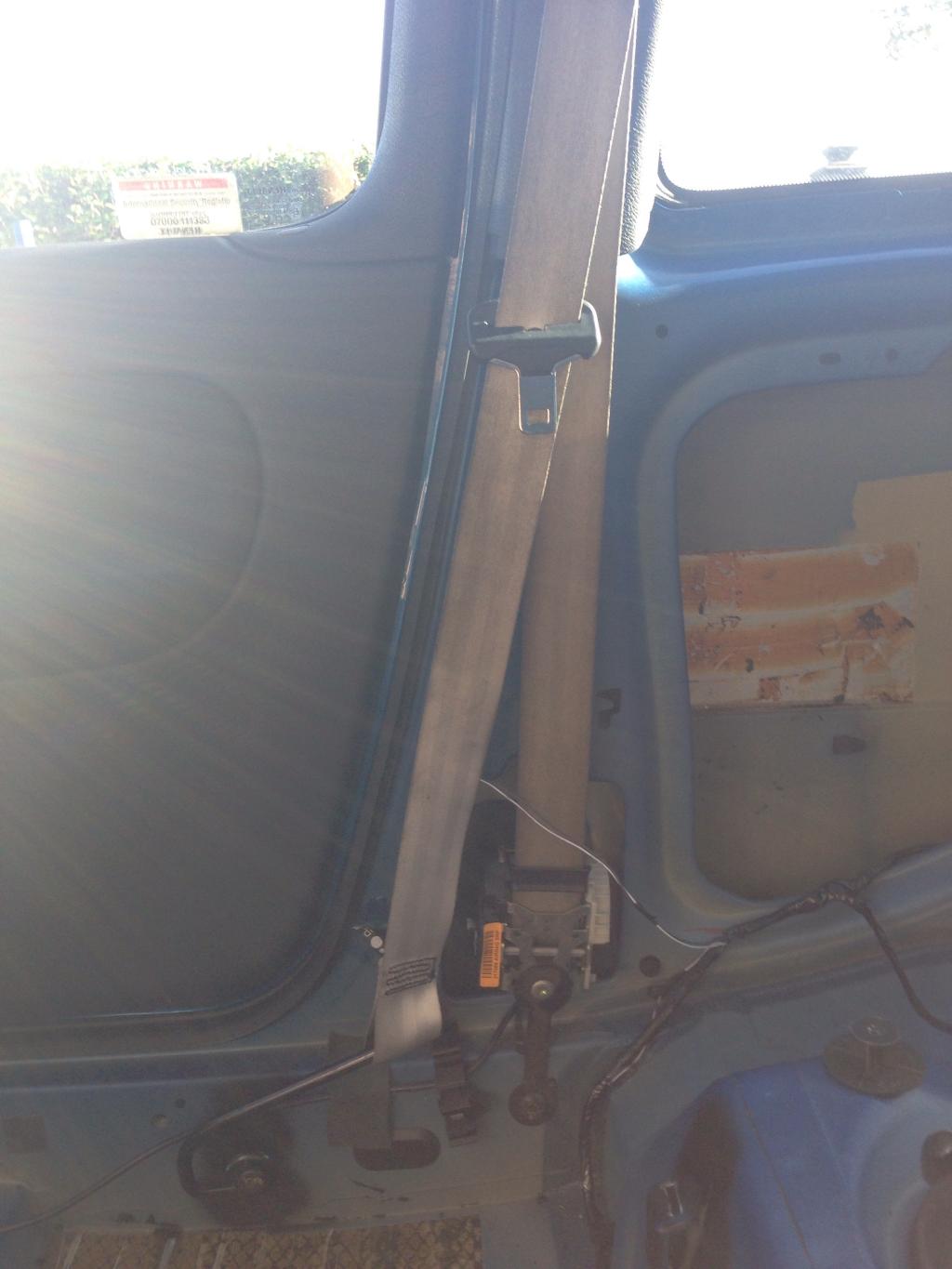

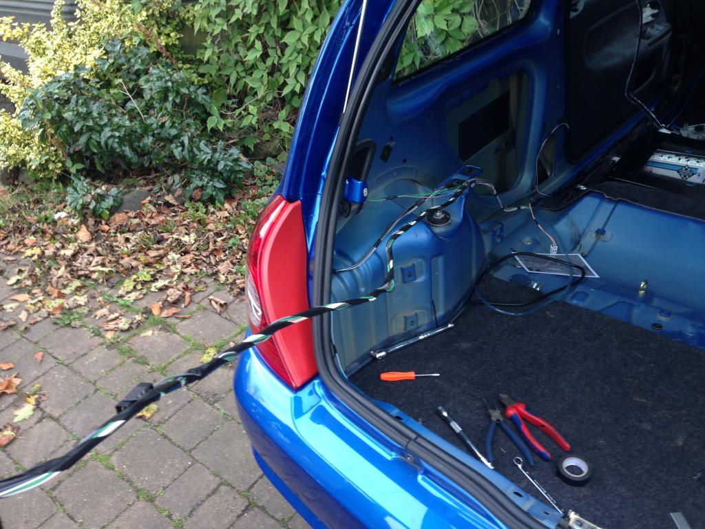

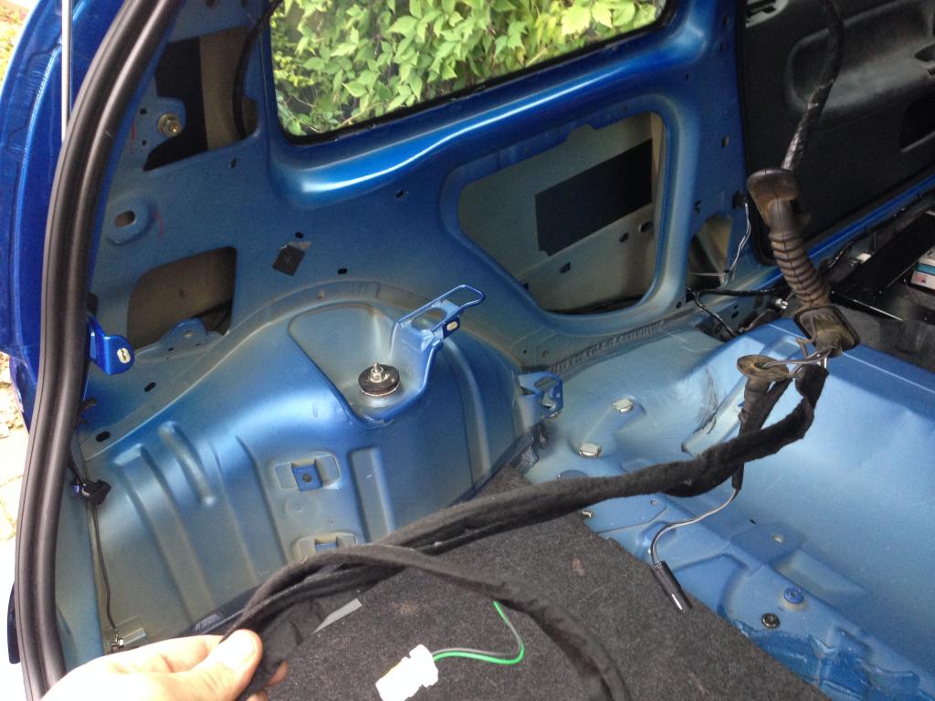

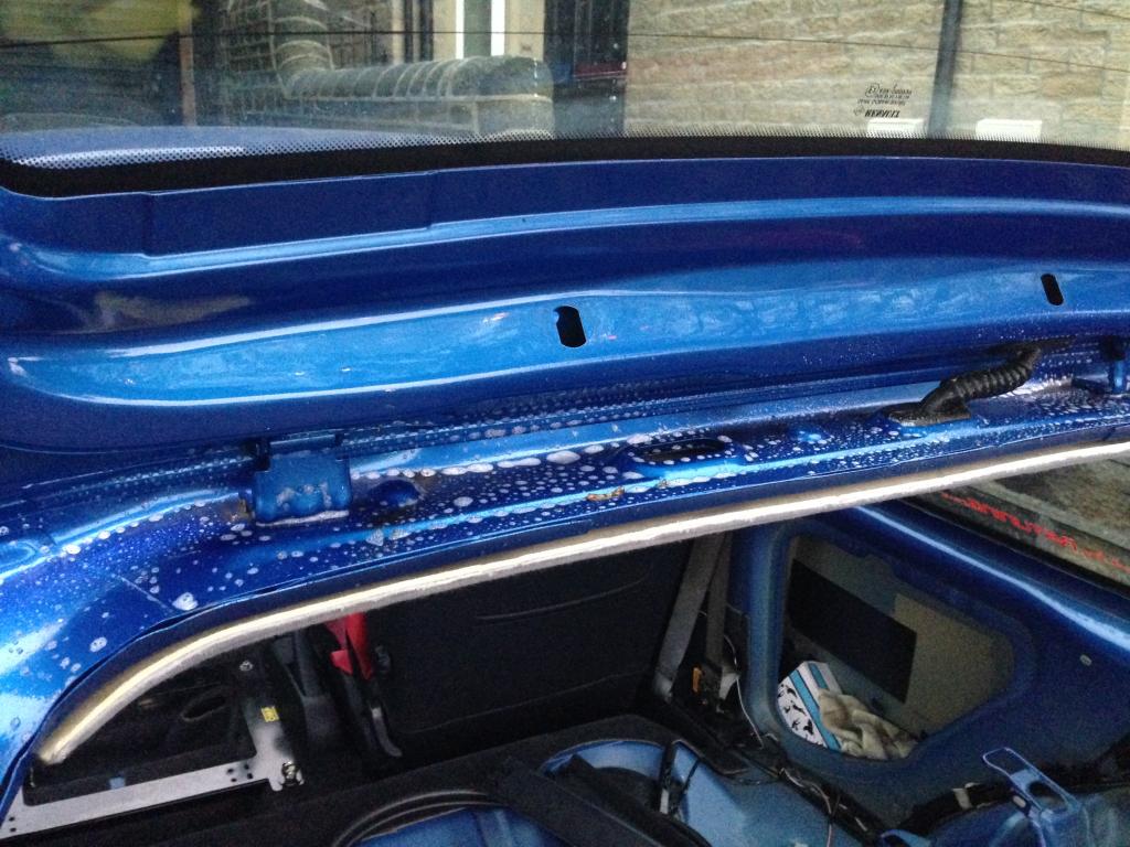

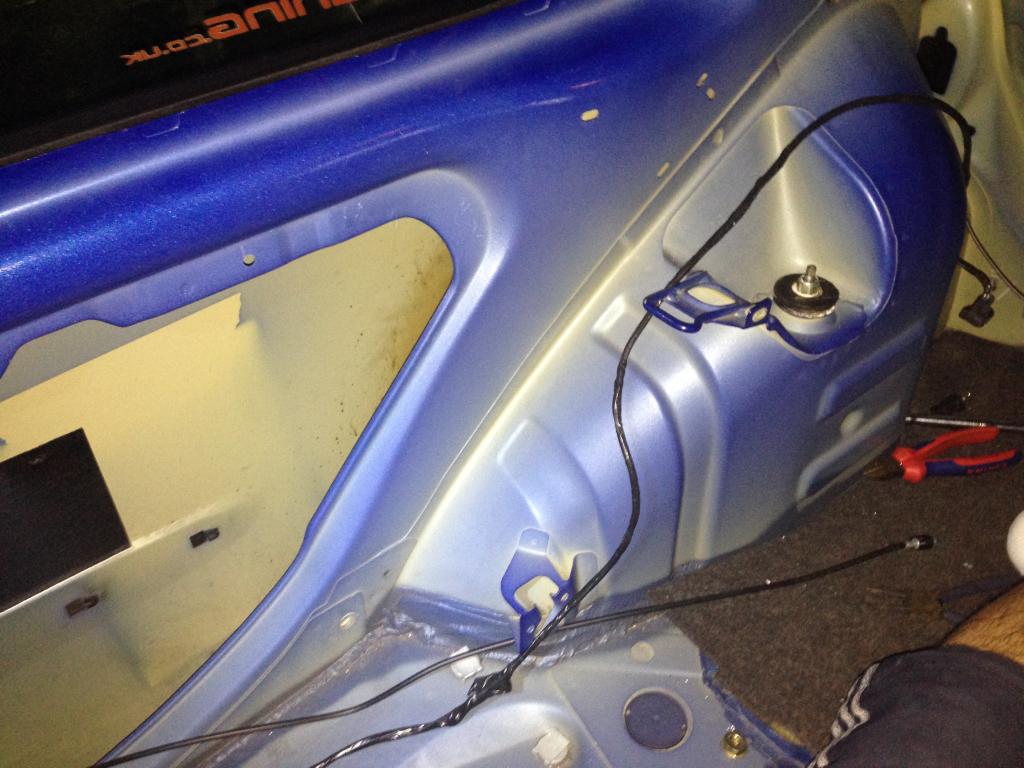

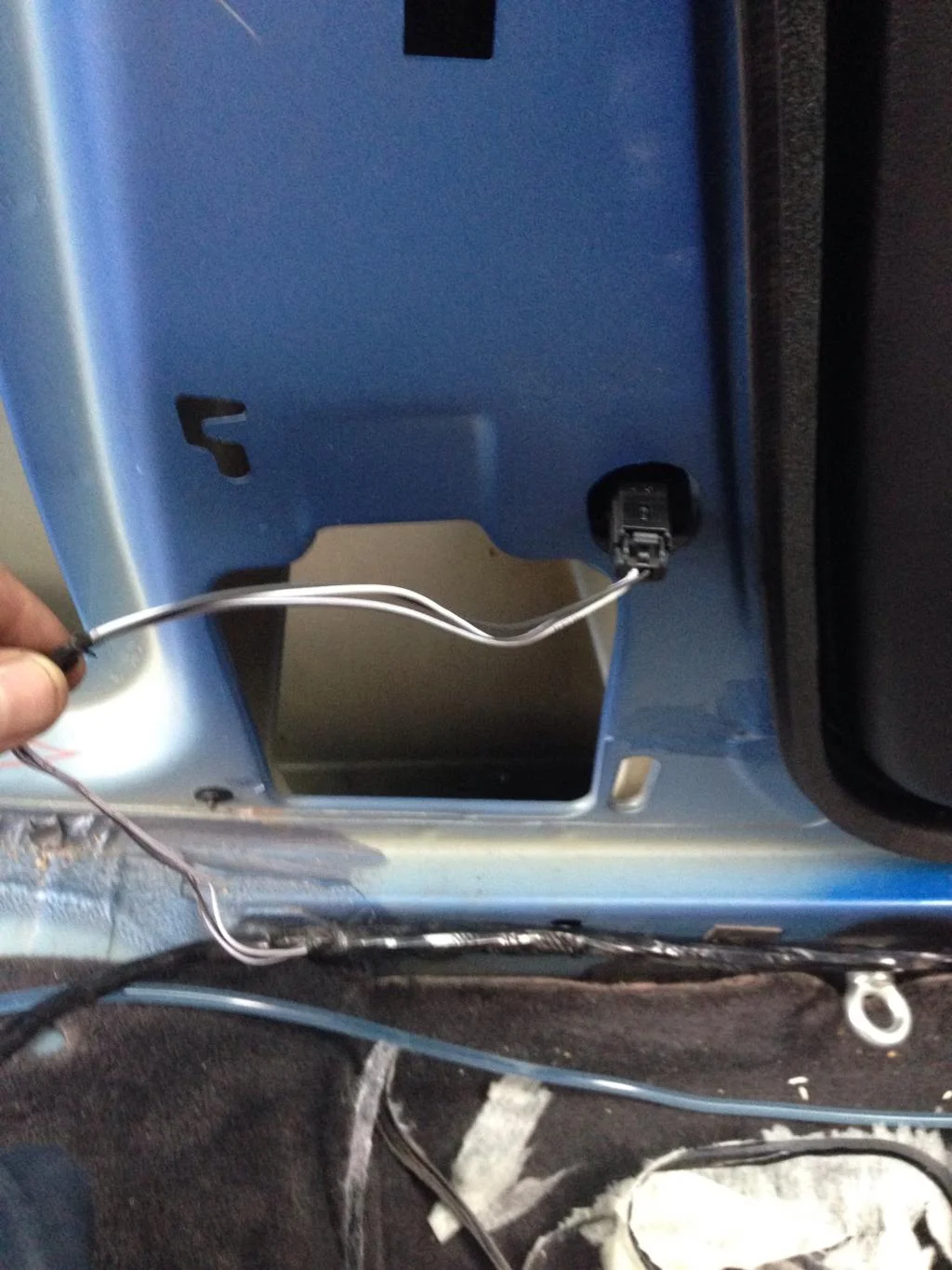

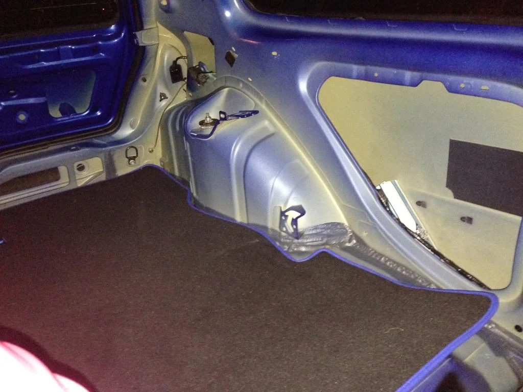

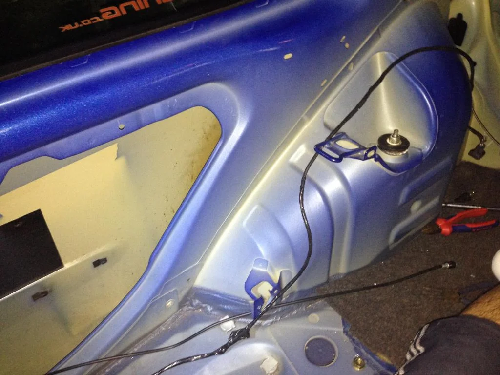

Gonna run the loom through the seat belt mech mount hole

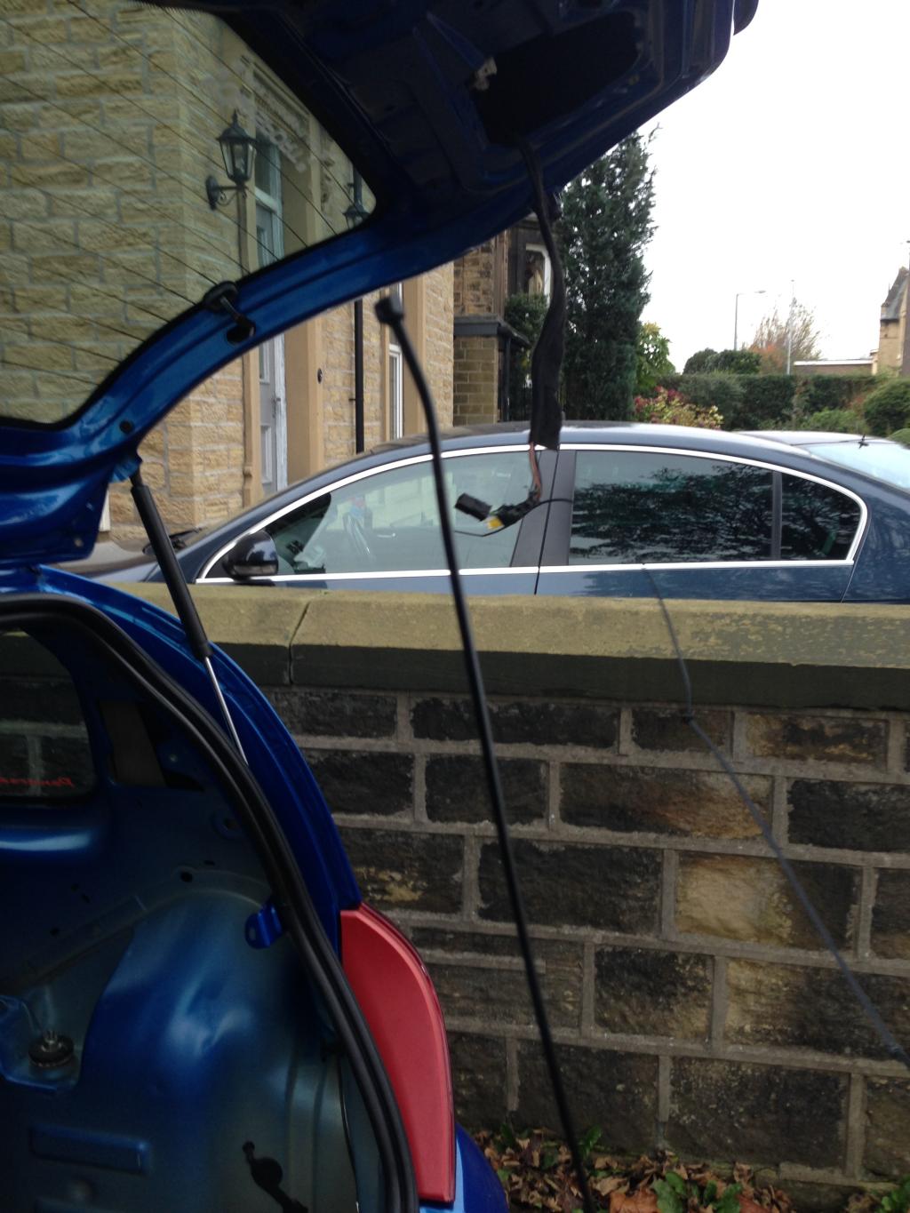

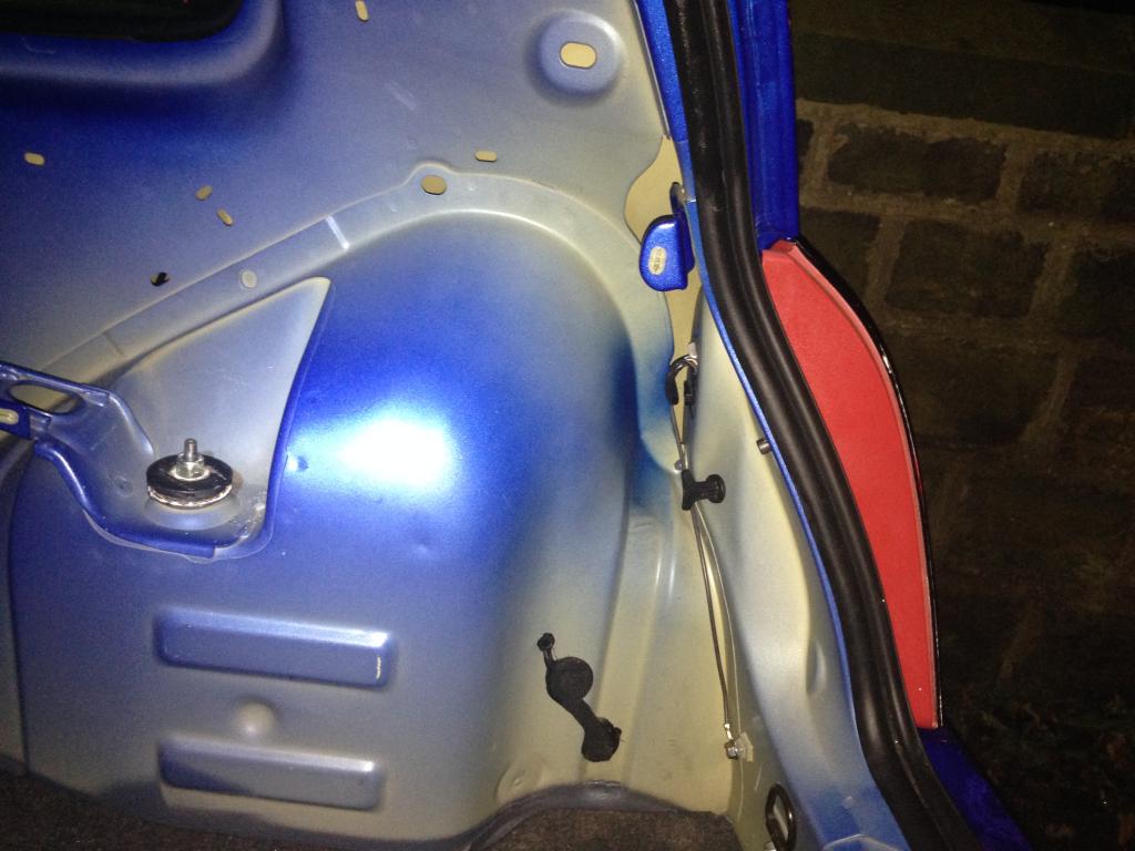

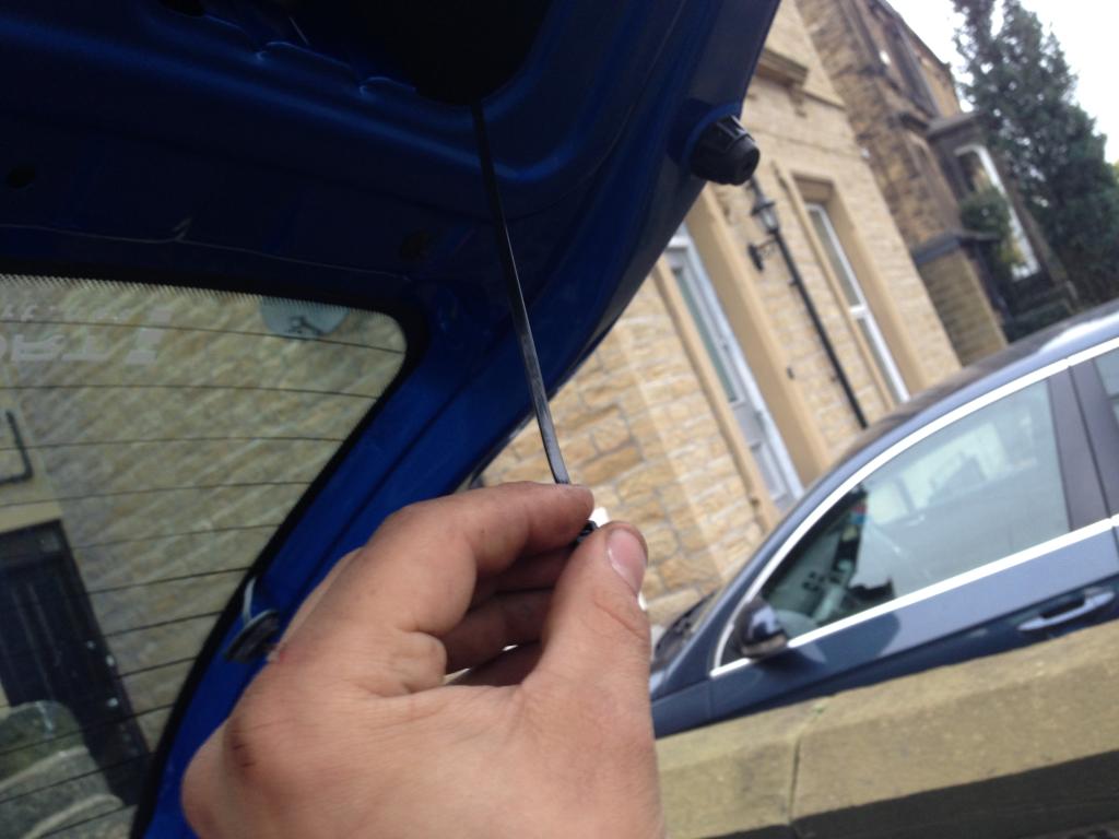

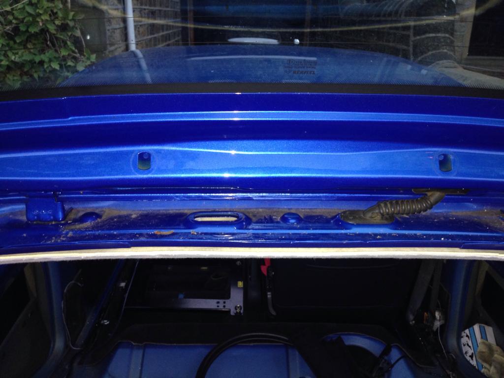

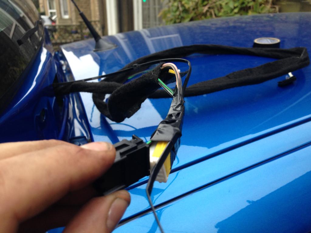

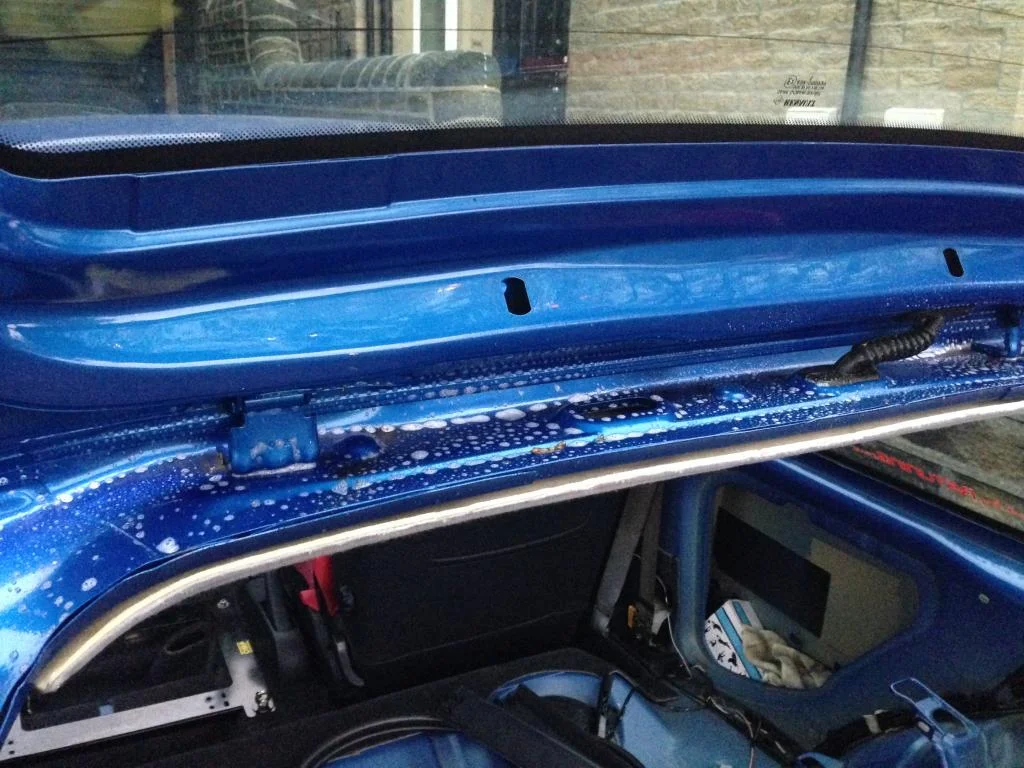

Removing the loom from the bootlid was easy getting back in was a tad trickier...
I tied a load of cable ties together and taped these to the loom then carefully threaded the cable tie through the lid and pulled it through using the cable tie. Which btw wasn't the best things to use as where they joined together the square kept snagging on everything! Recommend some welding wire...
VOILA no wires on show looks so much better in a stripped out interior! Even more so when it all gets painted!

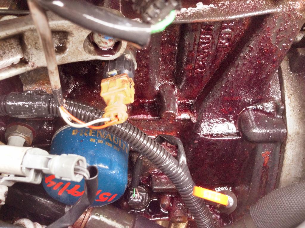

This stuff is incredible! Bought it for the wheels and busy work really as a fall out remover but tried some on my engine block and worked a treat! Didn't get a before pic but take my word is was bad! The usual nasty orange block to this....
You can reall see this stuff working straight away

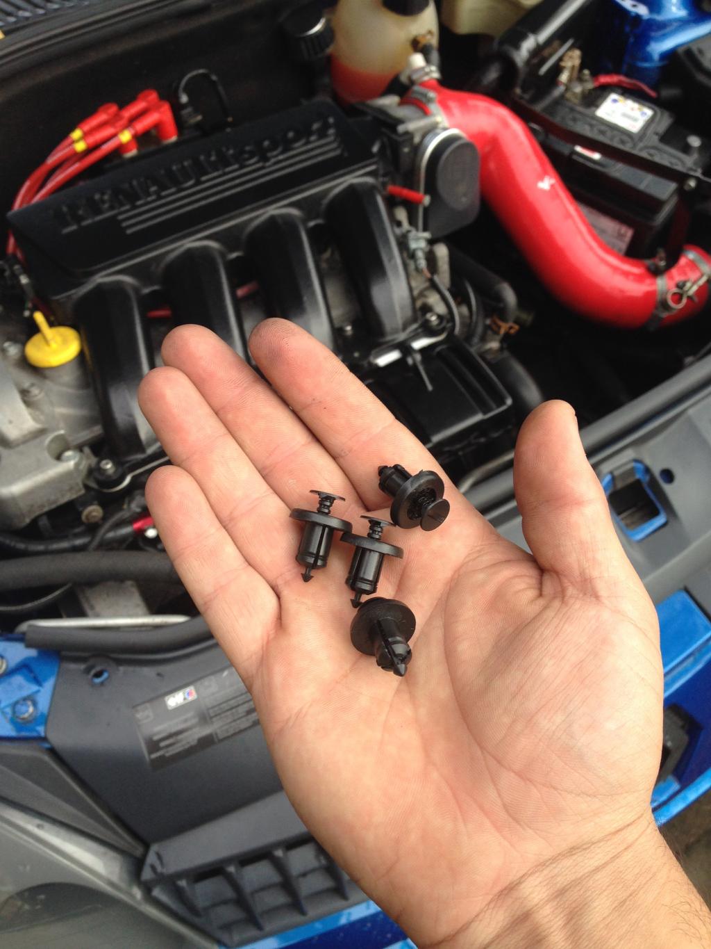

Quick detail and new plastic clips

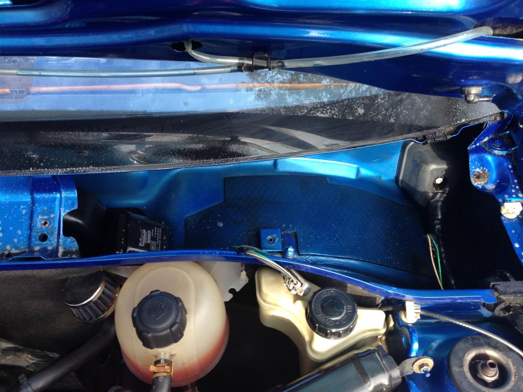

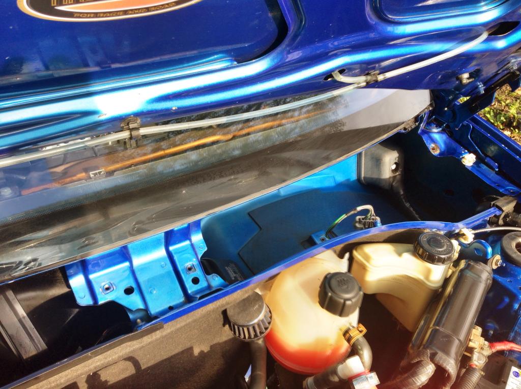

Also replacing the twin pump bottle for the smaller cup one and the shitty halfords special washer lines which you can just see have folded enough to reduce the flow...
Had a right good clean in there whilst the sun was shining

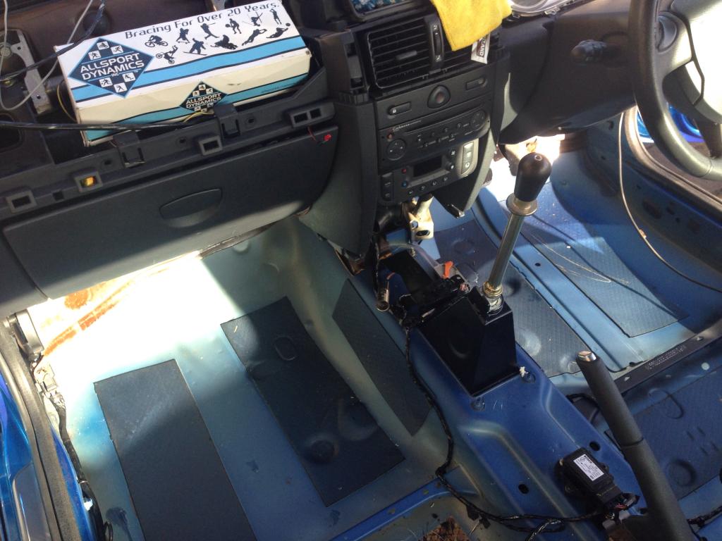

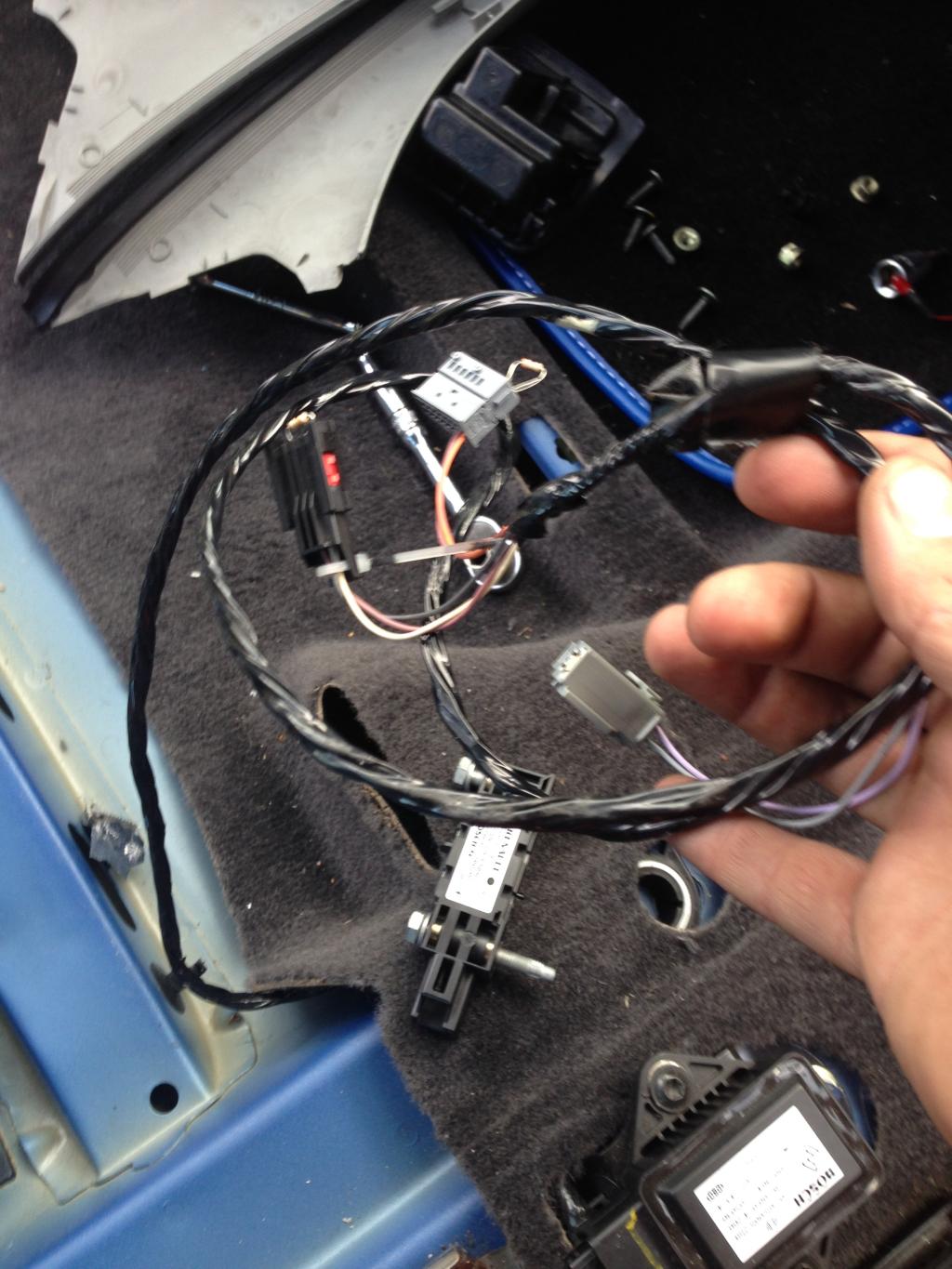

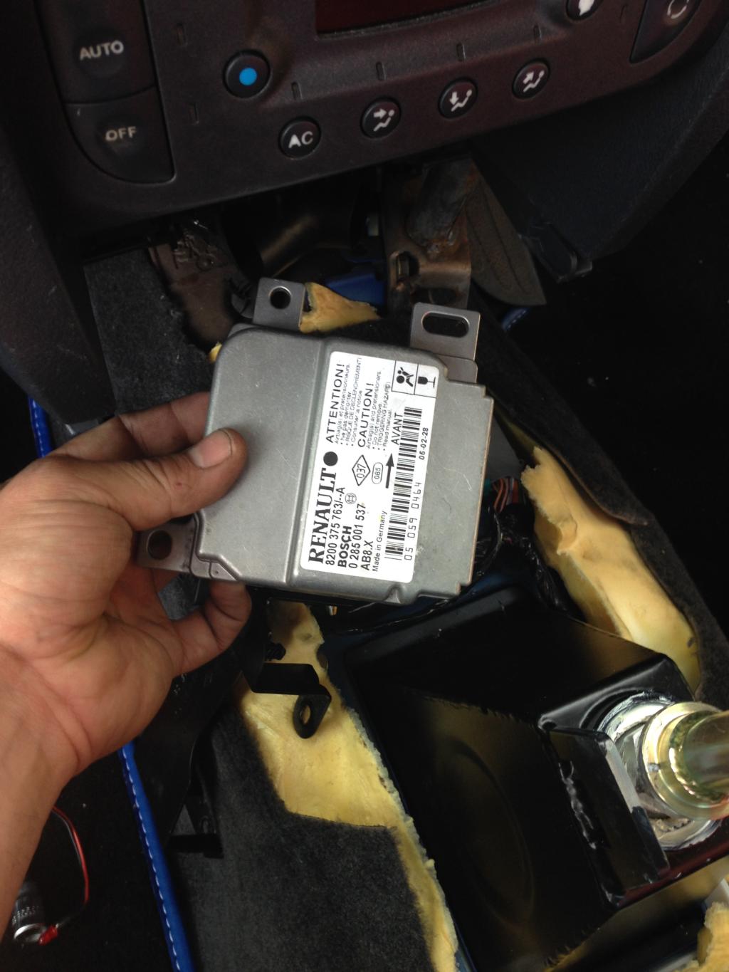

Back inside started removing all the airbag crap and loom. Not bothered about lights coming on the dash as these have been removed tehehe still flew through an MOT even though they don't illuminate.

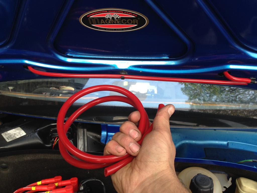

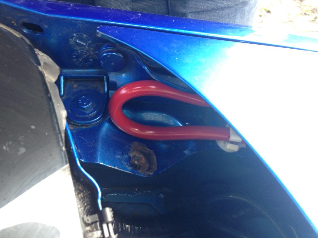

Back outside, haters gonna hate, bought some red silicon piping for the washer lines! So much structurally stronger and doesn't fold in on it's self or go hard like the crap halfords stuff and it was cheaper!
Quite like it. Acquired taste I think.
How easy it curls

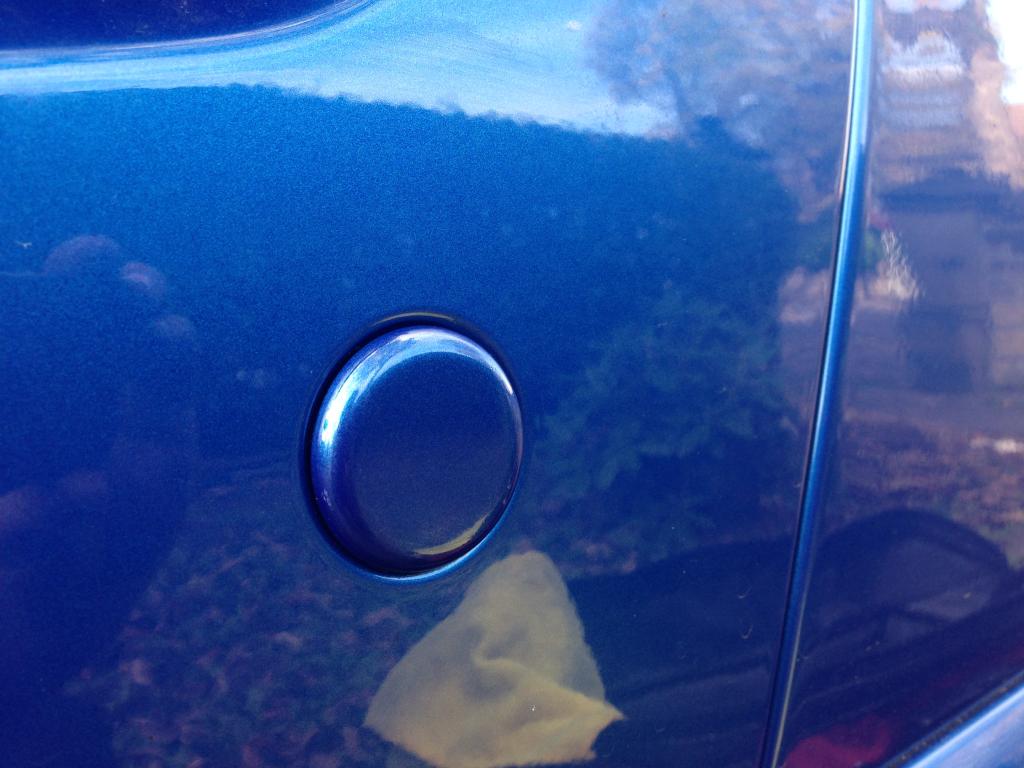

Randomly bought one of these...
Before
After
Nice touch I think,

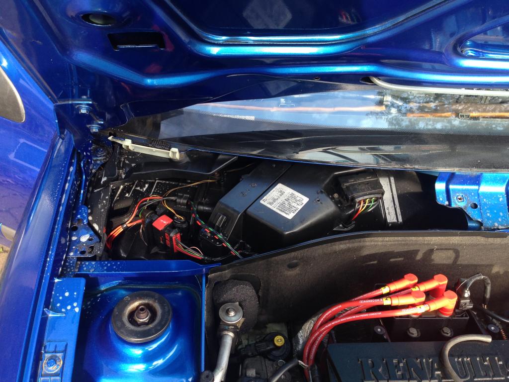

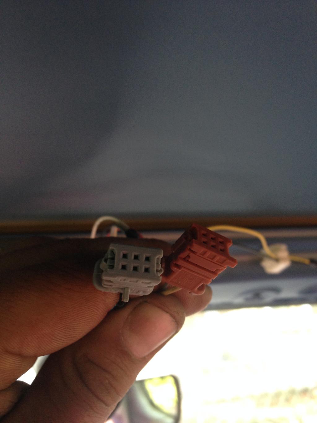

Anybody know why there is two different temp sensor plugs? Tried em both and one makes the air blowers colder? Bit random unless its for different countries and climate?

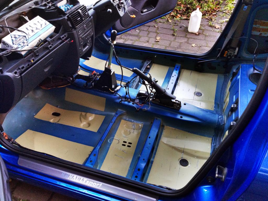

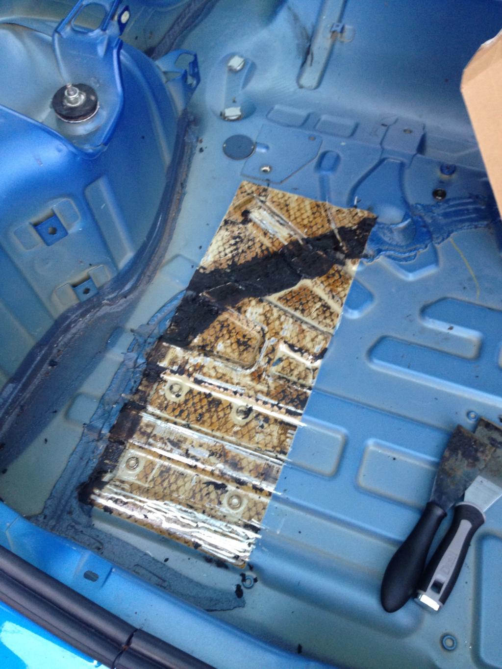

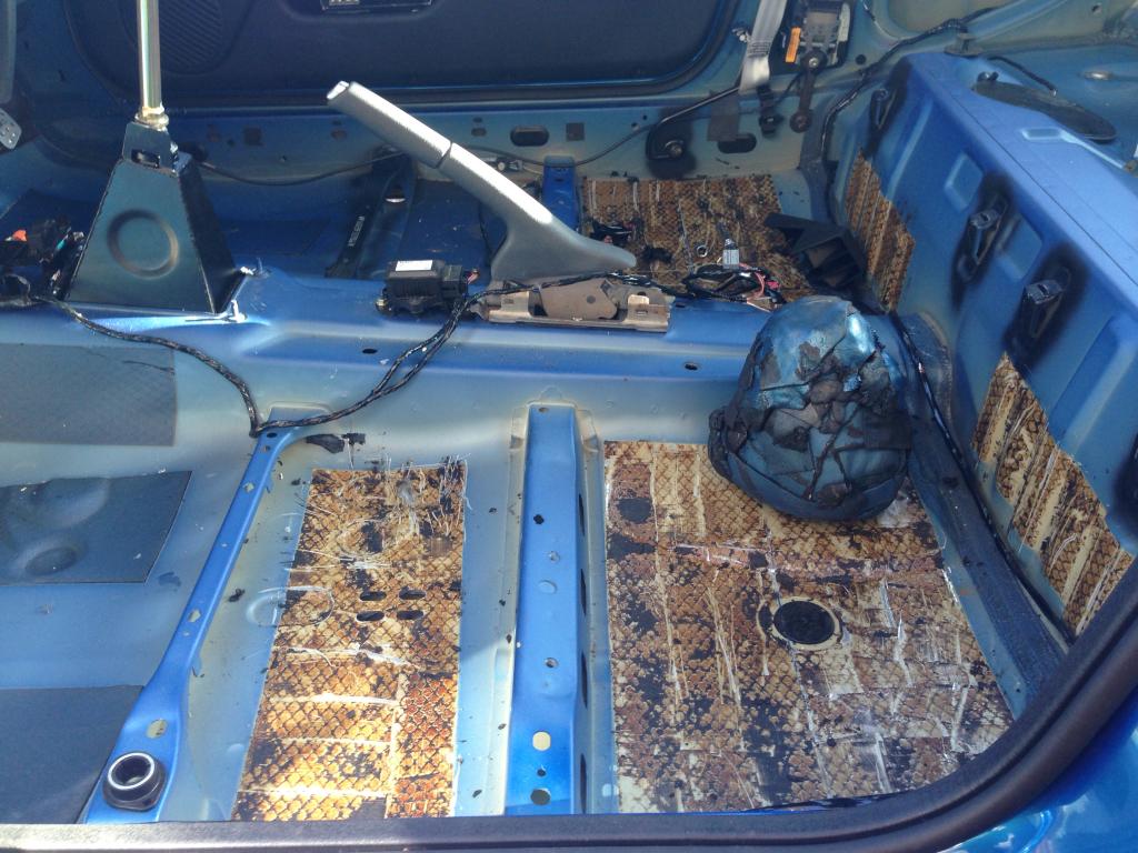

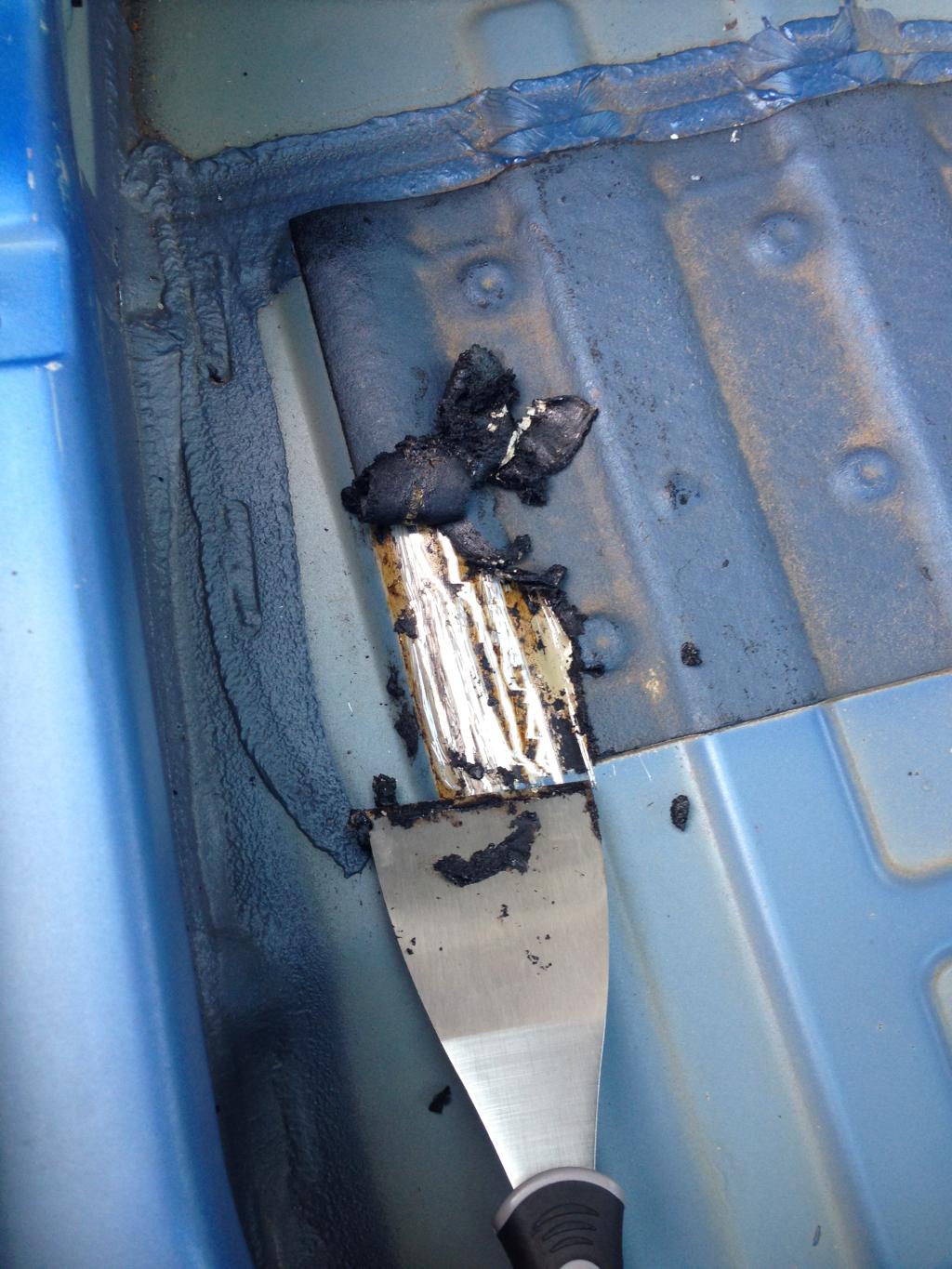

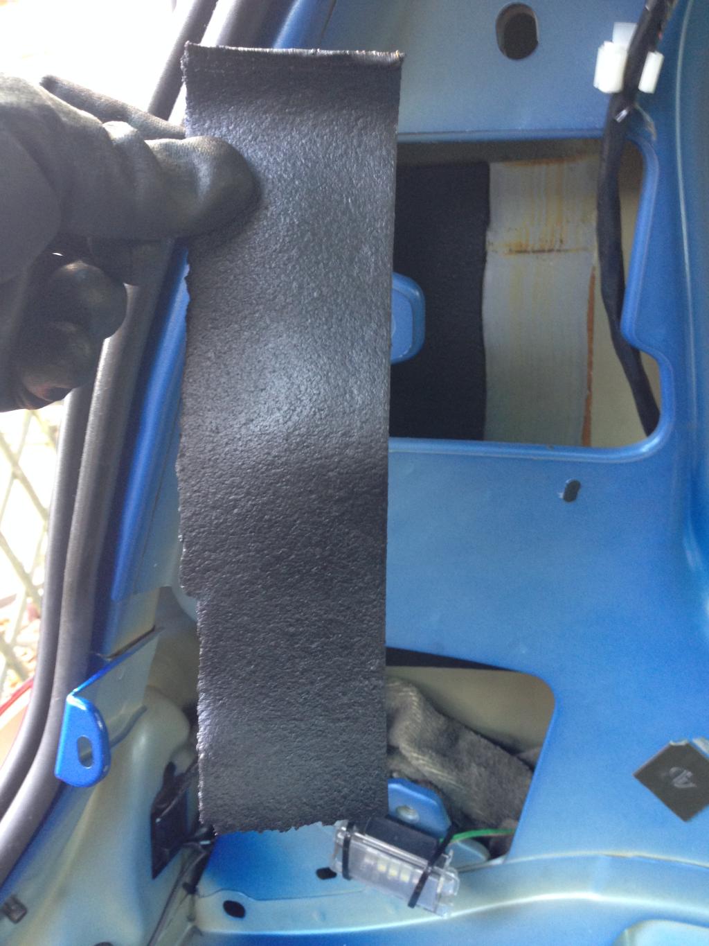

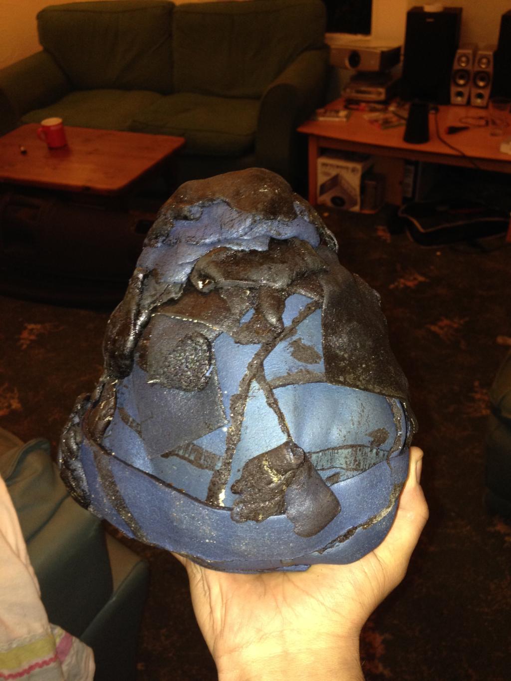

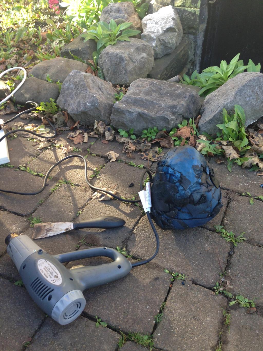

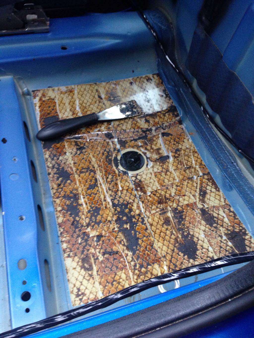

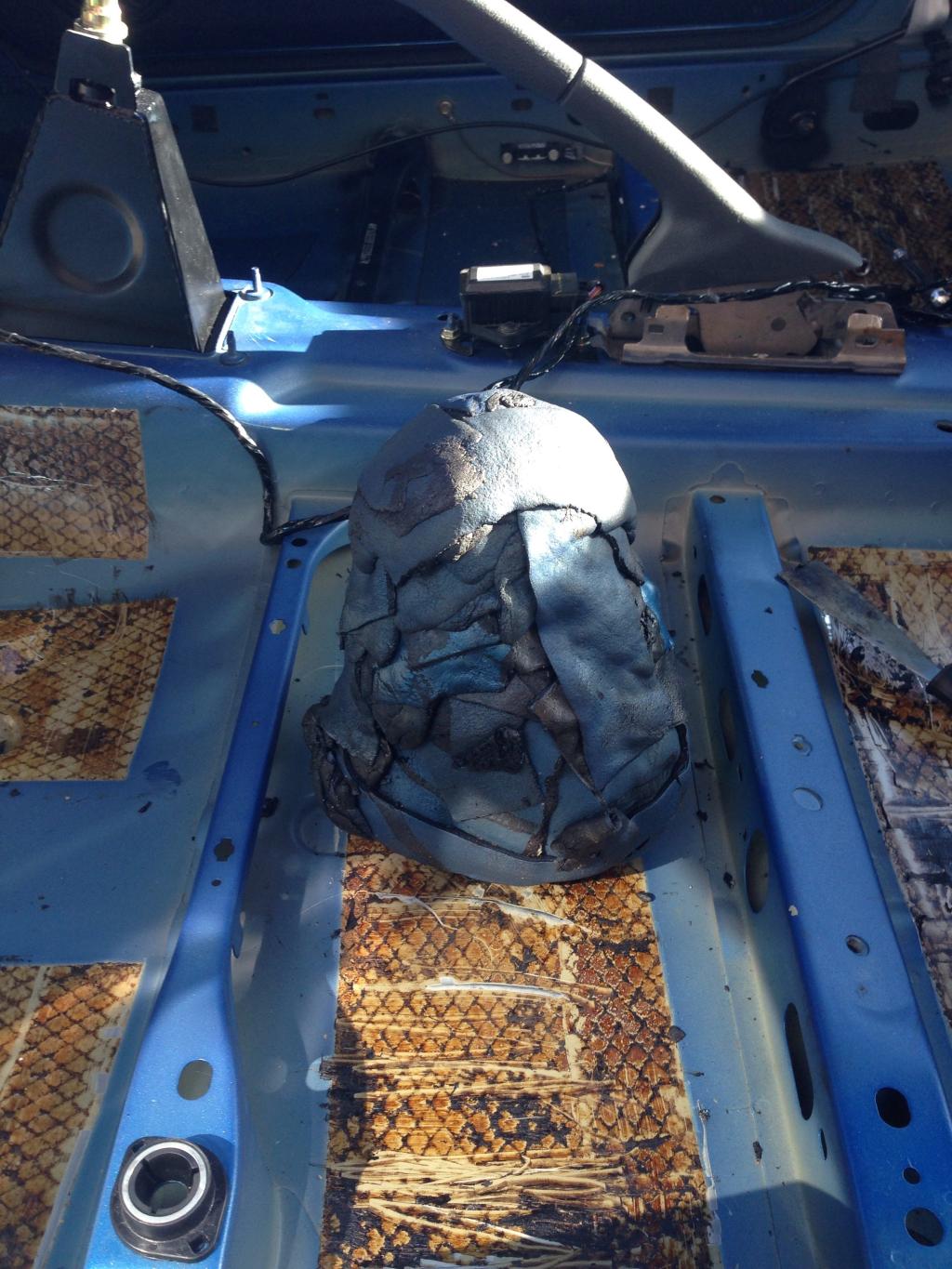

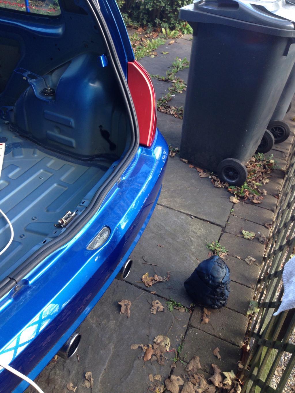

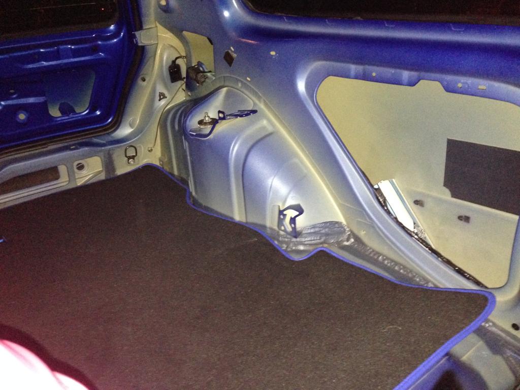

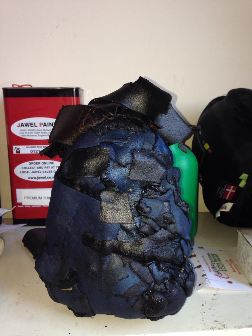

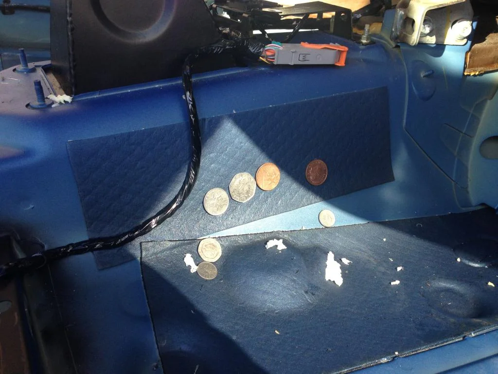

More on the tar removal...
This back one was a nightmare with the shape of the floor, I struggled with the tools I used anyway heat is your friend.

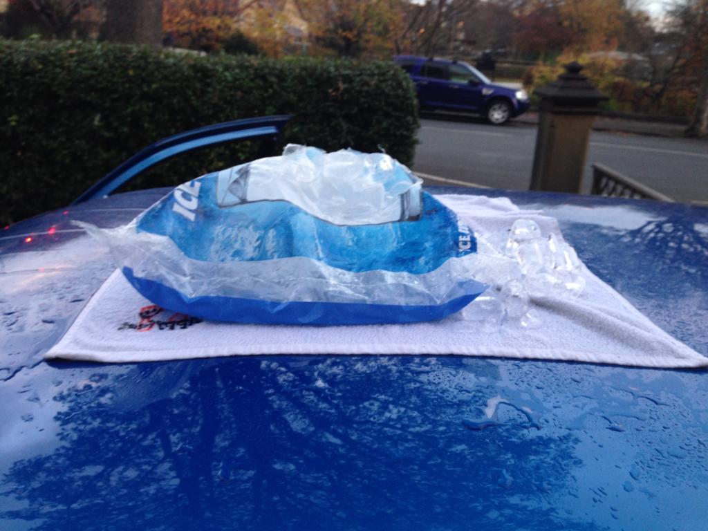

The weight quickly adds up and the roof one alone was 3kg
Bag of ice on the roof and a hose of water to keep the roof paint cool this is a must as you have to get the roof one pretty dam hot to get it off! its beast!
I started getting quite attached to my ball of lead
Free money!!!!! Yaaaaaay!
These pics are coming out in slightly weird orders on my pc copying them from photo bucket but you get the jist so far!!
  CLIO 182
These ones were surprisingly easy! the easiest ones id say they practically fell off, needed some heat of course
Behold my friend Wilson....the Blue Lead Turd
