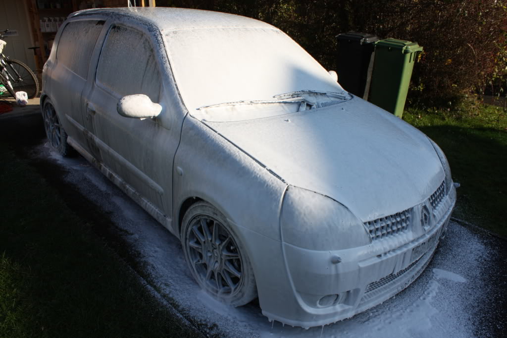

A pic of mine snowfoamed.

I've never got anywhere near using a whole bottle on just one car (and these have been Range Rovers etc), so I only fill it halfway, and still dont use it all! Especially on something small like a clio.
I can cover my clio like the pic above with only a 1/4 bottle filled!!
Dont waste it mate, have a play with the mixture until you're happy with the thickness.
