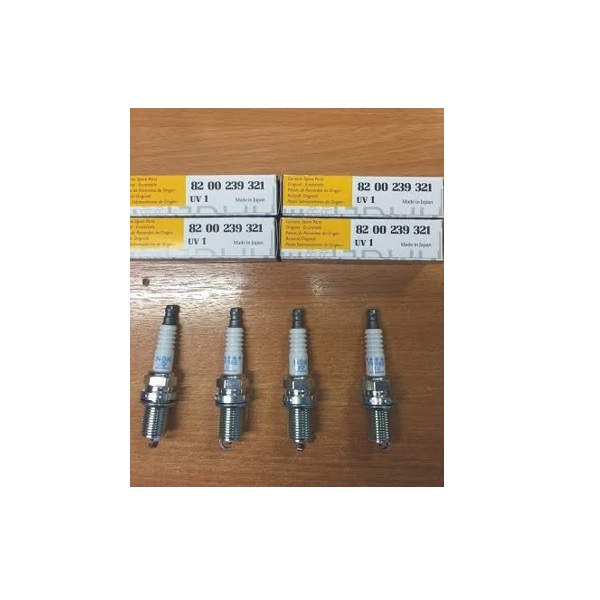

and these plugs from ebay: https://www.ebay.co.uk/itm/Genuine-...e=STRK:MEBIDX:IT&_trksid=p2060353.m2749.l2649
Socket fits over the new ones a treat but when I try and put on the old ones, it doesn't seem to be gripping. Is this the only size spark plug on 182's?

and these plugs from ebay: https://www.ebay.co.uk/itm/Genuine-New-Renault-Spark-Plug-X4-224018760R/222642576925?ssPageName=STRK:MEBIDX:IT&_trksid=p2060353.m2749.l2649

New plugs look wrong ones mate.
Got them out now, was a 16mm socket in the end meaning I got sent the wrong ones :mad:
Just ordered some more and after reading up on the horror stories, have gone for the NGK ones. Bosch supers have been removed and look a bit crusty tbf.
Yeh, deep one of course. Plugs are the recommended NGK PFR6E-10 3688 when they arrive (hopefully before Friday as I've got it in for MOT then and is currently in bits lol)
