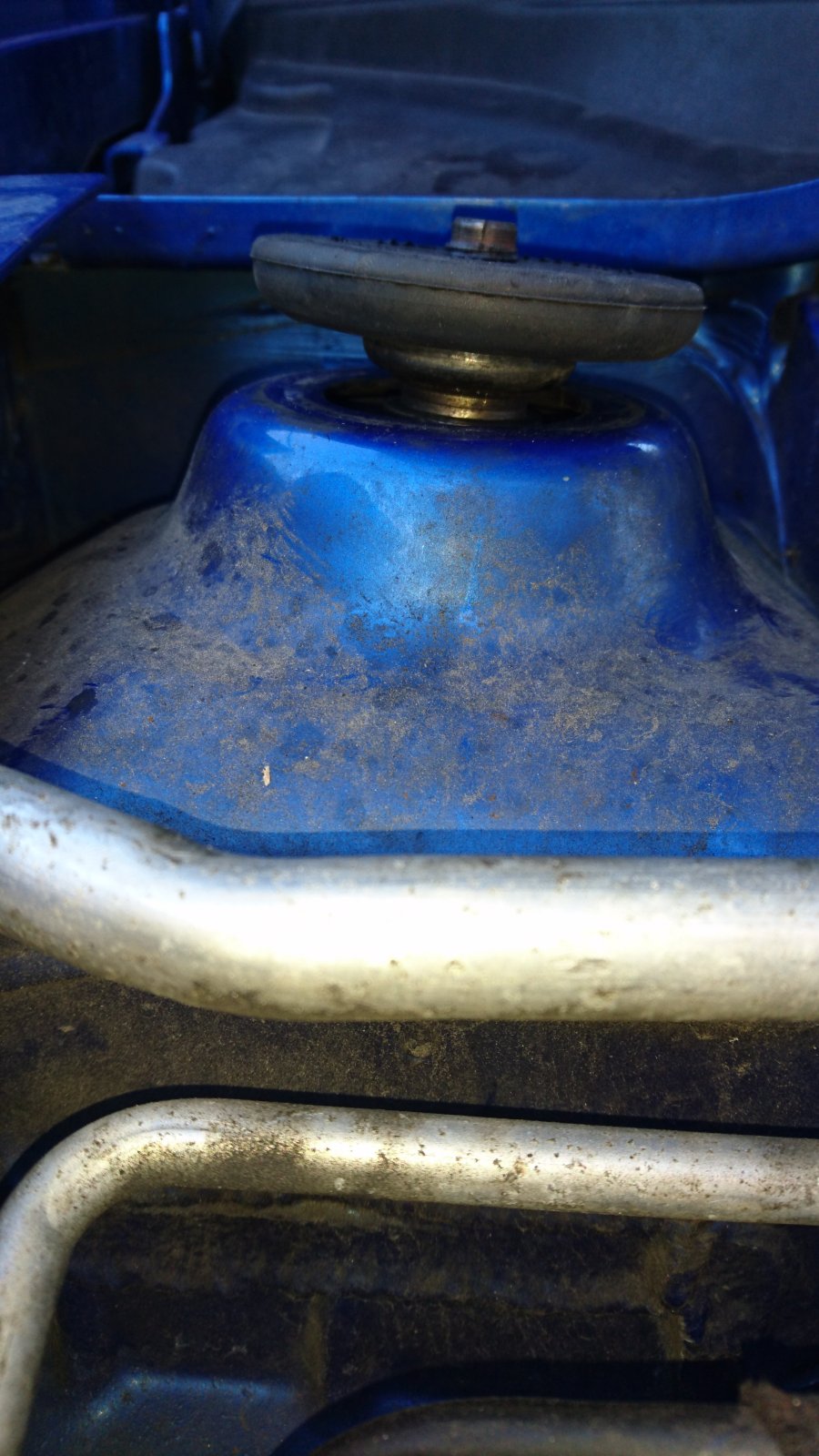

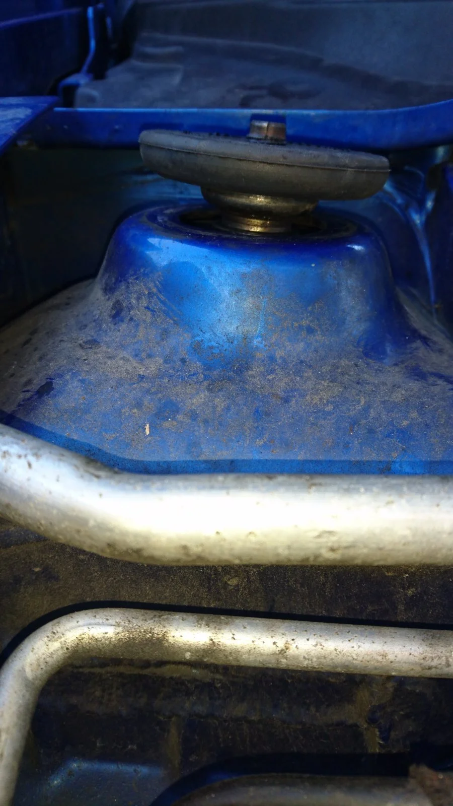

Thats not right sitting far to high
Yeah I thought so. I know the newer kit sat higher than the first type which everyone is used to, and everyone used to pack it out with washers because the old kit sat low so that's why the new kits came about so I can only assume this is the newer version but even to me it seems too high. it doesn't interfere with the bonnet though.
The guy who fitted it is a very experienced mechanic who has owned and ran the same garage from day one and has a big reputation round my way and is also a good friend. he did say about the old bearings were crap and I mentioned about having the top mounts done for peace of mind and he said they came with bearings and fitted them.
So my question now comes to does the normal suspension come with different top mounts to the cup suspension packs? as it's possible the shop has sent the wrong ones?
And to be clear both top hats sit like this and raise/drop a little depending on the steering angle

that gap looks about right for not having a bearing fitted...
what make top mounts?
Surely without a bearing fitted it would sit even lower? I can't see if something in the middle is missing it would make it sit higher? like I said I'm no expert but it just sounds weird if you see where I'm coming from?
I'll get a picture of the brand tomorrow I have the box somewhere
Without the bearing in place the top hat would be closer to the top moun. Need to pull them off and look. At least if you get the tops off, Jack the car up and try and get the mounts to drop you can reach them from the wheel arch and see if they turn freely.
