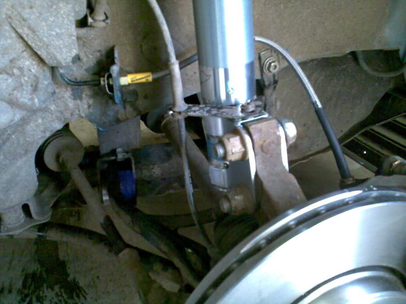

Whats the reasoning behind fitting the powerflex bushes?
  Evo IX GT, 172 Cup
Wheels arn't exactly 2 my taste either but they were cheap and they'll do in the meantime. As I say would like a set of Team Dynamics on her eventually. There's 40k miles on the car so would have needed to change the bushes for a bit of track work anyway so went 4 the powerflex items to stiffen her up a bit, hopefully make her a bit more positive.

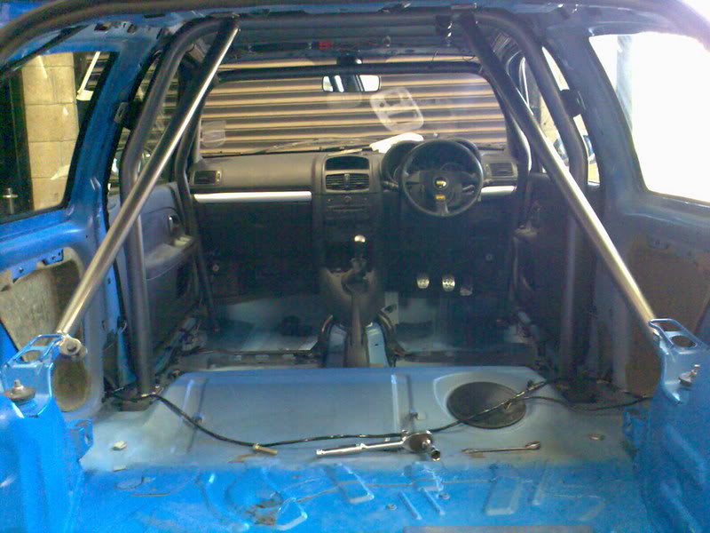

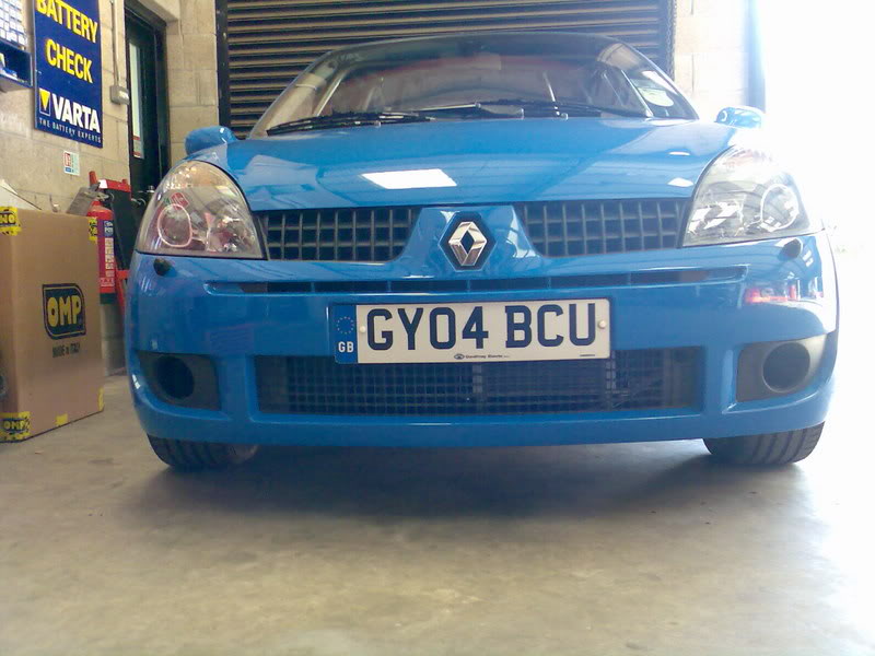

Finally the car's home, cam belt done and ready to start the hard work!! Got a lot of the interior removed today so first job is gettin the cage in, gonna make a start on that tomorrow so if I get a bit of peace to work on it hopefully it should be in this week along with the seats, harnesses etc.
Here's the wagon in all her glory, gonna go for sum decals once all the work is taken care of.
  Evo IX GT, 172 Cup

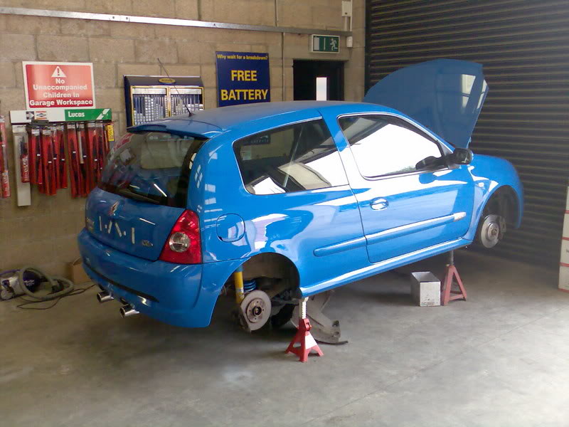

Been a busy week so getting time to work on the motor was difficult but things are starting to take shape.
Cage sitting in the car for a dry fit just to check everything, all looked fine so the mounts will be welded in this comming week. Also got the steering wheel stuck on!!!
Poly bushes, engine mount, bilies, brembo disks, DS2500 pads and goodrich lines all fitted.
Cage mounts, oil cooler, strut brace and decat pipe should be done this week then just waiting for the ecu to come back from GDI.
  Evo IX GT, 172 Cup
Hard work, long hours and no wife!!!;)
She's taking shape nicely now, the big push is on for a trackday in a couple of weeks!!

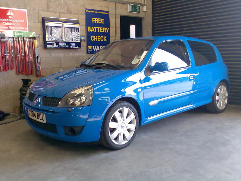

Comming very close now. Just have the cage to finish then bolt in the seats and harnesses. Might drop the ride height another few mm but I don't want it to low. Also need to set the alignment gear on her to see whats what.
First trackday of the year is growing closer!!!:cool: :cool:
  M2 Competition
Should be able to run the ride height a fair bit lower than that dude, its for pure track work yeah?
Remove the engine cover too, doesnt do anything ;)

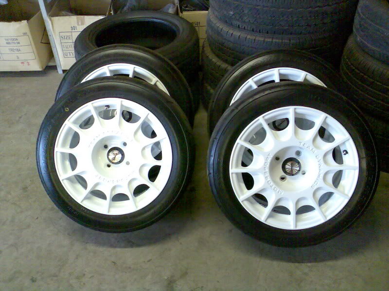

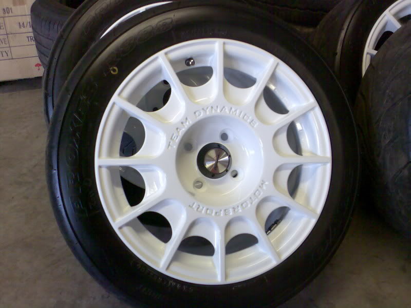

Got myself a a set of these bad boys for the track, now this is what i've been looking for from the start!!
I'll get them stuck on the car this week and take a few good higher res photos now that she pretty much complete.
First trackday in a week, Nice timing!!!:cool:
  Lux'd Glacier White R26
I'm not completely sold on those wheels, but i suppose you have them to serve one purpose only, which is not to look good!
Nice rubber on them as well!!
