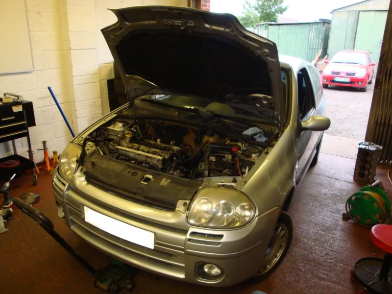

So I bought this little number as a non-runner (well nearly) It started and "just" about ran with a foot full of pedal so still decided to buy it for £350 as I had various projects at the time & parts could be handy! Had been sitting for a year & the story behind this was simple, He & mate did the cambelt on the drive so figured the valves were done!

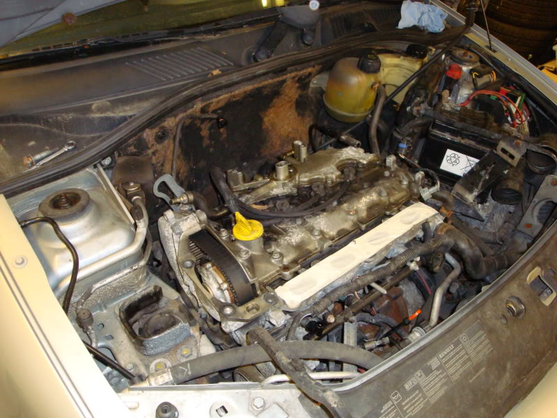

Engine bay was a complete mess! Things just broken every where
And surprise surprise...

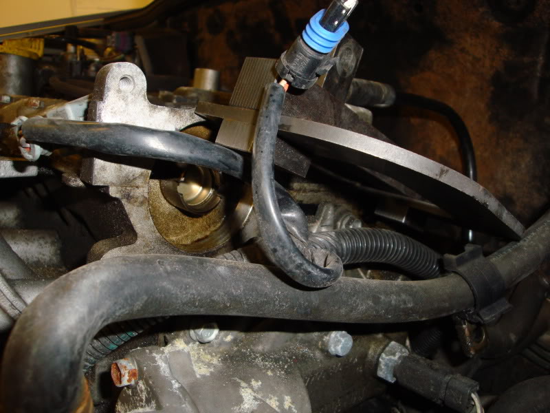

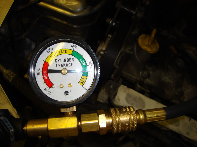

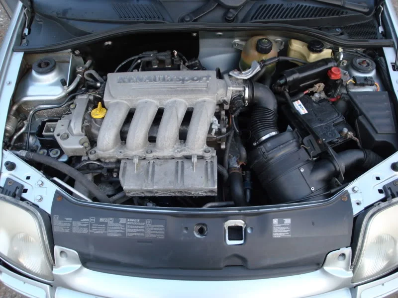

Now here's for the miracle, Purely to see what damage had been done I re-set the timing & performed a leak down test
All cylinders hold solid compression, So fire it up & it starts on the button!!! So new Cambelt/ Auxbelt Kits ordered from Renault along with the rest of the 72 service parts, Just under 3,000 miles later she's not missed abit!

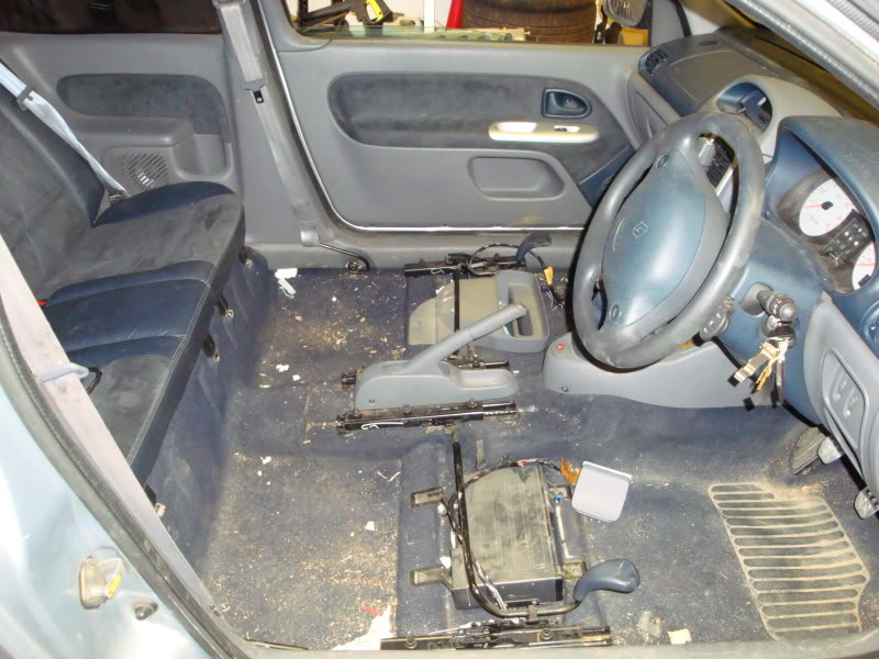

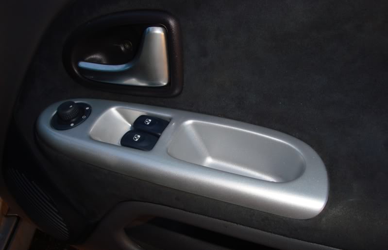

All the seats carpets were replaced with sub 50k 182 goodies (pictures to follow)

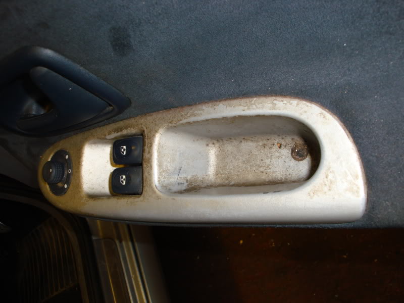

And re-painted the horrid door pulls with some rattle can action

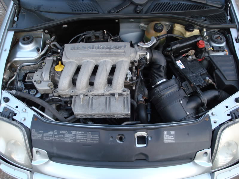

Engine bay

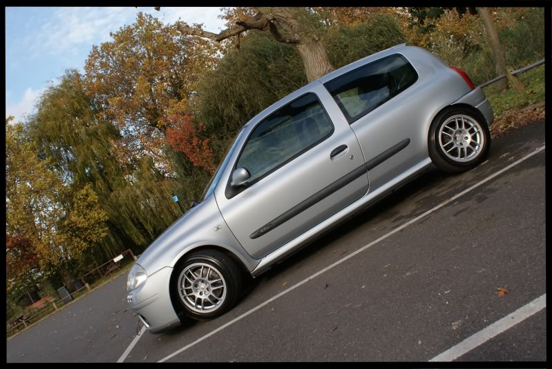

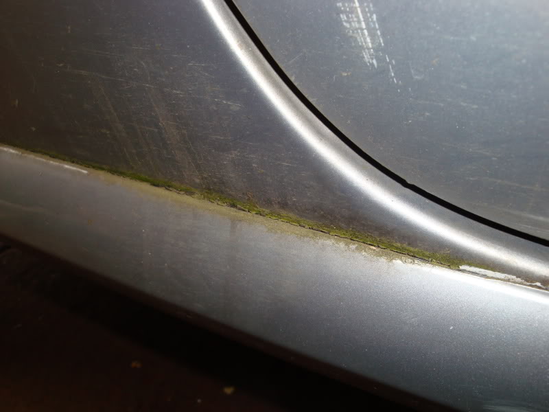

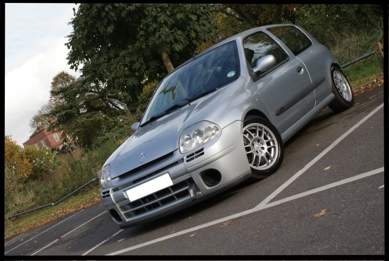

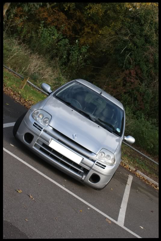

Thanks guys, Really pleased with how its turned out, Paint work is in really good condition, Only thing I've done to it is Clay bar to remove the tree sap, Good machine polish/wax and she shall be mint :cool:
  e92 + E46 M3 + Cup
Got to be worth £2k all day long!
Love Iceberg Ph1's!
Have been offered £1,500 & £1,900 Since completed! Don't want to sell it though :eek:
This is also my 3rd Iceberg on a PH1, thought there were only 99 of the things! all by chance as well!
Got me thinking of saving a ph1 now, really miss my old iceberg
Hasn't been cheap though, Just silly little things that really restore the car soon add up, Most of its labour, But its a hobby so no regret ;)
