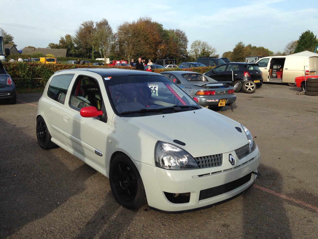

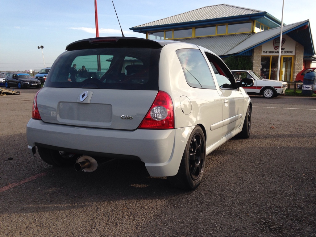

It had it's first outing today. It's quick!!
Sadly it shat it's dephaser on the last run and knocked the timing out :(
But it made a 2014 trackday which was the aim. Bloody nice car now!!

He got LOTS of attention today, everyone commenting on how well it's been finished. And it has.
I just don't tell him because I'm a jealous pig.

What is the engine spec?
Looks nice and sounds well.
Standard engine, custom ITB manifold, power steering and ac delete, 182 manifold, custom exhaust, mtec ecu mapped at circuit motors/sabre tuning.
214bhp and 186ftlb.

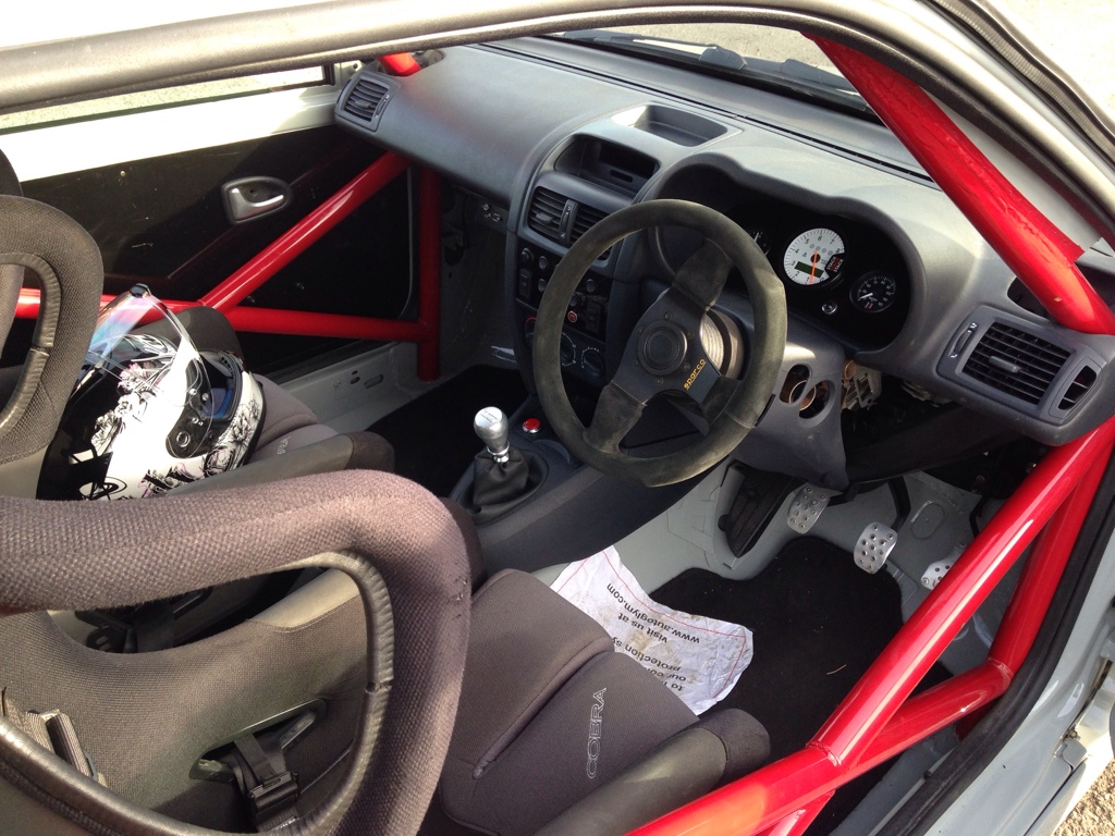

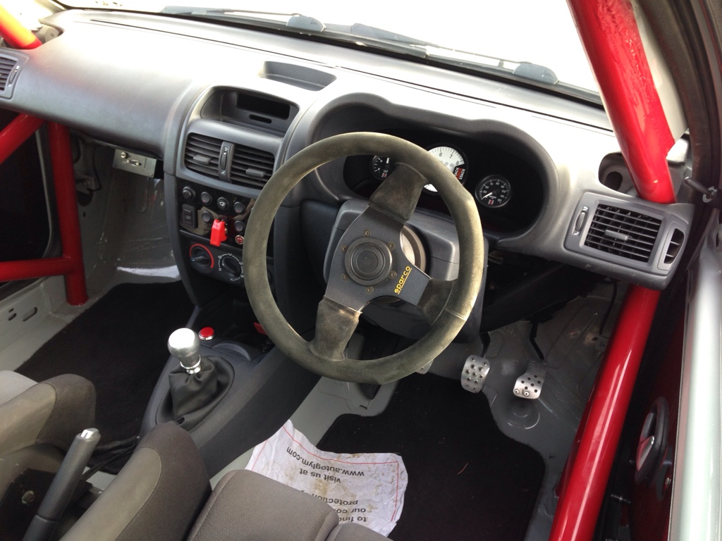

It may be because I'm tired, but how does the dash go around the cage? It looks very neat, and I can't see a join!
The Dan Grenade
  Whichever has fuel
But how did he fit the dash back with cage in place?!
See the gaps? Once all the screws are out, you slide it right so the left hand side clears, pull the left hand side free and then the right.
He's thought of everything! (Apart from a new dephaser)
