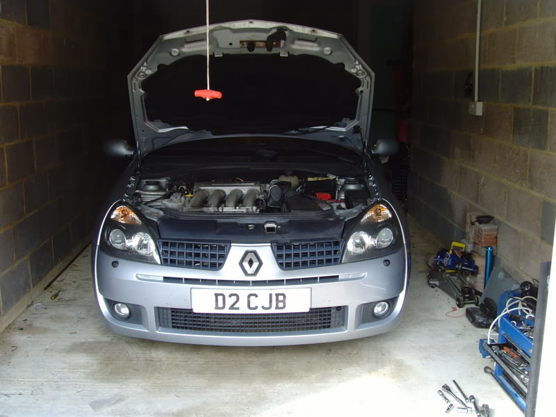

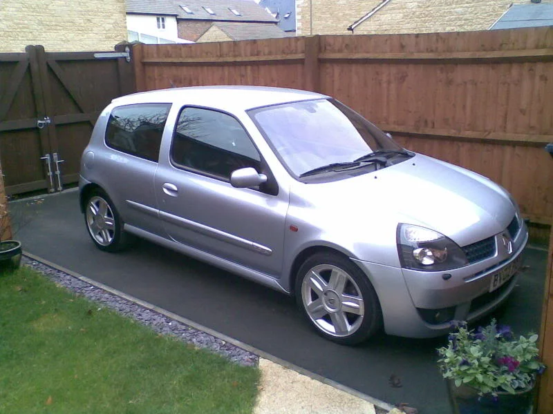

November 2007, standard 172

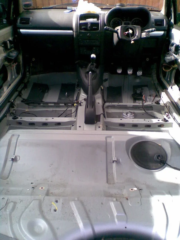

Car stayed on my drive, untouched until Feb 2008 when I started the stripping.

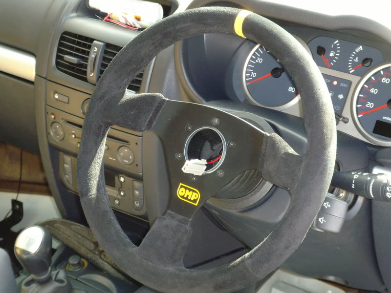

And new wheel

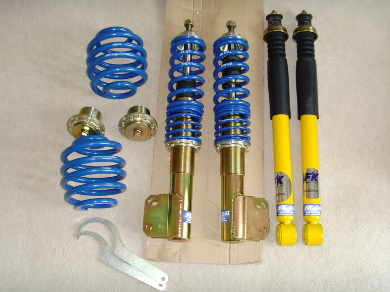

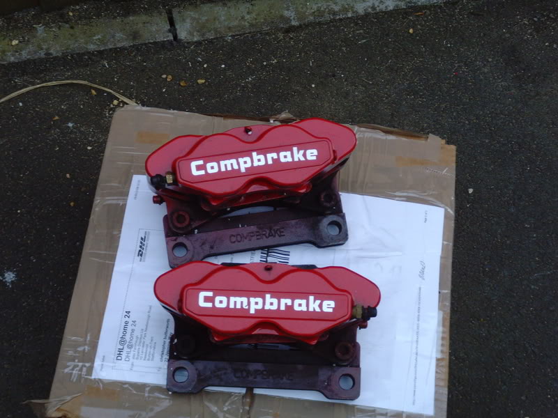

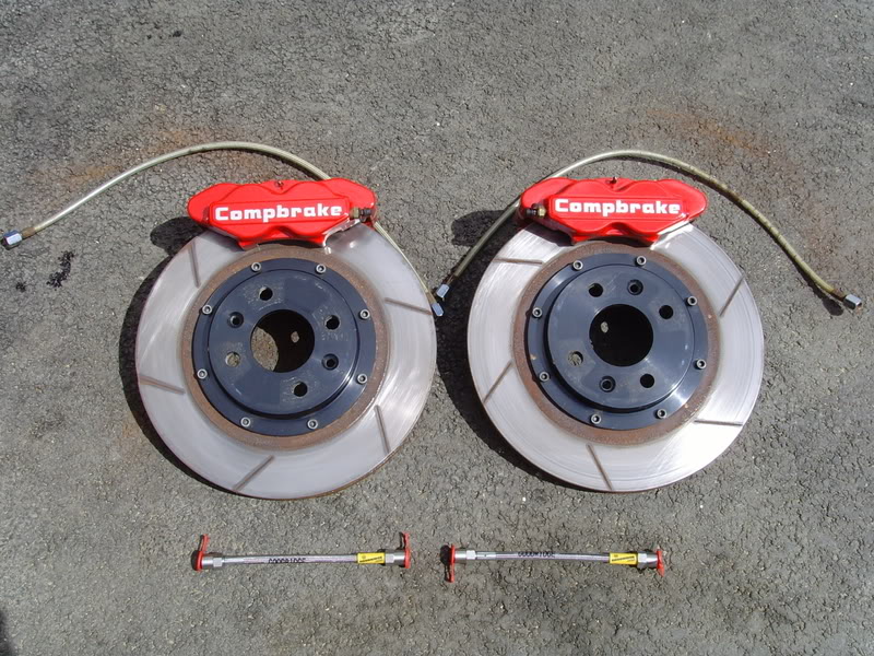

then got some collies and new brakes
Calipers have been re-painted since this pic and I have had some new compbrake decals made. Also have 2 piece 295mm discs but will get some better pics when its all fitted to the car.

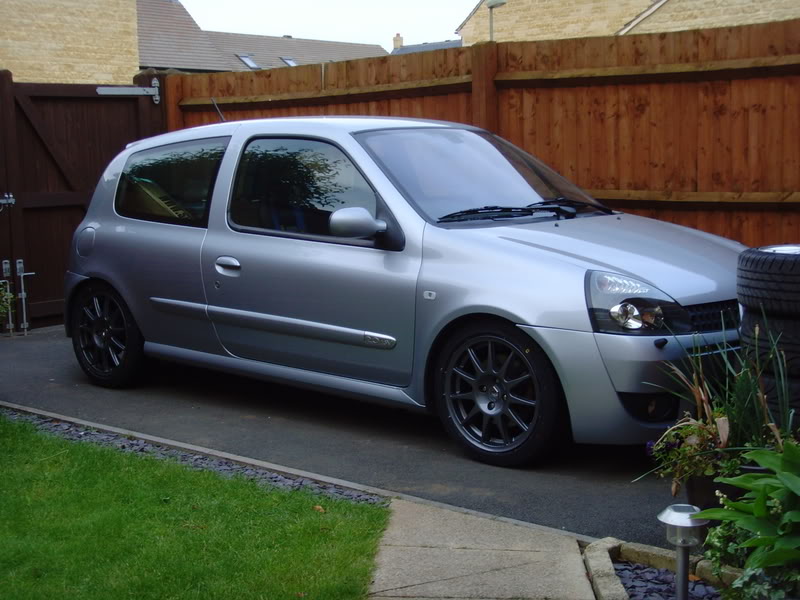

Next was wheels, and although I tried, I just couldn't resist Turini's:cool:

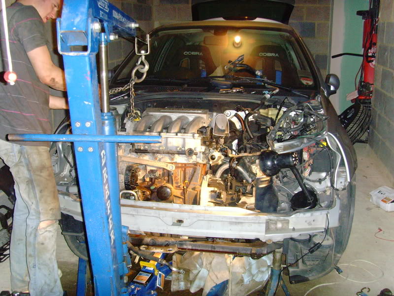

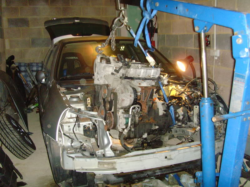

Used the car for about 4 weeks like this,then decided to bite the bullet, get the engine out and get the K-Tec stage 2 turbo kit with 300bhp FTW:clap:

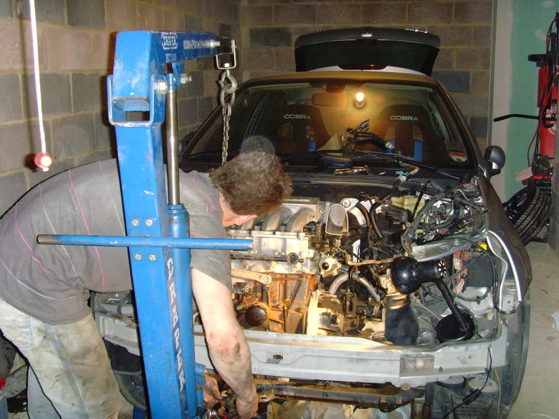

Was lucky as my mate let me use his garage, so in her new home for the next few weeks.

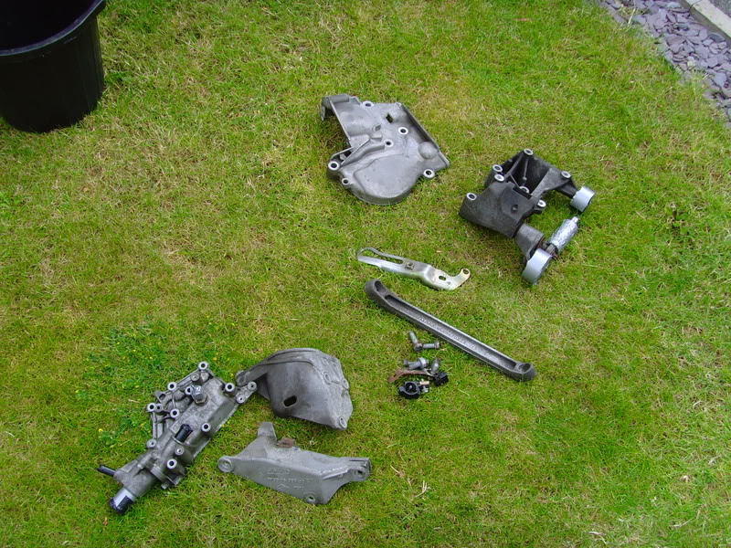

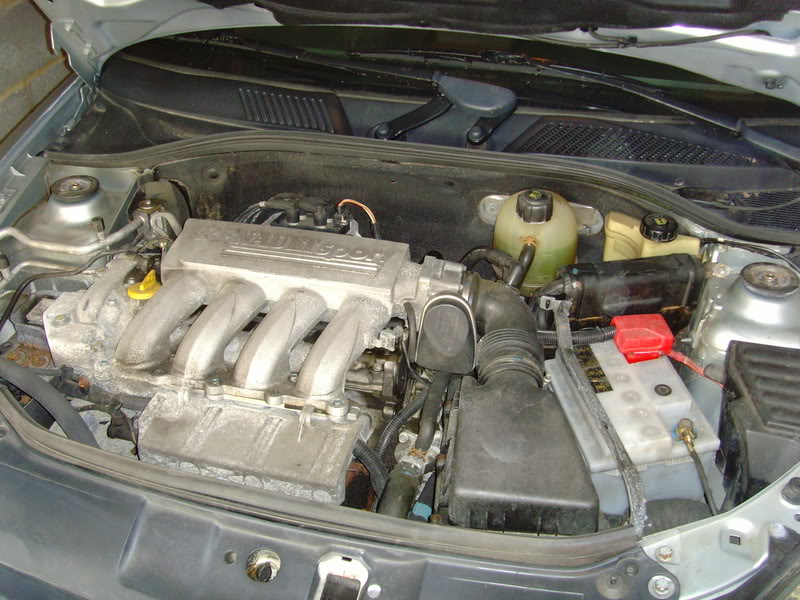

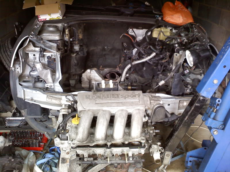

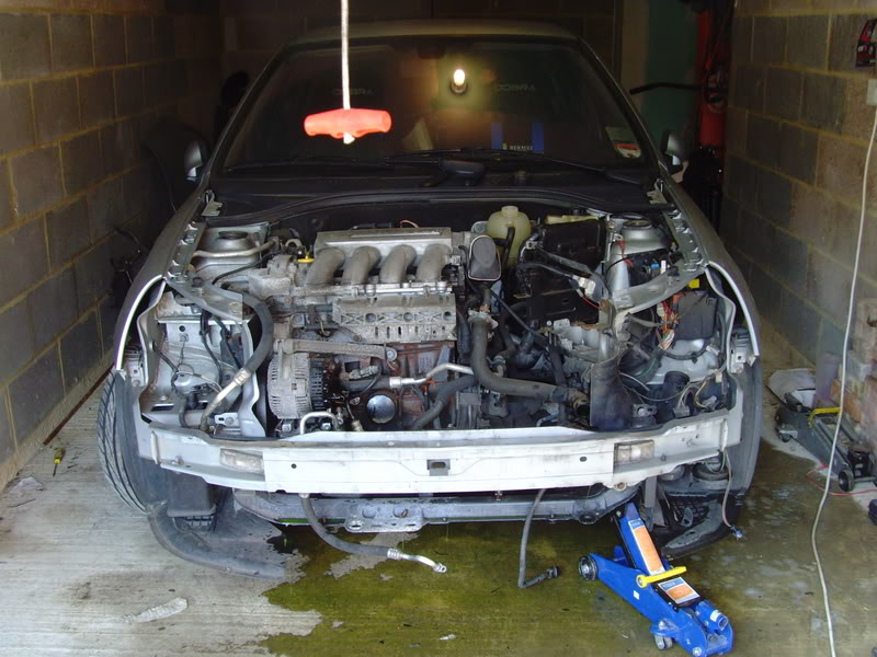

Standard, dirty engine bay
20 mins later!!

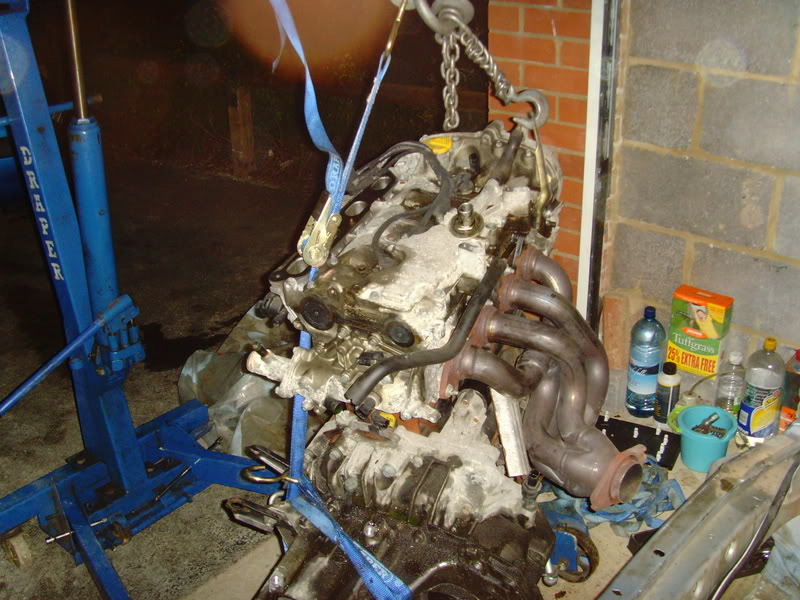

Bit later still,

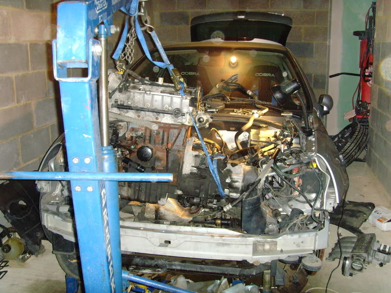

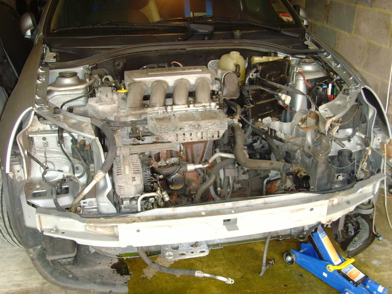

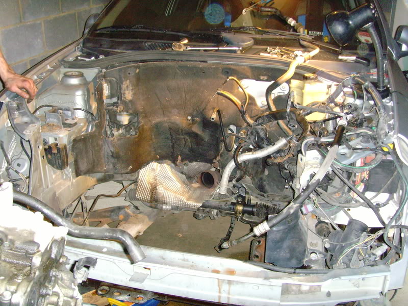

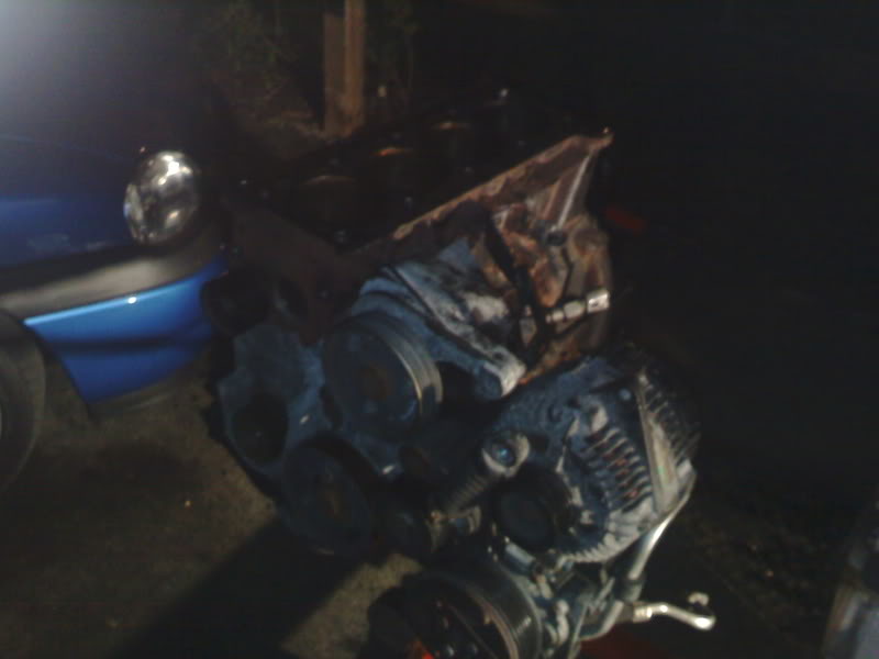

Then at 1am the following morning we had it out and nearly stripped ready for a local engineering company to work some magic on the head/manifolds.

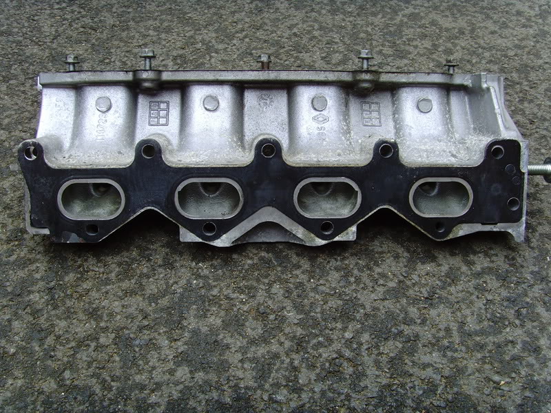

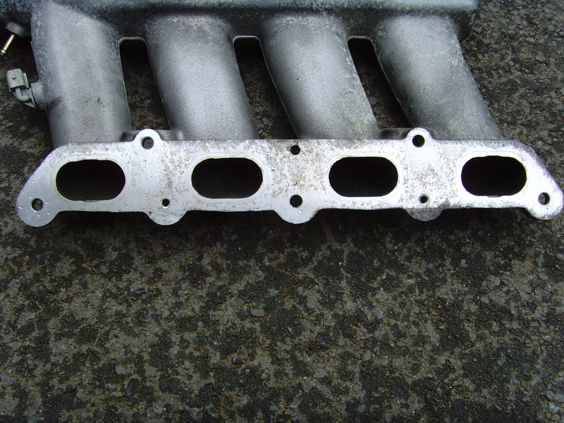

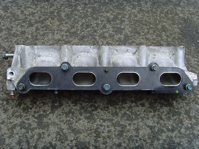

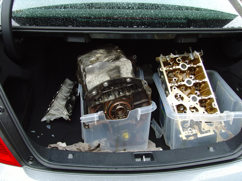

Following morning, had my company car loaded up and ready to go. Check out how much excess metal is on the manifolds:eek: , will all be matched to head/gaskets.
Thats pretty much as far as I have got so far, engine has been at the engineering company for 3 weeks now and will hopefully be back Wednesday this week. All the turbo kit has turned up from Dave at K-Tec but haven't had a chance to take any pics of it yet.

Where did you get the Turinis from? and were they in that colour or did you get them painted? I fancy a set for my 5... :approve:
Turini's were direct from Renault. Standard fit on the 182 trophy in anthracite or can also get them from K-Tec. Would look great on a 5:approve:

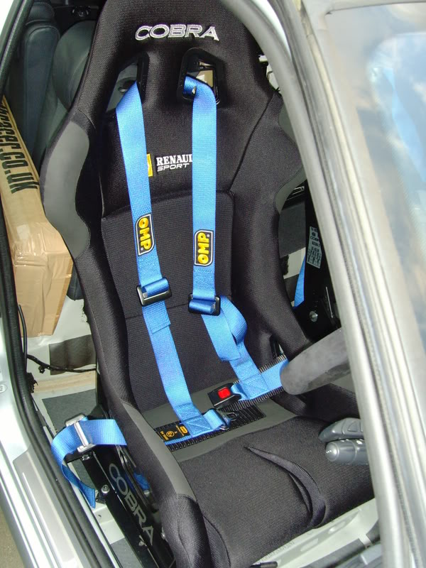

Like that steering wheel which one is it? Any idea on what they cost with the boss? and does it cancel the indicators properly?
  LY R26
good work so far.

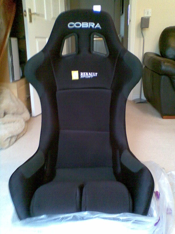

really like them seats.
Where do you buy "Renaultsport" stuff from,
I saw someone with "Renaultsport" Sabelt harnesses a while back,
dead jealous.

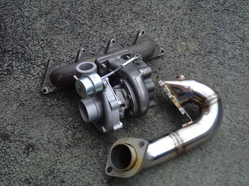

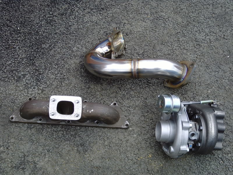

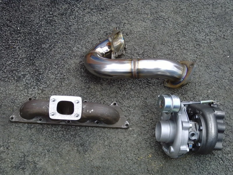

Right, didn't get a chance to get the engine today so will have to wait another week:dapprove: . I did however get to clean/paint some of the parts before they go back on and also got some pics of the turbo kit. Enjoy

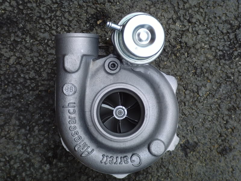

Turbo, cast manifold and down pipe

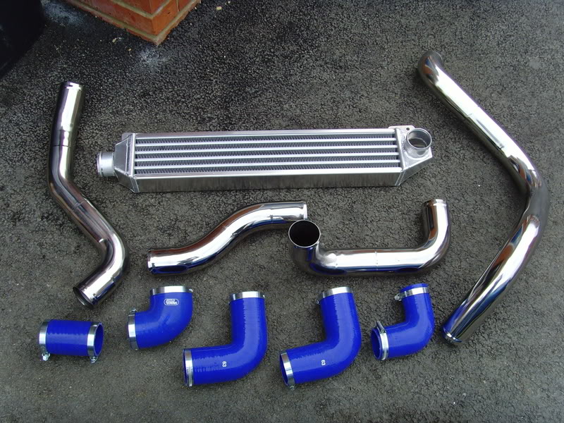

Intercooler and boost pipes

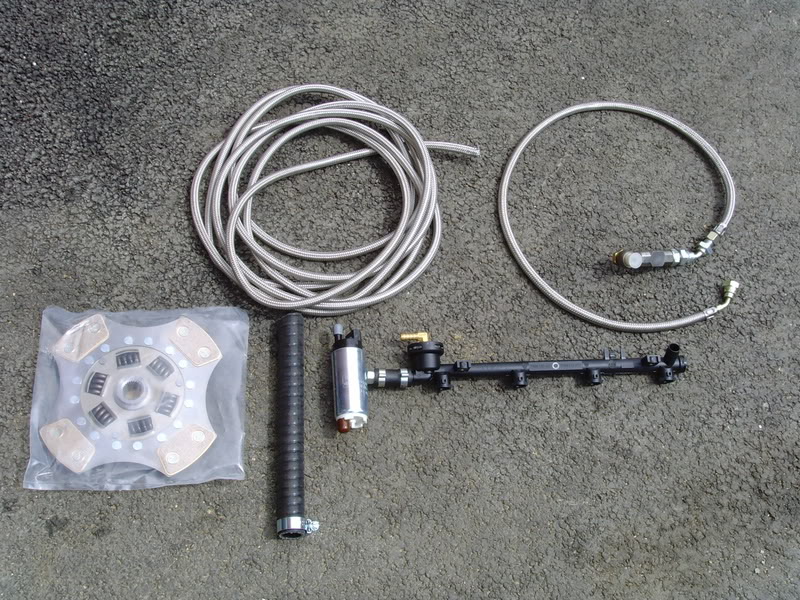

Turbo oil feed & return, modified fuel rail,braided hose,uprated pump and paddle clutch (pressure plate is with the engine for balancing)

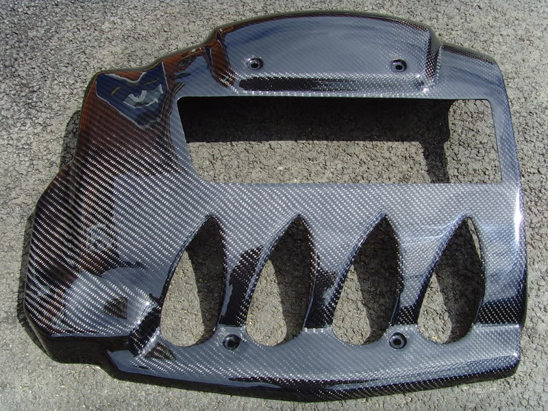

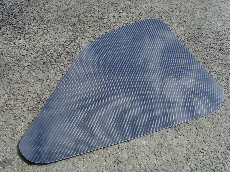

Carbon engine cover:cool:

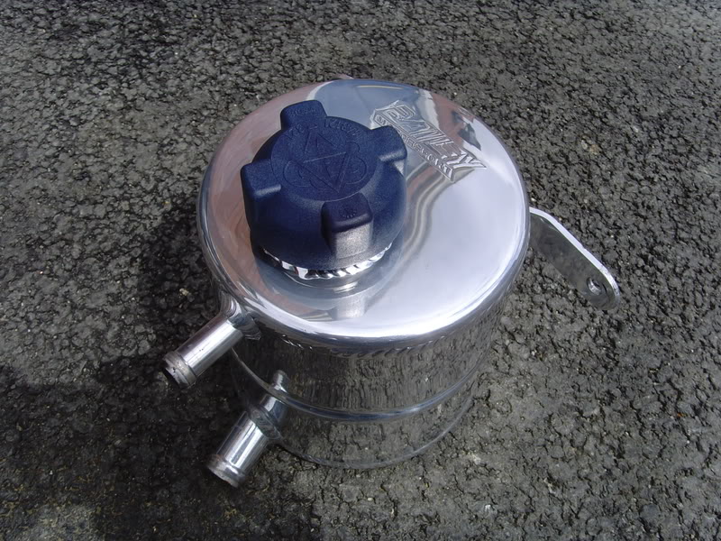

Bailey's header tank

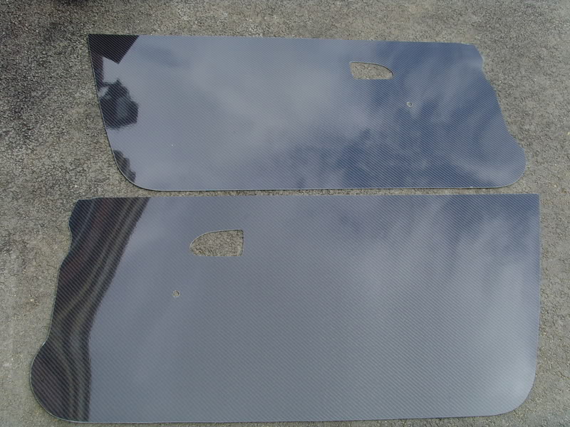

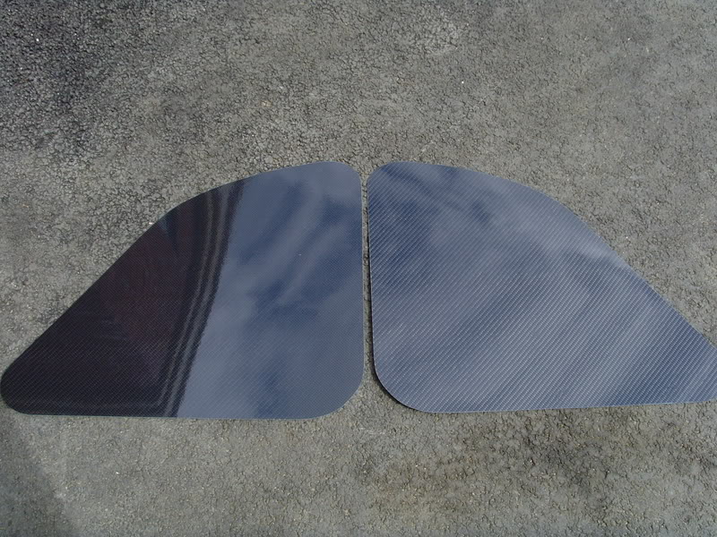

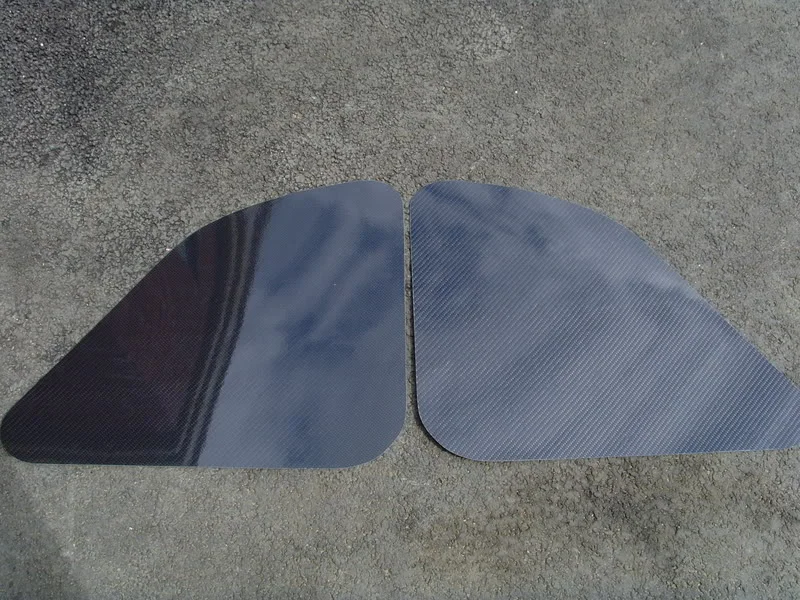

Carbon door and 1/4 panel trims
Refurbished calipers with new decals, 295mm discs and braided hoses

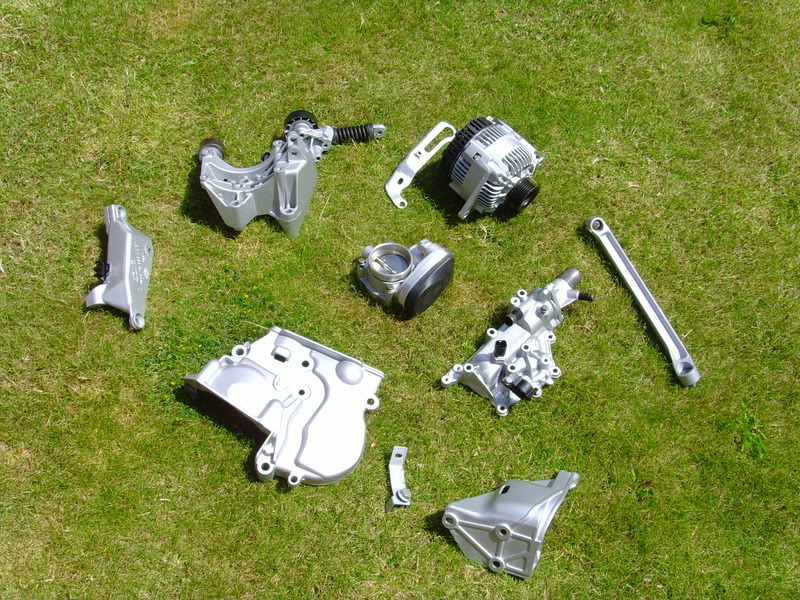

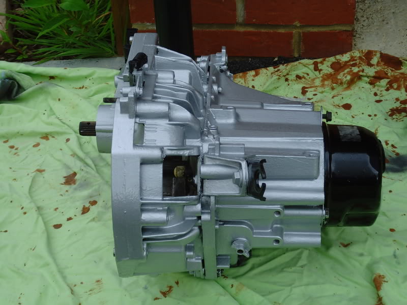

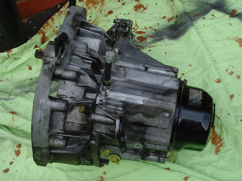

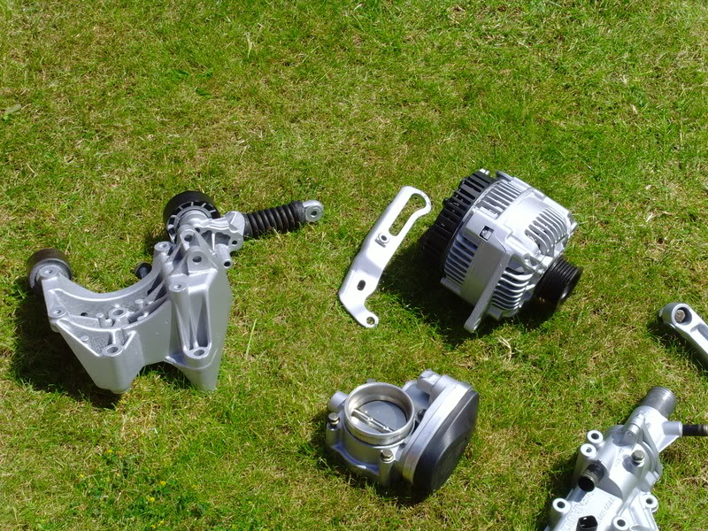

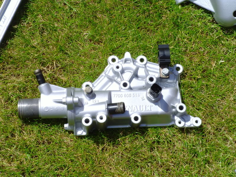

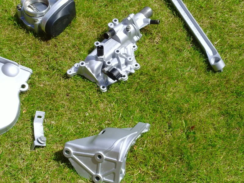

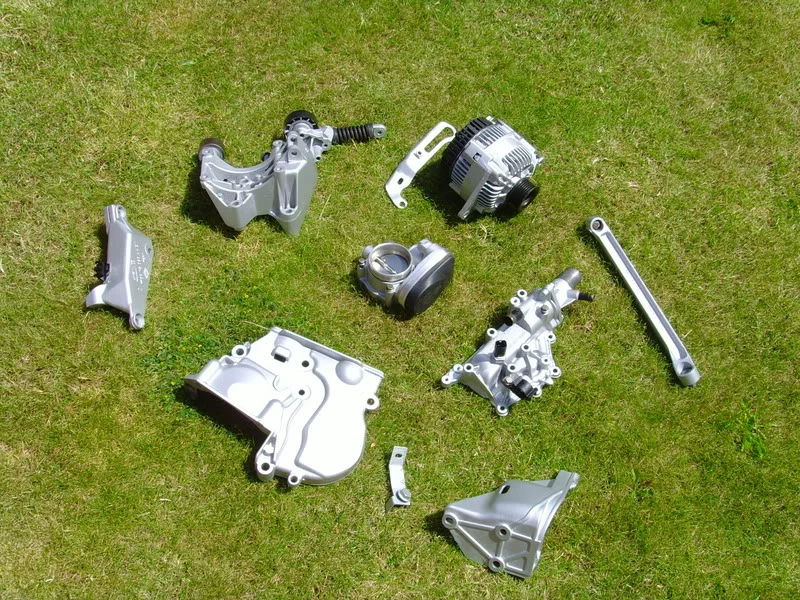

Cleaned gearbox
Then 2 coats of silver
same thing with the engine ancillaries
Think that will be it now until I get the engine parts back next week but will update asap.
