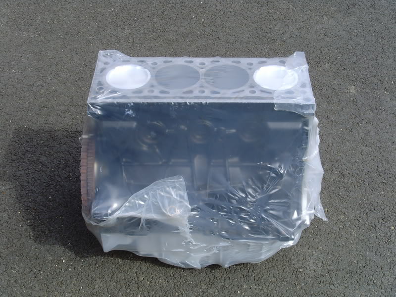

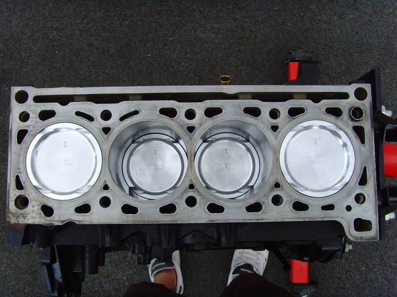

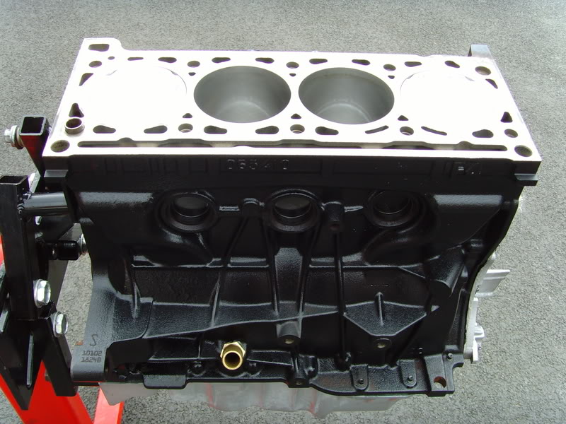

Block assembled and painted, unfortunatly didn't get any pics of the rods or pistons before they built it up. has got worssner forged low comp pistons and H section rods:cool:

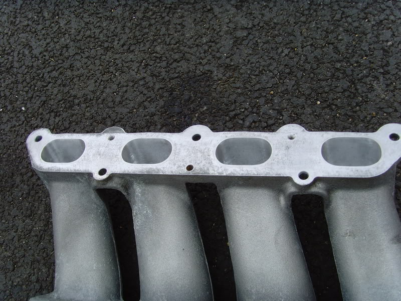

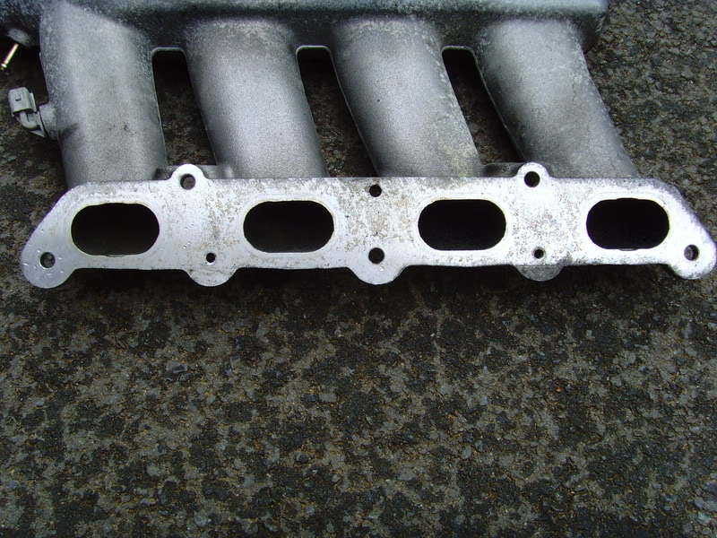

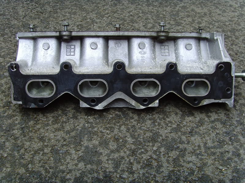

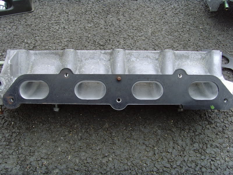

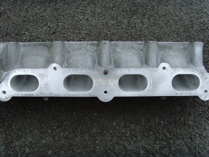

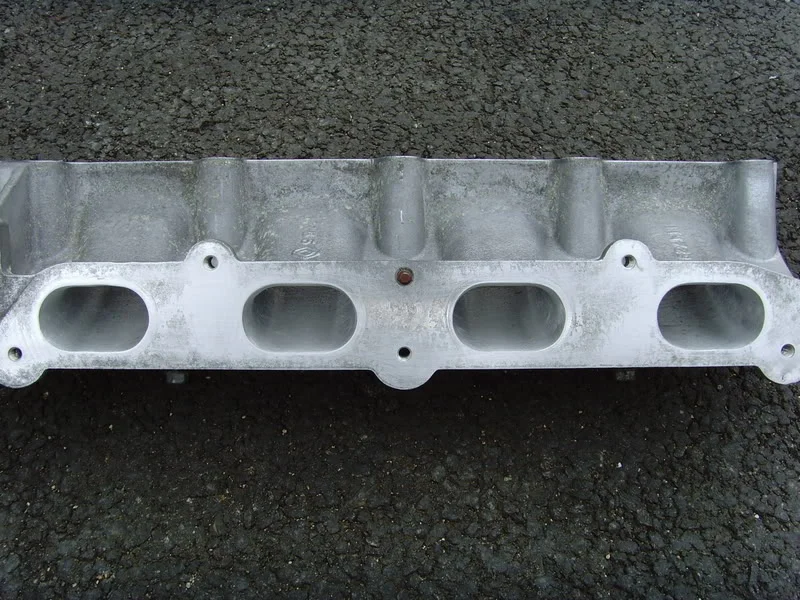

polished,ported and matched manifolds

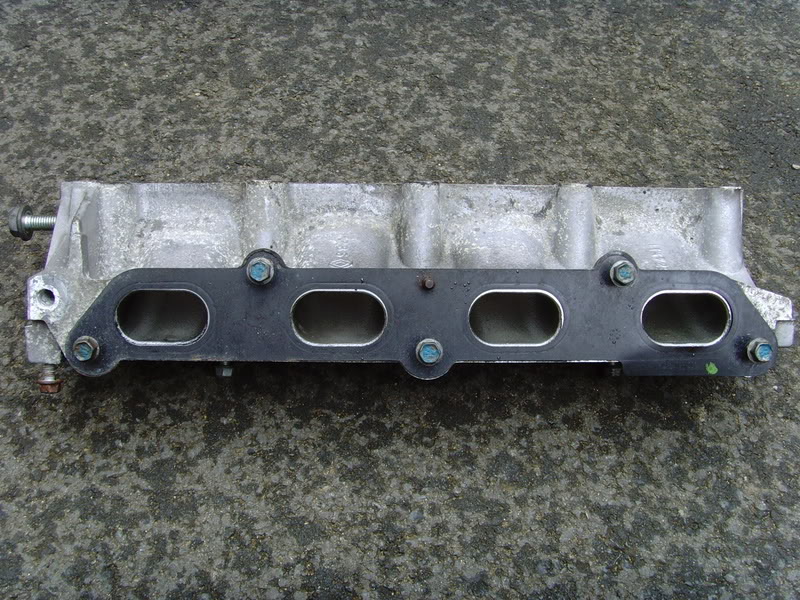

just to show how they have been matched to the gaskets

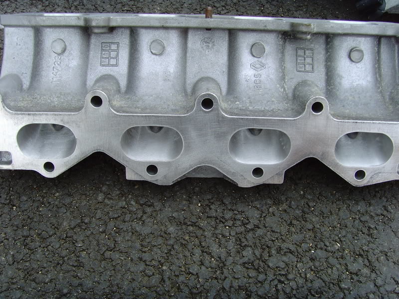

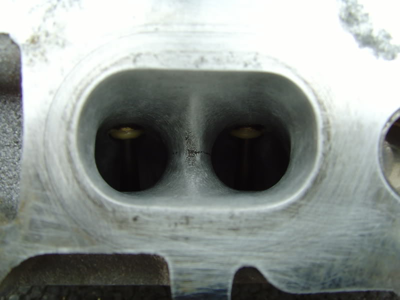

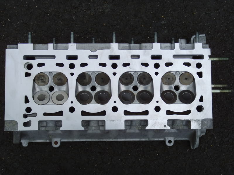

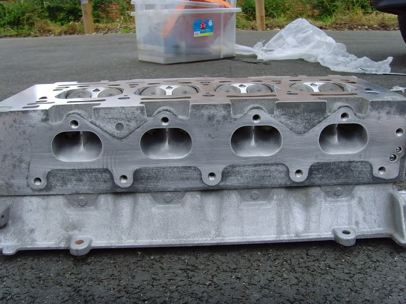

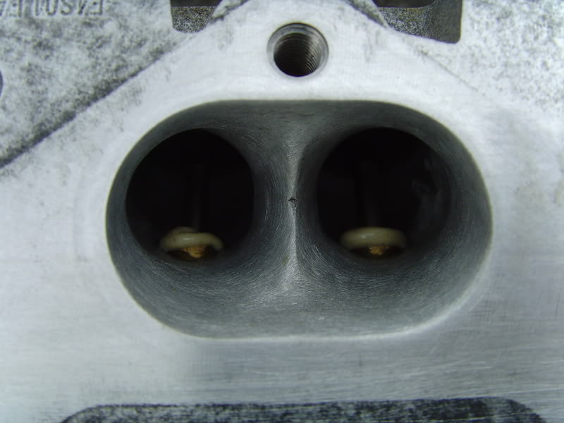

Cylinder head has been fully stripped/rebuilt. valves re-grouned and ports have been enlarged and matched to the manifolds/gaskets so should now flow as free as possible
Exhaust port
Inlet port

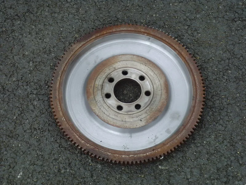

Also had the flywheel lightened.
The whole bottom end ( crank,pistons,rods,flywheel and clutch assembly) was then fully balanced.

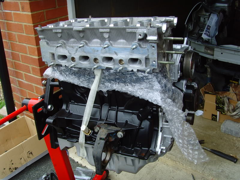

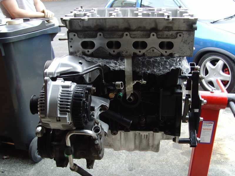

Then started to bolt things back on, trying to remember where everything goes:S .
Bubble wrap is to stop crap getting in the cylinder bore's and head has just been placed on to keep it safe.

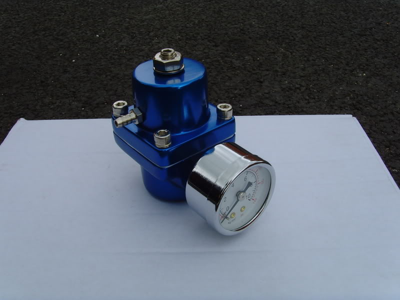

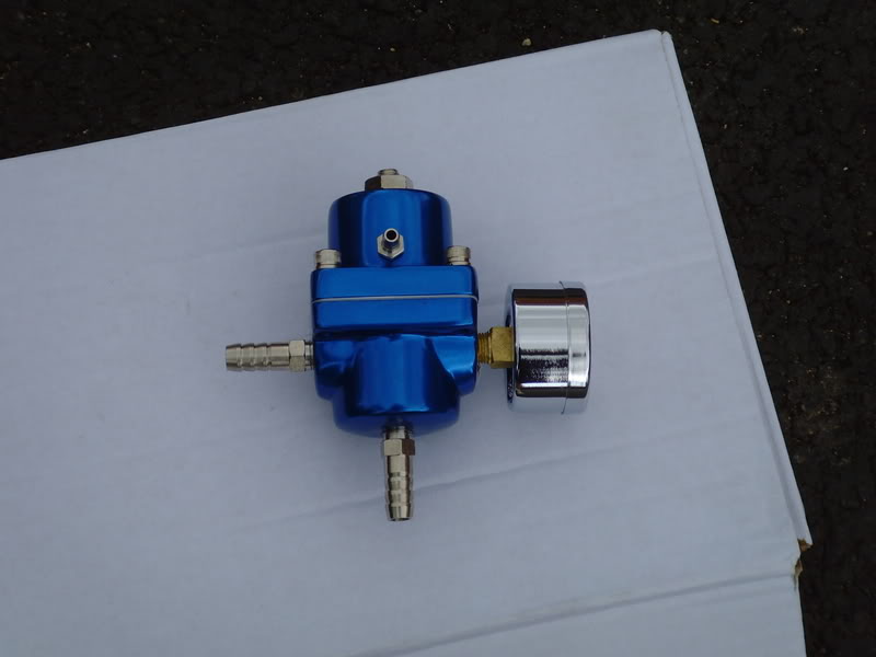

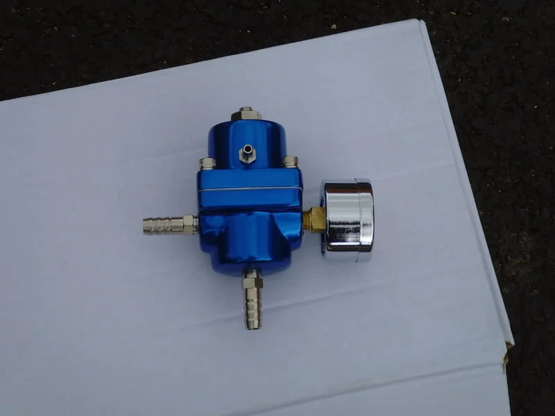

On the plus side, my new fuel pressure regulator had arrived when I got back to the house.
