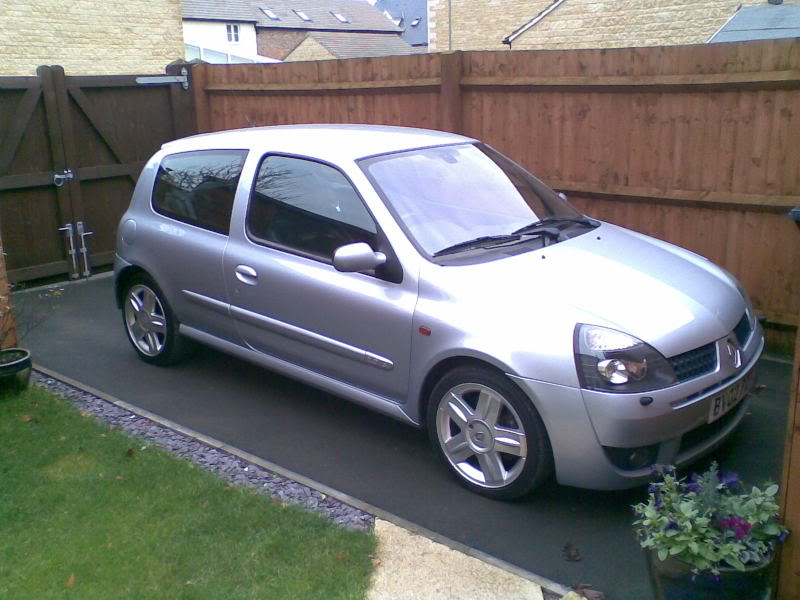

November 2007, standard 172

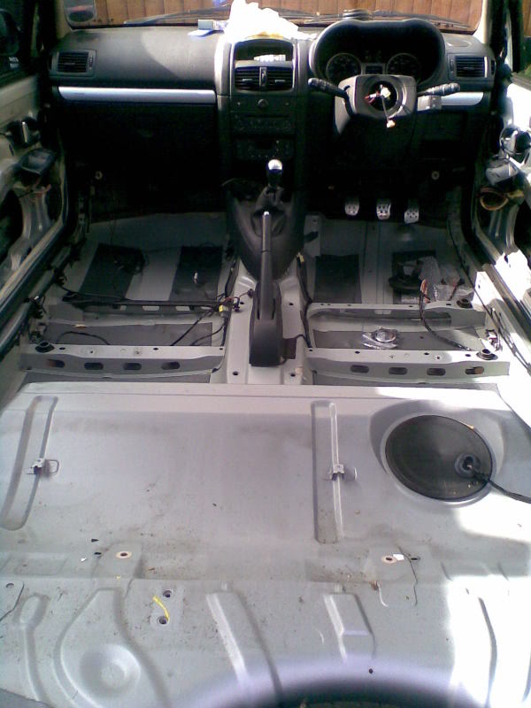

Car stayed on my drive, untouched until Feb 2008 when I started the stripping.
