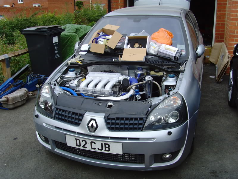

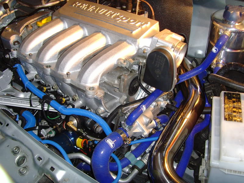

Been a couple of weeks since I worked on the car and updated this thread but here's the recent progress. Engine is 99% complete now, just got to get an exhaust made and work out how to route an air filter as there aint any room left in the engine bay:S

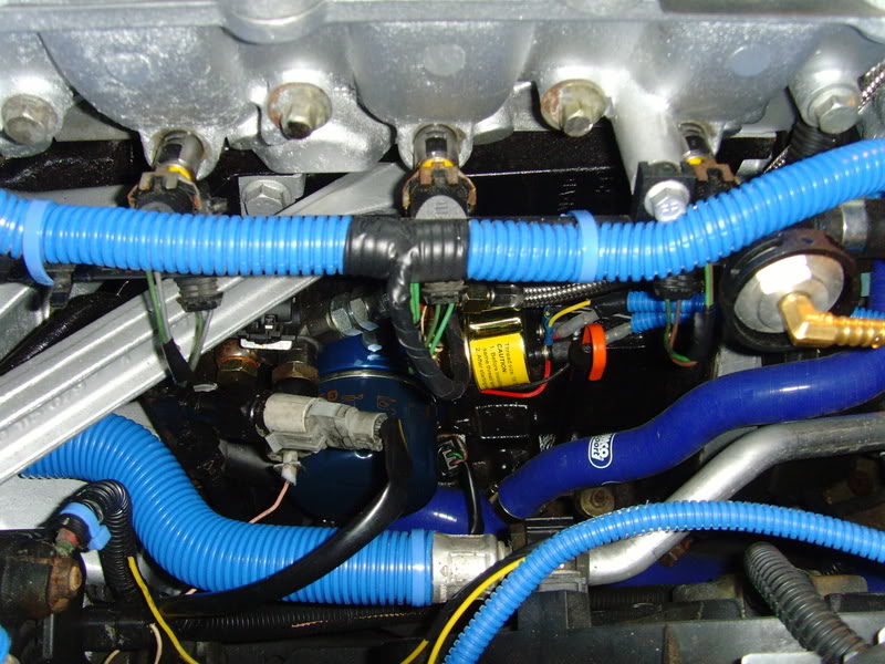

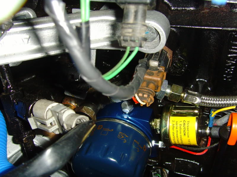

Started off by fitting a sandwich plate for my oil pressure and temp sensors and running all the wiring for these. Also had a bit of a tidy up with the wiring in the engine bay ( still to be finished )

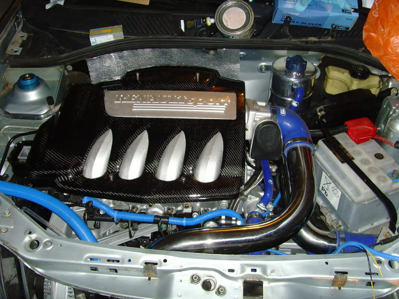

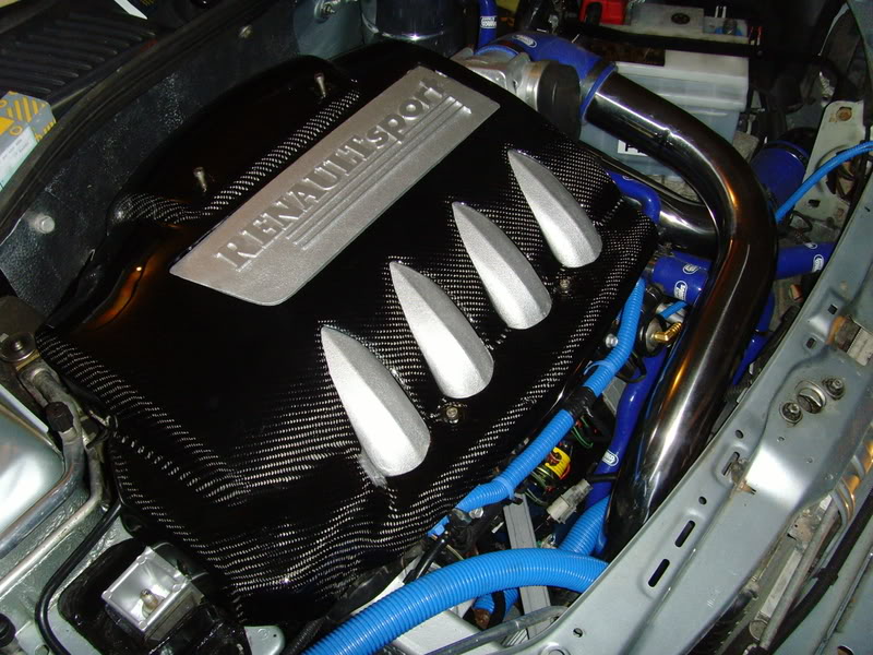

Then started to fit the boost pipes ( this was when I realised just how tight everything was going to be )

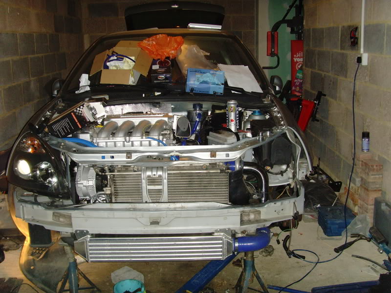

Intercooler fitted
All finished and as she stands at the moment
Fuel return and air filter are all that is left now.
Car is also back on all four wheels now, was waiting for my blue compbrake top mounts to arrive which you can just see fitted above. really please as this means that for the first time in 10 weeks it can come out of the garage to finish the work and give it a much needed wash:eek:
Will post up pics once exhaust is fitted

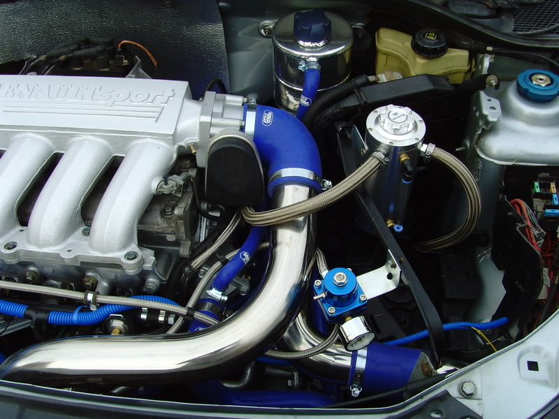

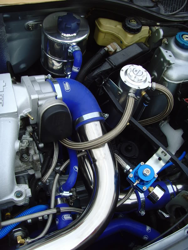

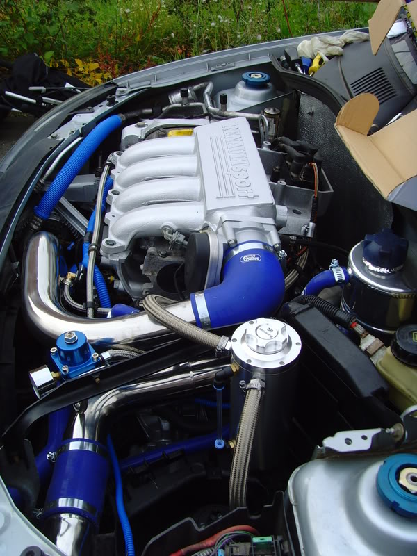

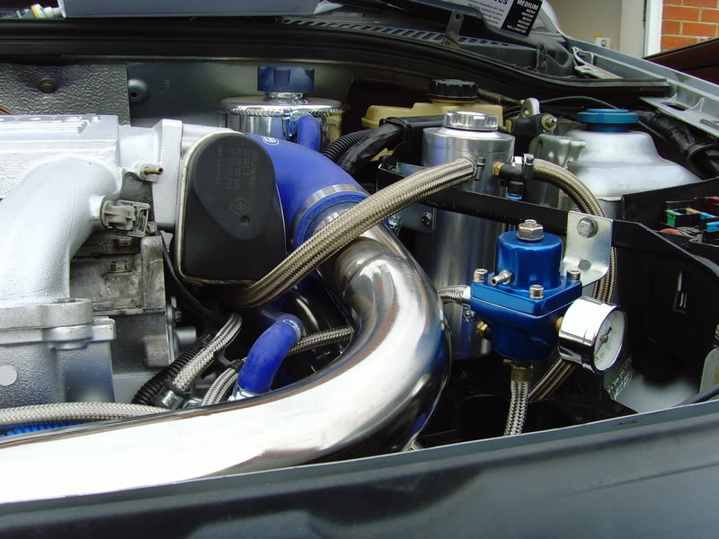

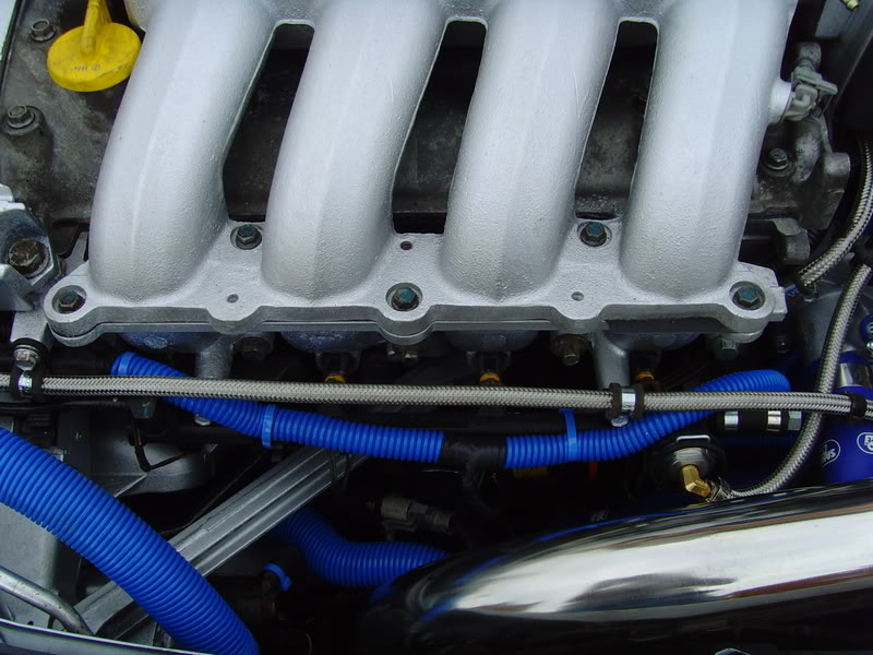

Little bit of any update, have decided to move the battery to the boot as suggested, at first I wanted to keep it in the engine bay but once the boost pipes were in it was obvious I needed more room for the air filter and breather system.
Anyway, have now fitted the breather system and fuel pressure regulator with more braided lines, also routed the new fuel return line to the tank.
Also refitted the front bumper, looks even more subtle than I thought it would. Can hardly see the intercooler so won't be much to give away what is under the bonnet:quiet:
On a down side, I can't find anyone to make me a side exit exhaust because its illegal to have it coming out of the passenger side and the fuel tank is in the way on the other side. Looks like it will now have a ktec stealth instead to keep the sleeper look.

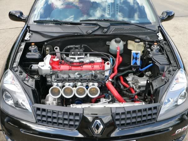

  ITB'd MK1
where's the air filter sitting? the 2 I've worked on have had NO room anywhere but where the battery would have been for the filter once the pipes are in but i can't see it there. Oh and dont forget the vac pipe that goes onto the FPR, it's important on a turbo :)
  A4 Avant
The filter looks to be to the infront of the inlet manifold slightly below on the left as you look at the engine bay.
No filter on the car yet, will indeed go where the battery was once i've manage to get a pipe to run from the turbo to filter. How did they do it on the two cars you have worked on? did they use silicon/hard pipes or flexable reinforced ducting?
Haven't forgotten vac pipes, engine isn't quite finished yet thats all;)

you thought of mayb painting the intercooler?
would hide it away completely then! :D
the ones I've worked on have had a solid pipe (think it's part of the K-tec kit) You'll also need to lose a lot of the brackets and bracing around the battery tray. I'd lay the ECU flat on the battery tray I think, will give you a massive amount more space, like we've done on our car :)

Looking good. One little thing struck me, bet you already thought about it but anyway. The braided hose going over the polished inlet tube will eat in to the material and make your nice inlet look like crap in no time. You better protect it in some way.
Btw the solid topmounts aint tightened in those pictures. They are superb have a set on my car.
