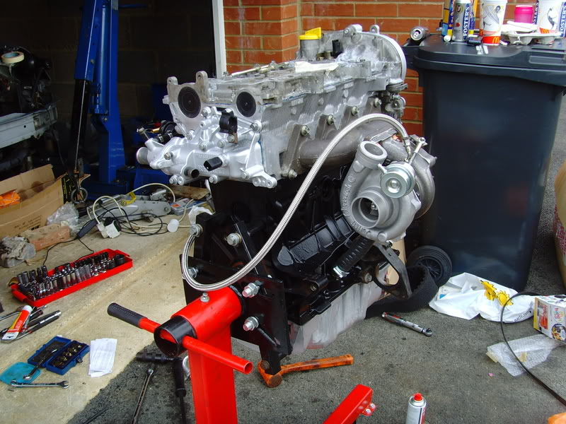

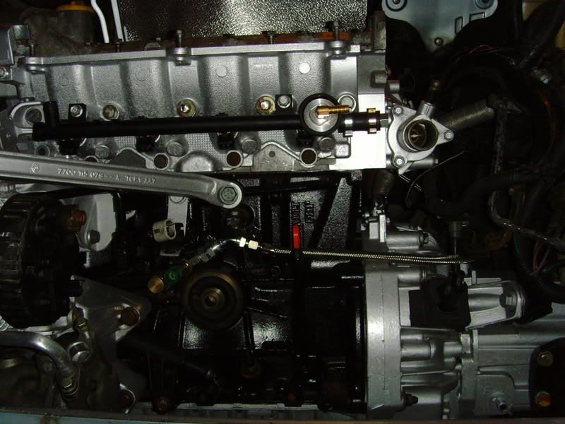

question,where do you tap an oil feed from for the turbo?
Oil feed is taken from the pressure sensor with an adaptor included in the kit. Can see it here just above the oil filter fitting, green plug connector is the original pressure sensor fitted into the new adaptor with braided hose.

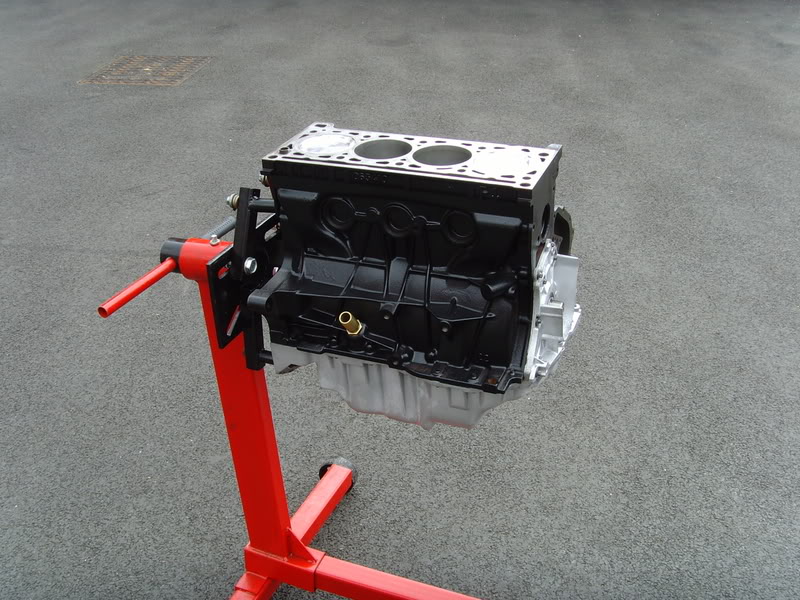

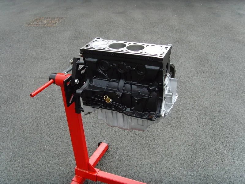

Oil return was drilled and tapped into the block during the machining work, was just a blank section in the block webbing before but in perfect place for sump return (think renault knew when they designed the F4R block ;) )
bronze adaptor tapped/fitted to block below.
and here you can see the black silicone return hose coming from below the turbo to the block
Hope this helps mate:)
The oil return on the F4R-774 in the Megane is in a very similar place so I guess they were thinking the same thing at some point :evil:.

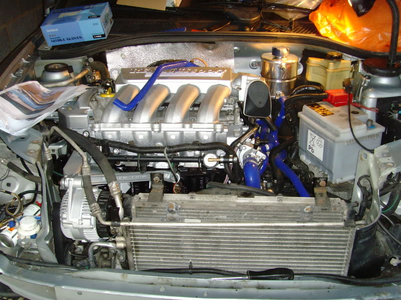

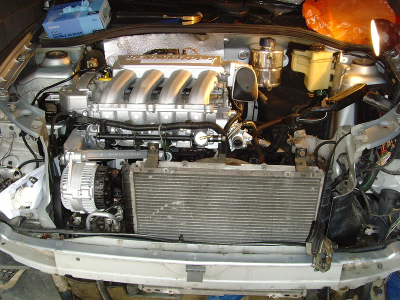

Small update for you all, although it doesn't look like much progress I got loads done this afternoon. All wiring is now done, starter connected and a lot of tidying up done in the engine bay.
Anyway, these turned up last week but had to go to Germany with work so didn't get a chance to touch the car.

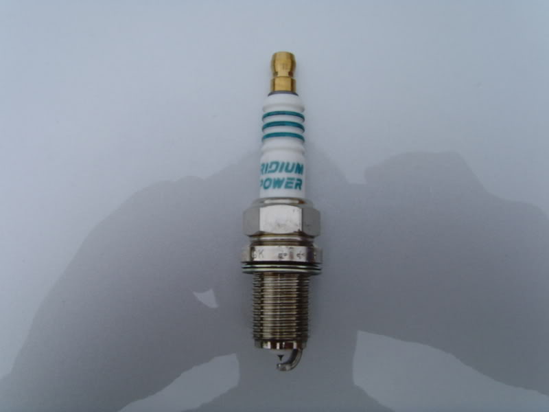

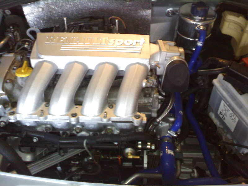

Fitted spark plugs and inlet manifold, also got radiator and A/C condenser fitted
Re-made the heat shield as I wasn't happy with the first one, fitted all the samco coolant hoses and new header tank

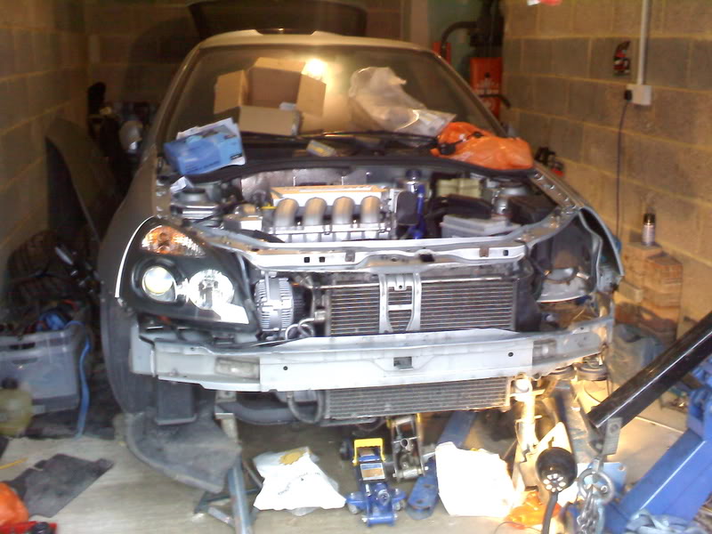

At which point my camera died so last two pics are on my phone, A/C all plumbed in,front cross member back on and o/s headlamp ( yes, I know it needs silvervisions;) )
Did do some more after this pic but forgot to take any more before I left. Very close now, all thats left is refit the drive shafts and hubs ( waiting for compbrake solid top mounts to arrive first), top up all fluids and fit the intercooler and pipe work . Then get the exhaust made and get it to k-tec for mapping:D
