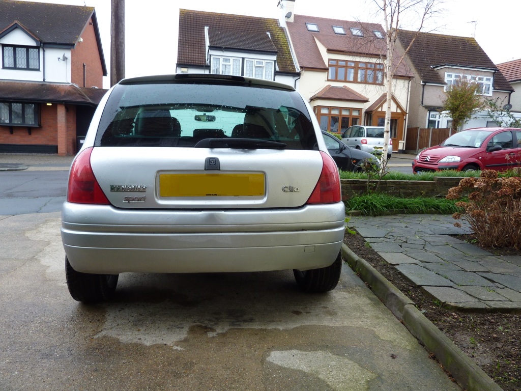

Well as of july this year i hung up my driving gloves for good because i was off to university, i broke up my F7R valver and put the money to one side for my next project, which was always going to be the same as the mk1, stripped out, bucket seats and rollcage!!

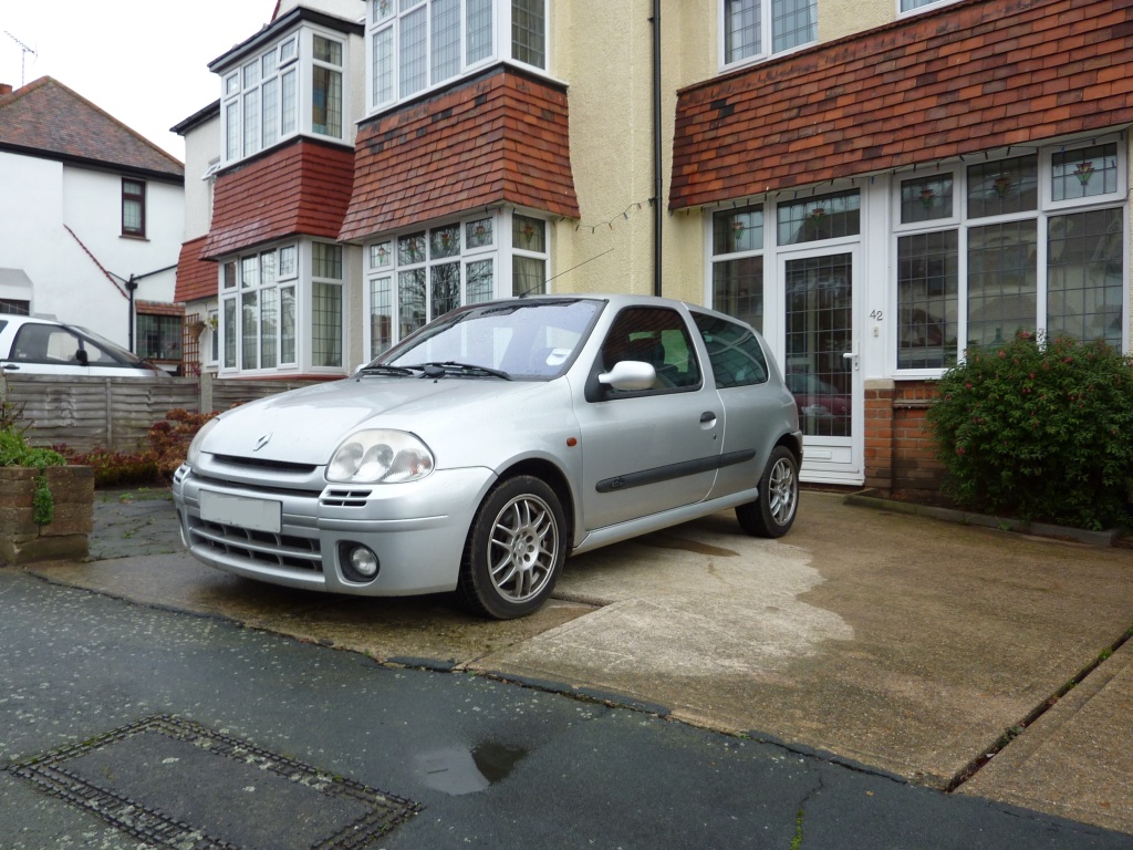

So after just one term at uni i found the perfect base to start my project!! this ph1 MOT failure cropped up on ebay just over a week ago and caught my attention, so i threw in a last minute bid of 535 and won it!! popped along on my way home from uni and picked it up!!
its bog standard with 90k,
no history (so ill be doing the cambelt before shes finished)
no rust, dents or colour mis matches,
seems pretty tight but i obviously havnt had a chance to drive it!!
problems with it
Discs and pads too low
Exhaust leaks
snapped spring
PAS pumps knacked and makes some funk arse noises! lol
obviously none of this matters to me as it will all be changed!!

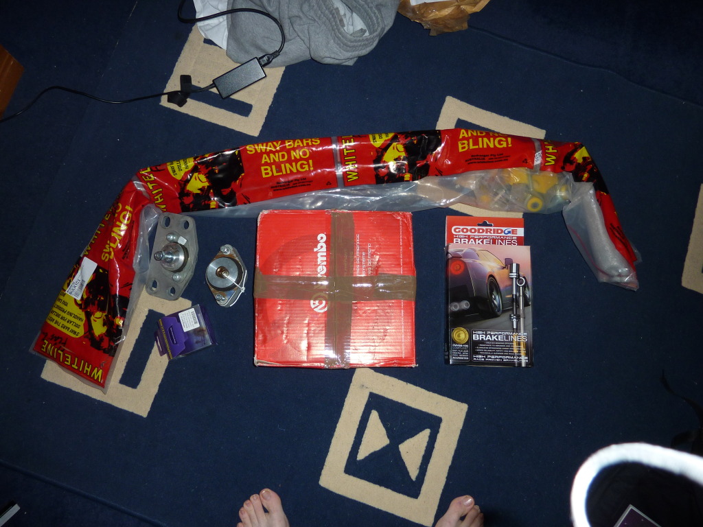

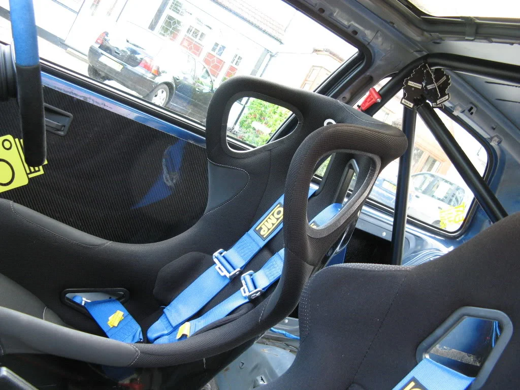

i have most of the parts i want to use with the build either already knocking around from breaking up my valver
Seats, Cage, Harnesses, Bonnet catches, Steering wheel, wheels/tyres, dogbone mount
also using the valver PAS delete kit and alternator to get rid of PAS and AC ;)
got a non-sport mk1 rack and column that i held on to aswell but only time will tell if i can make them fit!!
Also have
Pure motorsport top mounts
Gaz coilovers
whiteline ARB
powerflex bush kit
front camber bolts and rear shims
Brembo HC discs
Goodridge braided lines
vibratechnics mounds
pollybush dogbone
genuine rear discs and pads
manual mirrors
my bedroom floor is looking a bit of a mess, as is my nans garage :eek:

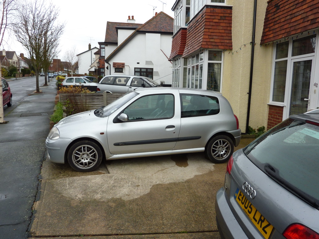

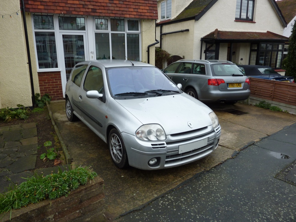

think im gna give it a clean, even though it might rain at any moment, its looking abit mouldy after fitting for months on end! lol

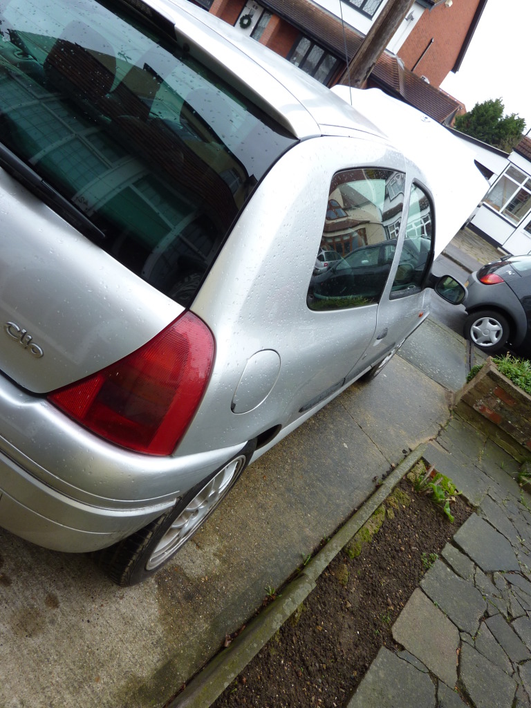

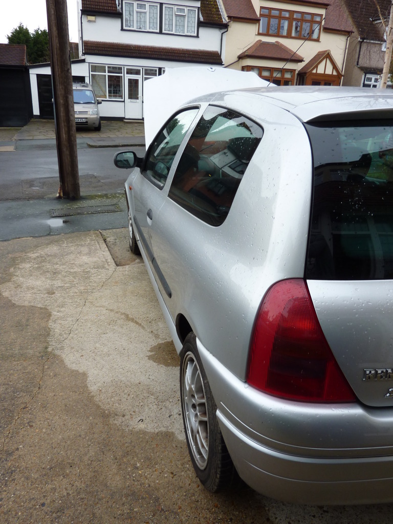

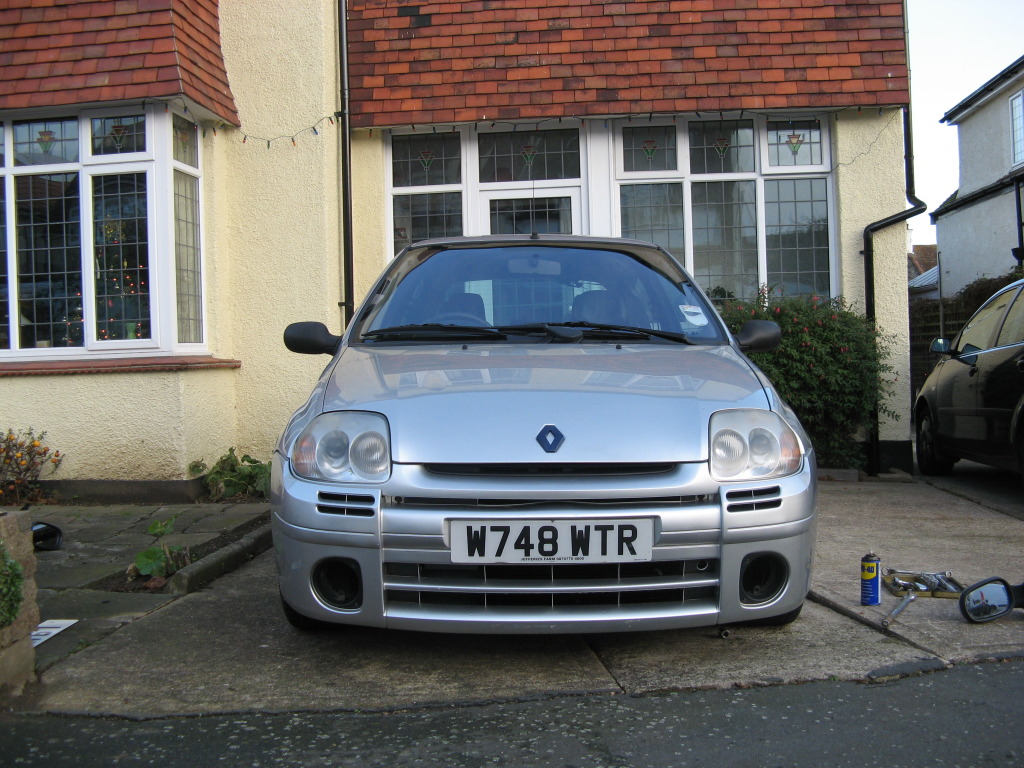

just gave it a little clean, paintwork have come up really nice, but i was amazed how much dirt came off it!! especially in gaps between pannels!!
also noticed a few niggles in the paint all over, but being silver it hides these quite well,
also noticed a large patch of paint peel underneith one of the side skirts,

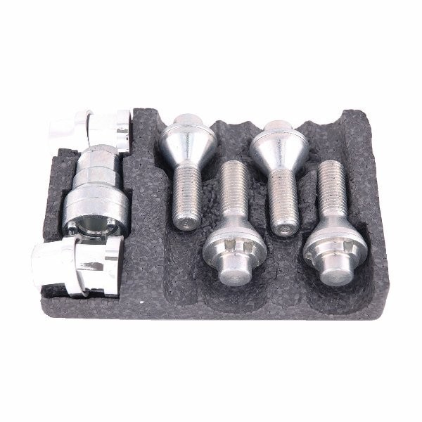

and that i have locking wheel nuts.....no key was supplied with the car :(

thats not the issue,
im just concerned how im going to get the current wheels off, without the key, or any way of getting it to a garage! lol
Struggler
  Ph1 track 172
pretty sure renault had a quite a few different sets with slightly different keys!!
i have set of similar lockers in the garage off a standard renaul so ill try those, hopefully ill strike lucky, otherwise ill try and smash a normal socket onto them, or trailer it to a garage just for them to take the lockers off!! lool

the lockers look like this
ill get you a pic of the actual ones tomorrow,
ive got a set of these in the garage, so ill chance using the key from that, but i dont hold much hope tbh,
ill then systematically start smashing every size socket i own onto them one by one until something hopefully gets them off!! :(

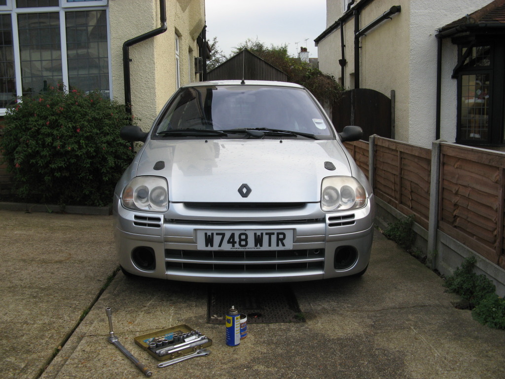

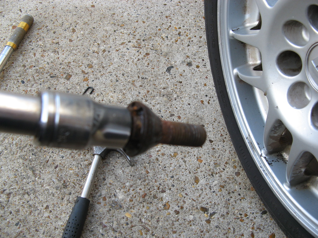

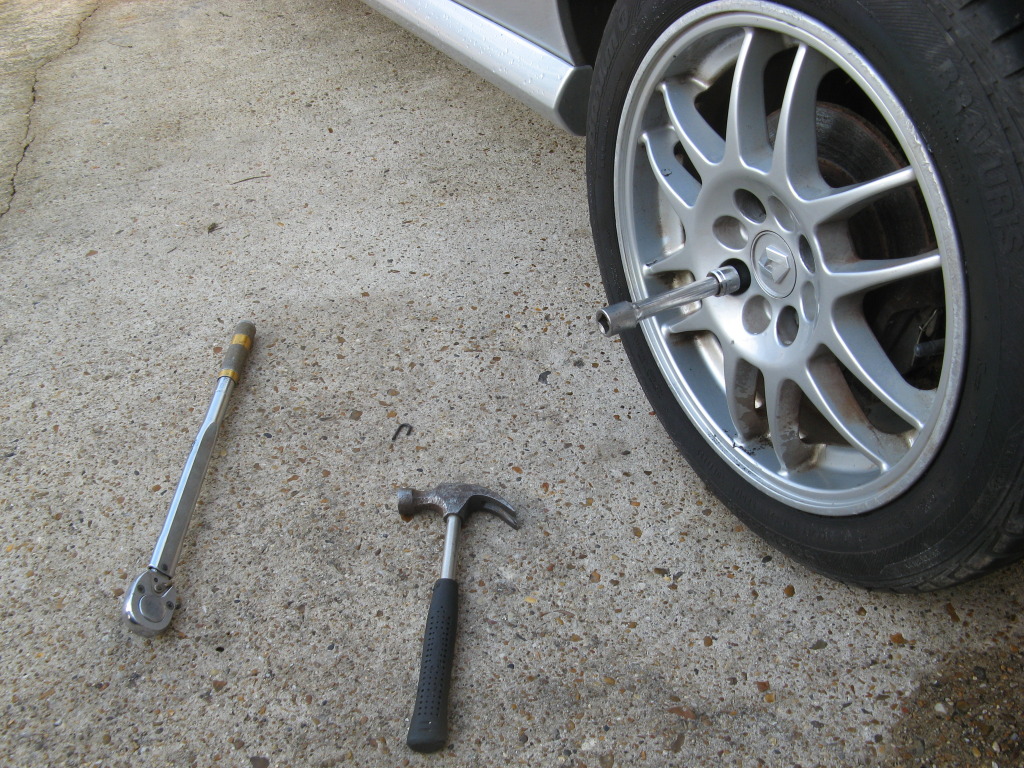

Ok had a little day on the clio today! nothing too majour as i dont really want to get under the car until i know i can get everything done!!

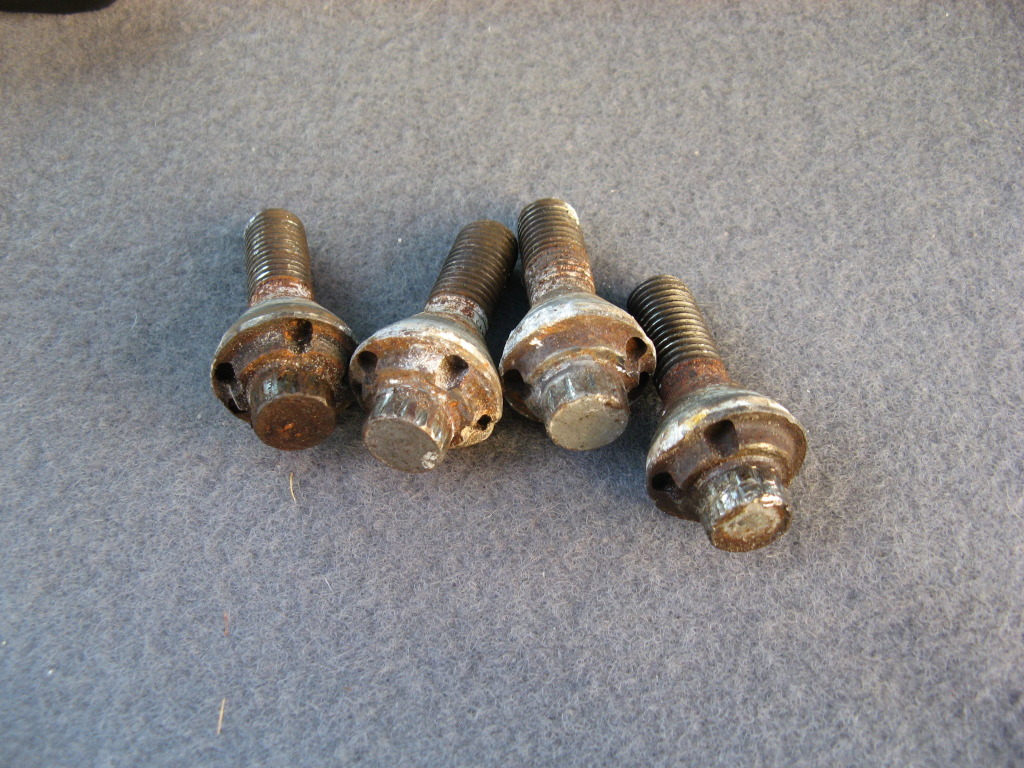

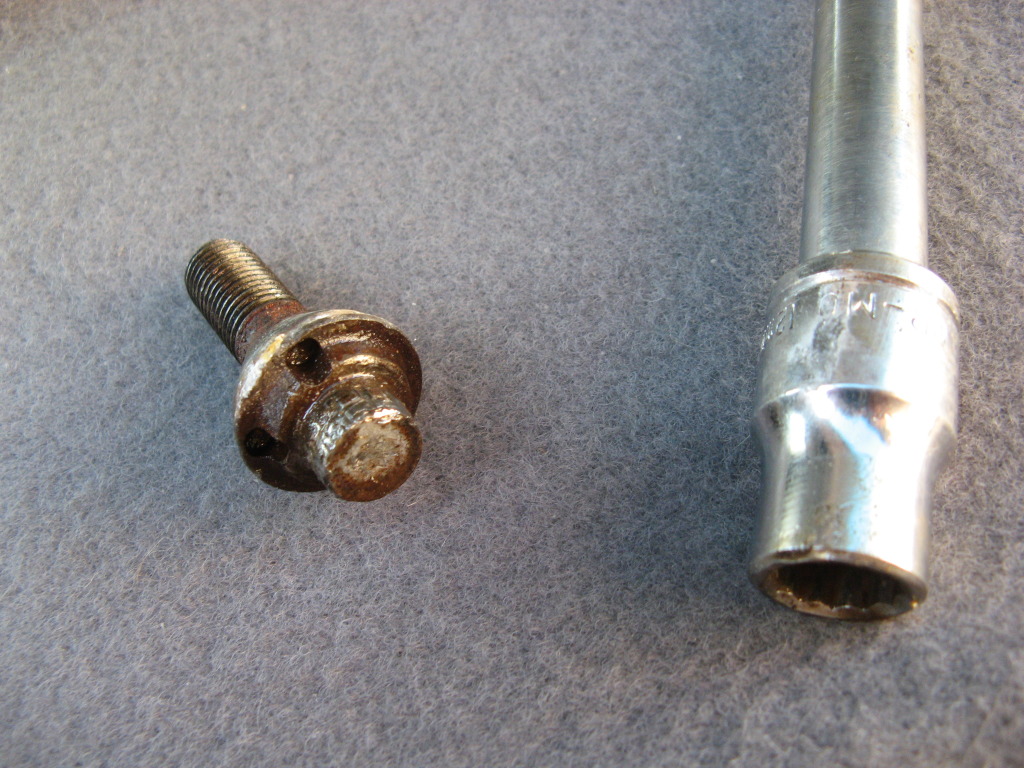

first point of call was those horrible locking wheel nuts!!
However a bit of this,
lead to a bit of this
and eventually they were all no match for me! :D

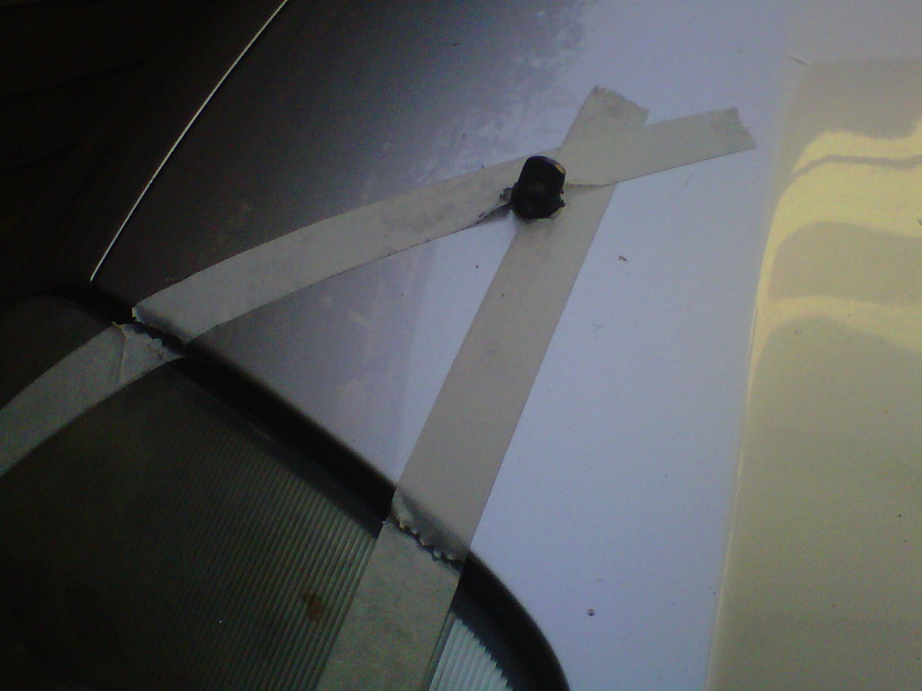

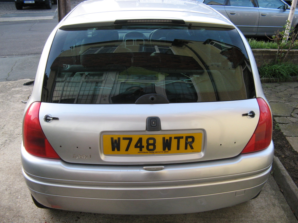

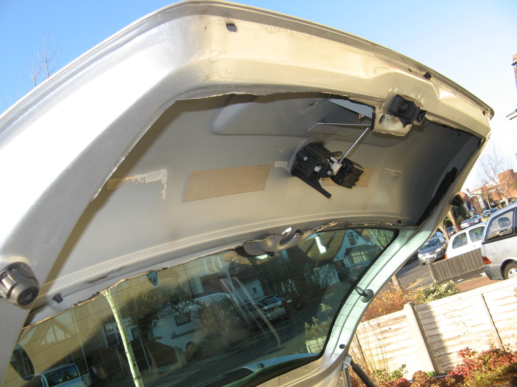

i then decieded to set about the boot lit!

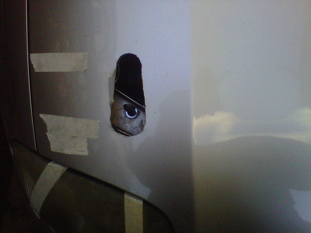

getting the wiper off was easier than i remembered

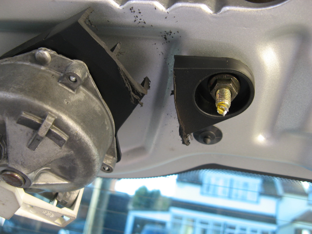

getting the motor off was a bit of a pain as the studs were just spinning, i got one off, but you can see the otherone couldnt be held with a screwdriver,
so i made light work of it ;)

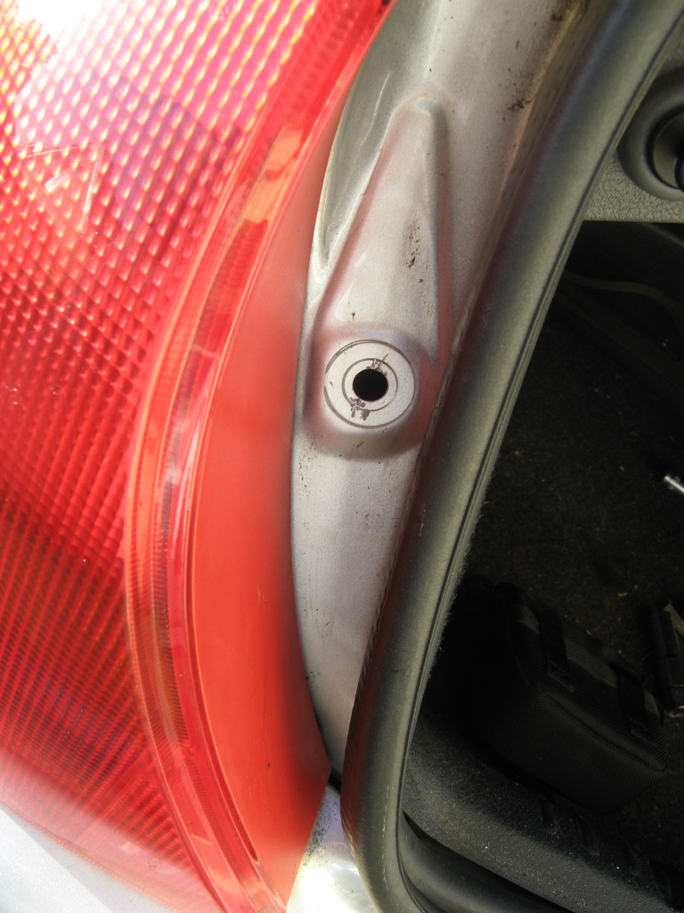

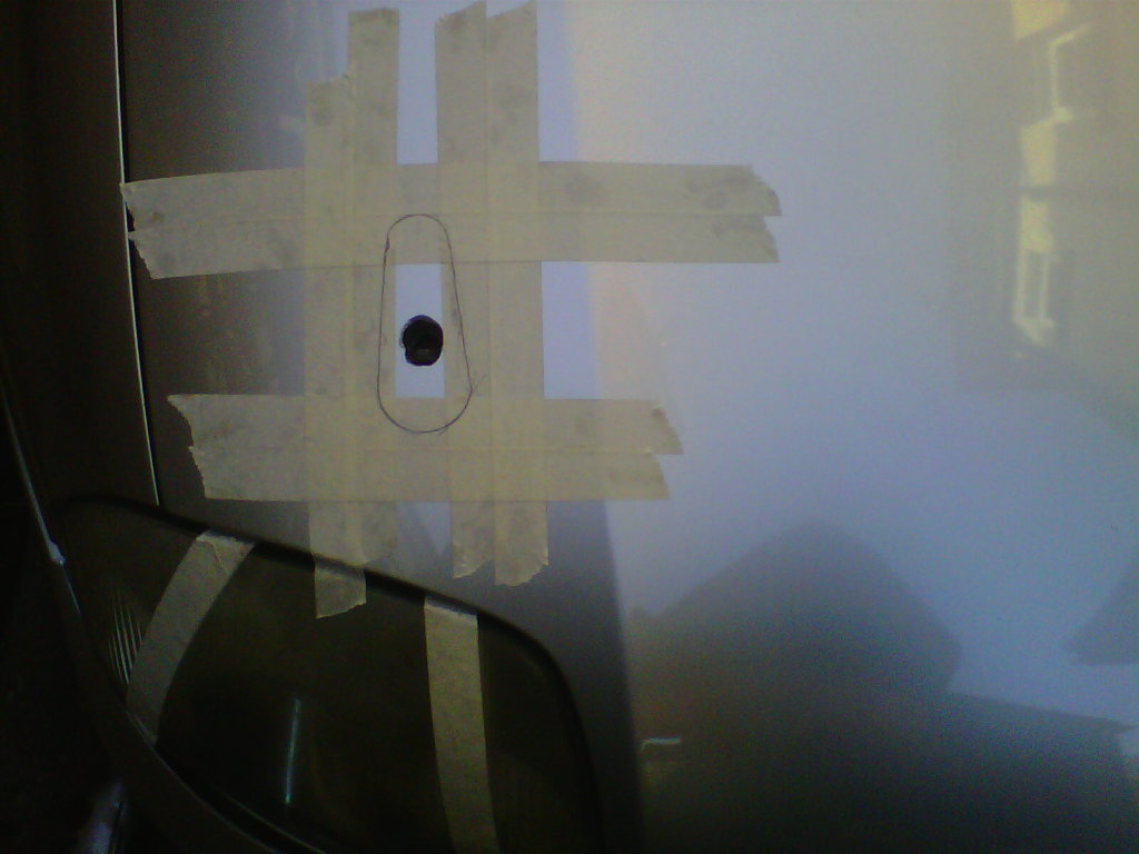

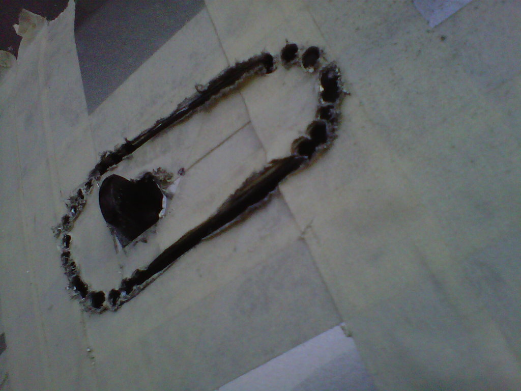

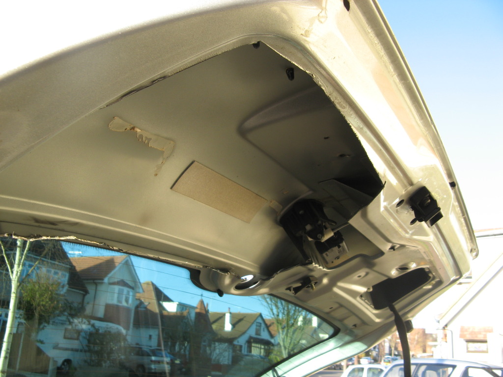

then proceeded to cut the inner skin of the boot out for lightness, this was pretty easy except i knew if you so much as brush the outer skin with a grinder, the pain will bubble on the outside!!
managed to get it all off thought, but this made the boot lid a little on the flimsey side!!

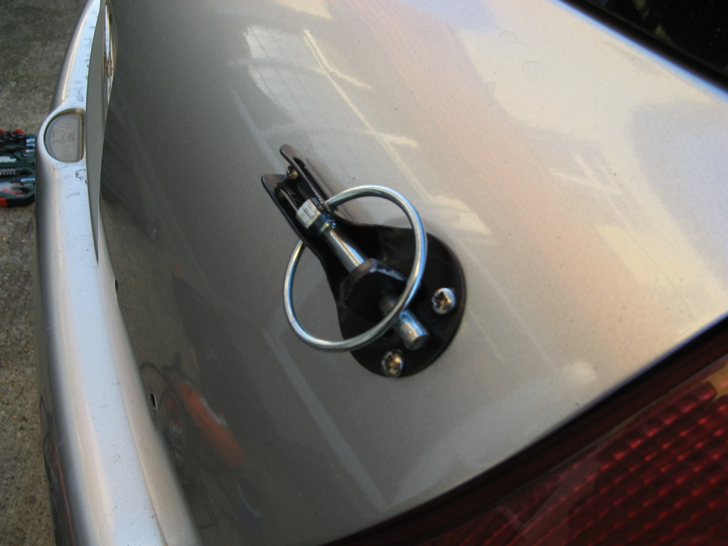

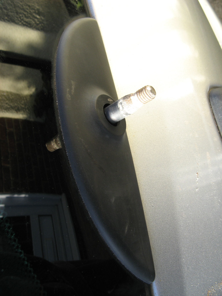

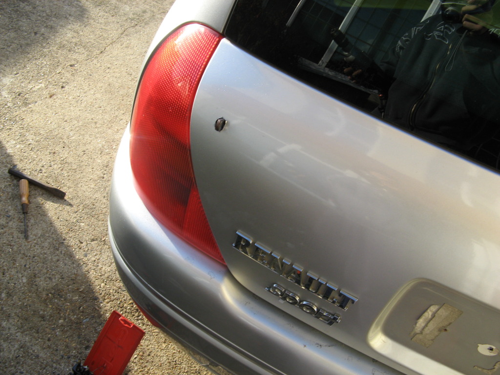

so i fitted these pins for extra security,
im sure theyre not to everyones tastes, but i personally love them,

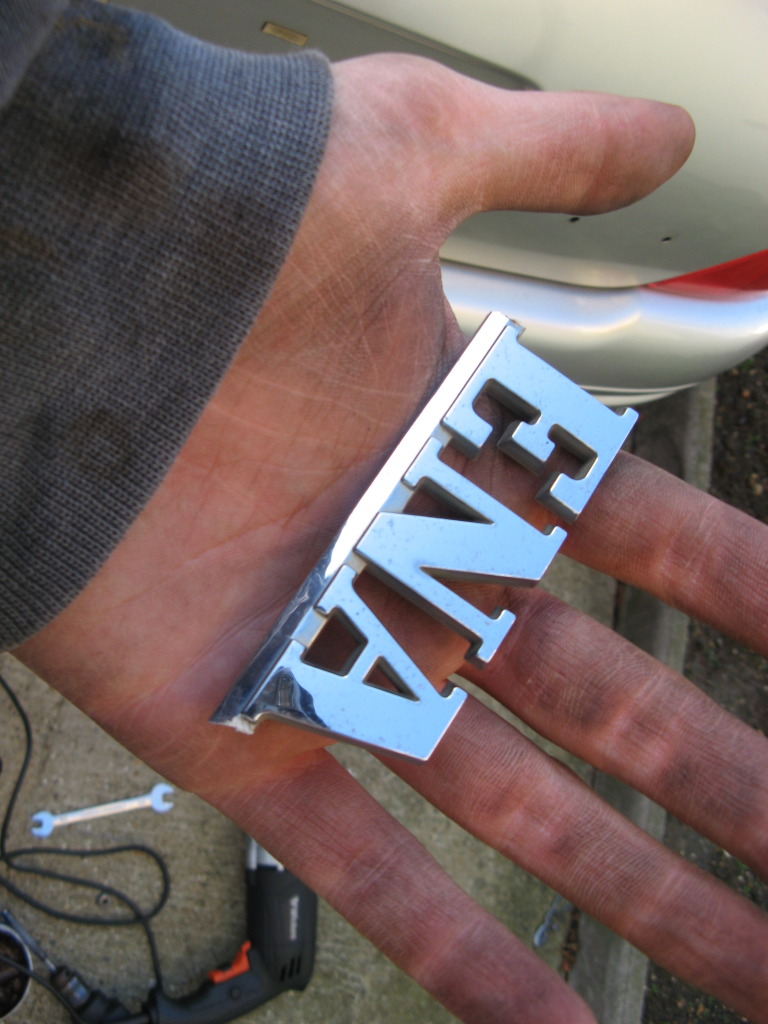

tried to take the badges off to clean and paint, but they didnt survive, will have to get some more to paint black and go with the pins!! :p
plus the sport one left a horrible mess, so ill be painting that and refitting!! lol

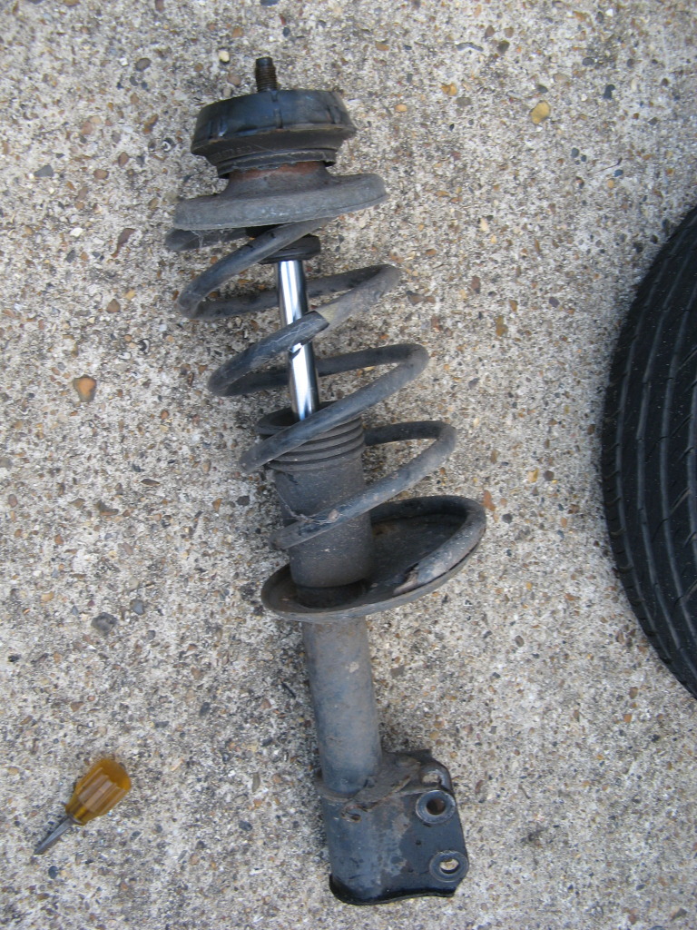

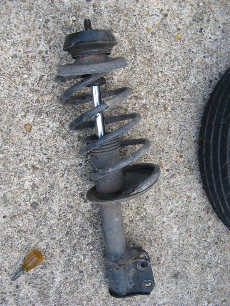

was going to change the front suspension, simply to get the coilovers out of my garage, and get the 172 looking sexy on the drive!! i hate high cars!!

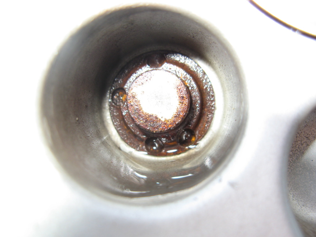

but alas the top cups would not budge at all, and looked pretty seized on so i decieded to leave it and get my mate to come round with an impact gun tomorrow eve, and they shall not stand a chance :D

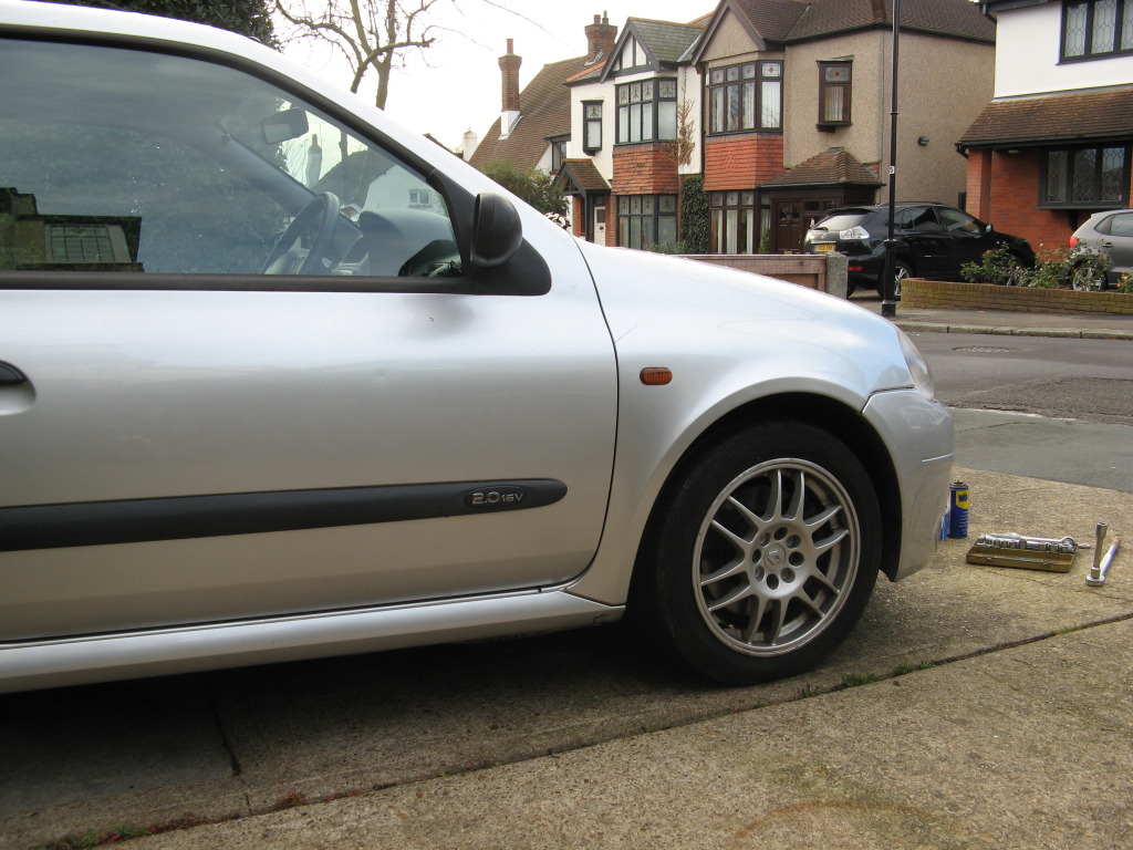

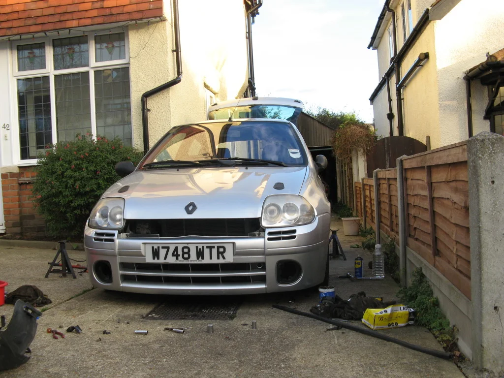

little update!! since the weathers been so forgiving (if bloody cold) ive tried to get as many little jobs here and there as i can!!
it took me a whole day to fit the bonney catches shamefully, theyre really iritatingly hard to line up nicely, theyre still not perfect because of the angle the pins sit, and the angle in which the bonnet swings down at, but they work, and look mean so im happy!!

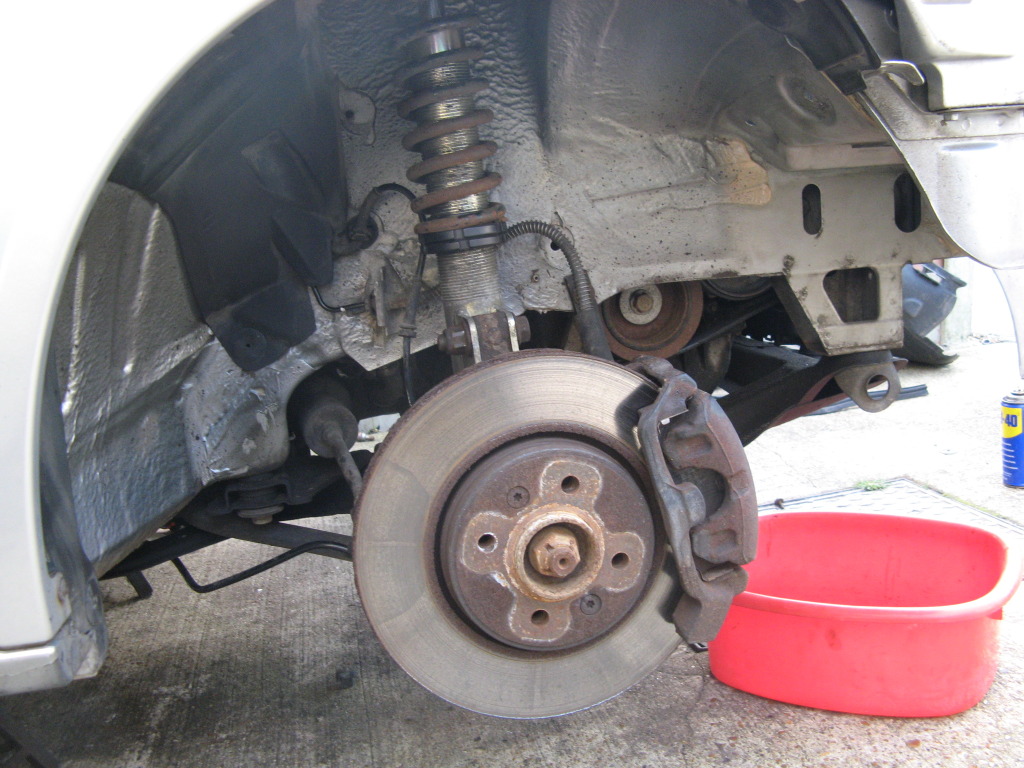

and since my mate made such little work of the suspension tops last night, i thought id have a little front end sort out today!!

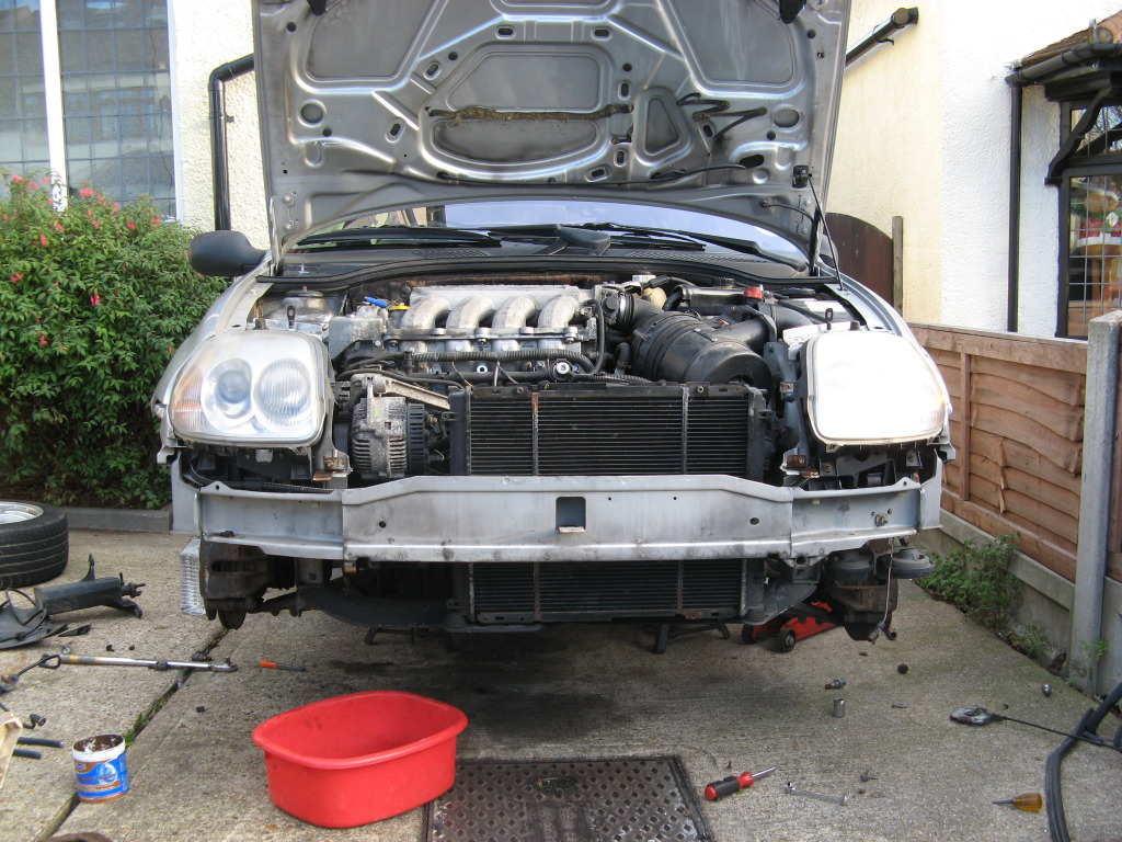

so the wheels came off, as did the front suspension.
decieded because of the little amount im gna drive it, im not going to run arch liners, (which was good since the O/S/F was missing)
so took them and the bumper off and had a little clean up!!
after my little clean ;)
Ive found quite a bit of evidence to imply there has been some kind of accident in the past, all on the same side; the spring was snapped, the bumper mount was torn off, half of the arch liner was missing, and the other half was nut and bolted in (badly). however the paint on the bumper doesnt seem new, and all the running gear seems straight, so i dont think it was very serious. Most likely someones rammed it up a curb faar to quickly!!
i wanted the upper slam pannel off too, but the aircon rad was too close to get the bolts out, so that had to come out!! as did the fuel purge valve since i had bumper and arches off already!
my lovely fix to stop the air leek from lack of purge valve! ;)

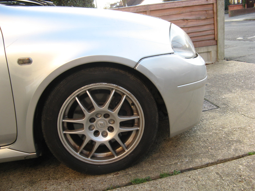

so after a heavy days modding she has a new front end stance!!
BEFORE
AFTER
BEFORE
AFTER
i quite like the stance tbh, not overly low, but ill see how it looks when the rear coilovers are on too!!

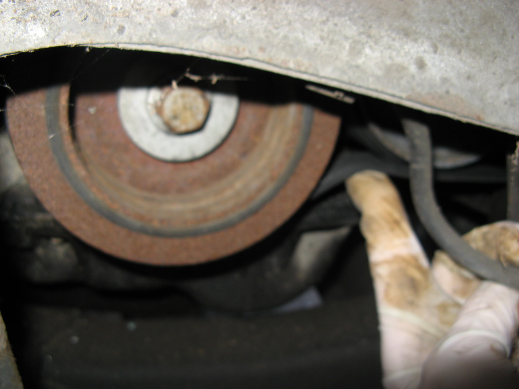

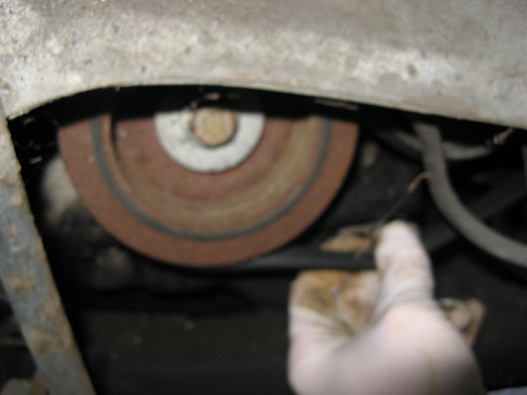

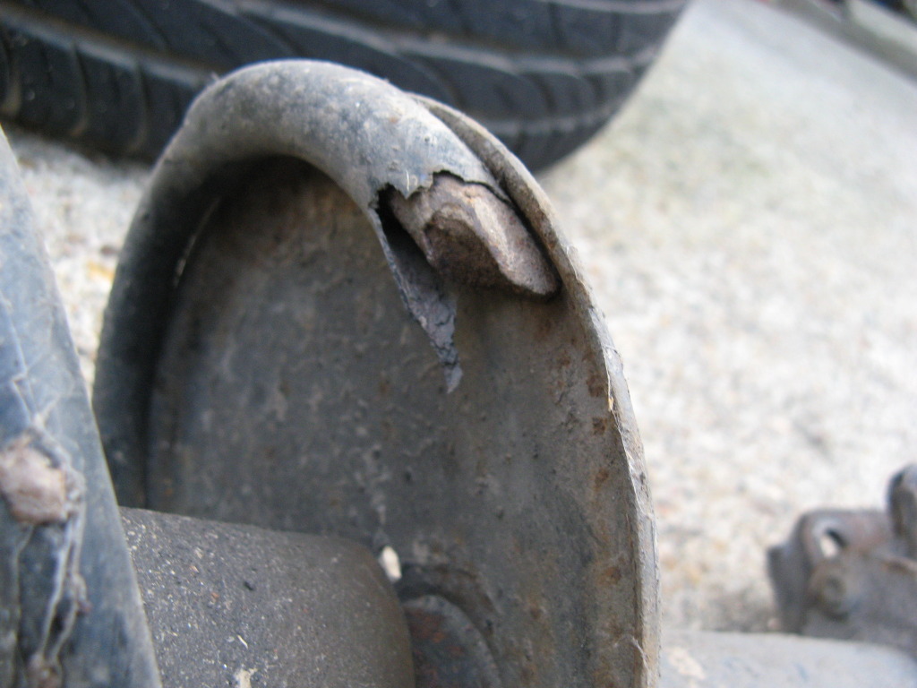

i also found this shocker!!
aux belt was litterally completely slack!! and the scariest thing is, this wasnt on the MOT fail list!! im a bit worries about even moving it around the drive like this, but i guess with no slack its unlikely to cause damage if it flies off...may well remove it completely and simply charge the battery if it runs out just to be safe!!

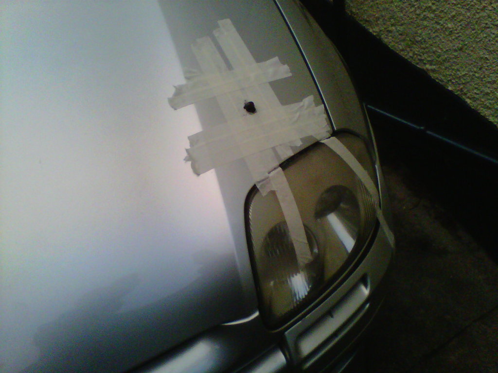

Tomorrow, ill be fitting pins to the front bumper as the accident damage has torn one of the bumper mounts off.

Great progress already! Love the bonnet pins (on both bonnet and rear tailgate). Im actually toying with the idea of them on mine in the future.

i love the look!! going to do the front bumper too tomorrow as one of the mounts has torn off and it cant be refitted properly!!

Looks good so far!
How will you stop people just opening the boot and nicking things?
Or is the standard lock still there?

the standard catch is still there, i just added the pins because i was worries about the boot flexing!! lol
heres one or two pics from todays work!!

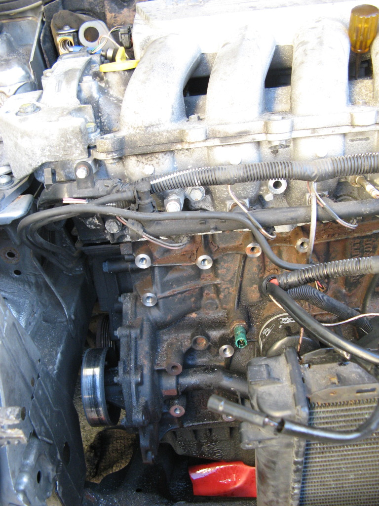

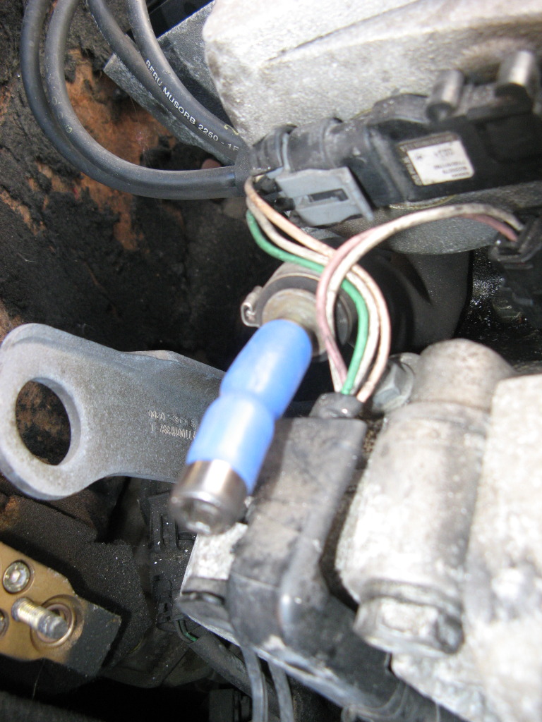

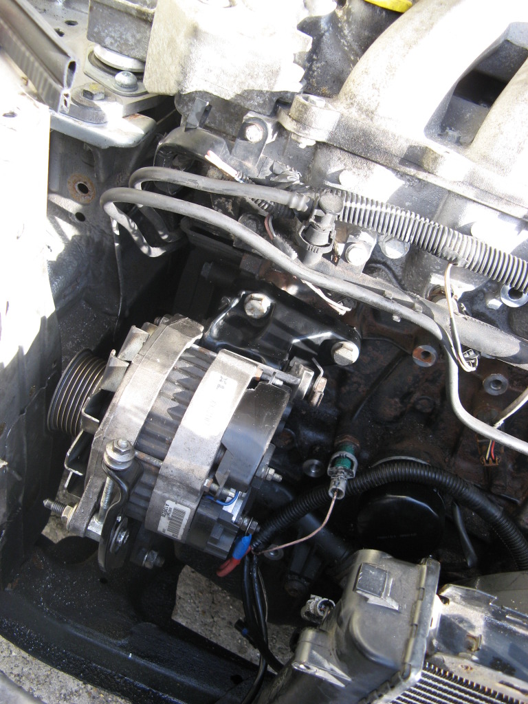

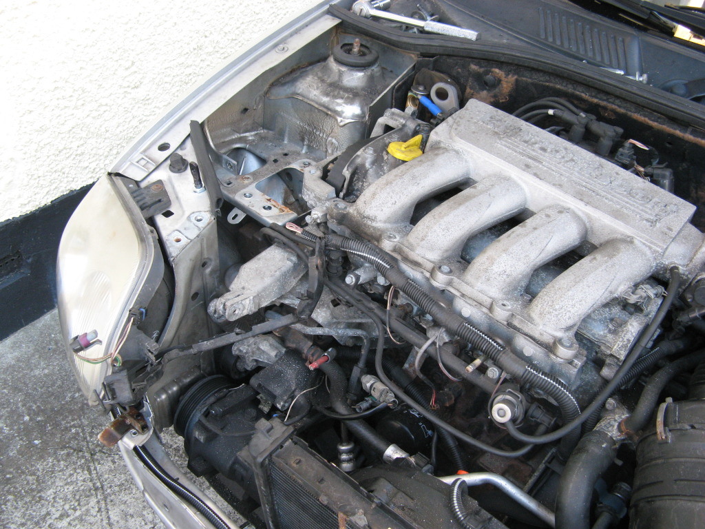

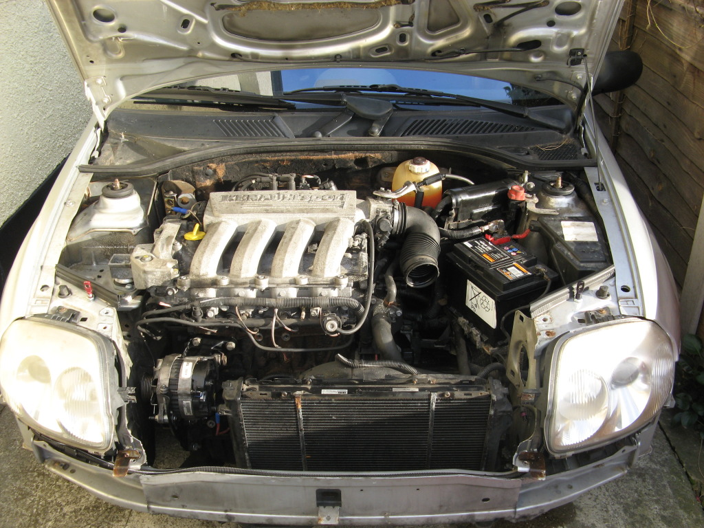

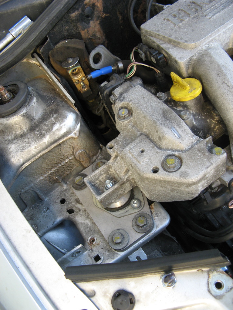

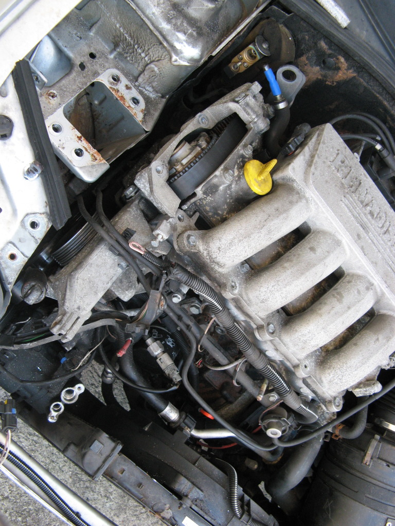

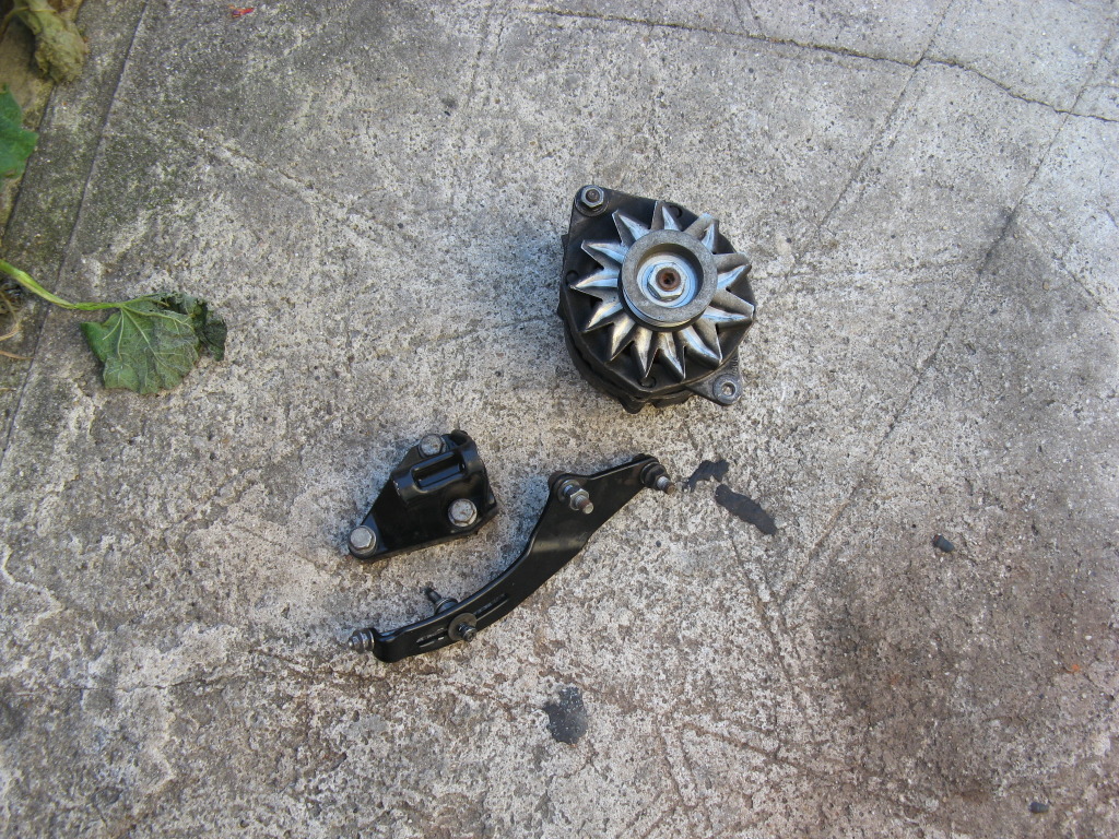

i stripped all the ancillaries off the engine until she was completely naked!! (filthy slut)
then i added (as you can see in the pic) two powerder coated black alternator mounts, and a valver alternator, these are the only ancillaries and has saved me around 10+kg's, plus reduced the drag on the engine by quite a bit AND made the engine bay much simpler and easier to work on!!
only drawback is, i now dont have an aux belt as the only i had doesnt fit due to (i think) bigger pullies!! :( so need to work out exactly what one i need and get it!! lol
also fitted the rear coilovers and arb which was a bit of a pain, no pics as the light was fading rather fast but i shall endevour to get some tomorrow!!
