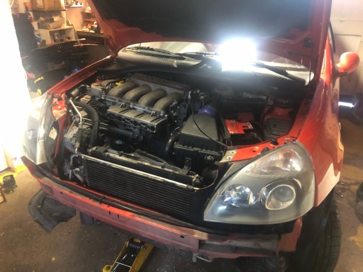

Just want to clarify the steps when removing the sump (the method without taking the subframe off)
Drain oil
Bump and slam panel off
Offside engine unbolted from chassis and dog bone off

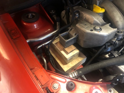

Jack engine up as high as possible and place block of wood under the engine mount
Undo sump bolts and wiggle out
This sound about right for an AC equipped 182?

Do you mean the dog bone mount or the chunky rubbe mount which sits in front of the box (the fourth mount as people call it)?

I didn’t have a single problem with the sump bolts fortunately, thank fully this car hasn’t had monkeys working on it in the past. However I didn’t want to chance the sub frame bolts especially considering it wasn’t needed for this job.
Once the engine is jacked up high enough getting the sump off was quite easy to be honest
