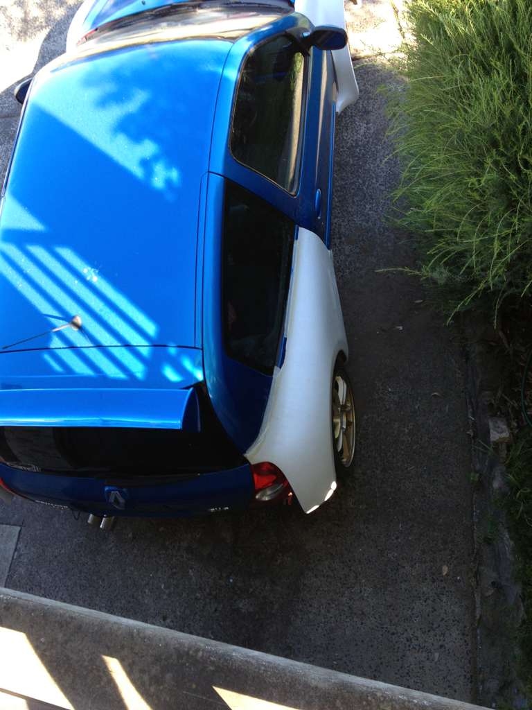

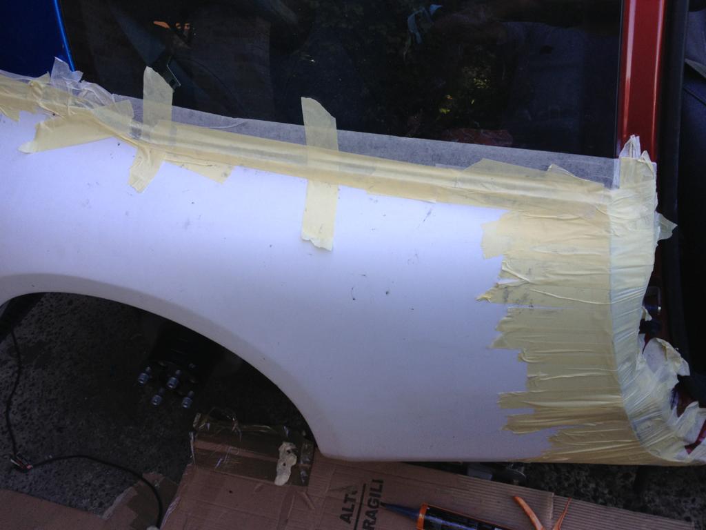

Love the rear arch's looks phat.
Haha ok sonny but i have only stupid details because i havent sleep last 3 days and i took the weekend to chasing chicks on the beach :) sorry about that ;)

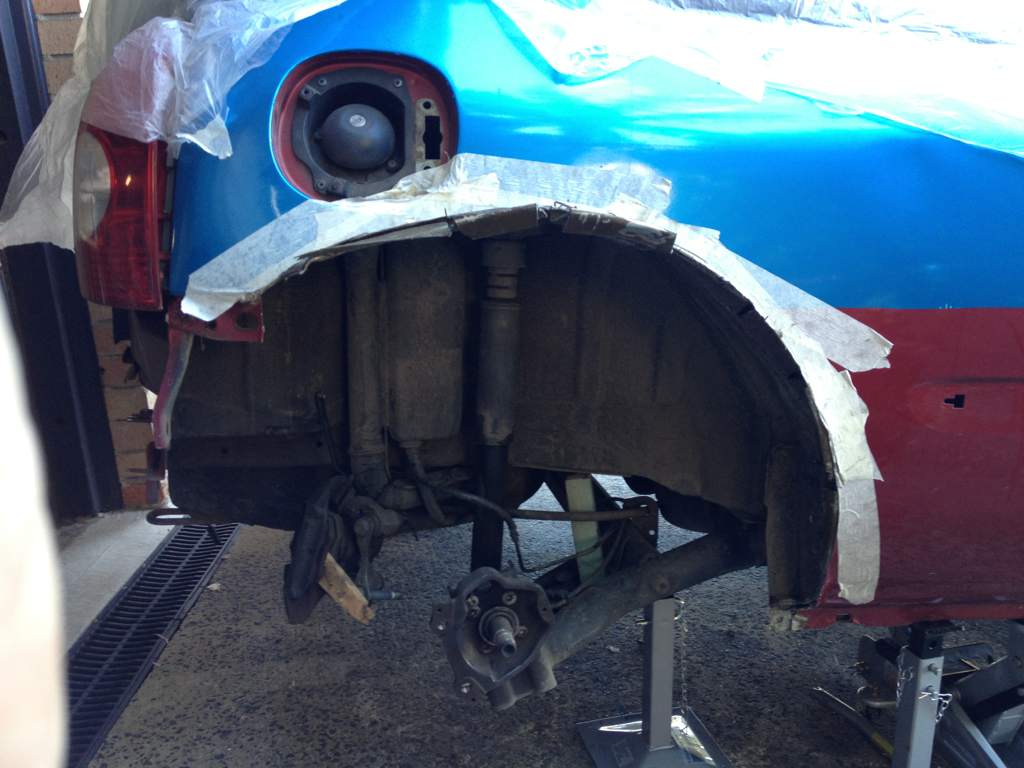

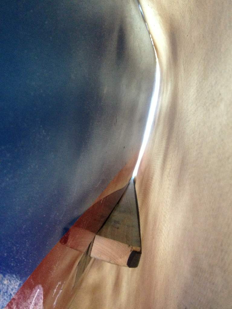

The first rear arch is been glued to the chassis... Fingers crossed...
Re: SUPER 1600 REPLICA based on 172, CLIO WILLIAMS Tribute, CLIO WILLIAMS IV (Austra

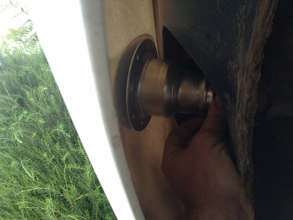

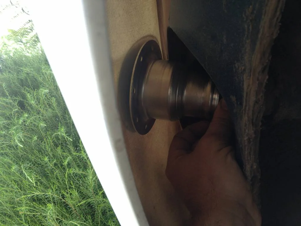

Is that 3x25mm spacers on there??. That rear wheel bearing isn't going to last long, or is that a temp measure until you get your metal block spacer/lowering thing done.
yep i put them to make sure about the measures for the spacer, next week i'll pop on the cnc workshop to check if he is doing them..
and the spacers I'm using at the moment are actually 3x 30mm!!! :)
I will never put myself in a car with 3 spacers per side... :)

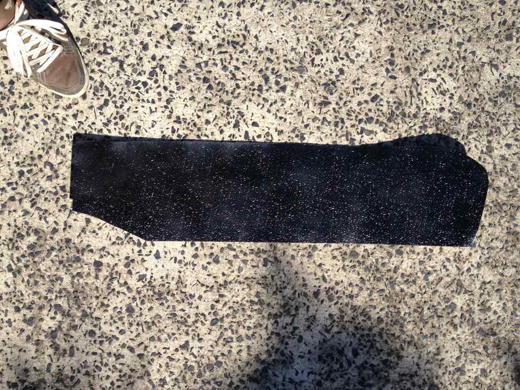

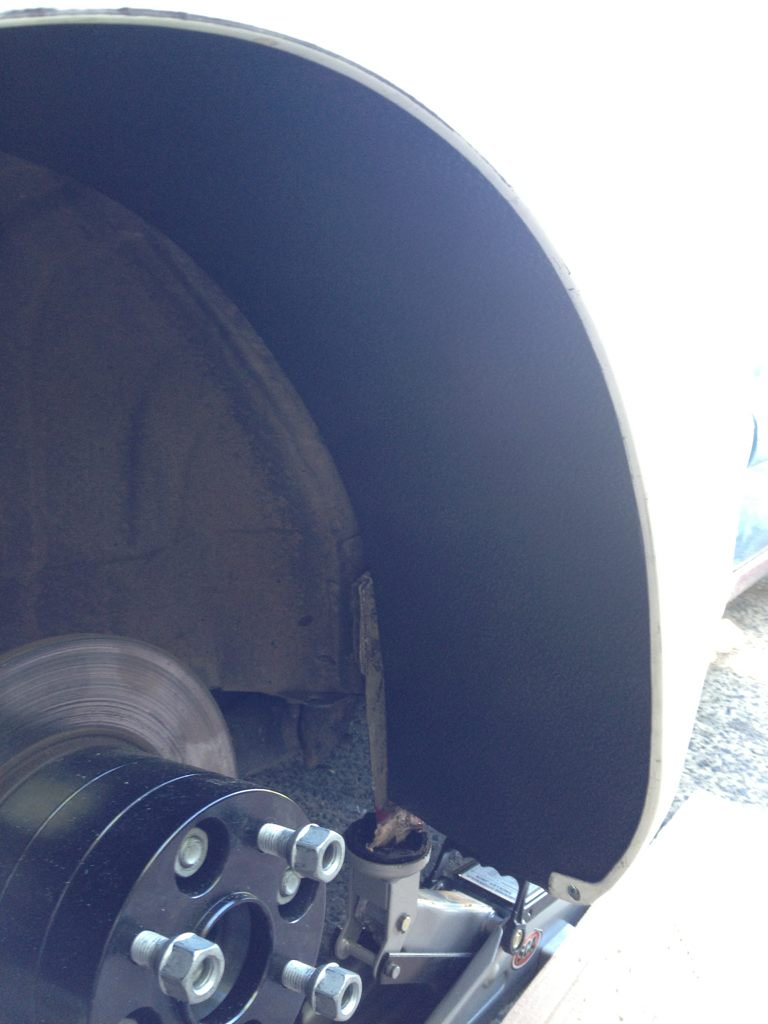

Did the kit come with the arch liners too?

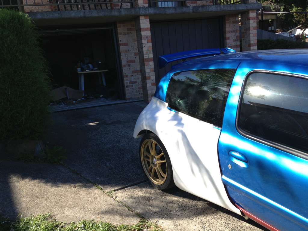

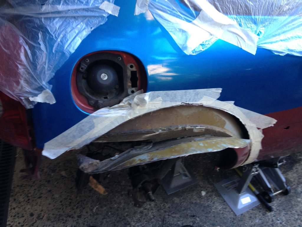

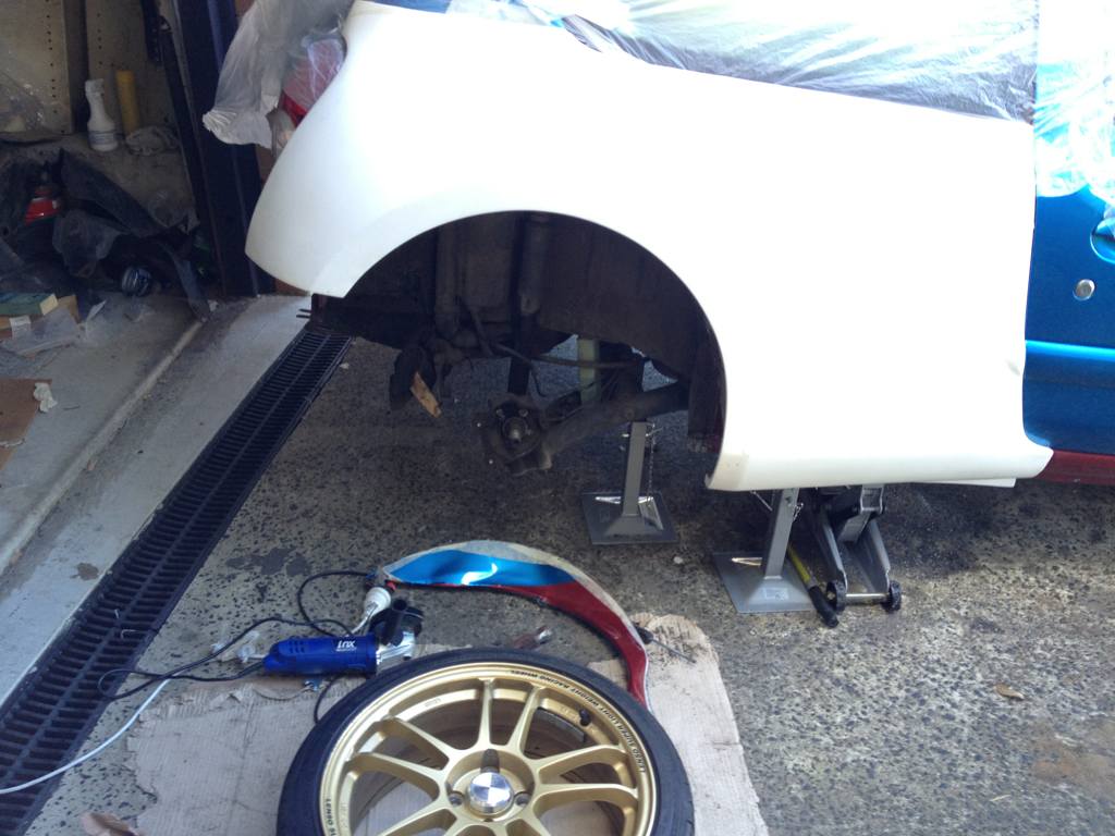

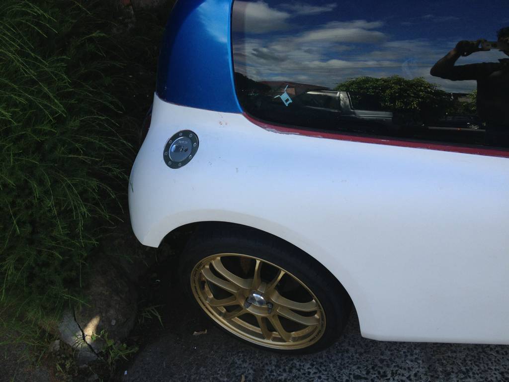

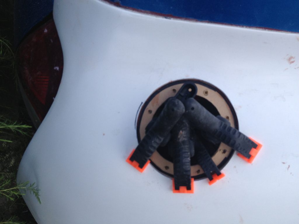

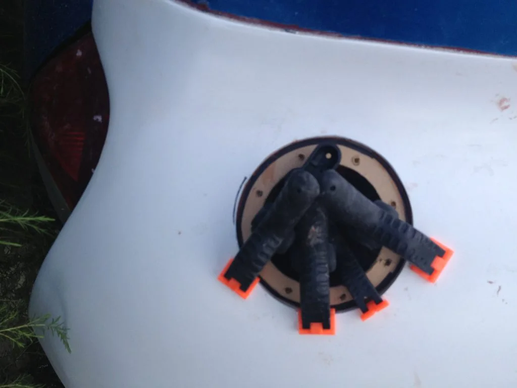

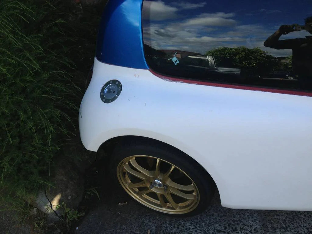

I dont know if this can be classified as "awesome"... But at least now i can put fuel in... ;)
Is not finished...
http://img.tapatalk.com/d/13/04/16/amu8ujeh.jpg[/IMG
[ATTACH=full]1025117[/ATTACH]
[ATTACH=full]1025118[/ATTACH]
