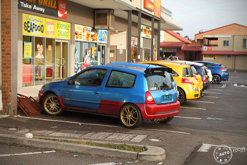

I never seen a Mondial blue in person but is the one I really love... I reckon that this wrapping blue is slightly brighter than mondial..
My idea was to make a fake new Clio model to fill the gap between a Clio V6 and a Clio RS Cup..
So i wanted same color of the classic V6 blue..

There was no 172 Cup in Oz, therefore no Mondial Blue. Could've gone with an Arctic 182 though that would've been close. Sounds like you got yours at well below market value though so wrapping is a small price to pay. Looked ridiculous on Sunday's cruise.

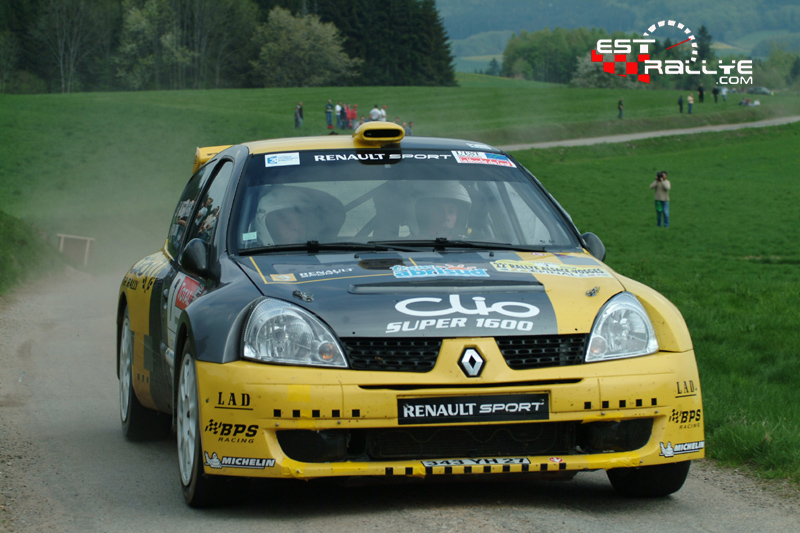

I'm ashamed to say I've never heard of an s1600 Clio before, shall I get my coat?
Flat Eric
Sing Hosanna!!
  F31 35d, Berlingo Na
Re: SUPER 1600 REPLICA based on 172, CLIO WILLIAMS Tribute, CLIO WILLIAMS IV (Austra
I know right! Bad Ye!
I've seen images of them before like the one shown above, but never new they had a name as such.
What spec were they? Power wise etc

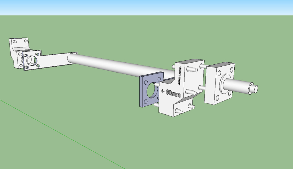

Ooh fancy drawings, so you are going to have it sit right.
Hiw you going about the front, hopefully not 100mm spacers :S
Yep was a sketch for my mate who has to milling the piece.. Hopefully will hold the wheel for a while :)

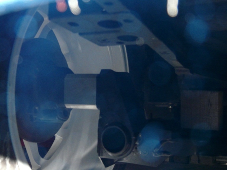

The front is almost ready with arms and steering rod from laguna v6 but i cant find a driveshaft to fill the gap..
Monday i will go a bigger wrecker maybe i will be lucky.. Here there is not much part as in europe... :(
I was in the same situation and the biggest shaft I could find with 32 spline inner and outer cv was from a ph1 1.9d Scenic which turned out to be the same length as the shafts I have fitted to my 172 cup. I am just going for custom shafts now, too much messing.
Would be good to know if you find anything longer 650mm passenger side and 740mm driver side though.

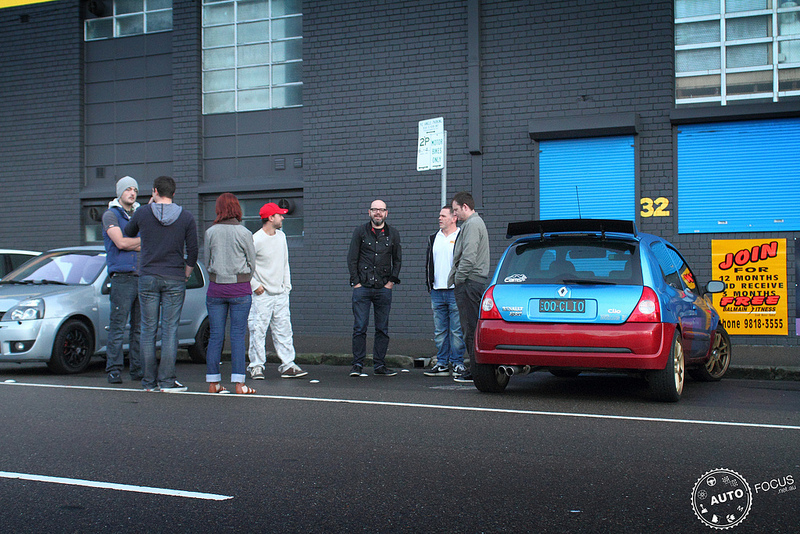

Is there no way to make the exhaust straight? That's the only thing letting this down
There is a way ^^:
Cut the double Exhaust-tip
And weld a nicer one on it.
So, that it will look like this on the Car:

As for winding over the rear track are you going to be doing something like this?
I saw this on a ex clio cup car in France, converted to a clio rs maxi. thought it might interest you.
Very nice search Andrew!
That blog is a bit hold but I really love it! did you see how cool is that F2000???? wow!!
Yes is going to be the same but I have to move the hub a bit up because I will use the ones from Laguna that are a bit bigger and the axle will hit the chassis...
