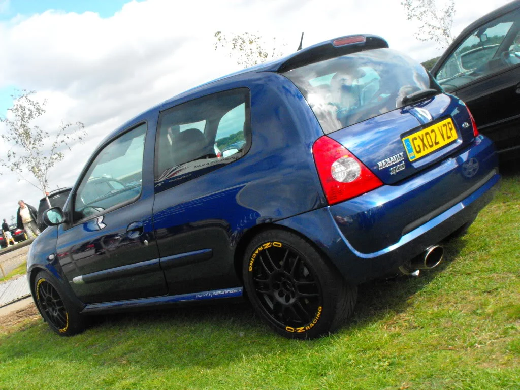

This weekend at TRAX I had chance to take some proper pictures of my car whilst it was nice and clean. All the work has been done at RS Tuning in Leeds and the conversion costs £3500 + vat for anyone interested.

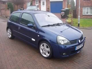

Here is the car when I bought it - Just 10 months ago!:

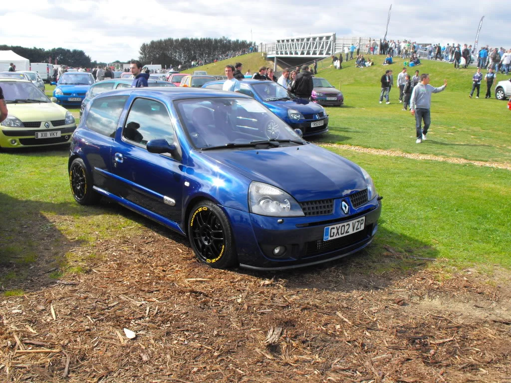

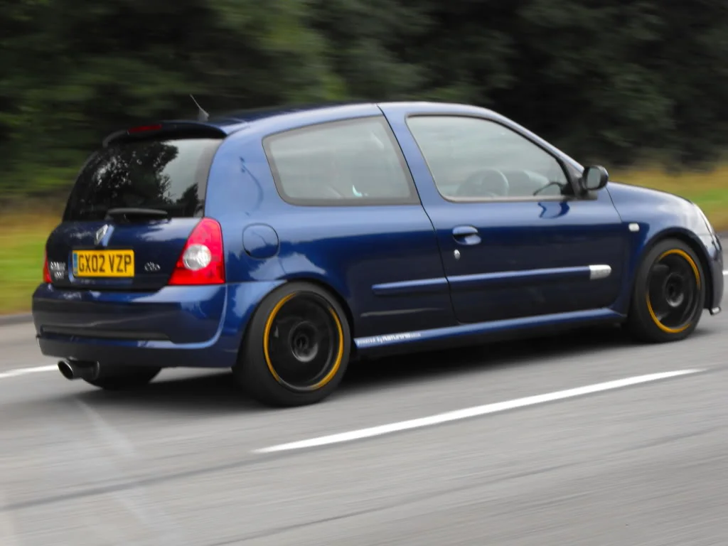

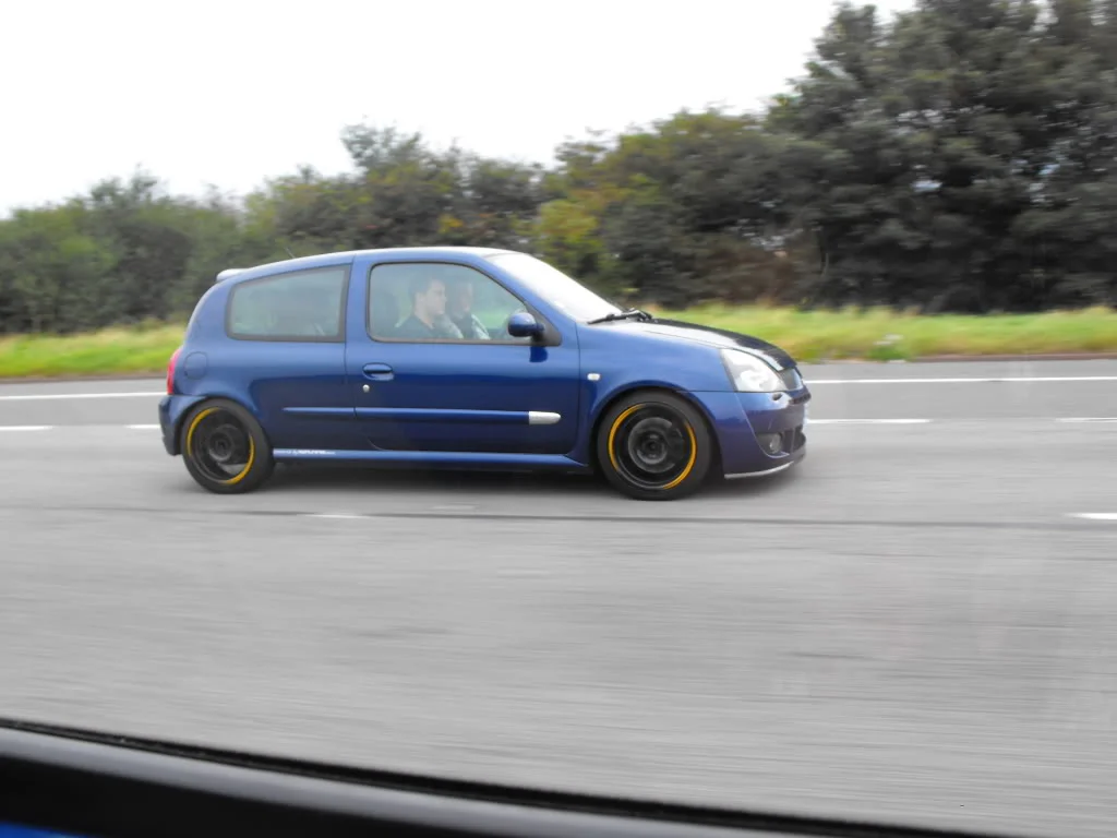

A few snaps taken on the motorway:

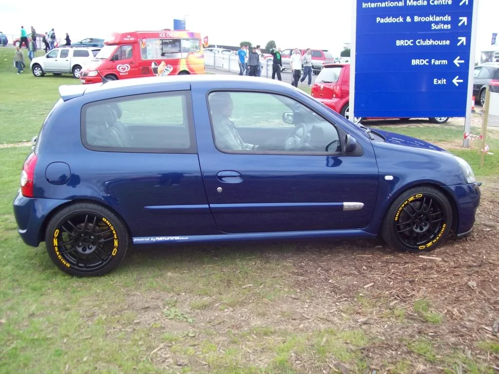

Cliosport.net stand at TRAX:

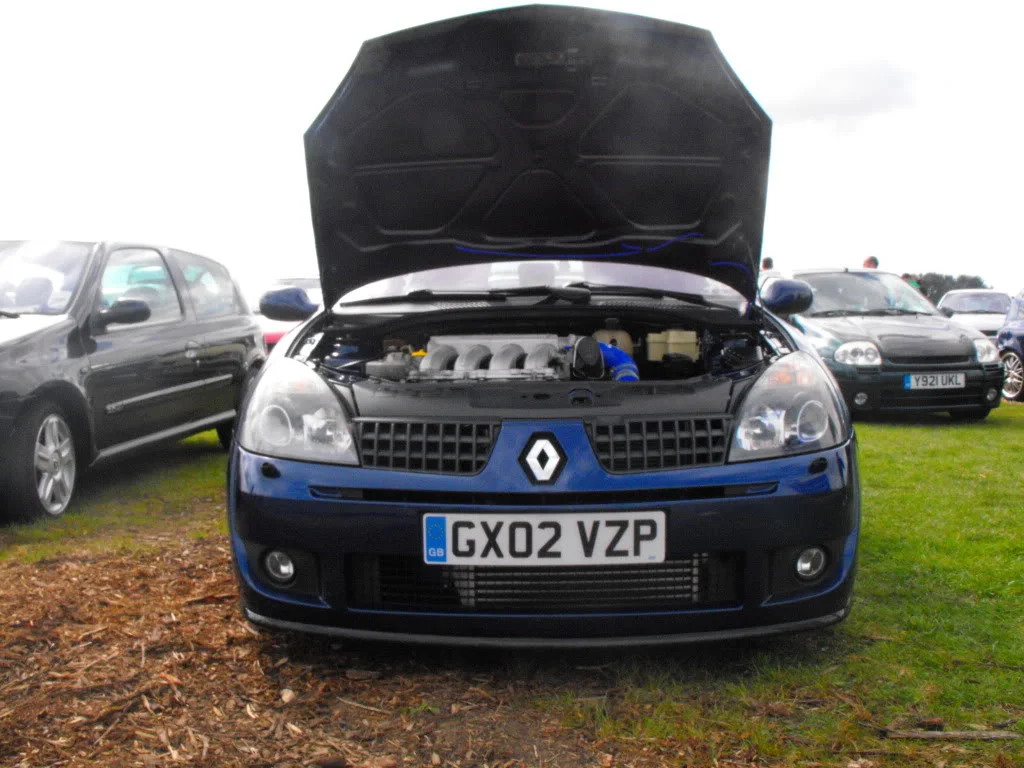

A couple of open bonnet pics:

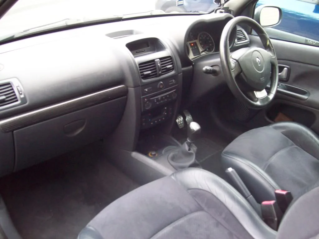

Interior pic:

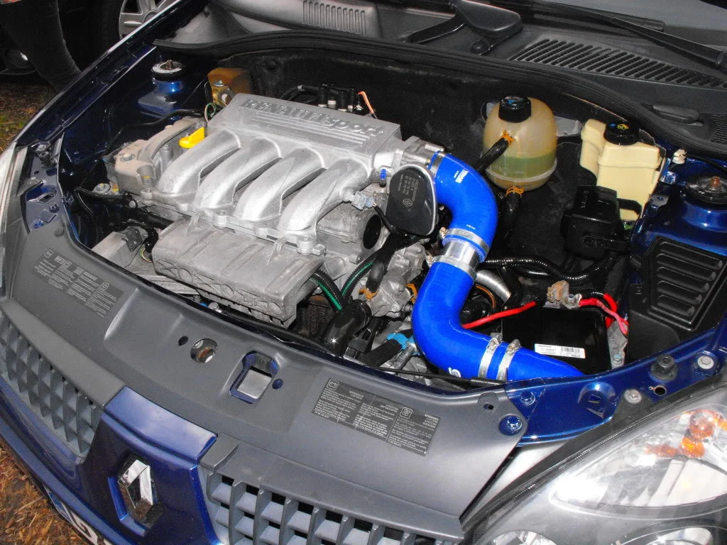

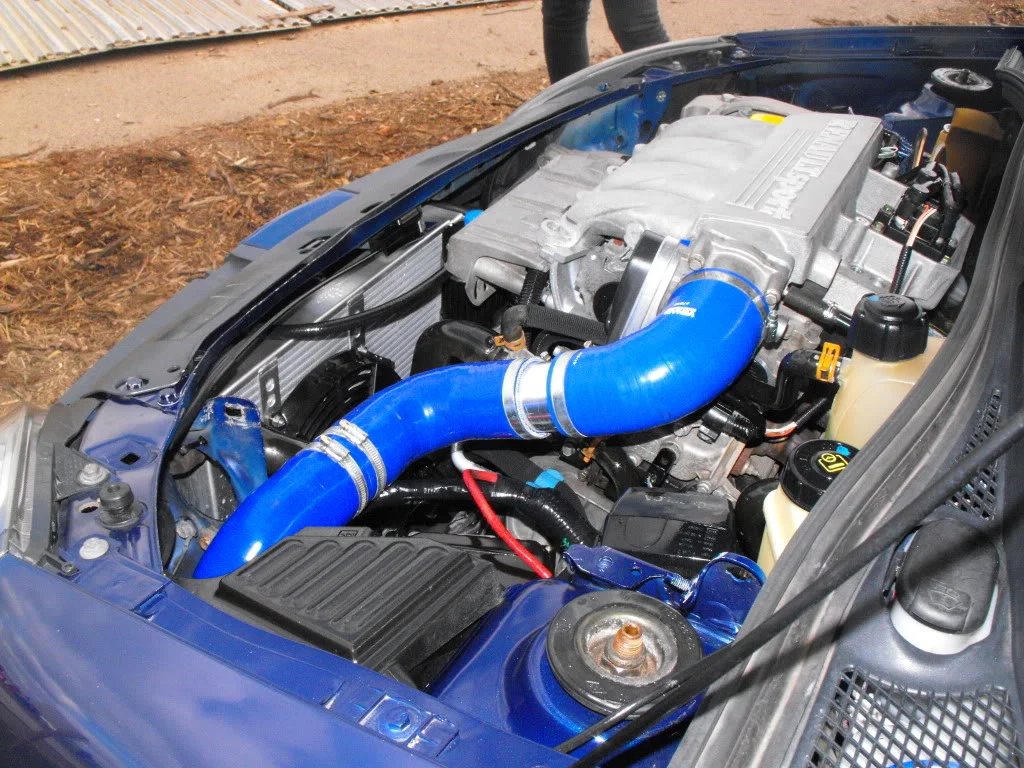

Under Bonnet Pics:

What the blue bottle for? Remote filter?
Its fudging awesome btw! Pauls done a really nice job of this "kit".

looks quality, i might have to get this kit start of next year! what air filter is on the charger at the moment?
