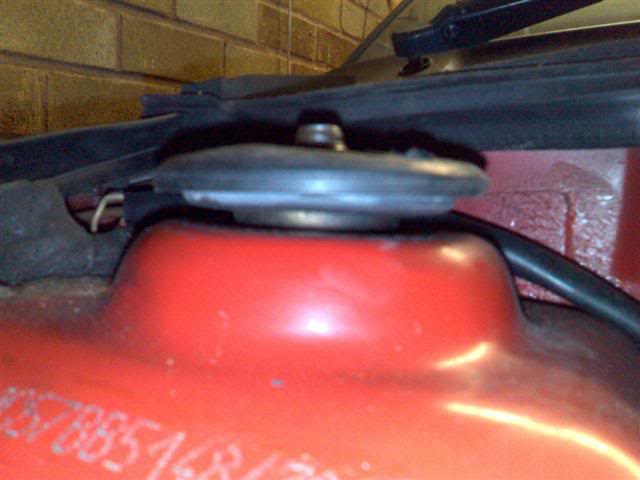

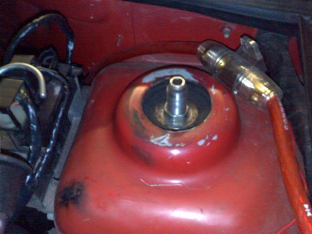

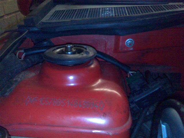

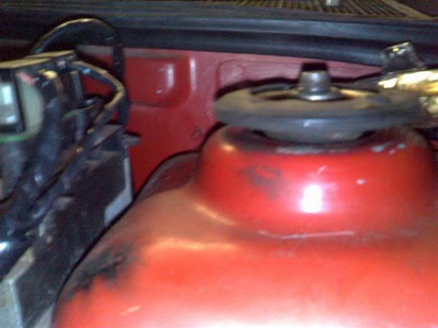

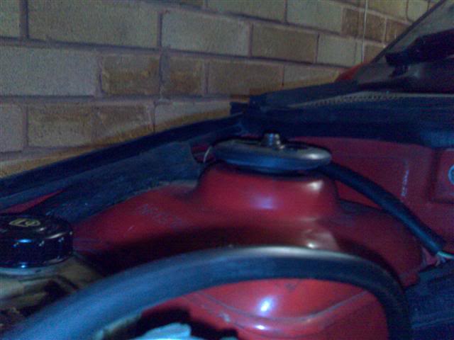

My problem is that when the weight of the car is lowered back onto the springs and the top nut is as tight as it can go... the top nut fits half inch or so proud of the steel.
i've tried various different ways and different parts but it doesn't seem right, i must be doing something wrong.

have you tried fitting the top cap to the fully assembled strut unit off the car?? the top cap should fit over the small retaining nut when tightened
yeah its fitting over the nut, i checked this out before as i thought it may have been a safety nut or something but no its the proper renault one.
am i right in thinking it should not sit proud?
no, otherwise you wouldn't be able to turn your wheels! (the whole strut rotates when you turn the steering wheel)
so the top cap HAS to be clear of the body
can you post a pic?
the whole strut rotates even the top?
i'll take a picture now yeah but aint got a clue how to post it.
if anyone reading has a pic of the top of a clio suspension strut attached the car could you please post or direct me to it....
thankyou
As in the renault nut (the big saucer shaped one) is above the strut housing/bulkhead bit?
If so mine always has, think its normal.
looks fine to me
